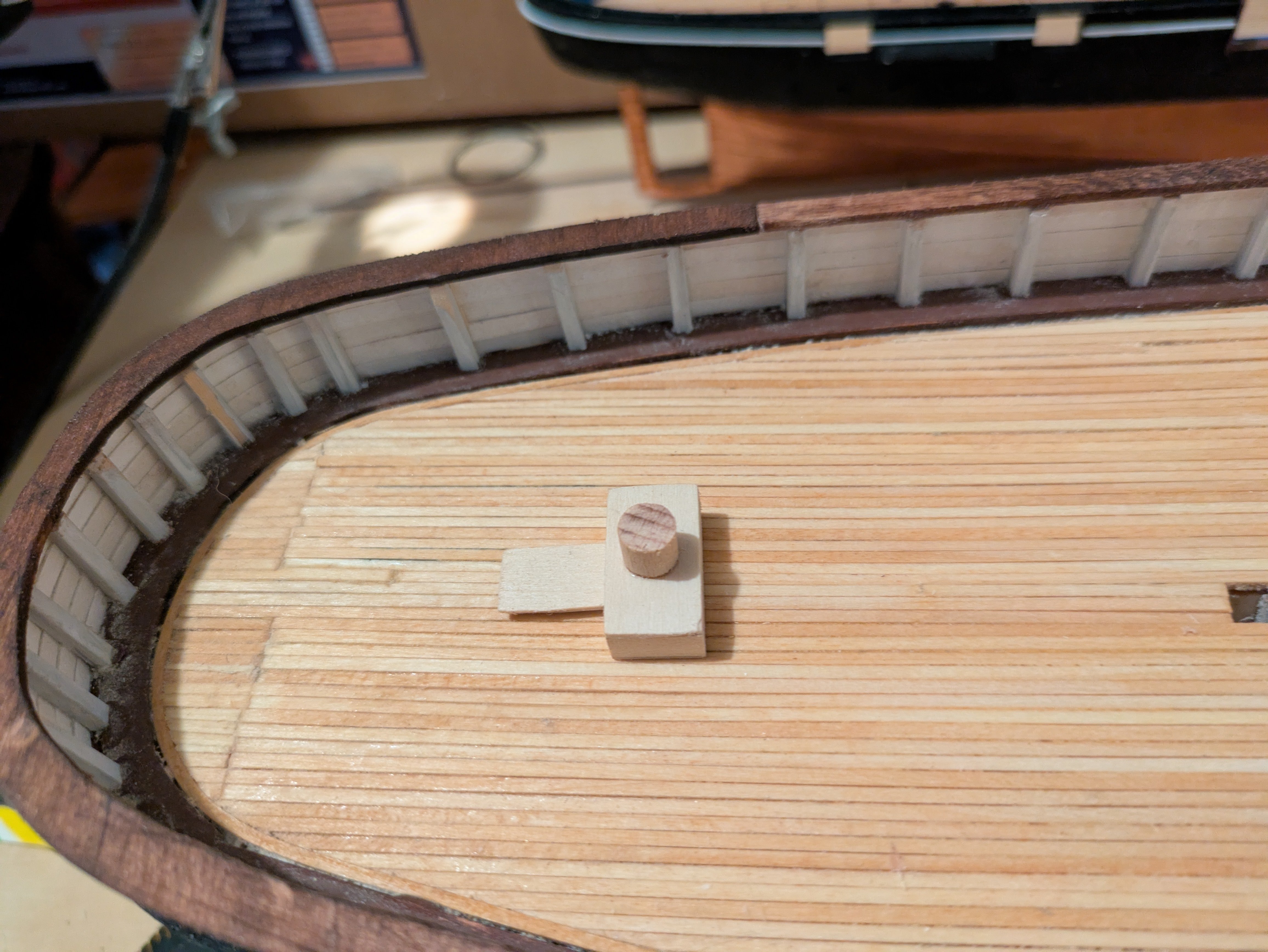

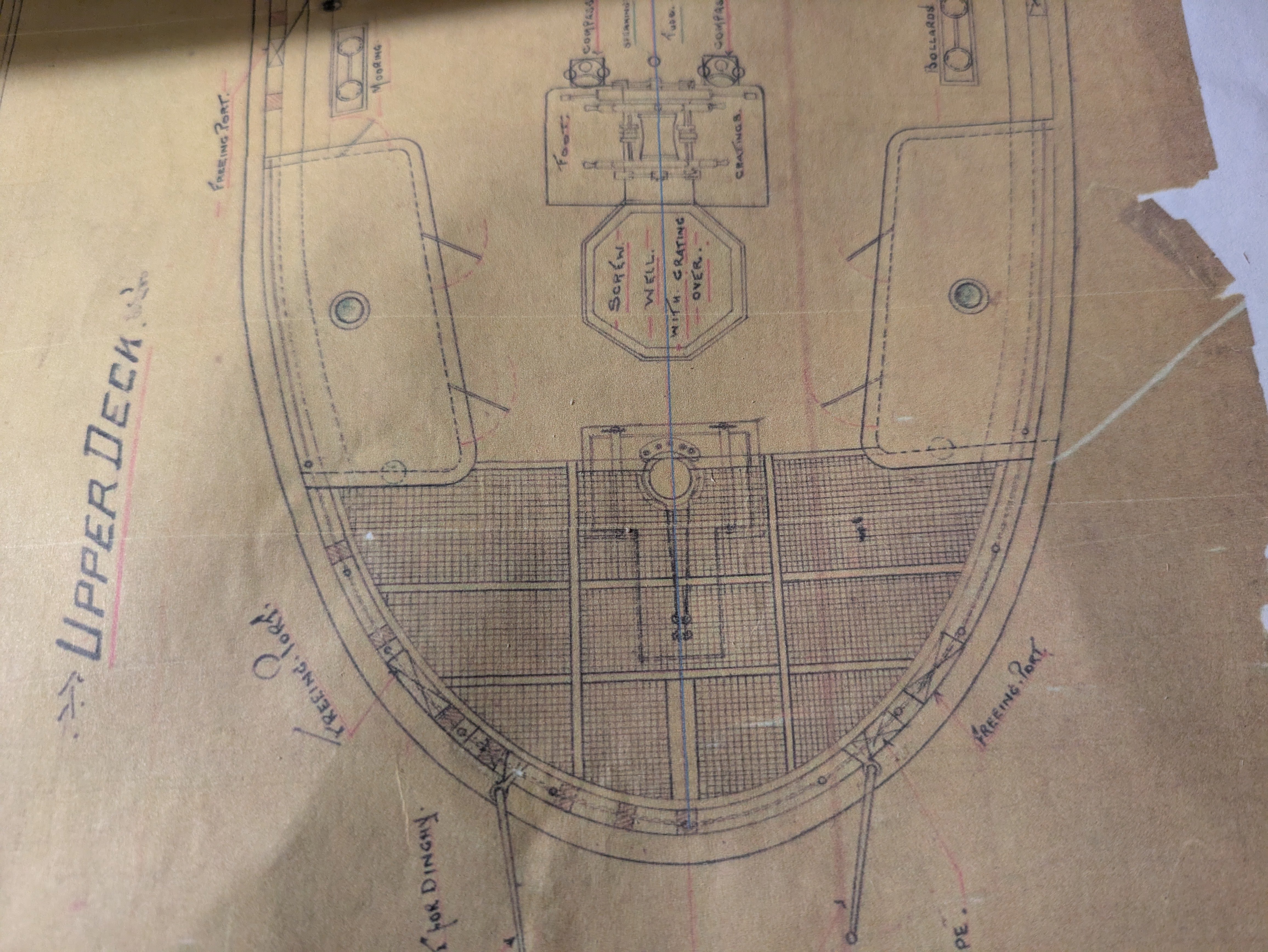

I also started the first piece of deck furniture - in this case the mount where the rudder post comes through the deck. Plans here:
The forward part is actually taller than the after part, and so the initial piece is thus:
The tiller will be made from brass, and the whole thing painted, and finished with some brass work that is visible in the side and top views. On the current ship it is black - I have no images to confirm or deny that suggestion, so I'm going to go with it (the whole thing is going to be hidden by the monkey poop that is missing on the current ship.

National Maritime Museum in the UK. There are a couple of plans of the 1901 version available online but they are really hard to read. Dundee Heritage (which owns the ship) has a lot of digitized, high quality plans from her refit in the 1920s.

Not as much progress as I would have liked. The management company for the house we were trying to lease refused to budge on the extension cord/adapter issue so we told them to pound sand, and I had to make another trip to find an alternative residence. Fortunately, we found an equally nice place about 0.3 miles away, and the lease is acceptable. Expecting the DocuSign Monday, at which point, thankfully, we can start actually planning the move.
In the interim, I finished up the tiller box and tiller. To make the metal parts (except the actual tiller), I took 3/16" wide copper tape, made 3 rows of dots for the bolts, and either cut them 1/16" inch thick (the bottom, the iron around the rudder post, and the two straps on the top) or, I cut a 1/8 strip and applied 1/16" to the top of the box and 1/16" on the side. The tiller is brass with a hole cut into it at the end for a wire loop that will be the attachment point for the chains. View from the front:
and the side:
Then, paint the whole thing black (as on the current ship):
To some extent, I don't know why I'm bothering. It will be mostly hidden under the monkey poop, although maybe I'll leave one of the grates off so that it is visible.

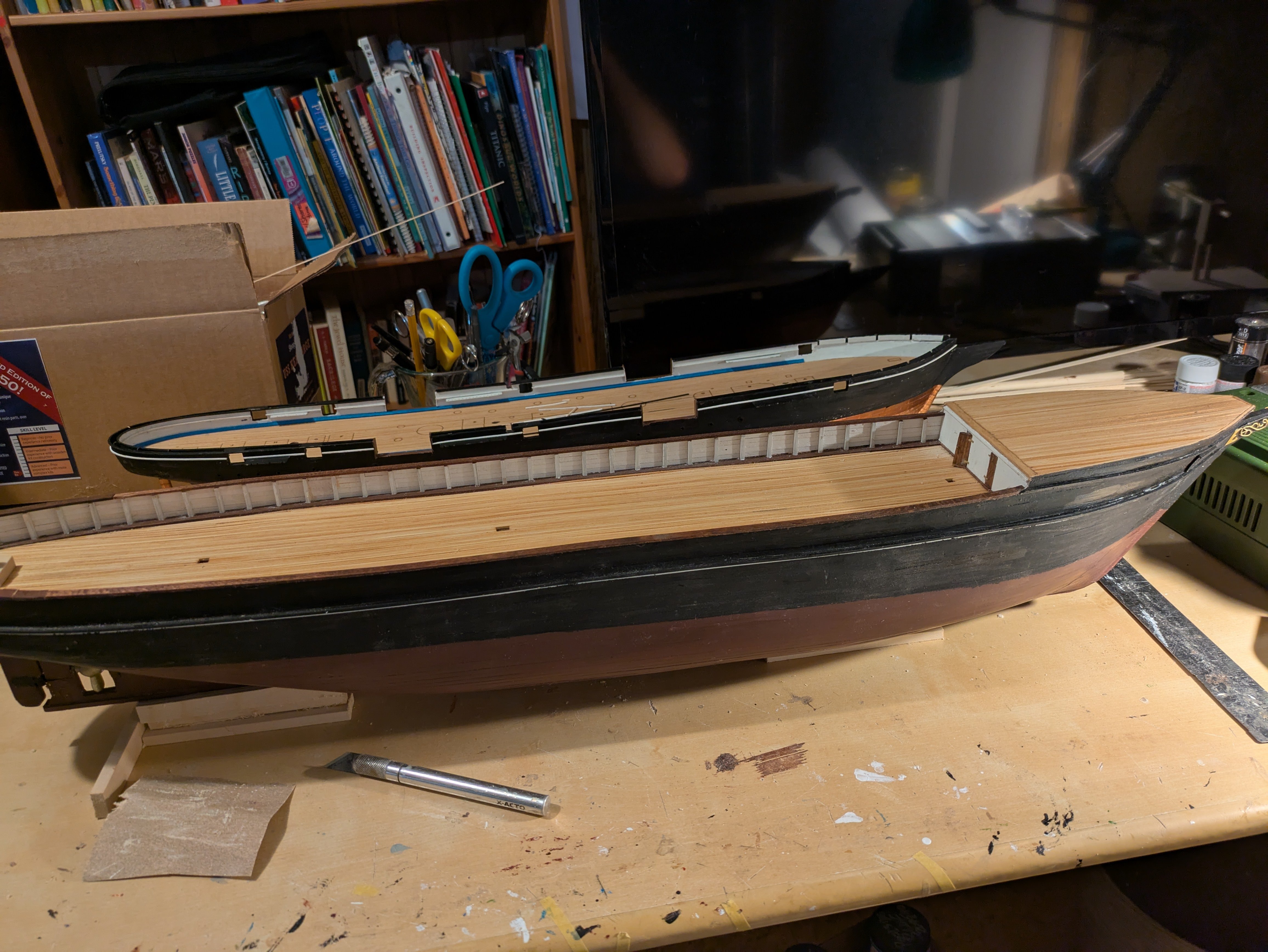

Well, I've been pretty MIA on the forums for almost two months now. The reason is obvious, but I have the following to show.
The Discovery packed for moving (in my car):
Many of my tools, similarly packed:
And my new Ohio worktable which I bought from a used office furniture place in Cleveland:
Not shown is a cutting pad I bought, because the table top is a white board! So, I can do my calculations on the table as I work.
We'll see if that is just a gimmick, but it's a nice solid table and I'm pleased with it.
Alas, my plans are still in DC, so I won't be back to work on the ship until after this coming weekend, but I feel like I'm pretty close to ready.
