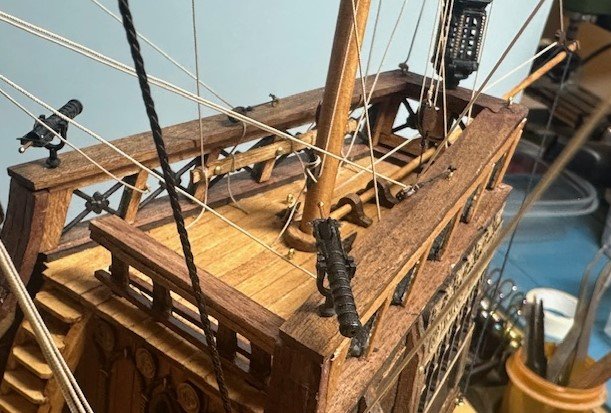

Well, I've completed another phase in this Santa Maria build, so thought I'd post an update with the progress I have made and the pictures I have taken to-date.  At my last update at the end of December, I had not yet stained the outer hull, so it was time to do that.  I think I had noted that Pavel Nikitin had his own set of paints/stains that he was recommending but, being the poor sprayer that I still am, I decided to use more conventional stains and brush or wipe them on.  For the hull, I wanted a darker stain, so I opted for Minwax Honey wood finish.  I wiped it on the hull, then sanded and used some steel wool to smooth it out some, then applied a 2nd coat.  May do a bit more touchup before completion, as it is a bit "splotchy" in spots, but it gives a decent impression, I think, of how a 15th century ship may have looked.
Next task was to work on the main deck and quarter deck rails.  The kit's quarter deck rails consist of 5 sets of two rail pieces glued together to make the proper rail width. while the kit's main deck rails consist of 6 sets of three rail pieces joined to make its rail width.  The char on all of these pieces was removed the best I could using my Dremel with a 220-grit sanding disc.
Once these were all glued together to form two sets of rails, the kit provided a sheet which was needed in order to cut and shape each of the rails to their proper form.  That was completed and then they were set aside for now, waiting to be stained and then placed once the decks were completed.

The rail system that was provided in the kit for the poop deck was a dark gray resin material.  Most of it would be covered by wood slats, but the decorative "X" supports were painted black in order to stand out a bit better.  The top rail isn't in these pictures, but you'll see it in later pictures.  The poop deck came out looking fairly well.
250126m-PoopDeckRailPainting.jpg.ef6d7a1aec0a68f43d96e4a0f6cb236f.jpg     250126n-PoopDeckRailTrim.jpg.7117a4bb5806fbd5f01d9c97d72a3fb3.jpg
250126o-PoopDeck.jpg.830e640c1e2e1b686a843eee9b1f69e9.jpg      250126p-PoopDeck.jpg.39e33a78a6eb4bb42d05b3e56d446443.jpg

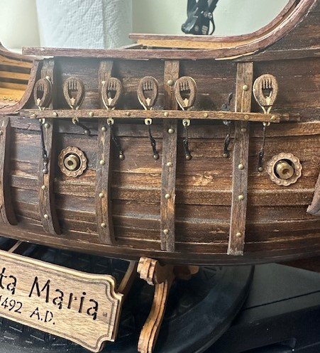

Another short update... Trying to complete everything on the outside of the ship, so the ship's buttock fenders (is that the proper term for these?) were next on the to-do list.  Like almost everything else in this Santa Maria kit, these fenders were provided in the laser-cut sheets.  The plan was to pop these out and match two of them together to make the buttock lines thicker as they were placed on the outside of the hull.  In order to not mix them as I was gluing them together and fitting them, I made a little box chart to assist me in the organization.
250209a-ButtockRider.jpg.d7542ee80b91b624446b72156af98a45.jpg   250209b-ButtockRider.jpg.ea1bb6f5c812890ef50379daf12e1fcf.jpg
There were also some design pieces included in the kit that needed to be placed on the hull and stern below the poop deck.  Since these were critical for the placement of the aft fenders, the pieces were secured on the ship's exterior with some CA glue.
The buttock fenders off of the quarter deck needed to be placed so that the kit-provided channel board would fit based on the spaced slots in the board.
In hindsight, I really messed up in preparing each of the buttock rider lines for placement.  They needed to fit smoothly over the wale strakes and, rather than cutting the wale strakes back to the hull where the buttock fenders crossed, I measured and milled slots into each of the buttock rider pieces.  Nice way to use my Proxxon mill, but it was not the best way to fit these vertical boards.
After they were milled but before final placement, I stained them, first with a pre-stain, and then with the same Minwax Honey stain that, of course, I used for the hull.
They were then secured to the outer hull with CA glue and the channel board secured, as well.
Still a bit more to do on the exterior, placing the nails in the buttock fenders, securing the rudder, and a few other things, but think I will work on the three decks' railings and ladders next.  Anxious to get this one done.

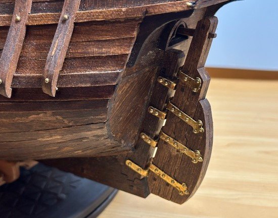

I had also begun work on the rudder previously, so wanted to finish it.  Positioned the kit-provided rudder straps for the pintles and gudgeons to fit properly and, with the ship flipped upside down, it was much easier to secure the rudder in place until the CA glue dried.
250228c-Rudder1.jpg.9782ce7db35b8292b2e844444b43167d.jpg      250228d-Rudder2.jpg.0b0a326d9c32e188aac99193733fcfc1.jpg
Wish I could get the brass straps to appear a little darker and may continue to work on that.  But, with the exterior work pretty much completed on this Santa Maria, it is time to get this on the cradle.  The kit provided a pretty nice stand for the ship to sit on.  So, popped out all the cradle pieces from the sheet, cleaned up the char as best I could, and then pre-stained it, stained it, and assembled it.  Still a bit undecided on if I want to permanently secure the ship to the cradle but will make that decision shortly.  Placing much more stuff on the various decks will make it difficult to flip the ship in order to drill the necessary holes for any permanent rods between the ship's keel and the cradle.

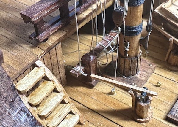

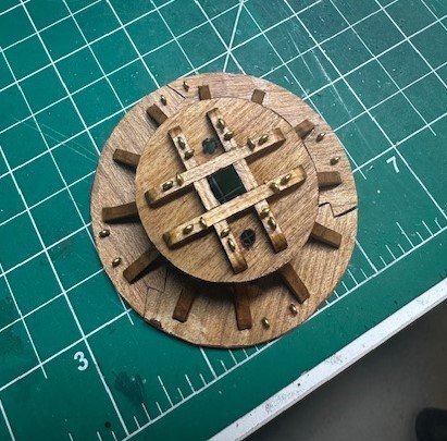

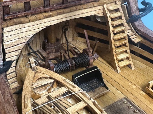

The windlass was a fun piece to assemble.  The Instruction Guide showed MULTIPLE pieces required for assembly.
Like the other deck pieces, these will all be permanently placed in their positions once I am confident they won't get bumped while doing other work on the decks.

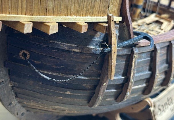

Another example of items in this Pavel Nikitin kit that suddenly appear in diagrams or pictures without discussion are the anchor ropes that go from the anchors through hawse pipes at the bow and are then secured around the windlass barrels.  It would have been much easier and cleaner to create these hawse pipe holes earlier, especially on the inside, under the forecastle deck.
250228u-AnchorHoles1.jpg.395eb6ffb0048f345165cab6de27f75d.jpg      250228v-AnchorHoles2.jpg.fa206e5c788c9acea78014a641c1b0bb.jpg
So, we will now work on the anchor rope and then get some of these deck pieces secured onto the deck.  Also, it's about time to begin working on the three masts for the ship.  Continuing to trudge forward...

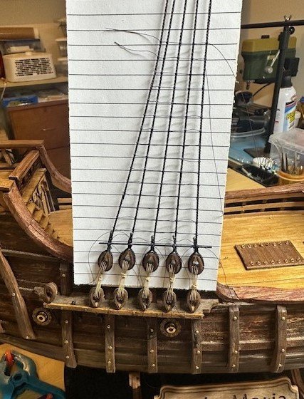

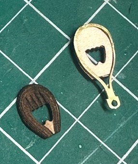

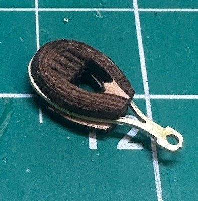

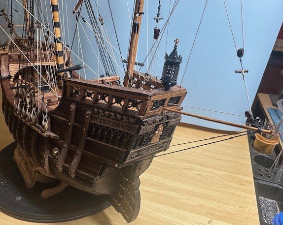

Well, it’s been several months since my last update, as I have been concentrating more on working on (and completing) this Santa Maria build than on posting status reports.  With that said, here’s what I have accomplished…

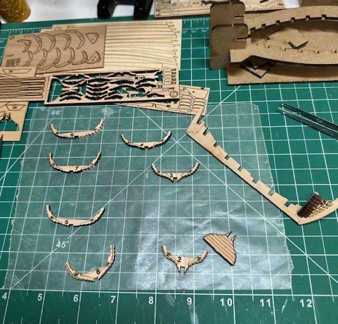

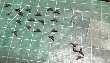

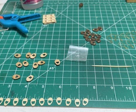

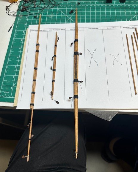

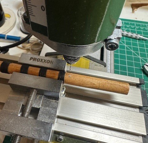

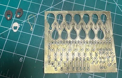

We left off back in March beginning to prep as much of the mast and yard spars as we can, placing ropes, blocks and eyebolts wherever we can prior to setting the masts in place.  So, I began that work, as well as began preparing for the shrouds placement, which included the building and placement of the kit-provided heart blocks to be attached to the chain plates.  The following are pictures of that build process.
250601a-Shroud_HeartBlocks.jpg.12ff37d000c76f13df558c69a218bb80.jpg  250601b-Shroud_HeartBlocks.jpg.3996f6a54cd0035a05f5f0b324b4d37a.jpg
250601c-Shroud_HeartBlocks.jpg.619e59613a2bdc73e433cf83ec5af0ee.jpg     250601d-Shroud_HeartBlocks.jpg.6caaef1856e6c01f96fd64ae2728288a.jpg
250601e-Shroud_HeartBlocks.jpg.bc5557016c21757892596c7458f3b280.jpg     250601f-Shroud_HeartBlocks.jpg.2a81c821e16e163f4463cc8f7c6f5b12.jpg

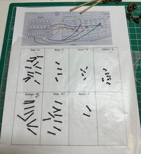

250601g-Shroud_Worksheet.jpg.0c55f46fedd105e28352d5dba48b4049.jpg   250601h-Shroud_Channel.jpg.6f41c763983d01615e62b6c26b726ebd.jpg

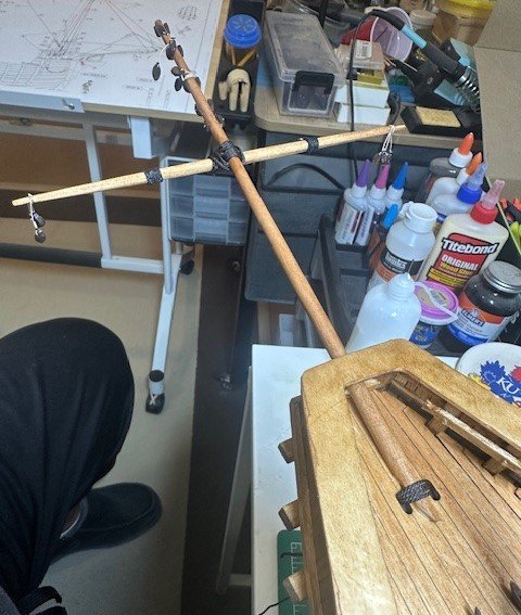

As I stated earlier, trying to get as much placed on the masts and yards as possible before each of the masts are secured on the ship.  In order to have the cleats hold well on the masts (or wherever they are placed on the ship), the “well-known secret” (it isn’t much of a secret then, is it?) is to place a small piece of brass rod on the back of the cleat and a place to insert the rod in the mast (or wherever it’s going).  So, we did that, as shown.  One note, the brass rod pieces I inserted, as you can see, were longer than I really needed, so the rods on each cleat were ultimately cut down, accordingly, as they were placed.

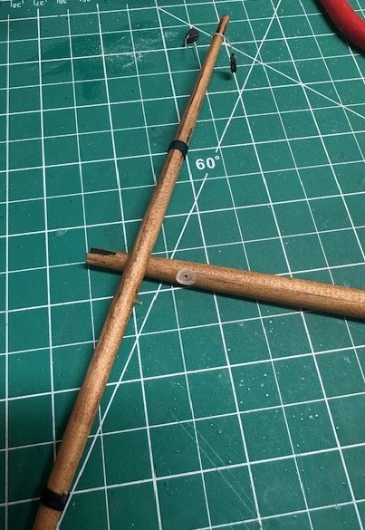

250601j-CleatPrep.jpg.9daf7672c3dd0fa68fd4b6a4d21f6fb9.jpg   250601k-ForeMastPrep.jpg.bc14bdf1ef349ebabc318079bba1af61.jpg

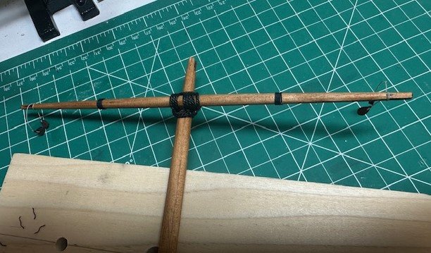

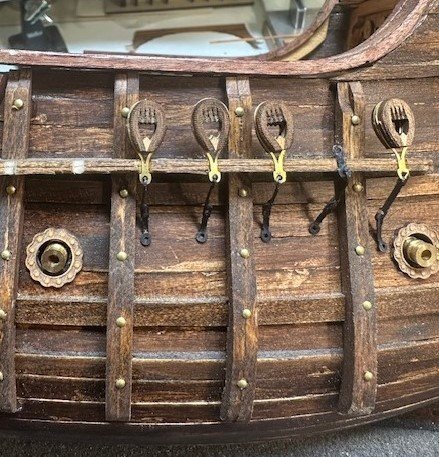

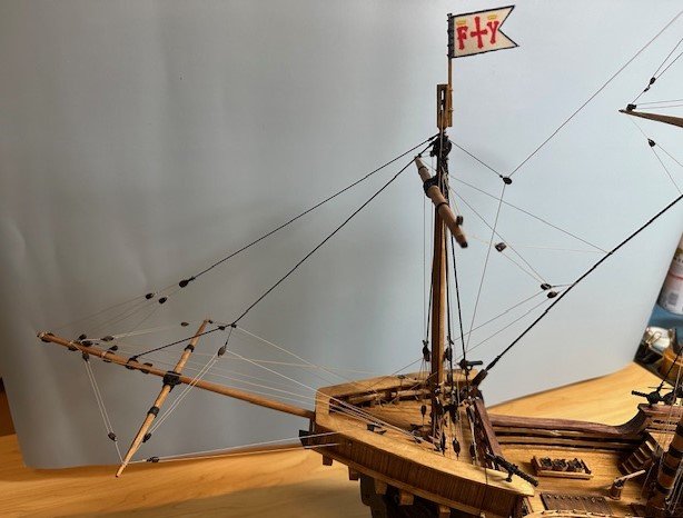

For the mast and rigging work on this ship, I decided to work from the foremast and bowsprit back. And, in order to attach the yard arms to the masts, I again used small brass rod pieces to help secure and hold the spars together.  I also simulated a rope lashing on each of the spar connections, although realistically, these would not be lashed in order for the yards to be raised and lowered but would be connected by some type of pendant or parrel.
250601l-ForeMast_YardPrep.jpg.b78b1ee9b5e8416a1d4ef834d1f2d817.jpg   250601m-ForeMast_YardPrep.jpg.55c6001377302bbd164726d8d8ad4465.jpg

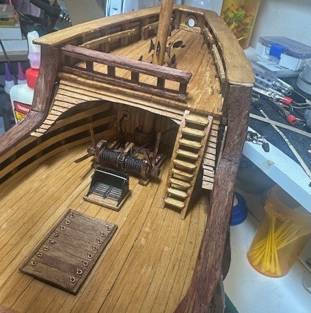

Once the foremast was fitted and placed, I was also able to permanently place the windlass, the stove and the ladder going from the main deck to the forecastle deck.
250601n-ForeMastPlaced.jpg.3b027e4e265a2b6d03912fd4590c3bf0.jpg   250601o-ForeMastPlaced.jpg.ecf979559d166828bd02379dde7a1ebe.jpg

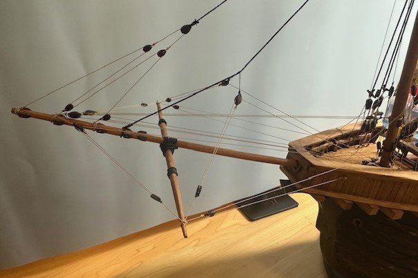

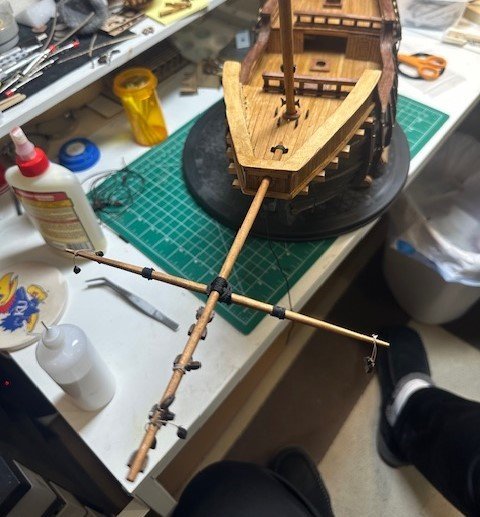

Next task was to set the bowsprit and its yard in place.
250601p-Bowsprit.jpg.fe0ffbce4cdfbdefa7585ff5bd88241e.jpg   250601q-Bowsprit.jpg.c9ed10466db40a46b396dcf725e4143b.jpg

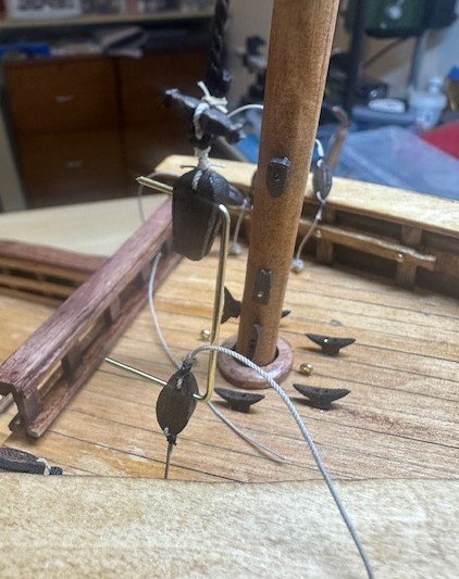

One thing I found helpful to me in working on this Pavel Nikitin kit, because there were so many pre-made or pre-assigned pieces that, once they were removed from their sheets were either hard to identify of hard to keep track of, was to make up some type of on-the-fly placement mat as a placeholder until the item was placed on the ship.  I even did that for the yard spars.

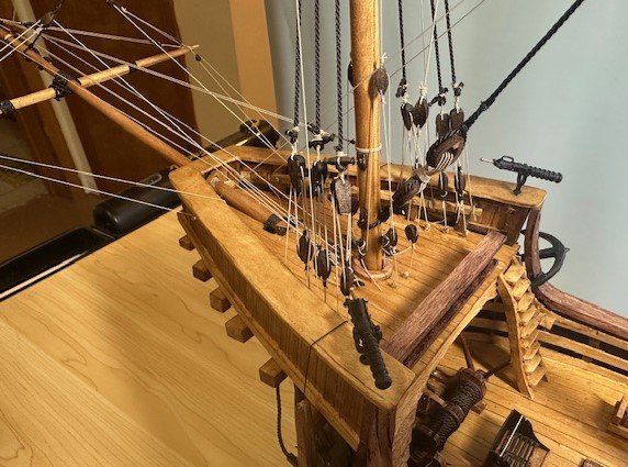

In looking at the rigging plans and also reviewing another builder’s YouTube build log, I tried to determine how many eyebolts were going to be necessary on the bottom of the crow’s nest to complete the rigging.  Ultimately, I ended up having more than I needed, but much better to do it now then to find out later You need to add another eyebolt after the crow’s nest is in place.
The following pictures show the work done in securing the foremast shrouds.
250601t-ForeMastShrouds.jpg.95797a1dd2915f17c33fb8ba6e780011.jpg   250601u-ForeMastShrouds.jpg.4b603447c7ee86fea50478ddc7741b53.jpg

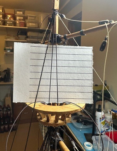

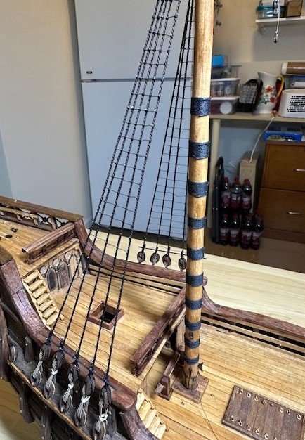

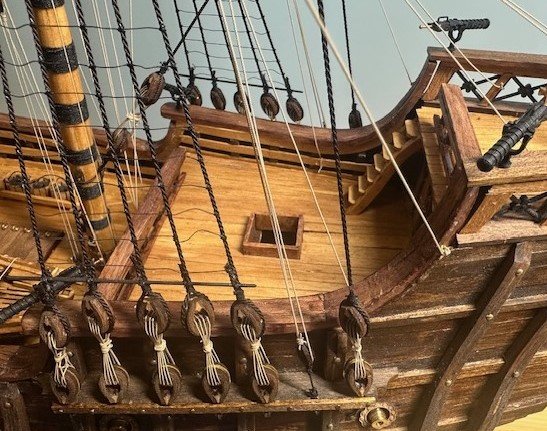

The following pictures show the main mast shrouds and… oh joy… tying the RATLINES!!  As almost everyone does, I placed a lined sheet behind the shrouds to assist with the ratline spacing.  I don’t recall now what spacing length I set up but it was equivalent to a ladder step spacing.  I will also take the time here to relay an interesting email conversation that I had with Olha Batchvarov.  As I noted earlier, I had previously prepared and installed a set of kit-supplied lower heart blocks on the channels.  In preparing to tie the shrouds to the chain plates, I was unsure how to initiate the rope ties between the upper and lower heart blocks.  I tried to research the issue here on MSW and other internet sites but was not finding anything.  I have been following some of Olha Batchvarov’s YouTube videos and had some previous personal communications with her, so decided to reach out and ask her advice.  She responded fairly quickly, stating that to her knowledge, heart blocks were never used for shrouds.  In the Carrack’s era, triangular deadeyes were used instead.  My options were, if I wanted to keep historical accuracy, remove and replace or… follow the author’s design and do whatever I want.  Replacing the lower heart blocks in the channels and connected to the chain plates would have been a mess.  And having heart blocks lower and triangular deadeyes upper would have looked a bit odd.  So, I figured out a way to tie the blocks securely and moved on.  I do appreciate Olha’s response, though!
250601v-MainMastRatlines.jpg.3cf2148ea588b0dc2420da93145e5b05.jpg   250601w-MainMastRatlines.jpg.f691a135e8a01558ae9920cc3e35d67f.jpg

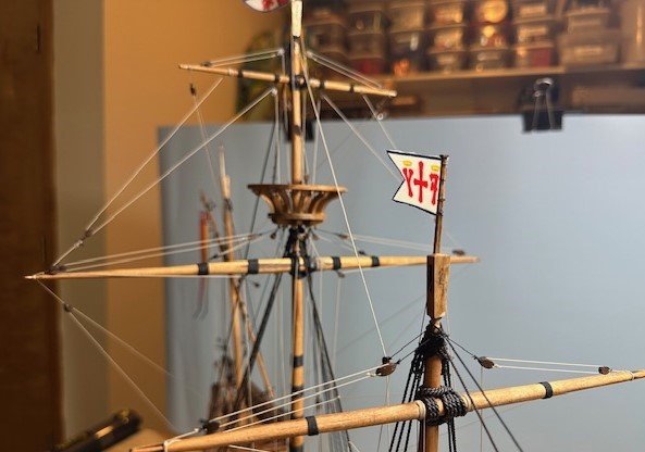

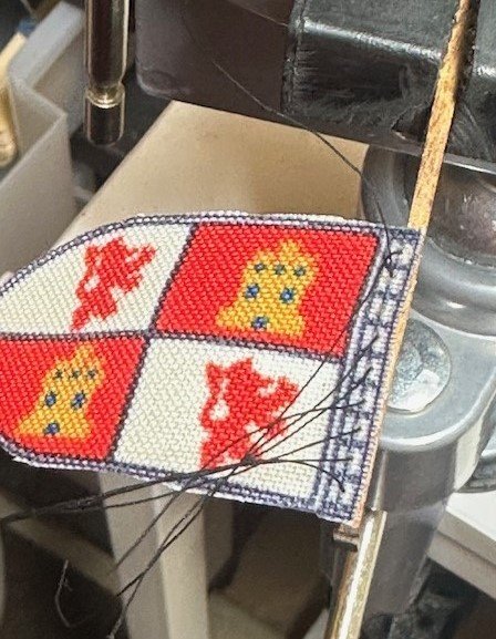

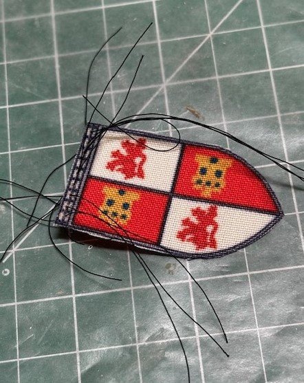

I also started doing some prep work on attaching the kit-provided flags to the flag masts which are then attached to the mast toppers.  I threaded a row of 0.025” rope thru the flag edges so that they could be tied around the flag masts, as well as secured by a little CA glue.  That all worked pretty well.
250601x-FlagPrep.jpg.d789f6e421f608650fdc0a979f762659.jpg   250601y-FlagPrep.jpg.f0ec60832428eb0aaa42da1caaa57469.jpg

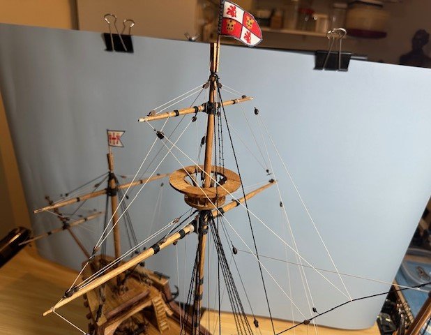

I also ran a smaller set of shrouds (and ratlines!) from the upper mast top down to the crow’s nest, using another spacing guide slid behind the shrouds to help with the ratline spacing.

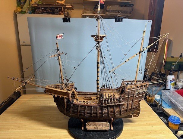

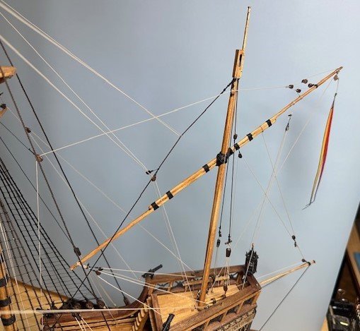

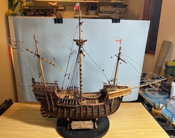

So…..!!! It’s time to actually do some rigging! This task was probably my favorite part of my Bluenose build and I was definitely looking forward to the rigging on the Santa Maria! Bad news is, though, that for my build log purposes, I took hardly zero notes and no pictures during any of the rigging… until the end.
There are no instructions in Pavel Nikitin’s manual pertaining to the rigging or the sails.  All that is provided are two large sheets of plans.  One of the sheets is primarily depicting what the standing rigging consists of, the other sheet shows the running rigging and placement of sails.  Although a more experienced sailor or modeler may have been able to determine what 100% of the rigging plans were to end up looking like, I landed at about an 85-90% level from what I could determine on how lines were run, how they were terminated at cleats or around side supports, etc.  Thanks to Vance McCarthy (VanMac on his YouTube build log) for answering a few rigging questions that I could not decipher from the plans.  As I said earlier, although no step-by-step accounts for the rigging, you will be able to see much of the rigging work in my final pictures below.
And, as I did on my Bluenose, as well, the Santa Maria will not have sails.  I understand it’s rather difficult for Columbus to have “sailed the ocean blue in fourteen-hundred and ninety-two” without sails, but mine won’t have them for a few reasons, but biggest reason is I just like the look of these majestic ships with all of the rigging exposed and the ability to see more of the ship details without the sails.  And mine would look crappy anyways.  So, there’s that, too.

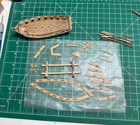

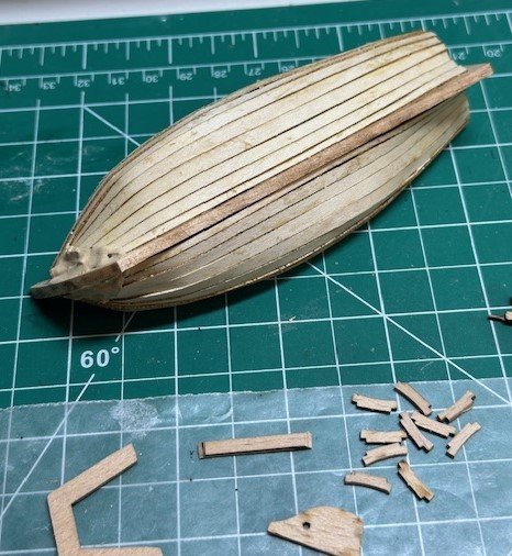

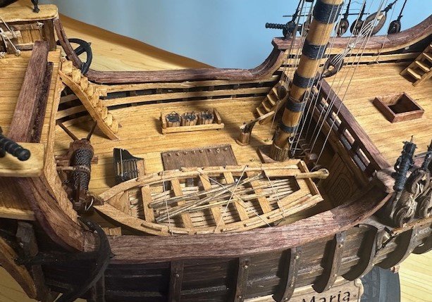

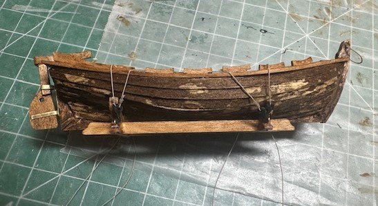

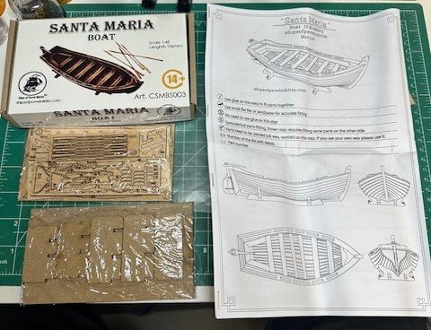

The Pavel Nikitin kit included a separate kit for the boat that sits on the deck that they would have used to go ashore, etc.  I decided to give it a go, as well, since there was the empty space on the main deck.  Like the main Santa Maria kit, this boat was designed to be fit together practically like puzzle pieces.  Well, except that it didn’t.
250602a-BoatInstructions.jpg.3adfb6584c619b5d71bab20fccff188f.jpg   250602b-BoatFrames.jpg.8524637899bdf162c37e288e58d7ed4b.jpg
The planks that were provided did not fit the length of the sides, inside frames did not fit as well as they were probably intended, and the seats did not fit perfectly.  In fact, because of that, I didn’t put two of the seats in the boat.  We made the best of it that we could and, all in all, the boat looked ok after it was completed and placed on the deck.  I tried to stain the small boat hull the same darker color the Santa Maria had, but it came out a bit blotchy.
250602c-BoatInternals.jpg.e7012f359db6f3f87554c7ccda12b1c7.jpg  250602d-BoatHull.jpg.77087f5e1b144e19ce7a2e36947ac43e.jpg
I would like to at some point put some coiled rope hanks up on the belay pins and other rope terminations.  But, at this time, I believe I am calling this Pavel Nikitin Santa Maria complete.  Here are some final pictures.  I tried using a background sheet to hide some of “other things” in my shipyard like shelving and a refrigerator, but… I didn’t do so well, sorry!
I am going to take some time off before I pull the next ship kit from my shelf in order to give the shipyard a bit of good cleaning, restocking and reorganizing.  We also have grandkids making their usual summer stay with us for a few weeks coming up.  But around the first of July, I should be back with a new build log.
Thank you to all of those fellow model ship builders who have at one time or another followed, commented and/or liked any of the content of this Santa Maria build log.  You are truly appreciated.  This Model Ship World forum is really something special and there is no doubt that I would not have now completed my FIFTH model ship without the support and wisdom provided through this website and its participants.  I wish continued success to the NRG and its support of this website.
