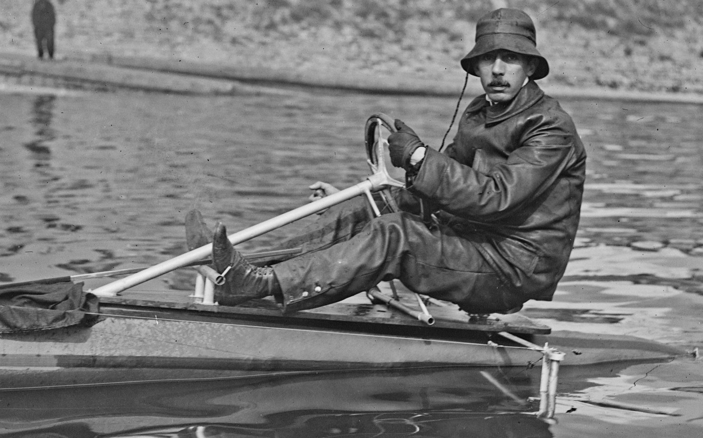

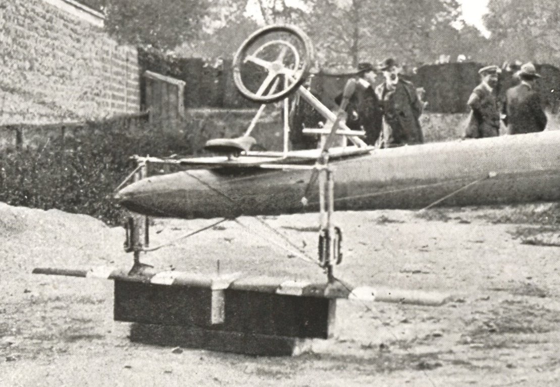

A couple days of work on the steering wheel has gotten me to here:
First I cut and milled a piece of brass to serve as the spokes of the wheel together with a rim. Two pieces of C Boxwood with a circle cut out were used to sandwich the brass piece - all attached with epoxy. Then the exterior was sanded to about the correct diameter. Sanding the wheel to a round cross-section then followed. A few more details to add, but this is what I'm trying to mimic:
I feel that I am getting close - probably as close as my skills will allow!
Nice steering wheel but I love the bicycle seat.

I've completed the cockpit. The steering column structure, footrest, and seatpost are painted grey-blue to match the other metal tubing; whereas the middle of the steering wheel has been painted aluminum. The supporting board has been oiled.
I've decided to keep this as simple as possible for now so that the cockpit will be mounted in the forward position. Based on a couple of poor photographs, I believe that this was the cockpit location when the boat was first completed (with engine, propeller, etc.). I also believe that at this point the engine's throttle was mounted to the right of the steering wheel on an extension of the tube that crosses the base right-to-left. It appears that soon after the cockpit was moved back and a different throttling system was introduced - one that was more complicated and mounted directly on the steering wheel.
For both locations of the cockpit, I am still not able to piece together how the steering column / rod would have been connected to the rudder. In particular, it appears that the steering column is mounted centrally - directly over the upper pontoon stringer. For structural strength reasons, it seems doubtful to me that the stringer would have been pierced to allow the steering apparatus to pass through it. Also, I have not been able to decipher if / where steering cables attach to the rudder. For a while a wondered if the rear hydrofoil turned with the rudder as a unit, but it seems that the geometry of the bracing rigging would prevent that.
Without evidence, I don't want to guess engineer a mechanism so for now I plan on adding the bracing but not having a way to move the rudder. Hopefully, down the road I will fine (be made aware of) additional information that solves this mystery and then I can determine if I can add it to the model. Going with the premise that no detail is better than making stuff up!
So here is what the model looks like with engine / fuel tank / cockpit all in place.
Mostly engine / propulsion work left now - I think all the woodwork is done.
Greg, do you have any evidence of a rudder? I can see what may be a rudder in the middle of the rear foil in the early version and perhaps aft of the hull in the later.
If I'm right about the early version the entire foil must rotate to turn.
I don't think the wheel was used for steering at least in the early version, I think the lever on the right was. It's too big for a throttle lever and a lever was how he steered his aircraft.
I think the speed was controlled by 'blipping' the engine with a kill switch on top of the lever, this would be consistent with aircraft through WW1.

 Question, did the steering wheel actual steer or was it merely something to hang onto? :unsure:
