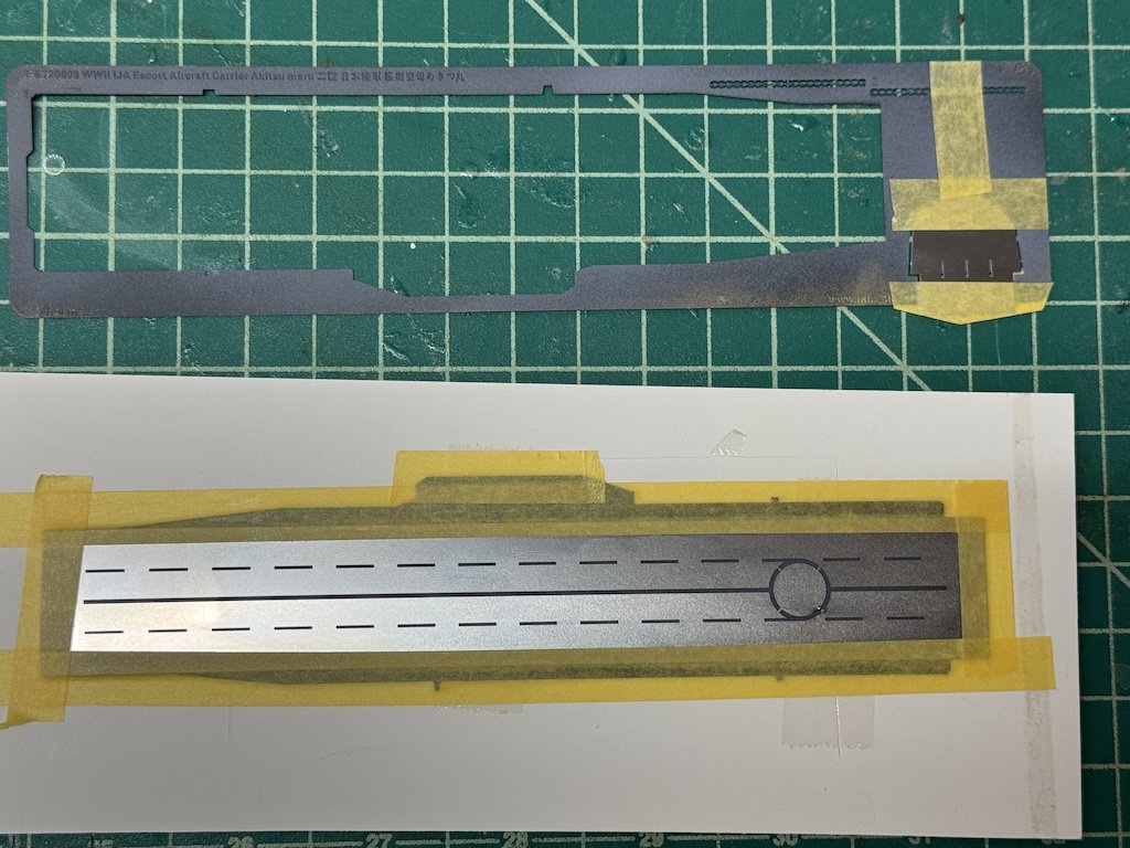

To start, the flight deck is going to need a lot of work to add the girders.  The easiest way to approach this was to first paint the top side of the flight deck, then flip it order and add the girders and supports.  I first primed both sides of the deck with Mr. Surfacer 1500 black, then sprayed Tamiya Maizuru arsenal on the top side of the deck for the gray color.  The Five Star kit doesn't give you decals to paint the lines on the flight deck and elevator, but gives you metal stencils:

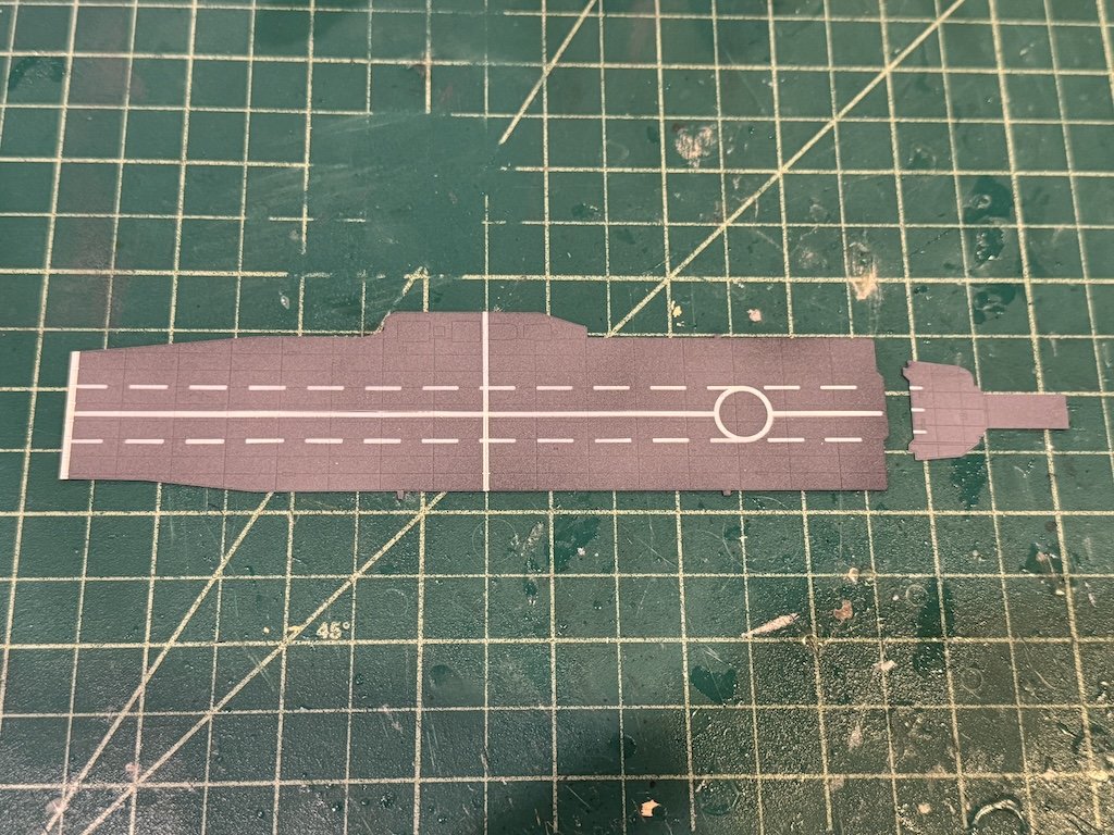

I placed the deck and stencil on a sturdy piece of cardboard, then painted the lines using Mr. Color insignia white.  As I was painting along the stencil with the airbrush in one hand, with the other I was pressing the stencil down using a wooden popsicle stick to make sure the stencil didn't lift and give me underspray.  Then, after it dried overnight, I taped off and painted the perpendicular lines at the bow and amidships.  I was pretty surprised at how well this all worked - all that anxiety for nothing!
Next I will clear coat the topside to protect the paint job, tape it off, and then work on the underside and glue on the supports, girders, etc.  As all that is in progress, I can finish up the underneath area/hangar deck.  I also have to finish up the Ki-76 planes, which are mostly done but just need a few more details to be added.

Nice work on the flight deck lines. They look great.
alan
Thanks Alan - turns out I was nervous about doing it for nothing.  I assumed that the paint would come under the metal stencil since there isn't a perfect seal but it worked very effectively.
