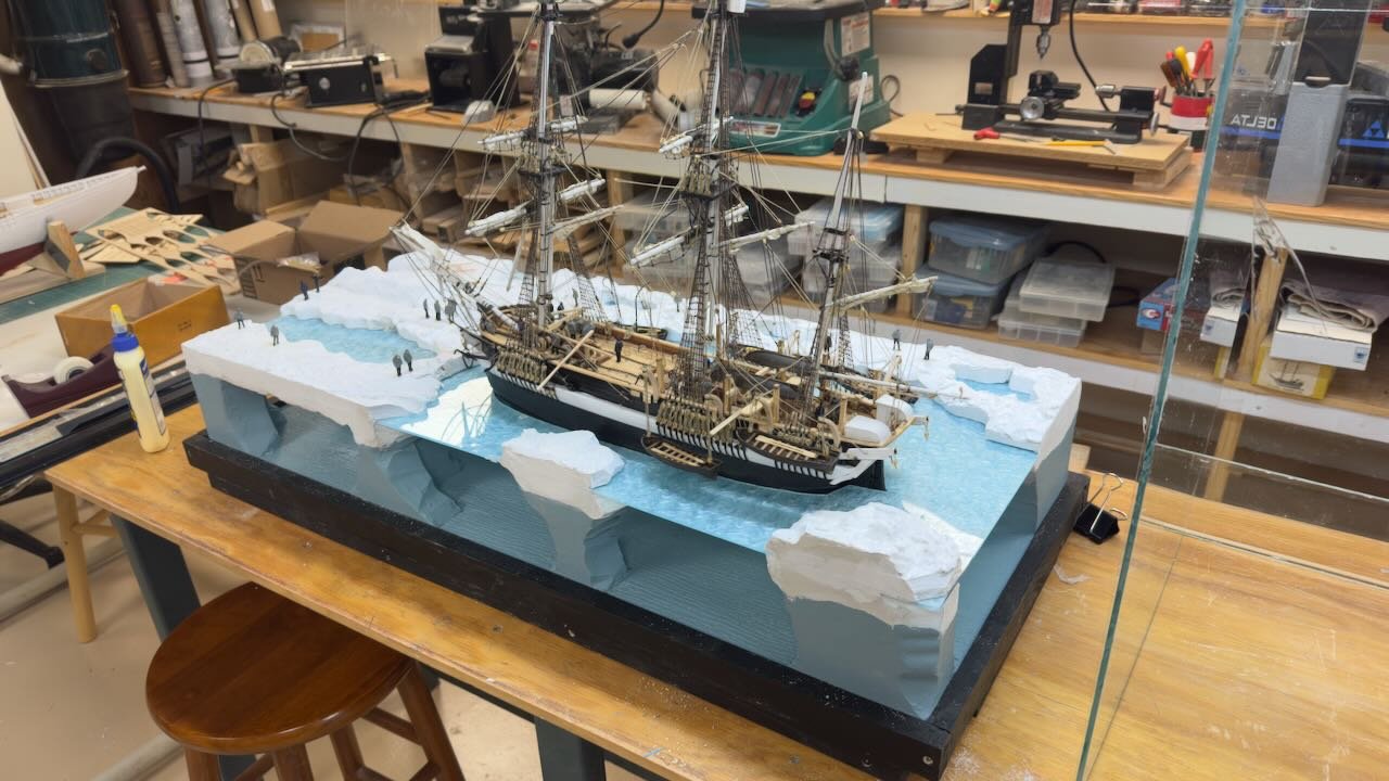

13.2 starting the diorama
Since the preview earlier this month I have been experimenting and buying a few things that I may or may not need.  I am about to disappear for a mid-winter break,  so I need to pull together the progress with an update.   The next series of photos show my trial and error and adjusting as I work into this area of trying to make ice look real.. I have taken a photo after each step.  Here we go
  • 05 -06 TER13-FFF_2383.jpg.0ed46f63d9269108d062b09d45e3713f.jpgTER13-FFF_2384.jpg.d06f57cb4acc81e19321bab1a5c890e5.jpgset the base elements and glued them to the base. Then I painted them all blue and set up the front elements in massing only. In the second view I use the wire cutter to shape them.  This is first pass.  There are competing elements. On the one hand we must support the water [ acrylic sheet] and the other we want lots of visibility below the water.
  • 07 TER13-FFF_2385.jpg.a0bec11b9647d6ff25fc1a89d7518d9f.jpghere I added intermediate supports and painted the back which is hopefully intended to be infinite water.  I am not happy as the supports on the back are too visible, and one sees shadows.
  • 08-09  TER13-FFF_2386.jpg.6a29704fadacb38ffc1d8000b54f1ff3.jpgTER13-FFF_2387.jpg.b7aef461f2d145701696afd464dc3d9b.jpgI set the water on to help plan the other ice. I cut out sheets and primed with Gesso …….  Note I am using the model cut out to extend a lead forward. I then set the cut-out ice on top. currently, I need to plan the underwater ice as well. the protective film is still on it.
Painting
  • 10-11-12.  TER13-FFF_2389.jpg.535bf96097f91a0be58c8810e1800d10.jpgTER13-FFF_2390.jpg.26c16268257499a326c234d1b3d50efb.jpgTER13-FFF_2391.jpg.2a1a1cd735a0ae8da362c19cce93569c.jpgthe sharp corners of the blocks on the back wall of water were not convincing, so I took card stock paper and using mod podge glued it in place then painted it blue to hopefully look more like infinite water. The thin long loose piece on top is painted out to be under water ice. In the third image it and another piece to the left side are pinned in place. Once I am happy with underwater painting I will glue and pin them in place.
  • 13-14. TER13-FFF_2392.jpg.8ff510207dadec63a2814185fbded699.jpg TER13-FFF_2393.jpg.c506259e9d34ee08e899bc901fc4f00c.jpg Here I laid out the acrylic. I am using scrap from the mock up piece so there is an even layer across the whole build. The last view I have the ice in its current preliminary set up.   The is much more to do with that stuff but here is a chance for a breather.
  • 15. Ter-13-IMG_1625.thumb.jpeg.e7f82bf53ab2e242fae352ed41df993a.jpeghere are the three products I am using so far
•    Styrogoo to glue the Styrofoam to itself and the base and the acrylic
•    Gesso to prime everything except the paper and pvc baseboard
•    Mod podge is the glue going forward as I add stuff to improve the ice. Fill slots in the water blocking etc..
All for now I will add the vessel and look around tomorrow.
  • 13,3 to finish up with the " starting of the diorama"
here are some images taken before we run south for a week on a beach.   Hopefully all our remaining snow will be gone when we return.
  • 15-17  TER13-15IMG_1622.jpeg.019a4c4eb95b9ca262d06824d2038e6b.jpegTER13-16IMG_1623.thumb.jpeg.d6131abaee50a4006507b0209dffd70e.jpegTER13-17IMG_1641.thumb.jpeg.0d8f9ee12c16365ed05208a9fe1f9146.jpeg
  • three views from above. Still pecking away at the rigging and deck work
  • 18-21 TER13-18IMG_1628.thumb.jpeg.6934de94f96a4db4cdc0c84822541349.jpegTER13-19IMG_1631.thumb.jpeg.f3ee11504fb6739189d120645e5d54c4.jpegTER13-20IMG_1632.thumb.jpeg.753299188ca8b4e5238c4a5d49674e1c.jpegTER13-21IMG_1635.thumb.jpeg.2c973f2933b2c9964f887d15d121658f.jpeg
  • four views showing below and above the ice.  There is a lot of work to do to make this work

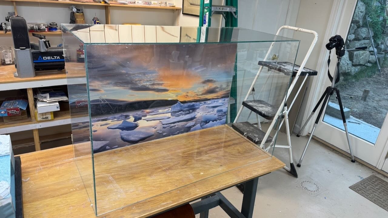

  • 22 ter-1322backdropsunrise01crop.thumb.jpeg.0905367c9b7c7c947891ca6391d18a9a.jpeg
  • here is the preferred back drop. A sunrise photo I took at Beechey island with and internet cropped image of arctic ice. I hope I can make this one work as the day time image is not as nice. When I get back I will order this poster and mount it behind.  My fear is the coloring, as nice as it is, will not blend nicely into the acrylic and ice.....we'll have to wait and see..

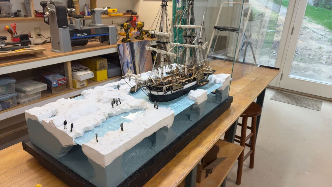

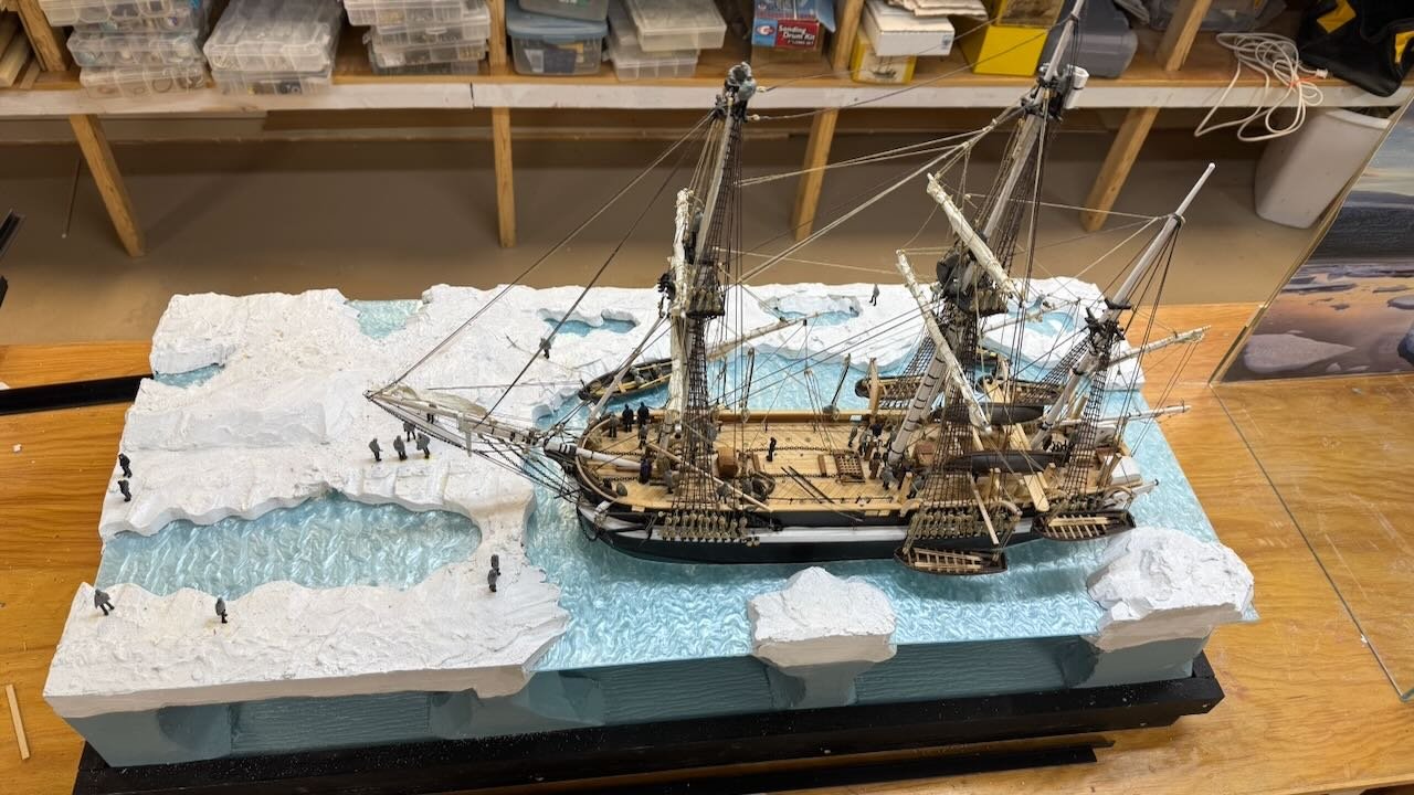

15 continued rigging and work on diorama
This is a brief update of combined effort on both the rigging and the diorama.
  • TER-15FFF_2401.jpg.f1c8113b62206e8d6e24392645c005ba.jpg this view shows the final underwater ice being added.
  • 2.TER-15FFF_2402.jpg.a1a540992891db9d632a62ddb00599e3.jpg  shows me playing with how best to use the small boats.  Should they be in the water, perhaps on the ice as they began to transfer supplies to the ice in case the ship sank. I also started rigging the davits.
  • 3-4   TER-15FFF_2406.jpg.be375e8b81083f313246887b4eb4933b.jpgTER-15FFF_2412.jpg.1b0432bb6c2c4f477f43a3ec69e57f6e.jpgshows they addition of spackle [ joint compound] to smooth the outside of the Styrofoam that will be repainted as water below and ice above. The top surface is very rough at this stage.
  • 5 TER-15FFF_2414.jpg.d1c880d4f7703289a6be639c8b4aca6c.jpghere we can see the ice barrel has been added, the platform for navigating or the “ice plank” and rack for aft boats.  I will likely show the two kit whale boats resting on this rack.
  • TER-15IMG_1710.jpeg.e2f55f6dc9b0bf415cf92078545c7169.jpeg shows the beginning of work on the crew.  I am using white glue and paper towel scraps to build up outer coats.   I need both sitting and standing figured as some in the boats would be sitting.  There were over 60 crew members and most of them would have been active on this day of mast lowering and preparing for the winter camp.   We’ll see where that leads. I clearly have enough to do the whole crew.  I will not try to show those Navy hats for the officers that were shown in the recent TV series, I cannot believe they would have worn them when the temperature went down.  Perhaps common sense and warm hats is an error common to us yanks.
  • 7-9.  TER-15IMG_1711.jpeg.1a0d41f19356fcda1a2ca36dd17aba84.jpegTER-15IMG_1712.jpeg.57756c519658e522c6c474873d61ce0c.jpegTER-15IMG_1713.jpeg.ae4c2e68c356e99713869897e3a047b6.jpeg these views show he anchors in place along with just about every line.  The lower coarser sheets were tricky. The middle view shows my first attempt at the iron [ steel?] davits for the middle boats.  I am a bit concerned as this location would have included the largest pinnace.  I intend to have it off the vessel as the whole deck will be needed for the mast lowering exercise. However, what I have made does not look strong enough.  I assume the trysail gaff would have taken half the load at a time to move the boat from center to over the side, transferring to the davits.   More thought is needed here
  • 10  TER-15IMG_1714.jpeg.1fc4464a86b9e75bea80d8a296d5af15.jpeg shows the ice plank and celebrated that the davit blocks for all the boats are in place.  I have yet to make them off as I need to decide how each will be displayed…. Up or down
Next up is to complete the diorama and prepare it to receive the backdrop. The poster came the other day and is currently flattening before trying to install.
Cheers

18. almost done;  Setting crew, building a case and working off the punch list
It has been a while since any real progress was made as spring finally came and outside work took over.  I need to get the diorama ready to go for show and tell in July, so I’m back to work.
  • I took her to the local Guild meeting in May and posed a few questions. Happily, I receive some good answers:
    • •    the footropes on the yard arms would have been lines and removed, or as lines been inconsequential as to being stored in the racks on deck.  I should remove them all and then store the two top gallant yards, along with some spare blanks.
    • •    How to build a case.  Buy green Optix at Home Depot or Lowes.  The Optix green means the edges are green and it looks like glass.  The cost is about $50 for each 24”x36” piece.   Then follow U-tube to see how to weld them into a box.
    • •    Support for my opting out to attempt to paint of wash or fool around with coloring within the ice, since the back lighting is early morning.  I am no artist and the white with more added snow will be just fine…..I hope .  I can always change my mind.
    • •    I had about 10 crew on board, and the group all agreed that more crew would add to the story.
So after much yard work, and a detour to cut down two previous dioramas that are too big sit on shelves. we are back to work.
  • 2-3.  Ter-18-02IMG_1850.jpeg.6faba624eb3f3368c016fc3c7fb6b9ae.jpegTer-18-03IMG_1851.jpeg.d927600c582f204d8d82b678f01feaf7.jpeg
  • here a few days back I had many of the crew located.   The full crew including officers and scientists etc. was 64.  In these two images I have 50 placed.
  • 4-5 Ter-18-04IMG_1855.jpeg.c557668cc2ca5a44dba5cf9023e5d352.jpegTer-18-05.jpeg.66a865aaee7b5d8f5d781ecd54913705.jpeg
  • here was an adventure. How to incorporate the poster into the case. A key issues is that glue between acrylic and other materials is just not recommended.  My approach was after cutting the 16.5-inch top piece, I took the remainder from the 24” inch sheet and cut it in half.   I then welded it to the top and bottom of the back.  I then laid the poster on thin mdf on 3/16” strips of wood using normal wood glue.  I used aluminum channel and weights to keep all as flat as I could.  In the second photo of the completed back, one sees the two wood strips adjacent to the two back strips. They are  extended past the sides to hold the poster in place.   I hope it works…
  • 6-7. Ter-18-06IMG_1857.jpeg.daaa53db40952c23f480e88e4a6b98f6.jpegTer-18-07IMG_1858.jpeg.b7d57a3fce52c8280daf413cd2b68e6c.jpeg
  • here we see the welded up case…my first so there are a few oops…. In the first view we see the green edges. For simplistic affect I agree the green choice was a good one.  However, every oops is there to see.   In the second view I have taken aluminum strips and spray painted them flat black over auto primer.  Before I proceed to add the aluminum, I need to learn how one glues painted aluminum to acrylic.   I thought to try clear silicon sealer, but it failed.   I guess I need to experiment.
  • 8-9. Ter-18-08IMG_1856.jpeg.d6bd285829c4724b54277ec8f2f8a9f1.jpegTer-18-09IMG_1859.jpeg.4bf5a38c6116c3873b5860c4d4f0bbd5.jpeg
  • after more thought, I decided to take the remaining figures and put them all out.  There are 21 on the ice and 39 aboard.  That is all but 4 of the crew who may well have been up and about on the early morning in the later fall of 1845.  My real reason was to show in the story how huge the crew of the adventure was. That huge size is one of the key reasons the attempt to traverse the passage became such a tragedy.  These two views are both not what will be normal . the first is from the top and the second from behind.
