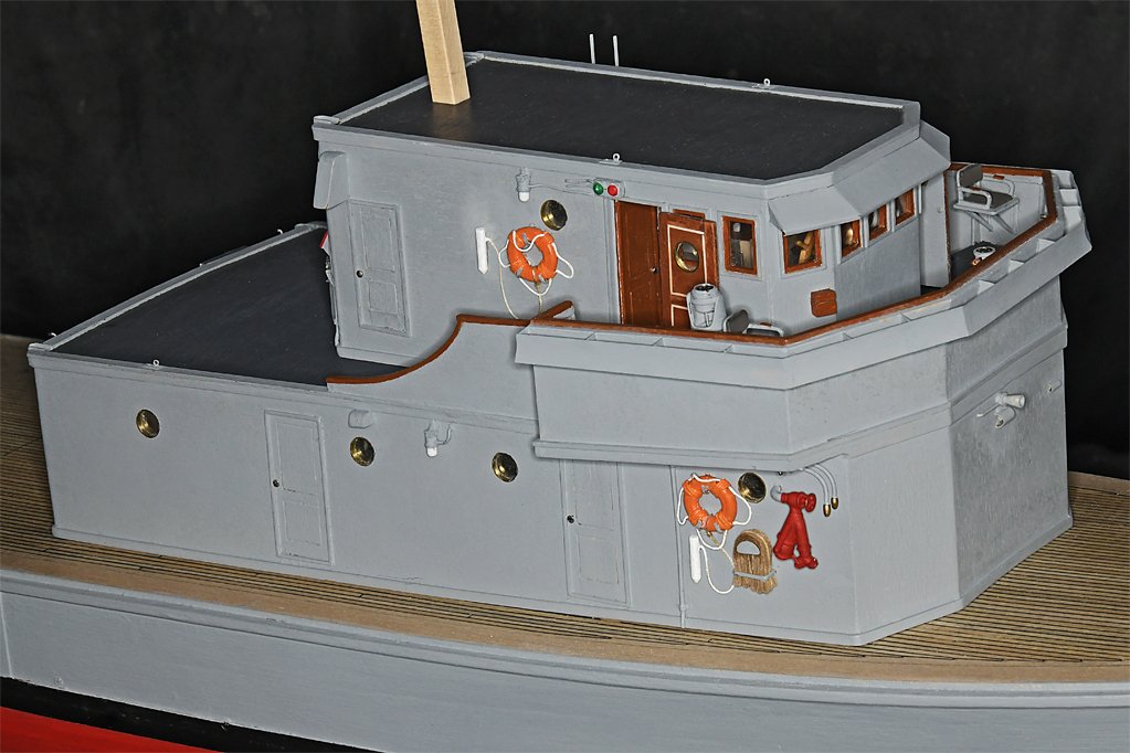

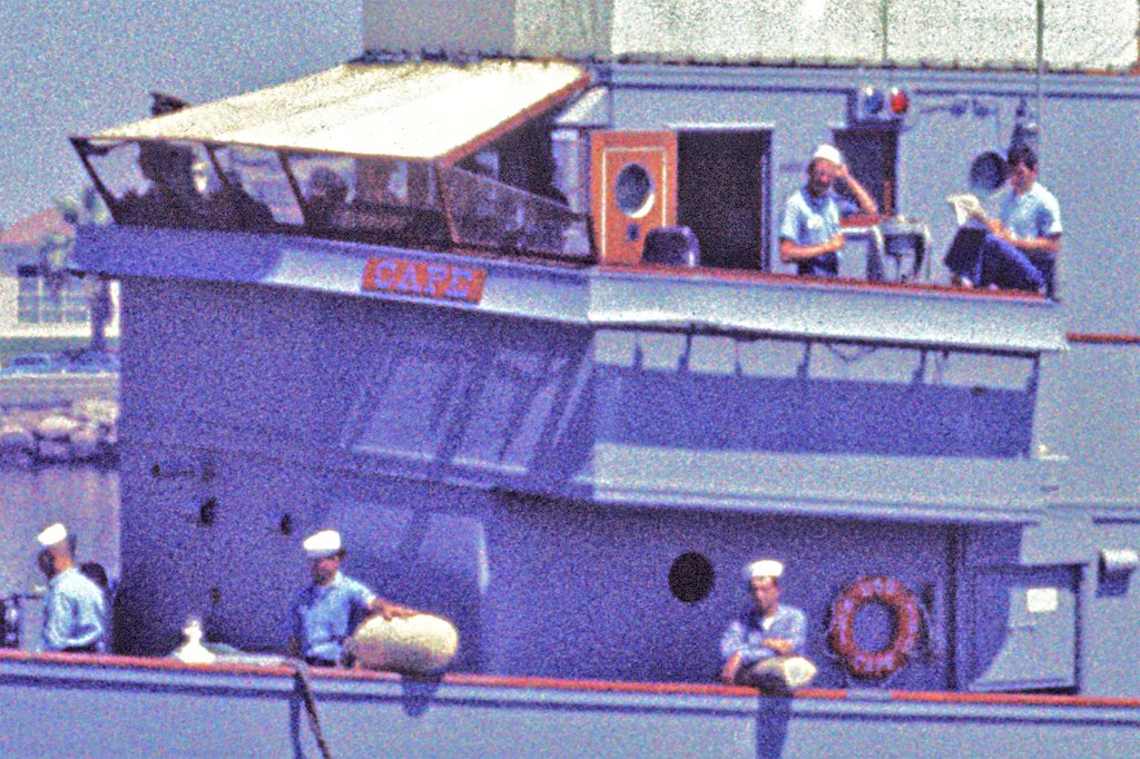

Roel,
Covelifering.jpg.9b8e3d3ae14984008bbd1edcfa1ab9d3.jpgYour question made me do a double check on the life rings, and that brought a surprise!
As you can see in this photo life rings were sometimes made up as I have modeled them. But if you look closely you will see this ring is labeled "USS COVE MSI ONE." This was the Cape's sister ship (possibly the actual smallest ship in the Navy).
I have been using photos of both ships for determining how to build the Cape model. And I remember that I found the life rings were made up this way on the USS Oklahoma City CLG-5 when I made the CAD model of that ship.
However, when I looked at the photo in post #420 above I realized that the life rings on the Cape were painted differently. The turns around the life ring were painted orange!
Capelifering2.jpg.88ec6c3c34a0e57f228a88b8b5b3bdb9.jpgCapelifering.jpg.097998a81173b0eae982ee4e3110b394.jpg
I'll have to correct that! Although the Cove and Cape were very much alike, there were many small differences like this between the two. This was especially true in the way the crews painted the details like this. But there were also some structural differences, such as the Cove having 12 inch (305 mm) searchlights on the O1 level open bridge and the Cape having them above on the O2 level. The ladder on the port side of the O1 superstructure was a bit farther aft on the Cape. And the O2 level life rails and lines were a bit different.

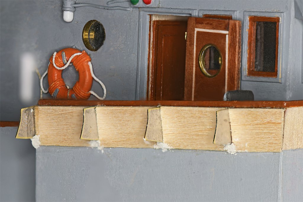

Venturis
venturisuportsonCaps.jpg.afcd435b3342273fe270ddaf7d9f1154.jpgventurisonCape.jpg.a8d1e0e564109930aa95da927f7ddb55.jpg

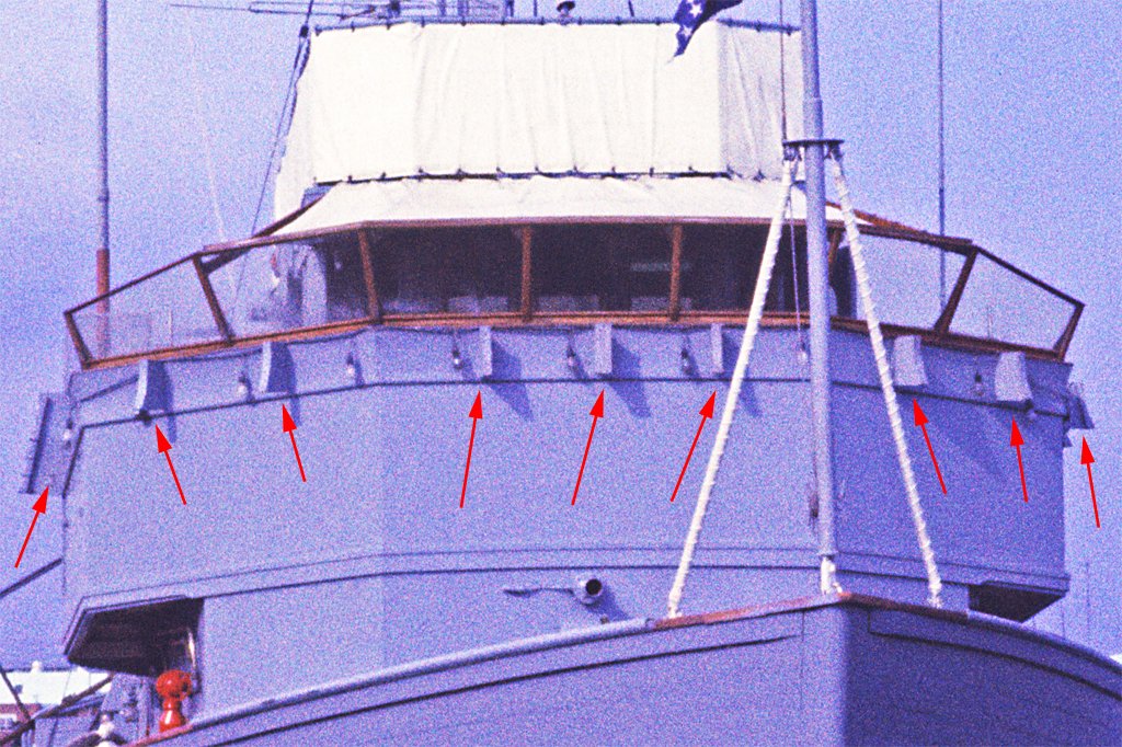

The Cape had venturis around the edges of the bulwarks on the open bridge. The supports are shown in the photo (left) while the venturis were being repaired. On the right you can see the venturi at the top outboard edge of the bridge bulwarks. The ship's name board is mounted on the venturi.

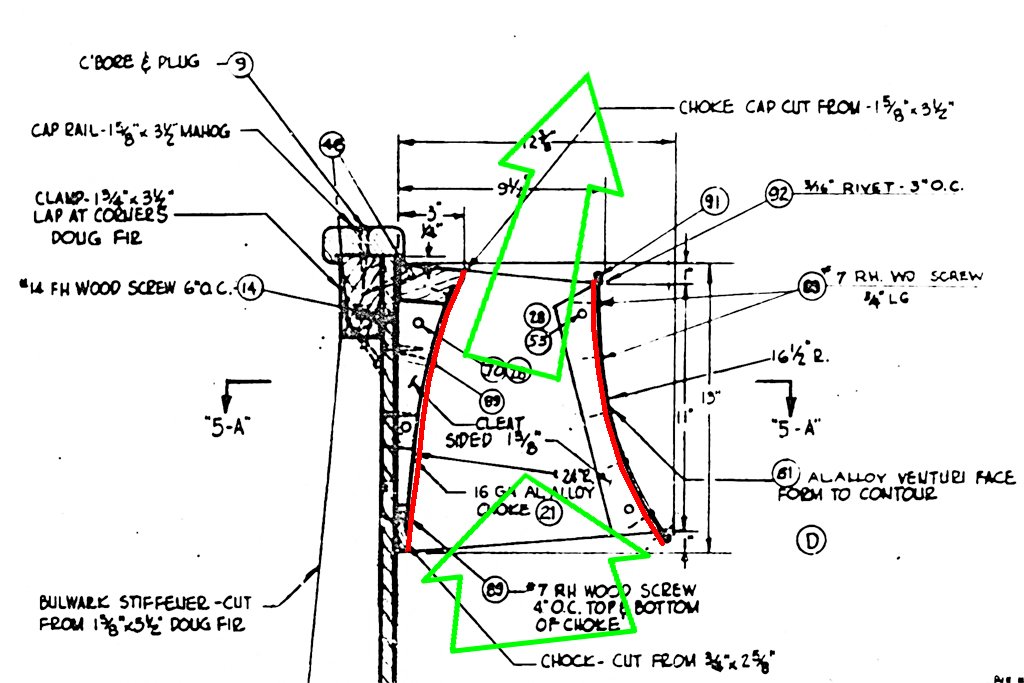

venturiblueprint.jpg.7eb5893dc8f114c835d35ad0cfa9b0a3.jpgWhat is a ship's venturi? It is a channel for air flow between two converging surfaces (marked in red). Air blowing against the sides of the ship's superstructure flows outward and upward along the deckhouse sides. It enters the bottom of the venturi at relatively slow speed (short and wide green arrow), and is compressed as the channel narrows.
If you remember Boyle's Law (you did take physics, didn't you?) the initial pressure and volume equal the final pressure and volume
P1V1 = P2V2
As the air flows through the venturi the volume decreases by about half, therefore the pressure doubles. This causes the air to flow faster to escape the top of the venturi. It comes out as a jet of air deflected upward around the sides of the bulwarks (long and narrow green arrow).
Now you may be asking yourself "Who cares?" Well, that up flowing air collides with the wind coming from ahead and deflects it upward and over the bulwark. This actually does work, and has a significant effect. I have stood watch on the Cape's open bridge in a downpour. Standing back a few feet from the bulwark I was pelted by raindrops. But standing close up to the bulwark the jet from the venturi deflected oncoming wind and rain up over my head! Behind this invisible windshield the air was fairly calm. These things made standing watch on the open bridge a bit more pleasant.

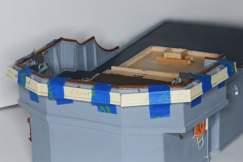

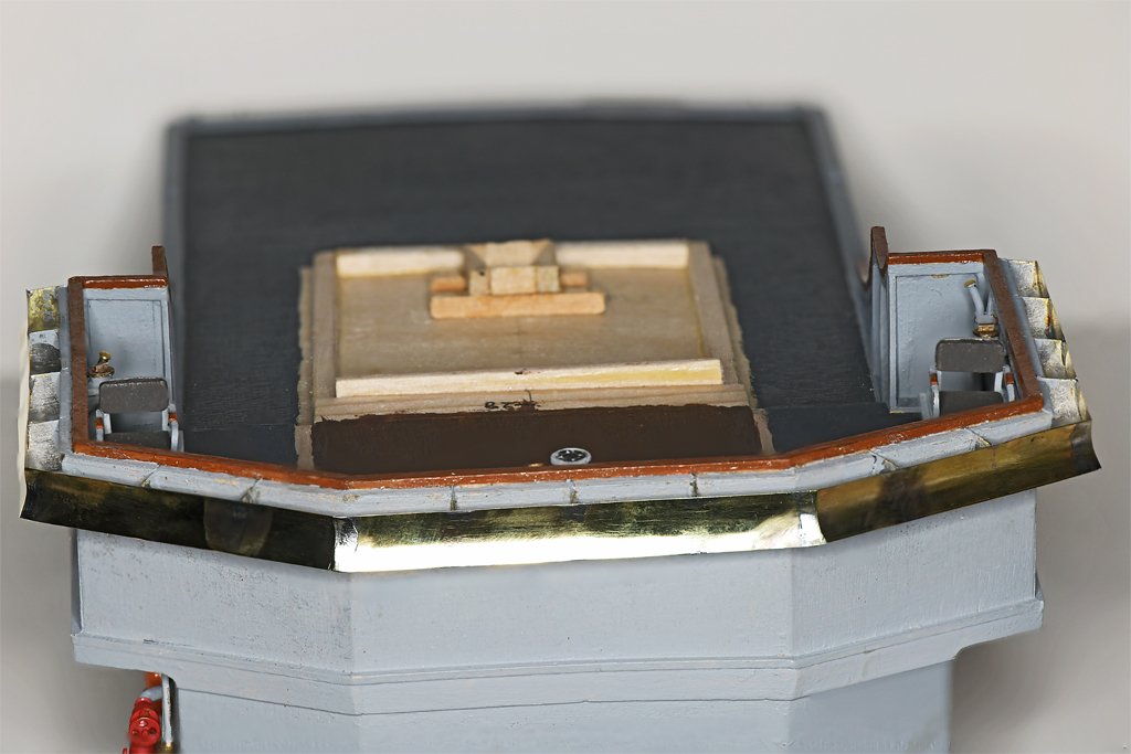

I have put off adding the venturis to the model for two reasons. First, they are on the outside of the wide bridge structure and subject to damage from handling while all the other work was being done. And second, I really had no idea how I was going to make them!
The blueprint above shows that there is a "choke" piece attached to the bridge bulwark that forms the inner surface of the venturi channel. It was made from an assortment of wooden and metal pieces, but I decided to simplify it for the model. I shaped a strip of wood with a triangular cross section for this inner part. I tried to cut a concave surface into the face of it. First I made a scraper with the cross section pattern and tried to use it to remove wood. That was a failure - the basswood strip didn't cooperate with the scraper.
Then I found a small bottle with a 1 inch diameter (25.4 mm) and wrapped it with sandpaper. This did work better than the scraper but the results weren't very consistent over the length of the strip. And after I was finished the curvature was so slight it really isn't noticeable! But the shape of the strip was good enough since it will be hidden inside the venturi anyway!

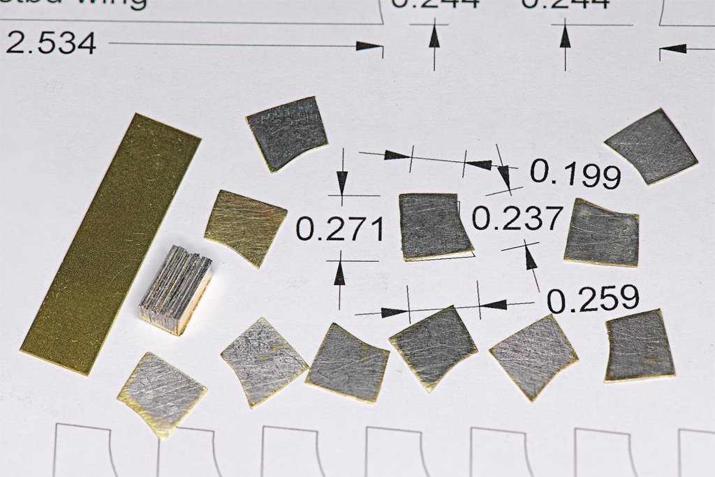

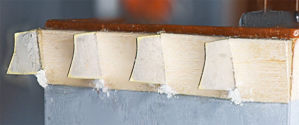

venturipatys1.jpg.20d12caa3df64c8c91638d23443c363f.jpgTo make the spacers that support the outer surface of the venturi (to be made of 0.005 inch/0.13 mm brass sheet) I cut some strips (left side of the photo) of 0.010 inch (0.25 mm) brass to a width slightly larger than the vertical dimension of the parts (0.271 inch/6.9 mm). These were sliced into short pieces 0.33 inch (8.4 mm) long, longer than the 0.259 inch (6.6 mm) length of the supports.
Fifteen of these pieces were clamped together and soldered to make a single solid piece to work with. A paper template was glued to the side of the work piece and the block was filed to the correct shape. Then the spacers were sawed off the end of the soldered block. The remainder of the block can be seen on the left side of the photo - the multiple layers are readily visible.
The block of spacers was reheated to melt the solder and free the individual parts.

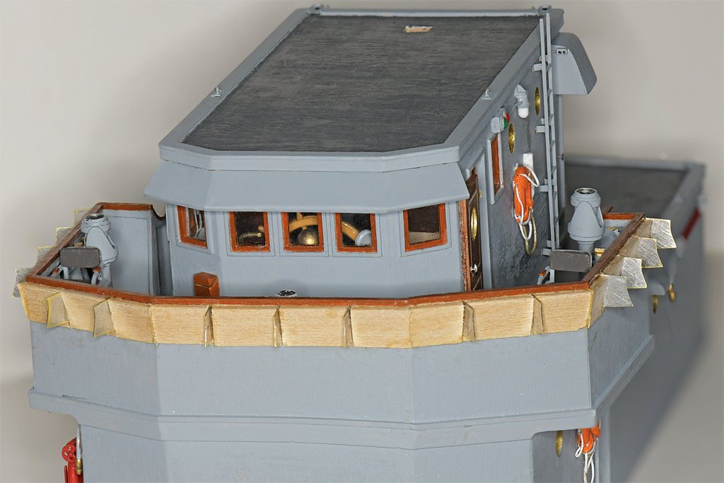

venturi2.jpg.c4cda584e767aae3e4ae32ee297b24ee.jpgThe wooden choke strip was cut into sections to fit between the individual spacers. These wooden pieces were glued to the bulwarks with Titebond Original cement. As each section was placed a brass spacer was glued to the end with Locktite Super Glue Gel. This allowed enough time to position the spacer correctly, and produced a very strong attachment.
I have been dreading this assembly because it just looked like it would be so easy to break off one part while placing another. But it has been very sturdy and I have had no problems so far.
venturi1.jpg.2be033500a676449b4a9da7c36ac93c1.jpgventuri3.jpg.b2d7298135a31553cdd3193bba177c2d.jpg
I still have a bit of sanding, filing and filling on the wooden choke pieces to prepare for sealing and painting.
And notice that I did repaint the life rings in proper Cape fashion!

I noticed this feature on the bridges of 'modern' (from my point of view) ships, but never thought about their purpose and function. Thanks for the explanation, makes perfect sense to use the Venturi-effect for deflecting the air-stream.
I don't know when venturis started appearing on US Navy ships. I do know that we didn't have them on the USS Oklahoma City CLG-5 while I was aboard. I stood bridge watches in heavy weather and realized their absence when standing on the open bridge wings. But they were added at my last in port period (March-April 1972). I noticed the new venturis as I was departing the ship the last time in early April 1972.
I posted the photo of the Cape's venturi supports in post #424. This was my first photo of the Cape taken the day I reported aboard in April 1969. But this wasn't the initial installation. The blueprint showing the venturi construction is marked "AS CONSTRUCTED PLAN" and dated 18 Sep 1959.

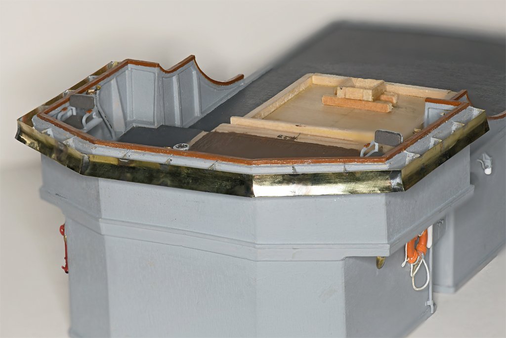

venturis4.jpg.416e0b4e0e1c8a95d4c0fd1e111e8708.jpgFirst I painted the chokes and supports. Then I cut cardboard templates for the sections of the venturis. This let me make an approximation of the lengths and angles for the parts.
Then I started cutting pieces out of 0.005 inch (0.13 mm) brass sheet. This was frustrating! I used the shear to cut the strips, and it was nearly impossible to make multiple strips of the same width throughout the entire length. I cut eleven 4-6 inch (100-150 mm) long strips in all, and only four were the desired 0.260 inch (6.6 mm) width!
I debated whether to use CA glue or to solder the strips onto the supports. CA would be faster and easier, but it is somewhat brittle and might break if the venturis were hit. Soldering would be stronger and less susceptible to breaking. So I chose soldering. It went pretty smoothly, with only one of the supports being knocked off (twice) before everything was all together.
venturis5.jpg.7b093eff459e4dfa5f987e89c6b08aa5.jpgventuris6.jpg.9a83d1c056d5ba51d90628134af27f49.jpg
Now I just need a bit more clean up to remove excess glue and solder, and then paint. The "mahogany" cap rail on the bulwarks came out a bit worse for wear while I was installing the venturis and needs another coat of paint.

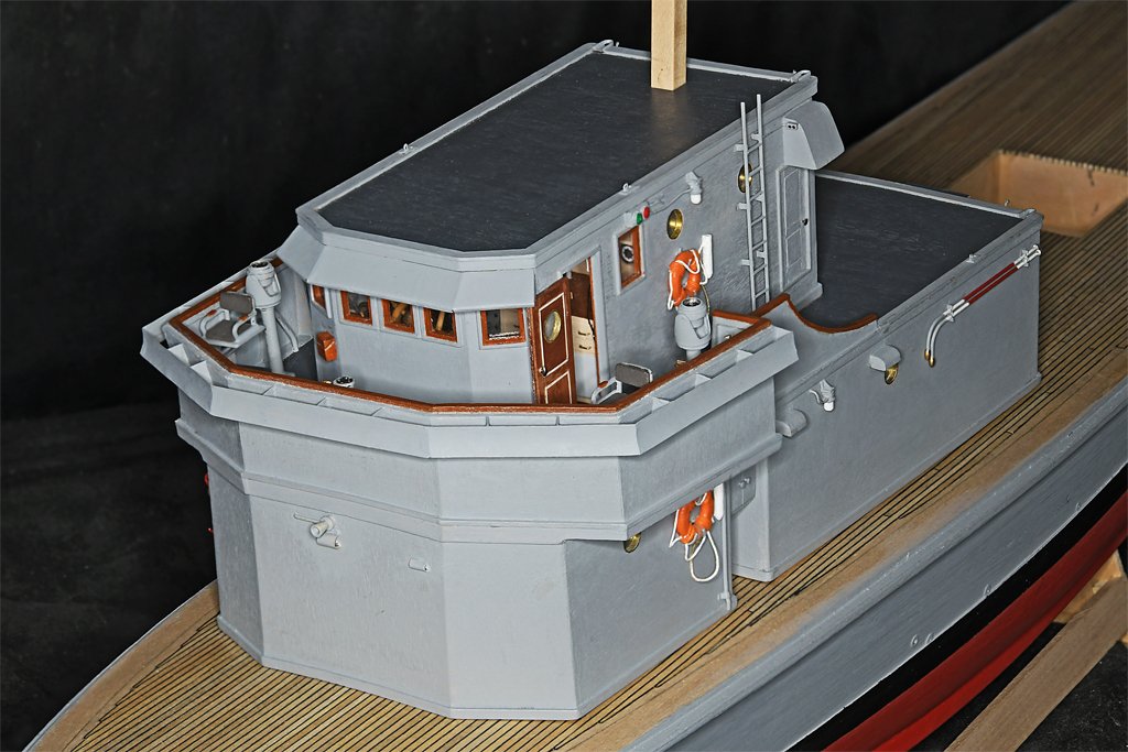

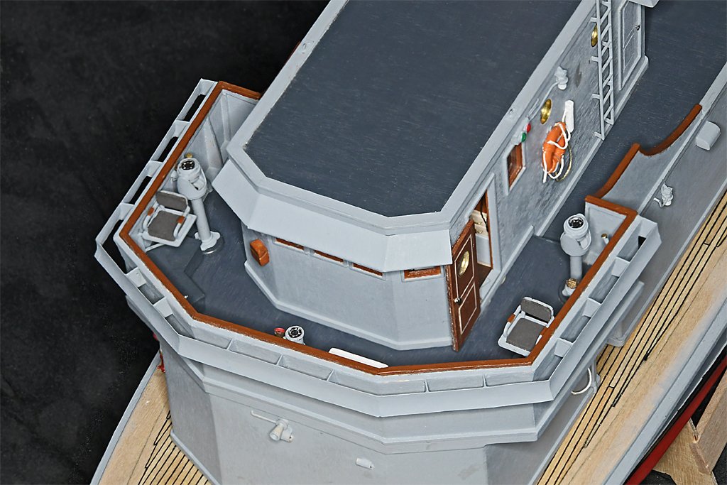

Final venturi work.
For all the worrying I did about making the venturis, I think they came out pretty nice! They seem to be very sturdy.
venturis8.jpg.1215cff102e84af8b4528929eaf545fa.jpgventuris9.jpg.aceba2b718c0bbbdc29873ba2c8e230b.jpg
The vents and horn on the face of the deckhouse complete (I think) all the details on the sides of the deck houses. But I still need to make the name boards.

That looks legit Phil!  Details, coloration, everything. Very very cool!!
Steve
San Diego Ship Modelers Guild
They certainly did Phil.

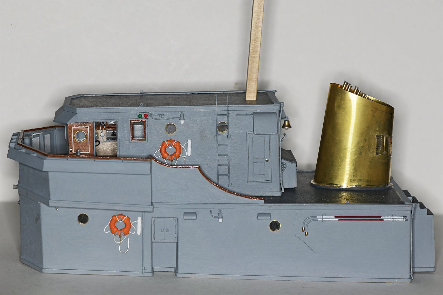

Smoke Stack/Funnel
The next "detail" to add to the deck houses is the smoke stack. It is a fairly complicated truncated oval cone. I suppose I could have carved it out of a block of wood, but I wanted to try making it from brass sheet. All this brass work is practice for the machinery on the stern of the ship.
First I made a CAD model of the smoke stack. The funnel cap piece was a bit tricky in CAD, but there is no way I could have made it free hand! Then I unfolded the 3D CAD parts to make 2D patterns for the pieces.
smokestack.thumb.jpg.deacc8b250f45d6155d90c5872a33d55.jpgsmokestackparts.thumb.jpg.e24fbe2ea66da0e384ee900ee623084a.jpg
I made the base for the smoke stack from 1/16 inch (1.6 mm) basswood sheet. It was sanded to the correct thickness (about 0.055 inch/1.4 mm) at the edges, and to fit the curvature of the deck.
It was glued in place with Titebond Original glue, and this is where Murphy stepped in to help. While I was working on the other pieces the wood curled up at the edges to a shallow "U" shape.
I didn't notice this until the glue had set, so I soaked the glue under the edges with water until it loosened. The wet glue was removed, more fresh glue added, and the thing was weighted down with a small anvil resting on a plywood scrap to force the edges to lie flat.
I cut out the oval ring at the base of the stack from 0.005 inch (0.13 mm) brass sheet. Then the oval top plate that holds all the exhaust pipes was made and drilled for the pipes.
A paper template for the shell of the stack was rolled up and taped closed to form the oval cone. The paper cone was fit into the base ring and the top plate was slipped into the top of the stack. This assembly fit nicely in place at the rear of the main deckhouse on the O1 level.
smokestack1.jpg.f85cb94c4459a2bbb4c0d2056057a9f6.jpgsmokestack2.jpg.92f01853a10eb45fc8f4d6b38a8bba5c.jpg
smokestack4.jpg.89c7c8b3b6026ece0f5b5ebaa5b14c84.jpgThe paper template seemed to be the correct shape so it was time to cut out the remaining brass pieces. These parts were cut from 0.005 inch (0.13 mm) brass sheet. It is pretty thin, but I think this will be sturdy enough after it is rolled up and the base ring and top plate are soldered in place.
I will install the 11 exhaust pipes into the top plate before starting the assembly. They should all have tiny cover pieces, but I doubt that I can make the minute hinge parts shown in the CAD image.
That top cap piece will be a bit of a challenge to solder directly onto the top edge of the shell piece. Then a 0.025 inch (0.6 mm) diameter brass wire is to be soldered along the top edge of the cap piece!
It will be good soldering practice. I have already done all this once before with the funnels for the USS Oklahoma City CLG-5 model - but at 1:96 scale.

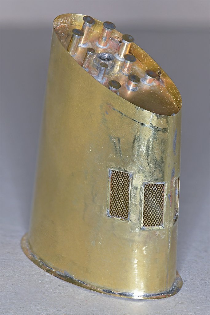

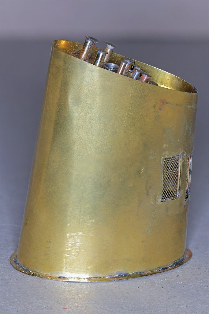

I finally got up the courage to roll the smoke stack shell and add on the base ring and upper plate.
smokestack8.jpg.13ee0a0c0d68c44529675bd659394521.jpgsmokestack9.jpg.84657ee5d691b3543c8c00ae20021bfd.jpg
I could imagine any number of ways this could go wrong, but it assembled without much trouble! The templates from the 3D CAD model worked perfectly. The shell rolled up to just the right dimensions for the top plate and base ring to fit correctly!
First I soldered the 11 vent pipes into the top plate. I still need to make the conical cover for the large boiler vent. And I think I have figured out a way to make the hinges for the cover flaps for the diesel exhaust pipes. The caps are just  0.127 inch/3.2 mm diameter so the hinges will be very small!
I had to do a small amount of fitting to get the top plate to squeeze into the shell at a scale 7 inches (0.146 inch/3.7 mm) below the top edge of the shell. Then getting it to stay there while I soldered it in place - without unsoldering any of the exhaust pipes - was an exercise in patience.

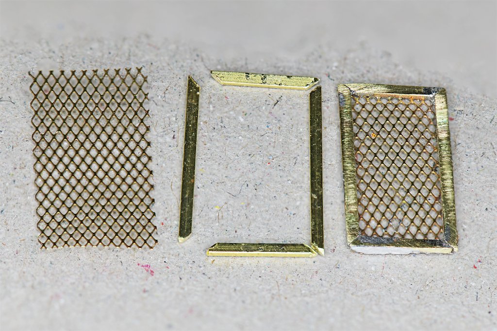

The next step was to make the intake vent screens on the aft side of the smoke stack. The blueprints call for a rectangular pattern screen with wires spaced 1/2 inch (12 mm) apart. That comes out to 0.0104 inch/0.26 mm square openings with 0.0013 inch/0.033 mm wire. I have three rolls of fine mesh wire screen, one brass with 0.025 inch/0.625 mm squares, another brass with 0.017 inch/0.43 mm squares, and a stainless steel mesh with 0.016 inch/0.42 mm squares. The wire diameters are about 0.004 inch/0.17 mm. These were all oversized and looked too "lumpy" to my eye.
Here I departed from true scale. If I was going to have an oversized screen I might as well use a fine photoetch brass screen used for vents in HO scale (1:87) F series diesel engines. I picked up a package of these at our local hobby shop many years ago, thinking they would make nice vent screens for ship models. It has a "X" parallelogram pattern instead of square, with openings 0.030 inch/0.77 mm wide.
ventscreens.jpg.a40c60ae28ba022a1a9e193bc7bad8a7.jpgvents.jpg.804da8180f5369dee2d23cc280cfe3d4.jpg
OK. It isn't to scale, so sue me! I think it looks a lot better than the screen wire. I soldered up four of these 0.51 x 0.26 inch (13.2 x 6.6 mm) vent screens and then glued them inside the vent openings with cyanoacrylate (CA) gel. Next will be the diesel exhaust cap hinges, boiler vent cover, and the cap that fits onto the top edge of the shell.

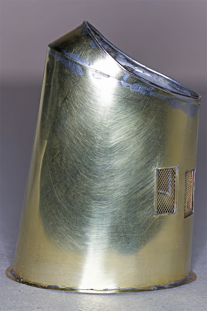

smokestack.jpg.009eb0be767f70361f28fc8a6f51bd3a.jpgThanks!
But it looks a bit nicer after it has been polished with #0000 steel wool!

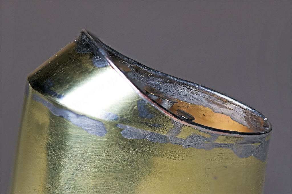

I have added the cap to the stack, and the bead that runs along the top edge of the cap.
The edge of the 0.005 inch (0.13 mm) thick stack cap rests precisely on the top edge of the 0.005 inch thick stack shell. And the 0.030 inch (0.76 mm) copper wire bead rests on the top edge of the cap.
I know this looks difficult, but it is actually a lot easier than you might think! The trick is pretty simple: start by attaching the two pieces just right at one place. I started at the front edge and used clamps and tape, repositioning until the cap was aligned perfectly at that one spot. Then I applied a bit of liquid citrus solder flux and a tiny amount of solder. GOTCHA! Once the two pieces are fixed together permanently at one spot they can't come apart and it is pretty easy to pull them together correctly at another place a short distance from the first. Then solder another spot, move on a short distance, align them again and solder another spot, and so on. This "stitches" the two pieces together. Just be certain to put heat sink clamps between the new solder place and the previous one to prevent heat from travelling back and unsoldering the previous spot.
For the wire bead I modified a small wooden "clothes pin" clamp to have a narrow point with a 0.033 inch (0.84 mm) hole drilled between the two parts of the tip. When this was clamped over the wire and top edge of the cap it held the wire centered on the edge. Because it was wooden I could solder right up to the clamp without soldering it to the assembly.
If I was really good at this I could have soldered everything from the inside without leaving the solder stain on the exterior. I have seen some amazing brass locomotives that were soldered together with no solder showing from the outside. But I am not that good. The stack will be painted gray with a black top, so the stain won't be visible in the finished piece.
