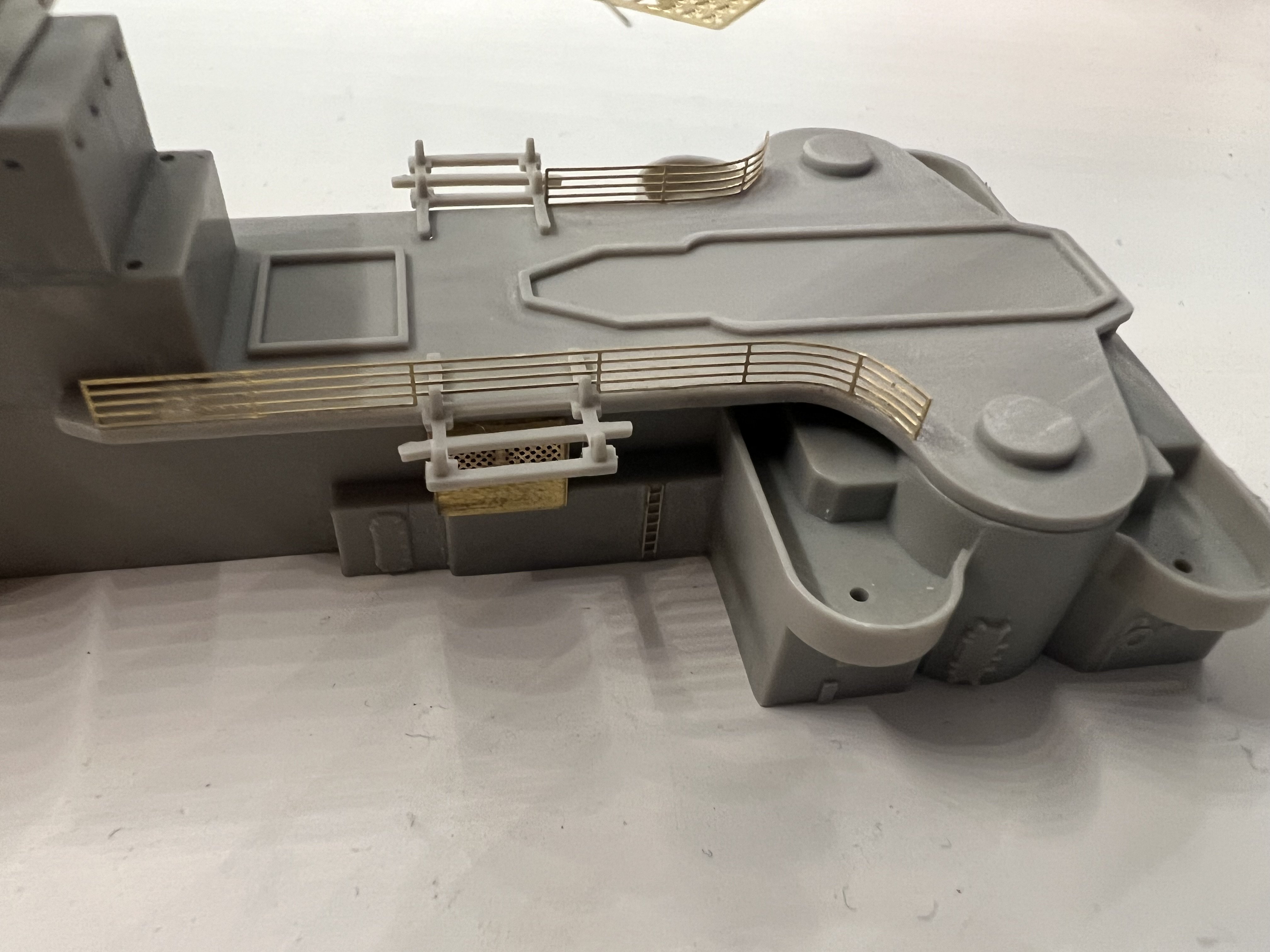

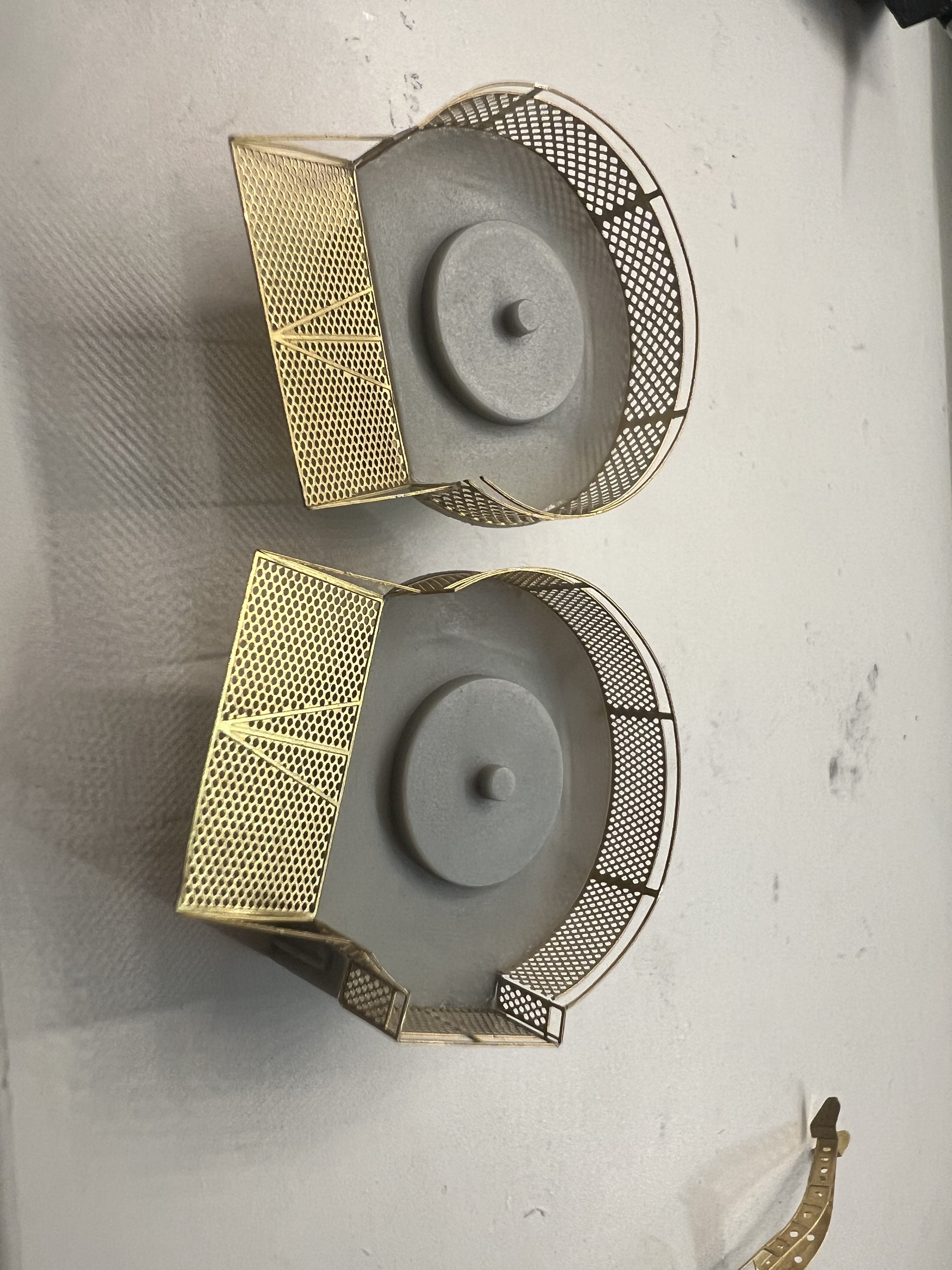

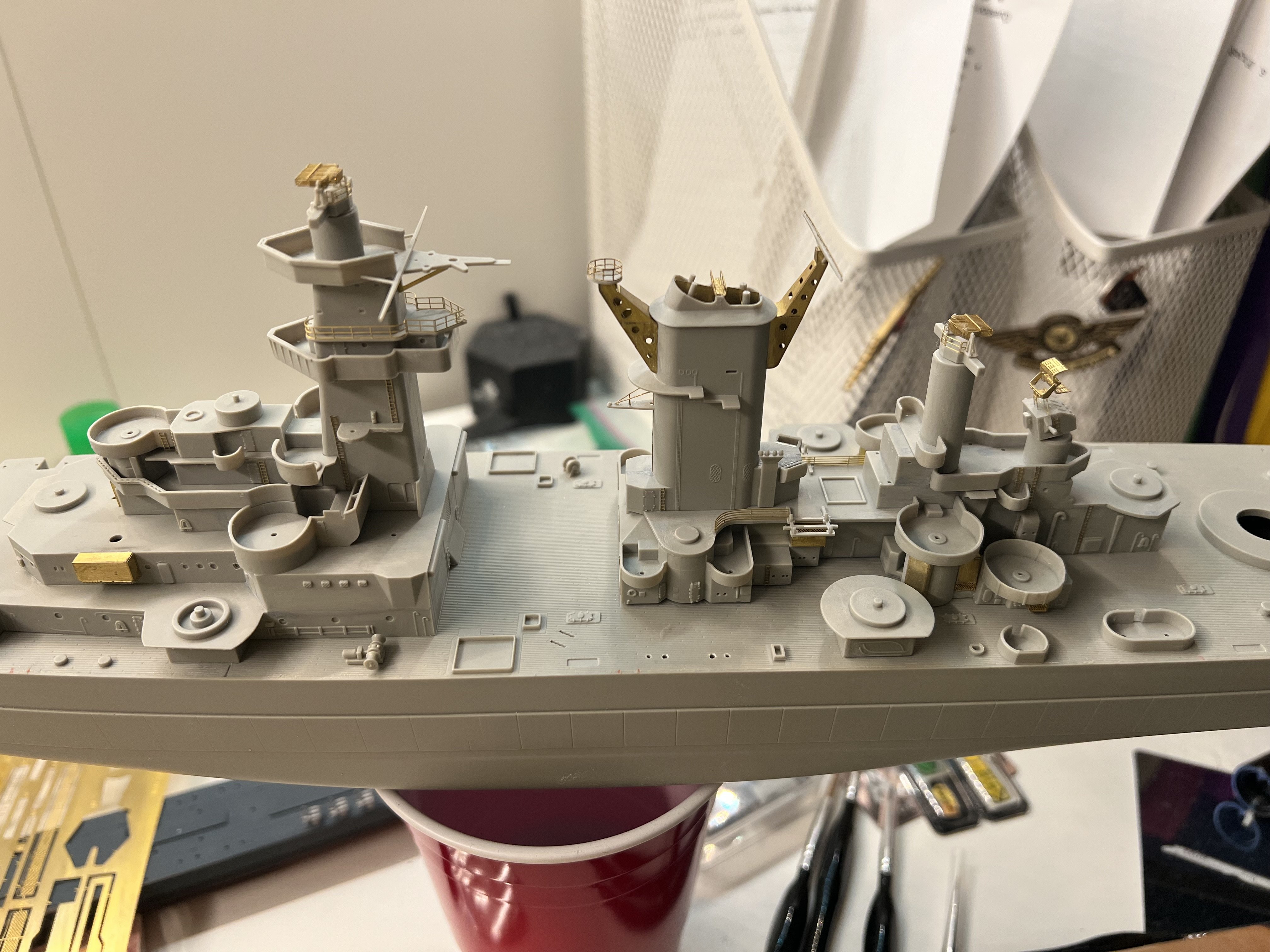

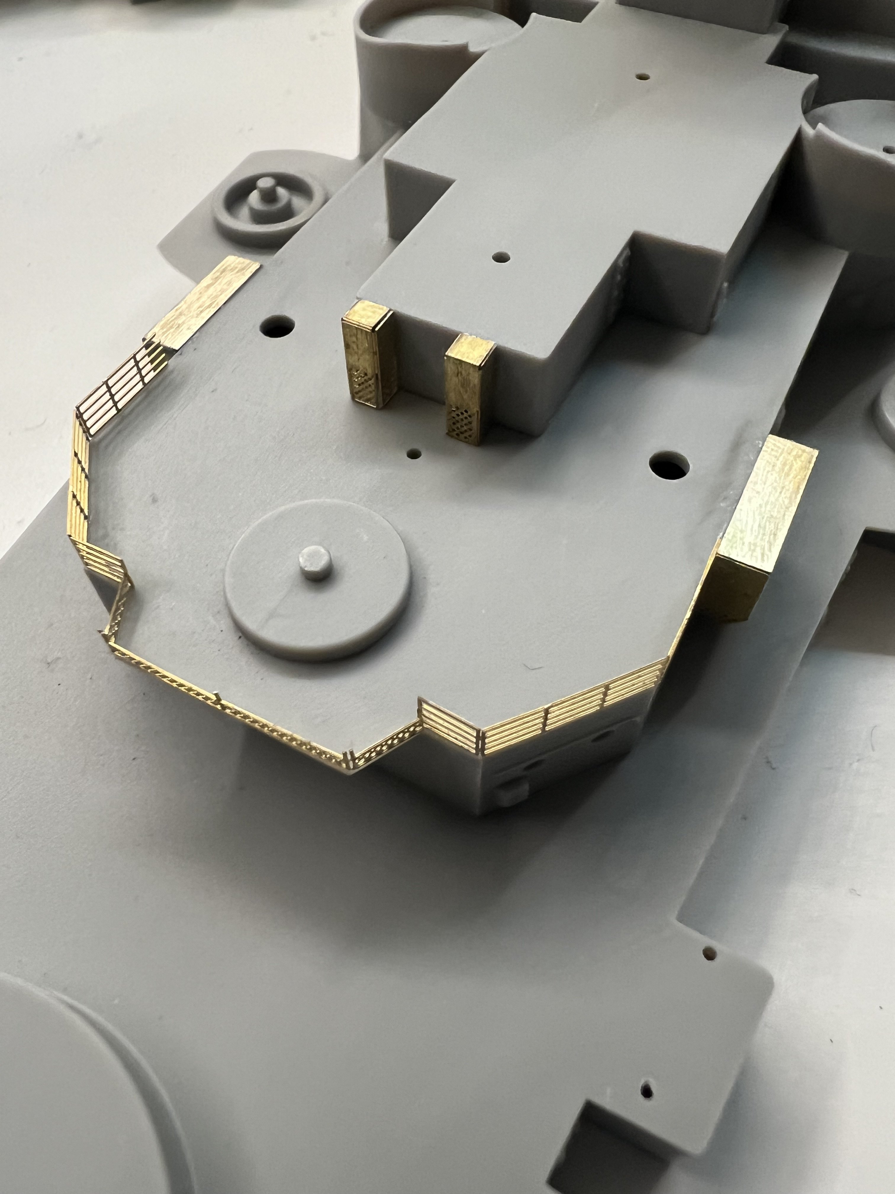

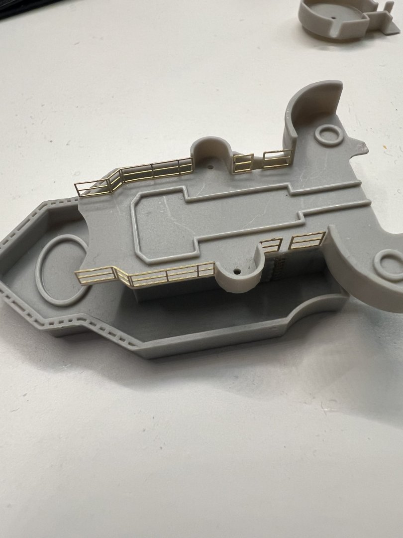

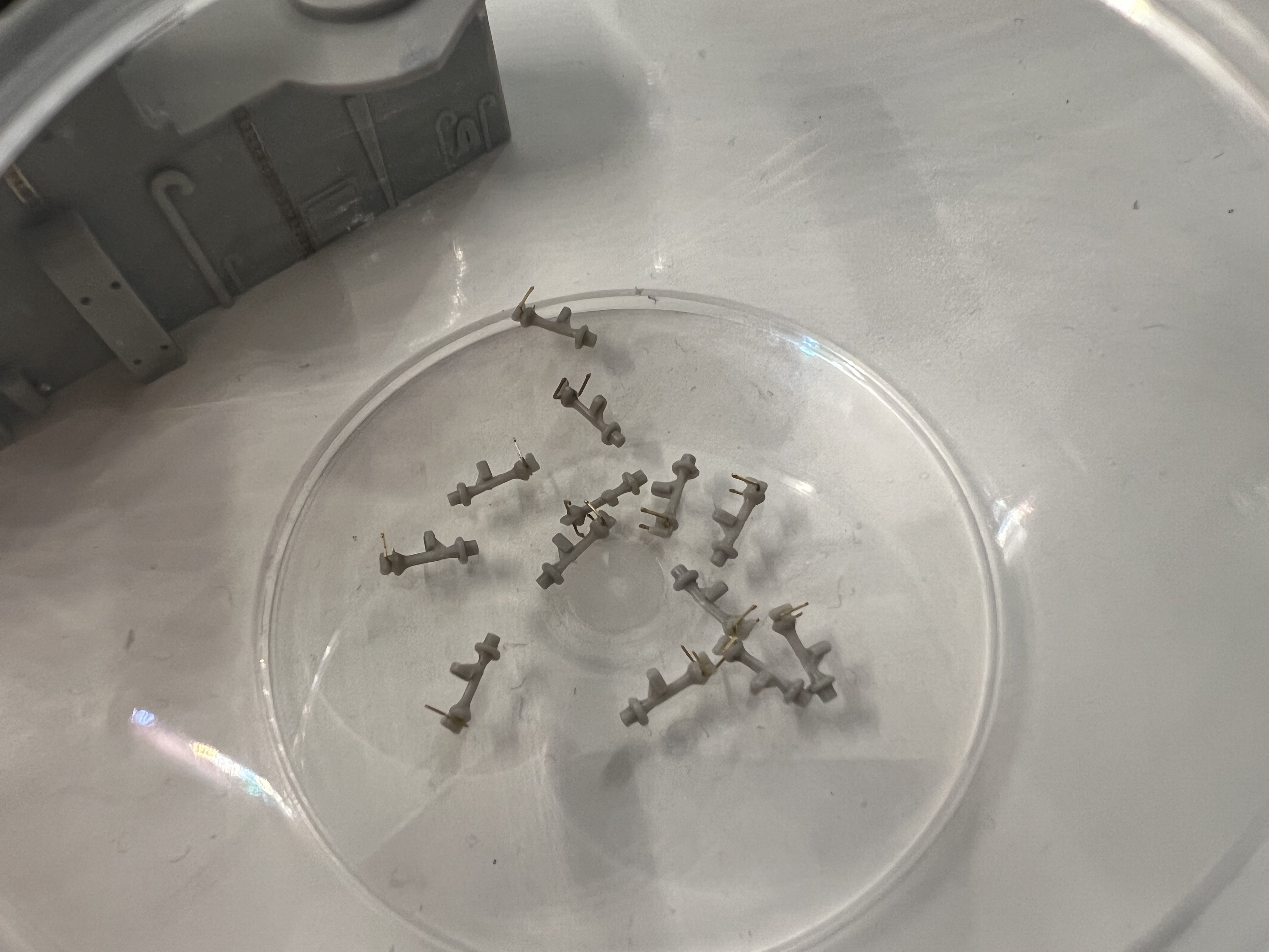

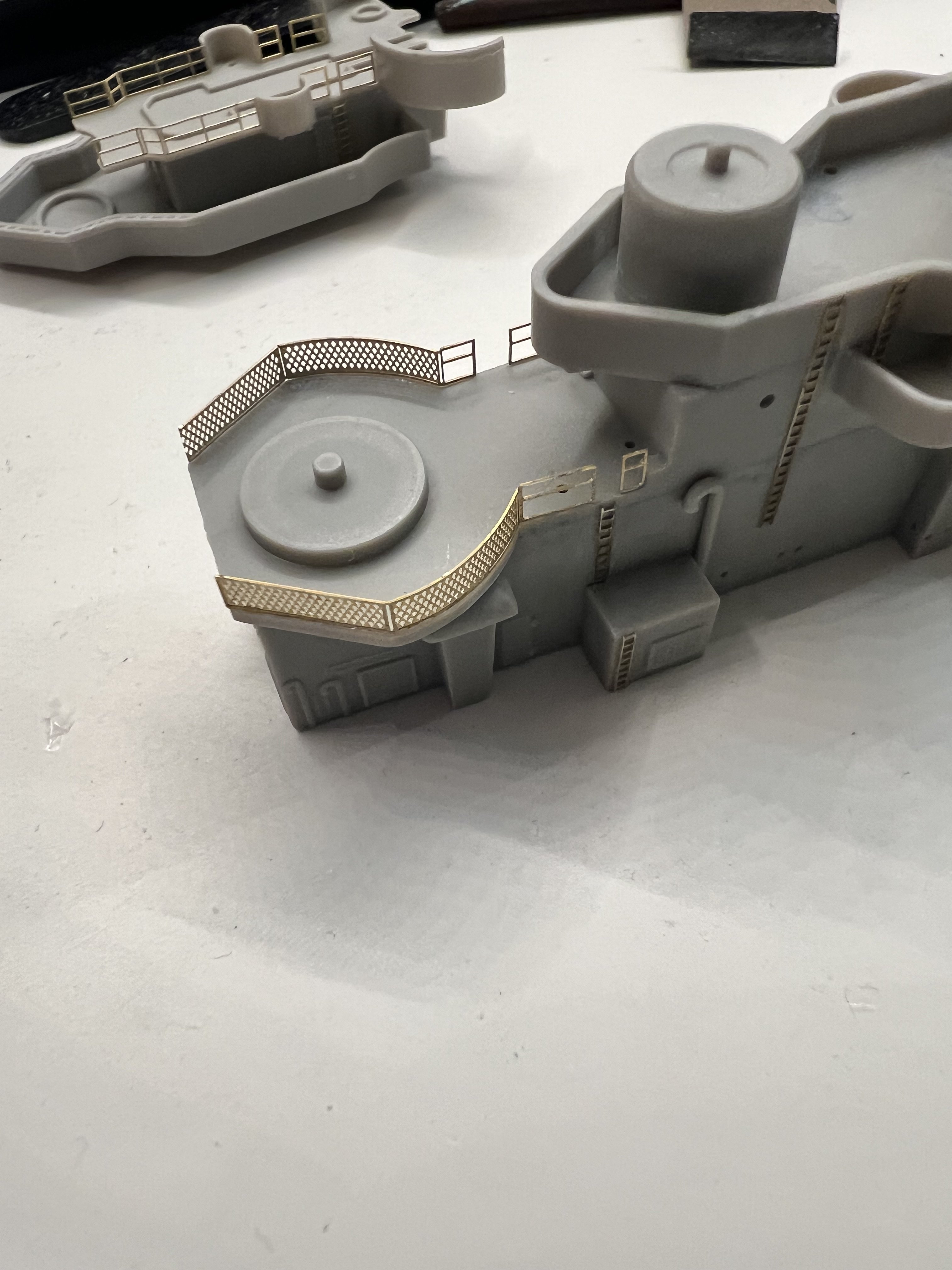

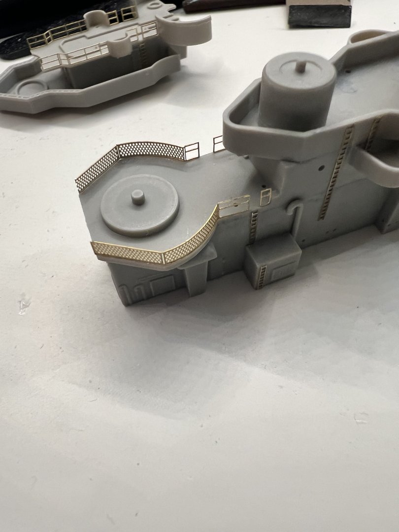

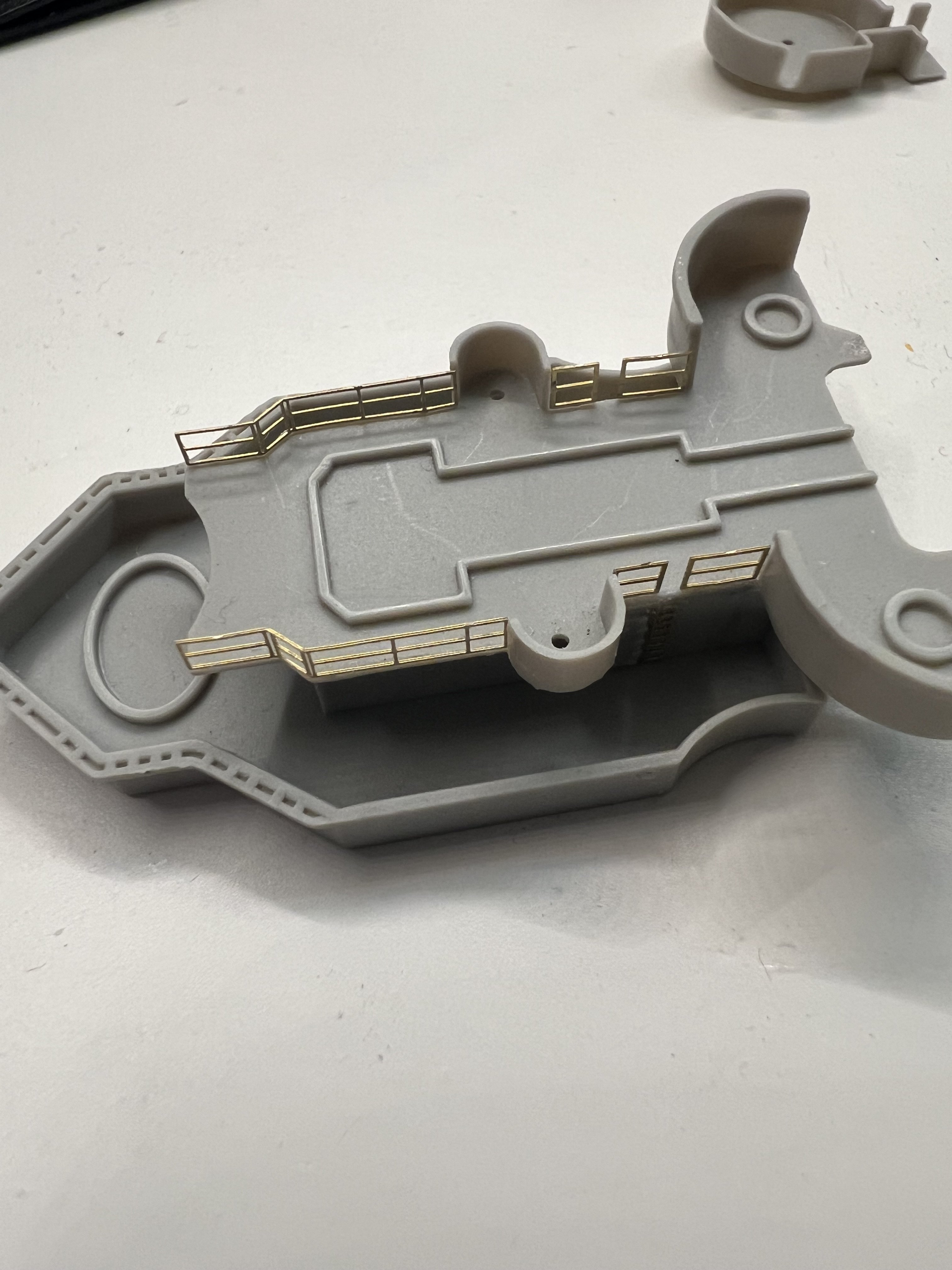

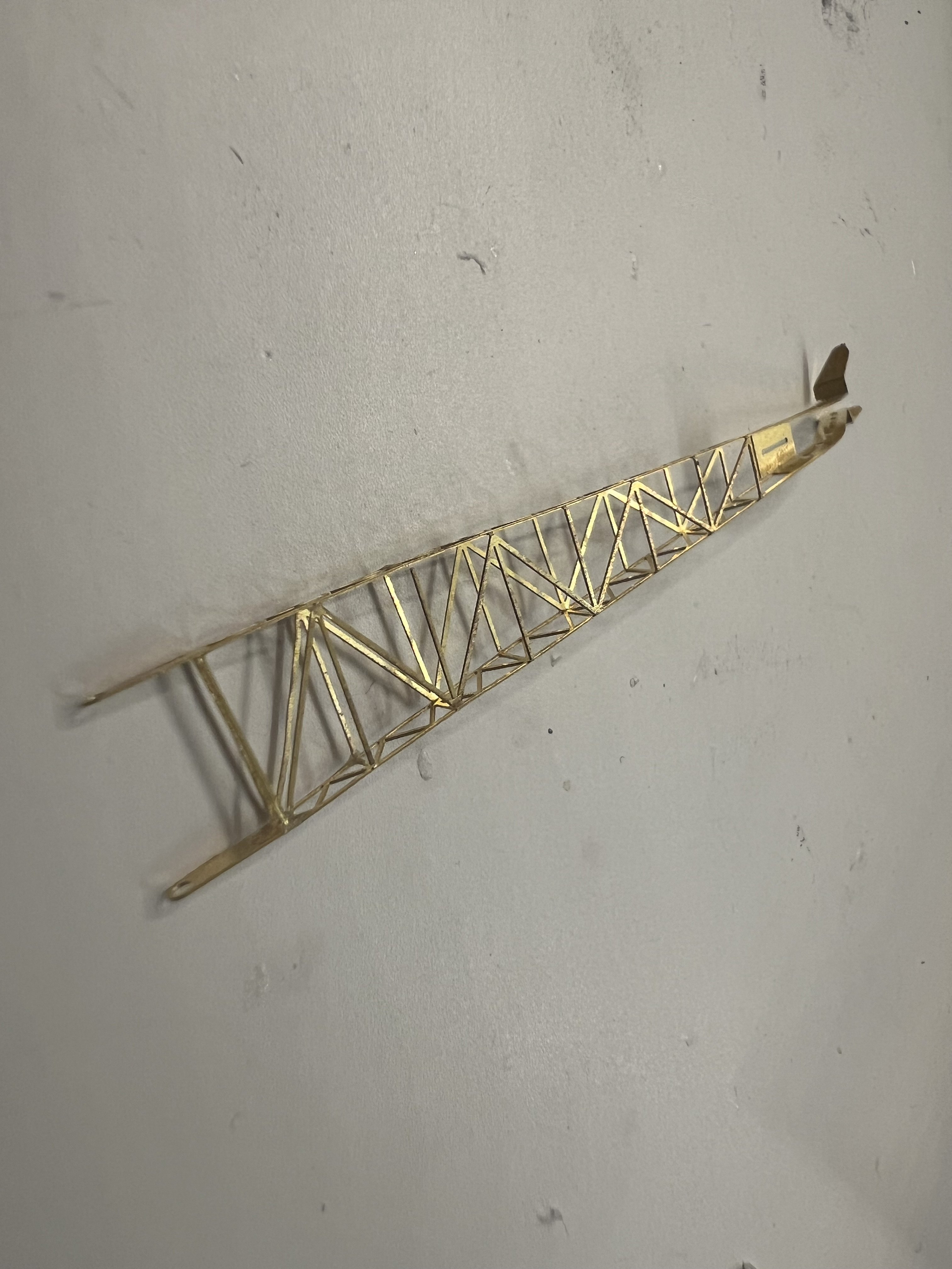

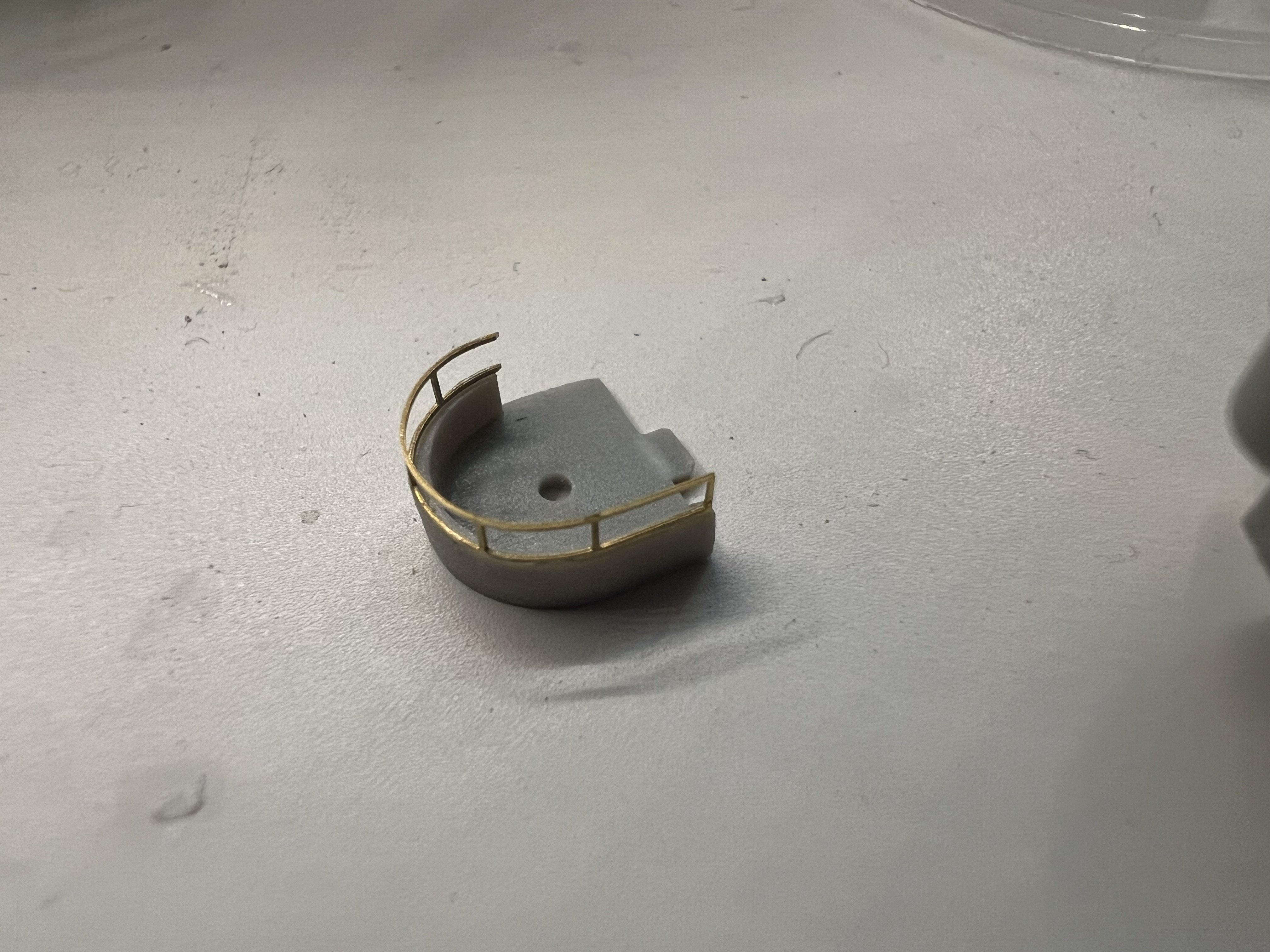

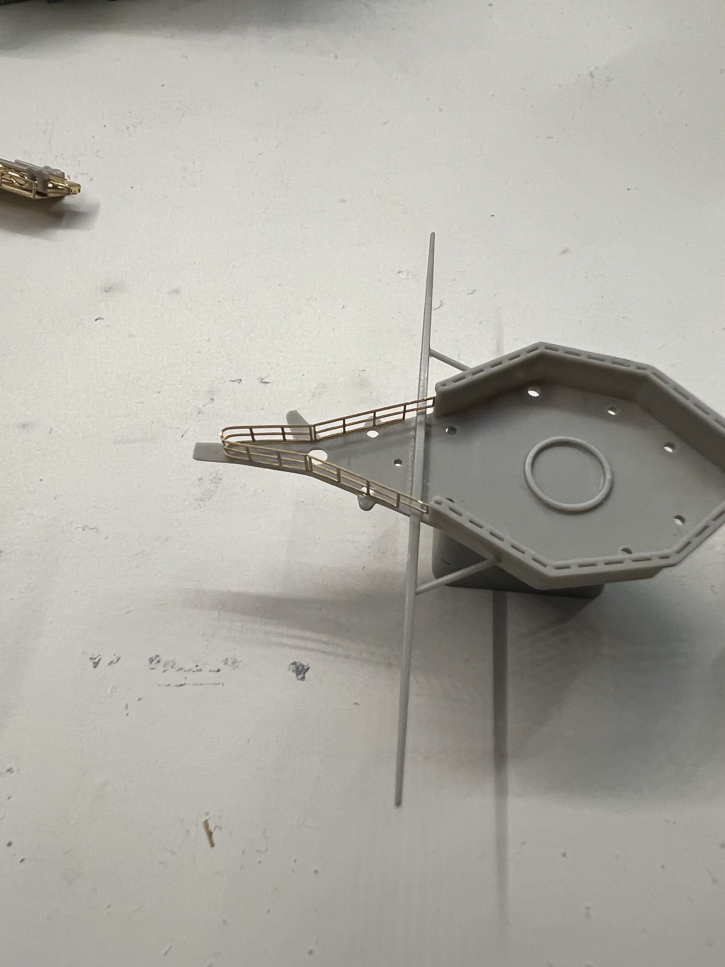

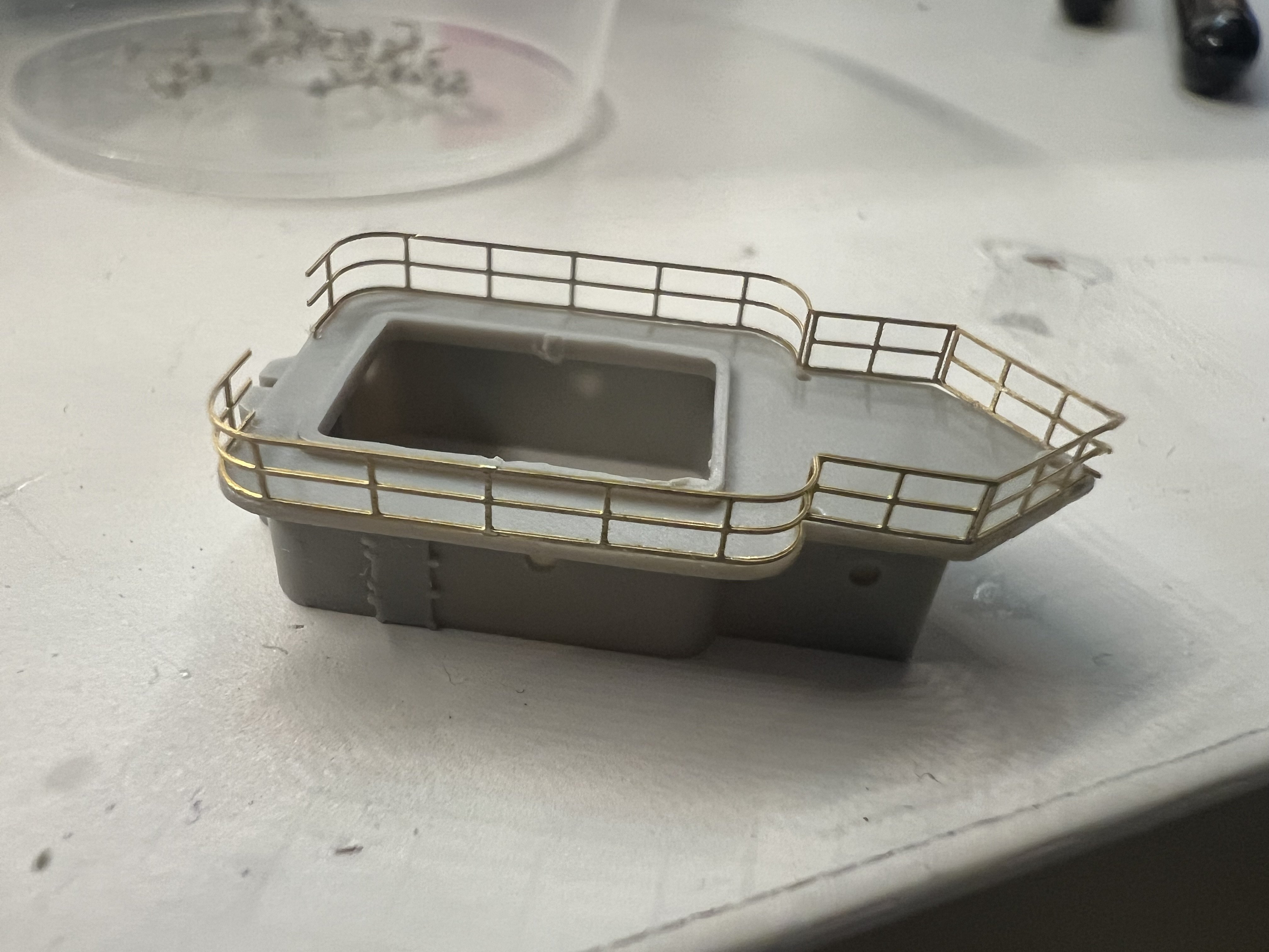

More photoetch today. The kits photoetch isn’t great, there are so many pieces that are too long and so I ended up cutting the railings into different segments. Annoying, but it worked:
IMG_7541.thumb.jpeg.524b336b40bca6e74531e5640afafff7.jpegIMG_7540.thumb.jpeg.1941415c82e63ecda41e5c7b4218019f.jpegIMG_7538.thumb.jpeg.506739caa0c1c9567a4edf20747af7f1.jpegIMG_7537.thumb.jpeg.0a6d96a35166aa7378590500809d8418.jpeg

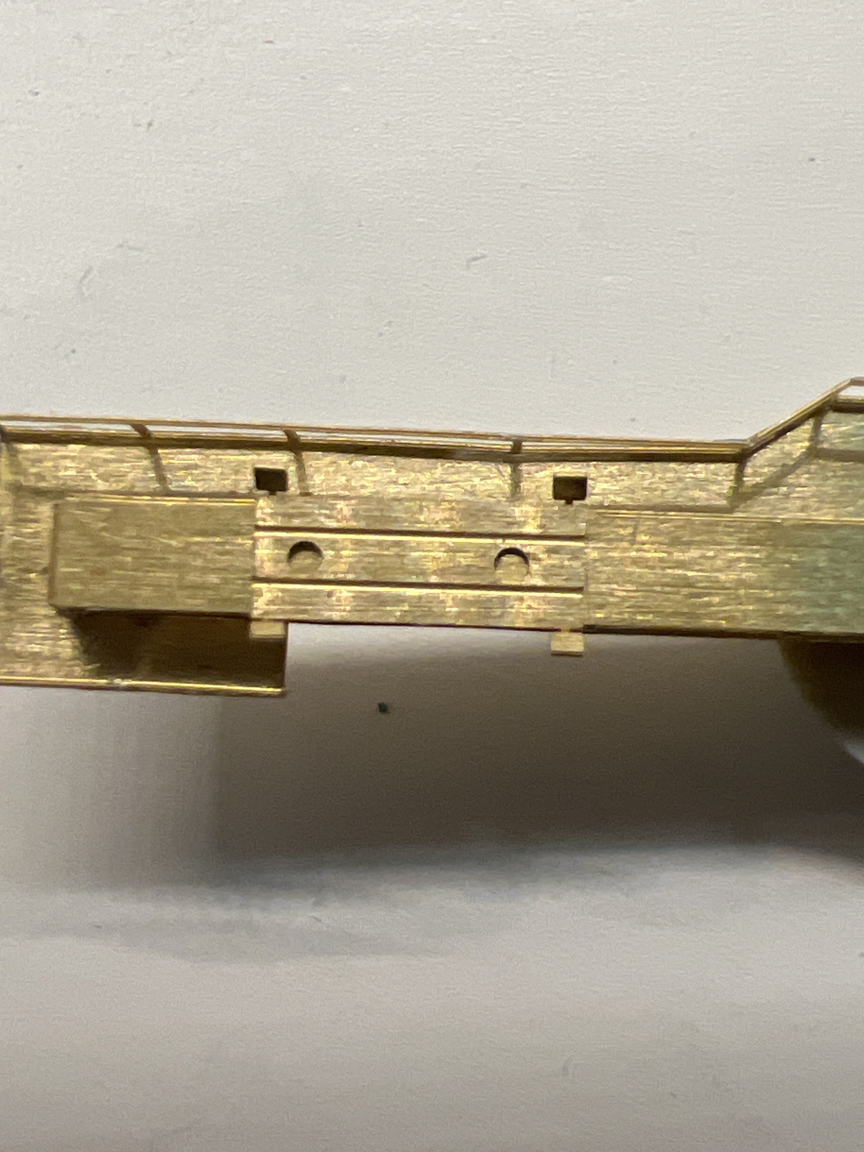

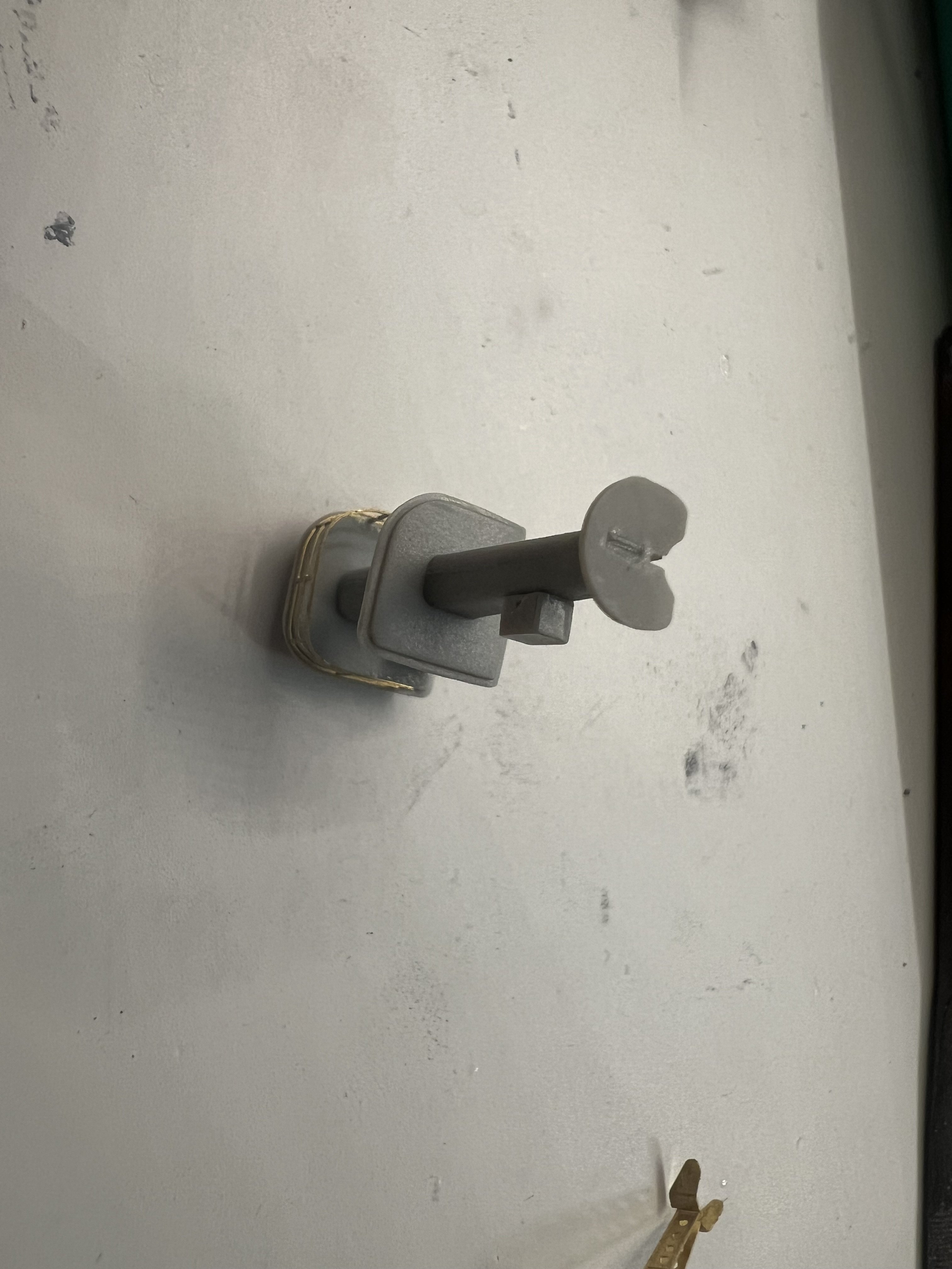

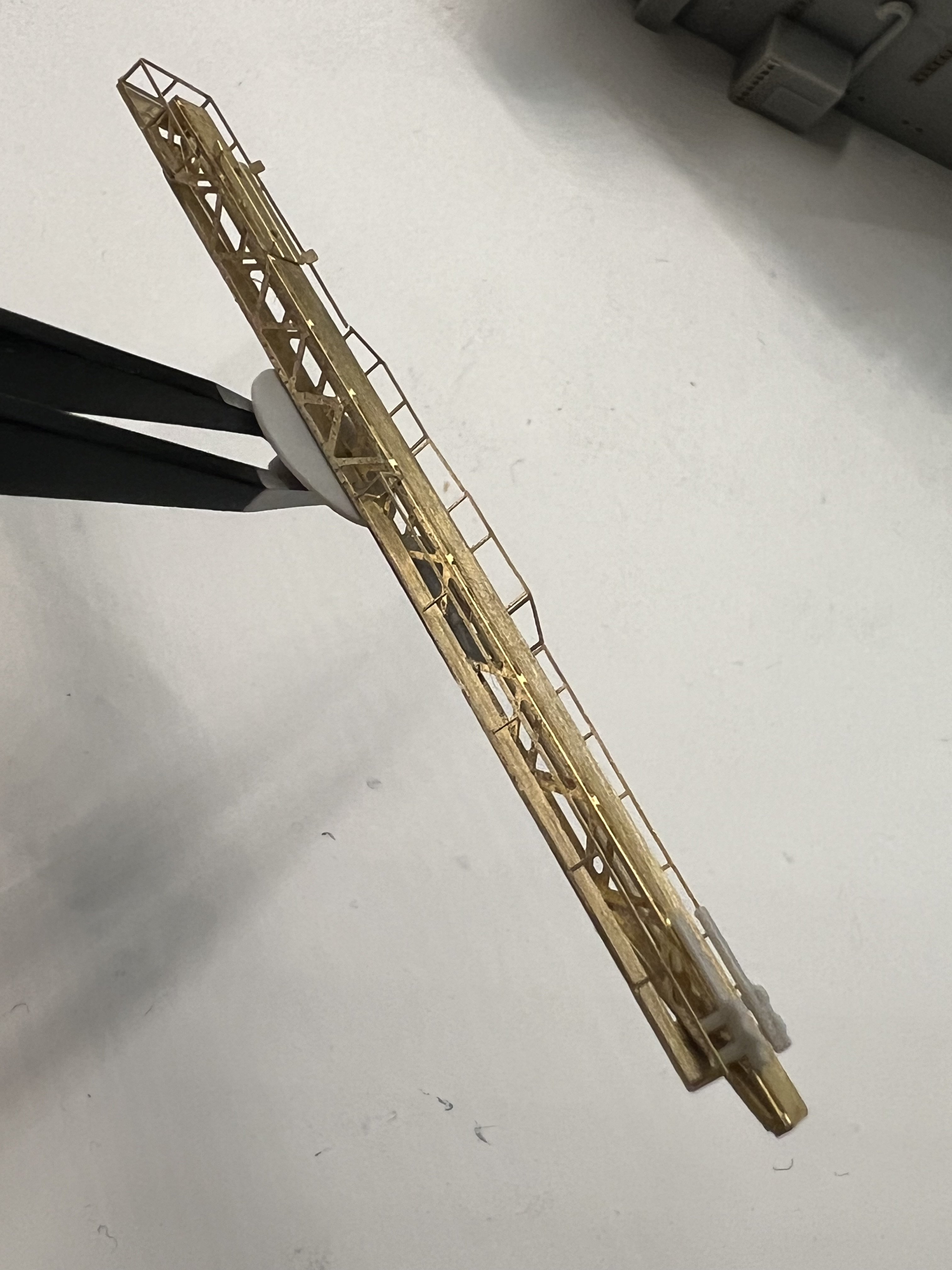

IMG_7539.thumb.jpeg.0868eda489b7966beea9c4519beefbae.jpegAs for the catapult, how does the cradle fold? There are four little foldable tabs:

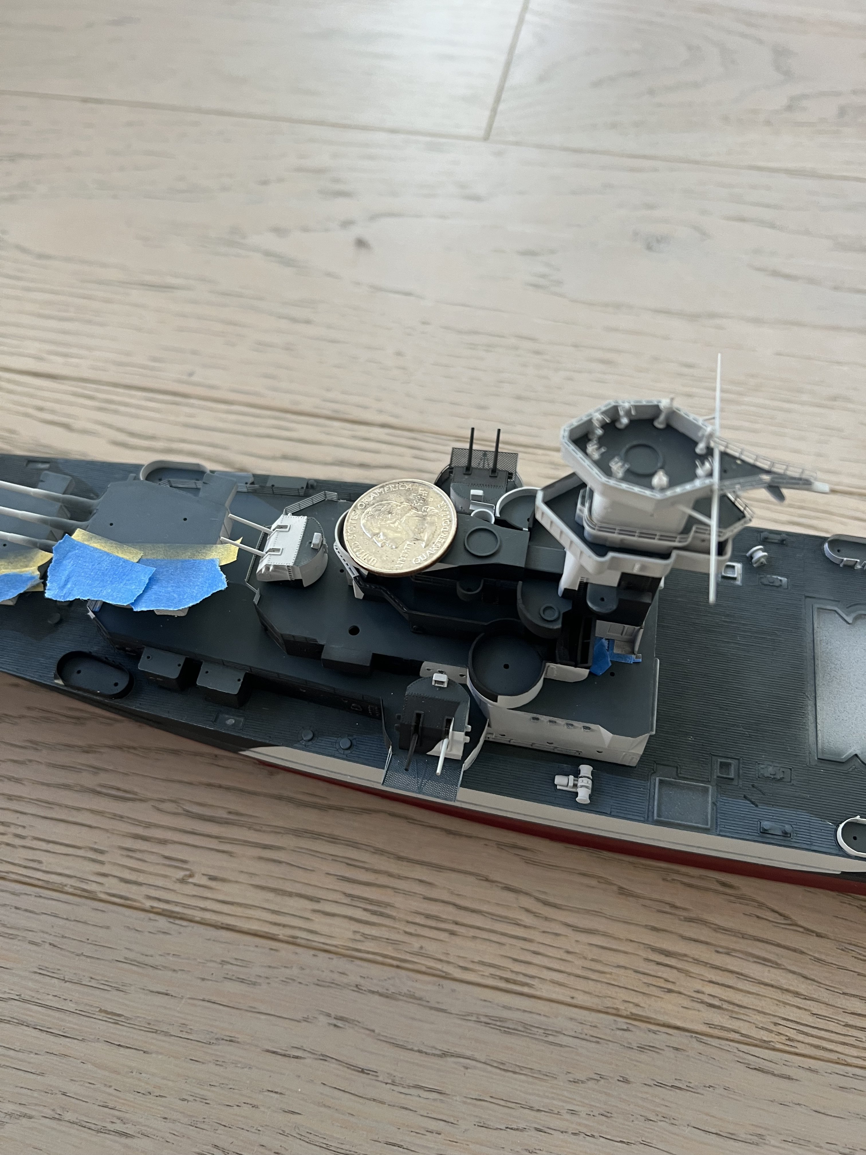

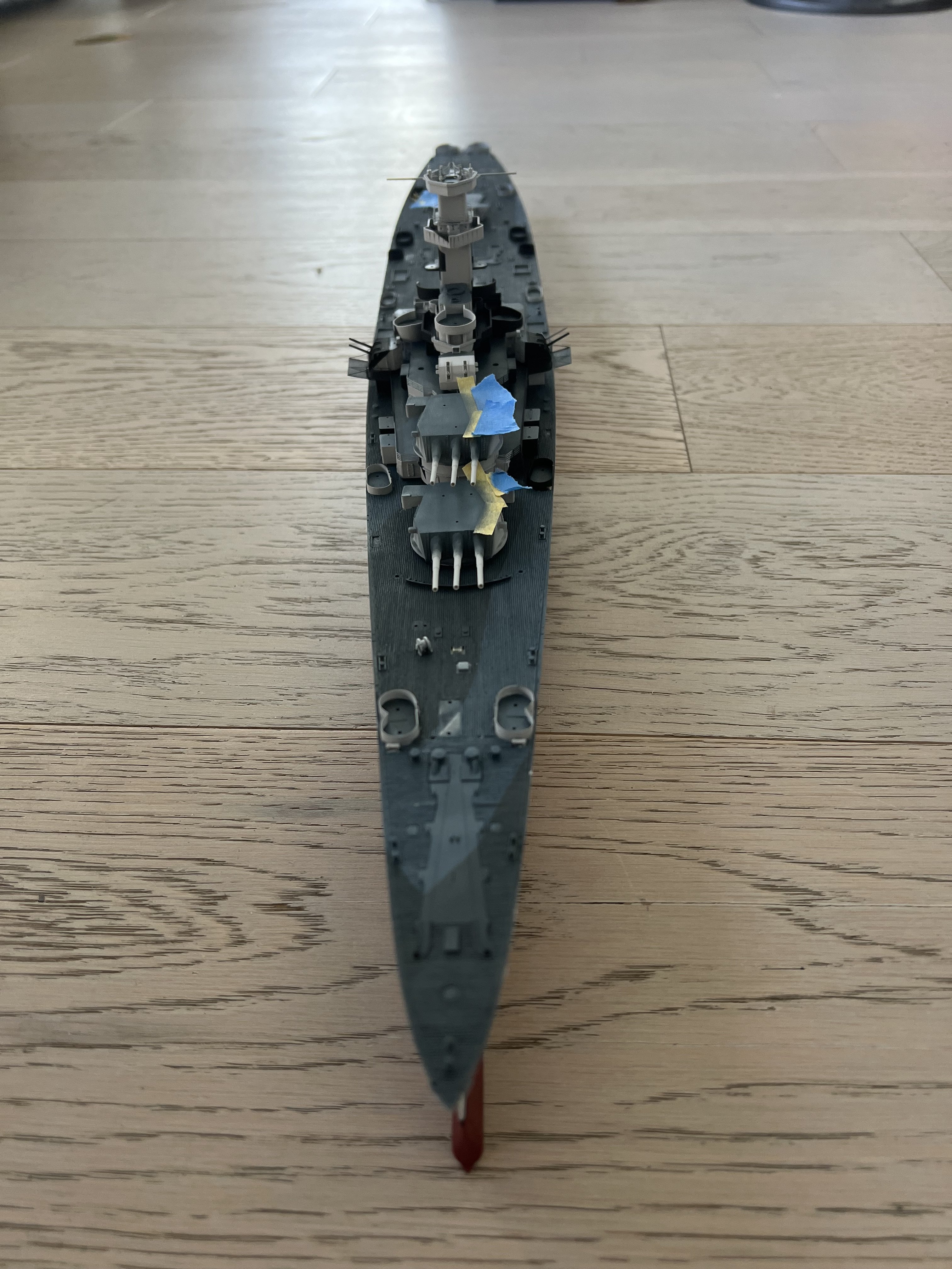

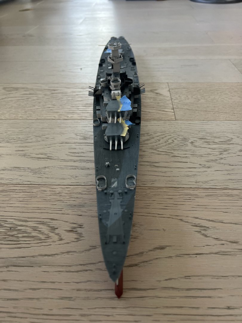

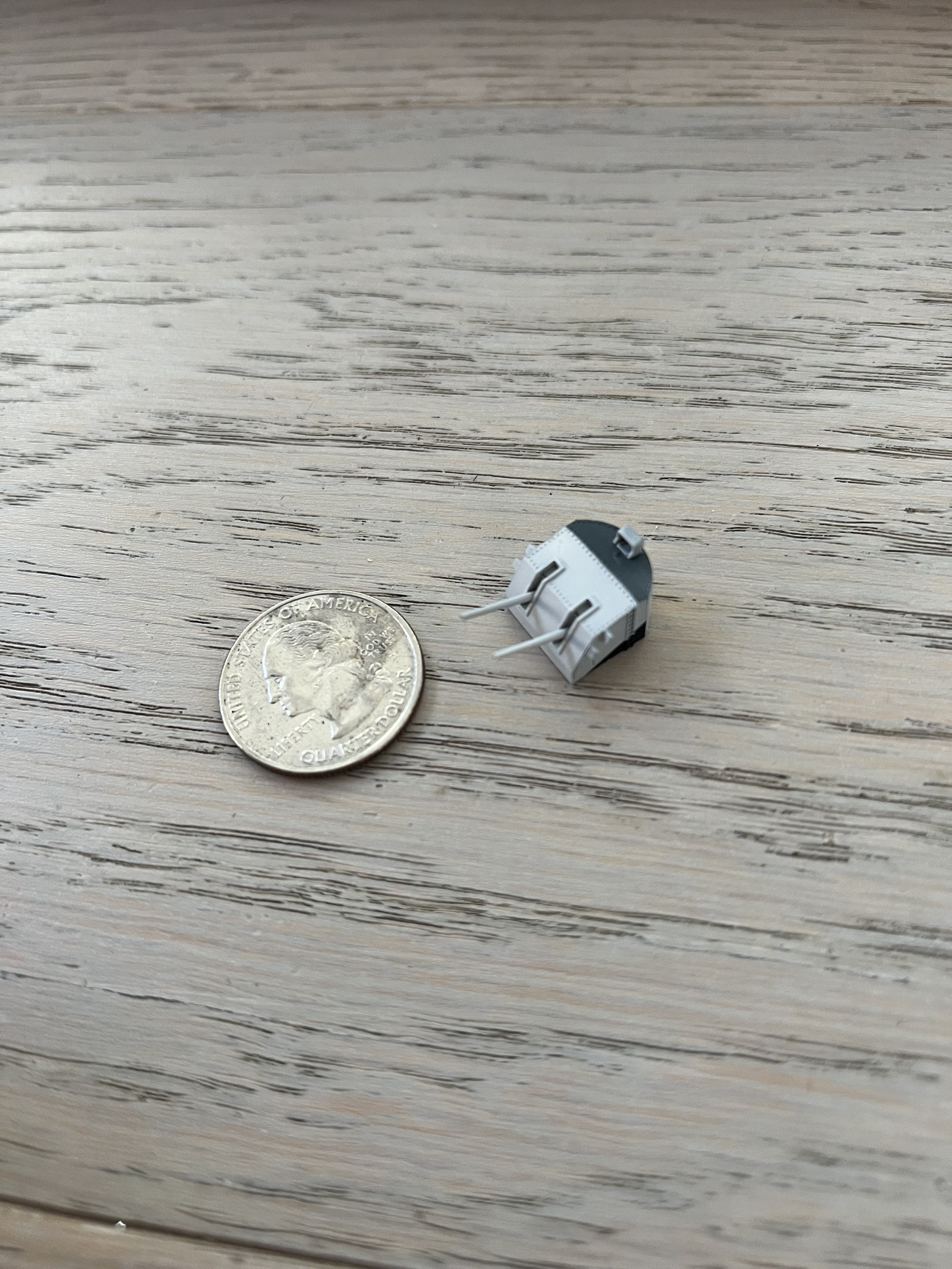

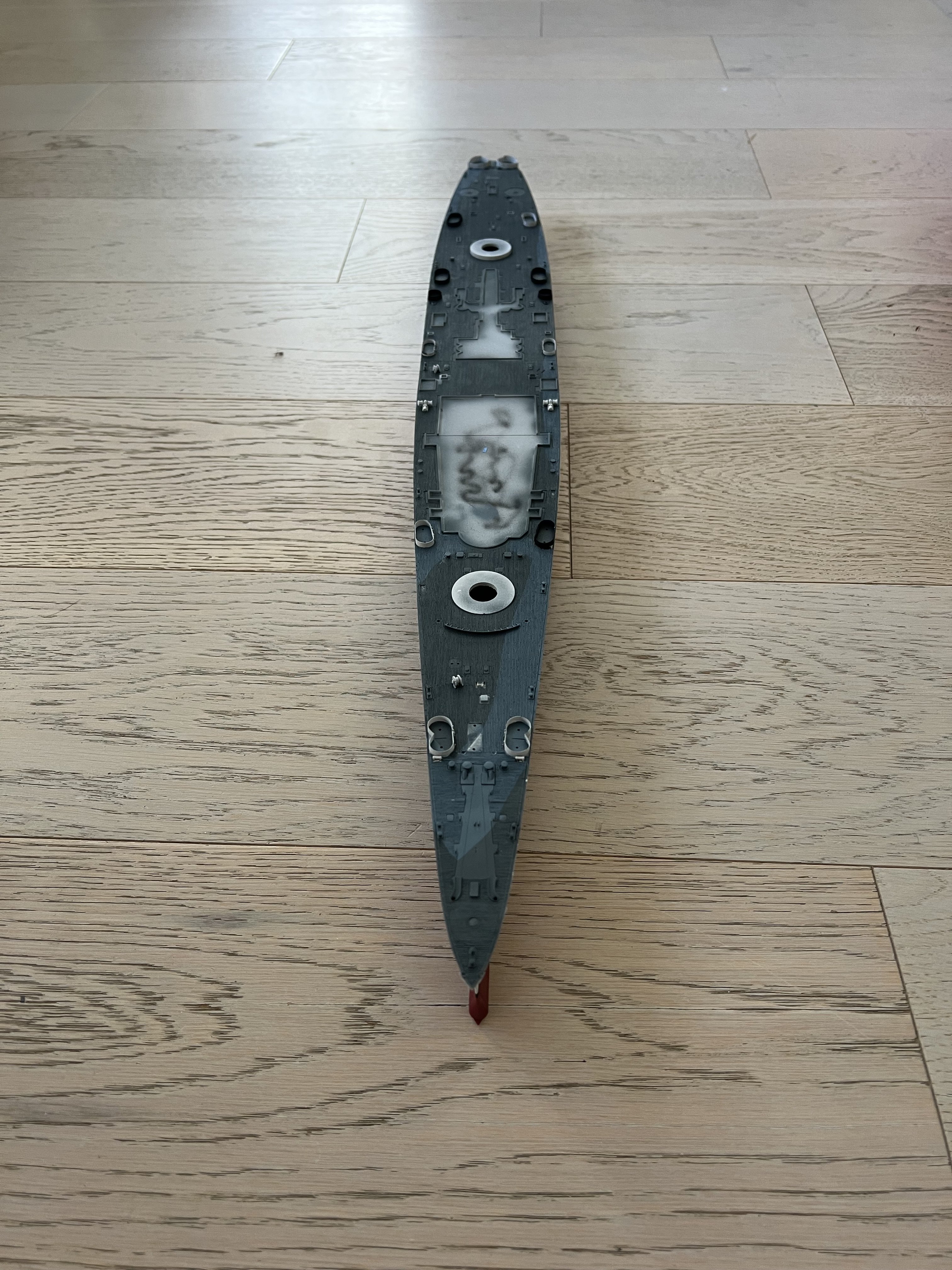

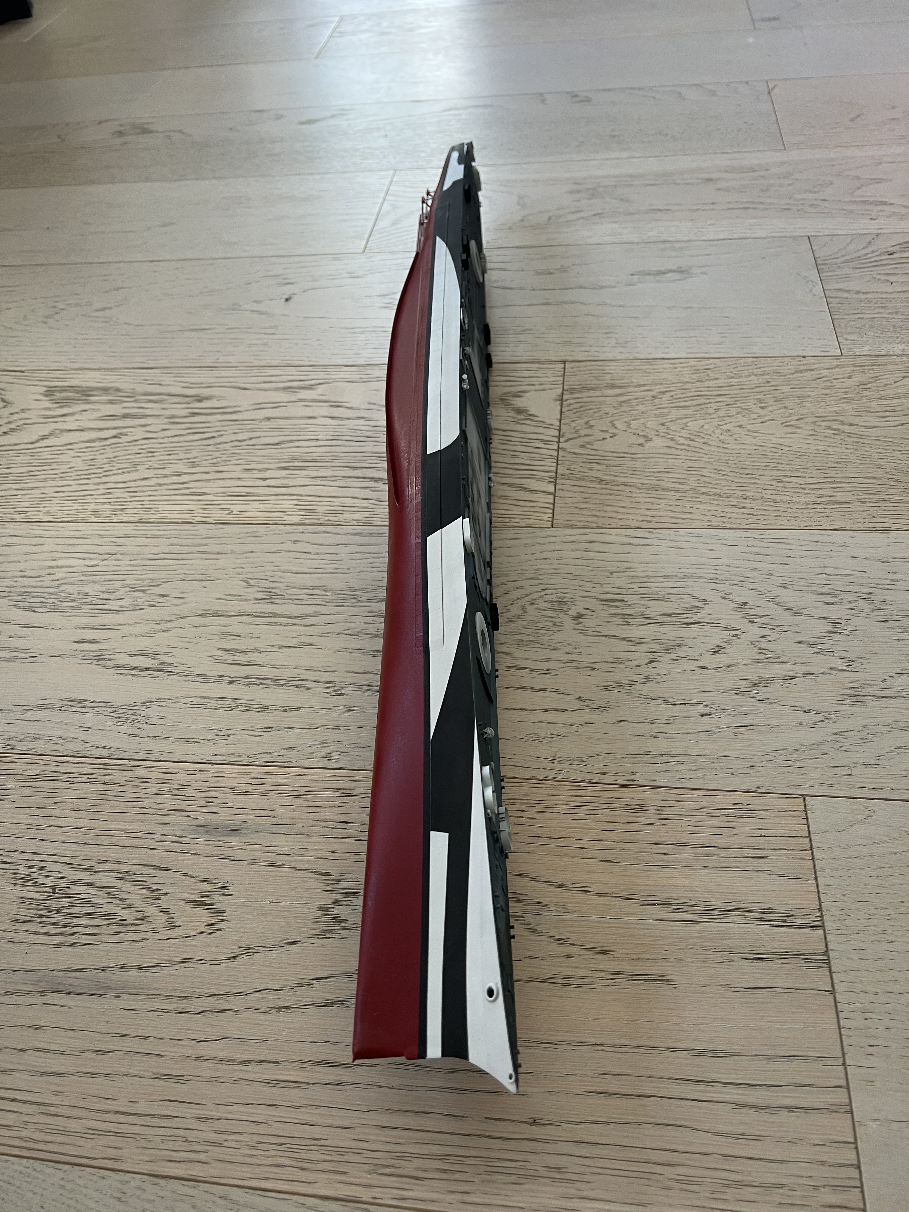

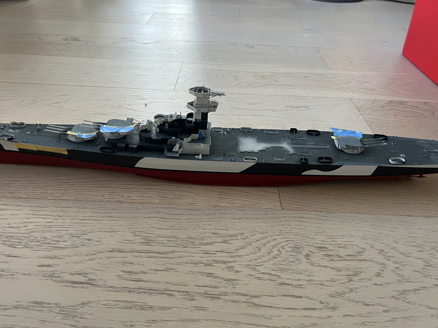

It’s been a while but I’ve been working throughout. I thought I’d paint the hull and then show you guys but I got carried away and decided to paint most of the ship:
IMG_7727.thumb.jpeg.cd0e3a8d12c075dc9080f0cc7dfb8c0a.jpegIMG_7728.thumb.jpeg.2618d94fac1ee06fa65ad0818b05bc06.jpegIMG_7729.thumb.jpeg.7e81631e0baf7cd1a401fafba14ce8d4.jpegIMG_7730.thumb.jpeg.dedc3177665d58a1628b2c0d55b3a03e.jpegIMG_7731.thumb.jpeg.9a350f6f8e1ca37e267cca16216f65fe.jpegIMG_7732.thumb.jpeg.fc481e266572dcf96c45de36abd2c988.jpeg
