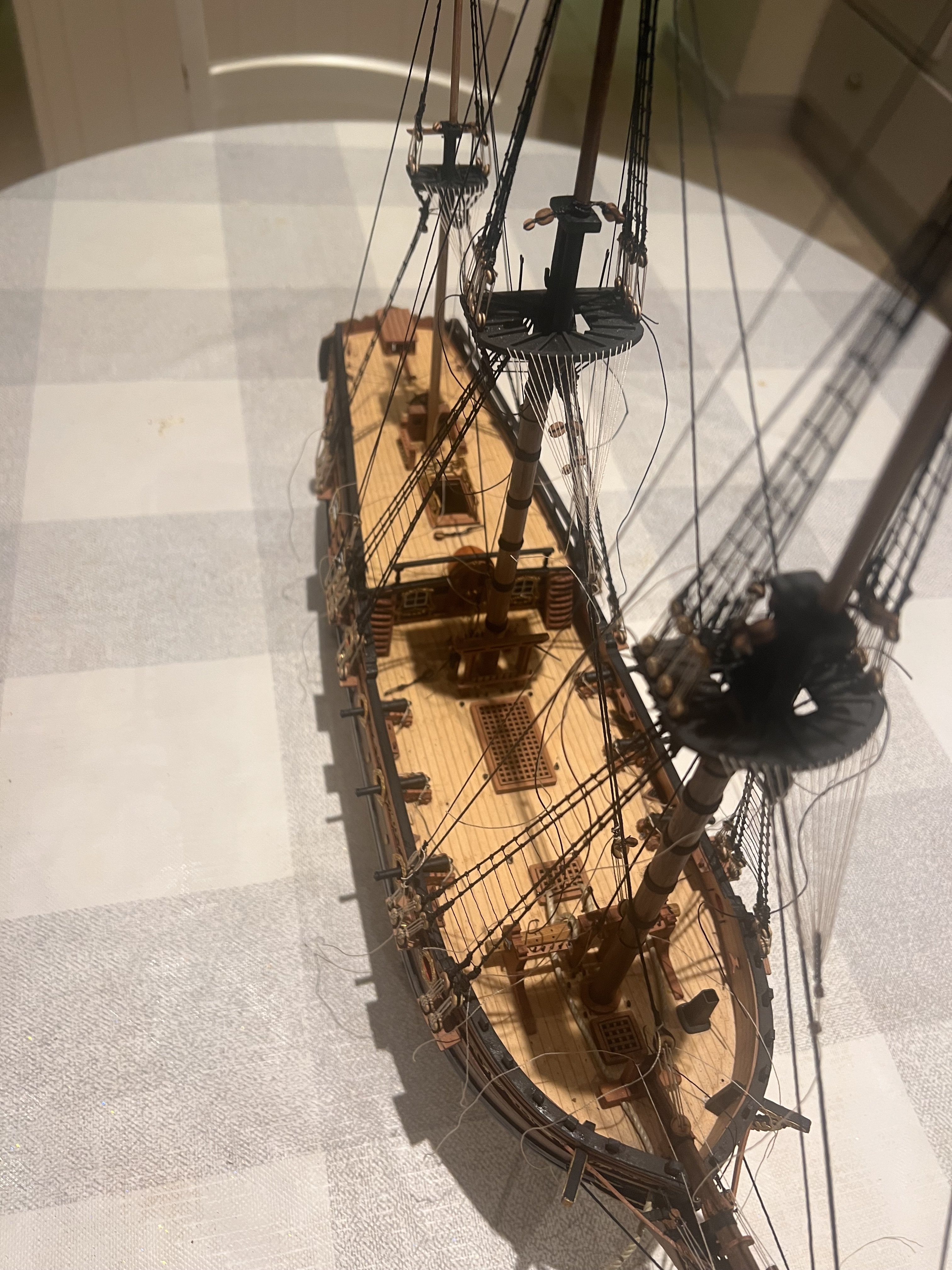

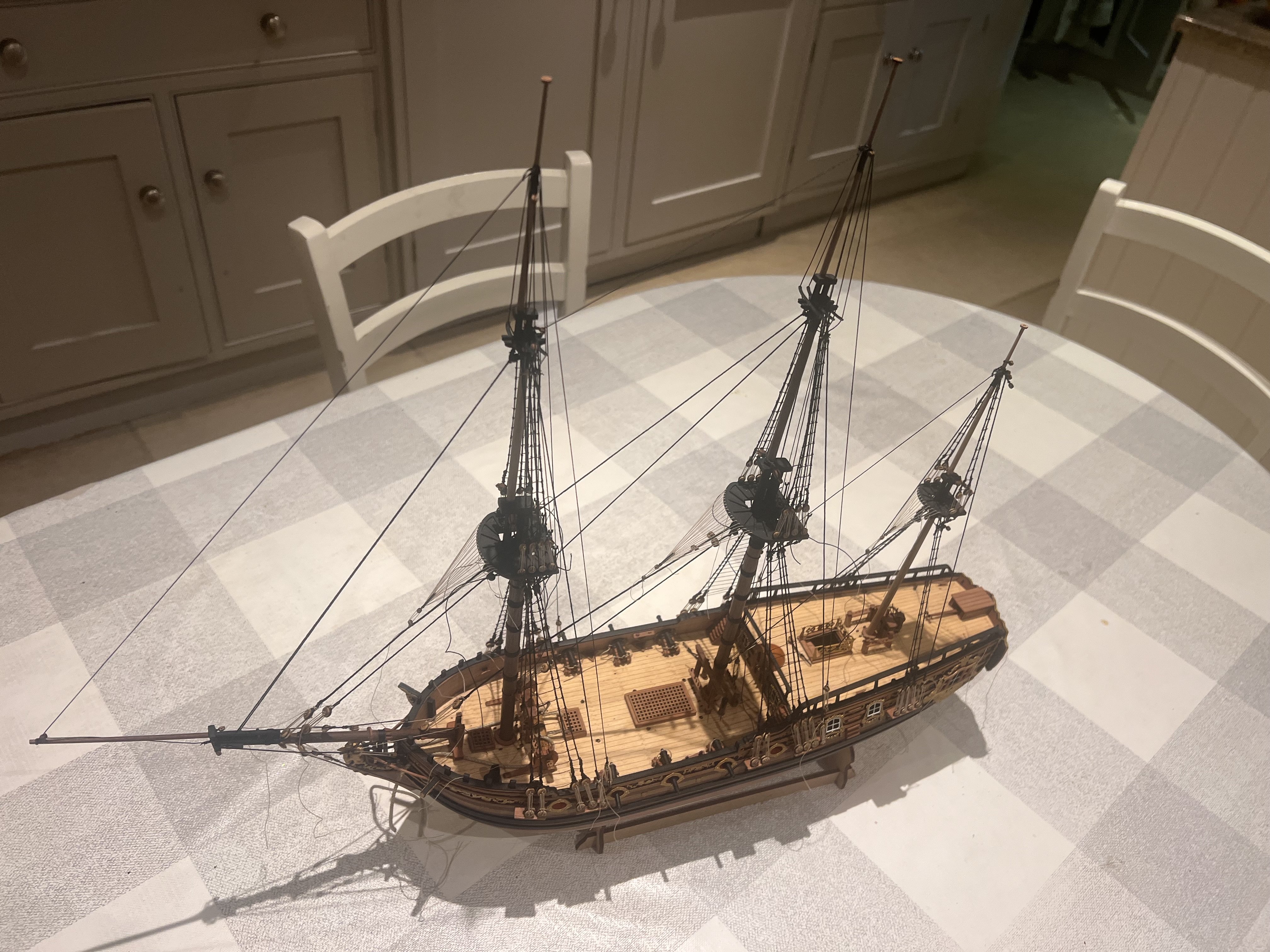

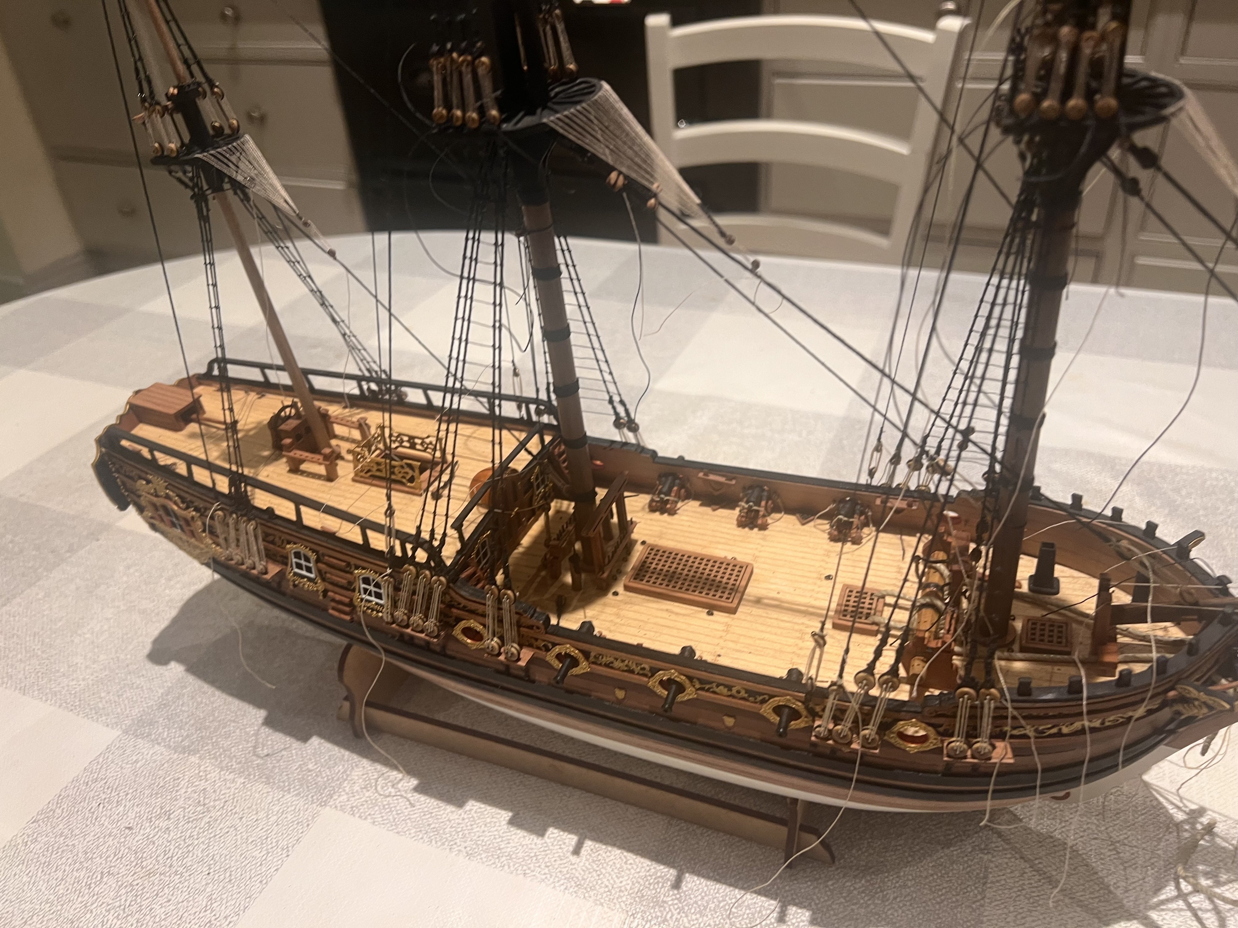

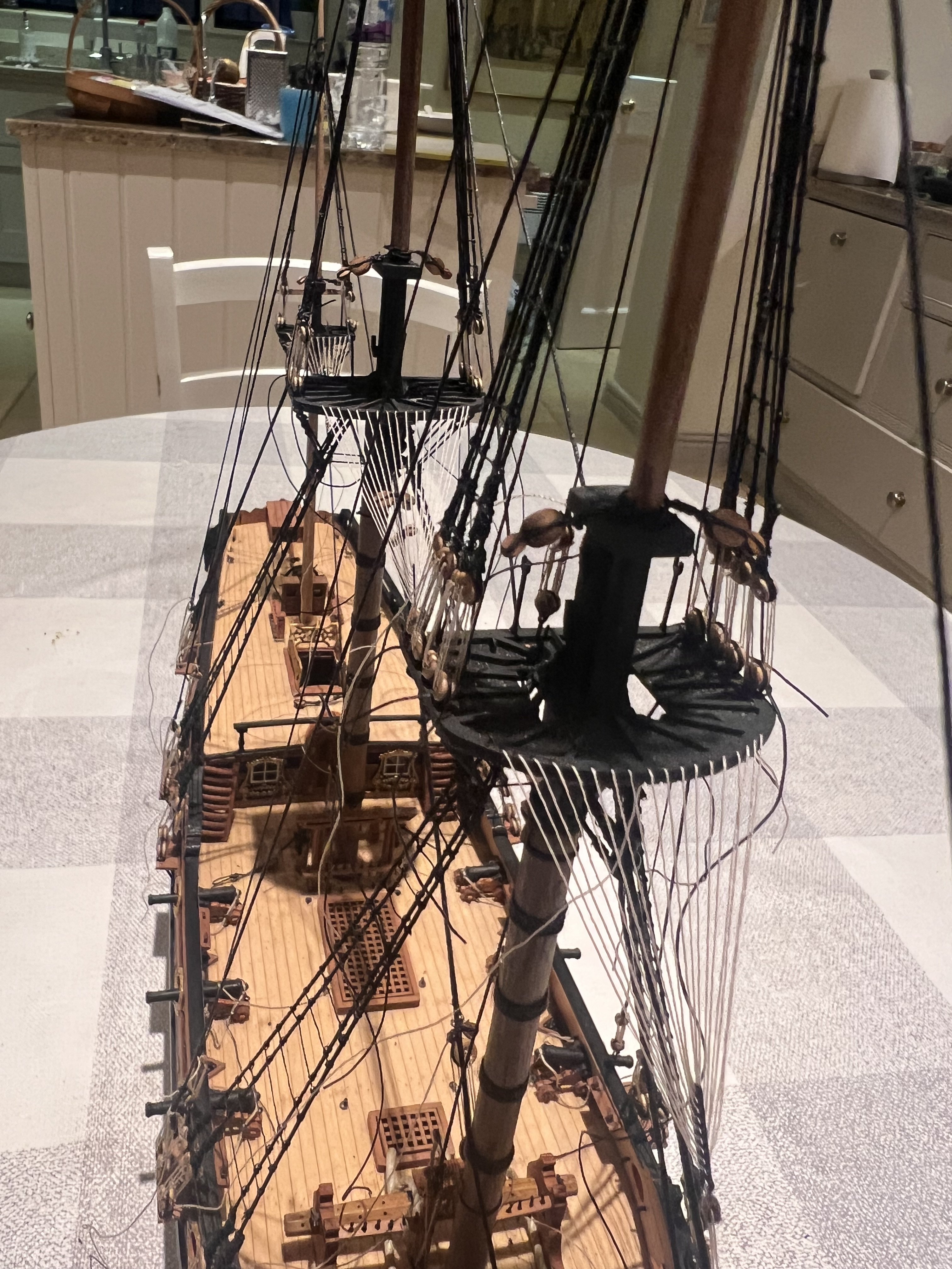

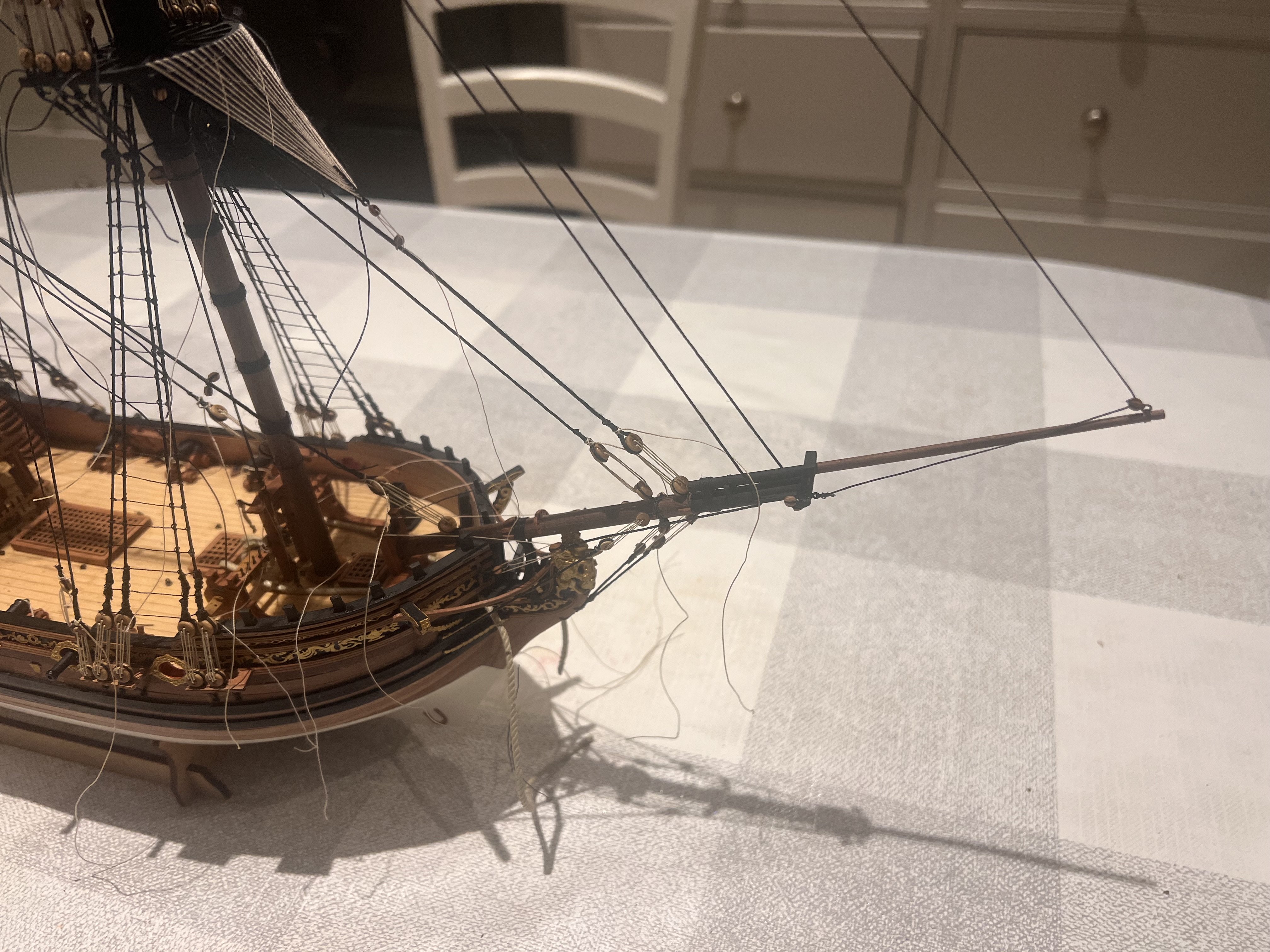

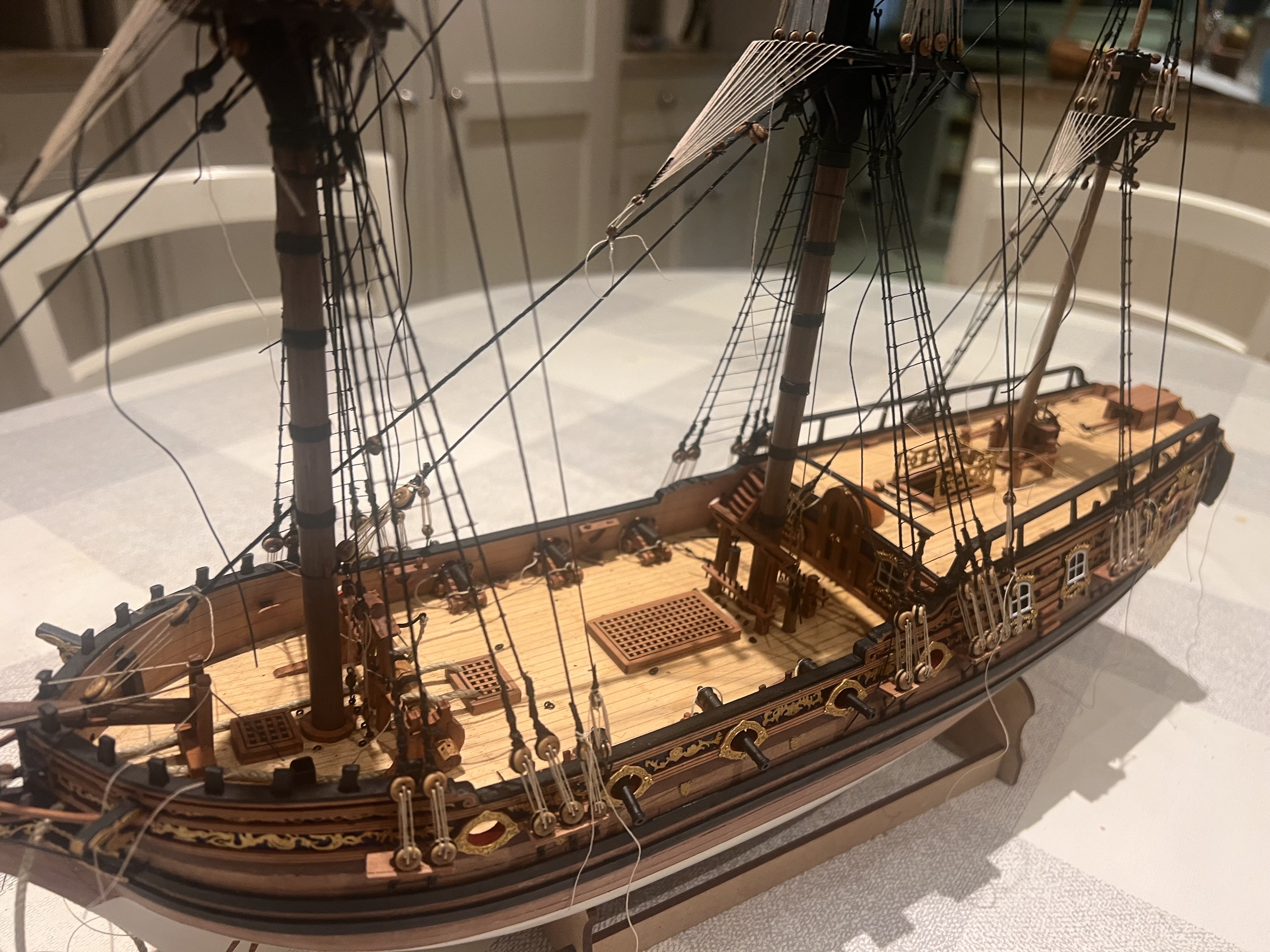

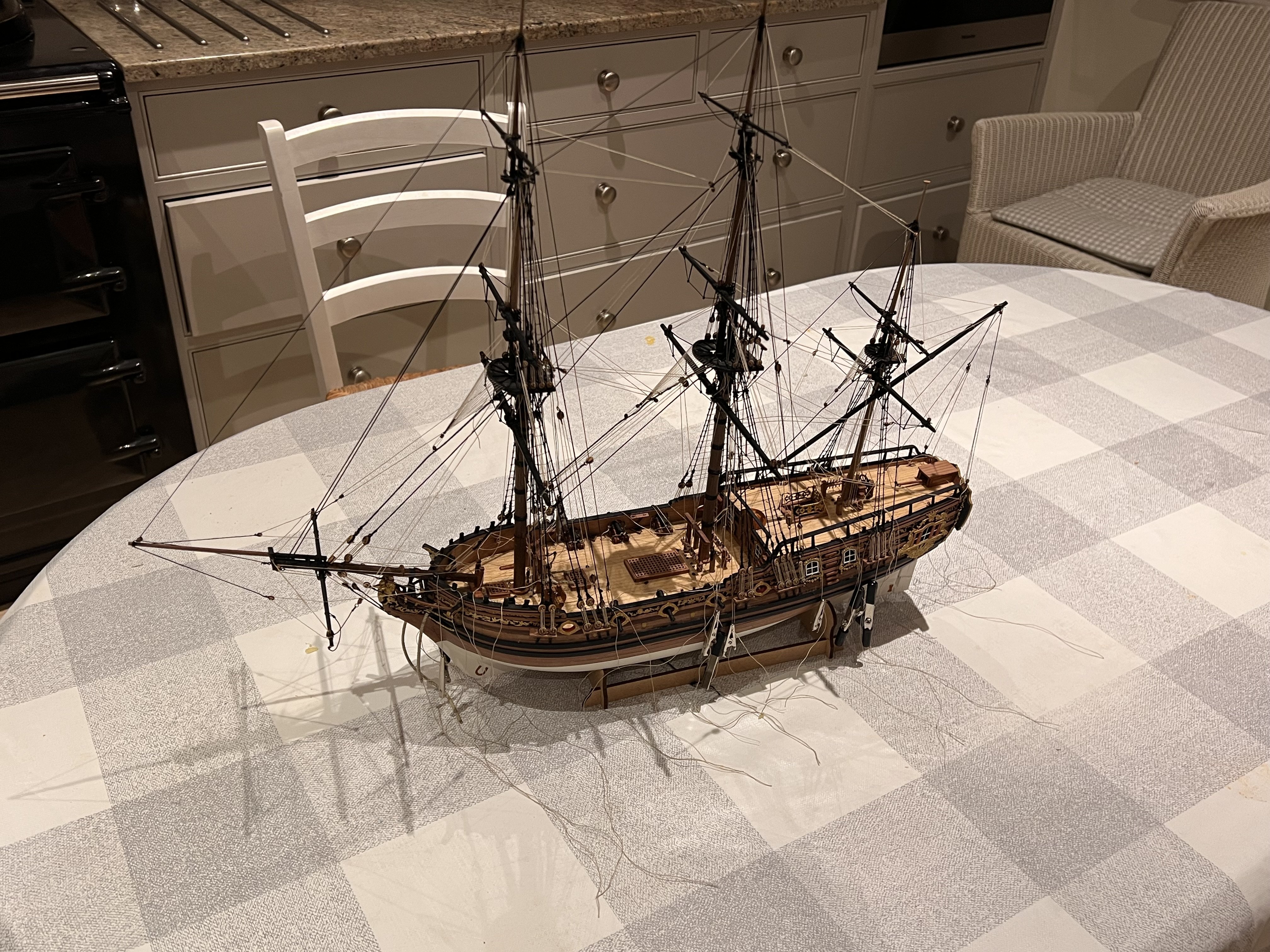

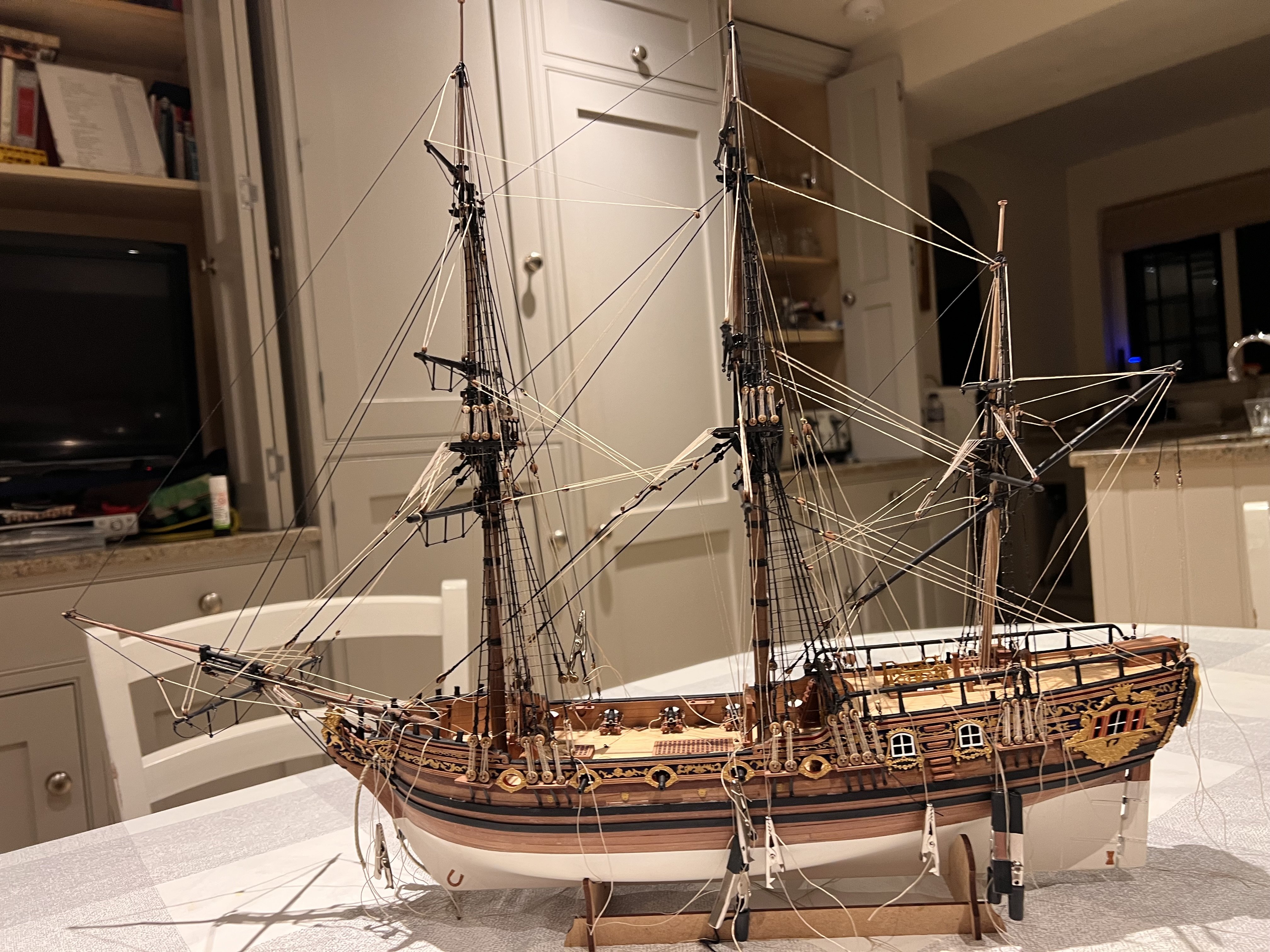

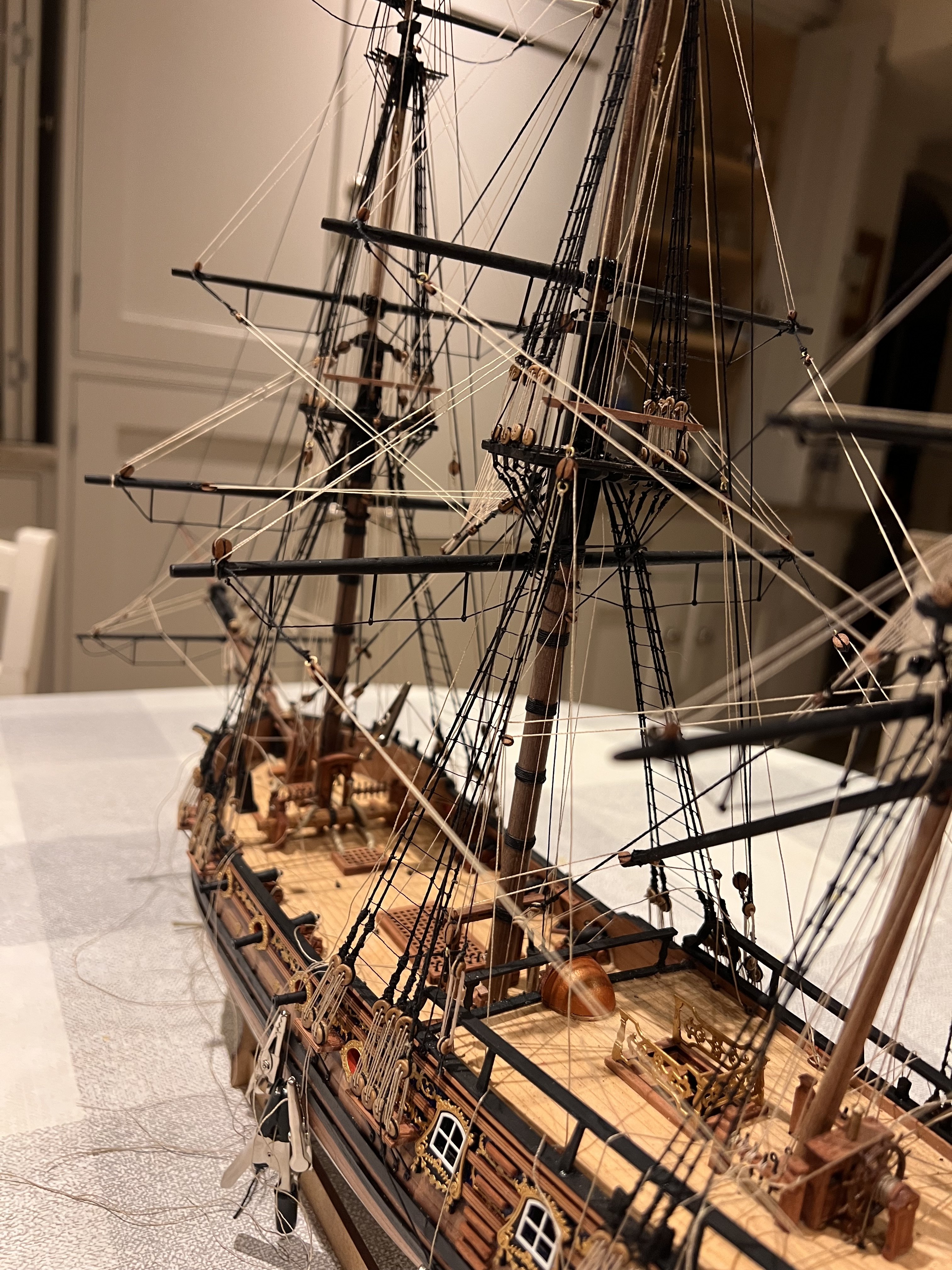

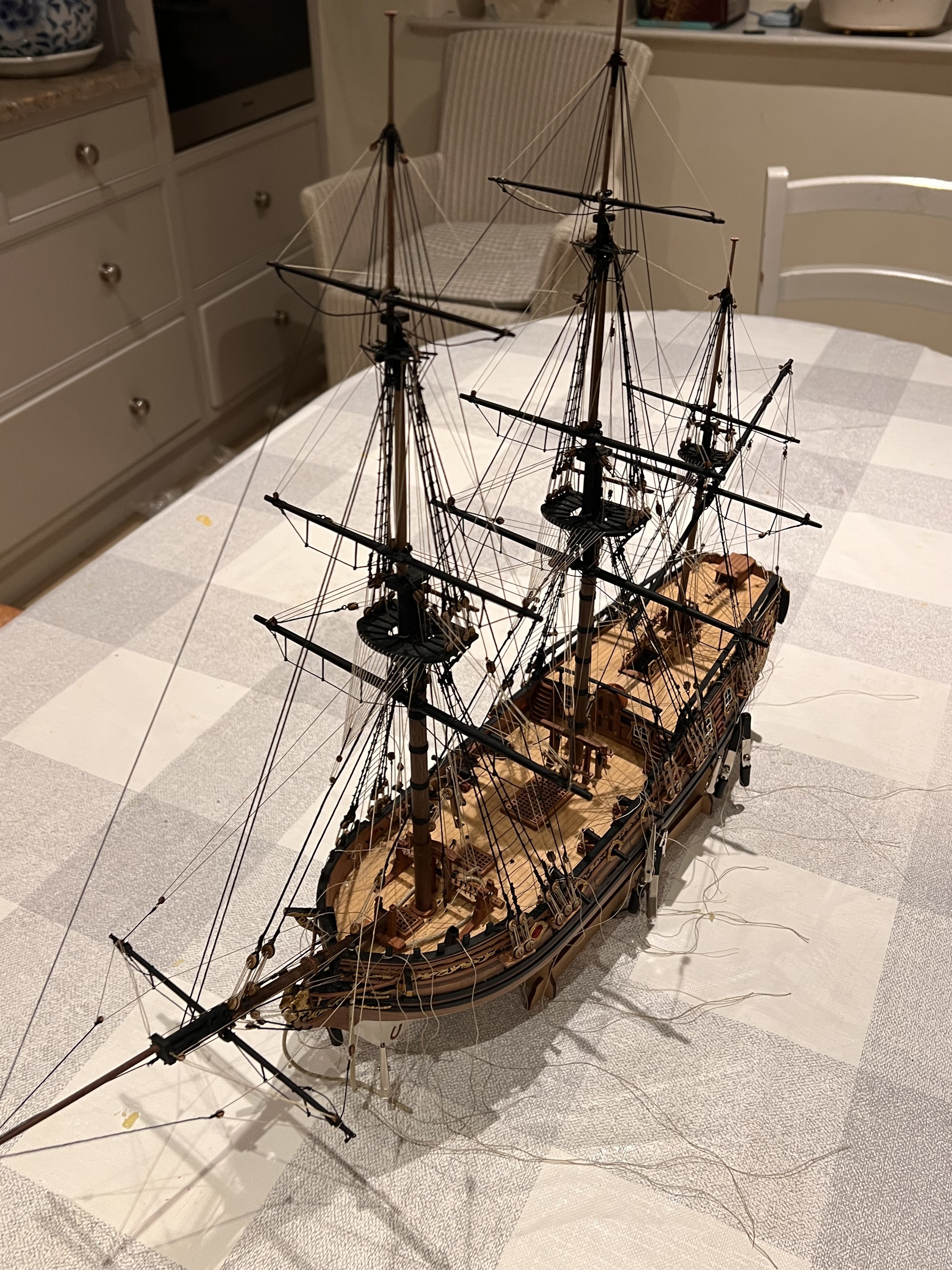

Progressing albeit still very slowly!
The lower shrouds are now fitted on all three masts together with futtock staves and catharpins.
I’ve just made a start on the ratlines for the foremast - surprised to find that I’m quite looking forward to doing these!
IMG_4263.thumb.jpeg.1f6e597187456eb8f3c3b9ac5cbe6468.jpegIMG_4261.thumb.jpeg.7d04f99d82ac9cfc919b14591088dfde.jpegIMG_4260.thumb.jpeg.b2db55ae1367cd8f946c2602f033c8b0.jpegIMG_4259.thumb.jpeg.91c8ba151c9c8cc099aecad3905e1cdf.jpeg

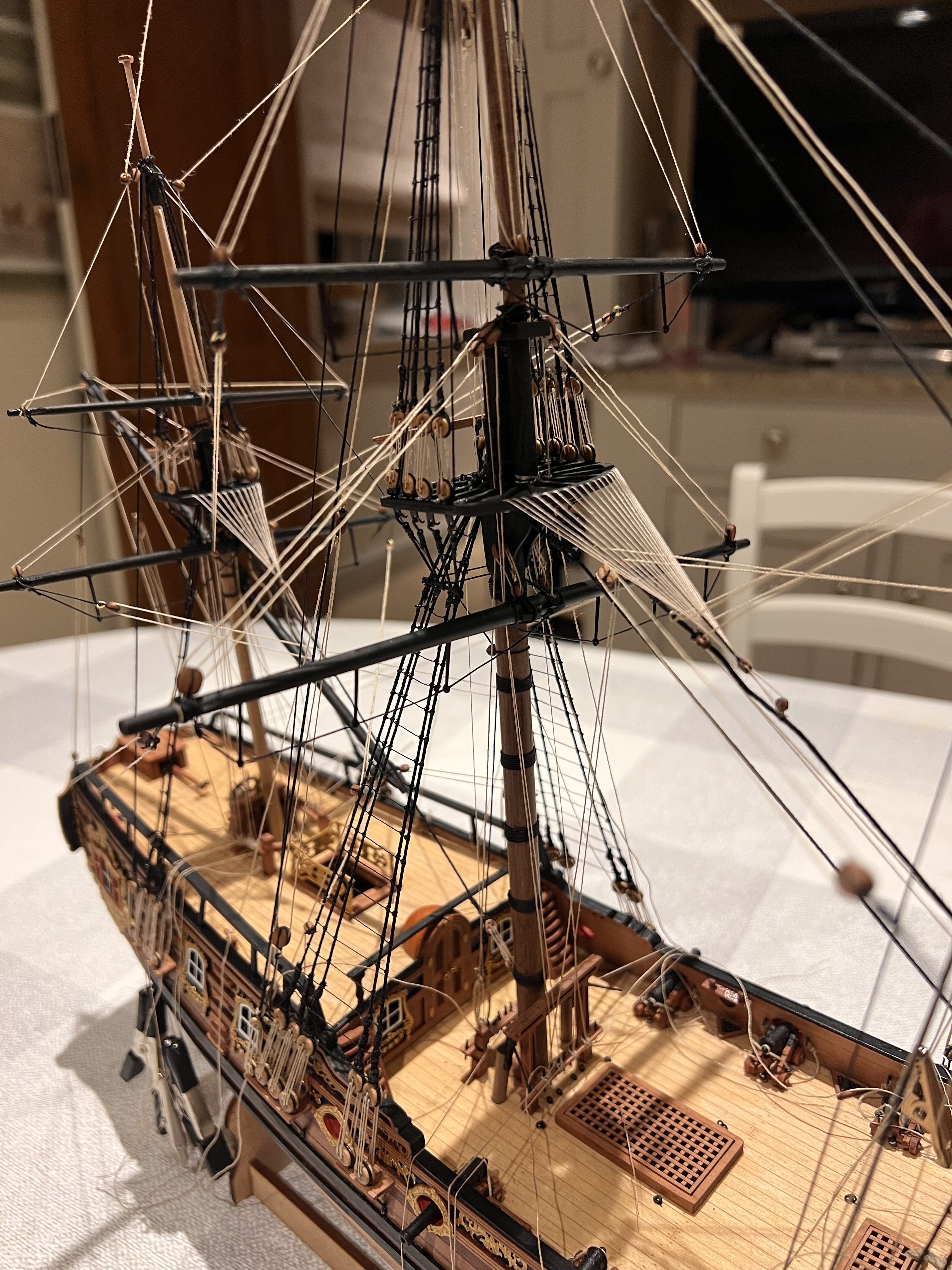

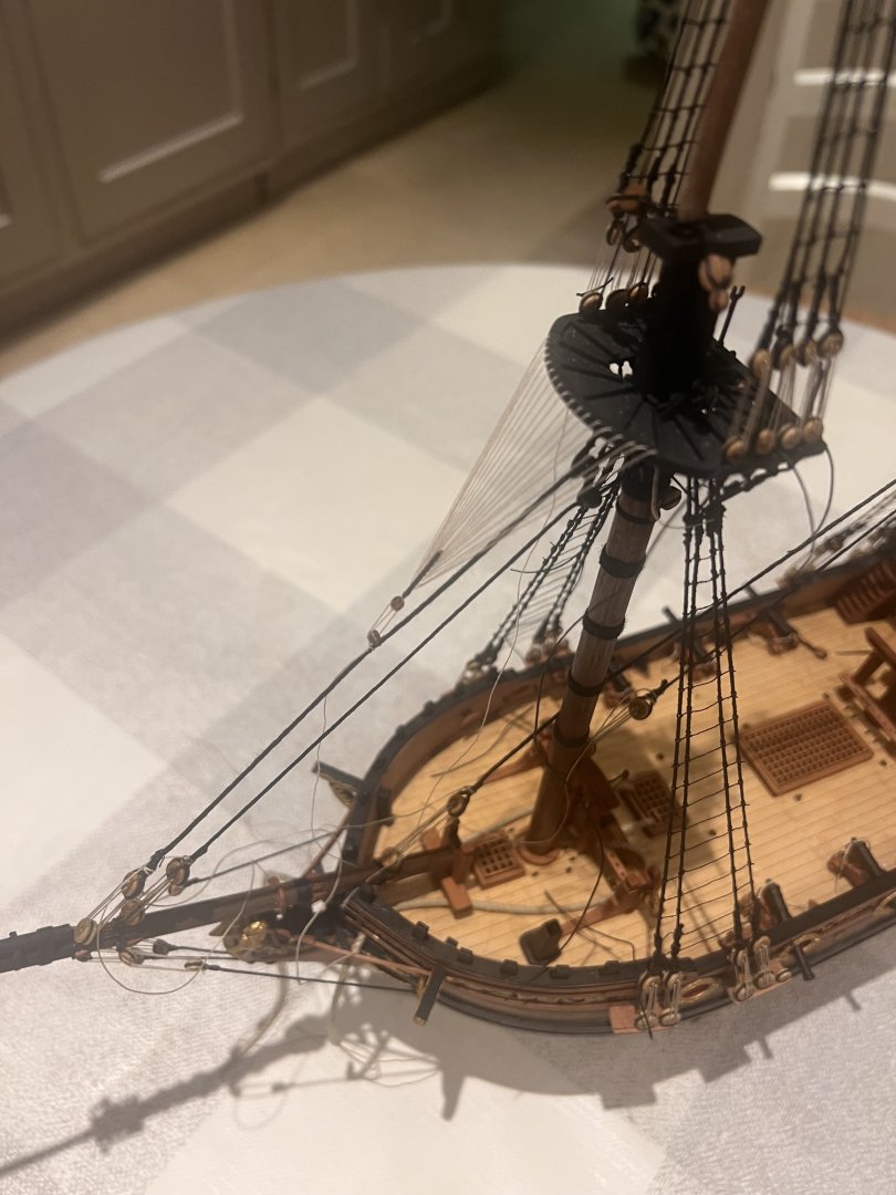

Duchess now has all forestays and backstays in place as well as all three crowsfeet.
IMG_5087.thumb.jpeg.b2b07f6ede599c7c6702d83a4fdeda47.jpegIMG_5085.thumb.jpeg.7c4371dfa308e4e49bfd18abff24770a.jpegIMG_5084.thumb.jpeg.bc9c89cdf33bb9c716795d72fbad6a60.jpegIMG_5083.thumb.jpeg.69a6c2d5db6dc78da48722c2c1bc6894.jpegIMG_5081.thumb.jpeg.a698413d658c2854883eec094a9bda0a.jpeg
Most of the stays are just tied on with the knots not glued, so quite messy with lots of excess thread everywhere and some lines need a little more tension.
I’m not sure whether to tie off, glue and trim all the lines now or leave them so they can be removed and adjusted when the yards and their rigging is added. It’s already quite a confusing forest of threads with the lines not trimmed, but access to areas such as below the tops is already quite restricted with all the stays, crows feet and shrouds in place. Any advice very welcome!
Duchess looks near completion, but I still have not made any of the yards so there’s quite a bit of work still to come. I doubt that I will have time to start making the yards on the lathe for a couple of weeks due to other commitments, but I’m looking forward to getting on with this last stage.

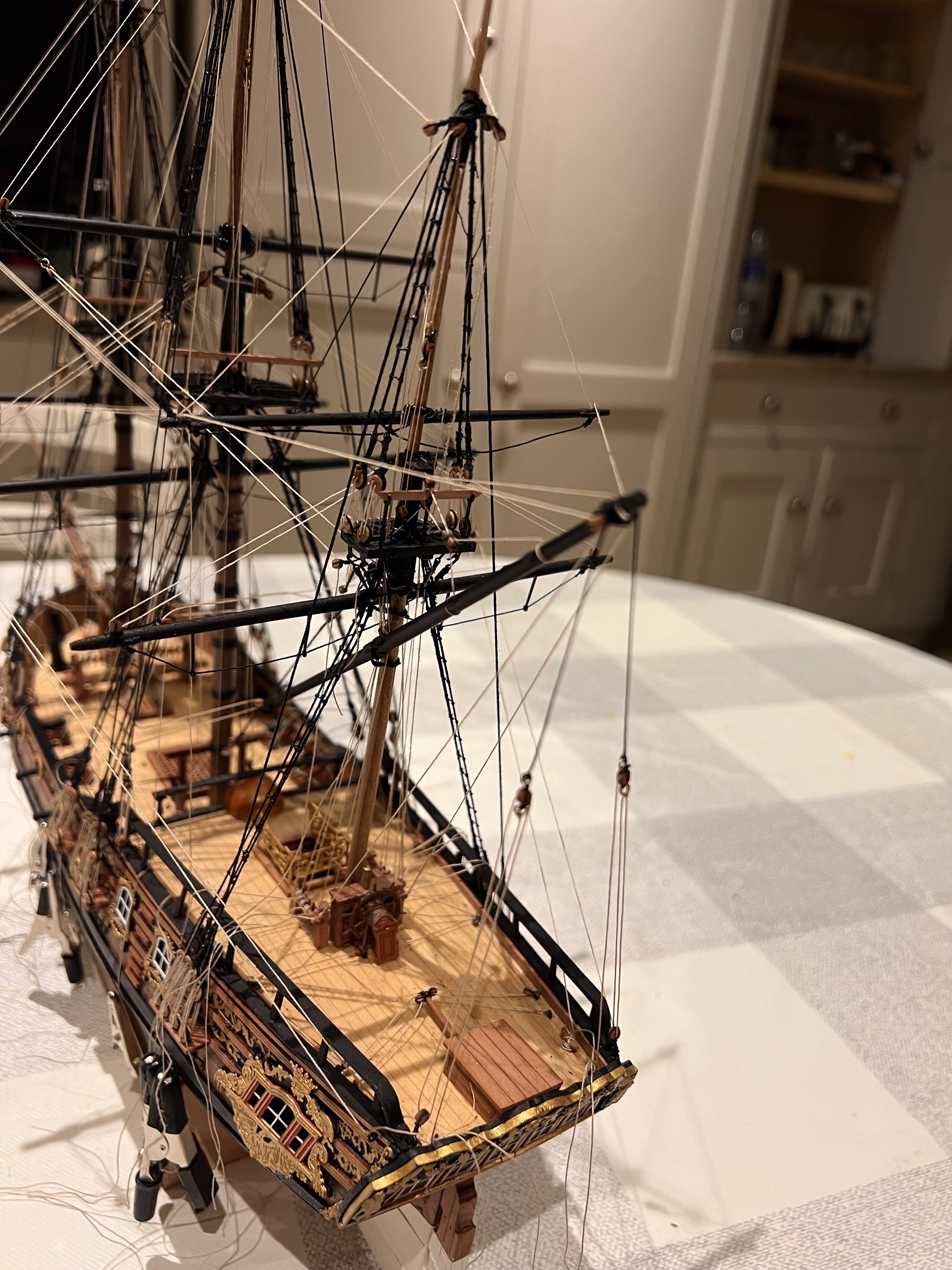

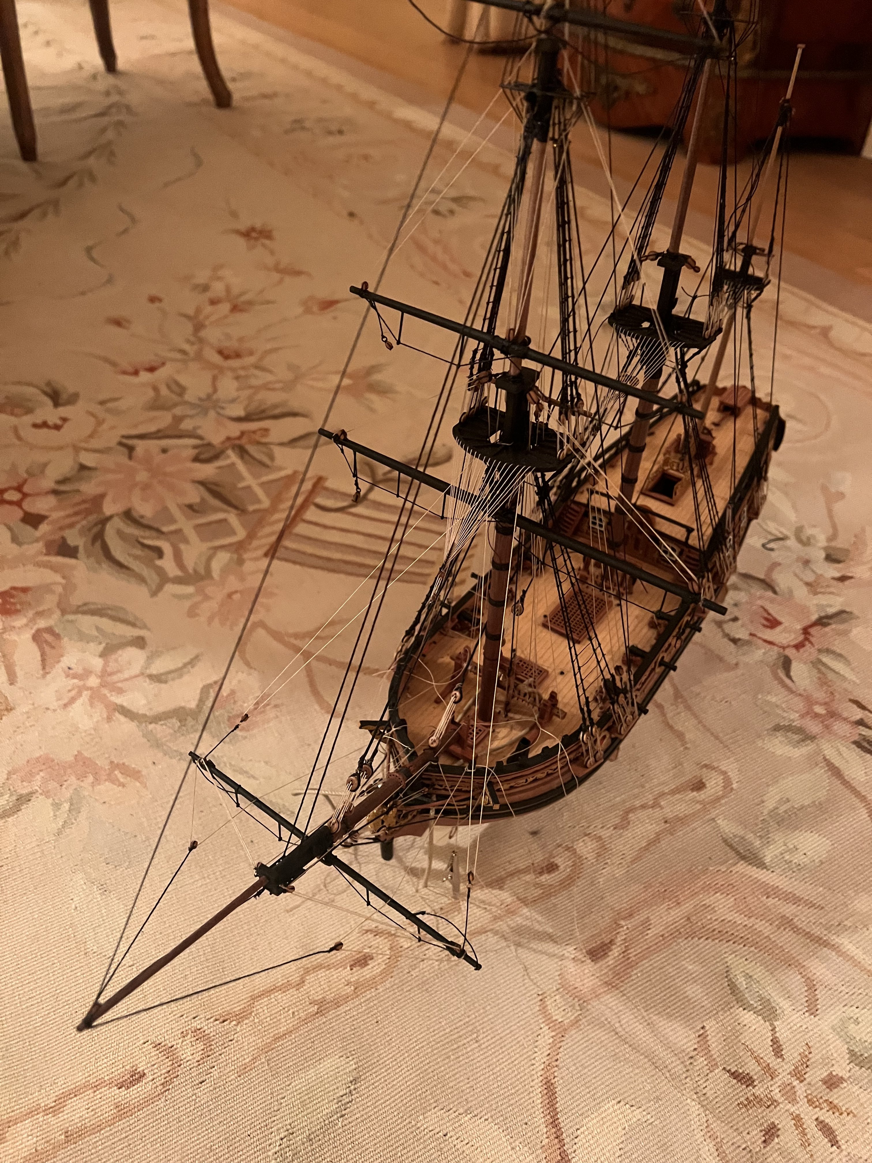

Rigging is progressing and the spritsail and foremast yards are fitted. I keep crossing lines and my rigging is messier than I’d like it to be. Even with Chris’s superb plans I often find it difficult to work out the path of each line through the bird’s nest of other lines. It’s all a learning curve still for me, with the plan to eventually build a frigate (Sphinx and/or Surprise) - hopefully by then I’ll have a good idea of the run of most lines.
IMG_5174.thumb.jpeg.0724a446abe88ddbf554b2353ff0a224.jpegIMG_5170.thumb.jpeg.ab2947f53e32ceaf4078e6a37e31e508.jpegIMG_5169.thumb.jpeg.2da1d5eaef7f6ce5c5a7c5e8377ded8c.jpeg
The foremast and yards are mostly rigged but I haven’t added yard braces yet as they’ll get in the way when working on the main mast yards.
Still to make the main and mizzen yards.

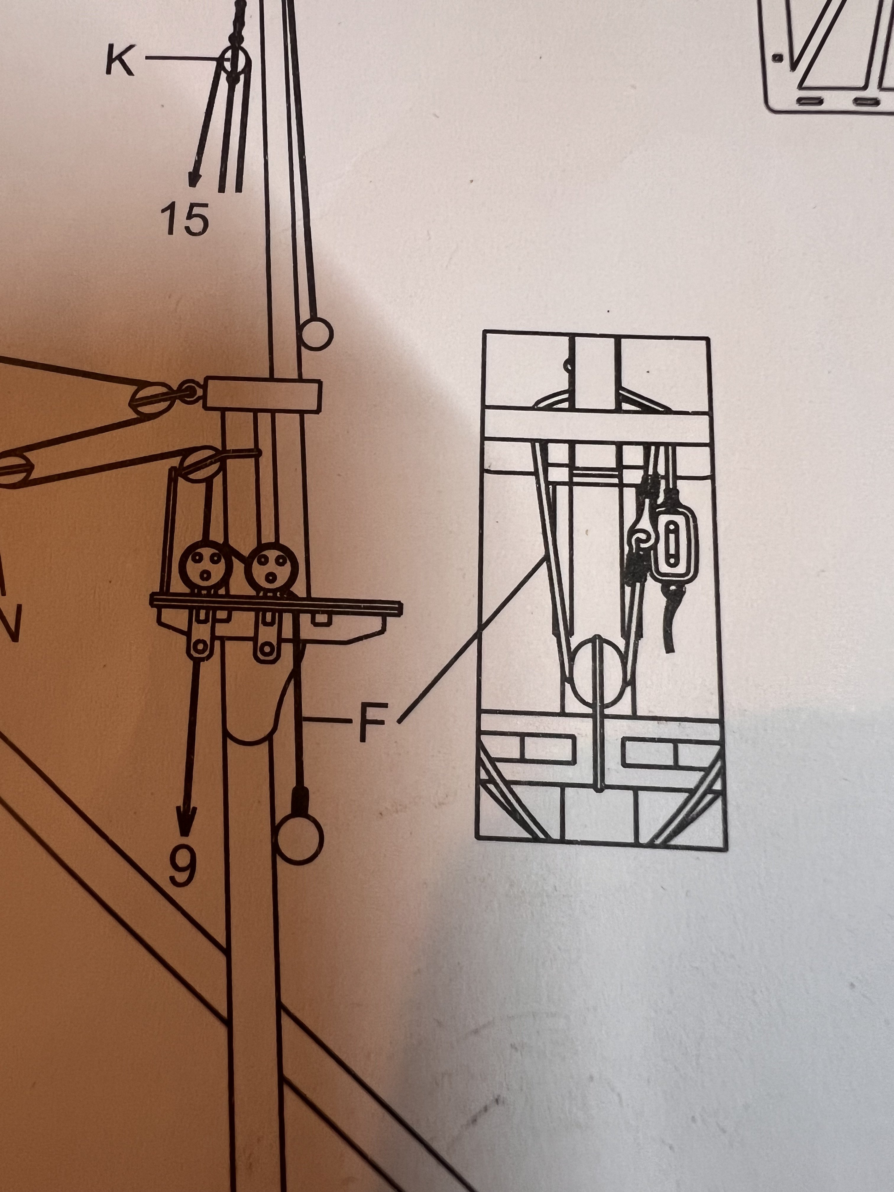

Please could I have some advice.
I have rigged the fore and main masts except for the yard braces, I’m now onto the mizzen mast and trying to understand how the jeers work for cross jack yard. It looks to me from Chris’s plan that the line just loops around the base of the mizzen topmast and doesn’t go through any blocks - is that correct? Where does the jeers line start - is it just tied to the mizzentop? Anything that could help me visualise this arrangement would be hugely appreciated. IMG_5326.thumb.jpeg.a8ab8e02796a5ba6ed56ce2cd3e93b3c.jpeg
I’ve trawled through all the build logs on MSW without success and the Peterssen book does not cover a cross jack yard with lateen yard below.
Thanks again.

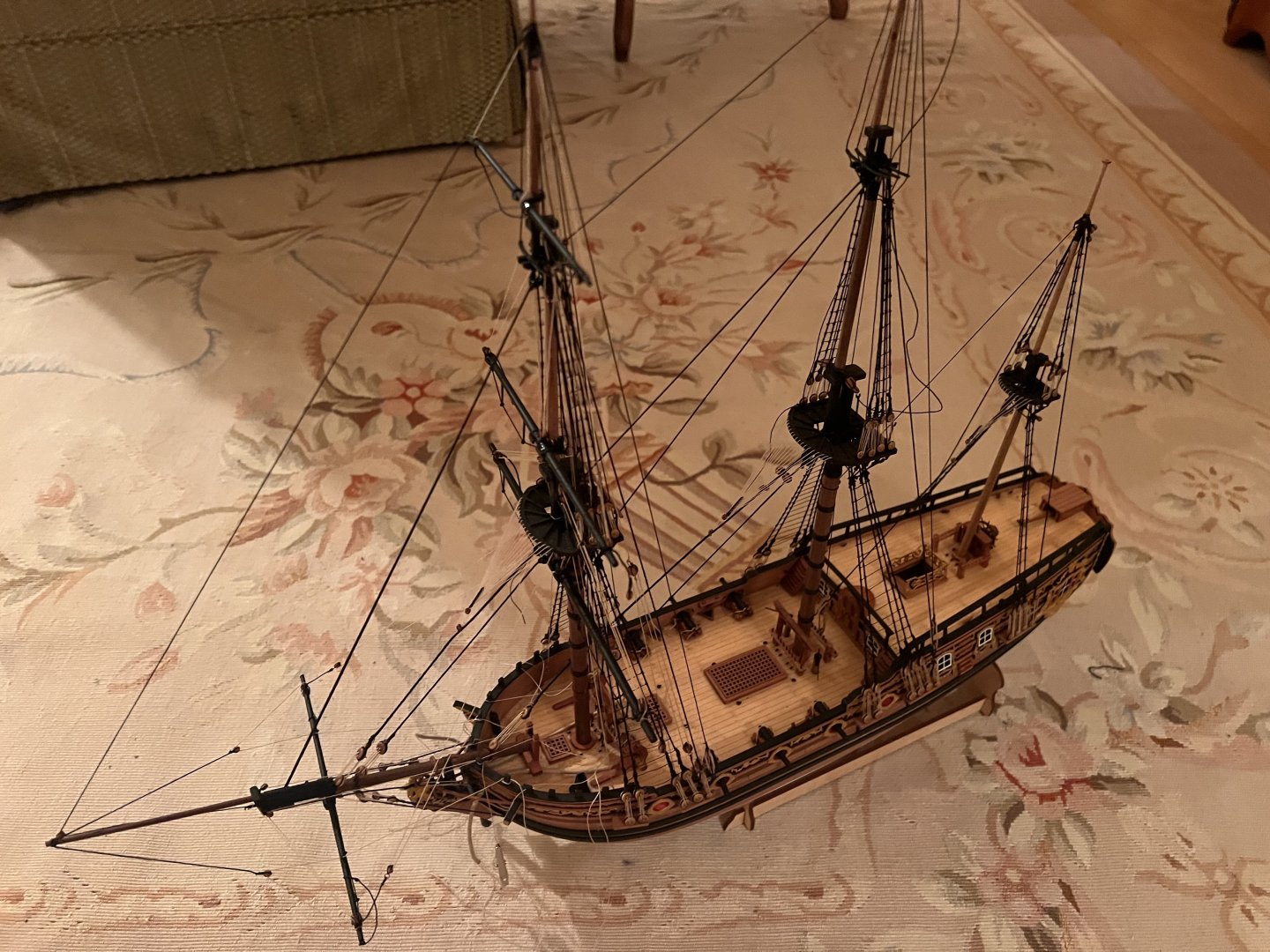

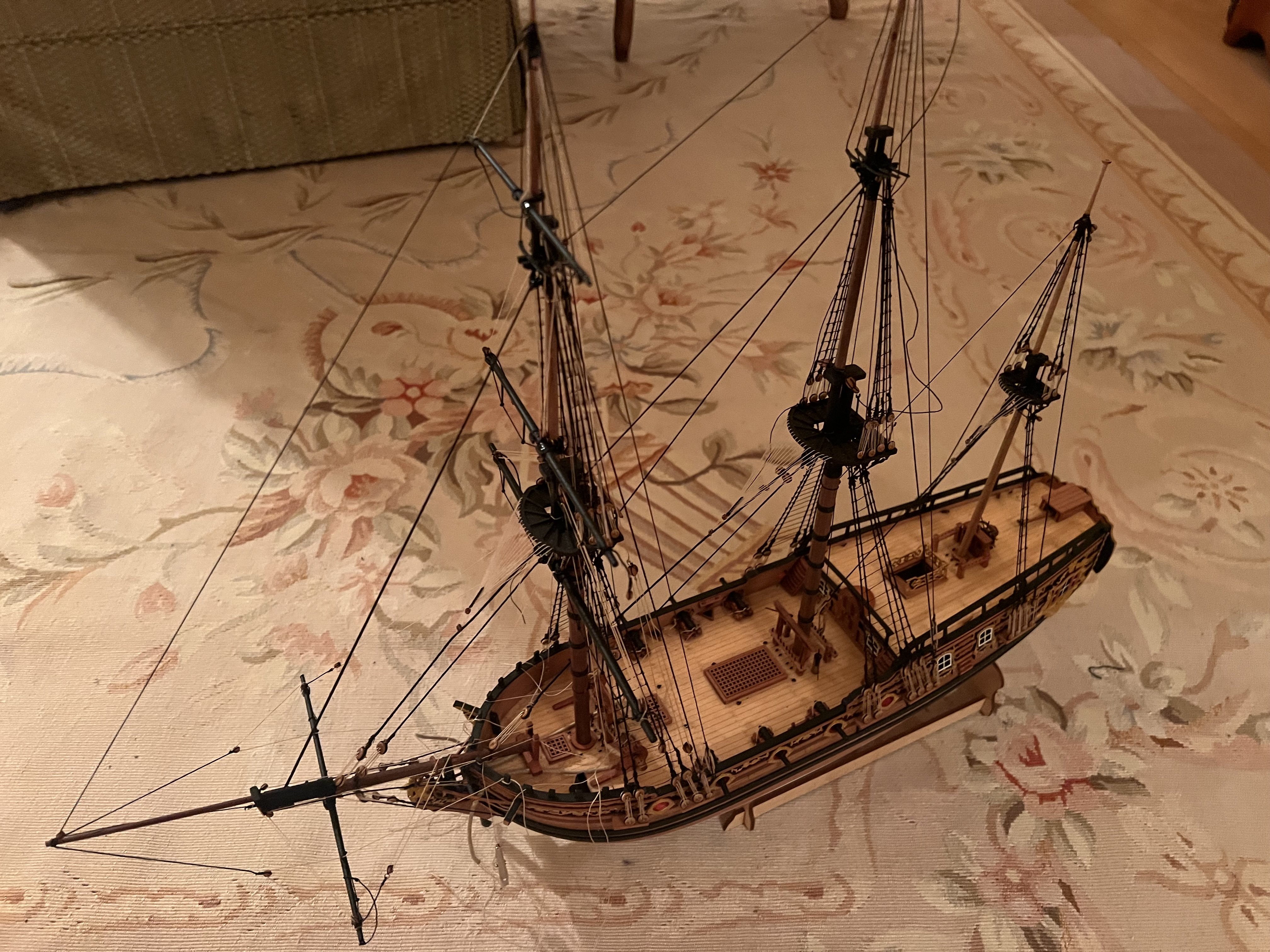

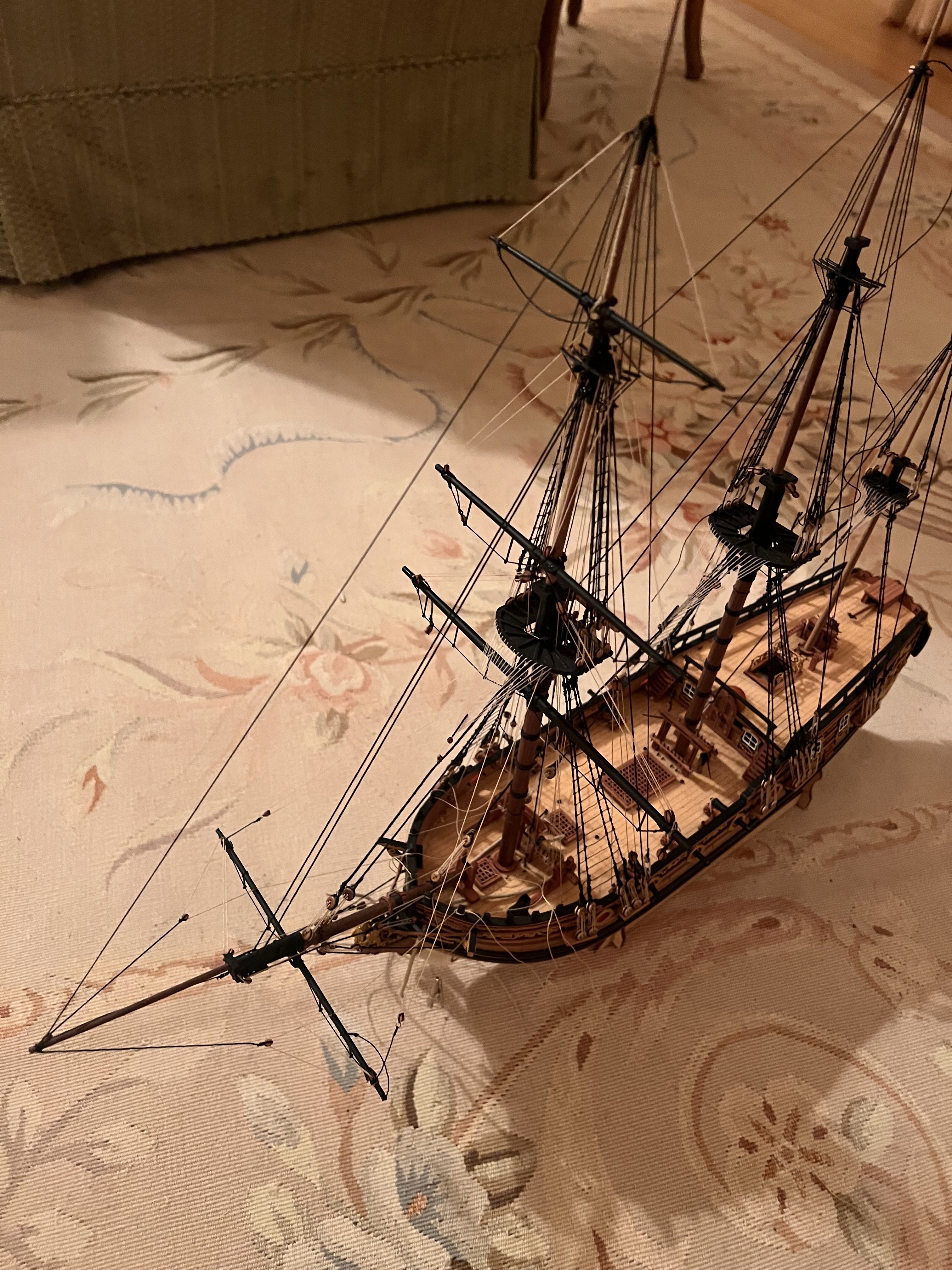

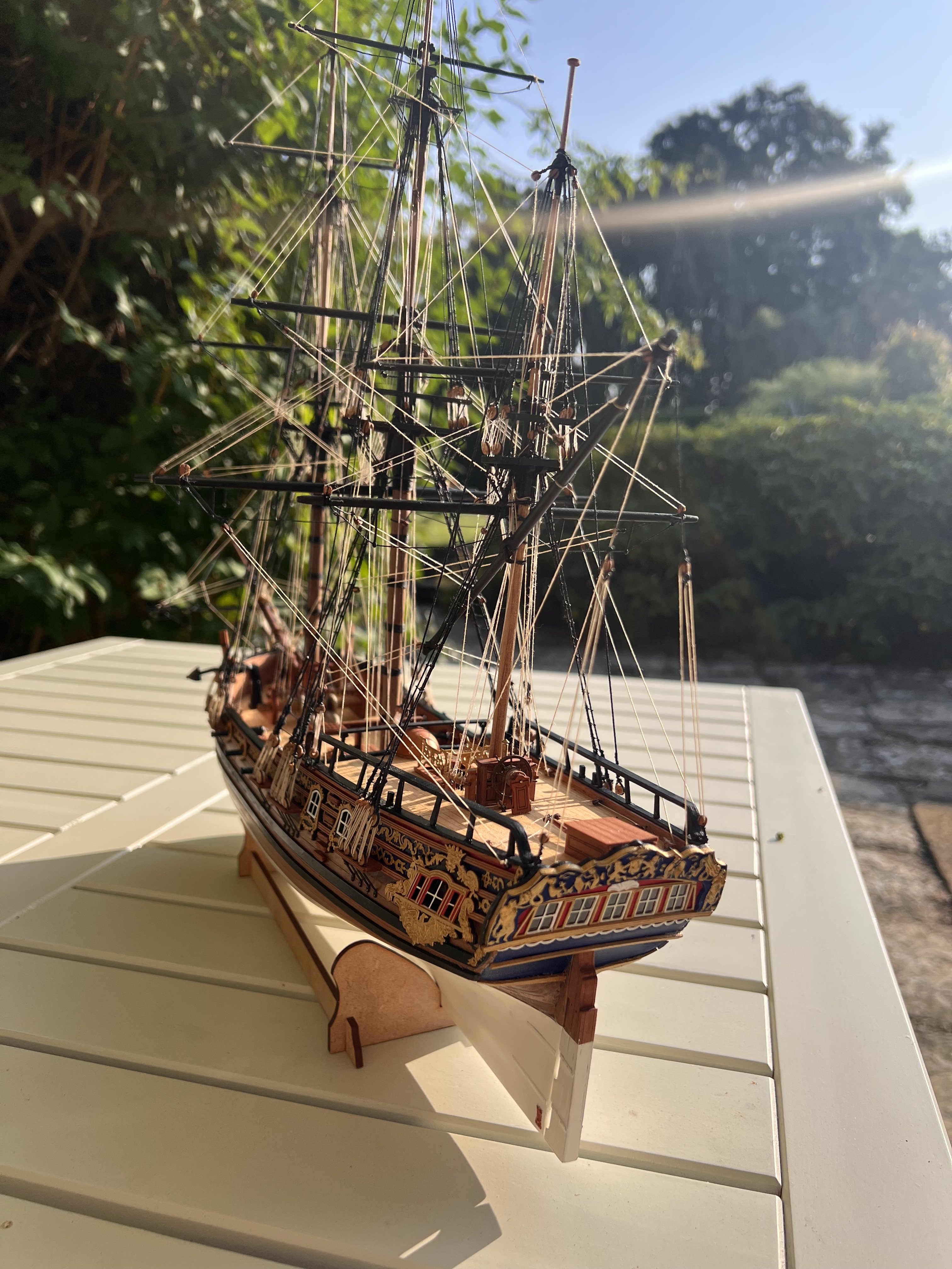

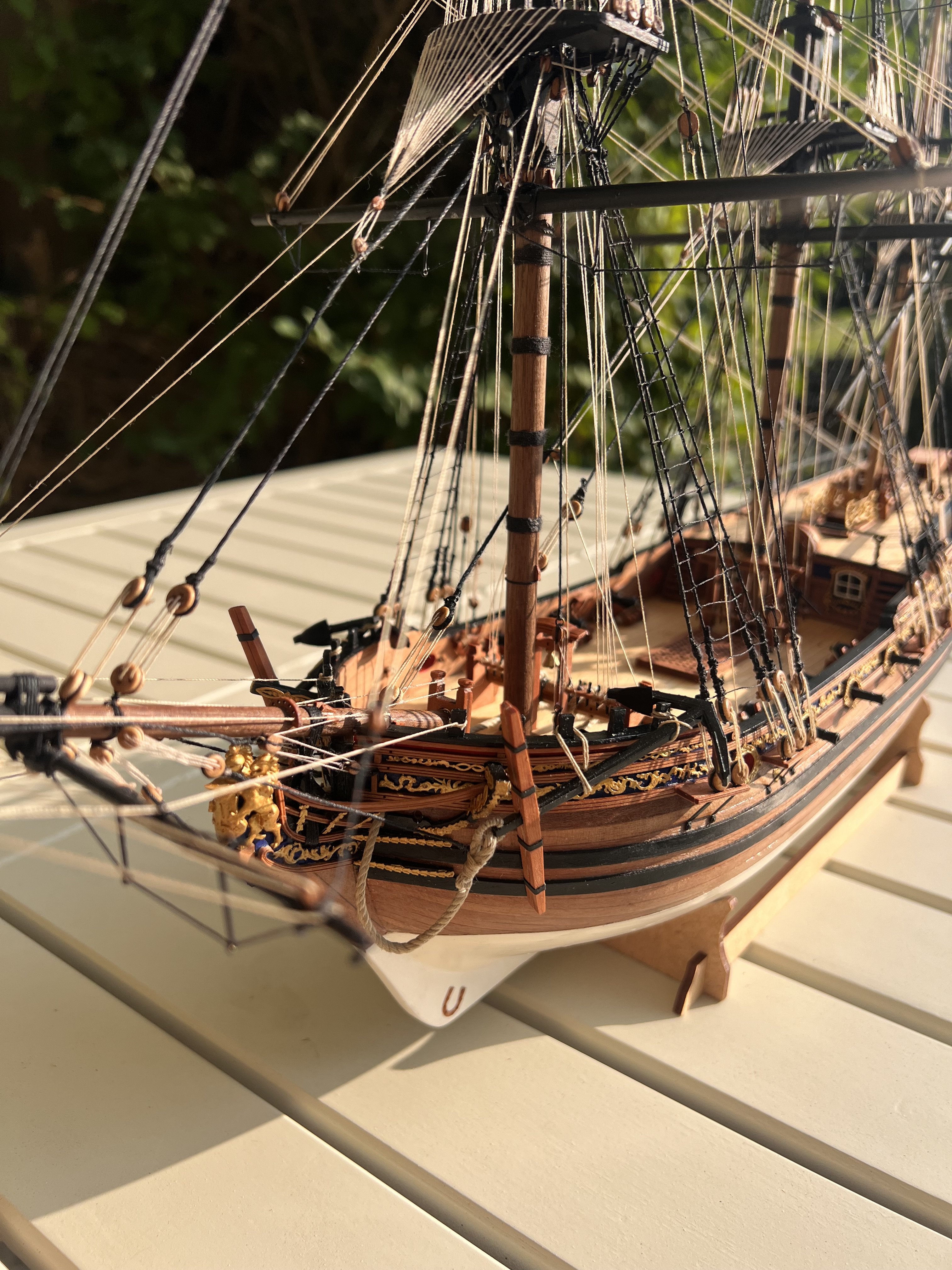

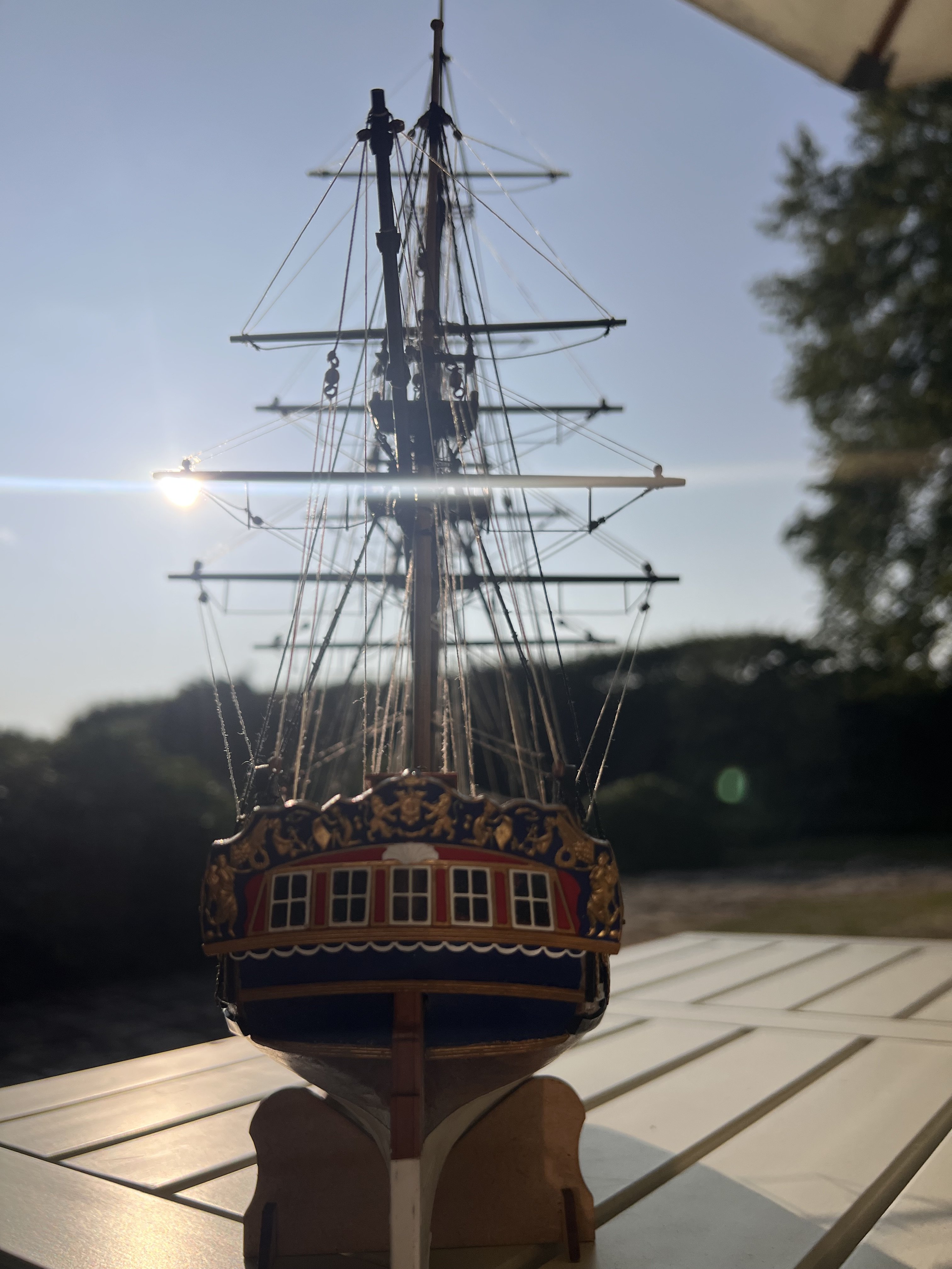

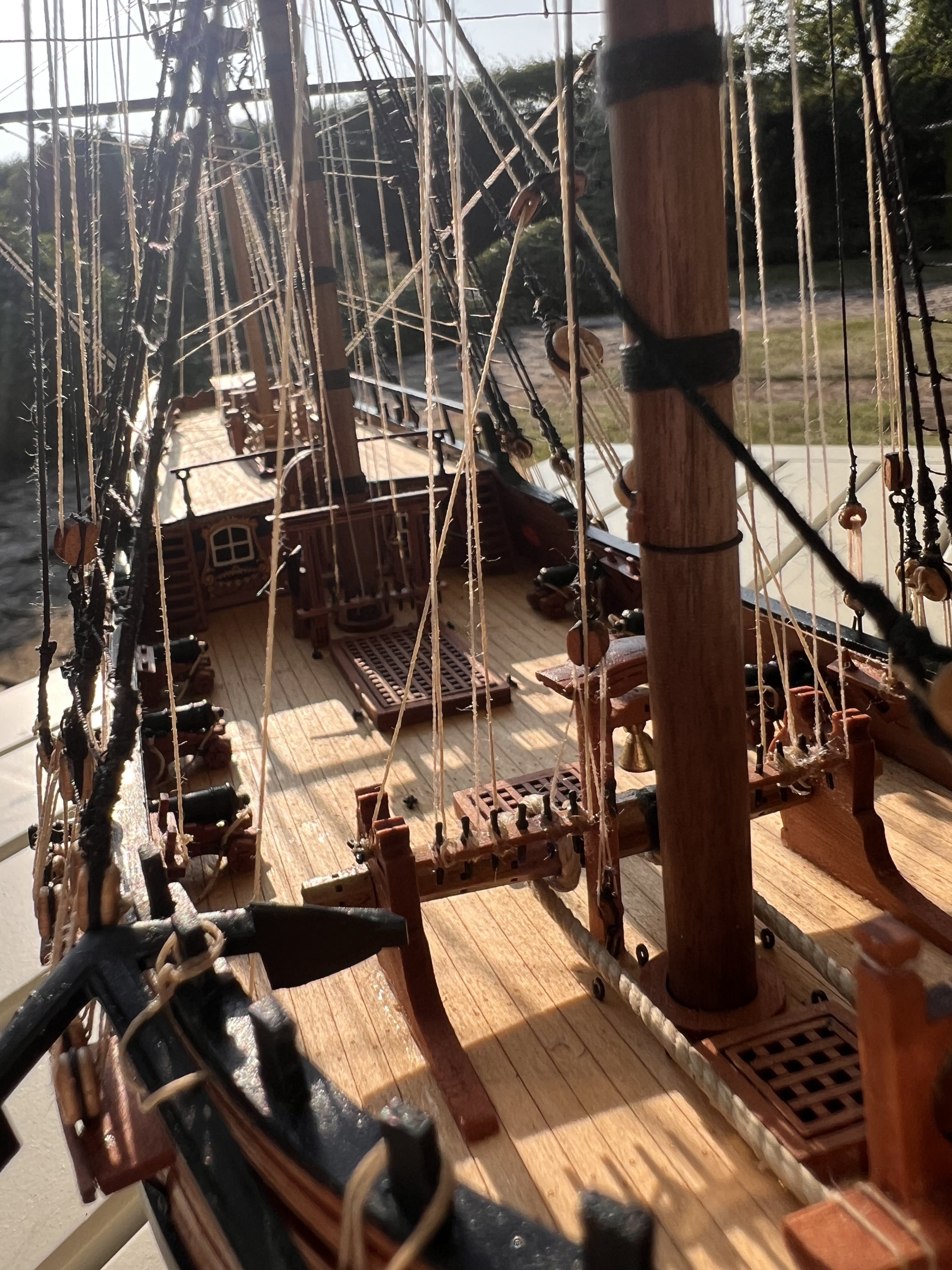

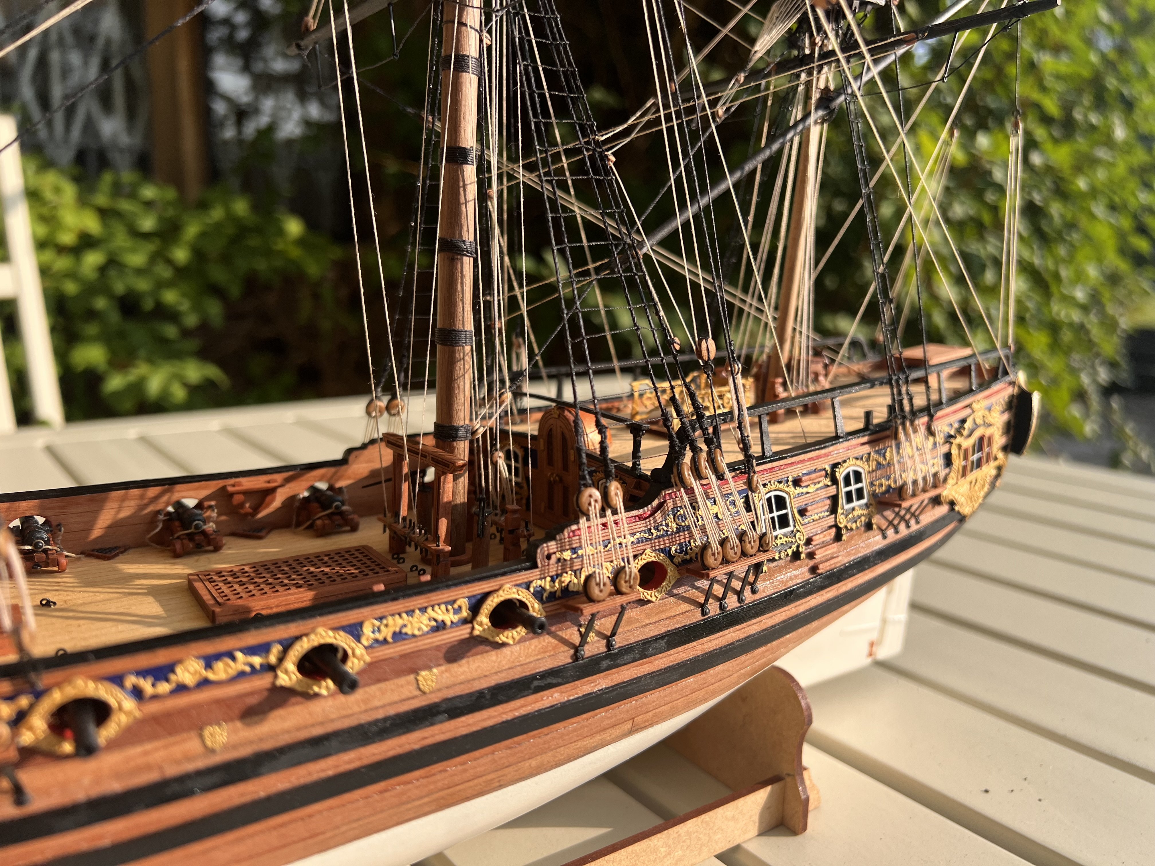

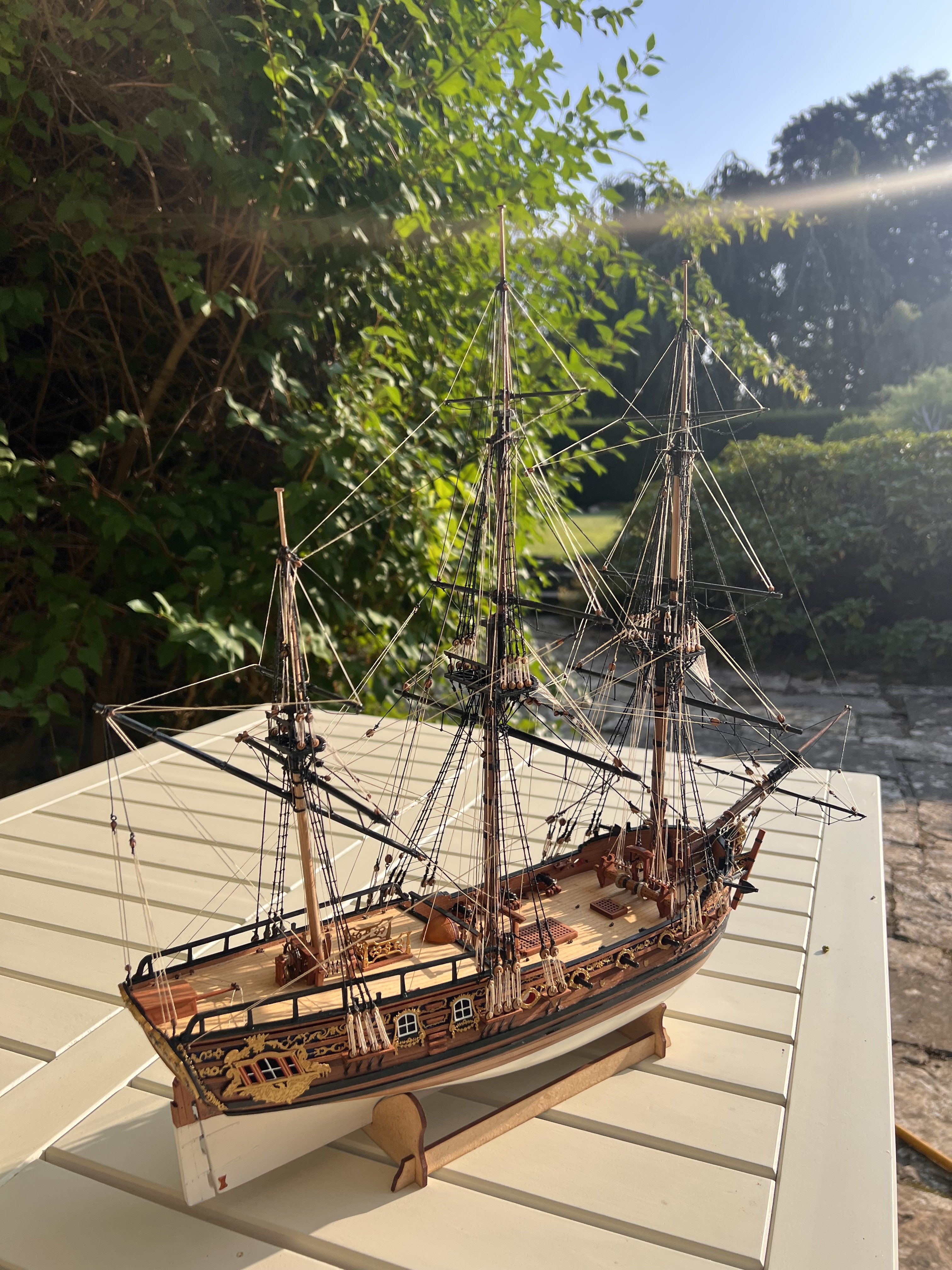

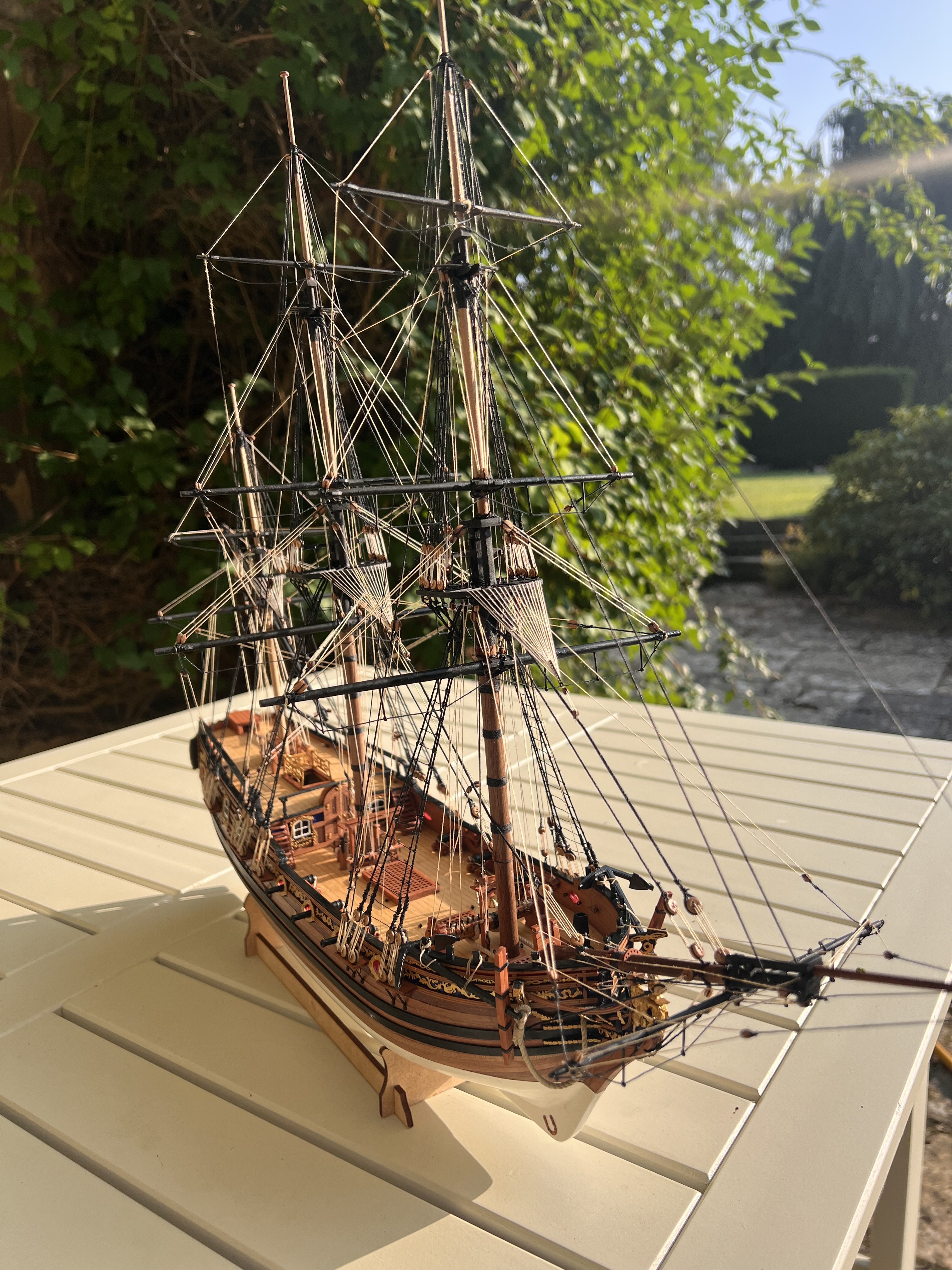

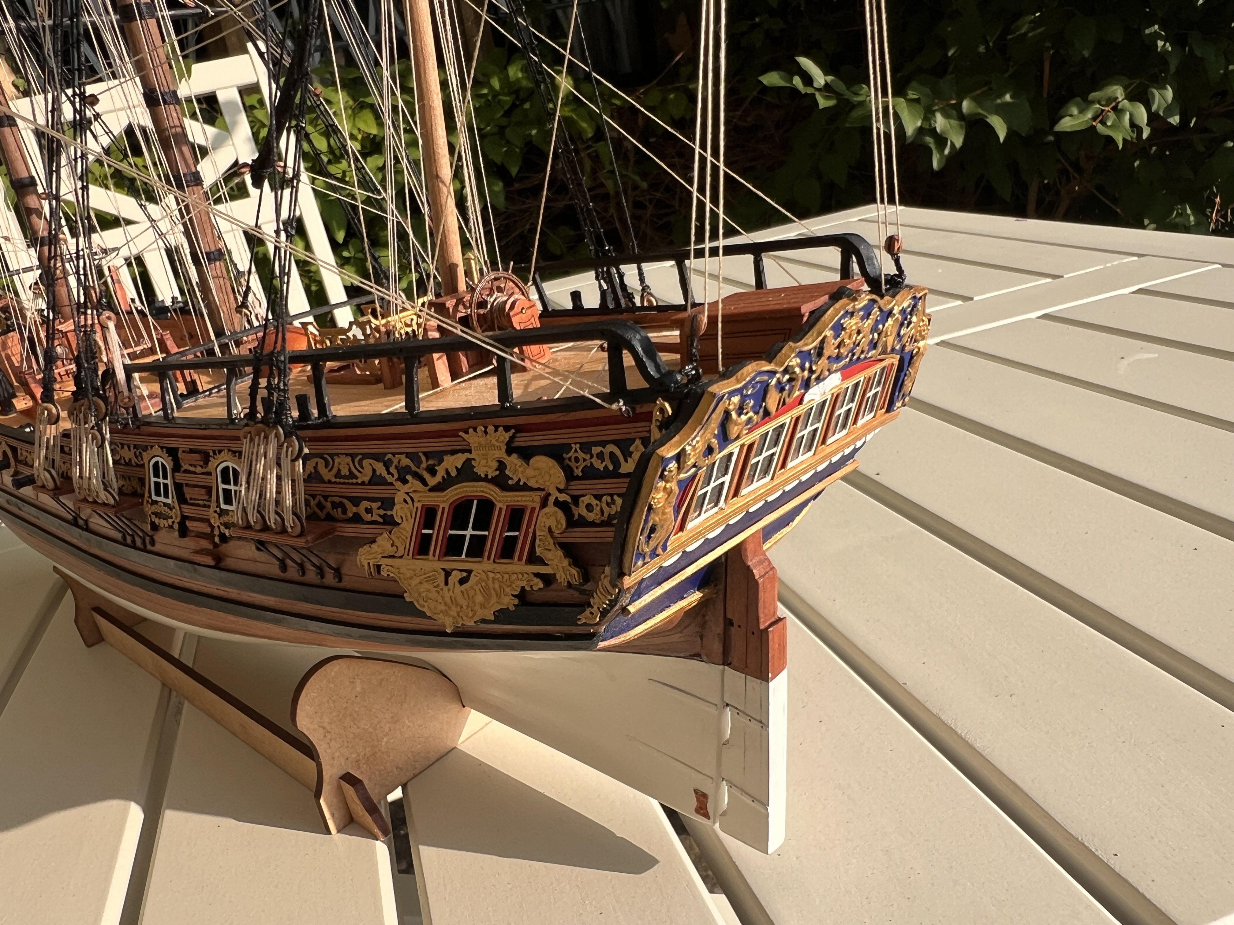

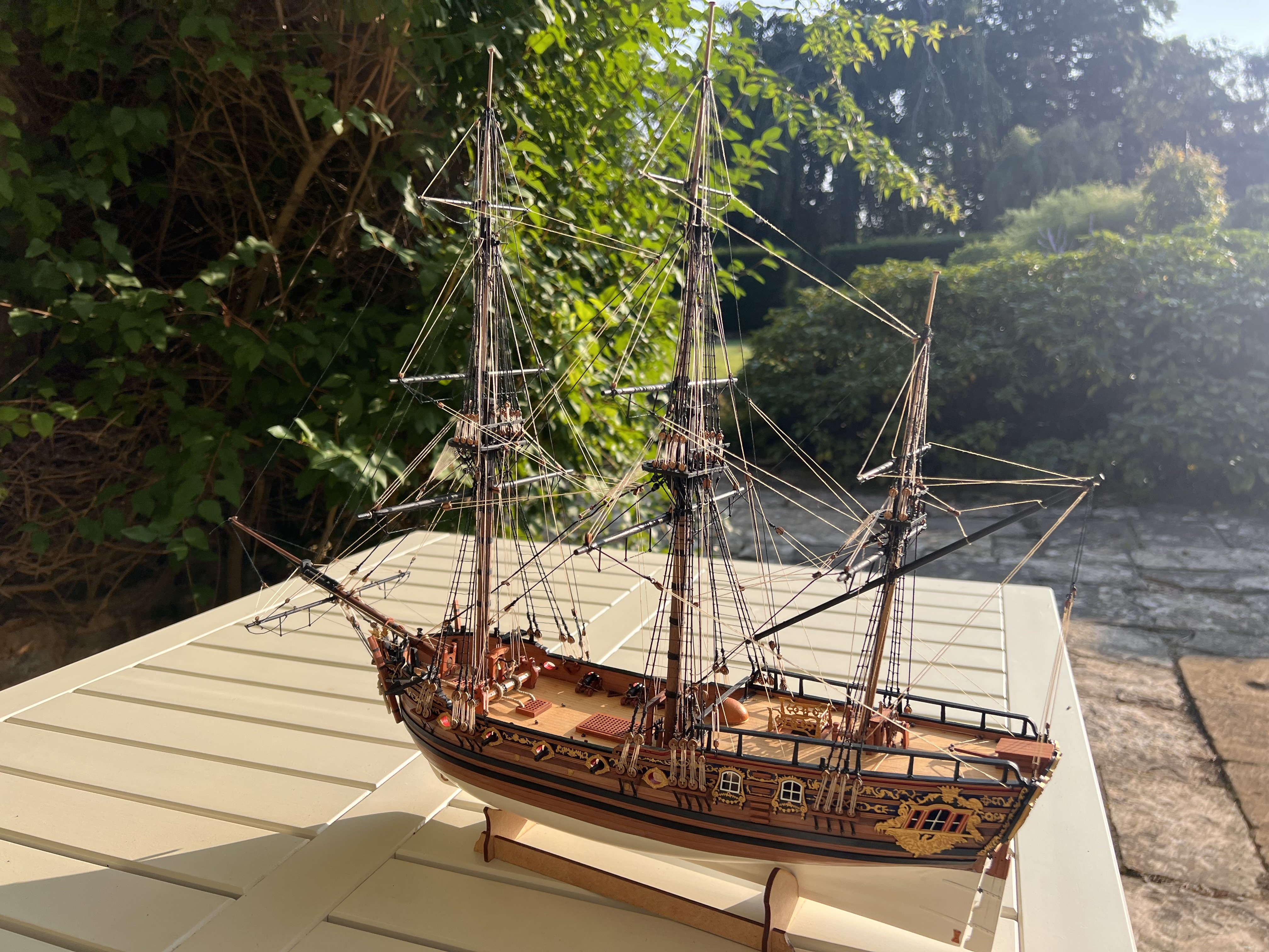

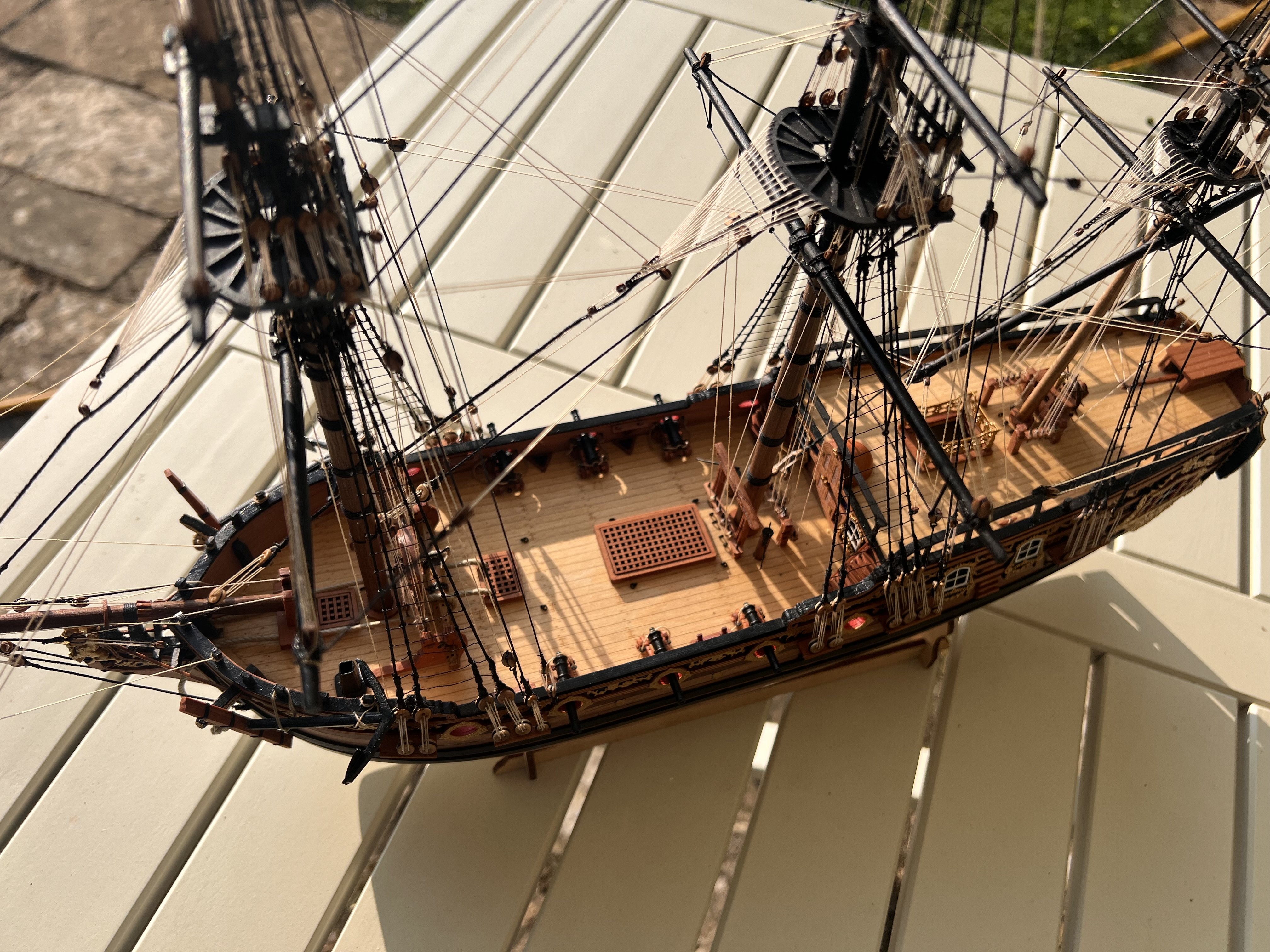

Work in the shipyard has continued very slowly due to the lovely weather we have been having in the UK, as well as busy work.
All the yards and rigging lines are now in place but most of the lifts and braces are not tied off yet so I can adjust tensions and ensure that the yards are aligned. It’s a fiddly business, as I tighten one line a couple of others seem to slacken, will take me a while to balance it out.
I also need to go through the rigging and touch up painting, in particular I used unpainted brass rings attached to blocks which need to be painted black where possible, should have painted these black first (or just bought black ones next time!). Likewise the parrel beads are shiny black plastic and need to be dulled down with some matt varnish.
Duchess continues to be a big learning curve for me, entirely positive. But I’m not absolutely sure whether the run of each line is exactly correct. The lines bunch going through the tops and whilst I know which is which they do tend towards a bit of a tangle, especially on the mizzen mast with the cross jack and lateen yards just below the top.
IMG_5417.thumb.jpeg.c6ee53db50744b317bca4d8713ef2788.jpegIMG_5430.thumb.jpeg.4216d63647180c10361dbc524b59fa0c.jpeg
IMG_5416.thumb.jpeg.ef8674610f41cd76f419041e2c54a3d9.jpegIMG_5421.thumb.jpeg.15d5e2ead41a9d8a3d72d632fca9d468.jpegIMG_5426.thumb.jpeg.02d0549310da59c26341559caba2c23c.jpeg
Not that much left to do, but busy couple of months ahead. I’d like to take my time to ensure that I can keep everything aligned. I hope to finish her in August. Still have the anchors to add too.
