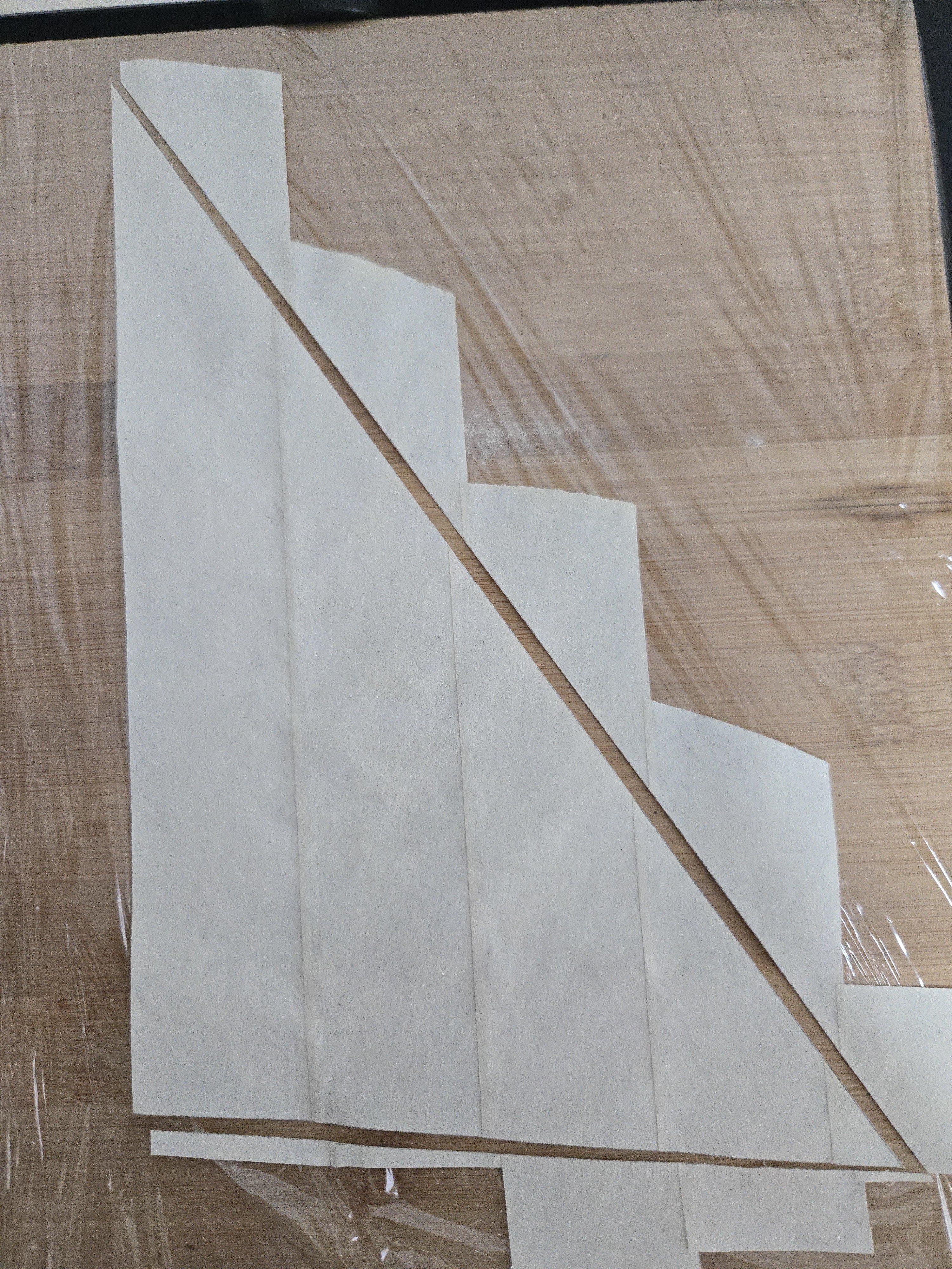

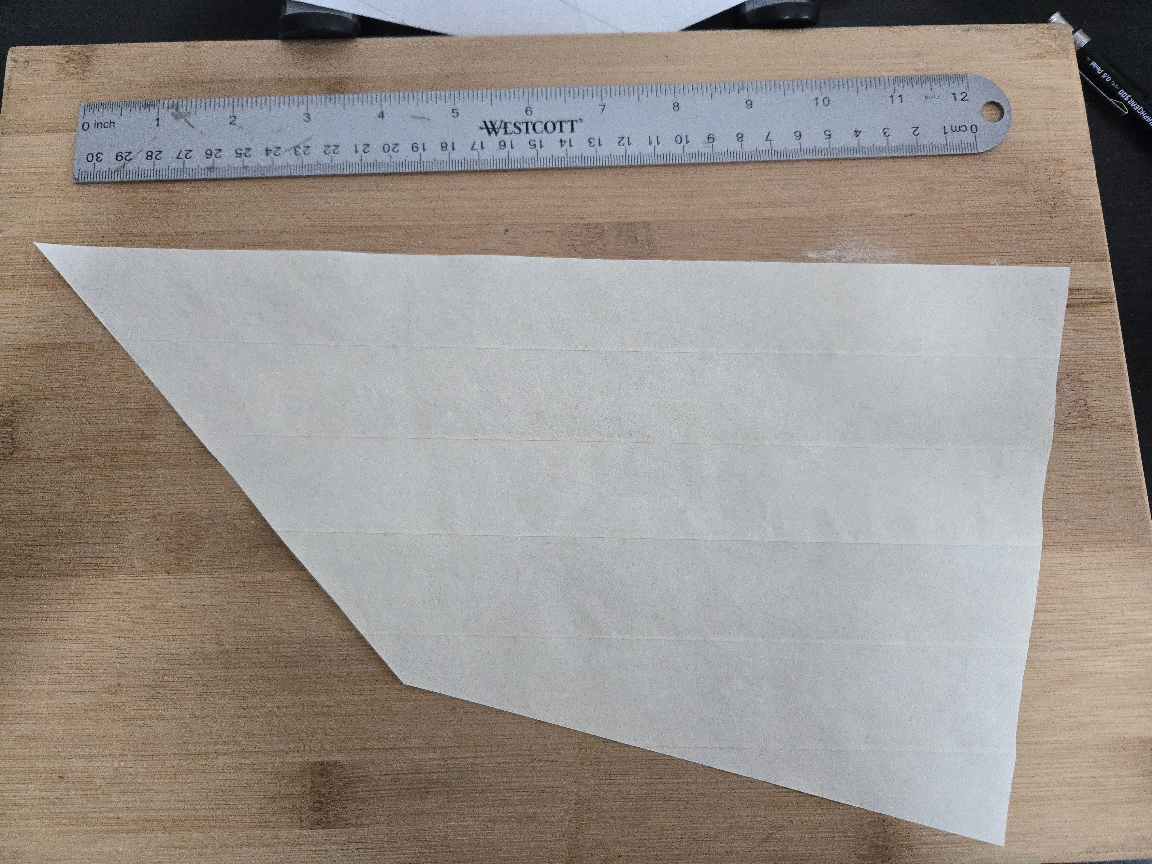

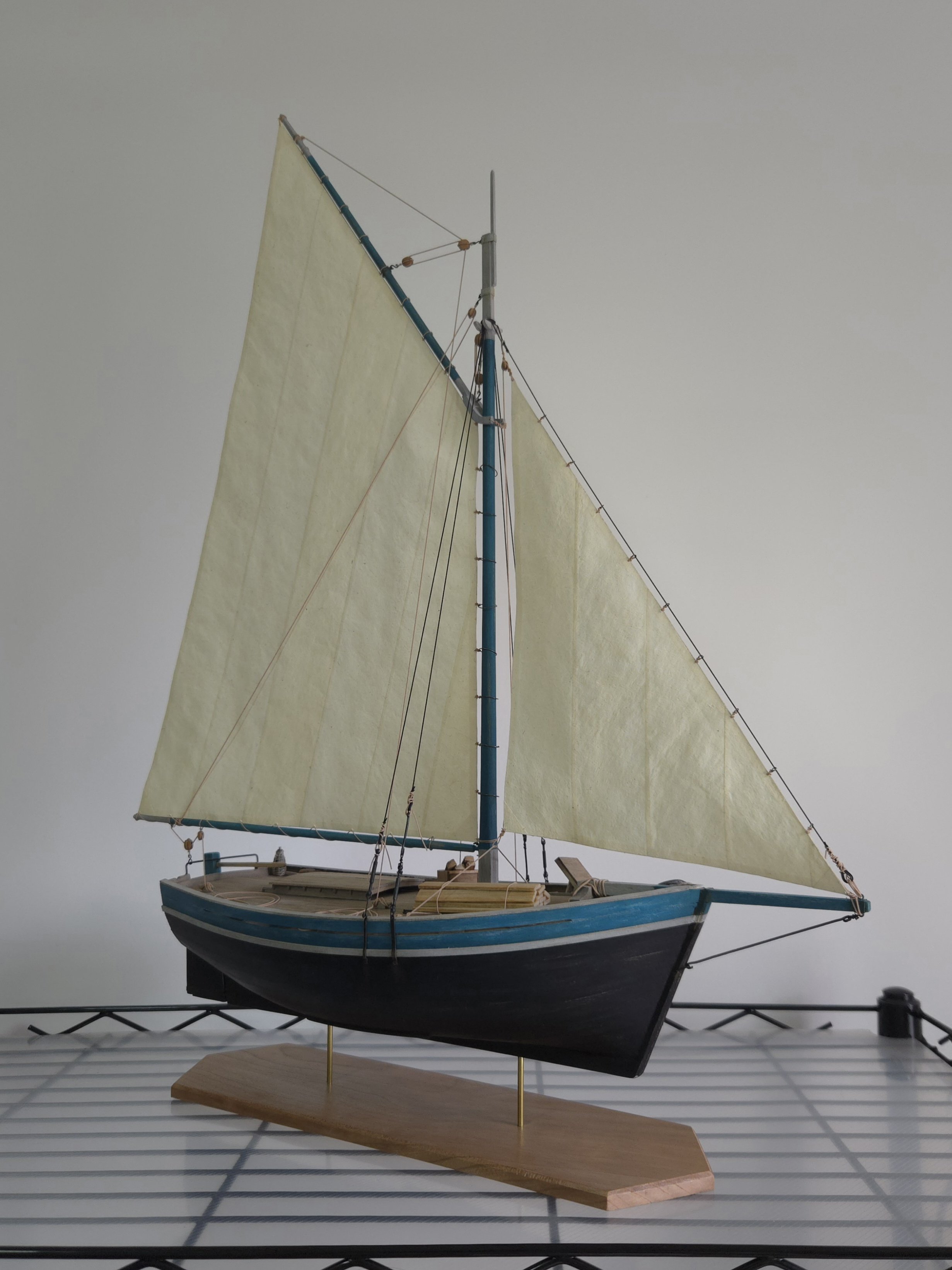

It took a bit longer than I thought, but the sails are now just about done, needing only the boltrope. As mentioned earlier, I began by painting a large coffee filter in a mix of acrylic paint, white glue, and water and letting it dry on stretched plastic wrap.

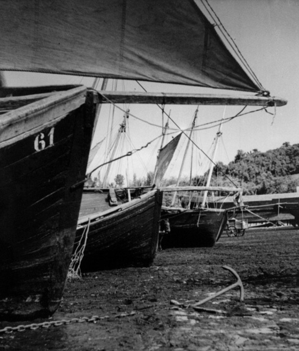

Looking at photos of lanchas, there was a lot of variety in sail panel widths. The lancha below, for instance, has 8 panels across the gaff sail:
Source: https://www.bibliotecanacionaldigital.gob.cl/bnd/629/w3-article-164339.html

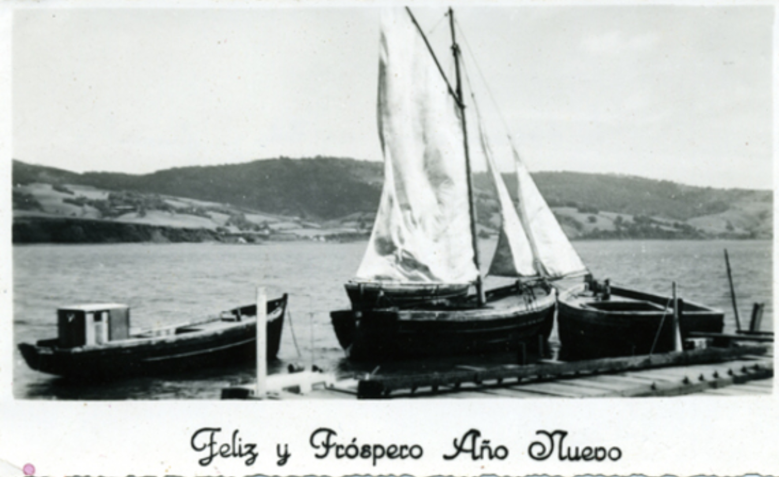

While this one has twelve or thirteen (and also shows lots of repairs).
Source: https://www.bibliotecanacionaldigital.gob.cl/bnd/629/w3-article-613540.html

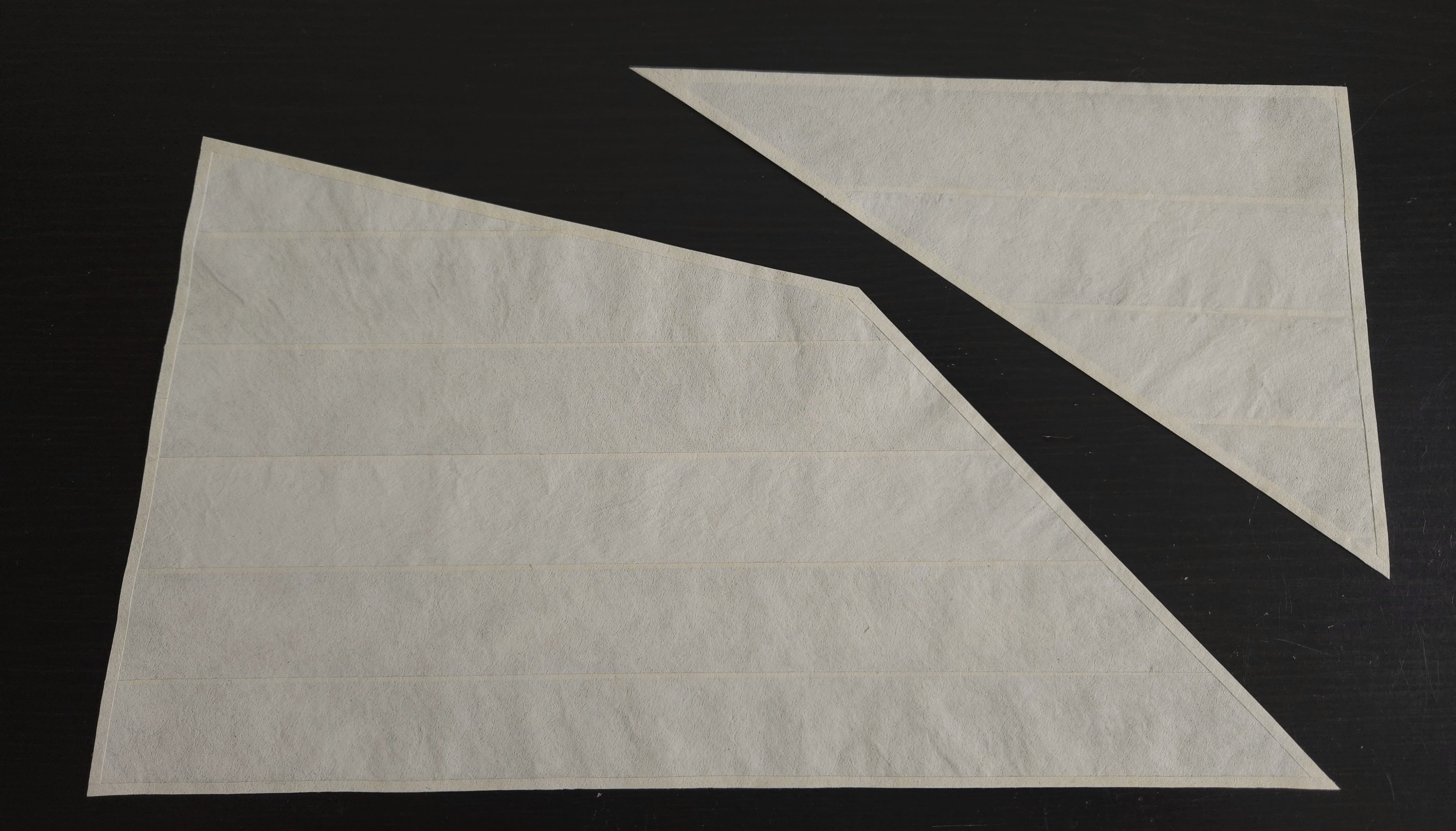

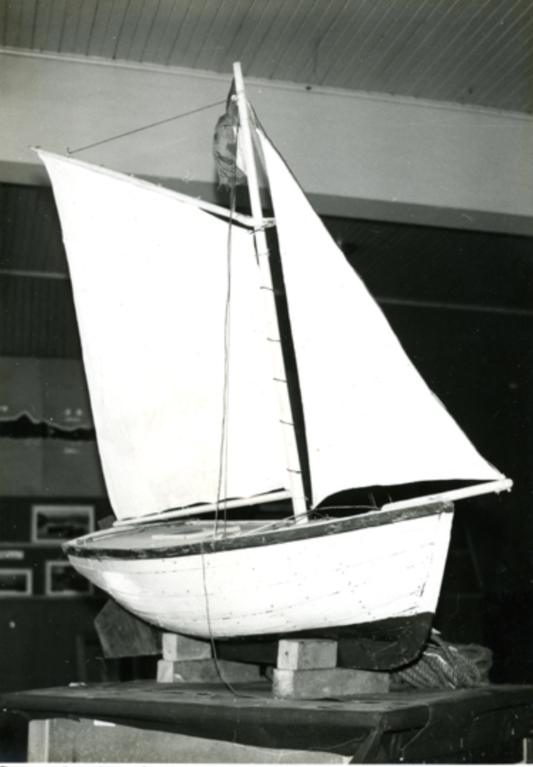

And at the other end of the scale, this one has six:
Source: https://www.bibliotecanacionaldigital.gob.cl/bnd/629/w3-article-164310.html
I'm not really sure why there was such variation. As far as I can tell, there isn't a strong correlation between fewer panels and more recent dates, which you would expect if larger strips of fabric or stronger fabric came into use over time. I suspect it just depended on what materials were available at the time where the lancha was built. In any case, I decided that making a six-panel gaff sail would be as accurate as one with a lot of smaller panels, but would have fewer chances for something to go wrong. I cut the panels accordingly, as well as some thin strips for the edge bands.

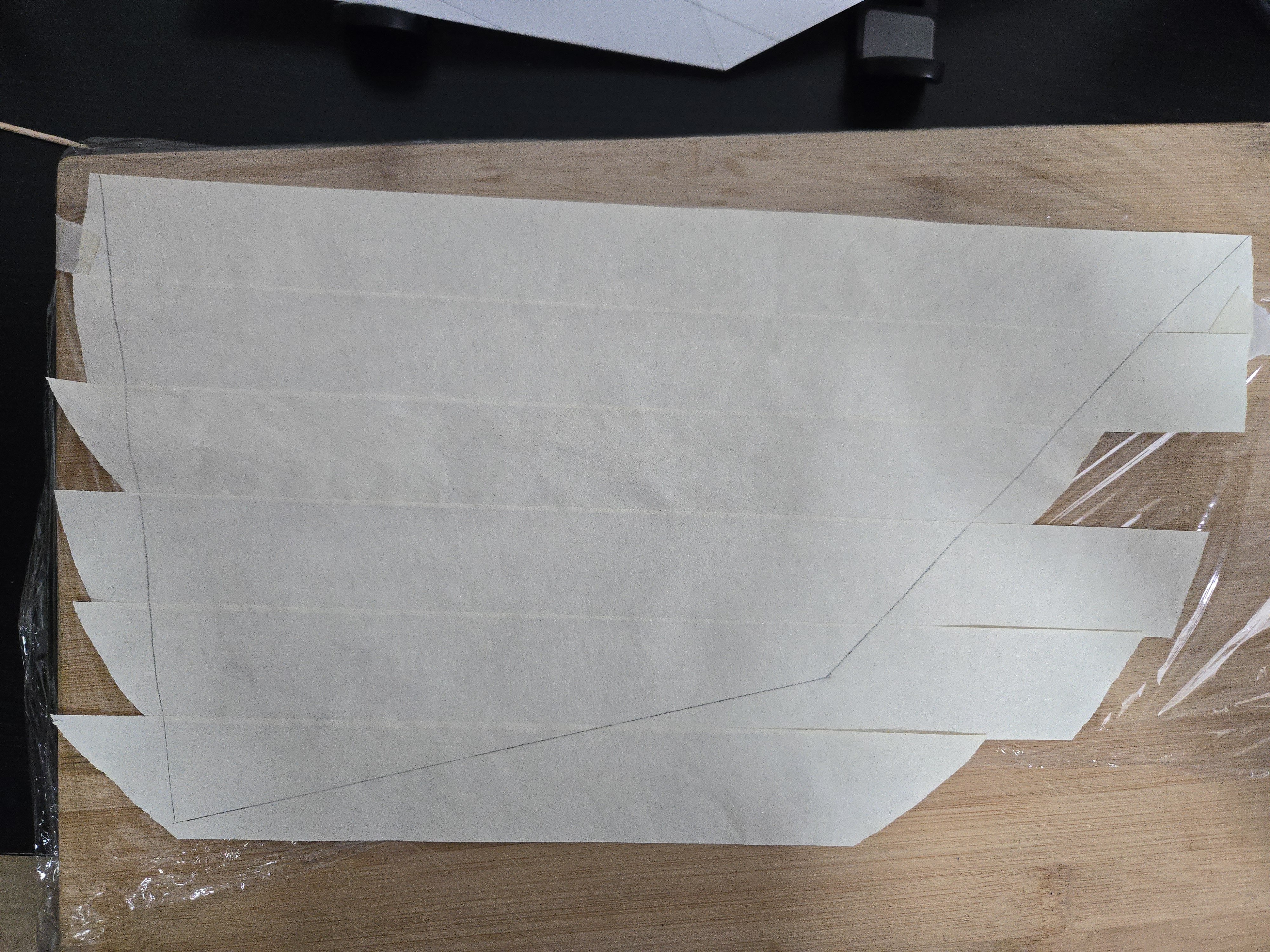

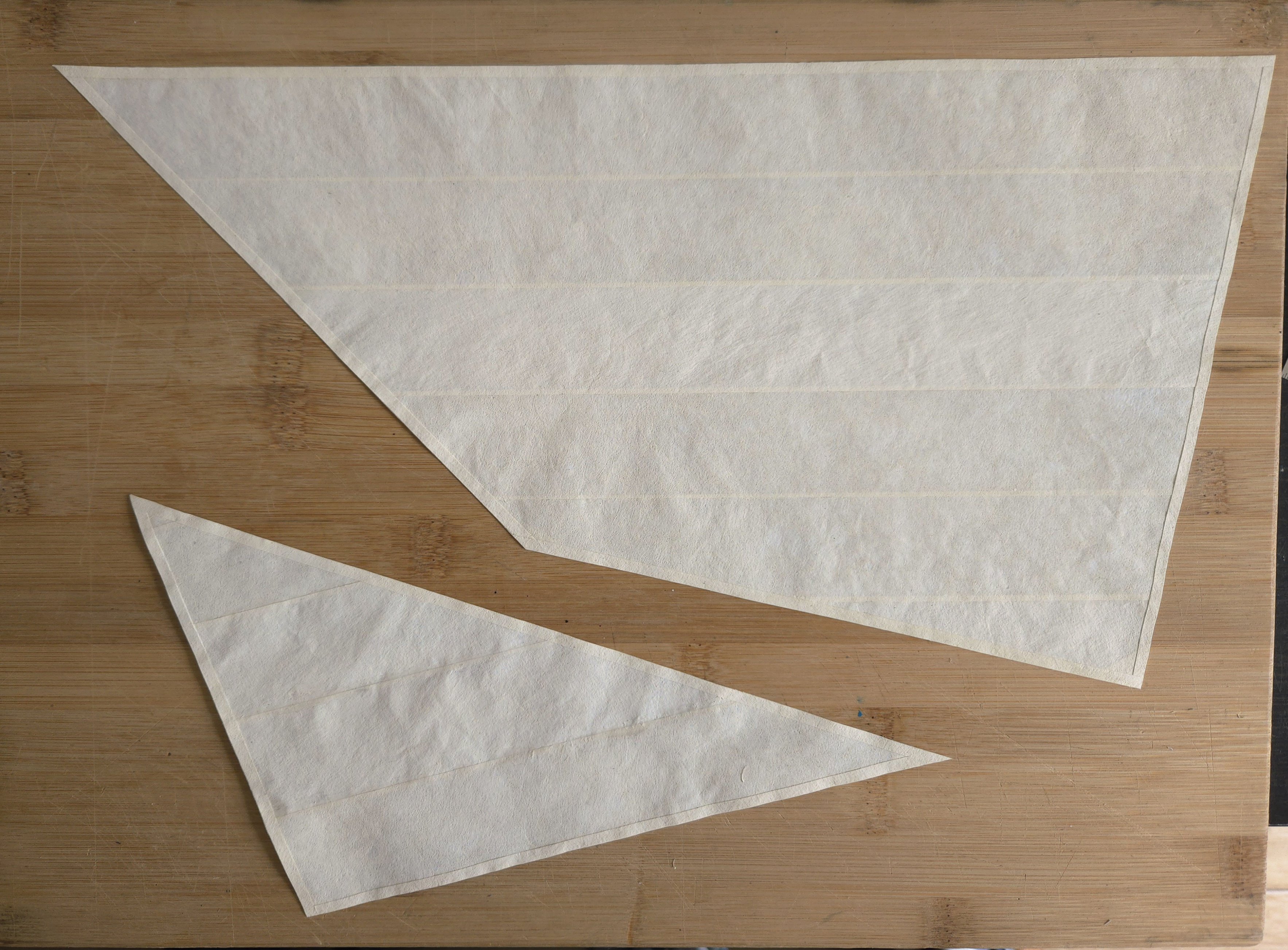

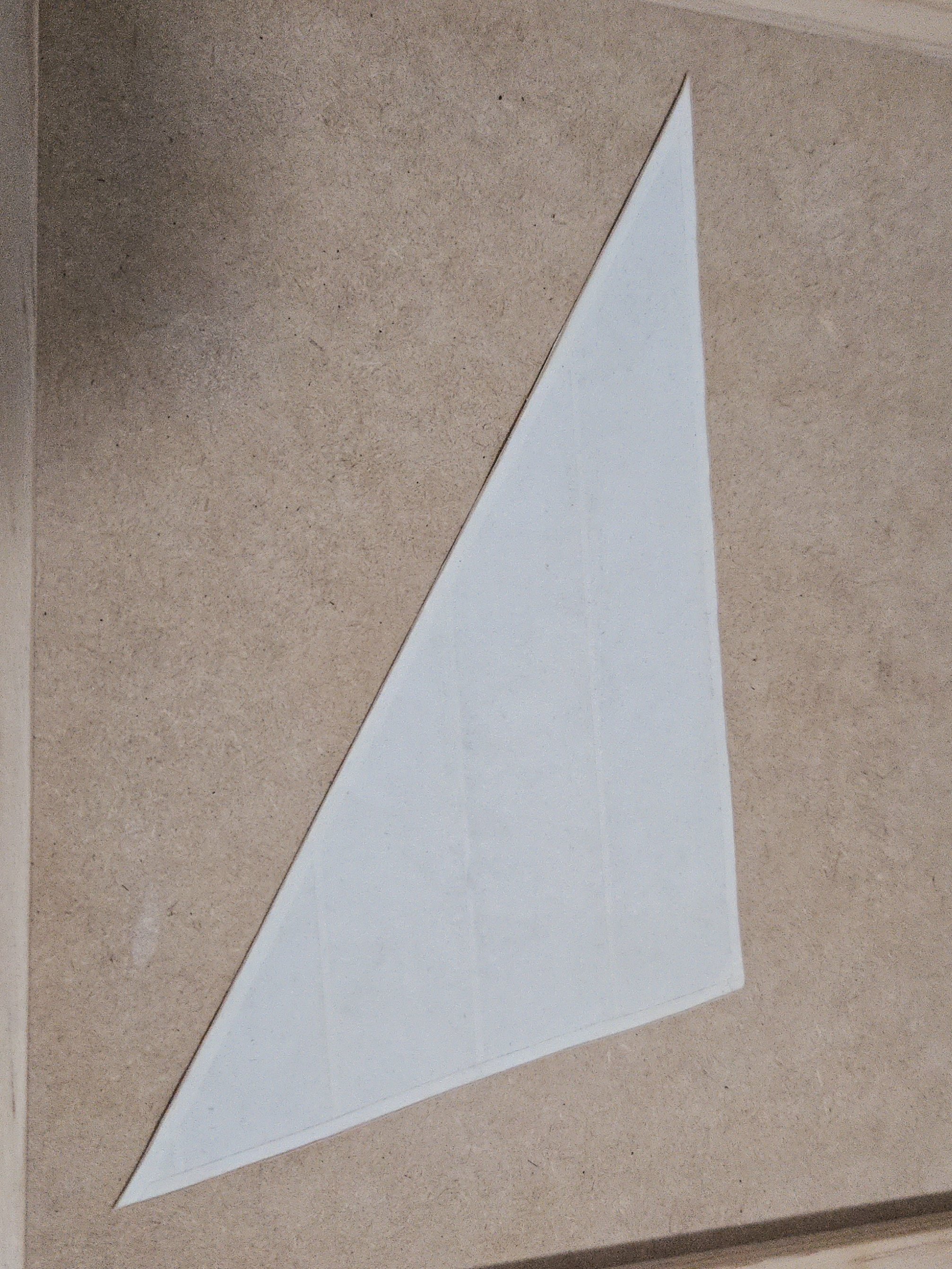

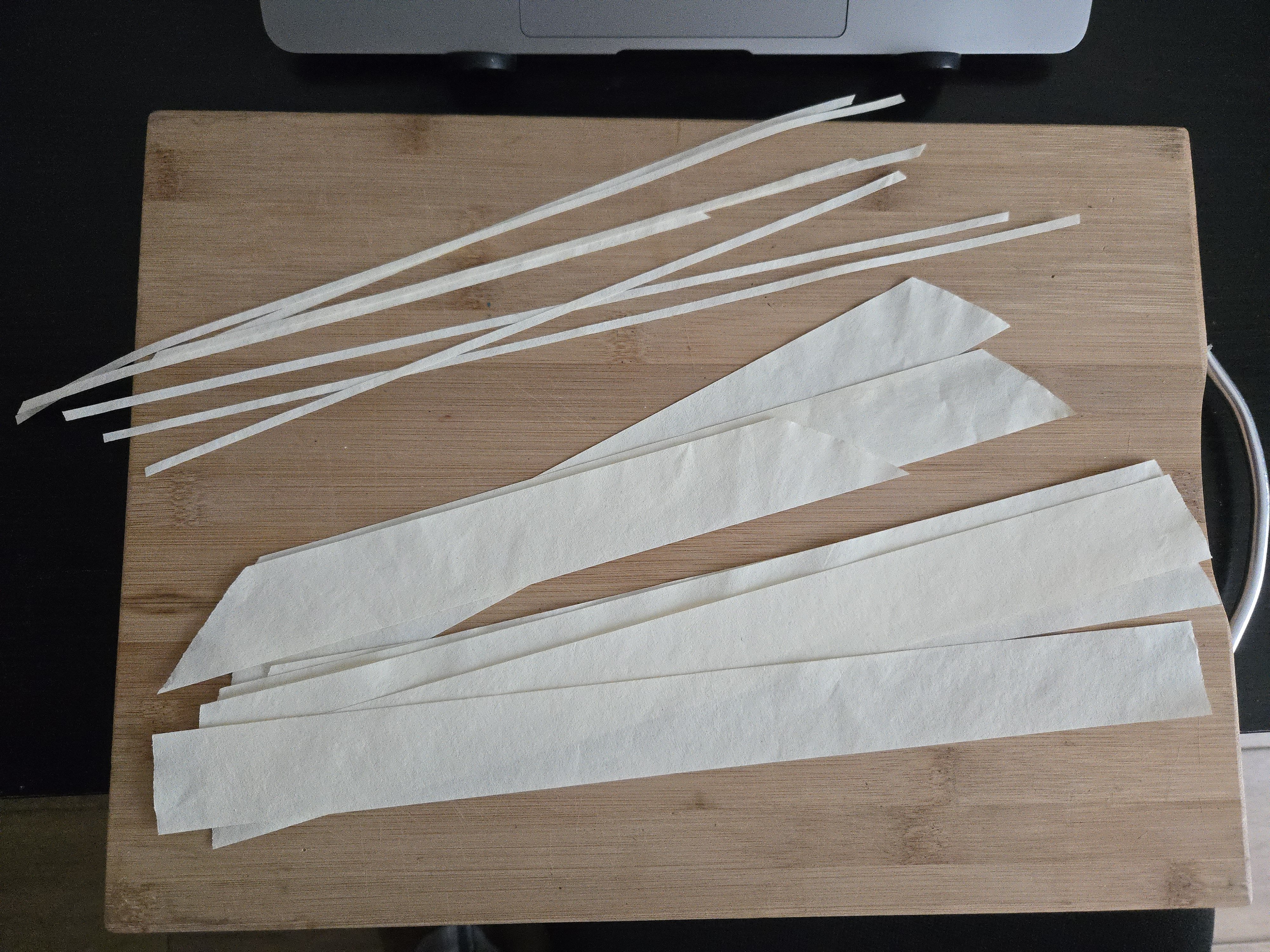

To glue the panels together, I used Aleene's Fabric Fusion glue, which dries strong but transparent and doesn't wrinkle the filter paper nearly as much as white glue would. I put plastic wrap over the template, and then began gluing the panels together. I overlapped them by about 3/64-1/16 of an inch, which is maybe a little oversized for scale, but I was worried that the sail wouldn't hold together well if I went smaller. Once it dried, I took out the template, outlined the sail, and cut.
I then did the same to make the jib.
This process seemed to work all right, but I did run into some trouble with the thin cheap plastic wrap sticking to the glue residue and ripping rather than peeling off. This was especially true for the jib. In the future, I might go for a thicker, sturdier plastic sheet instead of the cheapest plastic wrap around (which also, I should note, was tricky to get flat as it bunched to itself extremely easily). I also noticed that, between the gluing and peeling the plastic off, the sails got a little more wrinkled than I would have liked.
I posted about the wrinkling issue in a separate thread, and received a lot of helpful comments. While I figured out how to deal with the wrinkling, I added the reinforcement strips along the edges and the corner reinforcements. In hindsight, I probably could have made the edge strips a bit thinner.
After considering the advice I received about how to iron (or not) the sail, I decided to run some tests on scrap material. Unable to get baking parchment paper, I placed the sail material between two sheets of wax paper and put a rag over the top. On low heat, the iron didn't do anything, probably because the rag is pretty thick. Higher heat did press the sail material a little flatter. On a whim, I then slightly dampened the sail material and tried that (still in the wax paper and under the rag), which caused the paint to run. Lesson learned! For the actual sails, I carefully ironed them without moisture between wax paper and under the cloth. It helped a bit, although they're not the smoothest of sails.
At this point, all that the sails need before being added to the mast/spars is the bolt rope. I should note that I have not seen any photos showing reef points on a lancha sail. I'm not entirely sure why, as they certainly faced strong winds. According to Clinton R. Edwards's article on the Lancha Chilota, they usually hugged the coast and simply put into the nearest bay whenever the weather got too rough.
Unfortunately, at this point I realized that I made a mistake somewhere in the process, and the jib is slightly too large to properly fit under the jib halyard block--the tip of the sail will be basically in the block. I'm not sure how that happened, given that I had checked with the template. I think I'll redo the jib halyard block strop to be shorter which should raise it sufficiently to work with this sail.

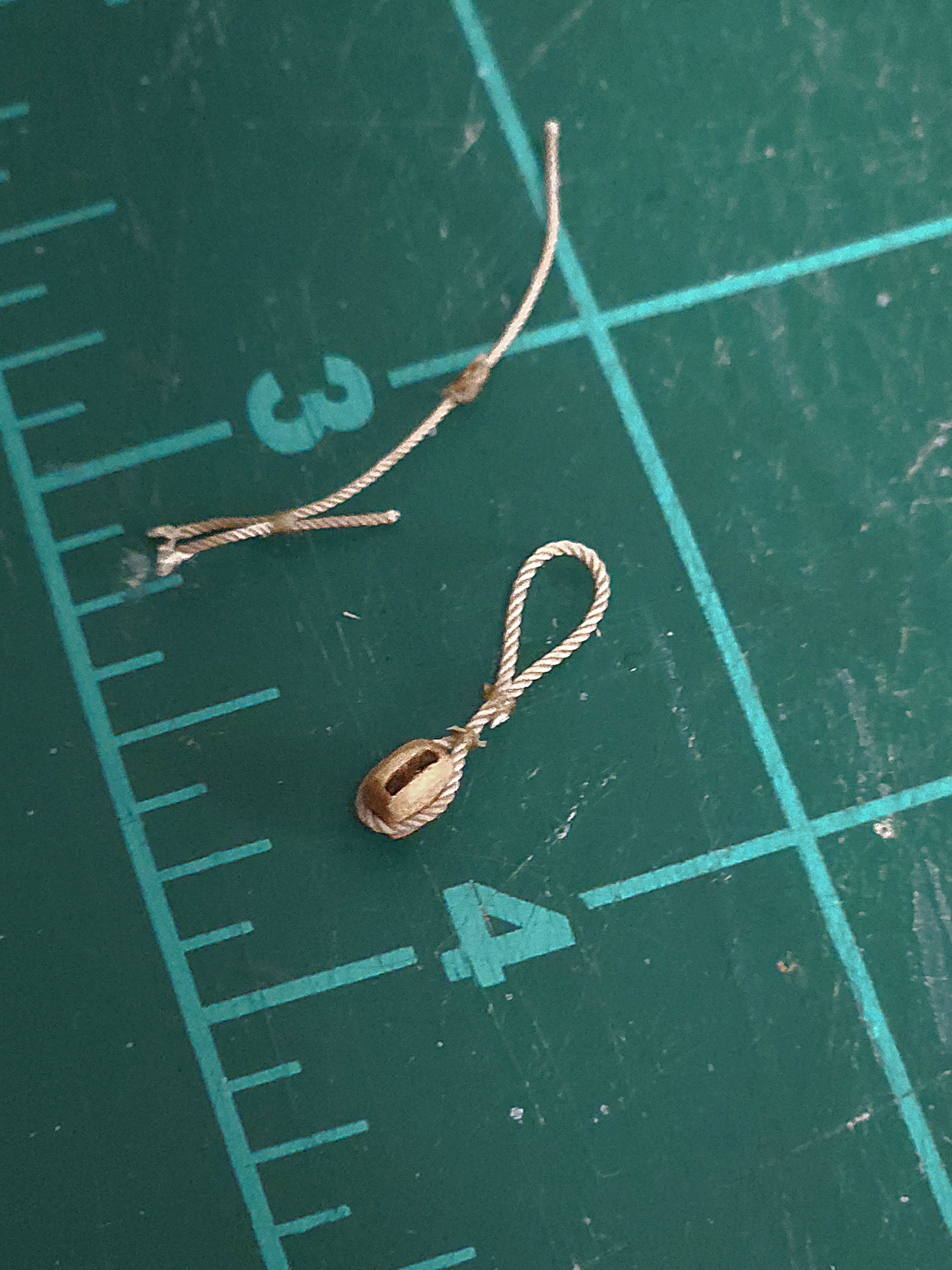

Some minor progress to report. First, I remade the jib halyard block's stropping and the loop around the forestay. It's much shorter now, which is more accurate to photos and will allow the jib to fit properly. After fitting it, I tensioned everything with thread and applied a bit of watered-down white glue so that it would properly hold the tight fold into the eye of the forestay.

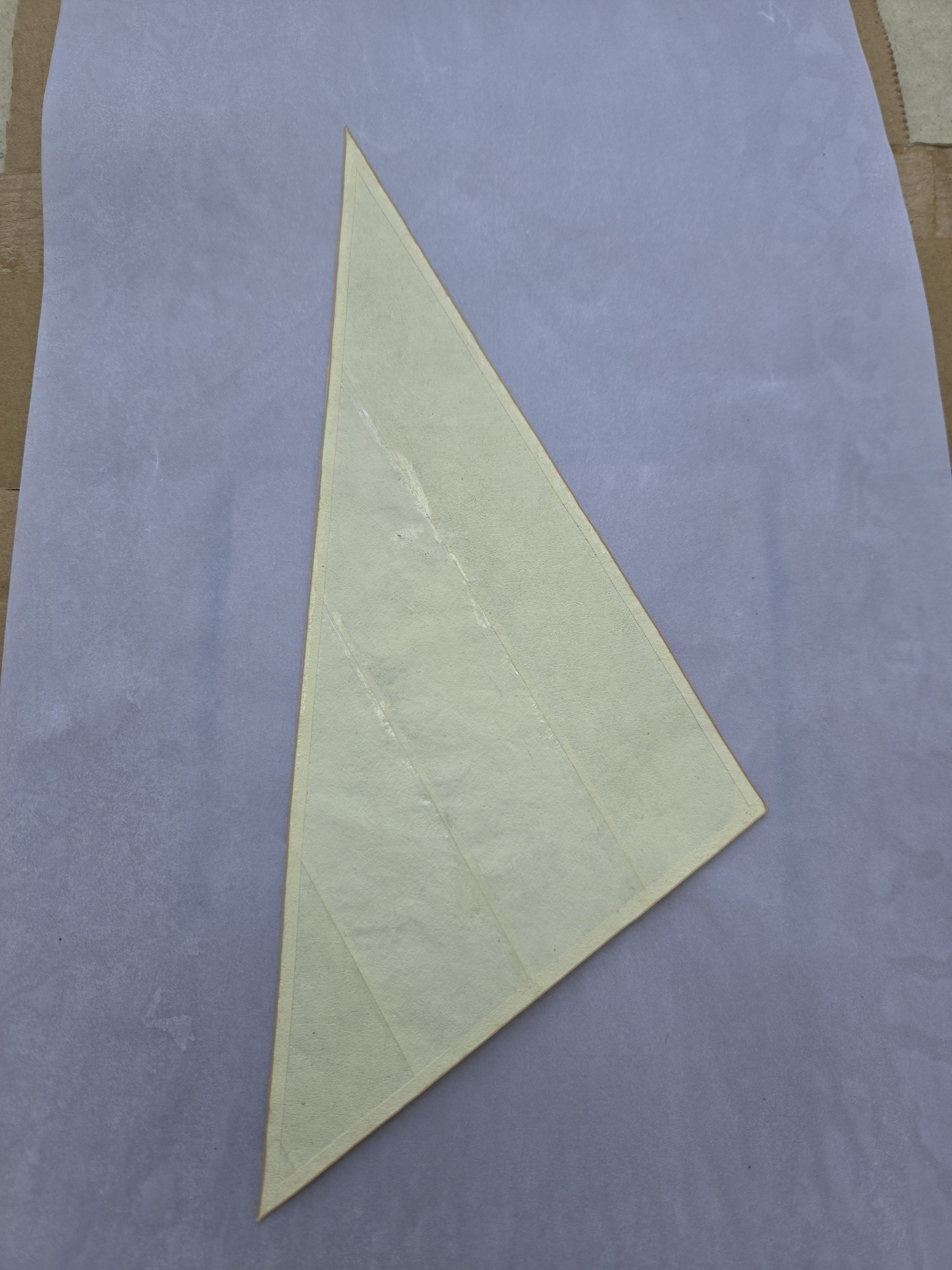

I also worked more on the jib. The bolt rope is made of .35mm rope from Ropes of Scale, glued in place with more Aleene's Fabric Fusion.
As can be seen above, a lot of the seams had shiny glue residue. To get rid of this, I took advantage of a brief bit of sun--Mexico City is quite rainy these days--to apply a matte transparent spray. A couple of coats on each side later, and the residue is practically invisible. The spray also adds a bit of strength and resistance to the sail, which is a nice bonus.
Next, I need to do the same to the gaff sail, and add the running rigging. I also need to work out how best to make the hanks (to hold the jib to the forestay) and mast hoops. According to Vairo, by the 1980s these were usually made of wire. I think I'll do some tests with 28-gauge galvanized wire and with thin black rope.

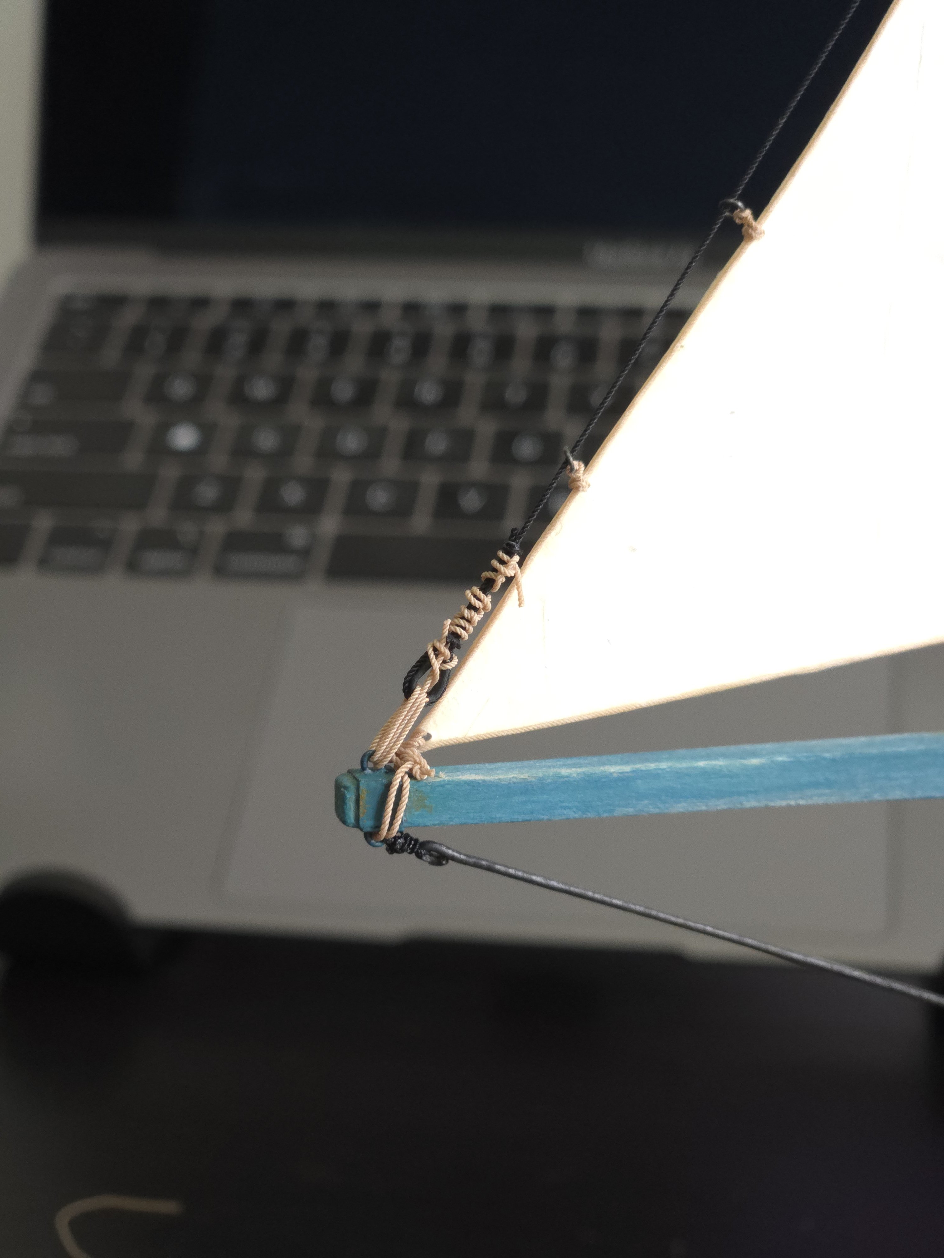

Next, the robands on the gaff. I was initially going to just loop the rope through the eyelet in the sail and then directly around the gaff, as below.
But, looking at photos, I decided it would look more accurate to first do a half hitch through the eyelet around the boltrope, and then around the gaff, as below. Subtle, but worth it.
As with the mast hoops, I first tied off everything around the sail before attaching the gaff spar.

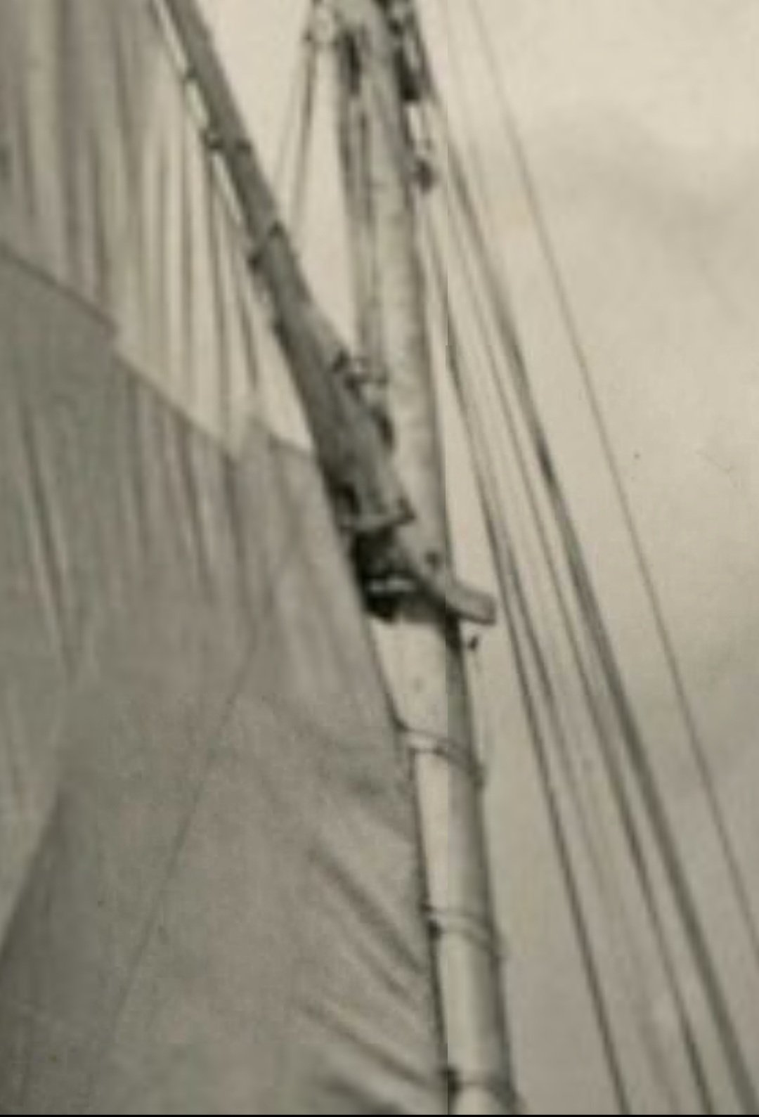

The throat took some thought, as I wasn't sure whether it should be attached to the gaff or the mast, and once I decided the former, it wasn't clear how to tie it off, as it's located at the gaff jaws. After a bit of searching, I noticed in the photo below that there was a thin rope running around the gaff jaws.
Source: https://www.flickr.com/photos/luchinmardones/5232587713/in/photostream/lightbox/
After seeing it in a few other photos, I now think that the throat was simply tied off around the jaws on many lanchas, so I did that, as seen below.
To make the robands, I used the same "fake splice" as I've used for stropping blocks: tie a half hitch, secure with a bit of glue, and trim the ends tightly.
A quick check, with the gaff temporarily held at the right angle with scrap thread and wire, to make sure none of the angles are wrong.
For the boom, I ultimately decided to go with the continuous loop instead of robands. While it at first looks like the continuous loop uses more rope, that doesn't take into account that each roband needs excess rope that gets trimmed after tying the knot. Handling it as a continuous loop was much easier than doing separate robands. That said, while I've seen a number of photos with a continuous loop lacing on the boom, none of them show that on the gaff spar, so this is accurate.

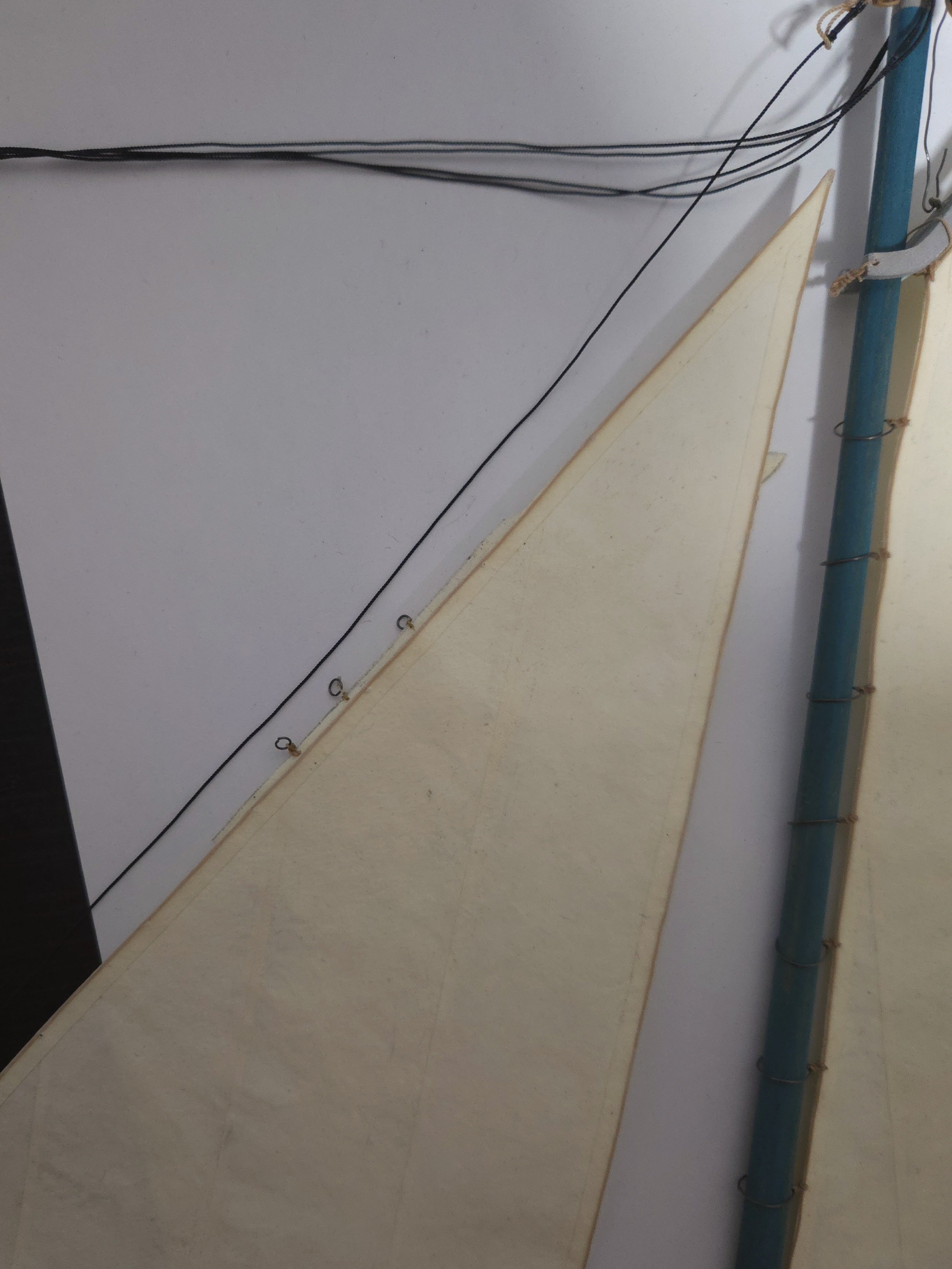

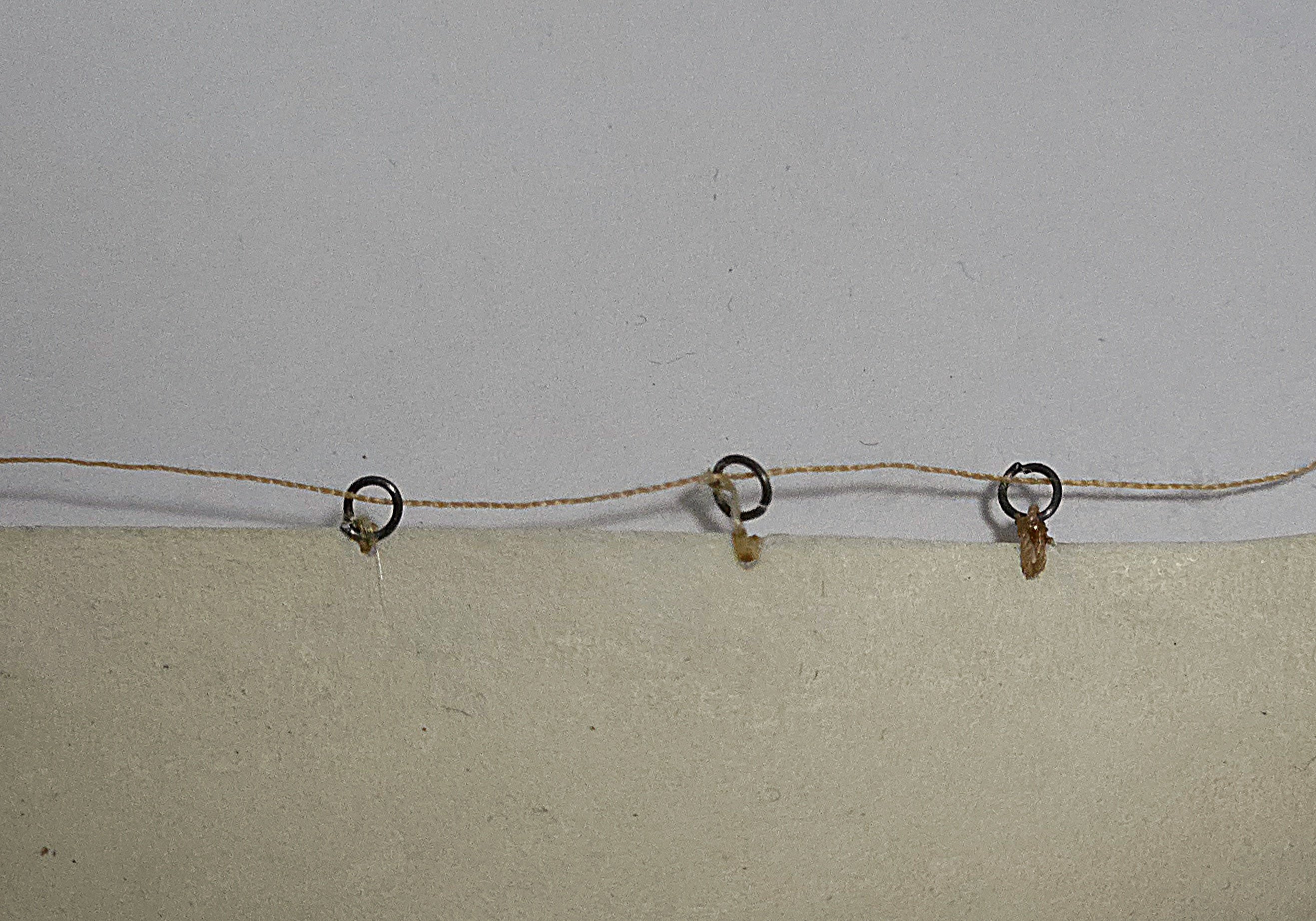

I've done a little bit of testing for the hanks. I made some small rings with 28-gauge wire and tried a few methods of attaching them. Below, there are three samples.
The center one was the first I made, using fly-tying thread that I looped and tied through the sail eyelet a few times before tying on the ring. It didn't turn out very well, with the final knot barely holding on thanks only to superglue. The left example also uses fly-tying thread, but this time I only passed it through the eyelet once before looping it through the ring, and then going back through the eyelet a bit before tying it off. It turned out better, but 1) I need more distance between the ring and the sail, and 2) the thread snagged on who knows what and created a tangled bunch of fibers. I find this happens fairly often when I try to use fly-tying thread. Finally, the one on the right used a bit of the .35mm rope, secured with a couple knots and a lashing with the fly-tying thread. I think this one turned out best, although it was also the most complex to make.
That said, my sense is that the metal ring is still too big. You can compare what the current size would look like on the jib, below (I tucked the test behind the jib), with some photographic examples that generally show quite small hanks.

I'm not sure if the best solution is to keep going the way I've been going, but to make the rings a bit smaller, or to use black rope to represent the hanks instead, as it would produce a smaller hank.

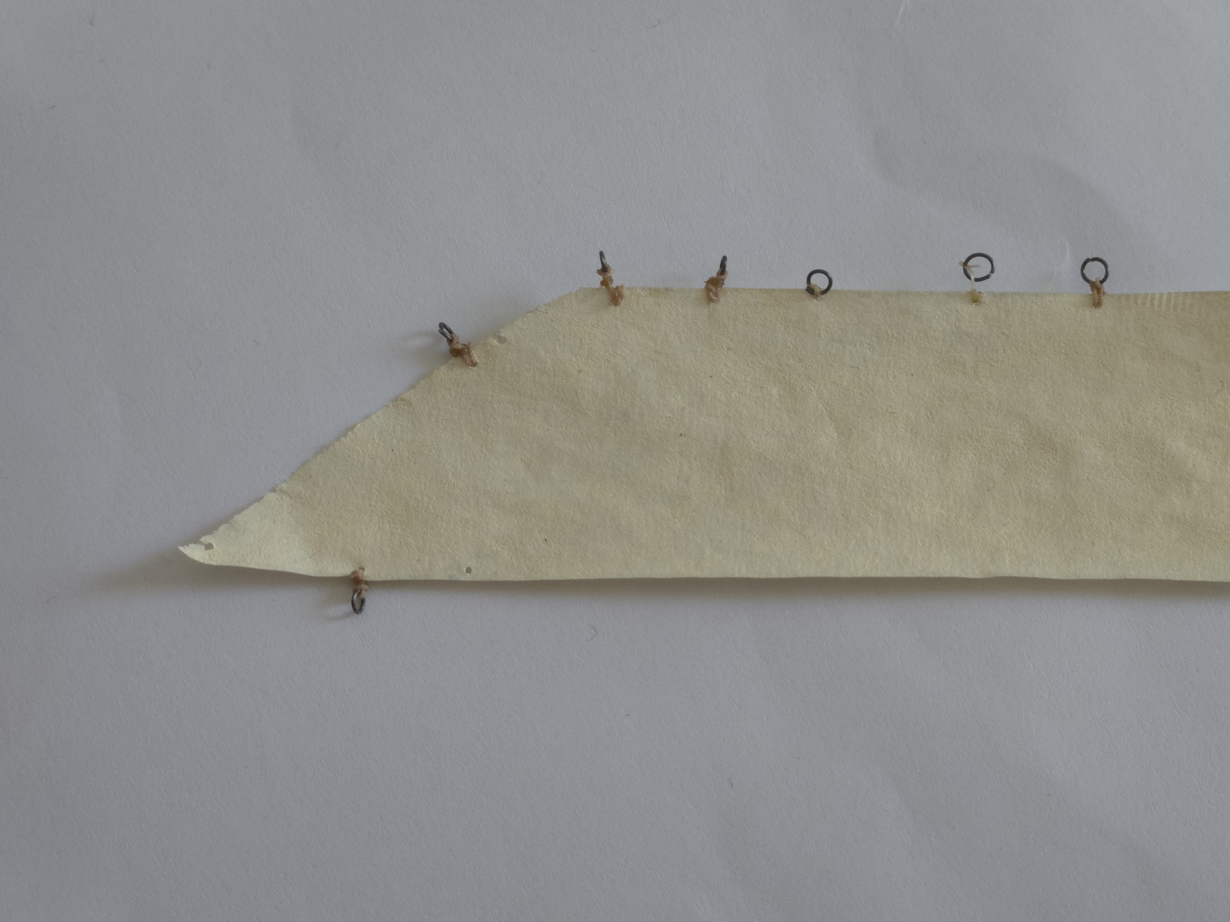

A little more testing, and I think I have the jib hanks figured out. I can get the rings down to an inner diameter of about 1/16-inch, which is still probably slightly oversized but any smaller and I'd have a very hard time working with them (it's already hard enough even just to get my metal cutters into the ring to cut them). I also switched to using the same method I used on the mast hoops to lace them to the sail, entailing first attaching the rope to the ring and then tying on the sail. This holds the ring perpendicular to the sail instead of parallel. It took a few practice runs to get it right, as seen below:
The three tries at top right were either a little bulky, or, in the case of the one on the corner, I added a little too much super glue to the initial knot and the rope became too stiff to be run through the eyelet properly, instead holding the ring too far out from the edge of the sail. The test at bottom left is where it finally came together.
All of these tests, except for the early ones that used only fly-tying thread, used the cut-off bits of .35mm rope from the gaff robands and mast hoop lacing. These were tiny scraps, about 1 inch long, making it very hard to tie the knots. For the final version, I think I can go with lengths of rope about 1.75 inches long, which should be much easier to work with, without quite using all of my available. 35mm rope, as I'd like to keep a little as backup in case something needs to be redone. I think the hanks would probably look better with .25mm rope, but I don't have any, so these will have to do.

Satisfied with my tests, I made the hanks by wrapping 28-gauge wire around a thin brass tube.
The rings are small enough (2mm across) that I could only cut off one at a time, as my wire clipper was too wide to reach any further. I made some extras in case I lose any, they're pretty tiny.
To get them on the forestay, I placed them in the tip of my hemostats, used a toothpick to open them enough for the stay to fit in, and then, once they were threaded, used finger and tweezer pressure to squeeze them shut, securing with a tiny amount of superglue applied from a toothpick that I whittled into a thin point. Next up I'll need to add the lacings, and then the sail itself.

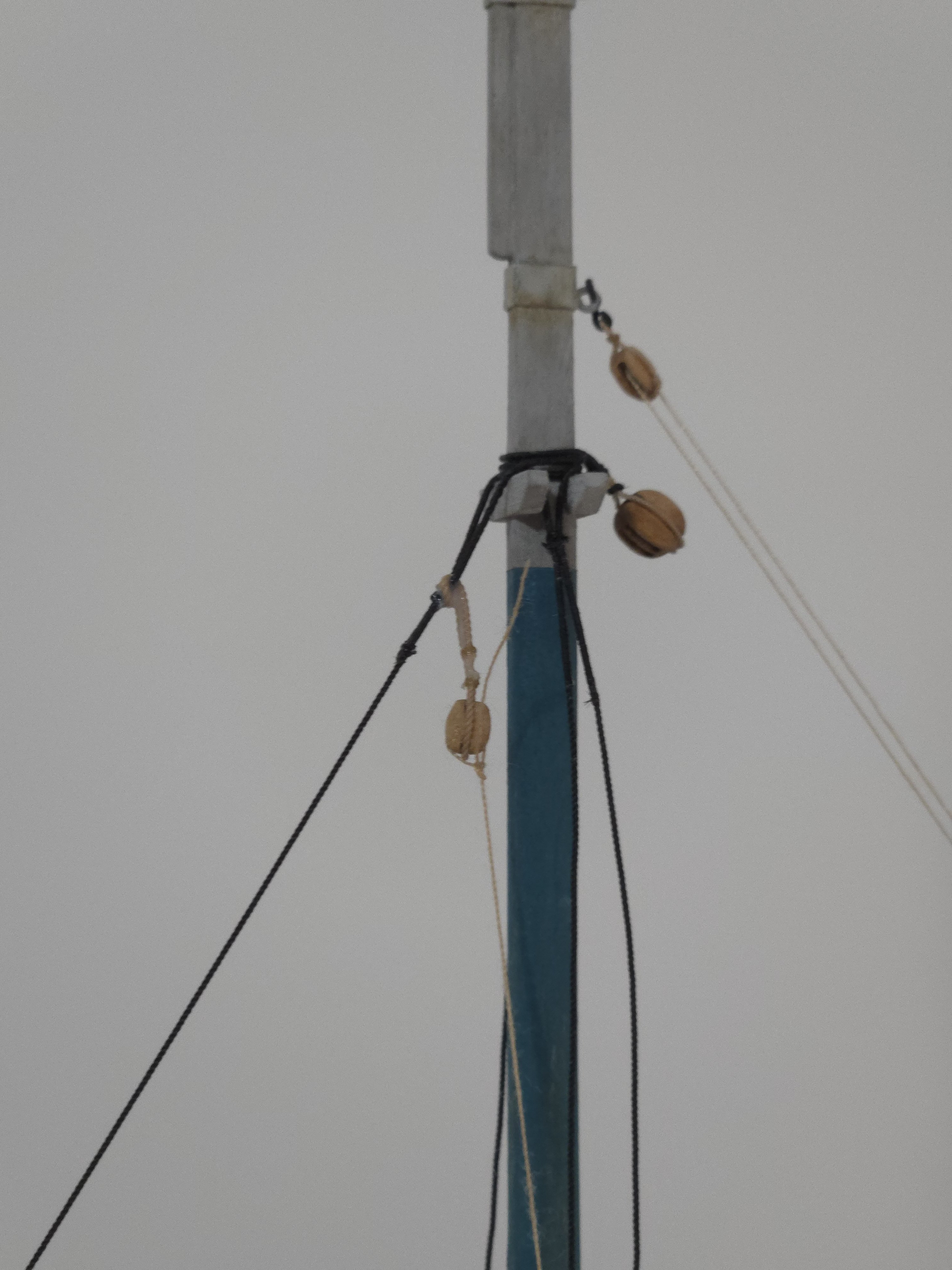

Before adding the jib, though, I wanted to add the jib halyard, as I thought the seizings, in particular, would be hard to apply once the jib was on the stay.
With that added, I figured that I may as well add the other halyards. I tied off the peak halyard not at the tip of the gaff spare, where many lanchas tied it off, but a little further in, so as not to put too much pressure on the spar extension. While I use half hitches for a lot, I knew I needed a different knot here, and ultimately went with a fisherman's bend, which turned out well with the .5mm rope.
Adding the throat halyard, which had been made earlier in the process, was a simple step. I wasn't sure whether the gaff halyards should both be on the same side of the mast or on different sides, so I watched a documentary on YouTube about a Lancha regatta in the 1980s ("Regata a un ventisquero," Dir. Domingo Garrido, 1983: https://www.youtube.com/watch?v=CDeTRT64kd8 ) and found, arou d 1:48-1:50, that they were on opposite sides. This was helpful for figuring out how the ropes should run through the double blocks.

Bending the jib to the forestay was a little tedious but nothing too difficult, just a lot of tiny knots.
I was lucky that they all turned out all right. After finishing, this was the total amount of .35mm rope that I had left:

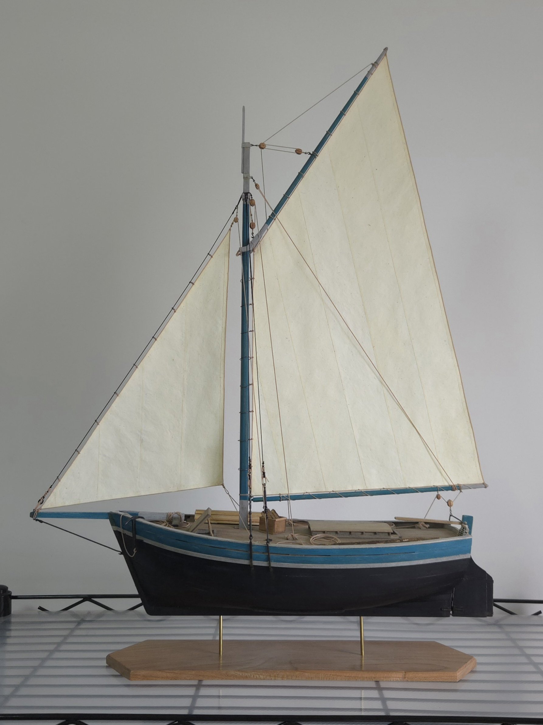

After getting as much set up off the hull as possible, it was finally time to step the mast. This was a very exciting step, as I finally got to get a good look at the model with sails in place.
After looking at quite a few photos and other build logs and the like, I did my best representation of the lanyard joining the forestay to the bowsprit. I also tied off the tack of the jib, the rope for which, following photographed examples, wraps around the bowsprit (I threaded it through the lower eyebolt to make doubly sure it would stay in place, although this aspect wasn't very clear in photos). For now the lanyard has been left long, so I can adjust it if I need to.
For the lifts, I ultimately decided to go with the .5mm rope instead of. 45mm. I think it definitely looks better, but I'm still debating whether the mainsheet should be cut off and swapped out for one made of .5mm rope instead of. 6mm, I feel like it might just look a little too bulky. One end of the lifts (which, following photos, are simply tied around the boom, rather than being fixed to a cleat or something) has been left long for now so that I can easily tighten it if the line starts sagging as it stretches.
At the moment, the line is all very long and just loosely piled on the deck. I need to figure out a convincing way to leave it--they definitely didn't use neat coils on these vessels. I also need to tie off the shrouds with lanyards, although this might make more sense to do after finalizing the running rigging so that I have more room to work.

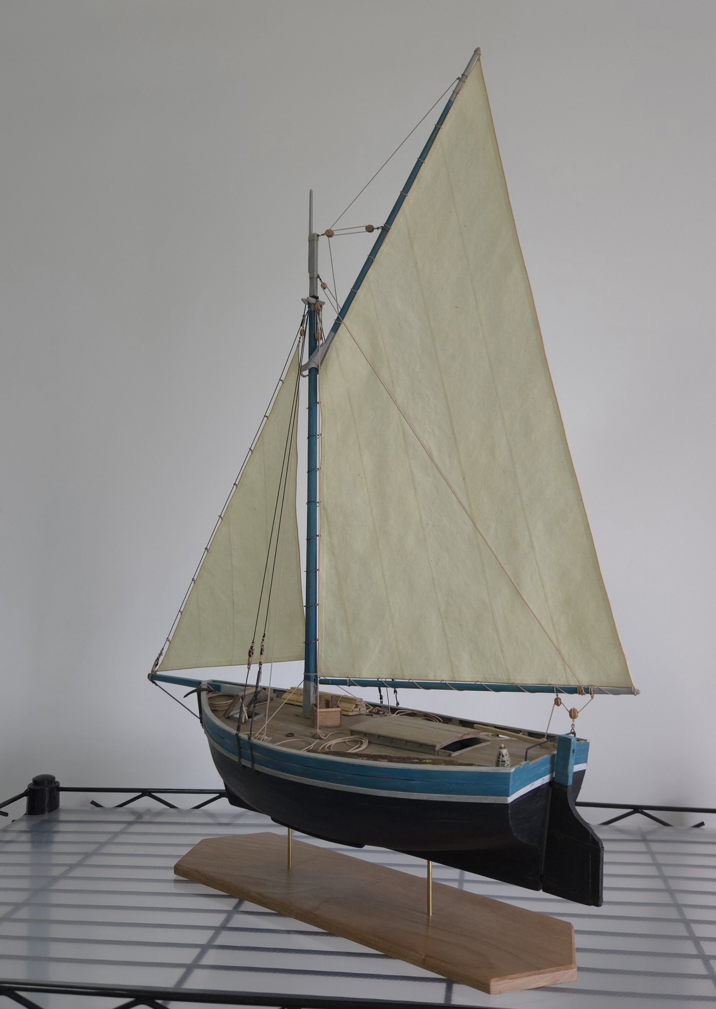

I have to admit that I'm very pleased with how this build is coming along. Thank you very much to everyone who has added a like, left a comment, answered questions, or otherwise offered support on this model.
 She's looks so sharp, Jacques. It's great to see the mast set with the sails deployed. .
Thanks, Keith! It's nice to see it all coming together.

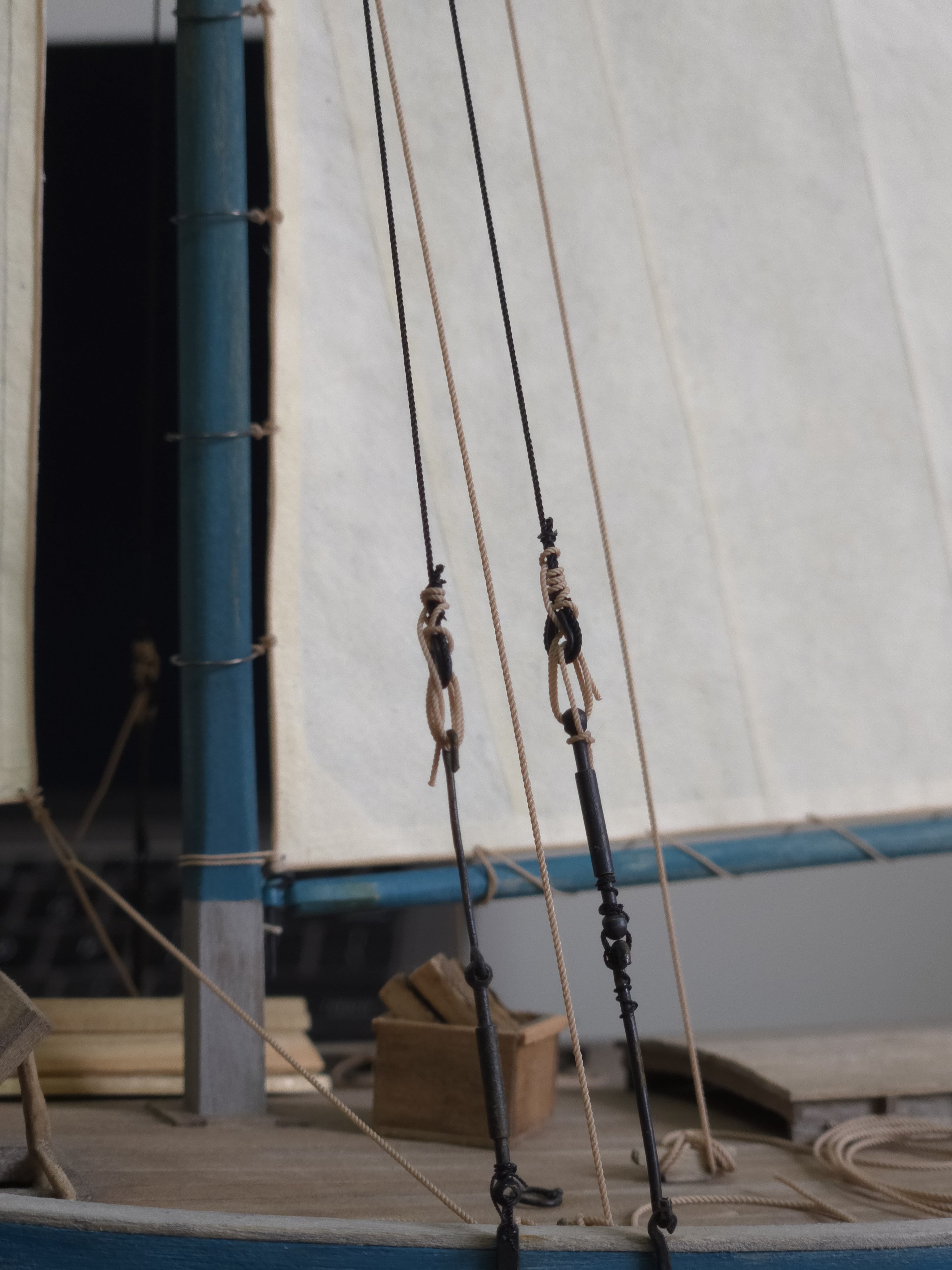

I figured that I may as well go ahead and add the shroud lanyards. So far they're not glued in place and I've left some excess, so I can adjust if necessary. Figuring out how to properly do the lanyards was a little tricky, given that these aren't deadeyes, just thimbles and hooks.
I've also loosely coiled the rope ends, also without glue, mainly to tidy up the deck a bit. The miniature rope doesn't naturally lay in a pile the same way the real rope does, so I'll need to figure out a better way to pile it up and glue it in place.
I also did decide to replace the sheet with .5mm rope, down from the original .6mm. I think it looks more natural running through the 4mm block, and the knot is a lot less bulky.
Looking the thing, you are on the right track!
I think the lanyards should be rove about three times through the thimble, keeping in mind that the steel shrouds are much stronger than the rope.
I use something like dilute nail varnish (the acetone solvable one, not the acrylic variety) for keeping coils in shape and place. I prefer a solvent-based varnish for that, because one can soften it with a drop of acetone, if the 'rope' doesn't comply yet. The problem may be that it leaves shiny traces, but if it is rather dilute it may be not so serious and can be corrected with some matt acrylic varnish.
Thanks, Paul!
Thanks, @wefalck! I agree about the lanyards, I think I can only do two wraps through the aft shroud thimbles/hooks because the hold in the end of the turnbuckle is a bit too small to fit more. In hindsight I should have drilled it out at an earlier point in the build.
I was able to find the time to redo the lanyards, adding an extra loop to each and doing a better job of tying everything off. Looking at photos of lanchas, I was struck by the way that lanyards and the like seem to have been tied off in rather haphazard ways rather than with more typically "maritime" knots, like in the detail below:

While I wasn't able to get knots quite as tight, the added knots will look more accurate than before. Rather than secure these with superglue and run into trouble later if I have to redo them due to the line stretching, I have secured them with diluted white glue, and they should be more malleable if moistened in the future for retying. They've still been left a bit long awaiting a final trimming, although the "tails" at least point downward with gravity now.

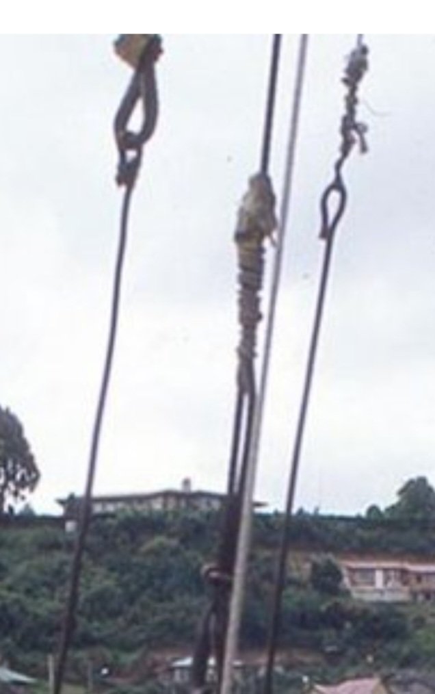

Jacques:  This build has been a delight to follow and I have particularly enjoyed your explorations of the methods to secure the mainsail to the spars.  One tiny point I would raise because of our own gaff cutter experiences is that the throat of the sail at the gaff (sometimes referred to as the "knock") will have a strong tendency in a breeze to want to sag away from the mast and move a bit up along the underside of the gaff if there is any slack in the throat halyard.  Because of the taper to the gaff jaws, the line around the jaws would tend to slide aft and loosen a bit.  This is the reason that some method of attaching a piece of line from the throat of the sail to well forward , either to an upper mast hoop or to thumb cleat on the underside of the gaff (or sometimes through holes going up through the gaff jaws) helped and was also simple.  Do any of your photos show a method of keeping the throat of the sail forward toward the mast?

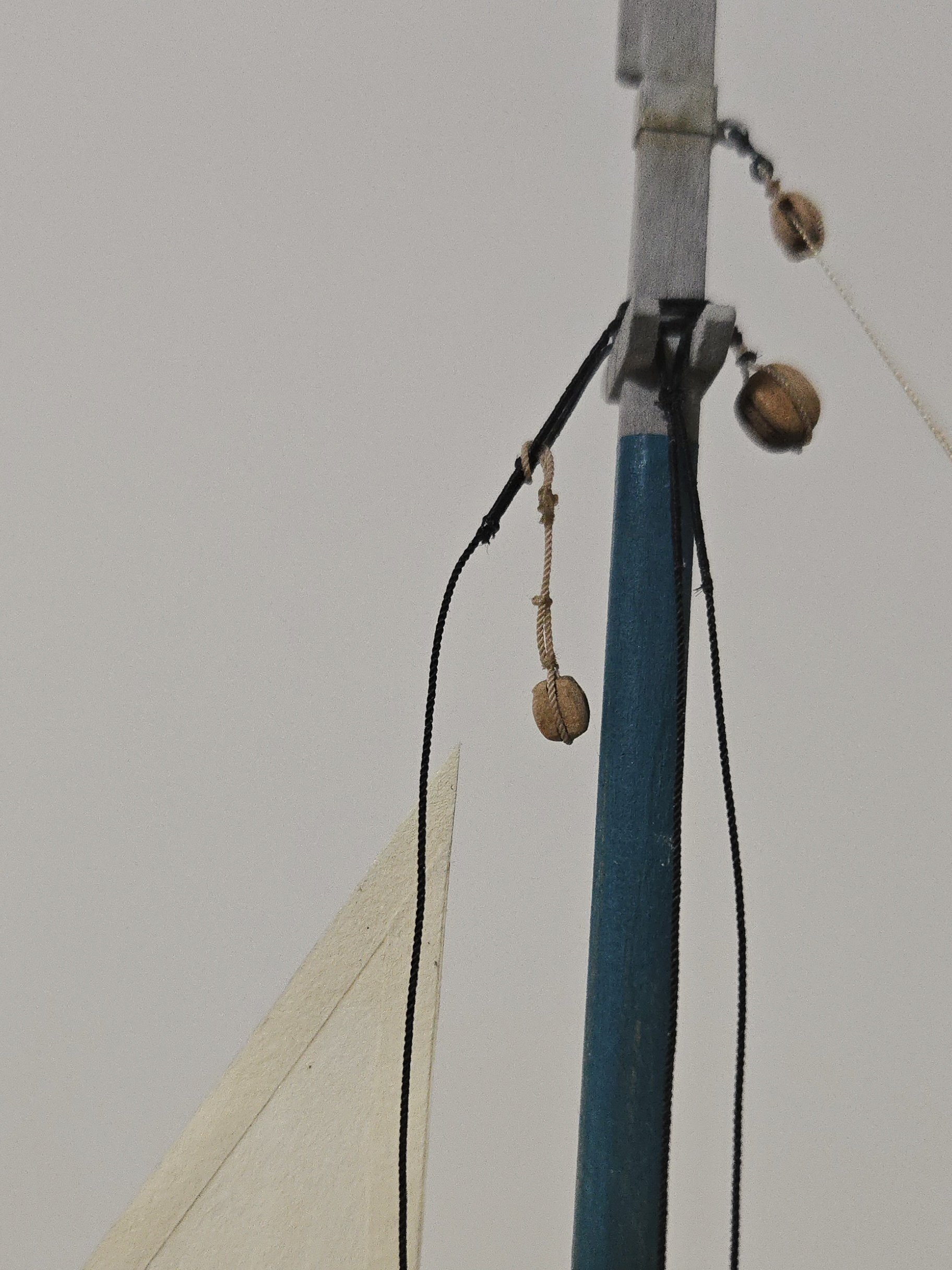

I noted that on the enlargement of this photo:
https://www.memoriasdelsigloxx.cl/601/w3-article-86076.html
There appear to be one or maybe two lines involved at the throat.  Unfortunately, I do not have a good image from our boat of that area.
Craig
Edited by MAGIC's Craig
forgot to add a picture for reference
Thanks, @MAGIC's Craig! That's a very good point, and something I was a bit concerned about when I was adding the sails, given the taper aft of the gaff jaws. My own sailing experience is extremely limited, so it's very interesting to hear how this issue would be resolved on an actual vessel (by the way, thanks for sharing the photo, the colorful sails look great).
So far, I haven't found a definitive answer. I had interpreted the photo you link to as showing just the line around the gaff jaws at the throat, and as having a mast hoop laced to the sail a short distance below the throat, but I may be mistaken. I also don't think I see any additional lines at the throat in the photo linked below (which can be enlarged by clicking the "visualizar" link).
When I was building it, I had the thought that passing the line through an eyebolt on the underside of the jaws might work, but I didn't see any clear evidence of that. I'll keep looking for something, though, as it definitely is something that they would have had to deal with on an actual lancha.
Digging around a little more, I found the photo detail below:
Source: https://www.bibliotecanacionaldigital.gob.cl/bnd/629/w3-article-613541.html
It's a bit blurry and hard to see, but it almost looks like there are protruding bolts through the gaff jaws that would keep the throat lashing from sliding back. I've definitely seen such bolts on some lanchas, though not all (which is why I didn't add any on mine).
The eye-bolt to which the the throat-block hooks may be a through bolt and have some sort of eye underneath from where the line starts with which the sail is lashed to the gaff. Also, half-hitches at each eyelet keeps the line better in place.
