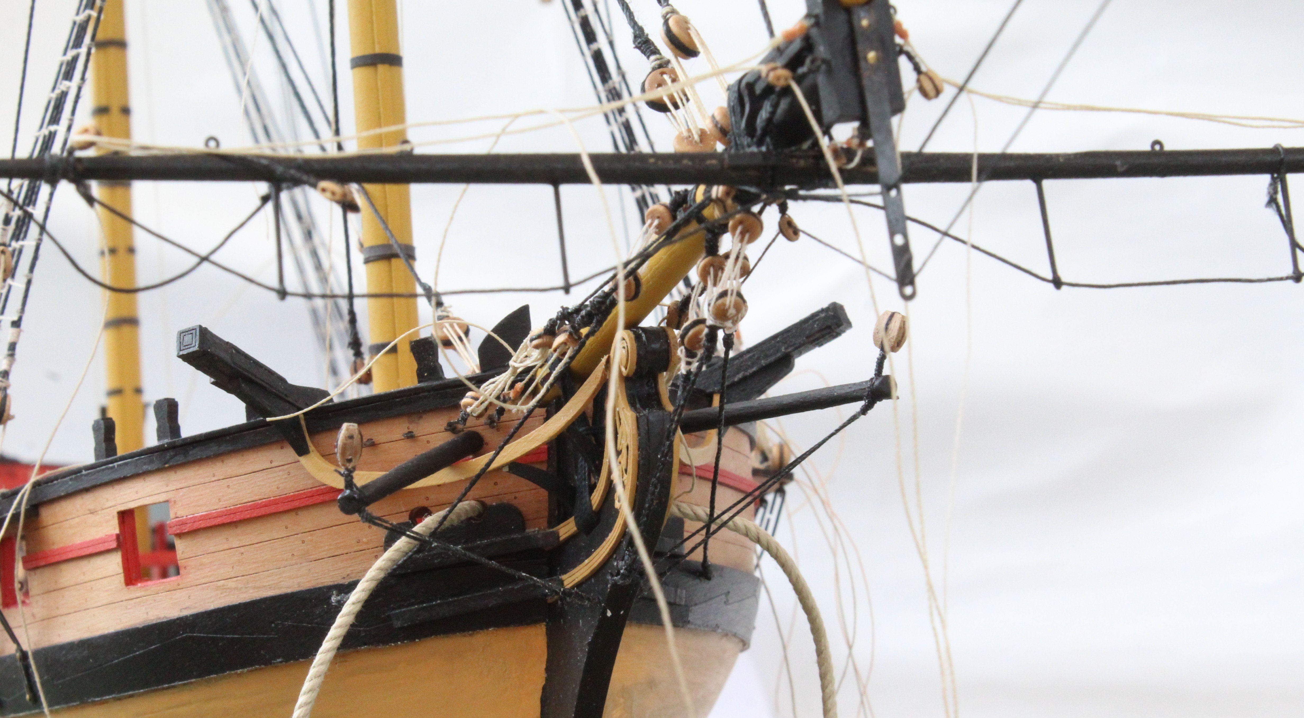

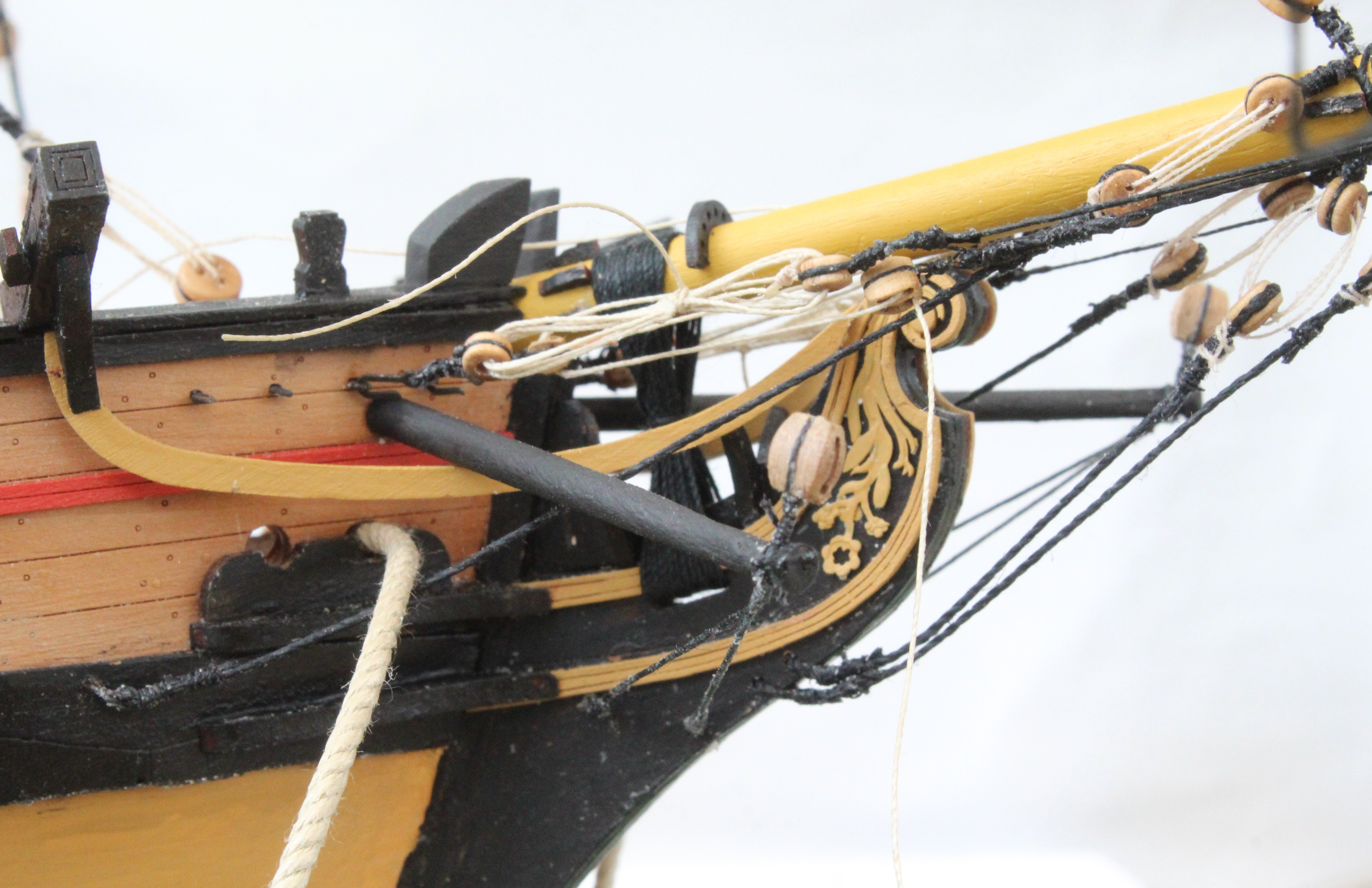

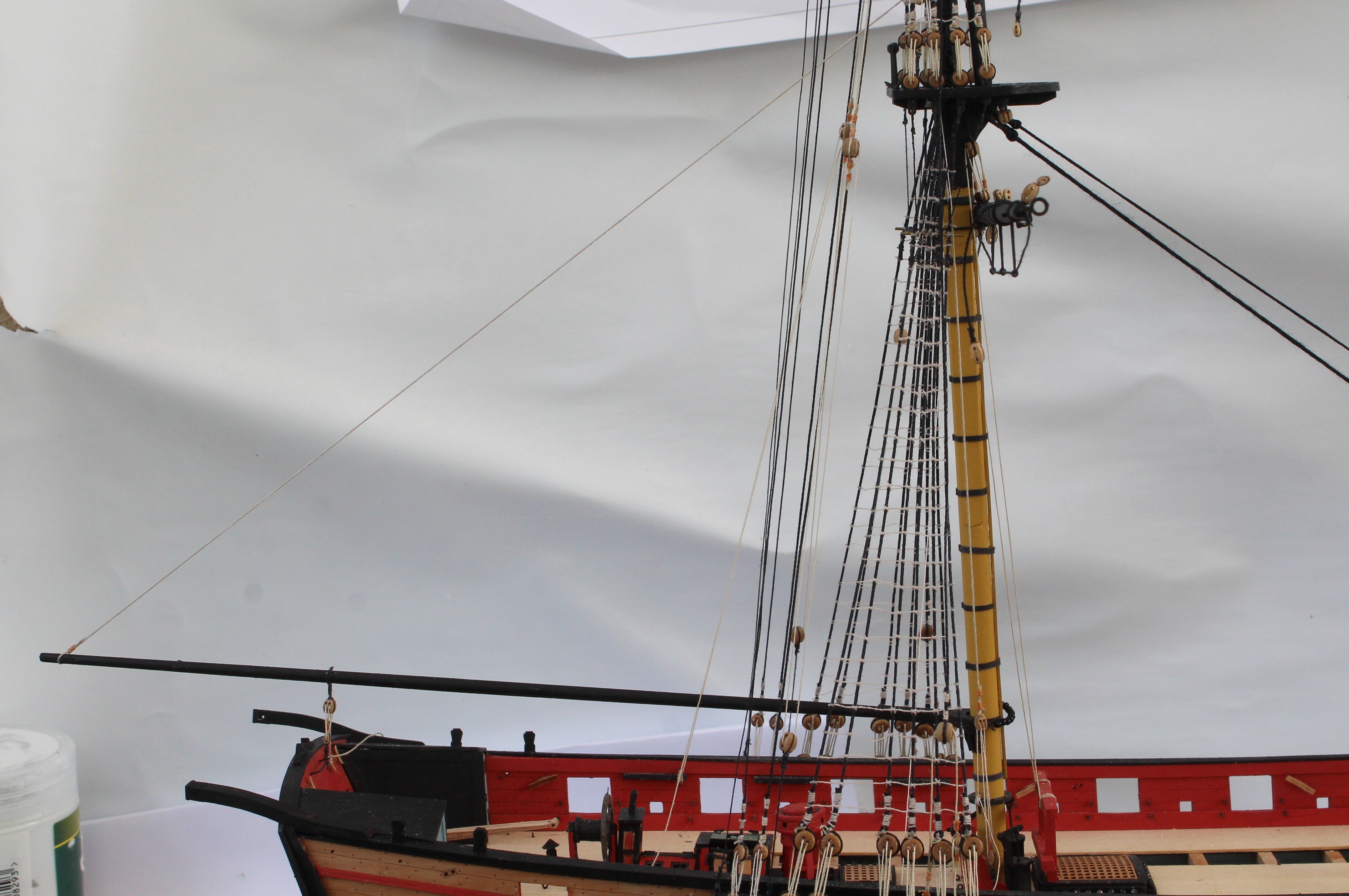

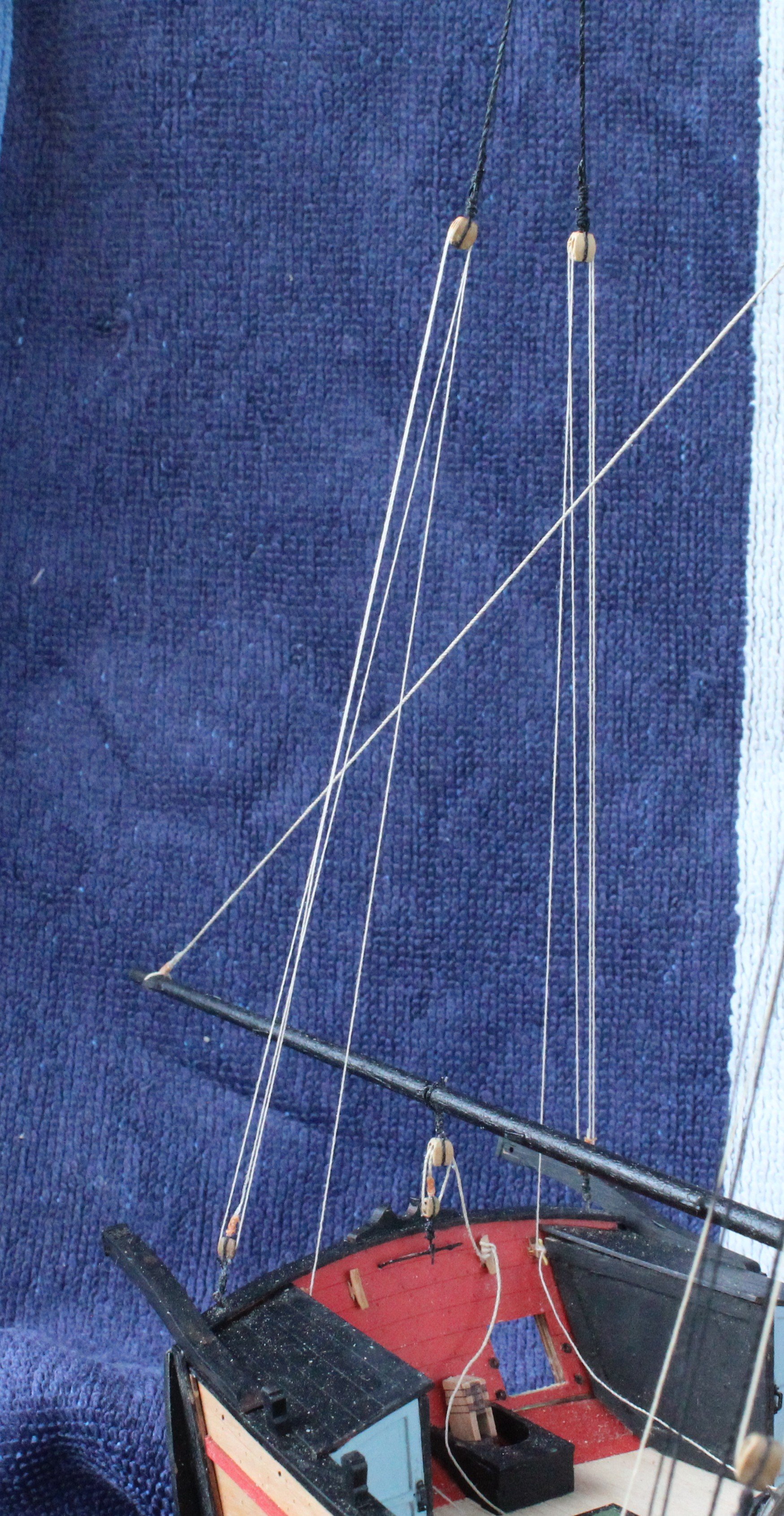

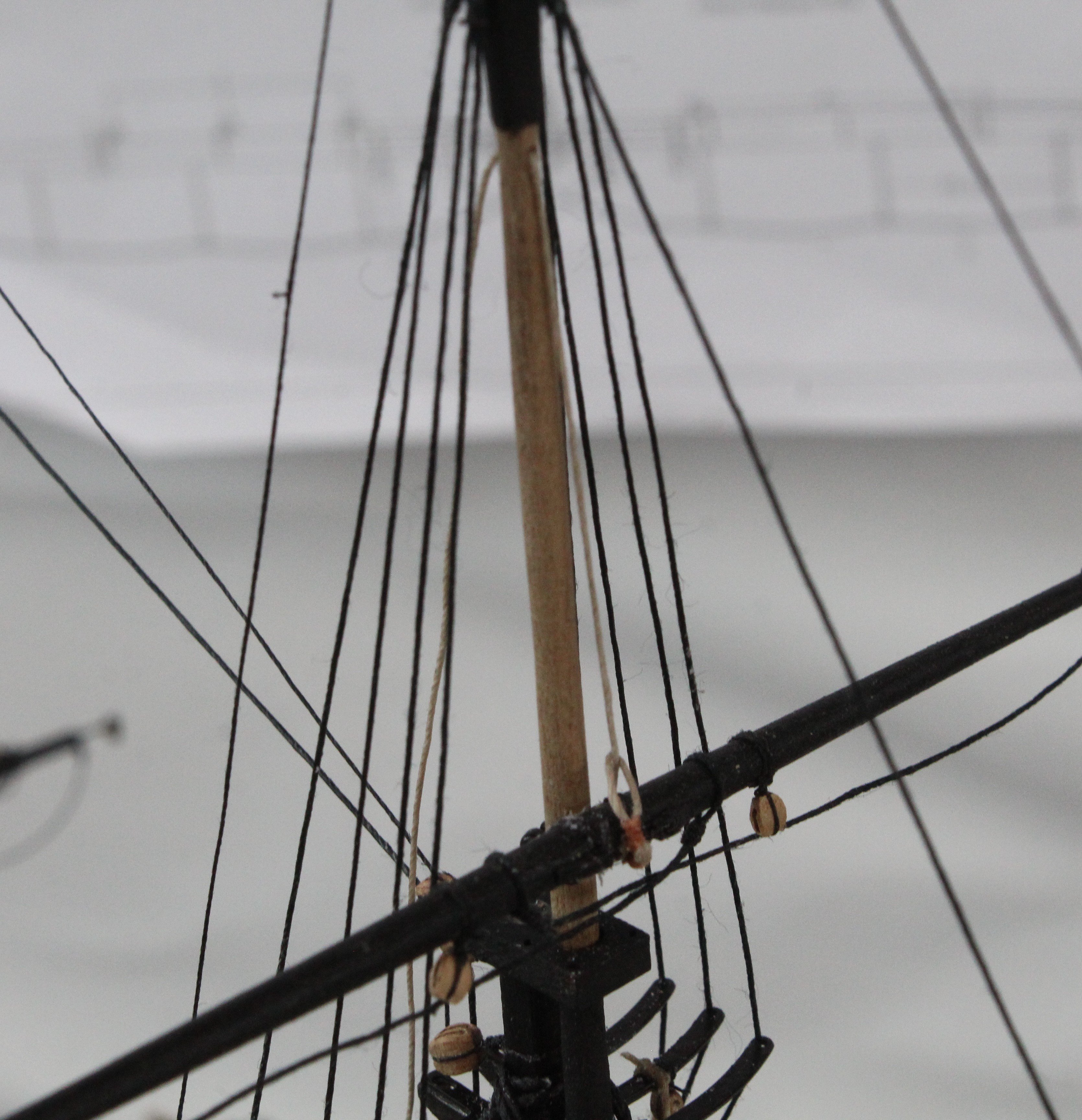

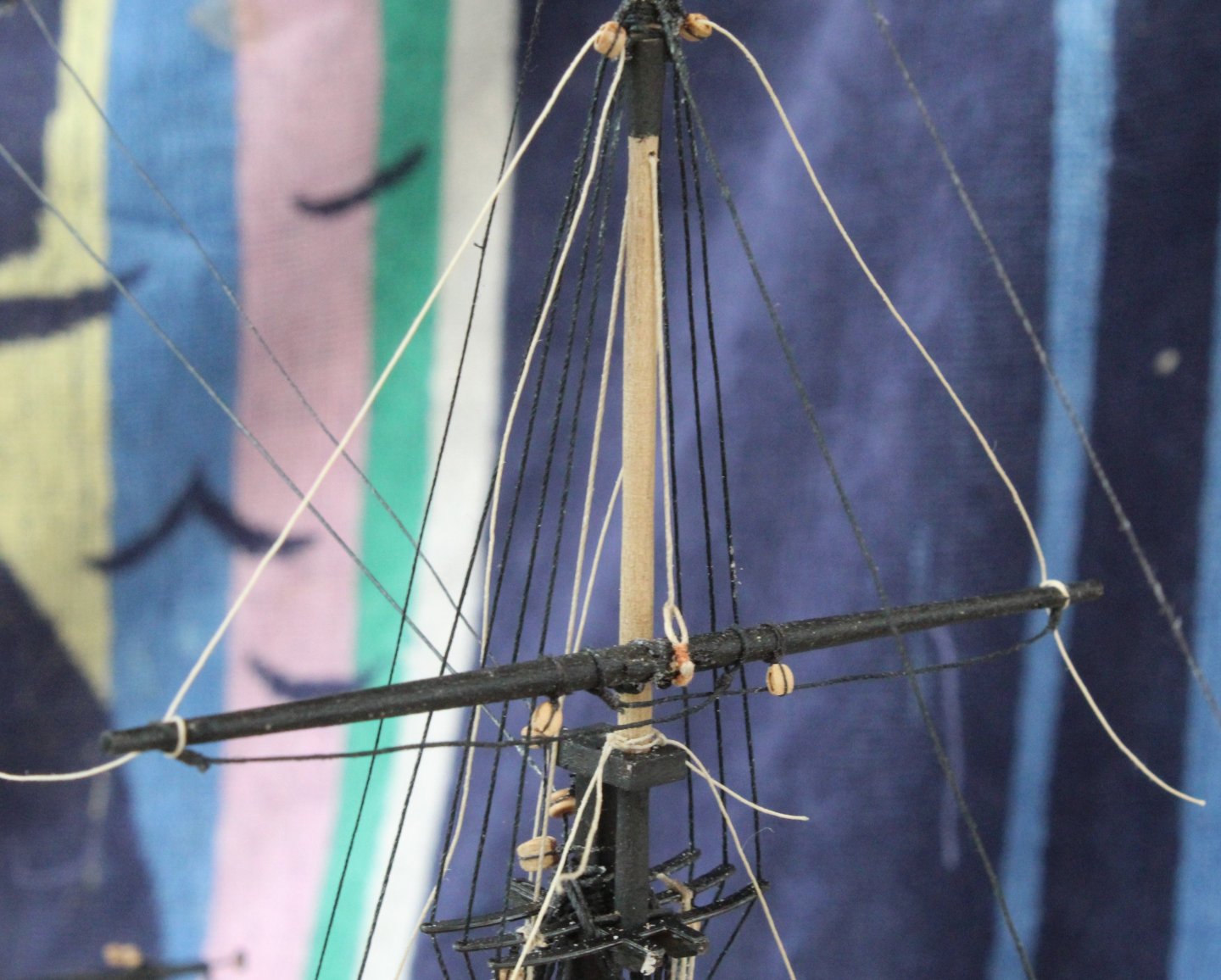

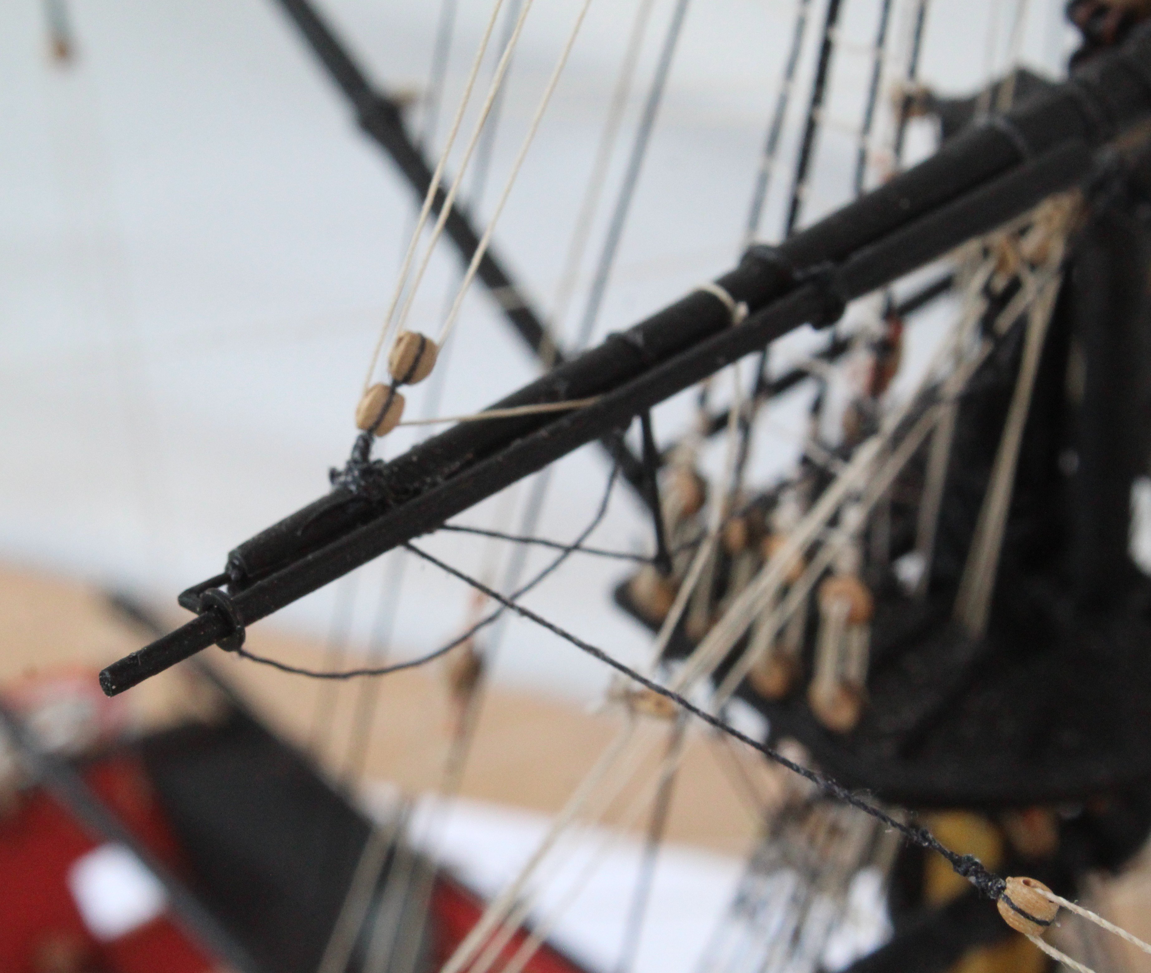

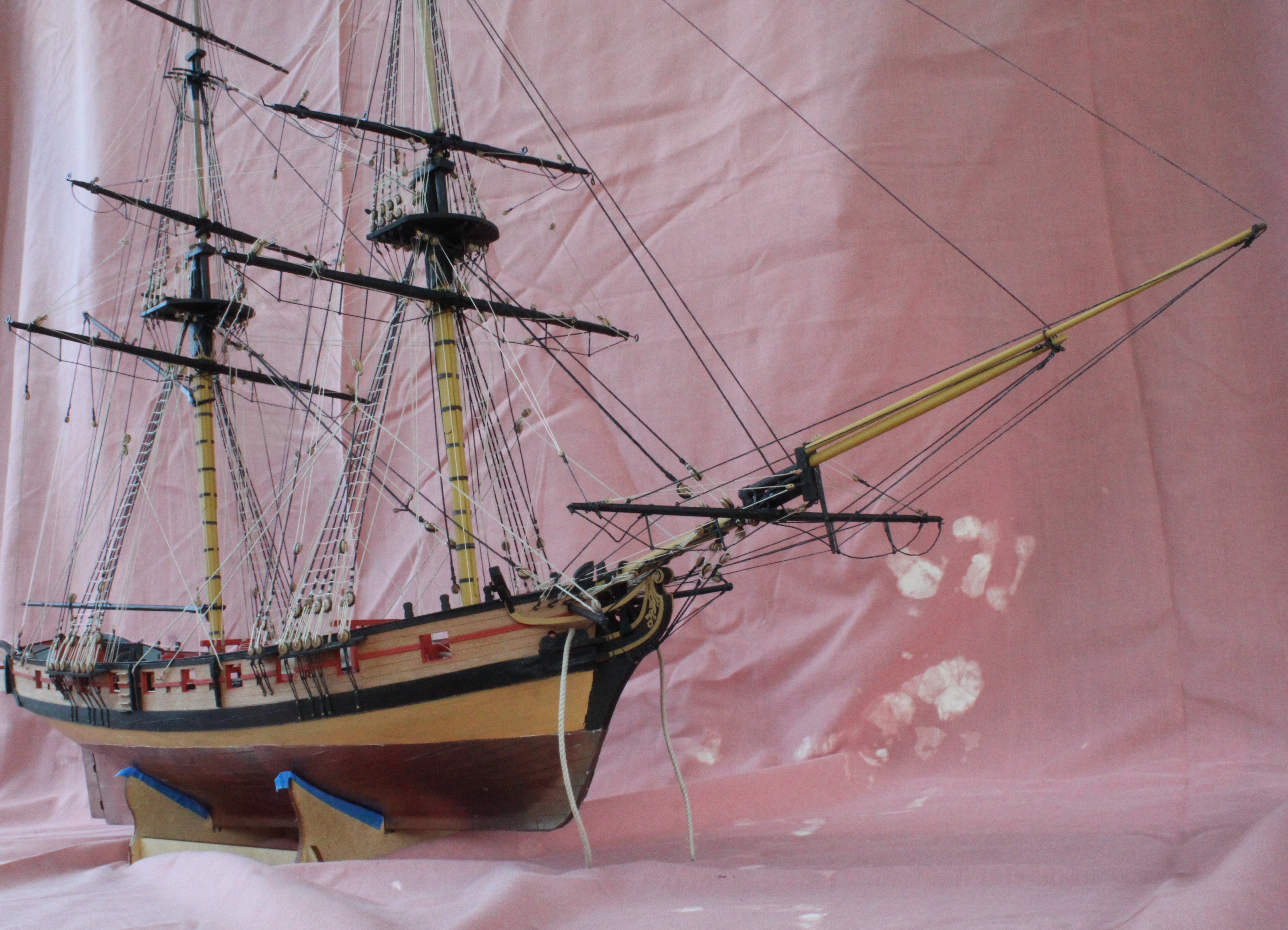

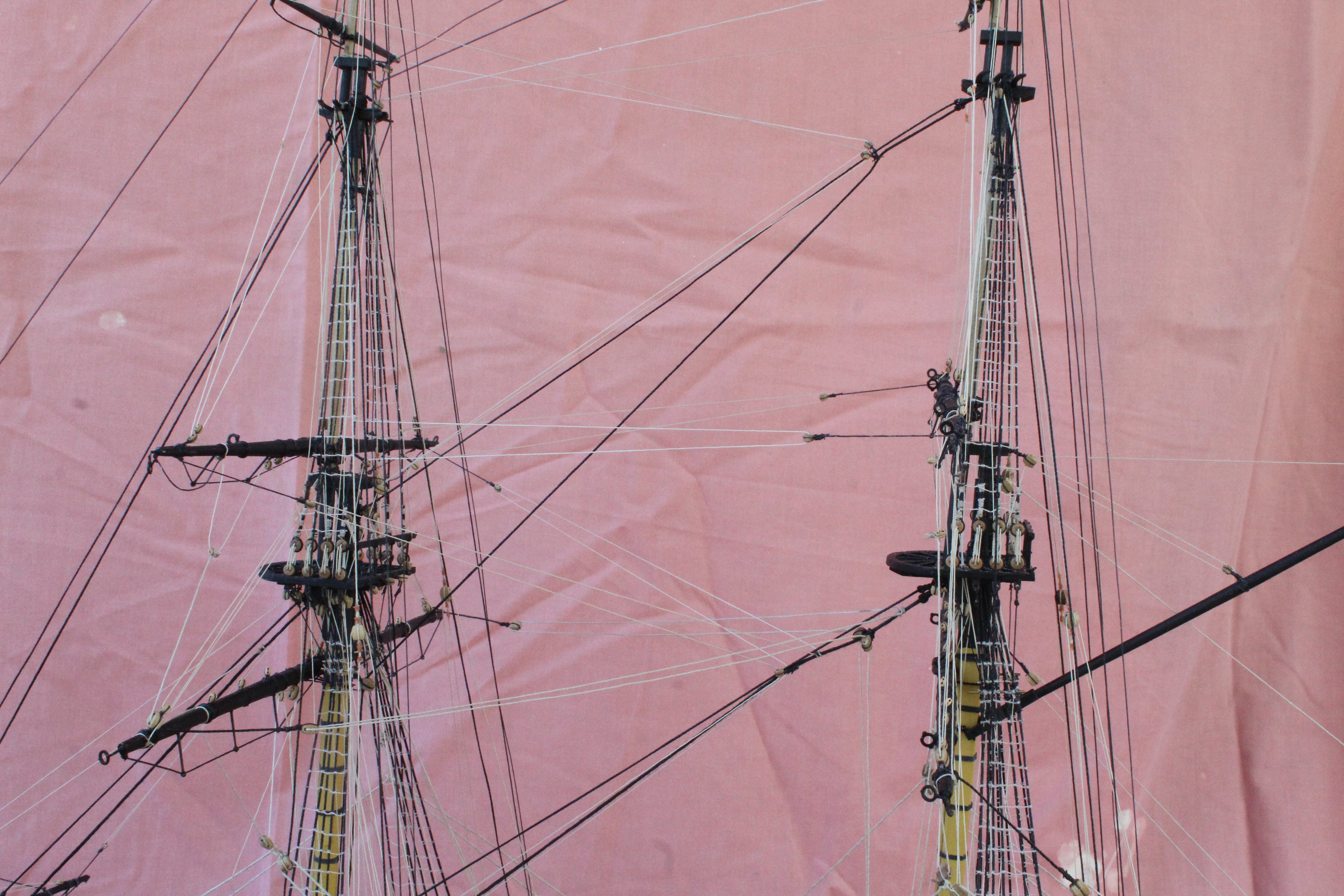

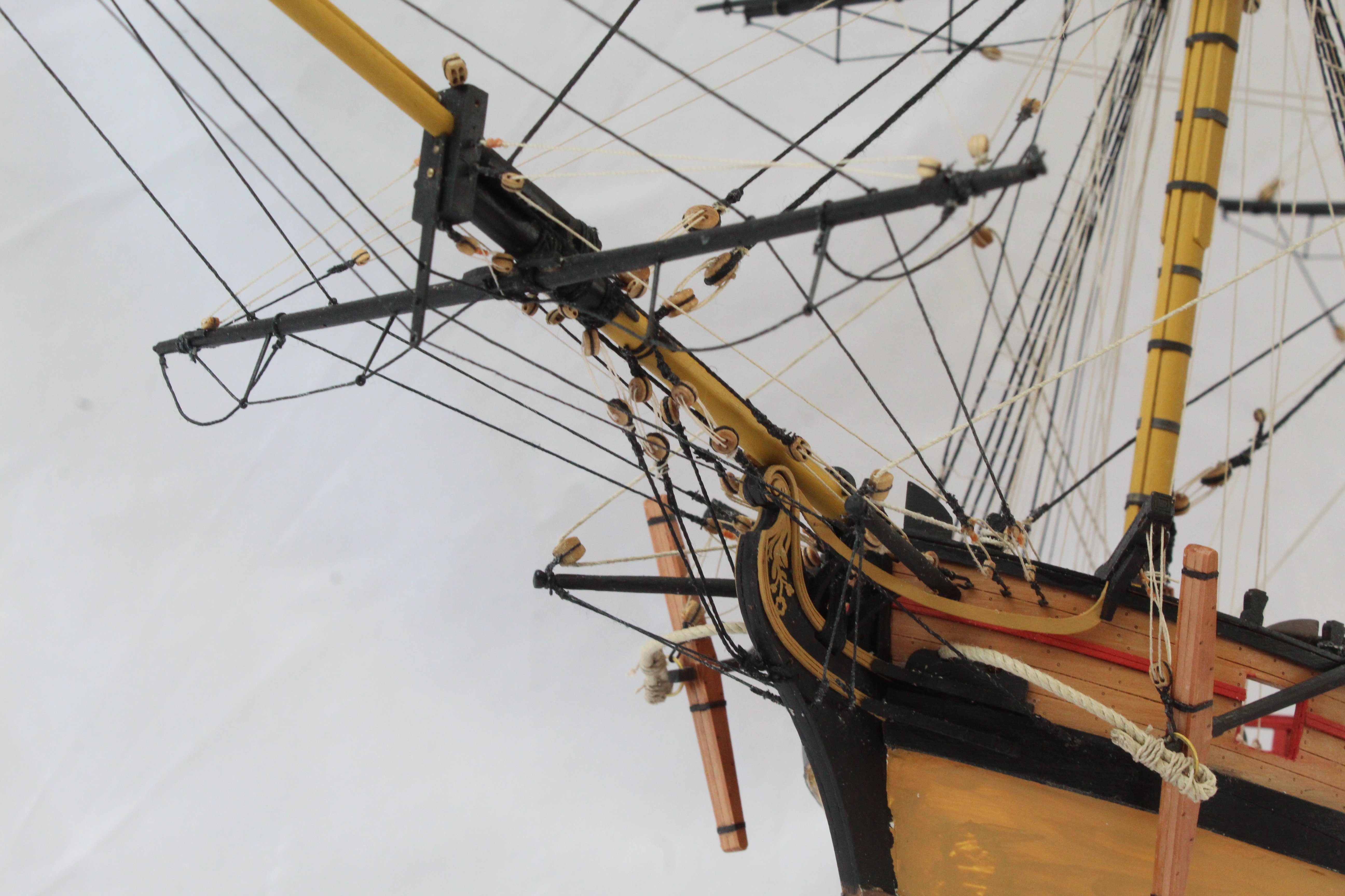

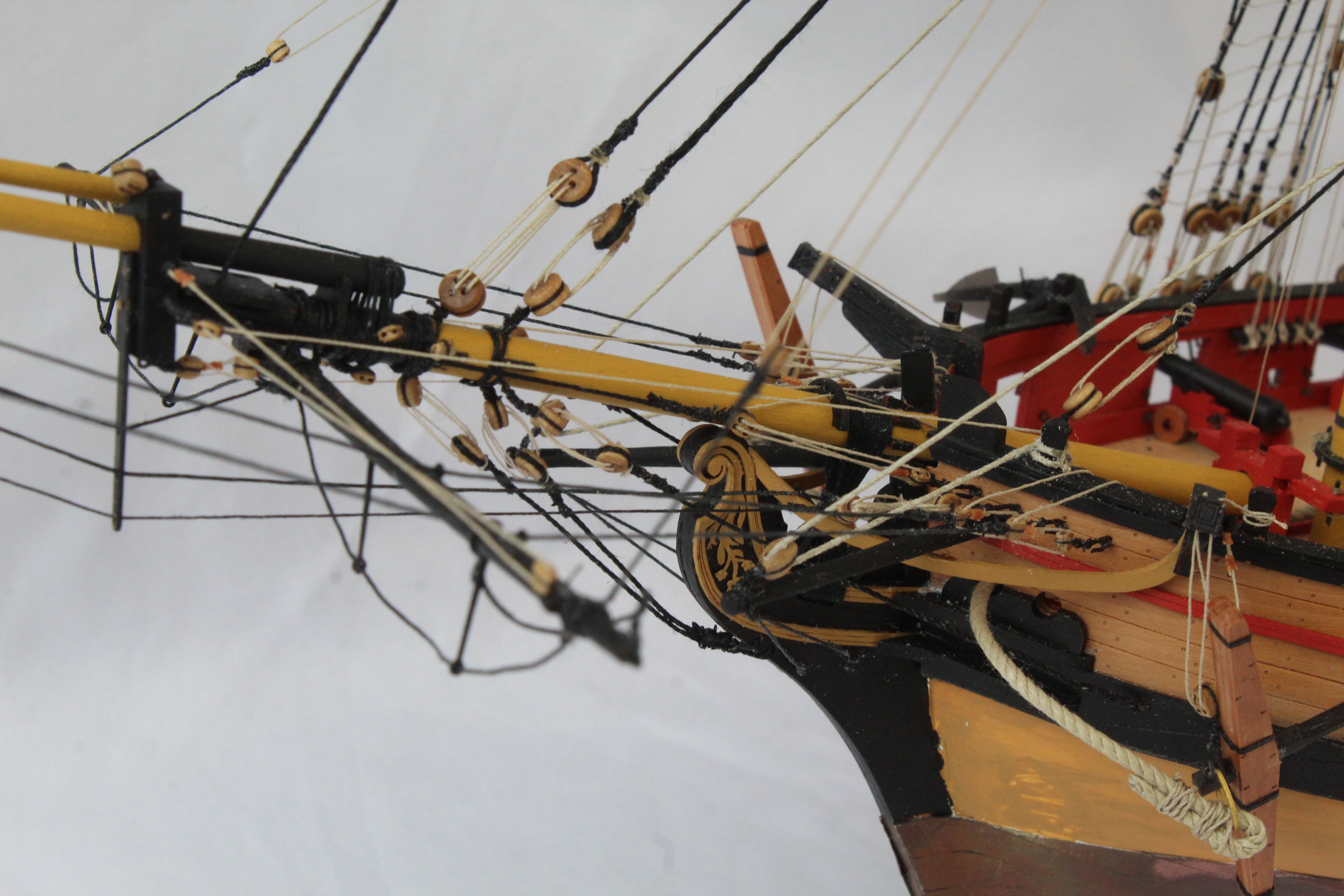

Before moving on to making and adding the boomkins I decided I should add both the jibboom and flying jibboom so the fore topsail and fore topgallant stays could be rigged.
The first two photos show the jibboom and flying jibboom in place.
001.thumb.JPG.b82d6669418b3be7947dcdf4d9499e4a.JPG002.thumb.JPG.9a52f1507fc993b7c200d8a8ac7008ff.JPG

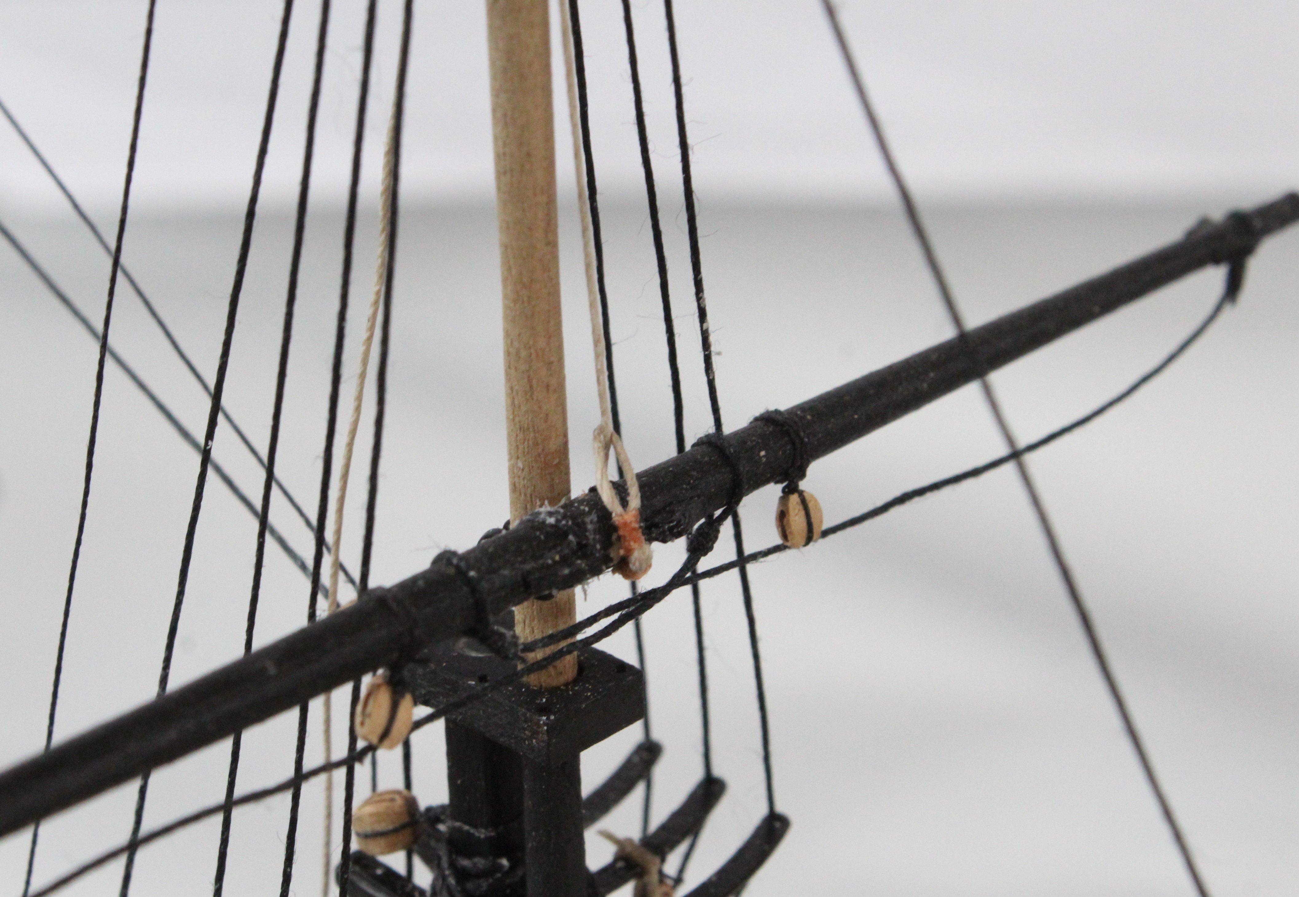

The dolphin striker was also added. As you will note, when looking at the photo, I made an error with where the fore topsail sail stay should be reeved. I used the upper hole rather than the middle hole. I only realised this error after I had added the thimble to the stay end. I concluded that I could accept this mistake rather than running in a new stay.
Both stays are belayed using thimbles, with the reciprocal thimbles for each stay hooked to eyebolts on the bow, as can be seen in the next photo.

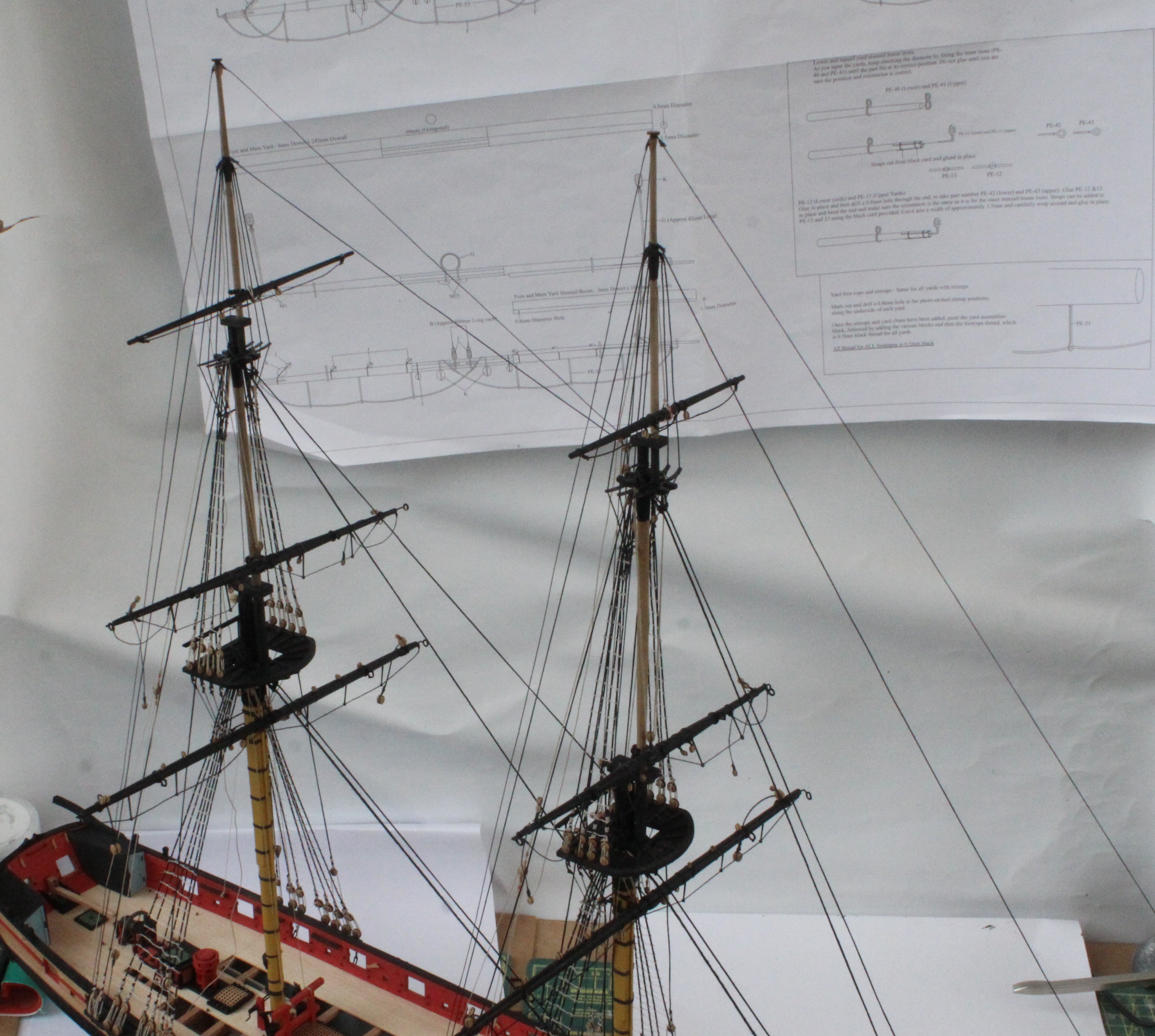

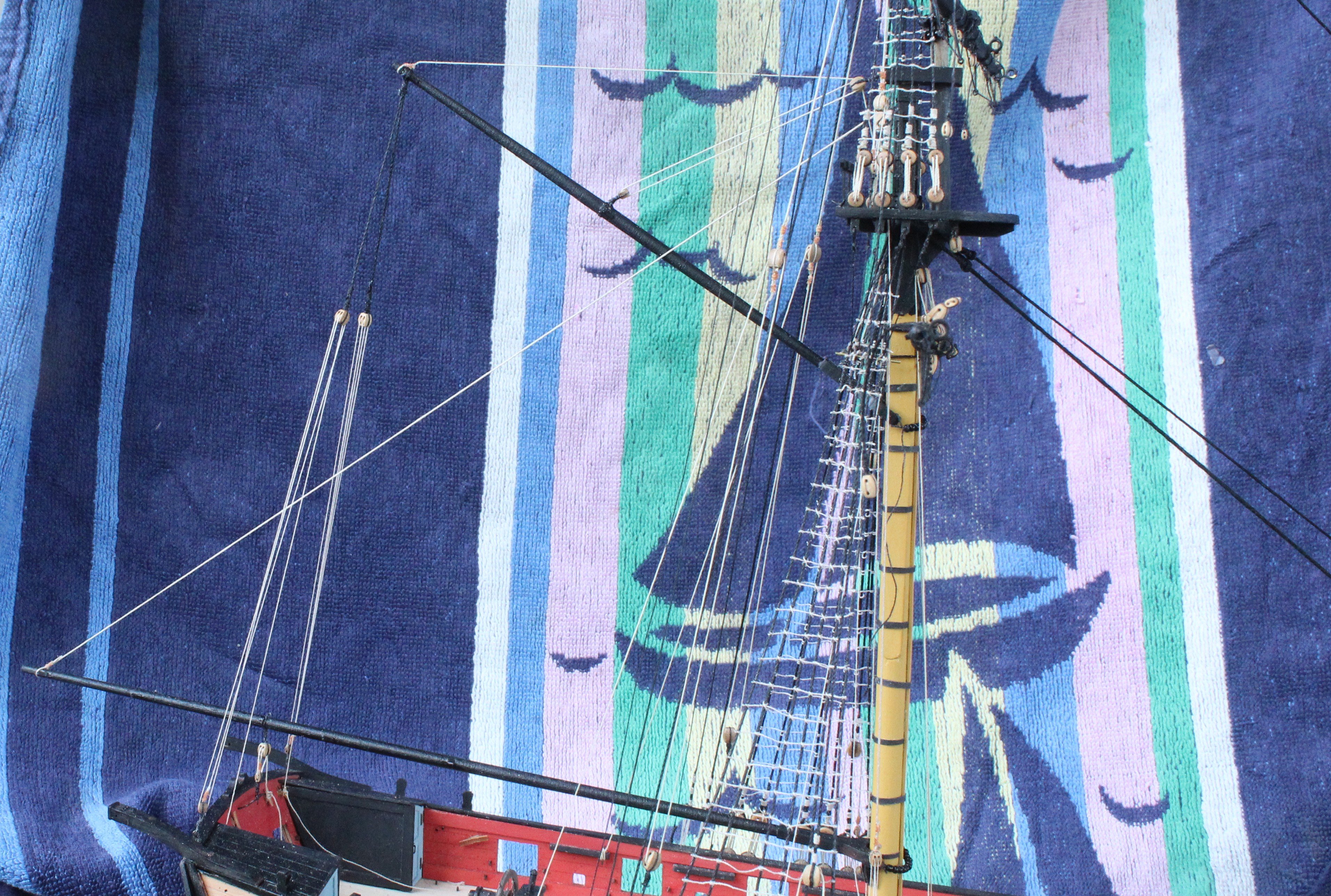

The next photo shows the foremast with the all the various mast stays in place.
The final photo of this post shows the current status of the Harpy rigging.
Glenn (UK)

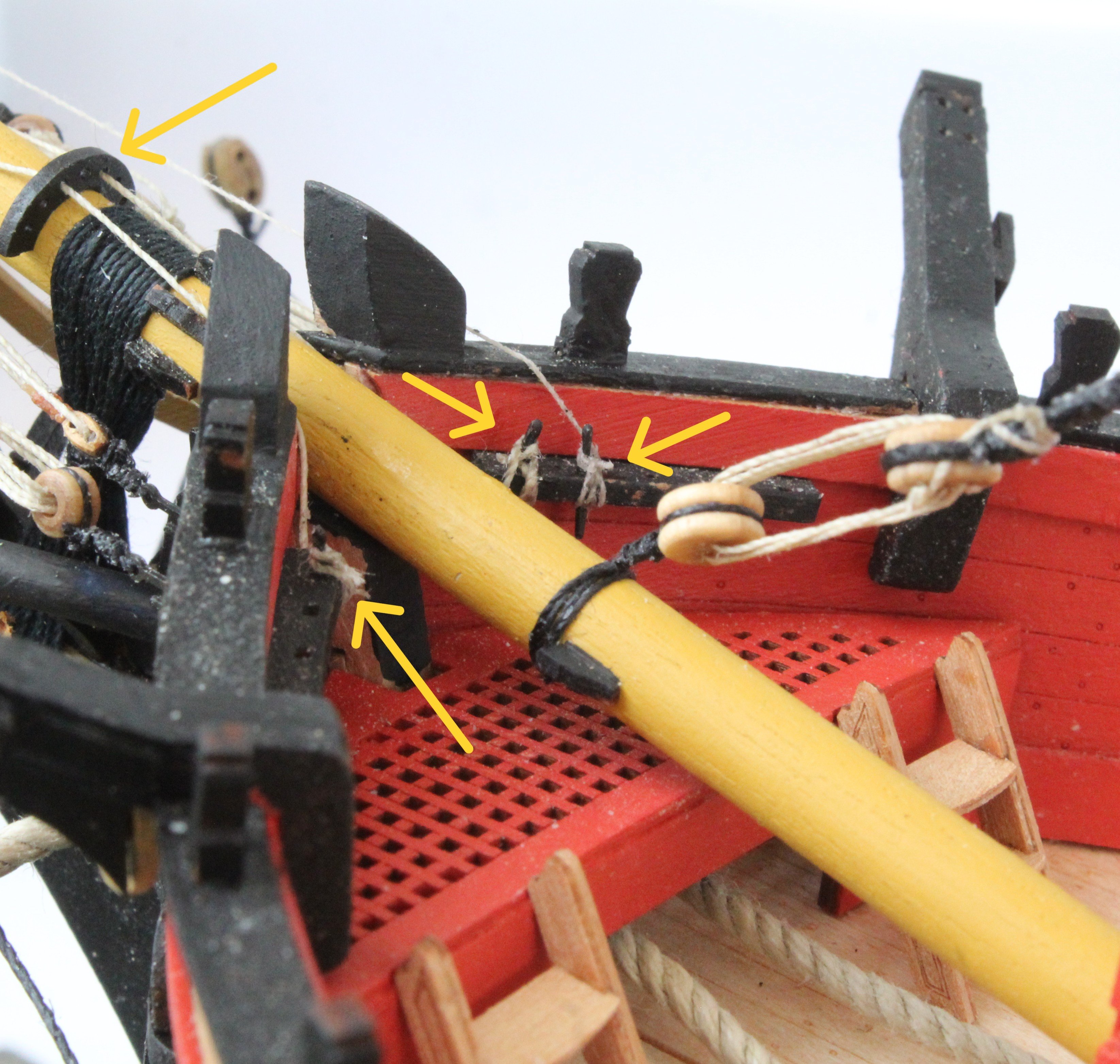

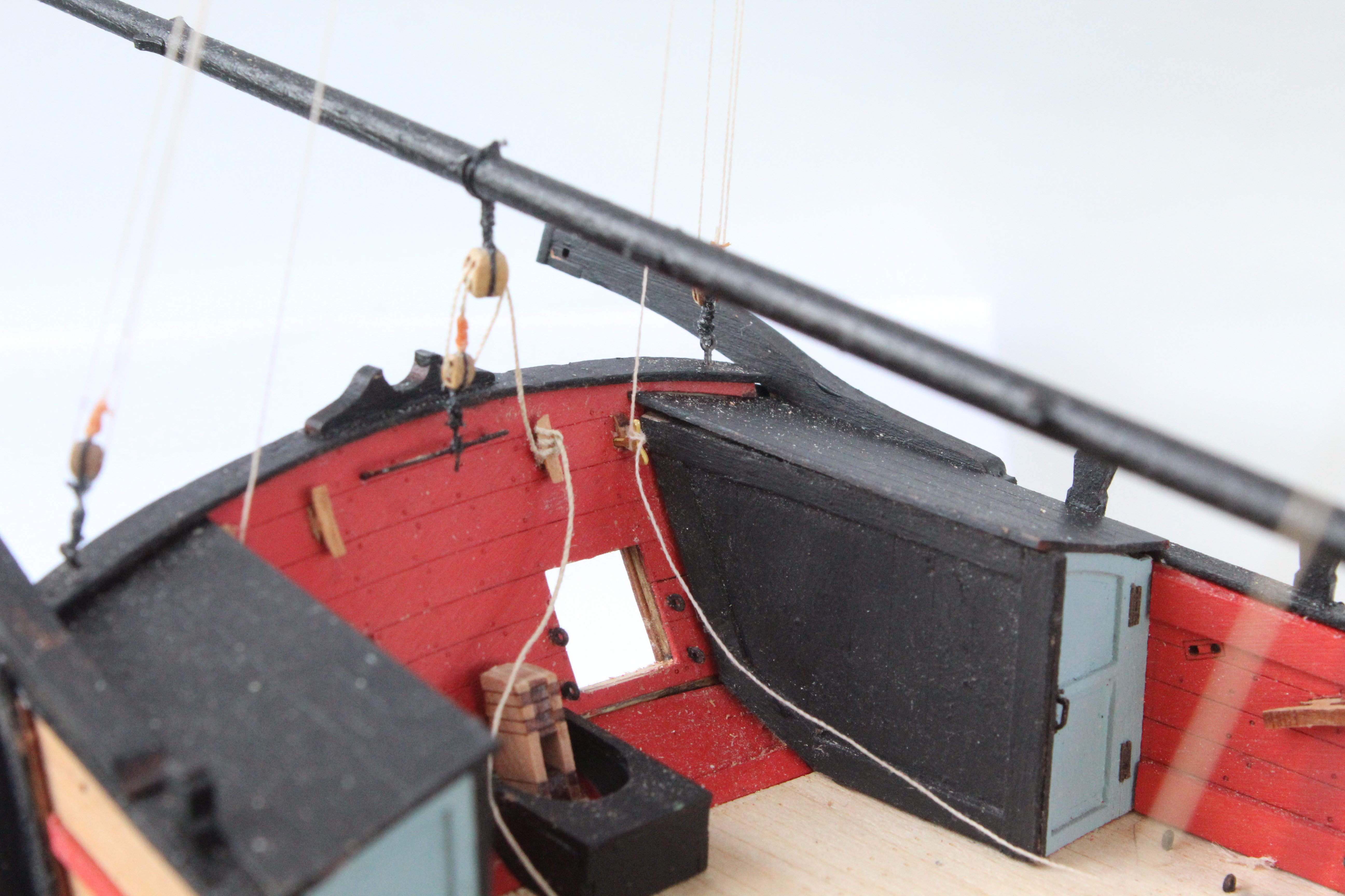

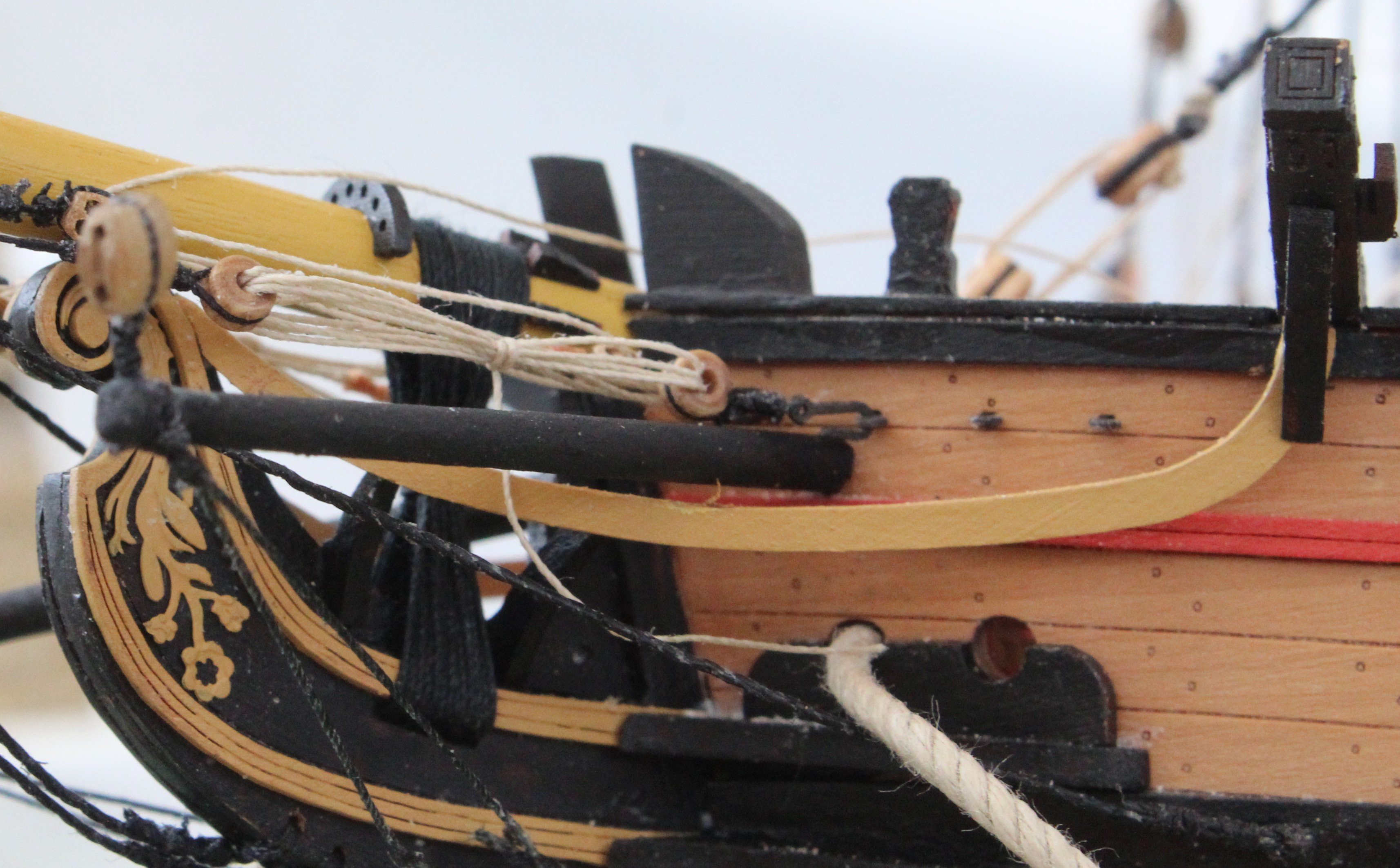

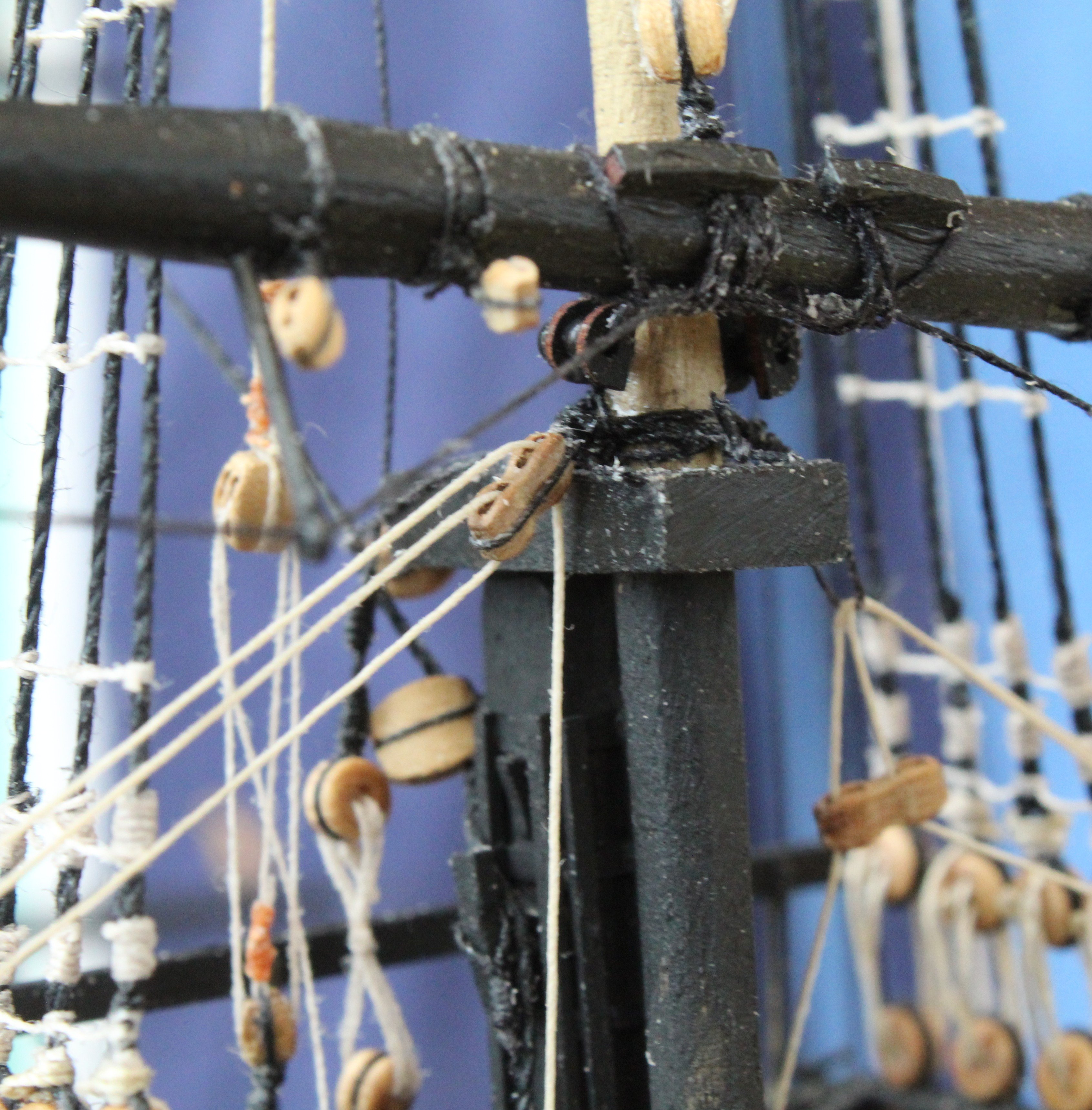

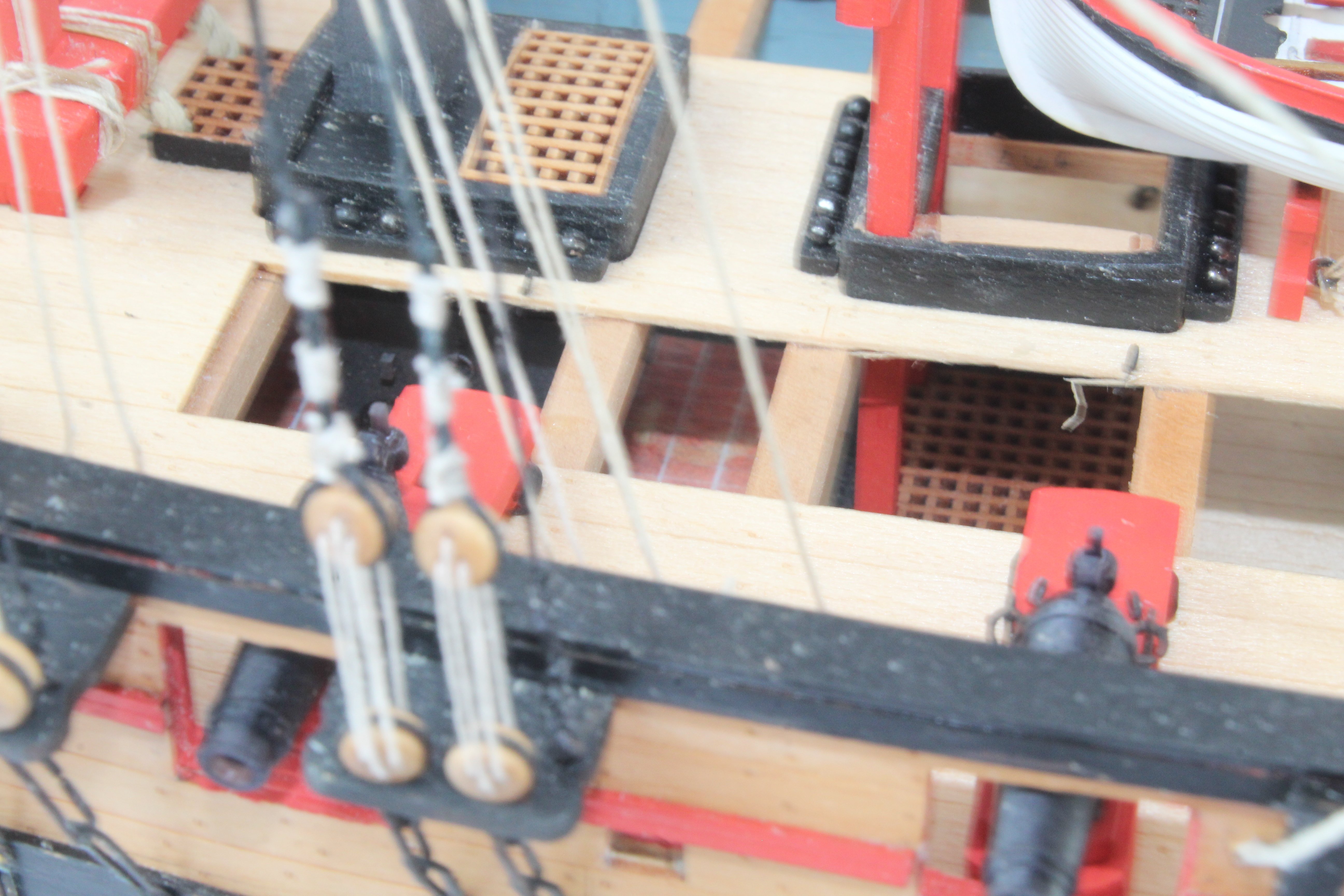

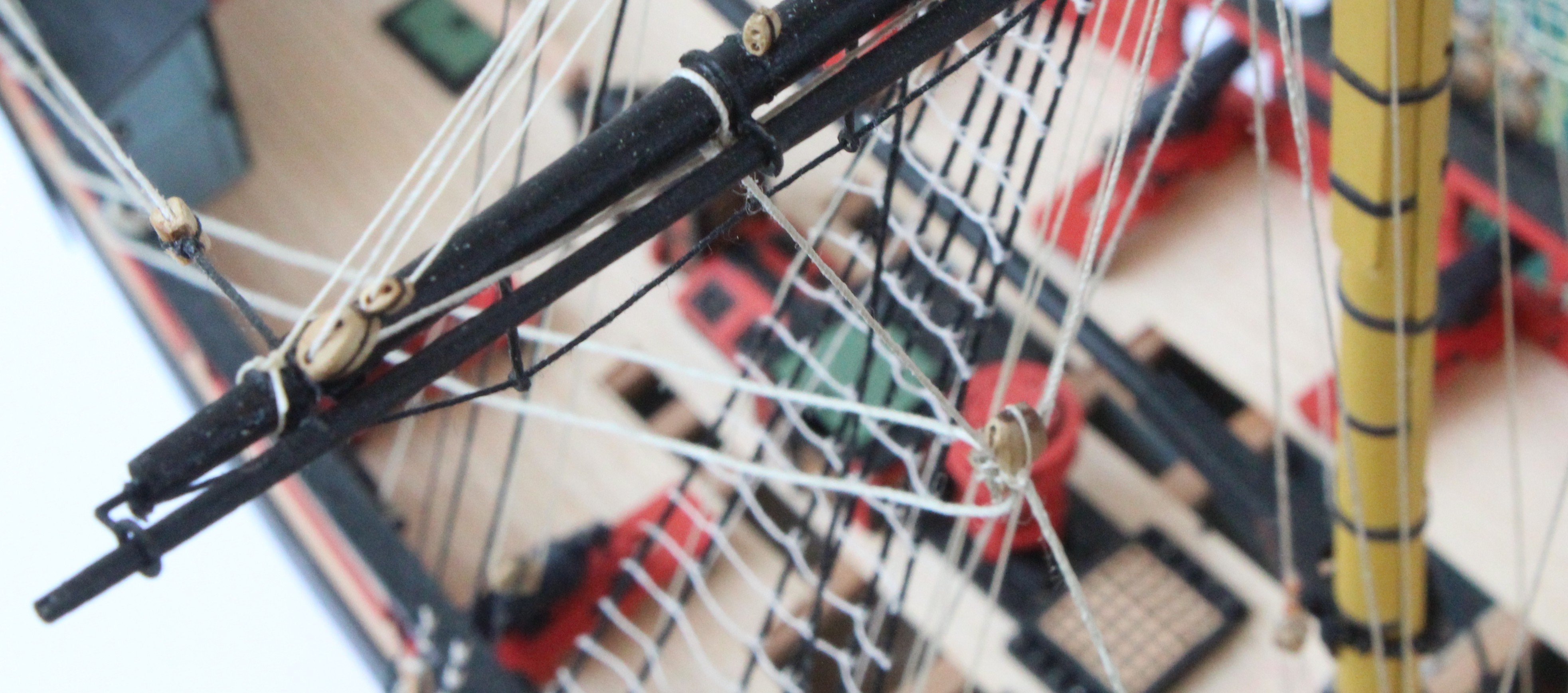

The two boomkins have now been added. It was a simple task to cut and shape two lengths of 3mm dowel as per the plan sheet. Once painted they were glued in place. The shroud were added along with the 5mm single blocks.
001.thumb.JPG.1a80586002a31cf896bc4ba702c5d52b.JPG002.thumb.JPG.618899ba028bdac1d82887b5bd87862c.JPG003.thumb.JPG.a6197d041d41ddaba3ef2462088378a0.JPG

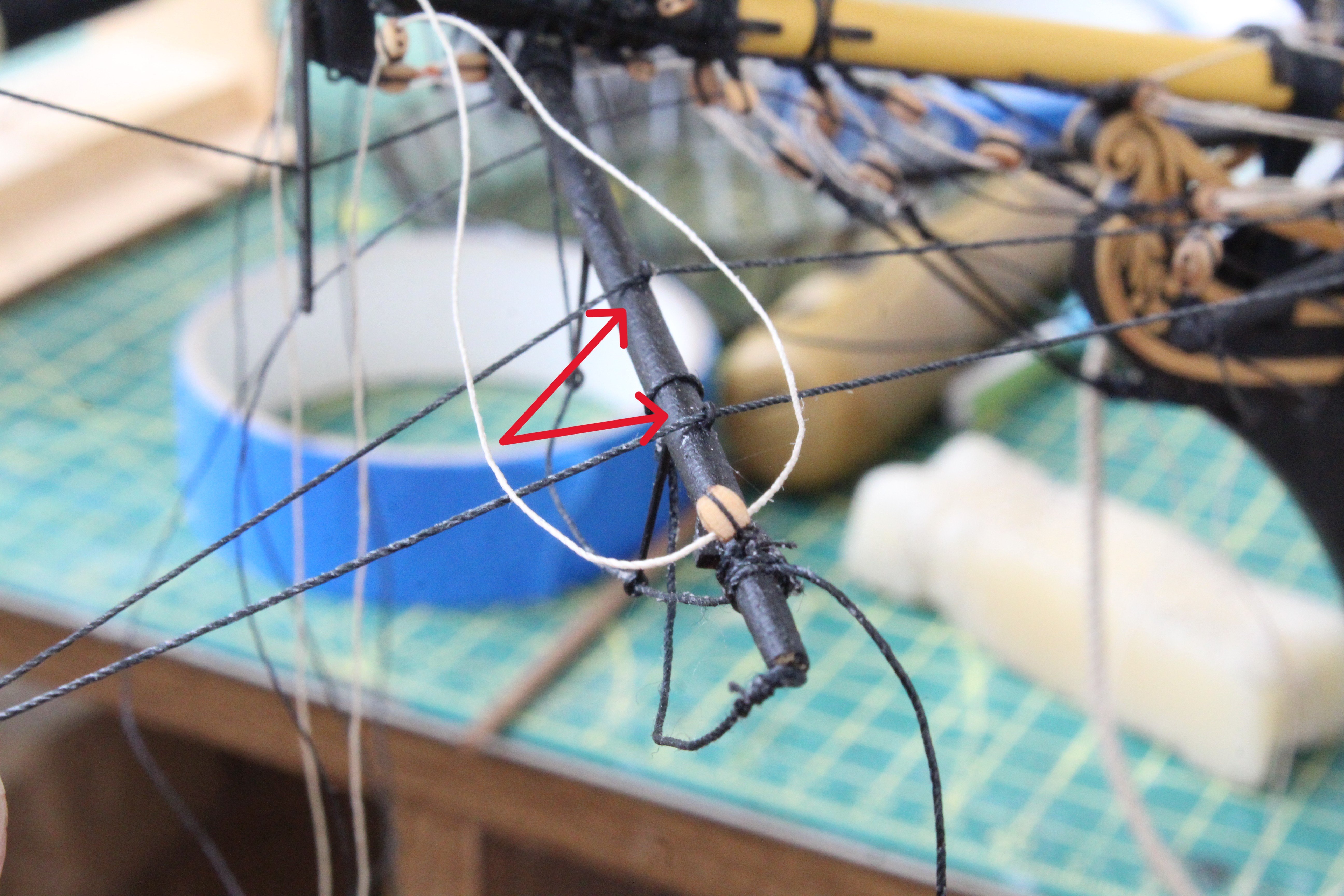

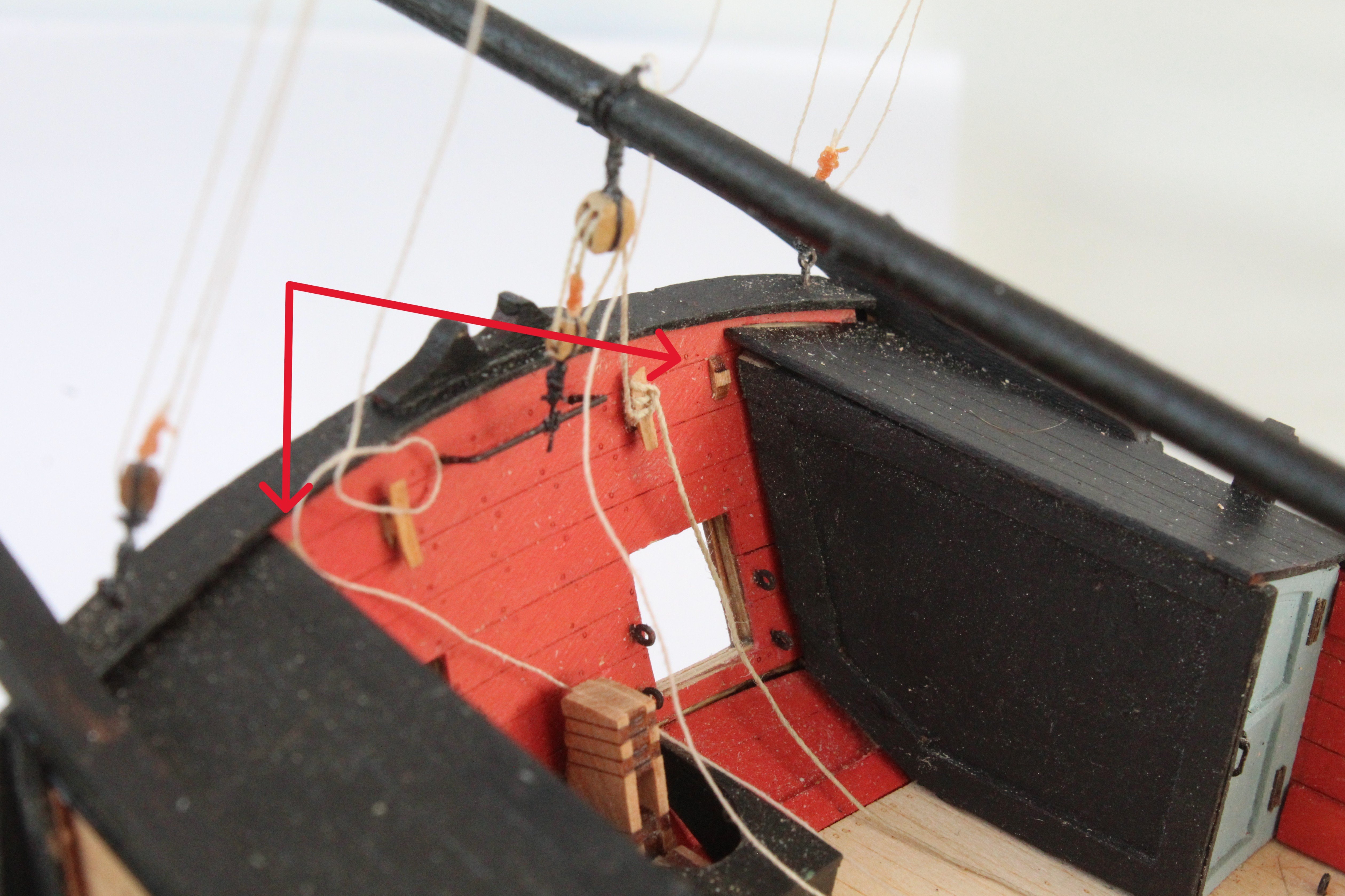

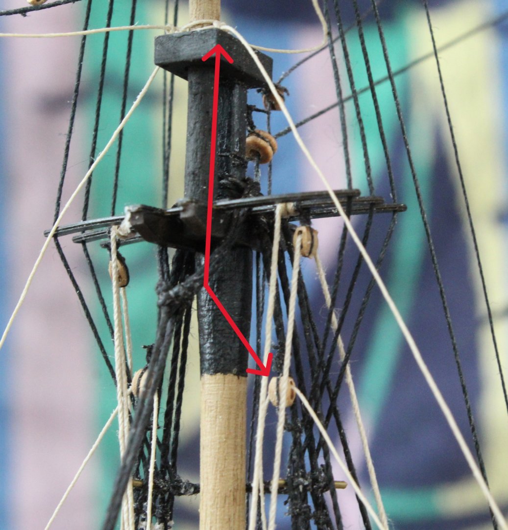

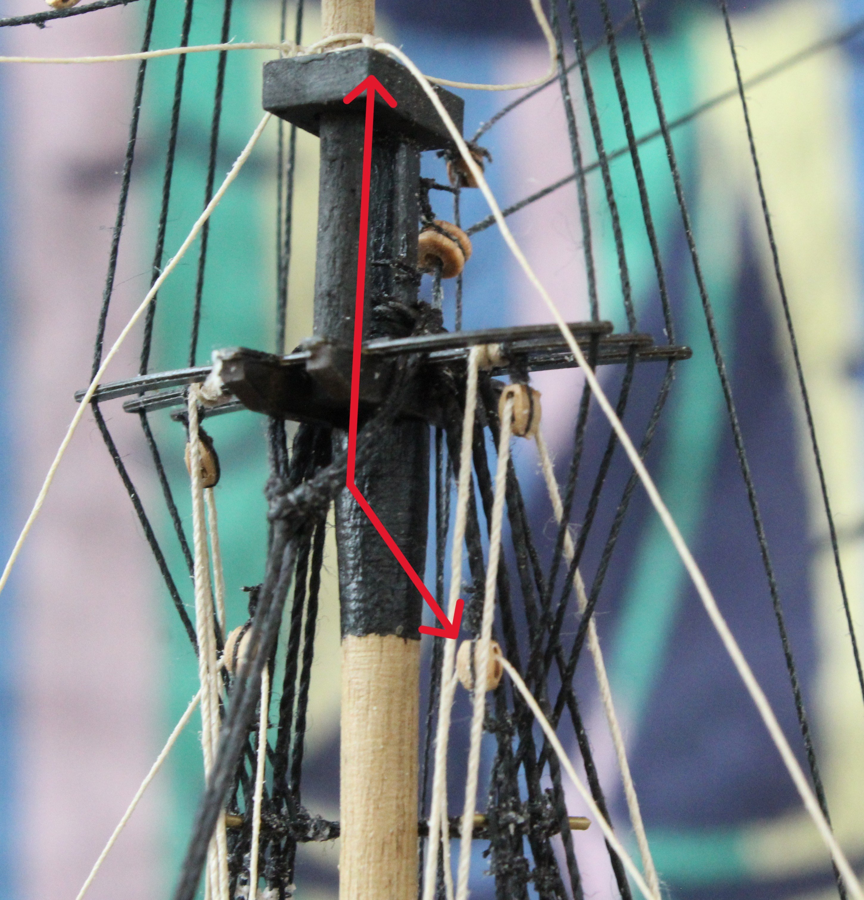

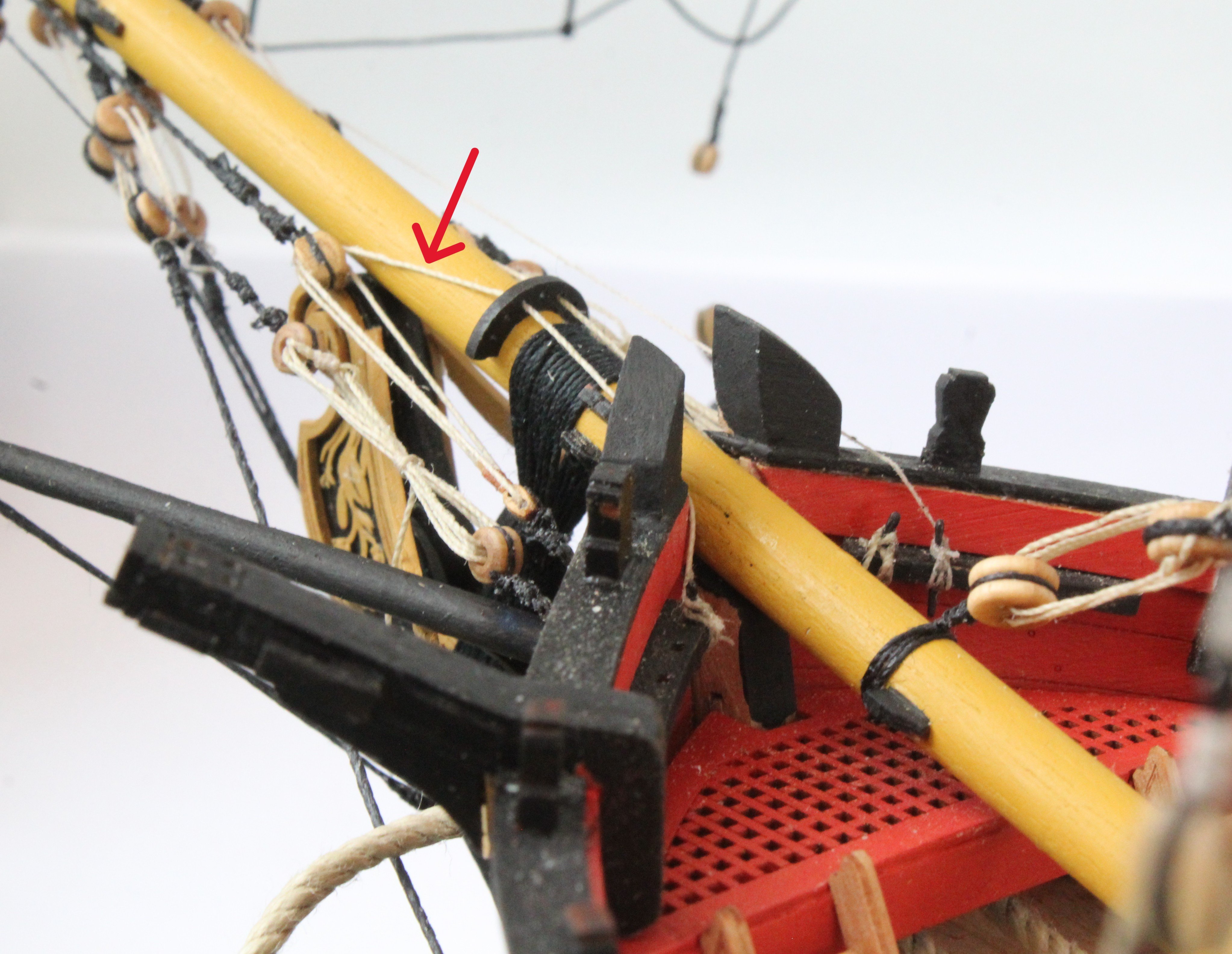

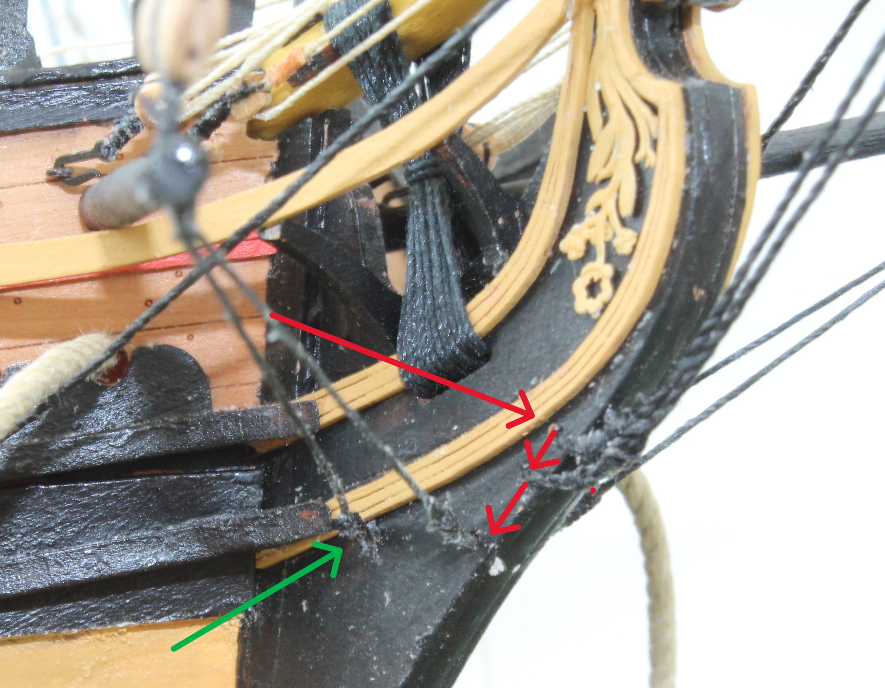

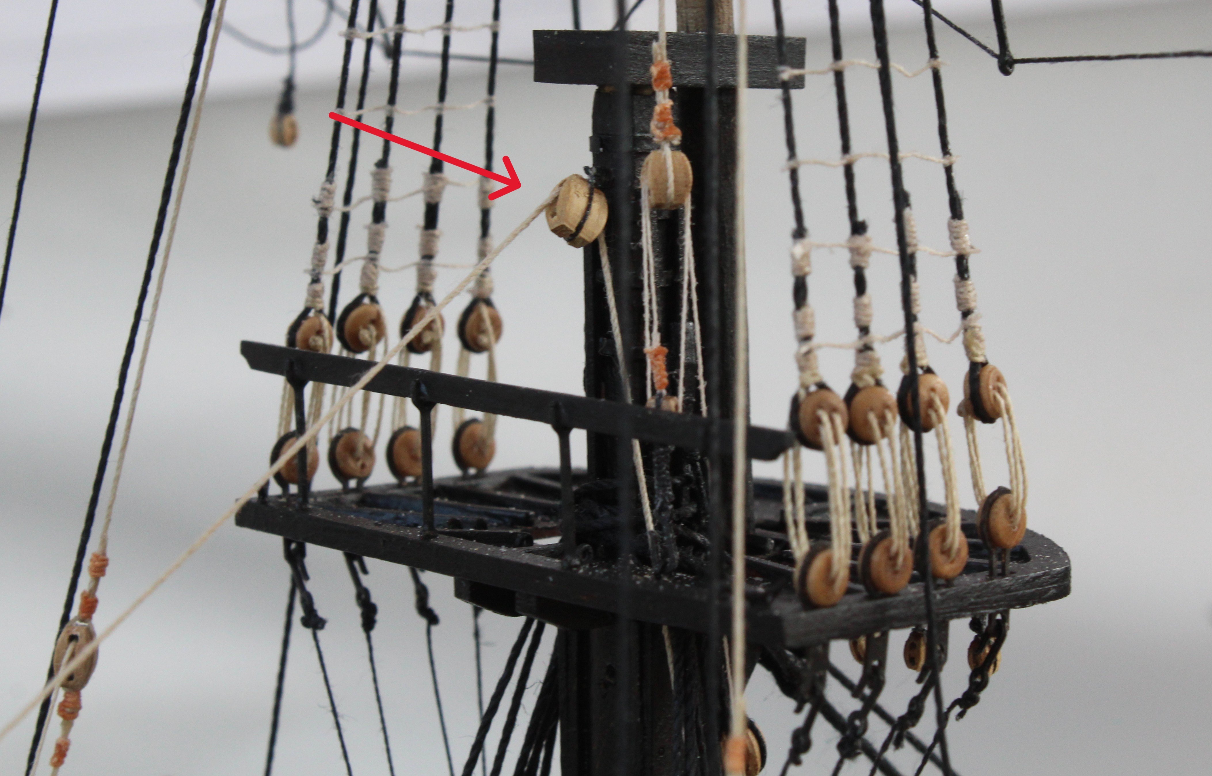

The boomkin shrouds were added, as shown below. Can you spot the error I made?
The next photo shows the error. The green arrow shows what I did right. The three red arrows shows where the various shrouds should have been placed. Thankfully, as far as I am concerned, it does not matter as no one will notice this once the model has been completed.
Glenn (UK)

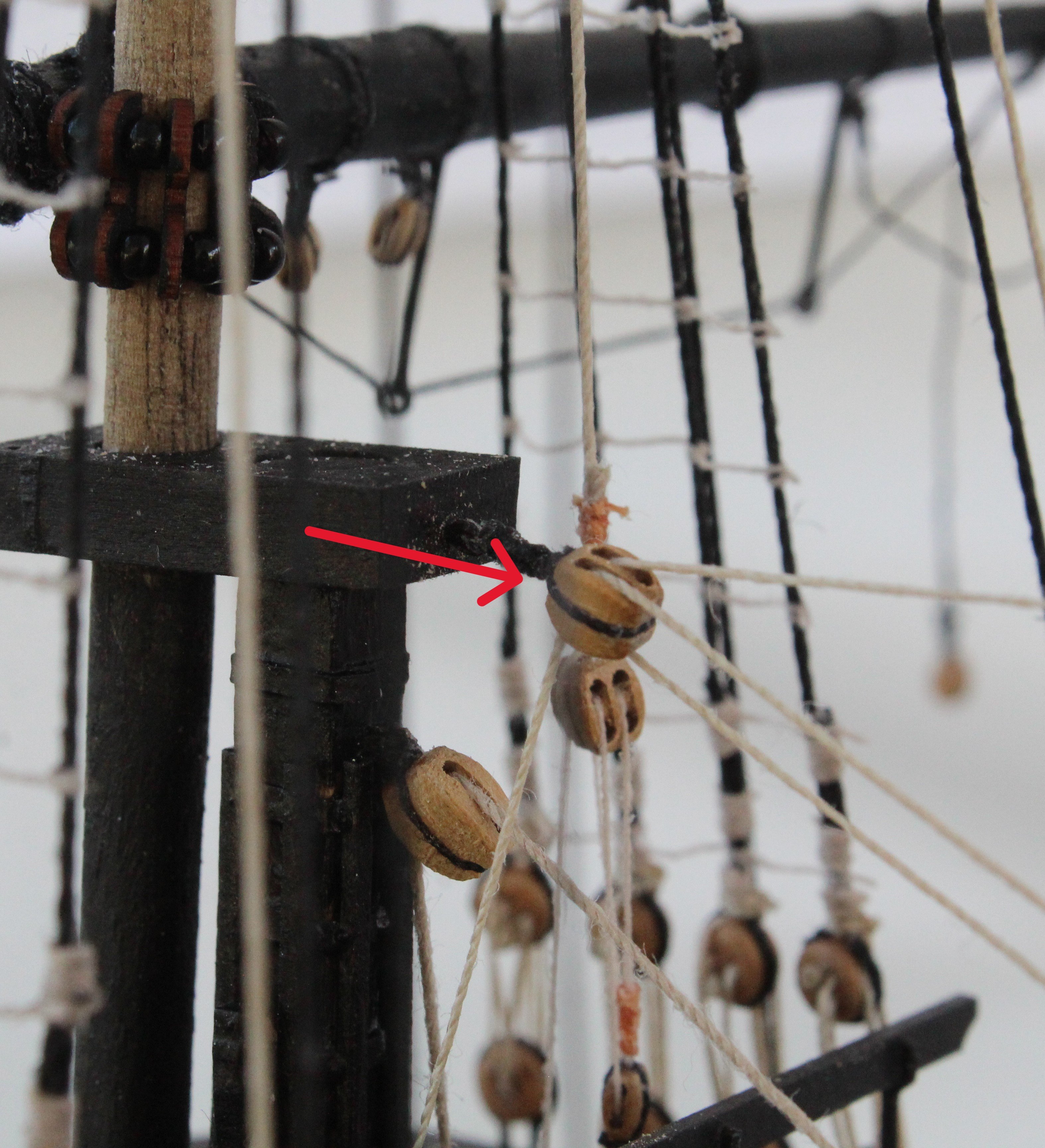

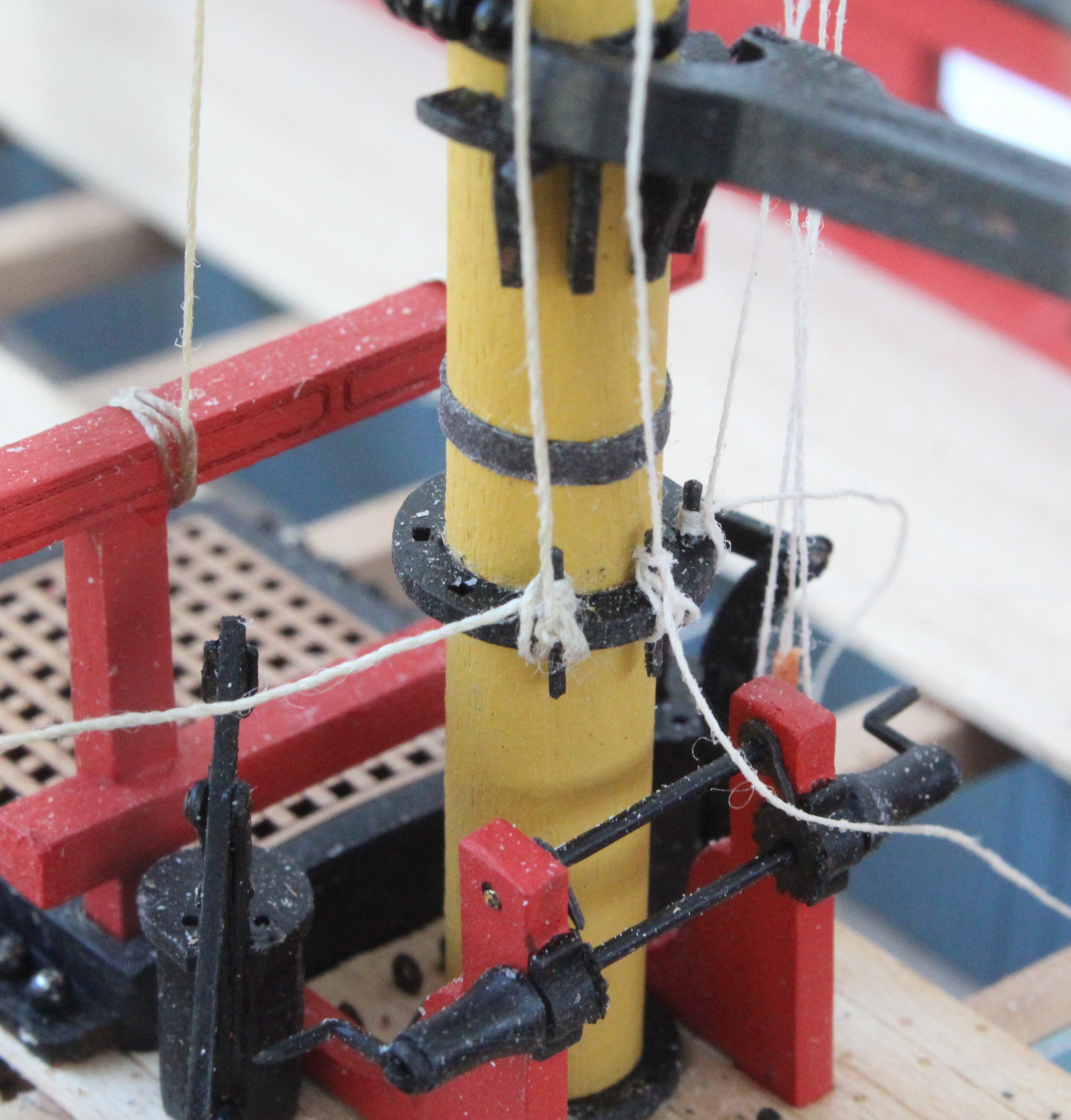

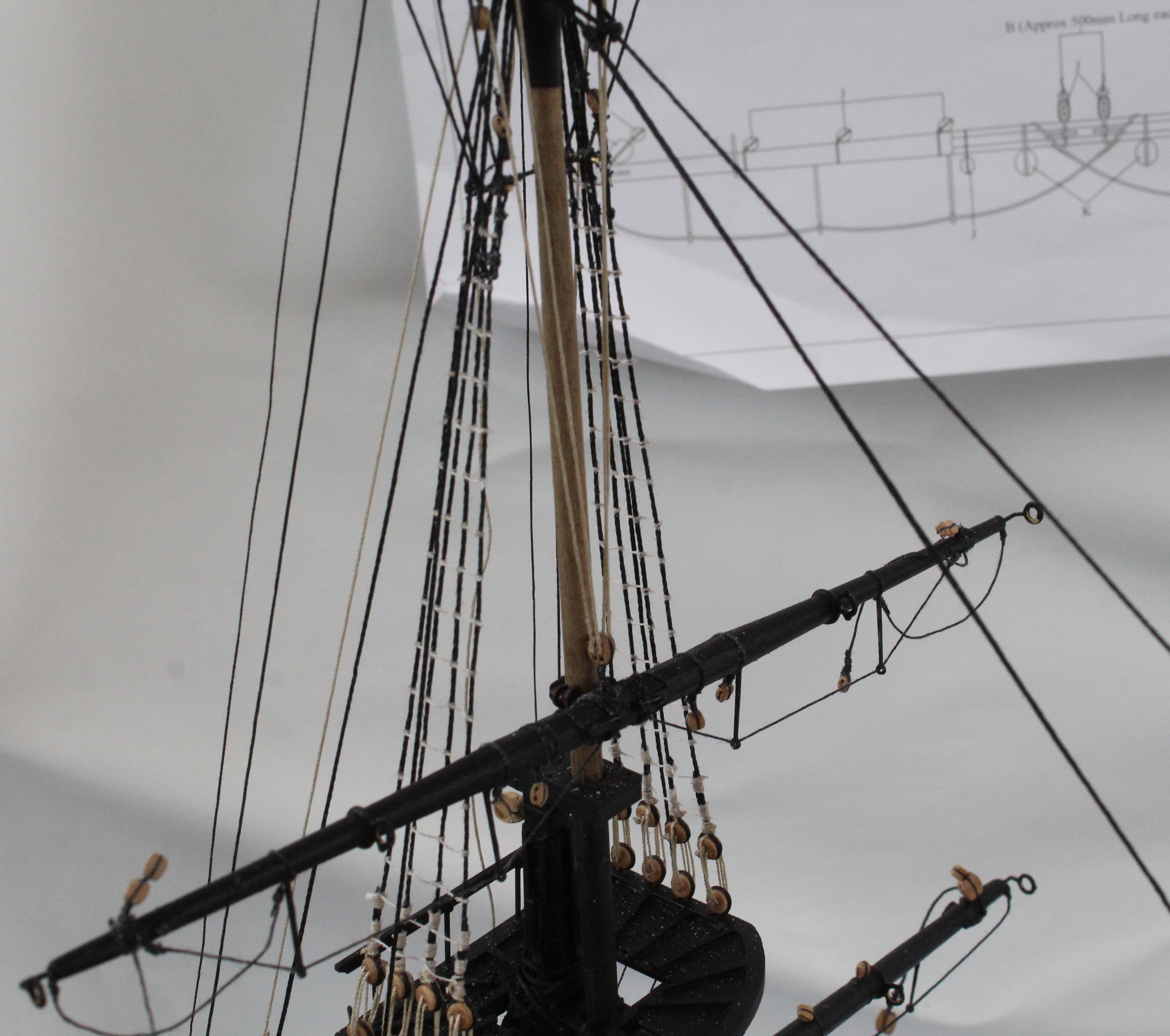

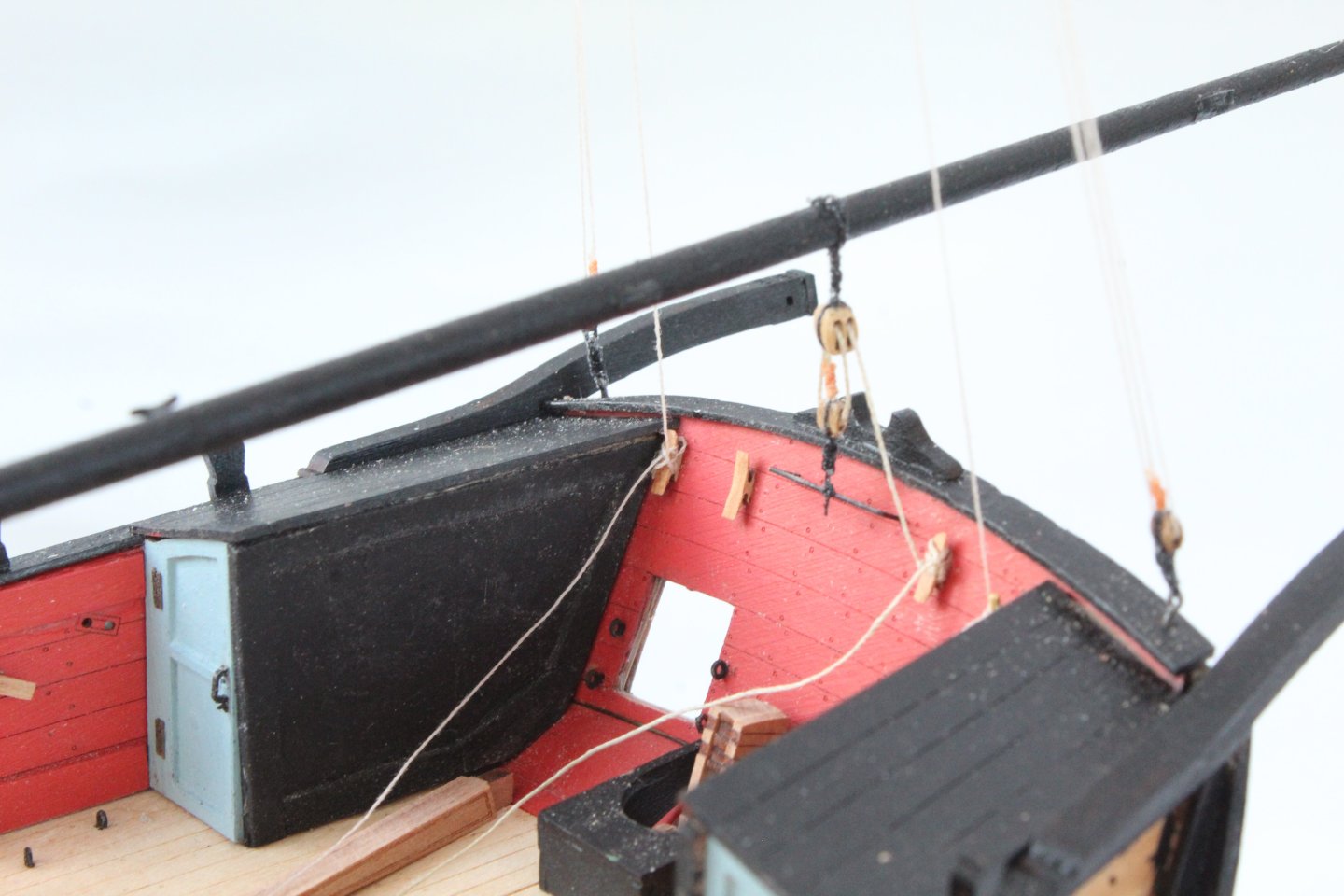

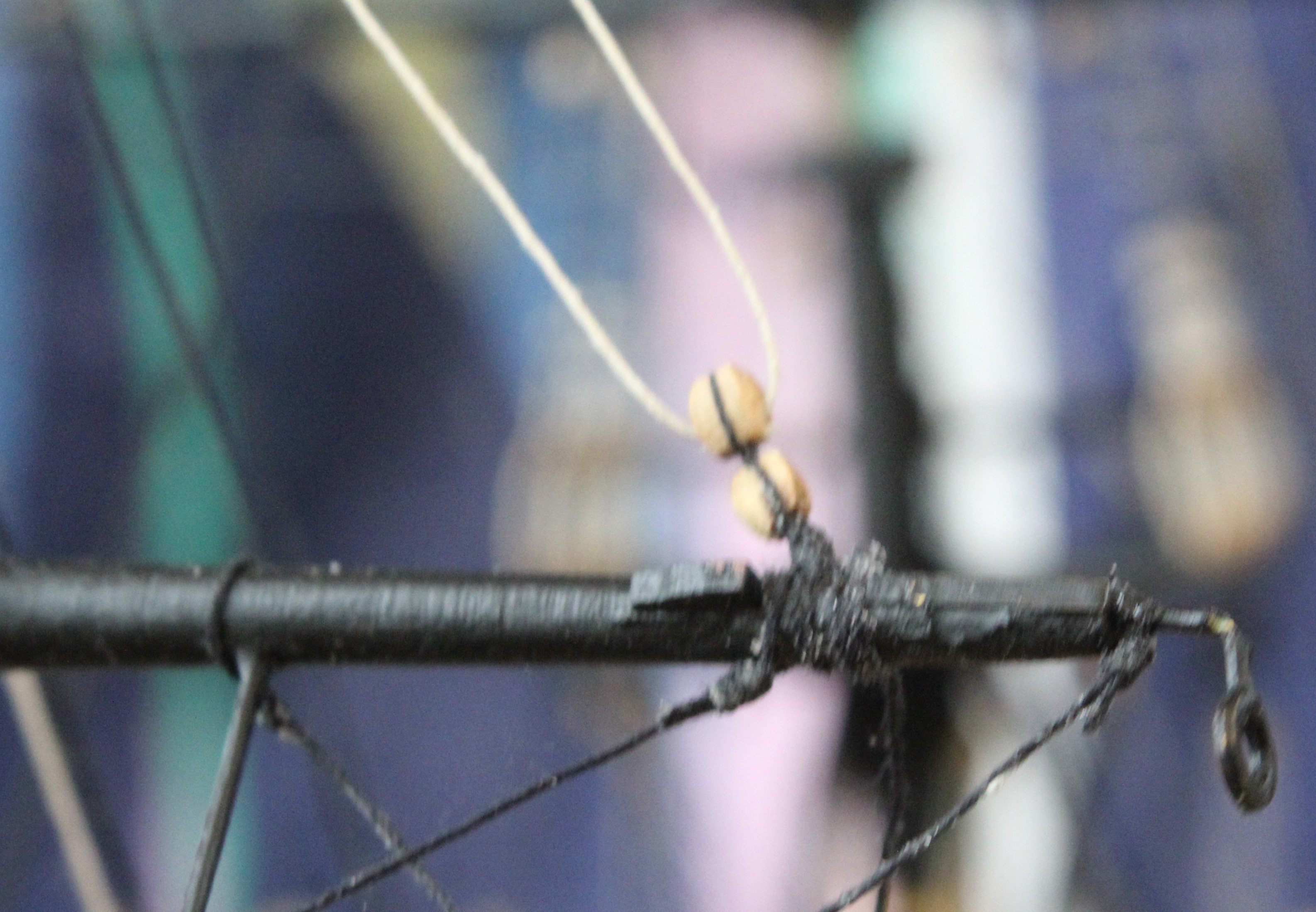

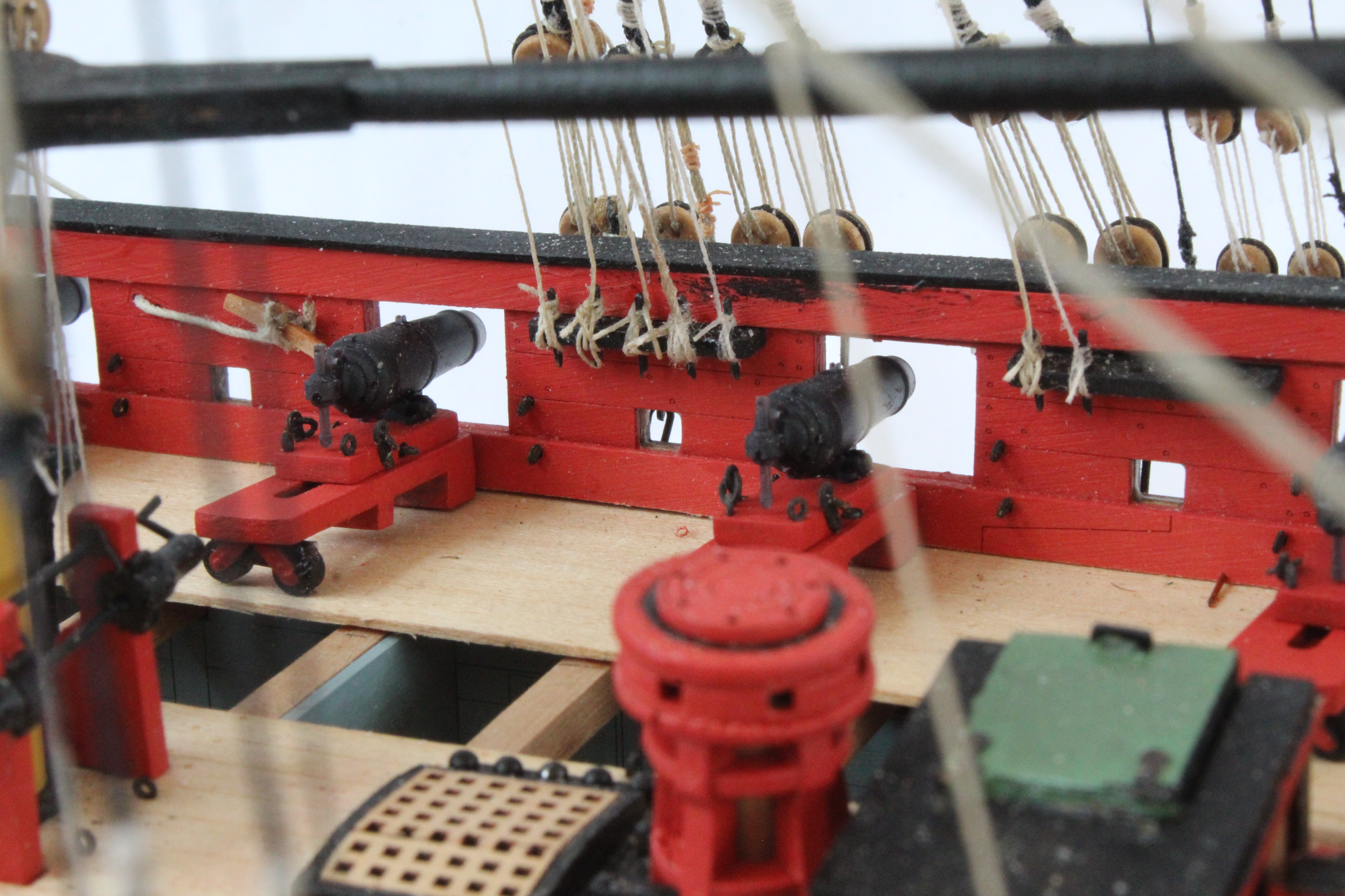

I spent a bit of time yesterday belying the rigging that had been run in, some of which can be seen in the first three first photos below.
001.thumb.JPG.6f4f51a8f046557a56a5526651b50028.JPG002.thumb.JPG.4281fc49f88abf59b450aa1b41f56bc7.JPG
003.thumb.JPG.8b62f21f4aa8d3973187282f01b8470e.JPGWith the jibboom and flying jibboom added their respective shroud rigging were next to be added. I opted to use hooks to secure these blocks to the bow for ease of installation, as can be seen in the two photo below, noting the plan sheet shows these blocks should be seized directly to the eyebolts. The free ends of the inter-block rigging will be belayed to pins located on the bow inner bulwark belay pin racks.
004.thumb.JPG.5831002f5a534e5c4f0457dcddd5584b.JPG005.thumb.JPG.aa95032e2bc3db25b10f741892267673.JPG
The shrouds are also feed through eyelets located on the spritsail yard before being secured to the ends of the jibboom and flying jibboom.006.thumb.JPG.93559ab9eedaf9b7727abf4fa2689da1.JPG
Glenn (UK)

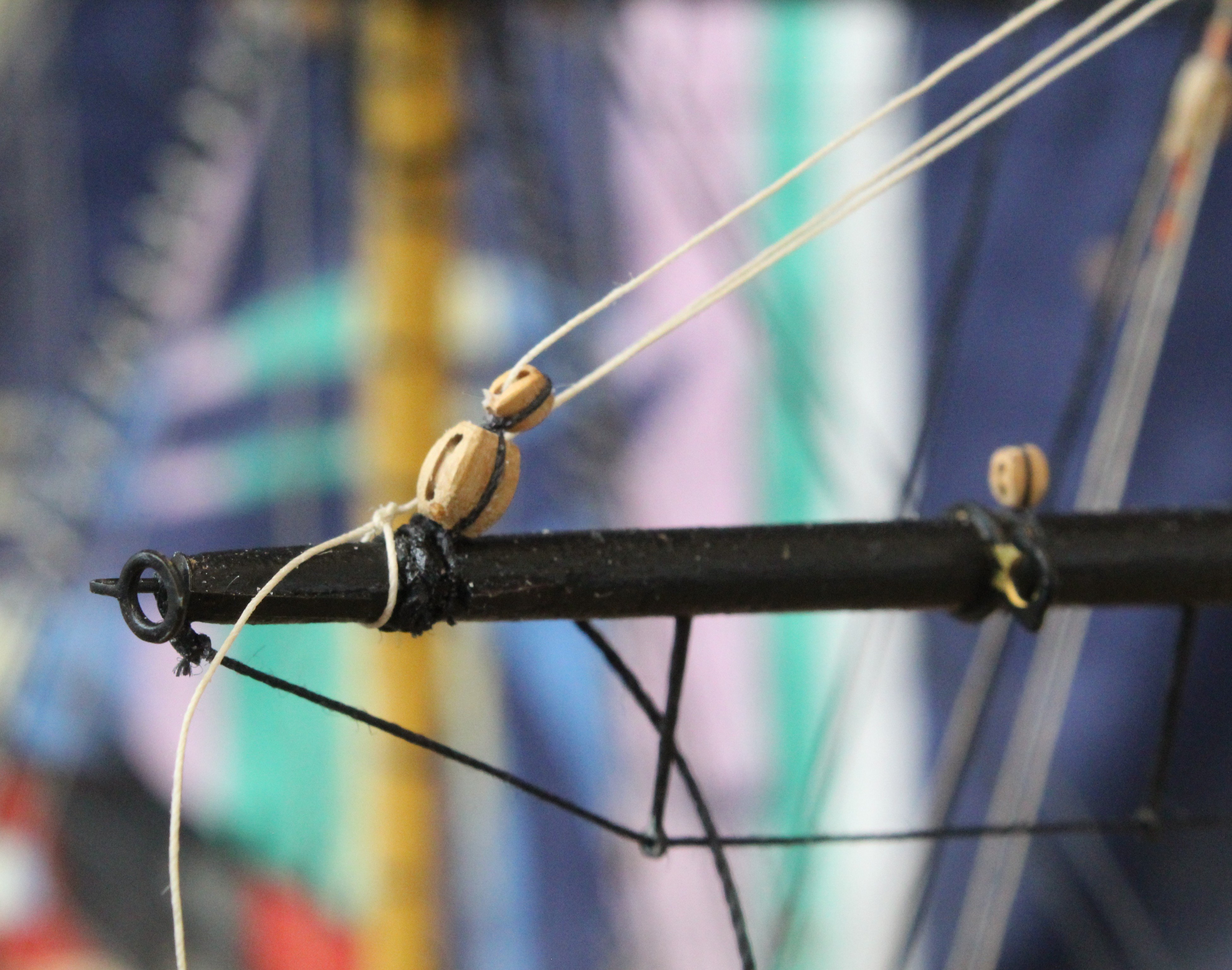

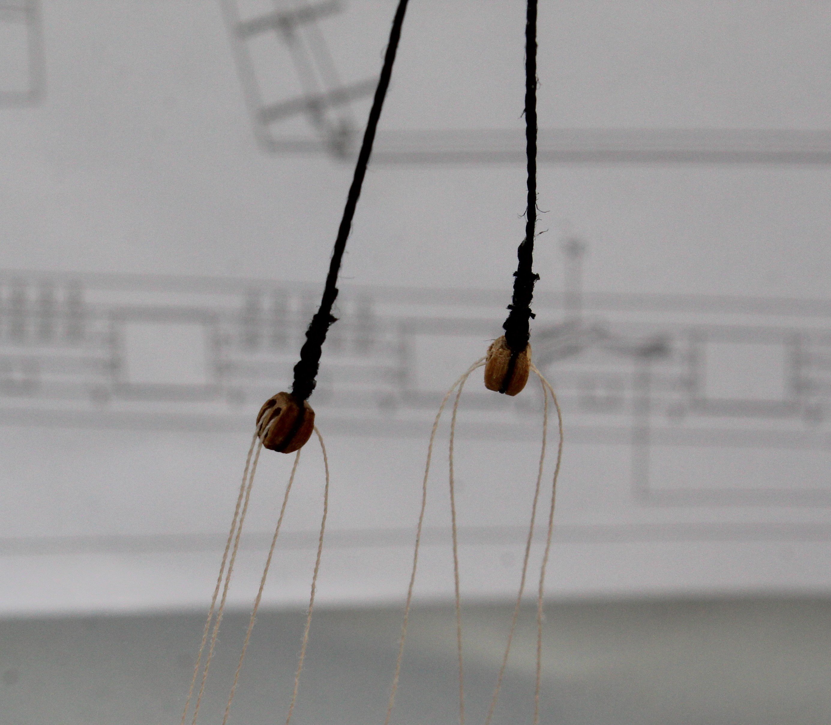

This post details the method I have used to rig the topsail sail tyes.
As can be seen in the first two photos below the rigging is fed through a double block on the topsail yard and is the reeved through a single block located on the topsail platform. The rigging is then belayed to the deck via two 5mm single blocks.
001.thumb.JPG.9723bbd579733cee2a9a142151355289.JPG002.thumb.JPG.275114873a4db337394a4c146a993c8c.JPG
Starting with the upper 5mm single block the tye thread is held in place as the block seizing is added as shown by the red arrow in the photo below.
The lower thread is then added, held in place with a reef knot.
The lower thread is then held in the quad hands so the seizing can be added,
The block is then reversed so the seizing can be added to the upper tye thread.
The completed upper 5mm block is shown in the next photo.
These threads are then reeved through the 3mm single block and the 4mm double block, the 4mm block is shown in the photo below.
A length of thread is then seized around the lower 5mm single block.
An eyebolt is then added to the thread, using a template to set the distance between the eyebolt and single block.
The next set of photos shows the completed rigging.
011.thumb.JPG.804d1fbb8055968c824ef8b1f15140ba.JPG012.thumb.JPG.268c9bdbb463de89cea33336ea643fa1.JPG013.thumb.JPG.c37eceb3f1fd4f56b320d11981820001.JPG014.thumb.JPG.f8d18e5e9d656f72a9b182fd711ff2b7.JPG
Glenn (UK)

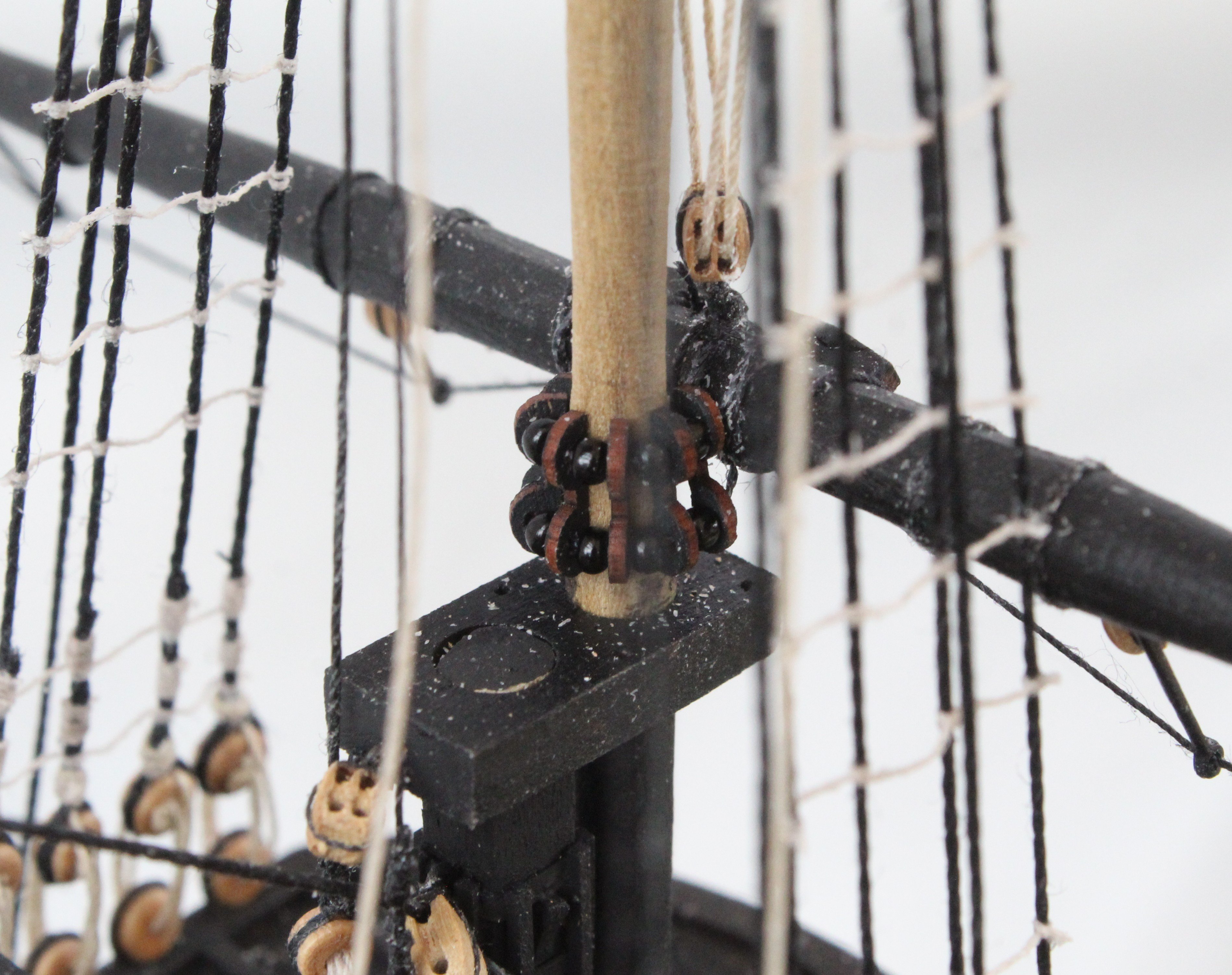

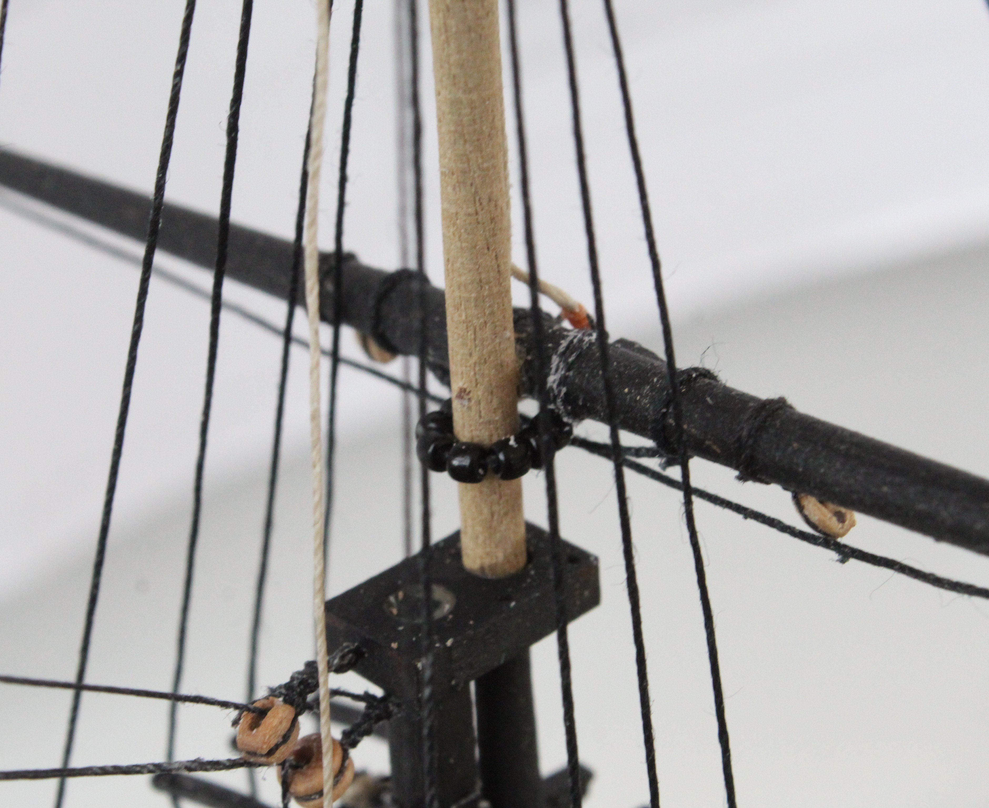

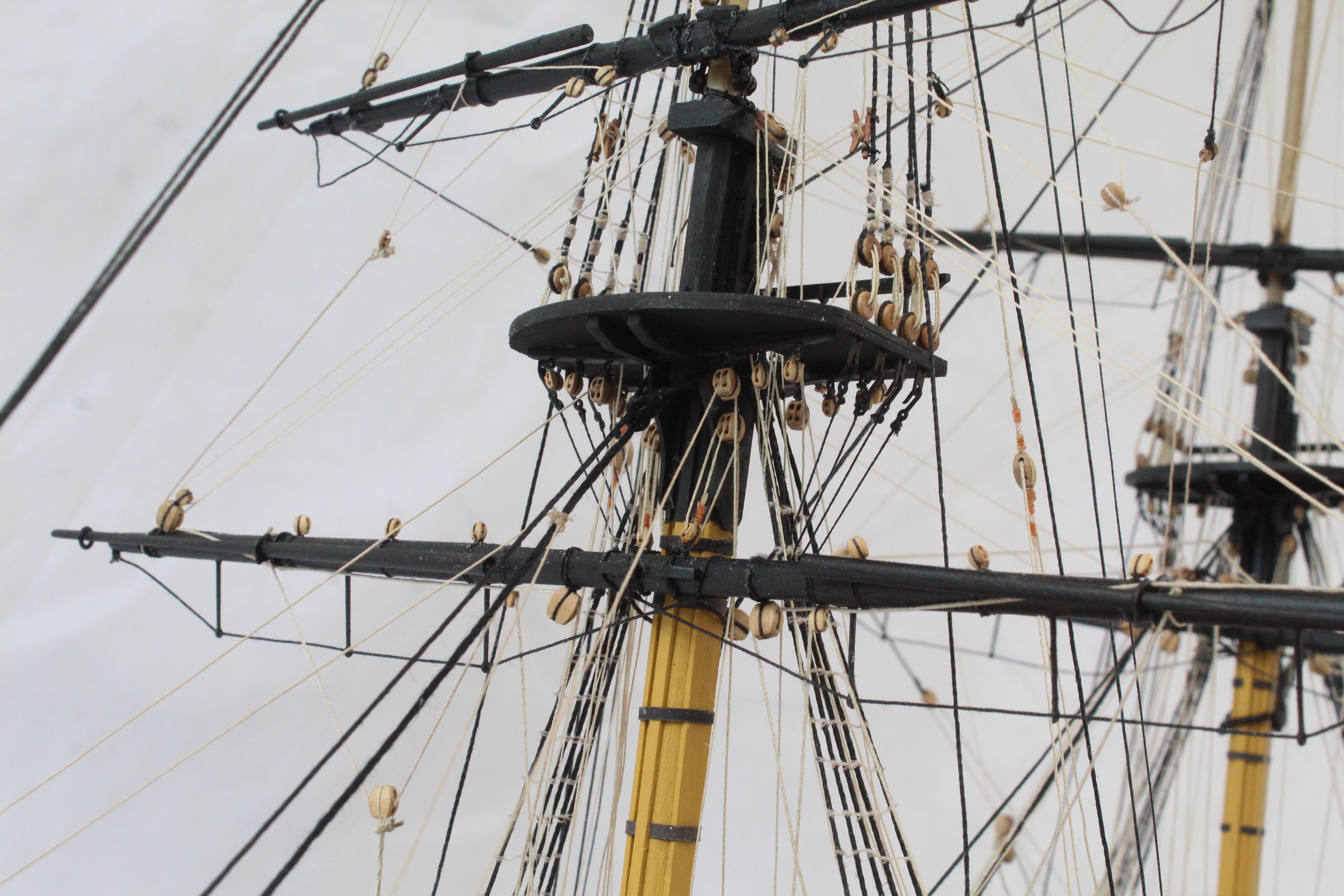

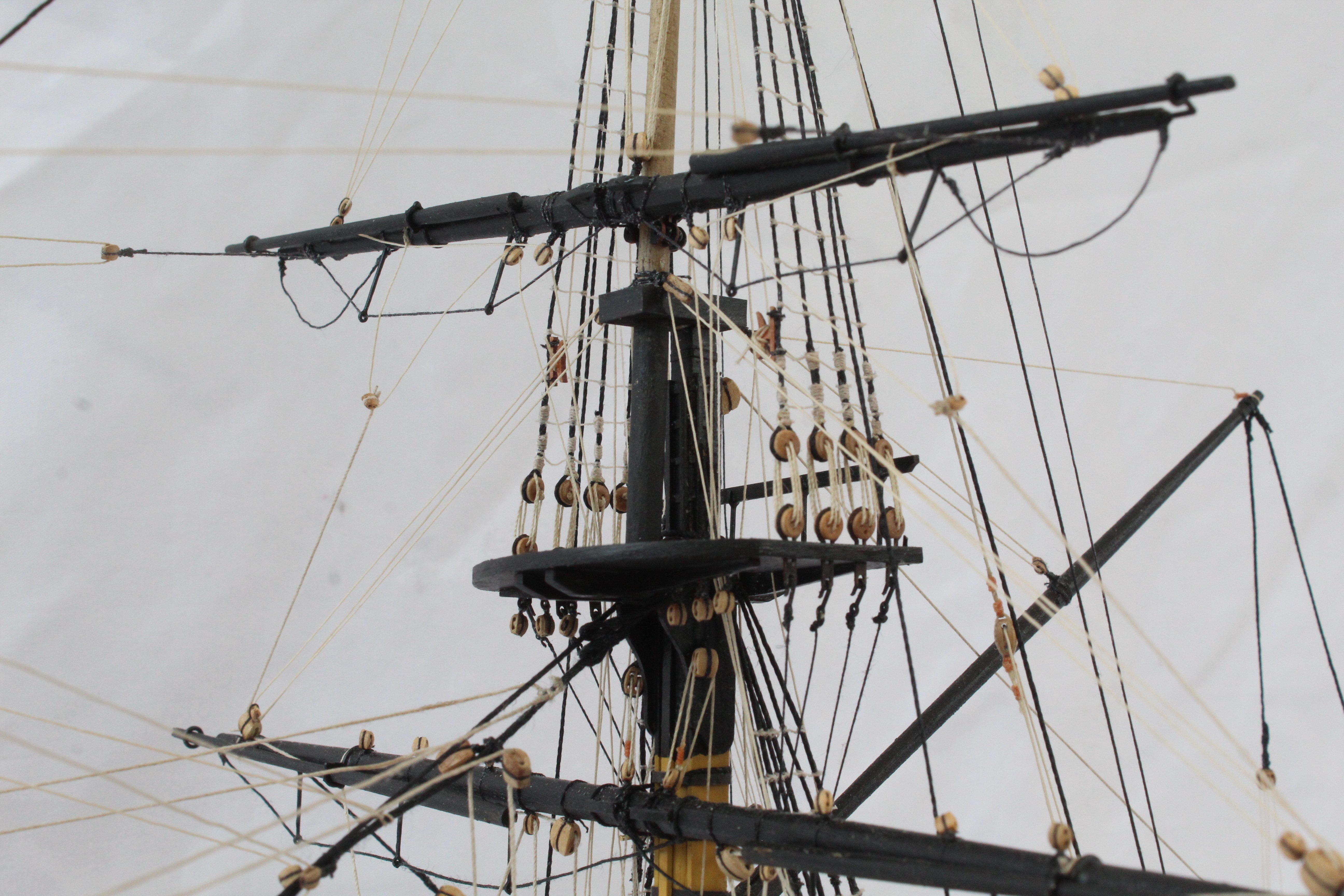

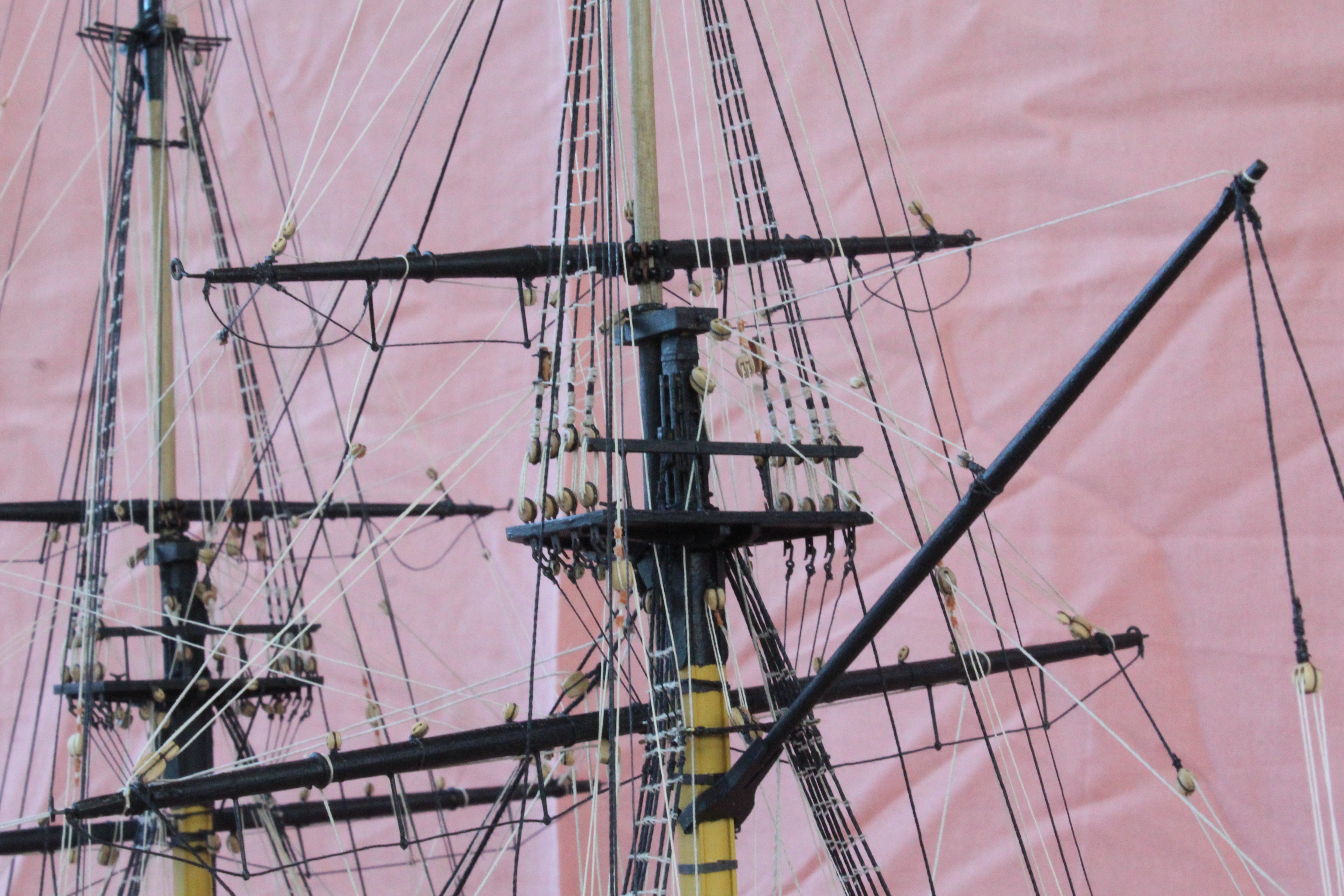

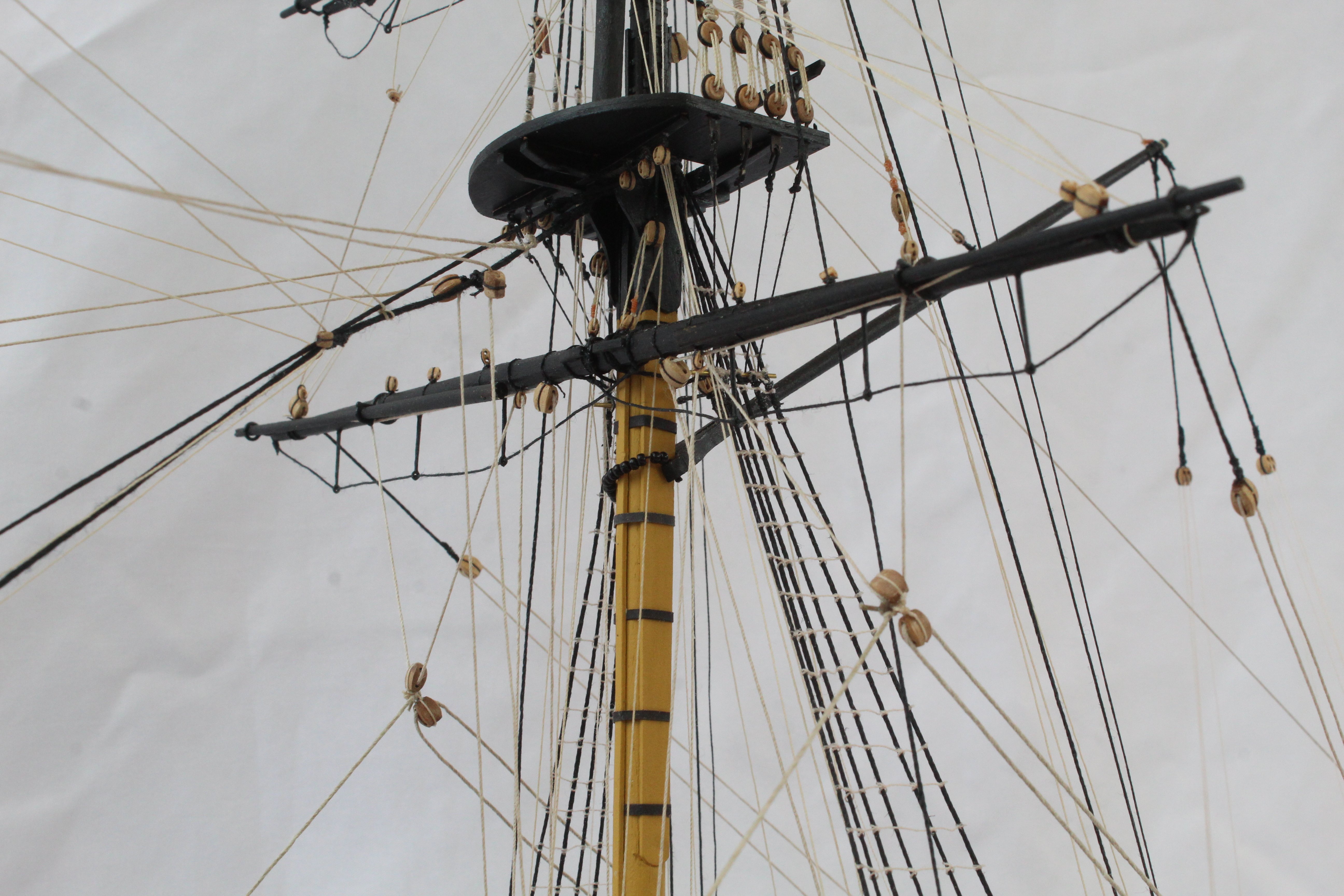

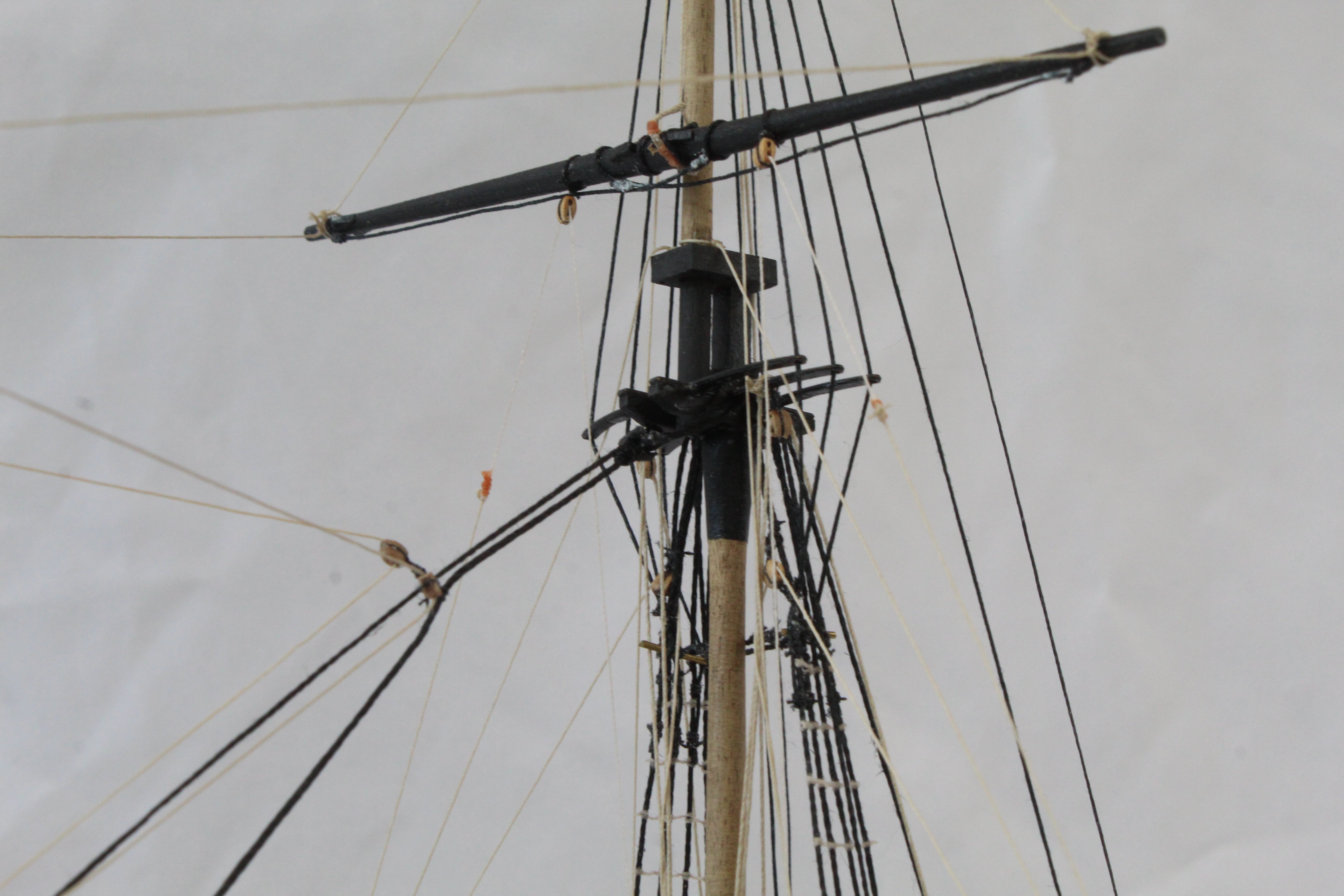

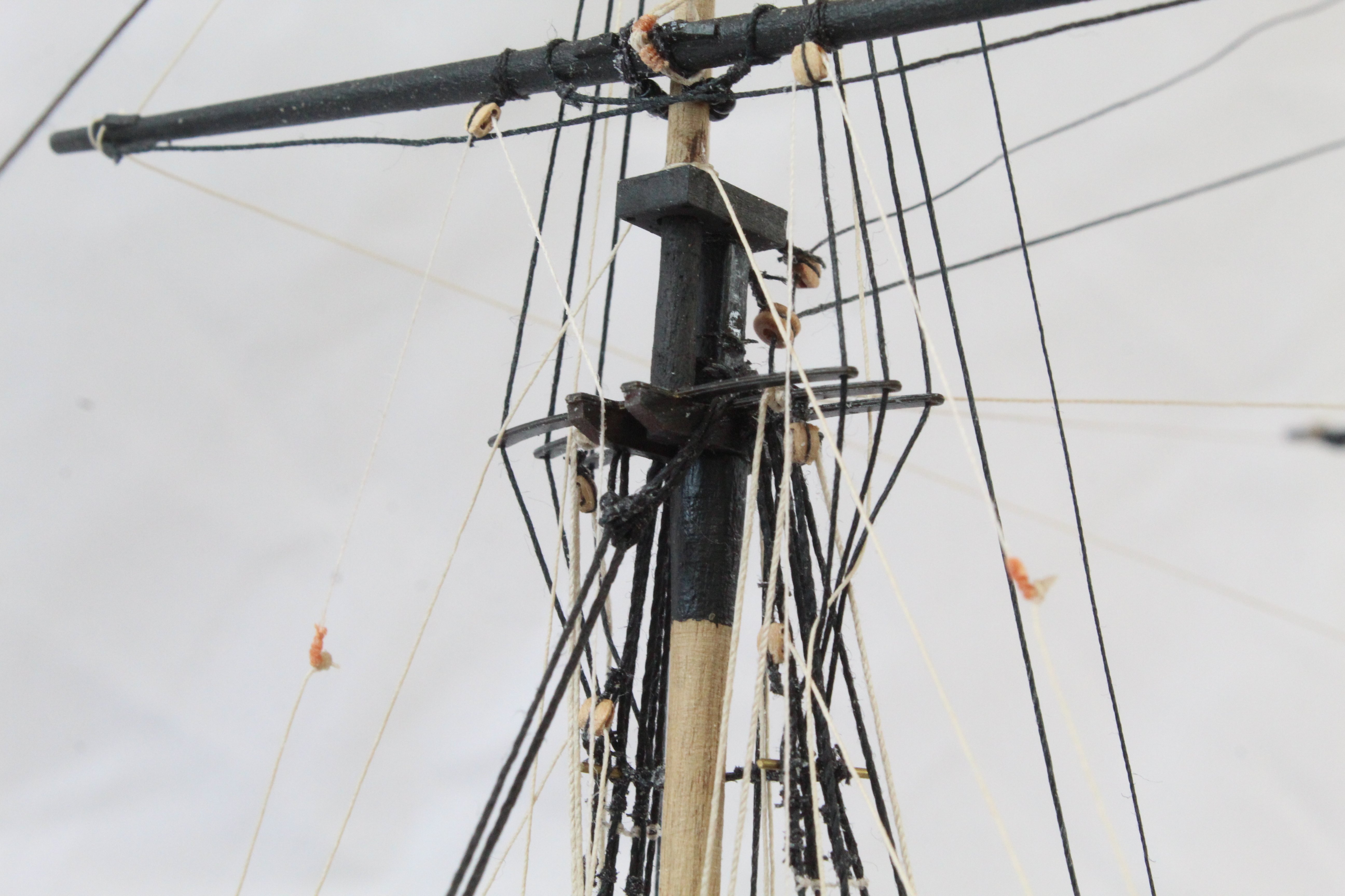

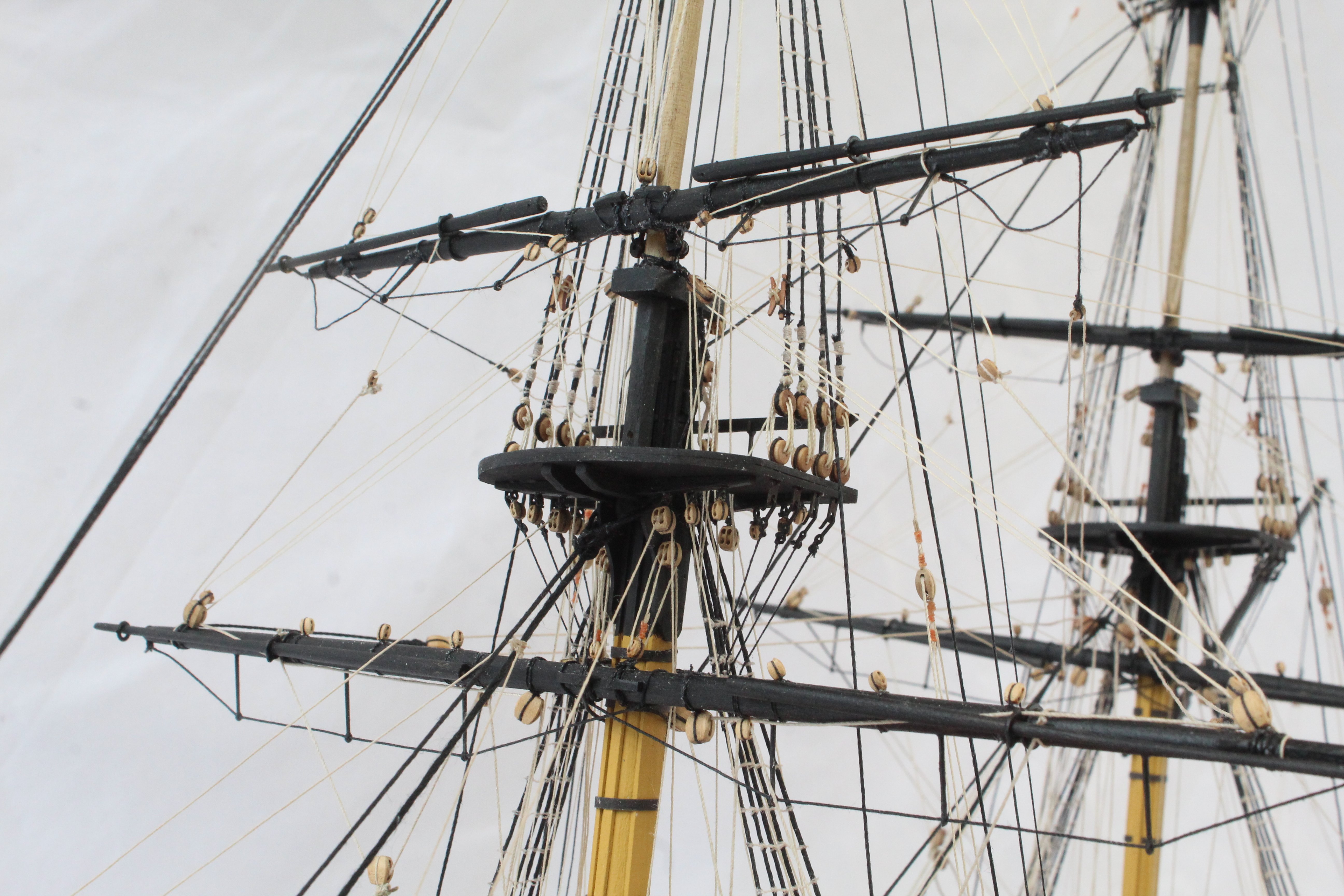

The main and foremast topsail and top gallant yards have now been added complete with tyes and lifts rigged.
Here is a picture of the current state of the build.
Now a picture showing the fore topsail yard with the parral beads in place.
The parrel beads around the fore topgallant yard is shown in the next picture.
Next is a photo of the topsail yard lfts which are now fully rigged and belayed.
004.thumb.JPG.88bf94d182d38728c4616015d12961c7.JPGThe final two photos show the lifts for the main topgallant yard, noting I have not belayed which will be via a double block arrangement, with the lower block hooked to an eyebolt on the lower platform.
005.thumb.JPG.ad048a8c9235f5b3be39bc1170d089d1.JPG006.thumb.JPG.ed08676177d255205804abbf7d19e8b3.JPG

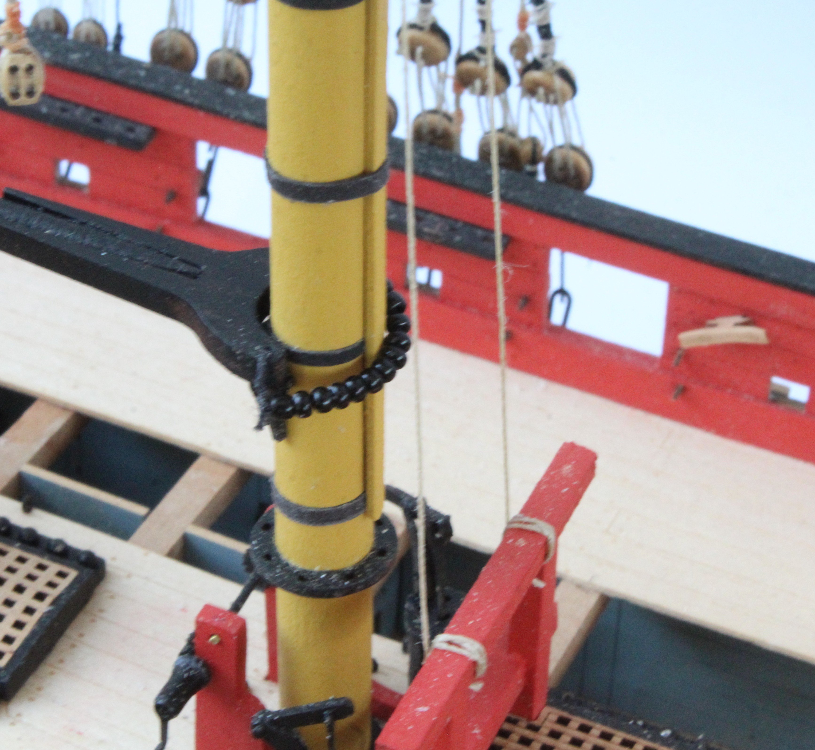

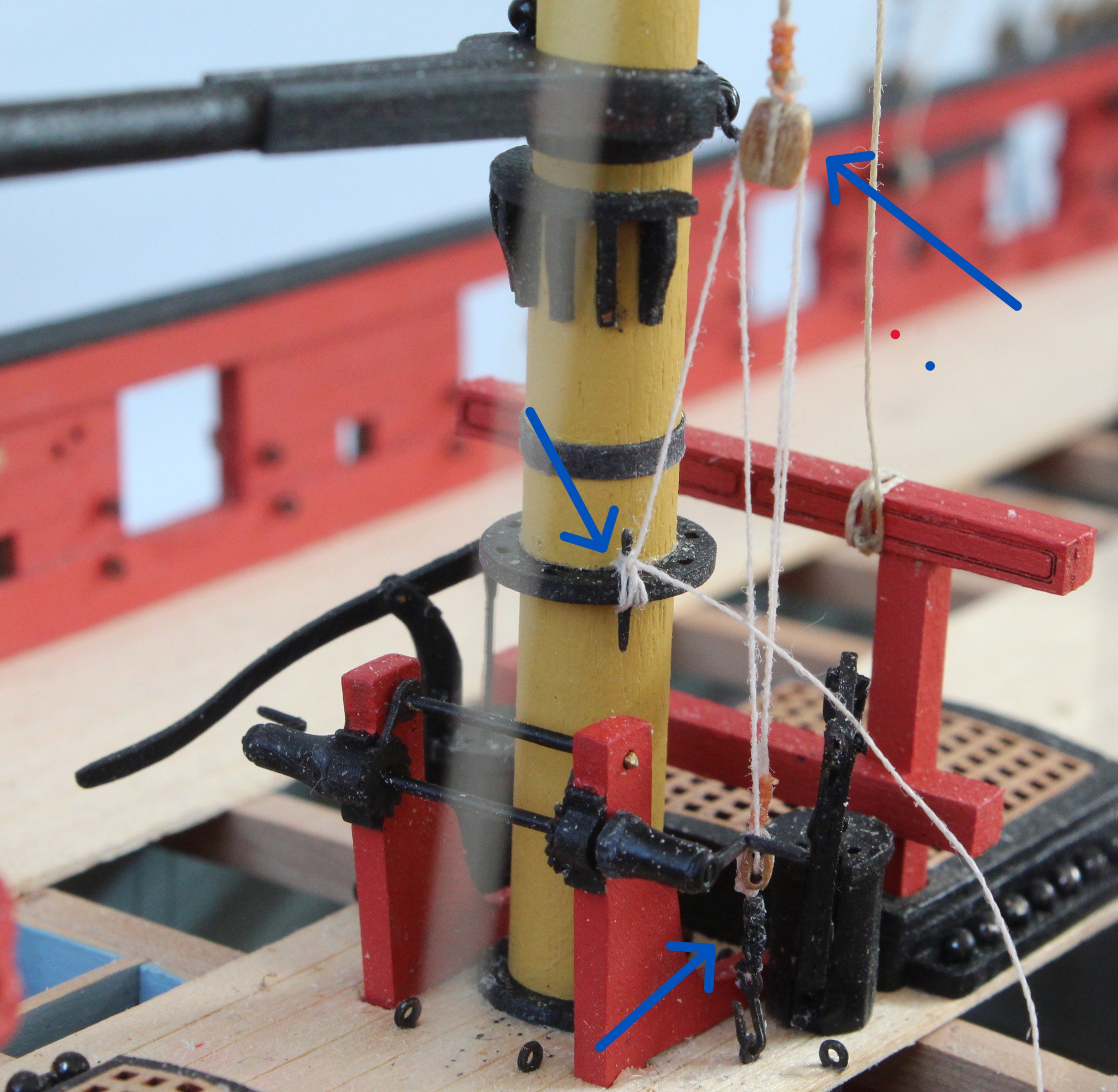

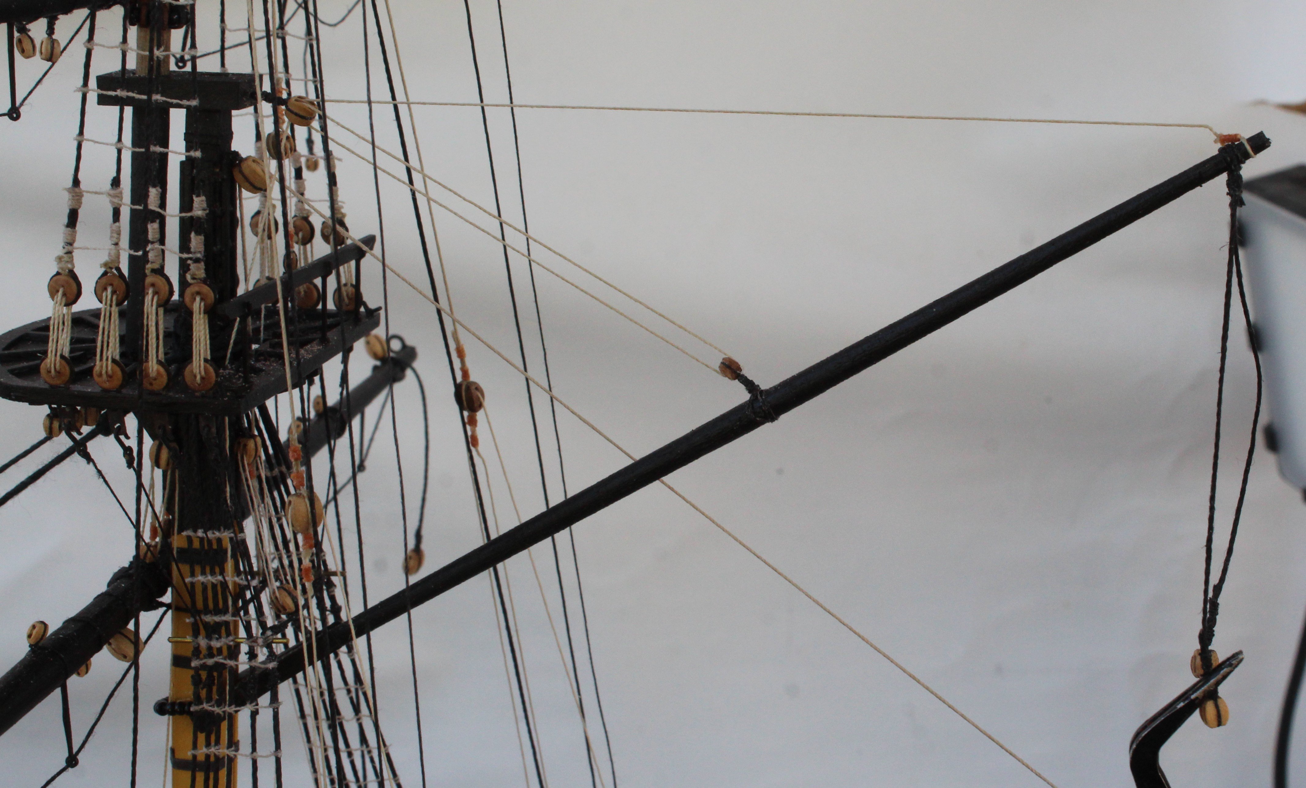

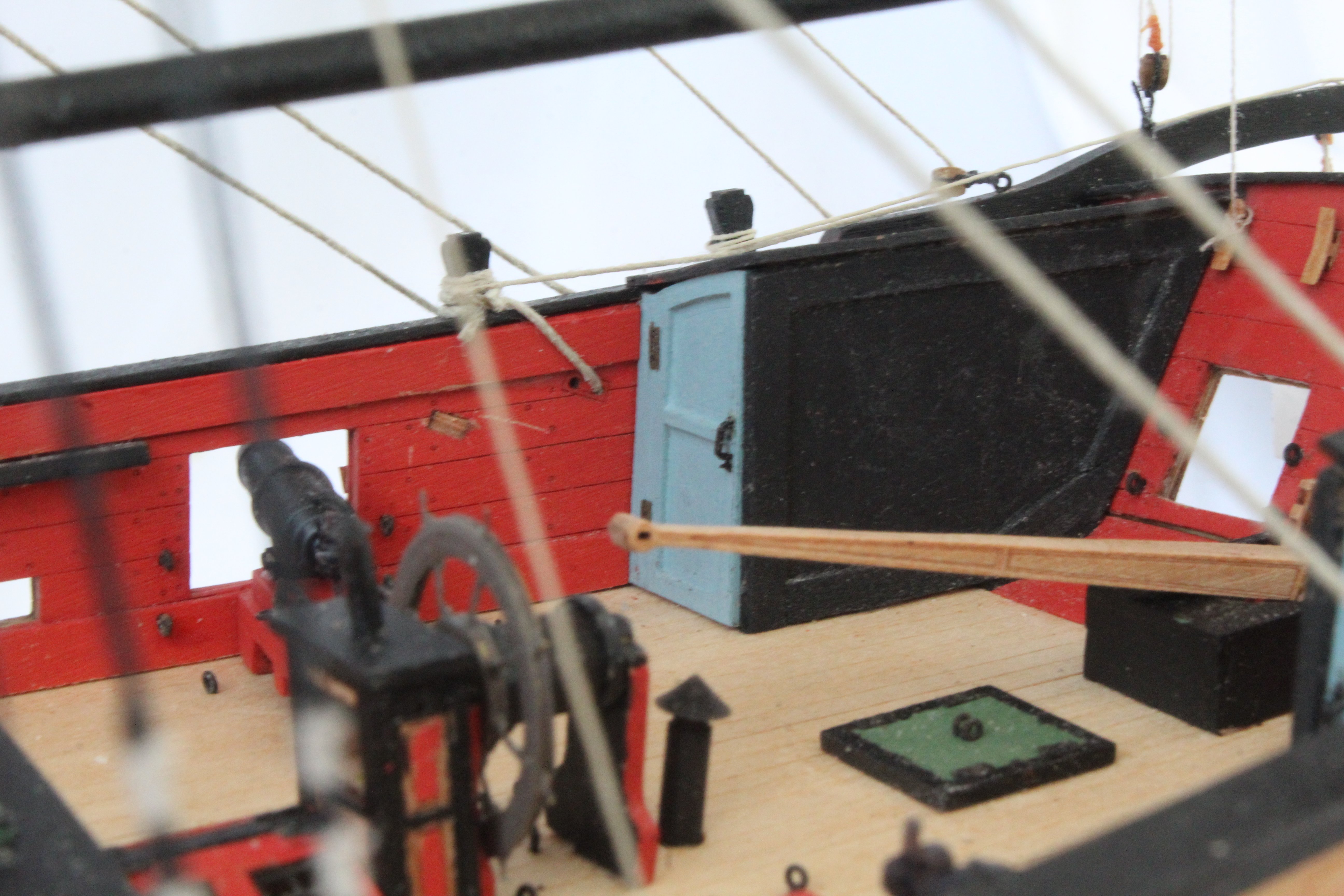

Today the Main Boom was installed.

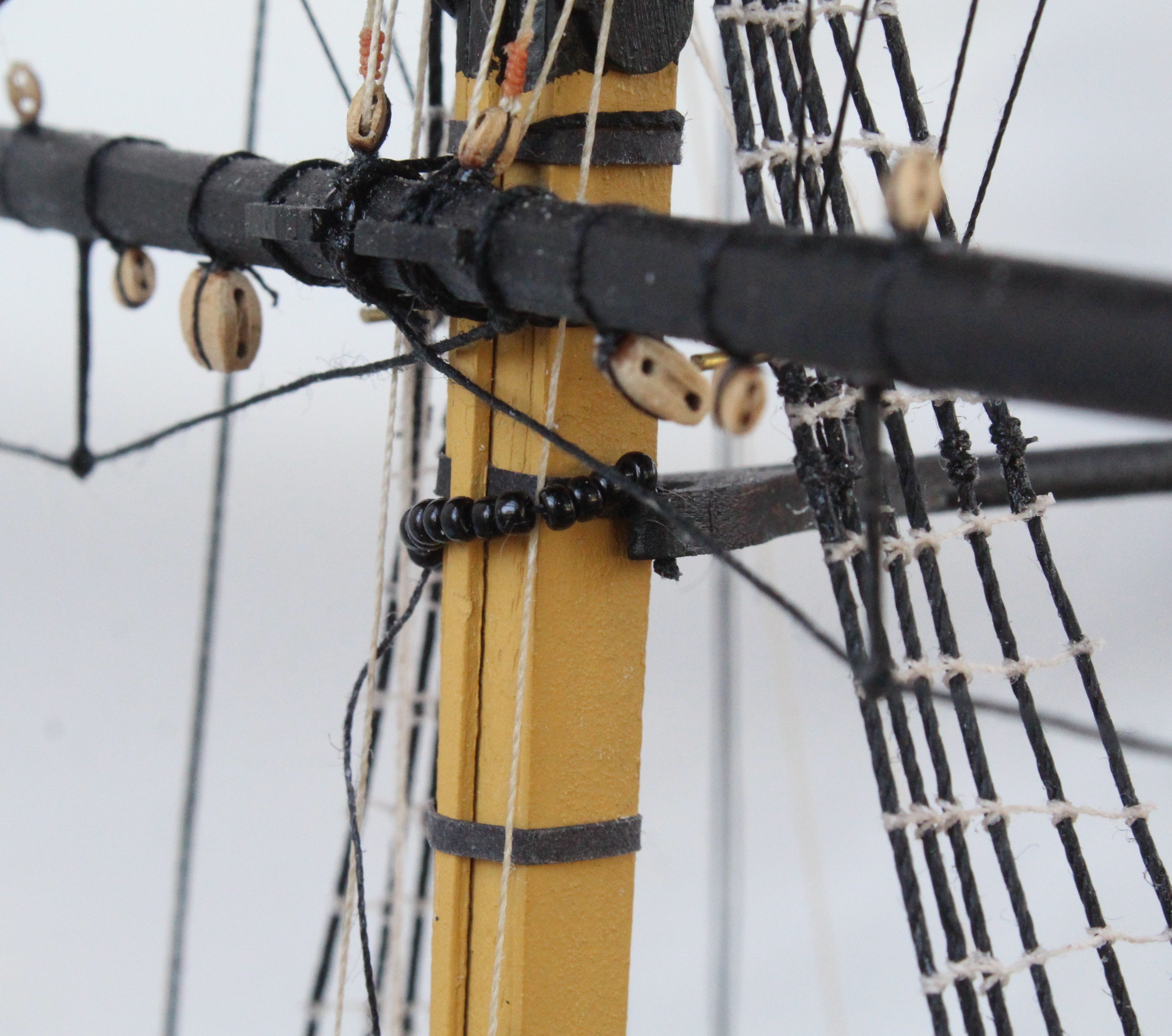

The first task was to secure the boom to the main mast with parral beads.

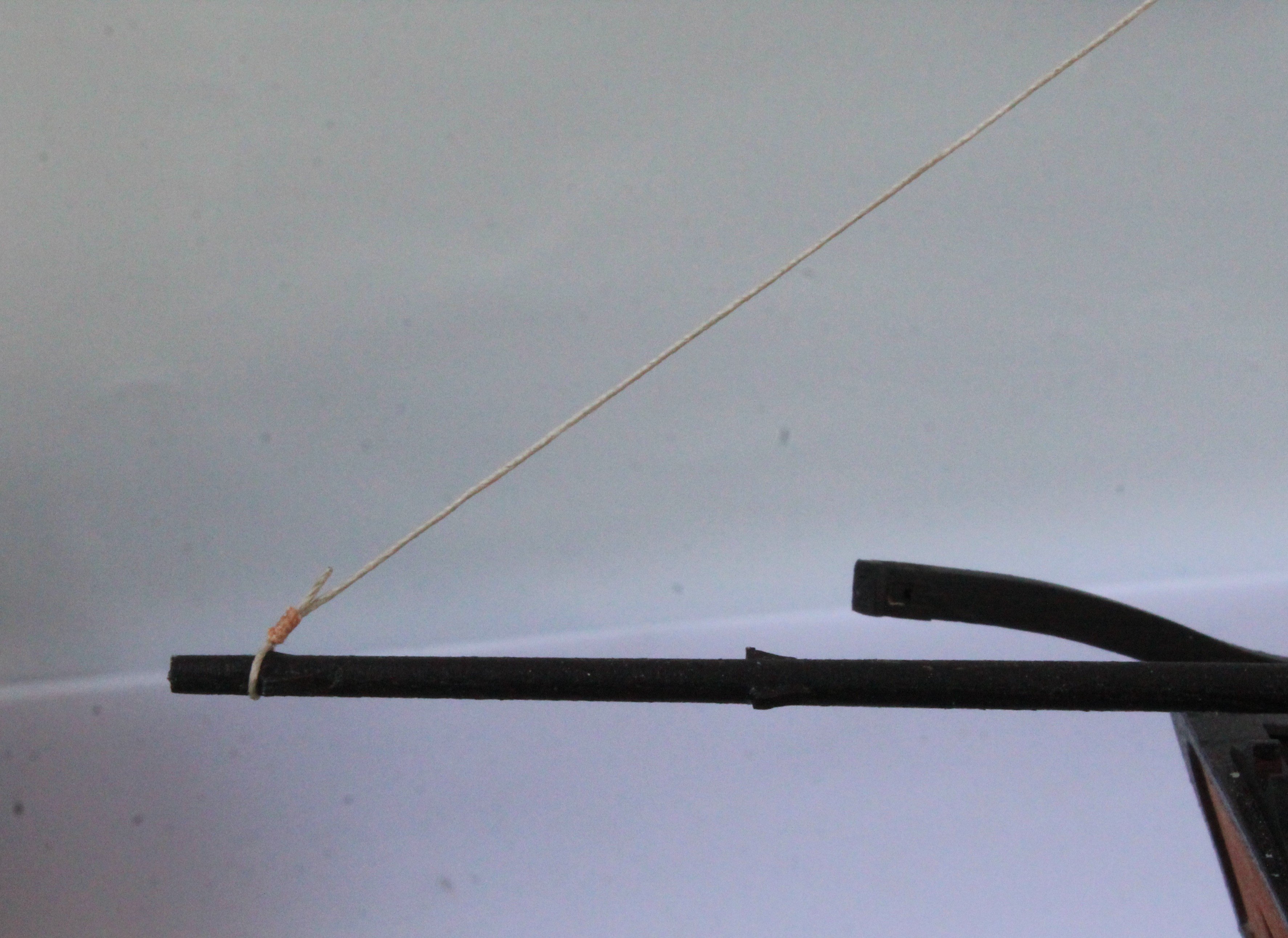

Next a length of thread was added to the end of the boom, as can be seen in the next photo.
This thread was then reeved through a block secured to the back of the main mast, as shown below.
The end of the boom was then belayed using a double block arrangement, as shown below.
Finally the thread that had been reeved through the main mast block was belayed to the deck via a double block arrangement, as shown below.
Finally a photo of the completed installation.

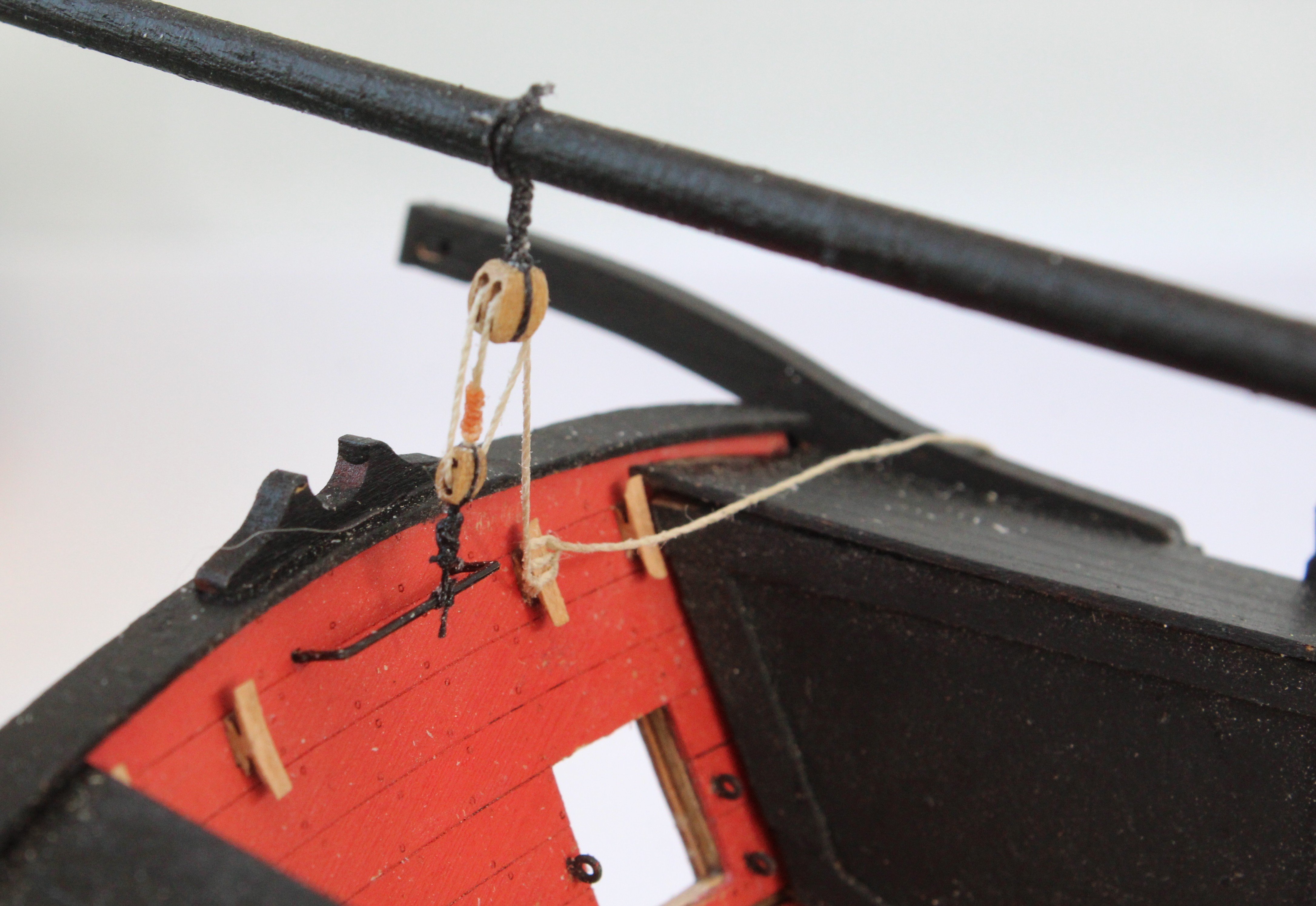

Today I have been installing the driver boom.
The first photo below shows the WIP when adding the parral beads.
The next photo shows the inter-block rigging for the driver boom tye.
The next section of the rigging has been added as shown on the next photo. I am using pliers to add tension to the vangs, whilst the rigging is belayed.
The next photo shows a double block reeved.
The inter-block rigging for the two vangs have been added, as shown below.
I am having a problem belaying the vang rigging as the cleats are located very close to the side cabins making it very difficult to tie off. I have also hit a snag as can be seen in the photo below as one cleat has seared off. I am not sure what I am going to so at the moment. Grandkid duties tomorrow so I have a couple of days to consider my options.007.thumb.JPG.6f52004fef05faf525898c59640f3253.JPG
Glenn (UK)
I have managed to sort out the issue with the damaged cleat and the vangs have now been belayed.

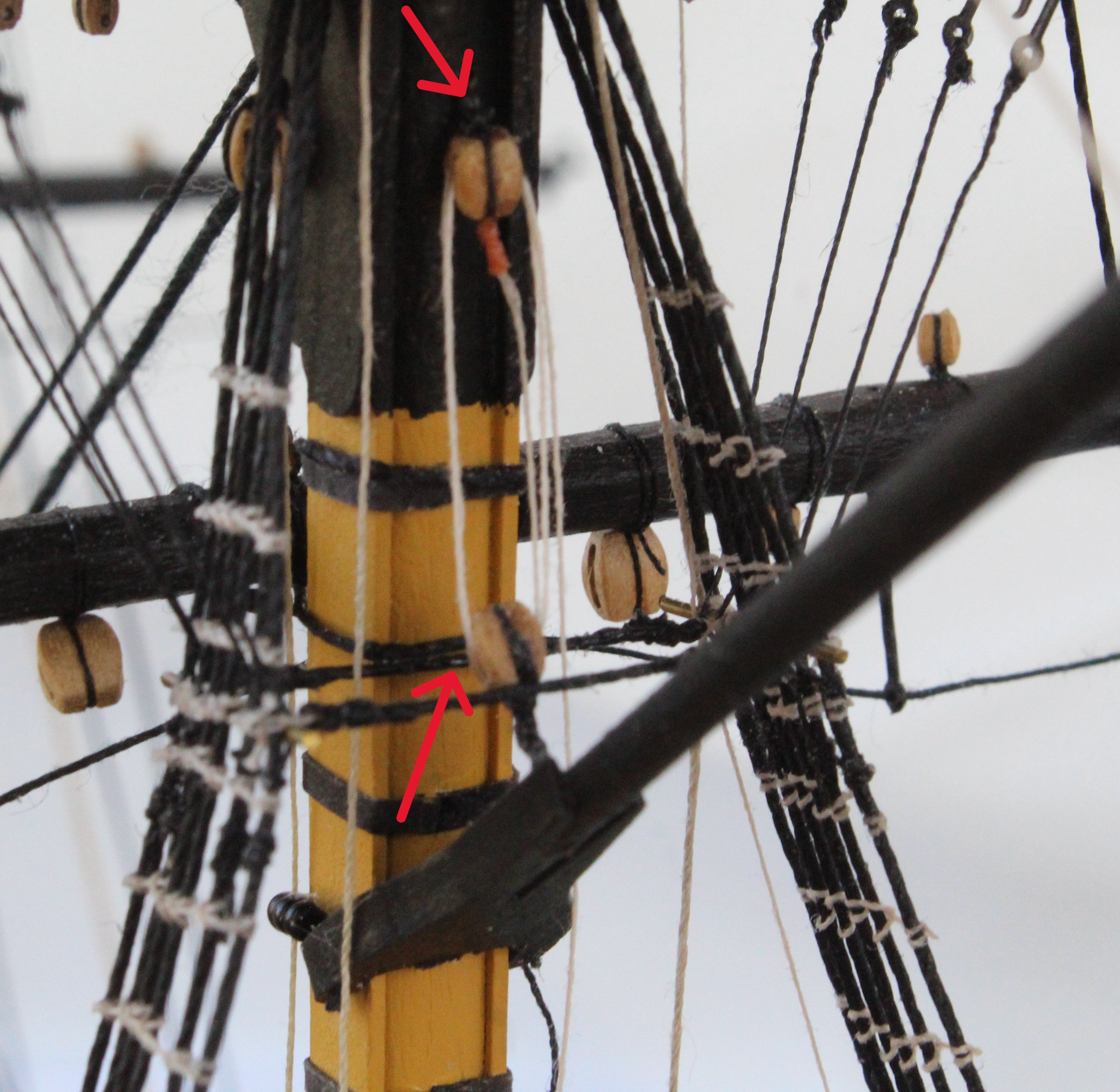

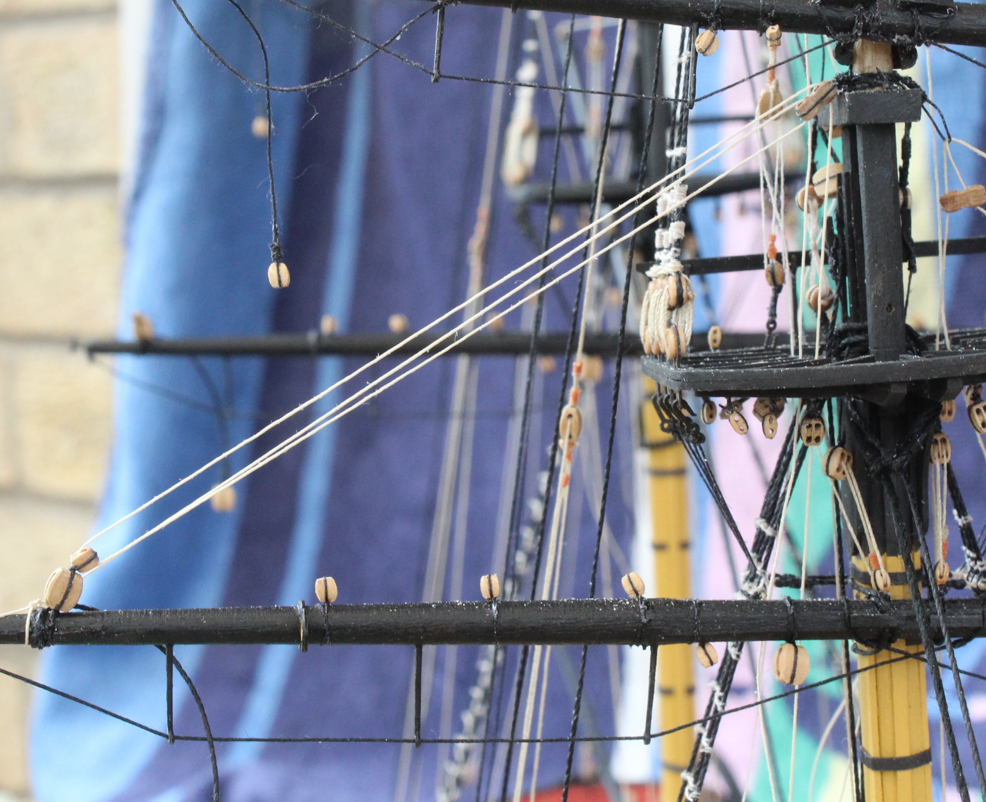

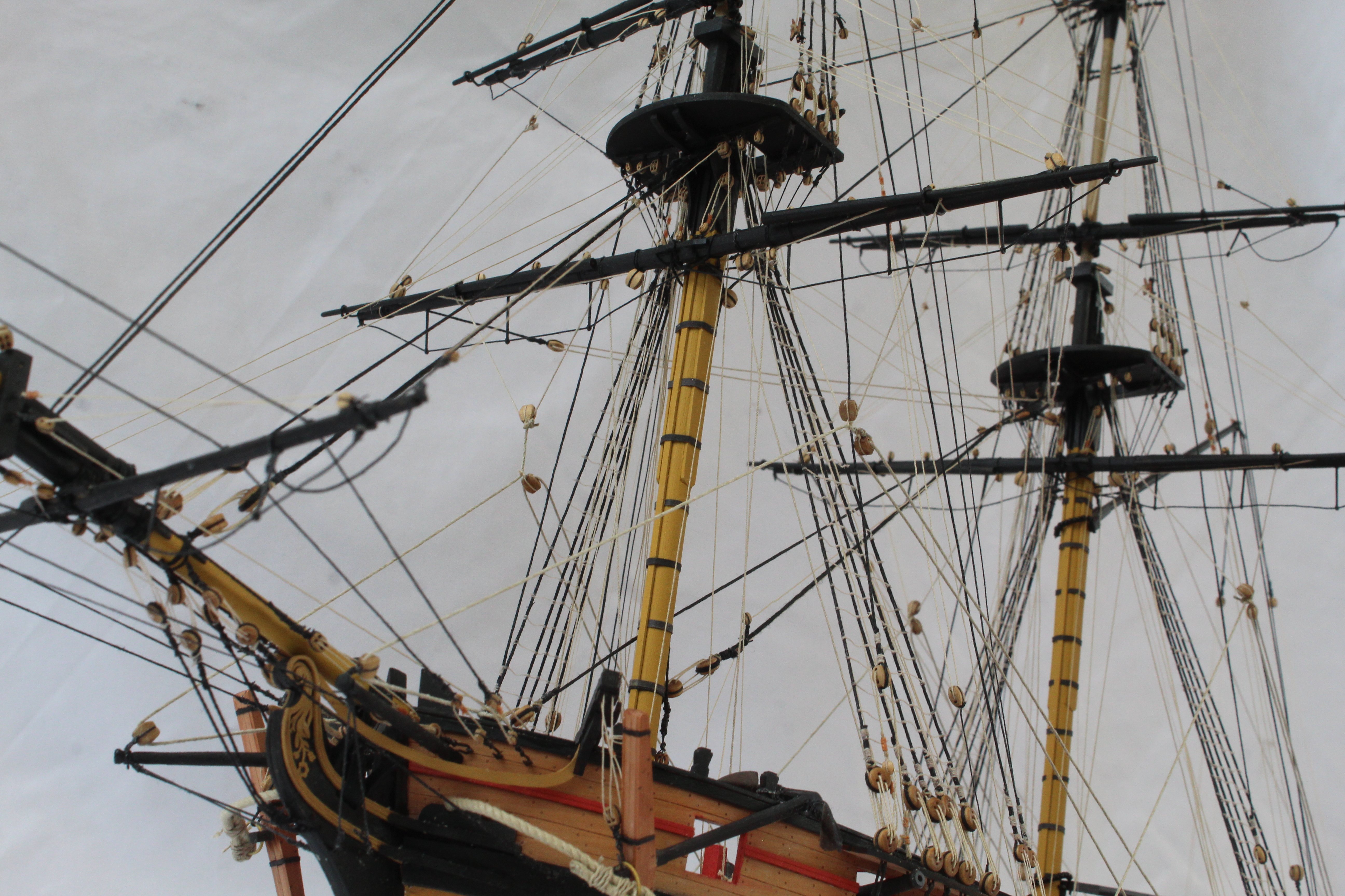

I have now started to rig the lifts for the fore yard fore topsail yard and fore topgallant yard.
The next set of photos shows the fore yard lift rigging. The rigging will be belayed to pins on the inner bulwark pin rack which will be entertaining when setting the tension so the yard is set level.
005.thumb.JPG.aa1c24a97a566f00526c5b4c1dda07b9.JPG006.thumb.JPG.e4808fc5c2f5c42098c57cac7bda1f00.JPG007.thumb.JPG.3a05c5f39426f7318e8146a93adf26ce.JPG008.thumb.JPG.e77b9bcb2a43e9d2eb654f6dea0160ff.JPG
The next set of photos shows the fore topsail yard lifts. The rigging will be belayed to pins on the inner bulwark pin rack, next to the foreyard lift belaying pin. The arrow in the first photo shows a block which has separated from the seizing. The arrows in the third photo shows the lift rigging.
009.thumb.JPG.aae67c4716138dd30b9a7ce261bcf94c.JPG010.thumb.JPG.cfd24669ea6309cc730bda9cbf00fed0.JPG011.thumb.JPG.30daf960f484cfcfa8f29f225ee0f13b.JPG
The final photo shows the fore topgallant yard lift. The rigging will be belayed to cleats located on the back of the topsail shroud rigging.

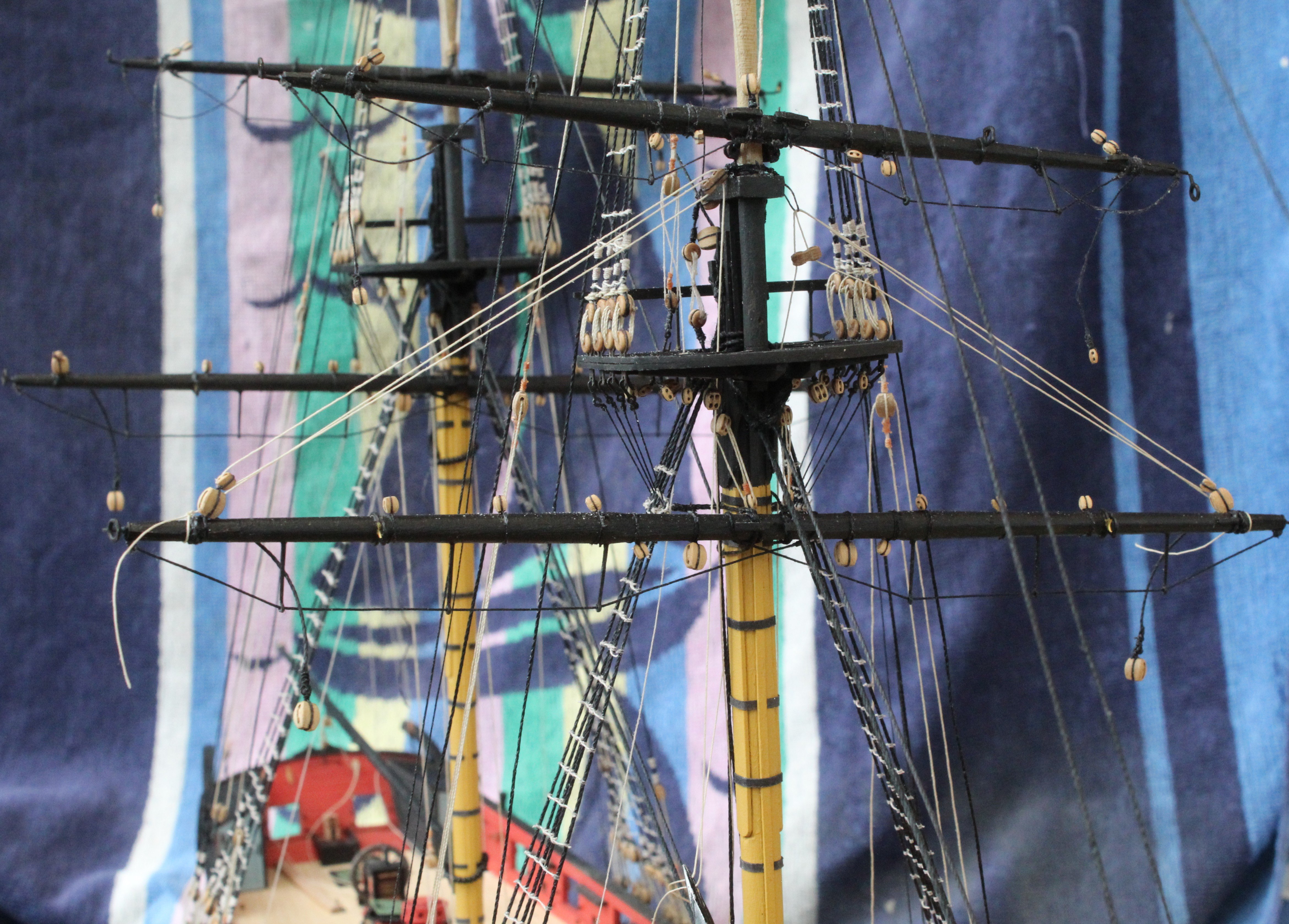

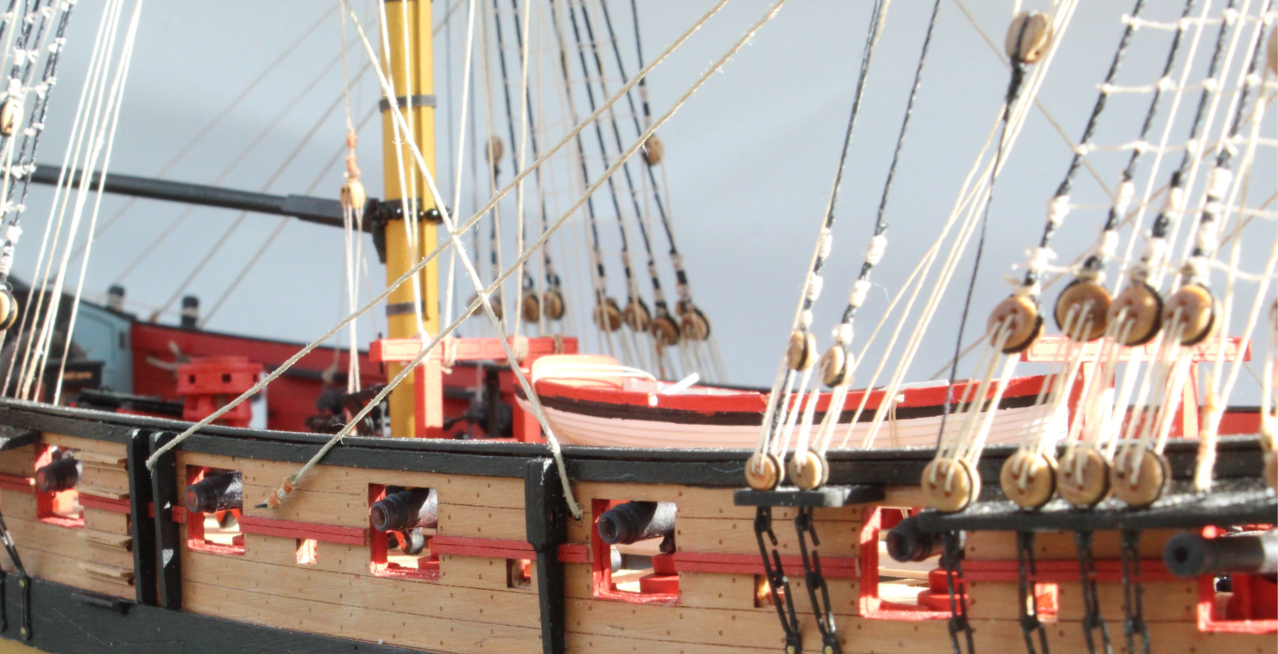

All the yard lifts have been rigged and belayed fore both the fore and main mast assemblies. For the most part I was able to set the lift tension so each yard was set at 90 degrees with the mast when belayed.
The main yard lifts is shown in the photo below.
The next two photo's shows the current build status. The lift rigging is difficult to see as the natural thread is not really visible when set against the white background. Clews, tacks and sheet rigging will be my next task which will take a few days to complete.
002.thumb.JPG.d55d1b6cca2f62496886c7e81446cd98.JPG003.thumb.JPG.78dda1394aa015979e75bbb9d90a8adc.JPG

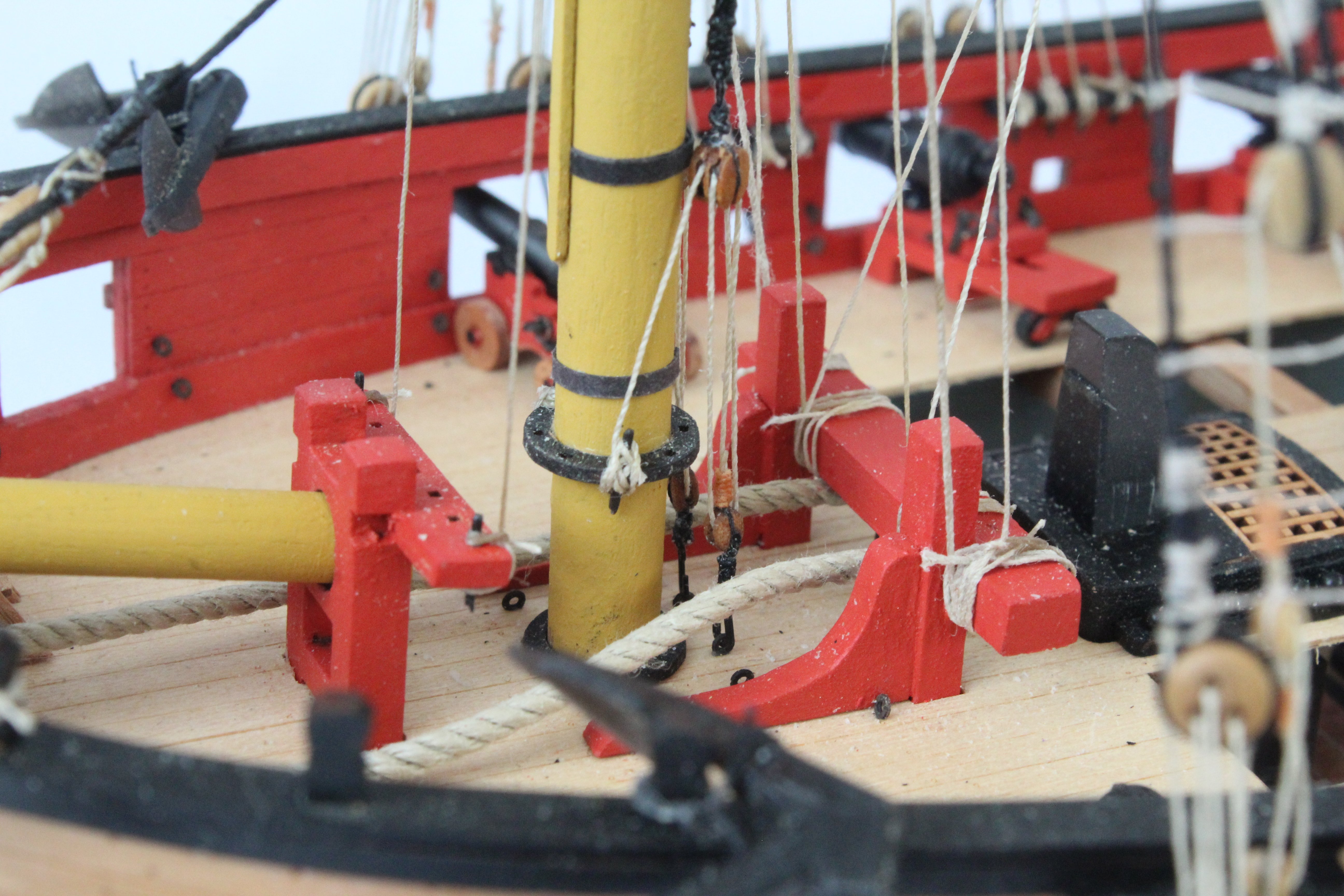

I have made a start on adding the clews, tacks and sheet rigging. The first task was to add pin to the end of a length of thread. The pin is a small length of thread which has been stiffened with ca glue. This is shown in the photo below.
The pinned thread is to be passed through a loop. I created the loop in a second length of thread, as shown below.
With the pined thread in place the loop is closed up and the excess thread trimmed, as shown in the next photo. In the real world the pin acts a quick release mechanism.
The next set of photos shows the rigging in place, noting it has not be tensioned or belayed. The red arrows indicate the rigging,

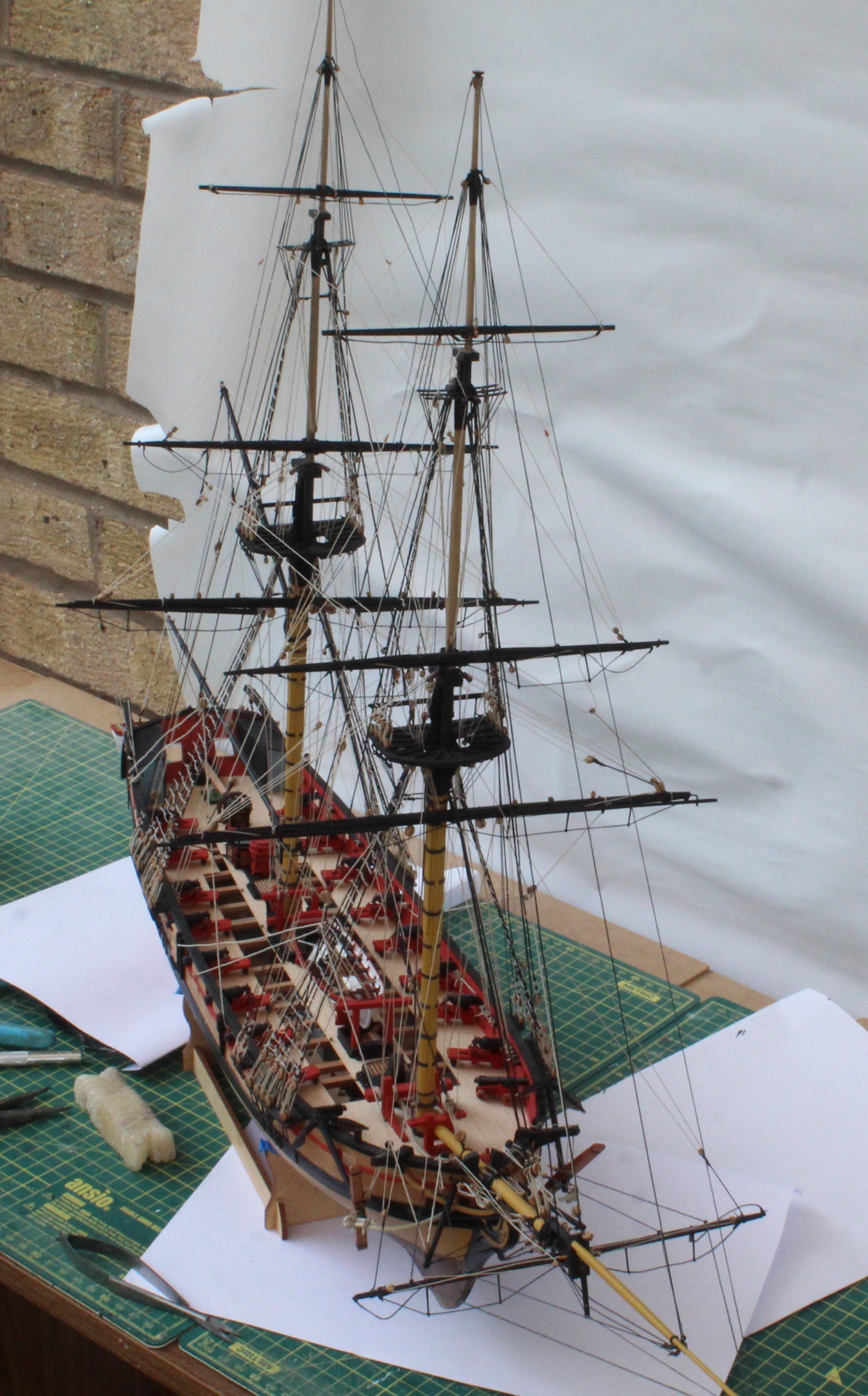

Work is progressing nicely on adding the braces for all the various yards. I have run in the brace rigging for all yards on the left hand side. Once I have run in the right hand right hand side rigging the braces can be tensioned and belayed.
In the following set of photos I have shown where all the rigging has been run. There is some fuzz on rigging lines which is not visible to the naked eye. As the end of this project nears I am thinking about which model to build next (as I wait in the wings for Jim to complete the prototype build for the Surprise). I am currently considering either the The Baltimore Privateer Schooner Grecian or HMS Speedy. I have previously partly built HMS Speedy but had to ditch the project partway through the build. I would like to build the HM Brig Sloop Flirt - Master Shipwright Edition but as this kit is currently out of stock so that is not currently an option.

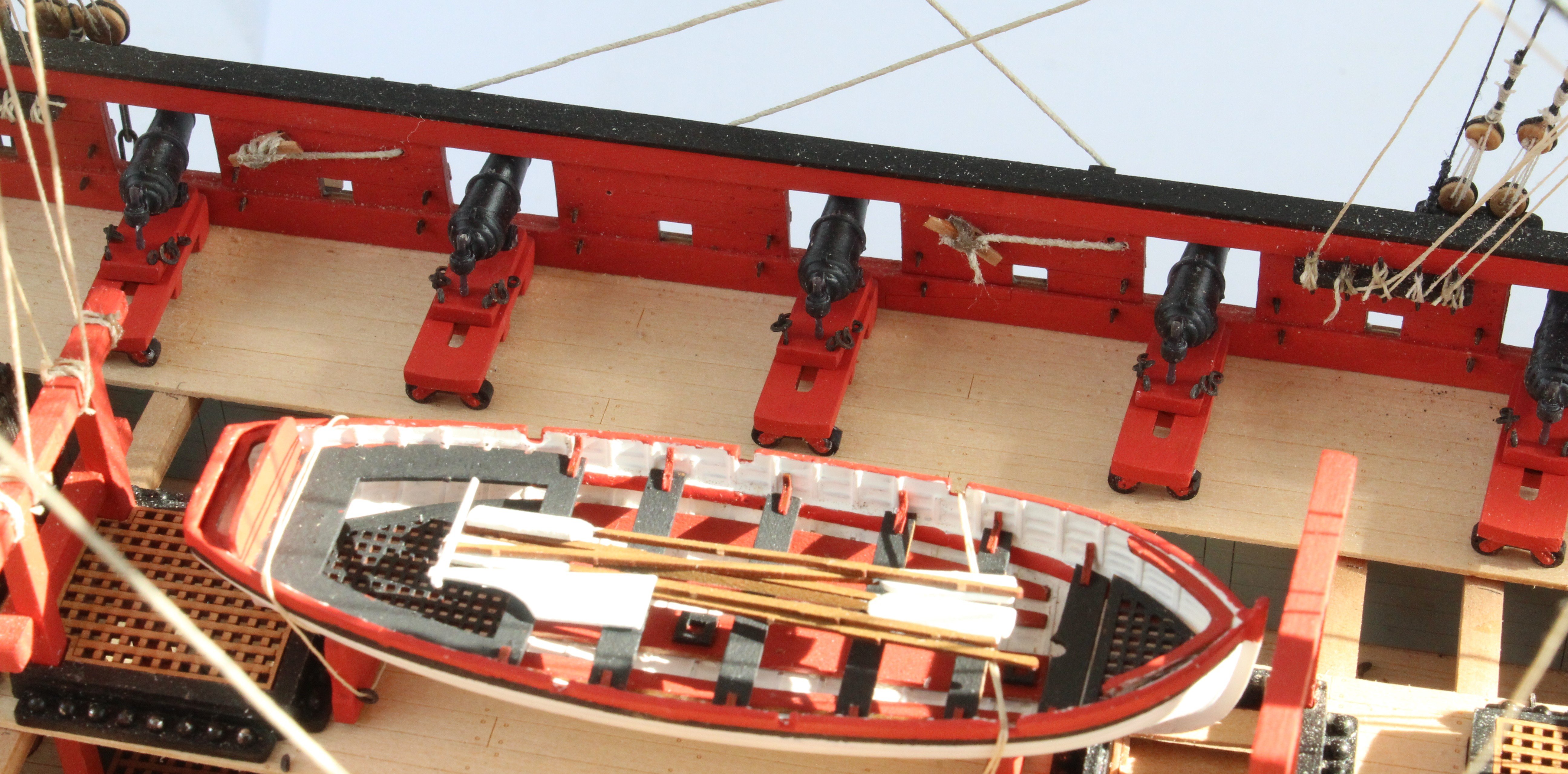

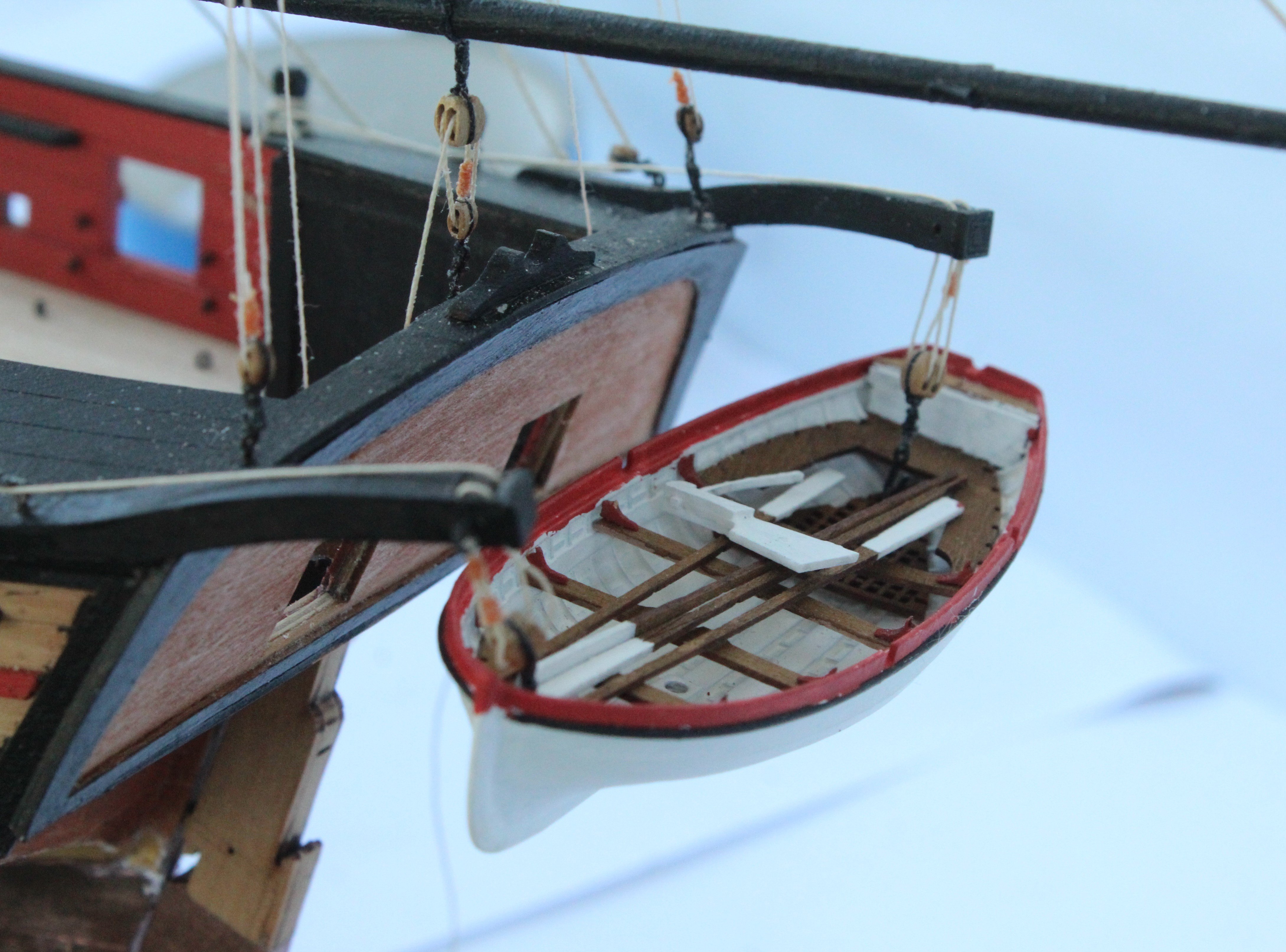

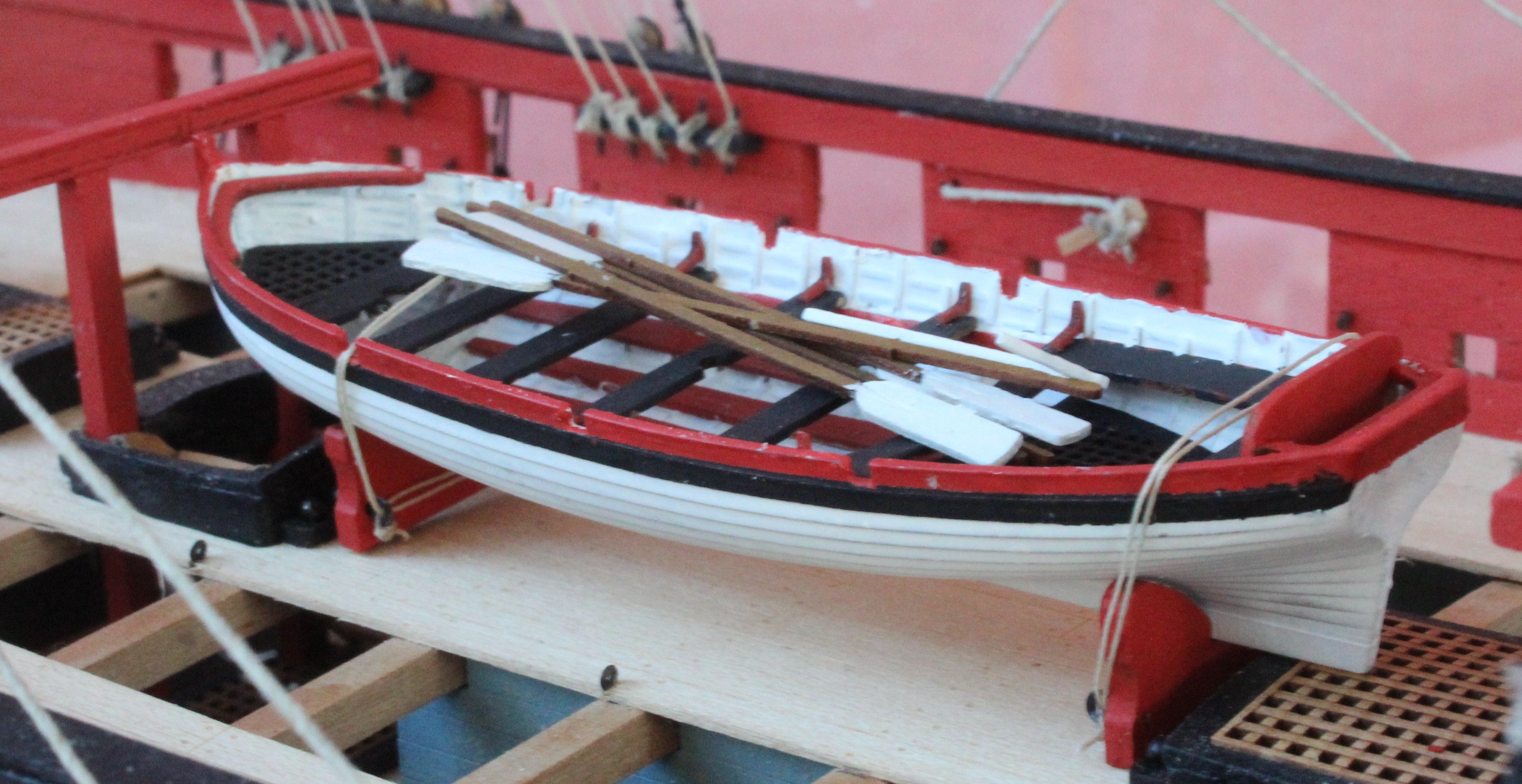

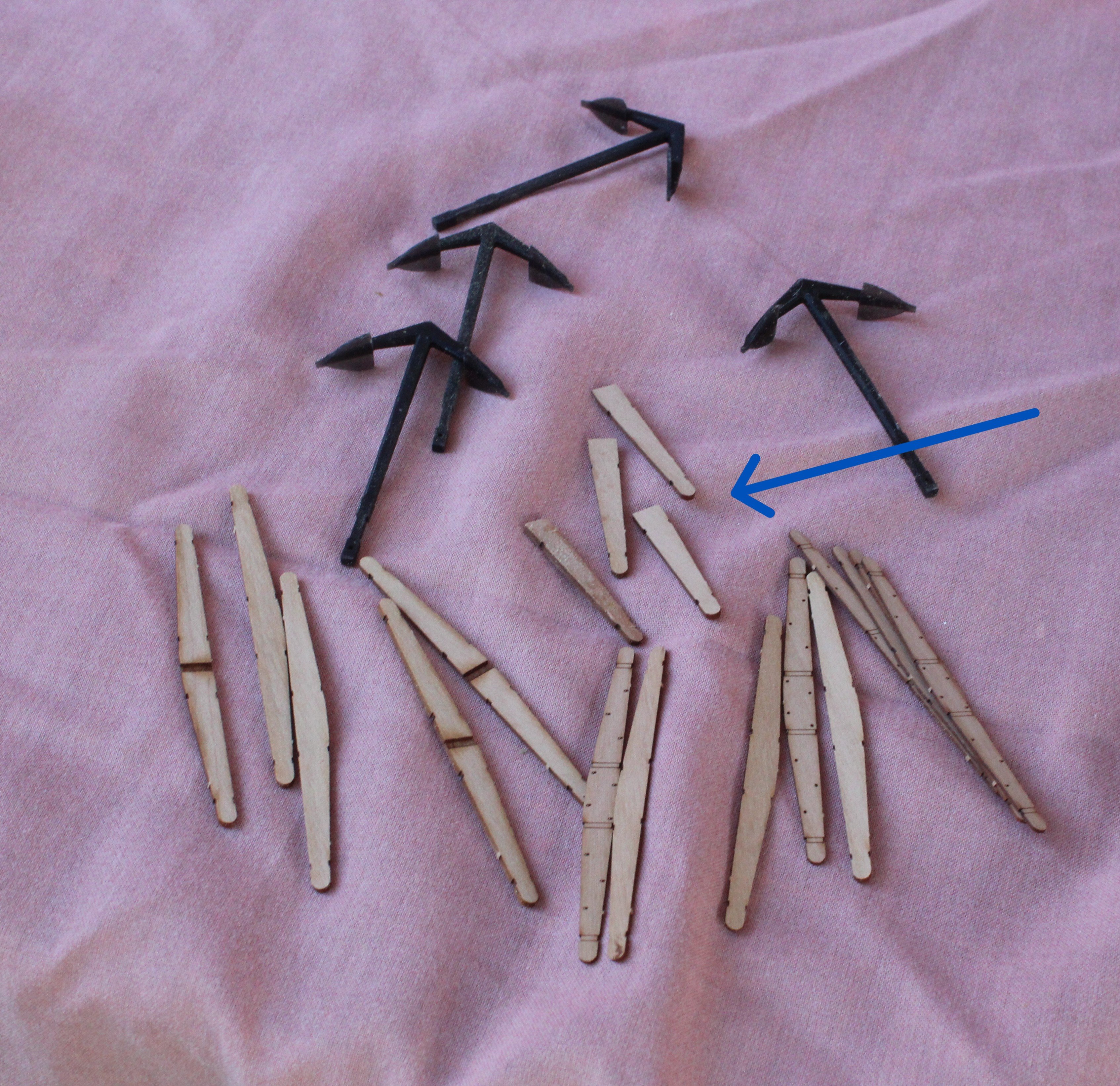

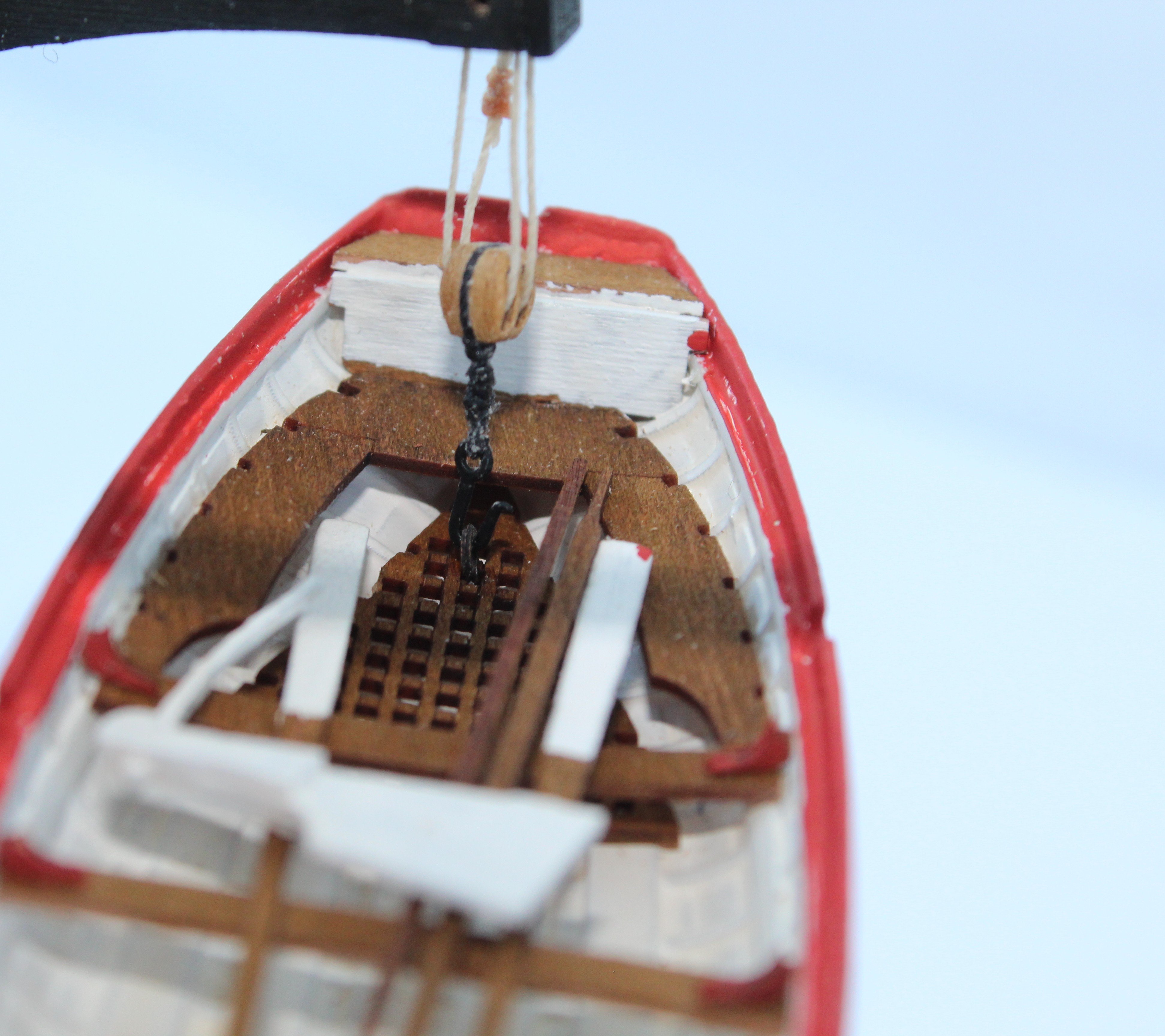

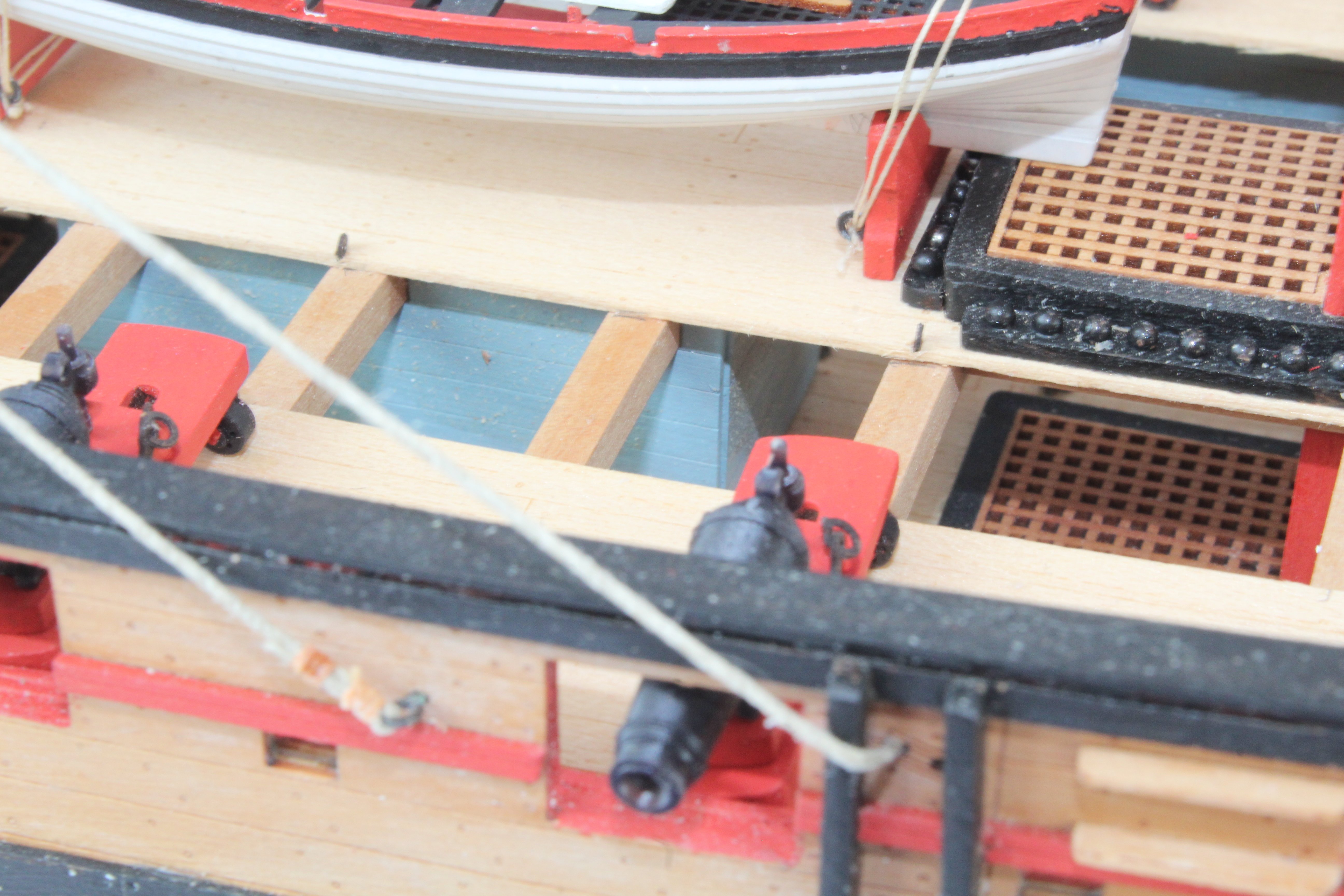

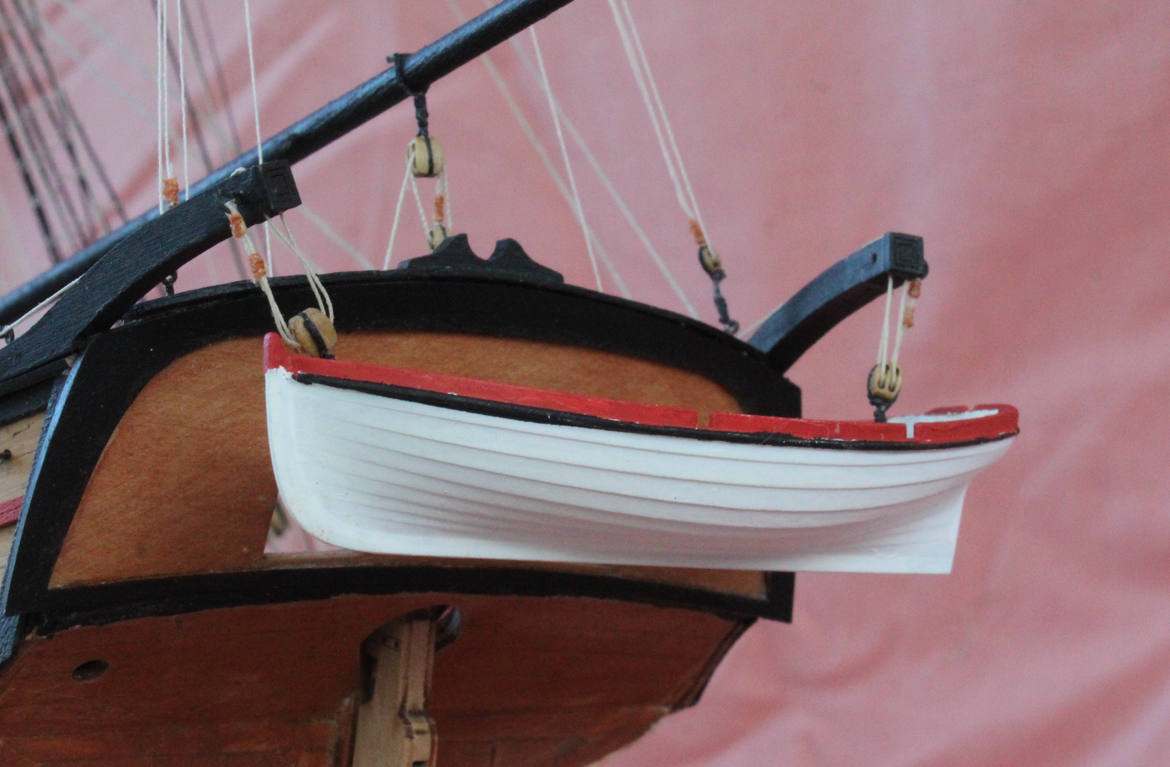

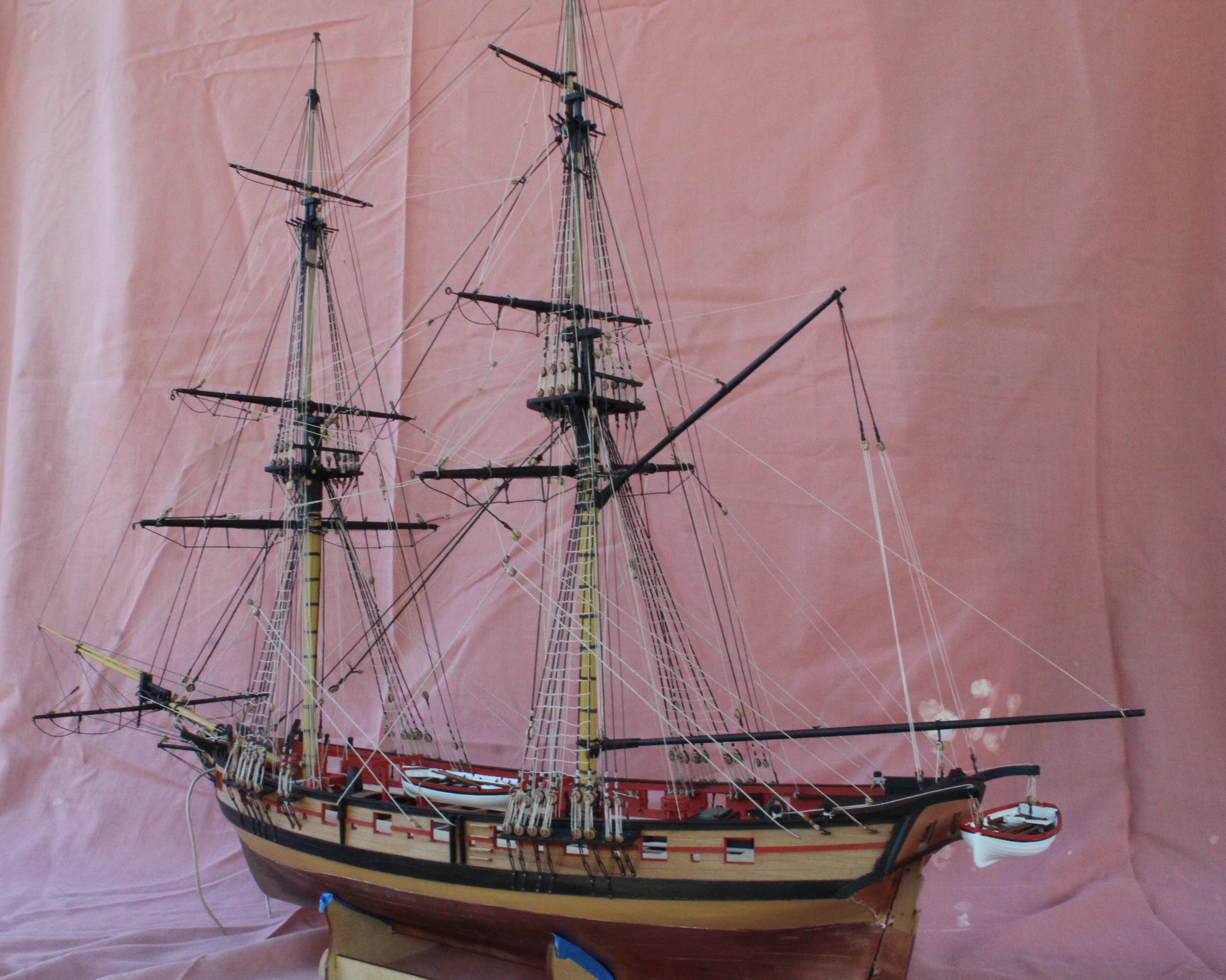

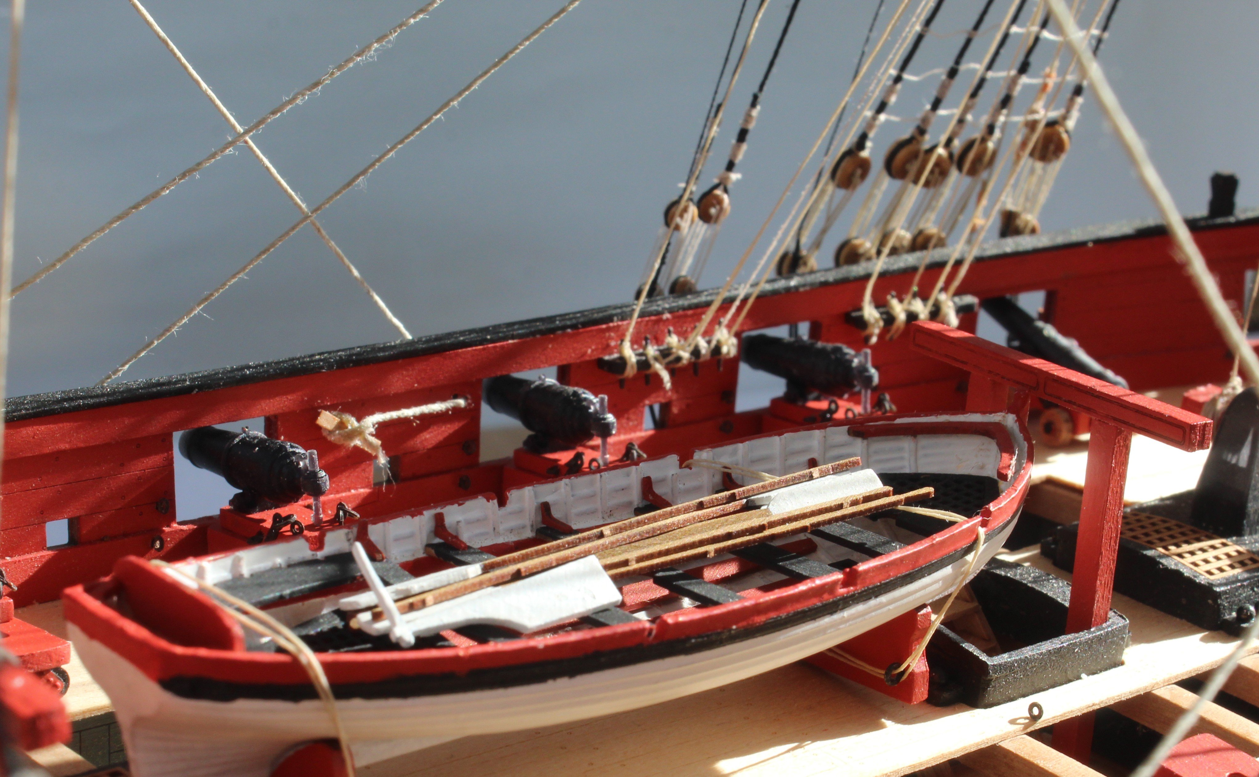

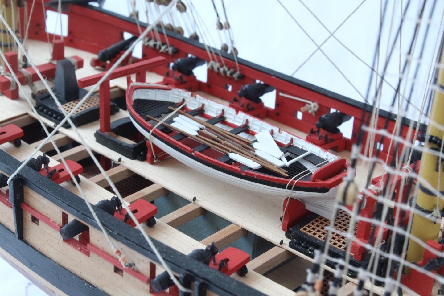

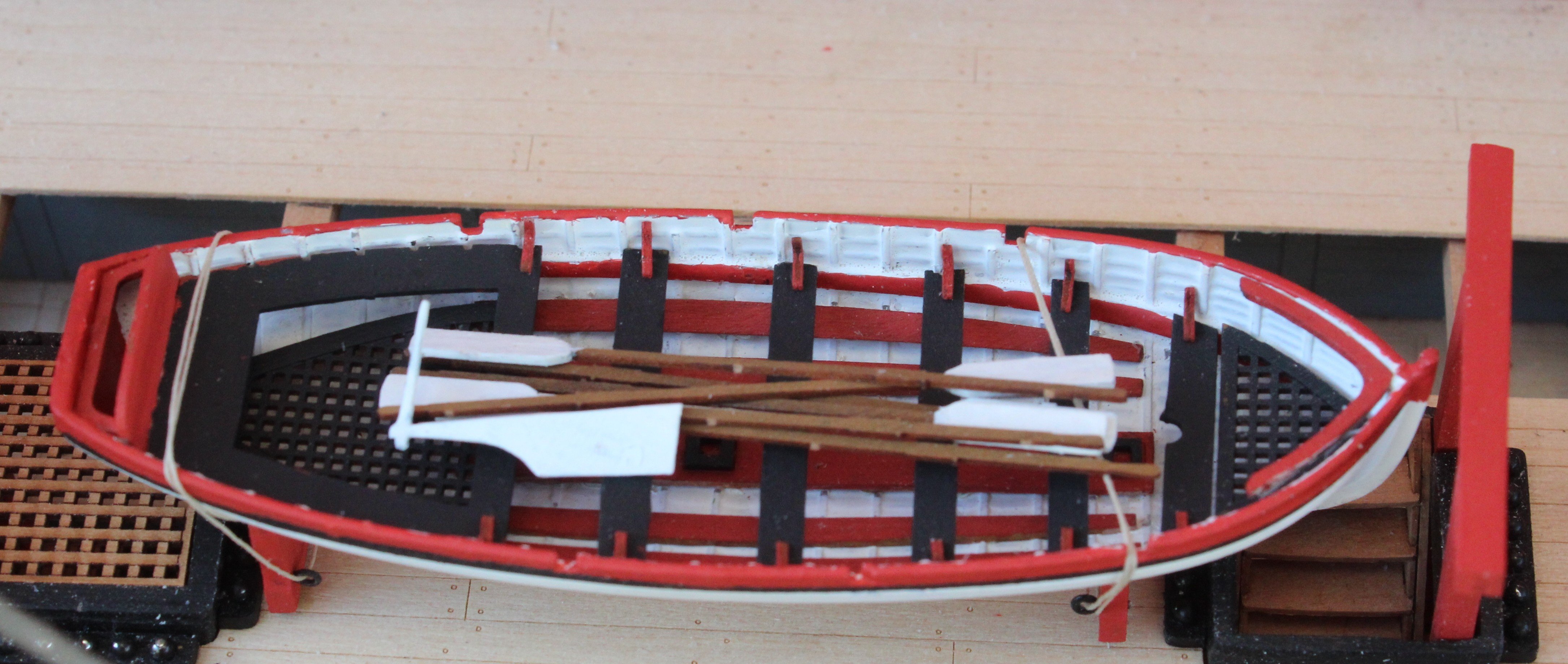

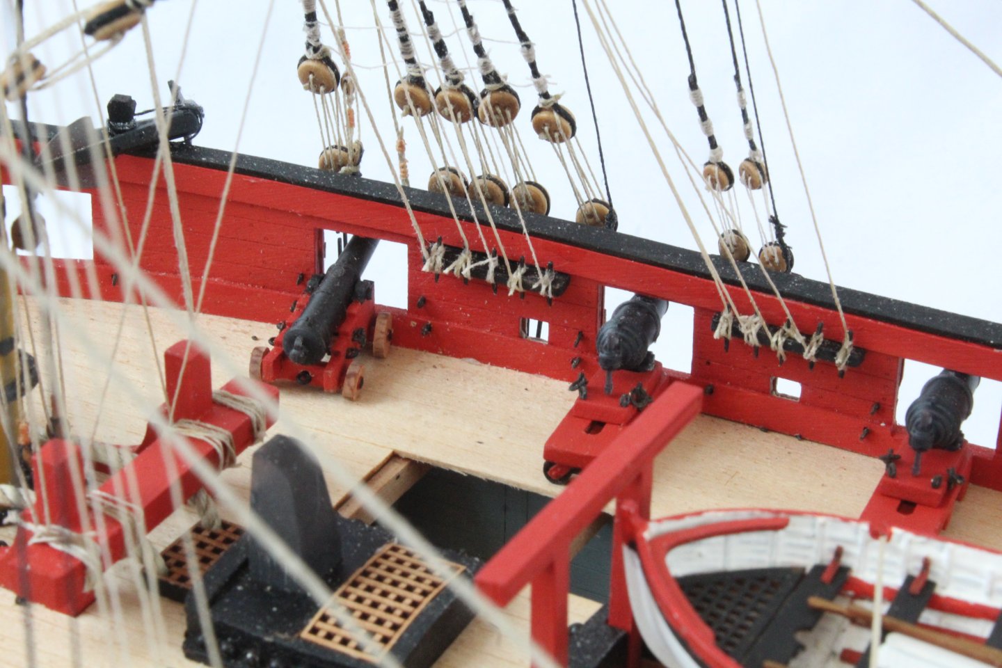

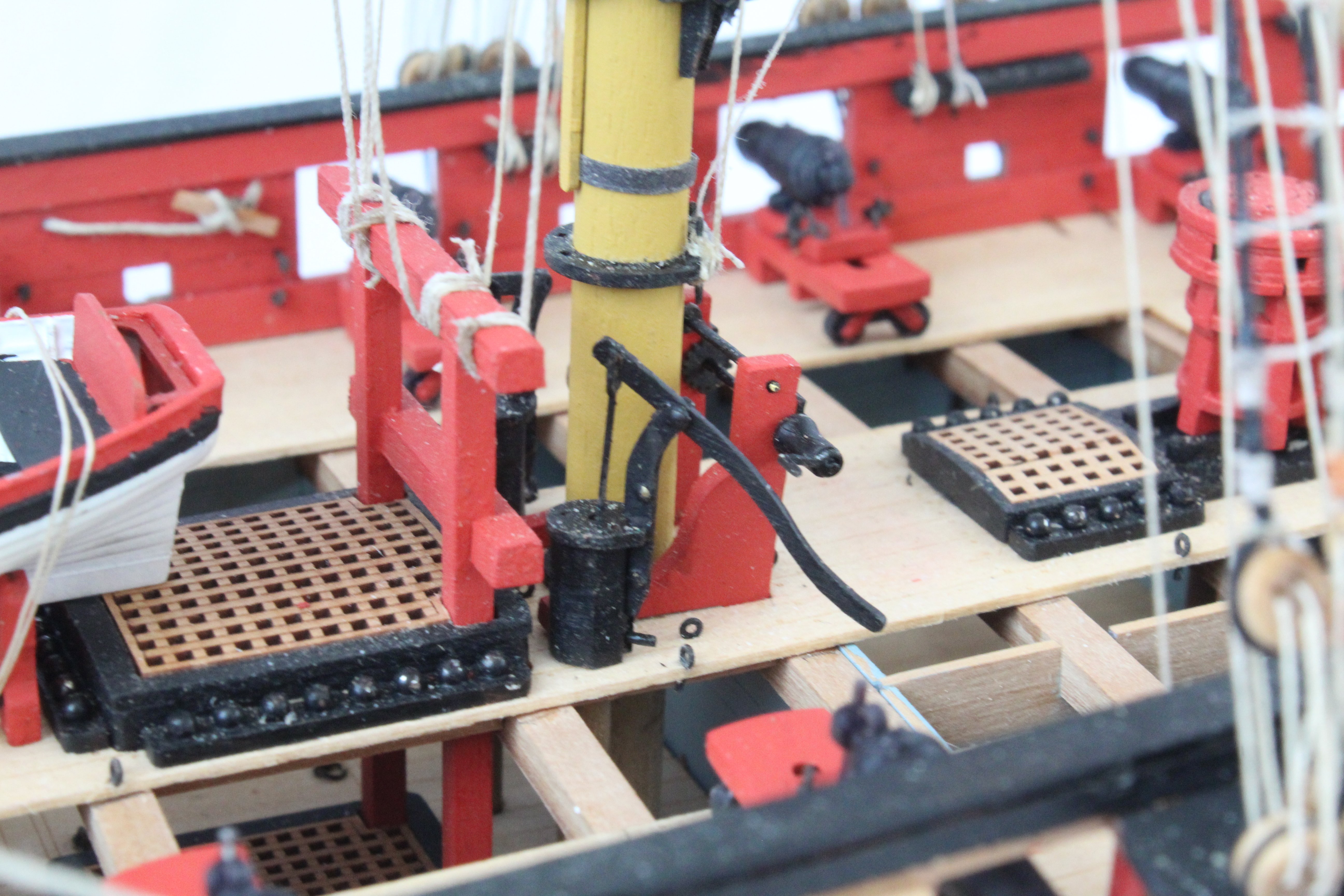

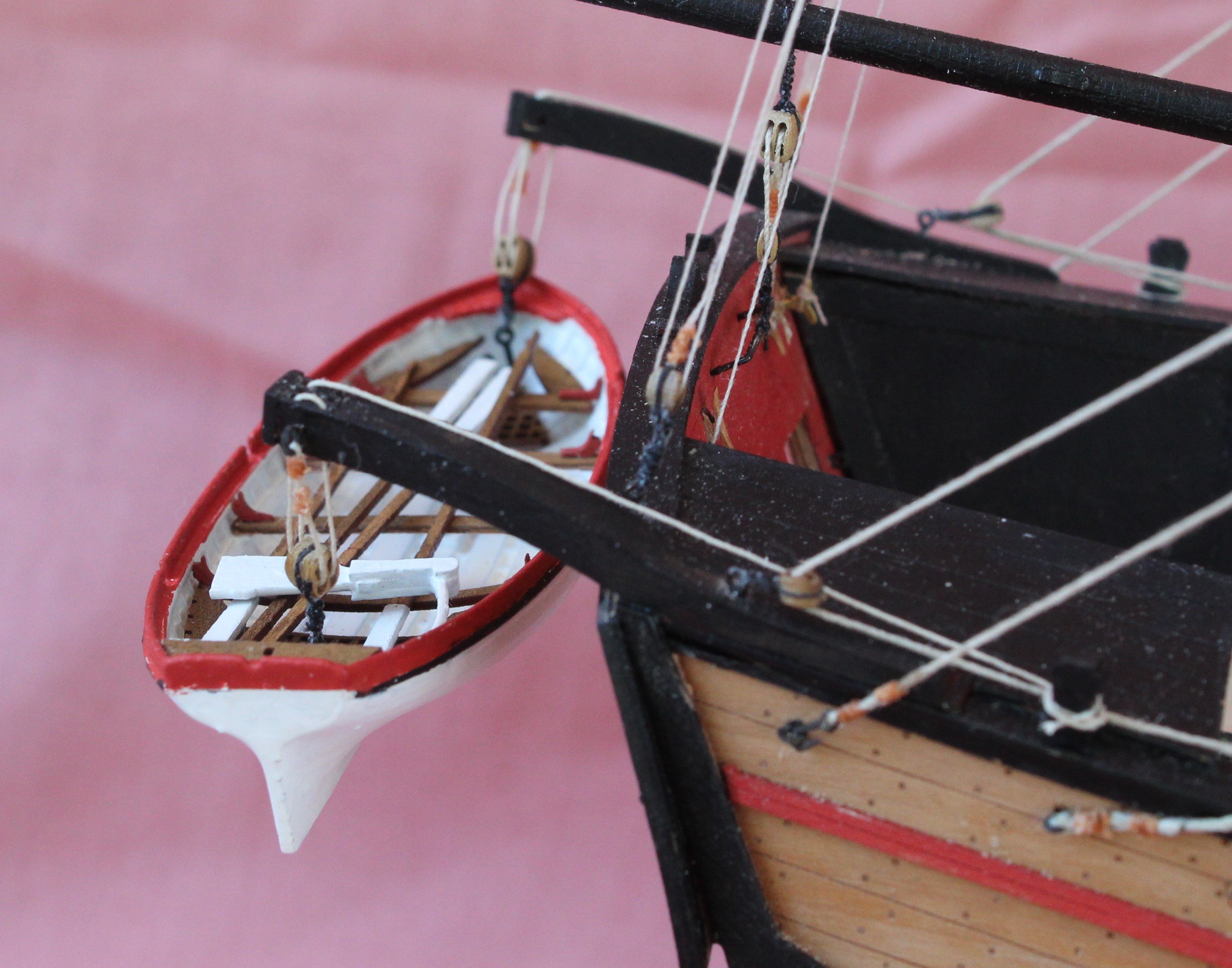

The end is in sight as I only have to install the weaponry, anchors and make the perplex stand. I have not added the bowline rigging. I am still in two minds weather to add these or not. I might redo the spritsail yard braces as it is currently (unintentionally) set at a jaunty angle to bowsprit.
The first task today was to hang one of the 18ft cutter from the rear of the ship. I opted to use a hook and eyelet to hold the cutter.
001.thumb.JPG.953022e89764f1c57367c6d1db296835.JPG002.thumb.JPG.6bdb1489250c1a068629d215c715b2f3.JPG003.thumb.JPG.9c35bebffbe8930fb223331f1bfa7c46.JPG004.thumb.JPG.9f6aa3e8e749cf5b8eb984ecf9356bed.JPGNext the 22ft cutter was added to the deck.
005.thumb.JPG.8b3f623a4991d27b1142d9f665bb97a7.JPG006.thumb.JPG.a19982b4285644f5ae711e0a8ead401e.JPGThe cannons have been brought out of storage and are ready to be added.

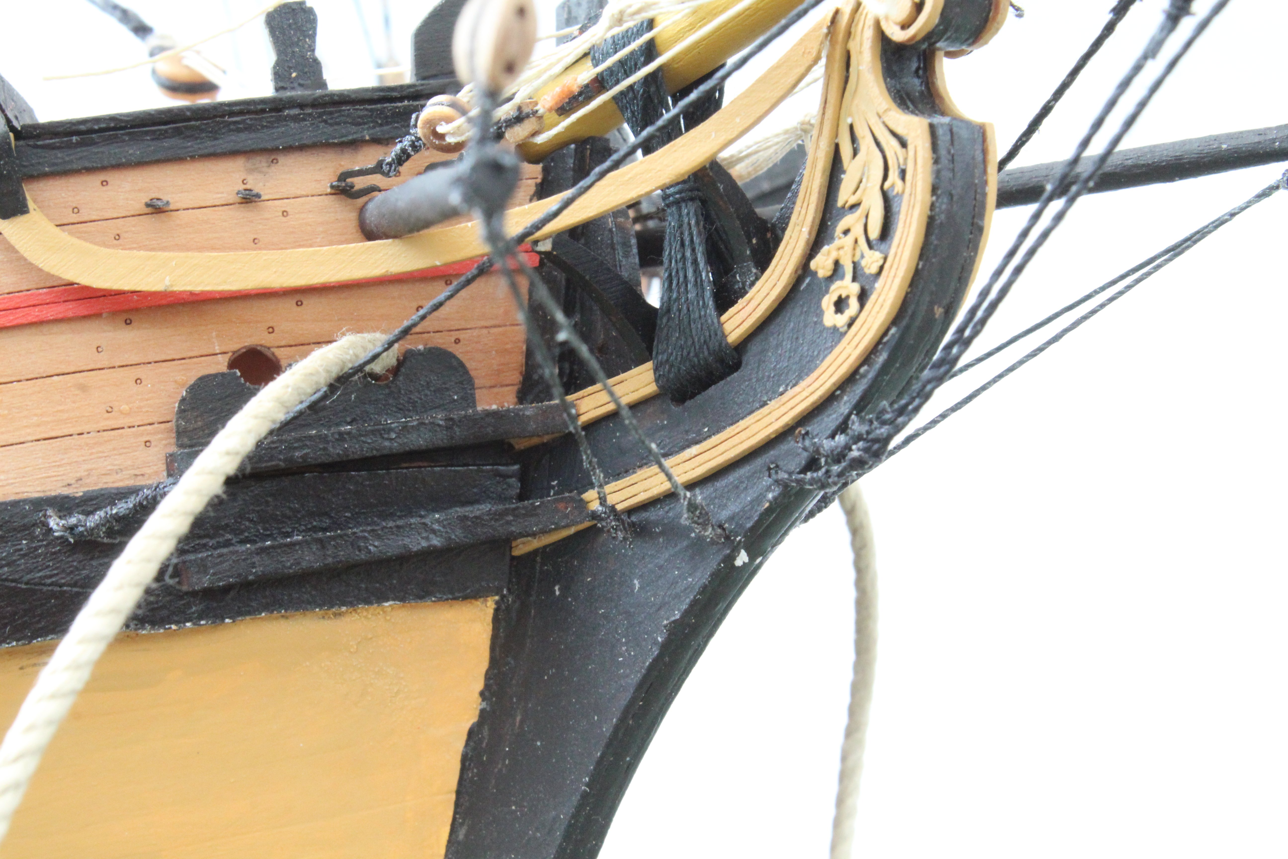

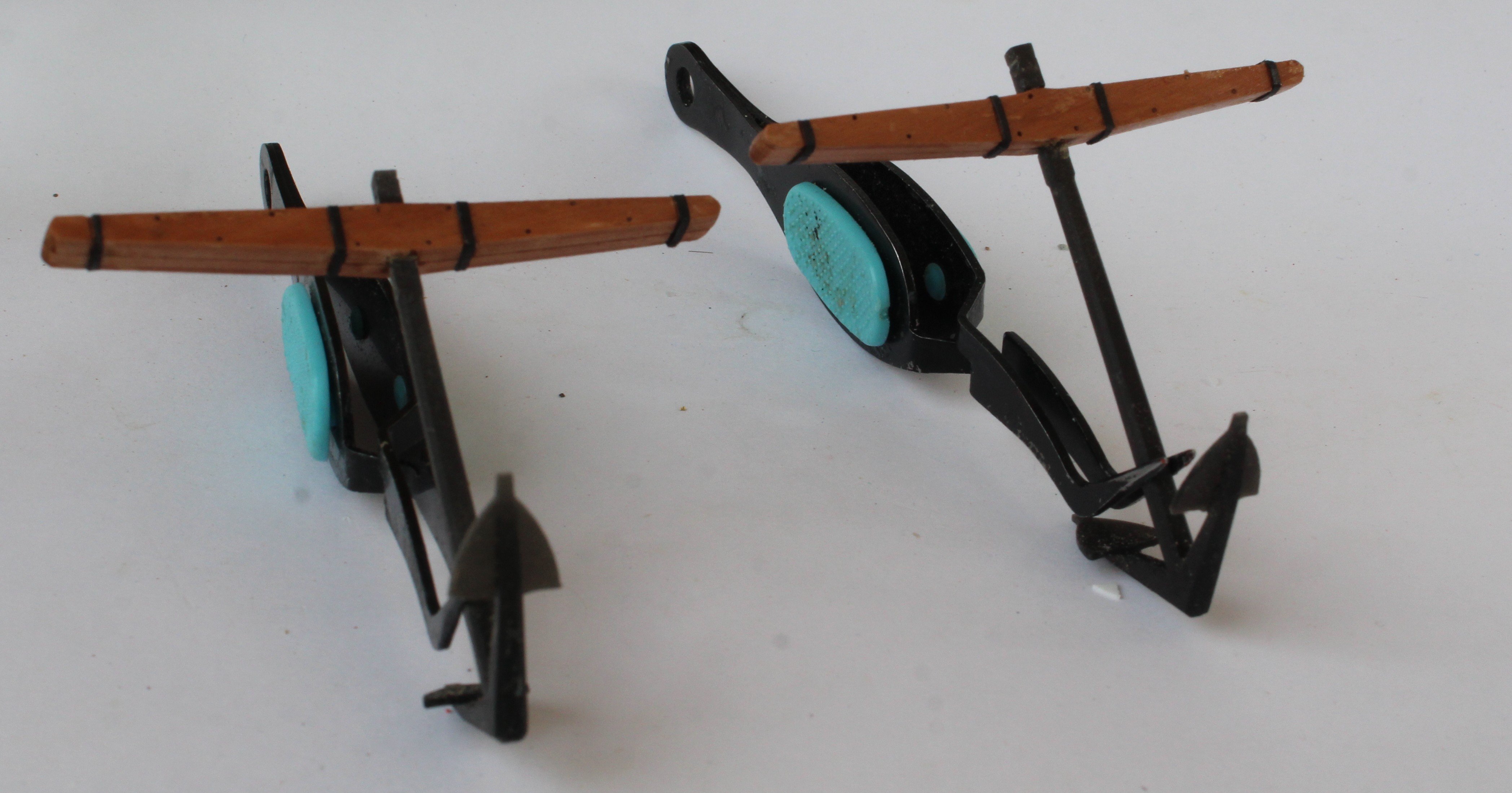

I am only planning to fit a set of anchors on this model. As can be seen in the photo below I have had a few issues with breakages.
After much deliberation I placed an order for the The Baltimore Privateer Schooner Grecian as I think this fits in better with the timeframe to complete and to then be ready for the release of the Surprise. The Grecian is not a boat that really appeals to me but I think it will be an interesting project to complete nonetheless

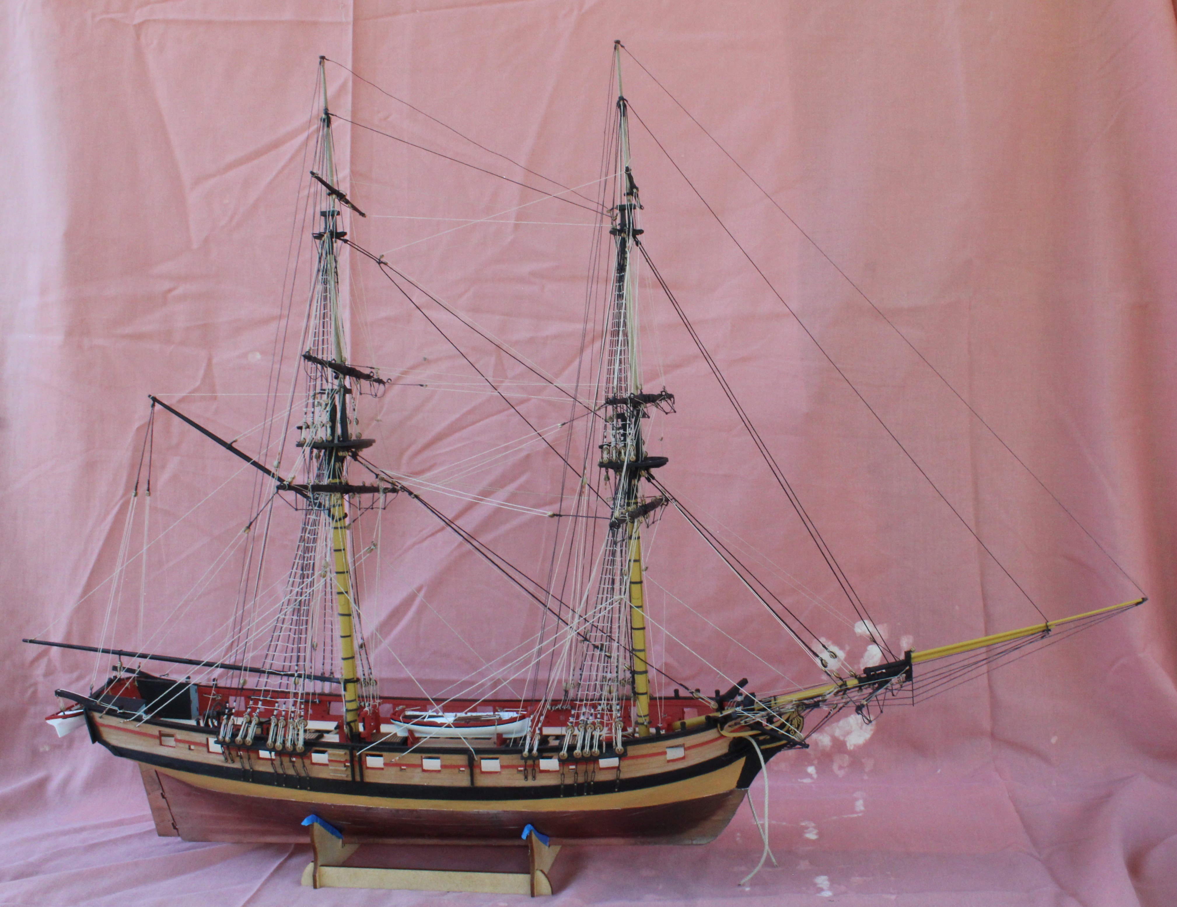

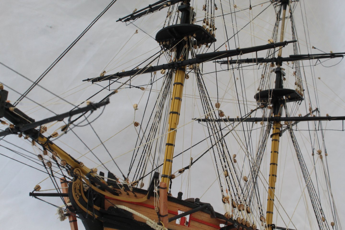

I have taken a few photos of the current Harpy build status, as shown below. The white blotches on the background are paint stains as the backing used is an old decorating dust cover.
009.thumb.JPG.1483c3f24a25b9e6471fda62b0690550.JPG010.thumb.JPG.14963d0968a105e17aaa708057d8162f.JPG011.thumb.JPG.76e6af12b52744ff0d0adb0d61f0feb2.JPG013.thumb.JPG.d6f6738dc154df9983966e949988b11e.JPG014.thumb.JPG.7b8f70587332cb7525805b7fc77f9e16.JPG015.thumb.JPG.c3505b86395050a88e6697b29e4dbae8.JPG
Glenn (UK)

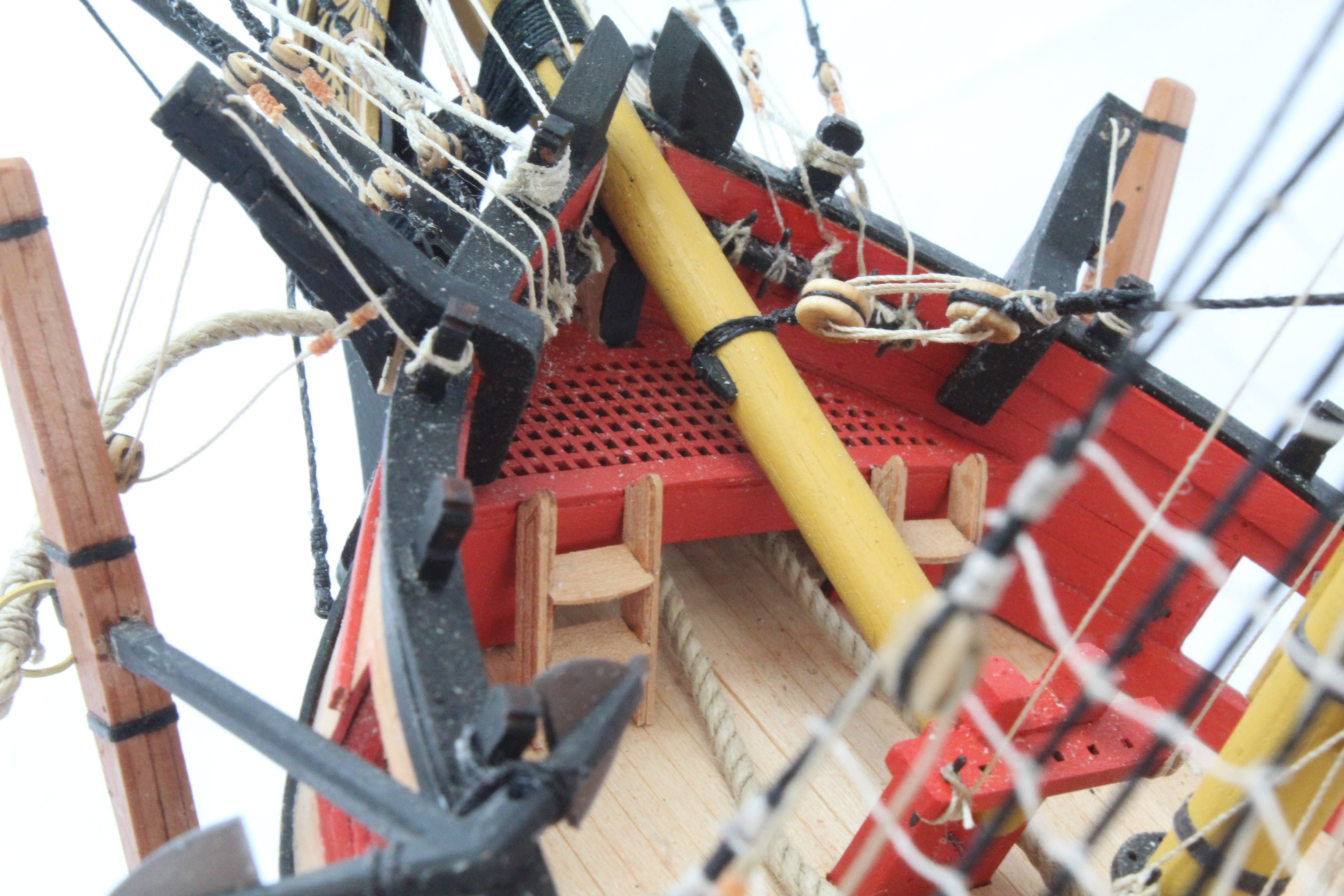

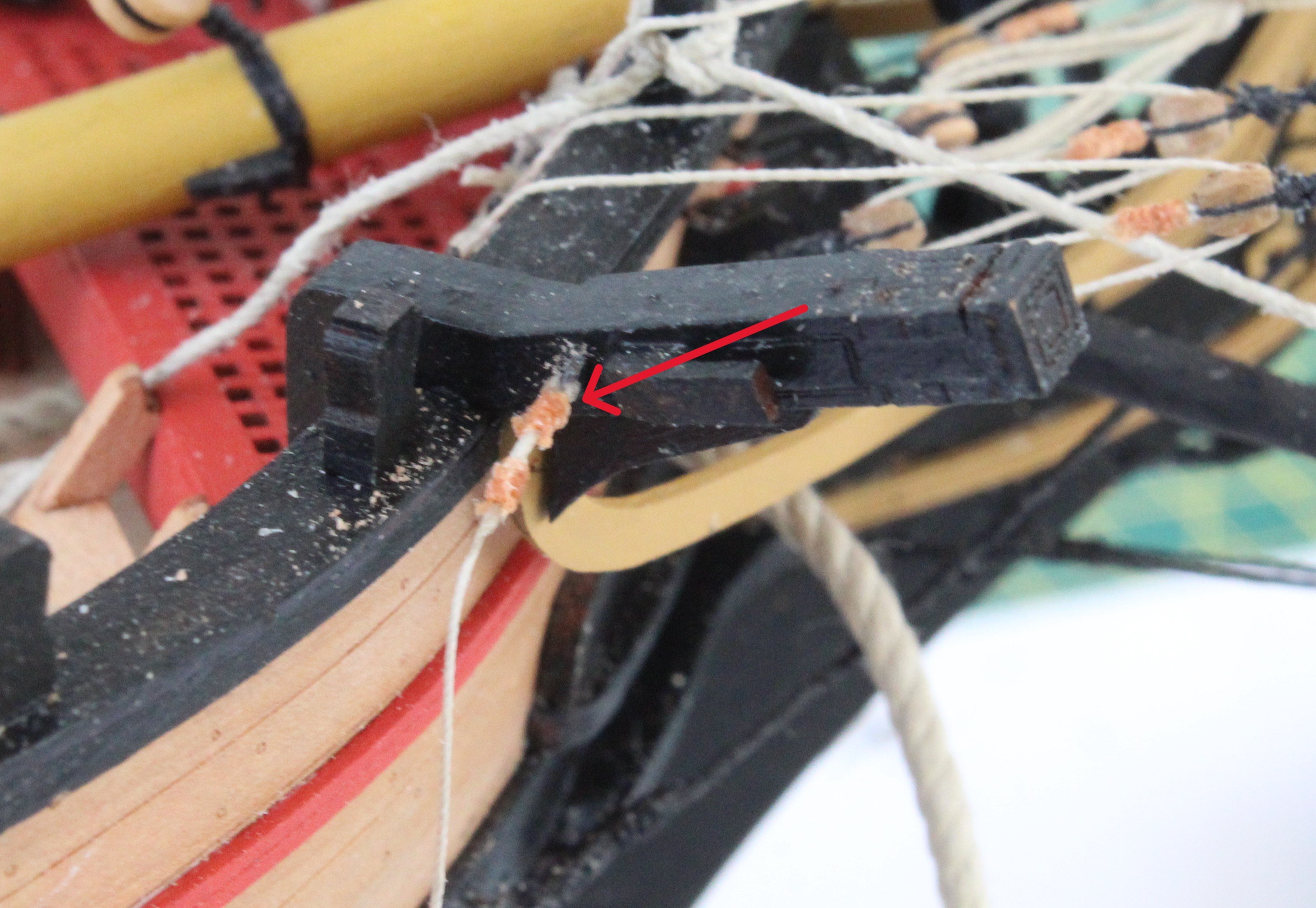

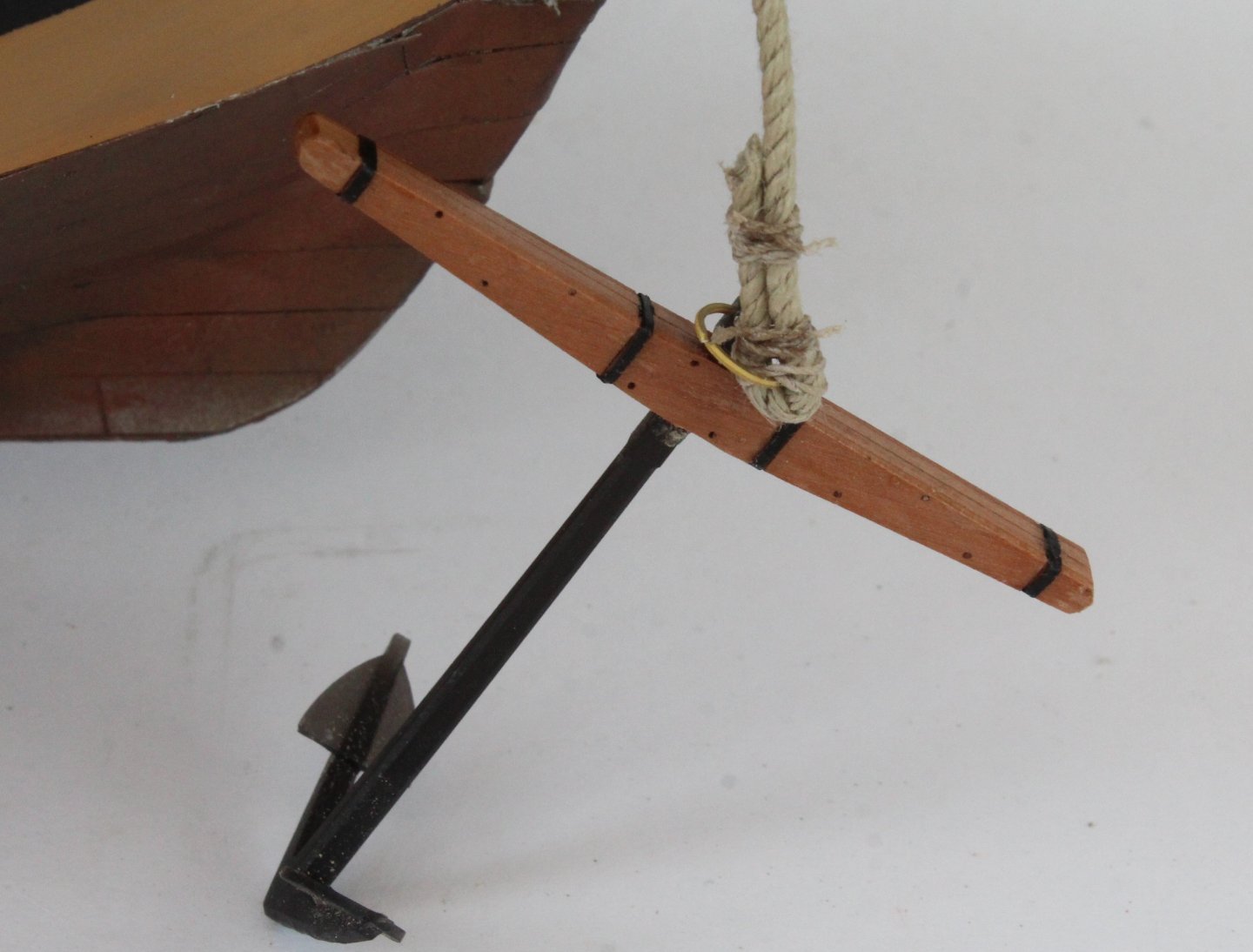

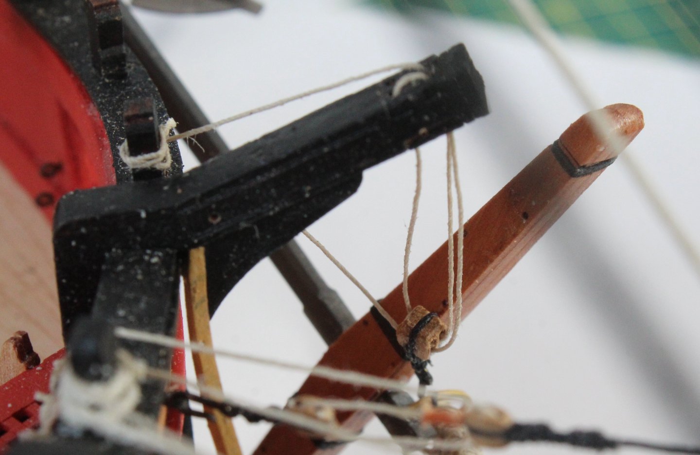

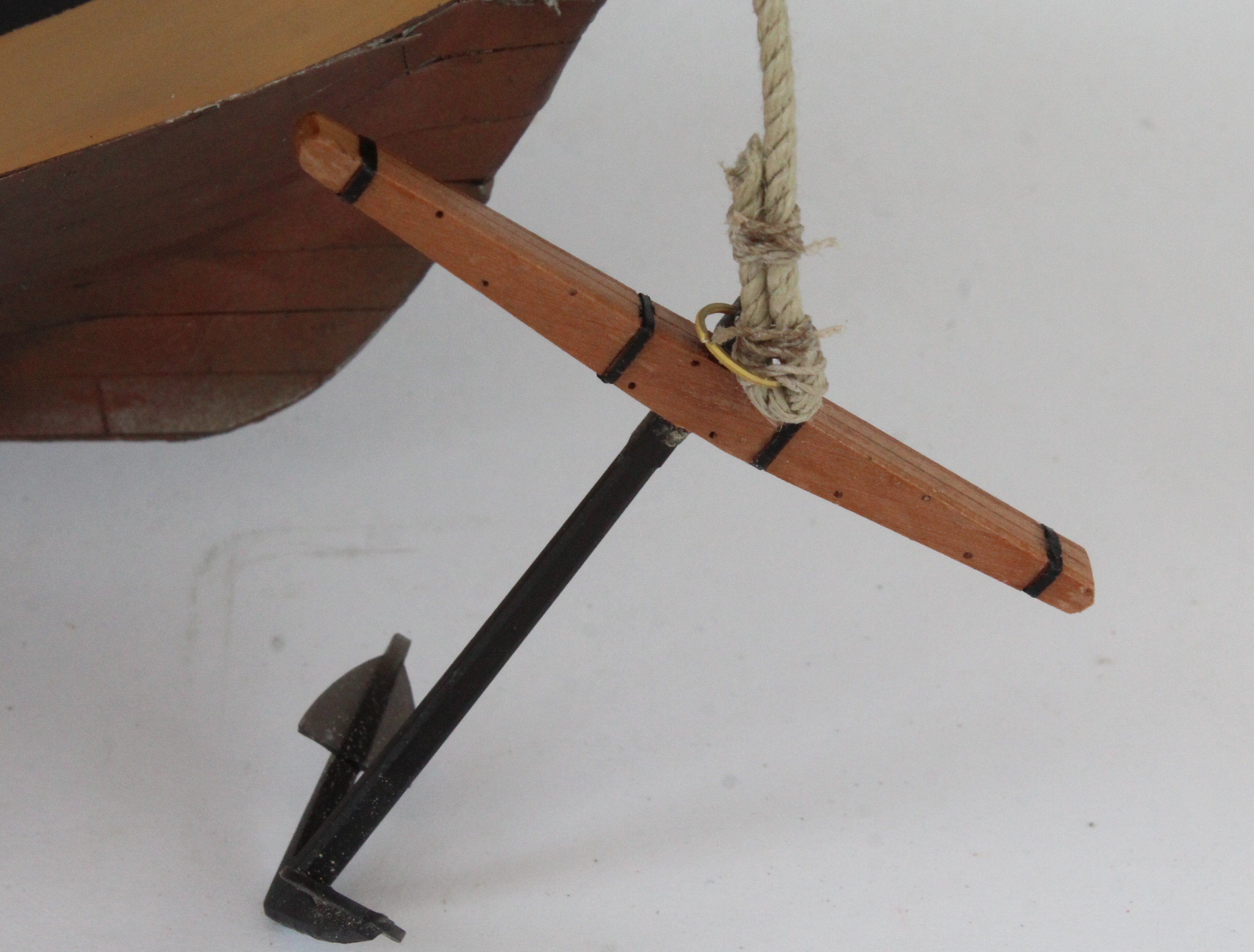

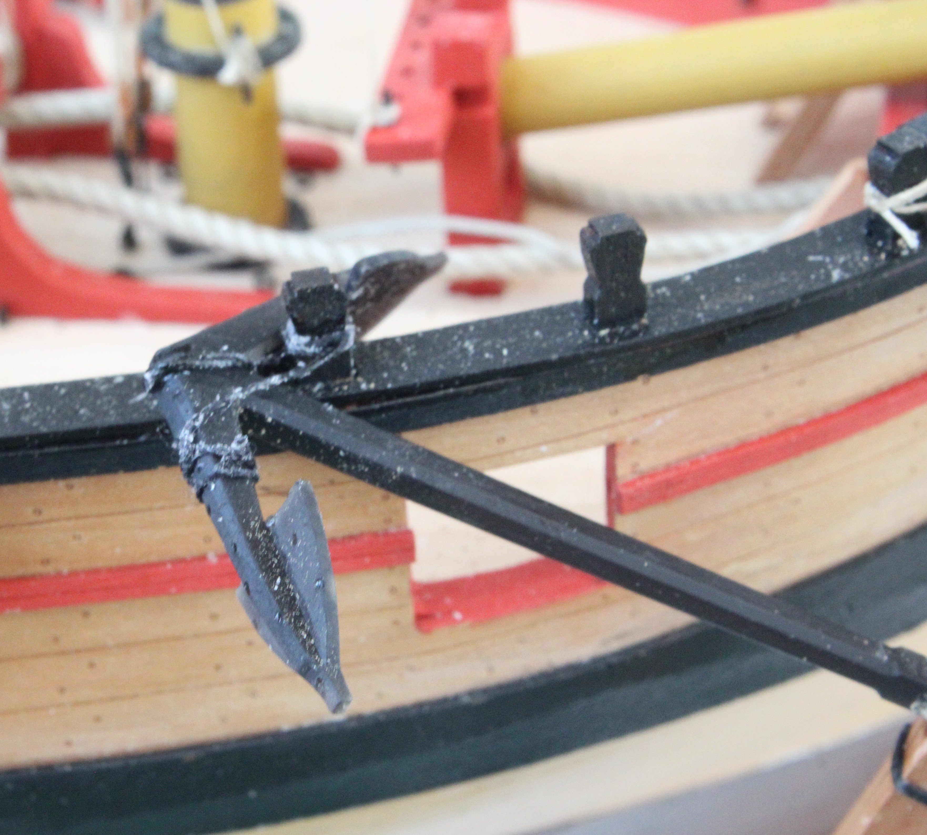

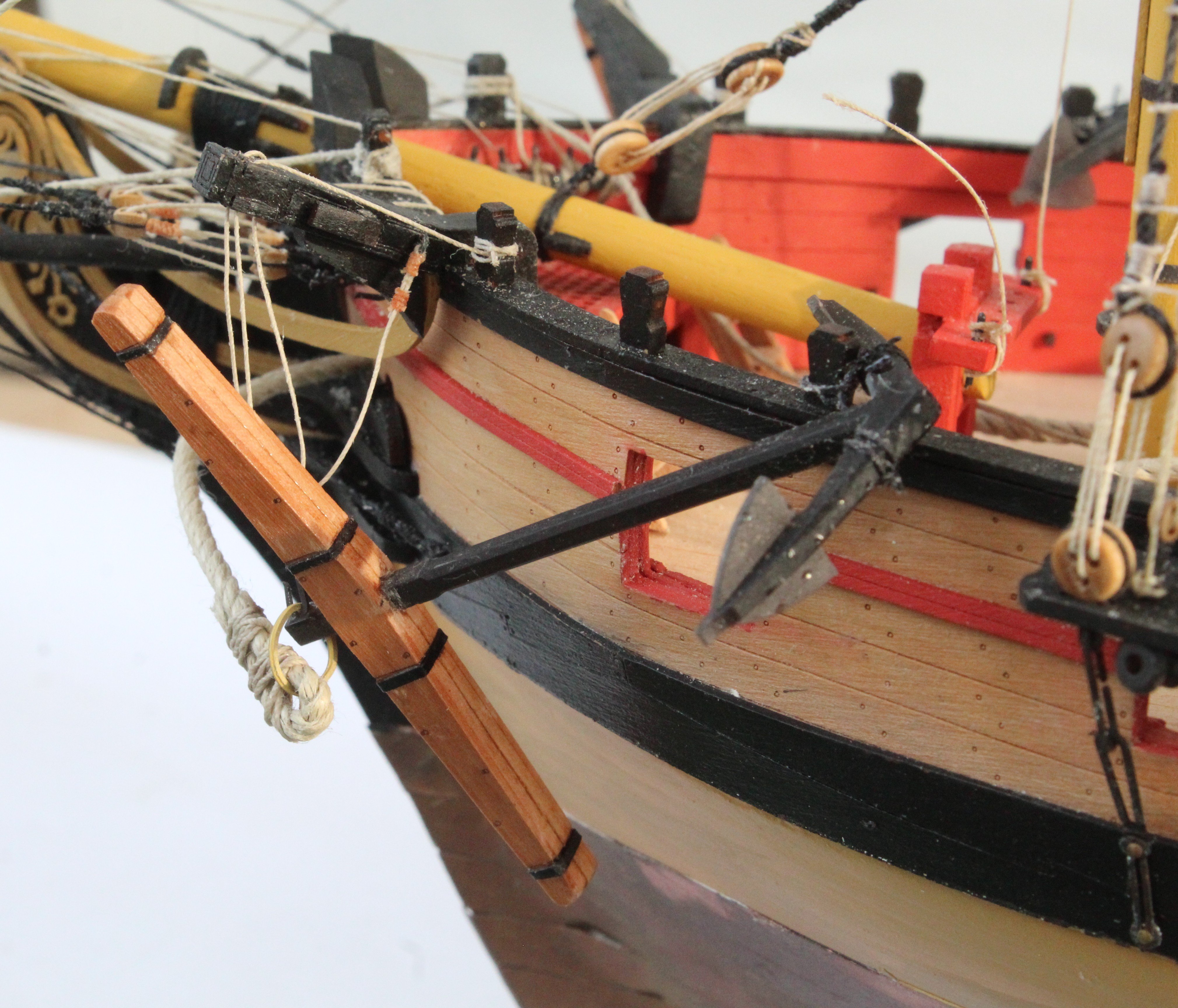

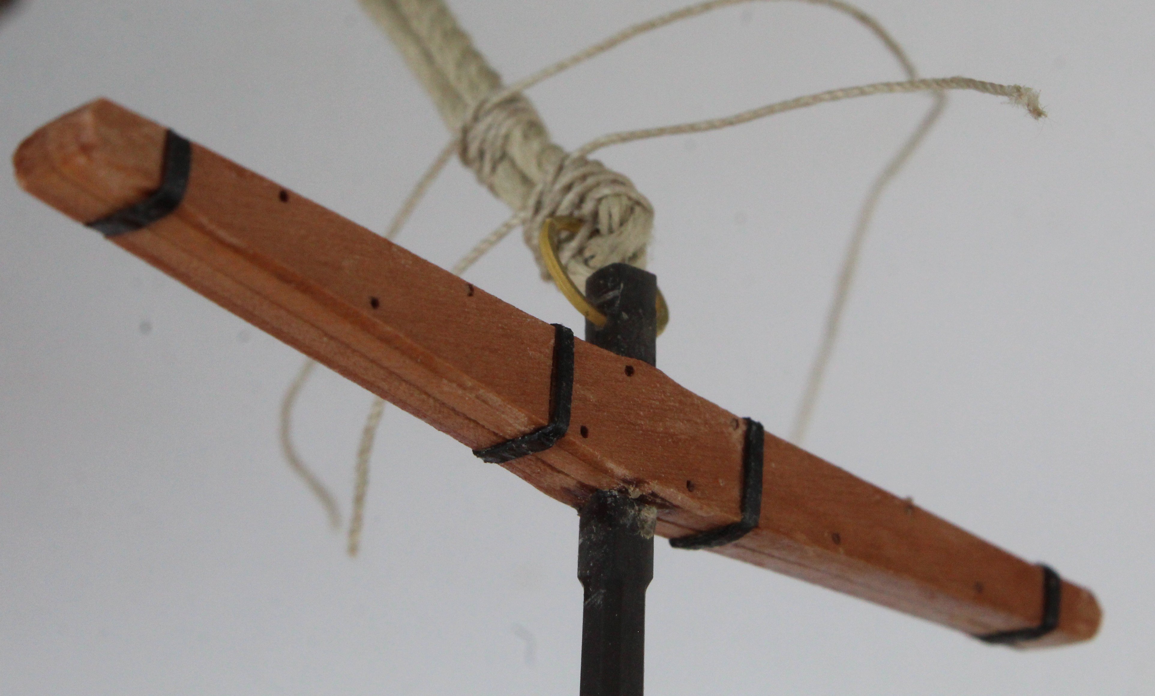

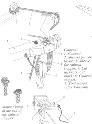

Working on fitting the anchors today. I am using the following picture as the basis for this task.
The first task was to seize the hawse rope to the anchor, as is shown in the next two photos.
001.thumb.JPG.8528abefb87067f66b8500d37f30b392.JPG002.thumb.JPG.52b258270020c8a631455def725869f9.JPG

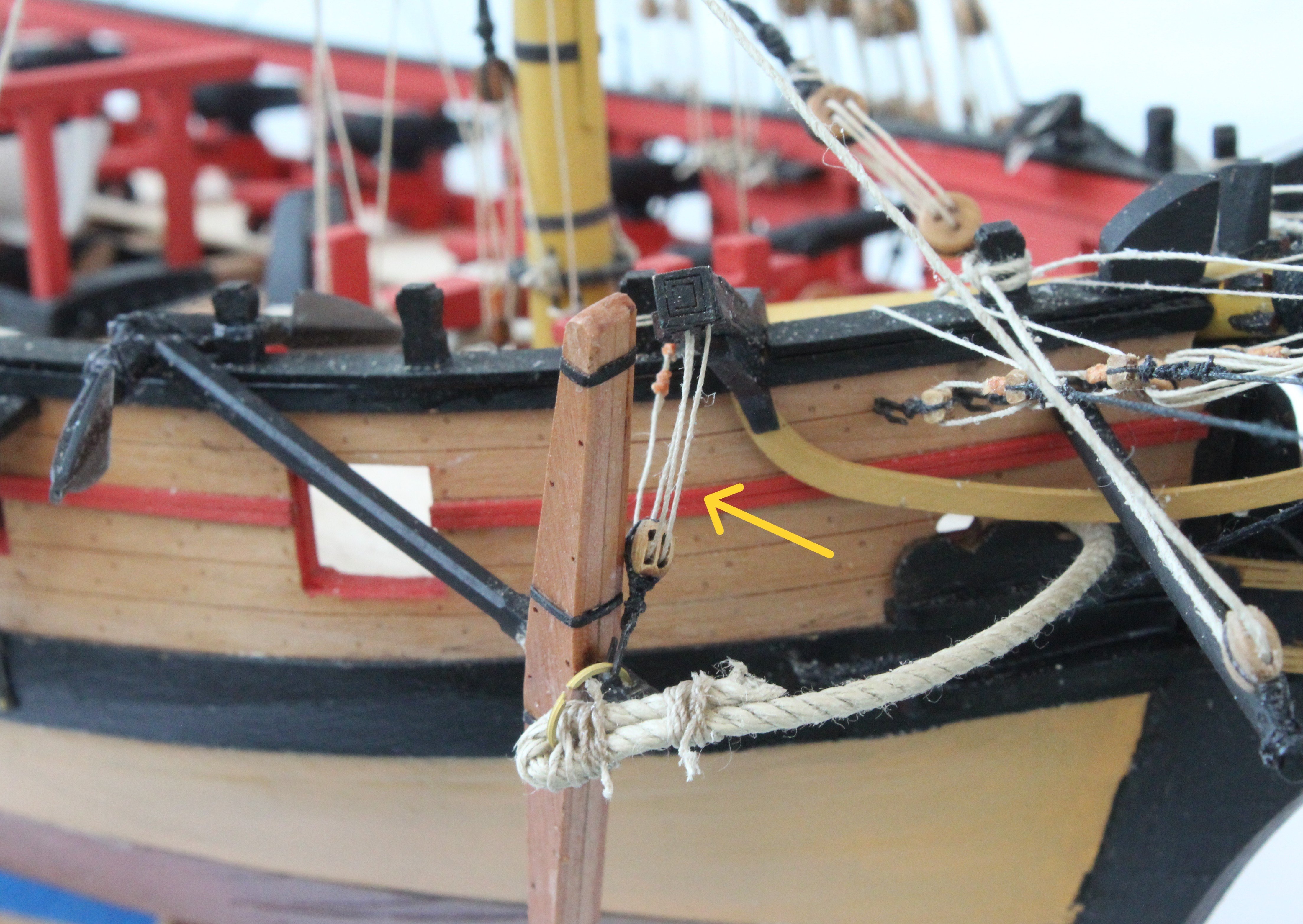

Next an eyebolt, seized with some 0.25mm natural thread was added to the cathead.
The rigging was then reeved through the double block and the cathead, noting I had a senior moment and inexplicably forgot to reeve, as it drops down from the cathead, back through the double block, as can be seen in the next photo.
The anchor was then secured to a timberhead.

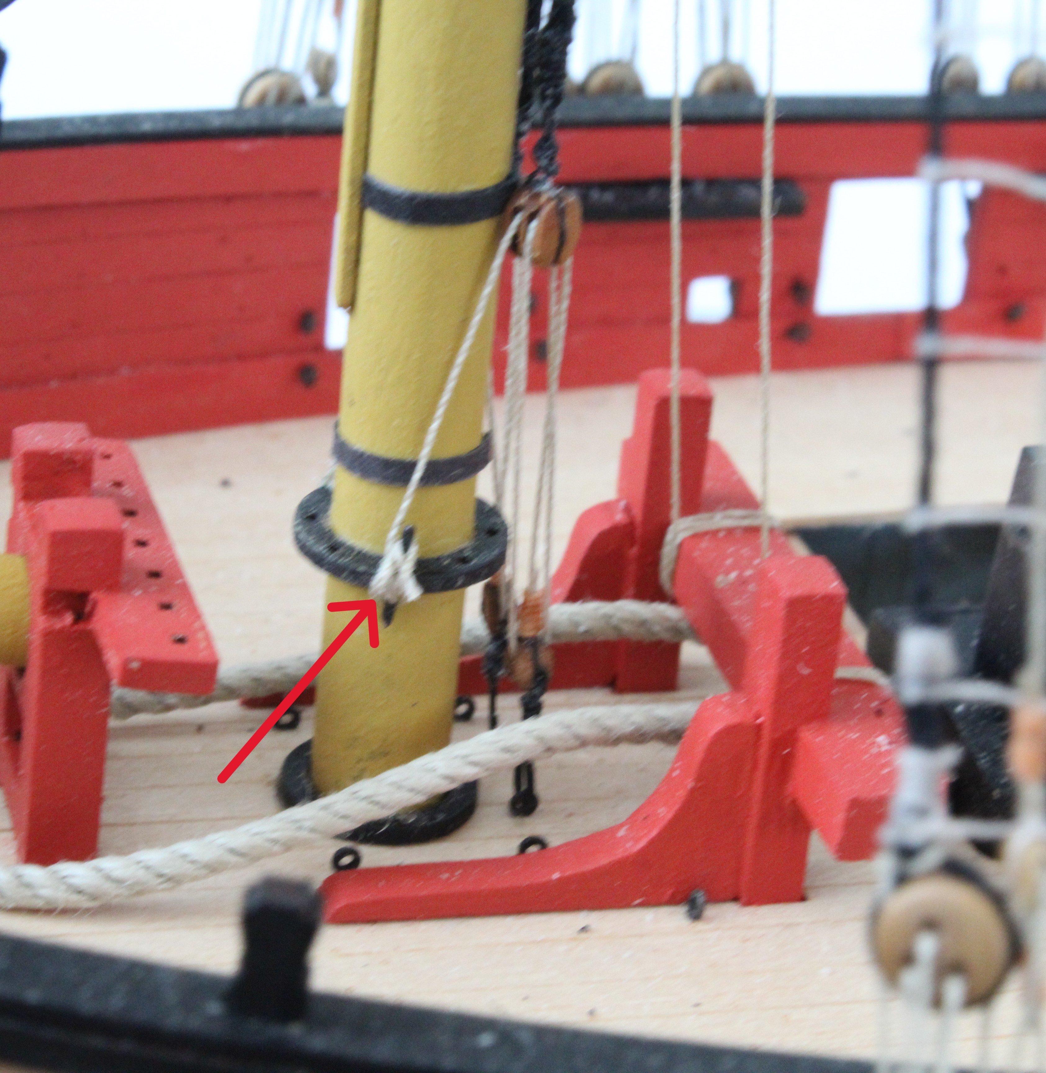

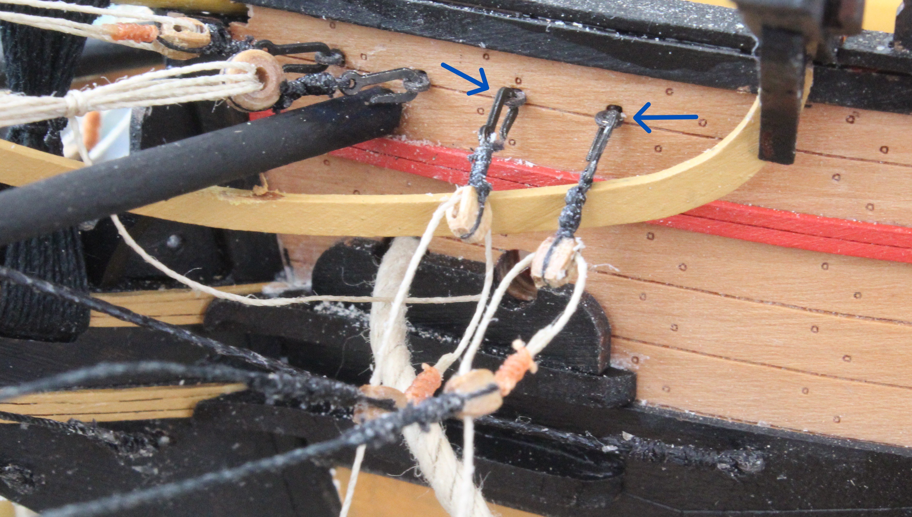

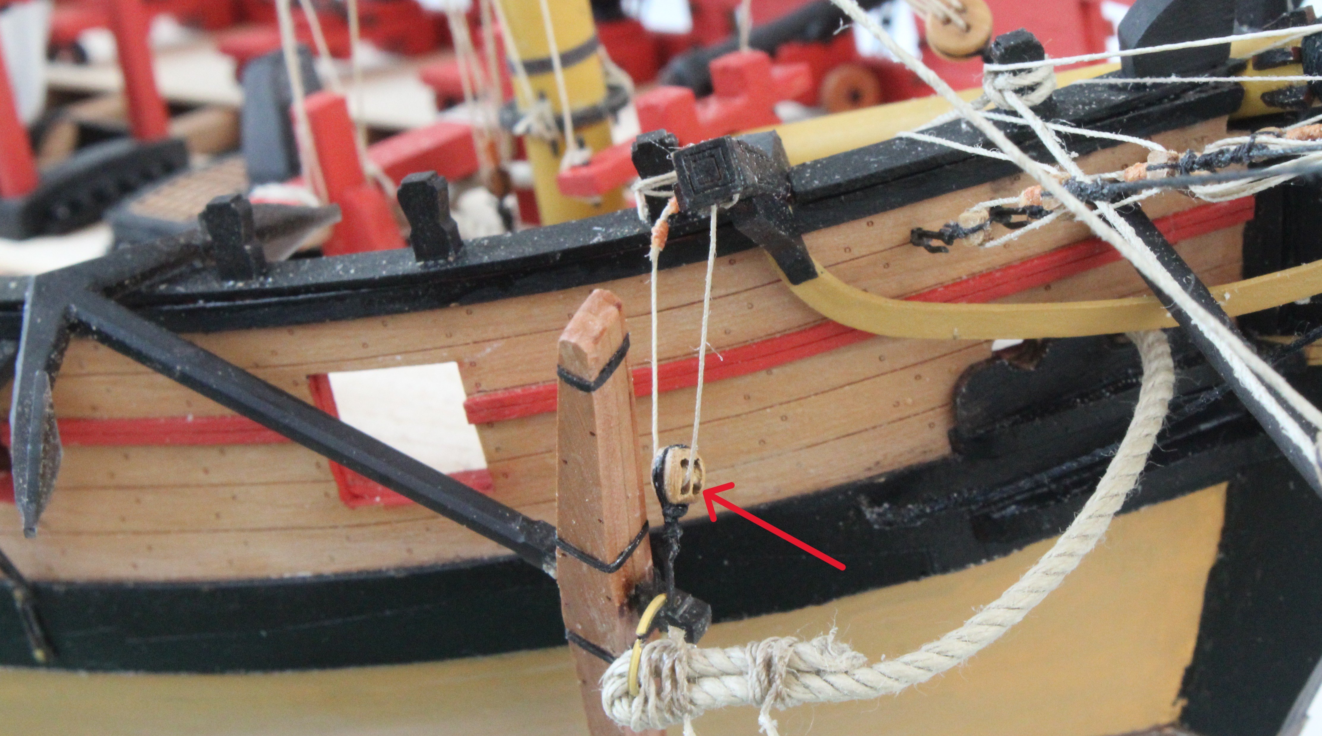

The completed anchor fitting is shown below, noting I have not corrected my error. In the interest of being correct I should correct my mistake but I am not sure if I can be bothered at this stage, noting once built the Harpy will not be on display. My enjoyment is in the building of the models and once completed the tend to languish on the sidelines.
I do have two small Vanguard model fishing boats on display in our living room and my completed Sphinx model is currently on display in our dining room. I did sell my completed Indefatigable model to a Captain Horatio Hornblower fan where it is on display and can be appreciated.

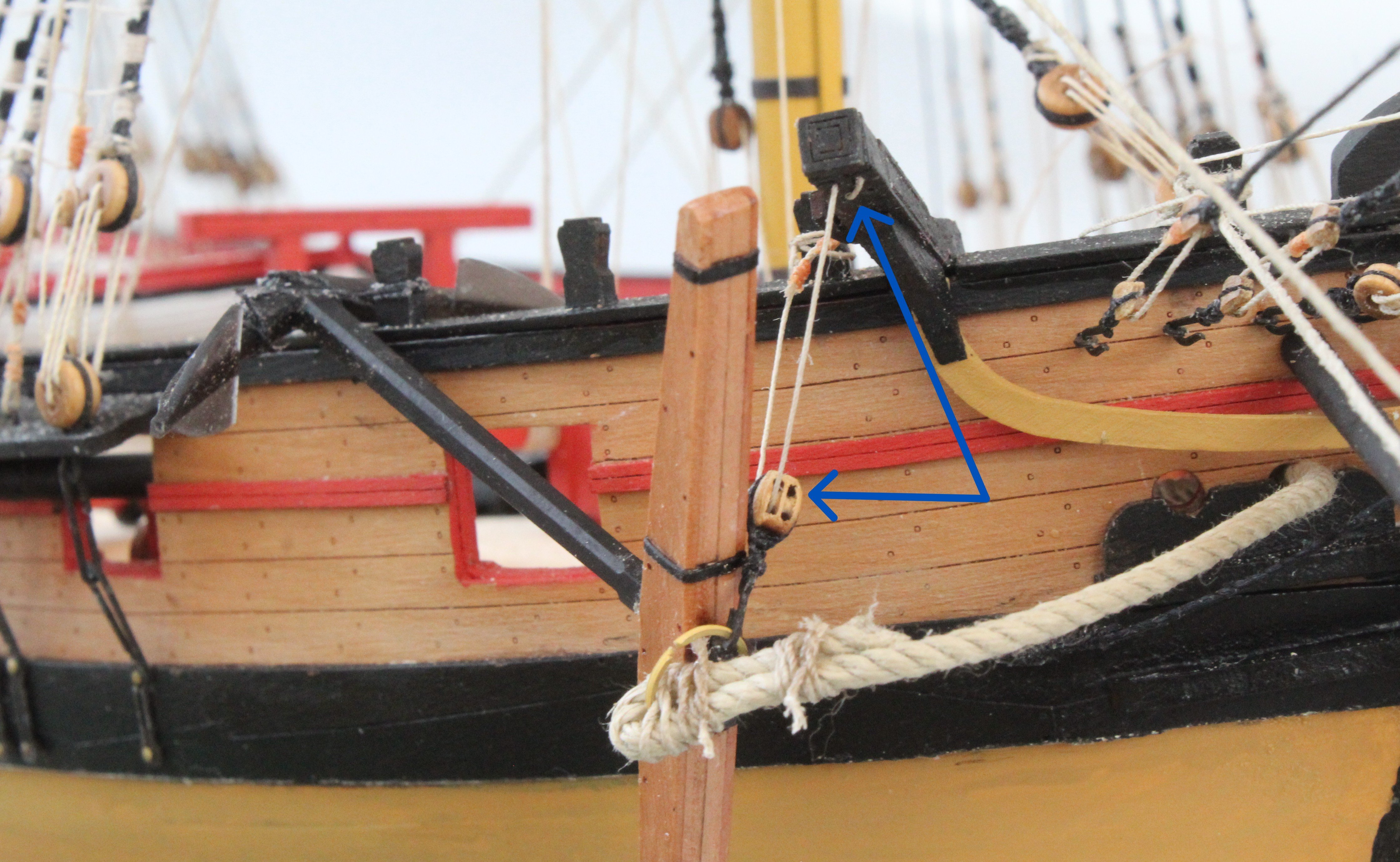

I will repat the above for the port side anchor and this time I will try to reeve the thread correctly.
Glenn (UK)

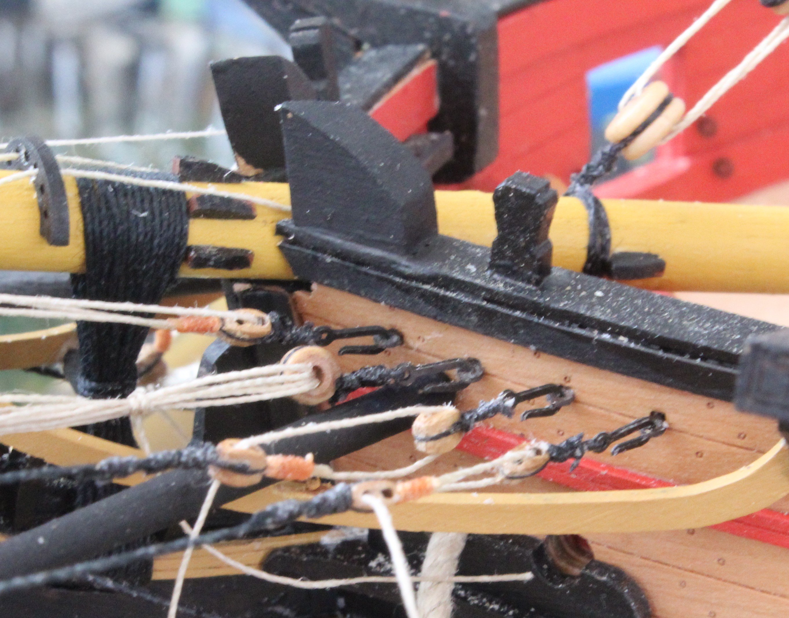

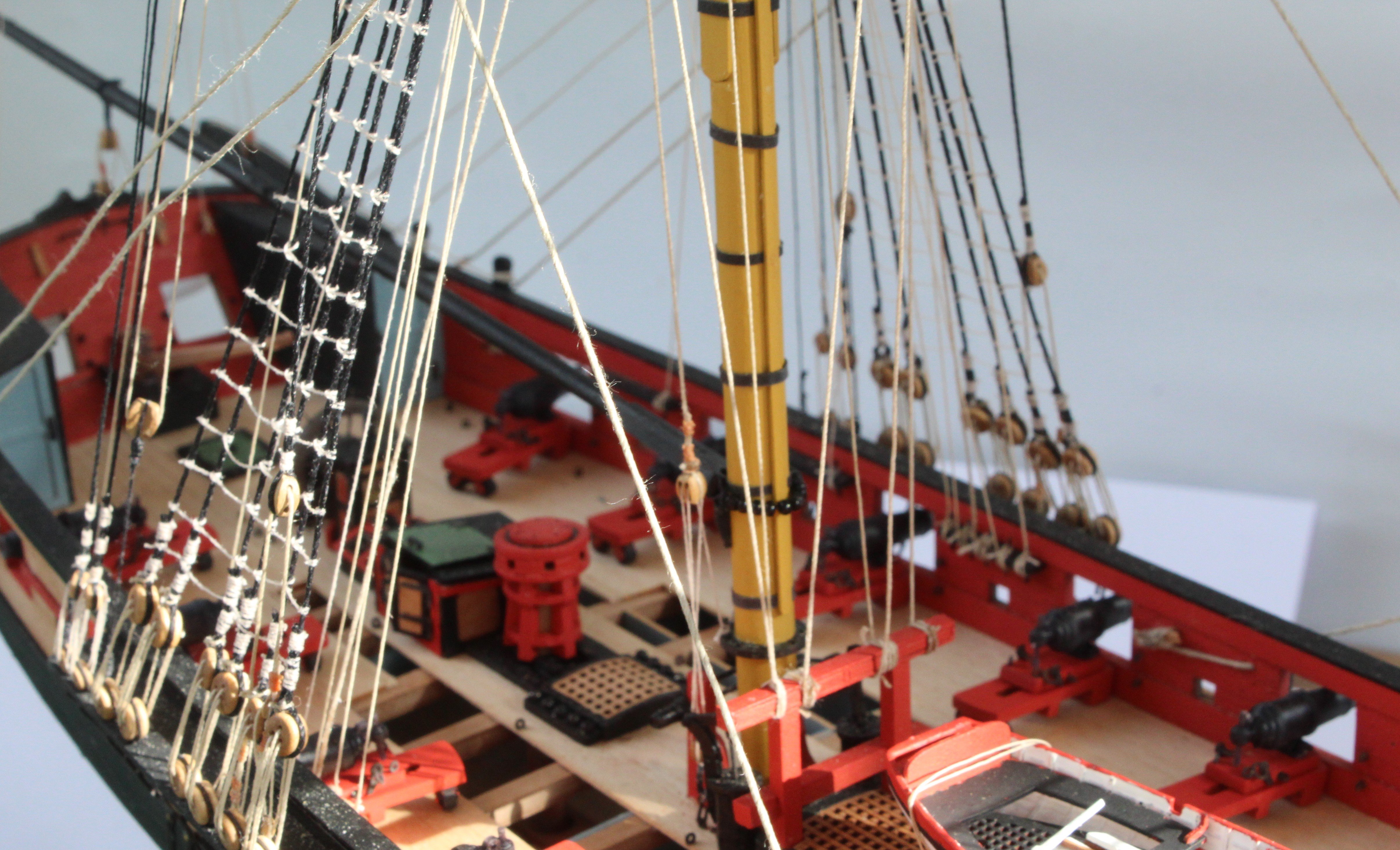

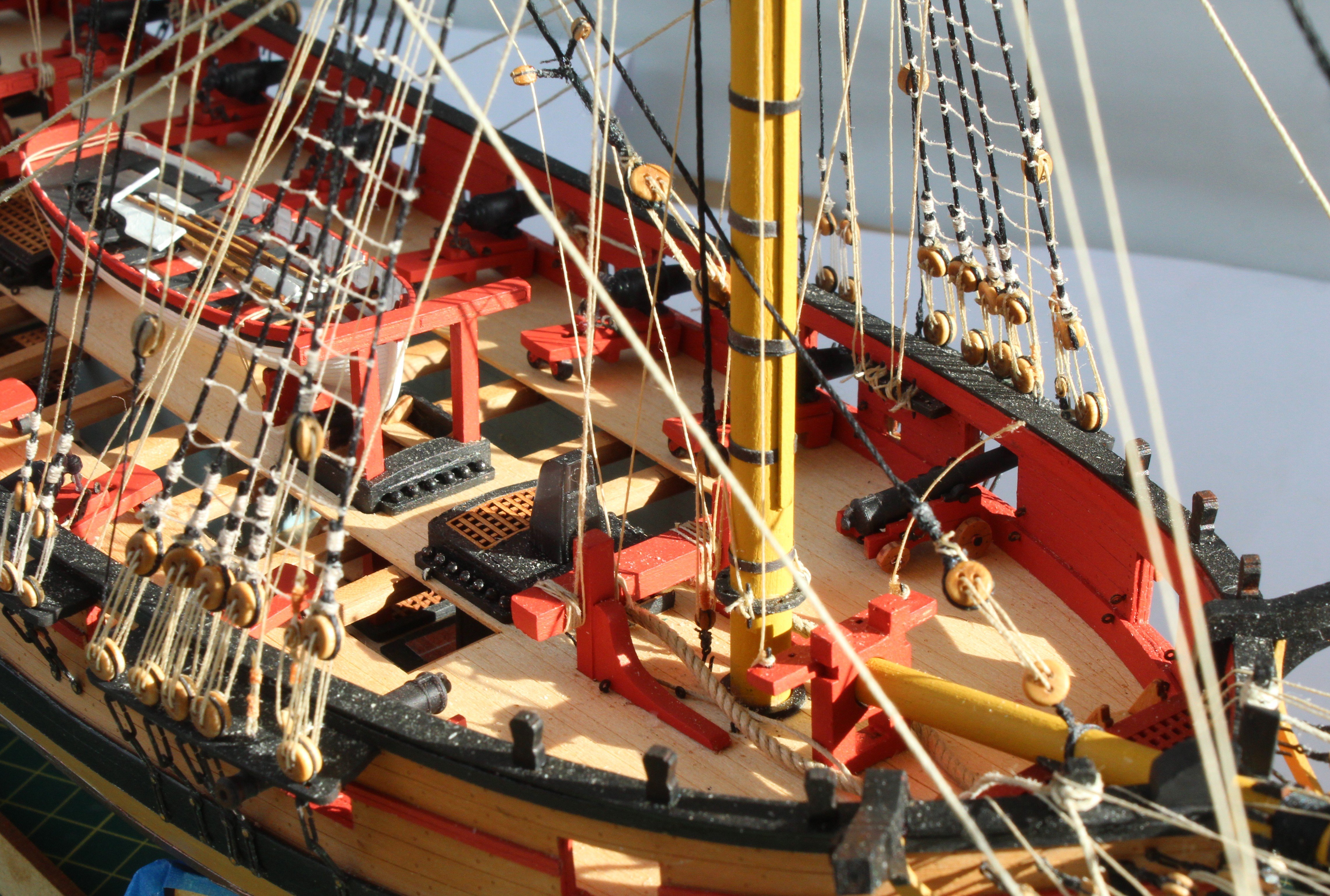

Not much more left to do. This morning I have redone the spritsail yard braces so the spritsail yard is now set square with relation to the bowsprit. As a result I will have to tighten up one of the lifts, as can be seen in the photo below.
I did end redoing the starboard side anchor rigging with the double block properly rigged.
All the stunsail booms have been added.
003.thumb.JPG.9cd769433e8c11b7270e702948cb5616.JPG004.thumb.JPG.3004c31f00a0a1dbbd17fde5f4226eca.JPG

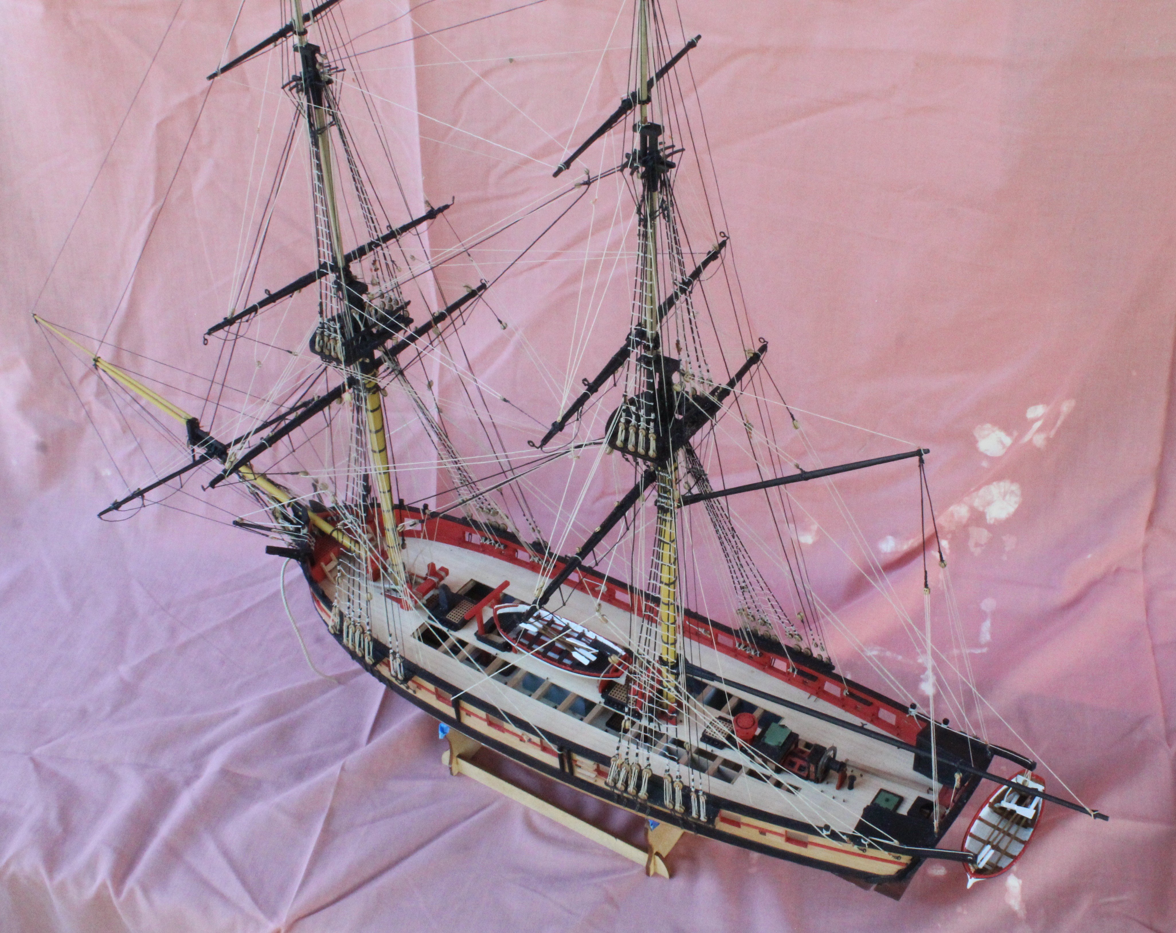

There is still a little bit more of tiding up to do and to make the perspex stand. To complete this, hopefully, penultimate build log post I have added photo of the Harpy on the workbench.
Glenn (UK)

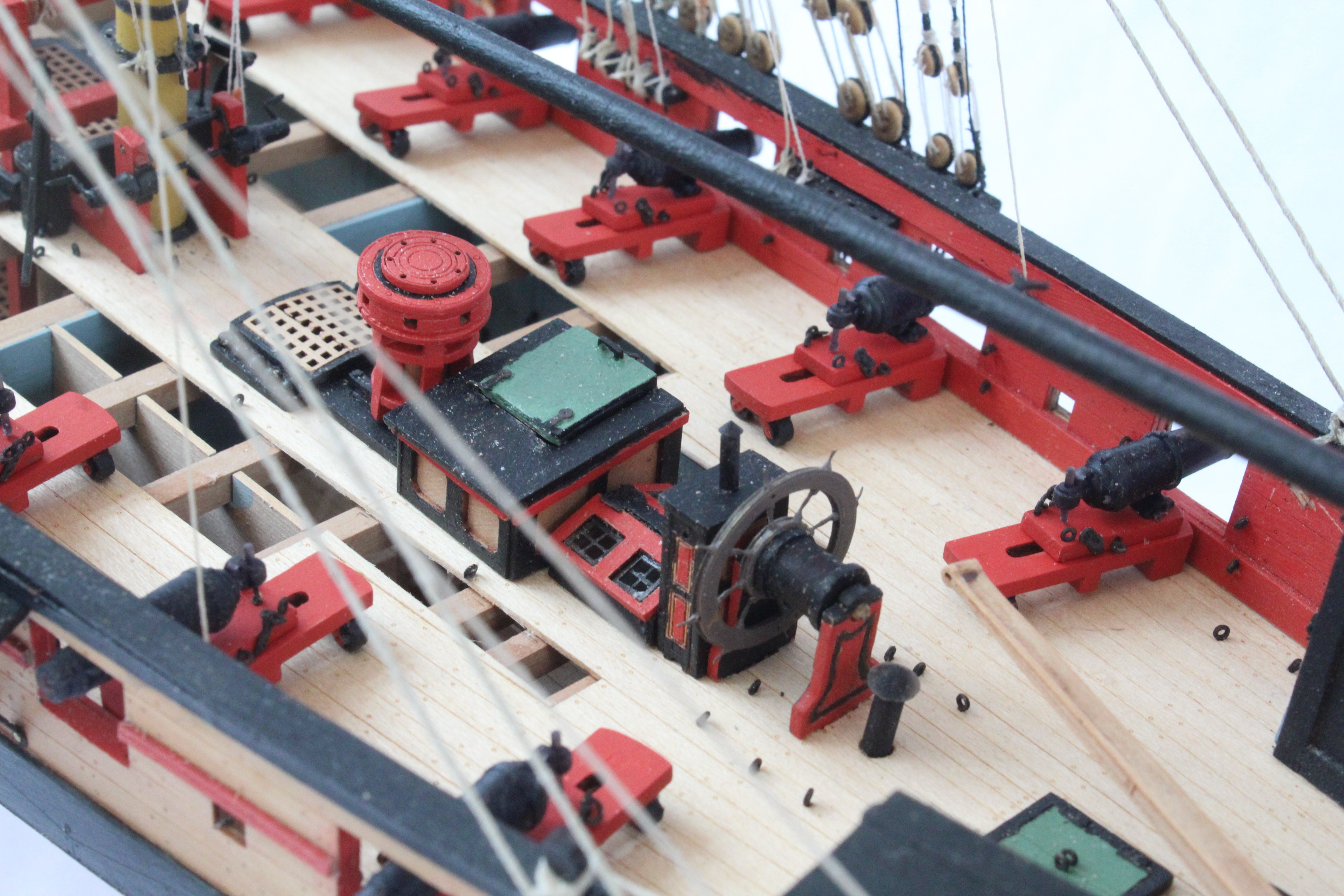

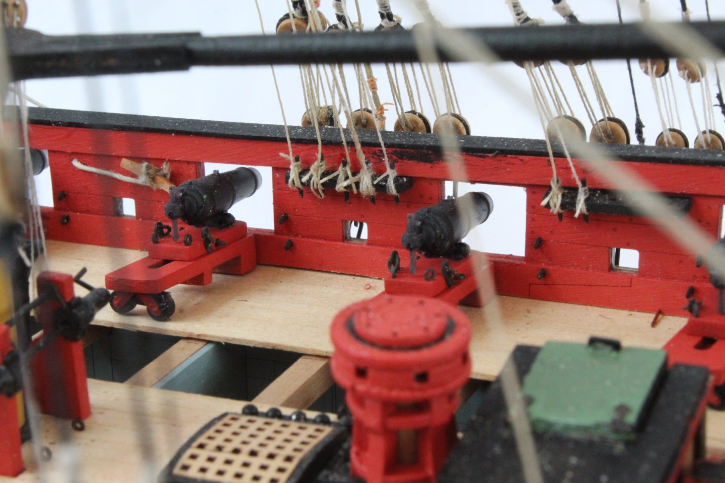

I have now completed all the the work on my Harpy build. This has been one of my most enjoyable builds. I have made a few mistakes during the build and rigging process but overall I am very happy with how the finished model looks.
@chris watton continues to set a very high bar with the standard of his kits and I am looking forward to starting my next project which will be The Baltimore Privateer Schooner Grecian.
Many thanks to everyone who has viewed my build log and for the likes and comments.
IMG_0001.thumb.JPG.844d3e2ac1e8b136ea8fbf951f2a5cd0.JPGIMG_0002.thumb.JPG.8d124231514ae0d424bea70ce7ab3b64.JPGIMG_0003.thumb.JPG.62640ed4b2d6581d3566af9b385ff879.JPGIMG_0004.thumb.JPG.6eb89614ae6af028aa00dabab9967e1d.JPGIMG_0005.thumb.JPG.bf123a8a5da3c410f1836f1c15281348.JPGIMG_0006.thumb.JPG.a54994096faae6470090a94864cfa9f6.JPGIMG_0007.thumb.JPG.79a8b9ab0aa4d9e84c7092f949bc6f8b.JPGIMG_0008.thumb.JPG.fc0cec119c255ac900382cbeb201a6b2.JPGIMG_0009.thumb.JPG.40b2b60ff9a531fc403a6508bd0ff2bd.JPGIMG_0010.thumb.JPG.2876dda5a8bc82b85f2f0f02e8d21e33.JPGIMG_0011.thumb.JPG.cf5de49ee82eca88847a762157afaf03.JPGIMG_0012.thumb.JPG.f360f6d6d80e6a1d2396e253e877b181.JPGIMG_0013.thumb.JPG.ac293e8fc936ce6445212cf74bc28b98.JPGIMG_0014.thumb.JPG.87fdce64a5e96d0e35c9700d62f0032d.JPGIMG_0015.thumb.JPG.c343201bfe0422d98c024cfd7aec677d.JPGIMG_0016.thumb.JPG.5e2b688fbf02c097519700bbdf7827e7.JPGIMG_0017.thumb.JPG.57b59ace7e7a85d30aece58ac93a0969.JPGIMG_0018.thumb.JPG.c7d70d87ffd5299d35665fa45422cea3.JPGIMG_0019.thumb.JPG.79e509bcb2f06c34647d16ec1006a78a.JPGIMG_0020.thumb.JPG.a97ee7f225c5725f38afd2885715febf.JPGIMG_0022.thumb.JPG.06274217f6b6a7cf5143dd9e2646985c.JPG
Glenn (UK)
