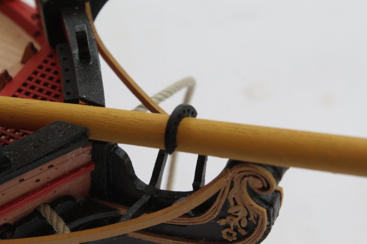

I have spent the last couple of days working on the deck items, With the exception of the ships wheel and shot garlands I have completed all the work. The various parts have been painted and installed. The deck eyebolts and belaying pins also need to be added.
001.thumb.JPG.e6d4e4ccfb9dca9d951cc4bf5ef341cc.JPGStarting with the bow area the bitts have been painted flat red. The shot garlands have been painted black but, as yet they have not been properly positioned and glued in place. The coaming that sits in front of the stove is not added, as I need to add the hawse rope. In retrospect it would have made more sense to do that before the fore mast bitt assembly was installed.
002.thumb.JPG.29b625ed9a52af1b58dd96e5eb83bd4e.JPG003.thumb.JPG.f74c229bf97c6b614022fd930175401b.JPG004.thumb.JPG.98e47c2bd3e4fda47fd5d7f43abefba3.JPG005.thumb.JPG.39ff036b74dd52f5a3385459260a829d.JPG
006.thumb.JPG.799f0461d8a86213743498aa07c2e061.JPGMoving toward the main mast area everything has been added. I did add the hand pump drain pipes in the wrong place, but I am sure nobody will notice if when looking at the model. I did paint the capstan top with a black iron band. Shot garlands still need to be painted and glued in place.
07.thumb.JPG.18a6bb9fdd5c4ad7912f661283f49445.JPG008.thumb.JPG.947735c39eb418373672f6897b2f6d0b.JPG009.thumb.JPG.9302fc877fb1c64011b1ca51607b57c6.JPG010.thumb.JPG.f5e818e07cb35badb46d7a120af0c452.JPG011.thumb.JPG.3ae286a2bfb35a351b93e39b14b0031c.JPG
Glenn (UK)

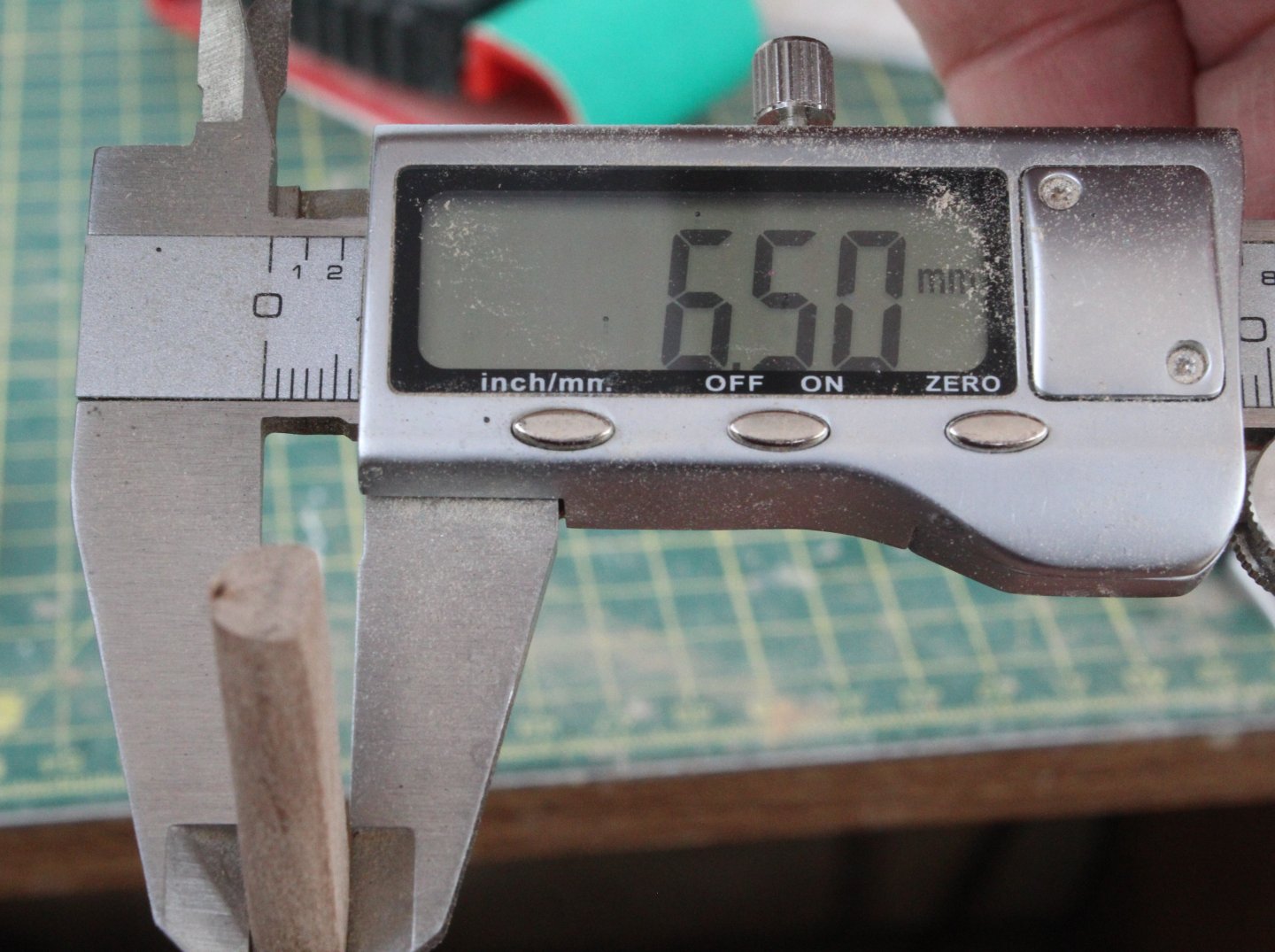

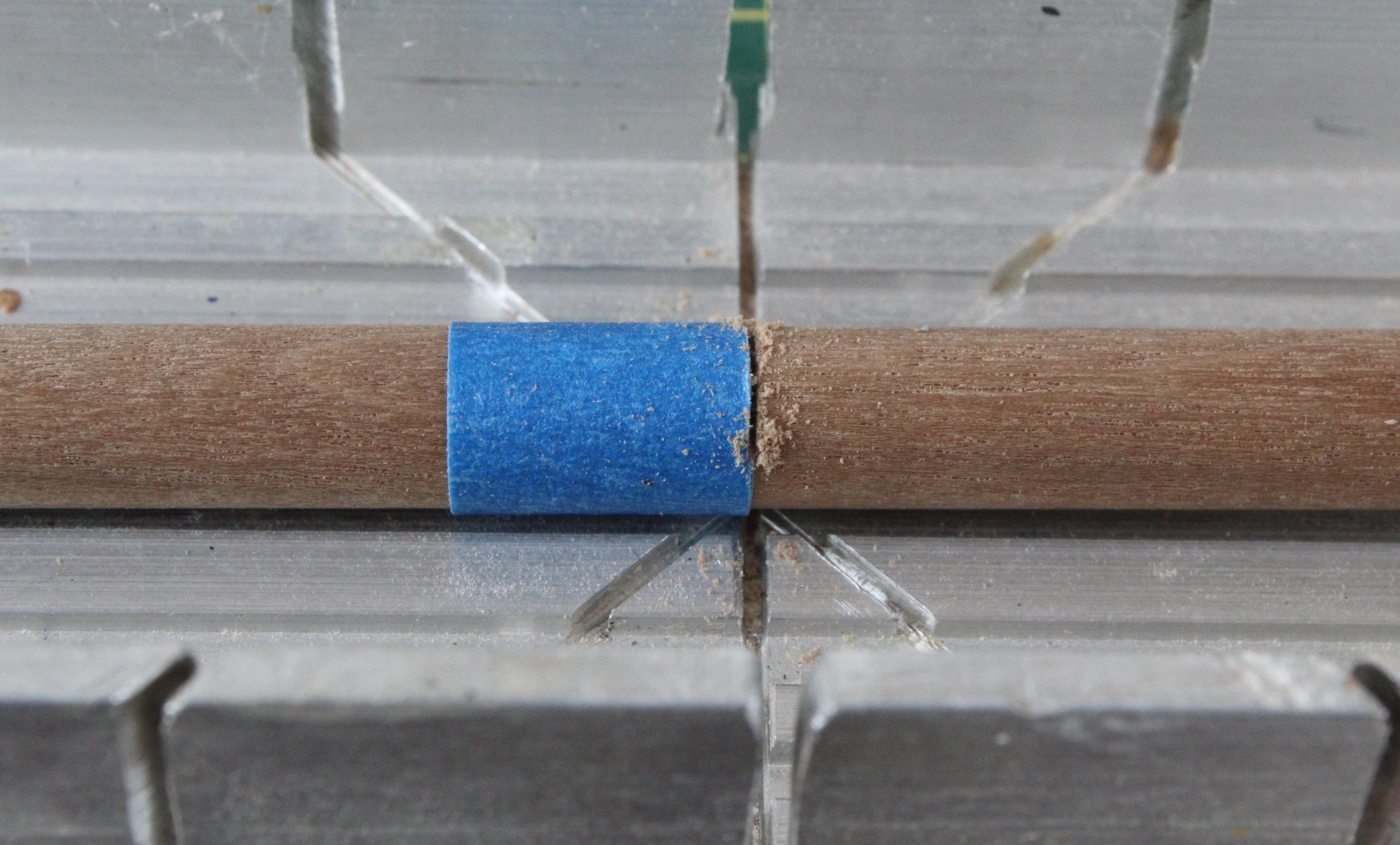

Following on from my last post I thought I would show, in a bit more detail, how I shaped the fore mast.
Starting with squaring the end I tape the start point.
I then make a small cut, using a razor saw.
I use a craft knife to remove most of the material.
A sanding block is then used to remove the remaining material and to smooth the surface.
I use a pencil to indicate any areas which require a little bit more work, after checking the width with a vernier gauge.
In the next photo a vernier gauge is used to check the width have been reduced from 8mm down to 6.5mm.
The above process are then repeated on the opposite side so that the overall width is reduced to 5mm, as shown below.
The process is then repeated on the other two side so the dowel end has been shaped to a 5mm square, and the final check is fitting it with the platform frame. This is shown in the next two photos.
008.thumb.JPG.d90b829e4e5420d33e8487582f0472c2.JPG009.thumb.JPG.9a5393c51f989376060e3bddb0c7cebf.JPG

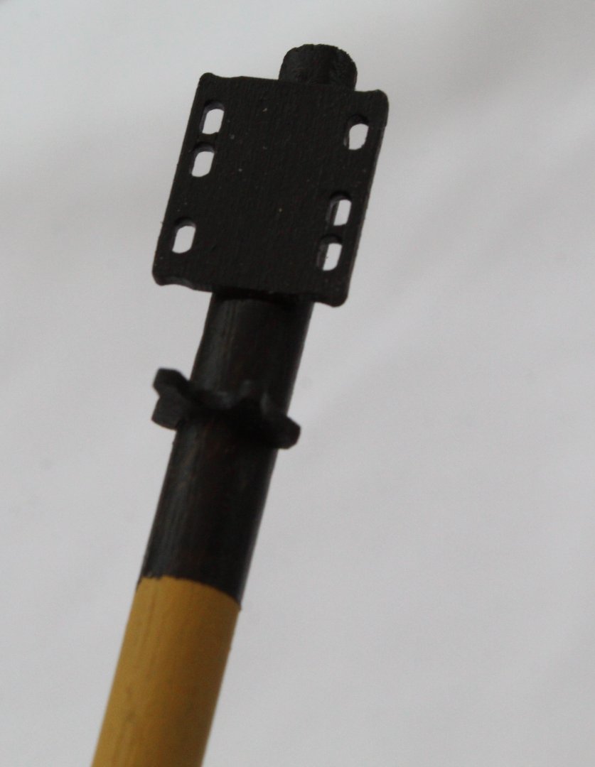

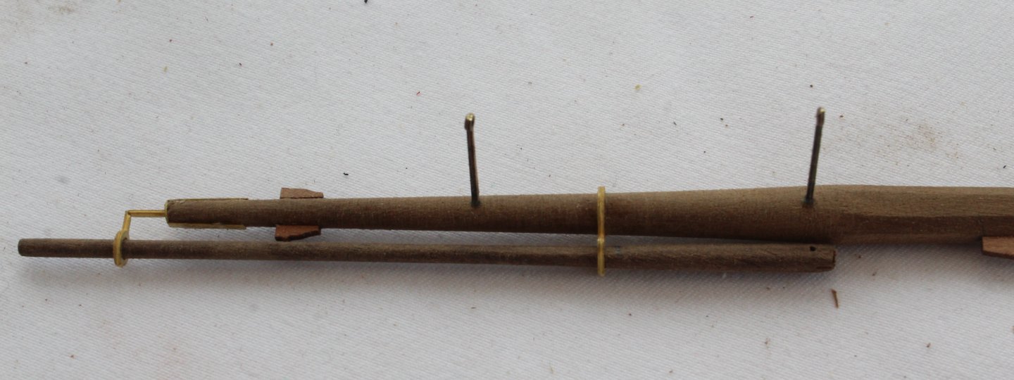

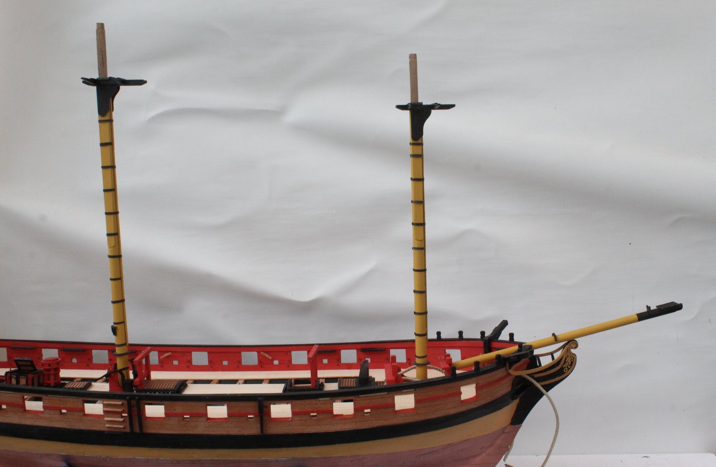

Work still continues with making the various masts and yards. After I had made the bowsprit, spritsail and jibboom I completed the work in this area by making the spritsail yard. All these items will require the various block, deadeyes and footropes adding. I plan to add these items once I have completed making the remaining masts and yards. In the two photos below the spritsail yard has only been pinned in place.
001.thumb.JPG.efe86a6ed88e75d4d4869e93b271fe14.JPG002.thumb.JPG.90b3874bd9c35673b7eabb6de808b4c3.JPG
Next I moved to to making the topsail and topgallant masts for both the main and foremasts.
003.thumb.JPG.7c81993d079720e6f8a84b38da5525b5.JPG004.thumb.JPG.dd846b4119d2a57907a87061a6bd97e7.JPG005.thumb.JPG.3d0ee2093d53f6c317b1bb4f107279ac.JPG
The Harpy is slowly coming to life, but there is still many more days work required on making all the yards.

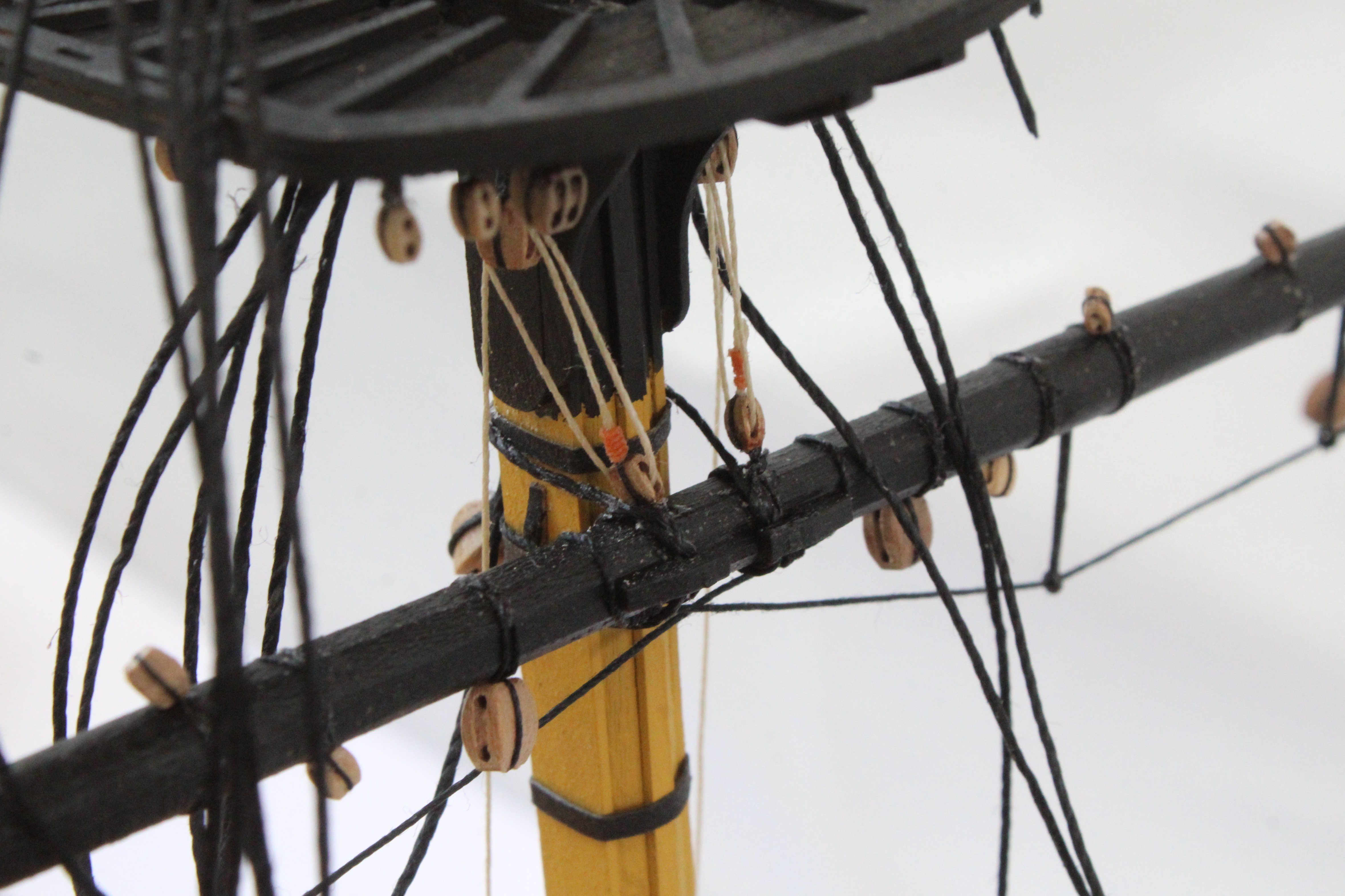

I am now prepared for around 2 to 4 weeks work of adding the various blocks and footropes to all the yards and masts.
I have cleaned up the work area and brought out the quad hands and homemade thread dispenser so I am now ready to make a start.
Today I concentrated on the topgallant yards for both the main and fore masts. It is a simple task as there are only two blocks and two footropes to add per yard. The one central and two end flying leads will be added later on in the rigging process.
I started with the footropes. I cut 4 lengths of black thread and created loops on each end, noting the loops position can be adjusted and closed up as required. The footropes were added to the central section of the yards and the loops closed up. The other ends were then thread over the ends of the yard and the position of the loops seizing was adjusted as necessary and the loops were closed up around the yard.
In the next photo I have added the footropes and I am using some clamps to double check overall shaping looks symmetrical. I have also brushed on some very diluted pva glue to the footropes to help maintain the shape once the clamps have been removed.
Once that was done I added the blocks.
The completed topgallant yards, noting the locating pins will be trimmed.

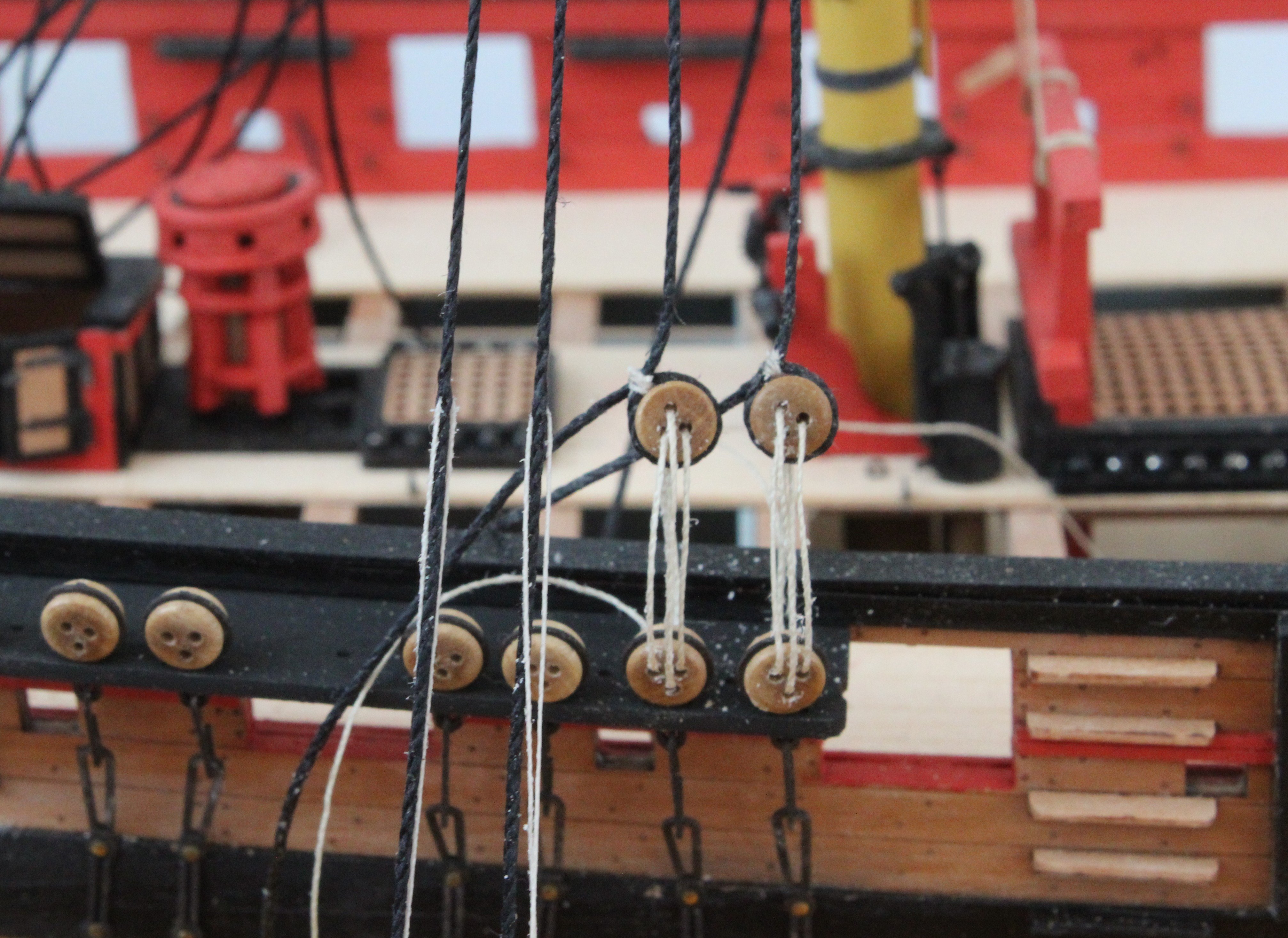

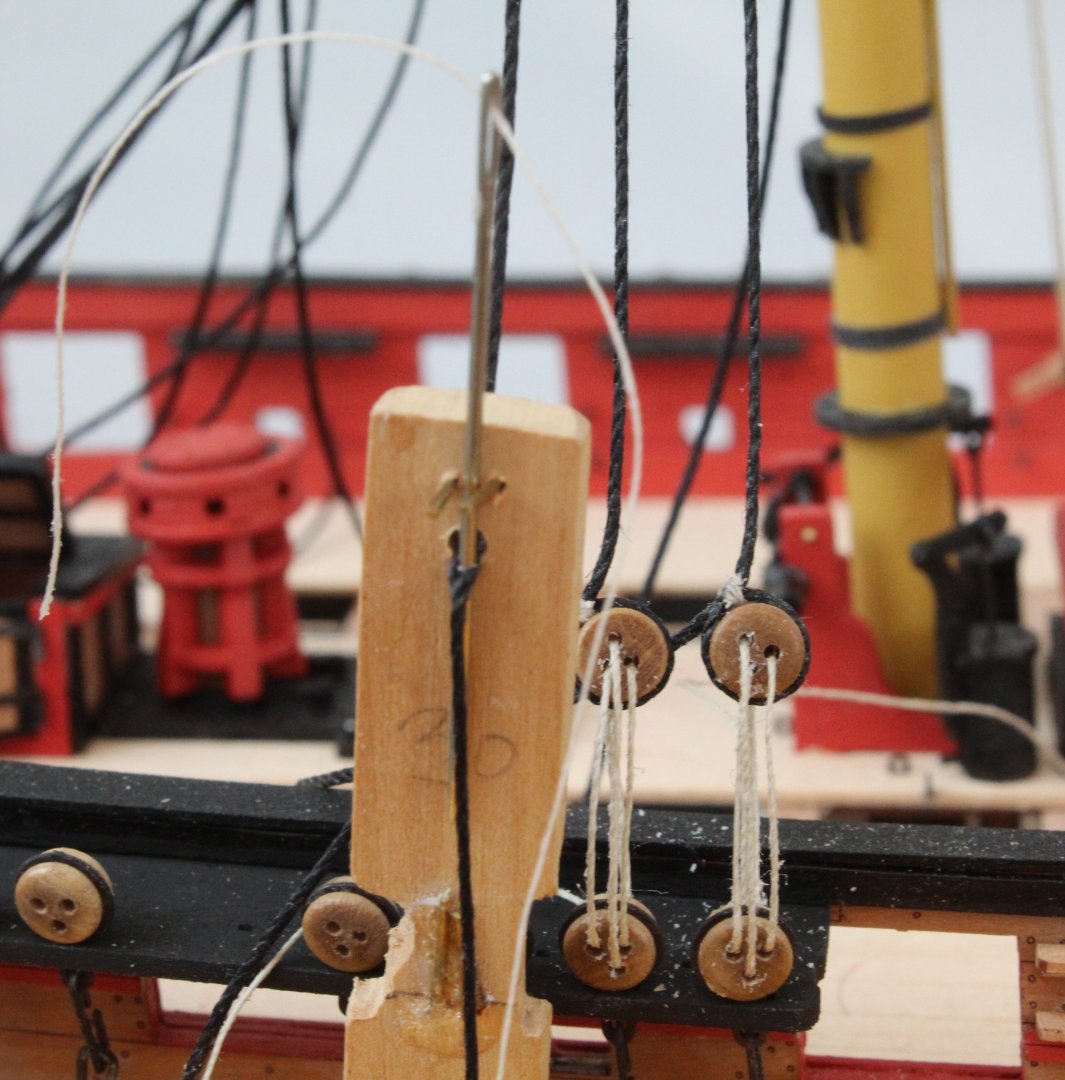

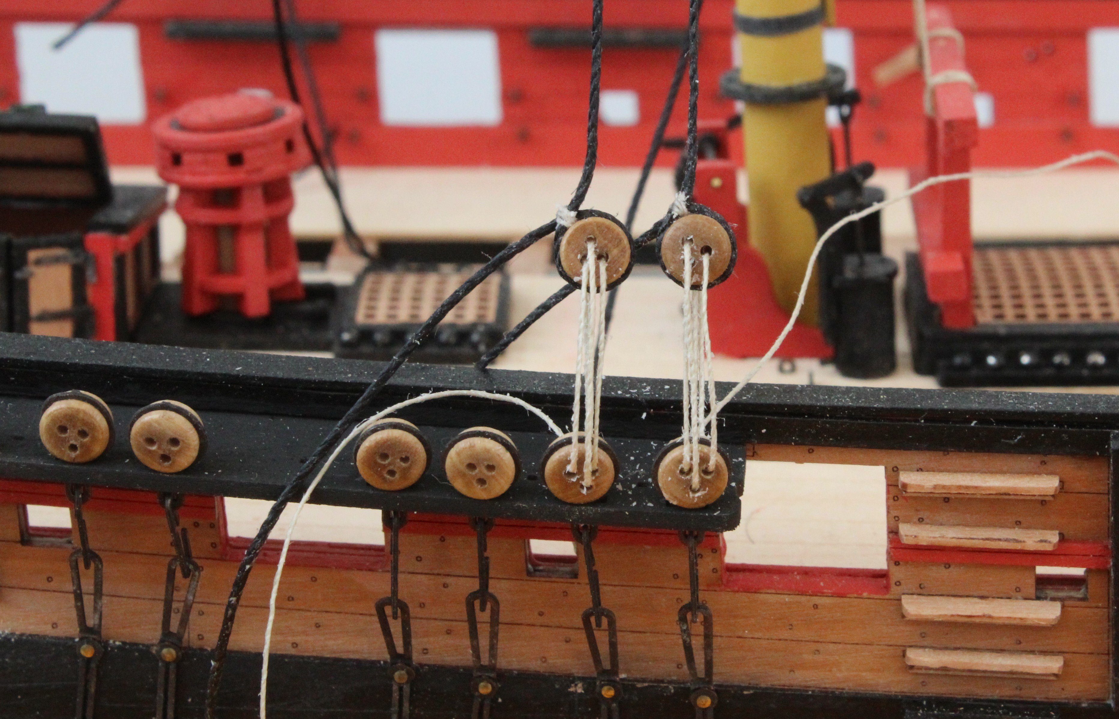

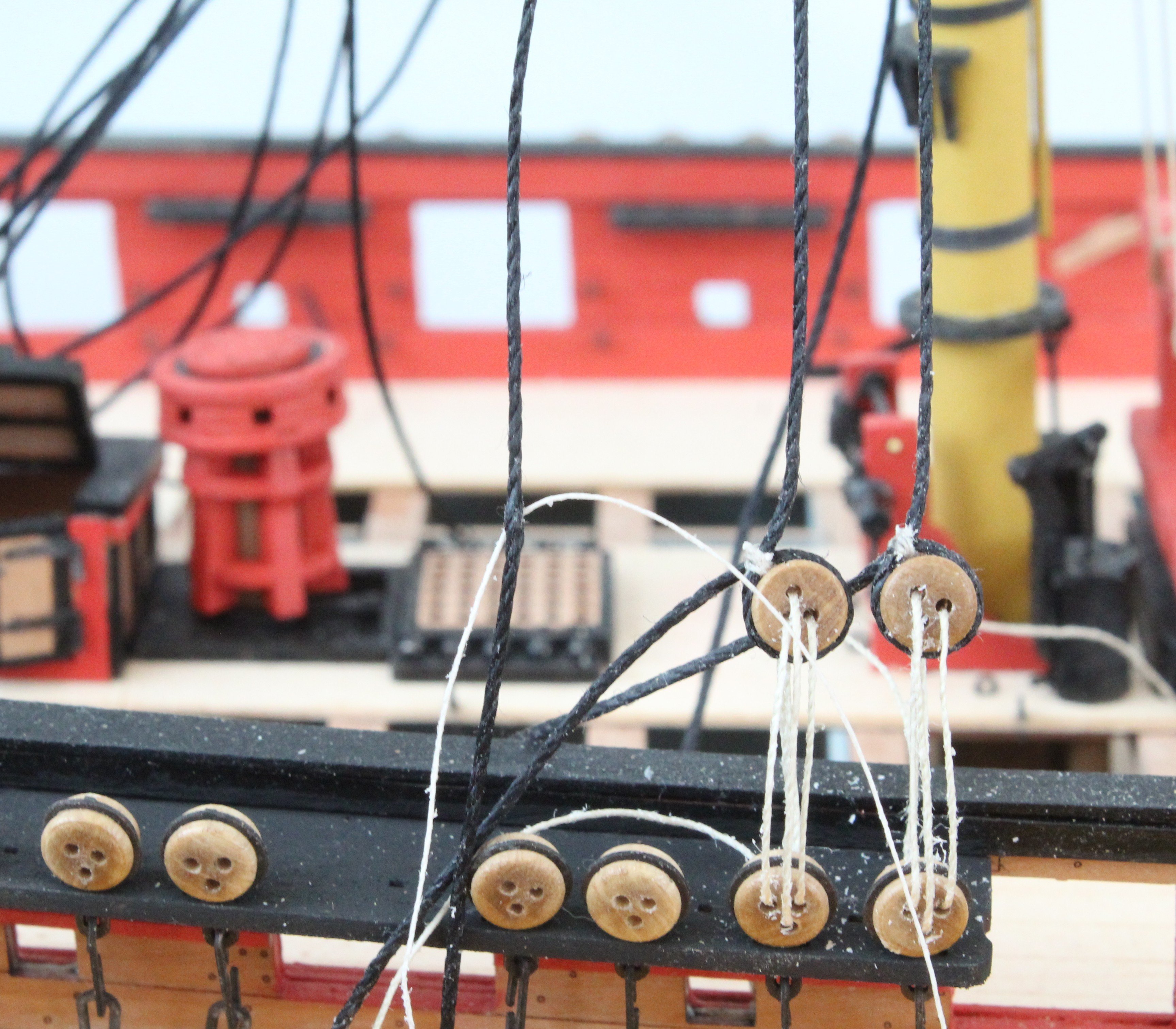

A mixed bag of items in this post detailing what I have been working on over the last few days.
I have made all the main and fore mast shroud lines. They have been position on the two masts but they can be removed if required before I a, ready to add the lanyards.
I have also made the main and foremast stays and preventor stays, and one pair is shown below.

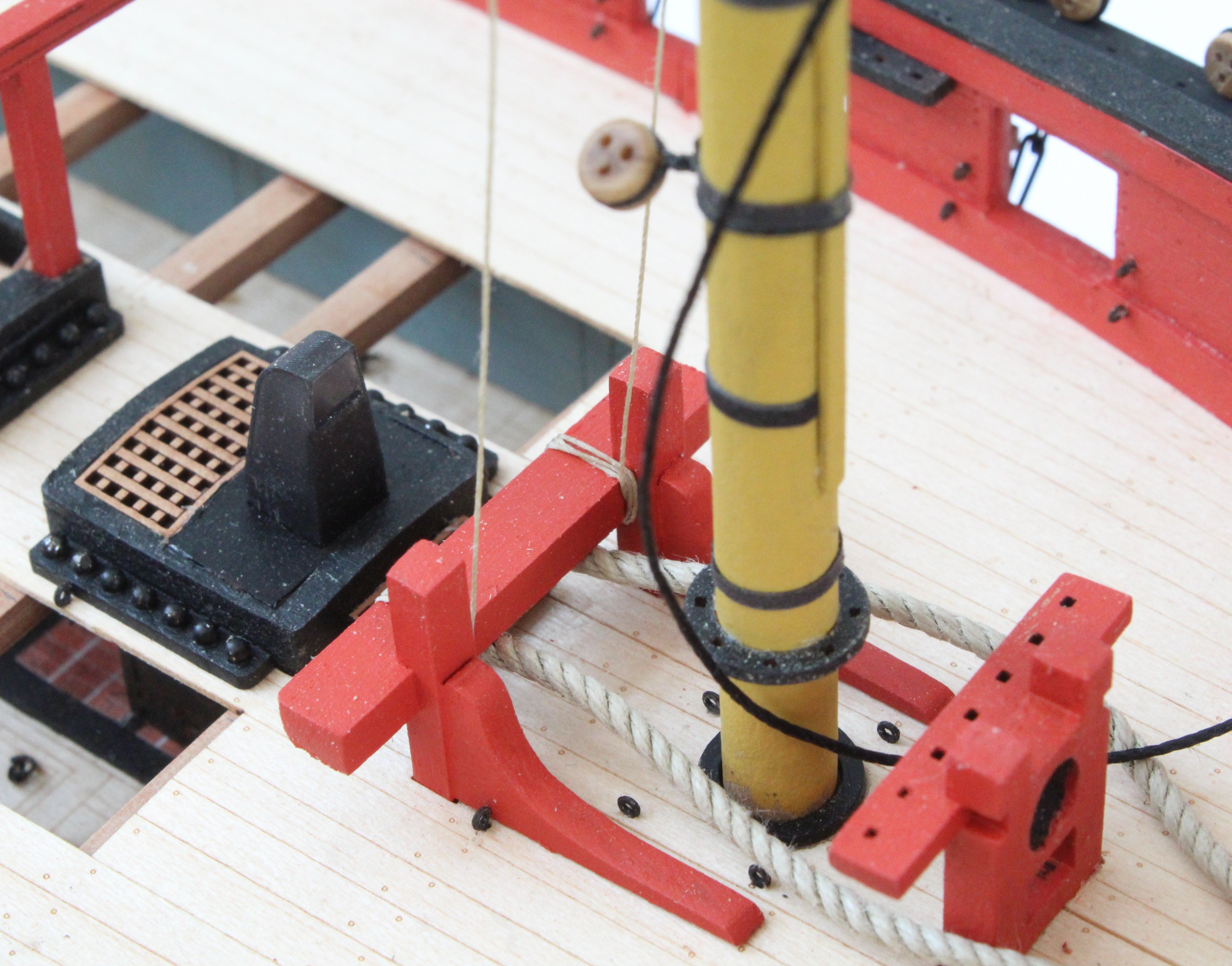

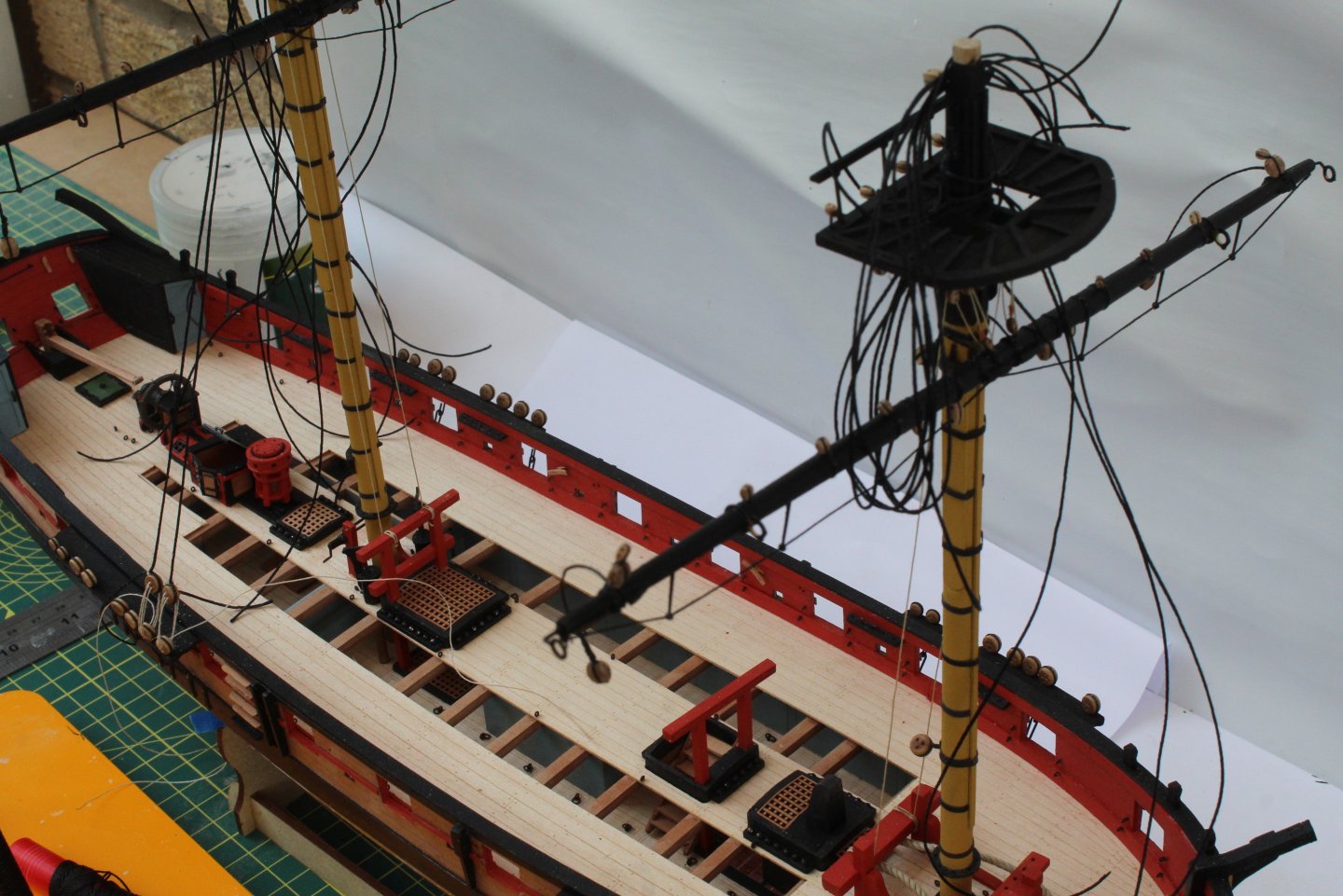

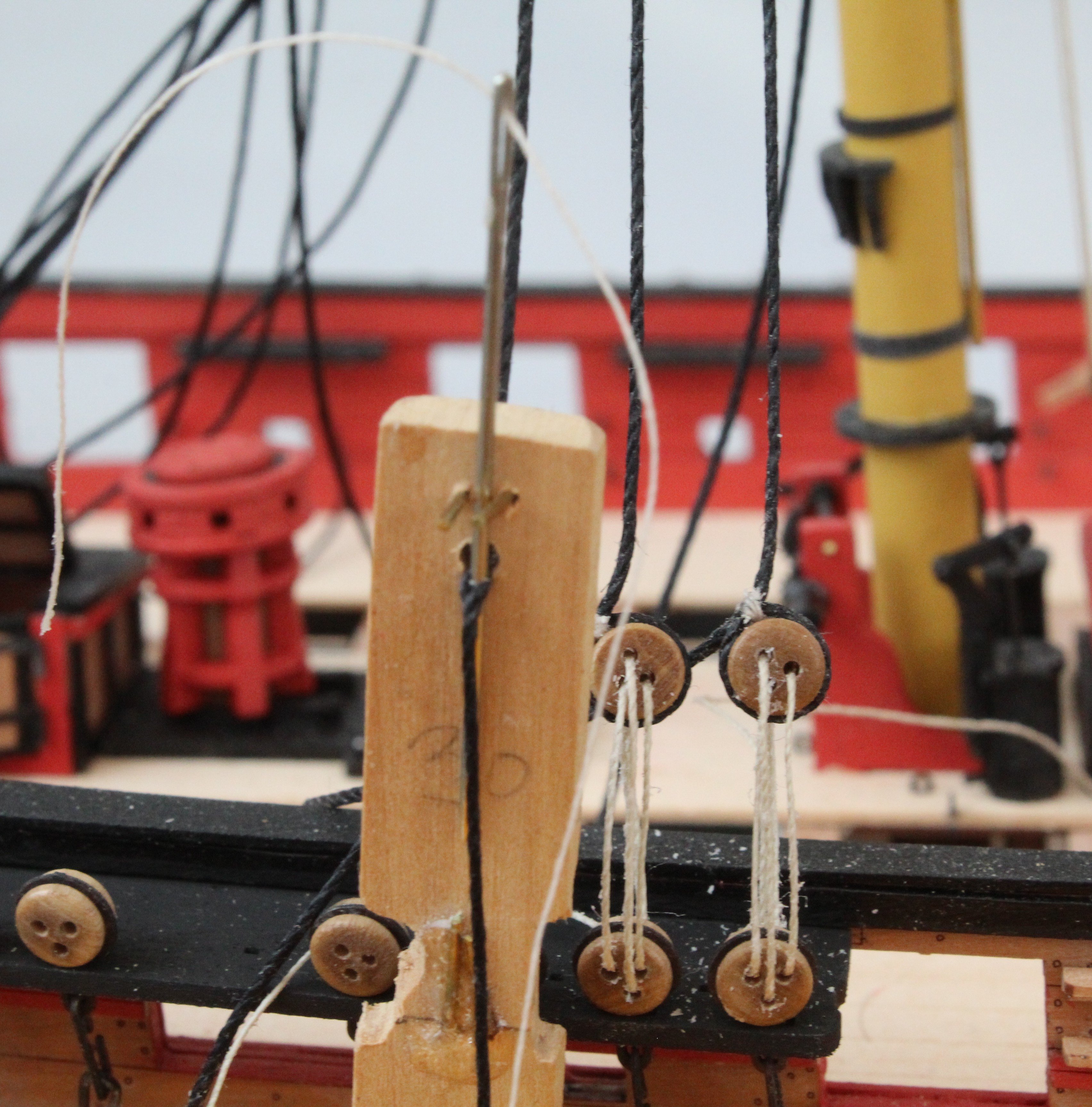

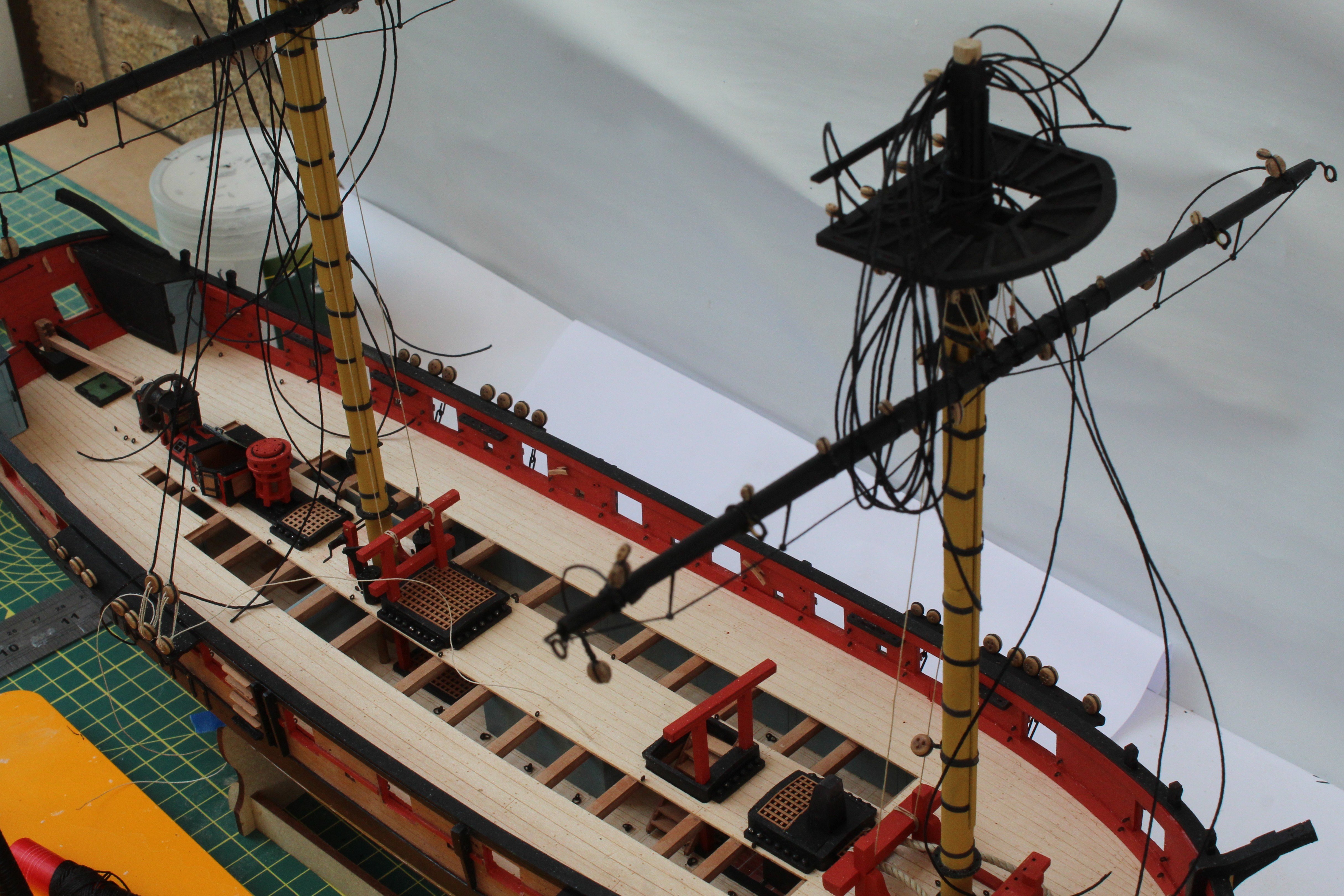

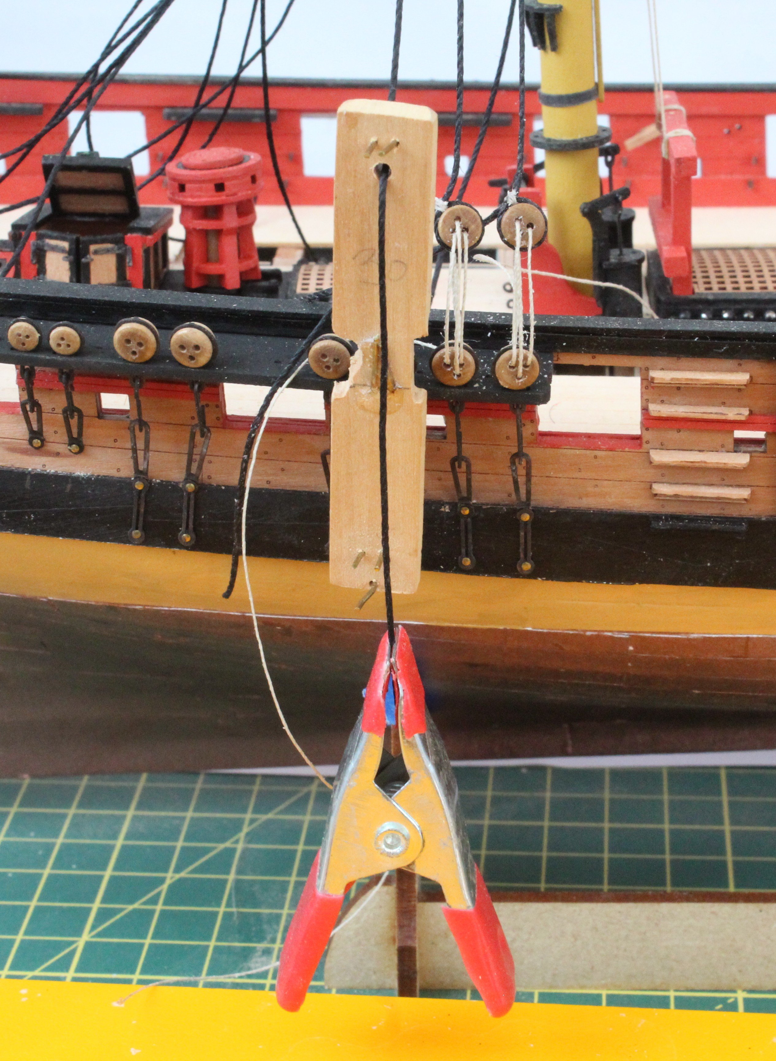

Next I moved on to adding the various blocks and footropes to the main yard. The first task was to seize threads to all the blocks.
The yard was then held in position, using my quad hands.
In the next photo the central blocks have been added to the yard. The footropes have also been added.
Moving outwards the next three blocks were added to the yard.
In the next photo all the blocks and footropes have been added.
The yard was then then test fitted to the mast.
The next job was to add the deadeyes to their respective strops.
010.thumb.JPG.ba3784fd3ec0125f23b61d52cc3569bb.JPG011.thumb.JPG.dd1aeee7f318a0c97ccbf1efc1c9fd9c.JPG
Next I started to add the chain plates and links. Using the shroud line as a guide I marked the position for the first chain plates and link.
The first four chain plates and links have now been added.

Progress has been a bit slow over the last couple of weeks due to the very nice weather. I decided it was time to revamp the garden pond. I ended up digging a new larger hole (7ftL by 4ftW by 1.5ftD) and fitting a new liner. The fish seem happy in their new home and I added a few more small ones, plus a filter and fountain.
Moving on the Harpy progress. I decided to follow @ECK lead and to fit and rig the yards to the masts before starting with the shrouds. It was certainly much easier to do at this stage.
002.thumb.JPG.2d0921b2202b9406edce7917cbc6cf59.JPG003.thumb.JPG.1de719e7acdca3353fb53637a0862ac1.JPG004.thumb.JPG.019a1910991ab0defc8aa0dfb1af7724.JPG
Next I started to rig the shrouds. I did an initial check that the method for adding the deadeyes would help to ensure they look reasonably level. It appears to work, noting I will need remove the left-hand lanyard as the deadeye needs to be rotated slightly.
The method I am using is to place a jig in the channel deadeye. The shroud is passed through a hole and held in place using a clamp.
The seizing thread is then passed through the shroud line, as shown in the next photo, using a needle.
The jig is then removed from the channel and the shroud and seizing is then pulled back through the hole.
The final check is to make sure the seizing thread for the adjacent shrouds looks level.
In my next post I will detail how the deadeye is added to the shroud.
