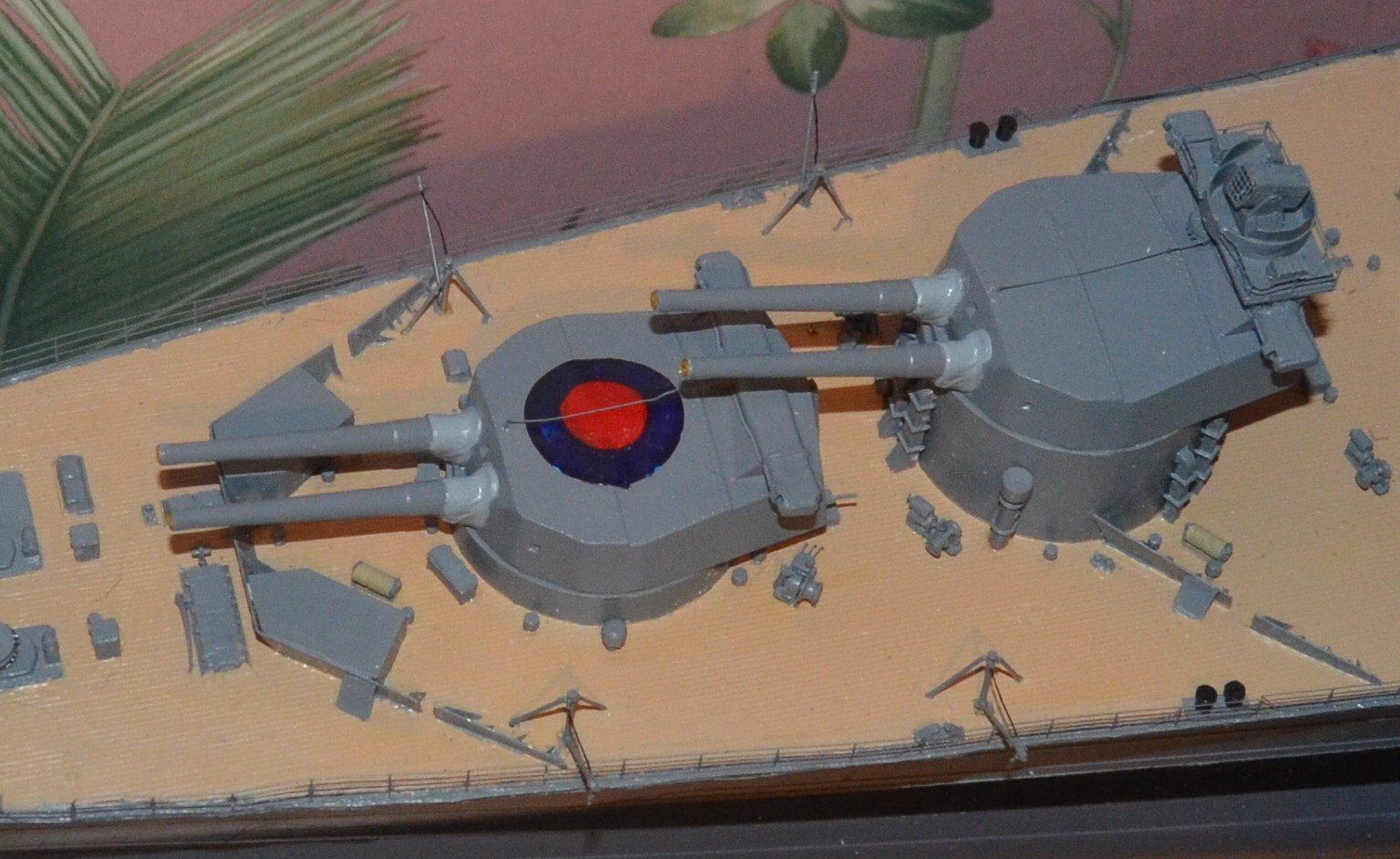

The kit comes supplied with two extra gun turrets. A is as built from the box. There are no blast bags with kit and nothing to hide the gap where the barrels come through the turret. B is the Trumpeter upgrade blast bags and barrels. C is the MK1 upgraded barrels with blast bags.
As can be seen there is a marked difference between the three versions. Especially in the length and diameter of the barrels. I am now almost certainly going to go with the MK1 upgrades.

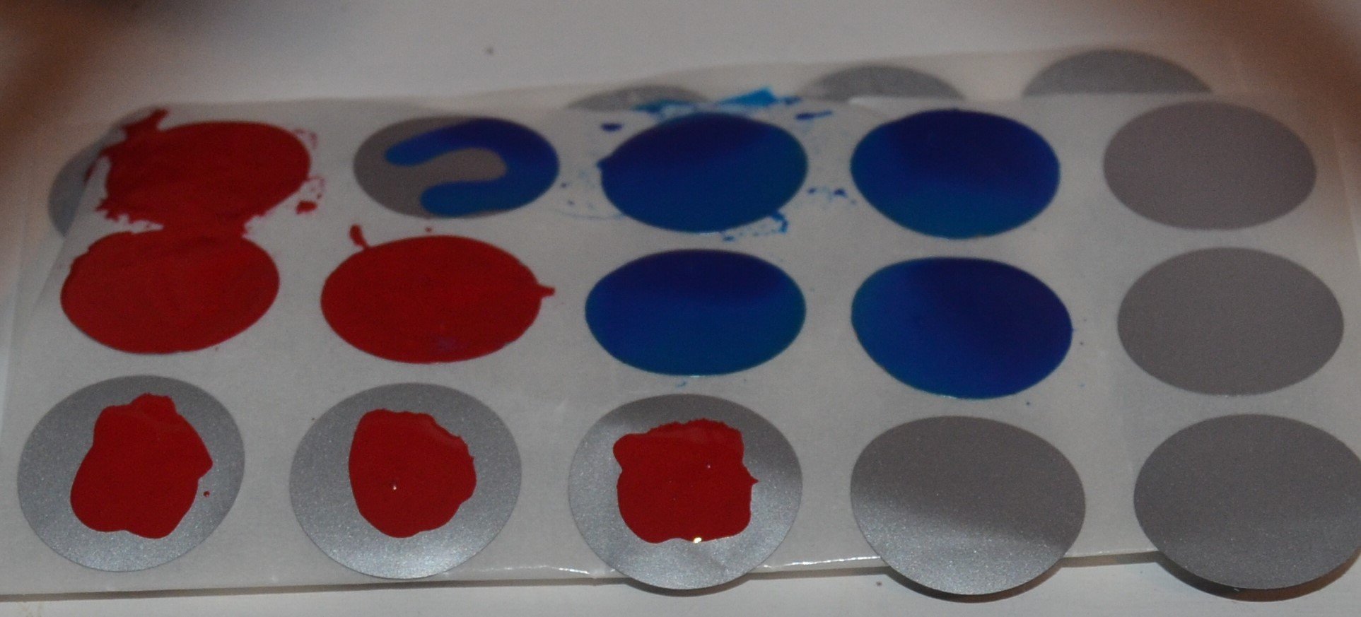

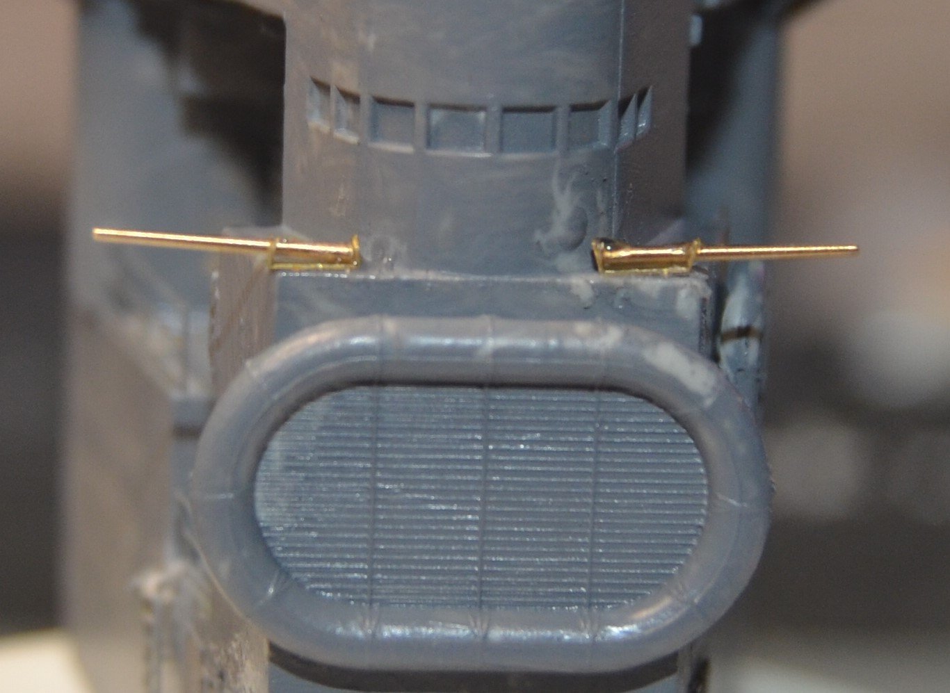

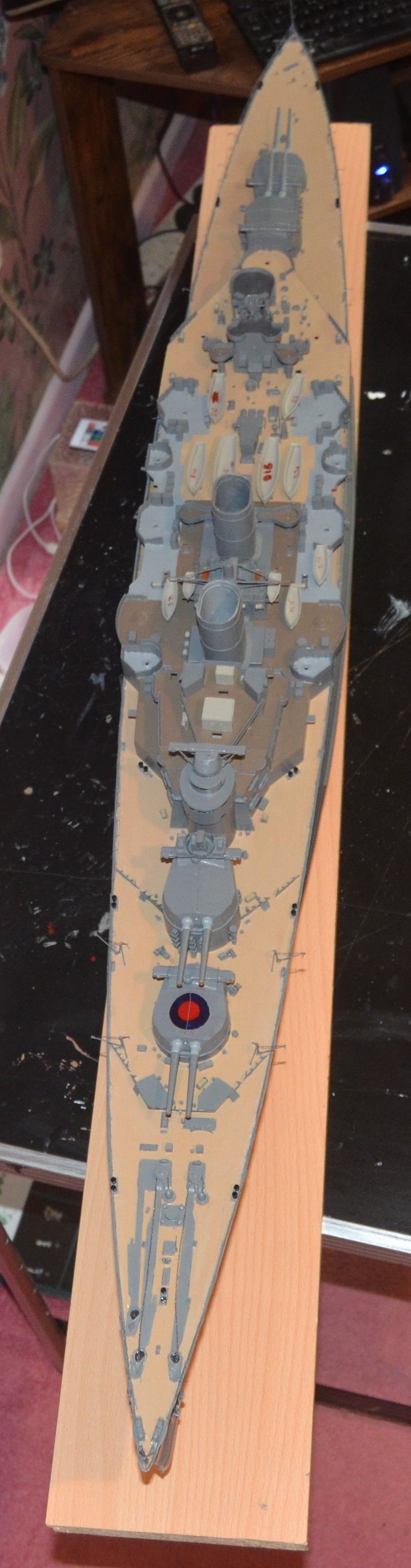

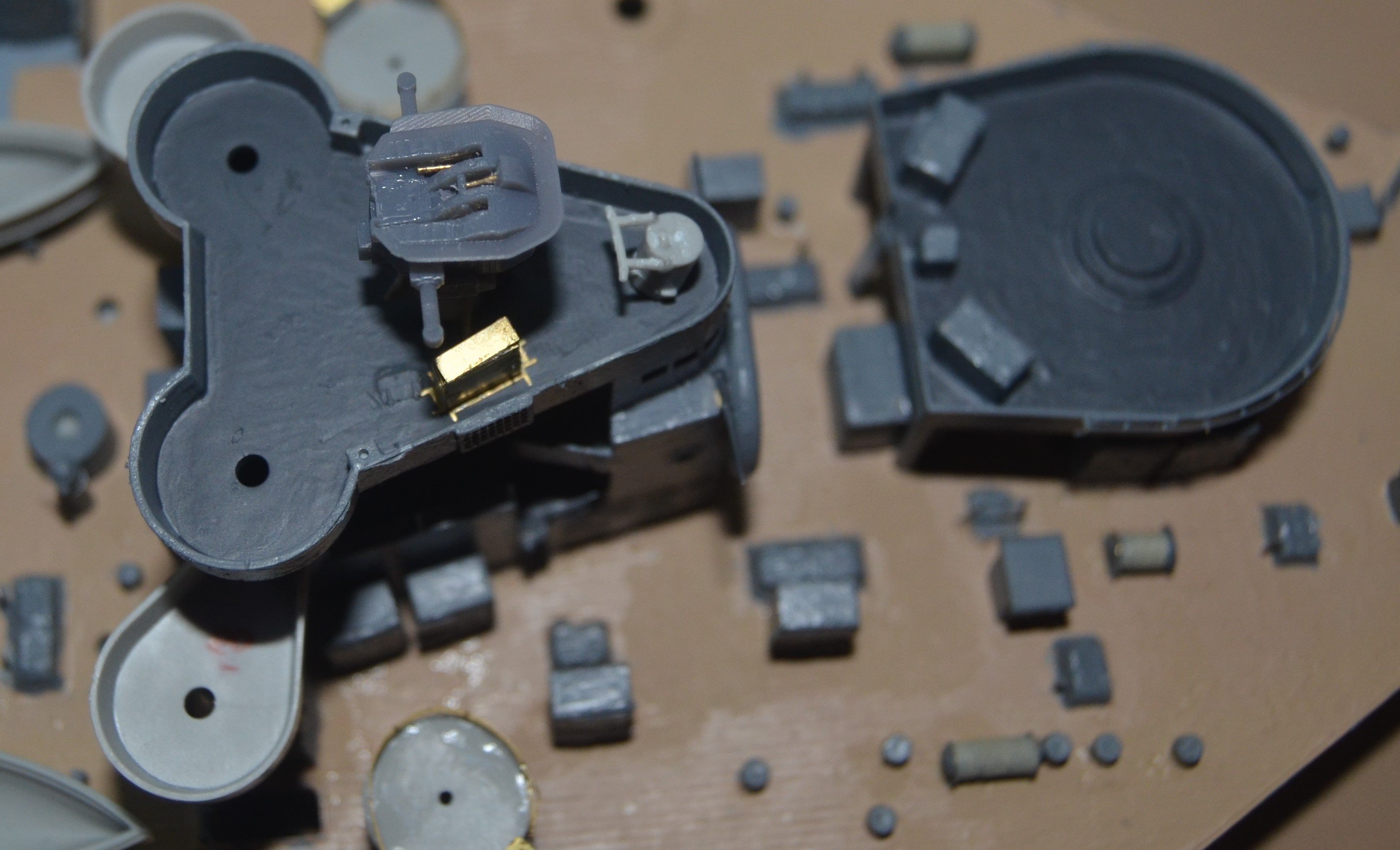

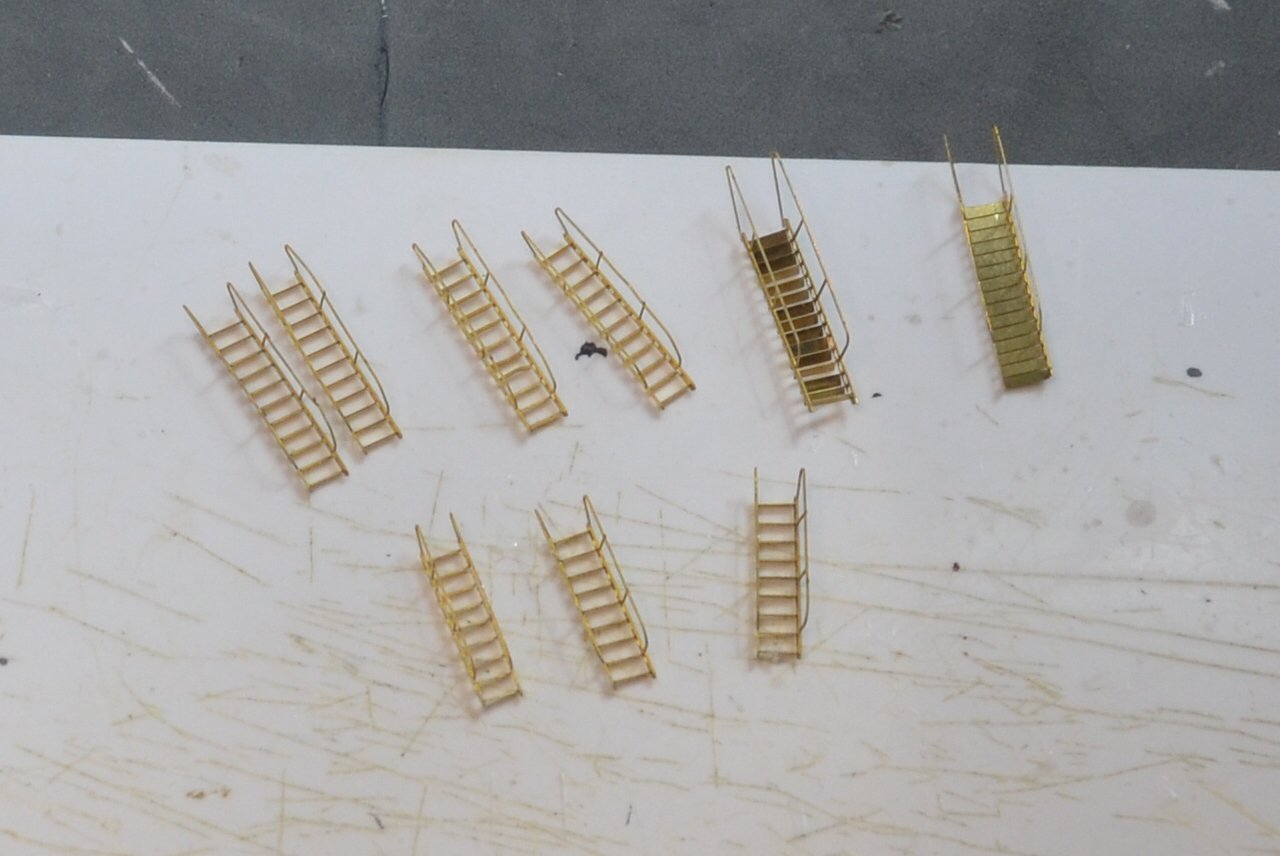

The bow deck completed. Including the rocket launcher on top of number 2 gun. I've added a bit of black paint to the rockets so you can see there is something inside the cage. I have also invested in a second resin funnel. There is nothing wrong with the correct plastic one. But because it is a two part build the join is visible down the sides. The resin funnels are one complete part so look better having two the same. The first picture shows how the funnel bases would look without clipping at one end. One of the bases would cover the two hatches. The second picture shows the clipped bases which sit in place a lot better.
Picture 3 is the paravane derrick and boom, used to pull the paravane through the water. I did wonder what the two housings where behind the breakwater. They are the sheds that had paravanes in. I have got two extra ones that come with MK1 upgrade kit. So may see if I can attach one of the plastic ones to one of the derricks and hang it down the side of the hull.

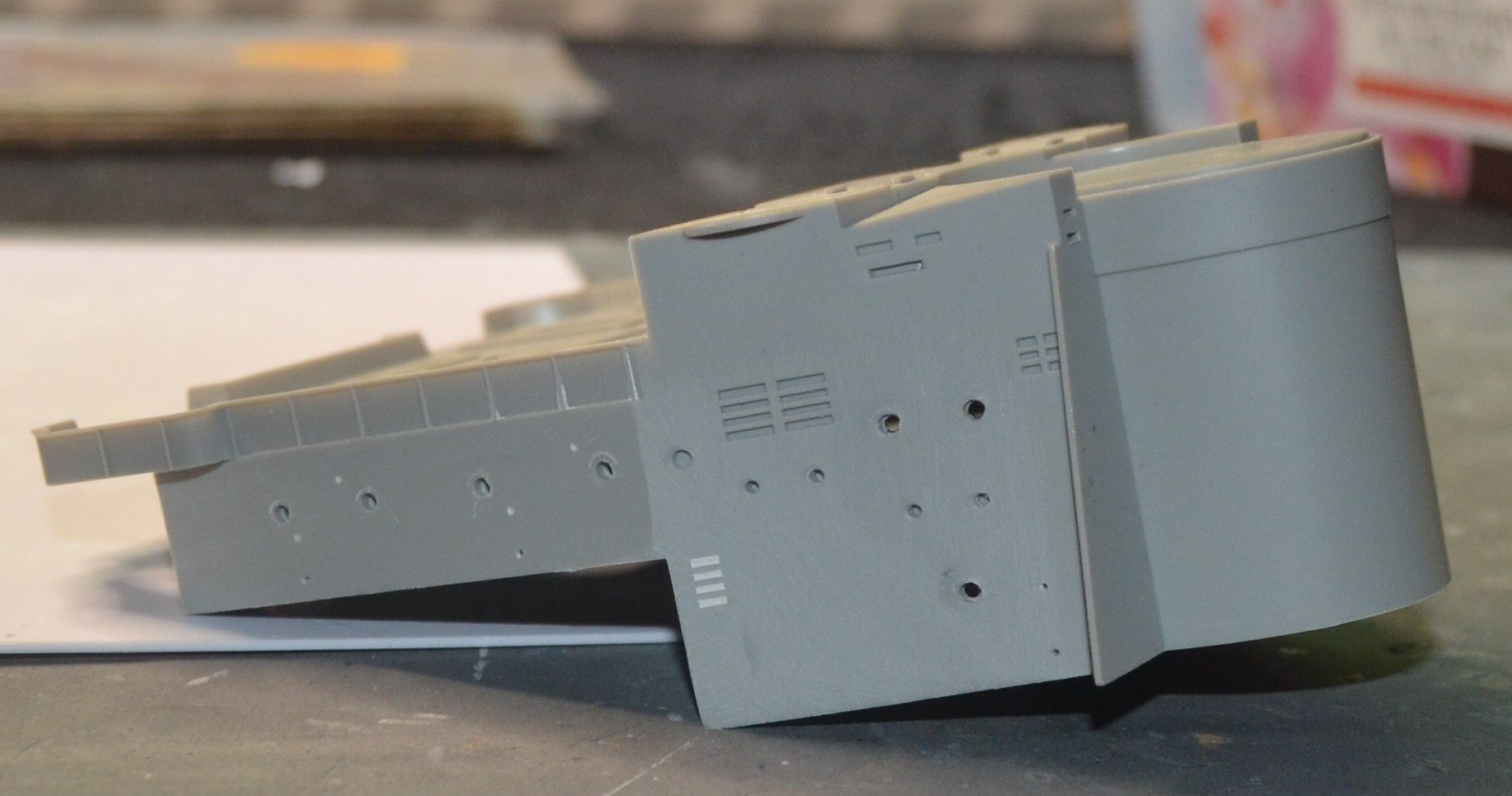

picture 4 is the parts for the rocket launcher. The very small parts are only used if I have the door open, which I won't.

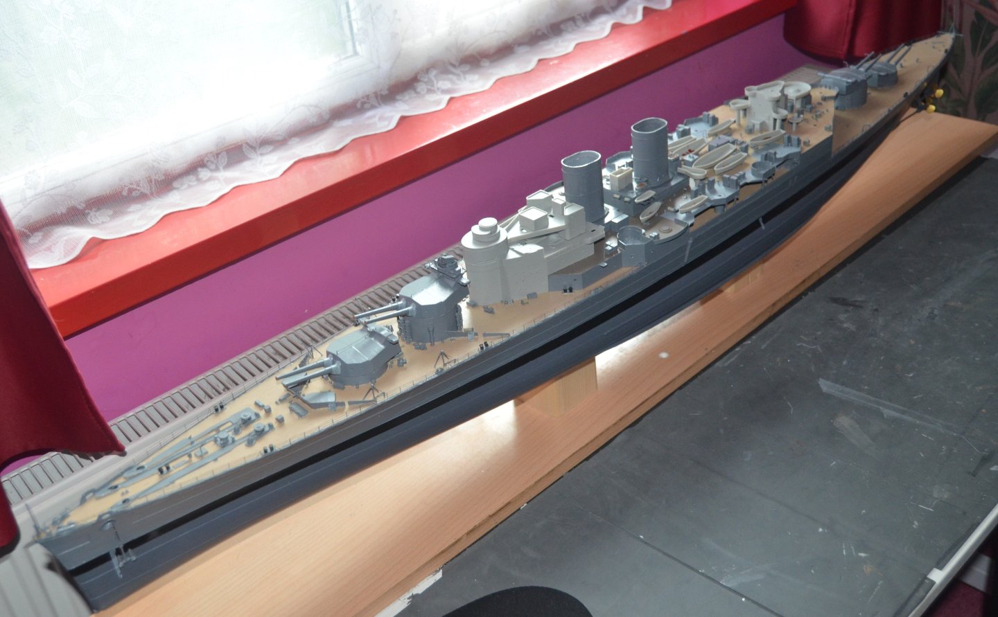

The shelter deck is starting to look a bit busy now. The ships boats are not necessarily in the correct order. I have added them to make sure to boat crutches are all correctly aligned, which they are.  I have also added stanchions to the hatches that are shown in the anatomy of the ship book that where used to hold open the water tight covers. There are 35 of the larger lockers on the deck and 16 smaller ones. There are now 17 reels and winches to make up and add. and then various davits and ladders to add. I will then concentrate on the smaller structures before moving on to the main central part of the ship.
Building the model the way I am out of sequence and not following the instructions to the letter is proving a much better way of working on the model.

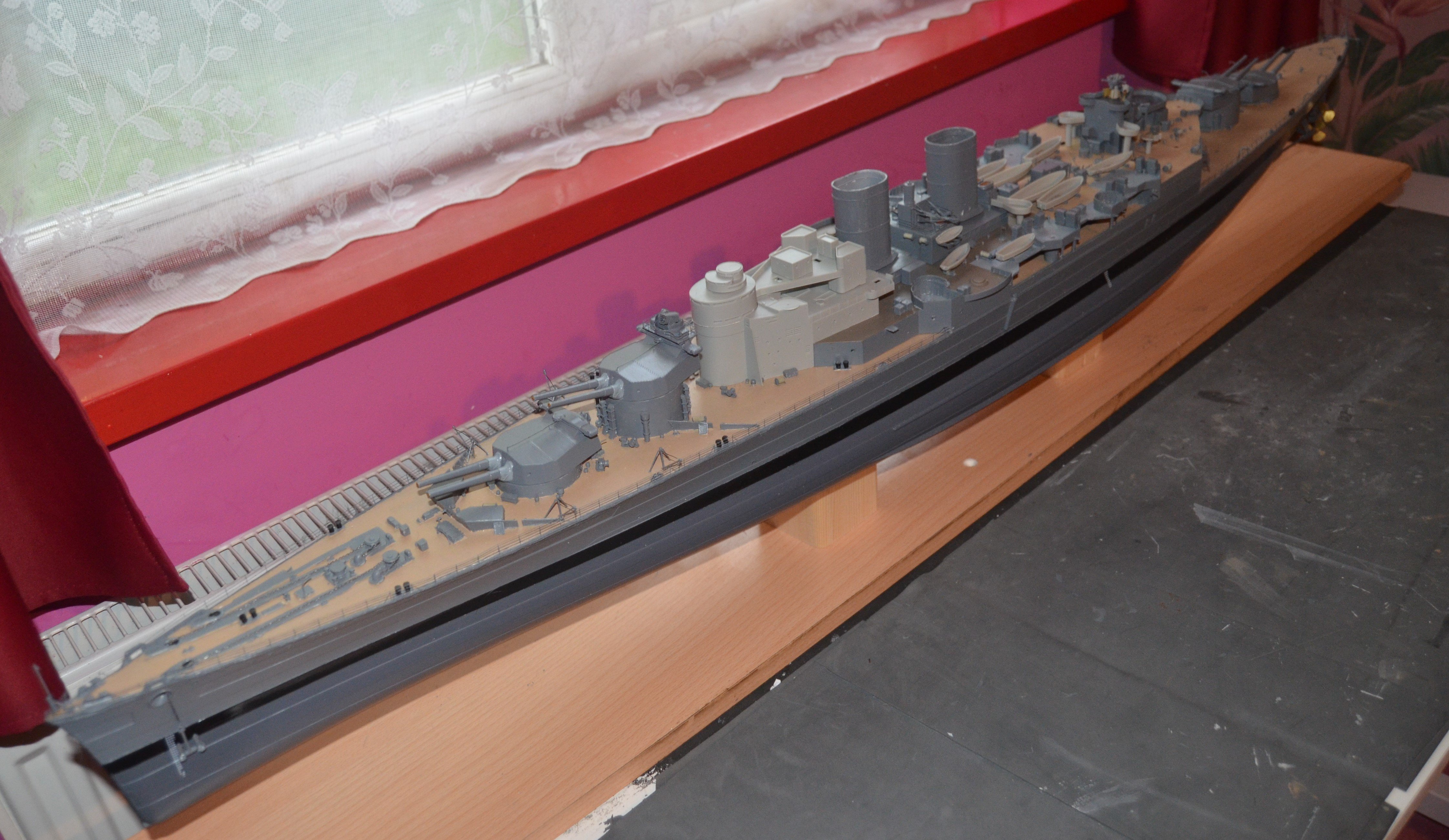

More work on the shelter deck. I decided to build the two funnel bases as there are various hatches that will sit against them. The rear base has a lot of the MK1 upgrades attached to it. I painted the base of the dinghy's in leather matt and the oars in brown. It just adds a bit of detail in amongst all of the grey. The ladders have come out very good. Considering that they are as bad as the PE handrails to construct because of how fragile they are.
It all looks a lot better than the photos. the close ups do pick out all the bits of dust and glue spillage that doe not show when viewing it normally. I will carry on with the smaller structures on this deck before moving on to the bridge. I will probably build the ships boats and various guns and searchlights.
I've added some before and after photos to give an idea of how much extra work has gone into that rear funnel base.

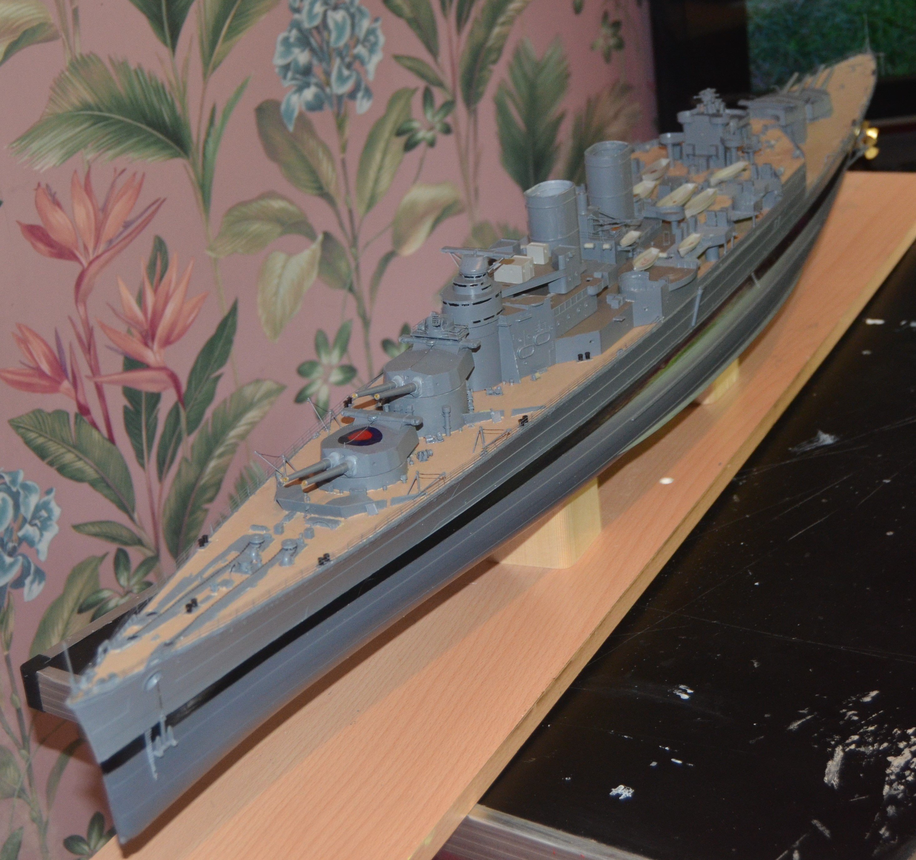

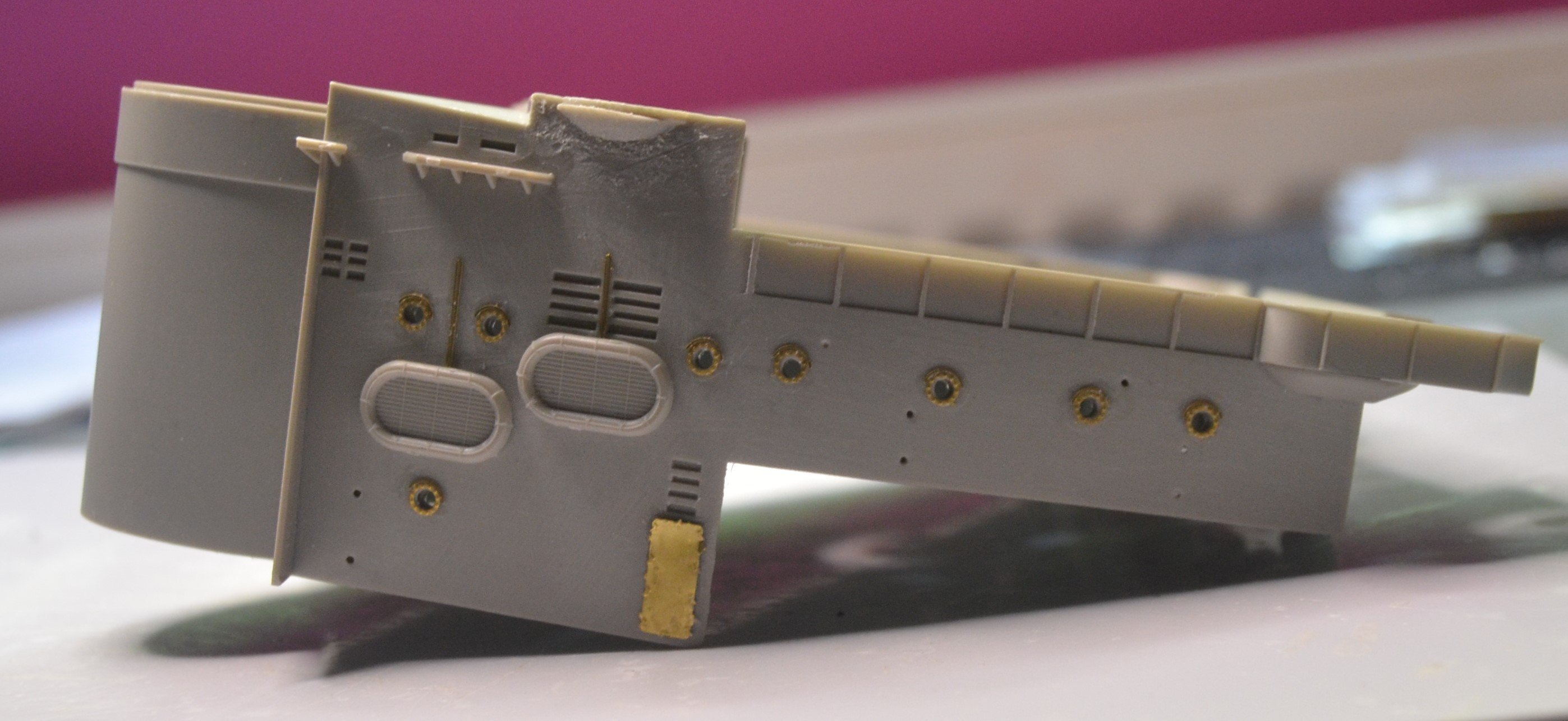

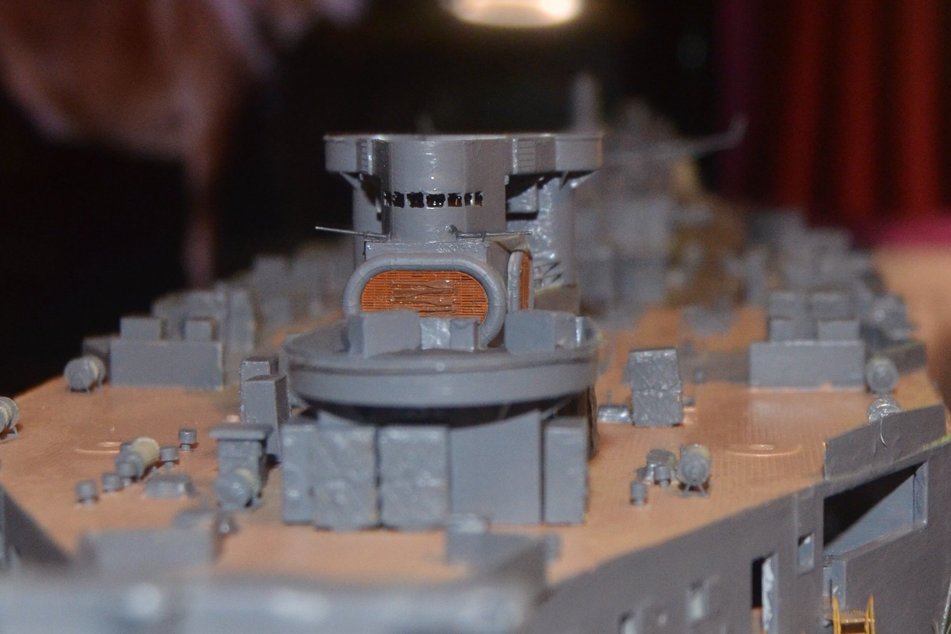

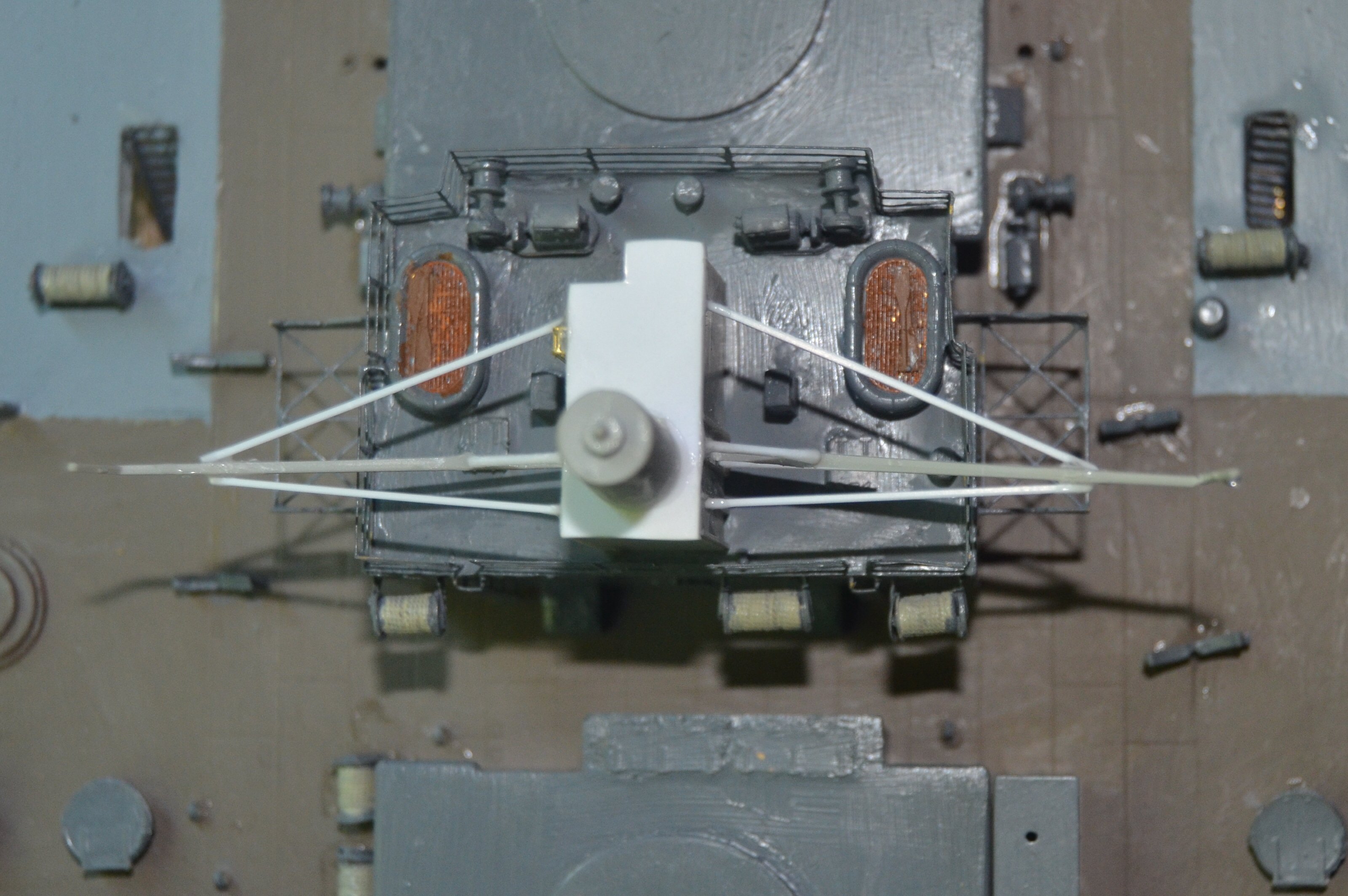

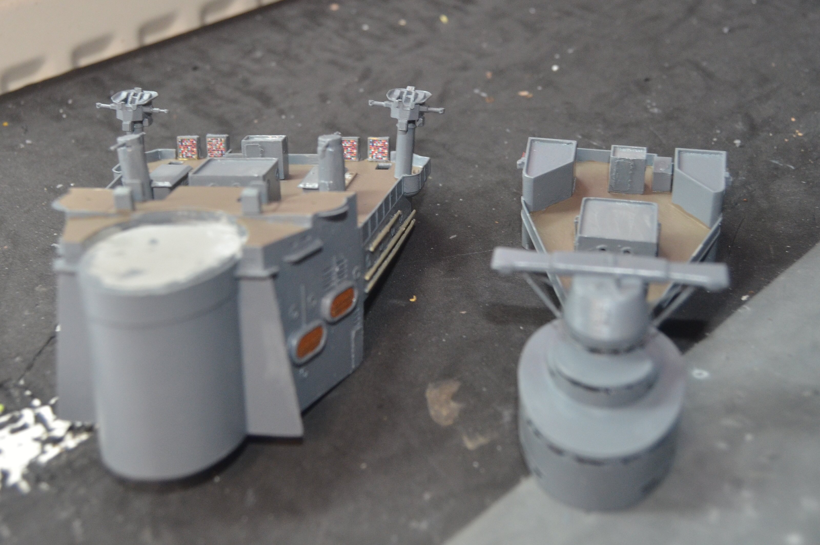

It's getting a bit complex now. I'm adding lots of details to the various structures. Probably around 80% of them are upgrades from the MK1 kit. Trumpeter have made some strange decisions with this kit. It is a quality kit to a very high standard. There are quite a few PE ladders and steps. But where  these are molded into the plastic they have not replaced them. But the MK1 kit does have all the replacements for these parts.

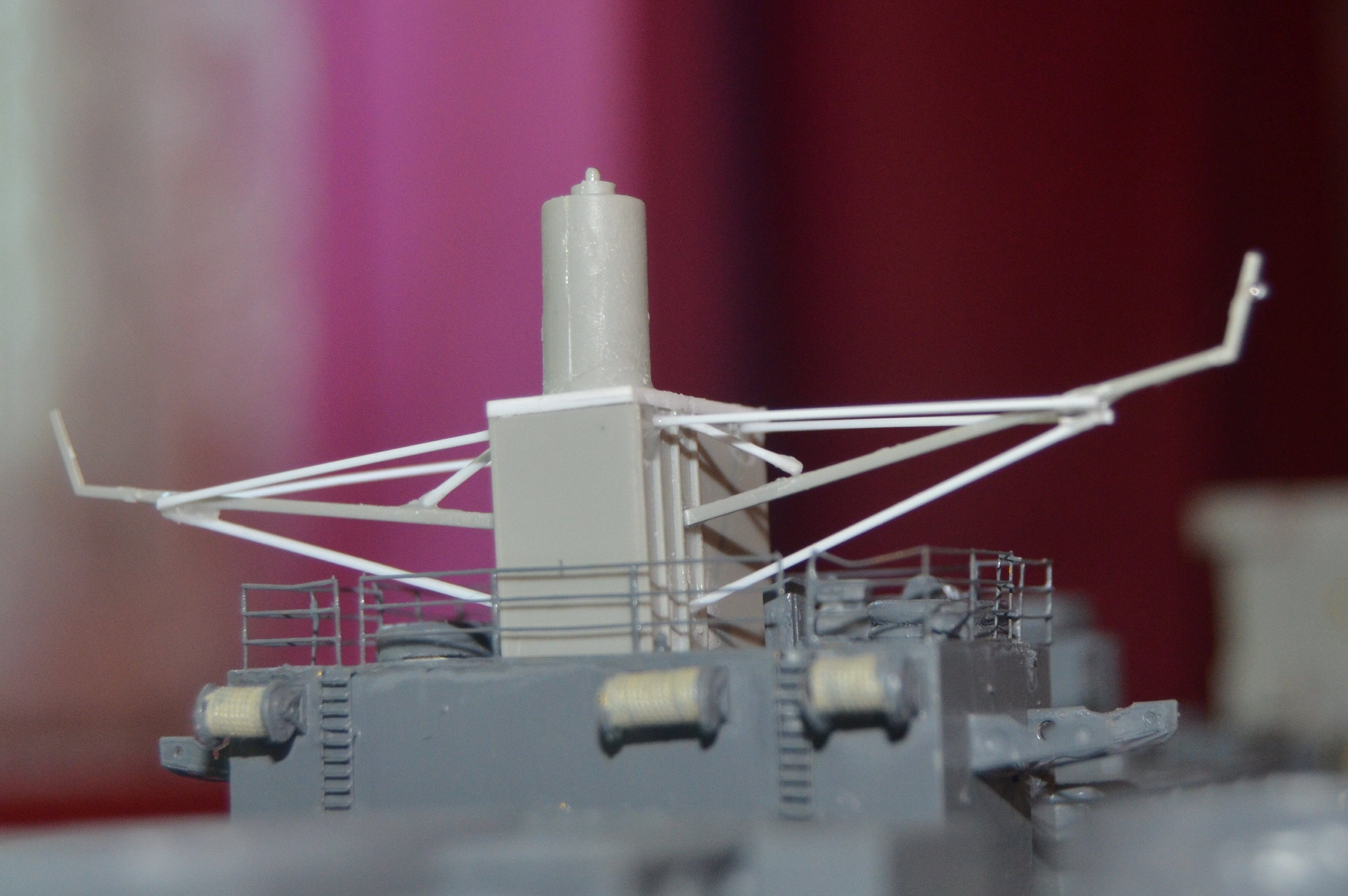

Pictures 1 and 2 are the wireless rig. Trumpeter have the layout slightly wrong. and the roof was flat not recessed. this has been remedied with some thin plastic sheet. And the aerial spreaders where made with some very thin PE that was also not quite right. I have made the spreaders from very thin plastic rod based on the HMS Hood web site. In picture three the tripod director has had the plastic one replaced with a resin one which is a lot more detailed. The black in the windows is lacquer paint and looks far better than the close up. They catch the light at times and look like glare from the glass windows.
Still lots to add to the smaller deck parts before getting round to the bridge. PE has it's good and bad bits . It is excellent for adding a lot of detail that would otherwise not be on the model. On the other hand it does add a lot of extra time to the build.

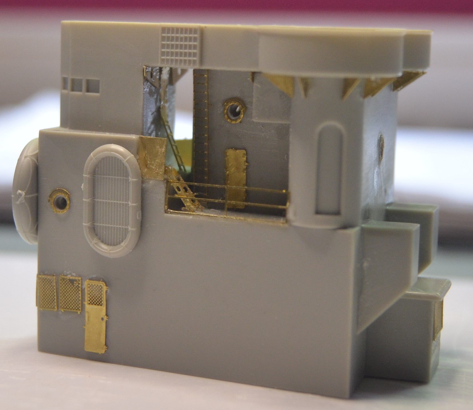

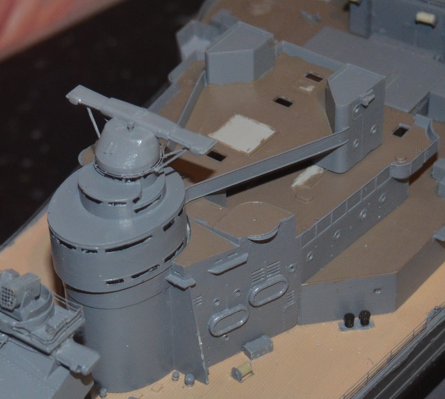

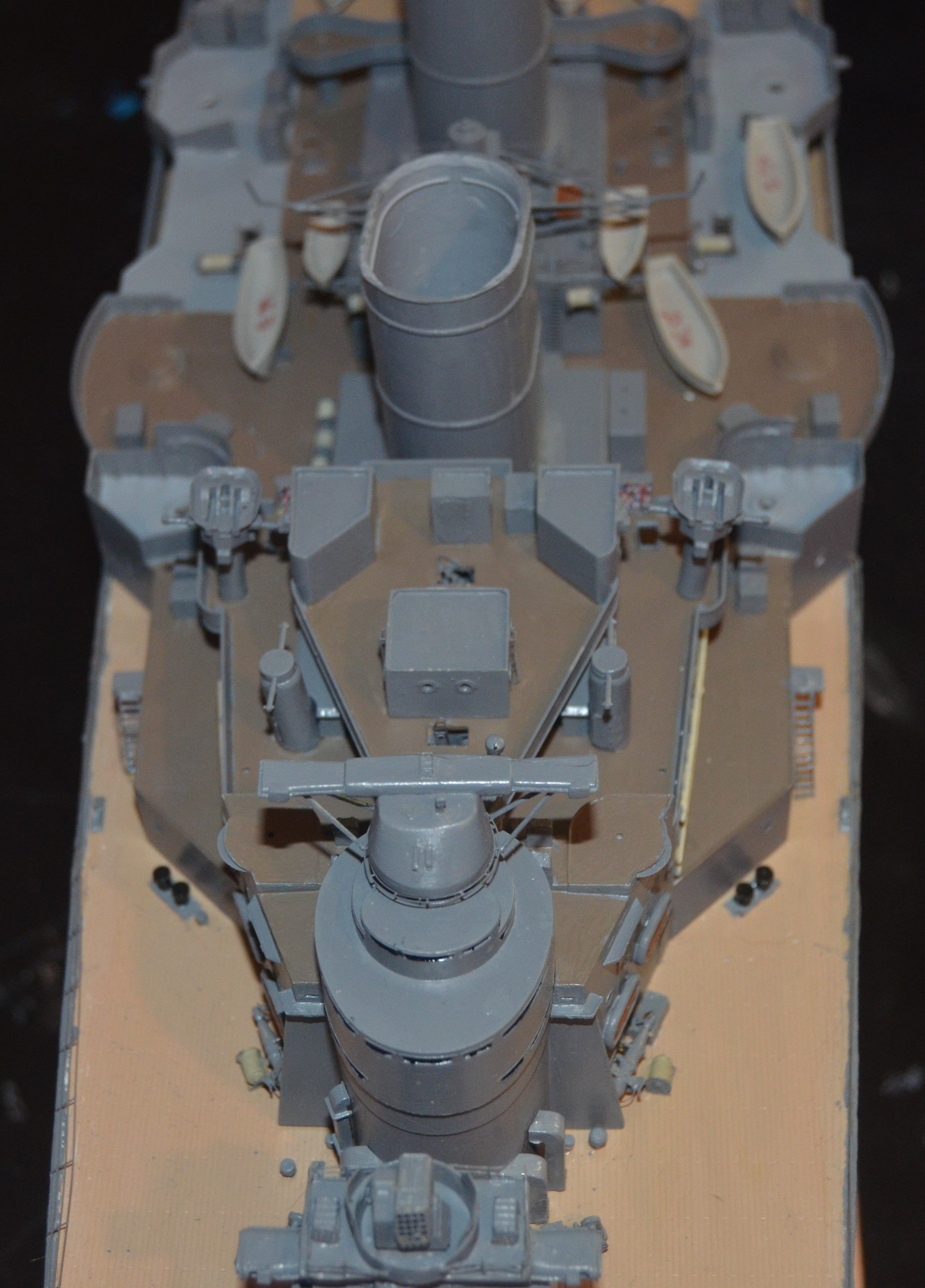

I have decided to do the bottom section of the bridge. Still a lot more to add to this inside and on the outside. I also decided to add the red and blue insignia to the gun turret. I had some self adhesive round labels which where the perfect size. After a bit of trial and error working out how best to paint it I settled on painting the blue on top of the red. This looks a lot better then the bright blue colour. It also looks better on the gun than in the picture I have zoomed in on as I have tidied up the edges and added another coat of blue. I have painted it over with a thin coat of matt varnish to seal it in place. I am adding so much extra detail now using the MK1 upgrade kit. Which is improving the look of the model so well. Still lots to do on the shelter deck alone before getting to the upper part of the bridge and masts.
In Work: HMS Hood
Finished: -queen-mary-2
Finished: rms-titanic-1912
Finished: king-of-the-Mississippi
Finished: Sanson

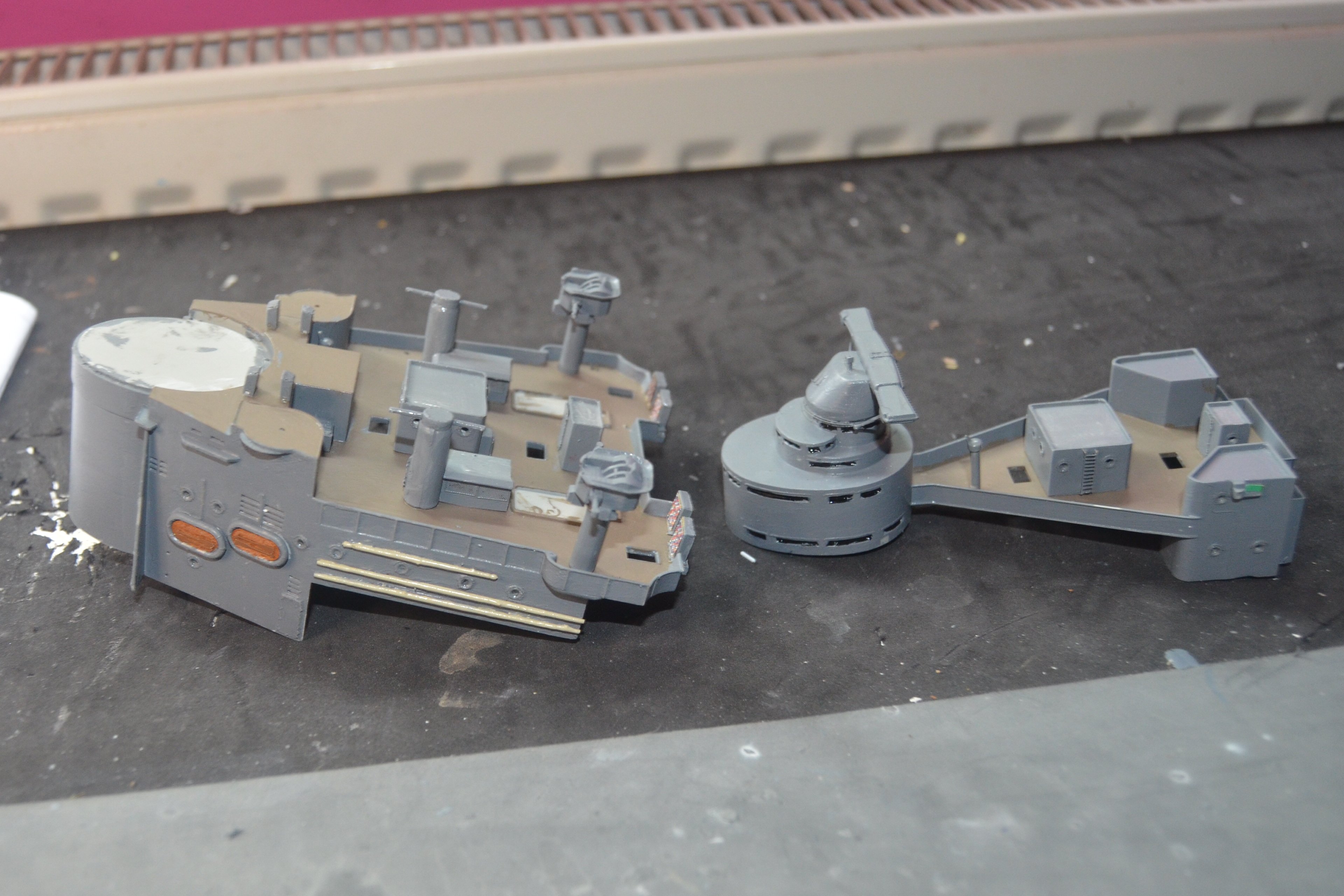

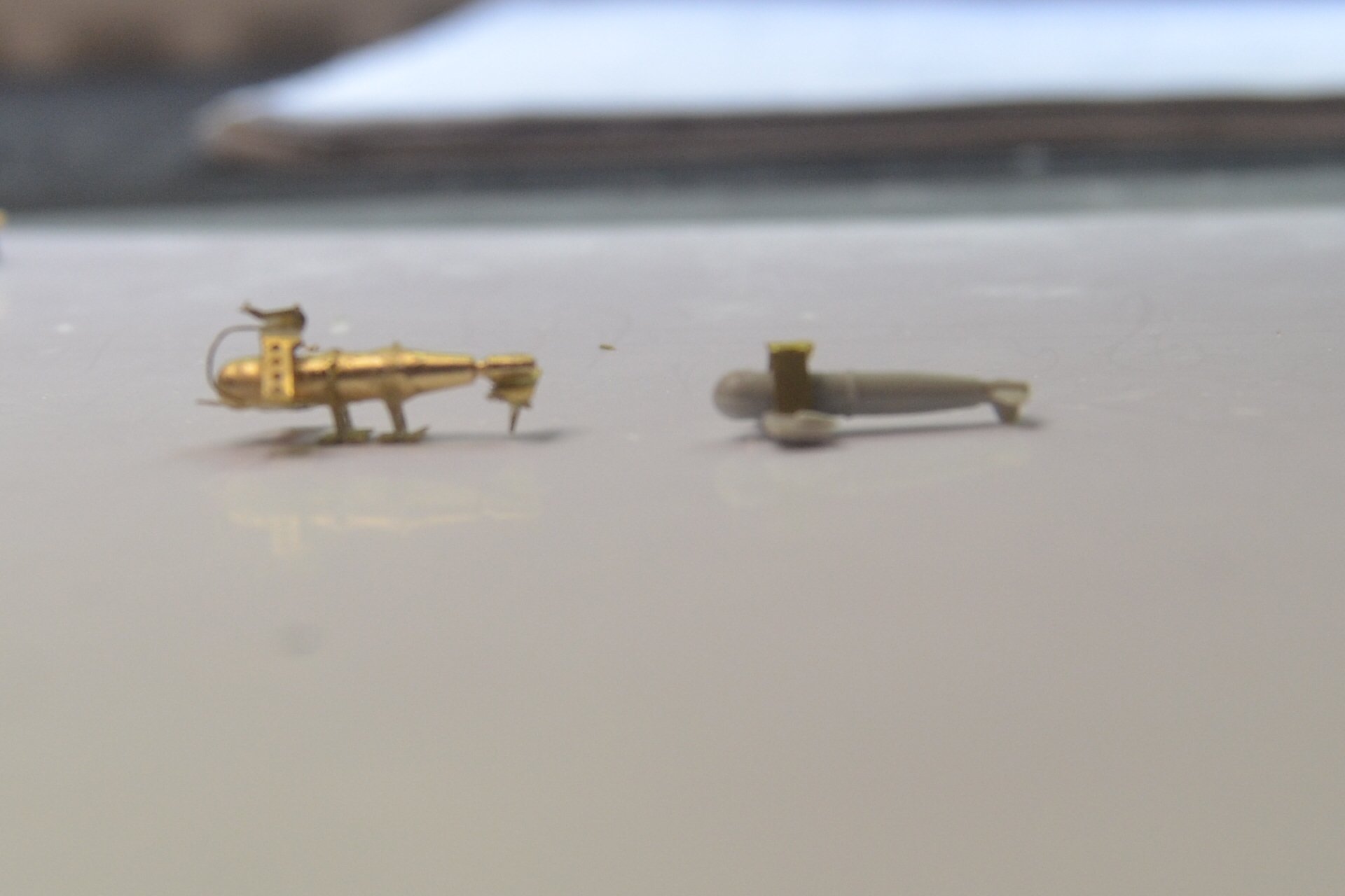

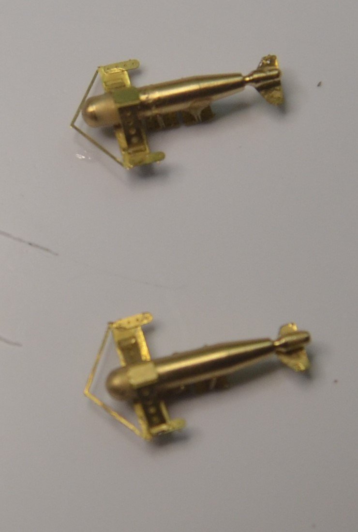

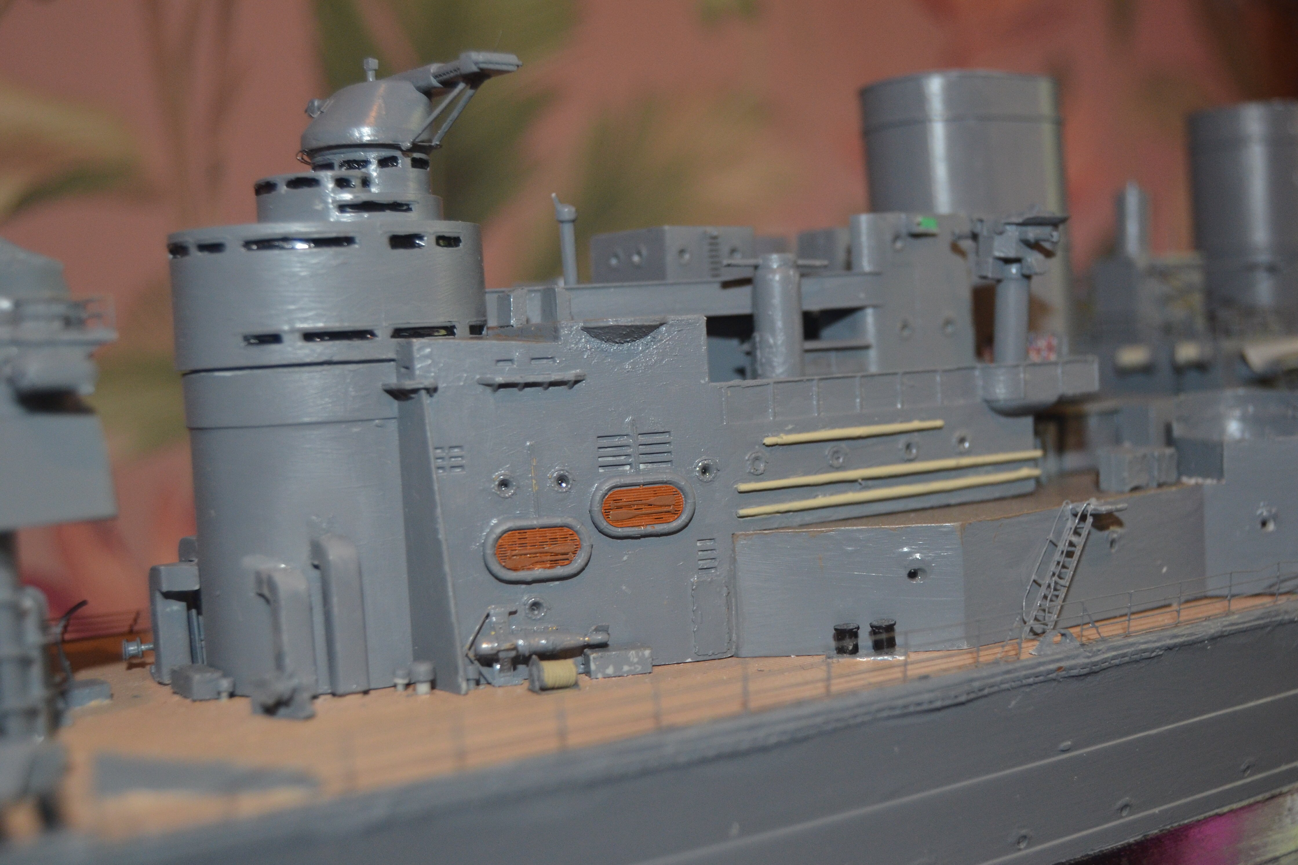

Quite a lot of detail added to the bottom part of the bridge. The paravanes are the upgraded ones. I have included one of them with one as made out of the box to show how much difference there is. The ladders have been added, although most of them are difficult to see below the top section. I think the next few models will be built out of the box. I enjoy adding all the extra detail but it does add a lot of time to the build.

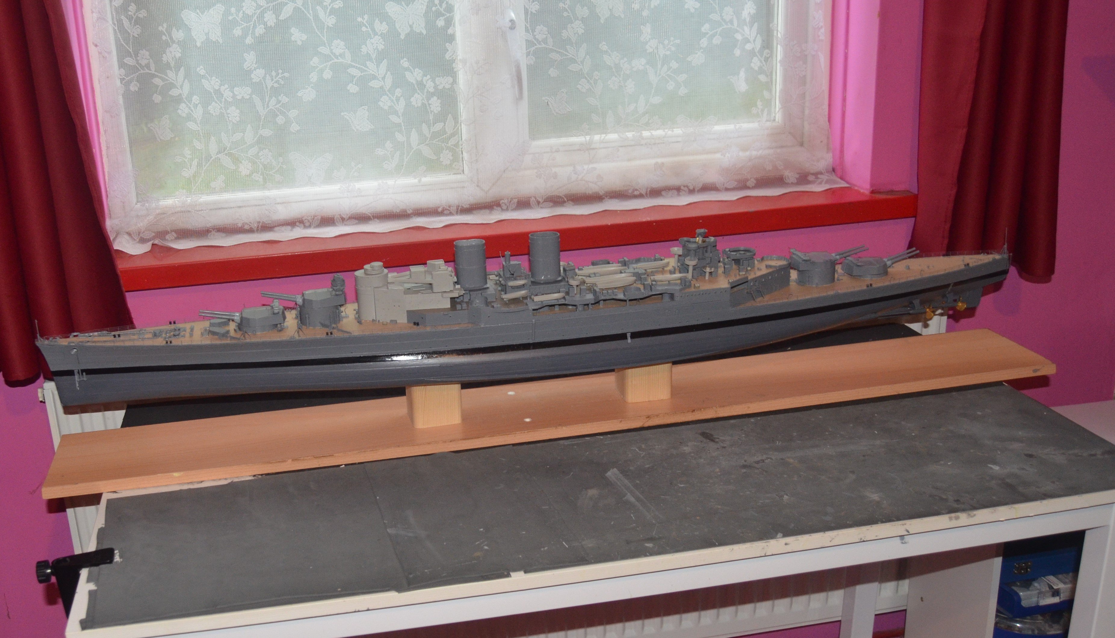

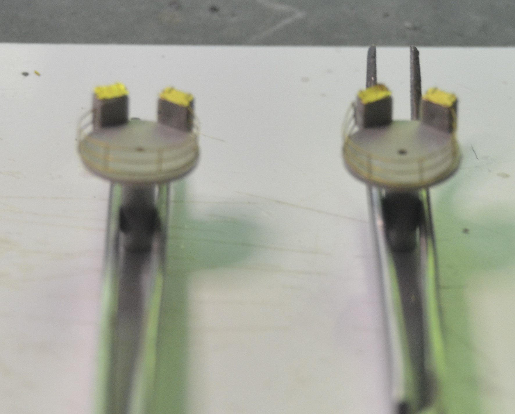

Funnels completed and glued in place. The PE adds a nice bit of detail. The cages on top have come out well considering how fragile they are.
I will be adding the binoculars next But not the PE ones, the plastic ones are far better. PE is mostly good but when it is a part that sits on a column it just doesn't work. They would just be flat parts that don't look right.
