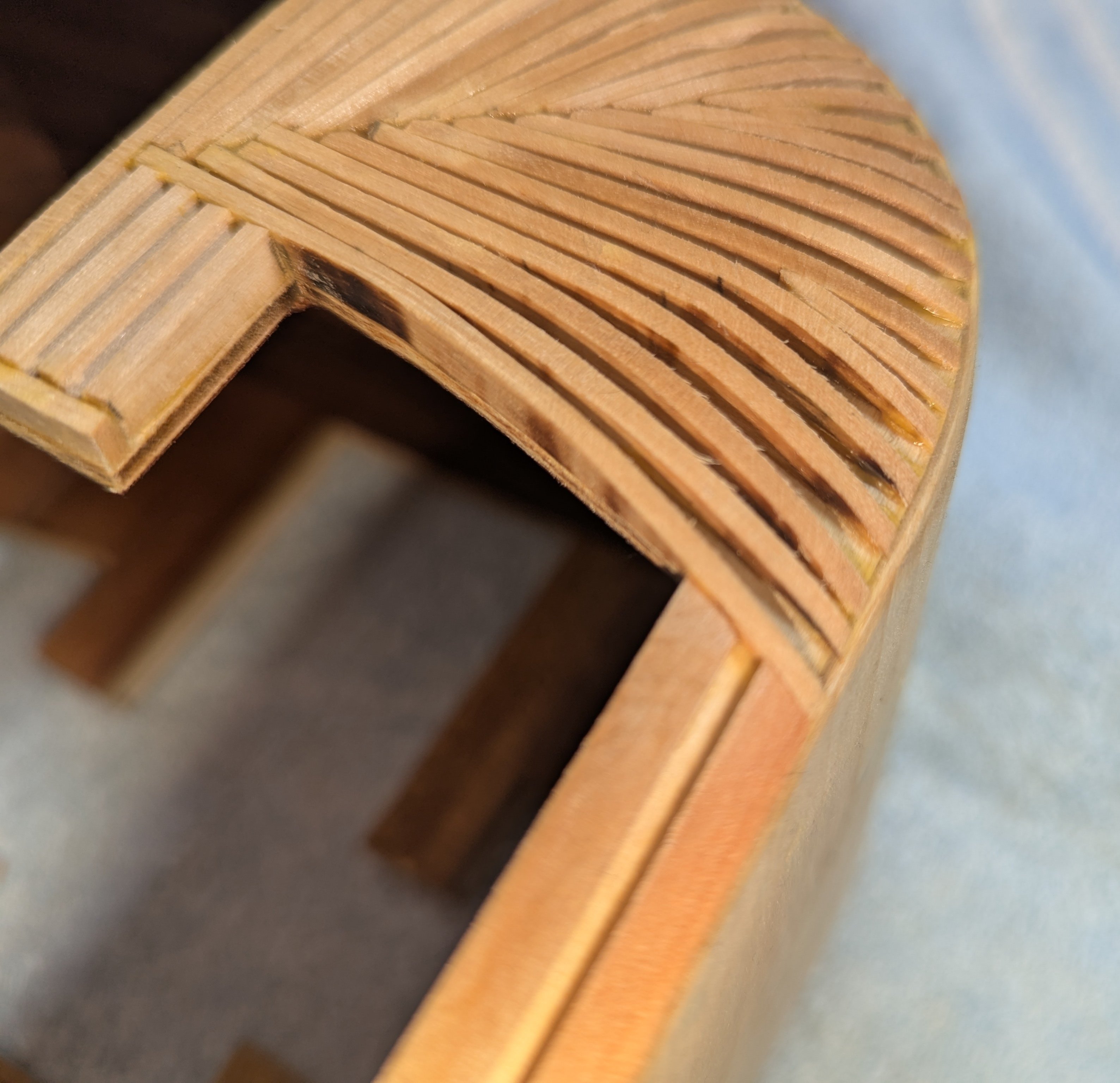

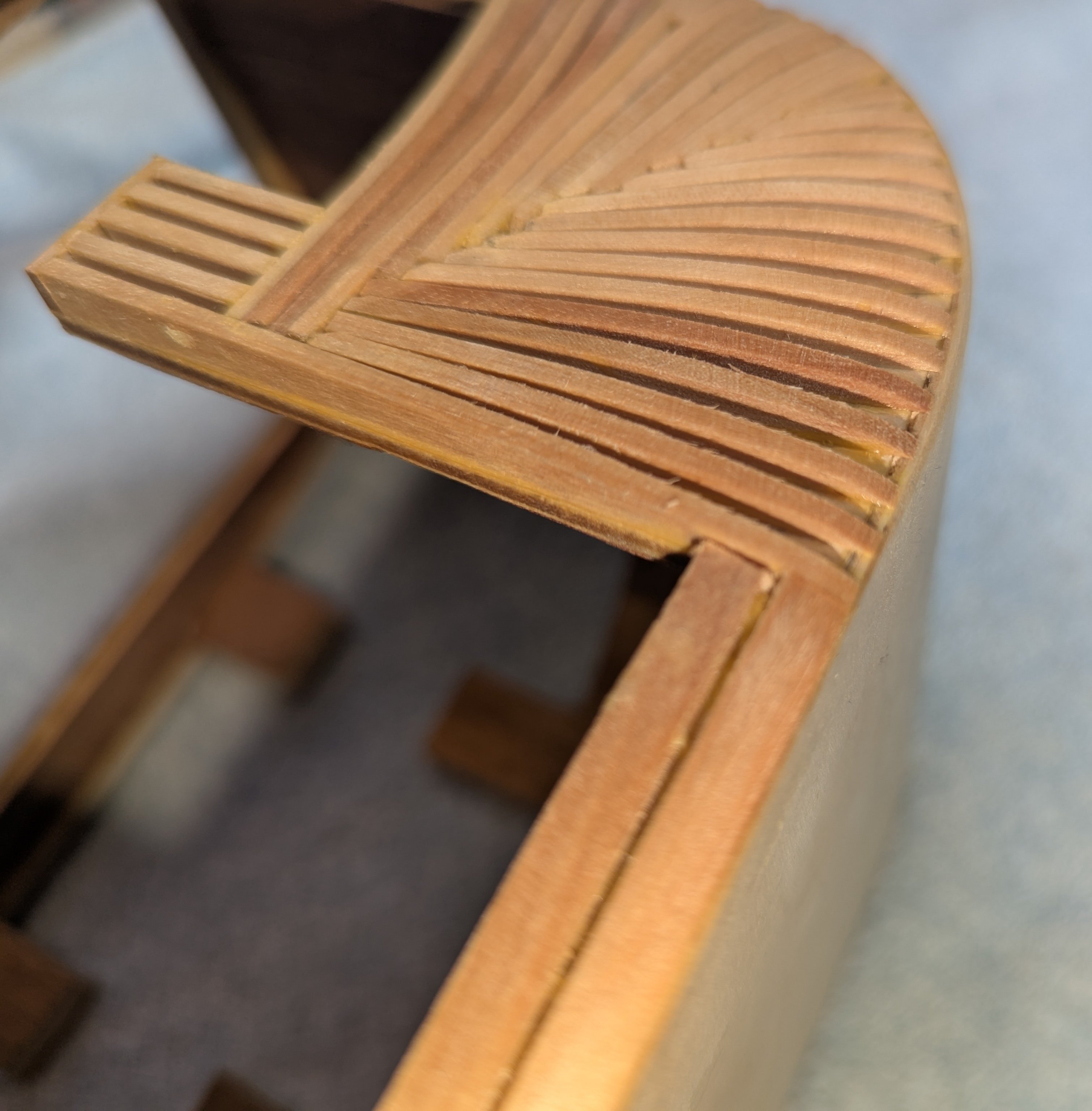

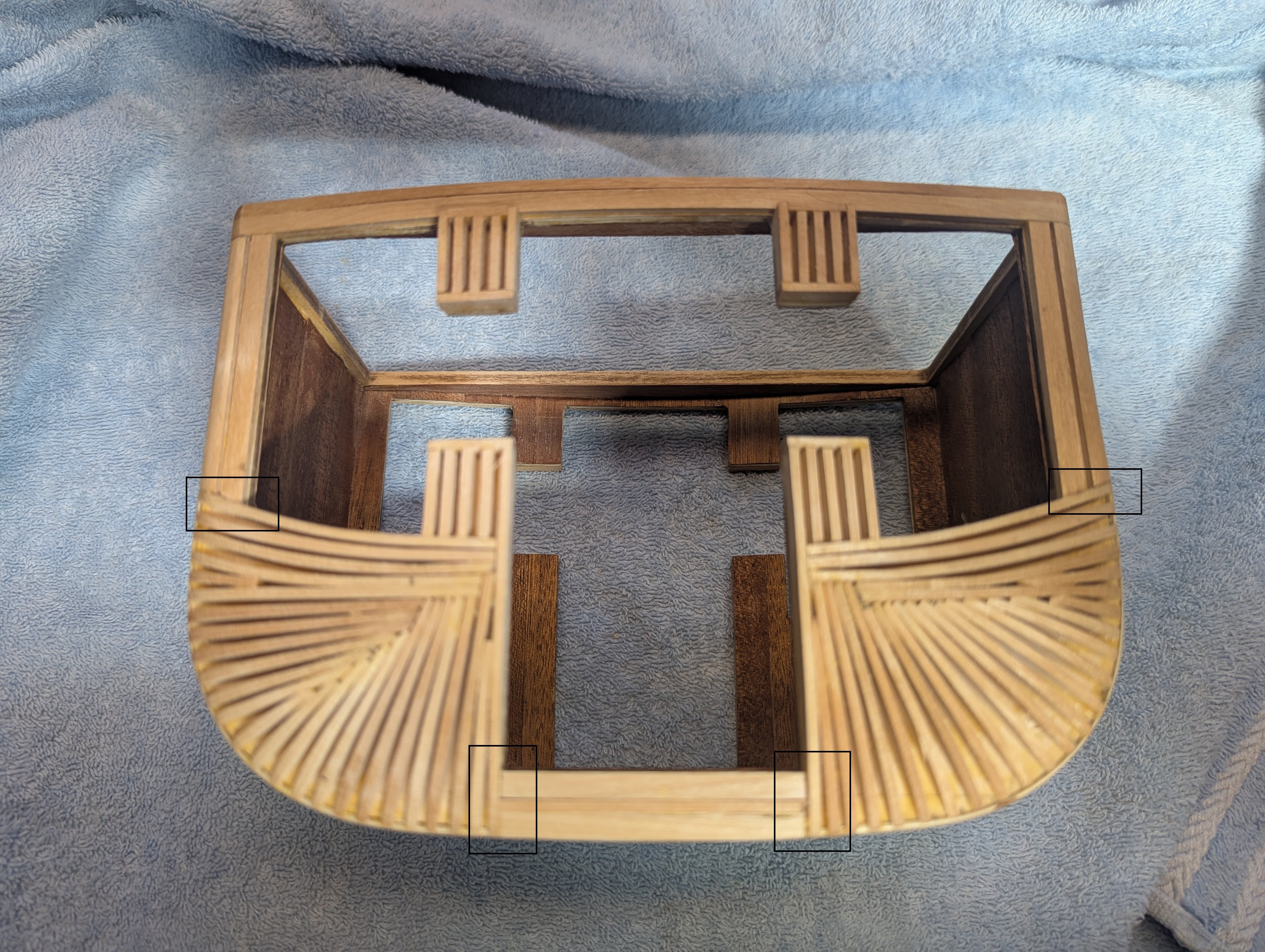

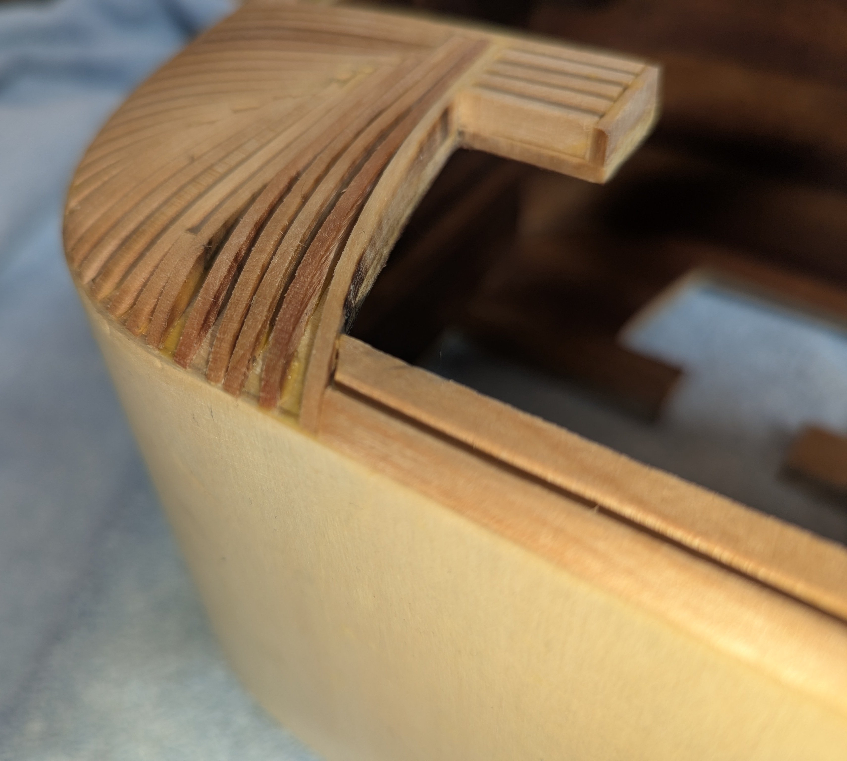

On to trimming and shaping the four sides..... I mentioned above that laying the strips got old very fast....   but sanding and shaping these same strips really got old fast.    This step kicks up a lot of dust.   I recommend wearing a mask and if the weather is nice outside, do this trimming outside.   Main idea after the strips are trimmed is to sand them from top to bottom forming a somewhat convex shape.   Very little is trimmed off from the top of the strips to when almost all of the strips are sanded off at the bottom.
Below is on of the two finished sides.   Pay special attention to the four areas marked with black boxes.   Since the finishing strips will lay across  these initial strips there needs to be a smooth transition between the strips and the side walls.
Pardon my photos,,, I seemed to have moved the camera with them as some of them are out of focus..  I will try to be more careful in the future.
Below are some close ups of the four transition sections I mentioned above.   You will also note the convex shape of these walls

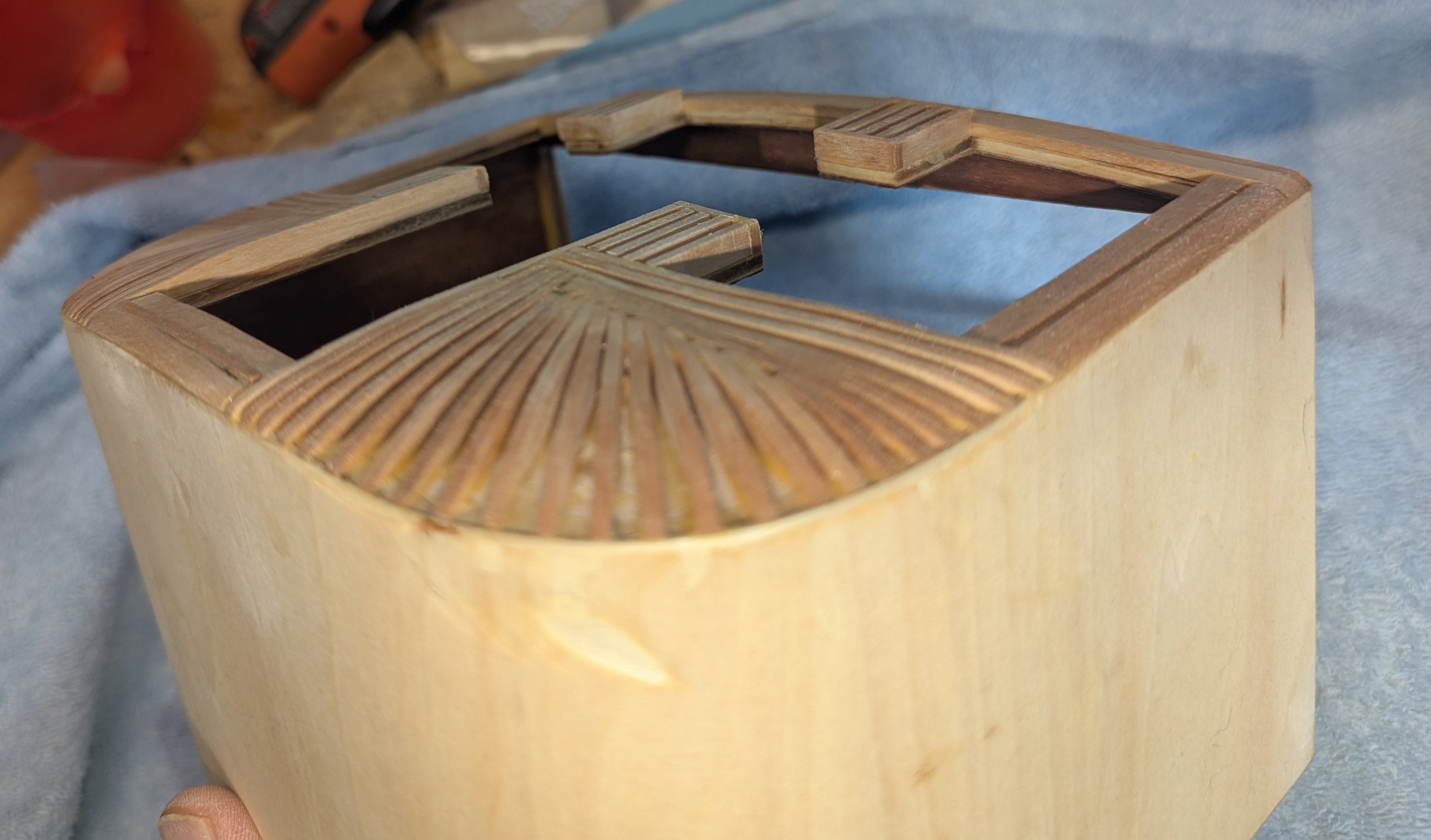

Next need to start coving the front, back, and bottom of the carriage.   Starting in the middle with the first strip.   A couple of large rubber bands really comes in handy here to hold the strip down while the glue dries.
Slowly working your way  out with other strips.   The outside strips will hang over the edge and need to be trimmed
Below you can see the strip hanging over the edge.    Once the glue is dry, using a sharp x-acto knife, the strip is easily trimmed.
After trimming.    Edge between side and front/back,bottom edges does not need to be exact as a strip of wood will eventually over up the seam.
Final shot from the top.   At this point I plan to put about four coats of rub-on poly to help protect the carriage.   In the end there will be more coats of the rub-on poly as more details are added, but for now four coats is plenty.   In hind sight, I would defiantly be faster to use a foam brush and just paint on normal polyurethan rather then rub-on poly as rub-on poly is really thin and takes a lot of coats.    I have a feeling when it comes time for more polyurethan I may just brush it on rather then use the rub-on poly.    Having said that, rub-on poly lays down a really smooth coat with no worry about runs.   We'll see what I feel like when that time comes.

After planking front and back
I will add the fine details later.....

On to putting the strips around the windows and doors.   Keep in mind since it is a curved structure, the strips around the doors and windows will be slightly slanted.   In the picture below I only outline a few places, but in reality strips around almost every window and door are slightly slanted.
A few pieces of scrap wood some in handy to keep the curved pieces in place while the glue dries.    Having said that, once you heat and bend the strip, with wood glue you can just hold the piece for a few minutes and it will adhere very well.   Strips are not really required.
Not sure if is a flaw with the builder (me) or just all the movement of the pieces in creating the carriage so far, but the tabs that make up the main door and windows for some reason do not line up.    They need to be lined up in order to glue the side door piece.   A few clamps and some thick wood will line up the tabs, so the door side piece can be easily attached.
Once the side piece is glued on, the clamps can be removed and the door side will be perfectly lined up
