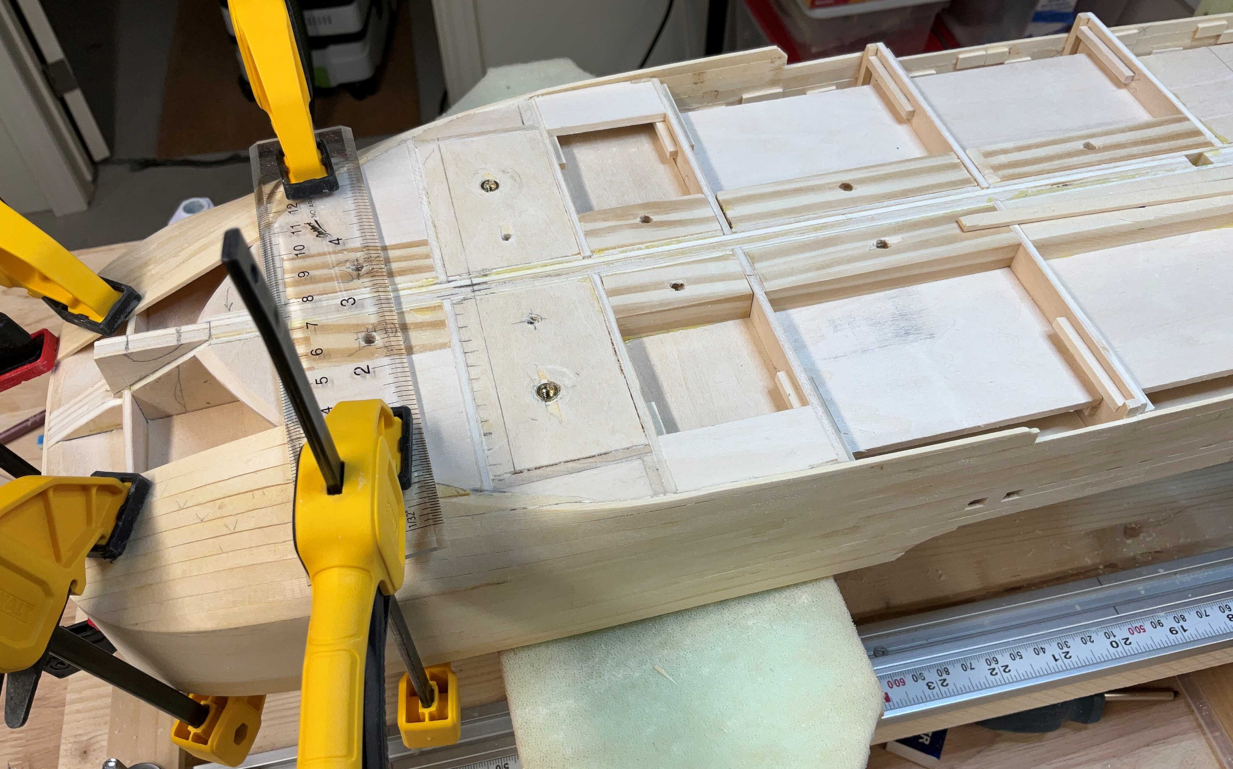

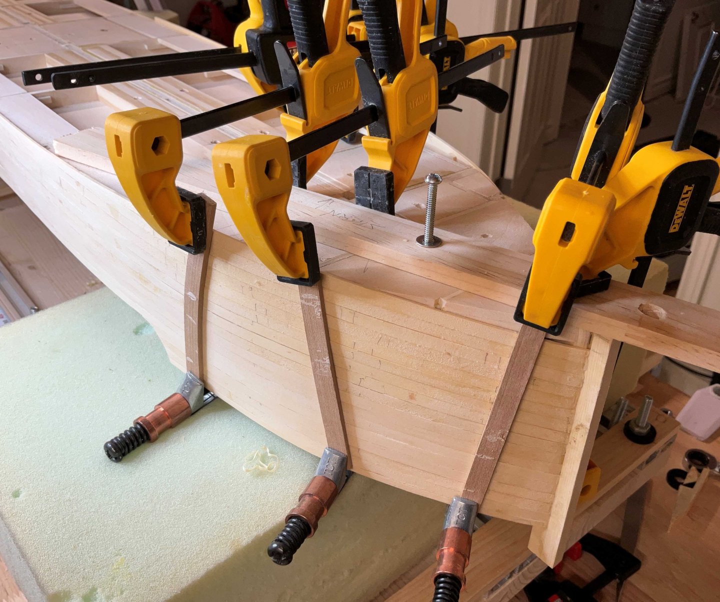

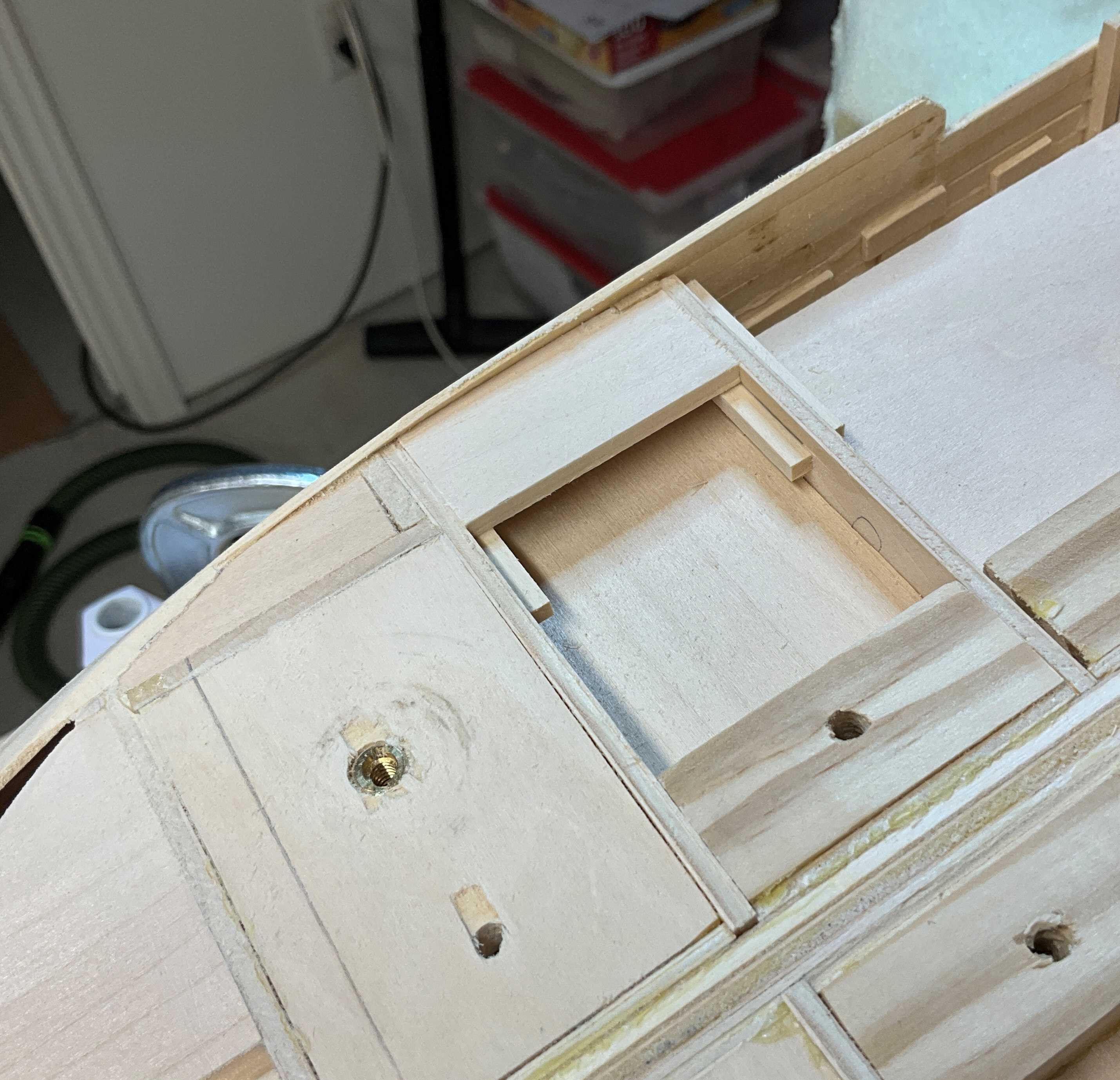

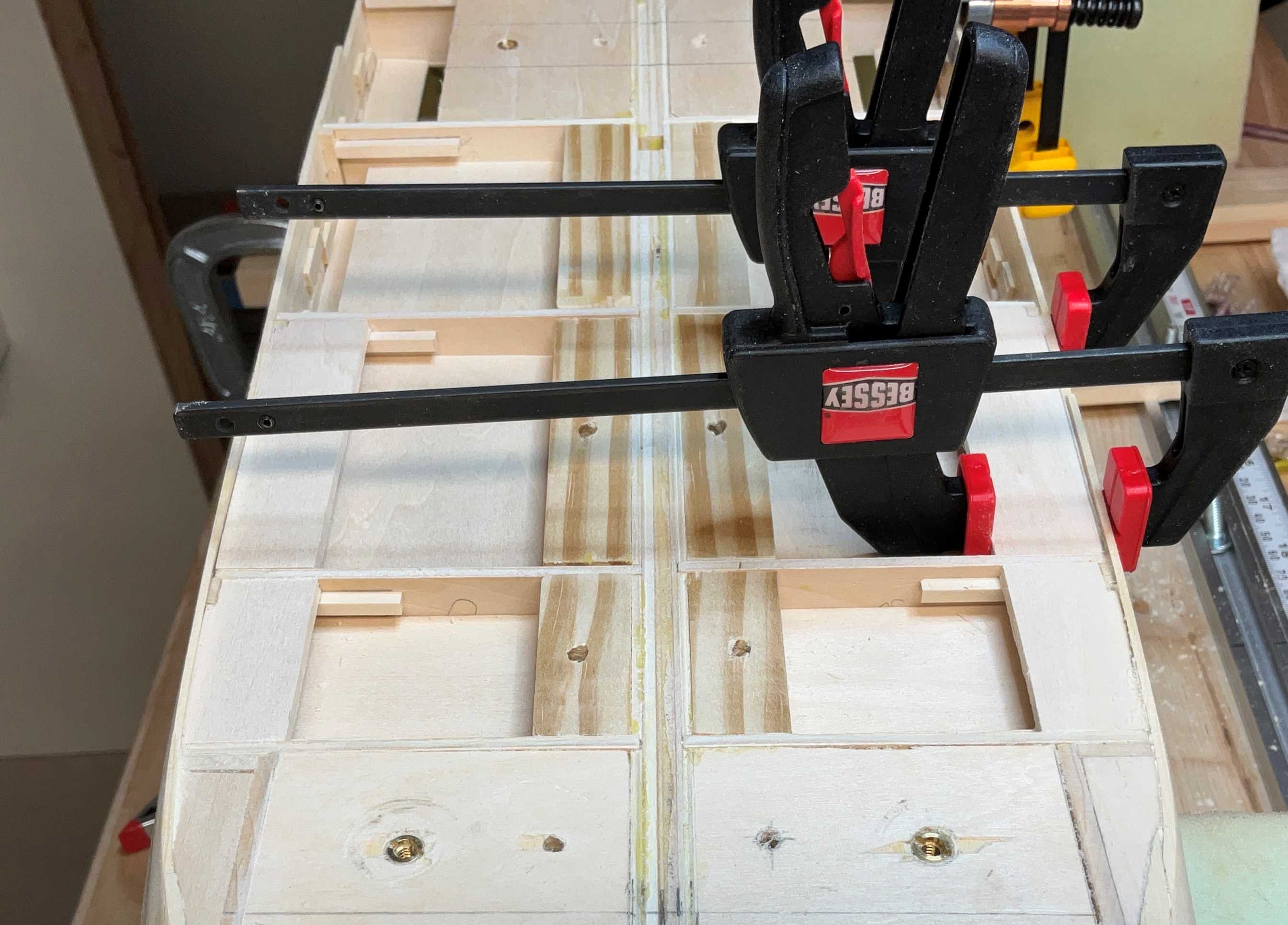

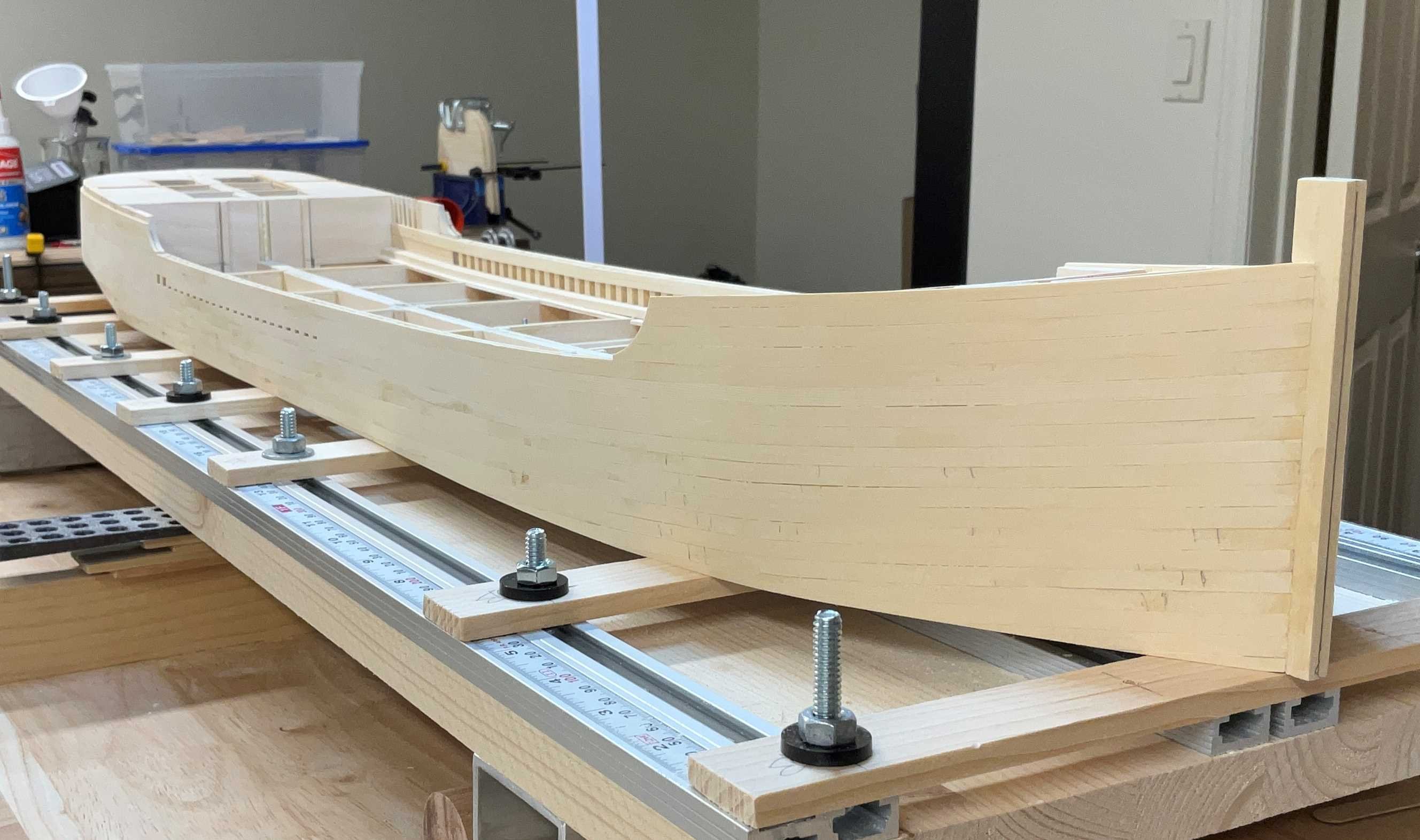

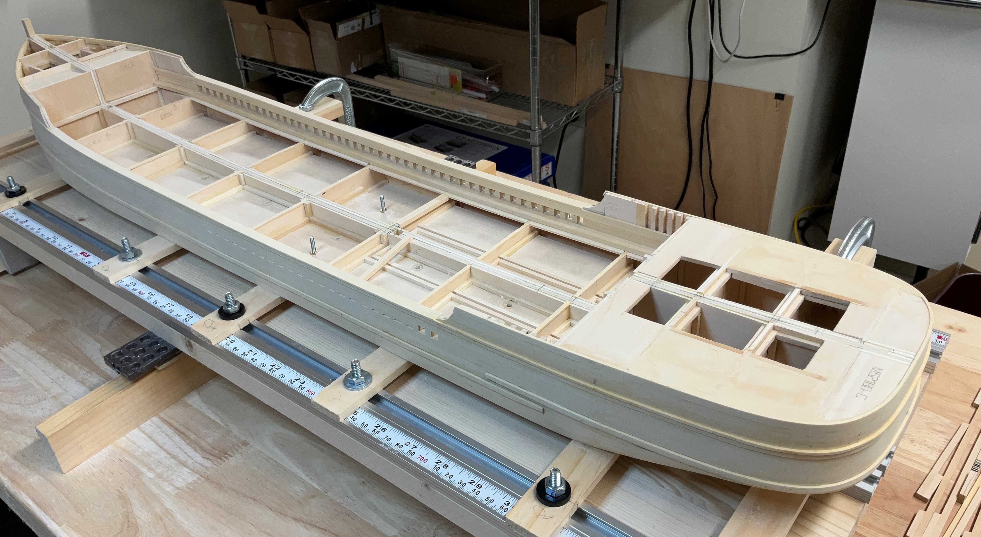

Hi Everyone, I hope all is good. Thank you for the great Comments and Likes. Just have a bit of a planking update today. I worked my way up to the rails and added support for the forecastle subdeck which will be 1/32" plywood.

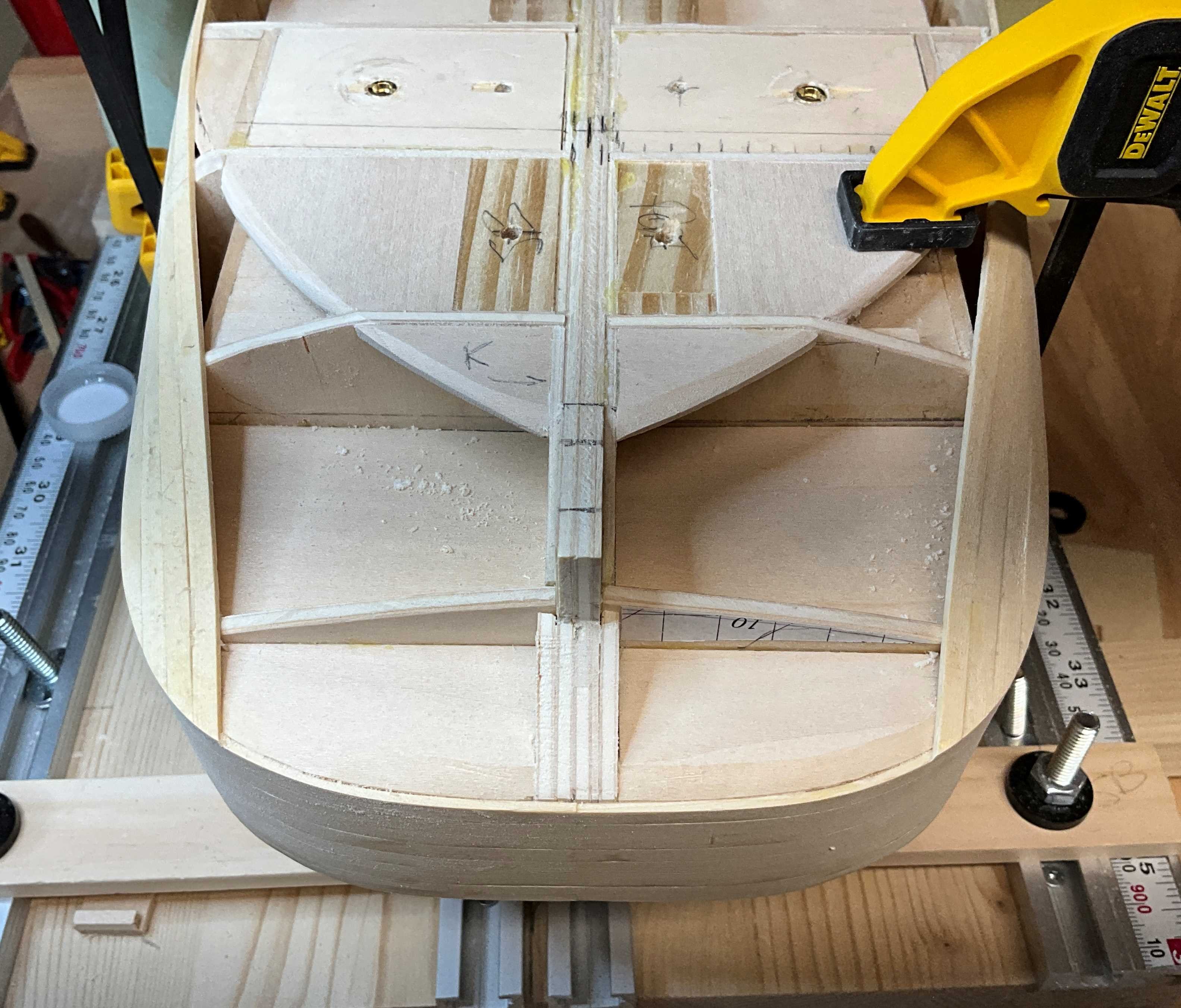

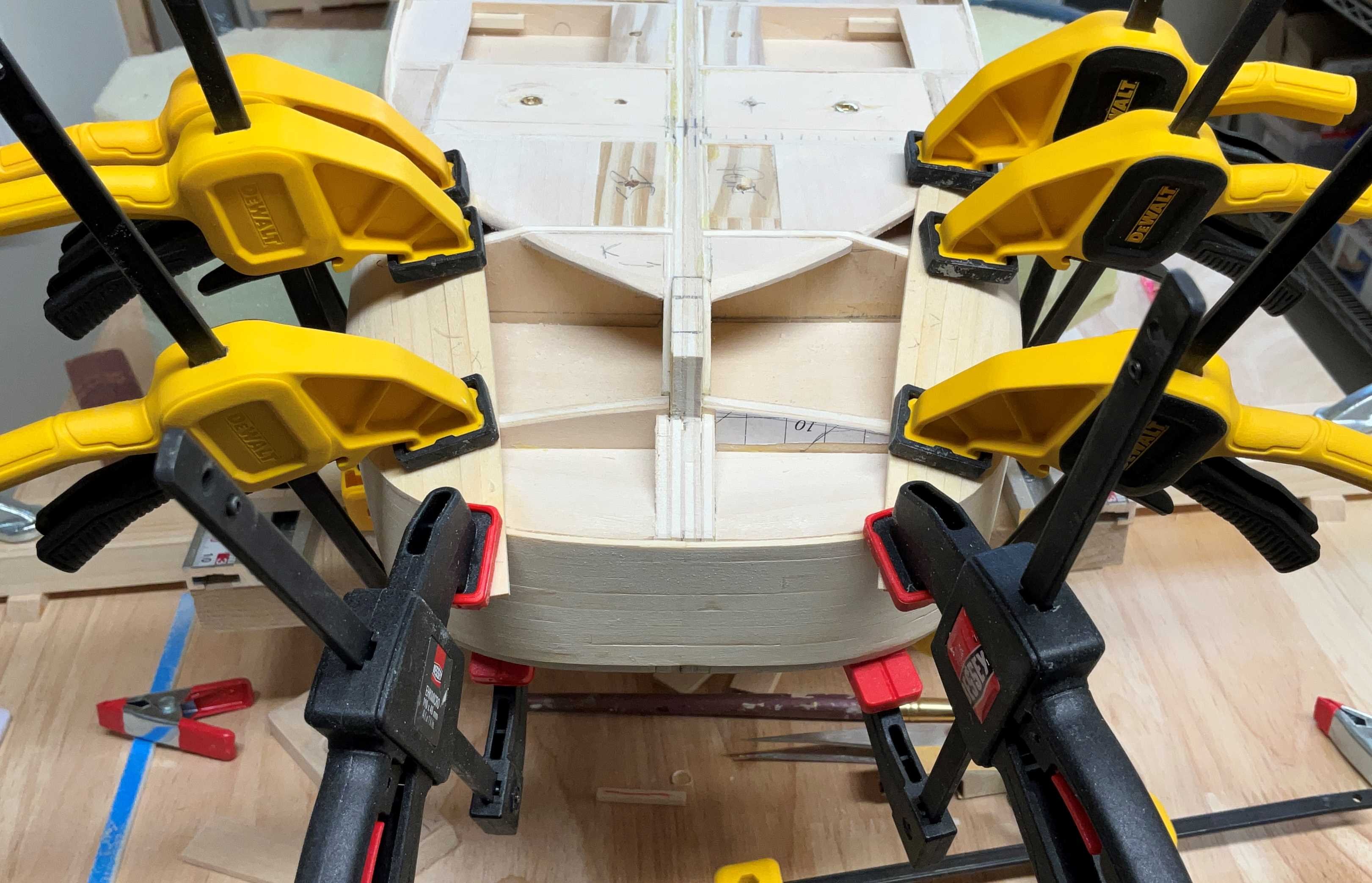

The model had to be removed from the build board and turned over to finish the fairing and planking down to the water line. Once that was done I started to focus on the counter. The first two strakes on Port and Starboard needed tapering, bending and twisting. A combination of CA and white PVA was used to keep them in place. My 2 year old Starbond CA was not up for the job so I picked up some Bob Smith CA. Read a lot of good reviews about Bob Smith and I completely agree with them. Support made from 1/8" basswood sheet has been added at the water line.
The rest of the counter planks have a slight taper and run off the stern so back to using just white PVA. Next post I hope to be finished the hull planking. See you soon.

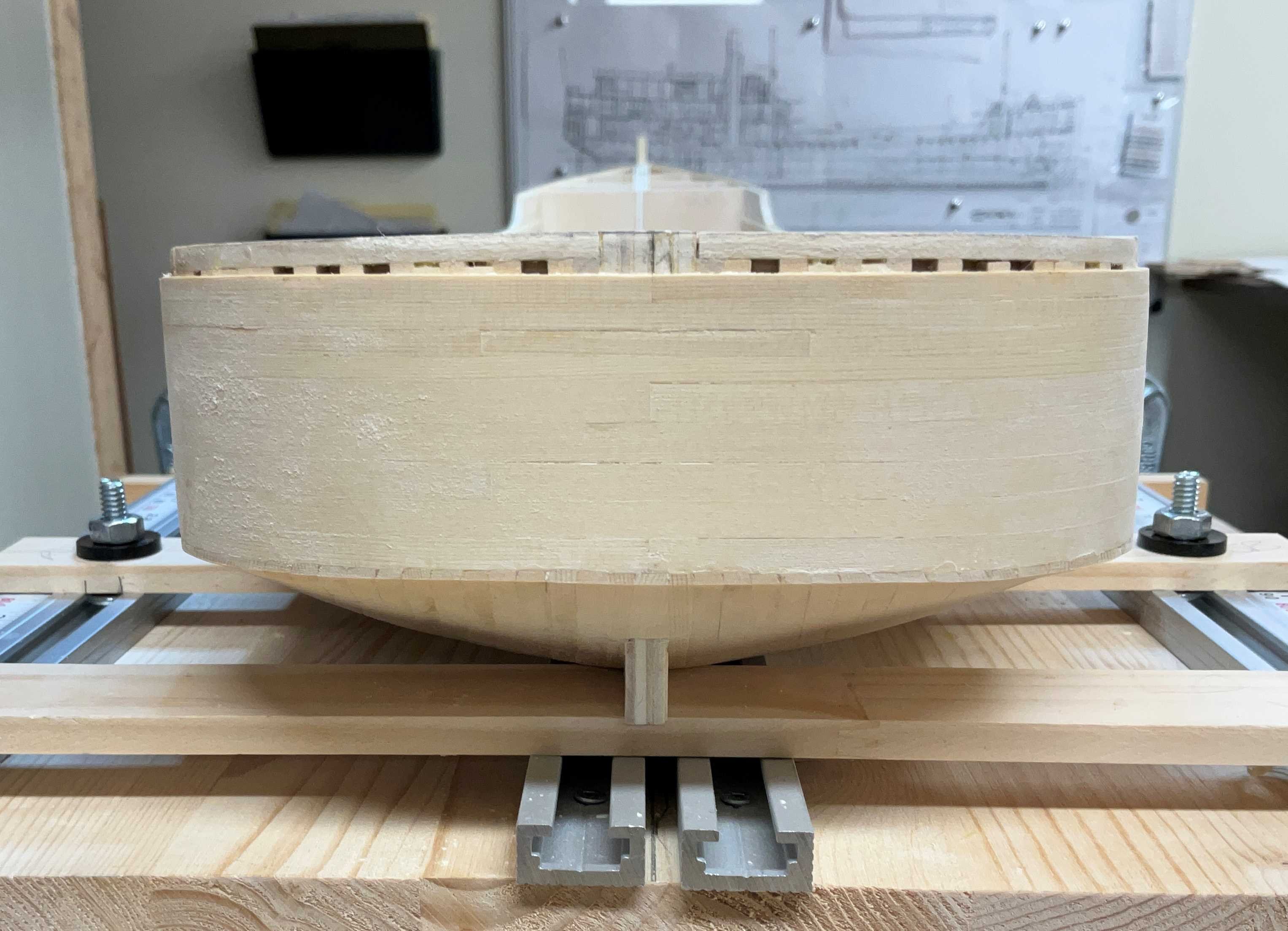

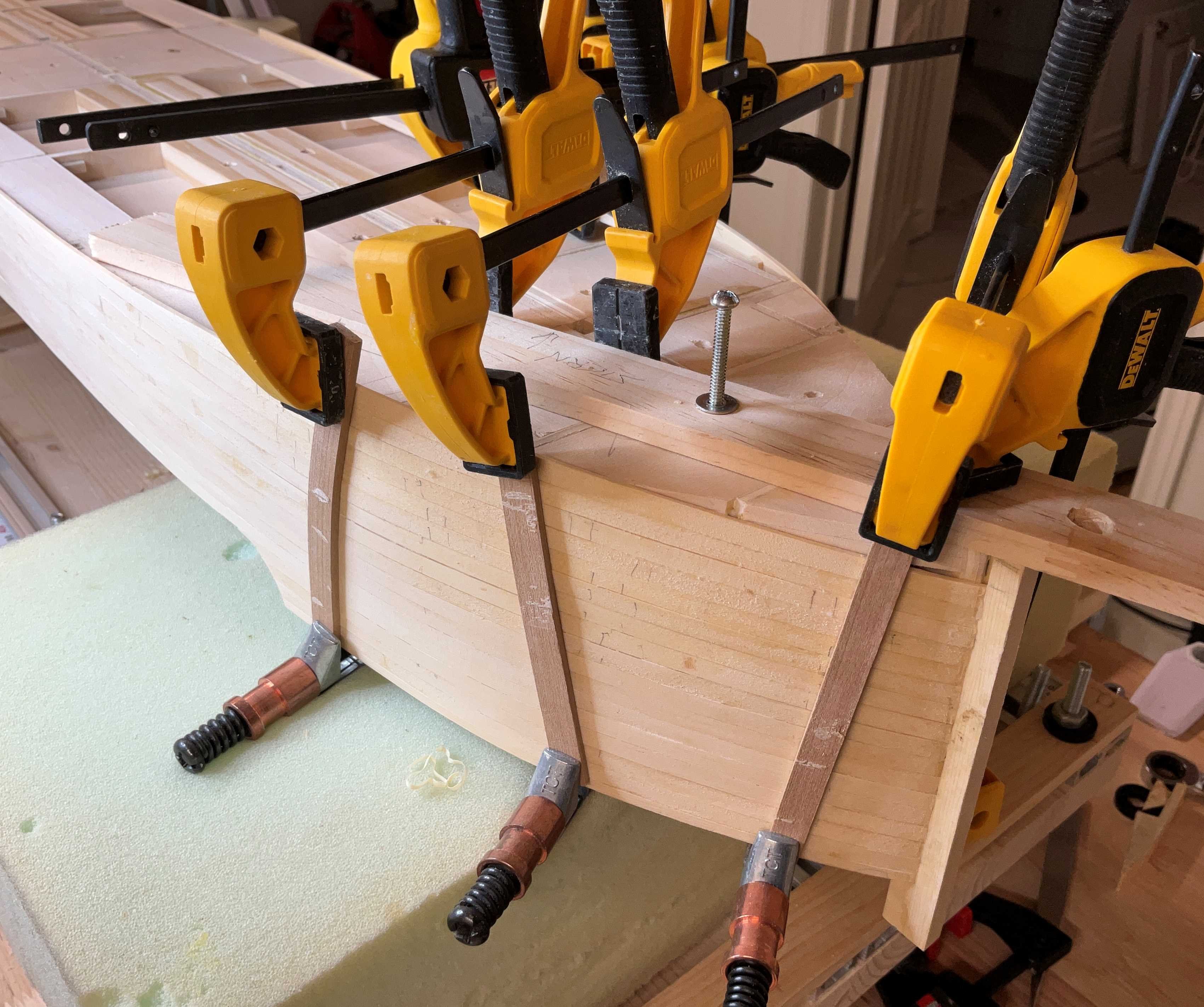

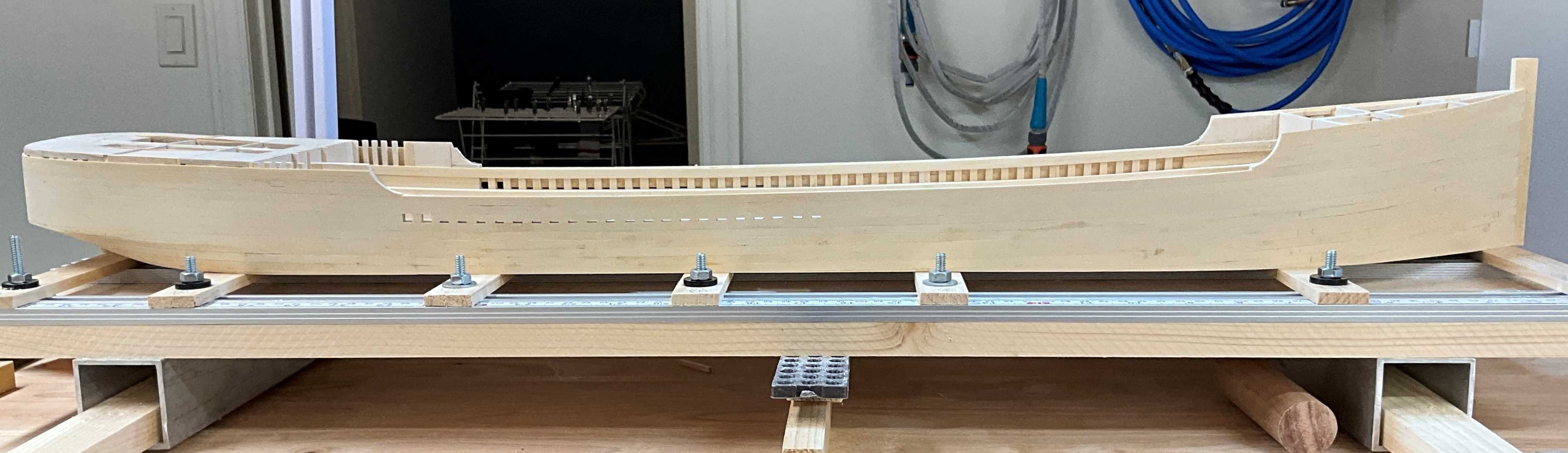

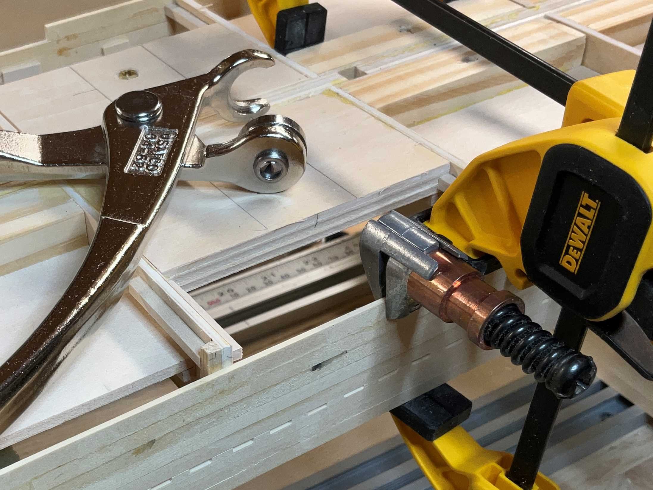

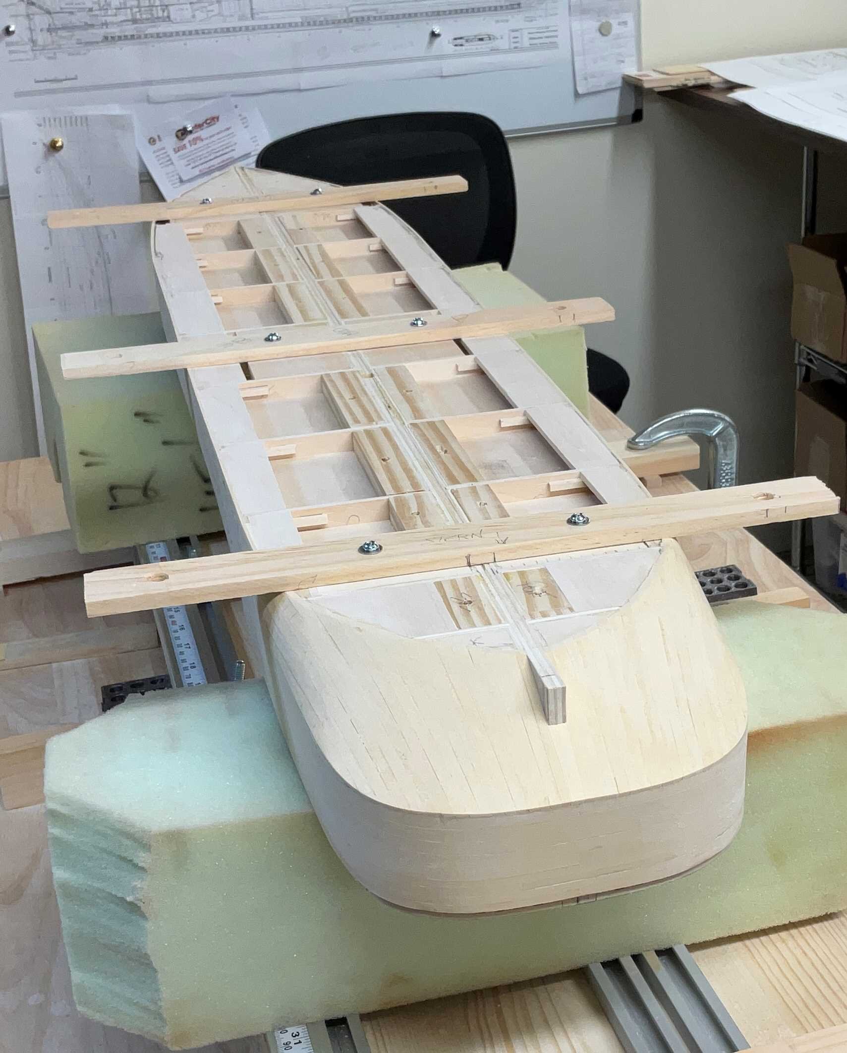

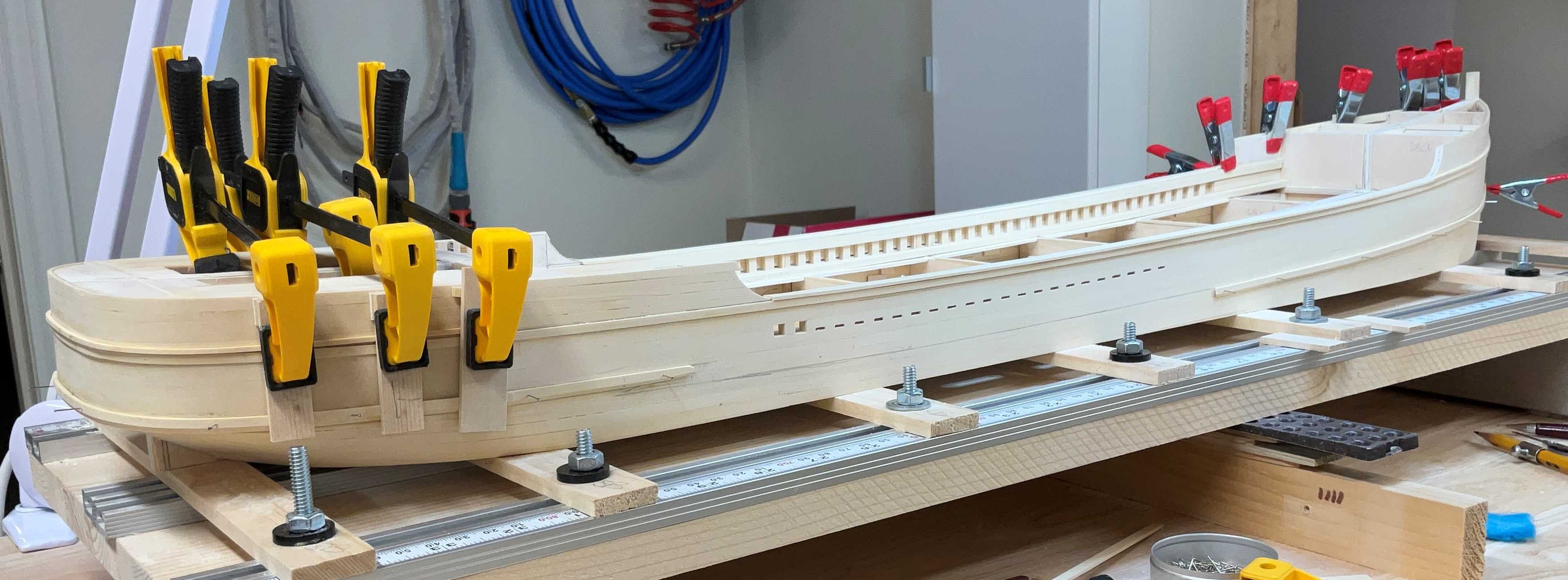

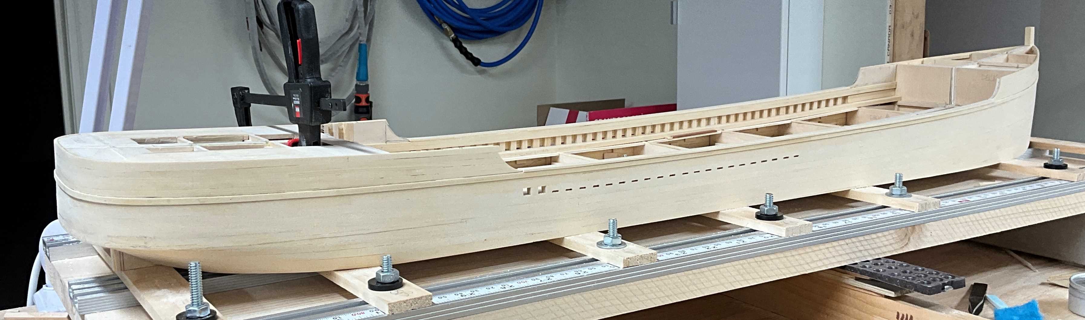

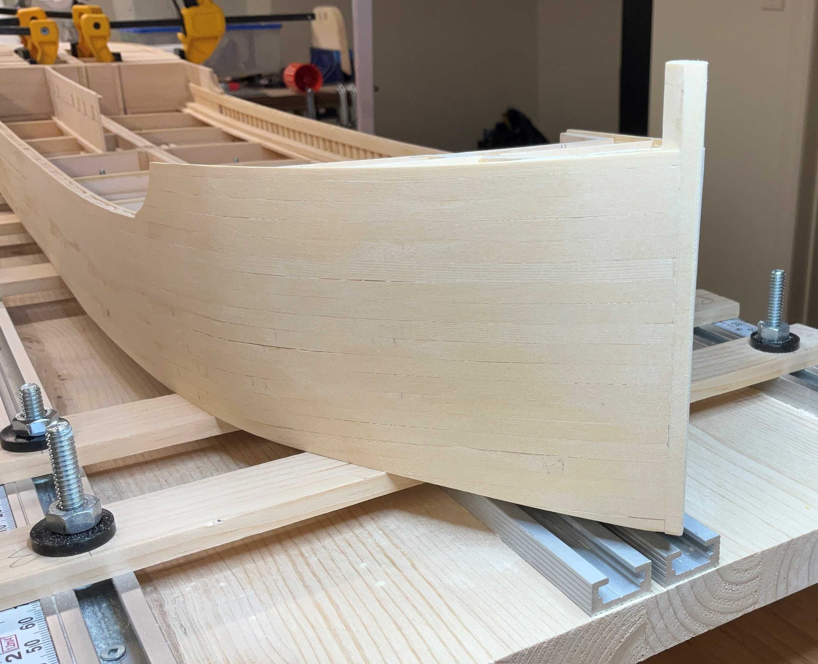

Hi Everyone, hope you are all doing well. Thank you very much for the Comments and Likes! The hull planking is finished. As the planks ran off the bulkheads and below the waterline, 1/8" blocks of basswood were added to define the waterline and add to the structural integrity of the hull. They were glued into place after the planking was installed to make it easier for clamping.

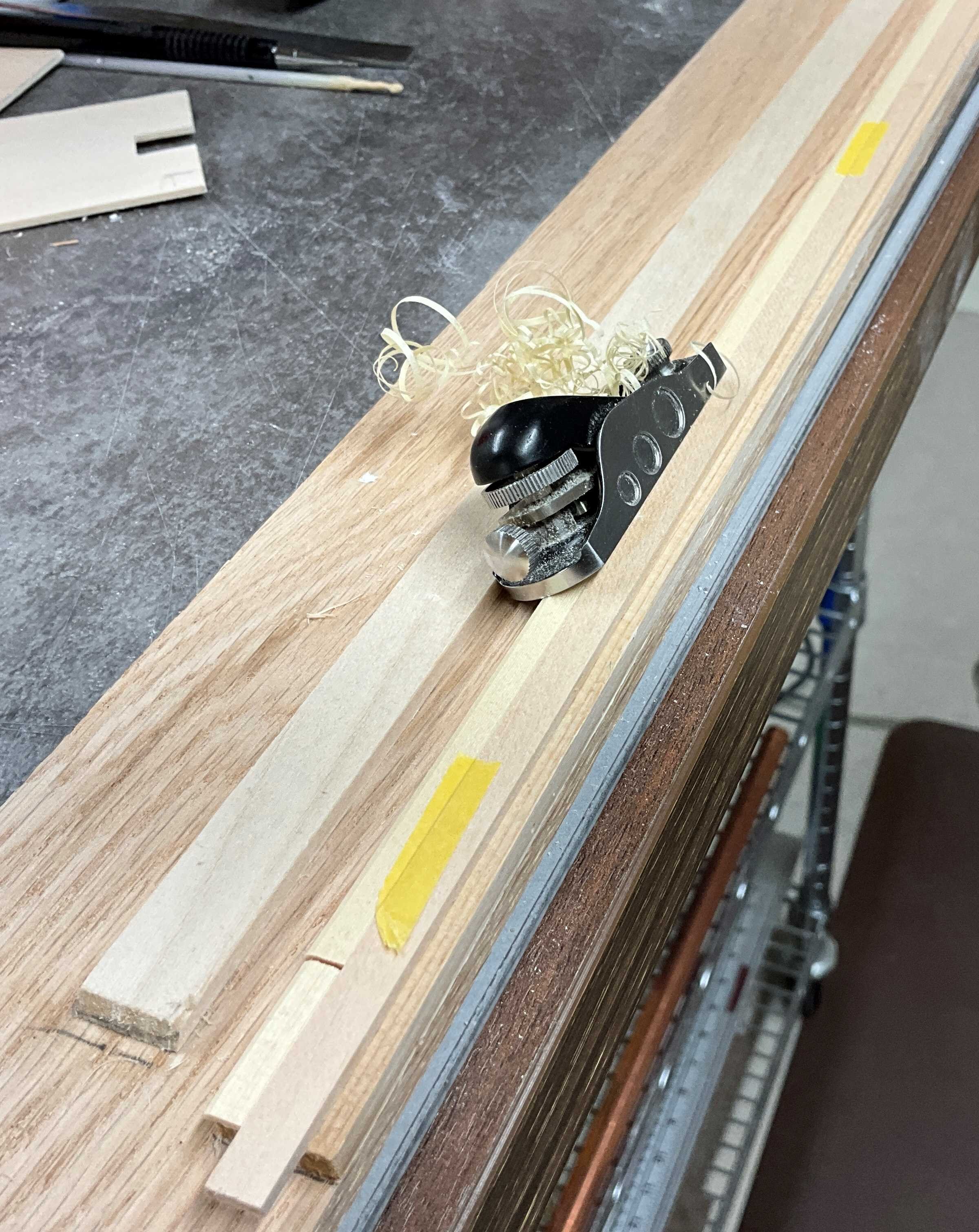

Once the blocks had been installed the planks were planed down so that they were 1/16" proud of the blocks. The process started at the stern and moved forward.

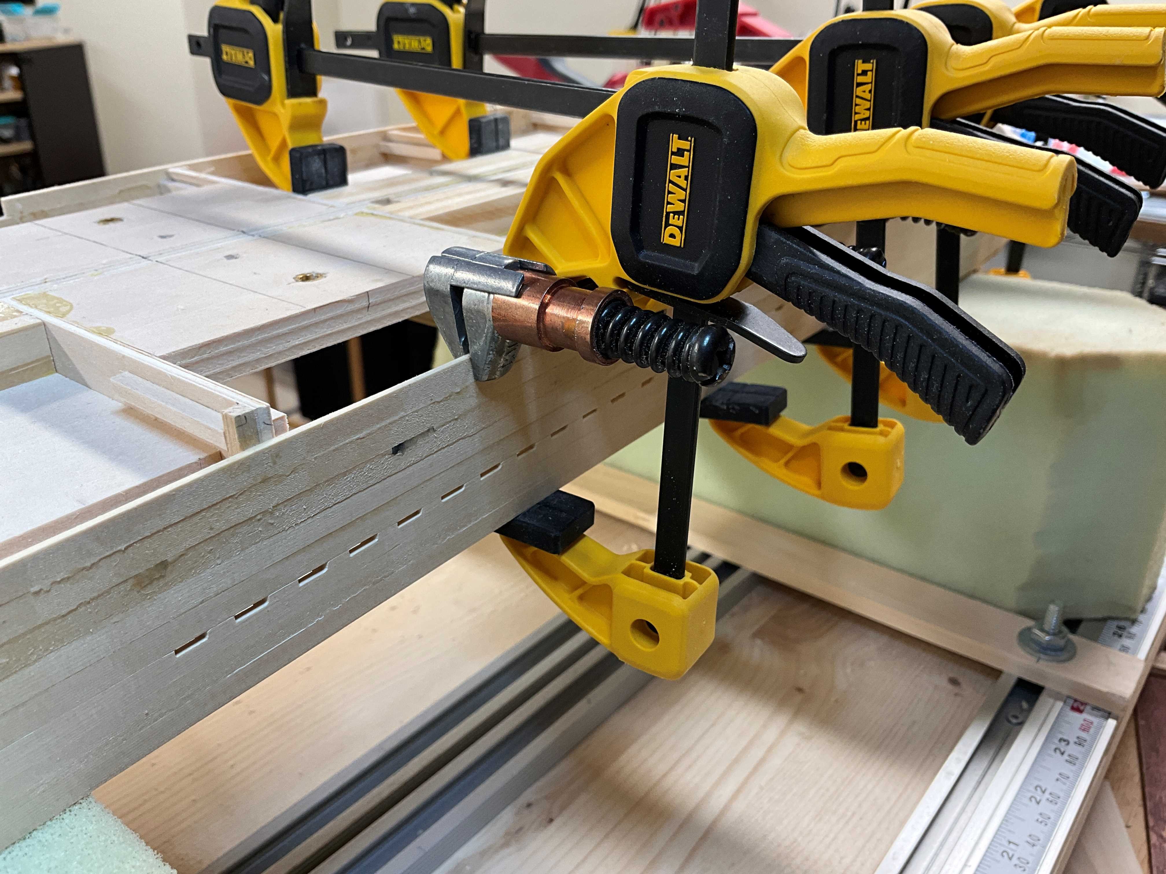

I had some Cleco type side grip clamps that had been used for metal work. They have a strong grip but didn't mark the AYC. They were good for the straight lengths. I got them from Aircraft Spruce. They are about 6.00 CAD each plus you need the pliers to put them on and take them off.
I started making the tabs that are glued to the back of the planks longer so that they extended from both sides. This made them interlock with the previous plank's tabs.
After the planking was completed they were sanded back to the waterline and the hull was mounted back onto the build board.
I went over it with 120 grit paper but it still needs more sanding. Once the sanding is finished the rub rails can be attached. Hope to see you when the dust settles.

Very nice work! That stern looks a bit tricky to plank but it turned out well.

Gentlemen, thank you very much for your kind comments! Although the planking was fun I’m glad that I didn’t have to do below the waterline

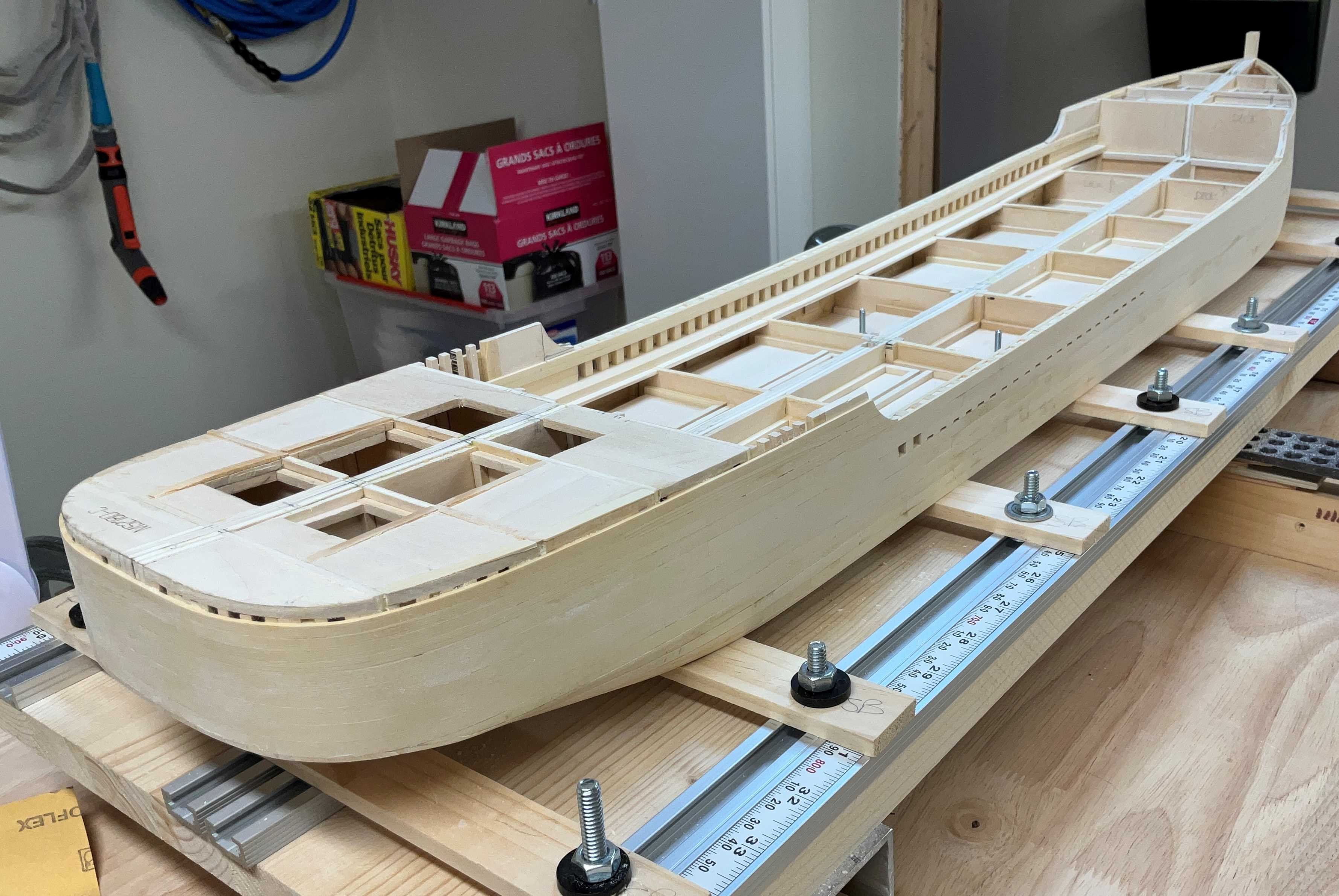

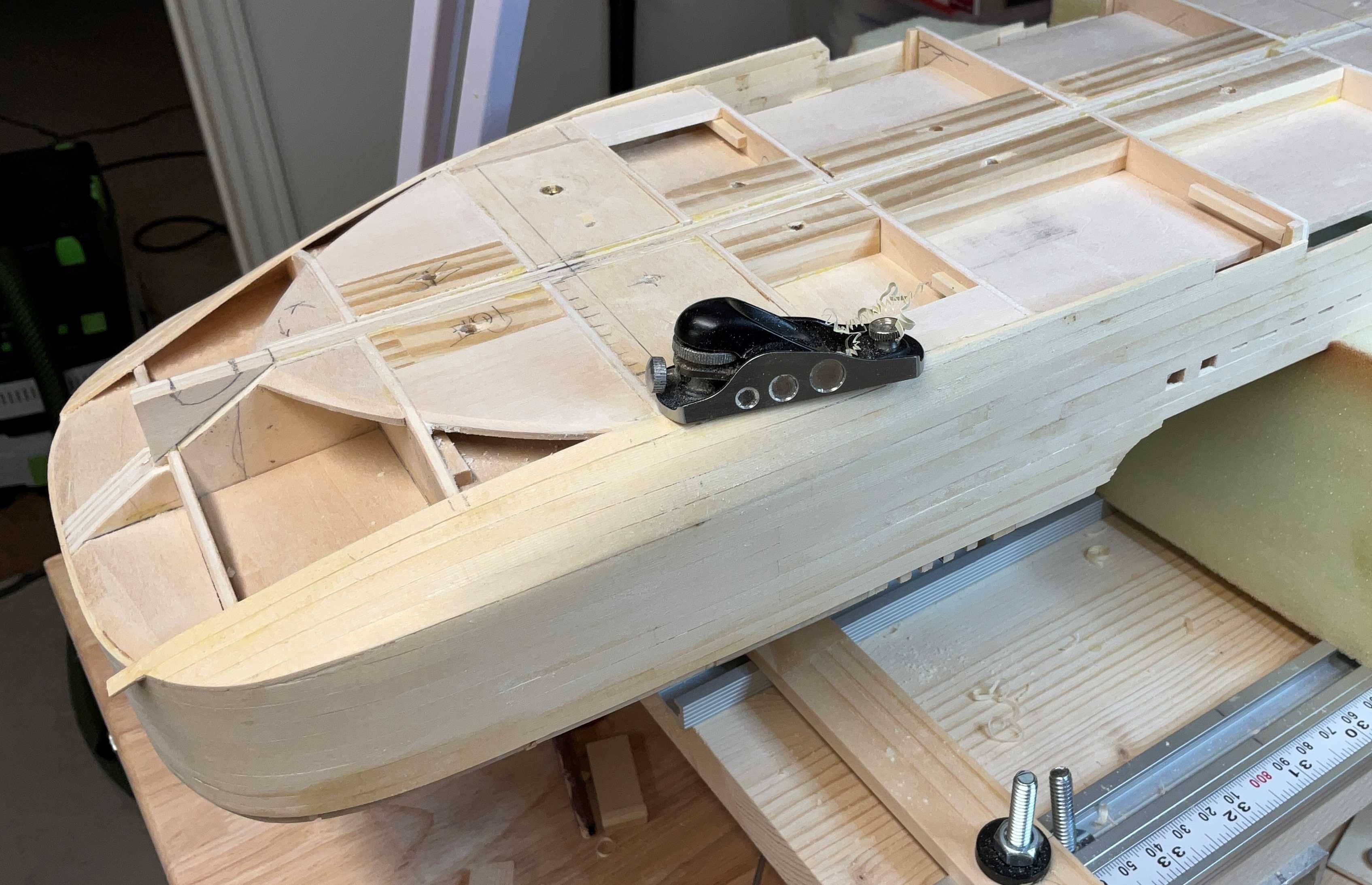

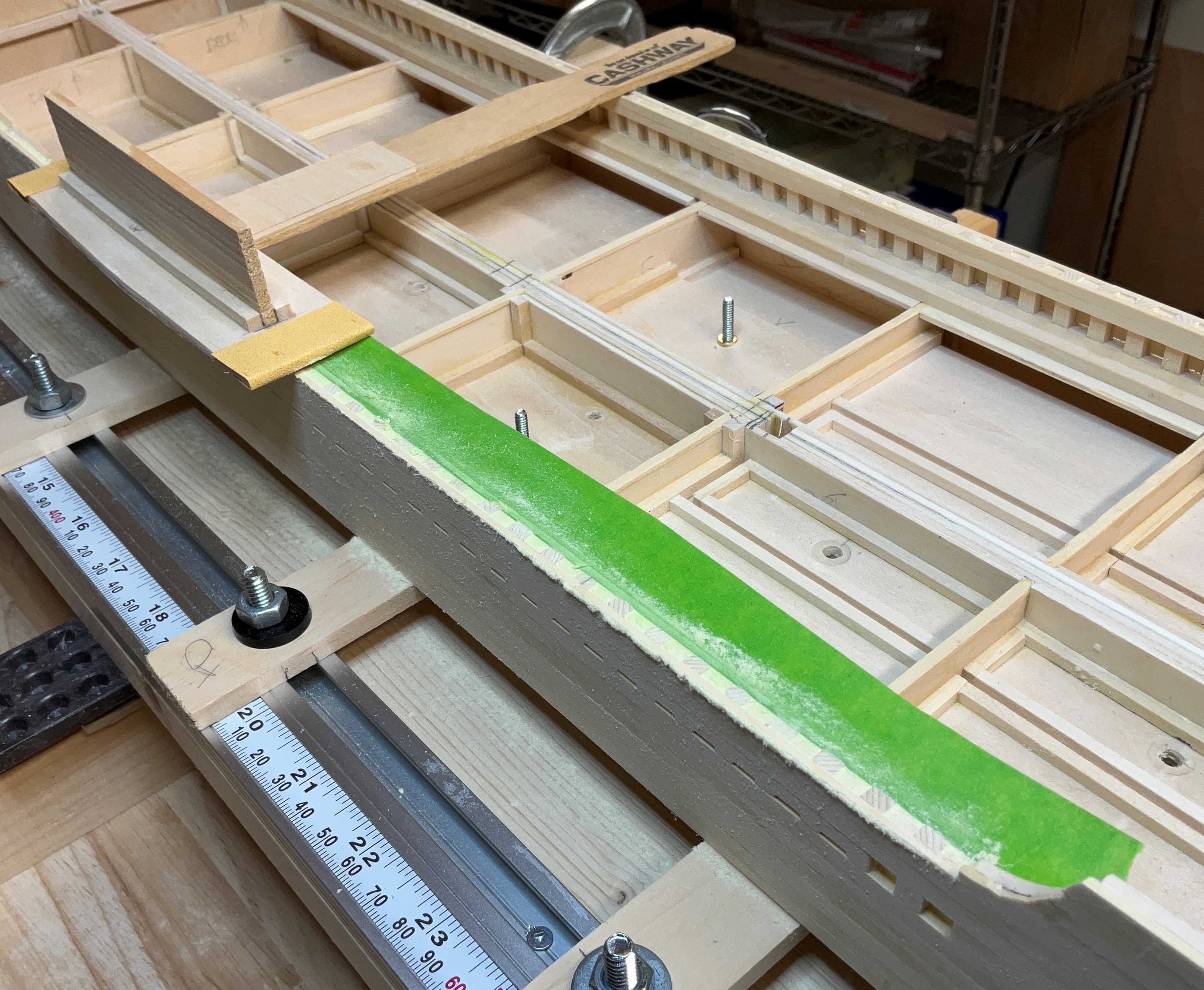

Hi Everyone, thank you All for your Comments and Likes! The dust settled about a week ago. The stem was the first thing to be sanded and as you can see in the first photo the angle is not a continuation of the planking. I didn't attempt to attain this change in angle because I didn't think the result would be satisfactory.

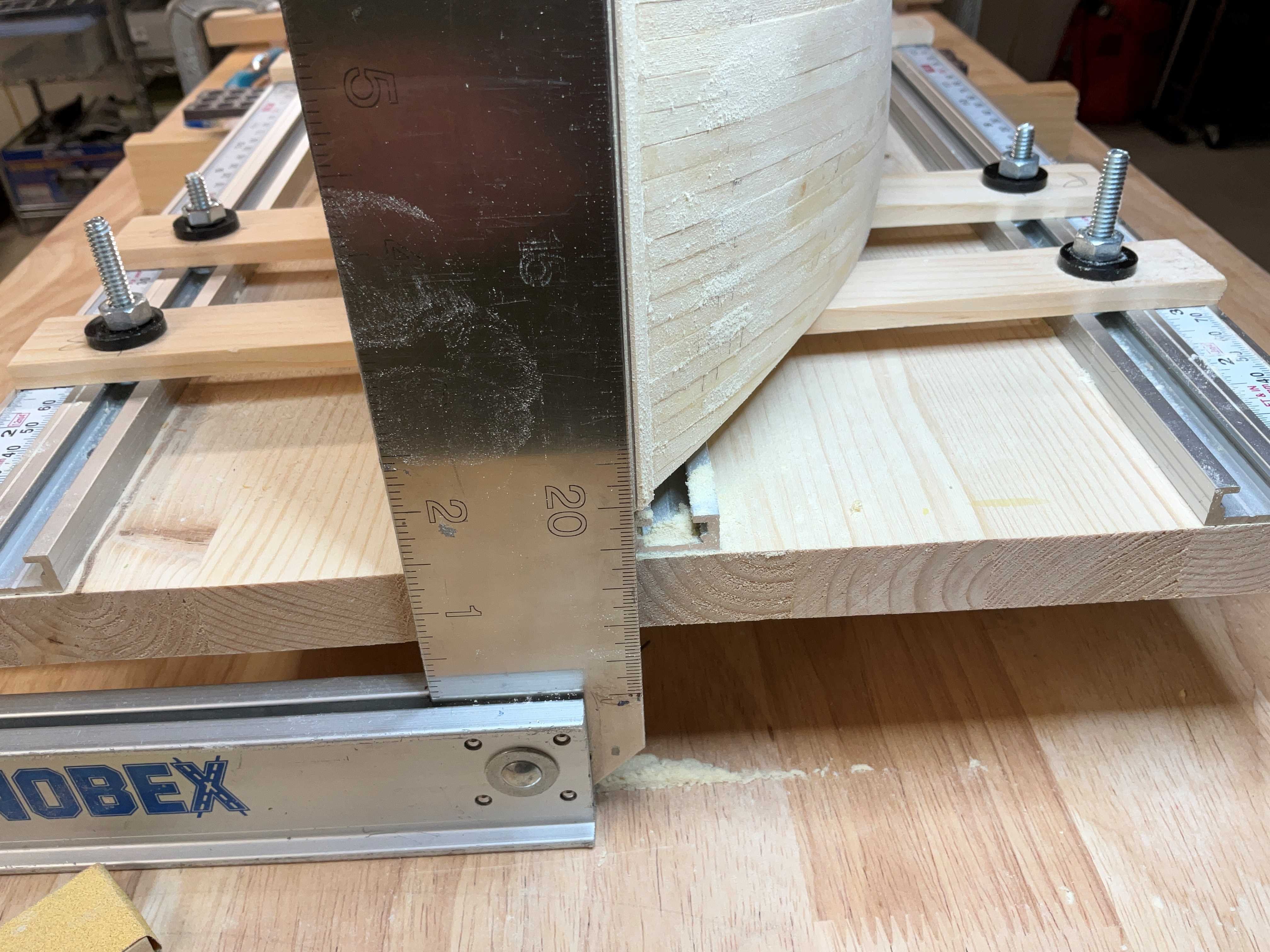

The bulwark planks were sanded level with the top of the longitudinal planks using a sanding sled that extends over to the opposite side to keep it level. It also has a bit of a curve in the base that the sandpaper is glued to. The planks were sanded until the masking tape on the longitudinal planks became scuffed.

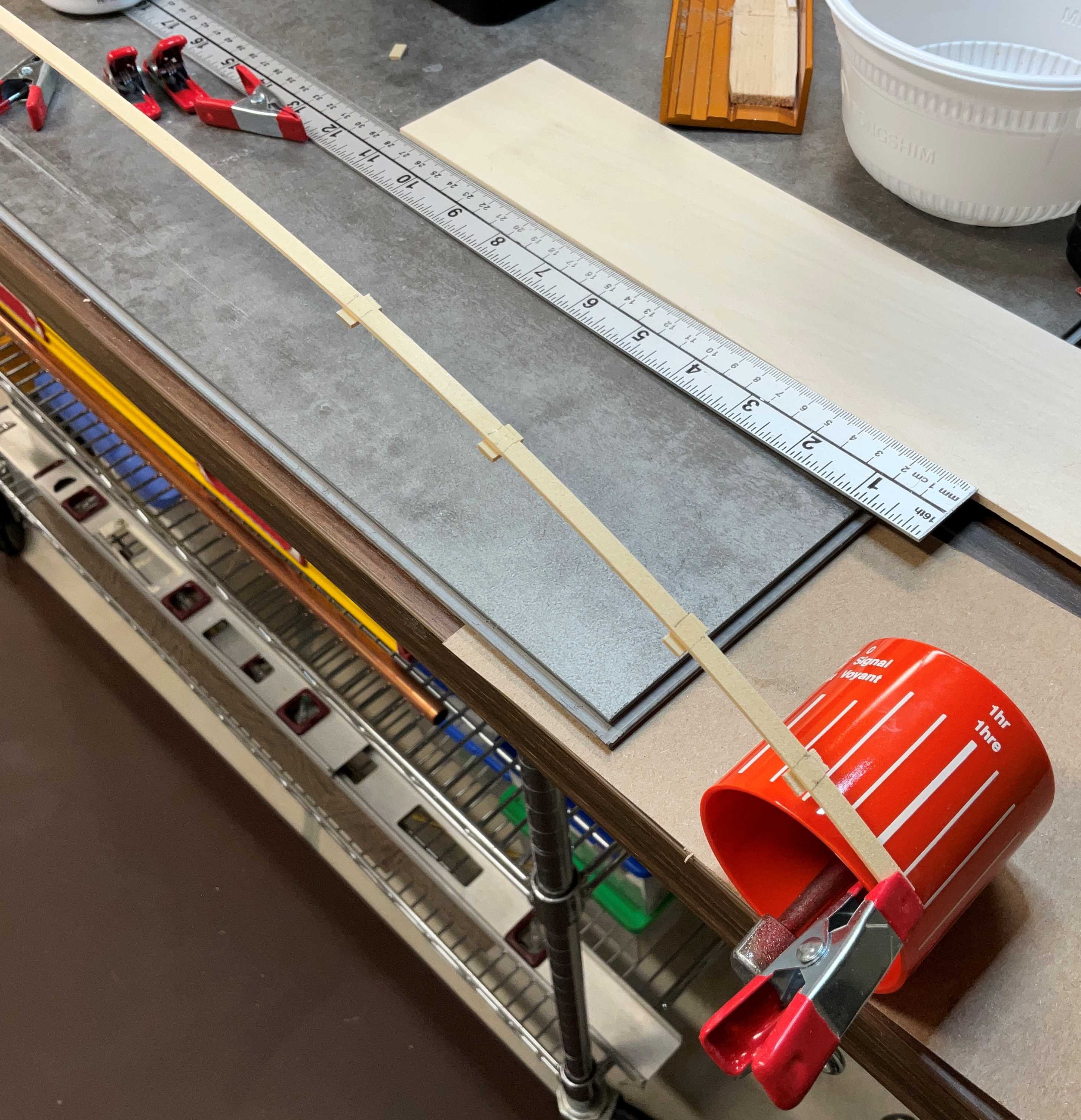

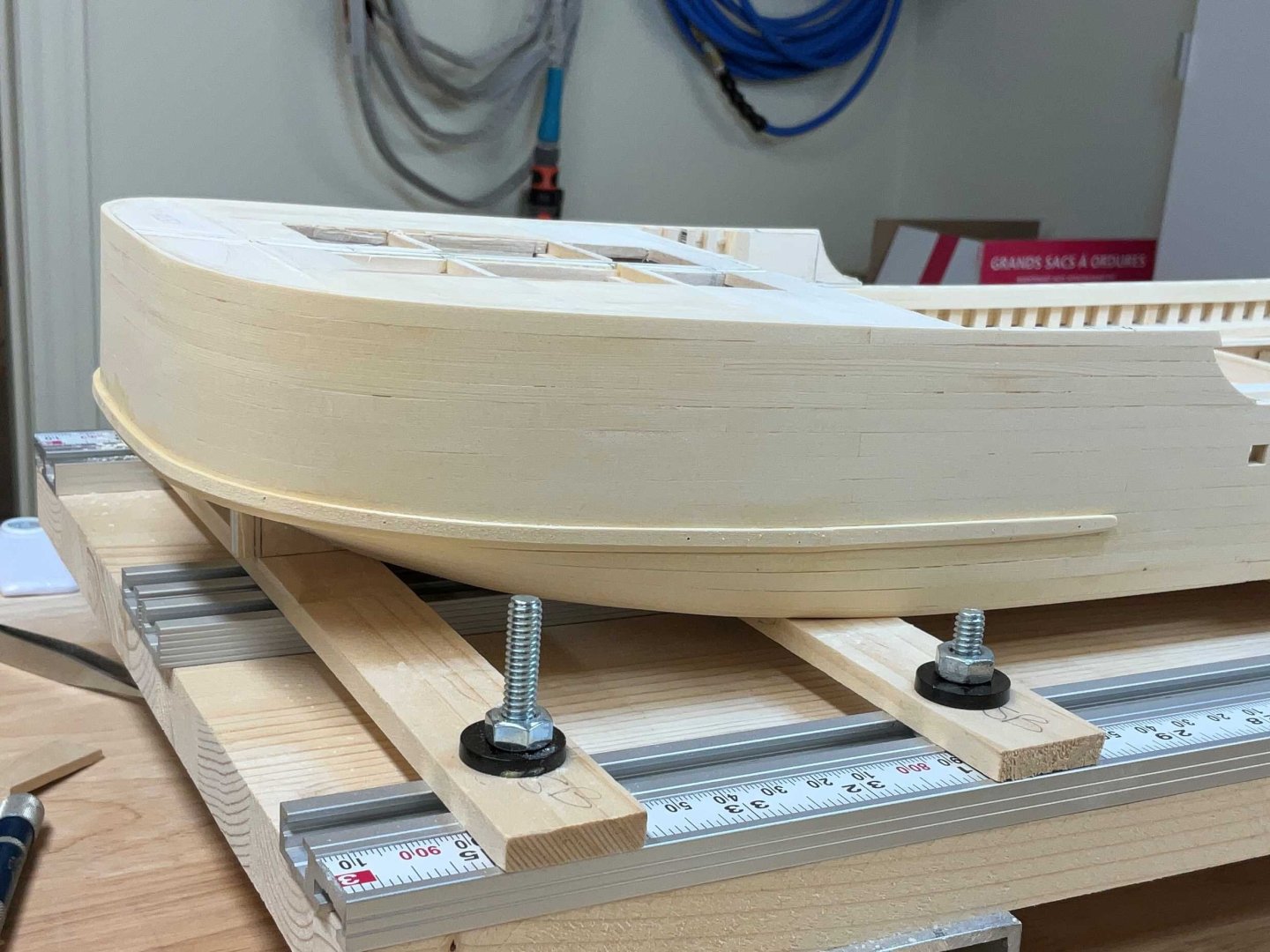

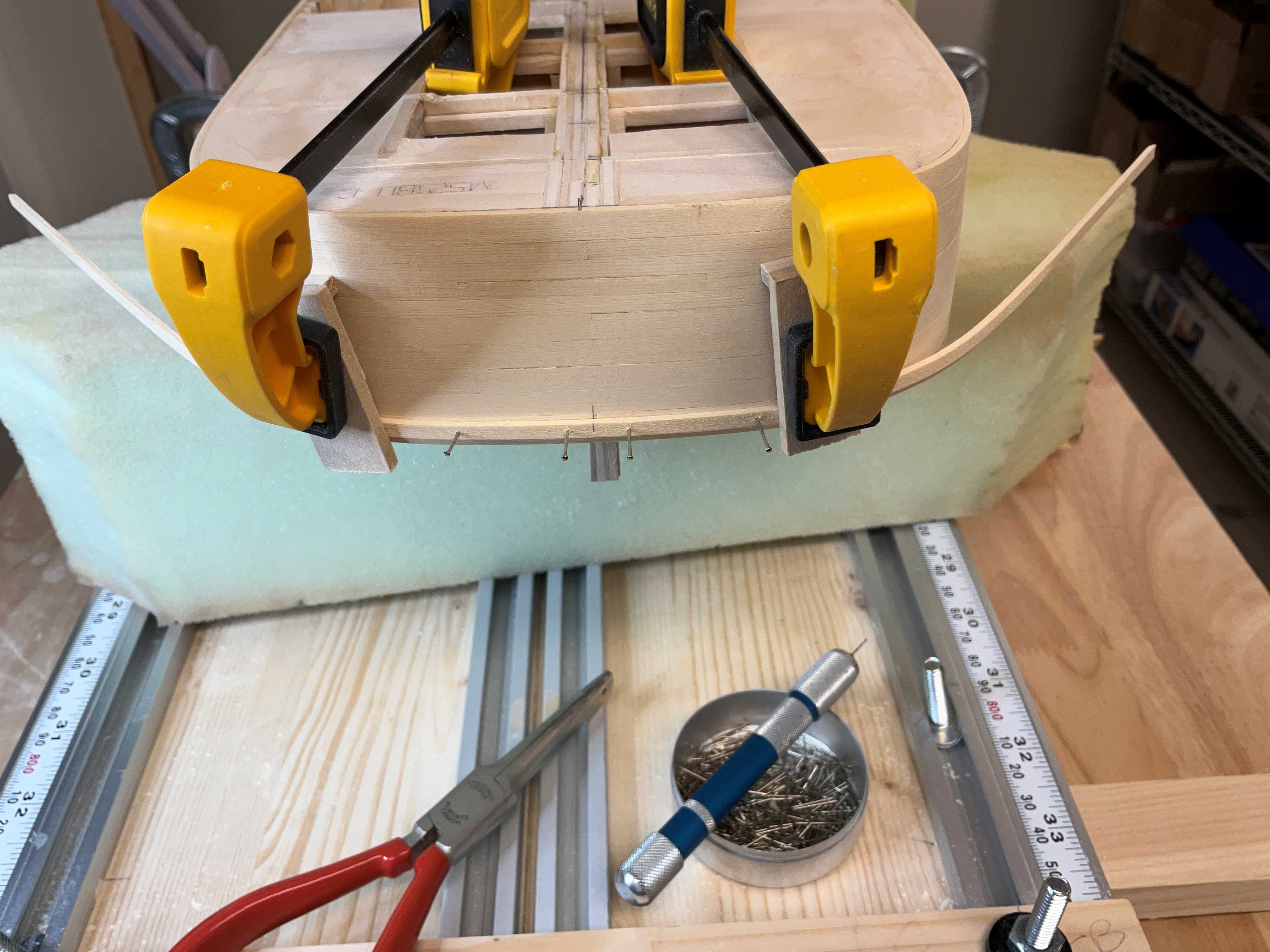

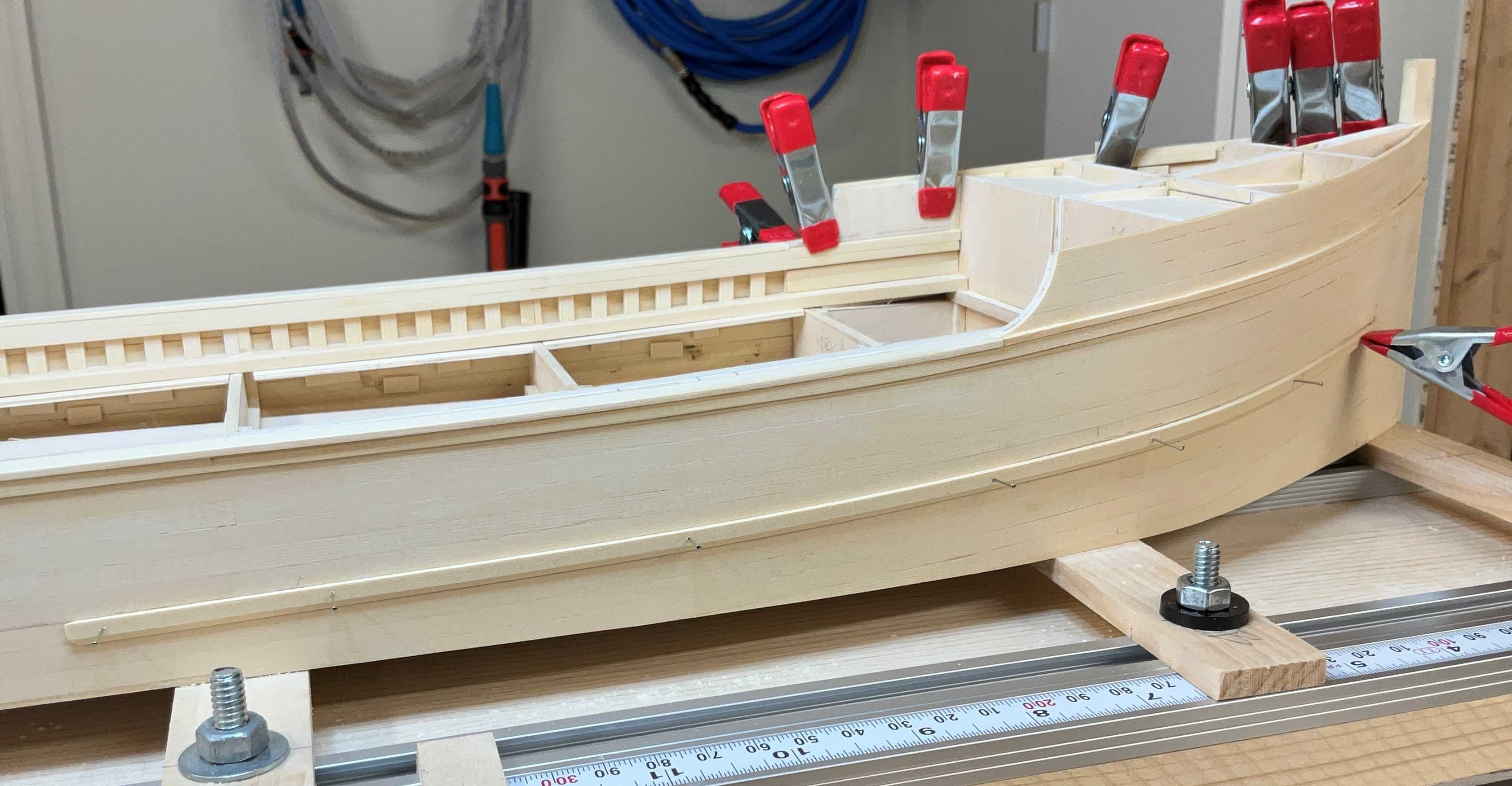

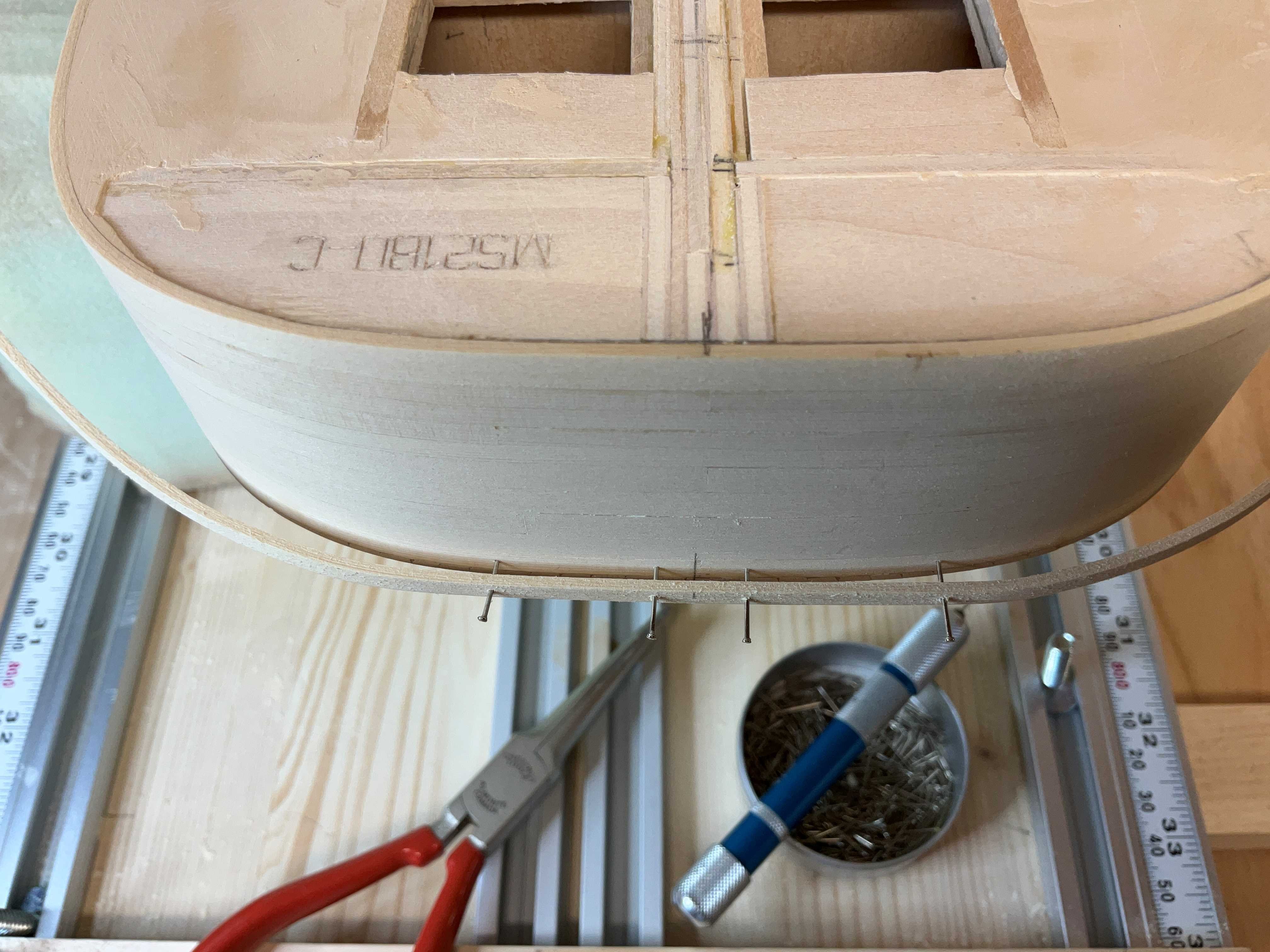

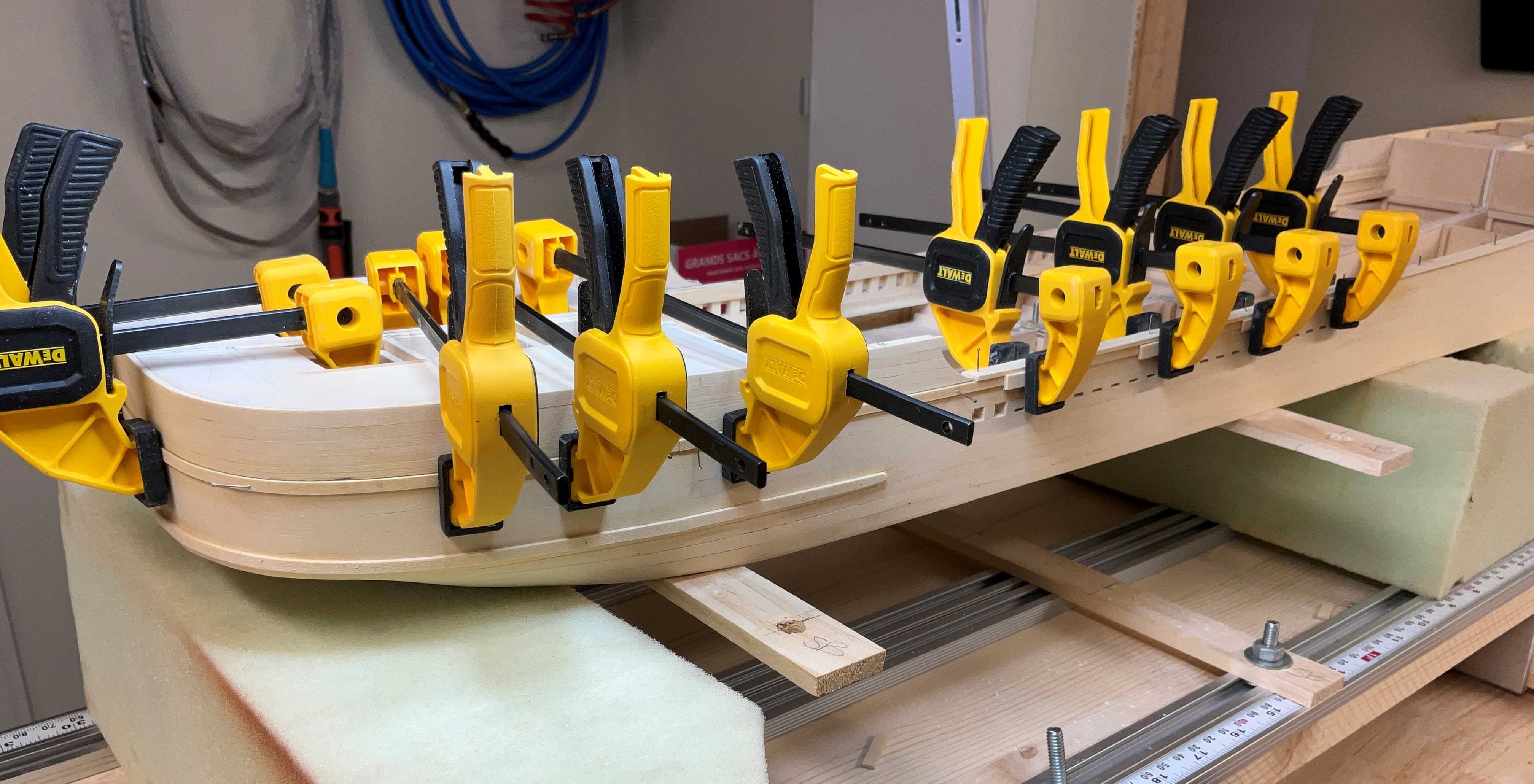

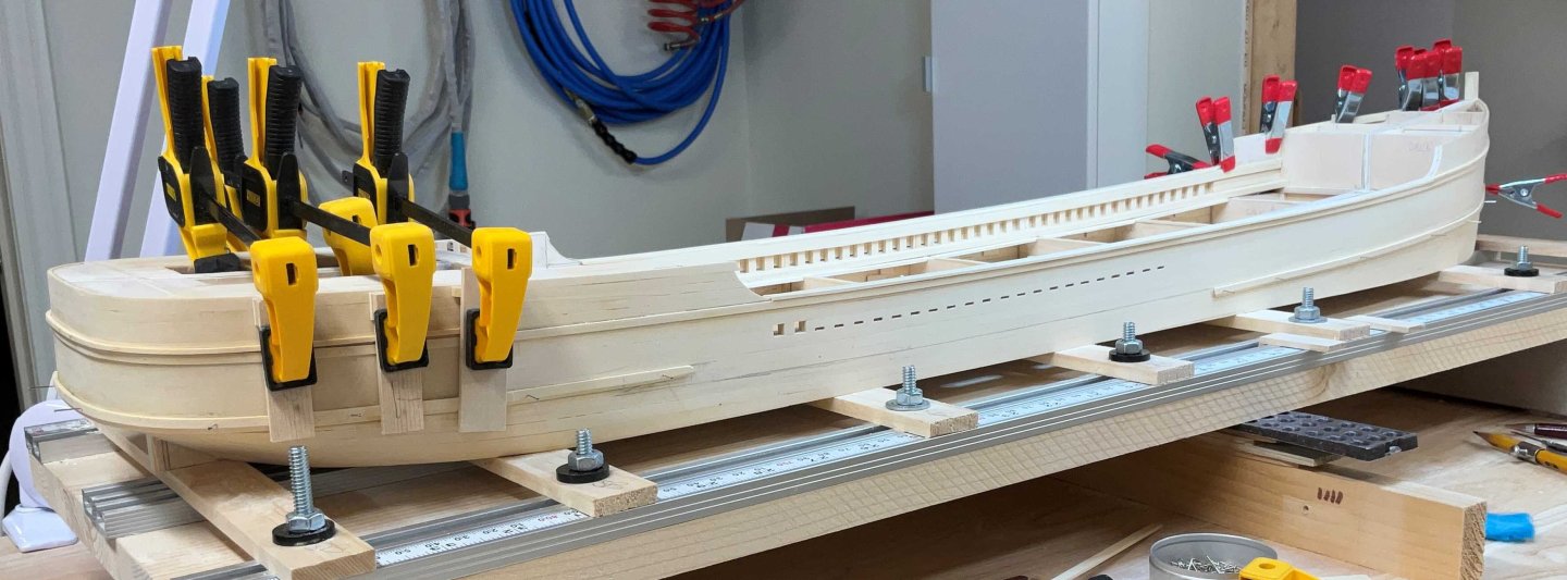

A jig was made to to chamfer an angle in the lower portion of the guards and the guard was attached around the stern after it had been bent to shape overnight. It was pinned into place and then pulled away from the hull on the pins. It was then glued with white PVA and slid back into position and clamped.
That was attempt number 1. The forward ends of the guard sat a bit low so off it came.

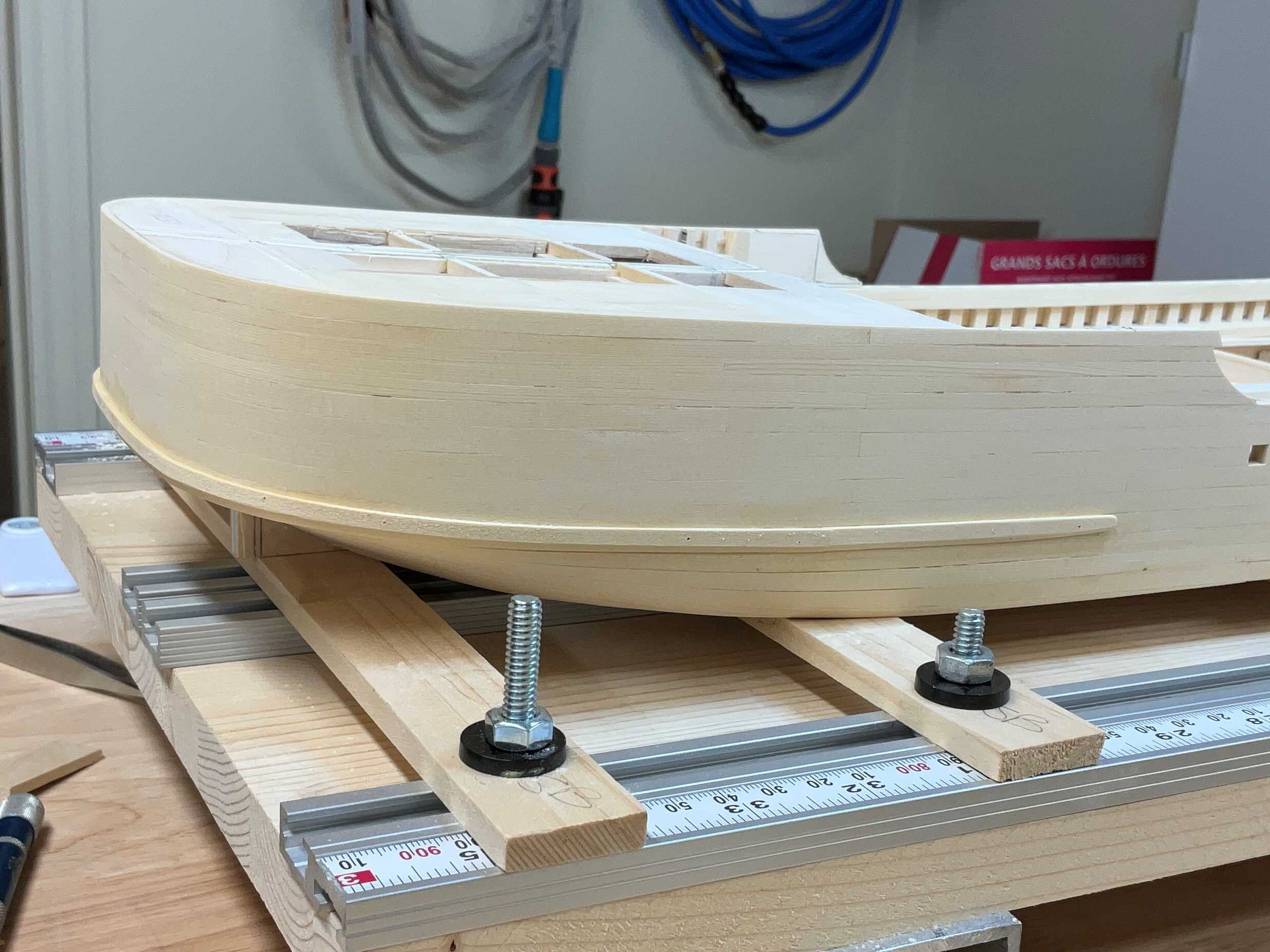

Attempt number 2 came out better and then the clamp that runs under the main rail was attached

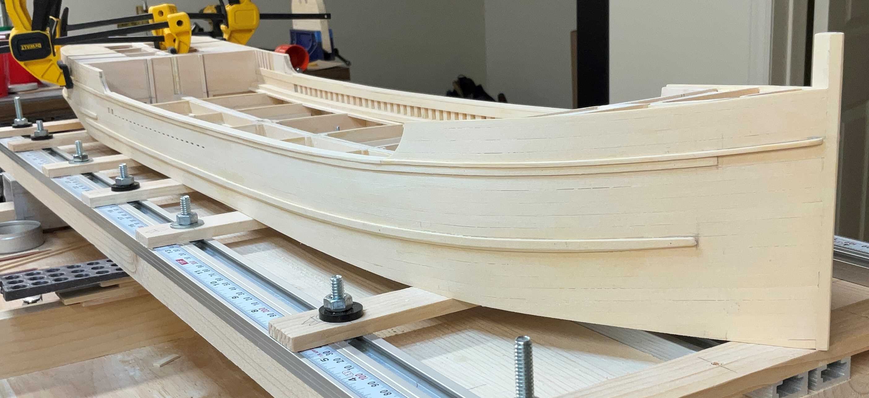

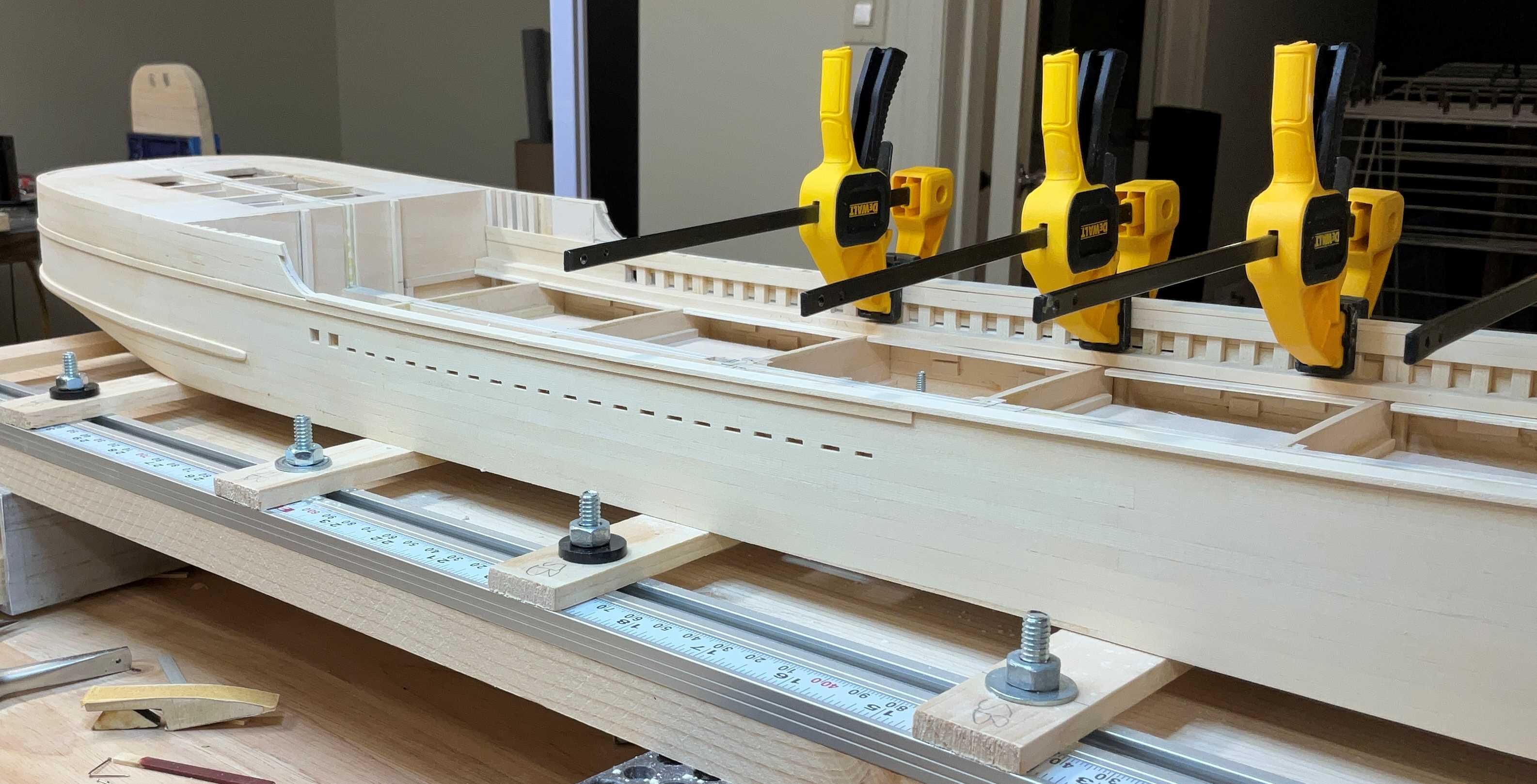

The guards that run forward were attached. There is a plank that was made of iron bark that sits on top of the guard but I'm not sure when that will be installed
Next the portlights need to be laid out and work on the main deck house has resumed. Hope to see you soon.
Best Regards……..Paul
