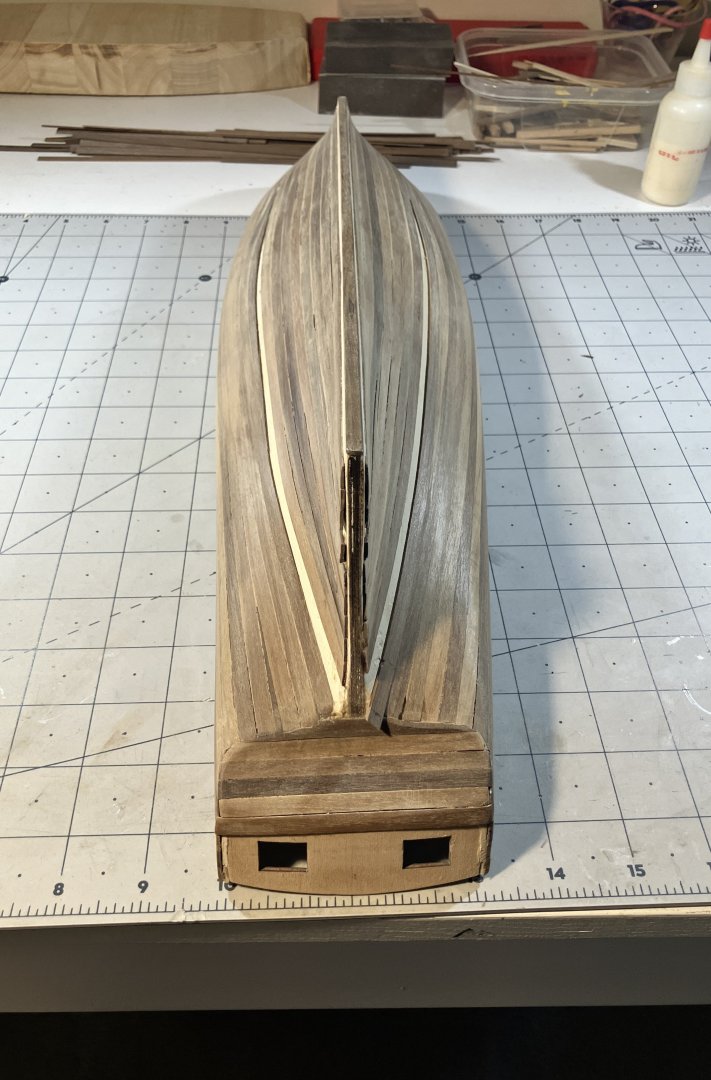

Almost there ........
The end is in sight with regards to the second planking. Although the hull will be painted I wanted to make it look as nice as possible, and it's good practice. I still have a few fillers at the stern to add and the transom still needs a few strakes also. Once that is done she will get a final sanding, some fine tuning to fill in any small gaps and tie up some loose ends and the hull is complete.

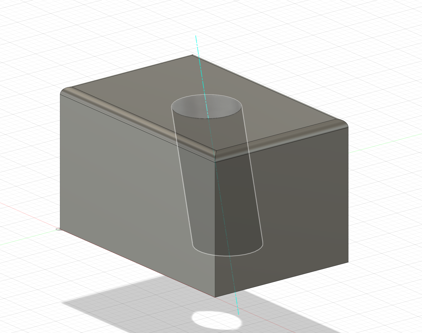

Now that the hull is as good as done I wanted to address the mast rakes. Before the deck goes on I needed to have something in place that would take the guesswork out of getting the correct rake angles for both masts (foremast 13.5° - mainmast 10°, as discussed at length earlier on in the build log). I hopped on over to Fusion 360 and did a very quick design. The holes go all the way through so that I can slot the butt end of the mast in the existing hole in the hull:
It is basically a small block with the hole angled appropriately. The height of both boxes was determined by the cross beam height at that part of the bulkhead. I tried to position the hole in such a way that the mast would not interfere with the crossbeams when it was seated in the block. So that I wouldn't mix the blocks up (and I knew I would at some point), I took the designs over to Tinkercad and named them both:

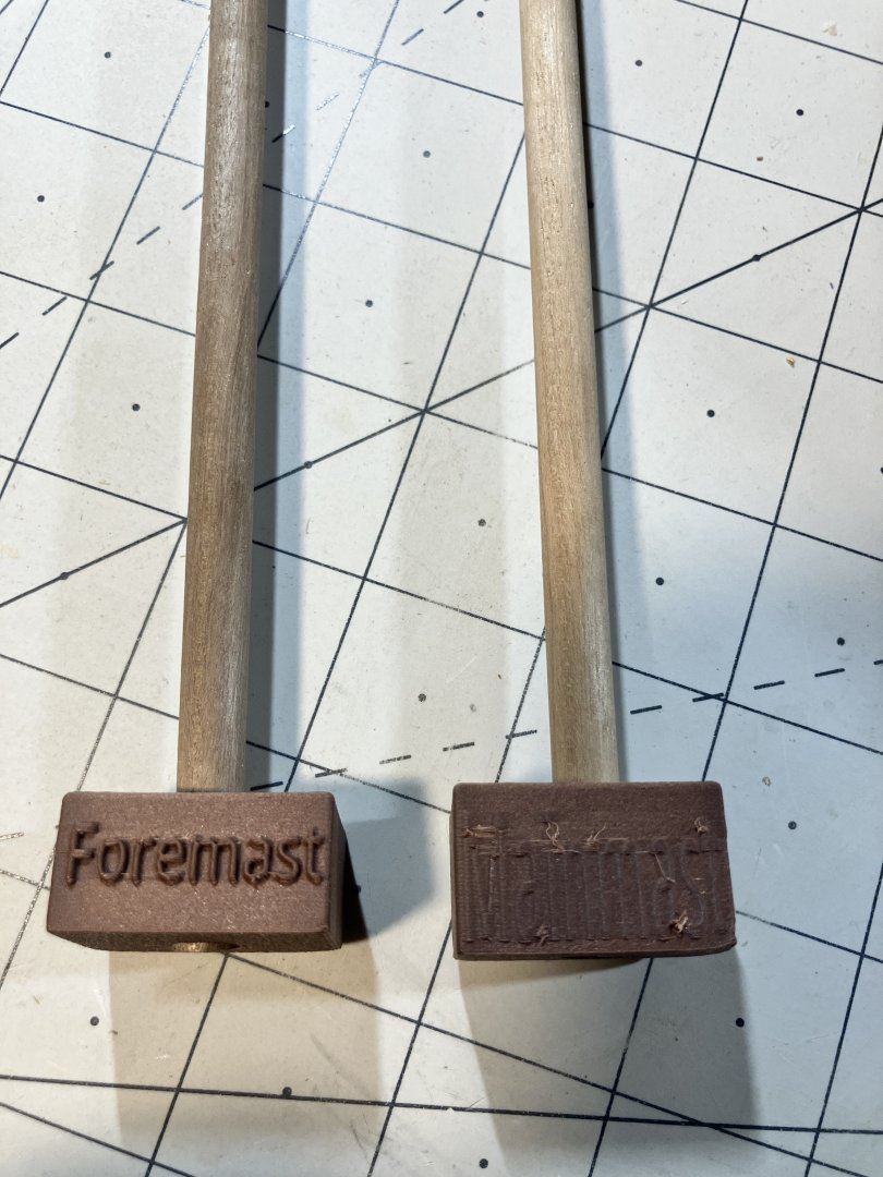

Once that was done I printed them and tried them out for size:
They both sit nice and flat on the lower deck but the mainmast block needs to move aft a little, my efforts to get the hole exactly right were a bit off on that one. I will probably just add a backer to the crossbeam there and sand the front of it away a little so that the box can slide. It really doesn't have to move all that much. Onwards :)
 Mark, after visiting other Lynx builds and checking the first photo of your build log it appears that you have the rake set too far astern?
Edited by Keith Black
Keith,
After quite a bit of research and lots of different opinions, I did not base the rake angles on any current builds. As you are aware, I am building this schooner as the Musquidobit. The plans that I have show this:
I was fortunate enough that Peter ( @SardonicMeow ) could work out the rake angles in Fusion (I wasn't au fait with that software at the time). He posted the results earlier on in the build log:
So, as you can see, I am basing the rake angles on "hard evidence" from existing plans of the vessel I have chosen to build. The image I found and posted at the beginning of my build log was a very nice one of the Lynx, put there long before I started concerning myself with rake angles :) I apologize most heartedly, sir, for any confusion.
 Mark, I'm not doubting you've done your research. What I'm doubting is the rake angles of the fore and main. If you draw a 90 degree angle and overlay it over your model, the fore should have (according to your #112 post) 13.5 degrees from 90 degrees = 76.5 degrees from zero and the main 10 degrees from 90 degrees = 80 degrees from zero.
 Those are not the angles I'm seeing in the last photo of post #112, IMHO. :unsure:
Mark,
I agree with Keith, the mast angles don't look right.
First of all, I studied plans and drawings for 17 Baltimore clippers, and on every ship the main mast had greater rake than the fore mast - no exceptions. Here are the angles I found:
Fore mast - 11.5 degrees average, with a range of 7-16 degrees
Main mast - 13.75 degree average, with a range of 8-22 degrees
I have never seen a plan, drawing, model or painting of a topsail schooner with greater rake on the fore mast than the main mast.
Second, be careful about the reference for establishing the rake angles. The angles I listed above are relative to the water line. But the angles measured by sardonic meow are relative to the bottom of the keel! All of these ships had a deeper keel at the stern than the bow, so the keel was at an angle to the normal water line.
You can see the difference in the drawing of the Musquidobit in post #114. The solid line just below the chains is the waterline.
I would use angles similar to the model of the Lynx in post #113. The main mast has a greater rake than the fore mast. While it was possible to change the mast rake a  bit by adjusting the wedges at the partners, it wasn't much of a change. The British could have reconstructed the mast steps to change the rake - they did shorten the masts on some captured American vessels - but unless you have documentation for this I would stick with the Lynx rake angles.
I worked out a fairly simple way to set the mast angles on my Albatross build:
https://modelshipworld.com/topic/19611-albatros-by-dr-pr-mantua-scale-148-revenue-cutter-kitbash-about-1815/?do=findComment&comment=599087
This let me set the rake angle and still allowed me to adjust the port-starboard angle to perpendicular with the horizontal.

@Keith Black & @Dr PR
Good morning, gentlemen,
Thank you for your valuable insights. Phil, what you said makes a lot of sense regarding measuring the angles at the waterline. Keith, your graphics confirmed what Phil was talking about. After reading (and hastily replying) to your post last night, Keith, the matter of the rake angles was the only thing going through my mind, pretty much all night because I was doubting what I had done. You good fellows have a whole lot more experience at this than I do. Phil, I like your solution regarding the rakes, very simple but incredibly effective. I guess my engineering brain was working overtime on my solution and I overthought the whole thing :)
I am going to re-check those angles again, taking what you both said into consideration. I am going to steal Phil's idea and let's see if I can get it right this time around :)
THANK YOU BOTH for bearing with me!
Mark,
We are all learning as we go.
Positioning the masts looks simple at first, but there really are three things you need to get right.
1. The fore and aft position on the deck centerline influences all the rest of the rigging. It also affects the positioning of hatches, deck houses, boats and other deck furniture. So you need to figure out the deck layout before positioning the masts.
2. The fore and aft rake was characteristic of the type of vessel, and the particular vessel. This has a lot of influence on the positions of the channels and shrouds. But the angles do not have to be exact - a degree difference won't be noticeable.
3. The transverse angle should be perpendicular to the horizontal (water line). This should be as exact as you can get it so the shrouds and backstays are the same length on both sides. Both masts should line up as you look from the bow or stern. If they don't it will stand out like a sore thumb!
Chapelle said the British didn't like the extreme tophamper the Americans were putting on the Baltimore clippers. They were trickier to sail and some thought dangerous. So when some American schooners were captured the Brits cut down the masts to reduce the sail area. But this made them slower and they lost the speed advantage the Americans had. So later the British built their own topsail schooners with a large tophamper.
I don't remember anything specific about what the British did to the Lynx after capture, and whether the Musquidobit had the same masts and sails.
All 3 points are obviously very valid ones, Phil, and this third one even more so. Although it seems obvious, I would not have thought of it myself (until I saw the end result where the shrouds and backstays were off center!). Note taken oh master :)
