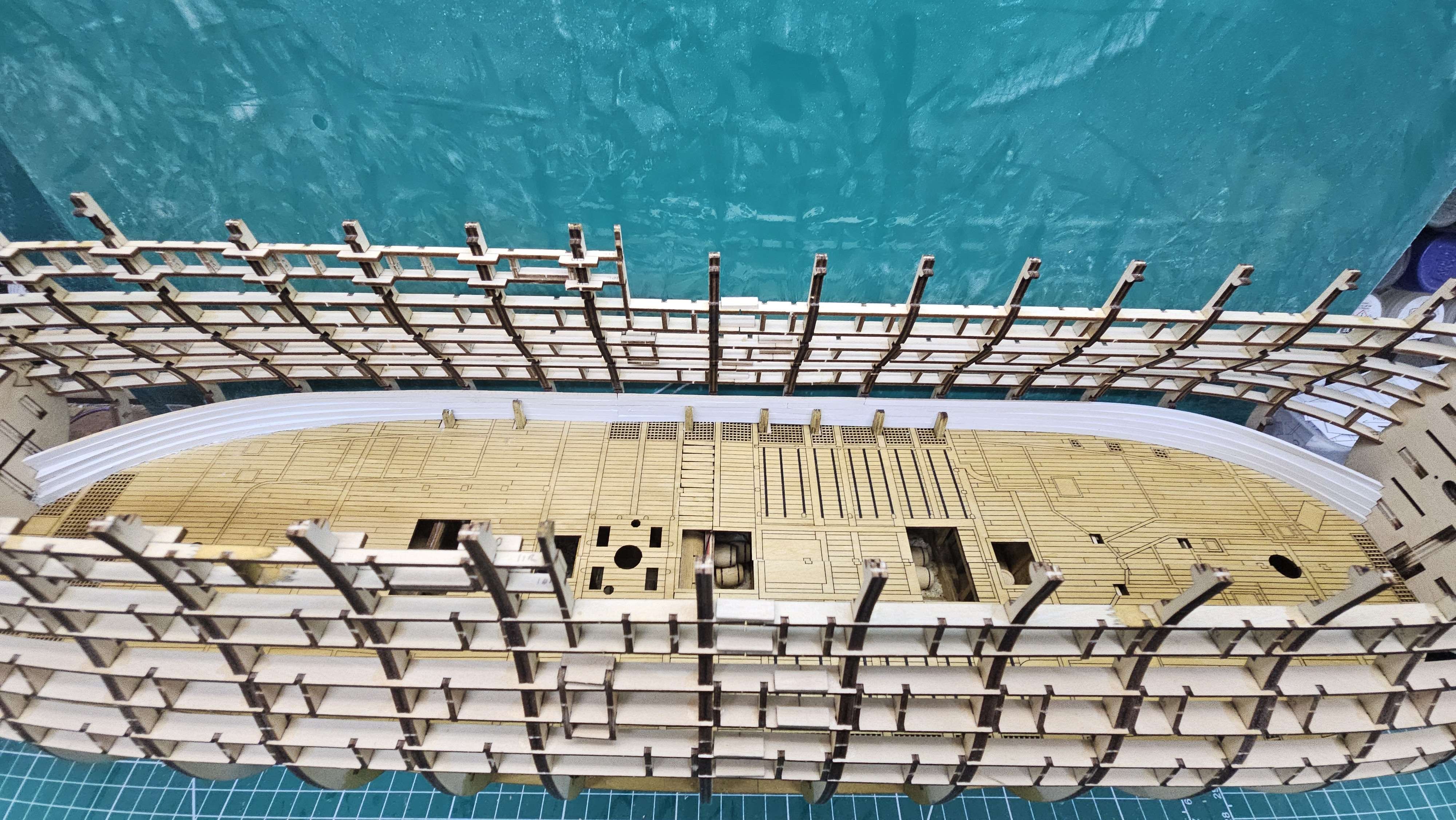

I know I was only going to post updates after each video was completed, but encountered a problem with this that I wanted to point out for anyone building this.
But first, a few photos of the progress of adding the ribs:
Now the first problem, managed to break a rib whilst fitting the brace that is meant to stop you from breaking ribs. Typical!
And now the major problem
The front bracing parts for the plank ends to mount on, well one got completely jammed for me, wouldn't come out, wouldn't go in. And by jammed I mean jammed to the point it snapped a thick metal file trying to see if I could lever it out!
Anyway, that part is purely to provide an end point for the hull planks, so as long as the outer edge and top are in line it doesn't matter. Although it is annoying. So I sanded the excess down so it was in line.

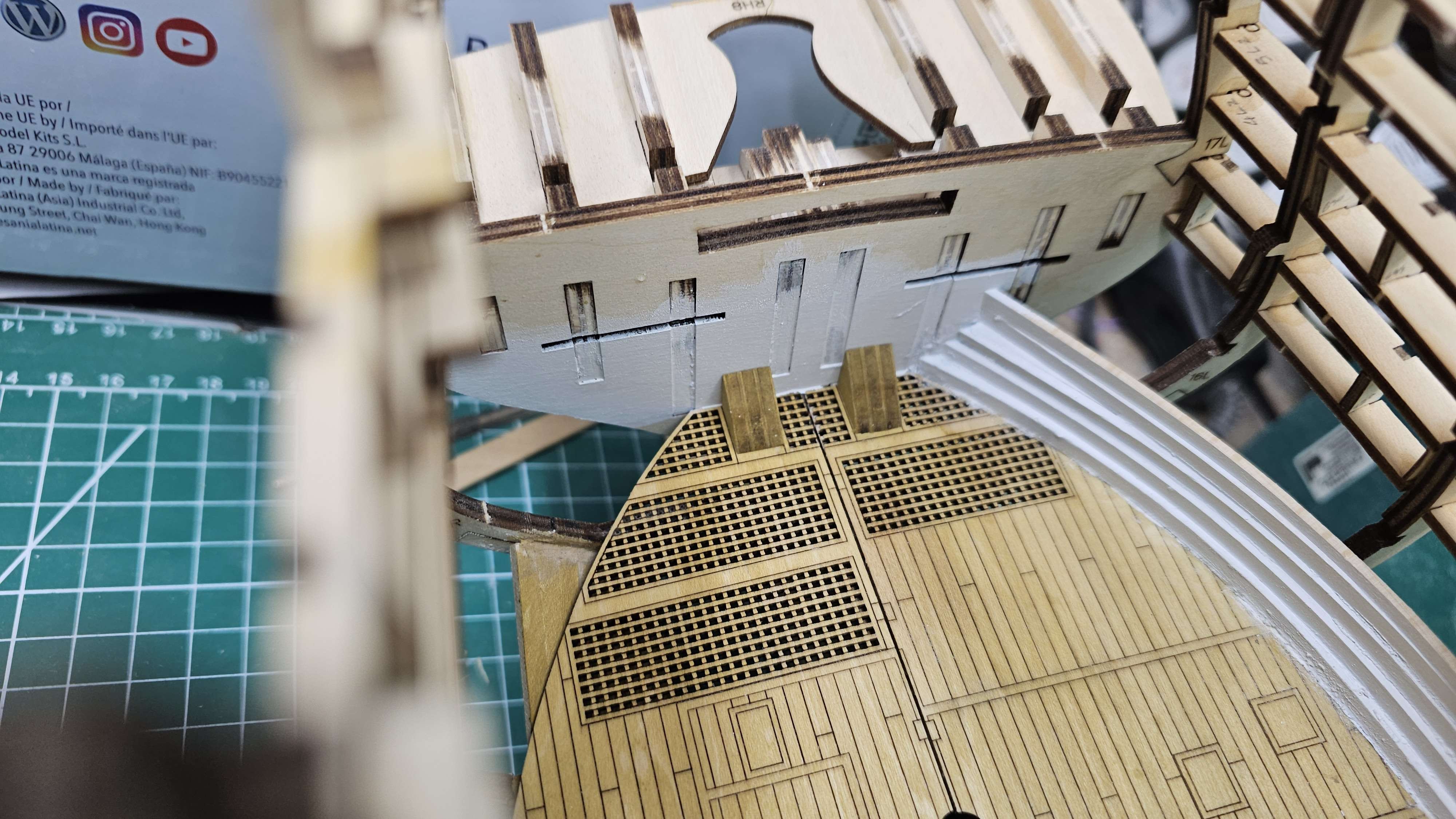

Video #3 Complete
This was a mission, had a number of minor issues.
First, not happy with the stain on the hold planking, I just wasn't careful enough with removing excess glue, and it's a difficult area (for me) to be able to sand.
Still, most of it will be covered up by cargo and ballast so it's not an issue, just annoying.
The supports for the shelves for me, weren't as long horizontally as in the video, and I also had to shorten them vertically to allow the shelves to sit level.
You can obviously work out what I did wrong!
The panels for the pumphouse were a nightmare to cut, as in my previous post. I got there in the end though.
I also had to do some slight adjustments to the slots for the rear deck piece.
One major thing I did notice was that, despite using the paper templates, the cutouts in the shelves template didn't line up with the ribs, and that cannot have been something I got wrong as the rib placement template lines up with laser cut parts. So something is wrong with either the laser cut parts, or either of the templates. Again, not a hard fix, just glad I checked beforehand.

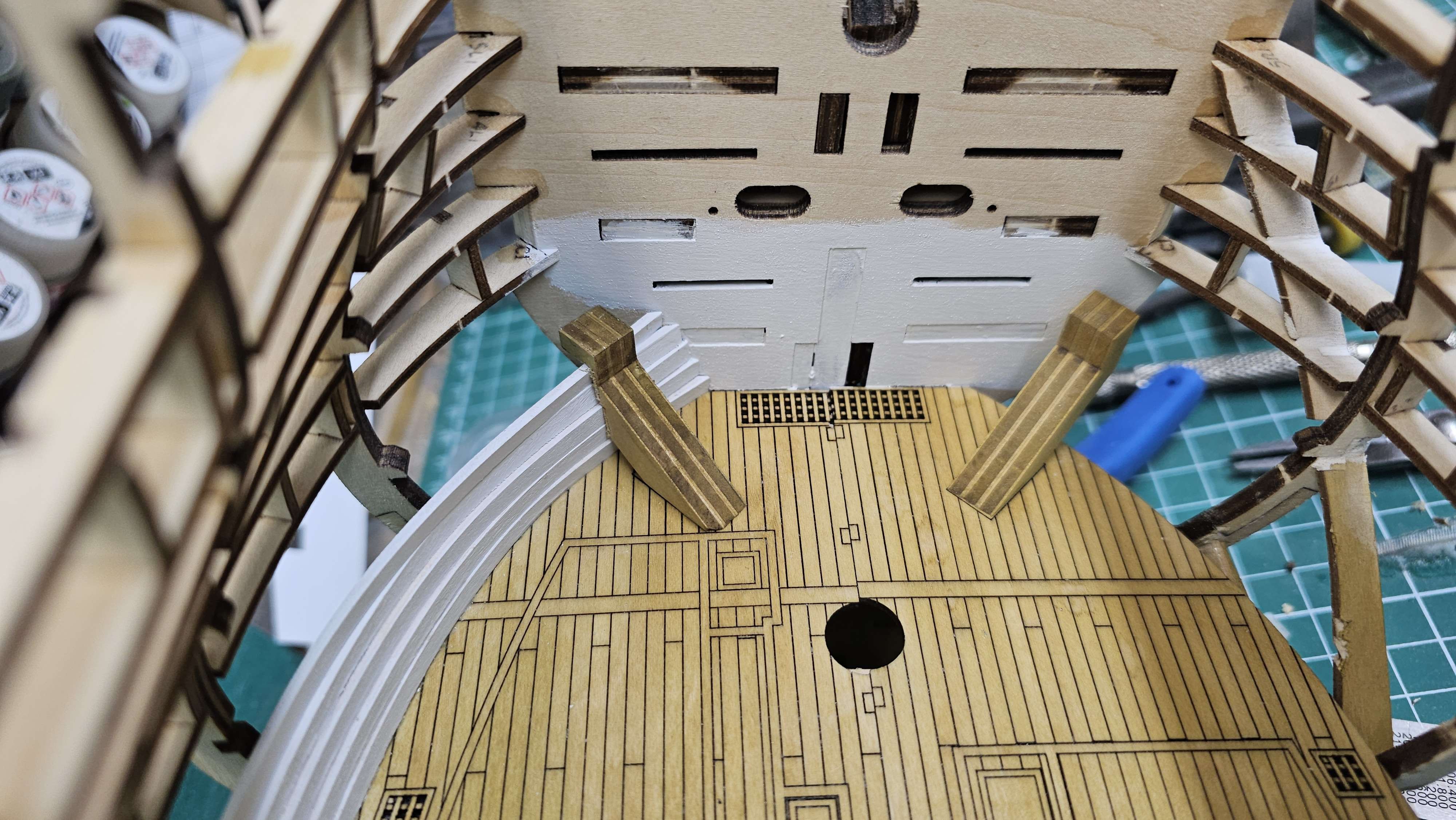

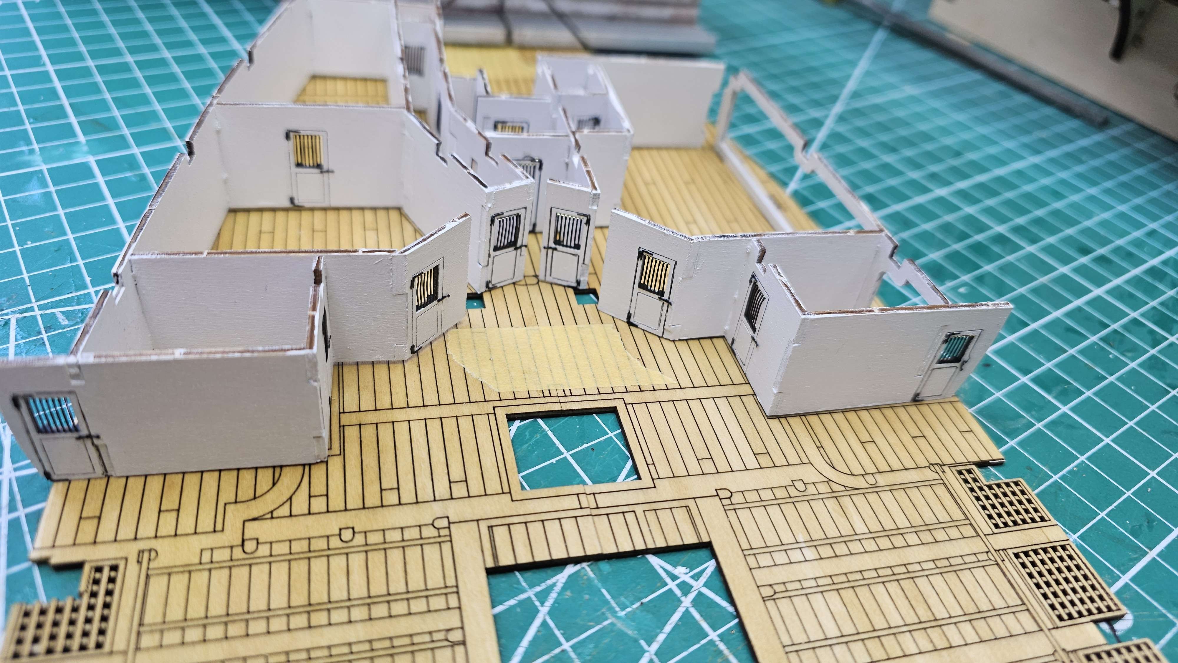

Video #4 Complete
That was a wade. Plus I was ill for several days so didn't get much done.
Cutting the templates was an utter chore. The boards kept breaking and I must have gone through well over 20 swann mortons.
I plodding on and eventually worked throough.
The rear hold compartment isn't get fixed in place, as I feel I may have to adjust the upper edges for the beams and deck to fit above. The inner free standing wall with the shelf is fixed in place, but it easier to get to if I need to adjust the top at all. Forward two deck parts aren't yet fixed into place.
Progress pics below

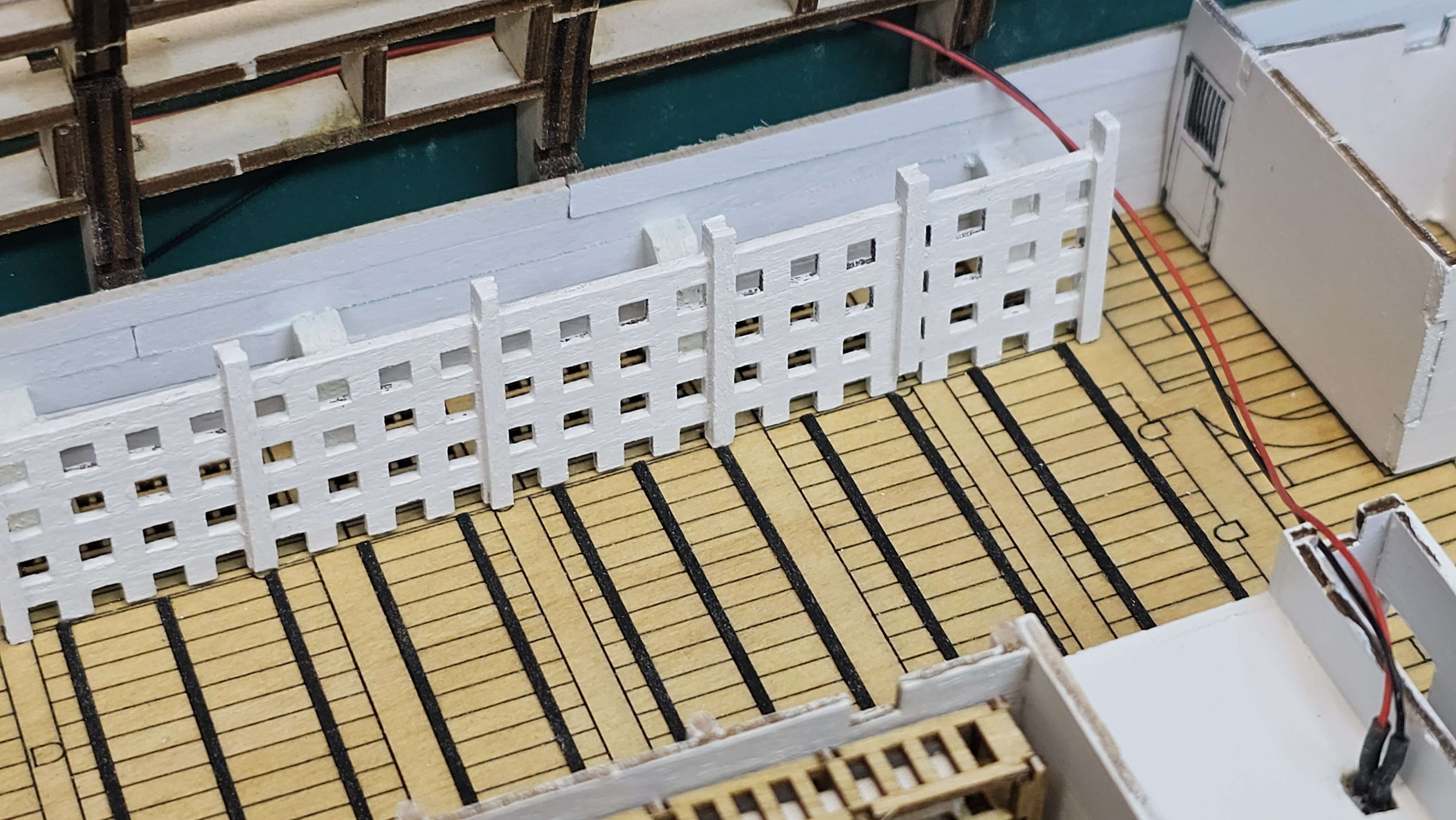

Video #6 Complete
Video 6 is done, which was adding support pillars and various cargo.
For the pillars, I found it easier to source the cross beams and use those for reference to get the correct height, and made some further adjustments to the compartment walls.

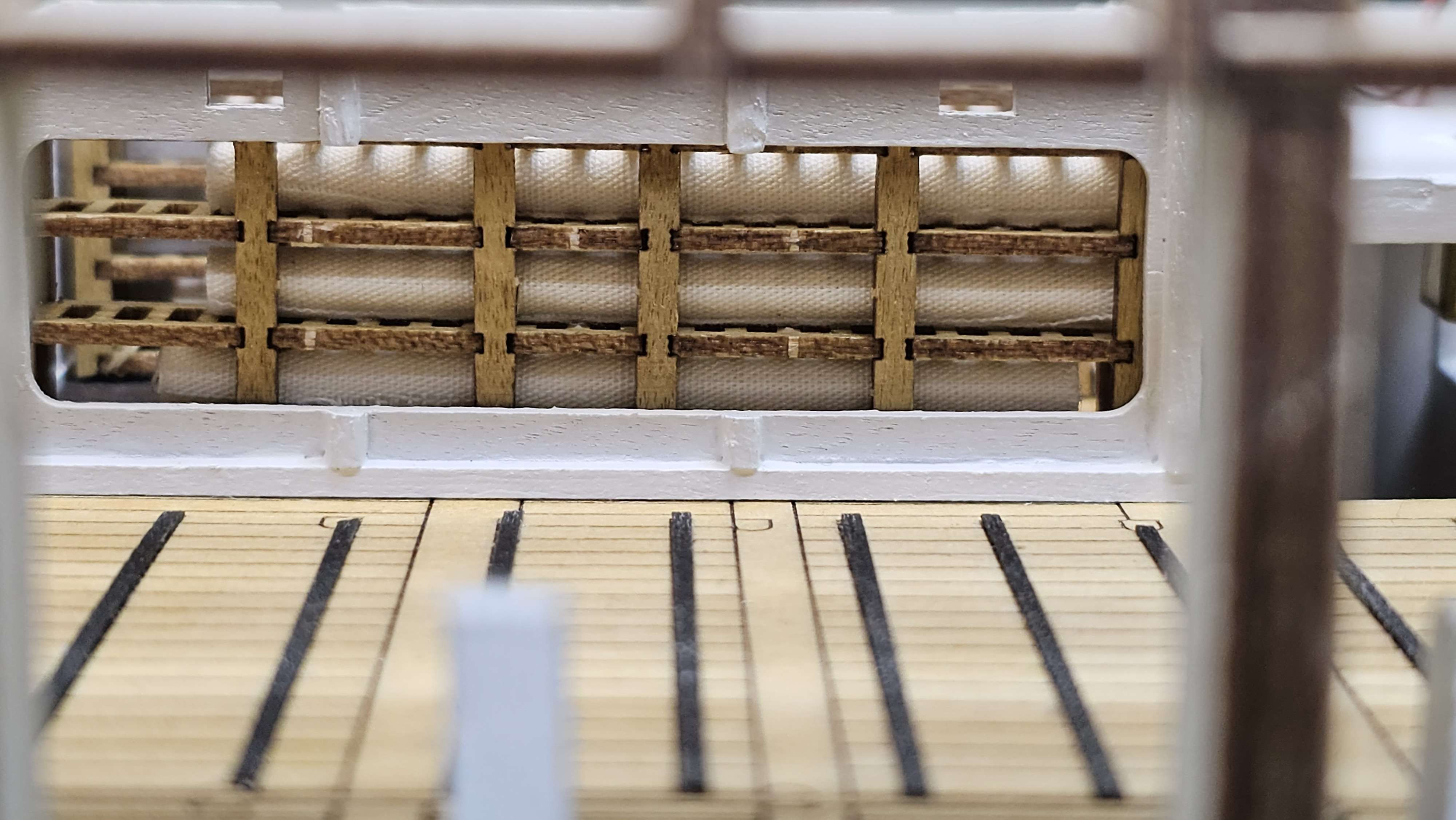

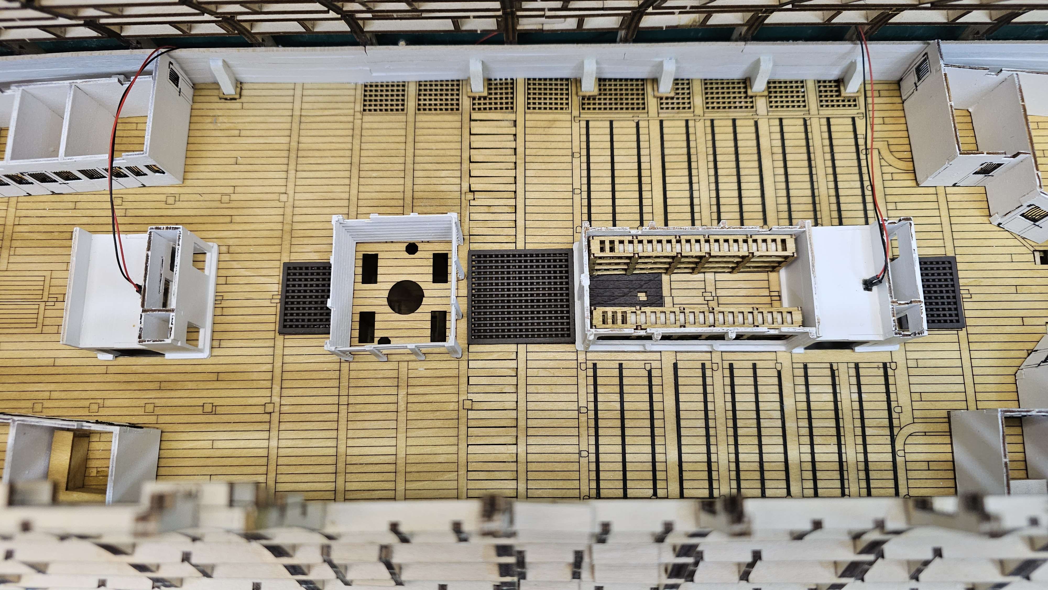

Video #7 Complete

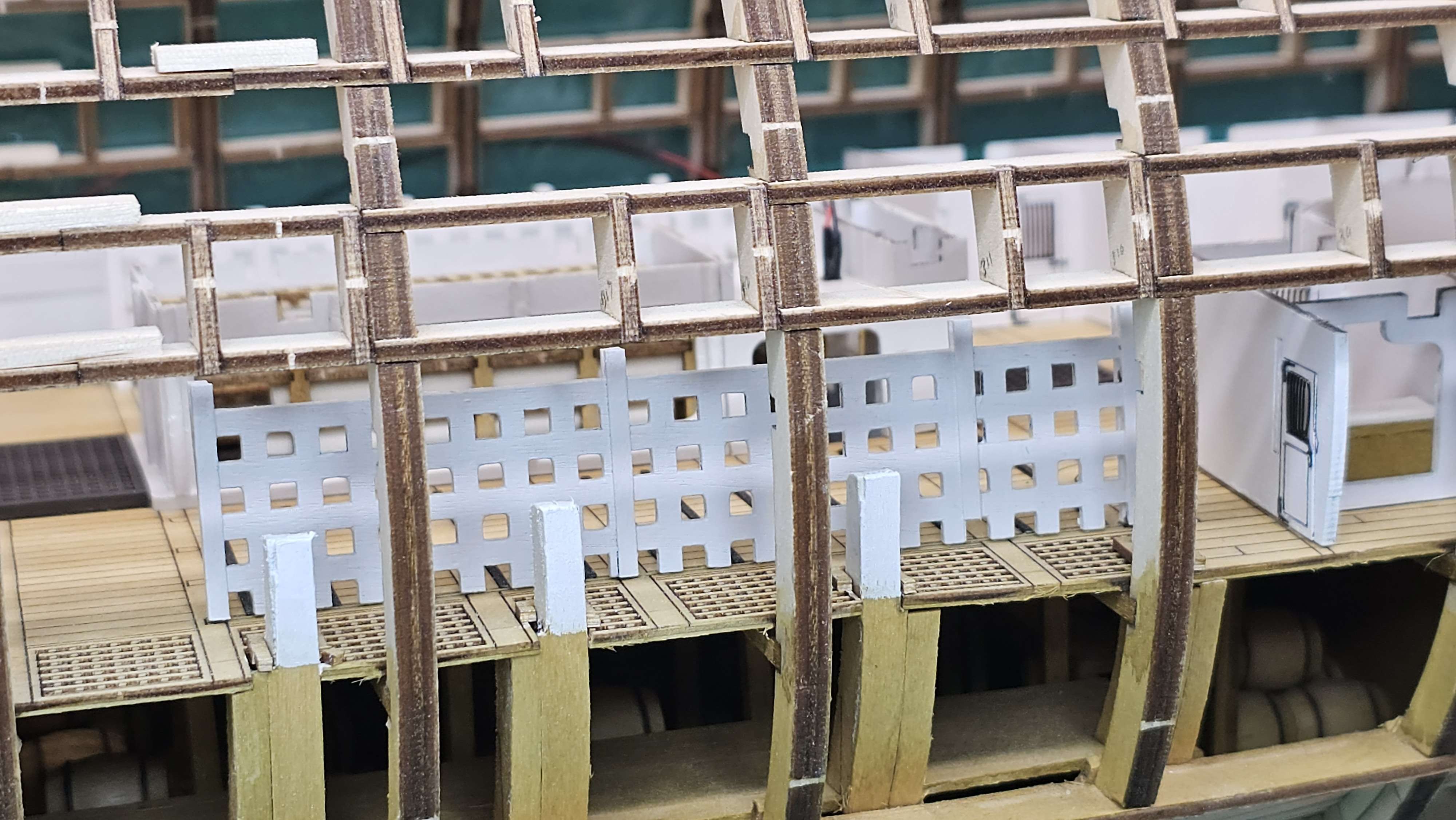

And video 7 is done. Pretty straight forward this one.
The wood for the beams is quite soft so the tool for making a groove works really well, but even if you don't have that, the pointed end of a needle file will work just as well.
In hindsight I would have piggybacked the wiring into the next set and so on just as with the upper decks, just so you don't end up with as many wires.
I didn't paint the frame for the lanterns as my hands weren't cooperating the last few days.

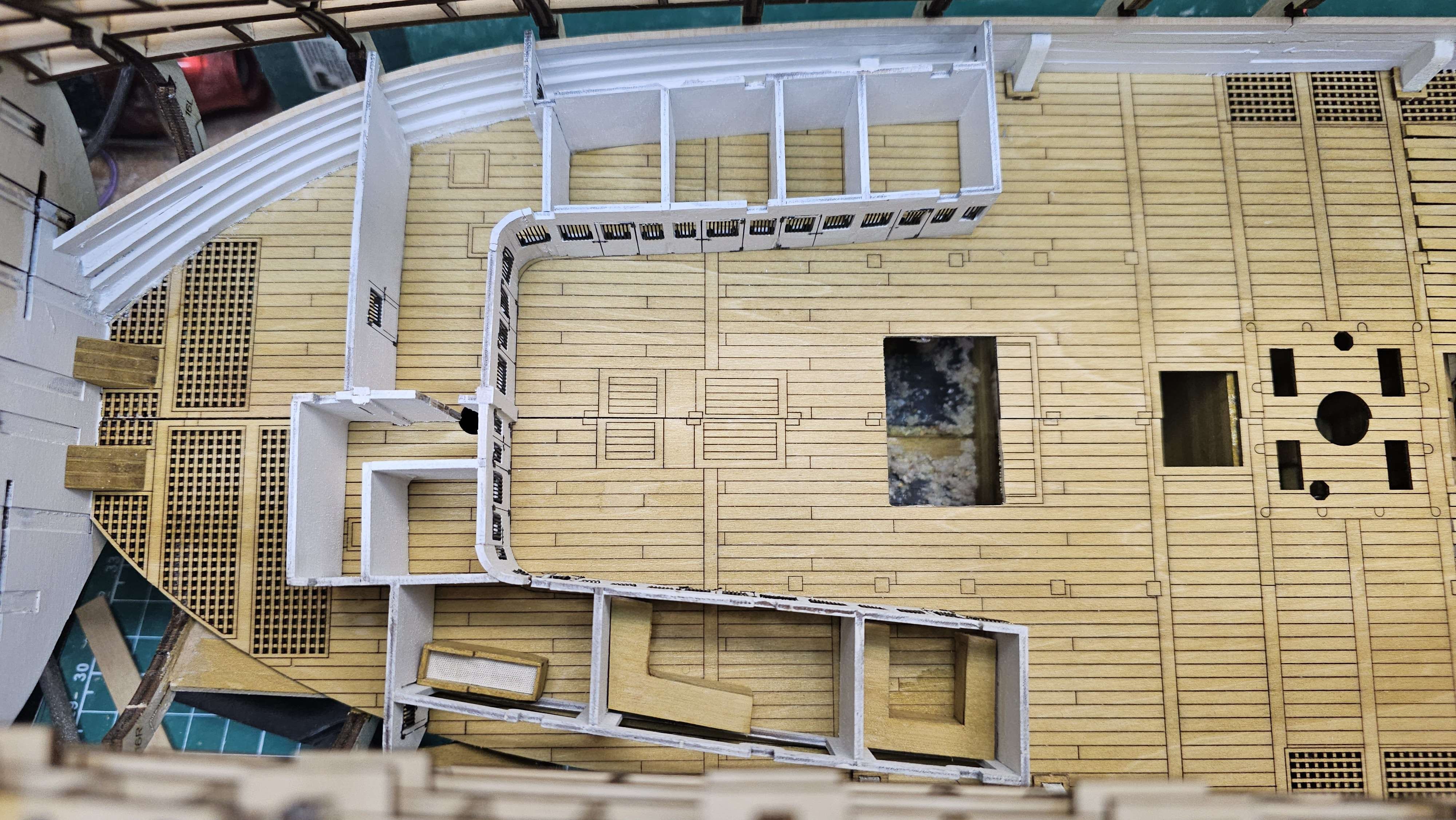

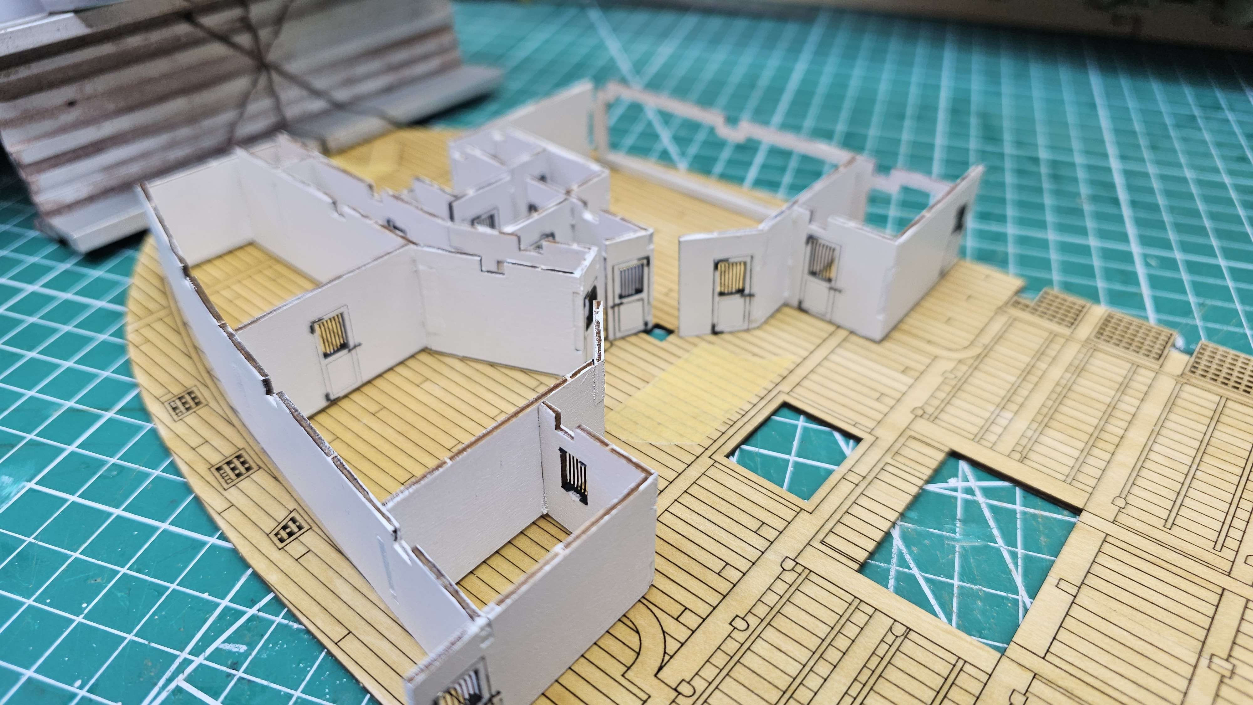

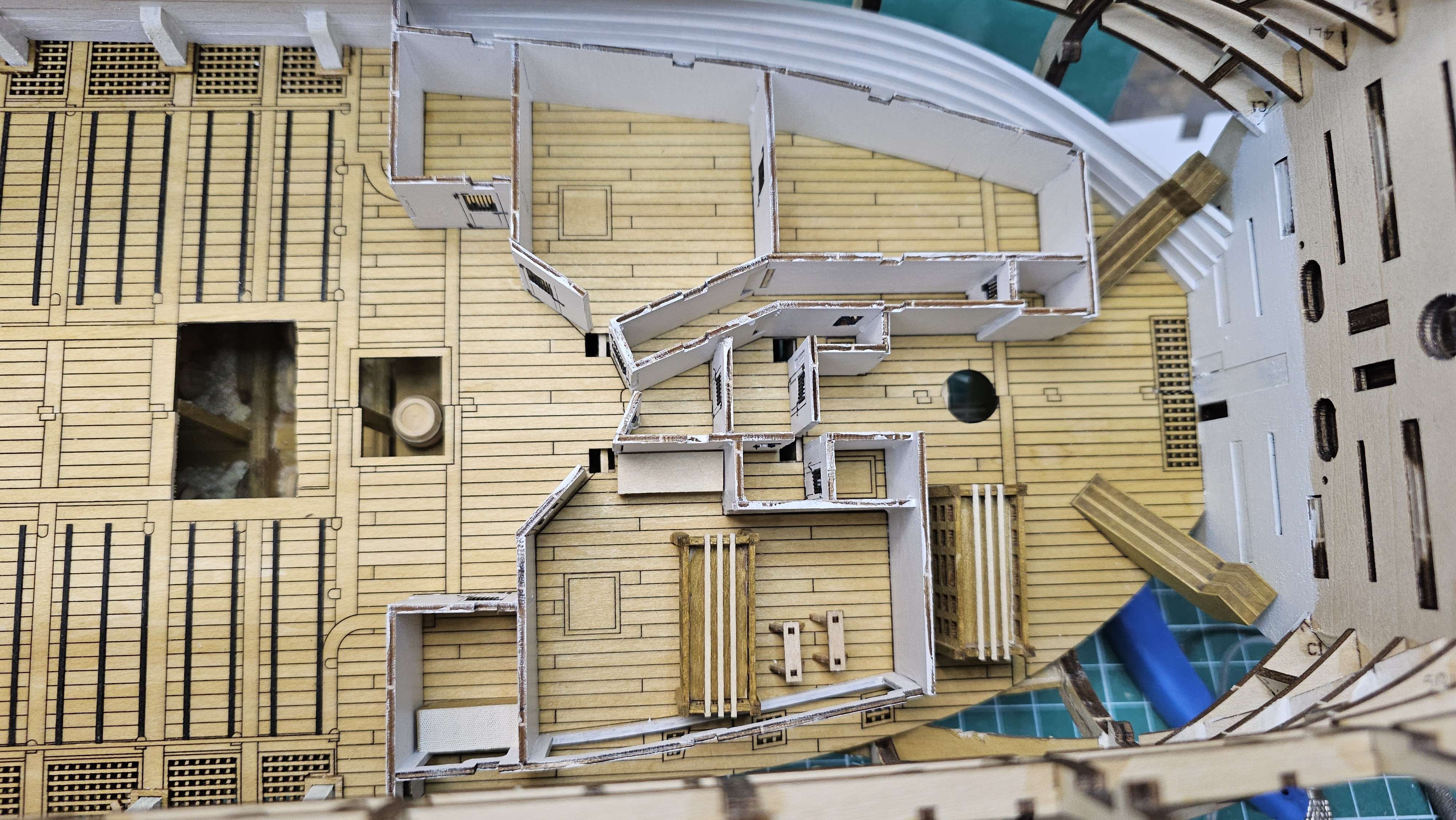

Video #8 Complete
Video 8 is done. Stern compartments. Not fantastic but given it will be very hard to see it will do.
For the bow compartment I may paint the parts on the fret first, I think I will get a smoother finish.

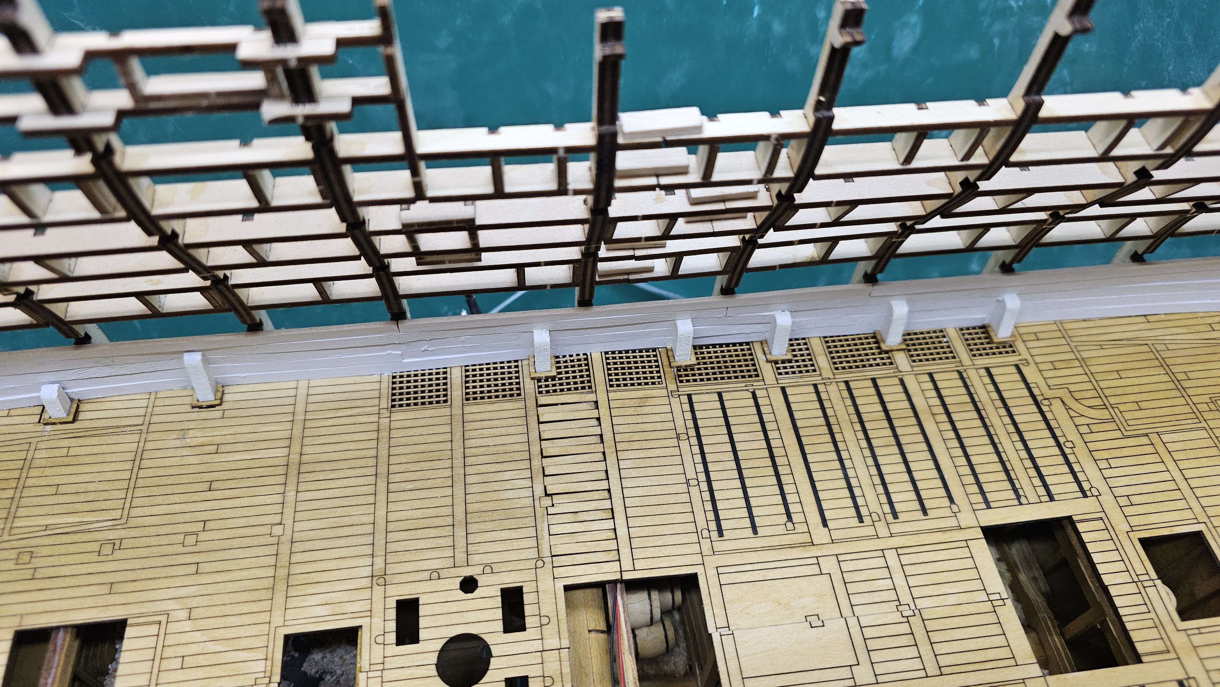

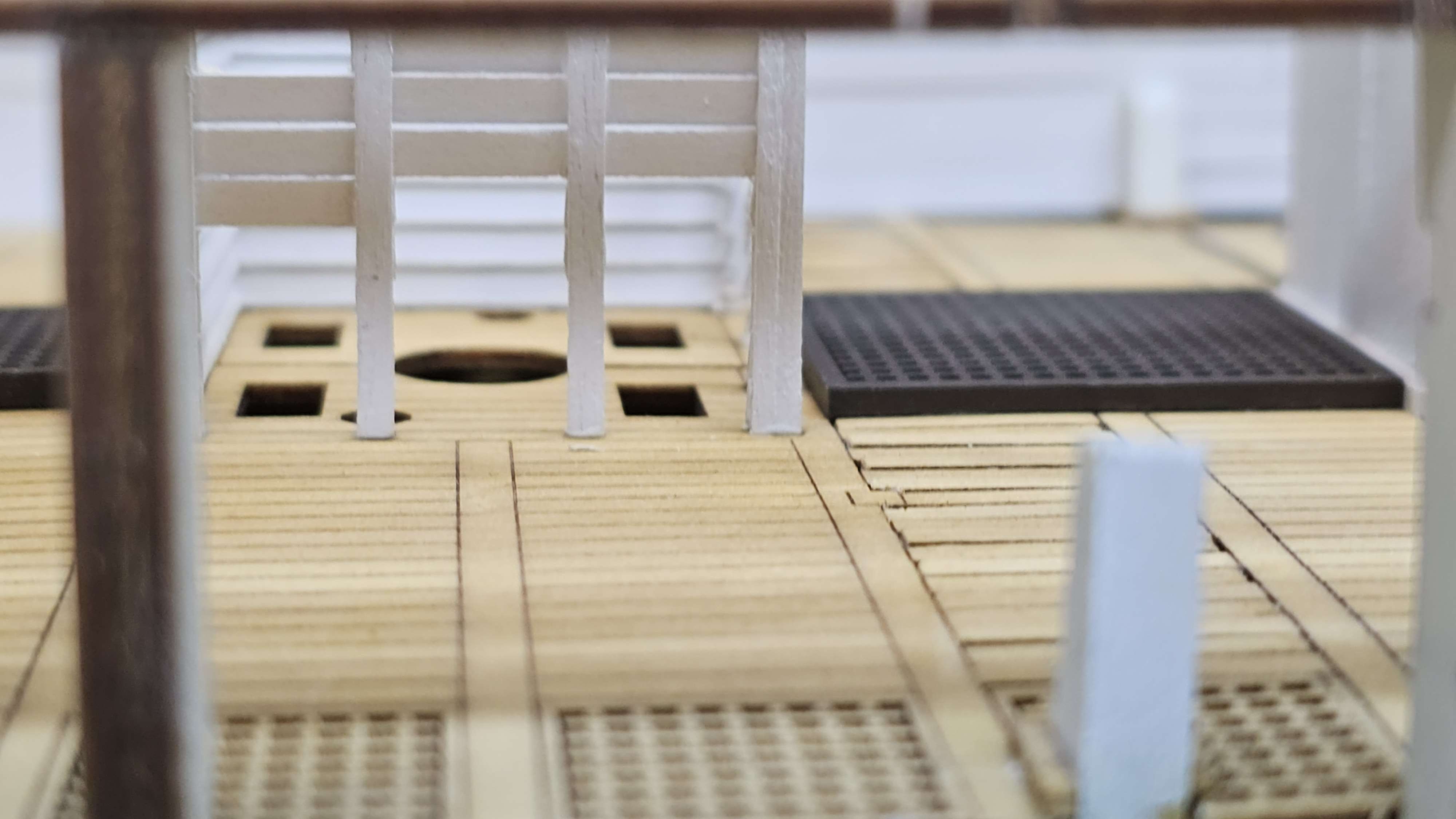

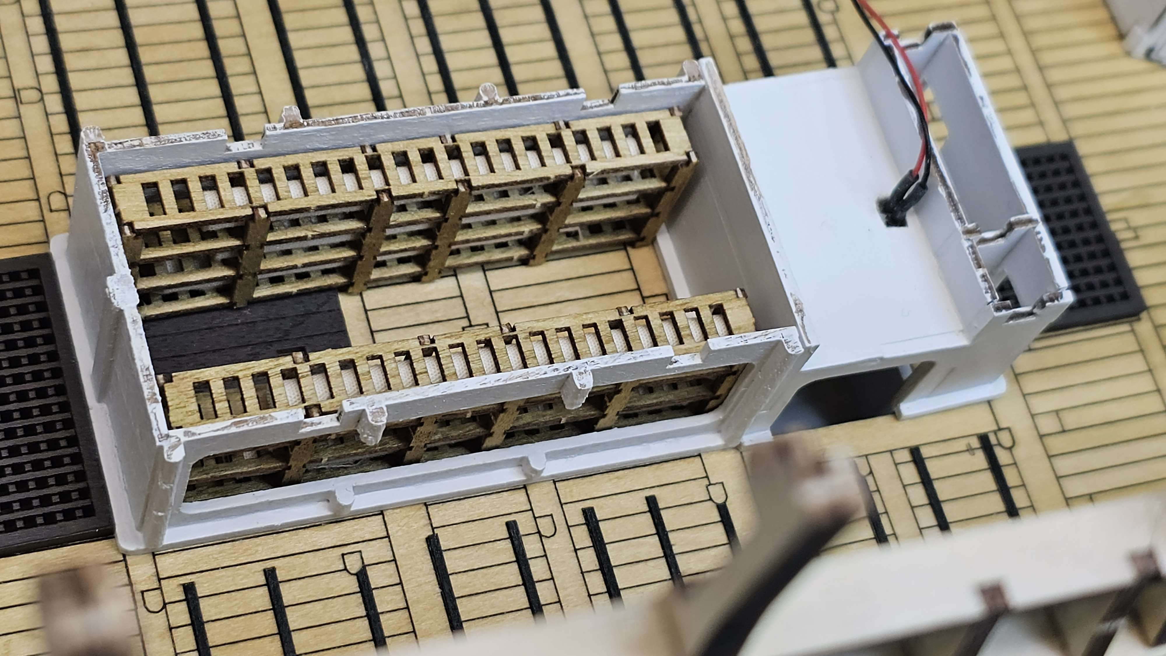

Video #9 Complete
Video 9 is done. Foward compartments. They are still in 3 separate sections at the moment as it made it easier to build this way. They will get joined when installing in the hull.

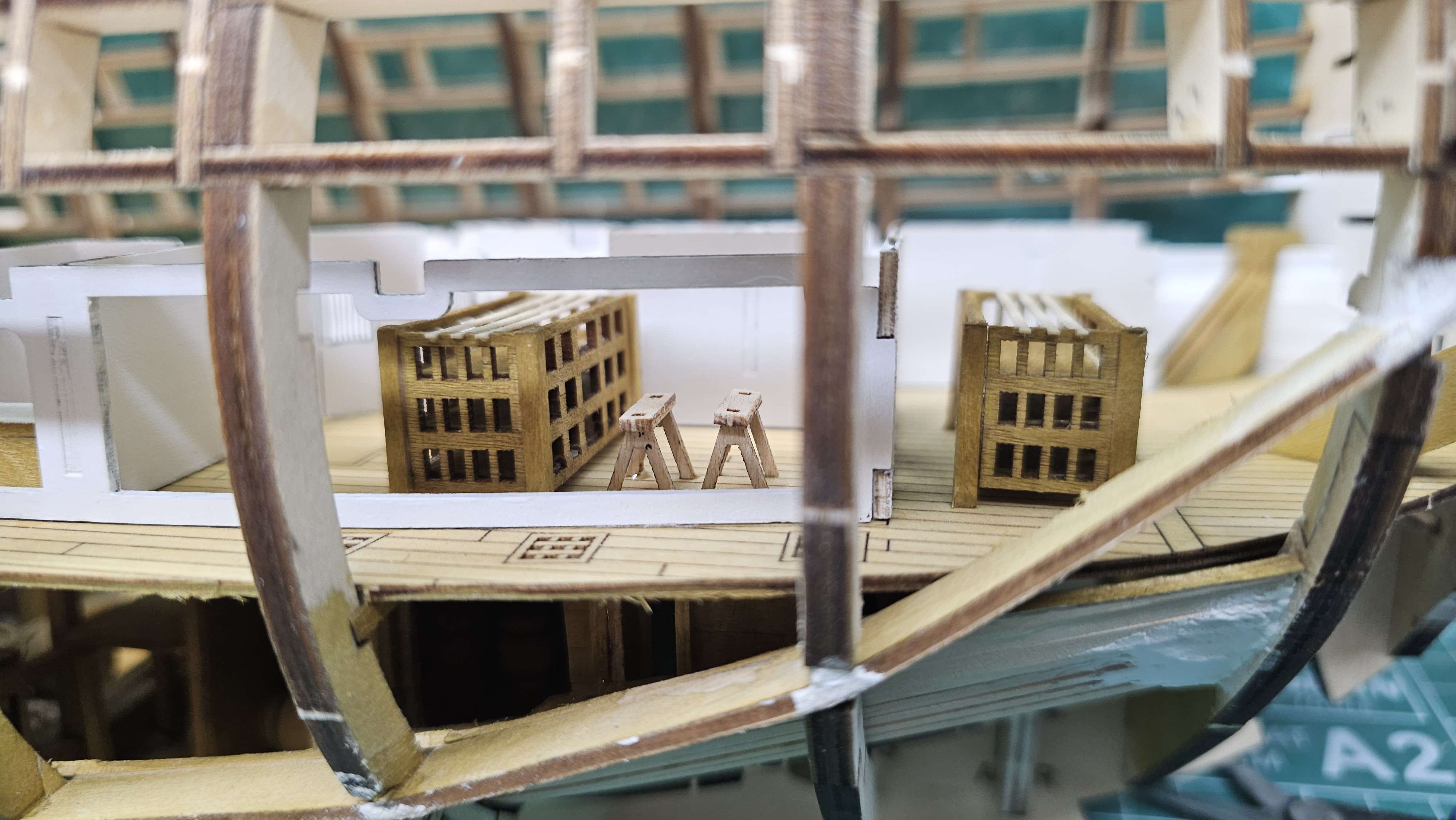

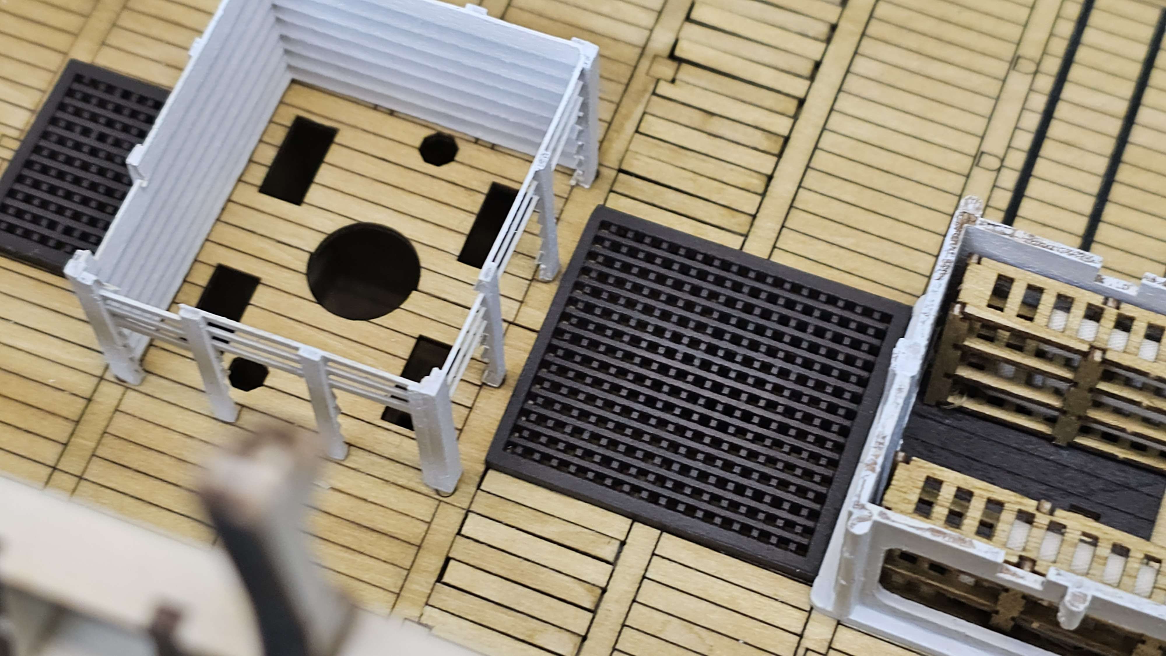

Video #11 Complete
Video 11 was mostly just building some of the internals. I will have a problem with the 4 vertical beams at the bow, as the lower compartment wasn't in the right position, but I will address that as and when.

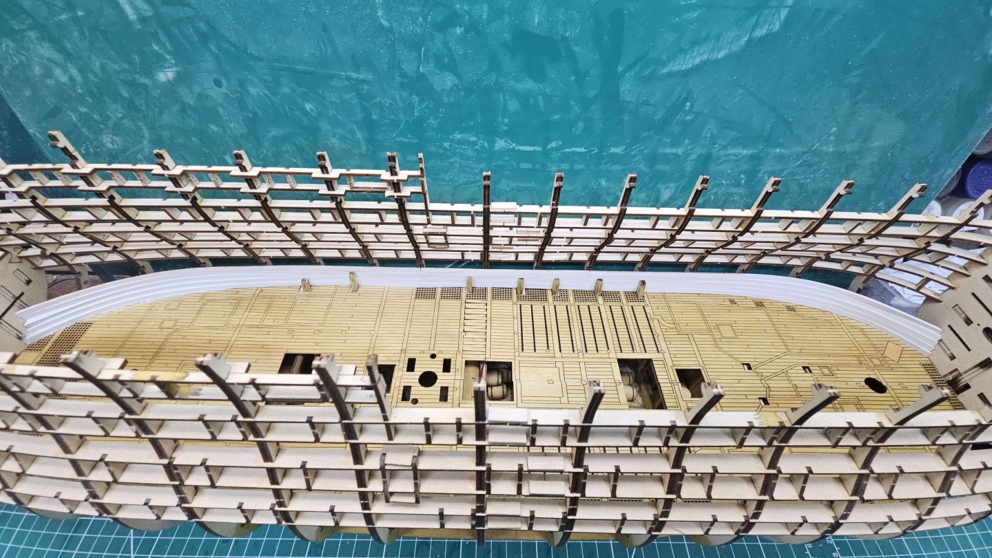

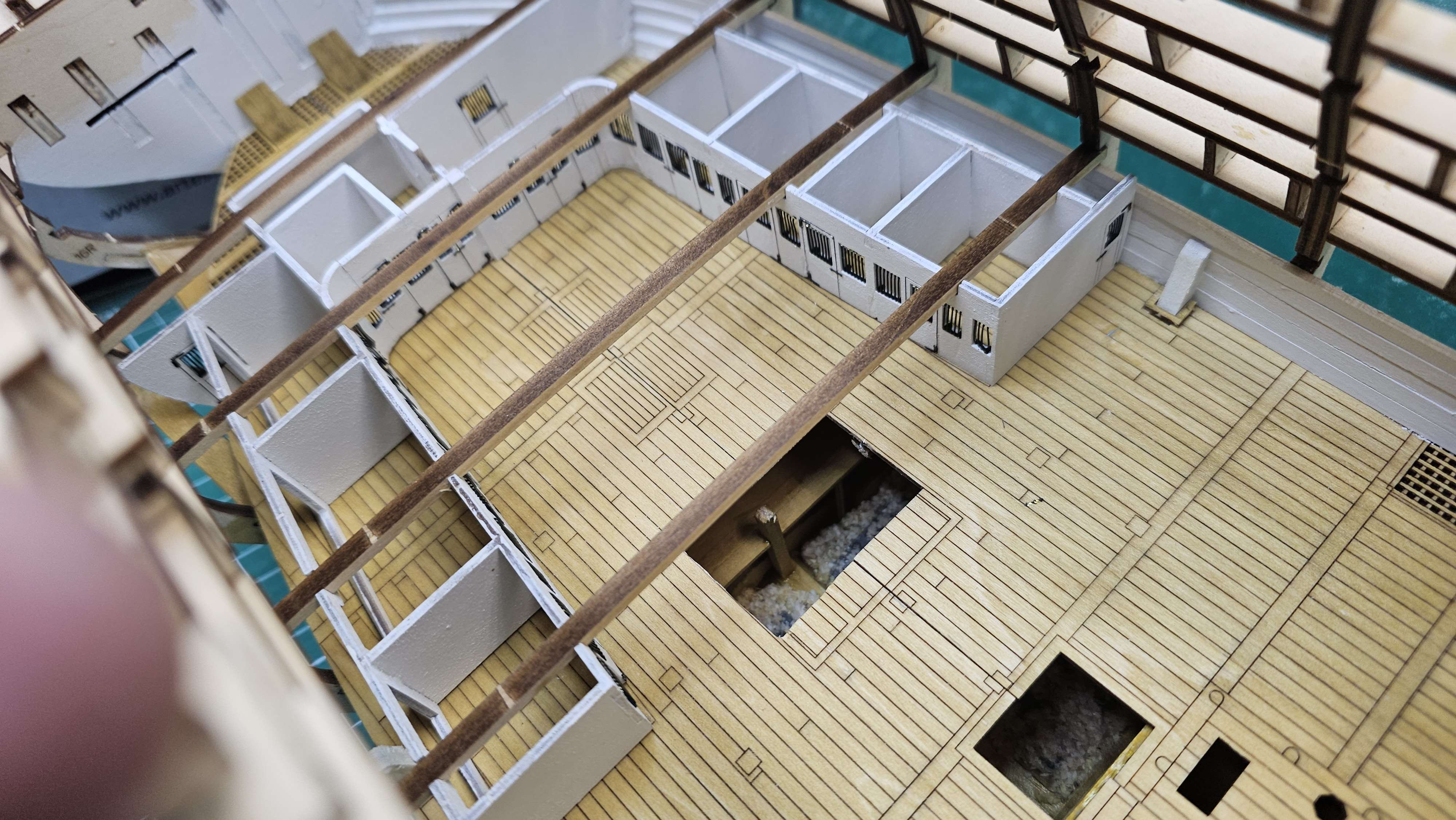

Video #12 Complete

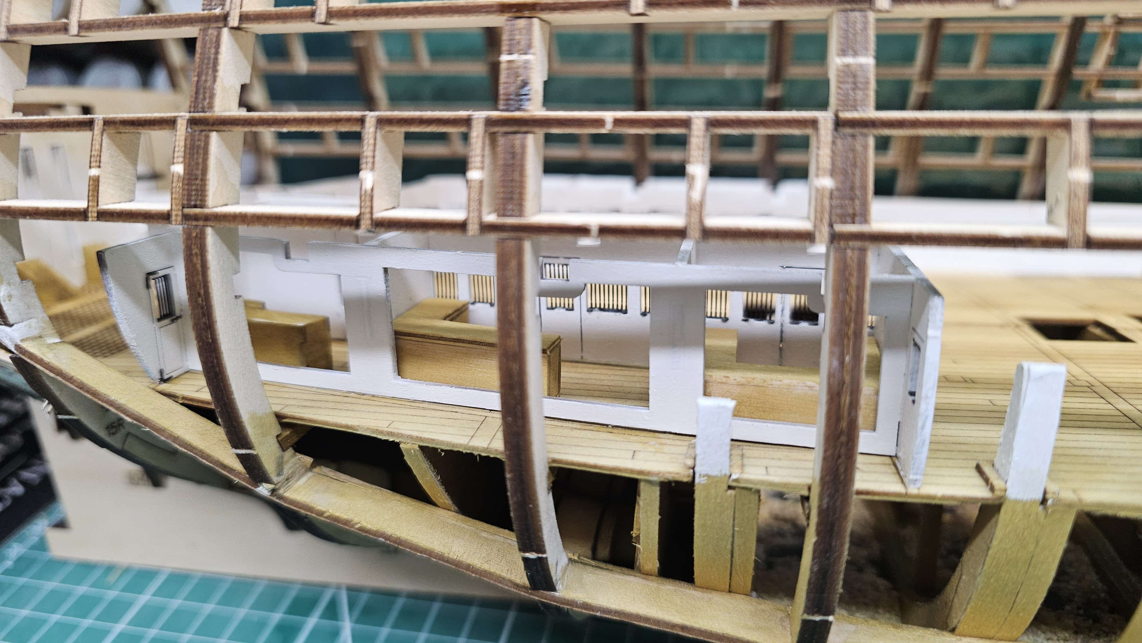

Video 12 was fairly straight forward. Mostly just fitting the items built in the previous video.
Fitting the compartments was much easier than I thought it would be. I did have to adjust the stern wall to fit as I clearly didn't get the wall in the correct position, and the same with the beam at the bow.

I was wondering just how all the internal fittings are going to stay pristine and in place when it comes to hull fairing/any planking
All the best
Kevin
KEEP IT REAL!
On the build table
San Bartolome 1584 by Kevin - Ships of Pavel Niktin - 1/48 - Jan 2026 -
My other builds:
I have the same concern. I really dislike working on any internals prior to fairing the ribs, but with this build it's unavoidable.
Any dust ingress I will probably deal with via my airbrush after fairing is finished. Dealing with any after sanding the planking is going to be a bit trickier...
