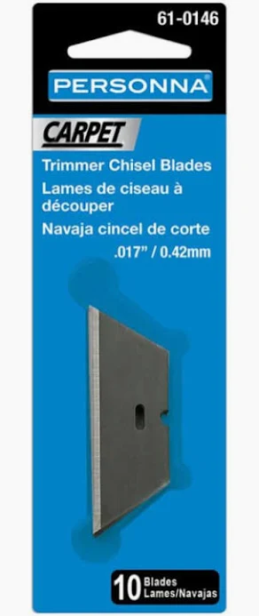

The Ultimation Slicer blades are available at Home Depot and I am sure Lowes and others.  They are Personna Carpet Trimmer Chisel Blades No. 61-0146 for 10 count.  They also have a 100 pack 61-0850.  These are single edge blades not beveled on both sides just one.
At least in my area; the 10 pack in about $3.50 and the 100 pack is about $18.00.
I live outside of Toledo, Ohio in a rural area, so when I ordered slicer I just ordered replacement blades from him.  I didn't feel like the 30 minute drive there to pick some up .  When I am in the area I will probably pick up some, just so I don't feel like I need to use a dull blade to save my supply.
They seem to last awhile, so a hundred pack would probably last a life time.
personna10.webp.77804e4ff85d3fdf4bd145d3a2849a99.webppersonna100.webp.2df2cbcdd74b1bf3b9ea3fe39d29ccdc.webp
