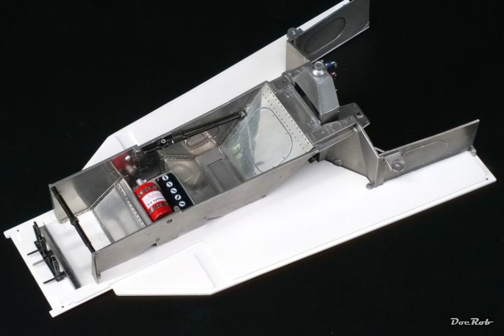

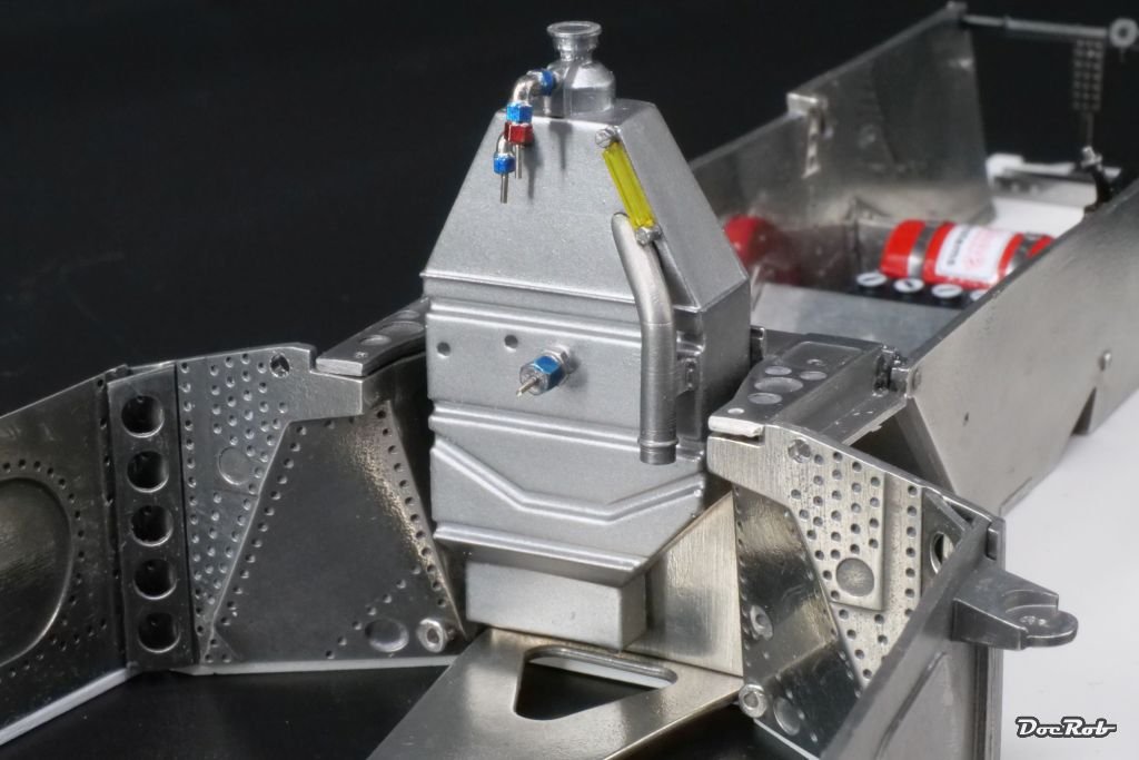

After all the body work, now it´s all about subassemblies and not to damage the polished body with scratches or CA fingerprints.
The polished tub went finally onto the floor pan and got screwed there permanently. I further added some details like the pedals.
The rear of the tub received the gas tank with all the needed attachments.
Then I finished the front suspension sans the steering. Most delicate were some turned pins and the intersecting tubes, which hold the nose in place later. There was a need for absolute precision, to prevent gaps from the monocoque to the nose part.

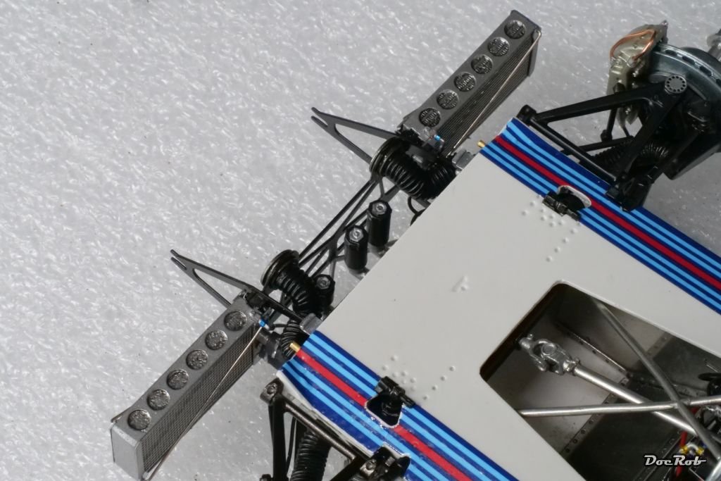

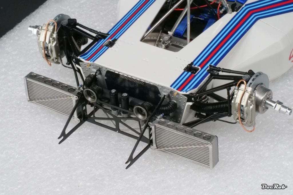

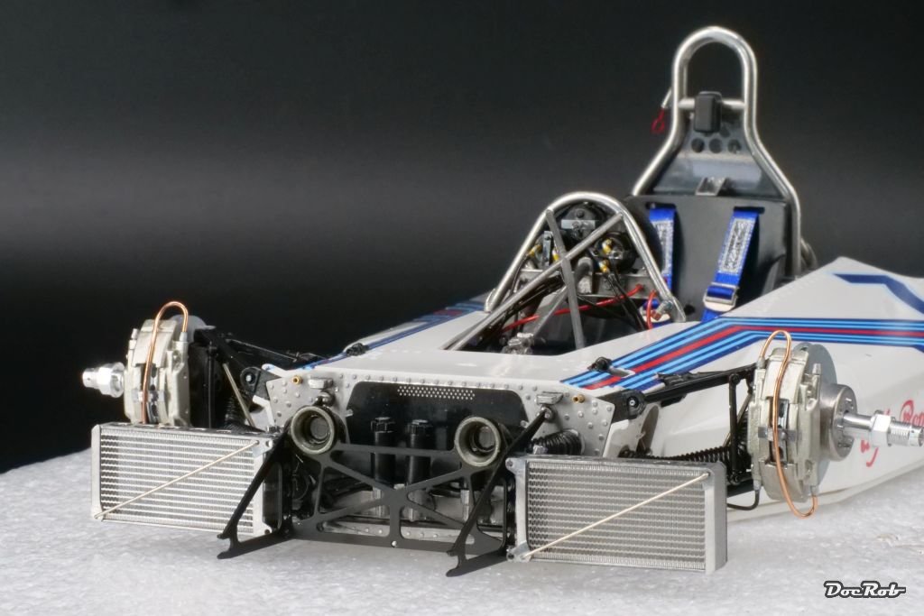

Today I achieved some very important and daunting steps, but firs things first.

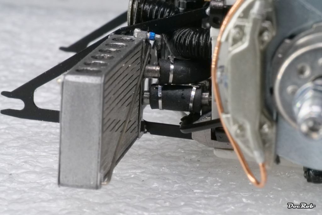

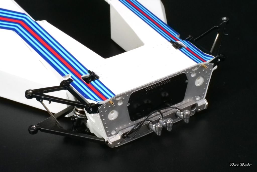

I finished the front section with all the parts added for the axle, brakes, steering and suspension. Some were a bit fiddly, but in all, the fit was great with that delicate section. It´s also quite robust. The axle screws are loose by design and therefore hanging on the pic.
Next was the daunting part, the closing of the main body. There are so many intersecting parts, that even test fitting is a time and nerve consuming affair. Finally I got it done and everything fitted with a tiny bit of tweaking here and there. The floor pan and body are hold together with eight screws.
Finally, I test fitted the engine section to the body and luckily everything fit as well.

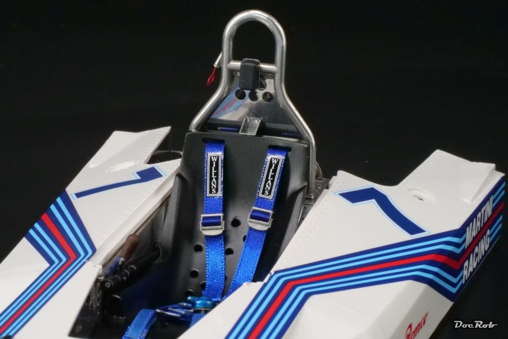

The cockpit tub starts to become busy. I added the seat belts to the seat and then this was glued into the tub. I really like MFH seat belts, as they look good and are relatively easy to assemble. There are white metal buckles and PE parts and two widths of blue ribbon. All got assembled using double sided tape, which has a strong bond and is supplied with the kit. I bought seat belt sets for other kits too, like for my 1/12 Tamiya kits.
The manual placed the headrest/rollbar before the seat, but I chose to do it after, because it was easier to fiddle in the seat belts behind the seat.

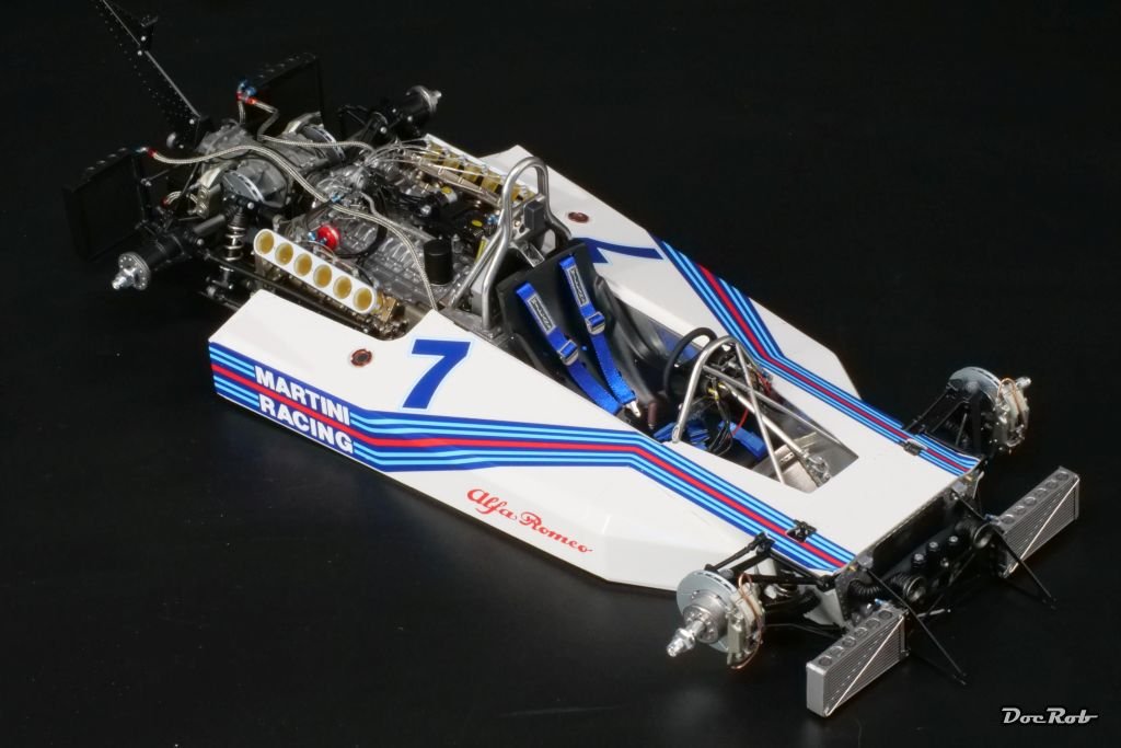

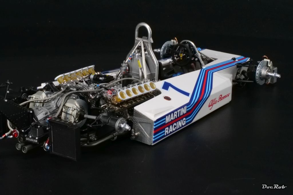

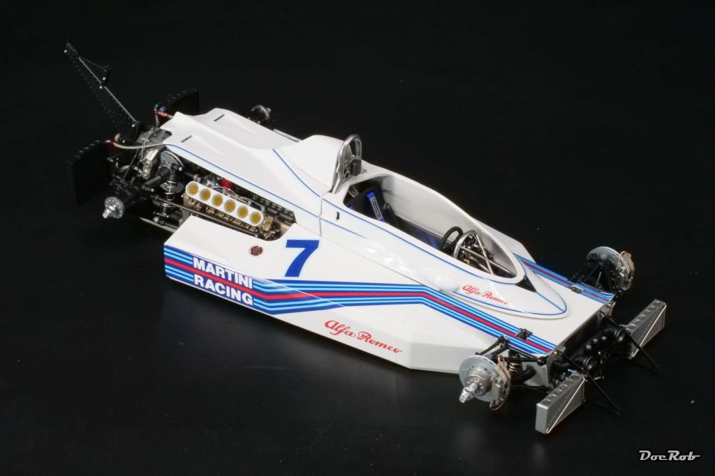

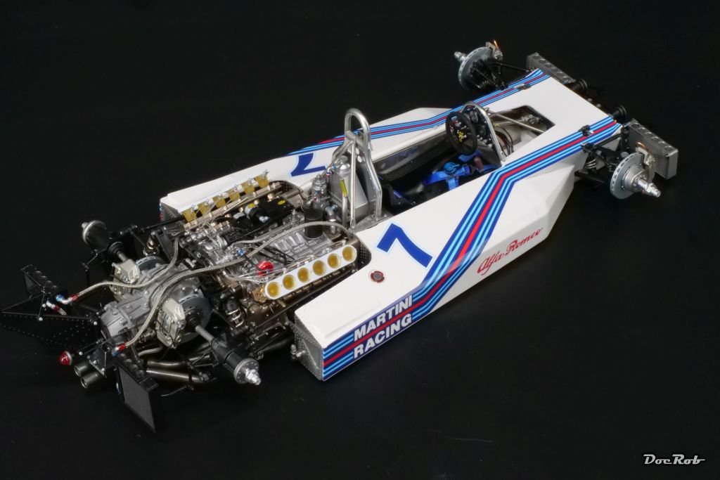

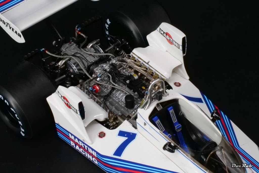

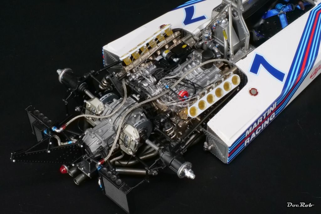

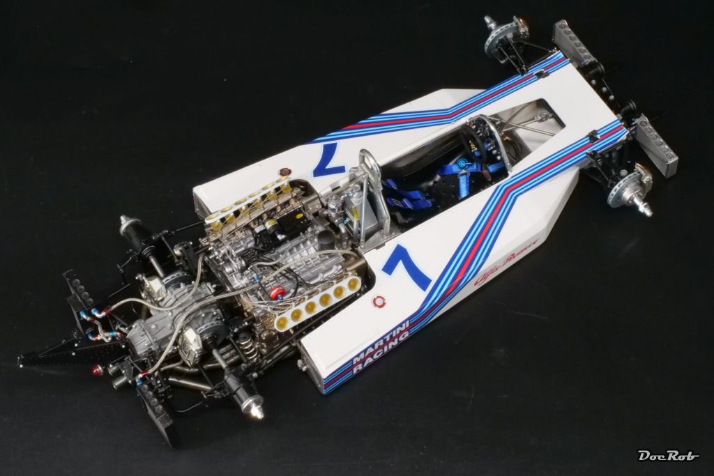

Today, I joined the engine with the monocoque. Test fitting was done before, but a last aggregate with three tubes attached needed to be fittet in between. That proved very difficult, but after some attempts, I got it done. If you ever build the kit, don´t glue the metal end plates (M142, M143) to the monocoque, like shown in step 13. Luckily I didn´t, because other ways I would have had to remove them to fit the engine in step 17.
And finally, I tried the fit of the center body parts.

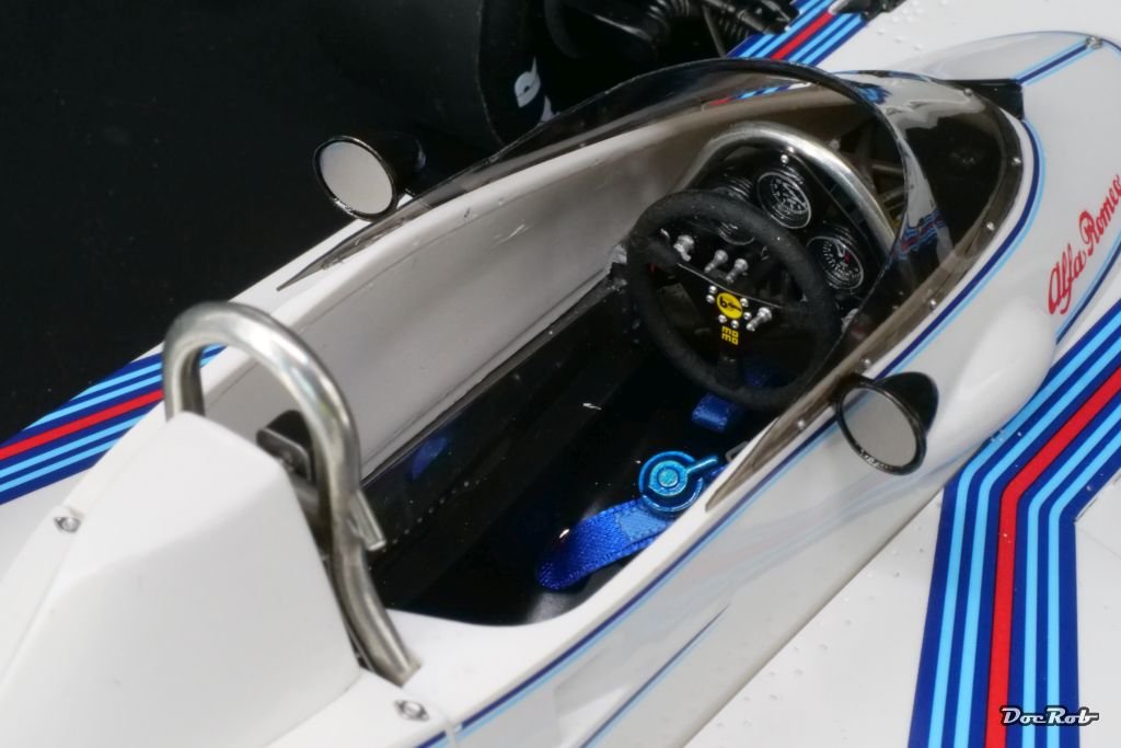

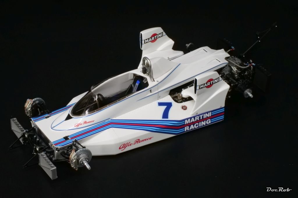

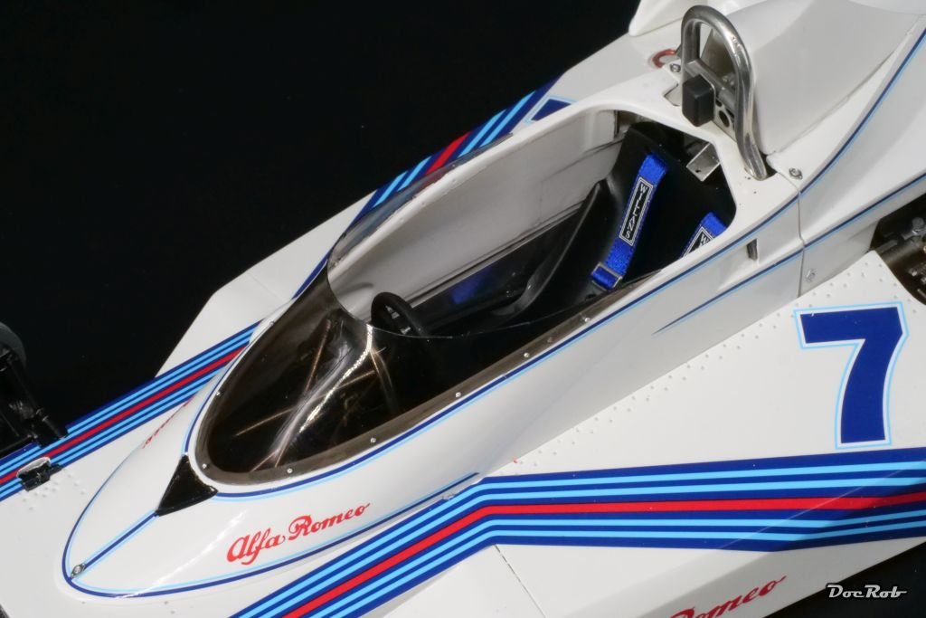

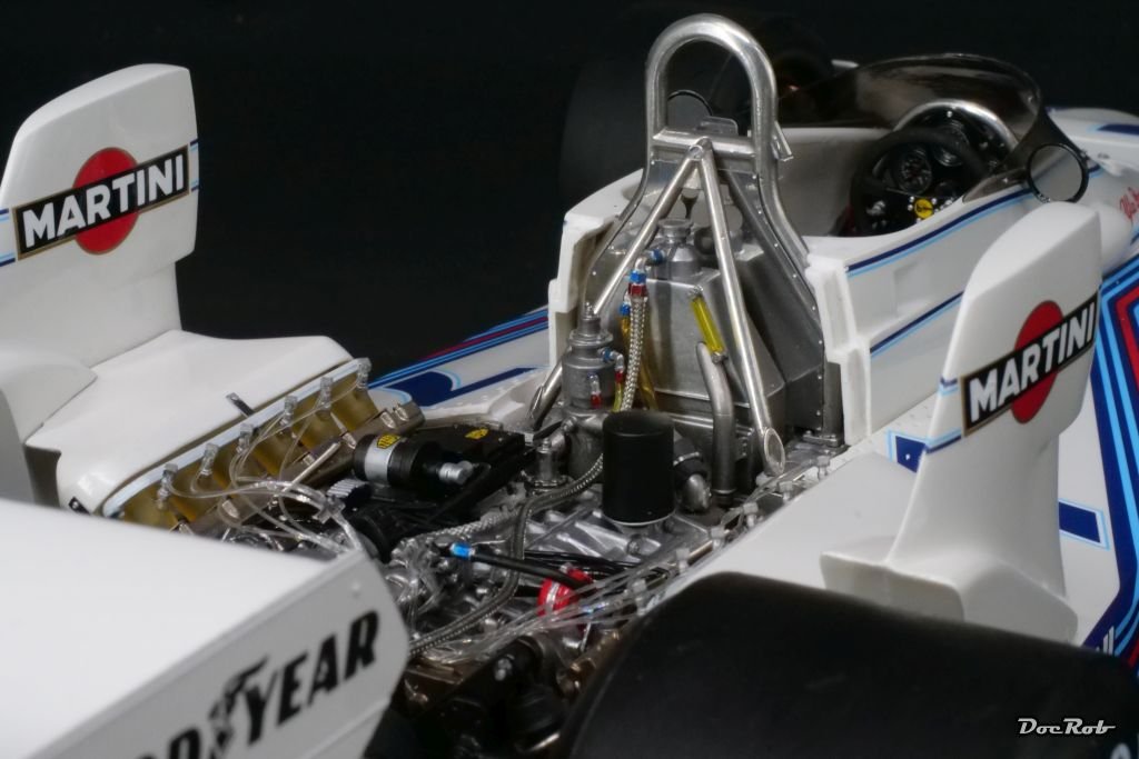

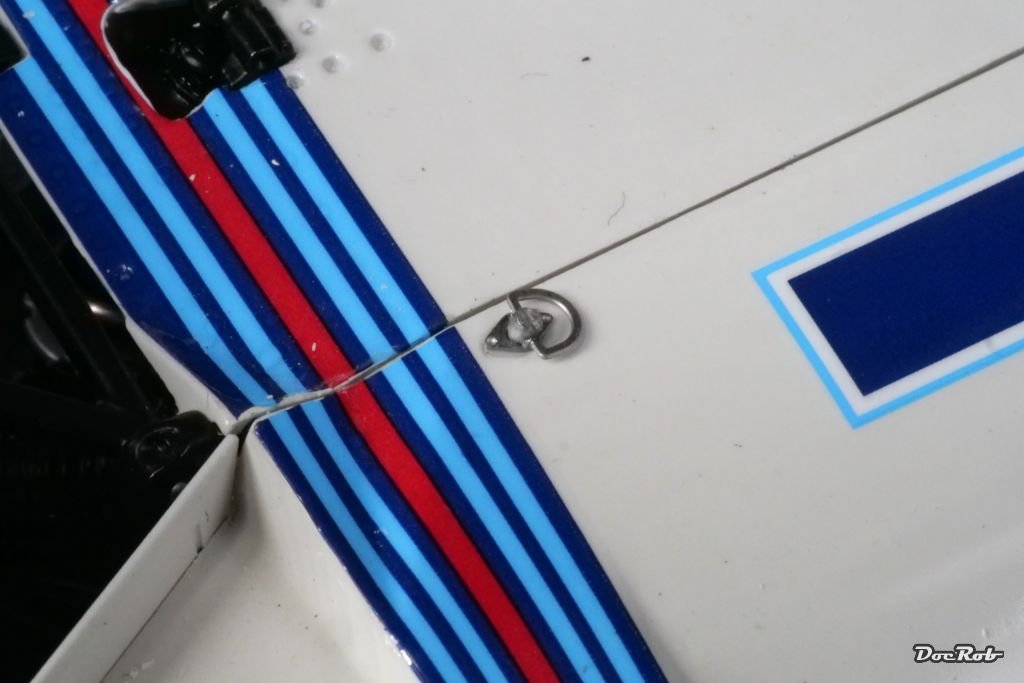

Slowly, I´m nearing the finish line. I added many details to the body, like fasteners, bolts and rivets and worked on the final fitting of the body parts. I am always a little scared when it comes to vacuum formed parts like the smoke clear windshield. It´s always best to cut it with a pair of scissors, than sanding, because the burr is very hard to remove. Finally I got it done, using Tamiya flexible masking tape as a guideline.
The clear part was glued to the body with 1mm wide double sided clear adhesive tape and then received the tiny rivets. The side air intakes are not finally glued to the body, I may let them removable for better sight on the engine, but then, I add some guiding bolts.
Now I´m preparing the rims and the nose section and then wroarrrrrrrrrrr 🏁.

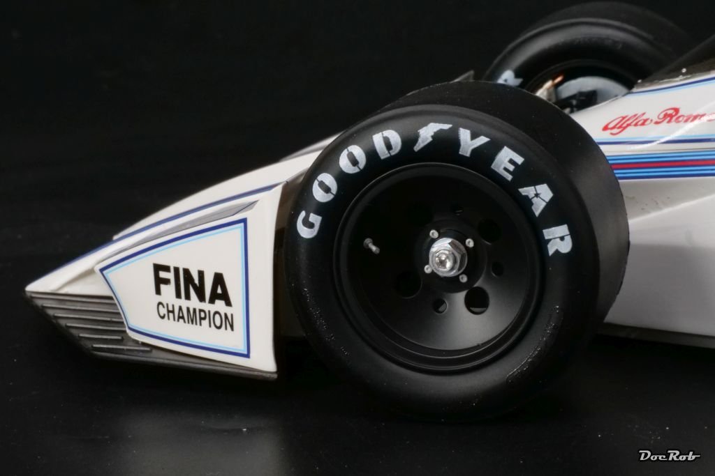

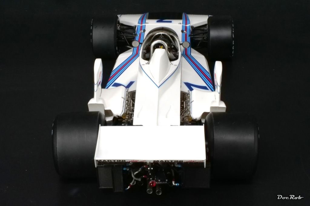

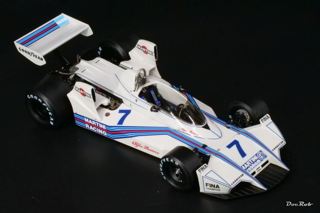

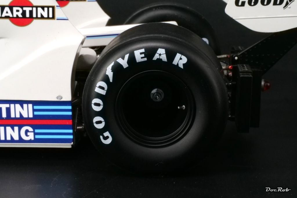

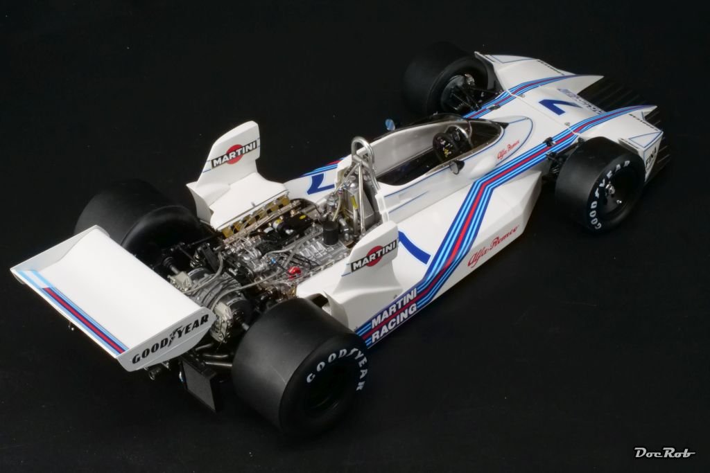

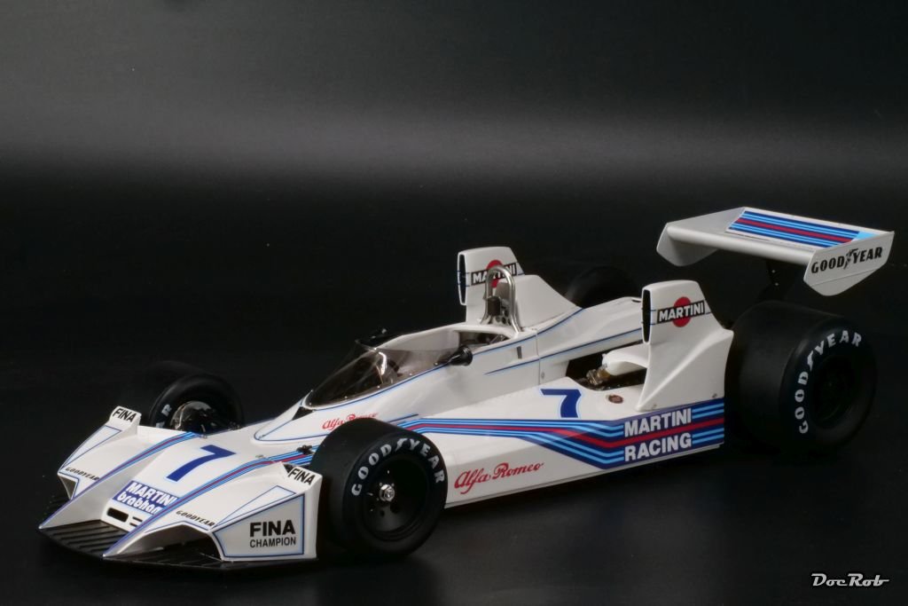

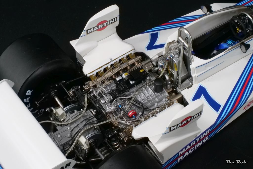

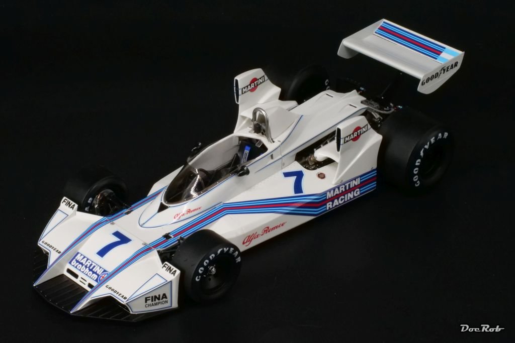

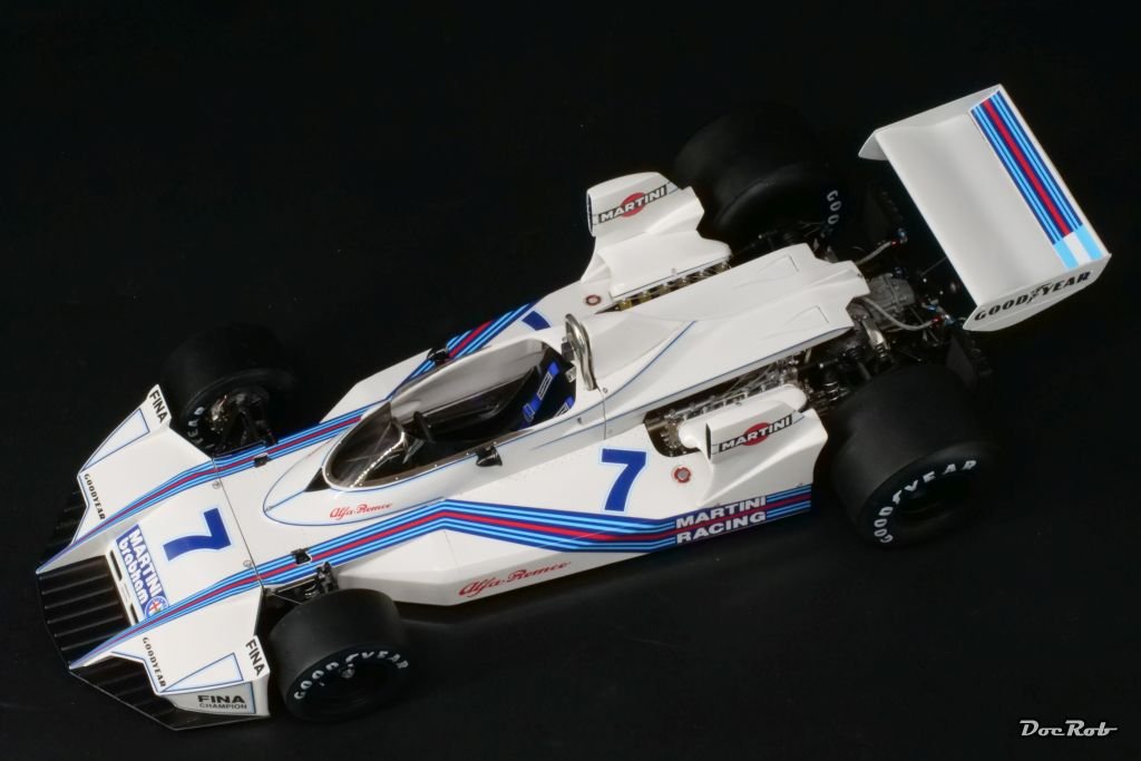

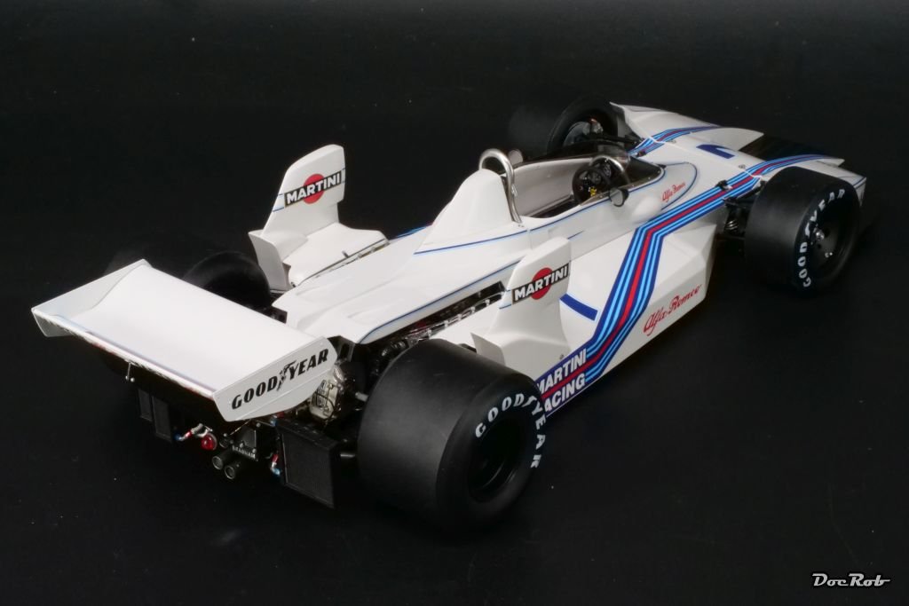

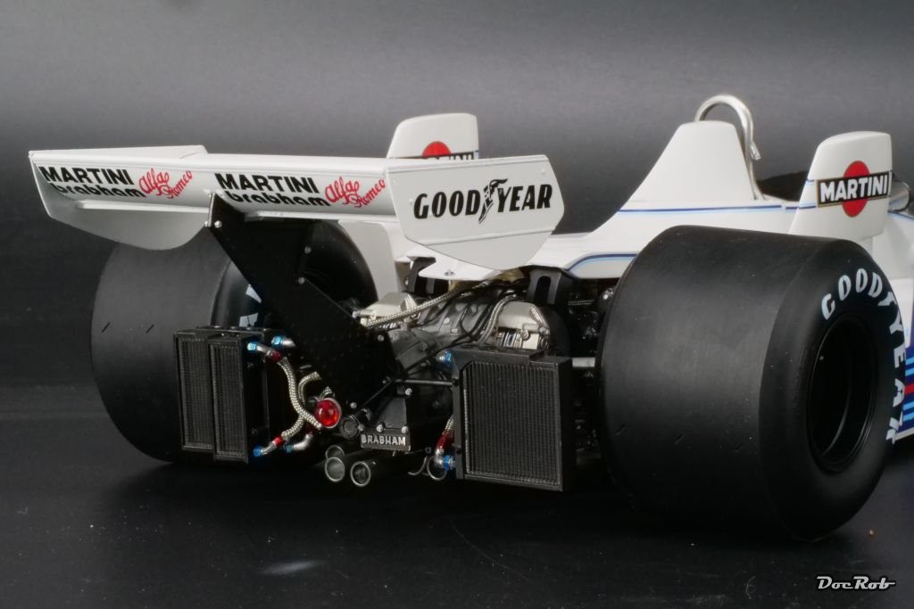

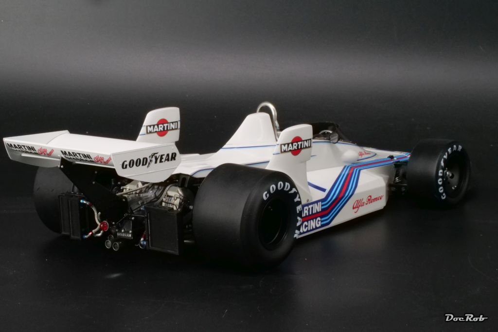

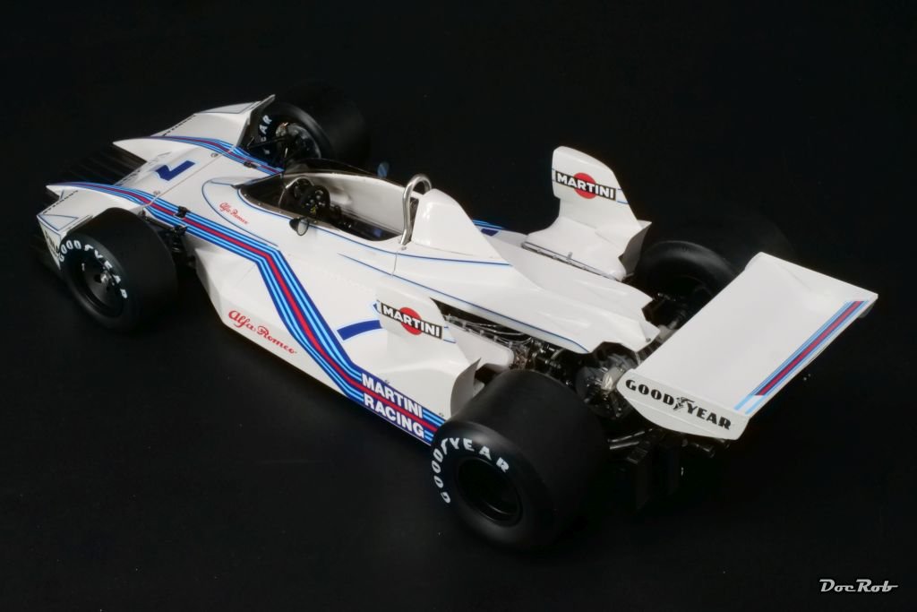

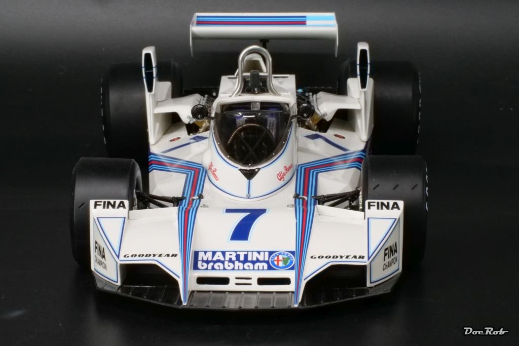

There is a song from The Reverend Horton Heat, which is called "It´s Martini Time". The song is like a anthem to me as I love cocktails and specially Martini cocktails, albeit, I never prepare them with Martini. Anyway, the BT45 would fit into the bar, but no chance, no models in the living area :D.
After two more sessions, the BT45 was done surprisingly rapid in the end. The innards of the nose section fit perfectly and on went the nose. It is removable as are the cockpit and engine fairing.
It felt nearly indecent, to paint the beautiful turned aluminum rims, but my car had them in black. After drilling all the needed holes very carefully, not to scratch the precious parts, I primed them with Mr. Surfacer 1500 black and found the matte black looked so good, why spoiling it with a color coat. Finally the tyres were mounted onto the rims and then I added the air vents, which proved fiddly. The tyres are absolutely perfect, with pre printed branding and much heavier and durable then e.g. Tamiya tyres. They need to be with the weight of the car, which is also supported by two spacers under the chassis.
Well, let the pics speak:
Cheers Rob

52 minutes ago, Canute said:
That's one beautiful build, Rob. The F1 racers are so aerodynamic. Well done. 👍
Thank you Ken, I especially like the looks of the BT45, it looks faster than it actually was with it´s sleek low profile shape, which was possible due to the use of the flat 12 cylinder engine.

14 minutes ago, yvesvidal said:
Beautifully executed Rob. Maybe you should have a group picture of all your Model Hiro Factory models.....
What is the next candidate?
Thank you Yves, there are not so many finished MFH kits. I built three, the Crocker motorcycle, the Cobra Coupe and now the BT45. As I guessed before, building a MFH Formula 1 kit was much easier than a full bodied race car like the Cobra Coupe with all it´s doors, bonnet, many clear parts, etc.
Basically there were no real problematic areas through the build and I enjoyed it massively. The build took less than three months.
What´s next, good question, cleaning the bench is a must, which is cluttered with parts and tools, jars and reference and then...
I will be traveling a bit over the next weeks, so maybe a short project, probably not a MFH kit.
Cheers Rob
