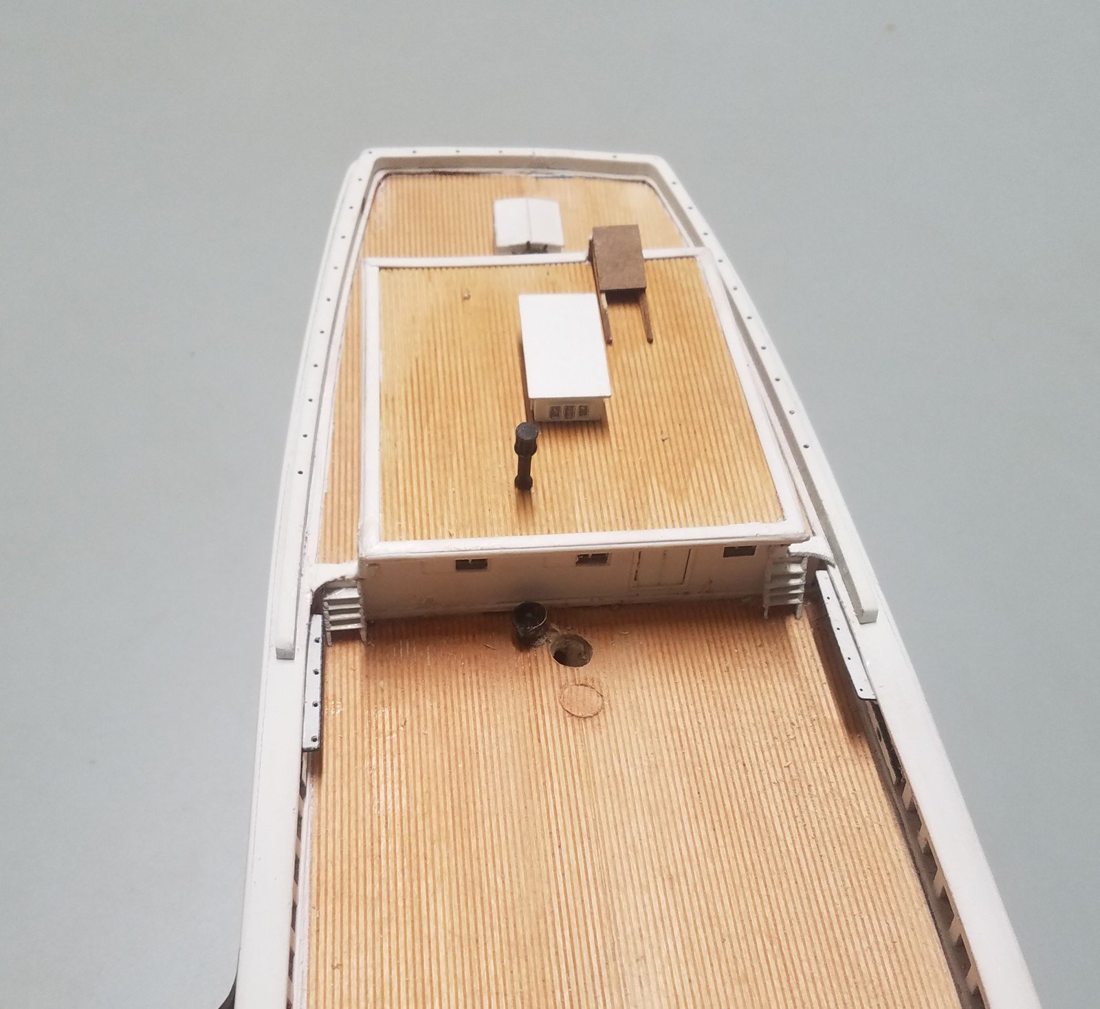

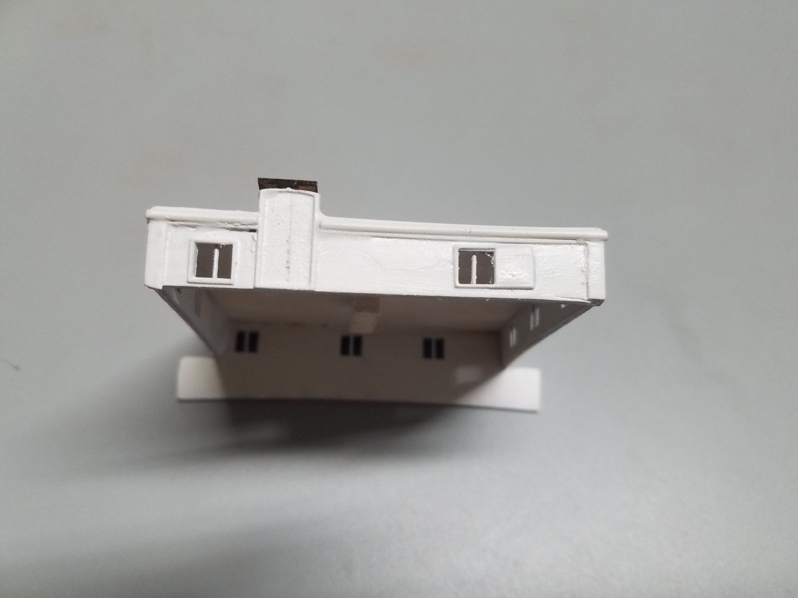

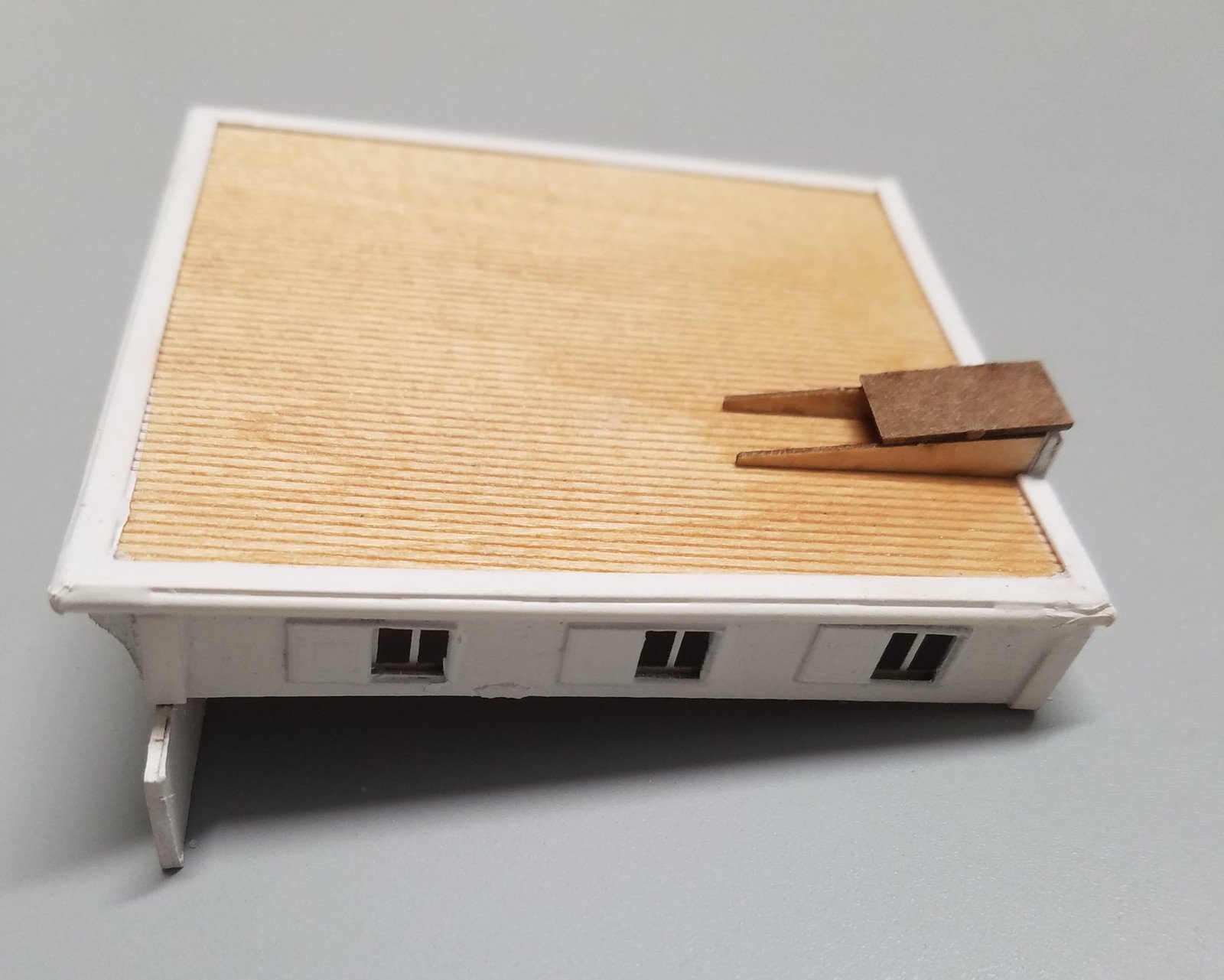

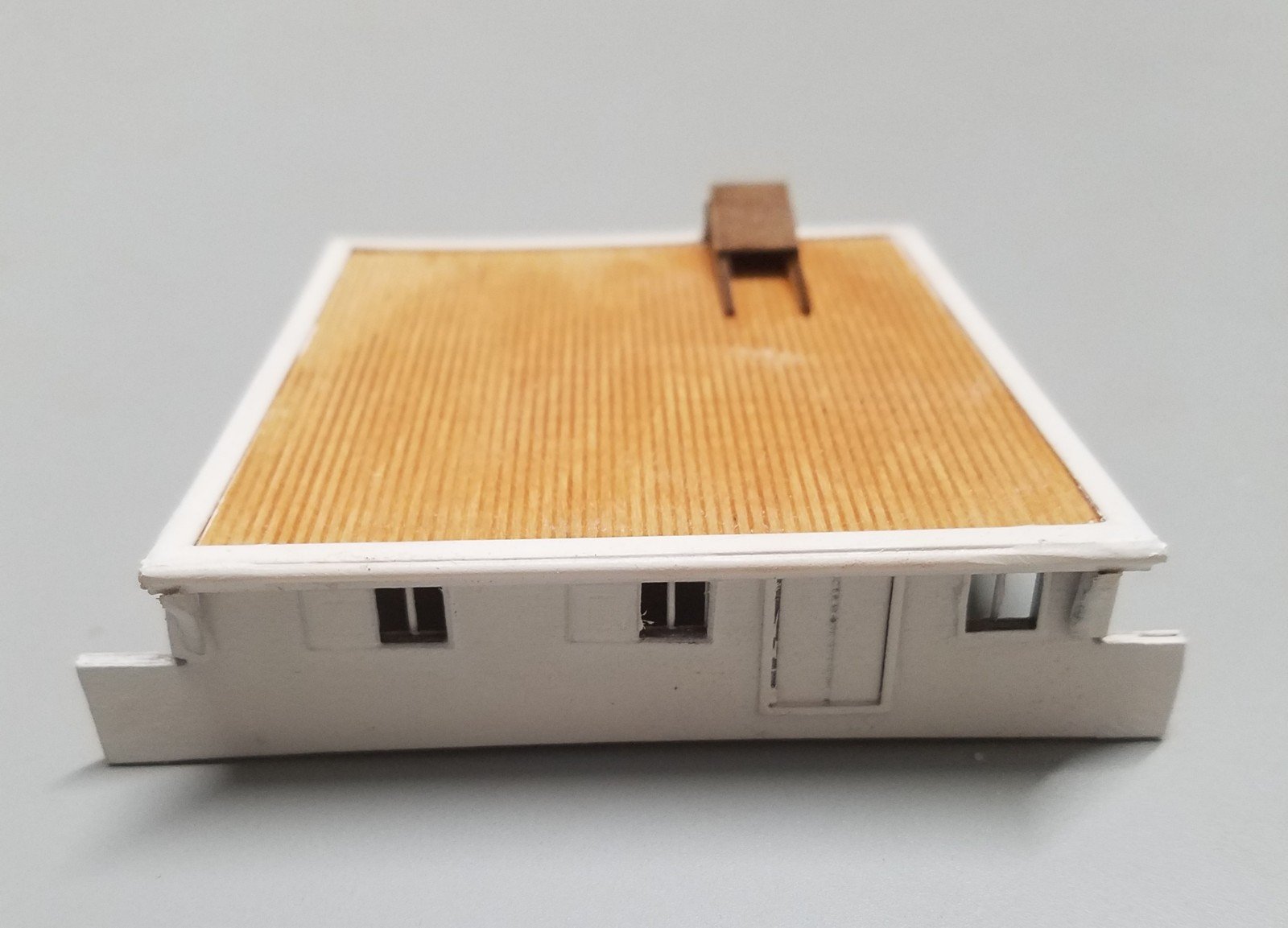

Nice rendering of the windows Al.  I've seen something similar done on other model kits in photo etch.  I'm chompin' at the bit to see the final reveal.  Looks like she's going to be a wonderful much anticipated kit.

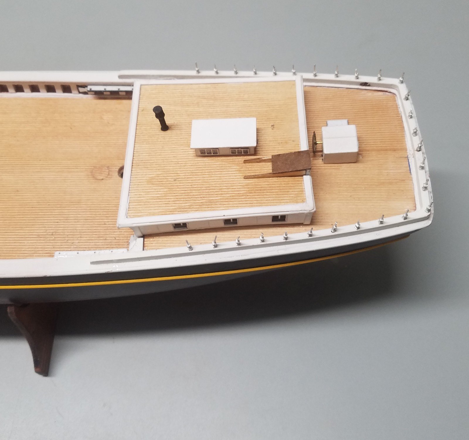

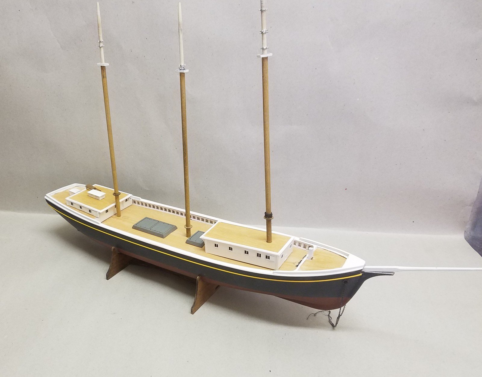

Looking more and more like the CA Thayer or Wawona.  We can only hope as they were both basically the same ship.  I'm staying tuned for coming attractions.  From the black hull color and yellow sheer line my guess would be the C.A. Thayer as the Wawona had a green hull.

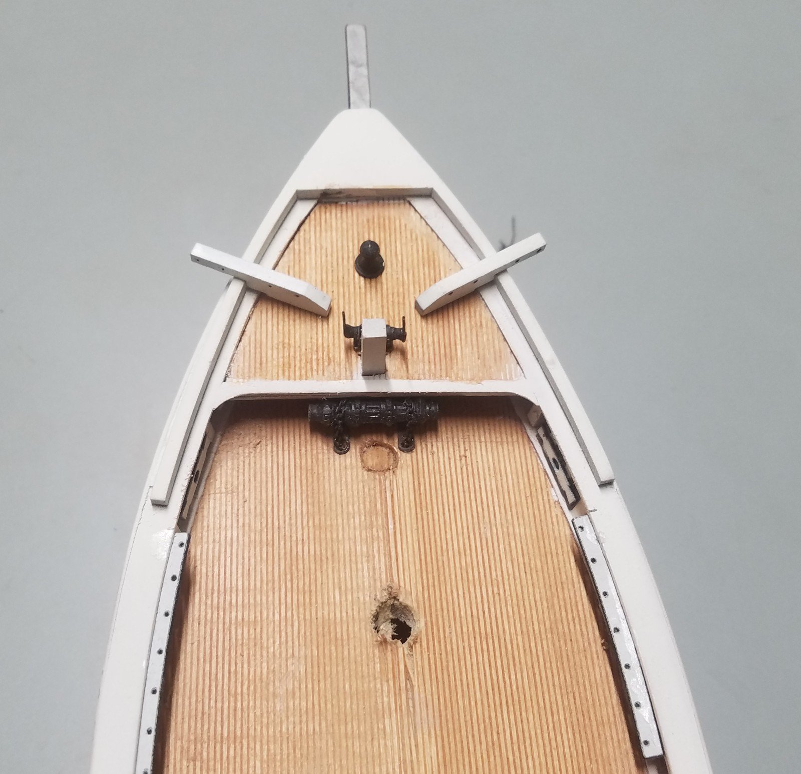

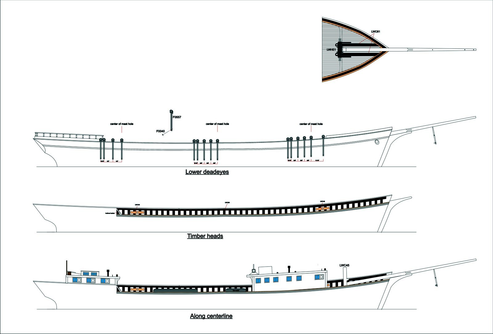

I am finding this log most fascinating.  Since I am studying the local 4 masted design, such as the Forester.  I recently acquired an older model shipways "Yellow Box" 1:128 variation.  So the various build details look to be quite useful.  I especially like the laser cut timber heads.
It is good to see an interest in these west coast lumber schooners.

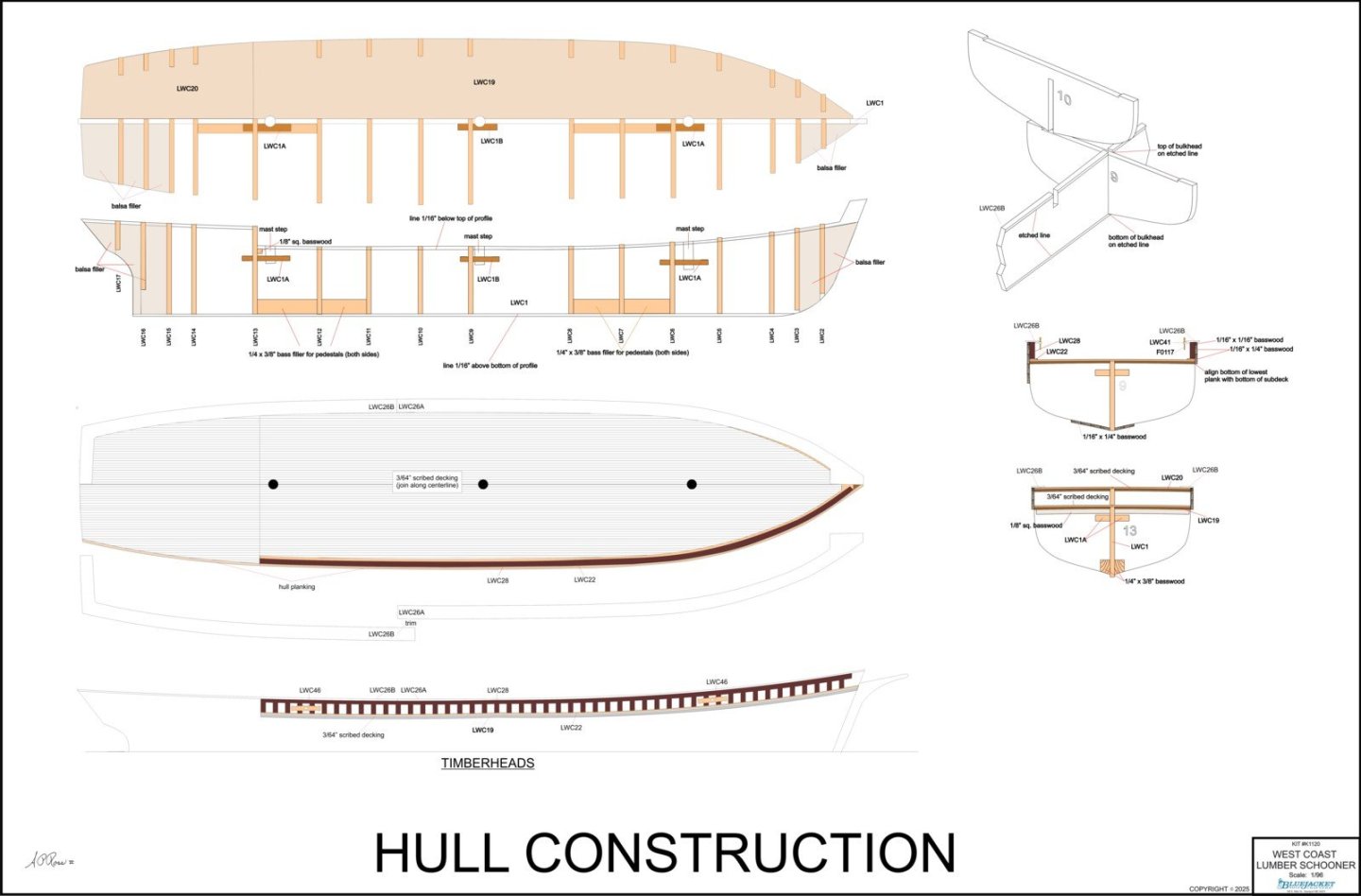

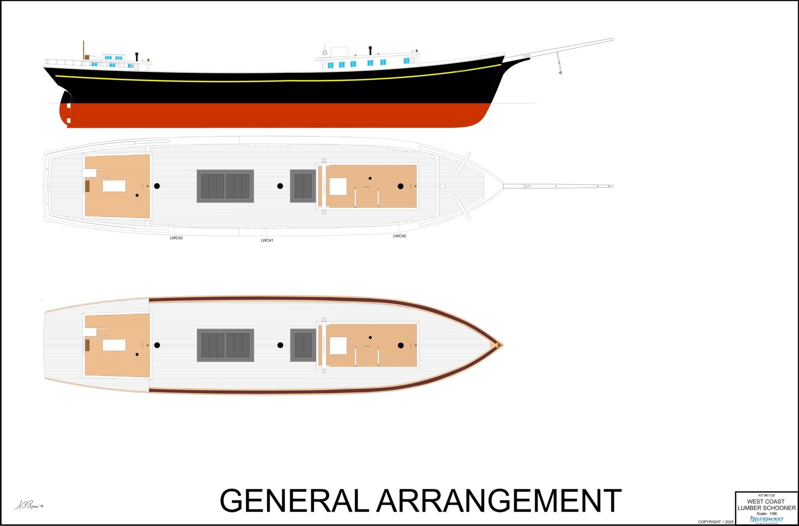

This week and next (at a minimum) will be spent drawing.  I've been creating the plans by importing the laser drawings as a base which speeds up the process and also gives me another fit check.  These two will probably be rearranged several times before they're done.  These are the 24" x 36" sheets.
