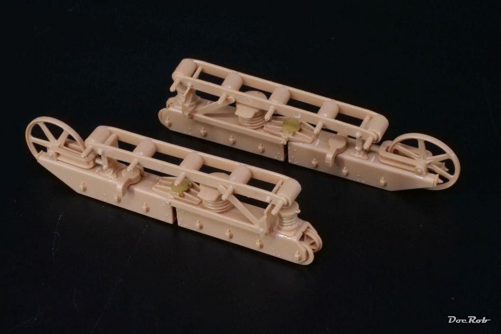

I have the feeling, this will be a short build log, I´m not used to put something together in only a few hours. I started with the under carriage, which consists on maybe half the parts count. It´s a bit fragile during construction, but in the end, it´s robust enough. Some parts like the coil springs look a bit toyish, but there will be dust and mud, so I didn´t bother. Fit was good, engineering was - hmmh - hobbybossish.

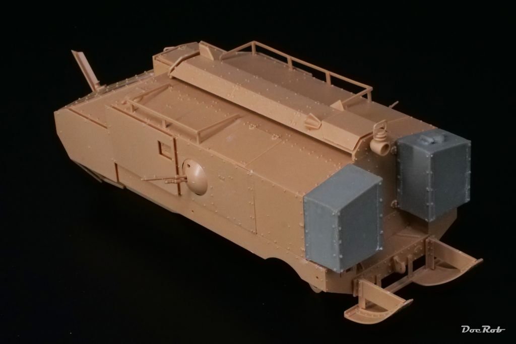

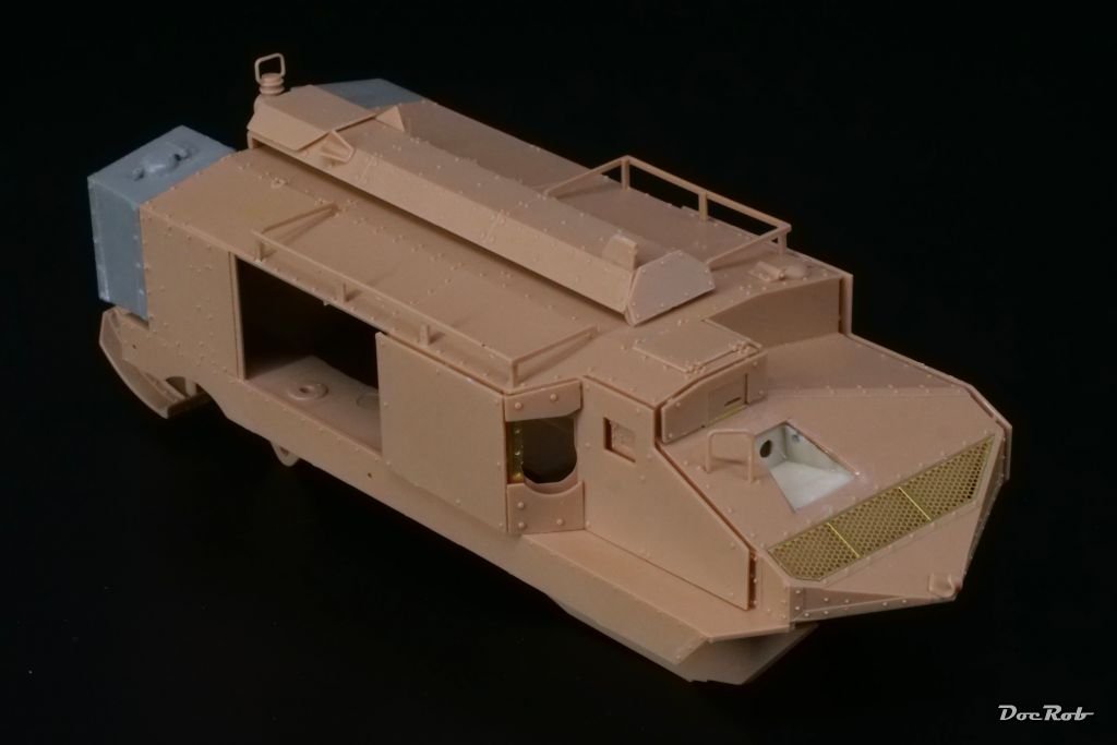

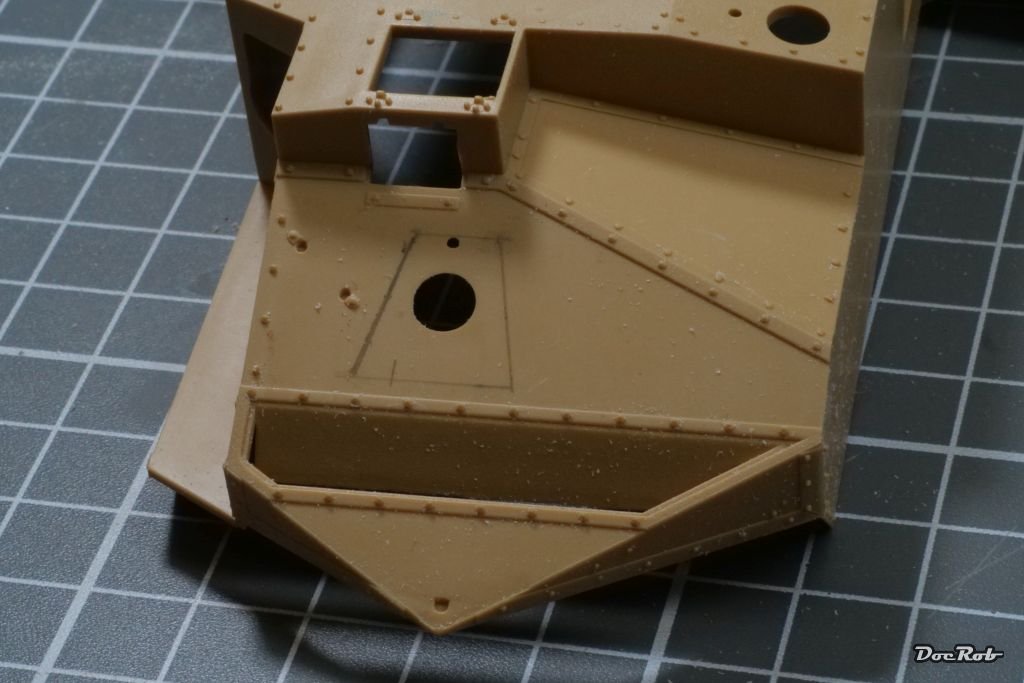

Next was the boxy body, which luckily is build up from a one piece tub. I needed to make some surgery, to add the front gun port, which only had some of the Spanish vehicles. Here the position is shown, clearly measured in the manual.

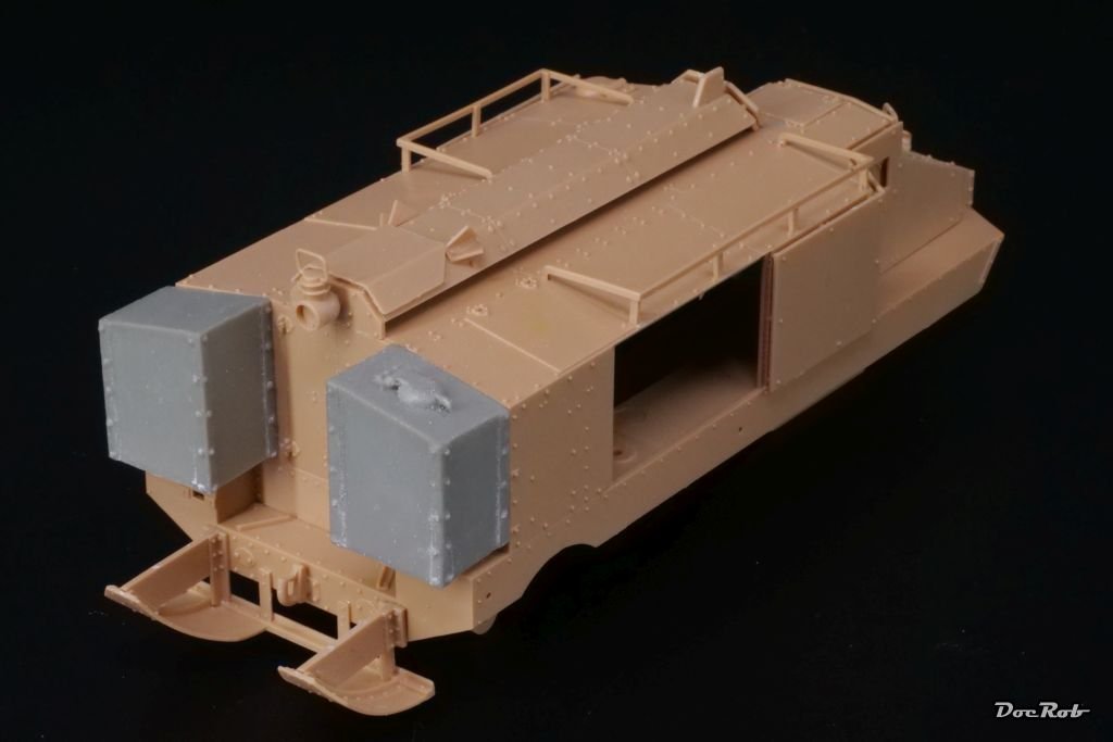

I added the gun port in front and the huge external tanks at the back. The cabin built up straight forward without issues. In contrast to the early version of the tank, this one was up-armored with additional steel plates, riveted on top of the body.

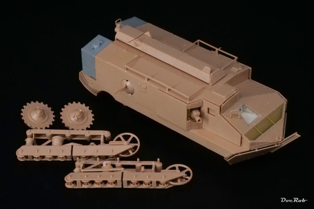

Today, I finished building the Schneider minus the tracks. Almost everything worked like a breeze and the fit of the body parts was very good. The manual suggests to add the side MG´s with their gun carriage glued to the base of the tub and then add the sidewalls with the fitting hole on. That was somehow impossible to achieve and I suggest to cut away the lower part of the gun carriage and glue the ball mount direct to the side wall hole.

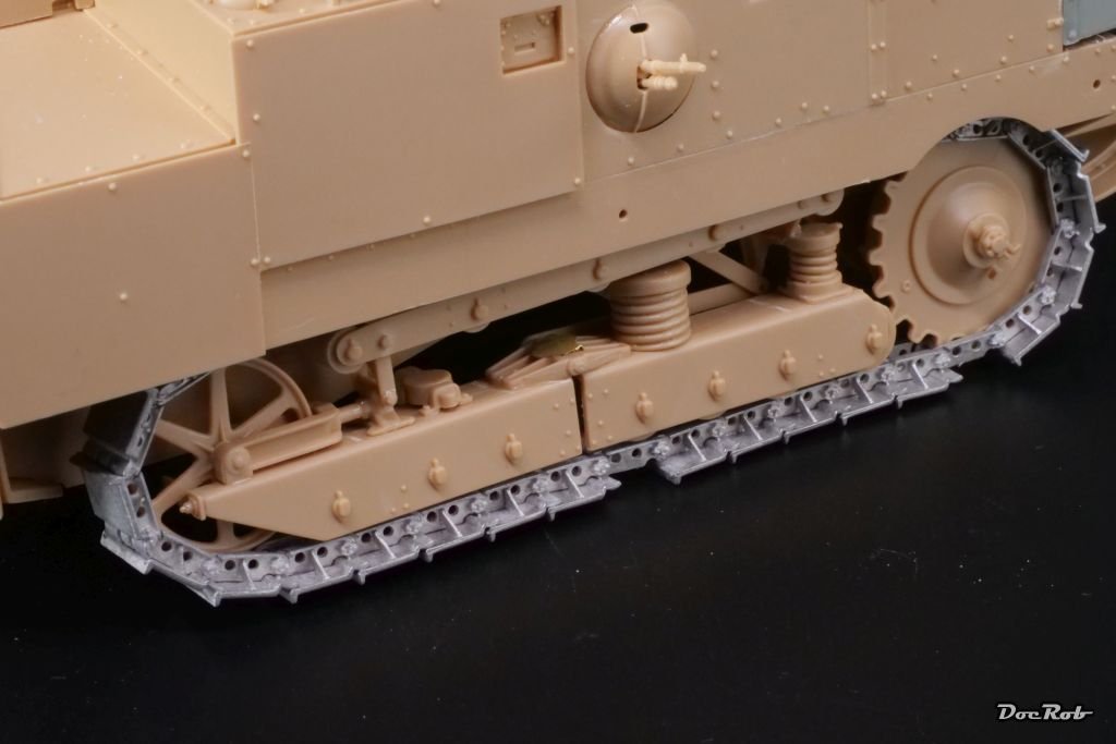

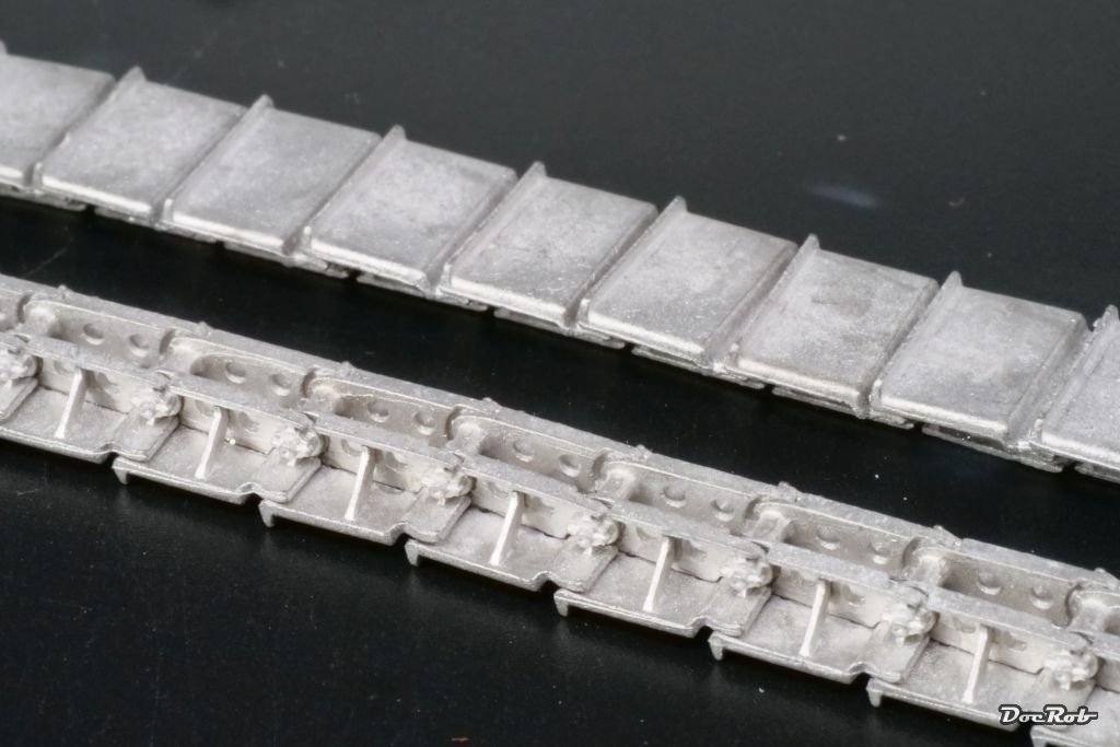

While preparing the track construction, I realized, I needed to add the running gear to the hull, to be able to determine the length of the tracks. I would have liked to add them after painting, but that wouldn´t be a big problem.
The spoked rear wheel is still movable and not glued in place, because with it´s eccentric arm, it can be used to tighten the track.

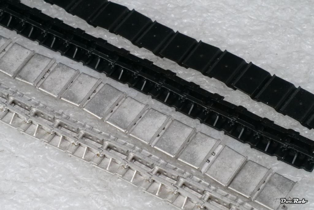

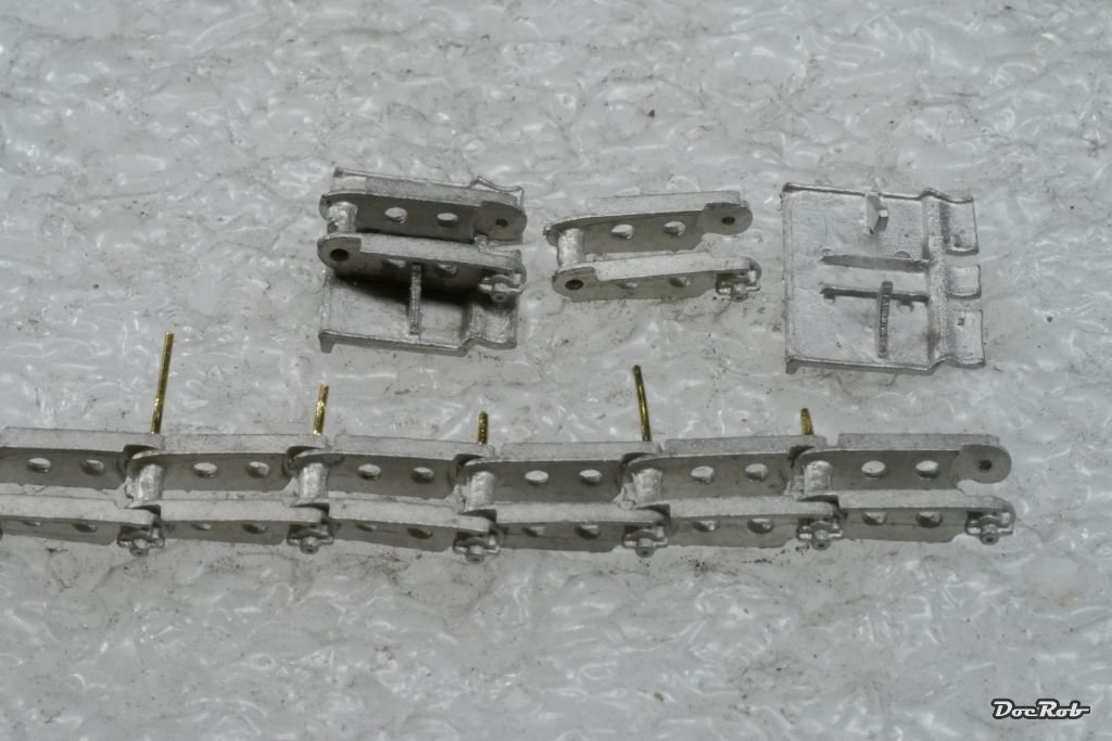

Then I started with the tracks. Every link consist from two parts, which need to be drilled out with a 0,5 mm bit and then glued together with CA. It proved to be very difficult and time consuming to put the links together and then connect them with the next link, that´s why I leaned back and thought about another way, to simplify the construction.
I found it much easier to connect the inner link parts with wire and secure them with CA and then finally add the running pads, which fell in place and were glued with CA.
The HobbyBoss manual suggests 32 links per side, but I will need 34, possibly 33, but that might be millimeter too short.
Cheers Rob

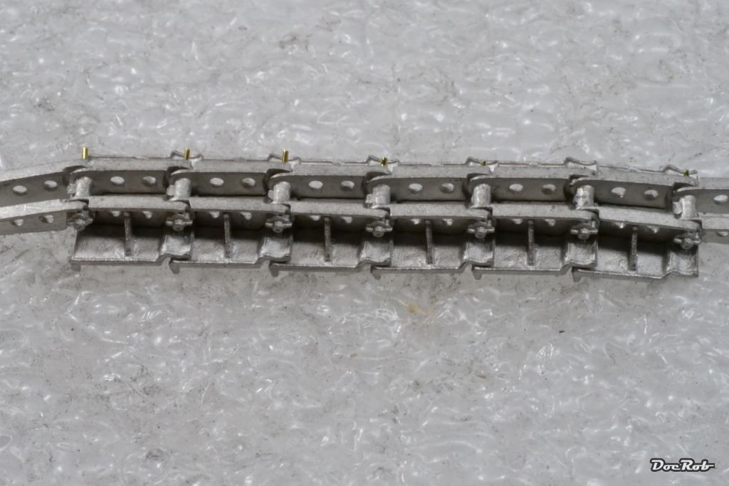

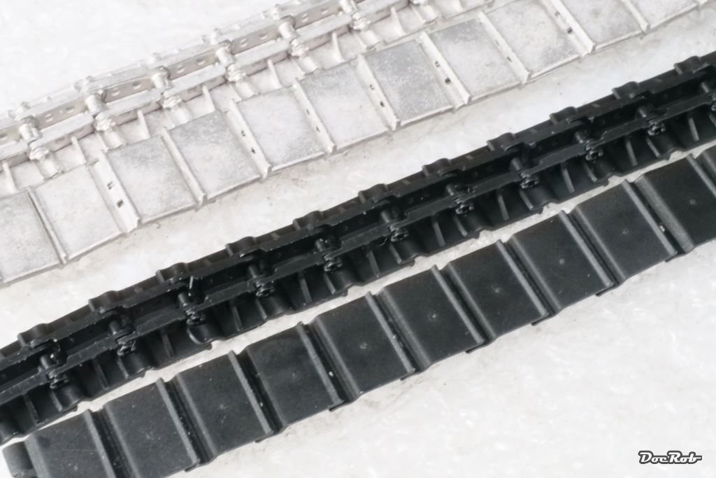

I got the tracks done, thanks to my established second effort, it went rather quick. It is much faster to build a chain of the inner track links and then the track pads drop in place with a bit of CA. Building up every track link from two parts and then connect them would have extremely more time consuming.
I needed 34 links per side, which results in a loose fit, but there are no half links ;). The manual suggests 32 per side, but the plastic ones may be different.
I will blacken the tracks later with a burnishing fluid. Unfortunately my black CA glue dried up, which will lead to non blackened areas, where there are CA residues.
One pad fell off and is reglued now. The closing link remains without pad until I finally mount them.

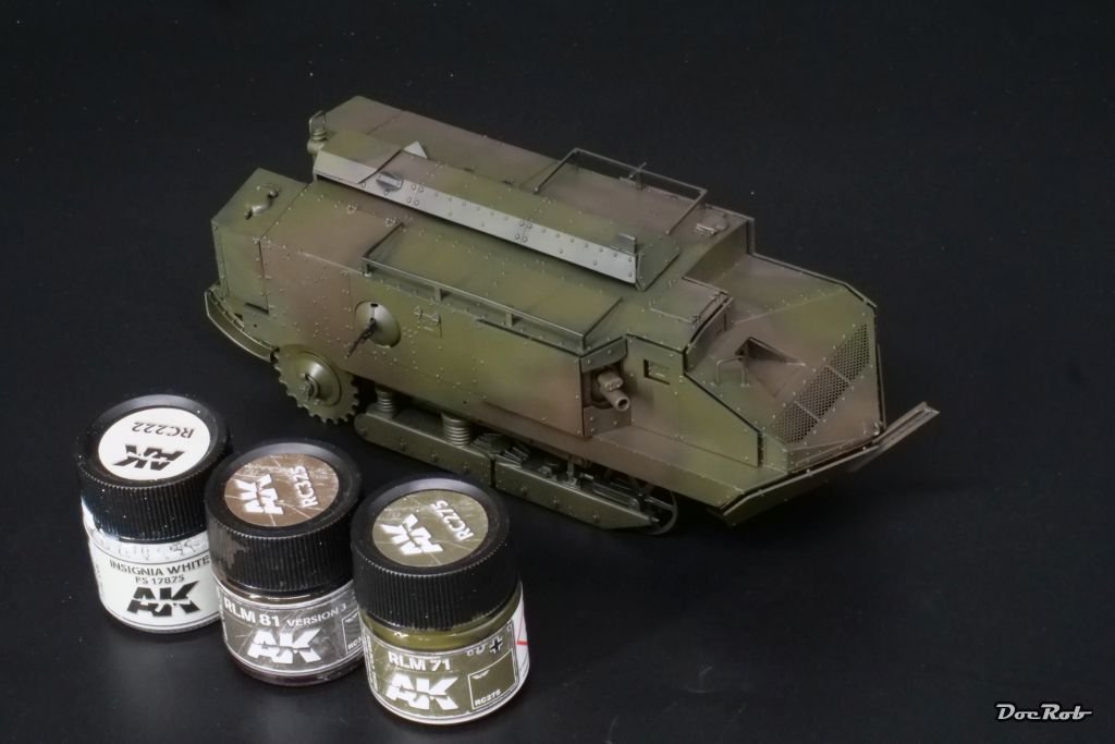

Meanwhile the Schneider itself got black primed with Mr. Surfacer 1000.

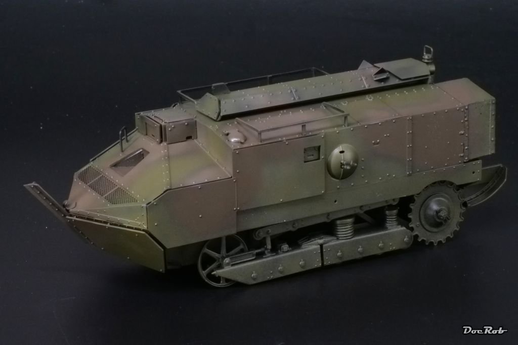

As I mentioned above, the twist with this build will be, that this outdated fossil from 1916 was still in use in 1936 in the Spanish Civil war with the Republican forces against Franco´s Nationalists.
I guess, over their period of duty, the six? Spanish tanks served in Maroc and with their age, I assume, their state of maintenance not to be the best. I will try to show this appearance through the camo paintjob, which was sprayed translucent and freehand over the black primer, with heavily thinned AK Real colors. I made a second pass with both colors, adding a drop of Insignia White and tried to work a bit with highlight, shadow and modulation, which is not easy with a non-monochrome body.
Anyway, that will be the starting point for further painting and weathering stages and of course for decals.
