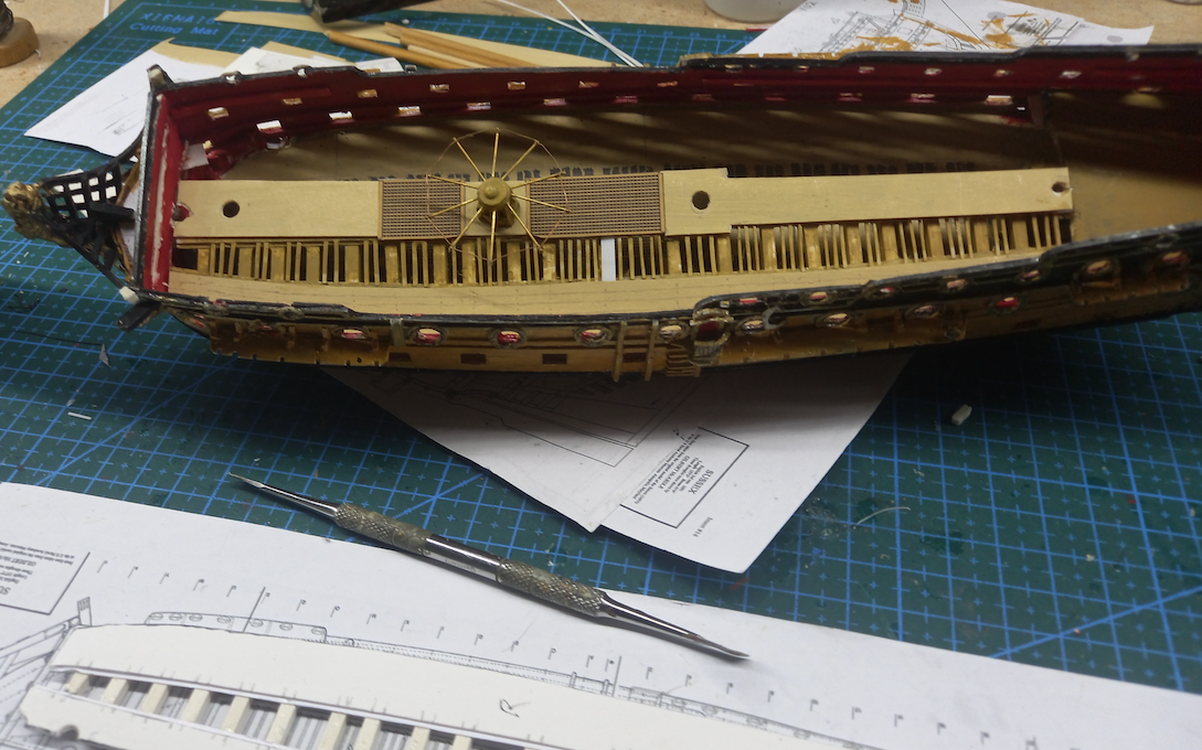

The deck clamps on the inside of the ship's sides were glued in to fit both the decks on the correct height. The masts could provide sufficient orientation and enough stability to get everything temporarily in place.
Then keel, stem and stern were cut from 1.8 mm card and the whole upper works could carefully be glued together.
8.png.cd86154f13b2d5390b23b09a6eebb940.png9.png.c773d82b847bb230d01b9244ef553ed3.png10.png.8855edececd95781f5f06ea78ea2d230.png11.png.83573504b12d49337cda24bfdf4802eb.png

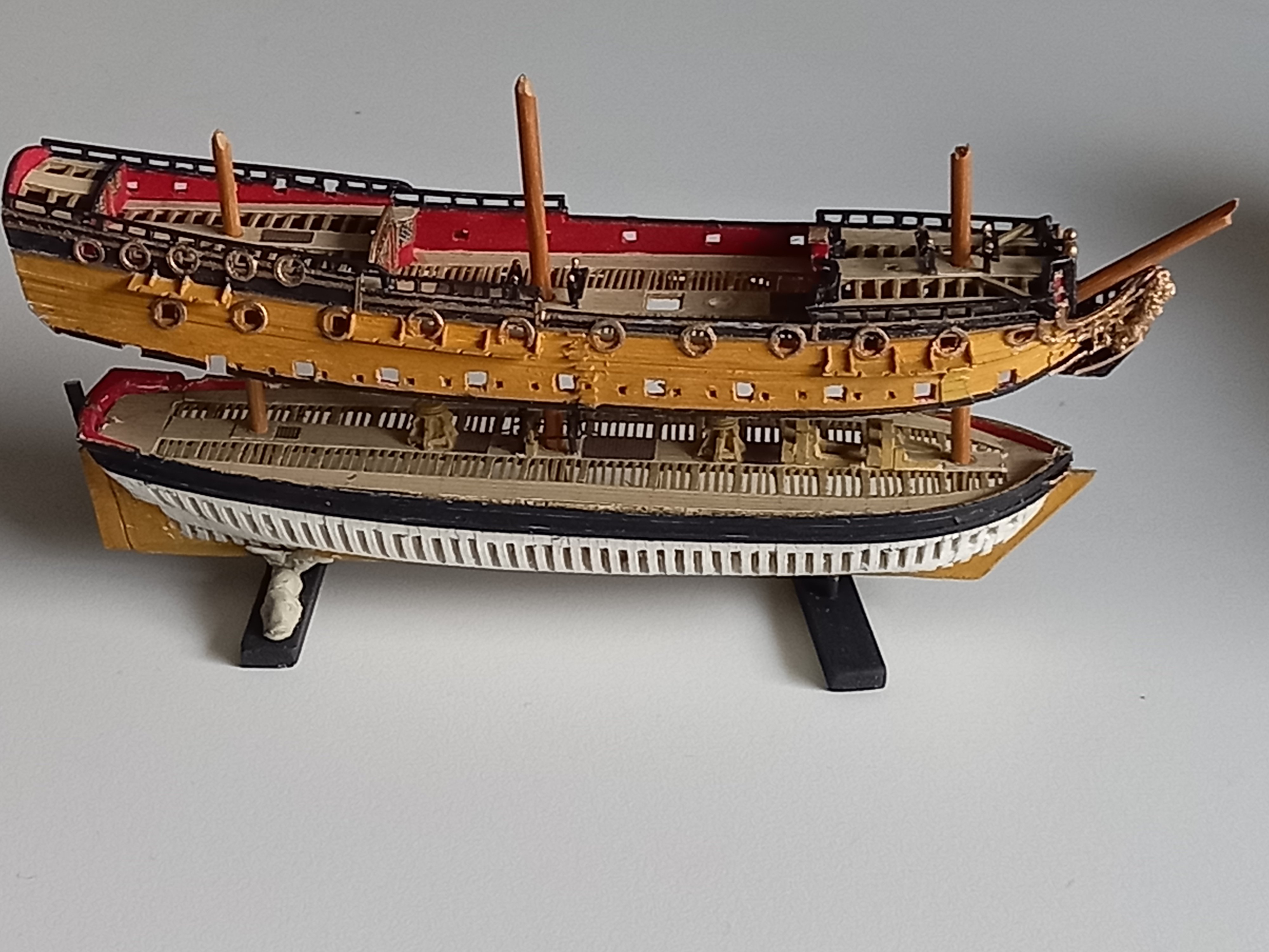

In the mean time the frames-block below deck were completed, and sanded into shape. After precisely marking the locations of the interruptions between the frame parts, all frames were separated to cut the inside to shape, taking care that the horizontal top sides were maintained to be glued to the underside of the lower deck in order to get everything back in place. 12.png.9a3fa27ac09e79dff1110f3f94b70510.png13.png.624463336e8e7a529c43dbad50c002cc.png
Even the sanded block had to be sanded again after all frames were glued in place, but no real problems showed up. It went better than I expected. The next problem to be solved was the lining of the openings between the frames. However precise I tried to be, small deviations from the markings showed up and had to be filed to keep the lines fair. Therefore I modified an old lock file in a way that the thickness was diminished to 1.5 mm and the narrow sides still held their filing profile. A drop of AC glue brought the necessary sharpness back to the joints.

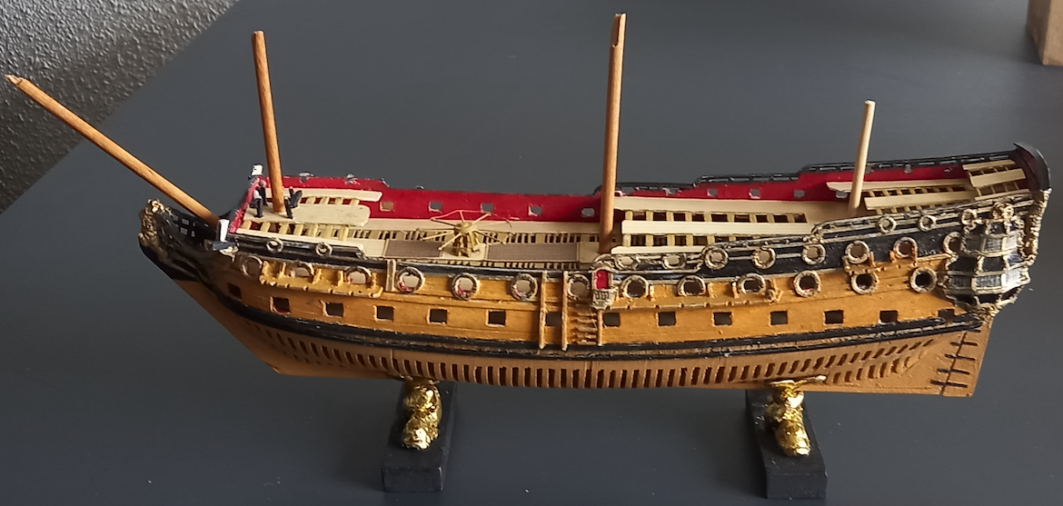

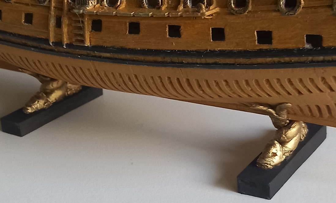

Special attention had to be given to the stand of the model. Normally I make a very simple card stand, because it serves no other function than to keep the model up right. In this case the model was presented to the king as a thing of beauty and the stand had to meet the same purpose. So I kneaded some dolphins supporting the lower hull with their tails on both sides and gilded them. Inside was a brass tube and a fitting piece of brass wire made the connection. The first couple I made appeared to be too big, so I made a second pair, with a slightly better result.

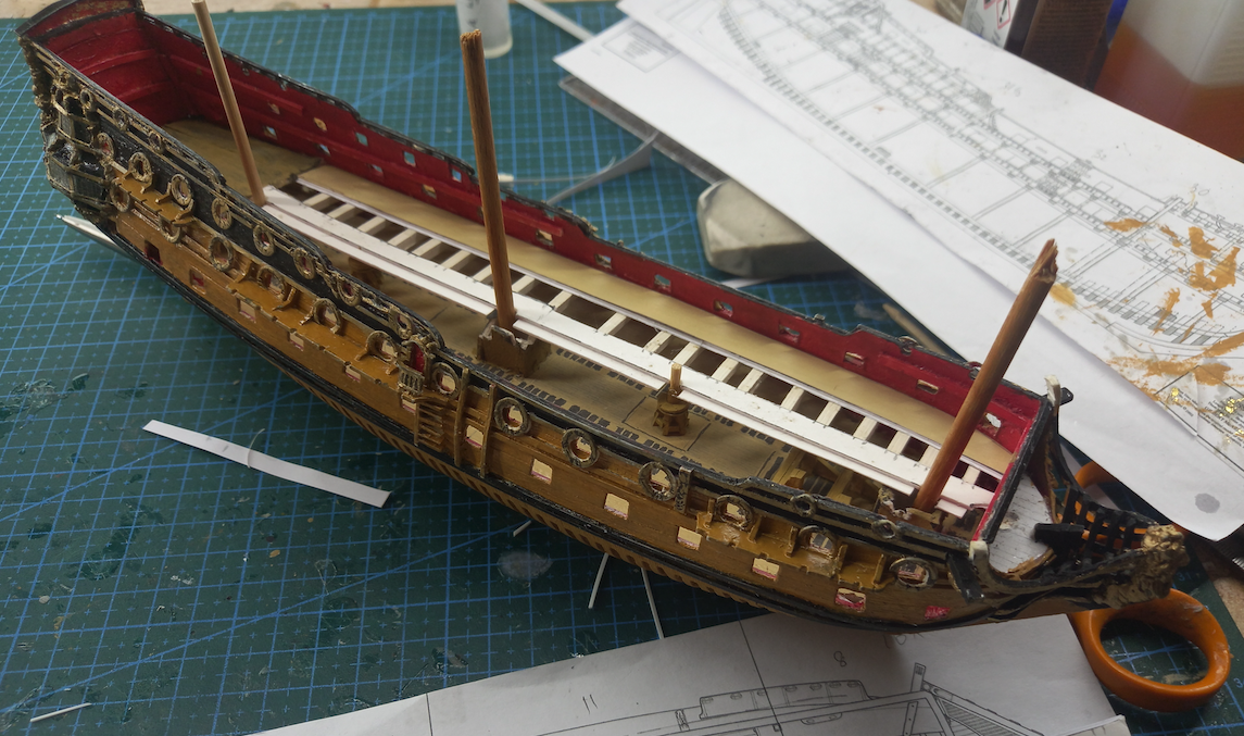

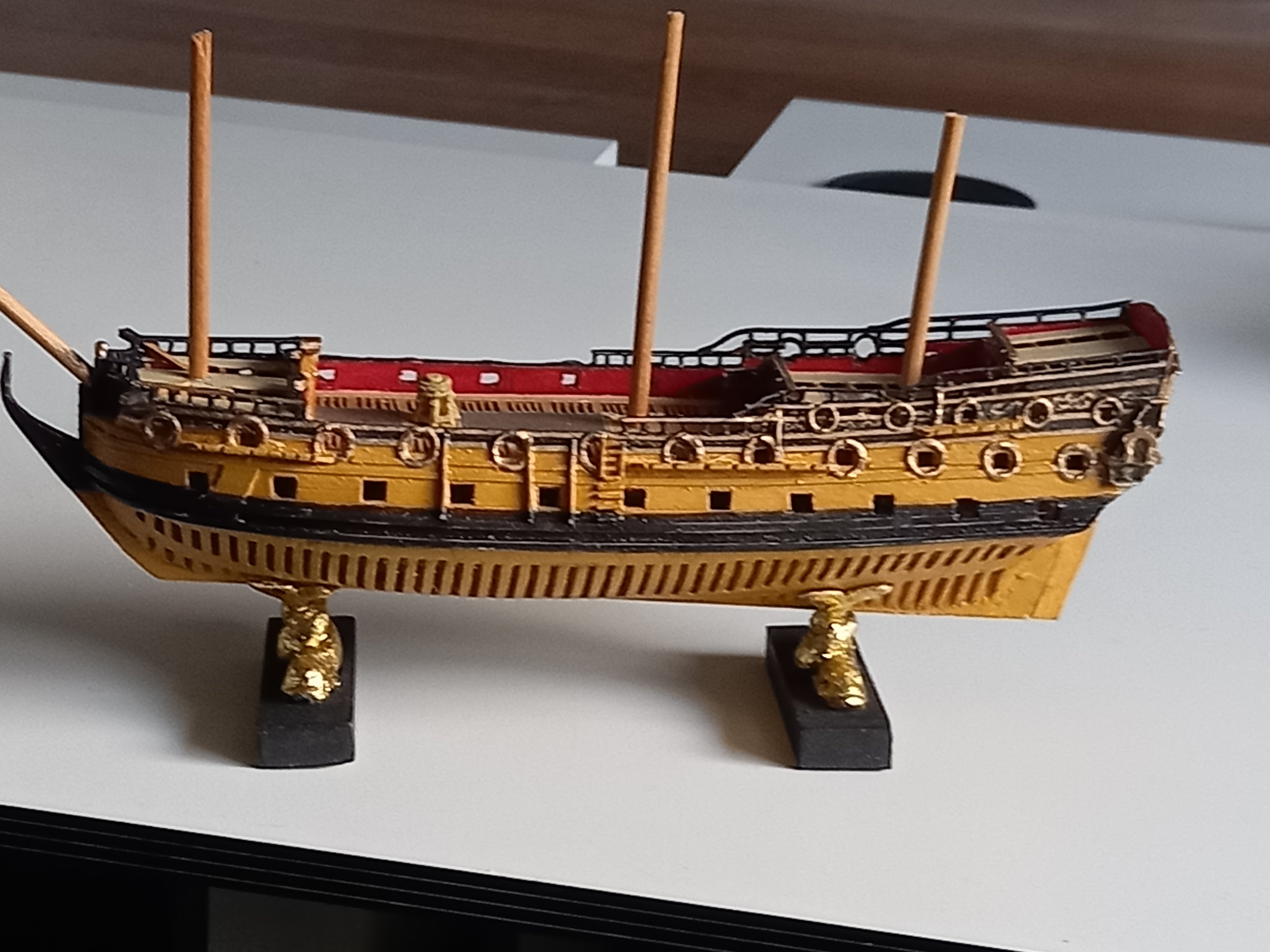

A small update. Work on the ship's sides continues.
Hard times are to come. I fear I will have to remove the upper deck to dress the lower one. Besides I want to make it a bit narrower, so destruction is threatening.21.png.3a21432167acac6ee600106d68f3fbb8.png

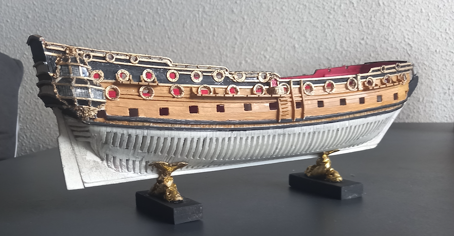

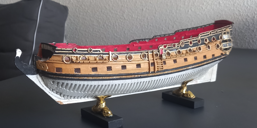

I'm not sure what to do with the lower hull. The sides of this sort of card color differently than the surface, because the paint seems to intrude the material. Perhaps I will use shellac first. This project grows like tree.
I gilded the stands, but I find them a bit too shiny in comparison with the model, which has no gilding yet (only gold paint) and I have many hesitations for using real gold on it. I really am struggling to get rid of my love for worn out ships in this project. I seem to be a bit scared of brilliantly shiny images.
But the build is a lot of fun.

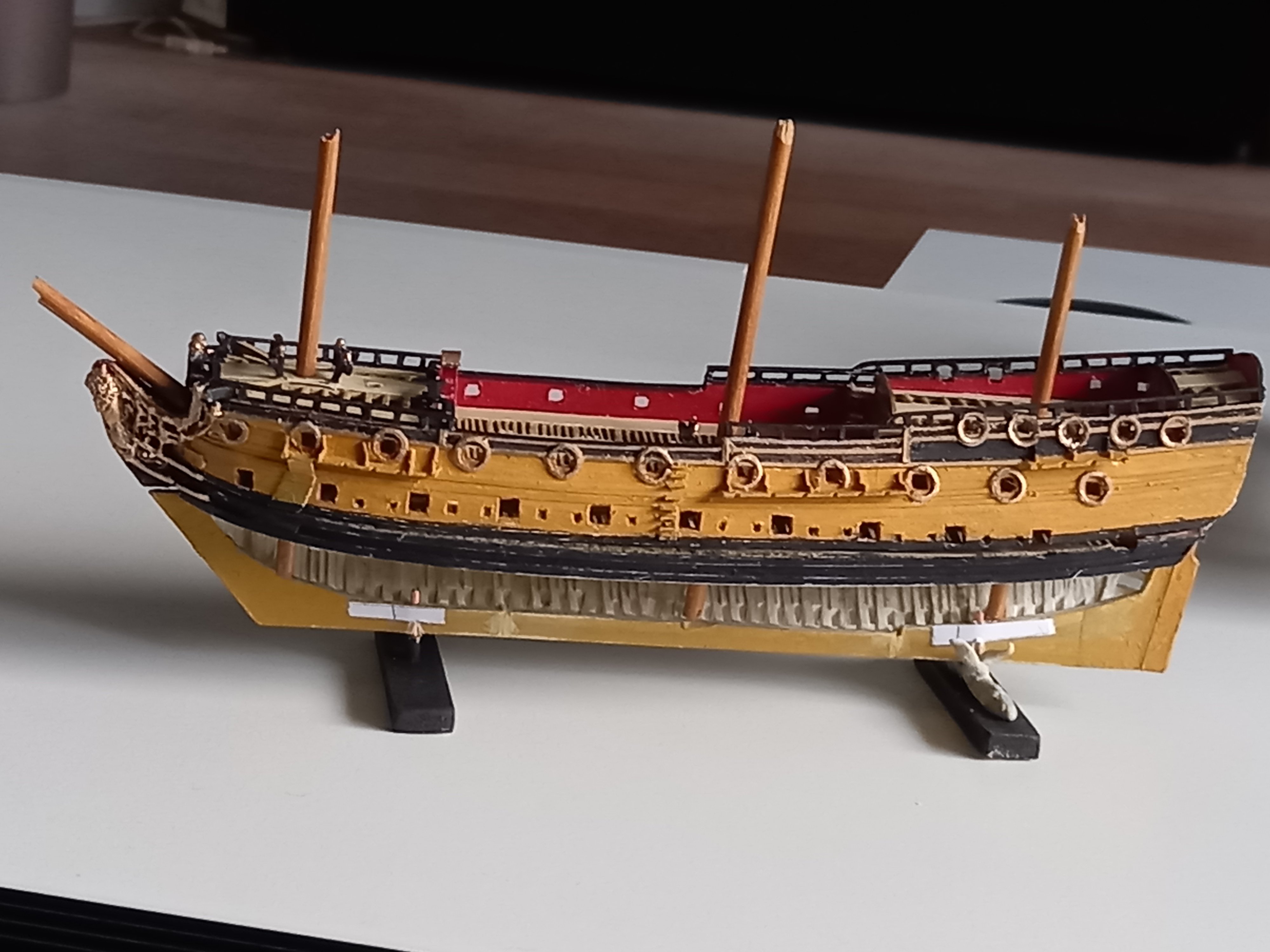

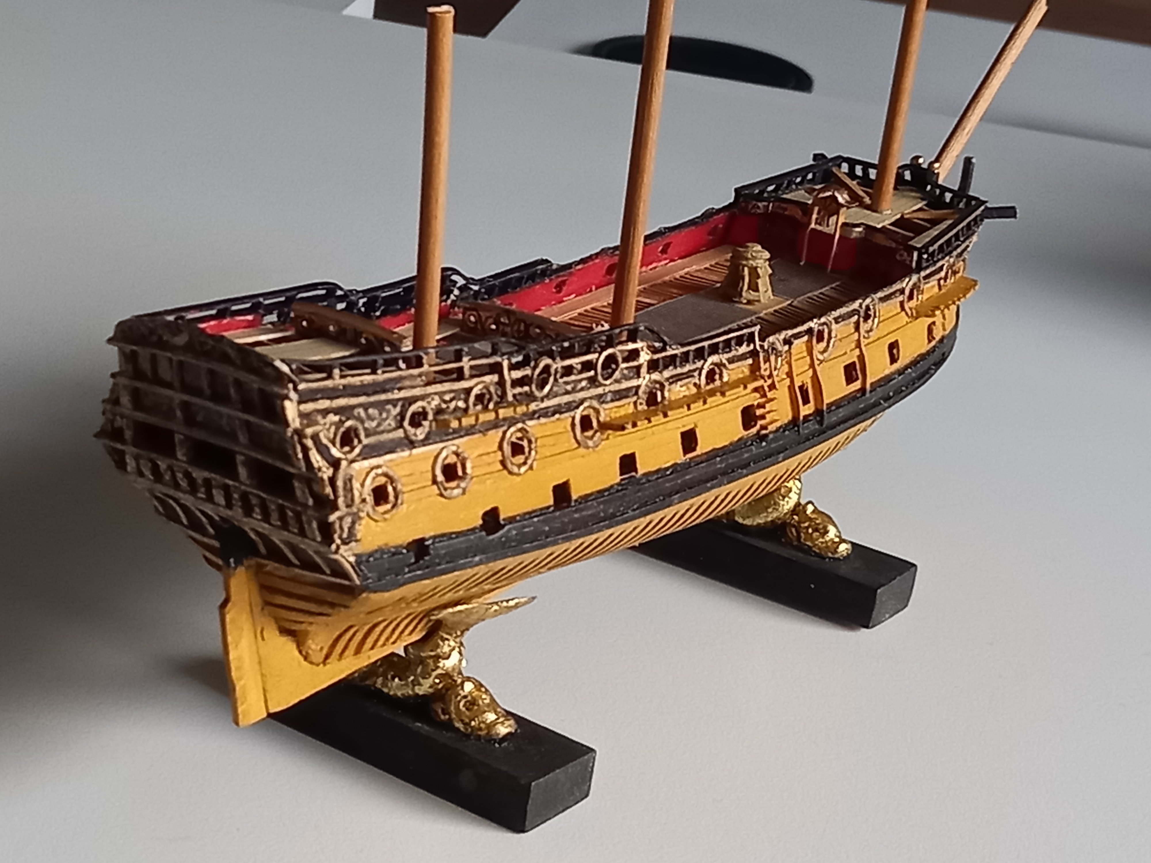

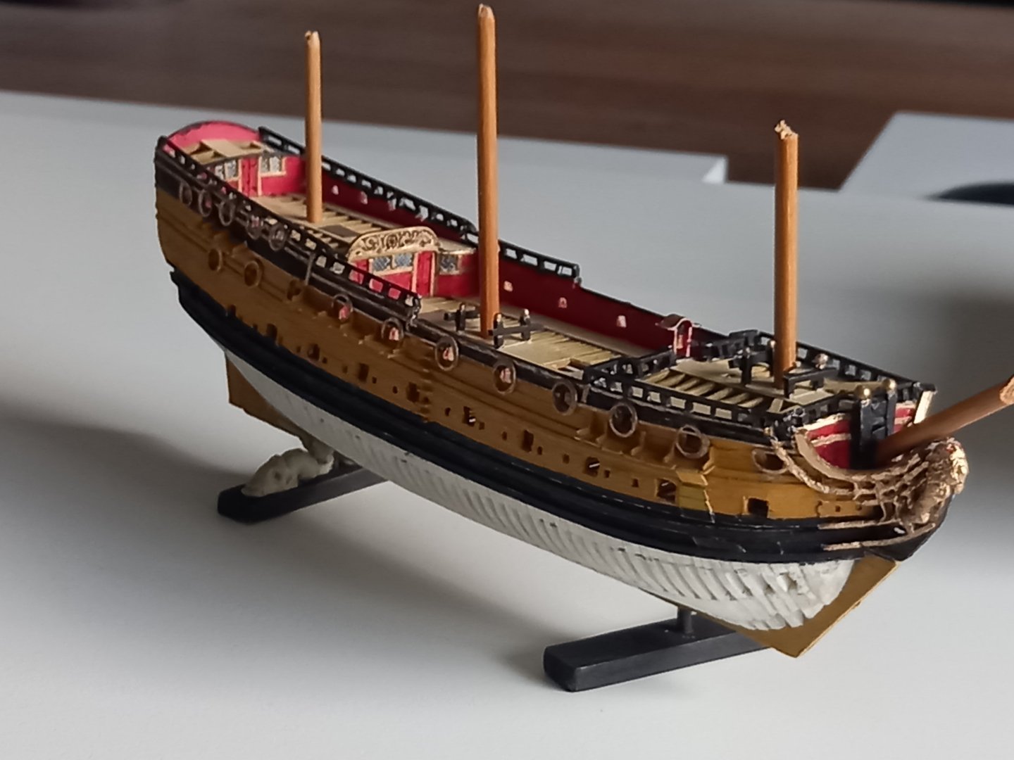

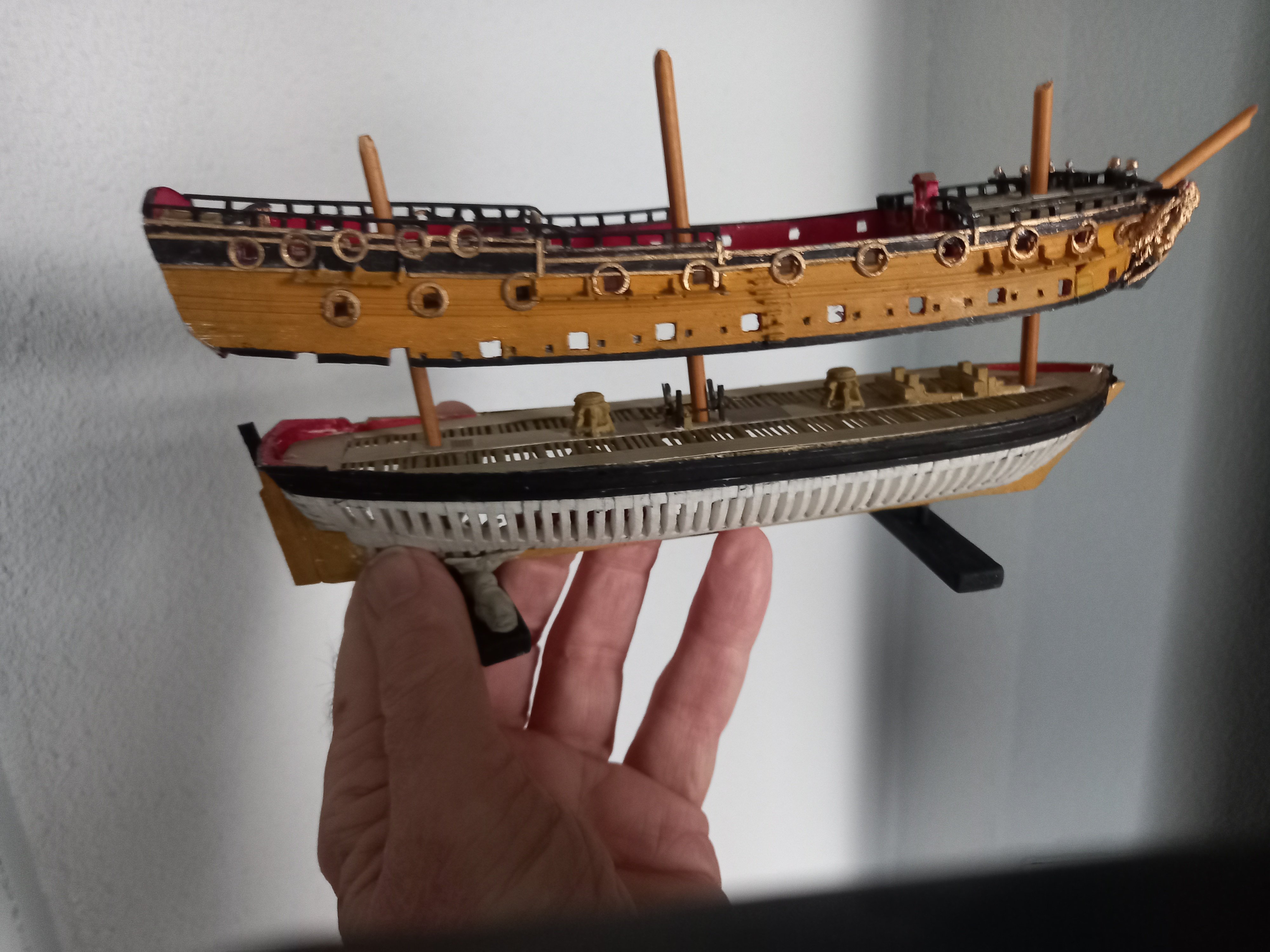

Much progress over the last fortnight.

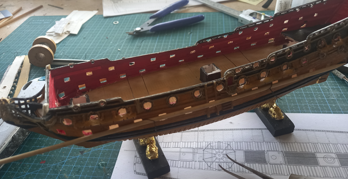

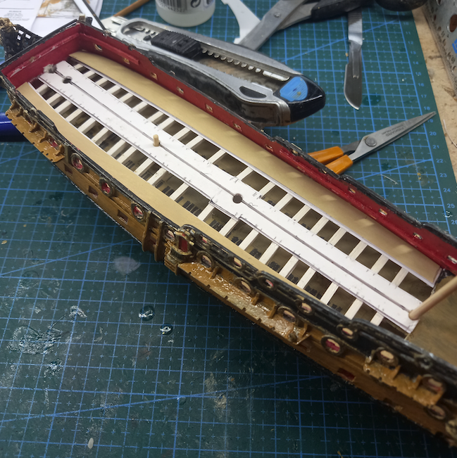

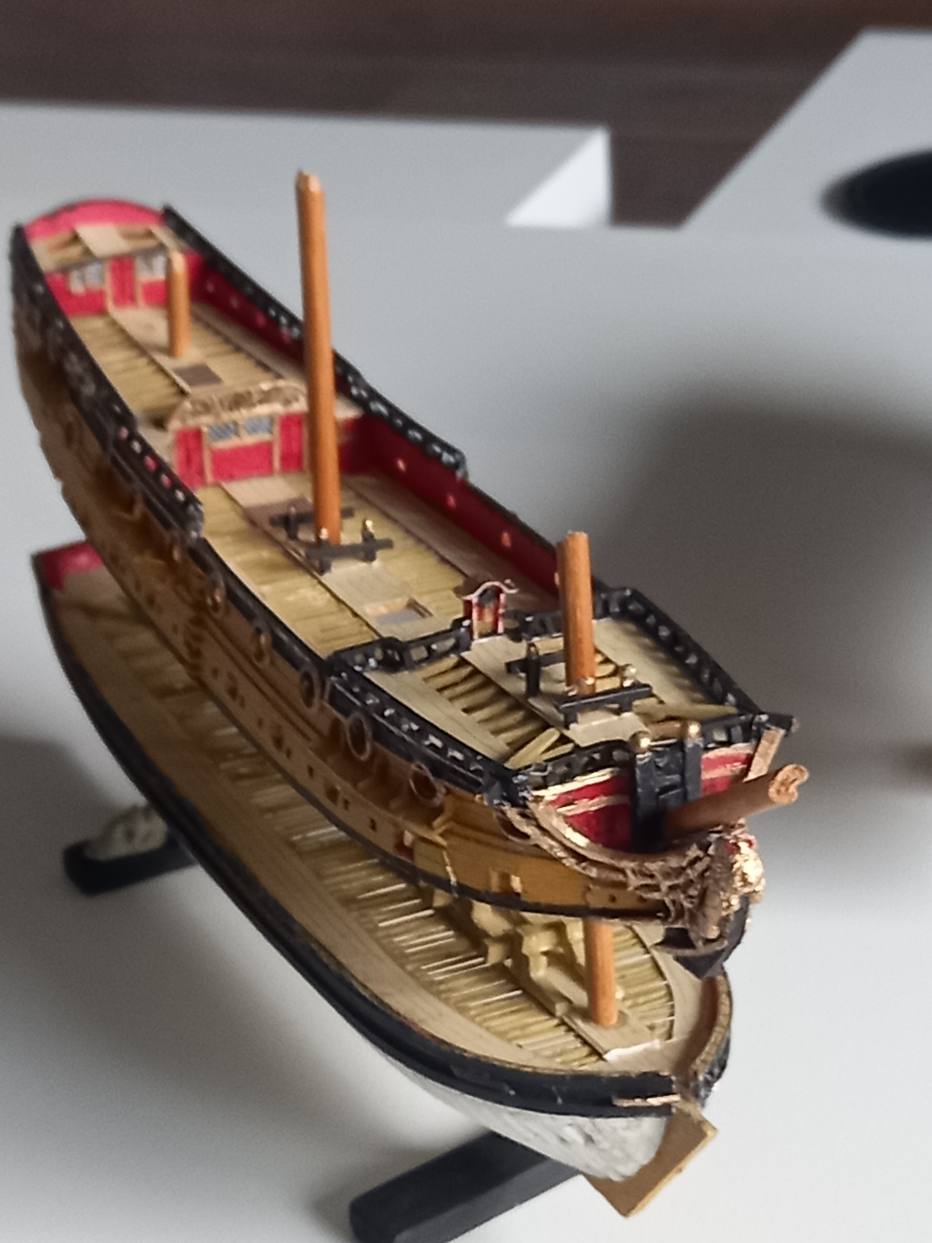

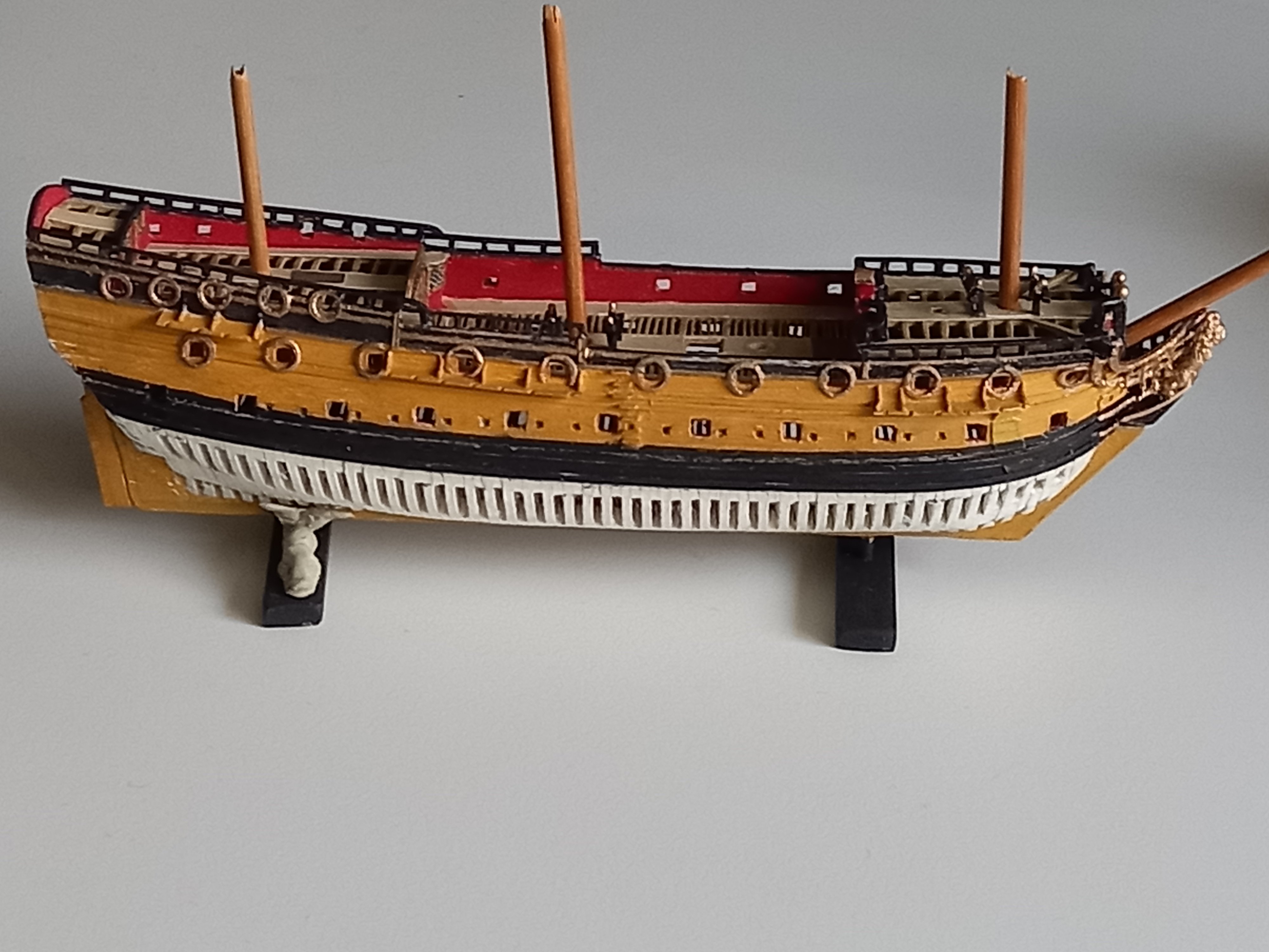

I removed the upper deck without damage and did the necessary details on the lower deck, like the (double) bitts, the gratings and the capstans. They will hardly be visible in the end, but it is always good to know they are there.
I also tried to squeeze the model back in shape with a few sticks tied with an end of wire. It looked good, but with hindsight the mounting of the upper deck brought back the too wide sides. A failure.

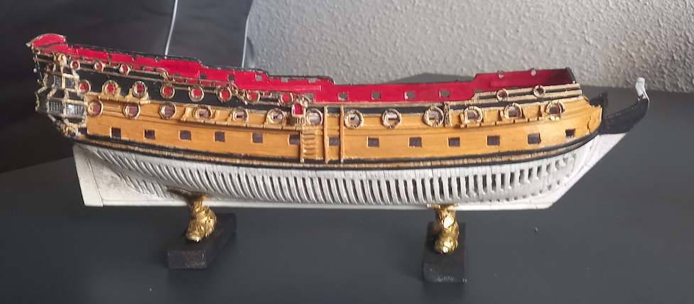

I treated the underwater part with shellac first so that it could be sanded easily to get rid of some fluff. I'm not sure about the color. In the back of my mind it should be a bit lighter than it turned out to be. Maybe I just have to get used to it.

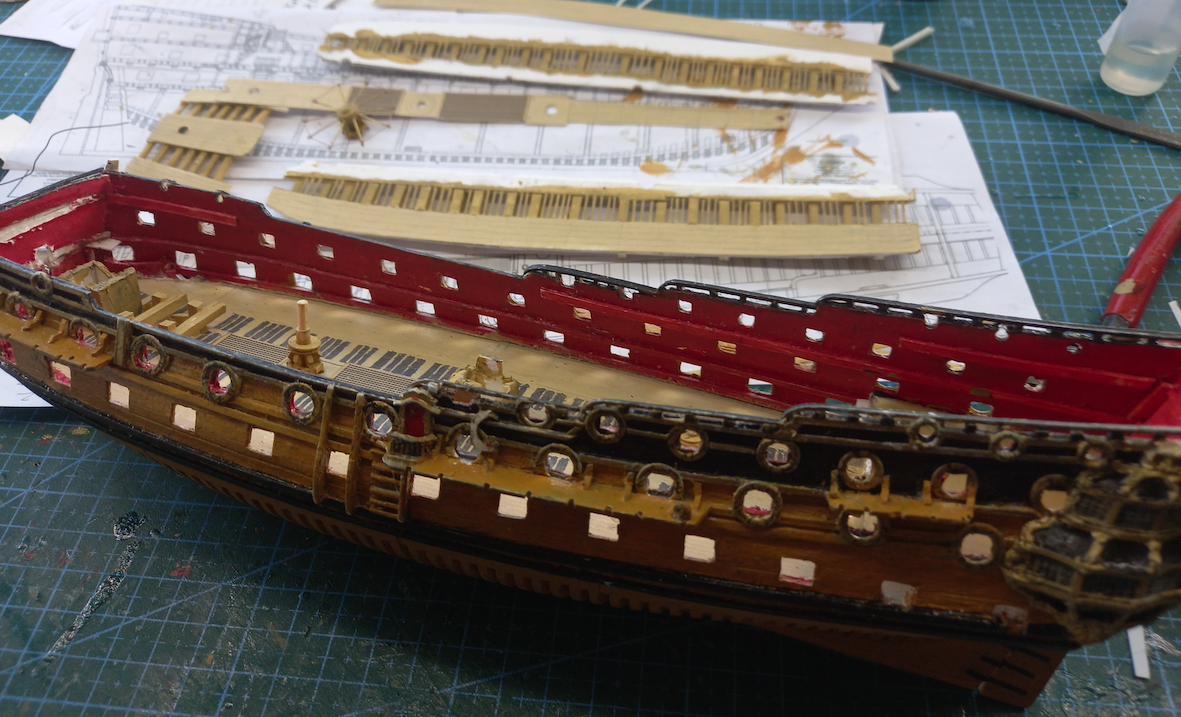

The mounting of the upper deck was a nice experience. I decided to split the deck into two halves, which could be mounted one by one. Because of the deck beams I had to roughly take down part of the supports I had created around the masts. Nothing of them will be visible in the end. The seam was covered by the 'planking', a sheet of prepared and painted paper. It all fitted to a T, but the deck turned out to be 2 mm too wide. Not something to lie awake at night but still...
29.png.71e5c78307e368a5a766f4d07cfced45.png30.png.4421a26c82fdaf3a62ca7bafc26b0da3.png

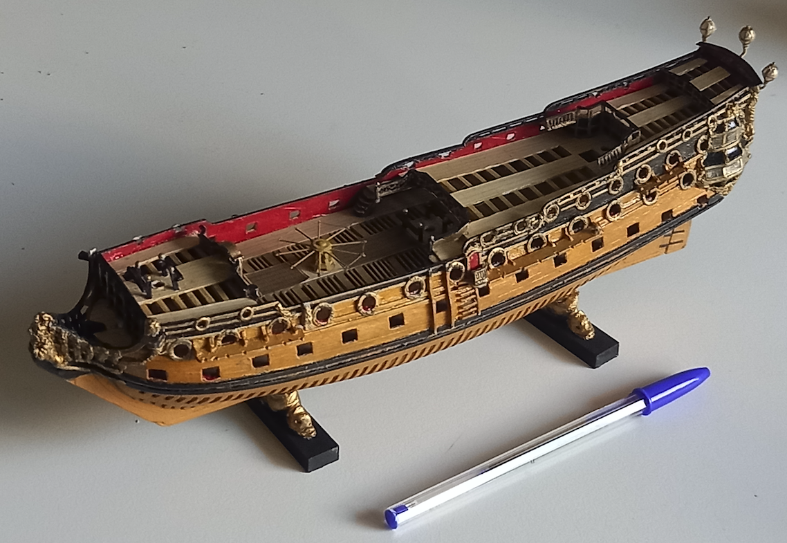

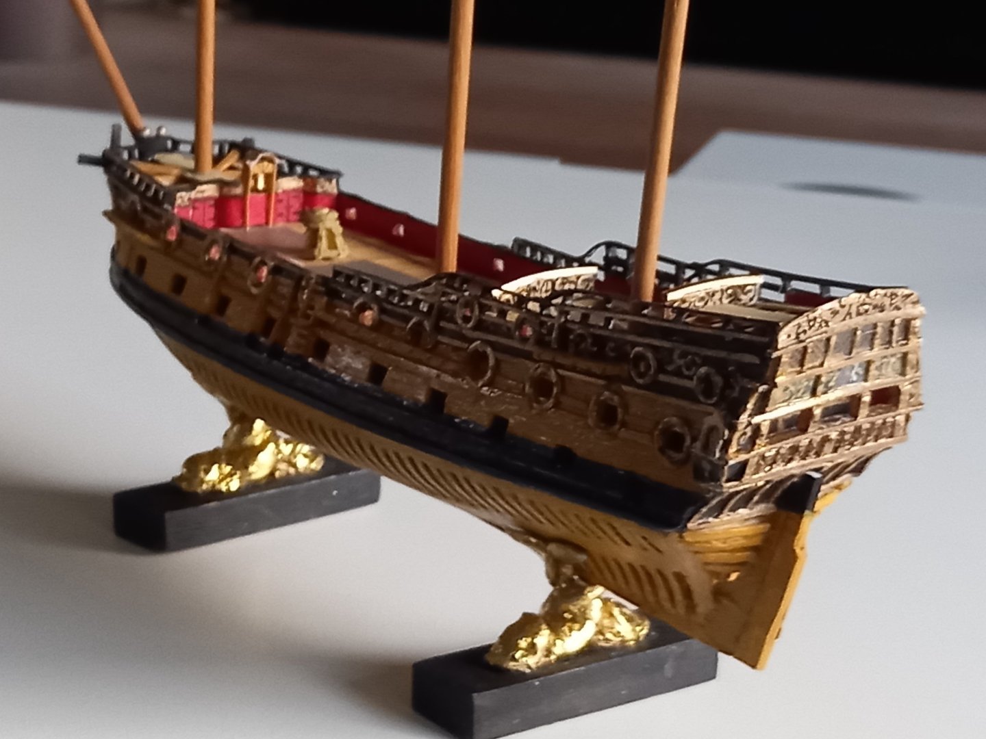

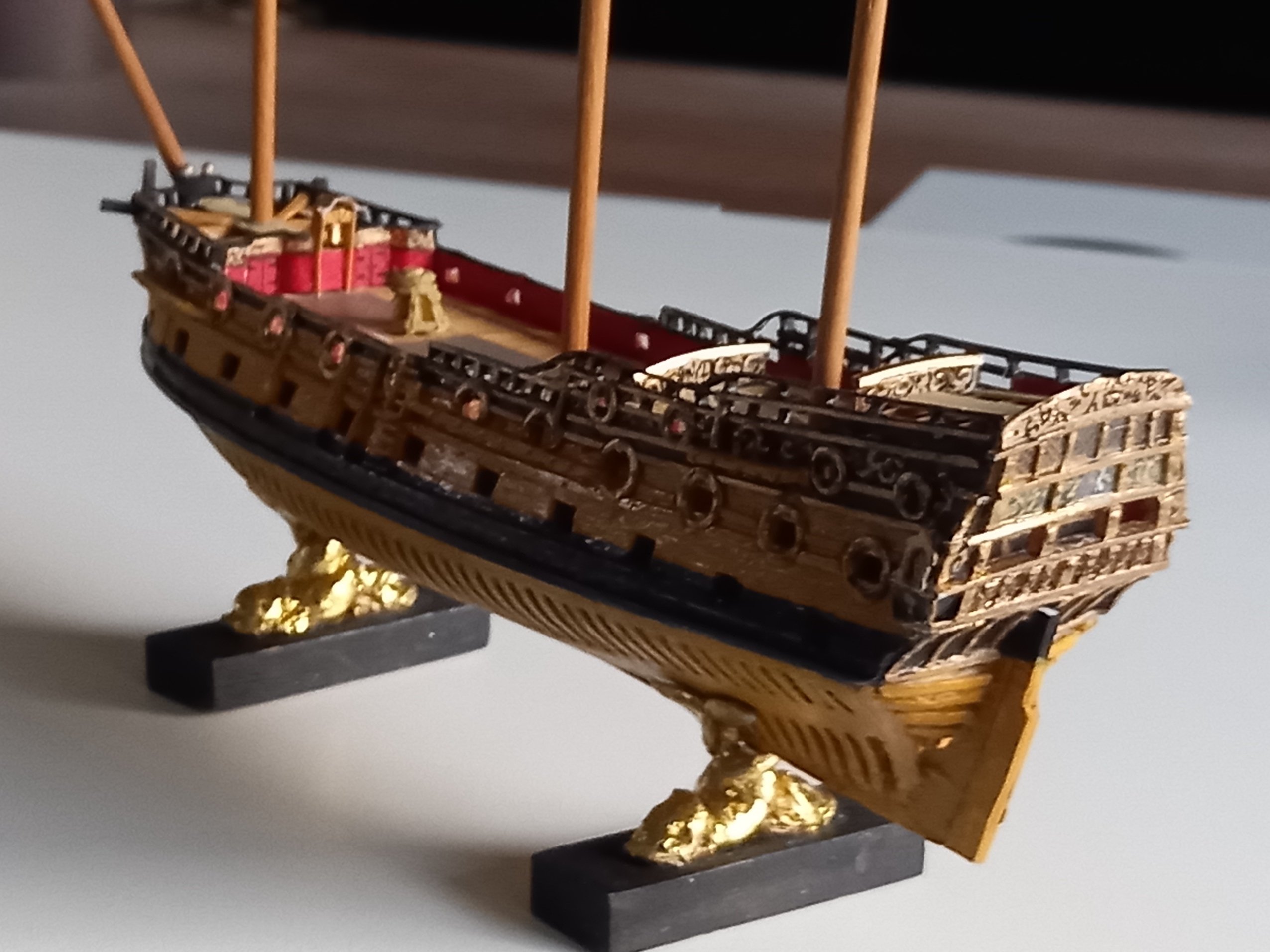

The capstan on the lower deck continued at the upper deck. The other decks were quite straightforward to model and mount.

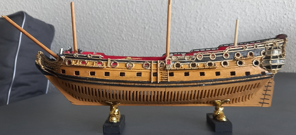

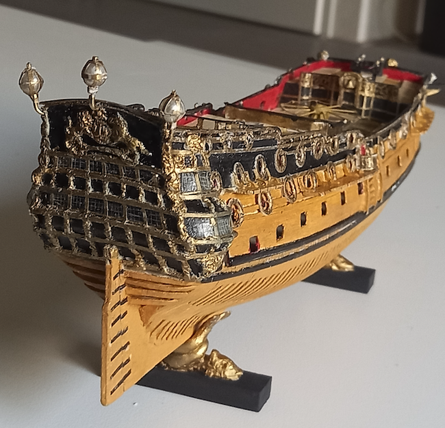

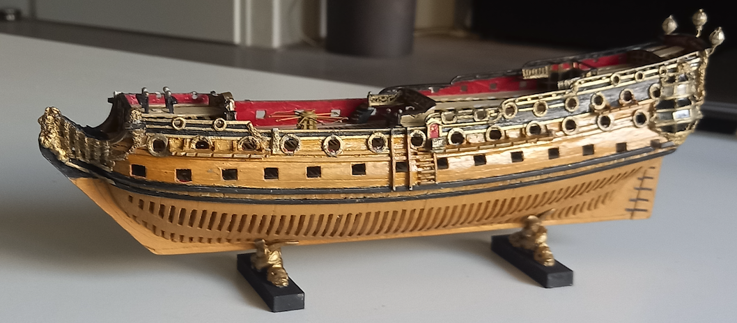

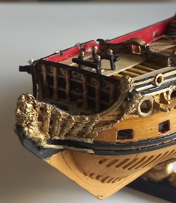

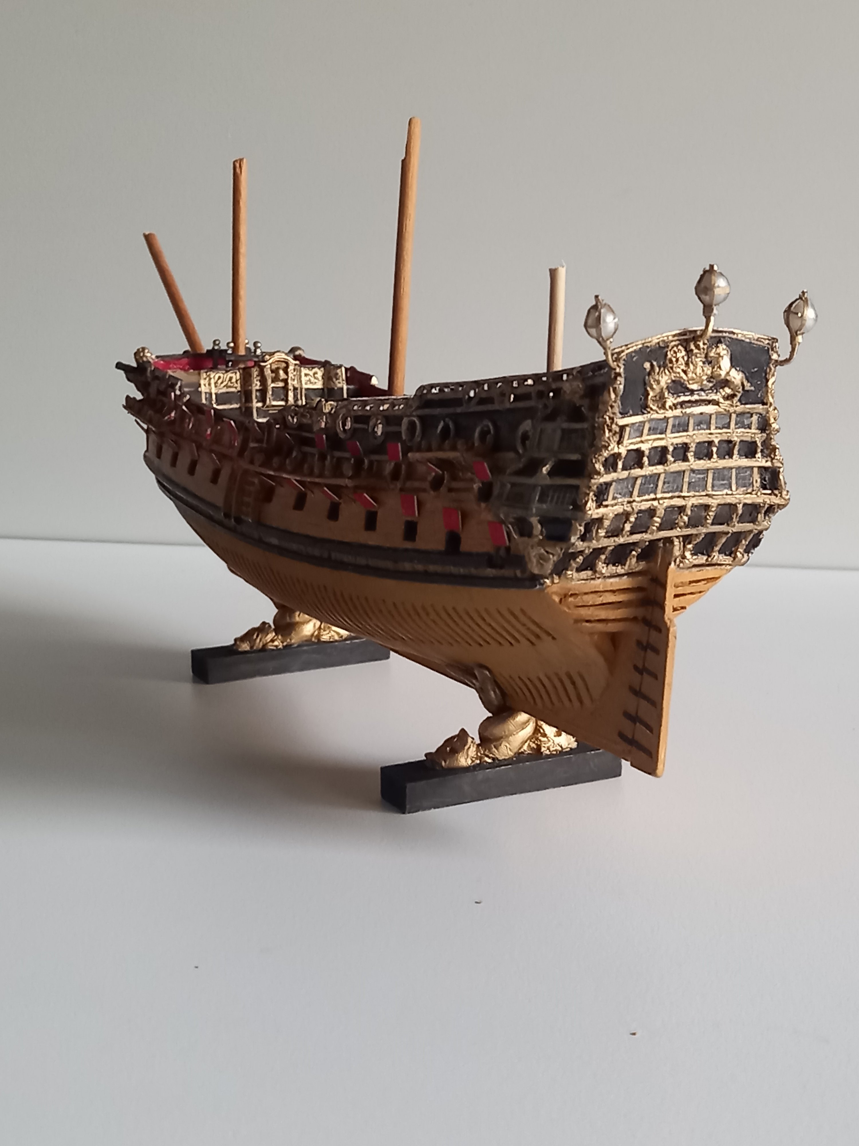

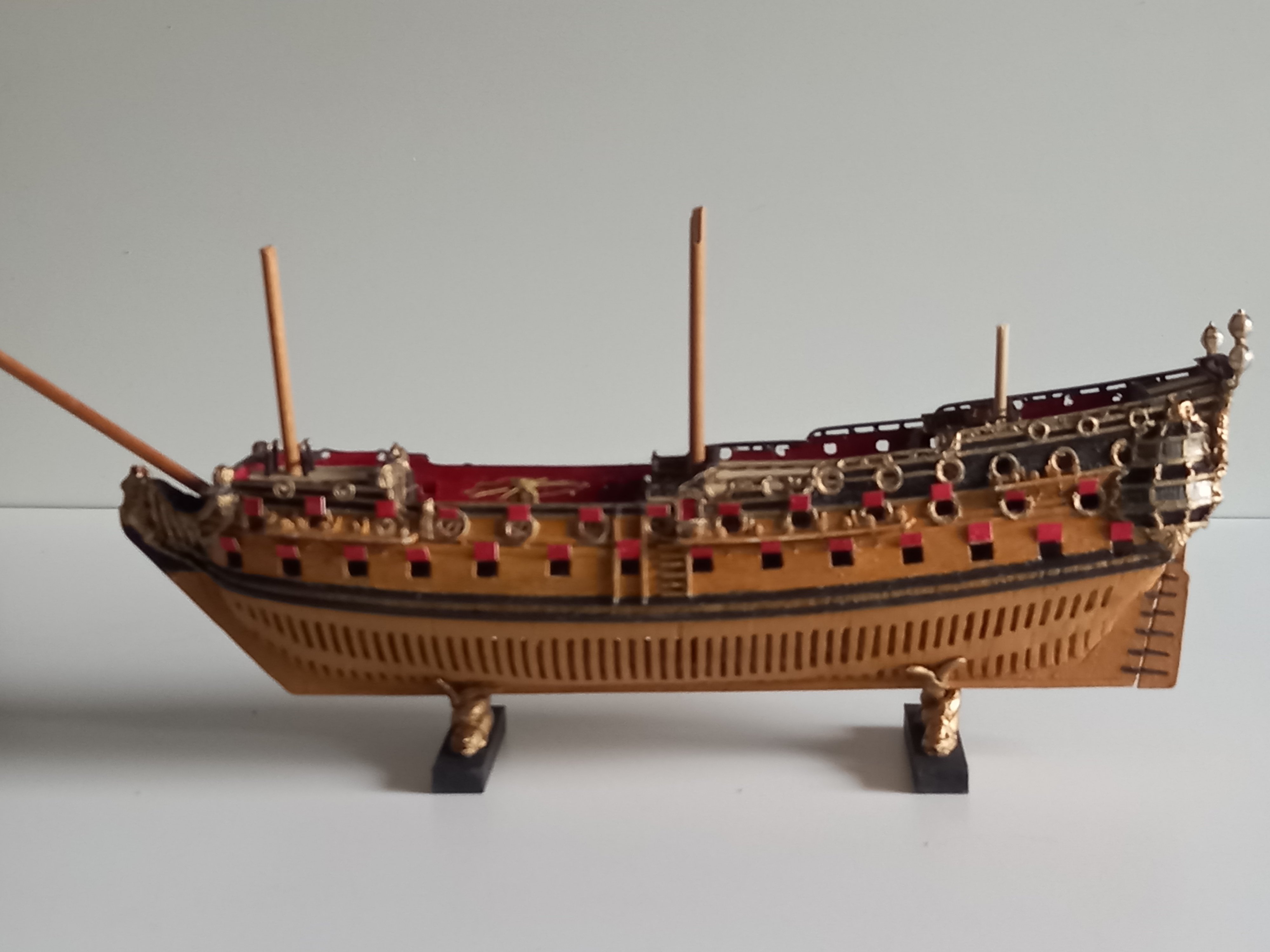

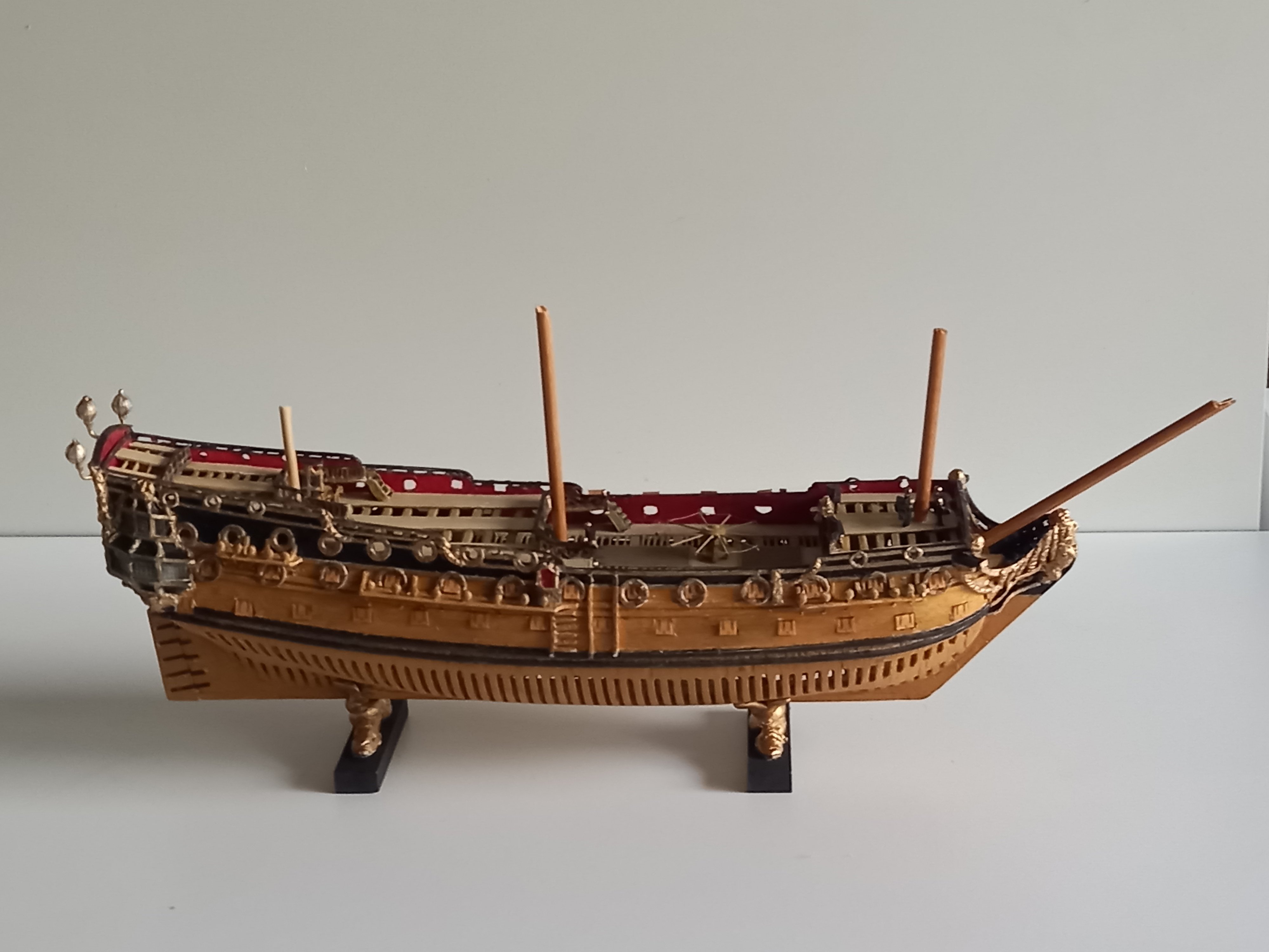

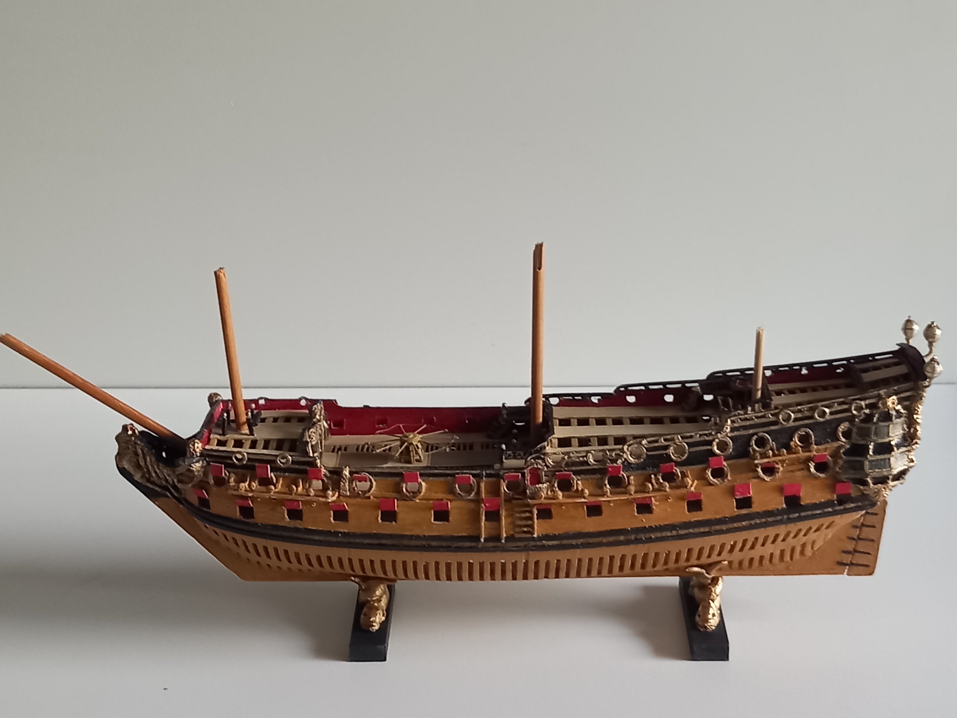

What rests are all the decorations for the bulkheads, the beak head and the sides, the dead-eyes, the lanterns and the lids of the gun ports. Nothing to get nervous about.32.png.c8a22c4c434f799d7fa202e82923daff.png

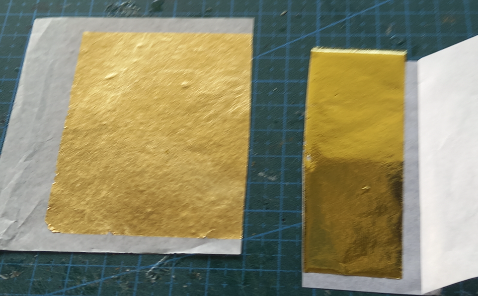

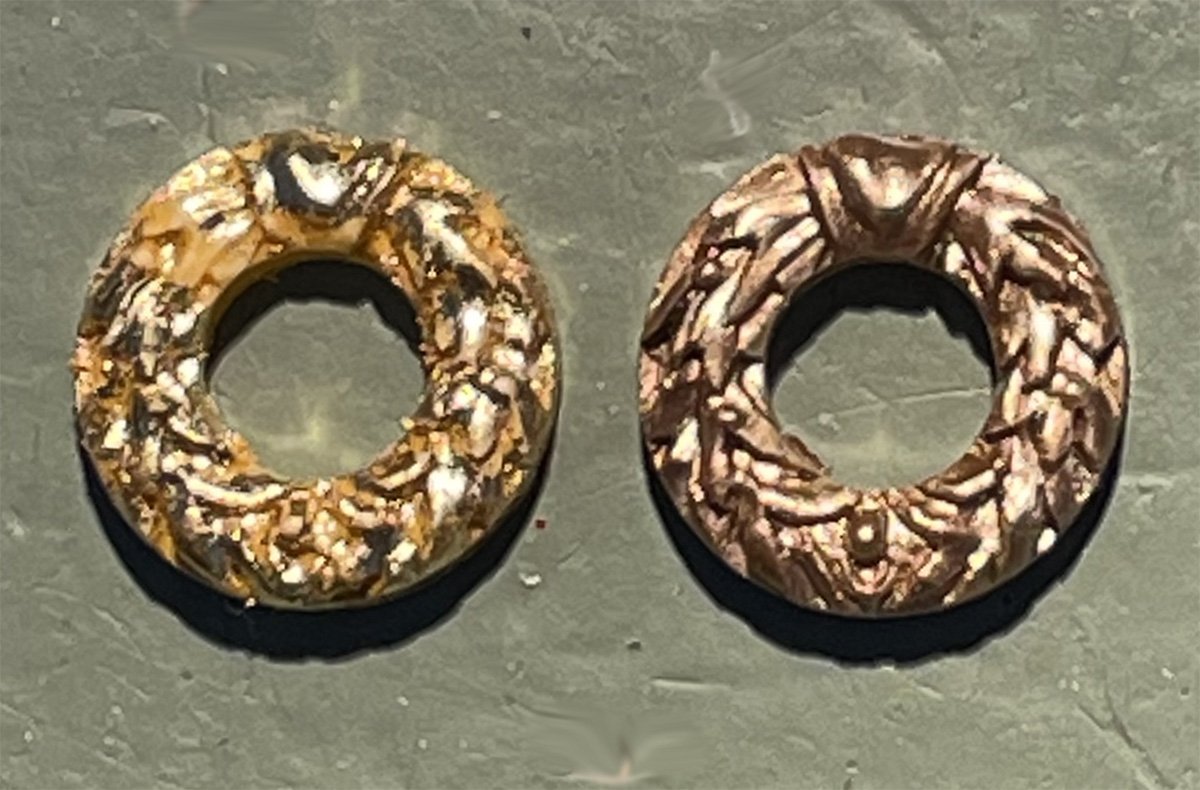

What I do am nervous about is the gilding. As I told before I used gold paint so far, but I intend to add real gold leave. There was very little left from what I usually have in stock, so I went looking for a new booklet of 25 sheets. Expensive stuff (about 80 Euros), but at some Chinese site I spotted a package of 100 gold leaves for just 12 Euros! Too good to be true of course and indeed, when it arrived I did not like the tone of the color at all. I don't know what they mixed the gold with, but it is too flat and shiny for my purposes. I'm afraid it will make the model look cheap. Still I want to give it a (test)try, because I might tone it down a bit with some transparent paint, but the looks of the material make me shiver... Look for yourself, to the left the real gold, to the right the Chinese 'gold'.

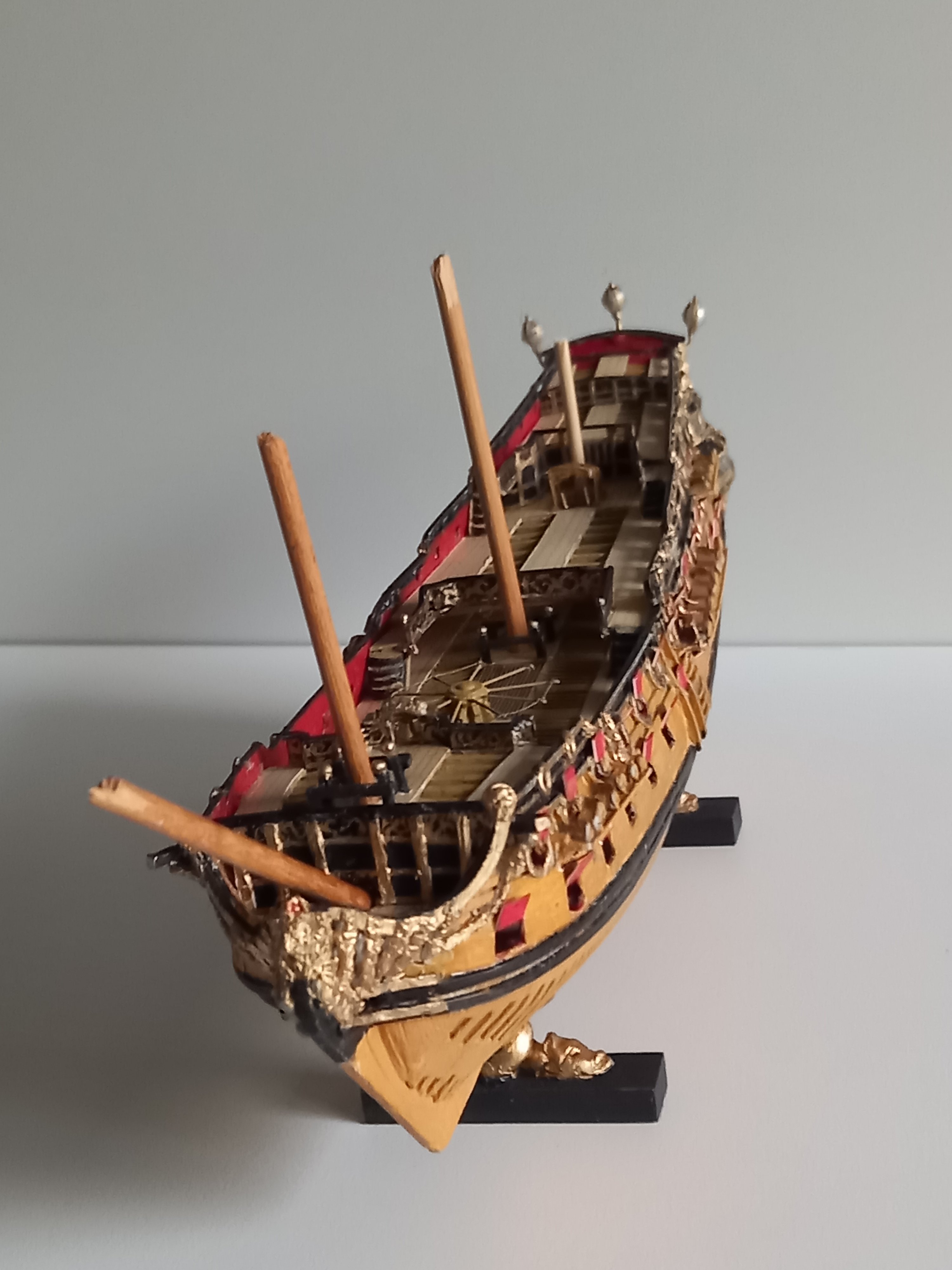

In the end we can conclude that it is indeed possible to build a 1/200 scaler dockyard model from card.
