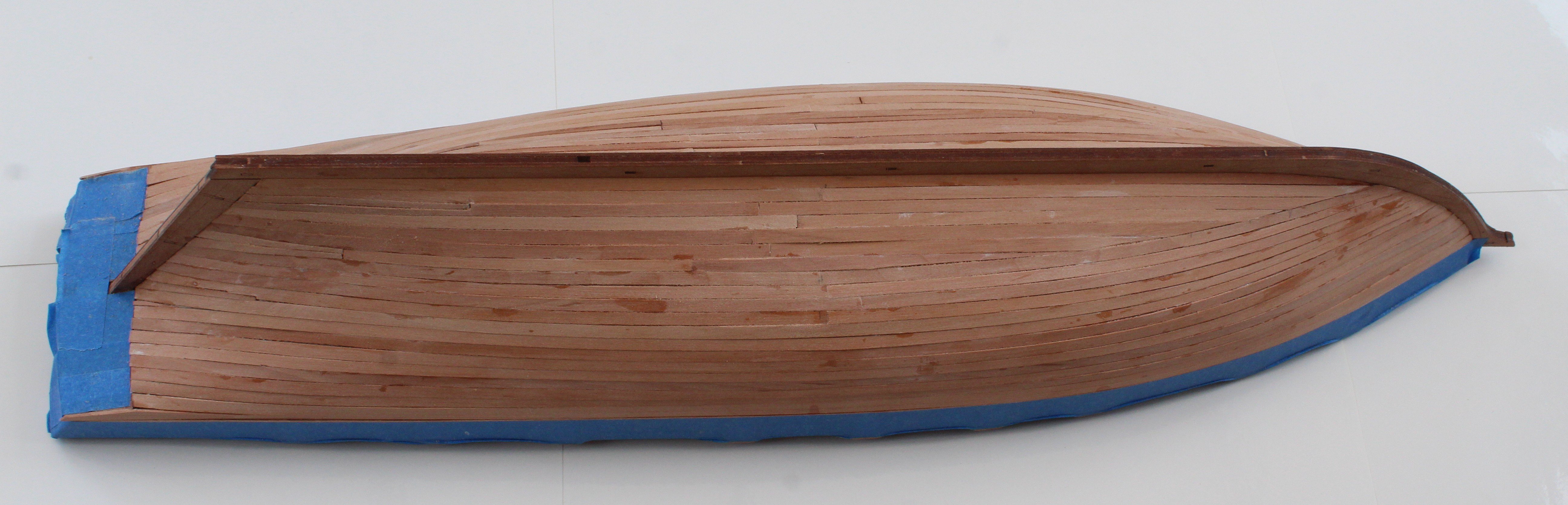

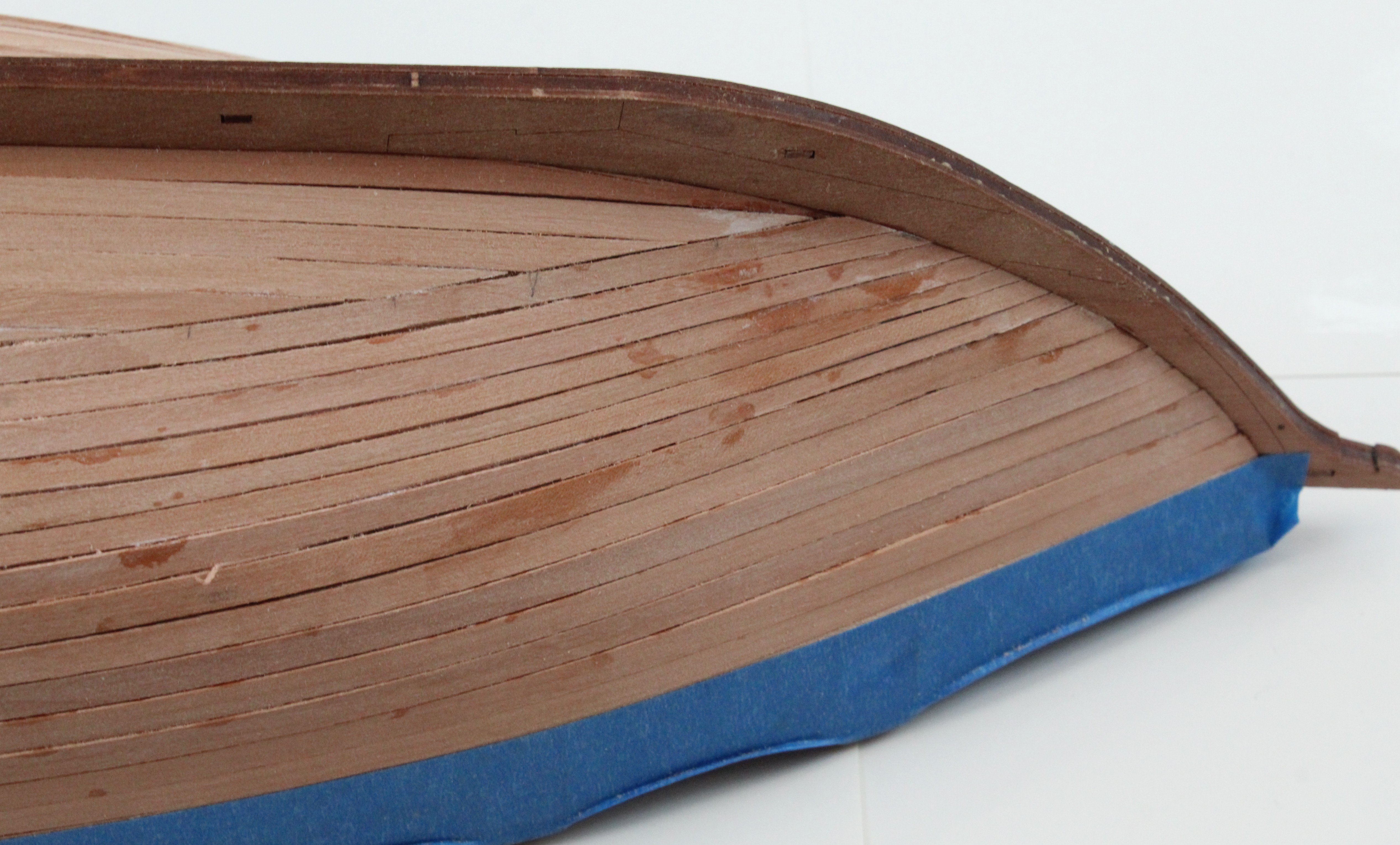

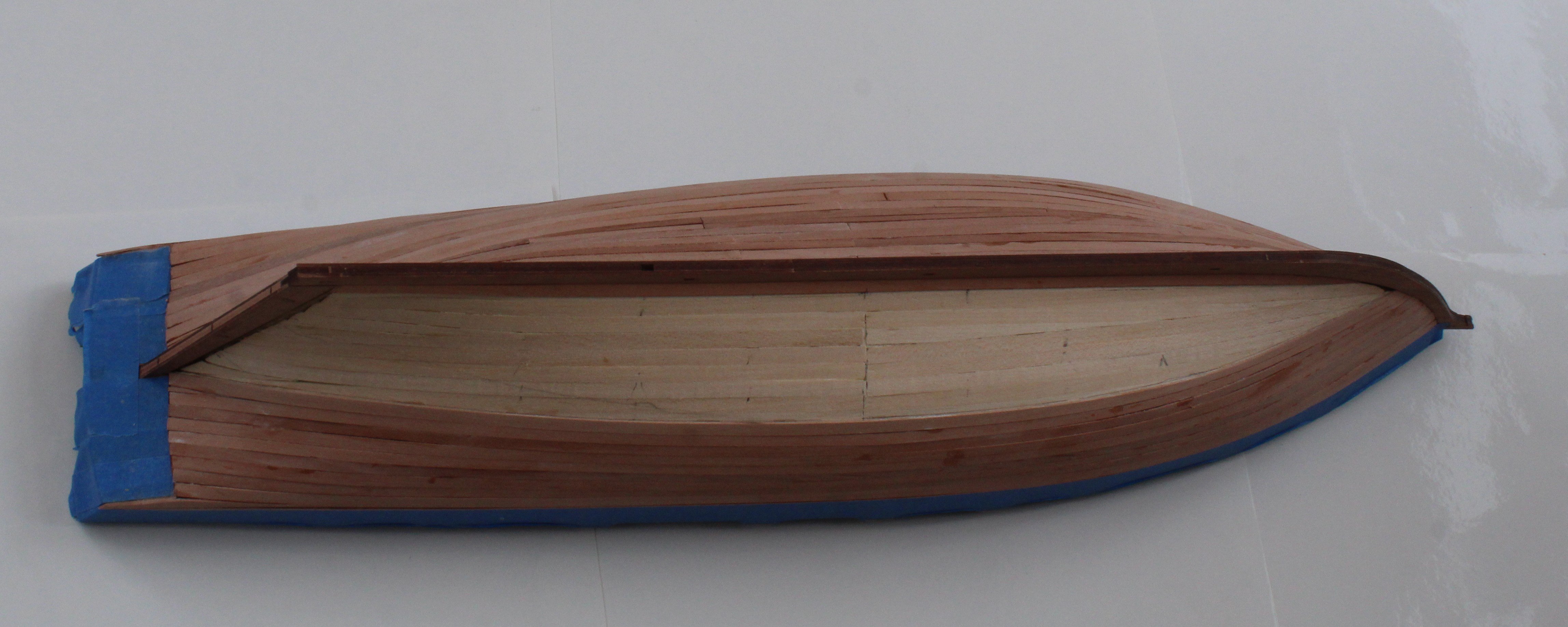

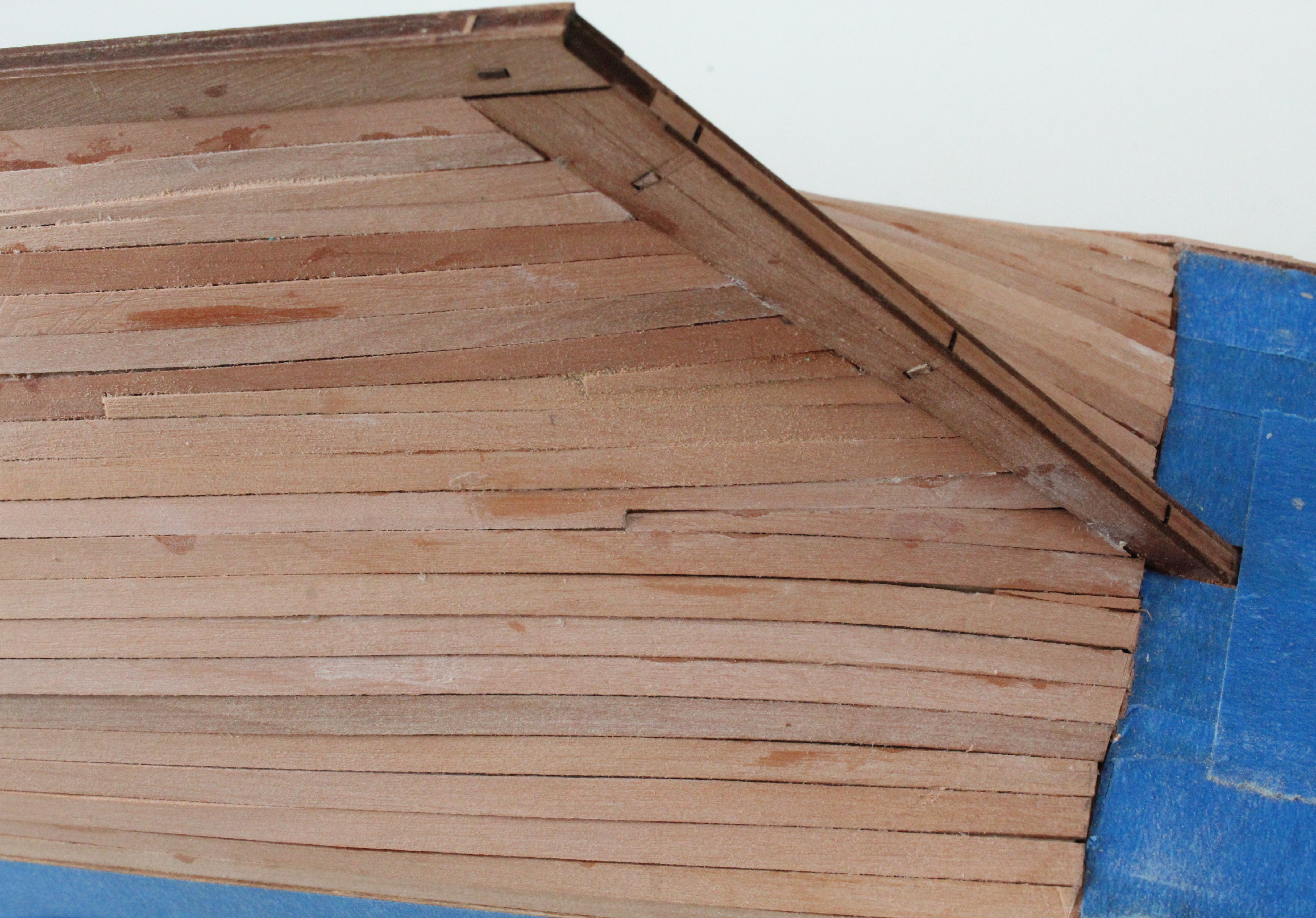

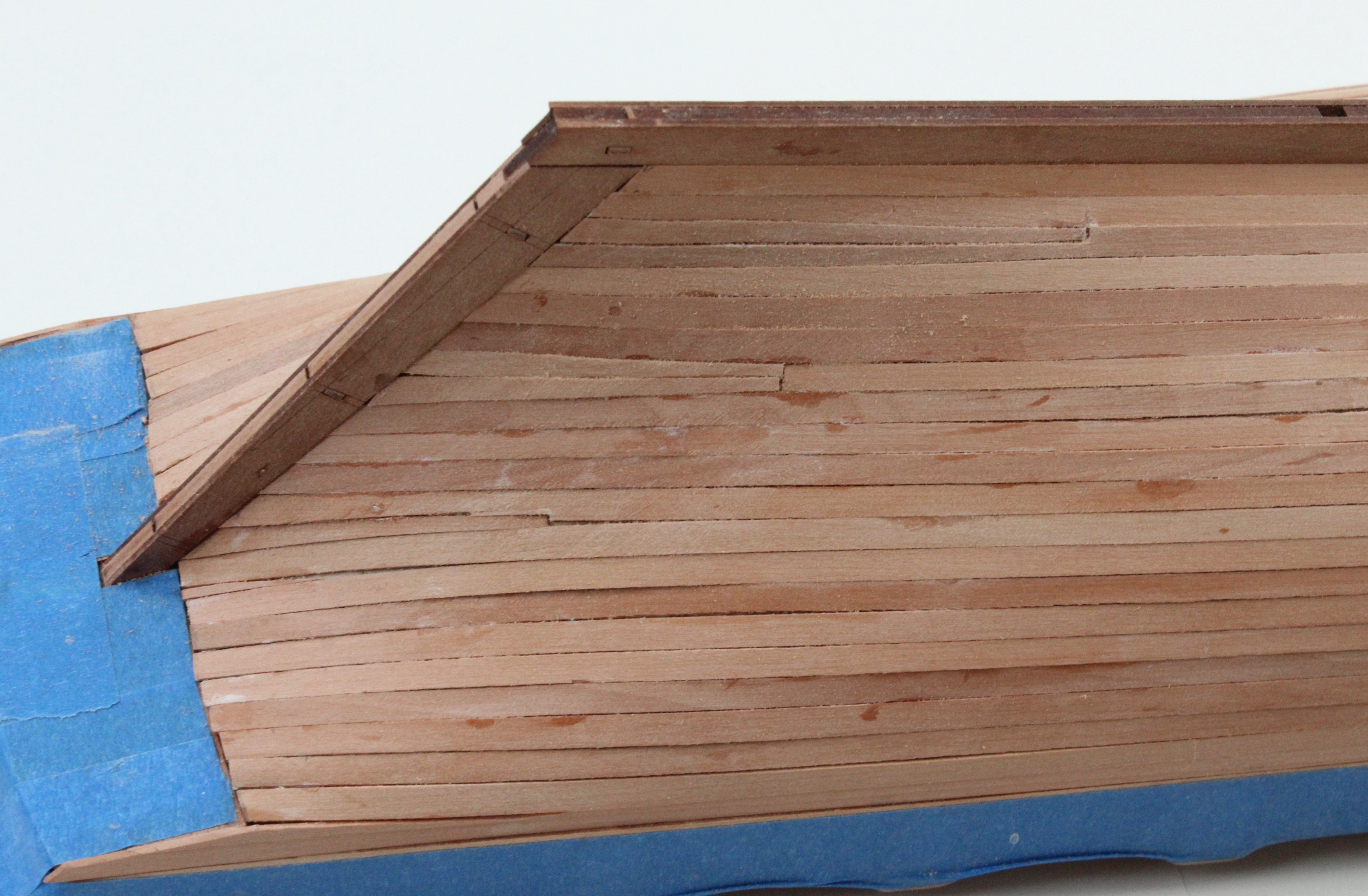

Just a quick update before we travel to yet another hospital appointment.

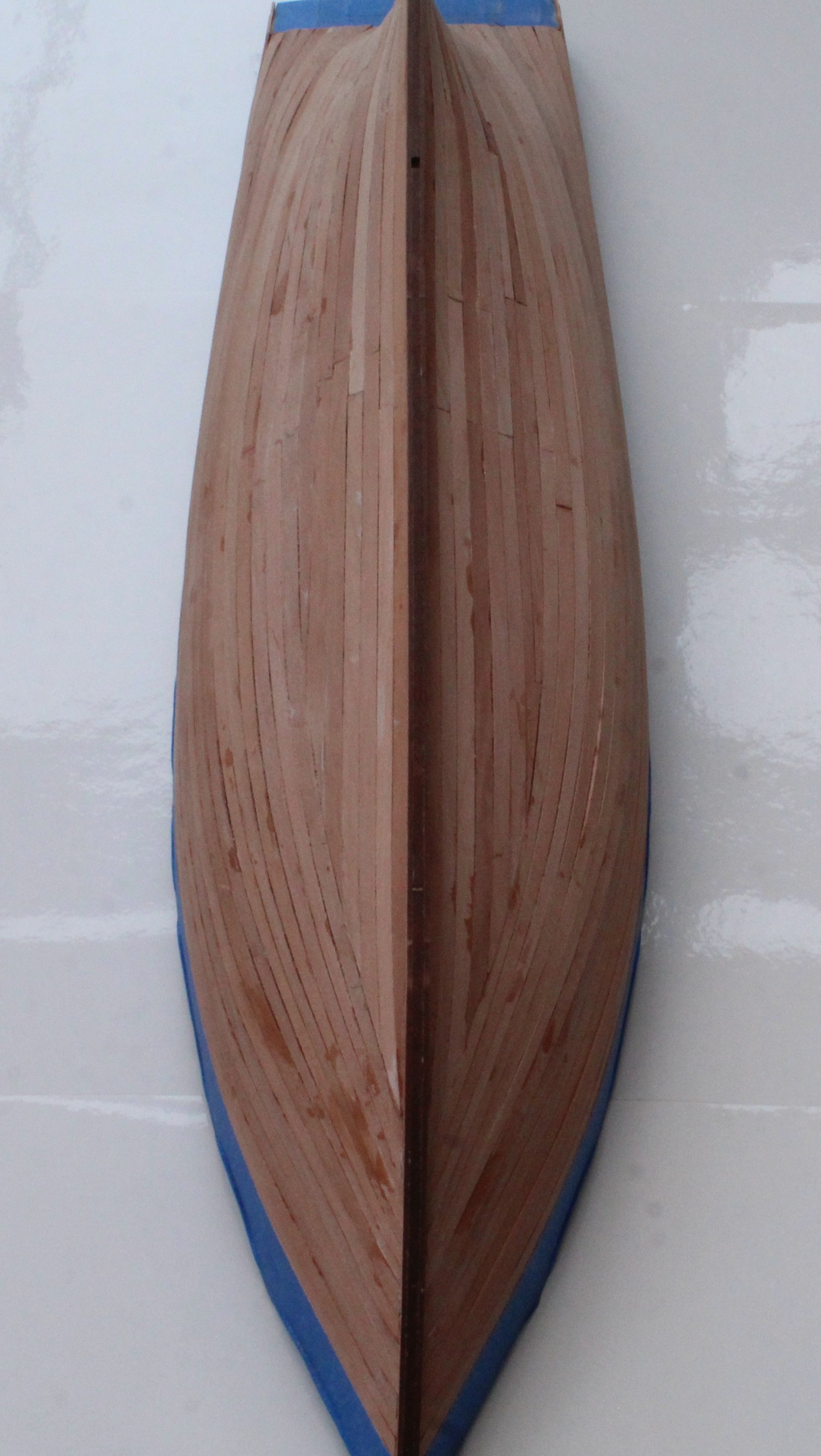

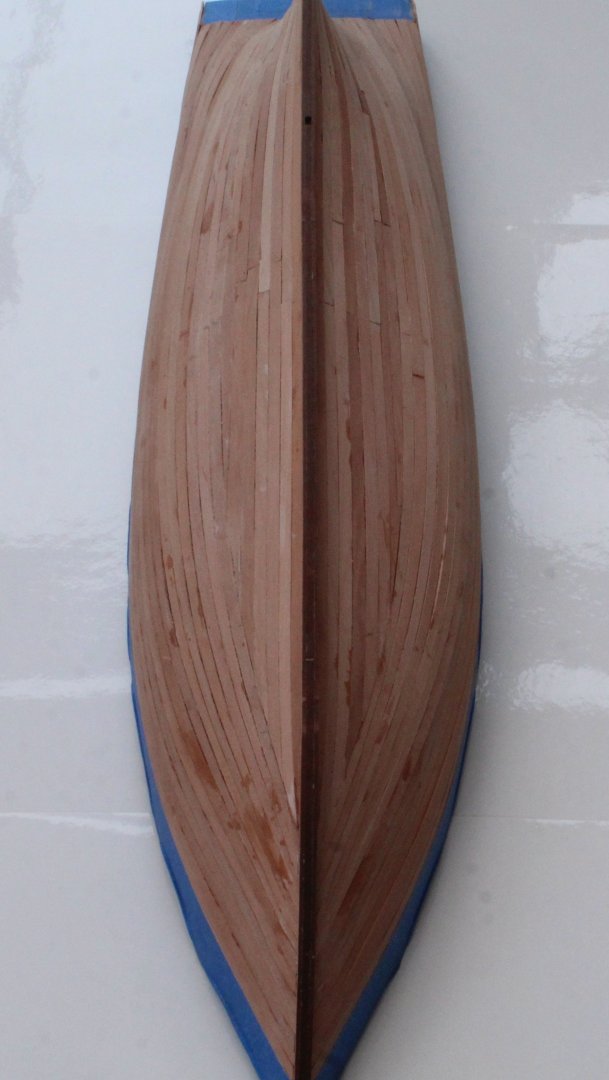

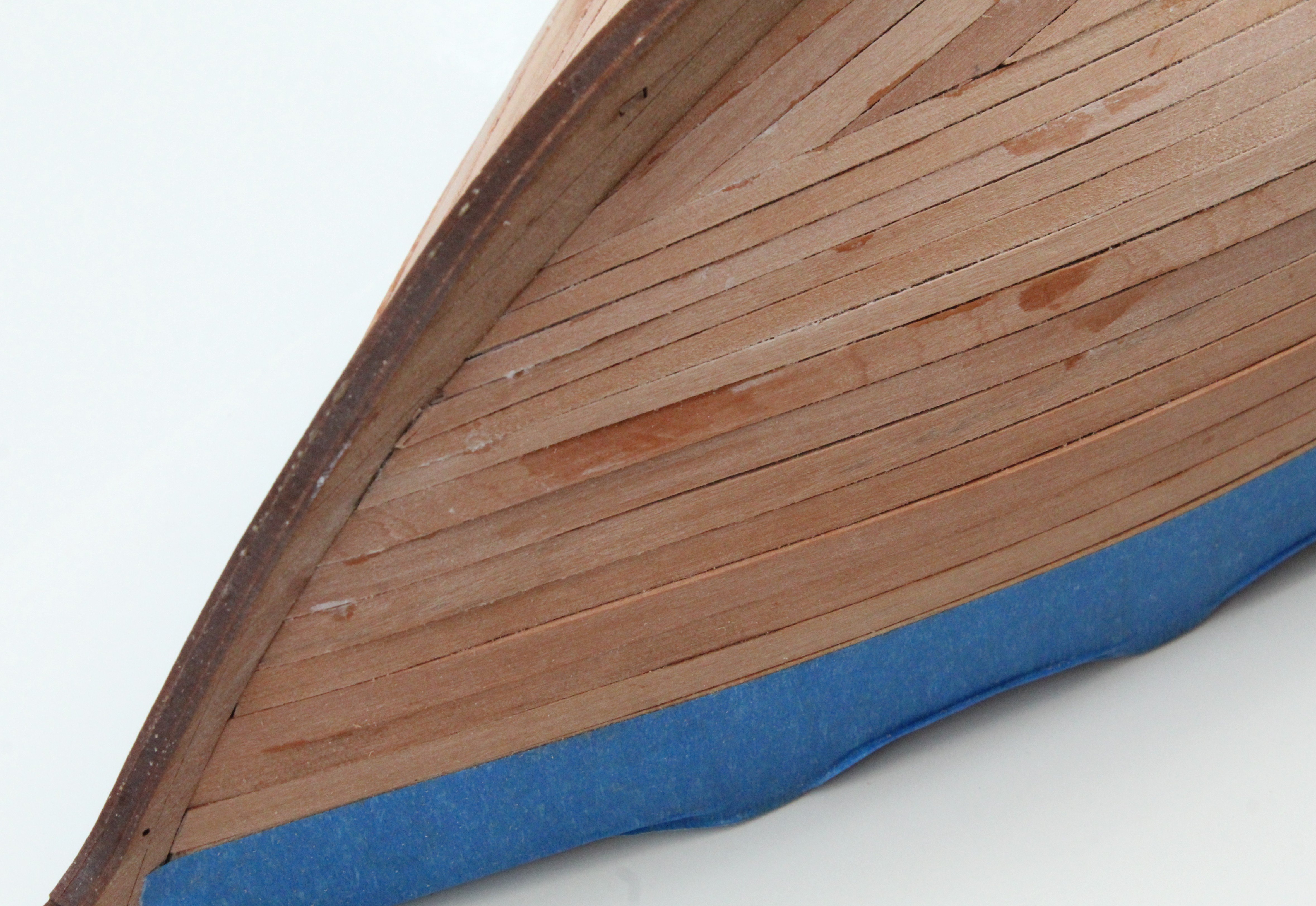

I have completed the second planking on the right hand side. For the most part I am happy with the end result. I did have some acetone on hand as the planks were glued in place to wipe away any excess.
As can be seen in the next photo I did not follow the correct method for planking around the bow but as the hull will be painted and copper plated it does not really matter for this build. I did find it necessary to laterally bend the tapered planks to get a good fit.
I did add some steelers when planking the stern.
003.thumb.JPG.a971c62cb56b7e5ac8fb38cd7cdb3143.JPG004.thumb.JPG.f18c3df175d8b621da3e33ceeae99cc7.JPG005.thumb.JPG.156670448c4d7d8ca887e1555a8772fa.JPG

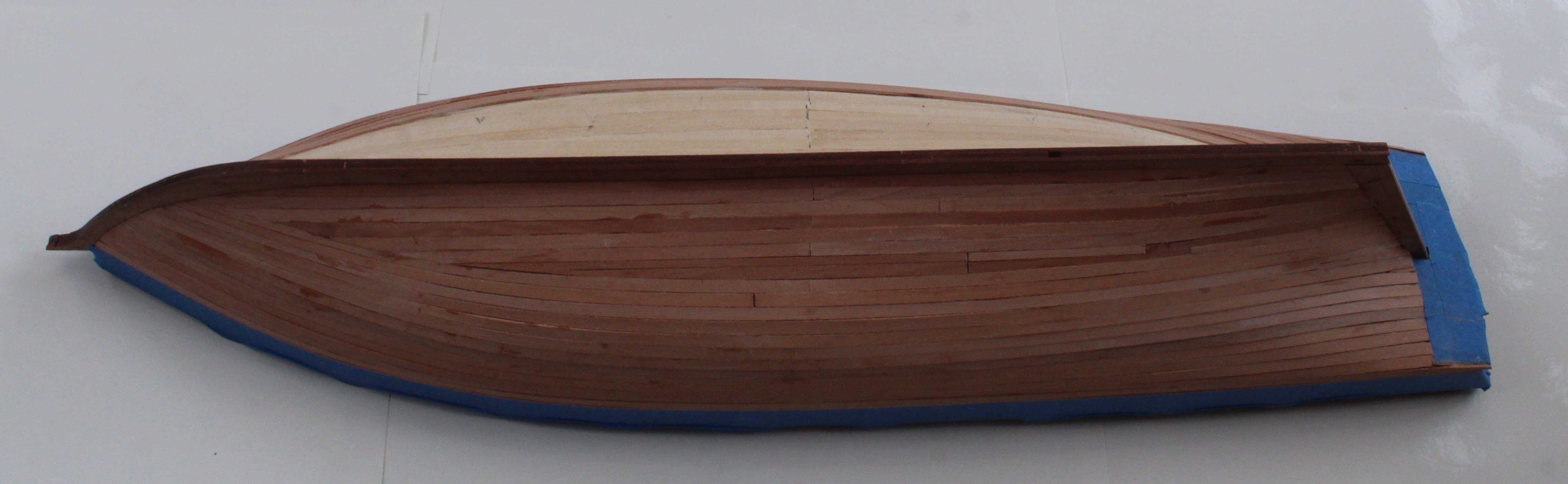

The left hand side is nearly complete and hopefully I will be able to complete this the next time I am in the shipyard. I did manage to release and reset the plank mentioned previously.

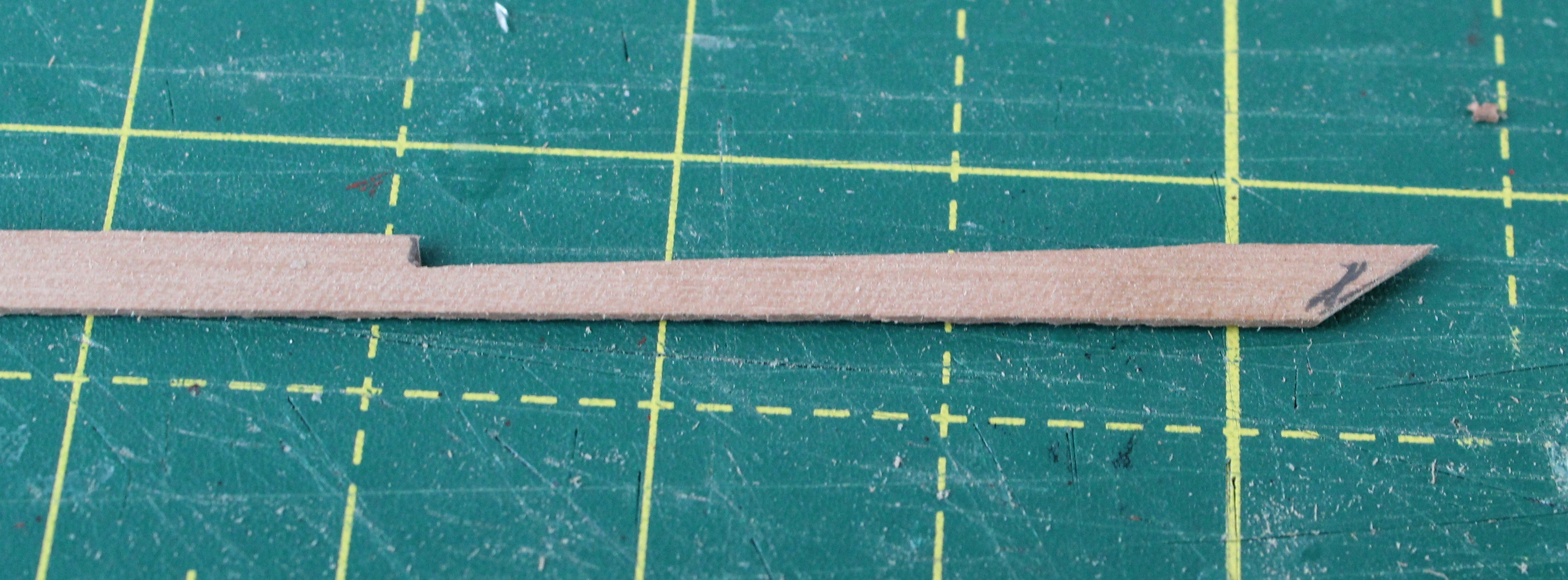

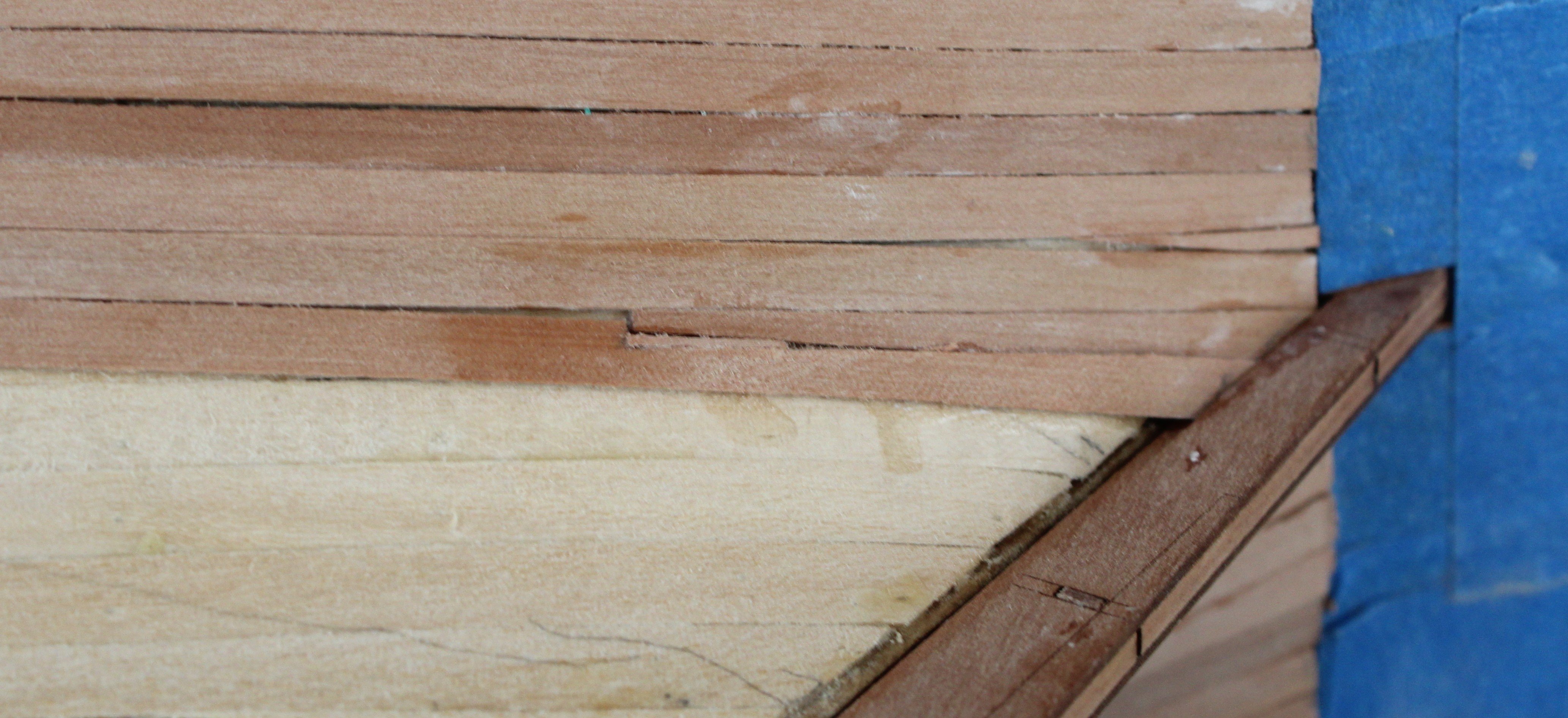

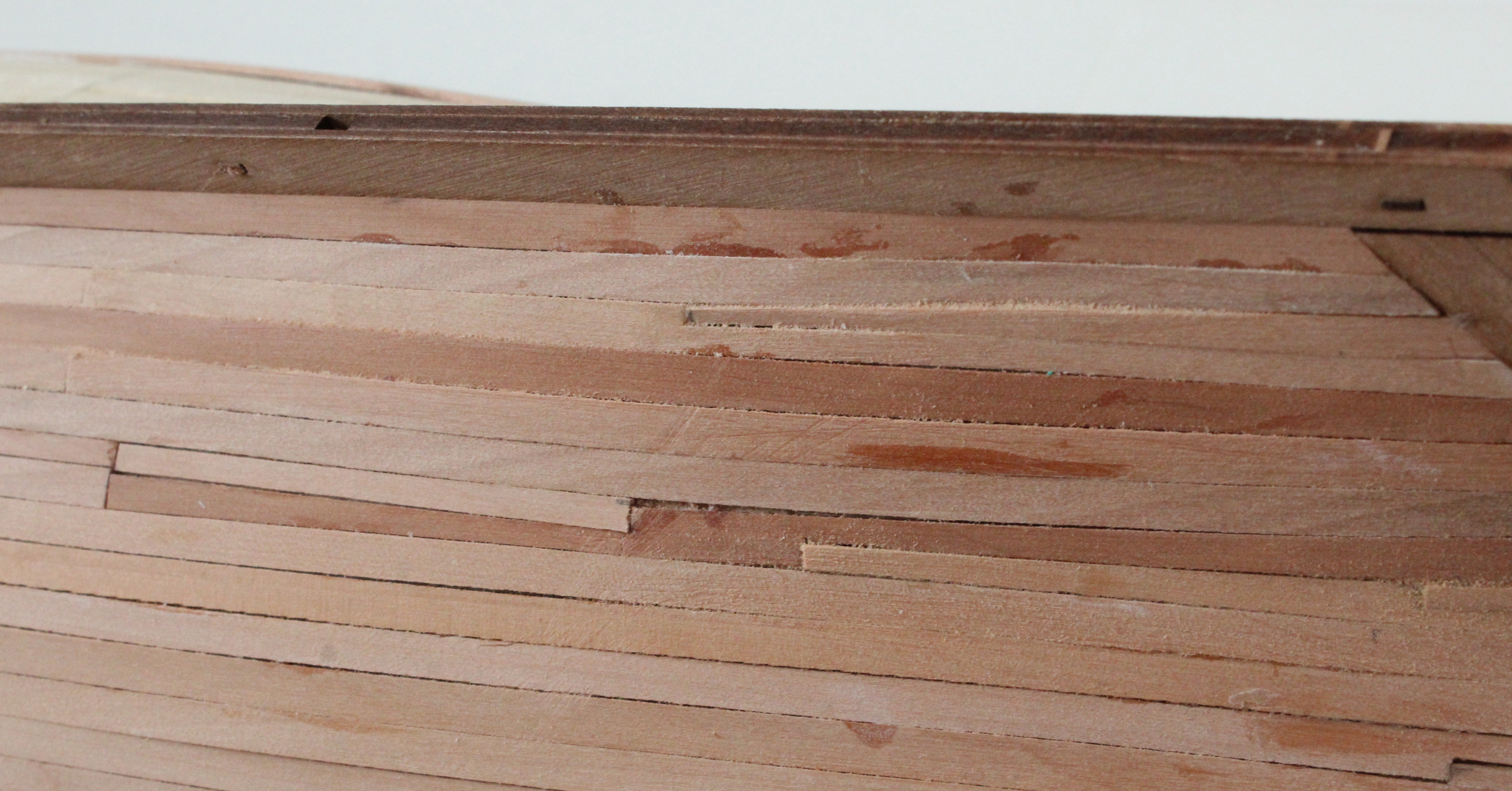

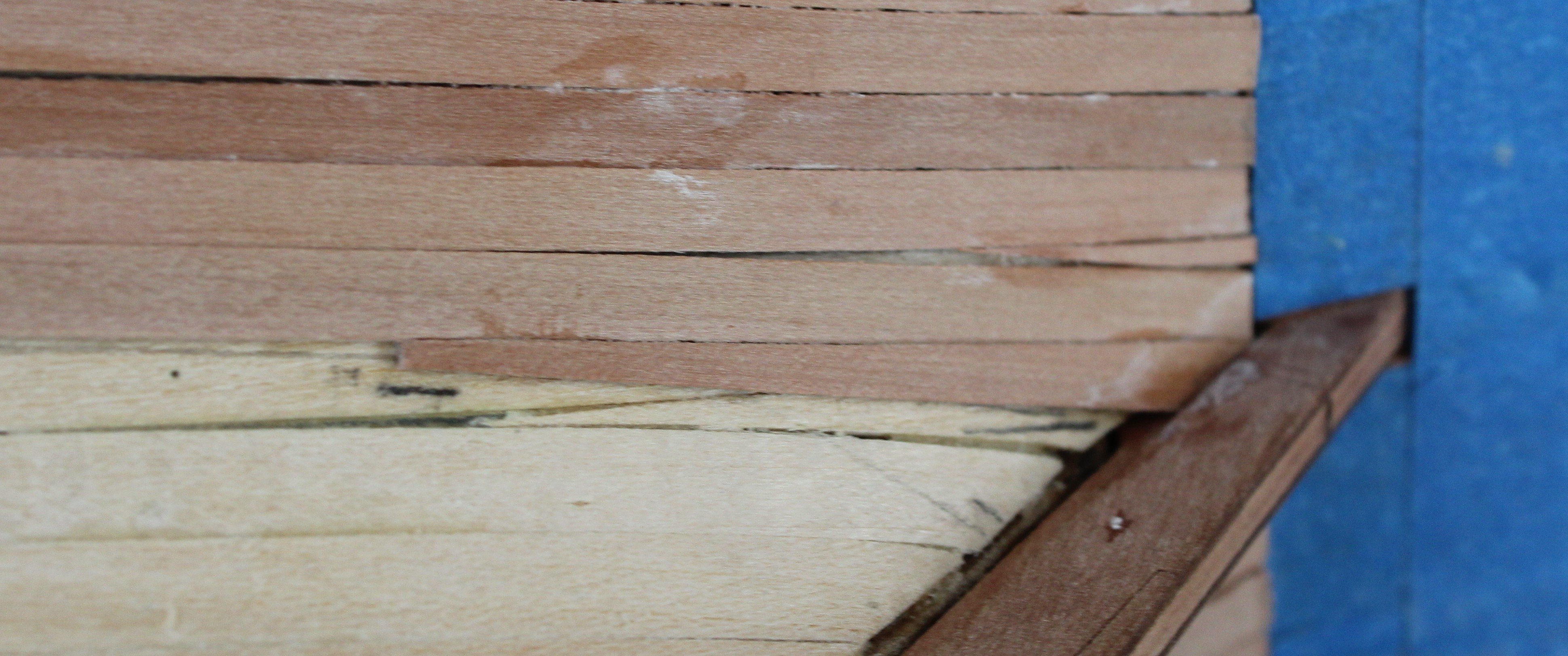

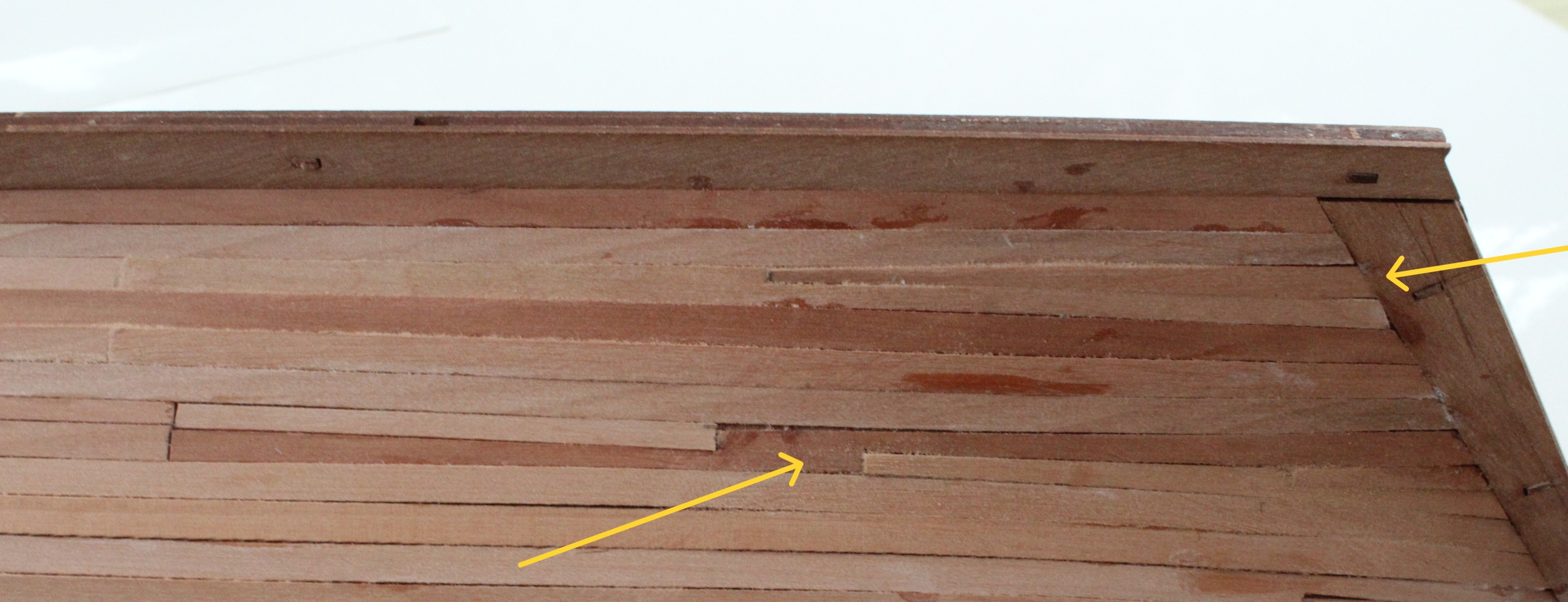

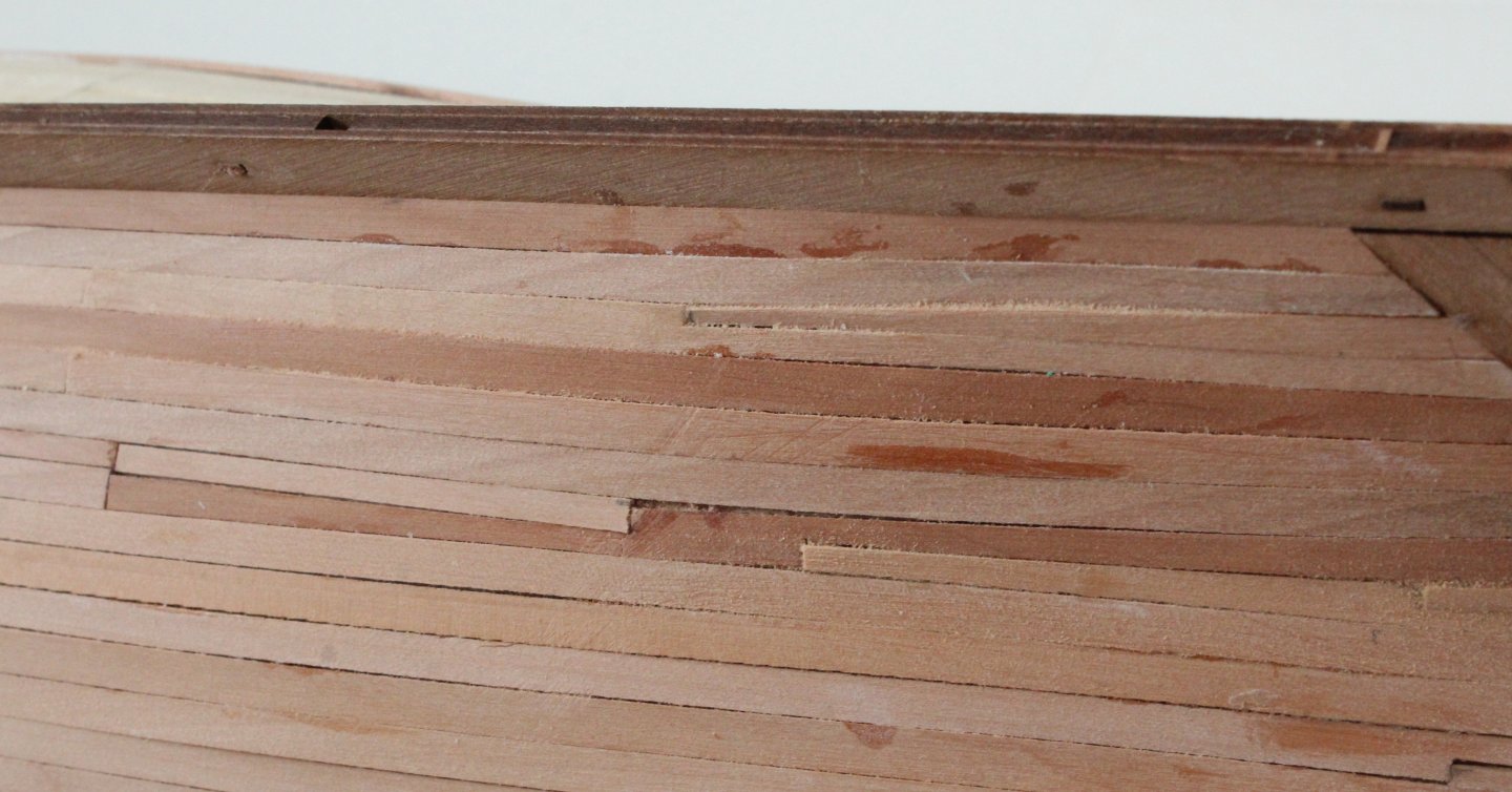

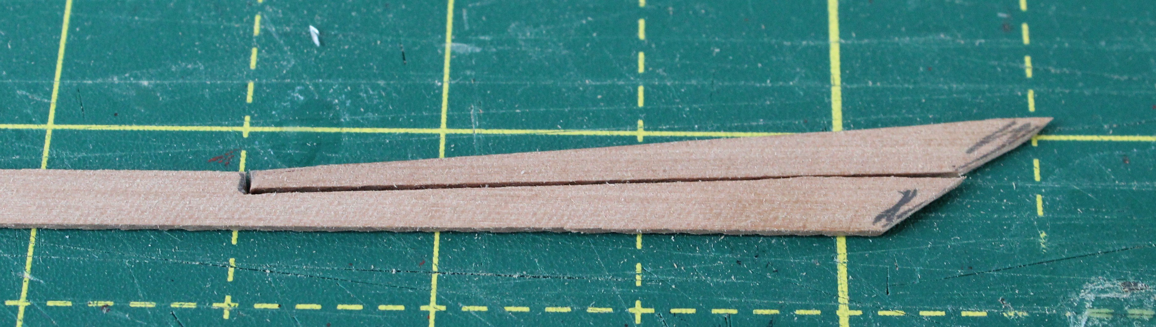

As I work towards completing the left hand side second planking I thought I would share how I go about adding a steeler.

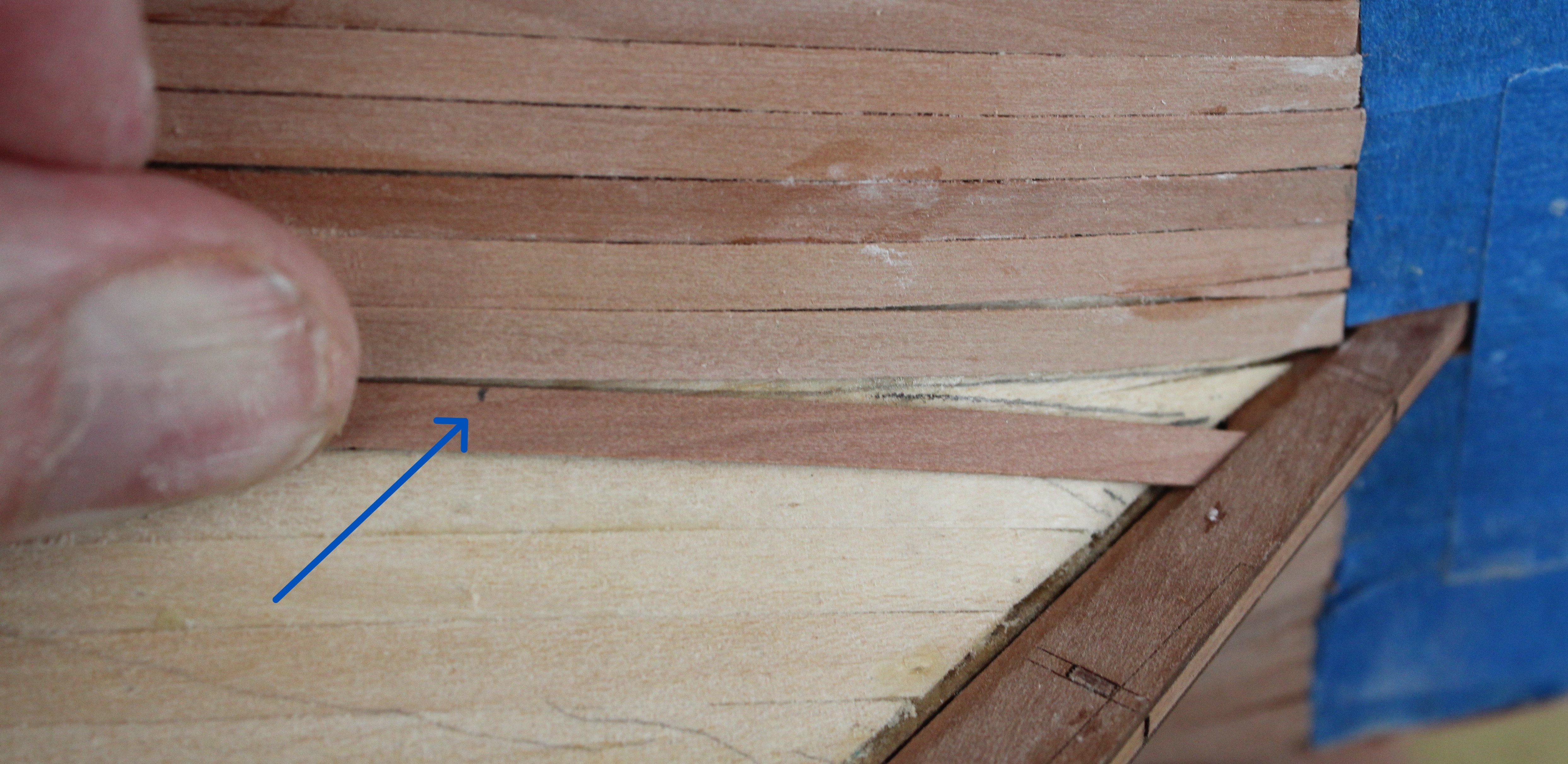

With the plank in place I make a mark where it starts to drift away from the next plank. This is shown in the photo below. I also aim to have a full plank width space at the stern post and you will note I have also made a pencil mark on the hull near the stern post.
I then cut away the excess material from the plank. The objective is to have about a taper that goes from about half a planks width to a full planks with. I think the next photo will help to clarify that description.
Next I make the steeler and check its fit before progressing further.
Once I am happy with the fit I will then glue the steeler in place. Doing this ensures I have the right space set at the stern post for the plank when fitted.
The plank is then glued in place and all looks good. You will note I did not do such a good job this time around as I found it necessary to add a small filler piece.

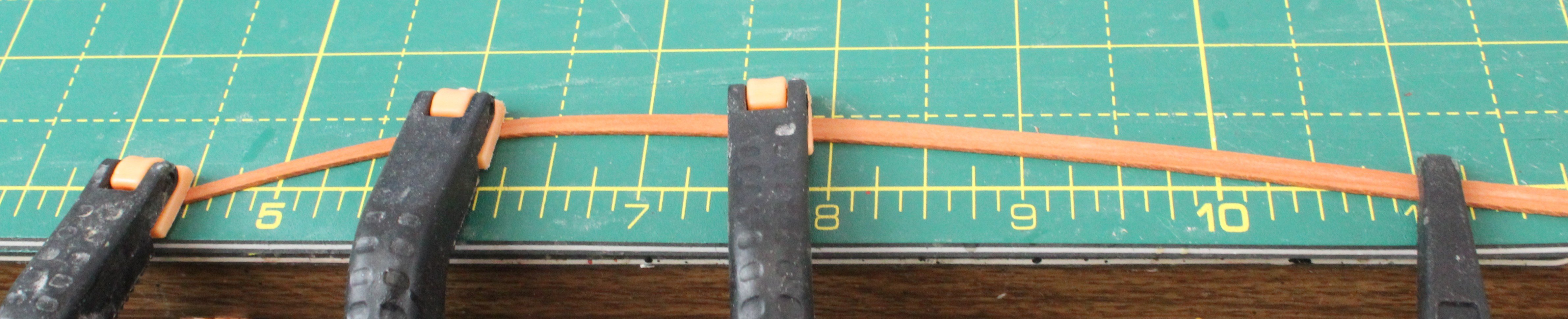

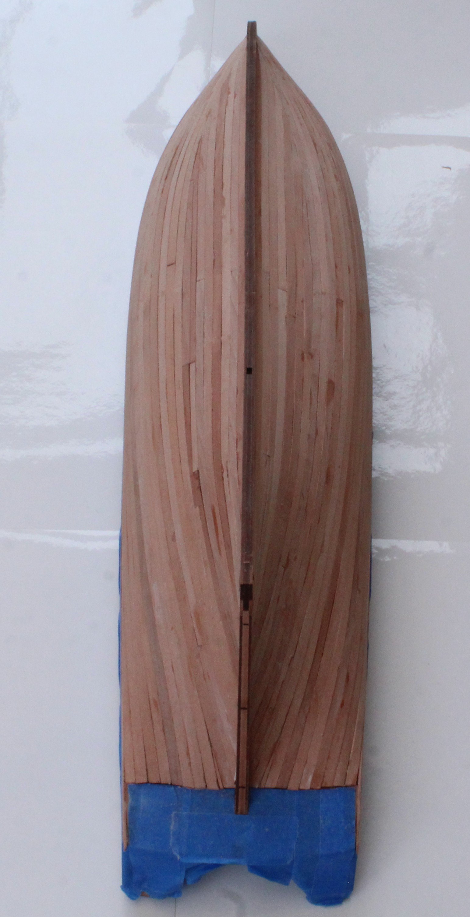

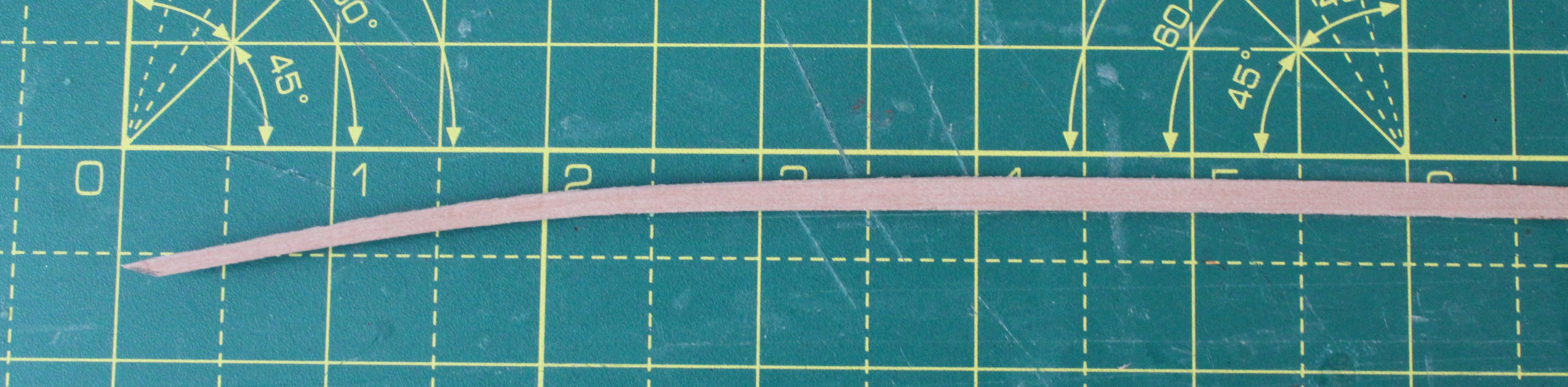

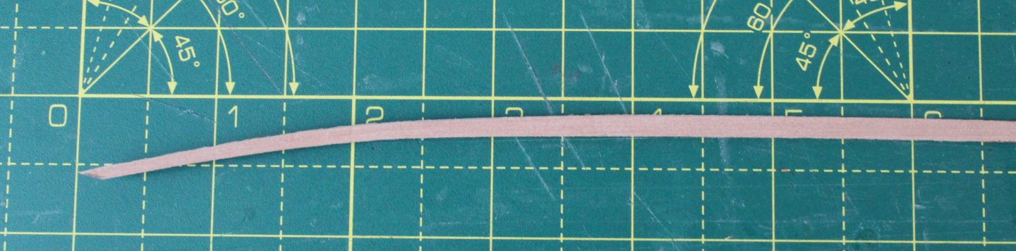

I use a very simple method when laterally bending the bow planks. I dip the plank in some water and then clamp it to my workbench. A hairdryer is then used to blow hot air on the plank to remove the water and to retain the curve.
Once the water has been removed by the hairdryer I am left with a nicely curved plank. The curve, if necessary. can be adjusted but with experience I have found I am now usually able to judge the required bend first time around.
The left hand side second planking is now complete.
008.thumb.JPG.a04e1aa8abbce1f12833d46fbd499364.JPG009.thumb.JPG.c15dc2cbe5298f6bc1c1c64274eb1be7.JPG010.thumb.JPG.d2292405e774312d2e2036515bd149d7.JPG
The completed hull is now ready to be sanded (and filled) prior to painting and adding the copper plating.

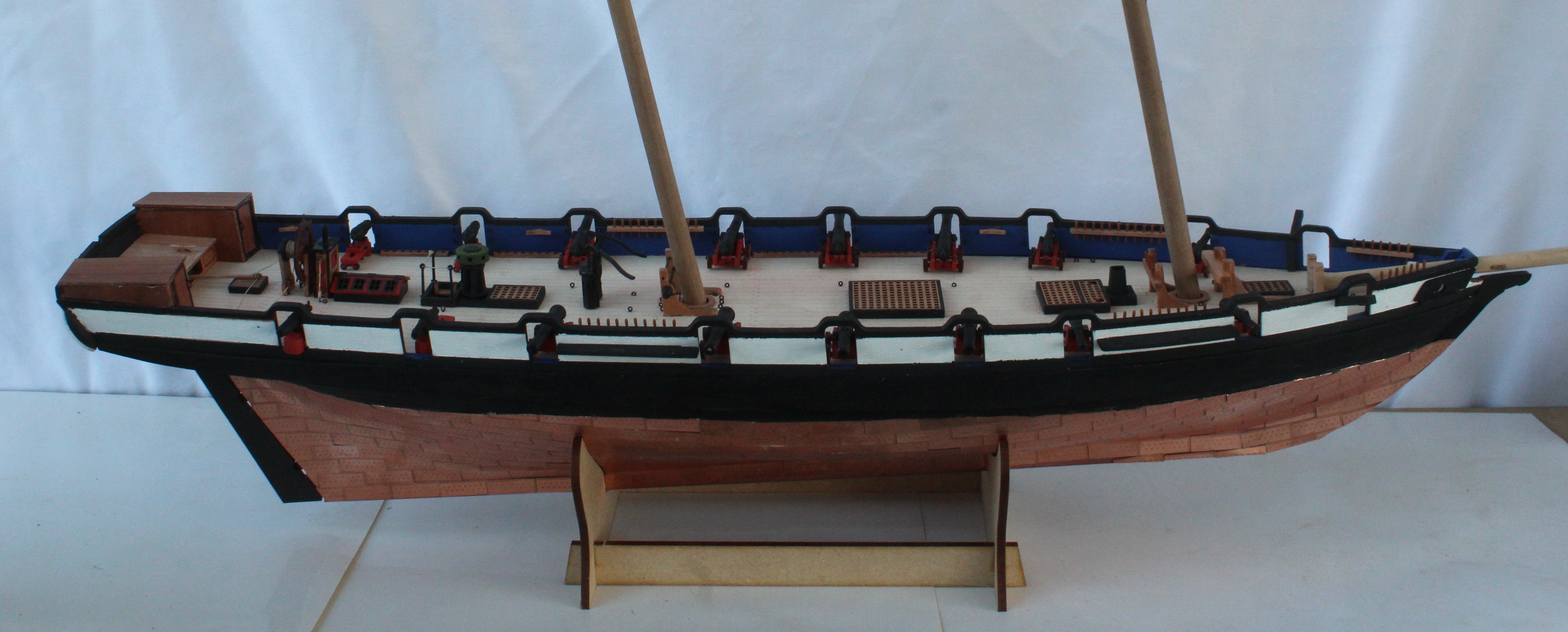

The following photo shows the current build statis

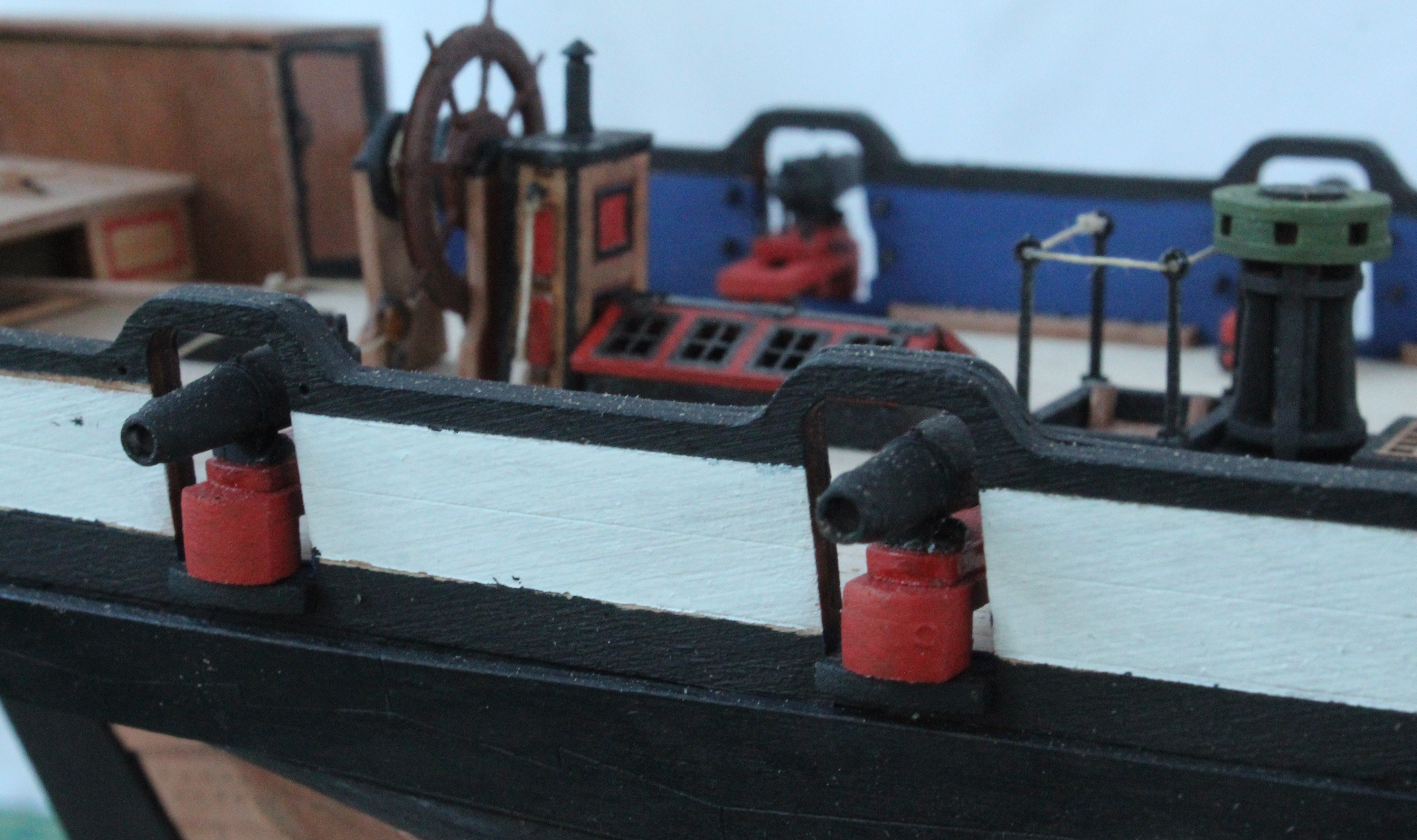

Next is a picture of the rear cabins. I now wish I had not painted the outer surround of the cabin doors black but it is not a show stopper. I do like the red infill I added to the tiller housing front panel however.
I have also test fitted the tiller housing canopy. The cleats have also been added to the inner bulwarks.
Next is a picture of the stern. I am not totally happy with the joins between the various parts, but in the great scheme of the build this aspect will not really be visible when the model is completed. Also there is an outer pattern to add to the stern main board which will make thing look better, once fitted.

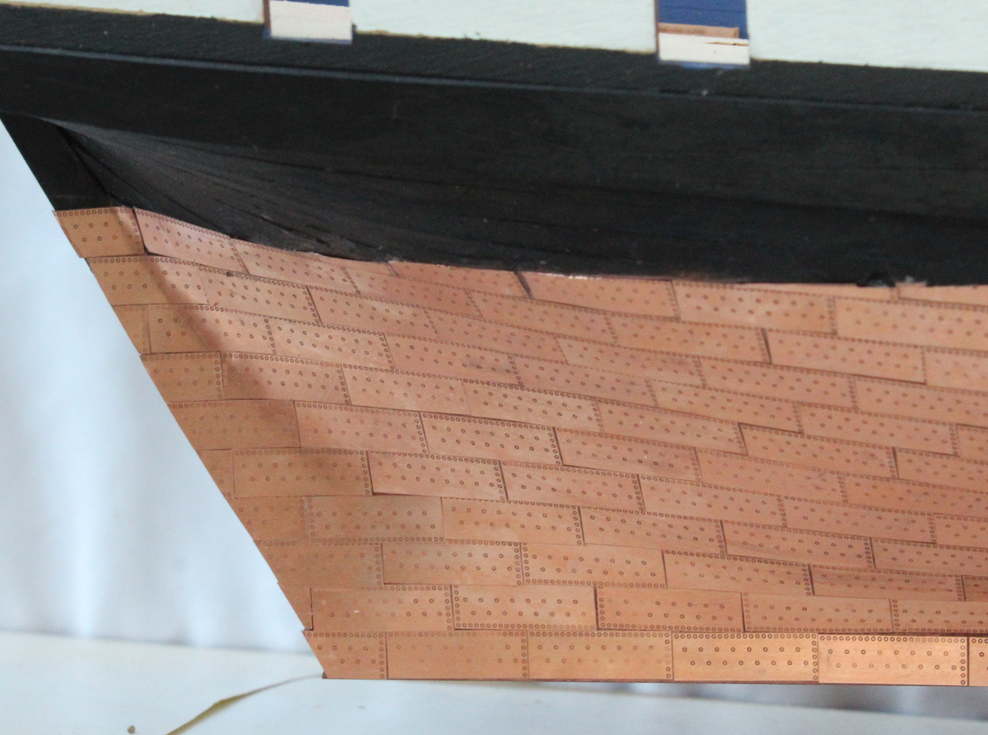

Copper plating has been completed. I have not made a great job of it, especially around the bow.

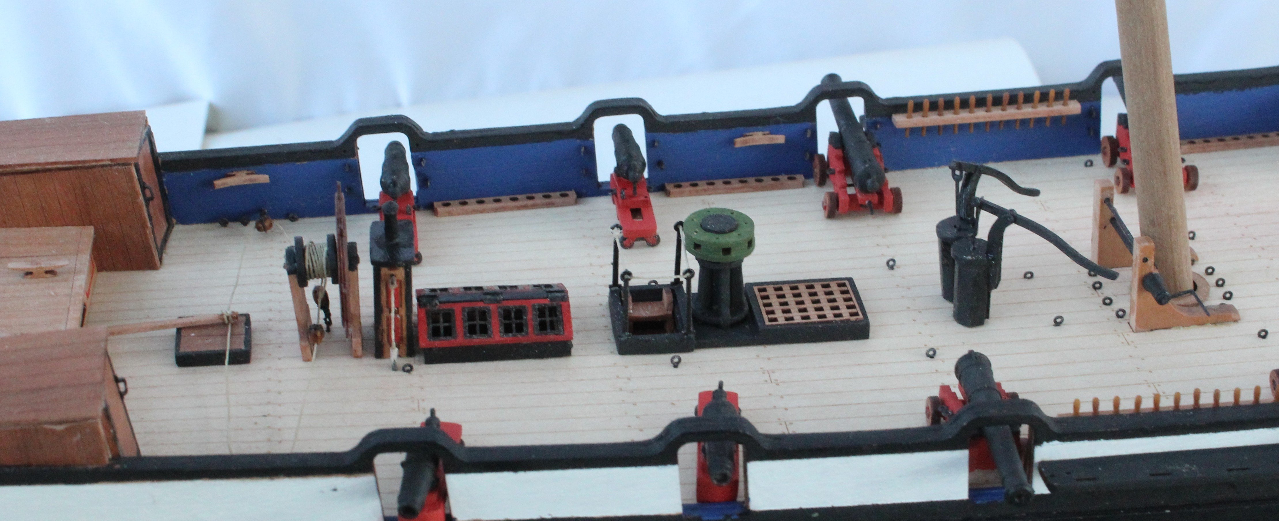

With the copper plating completed I then added the previously built deck items.

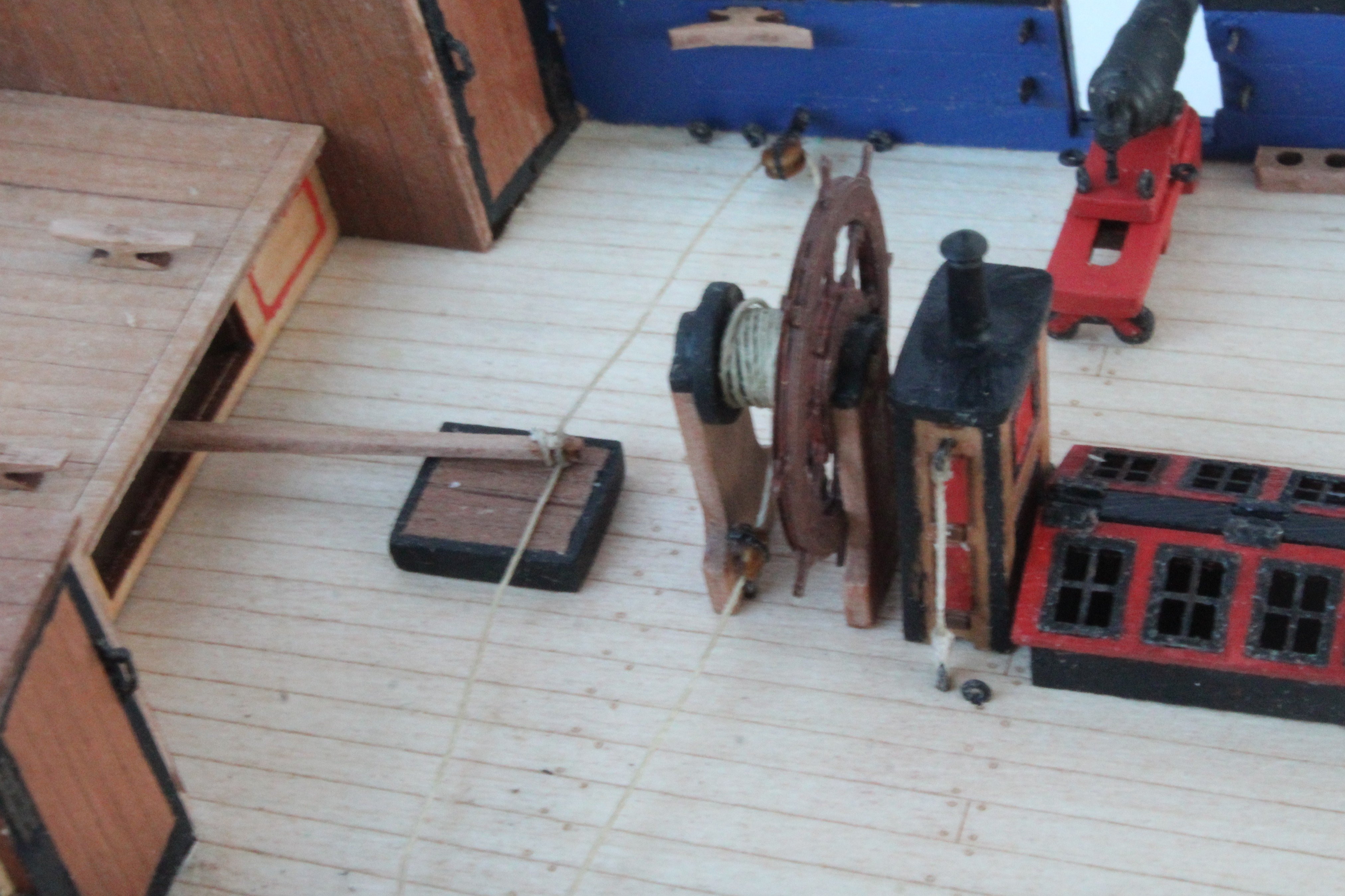

I really like the look of the Syren belaying pins but I am concerned they may break when securing rigging to them as I have already broken a few.
The companionway, binnacle and ships wheel rigging have been added.
The cannons and carronades have only be placed on the deck in the following photos as I still deciding on the armament arrangement for my build. At the moment will probably go with the arrangement shown in the ensuring photos.
003.thumb.JPG.83e3137d529271728e72b64ab58df178.JPG004.thumb.JPG.4bb8f5e6203bf3688082c890092feb12.JPG005.thumb.JPG.44feb746165f96824f5efa859fcc72f6.JPG006.thumb.JPG.bc23bc1c1927dd1d47e338f9c5172f98.JPG007.thumb.JPG.eca152f405d15da1f593b3e0dac560e1.JPG008.thumb.JPG.38401a5356e9f2a843a4fc5a2faab008.JPG009.thumb.JPG.3f567d06e0db67be4207b47d00dc5b69.JPG010.thumb.JPG.6f75eca23b436058b78d4df0ee4579e5.JPG011.thumb.JPG.8e78f6058b12415f2f0f317a0a564f08.JPG

52 minutes ago, palmerit said:
Did you - will you - put something along the top raw cut end of the copper plates? I've seen various approaches - leaving it raw, add a rope along the edge, cut a thin strip of copper alone the edge.
That would be my intention however this build is now on the back burner as I have a new commission build which I am eager to start. I am happy that the Grecian sad it stands will be ready for mast/yard/rigging if or when I have time to return to the build.

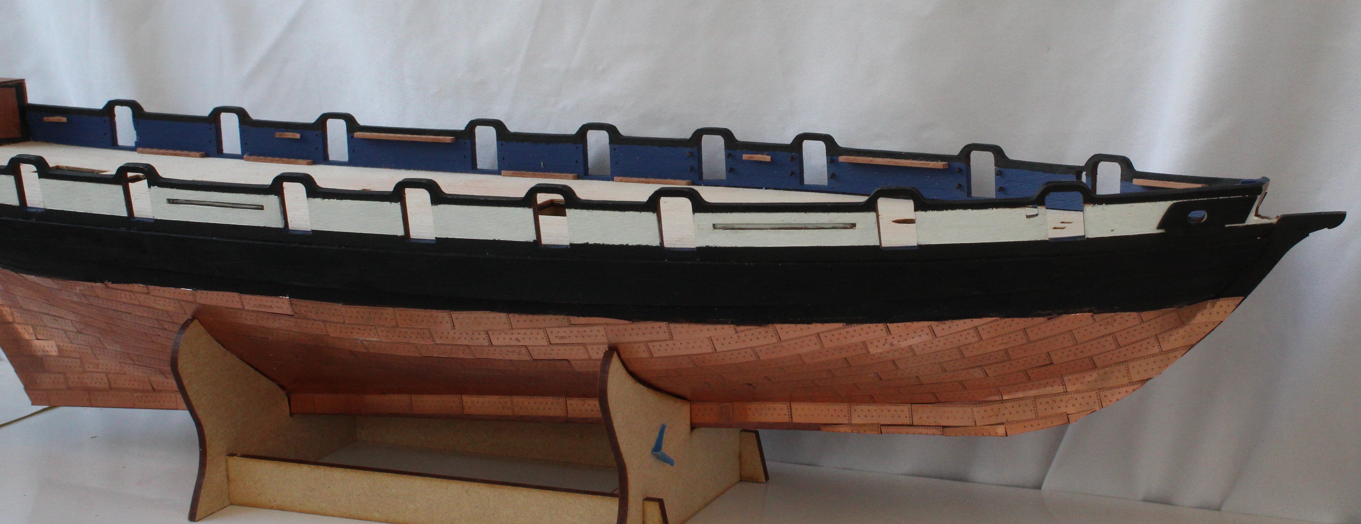

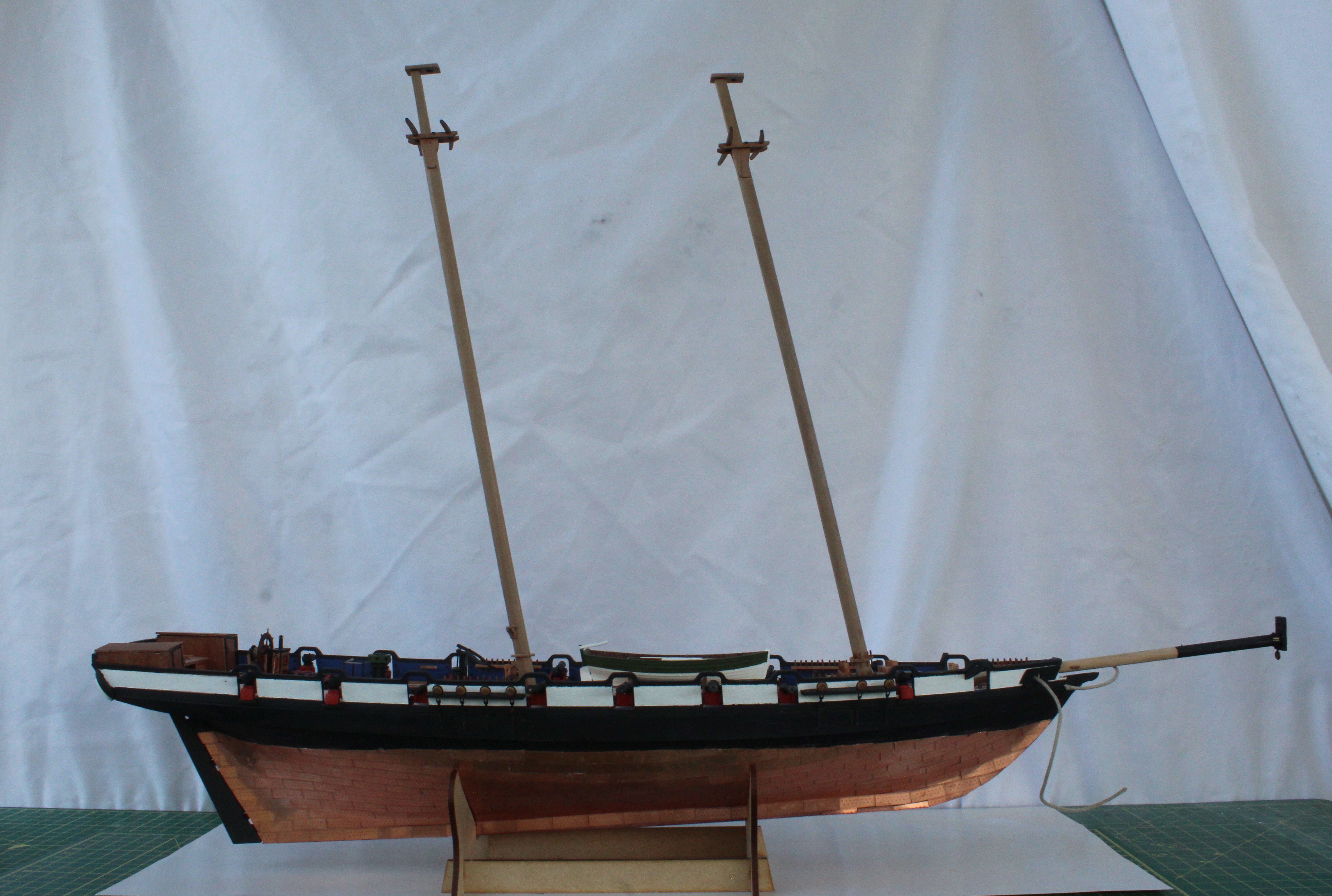

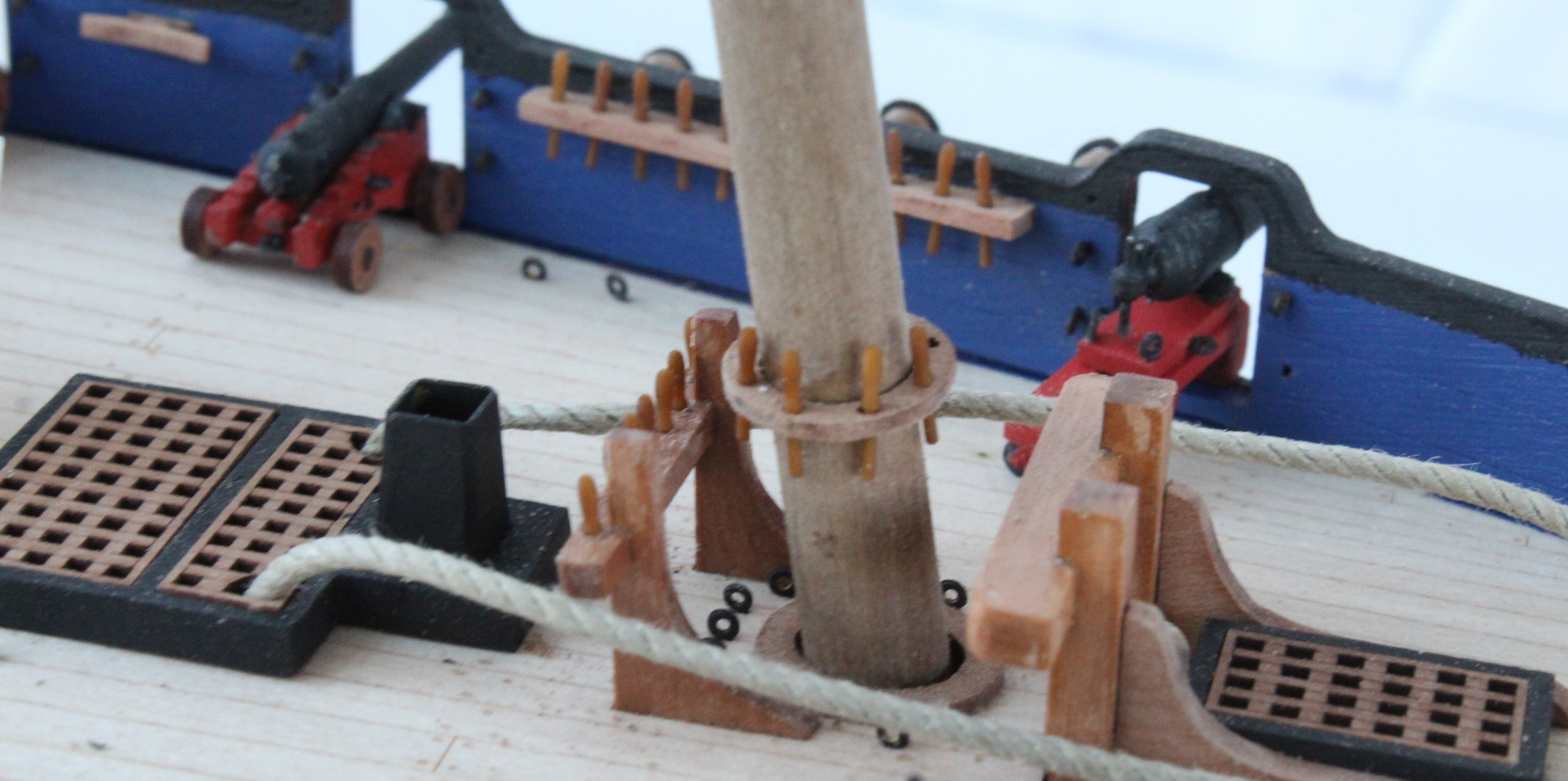

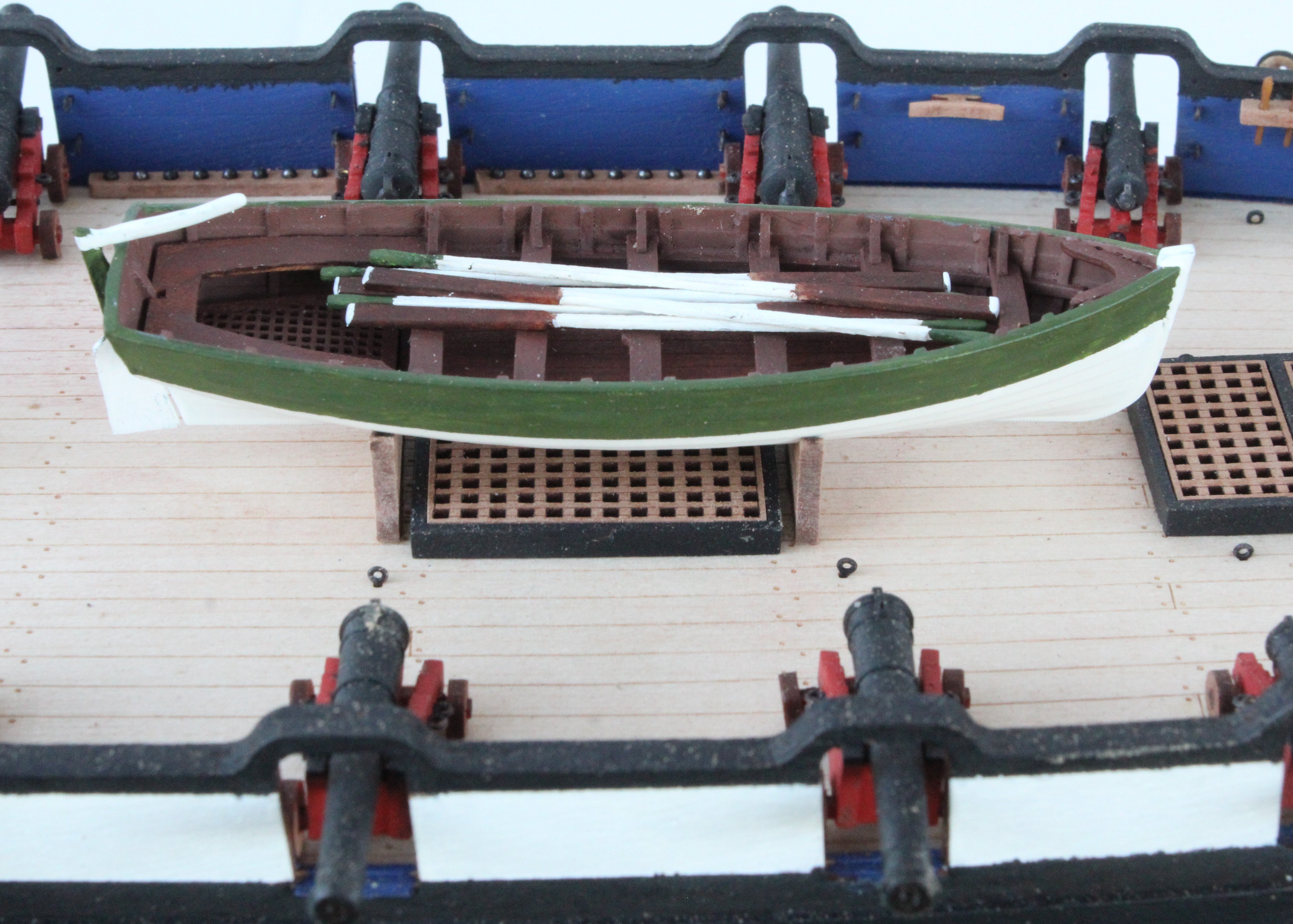

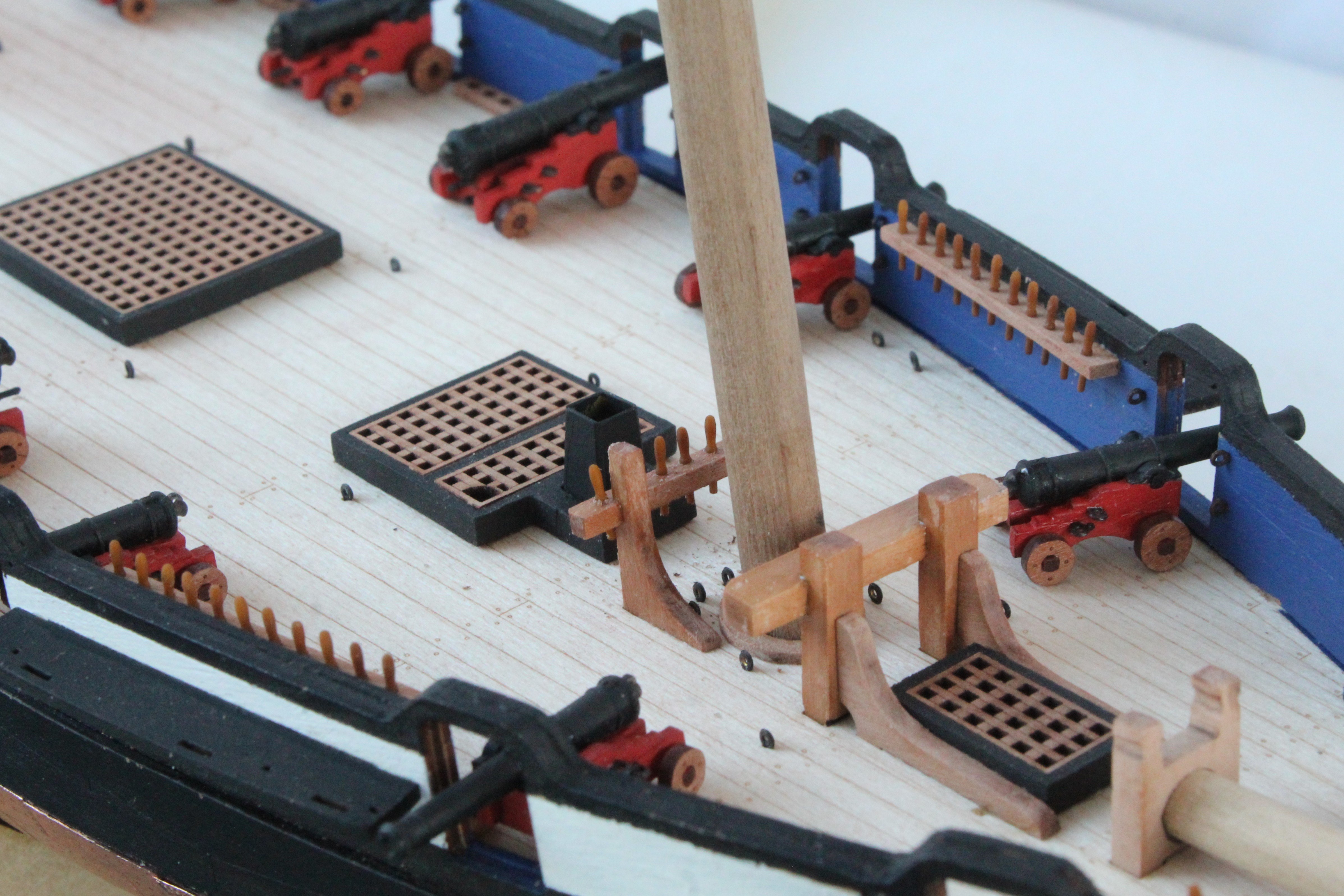

This will be my last post for the foreseeable future as the Duchess of Kingston kit is currently out for delivery. My daughter-in-law as always admired the first Duchess of Kingston model I built and was very pleased when I offered to build a new one for her. I have started a build log for the new build, just click on the hyperlink above to view (and follow).

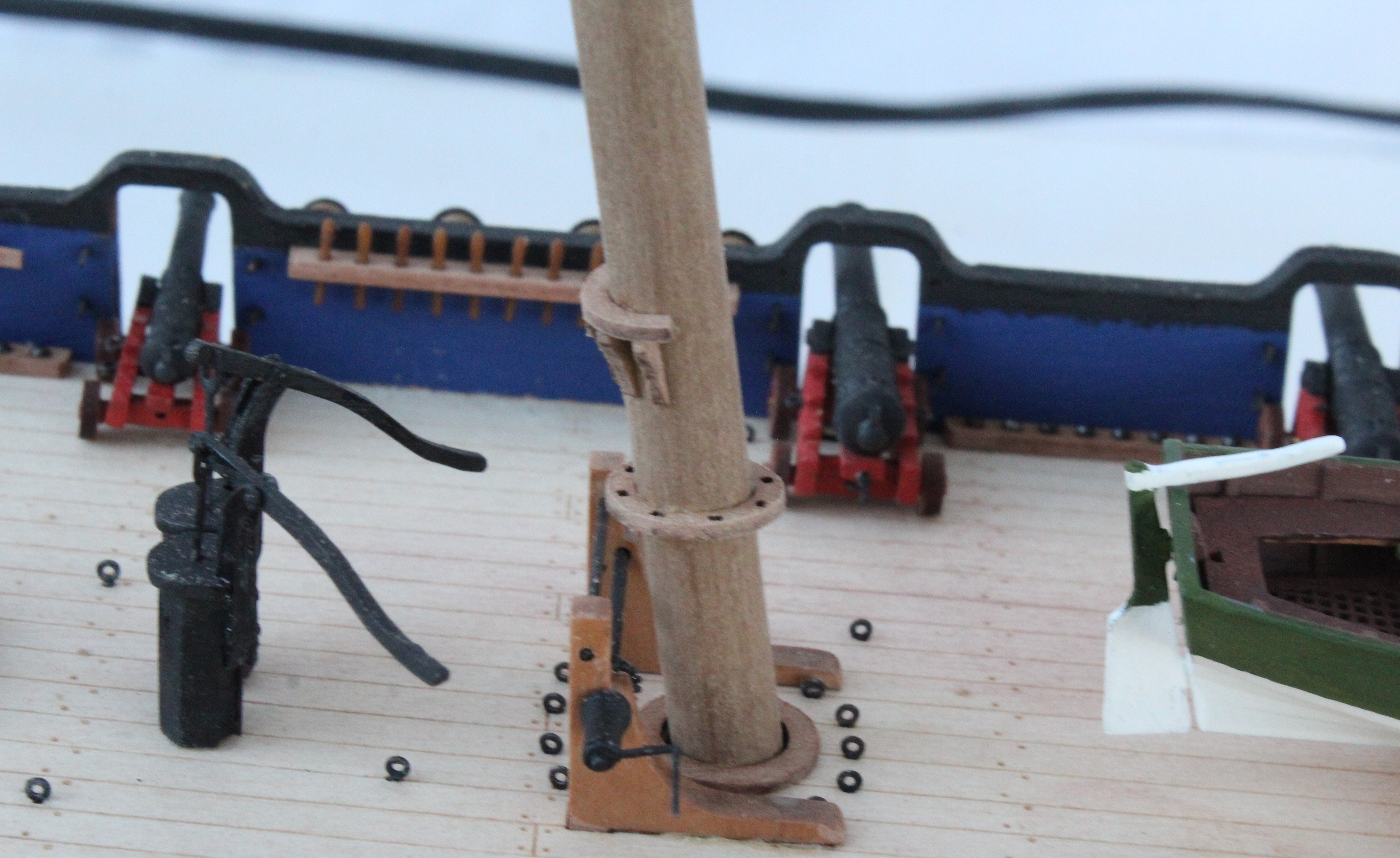

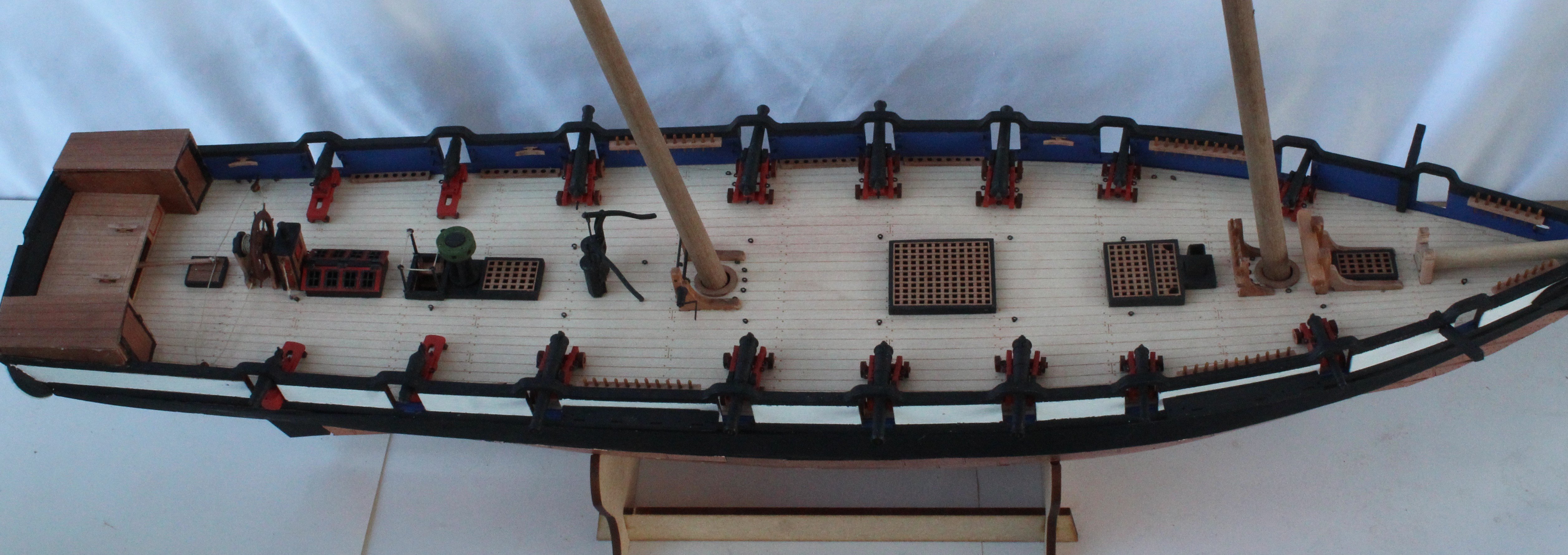

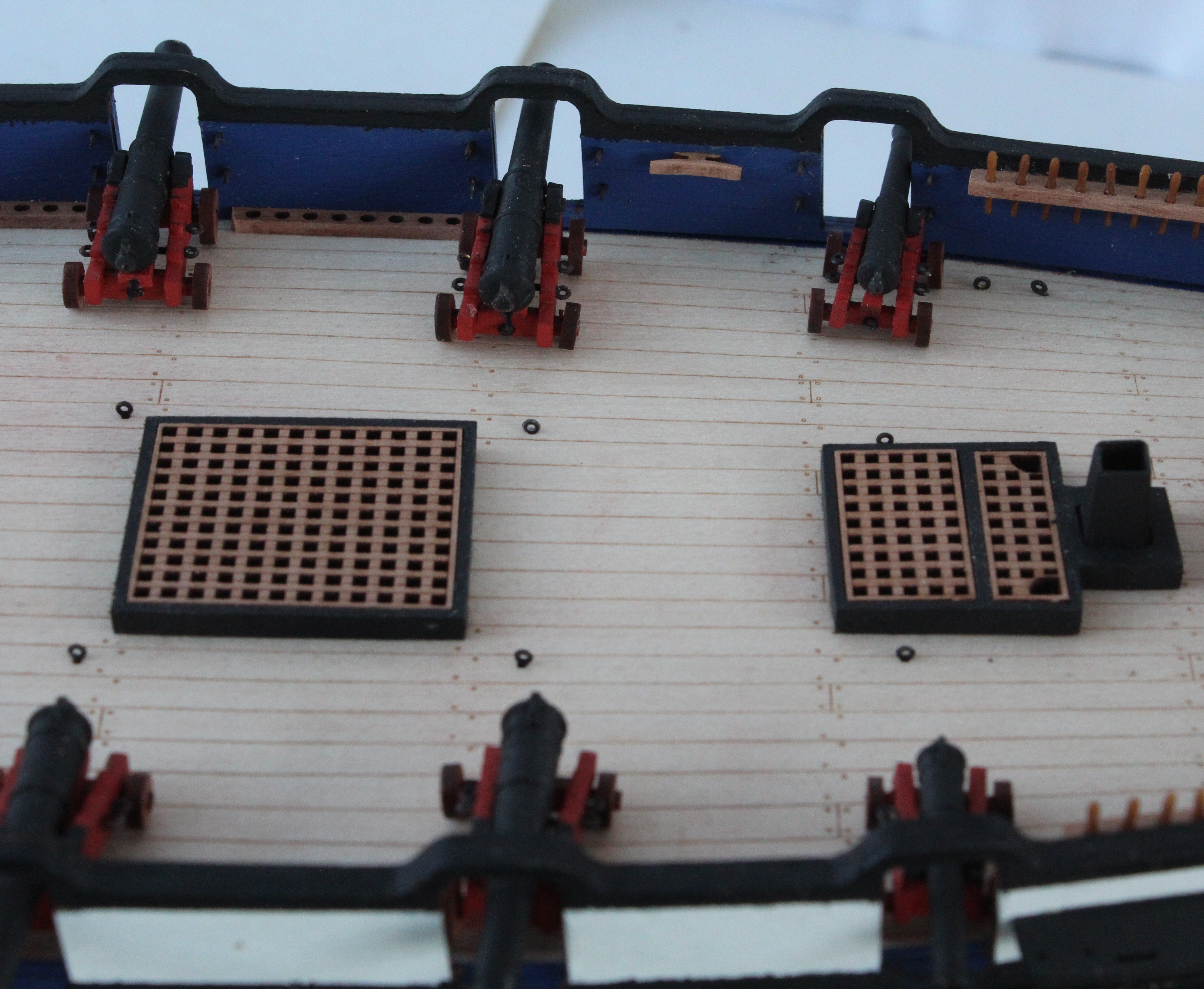

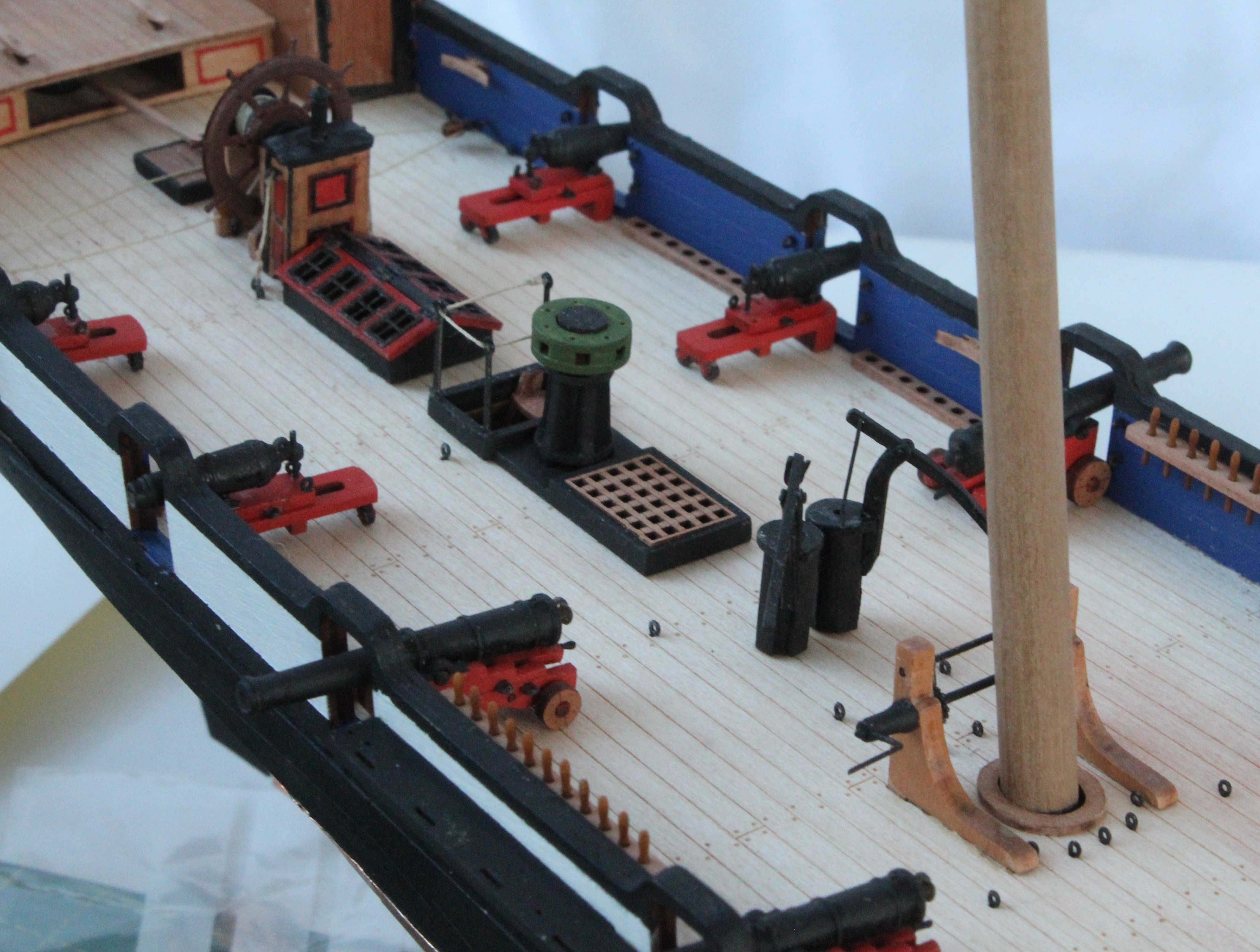

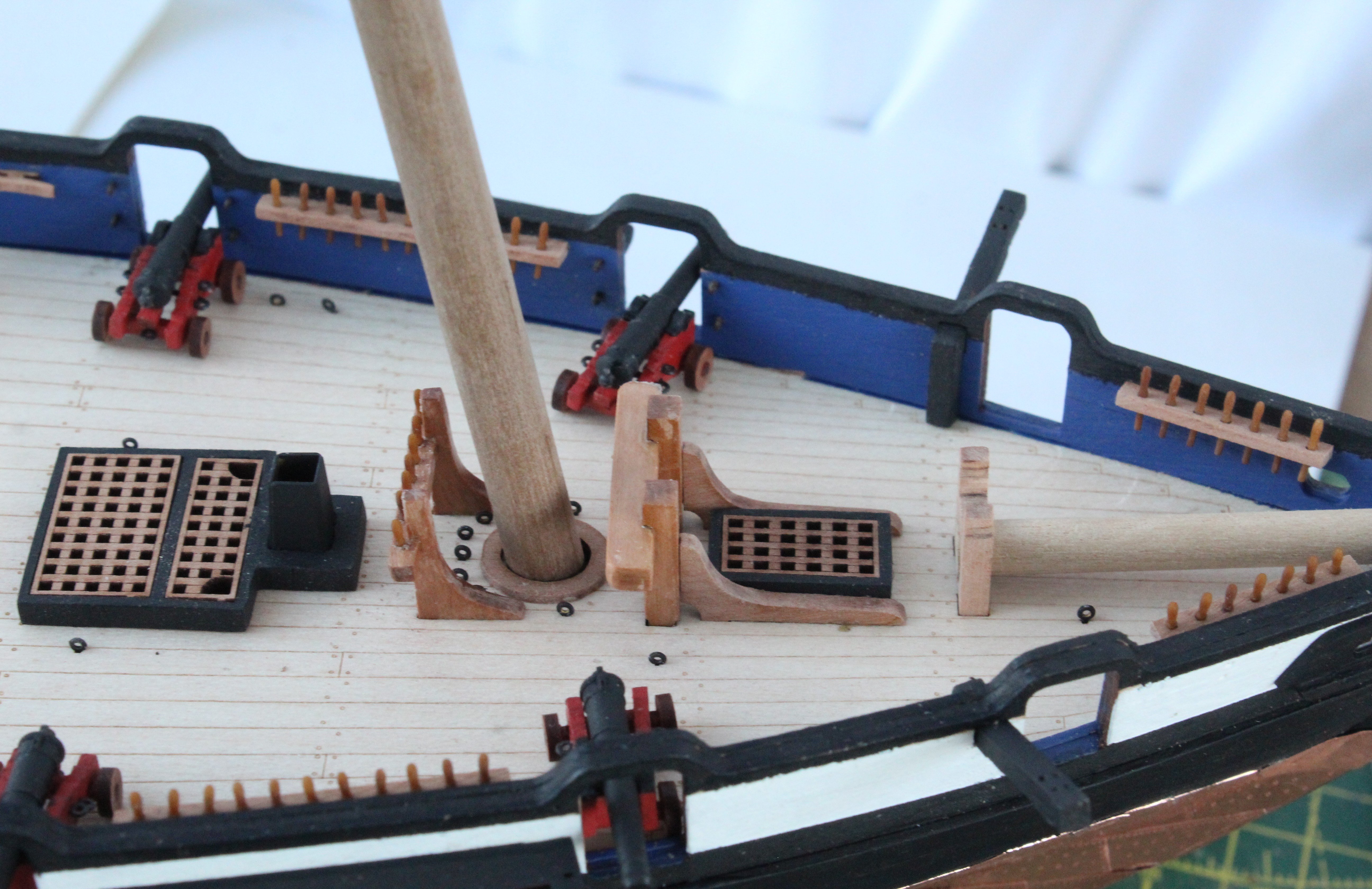

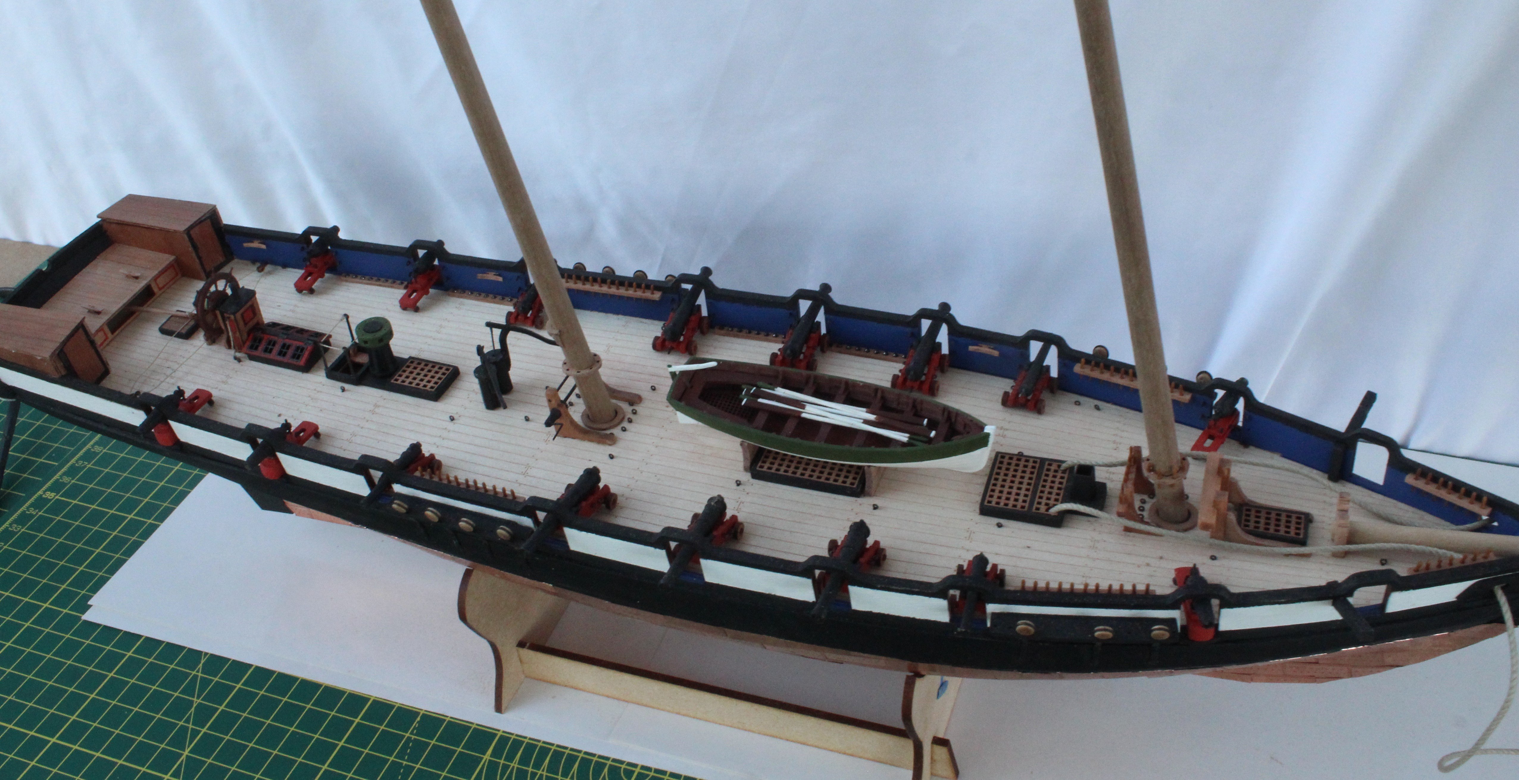

The first photo shows the current build status. It is a good place to stop this project as the next phase will be rigging.
The next photo show the deck items, the armaments have now been fixed in place.
The next photo shows the small cutter in situ.

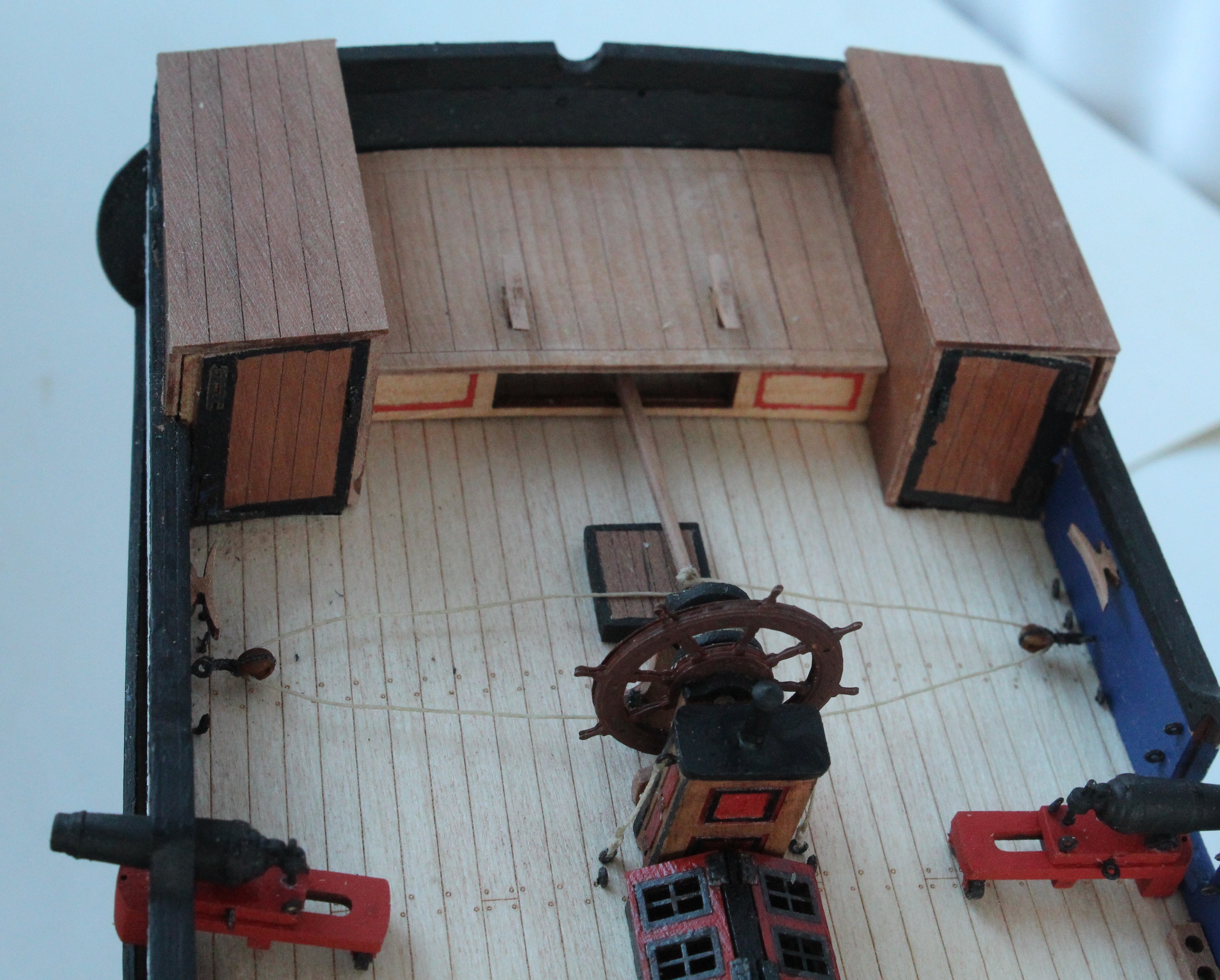

In the end I opted to fit 6 carronades, 3 per side, 2 at stern and 1 at the bow. The photo show the stern carronades in place, with the external base fitted beneath the gun port.
The final two photos show the fore and main mast. I ran out of the Syren belaying pins.
