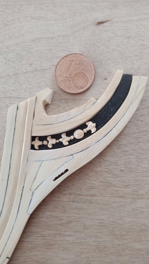

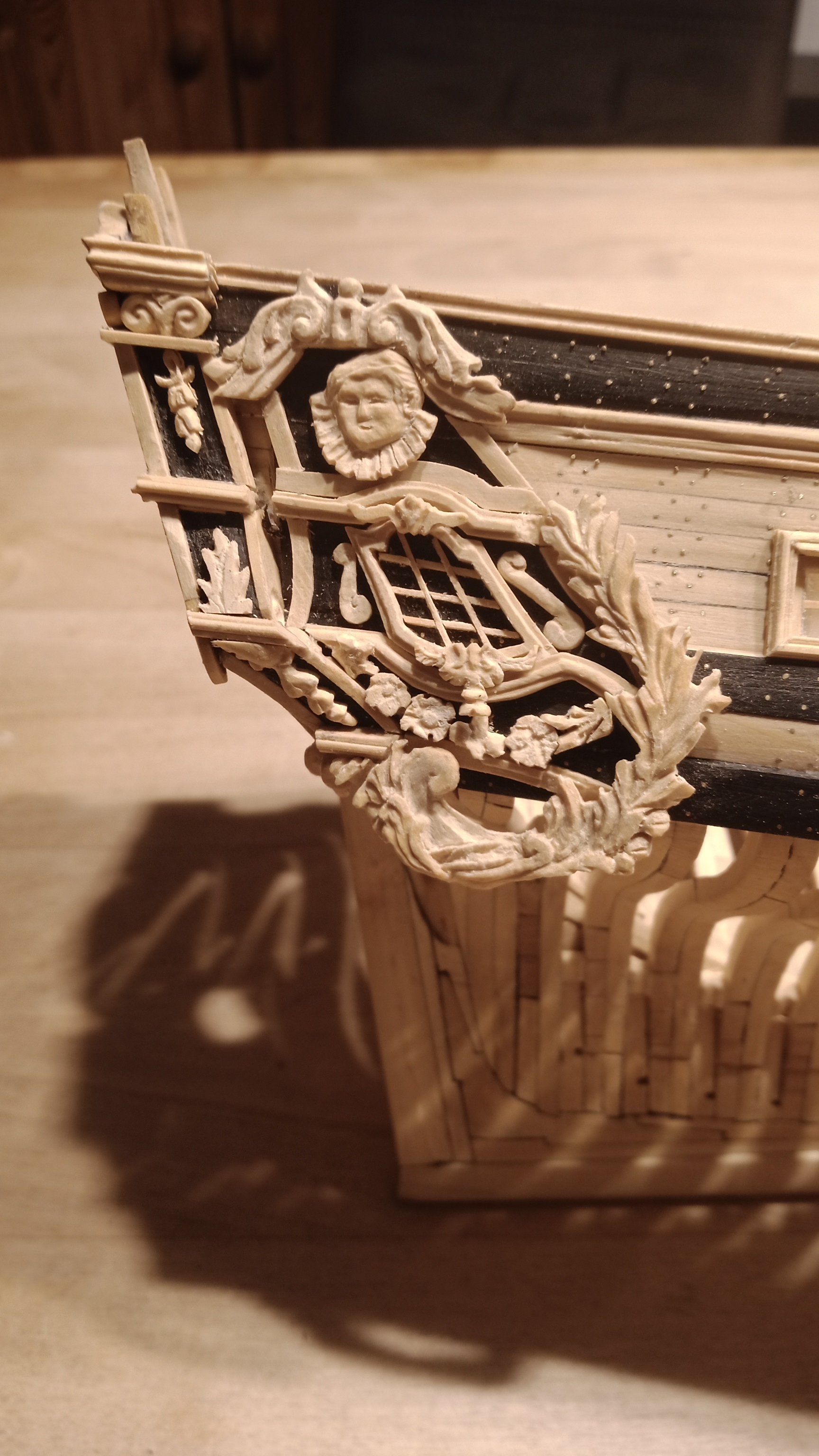

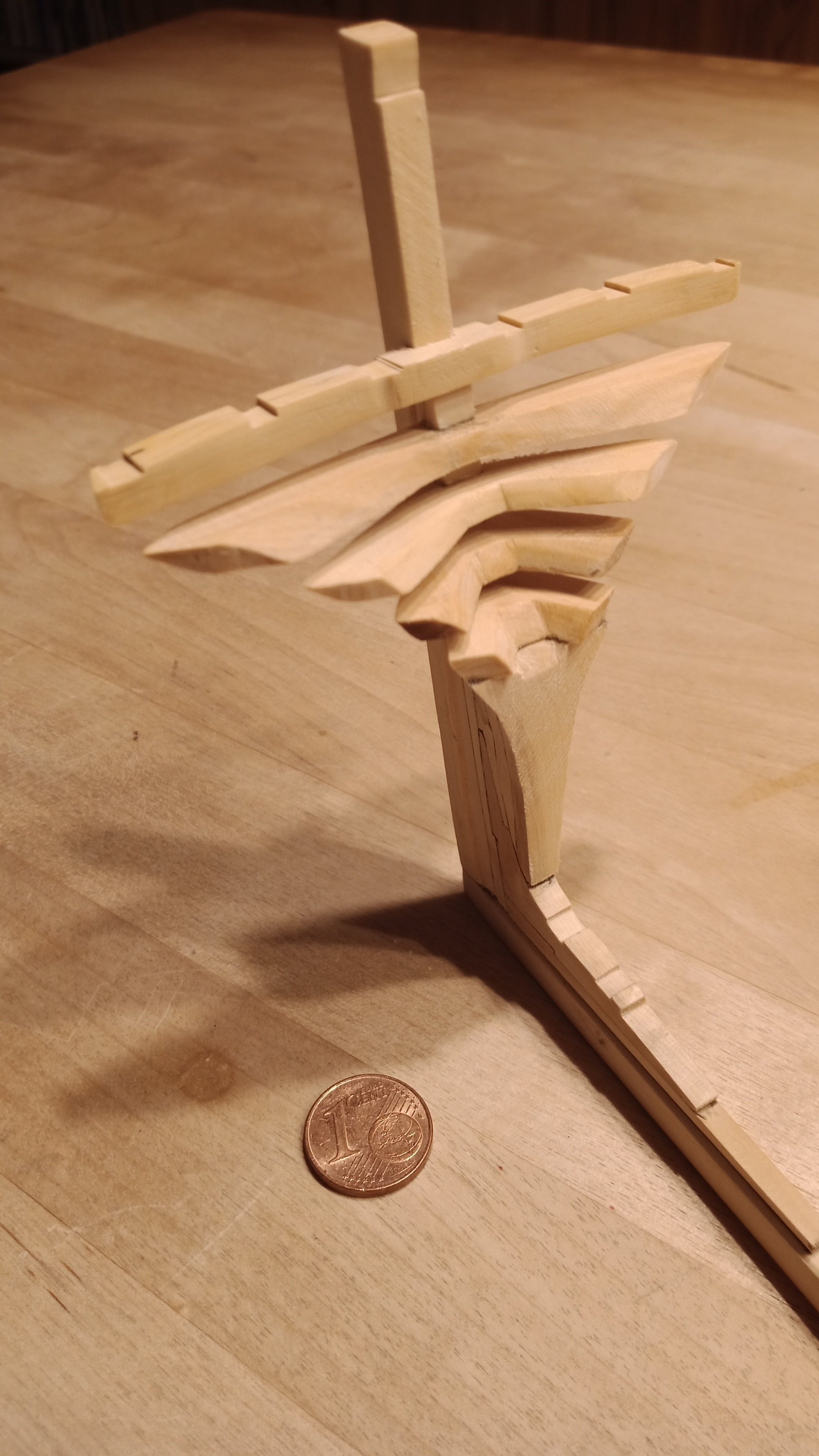

the hawse timbers (compared with those of la Vénus on the same scale):
The pictures show what happened next.

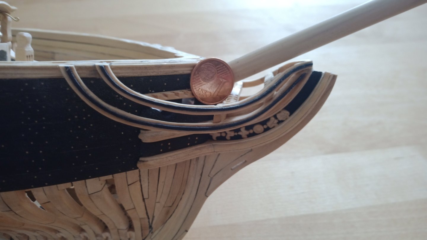

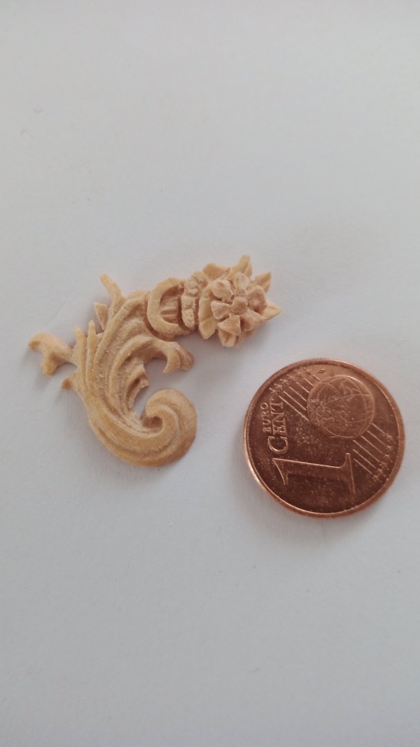

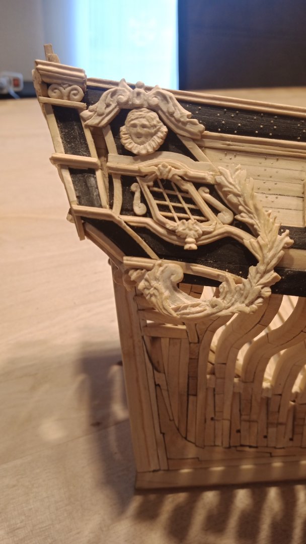

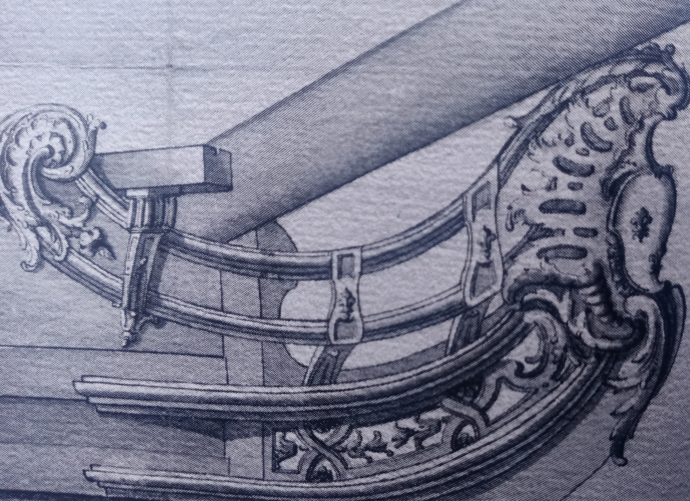

At this stage, a decision had to be made.

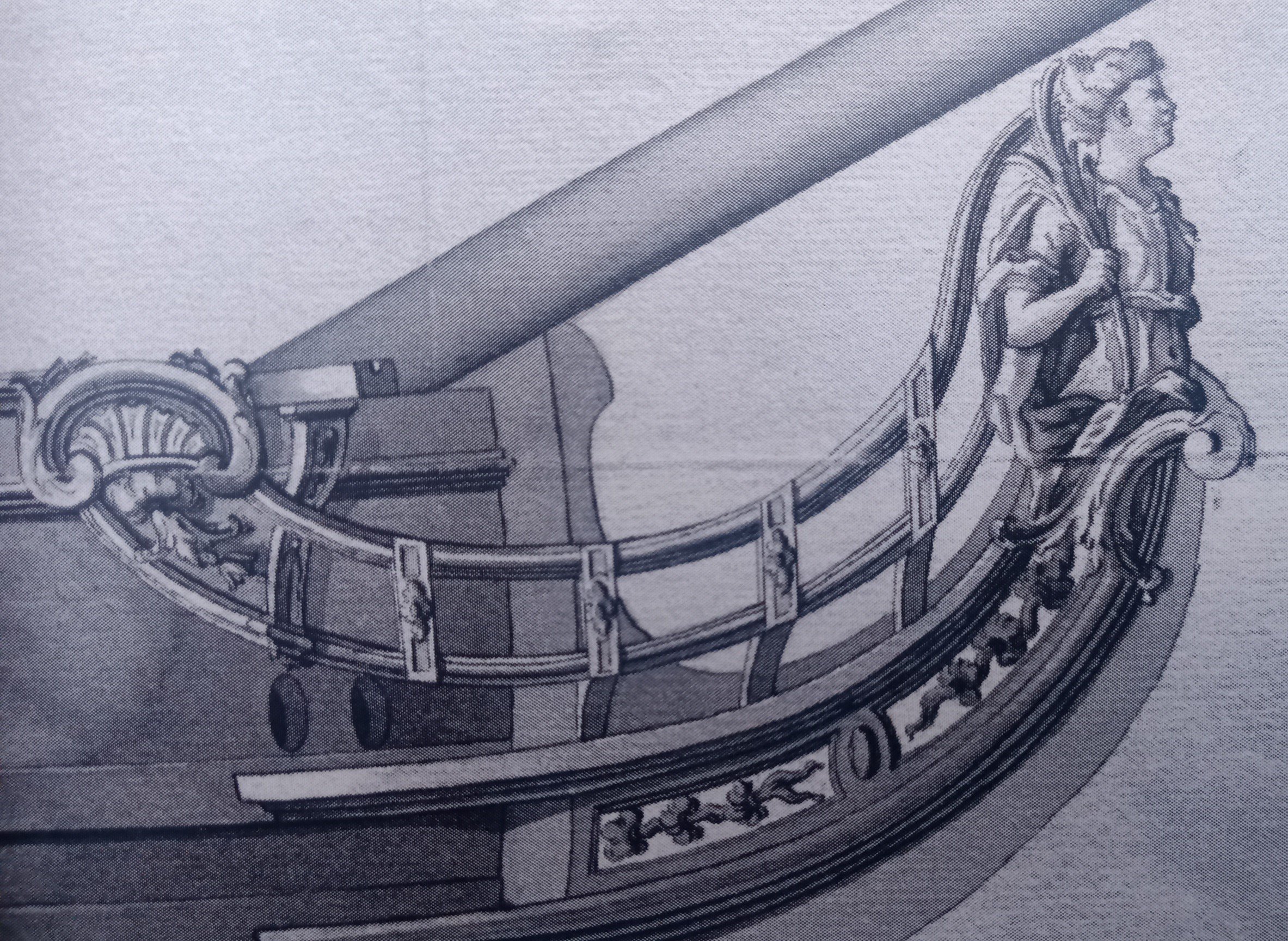

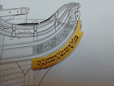

The first carvings on the bow had to be created now, as this area will be difficult to access later.

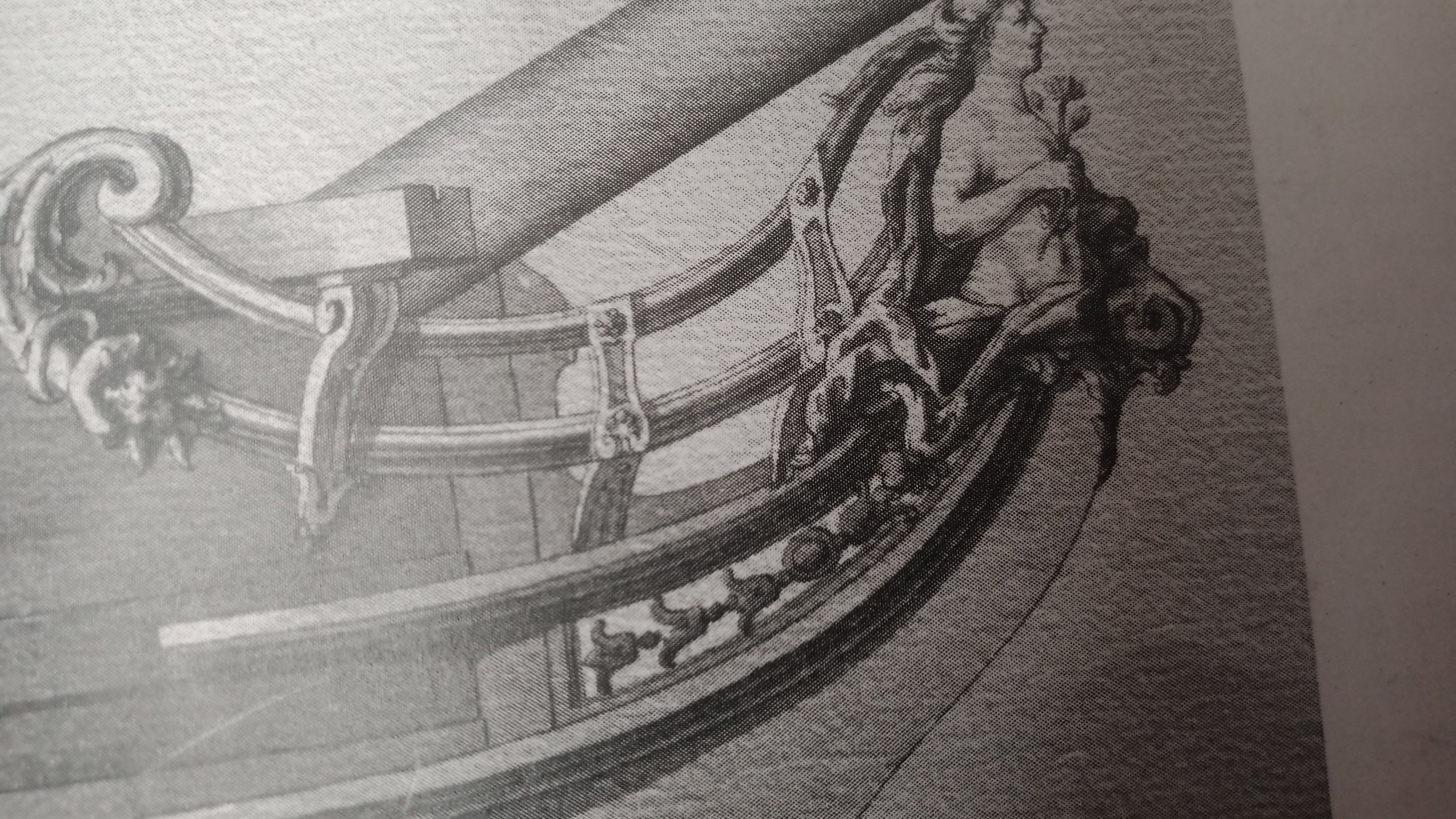

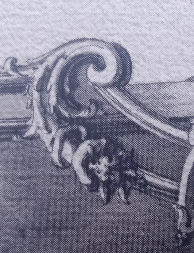

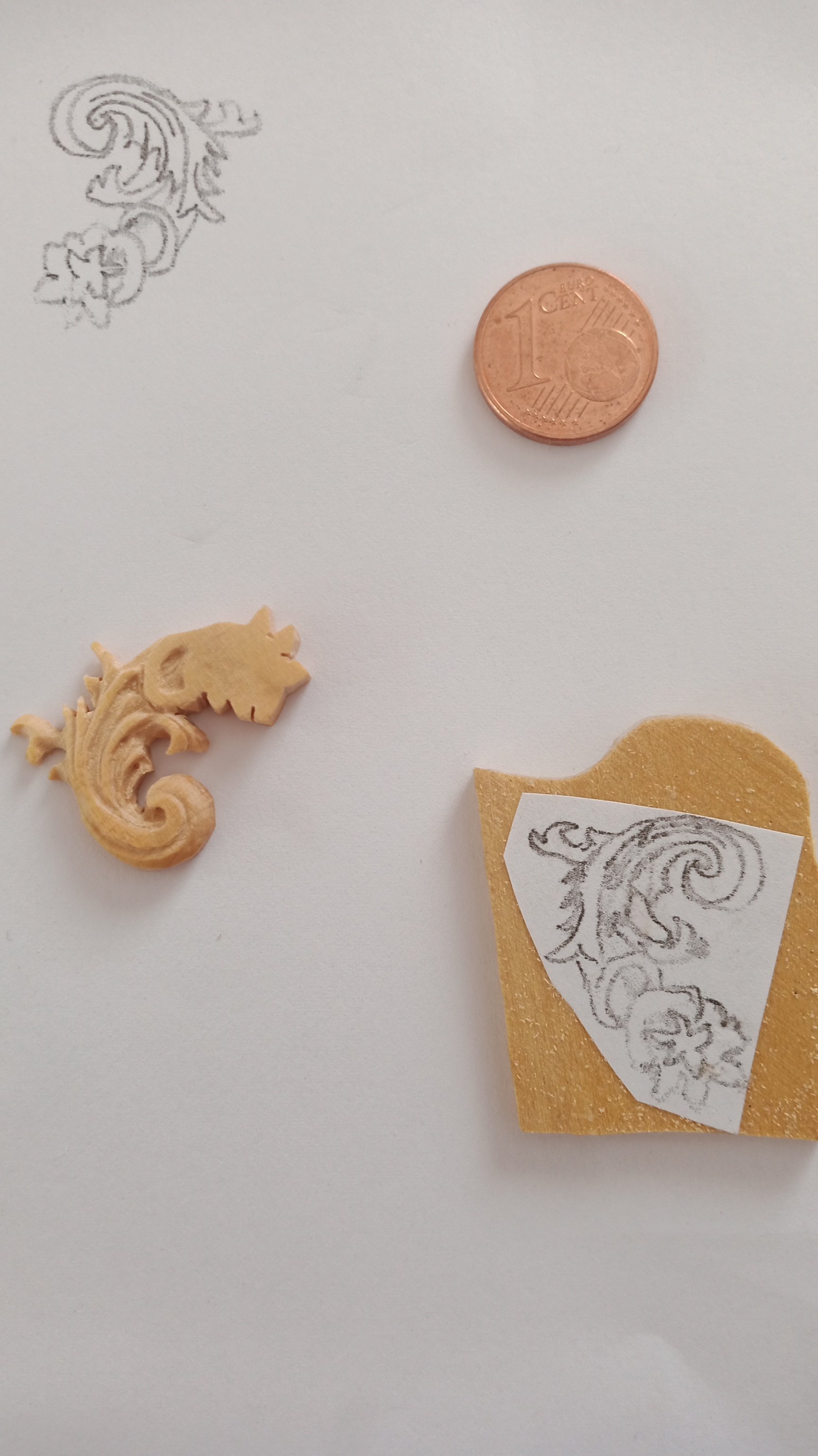

This meant I had to decide on one of the three sister ships. They differ almost only in their decoration.
For his plan, Gérard Delacroix chose L'Amarante. Its figurehead was an ornate coat of arms.
La Palme and L'Anémone had female figures as figureheads instead of coats of arms.
My decision...well, what can I say...I prefer a pretty woman.😉
In conjunction with the decorations on the stern, I chose the l'Anémone.

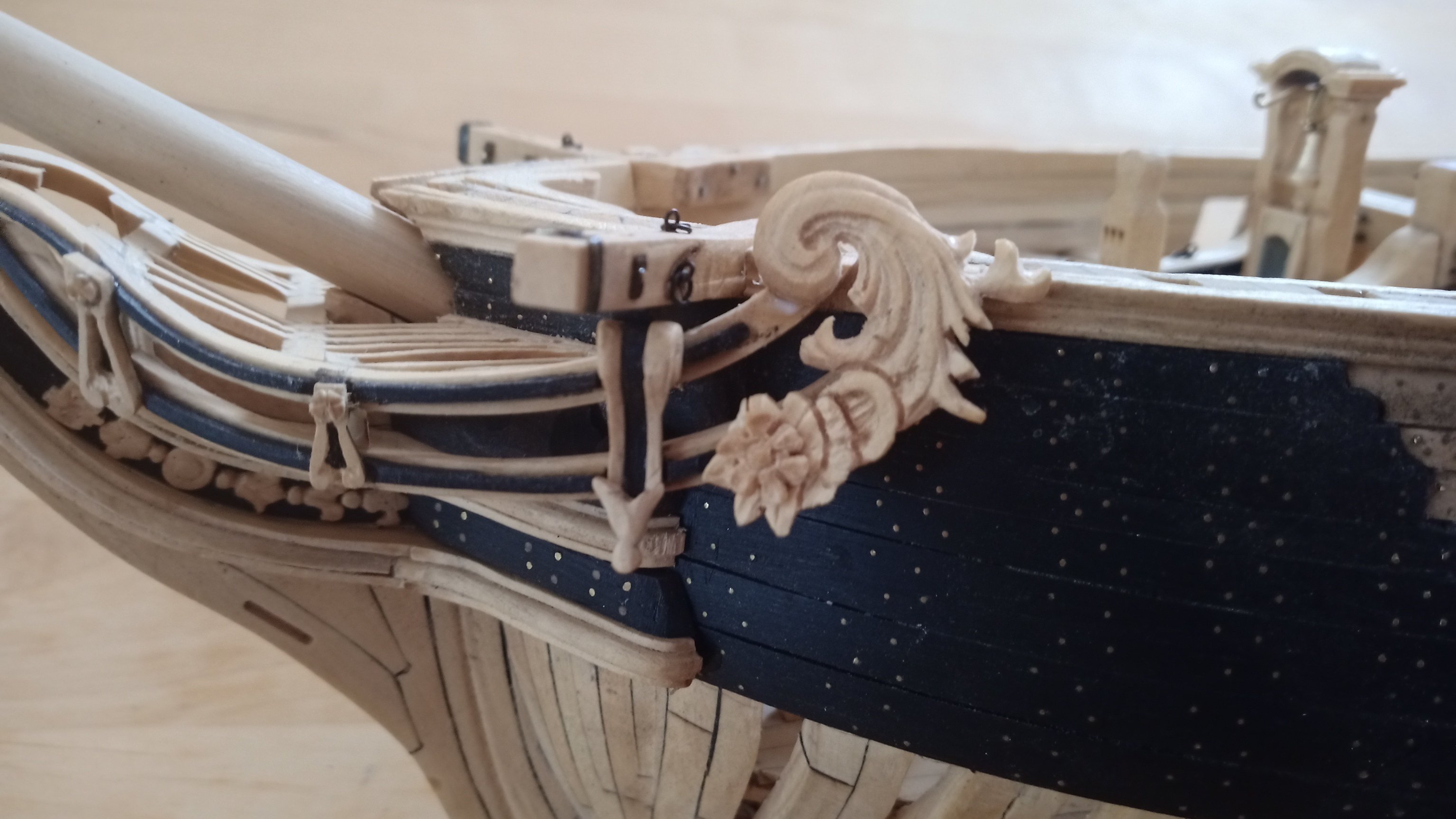

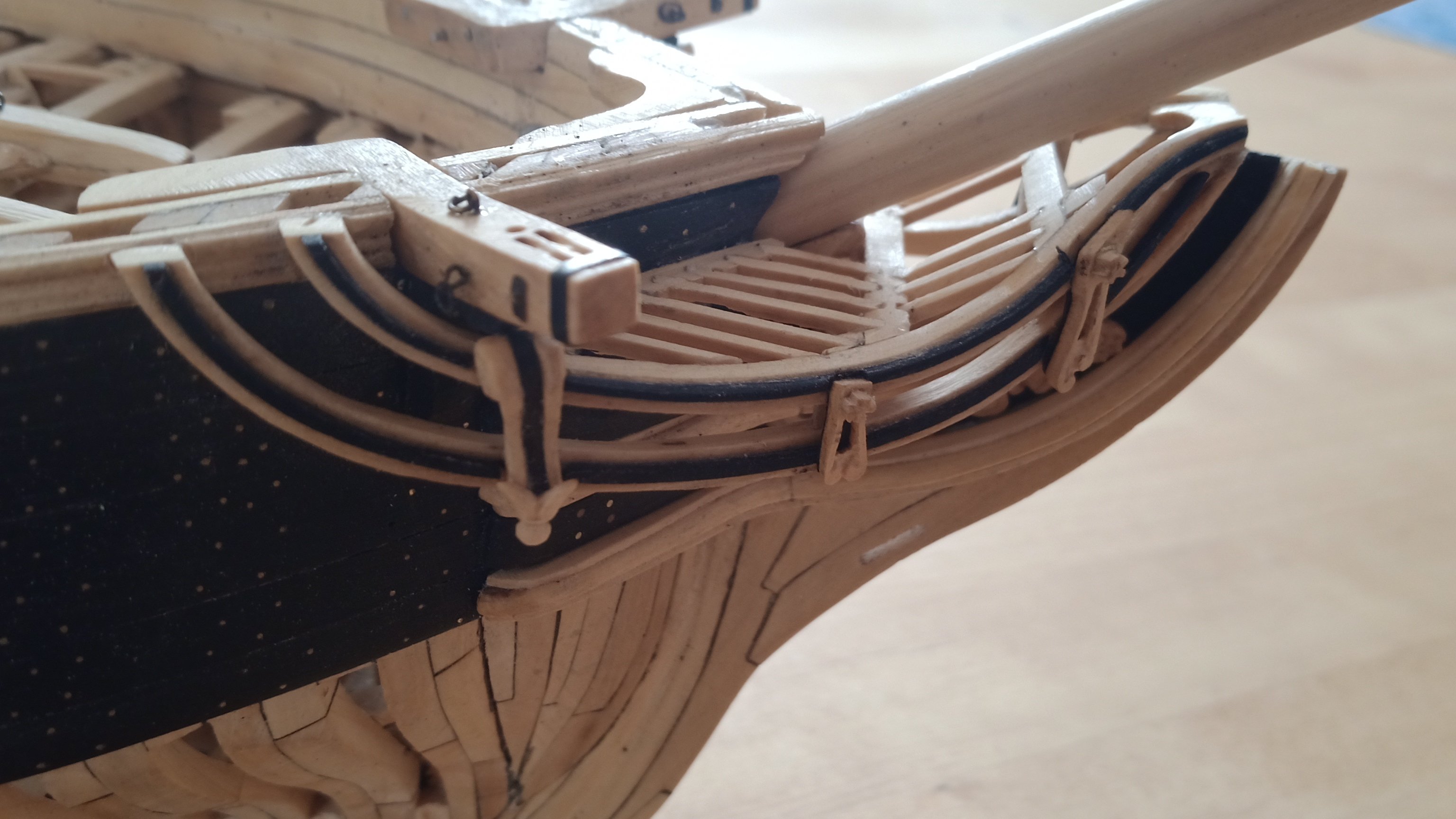

The carvings on the bow were interpreted by Giampierro Ricci and Vladimir (marsalv) as open, or free-floating.
However, this seemed too delicate to me for such an exposed element subject to heavy seas.
My interpretation is therefore as follows:
to be continued...

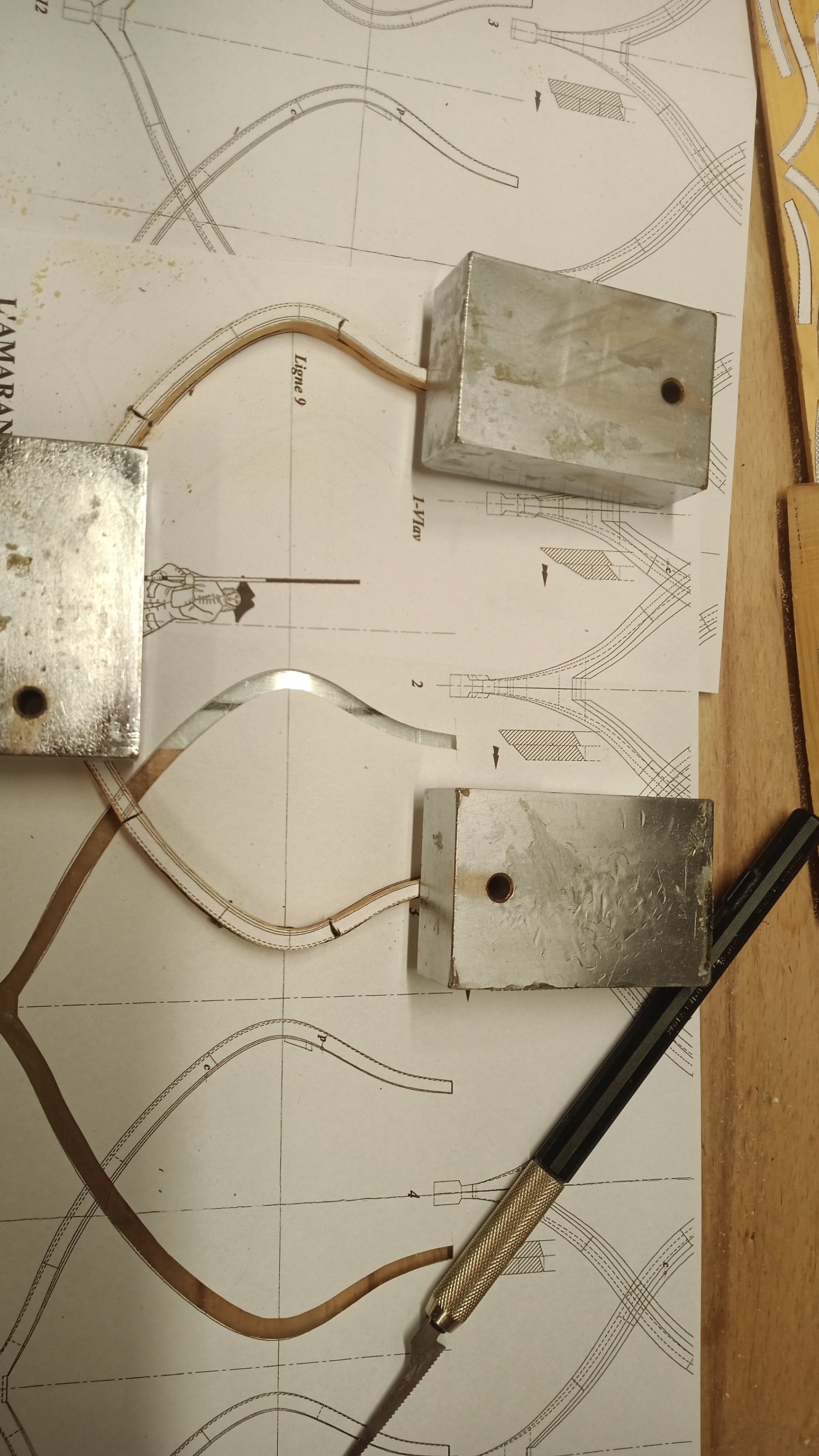

Hello everyone
Hello everyone

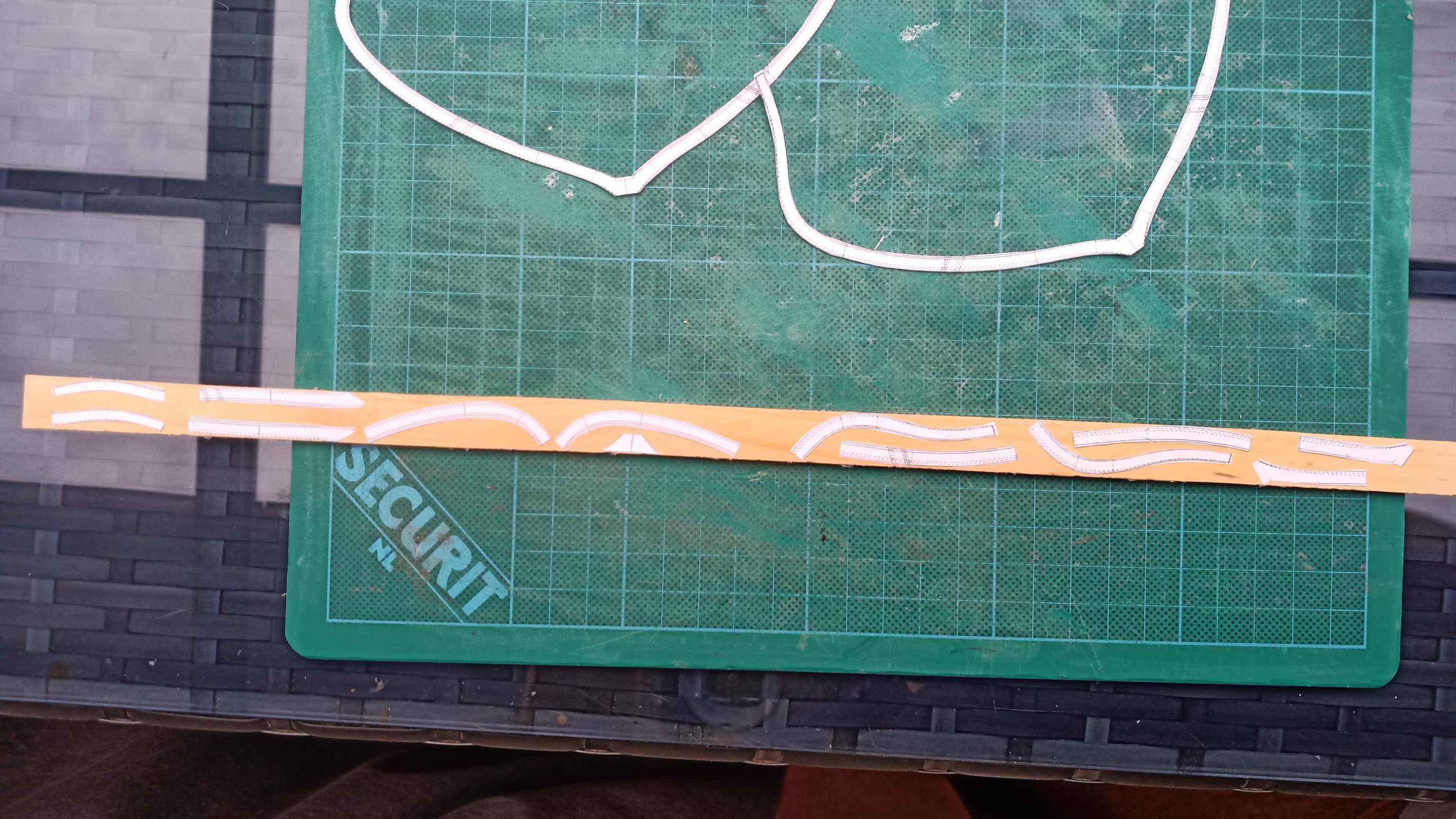

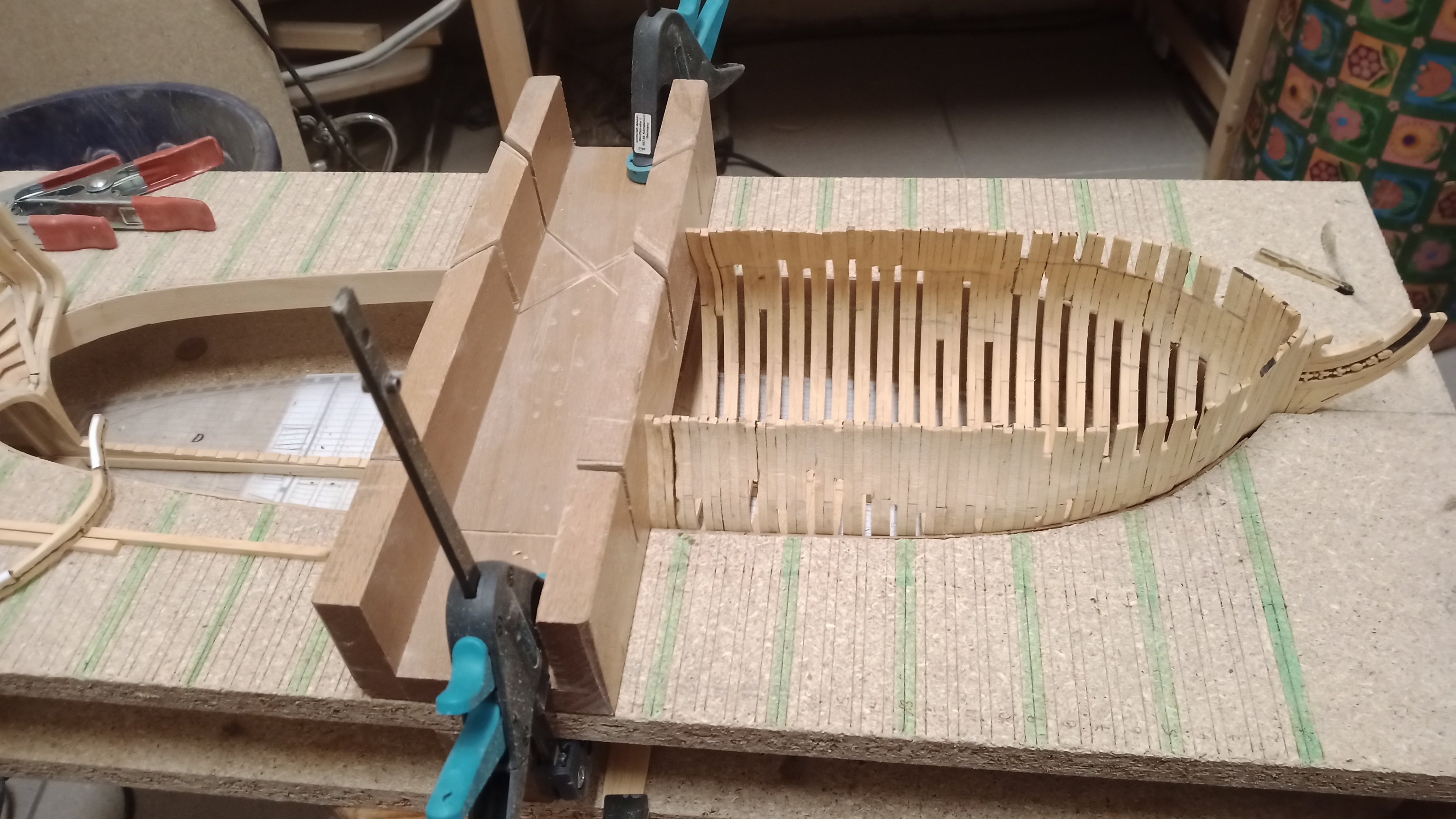

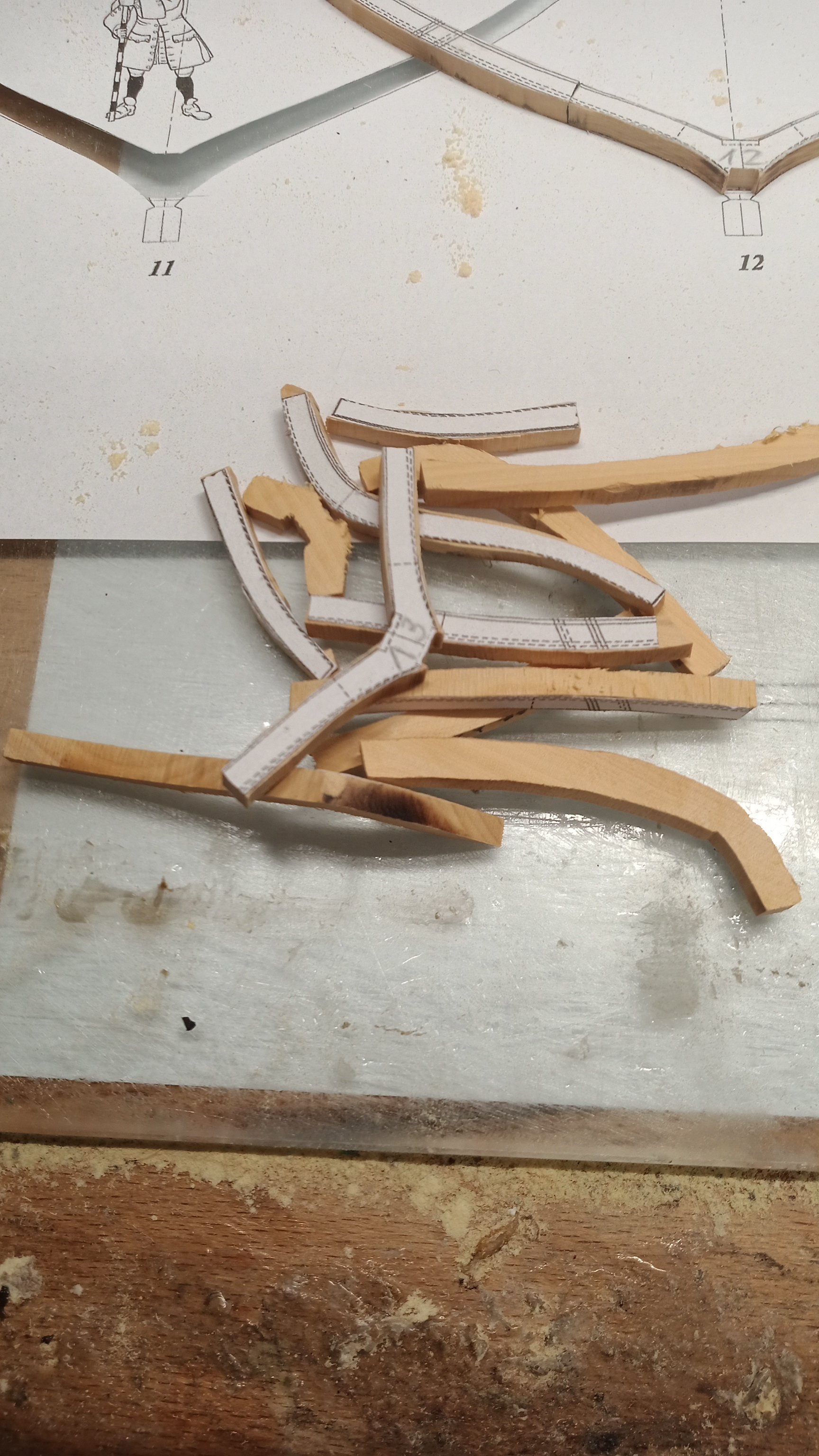

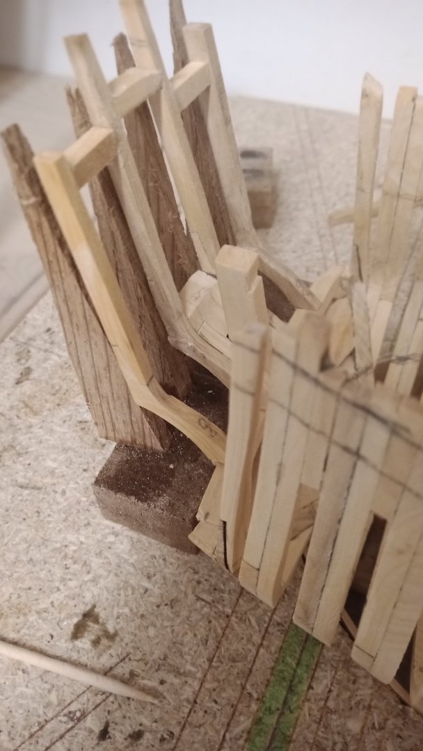

The rear (hopefully these are the correct terms or are translated correctly)

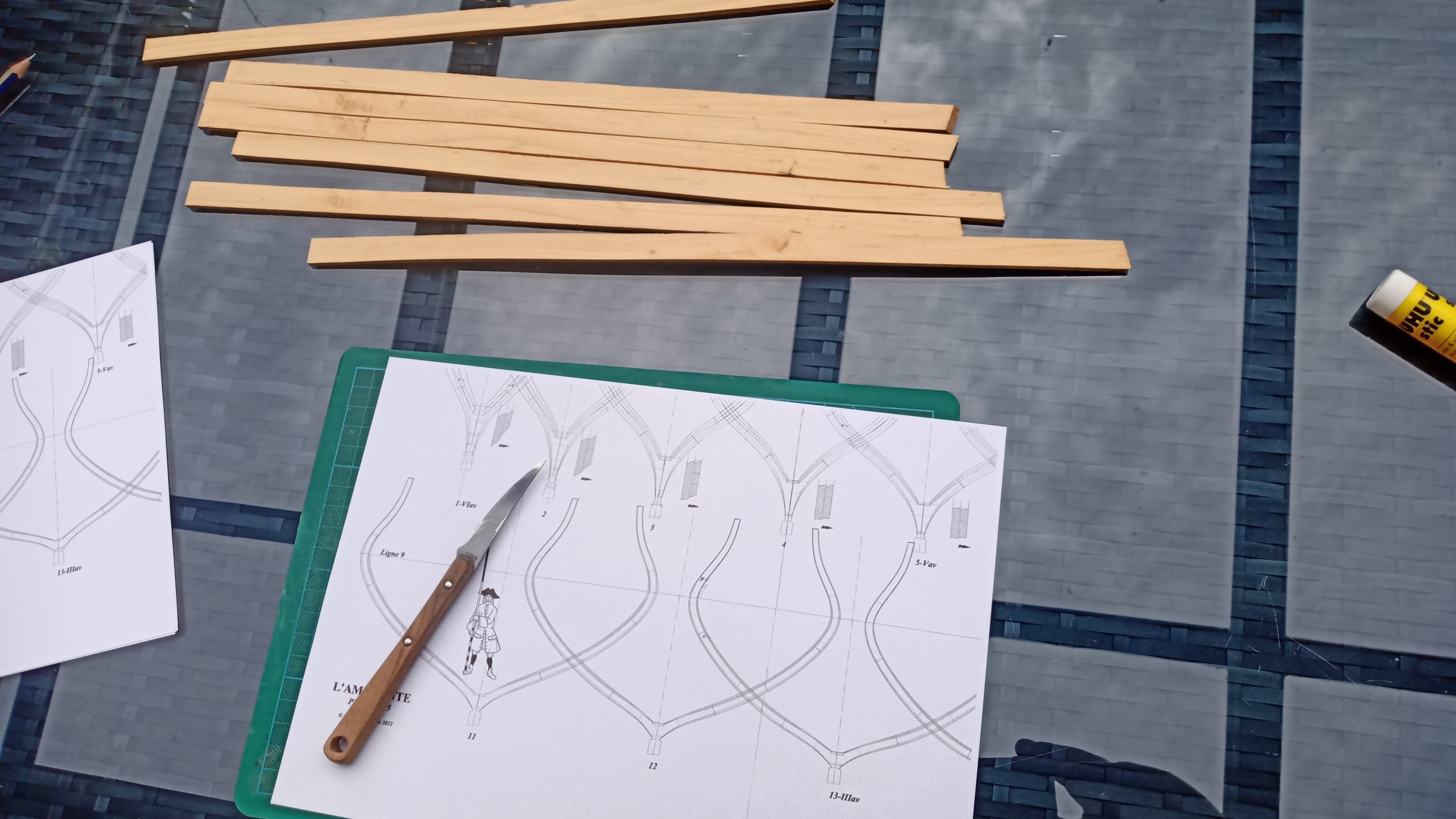

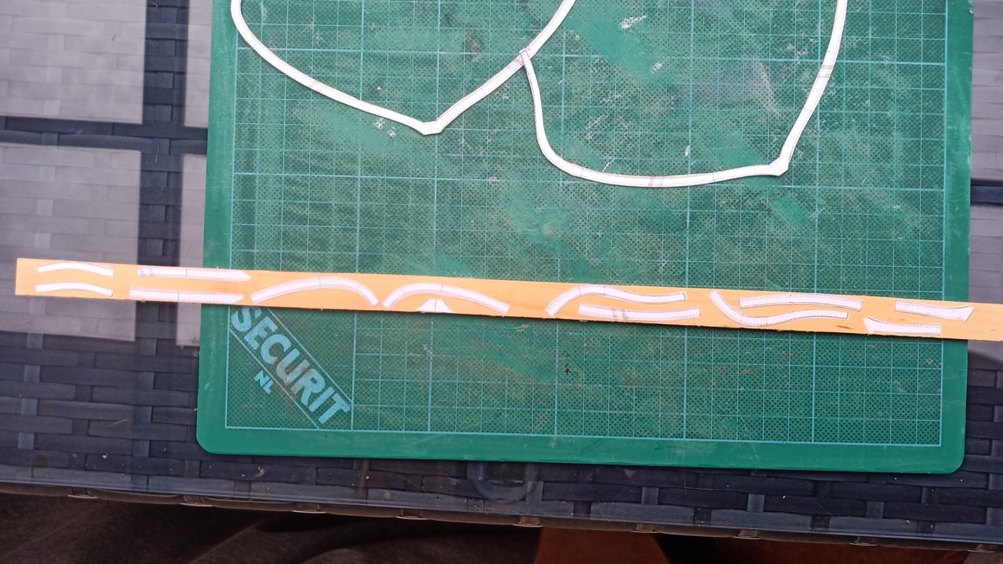

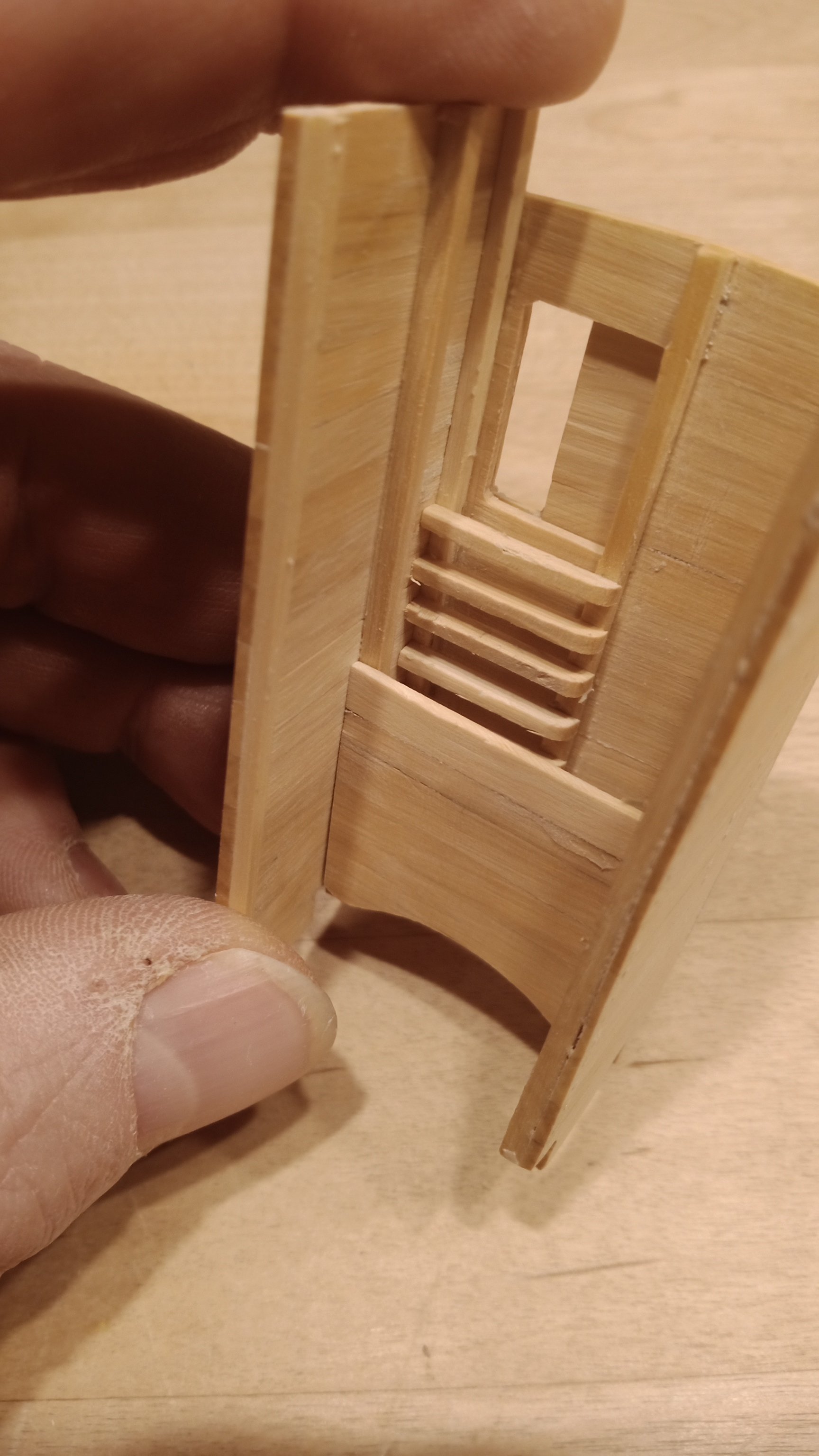

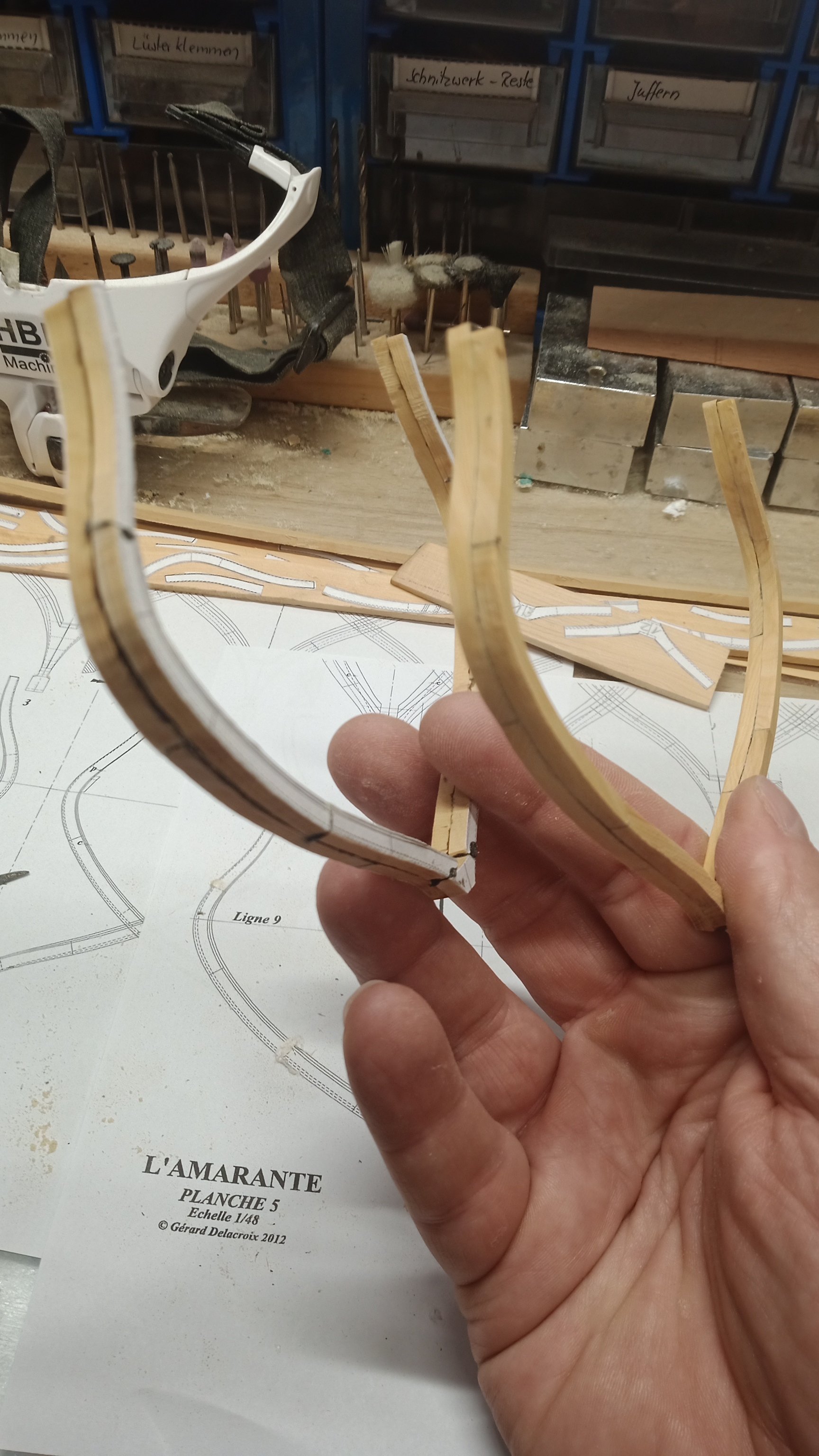

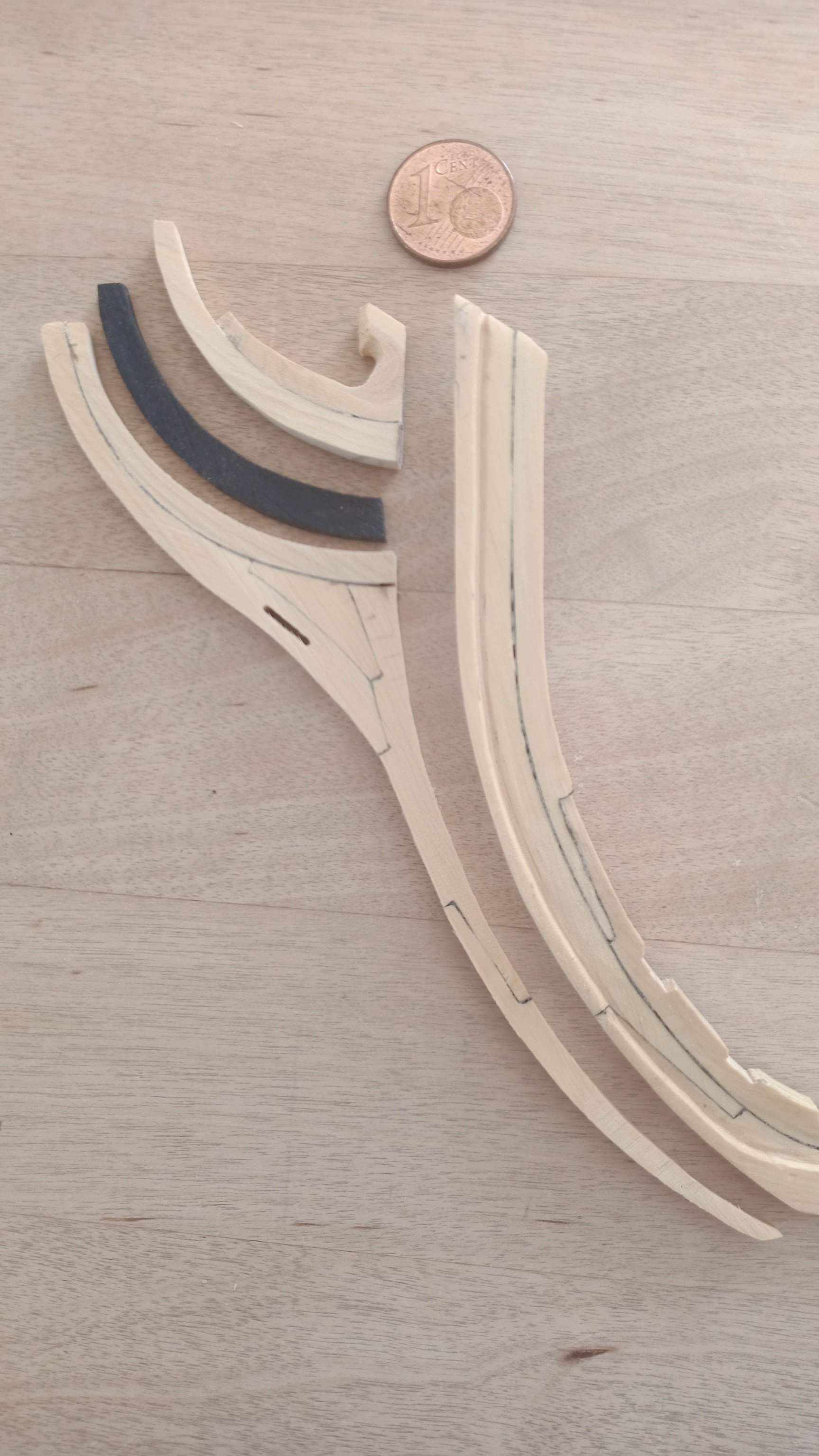

How I made the frames:

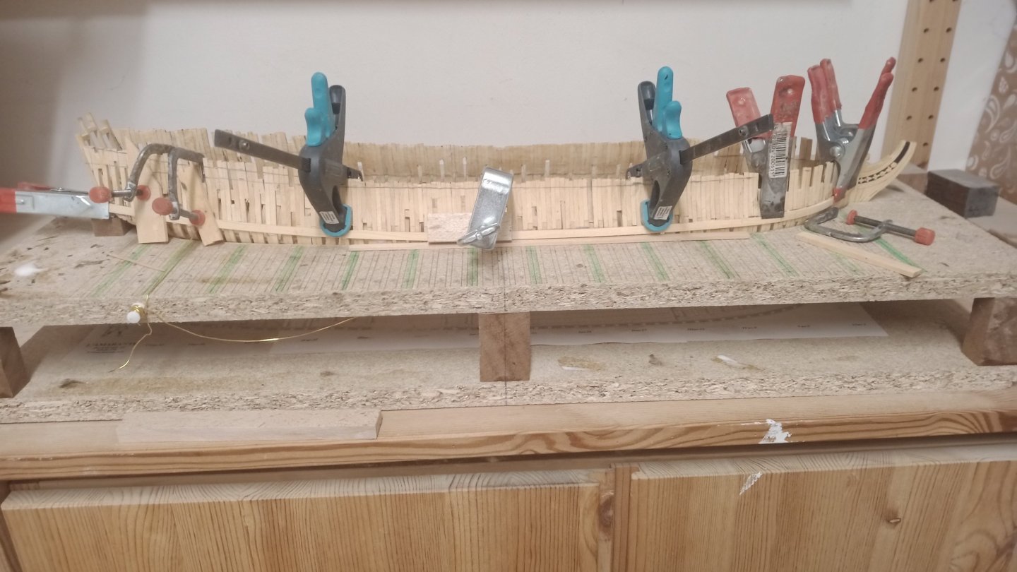

Copy the plan, cut out the paper frame.
Disassemble the paper frame into its individual parts.
Glue the segments onto a boxwood strip. Consider the grain as much as possible.
Cut out.
Clean, sand.
Reassemble the individual parts to form the two frame halves (almost like a puzzle).
Assemble the frame halves (left before, right after pre-shaping).
Installation
to be continued

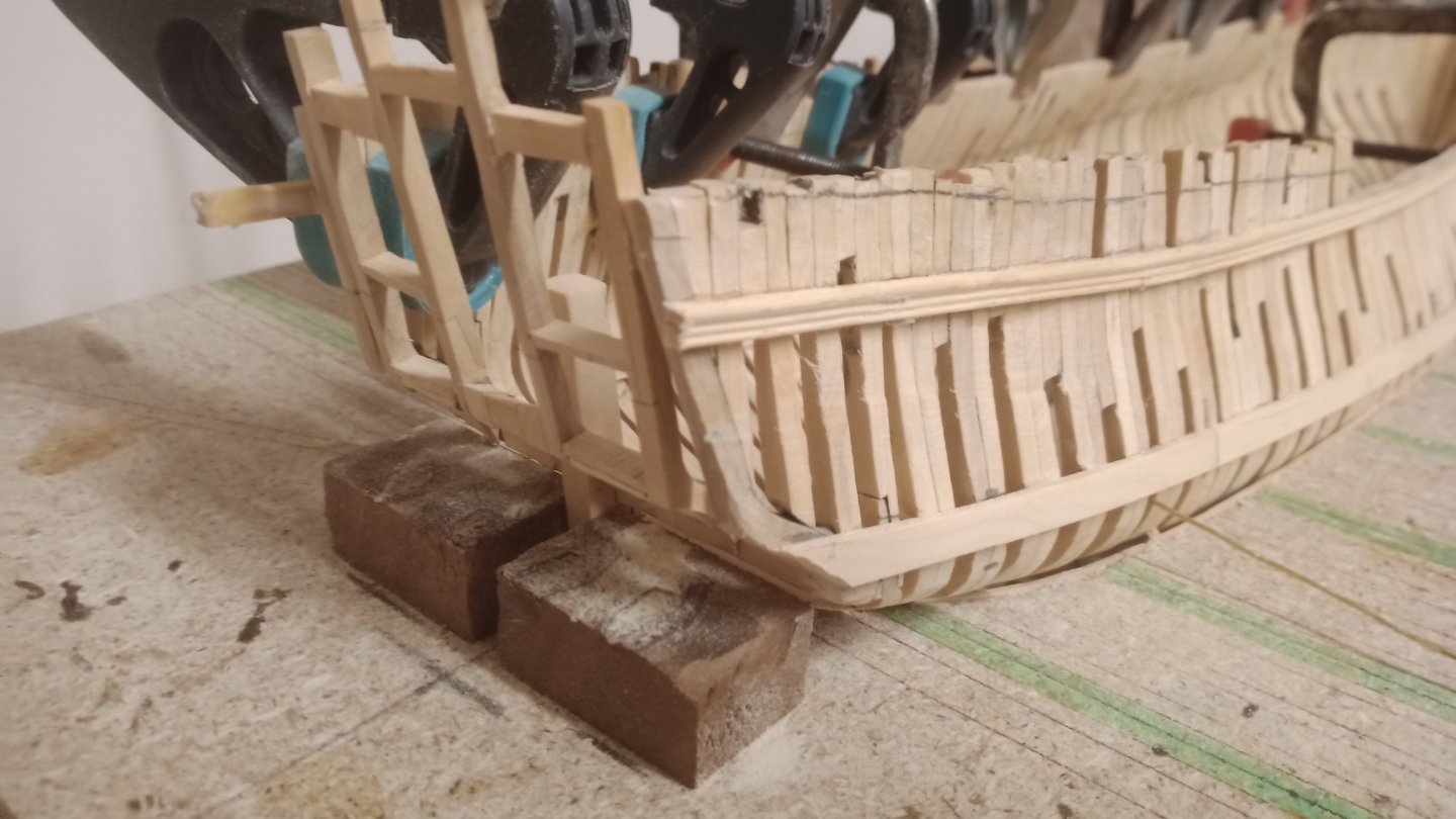

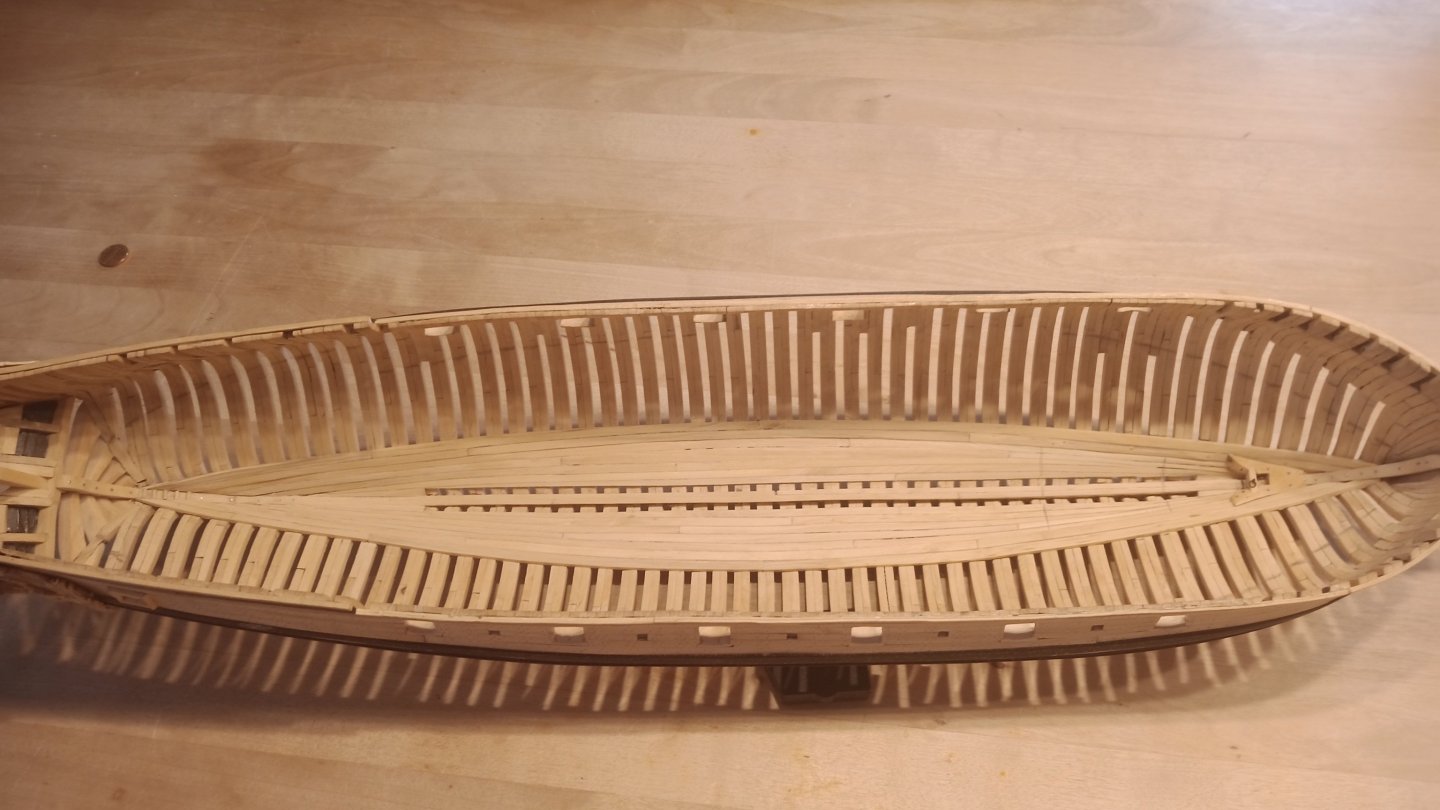

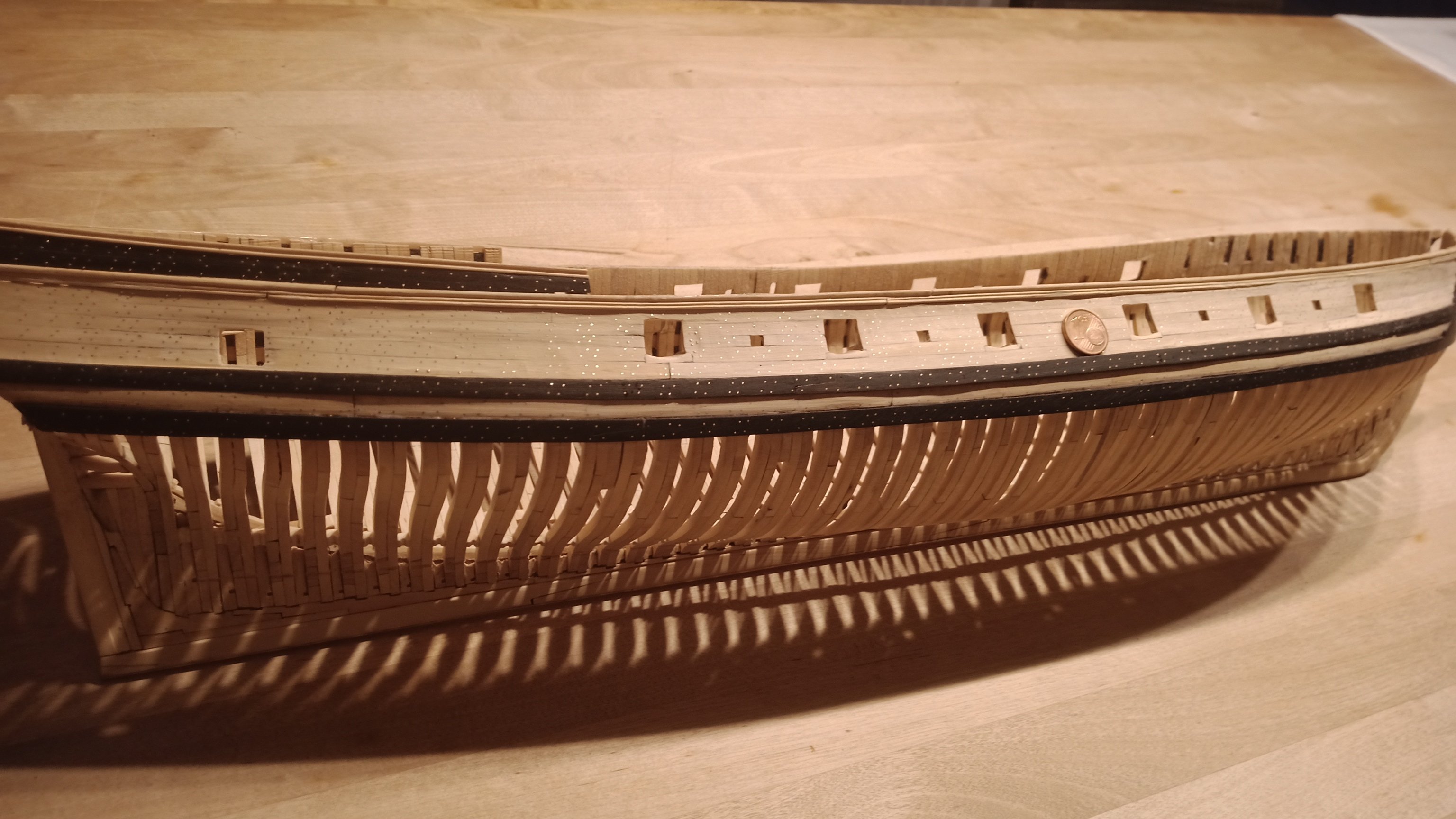

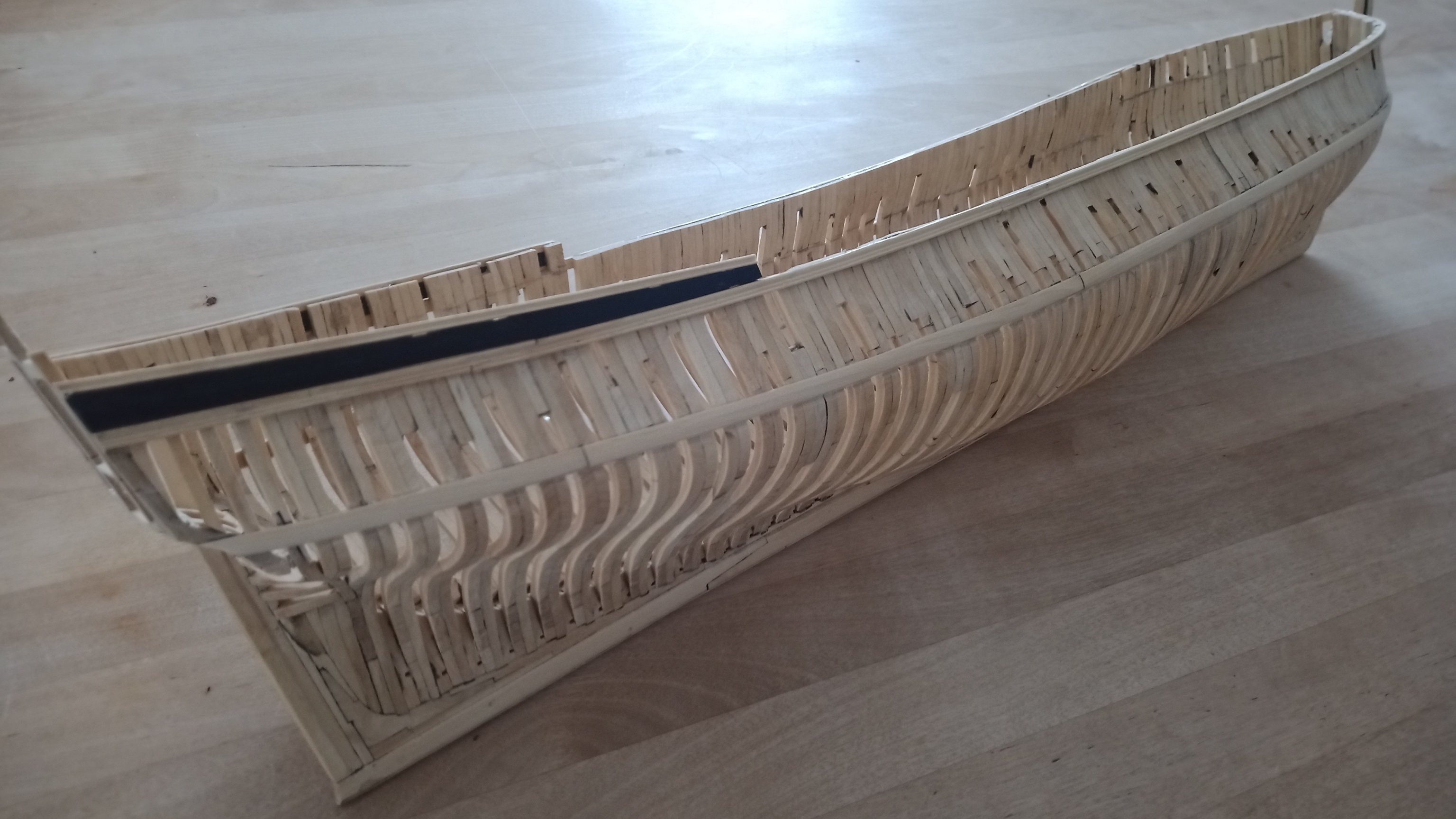

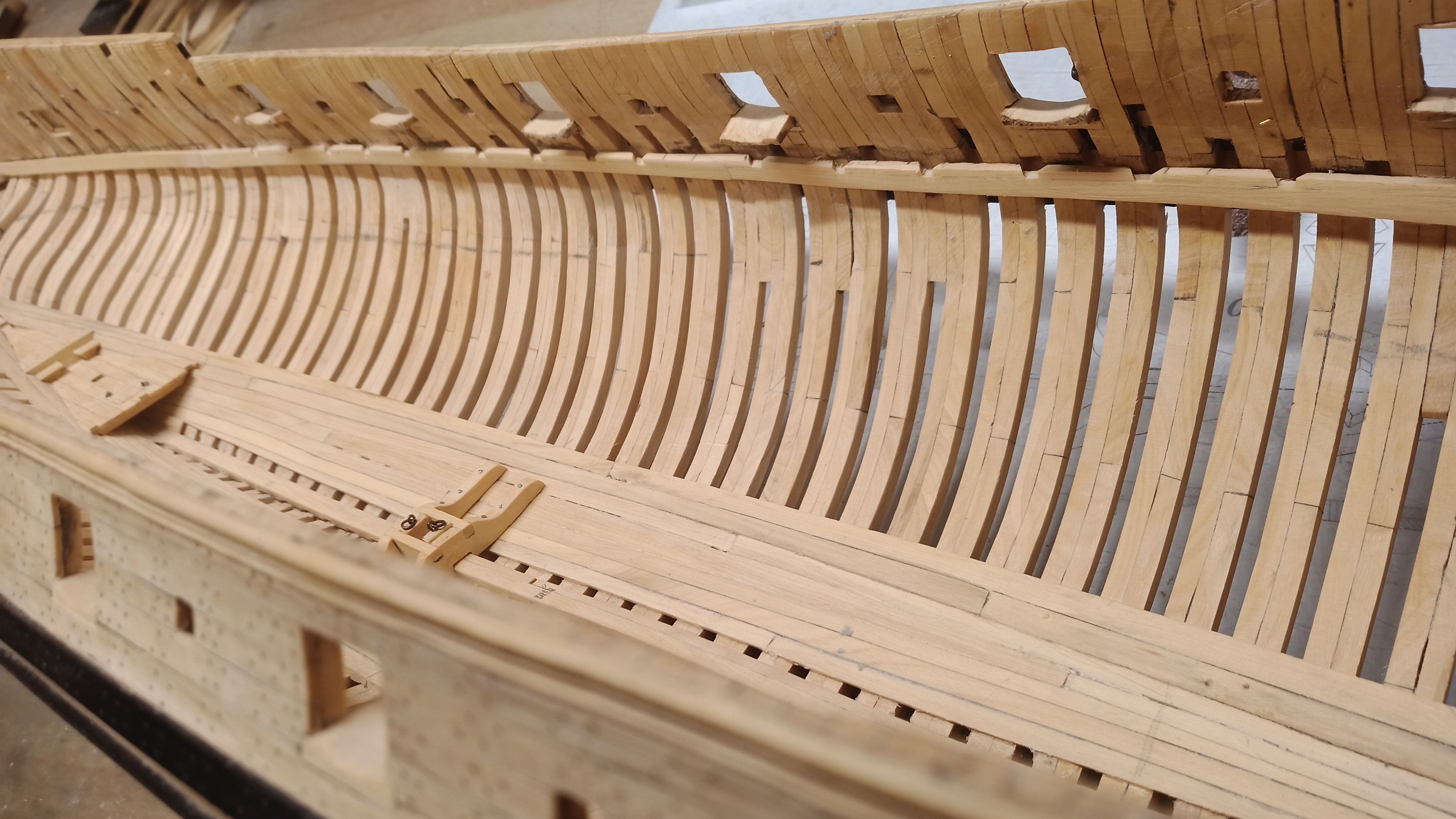

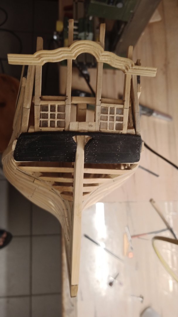

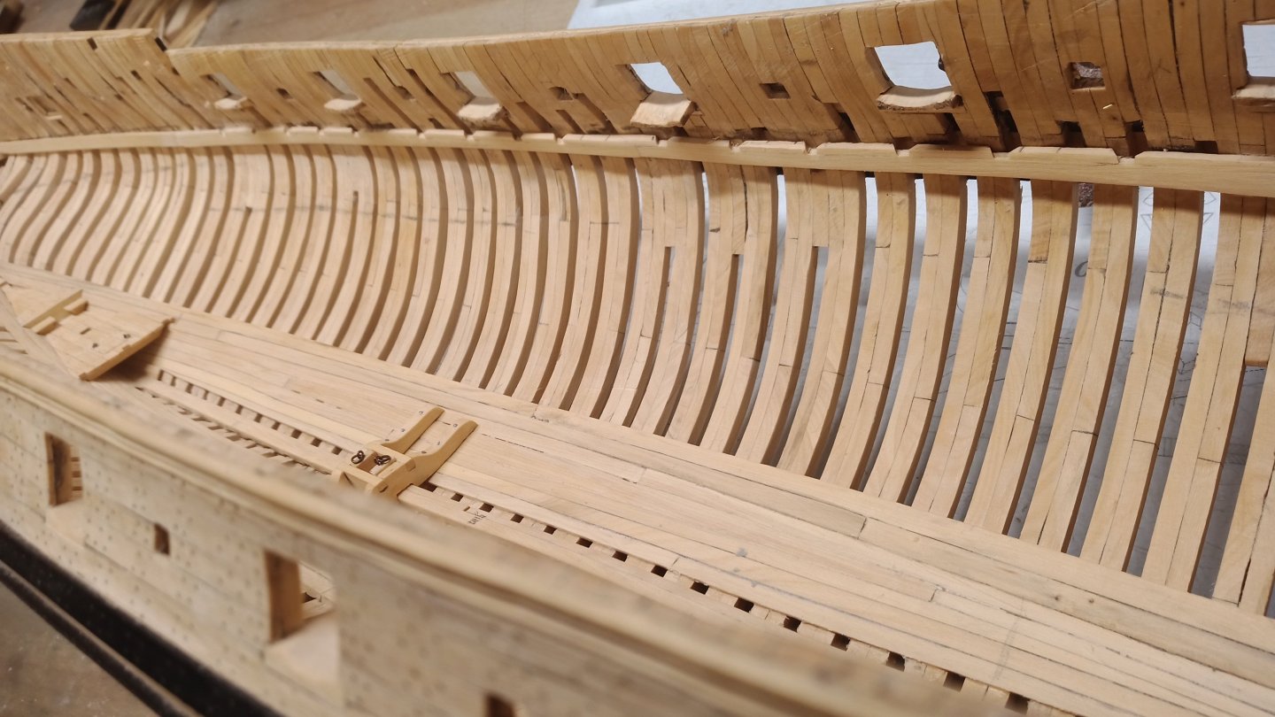

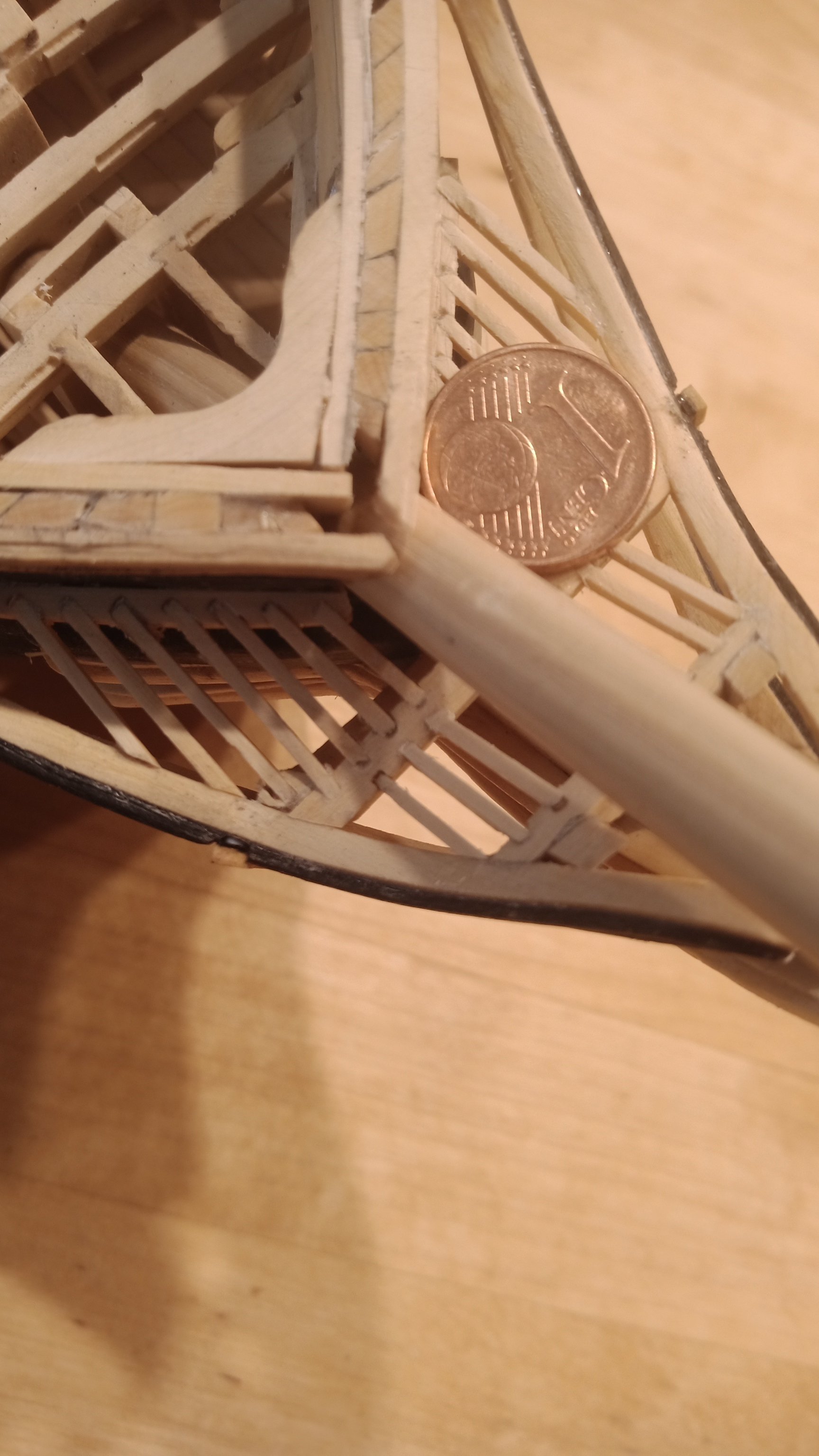

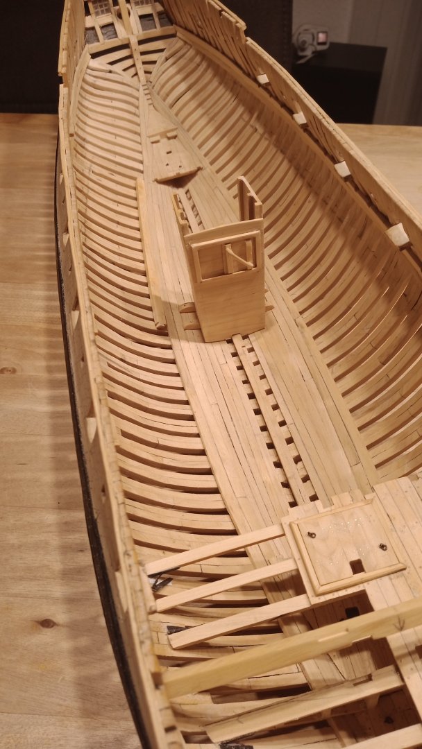

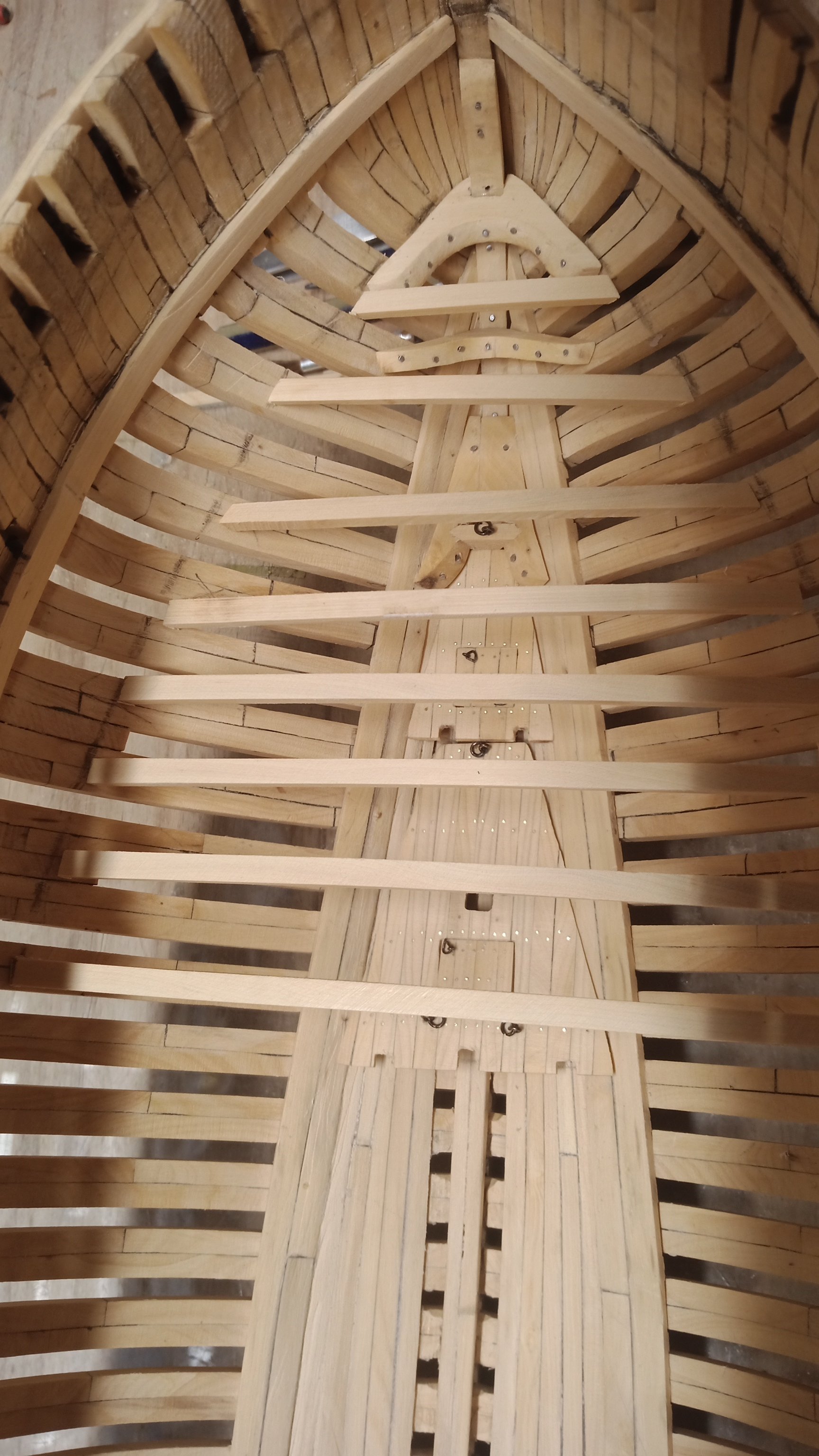

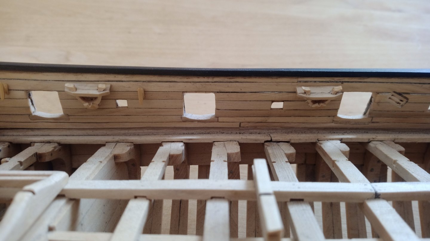

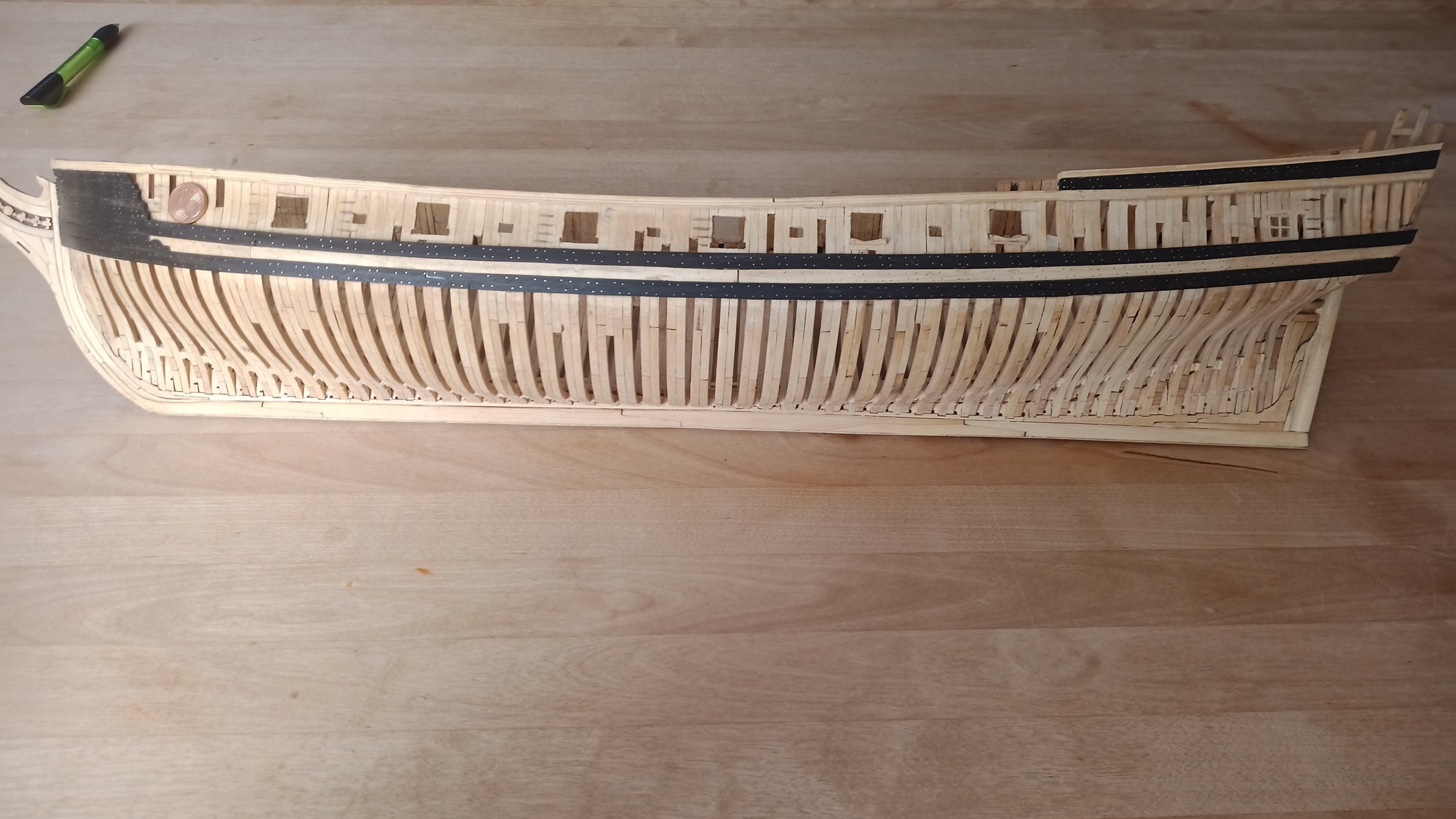

Hello everyone
All frames in place. The finishing touches are still missing.

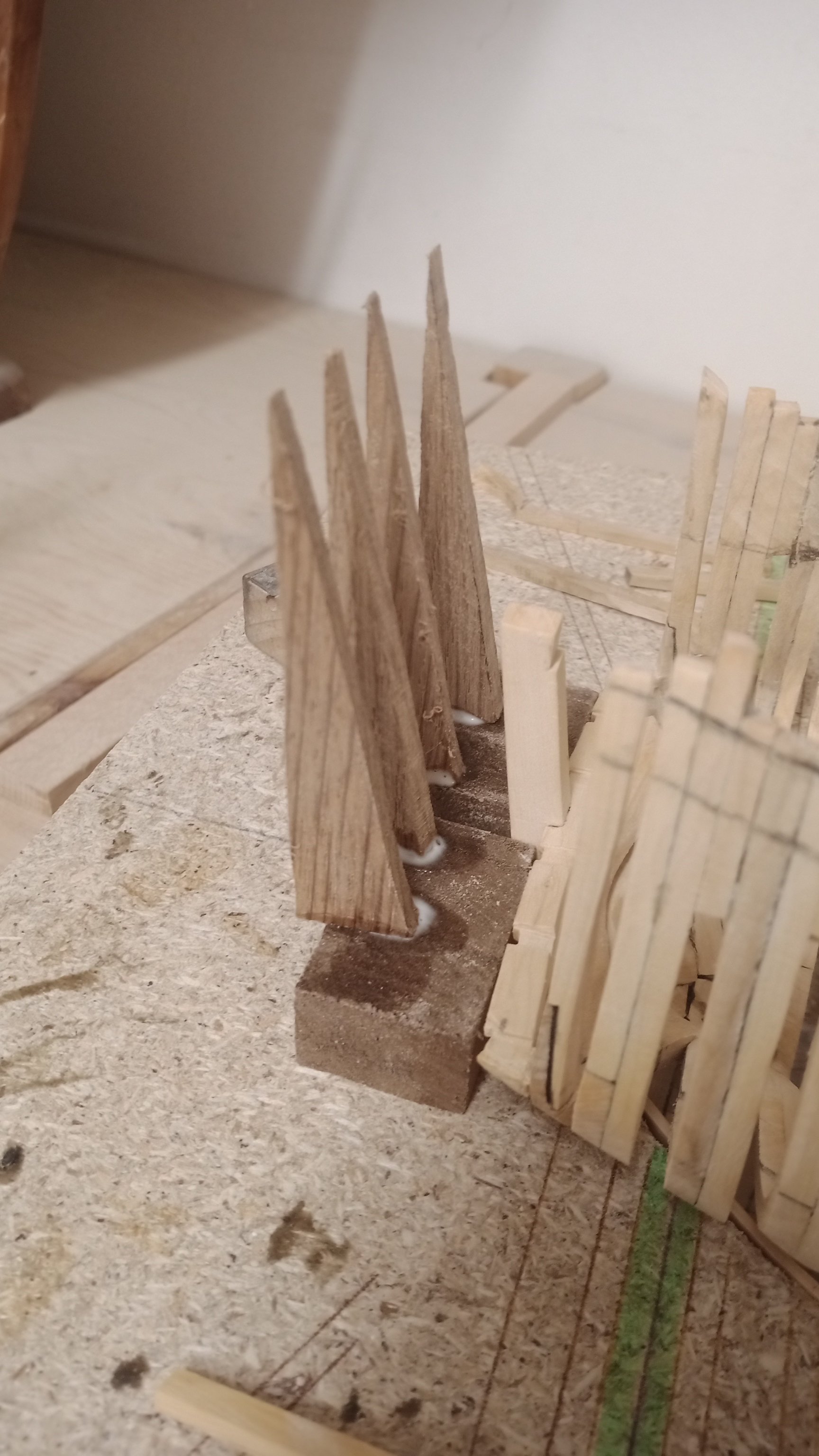

Jig for installing the stern timbers.
First plank (the one between the wales)
For greater strength, the plank was lashed vertically.
Installation of the waist rails (?)
planking goes on
to be continued...

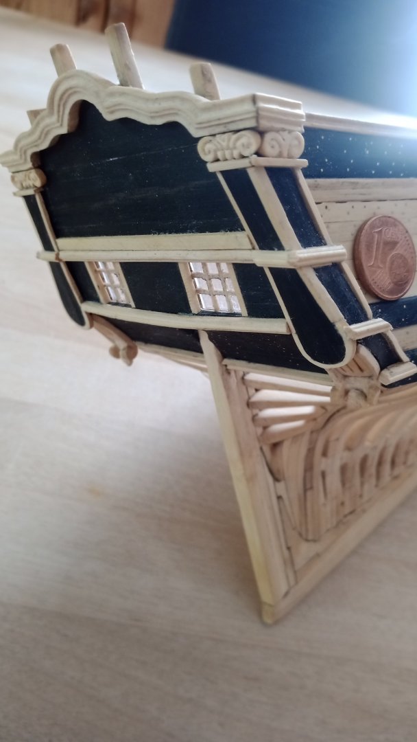

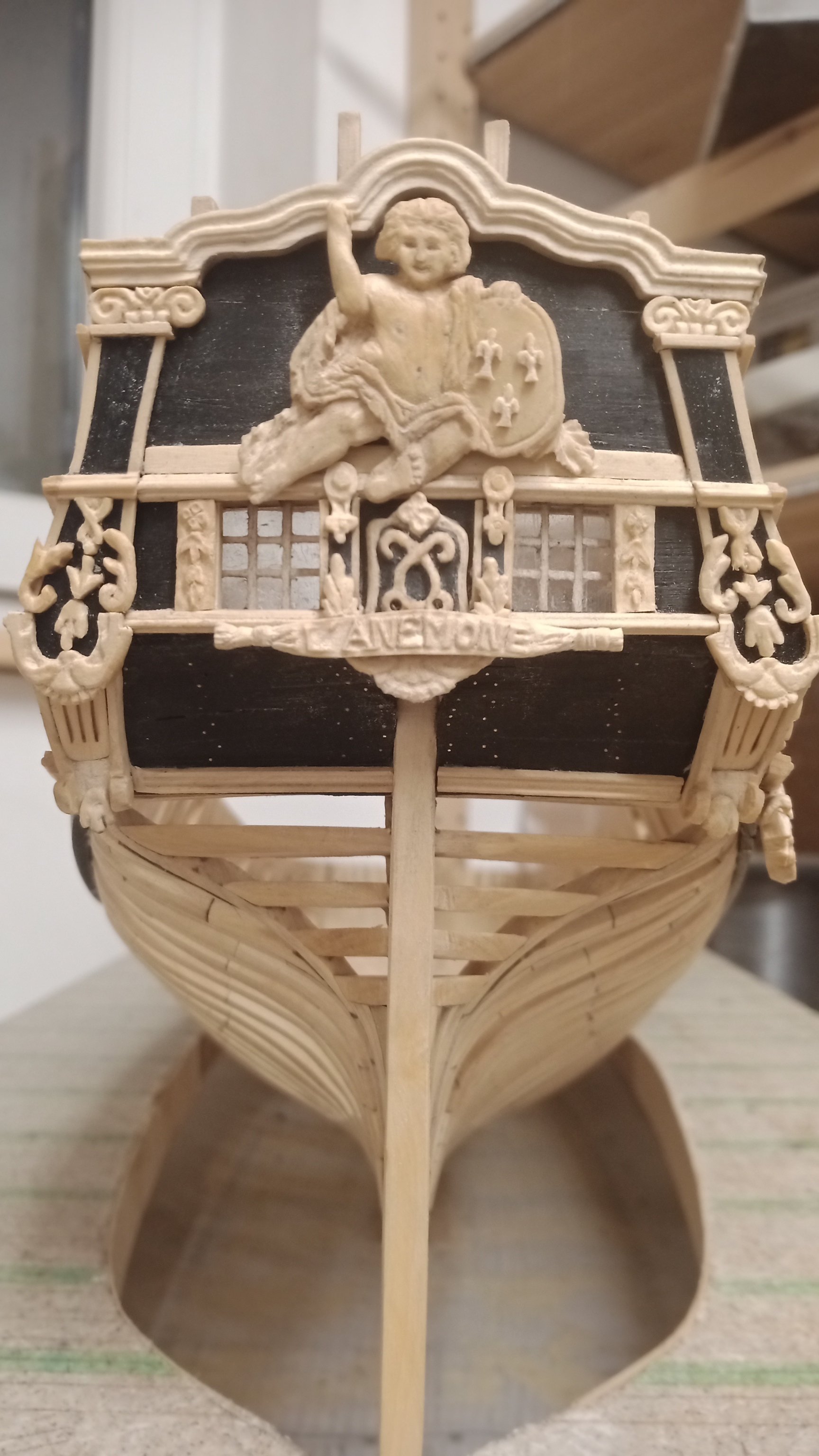

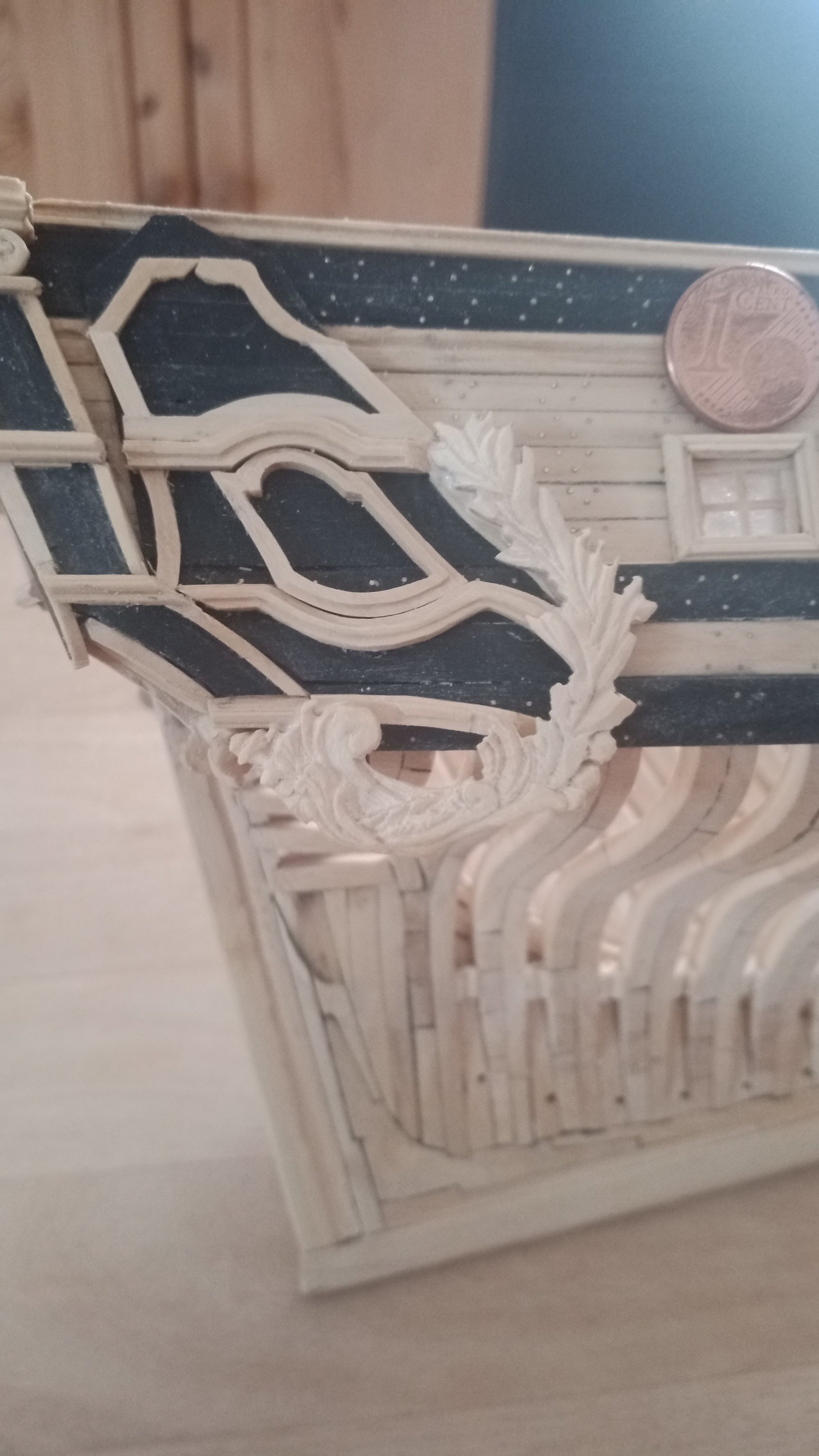

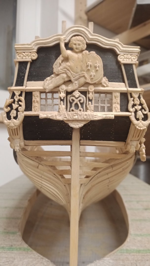

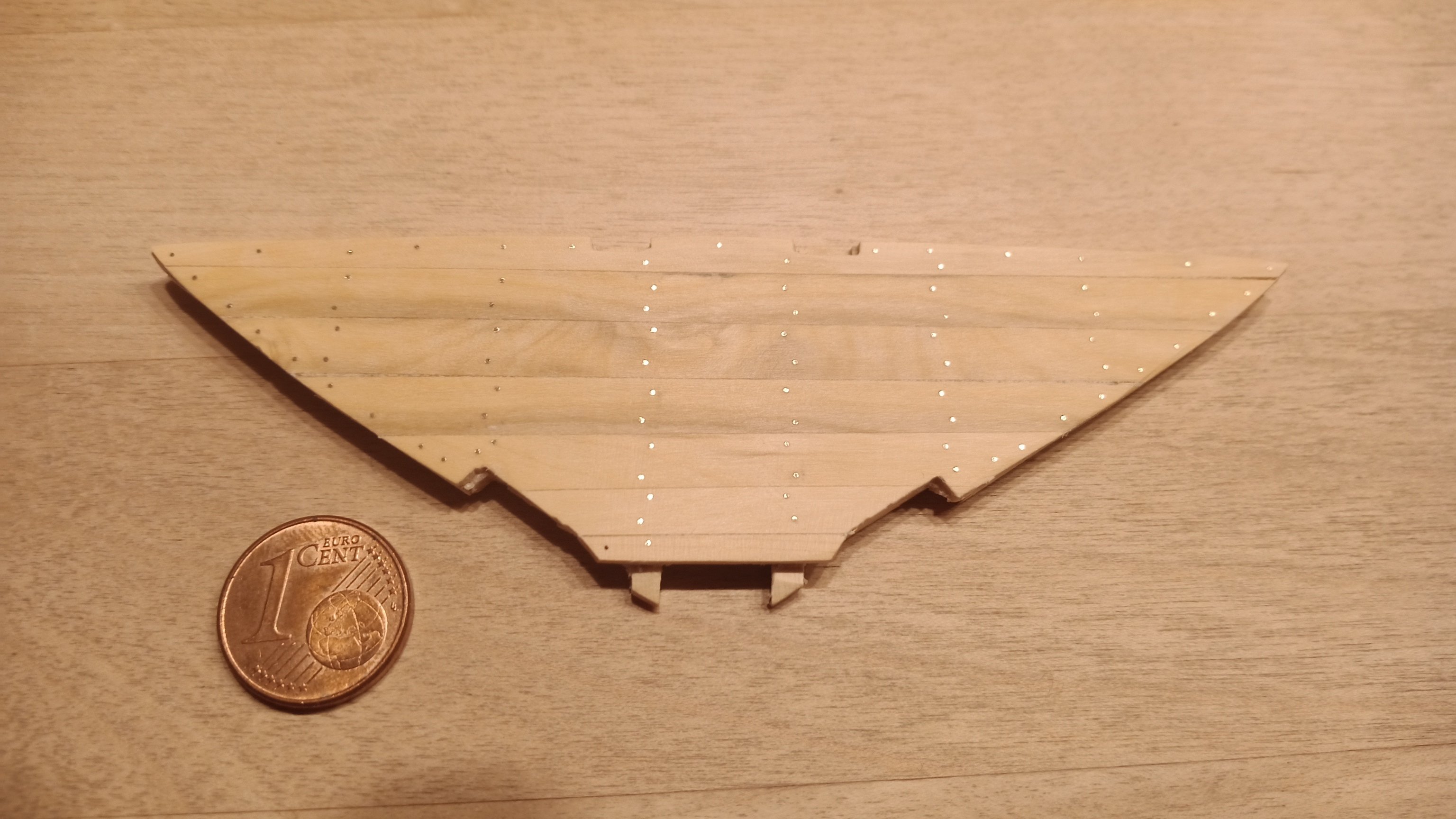

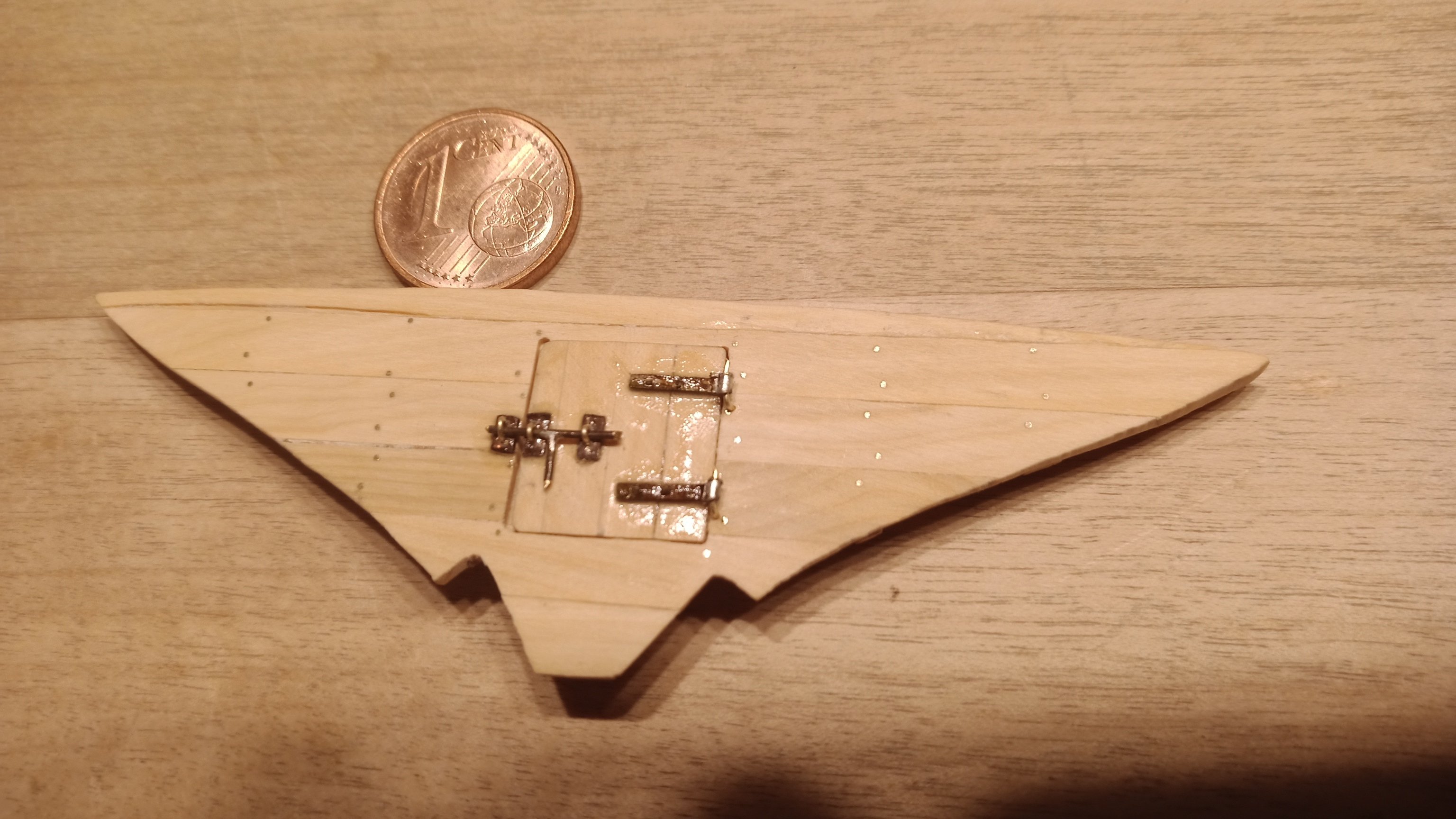

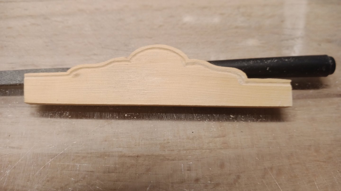

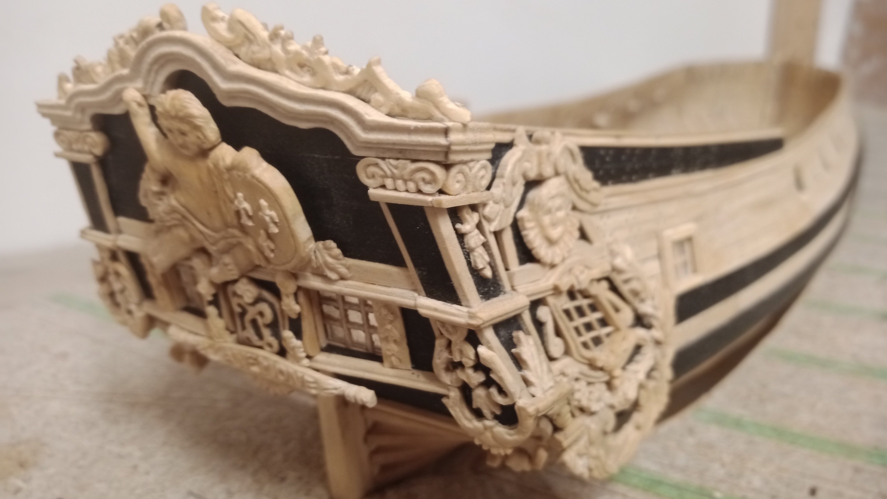

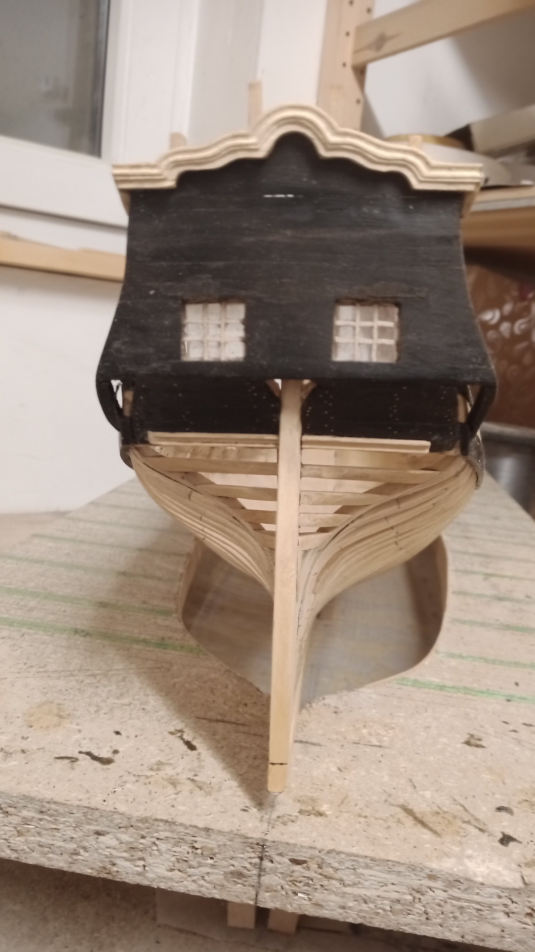

Hello everyone

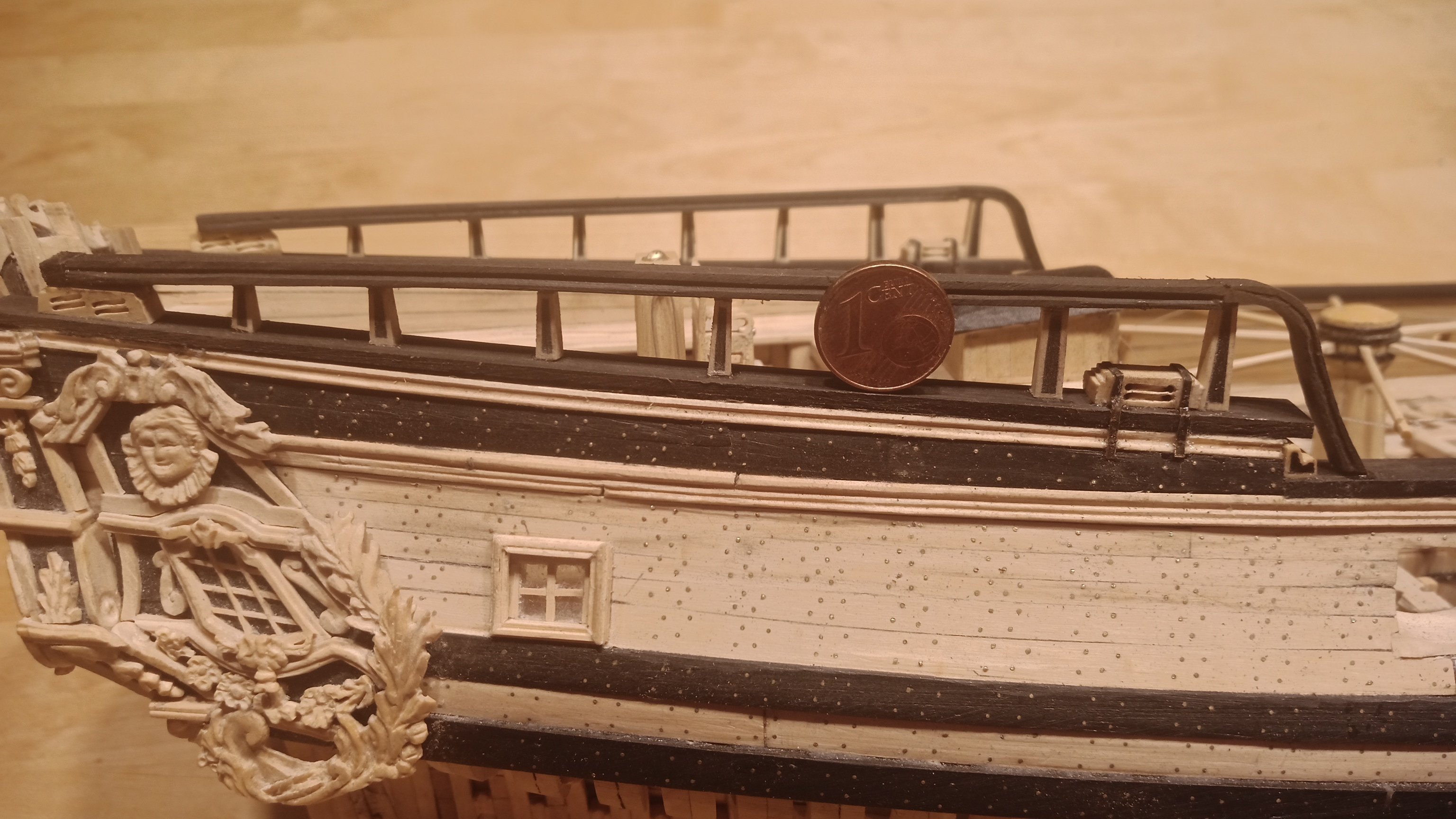

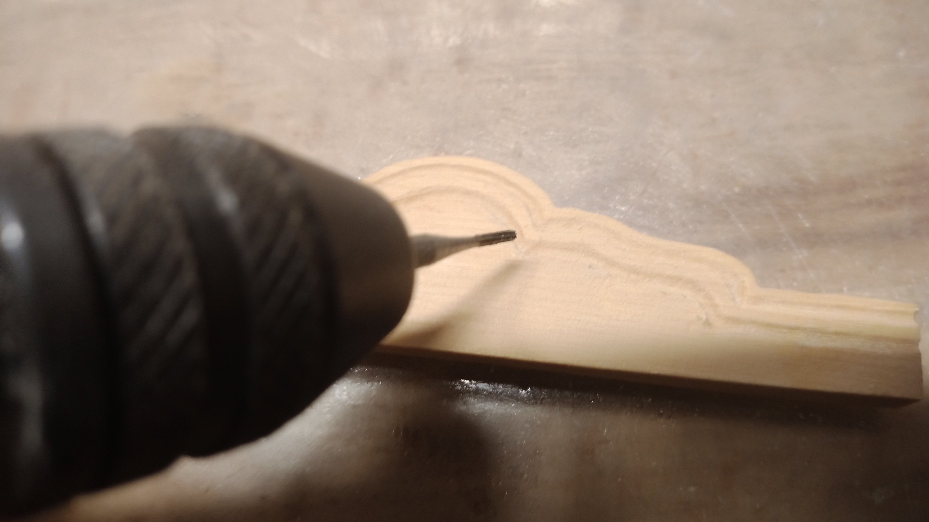

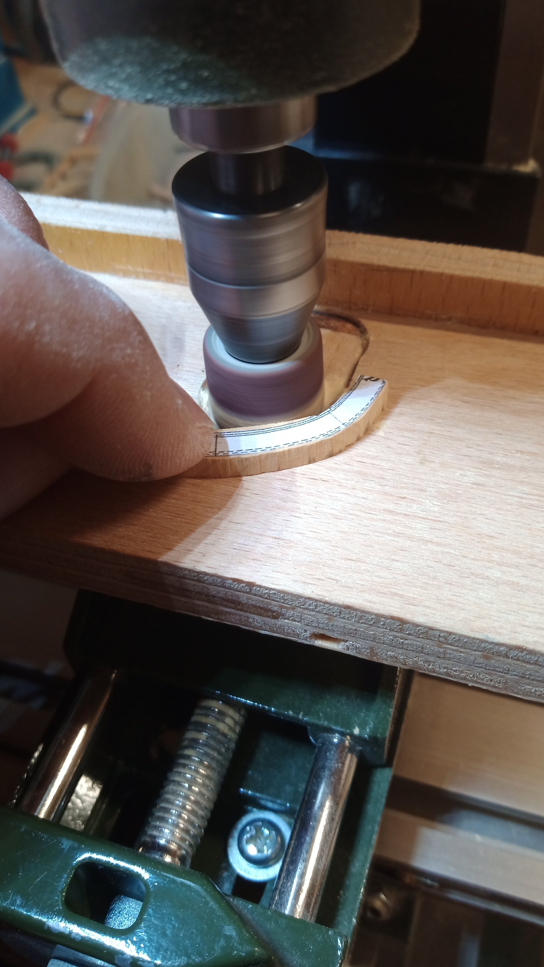

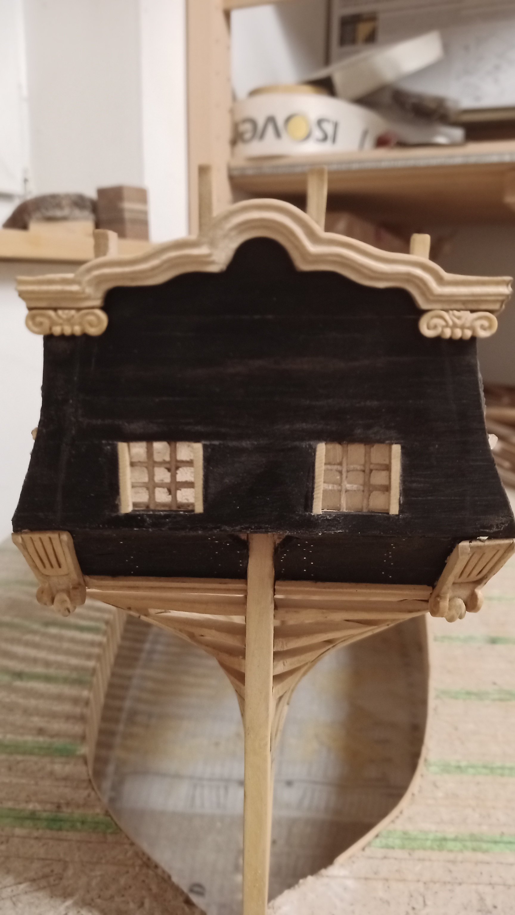

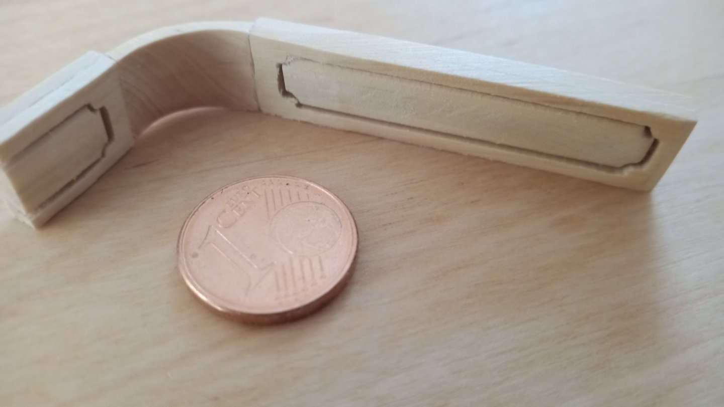

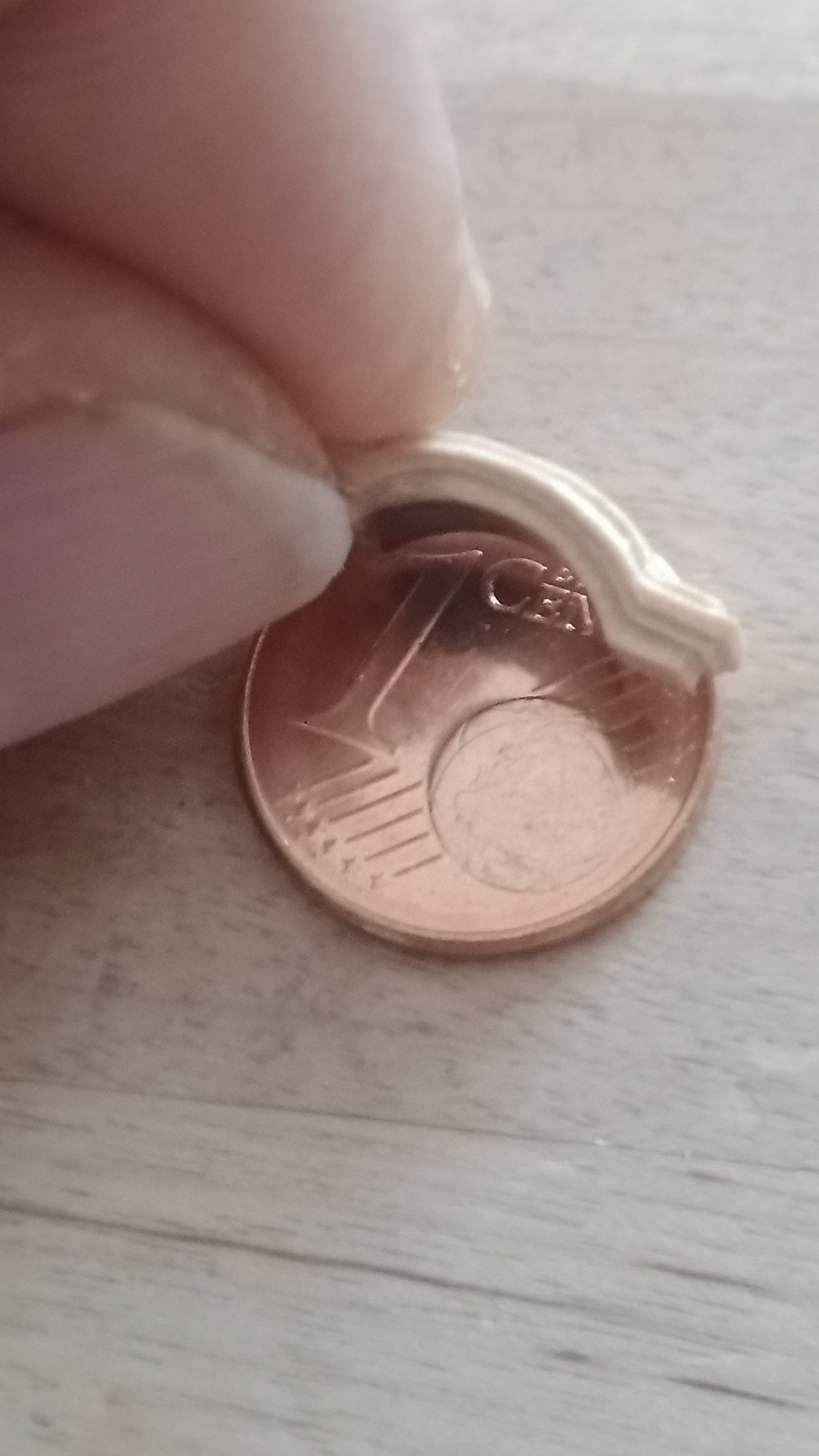

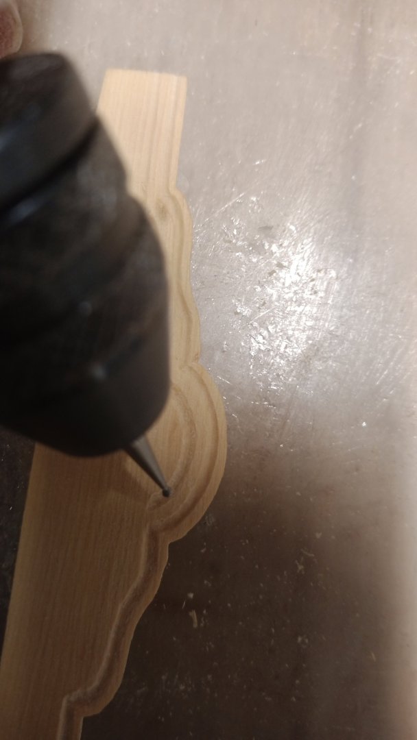

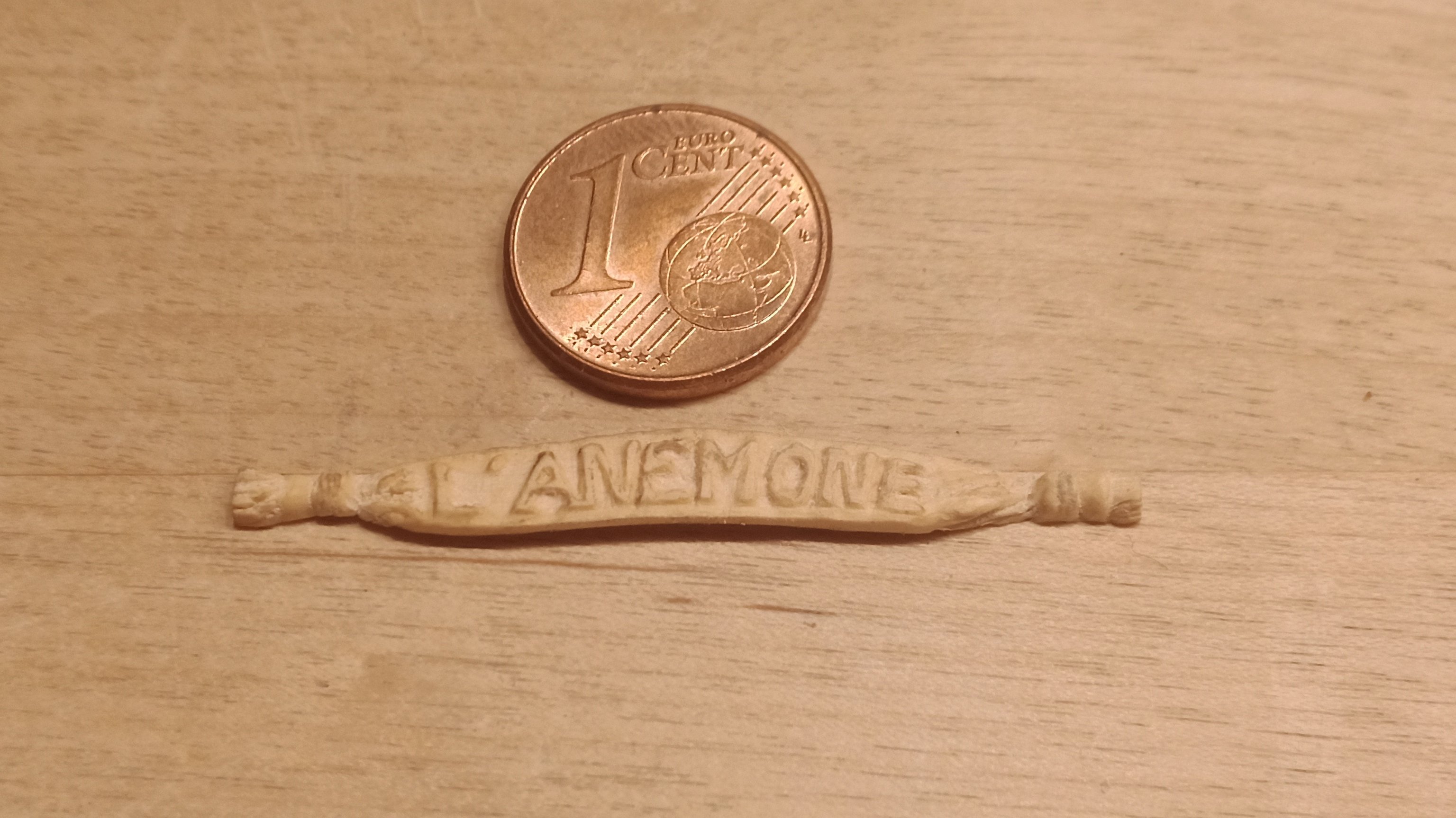

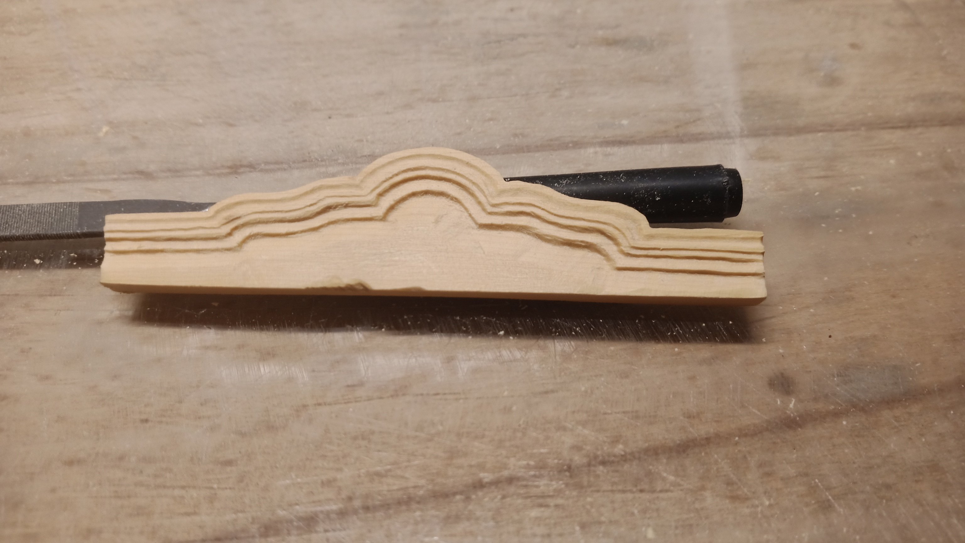

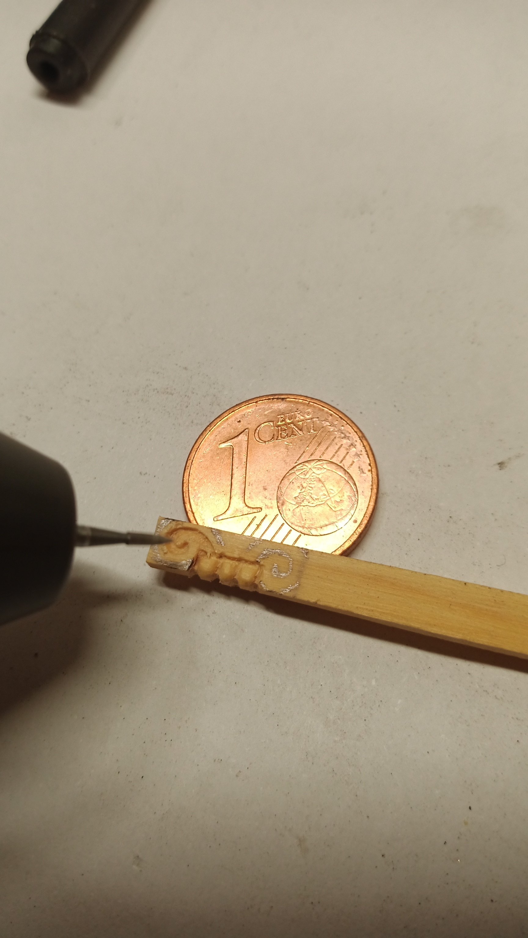

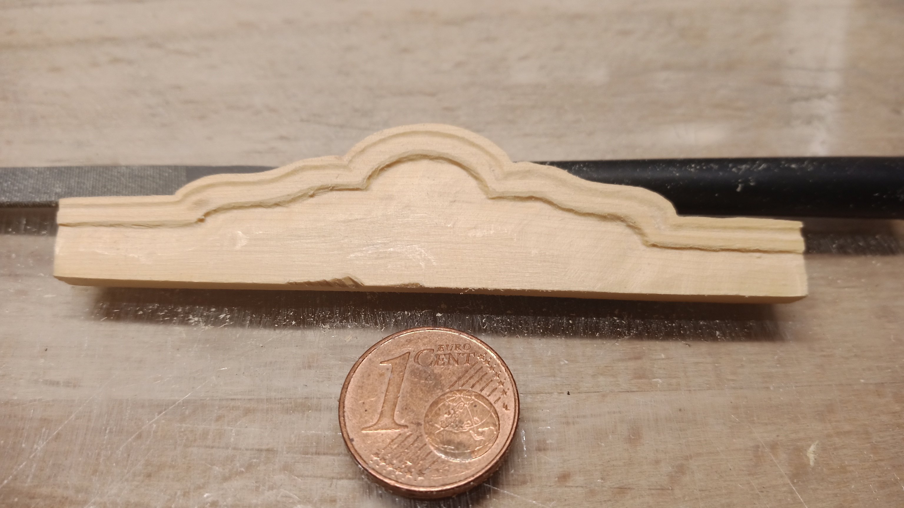

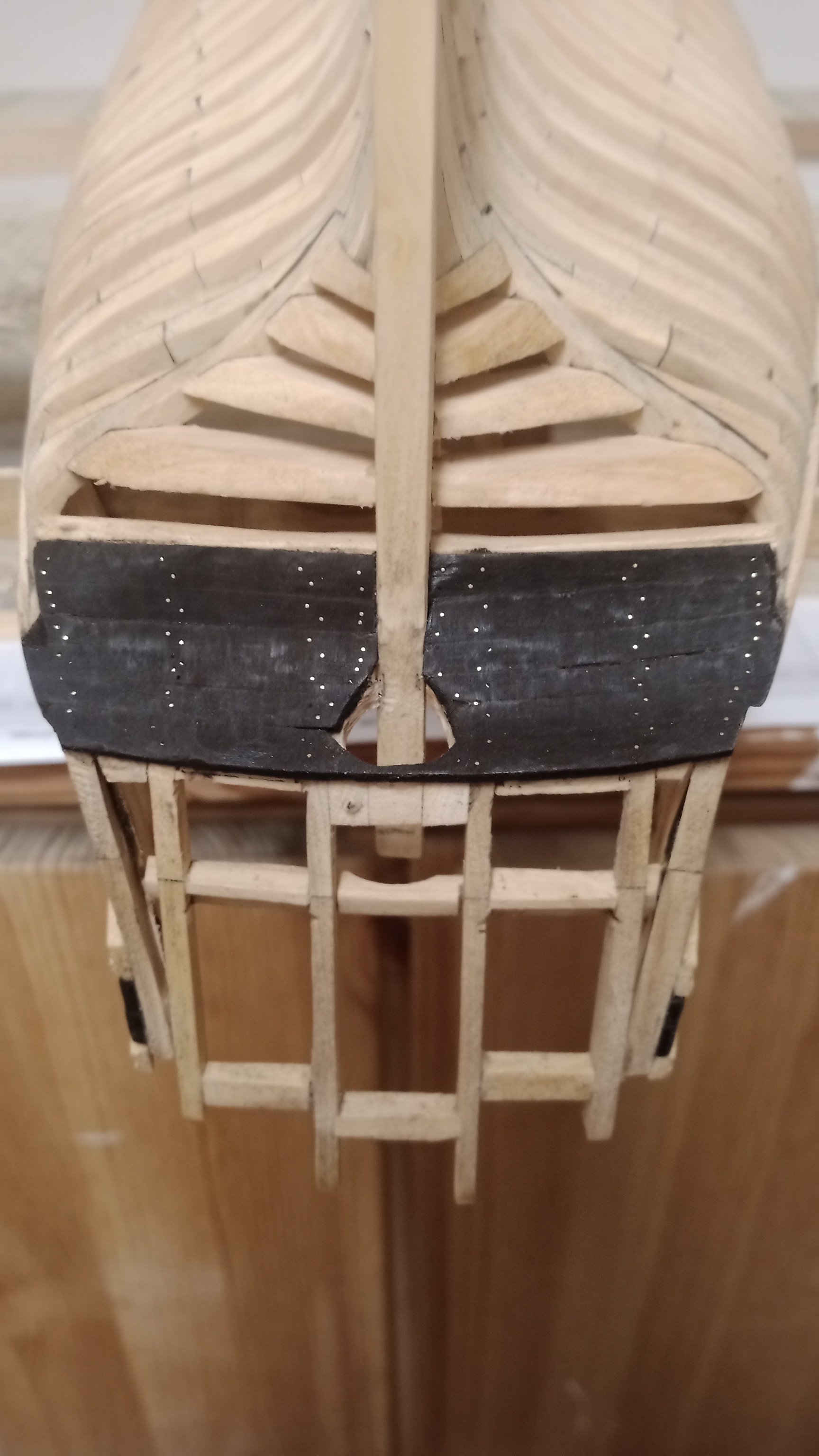

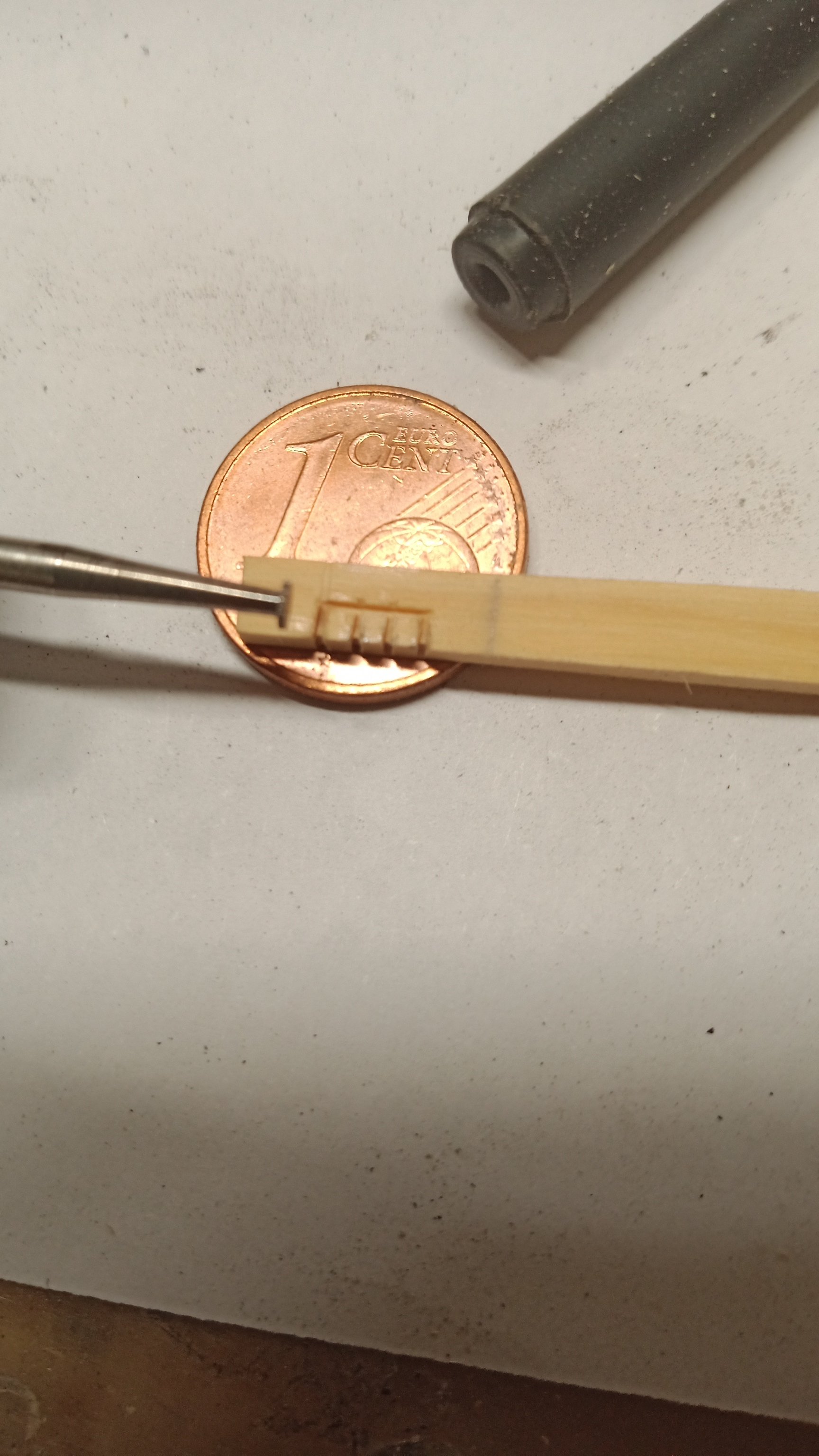

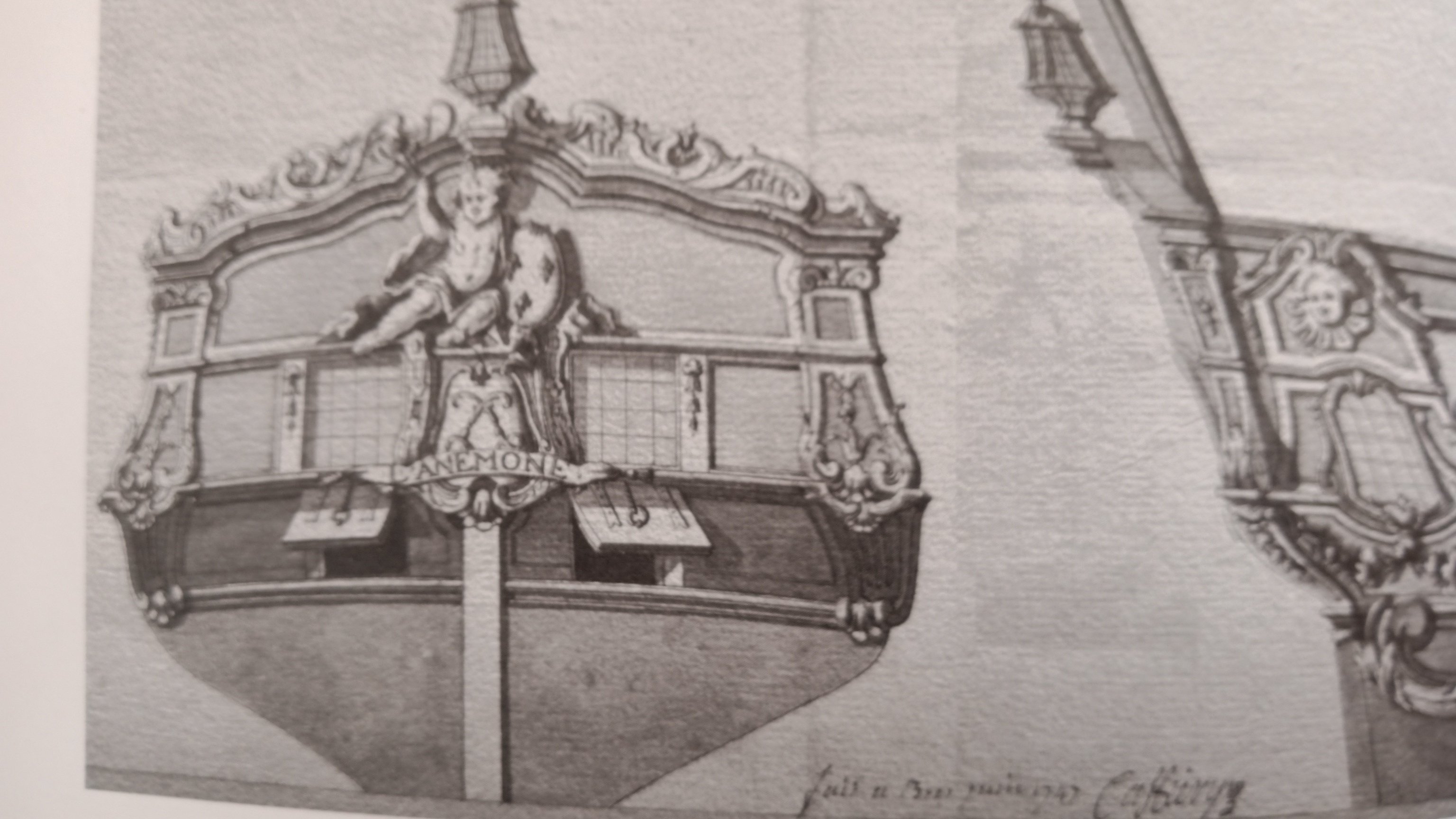

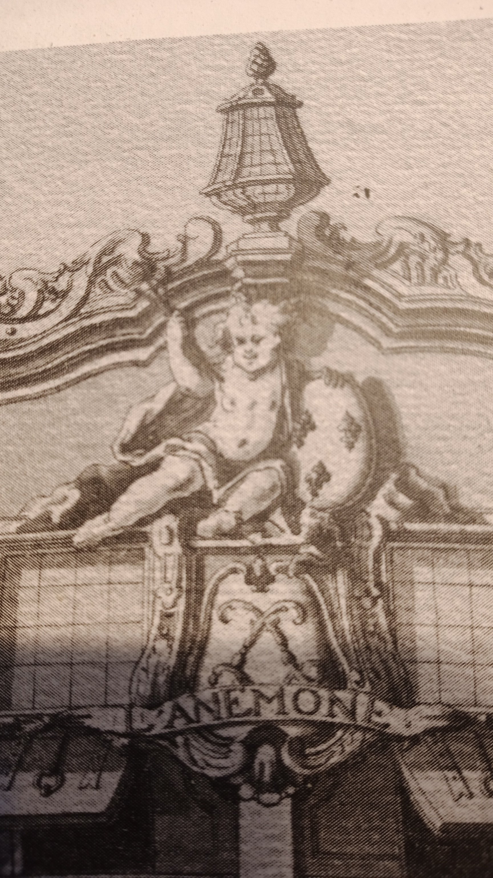

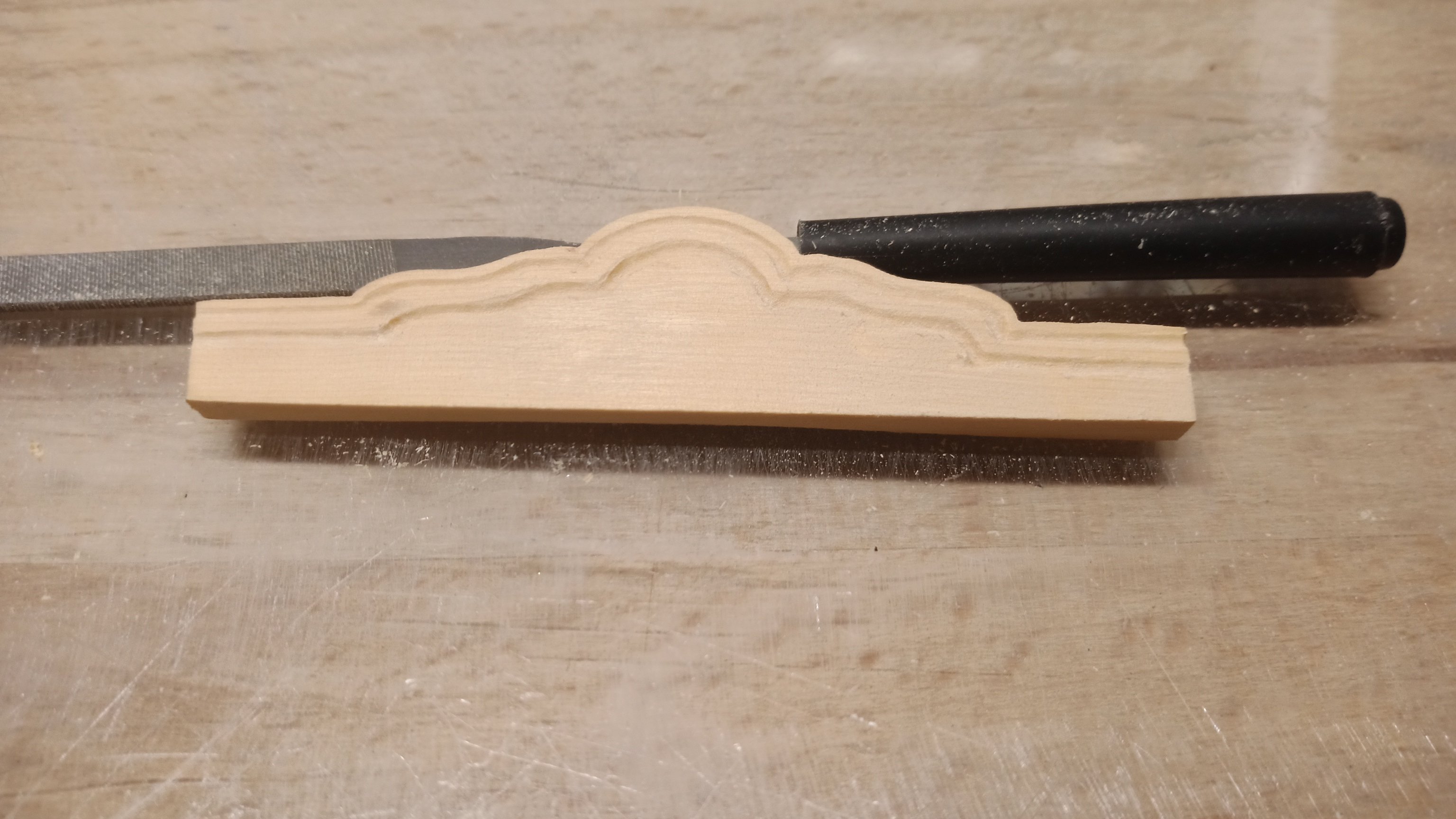

A special and unique feature of the l'Anémone is the upper end strip of the transom.
To stabilize the stern structure, it had to be manufactured and installed now.
Due to its curved shape, I couldn't use a scraper. Therefore, the strip was hand-cut using a small milling tool.
to be continued...

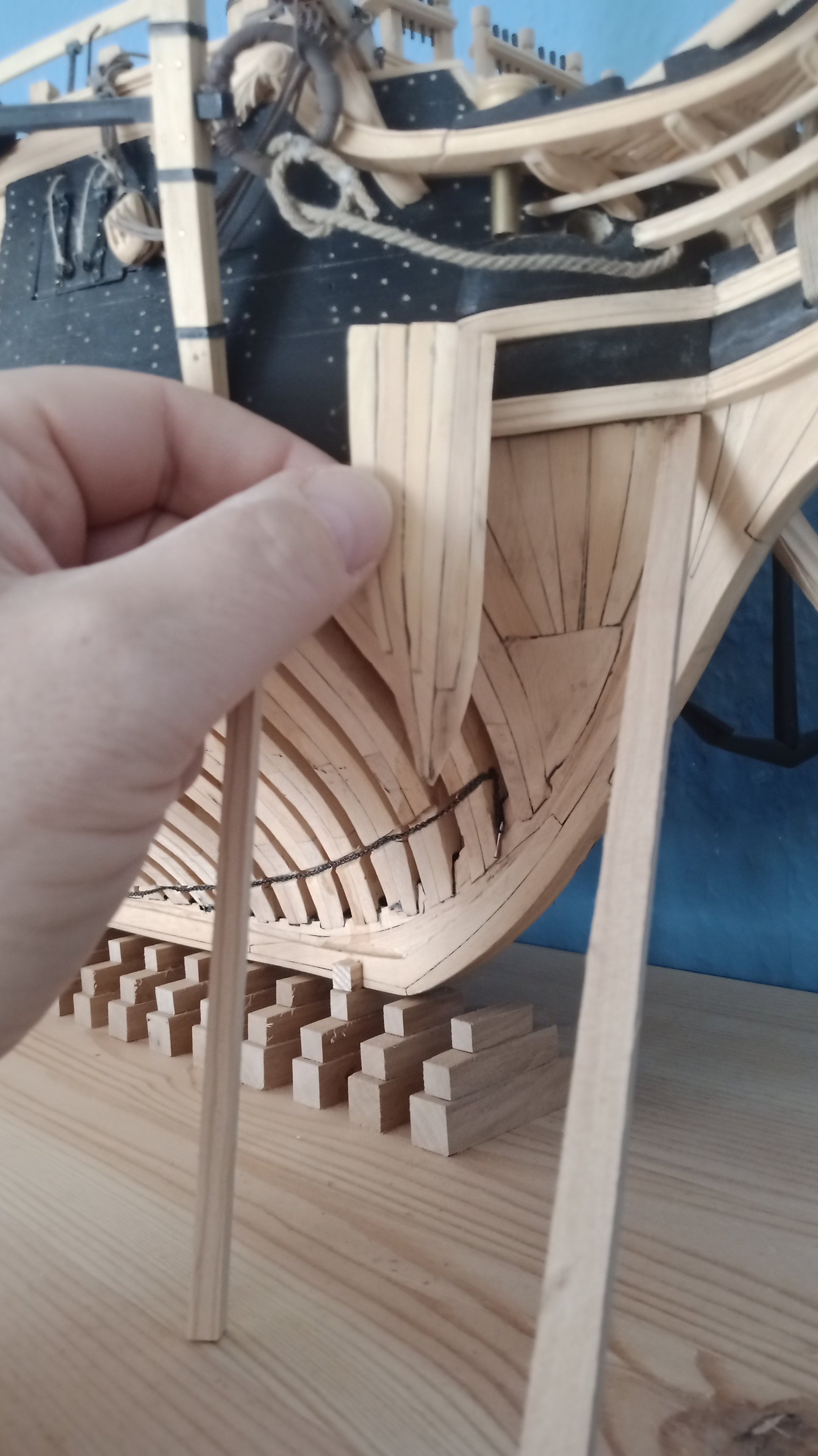

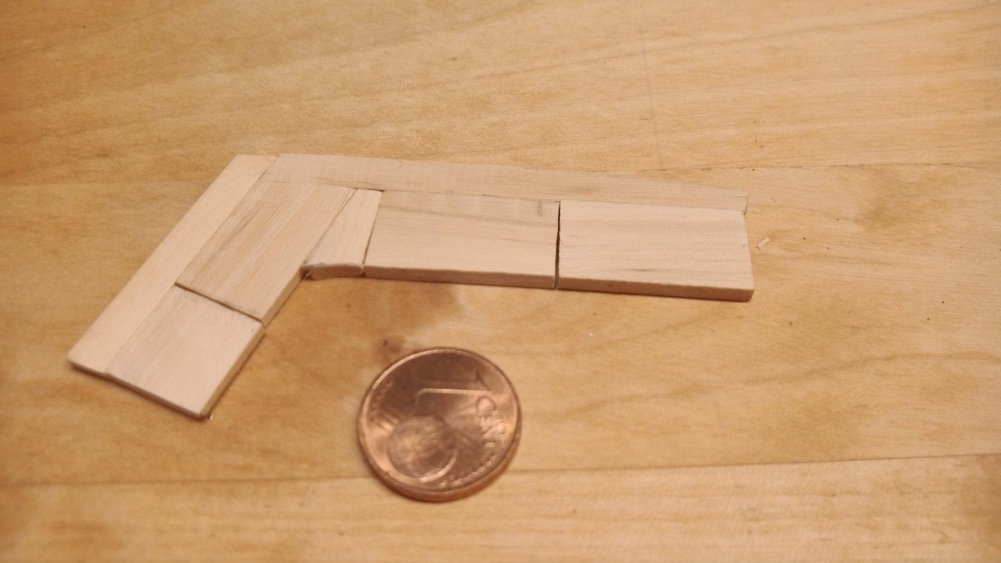

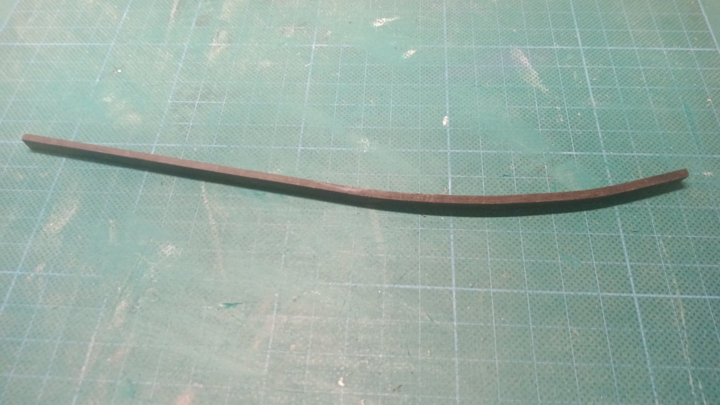

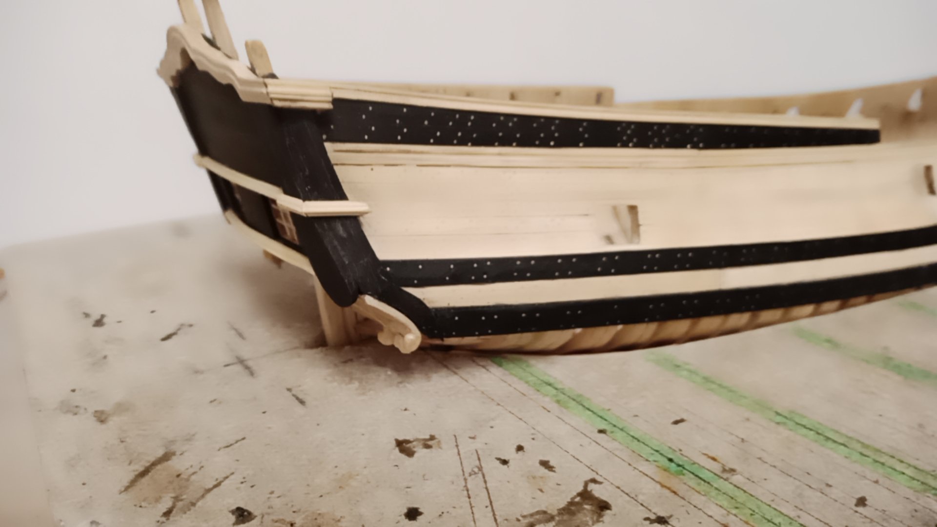

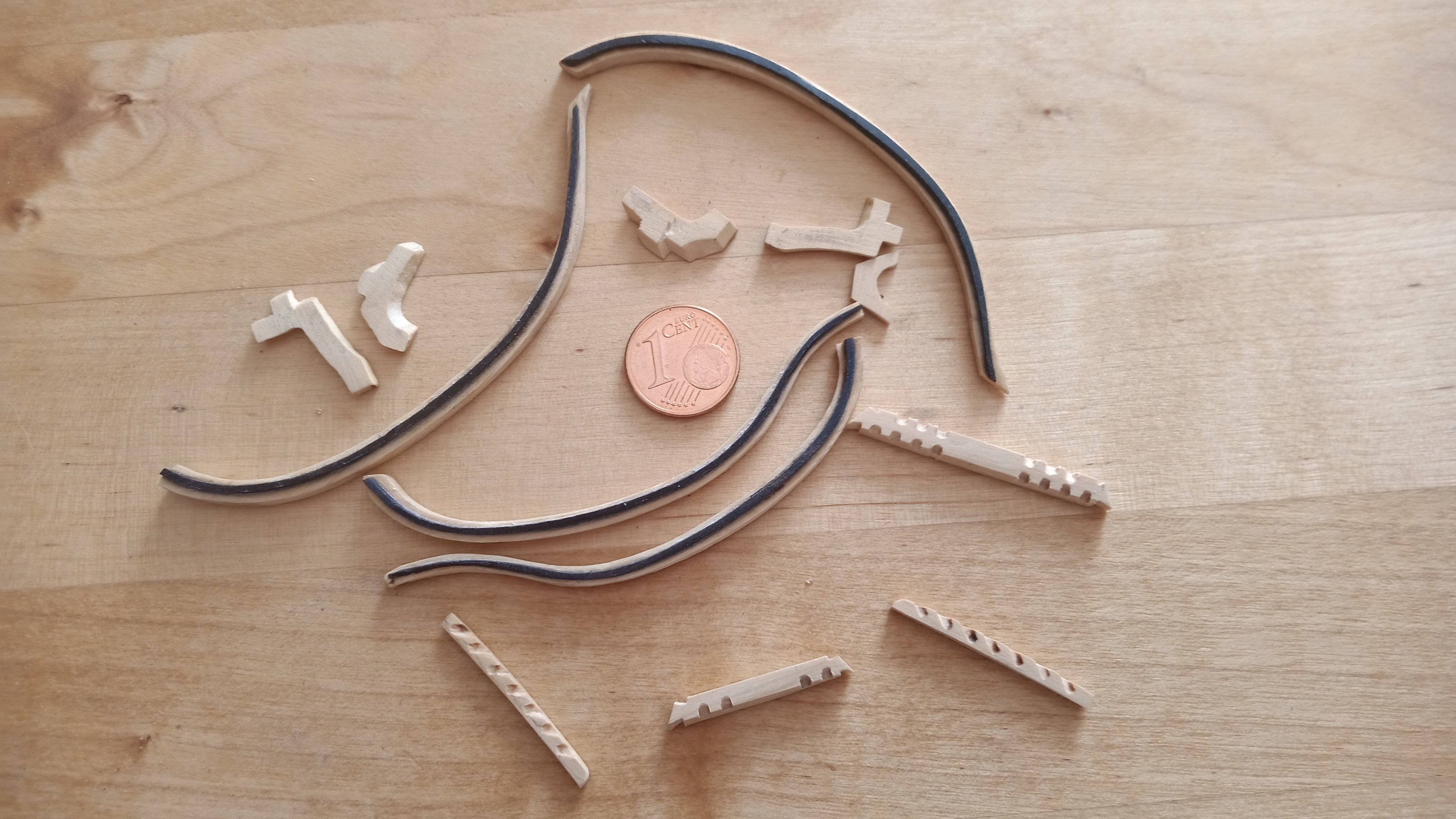

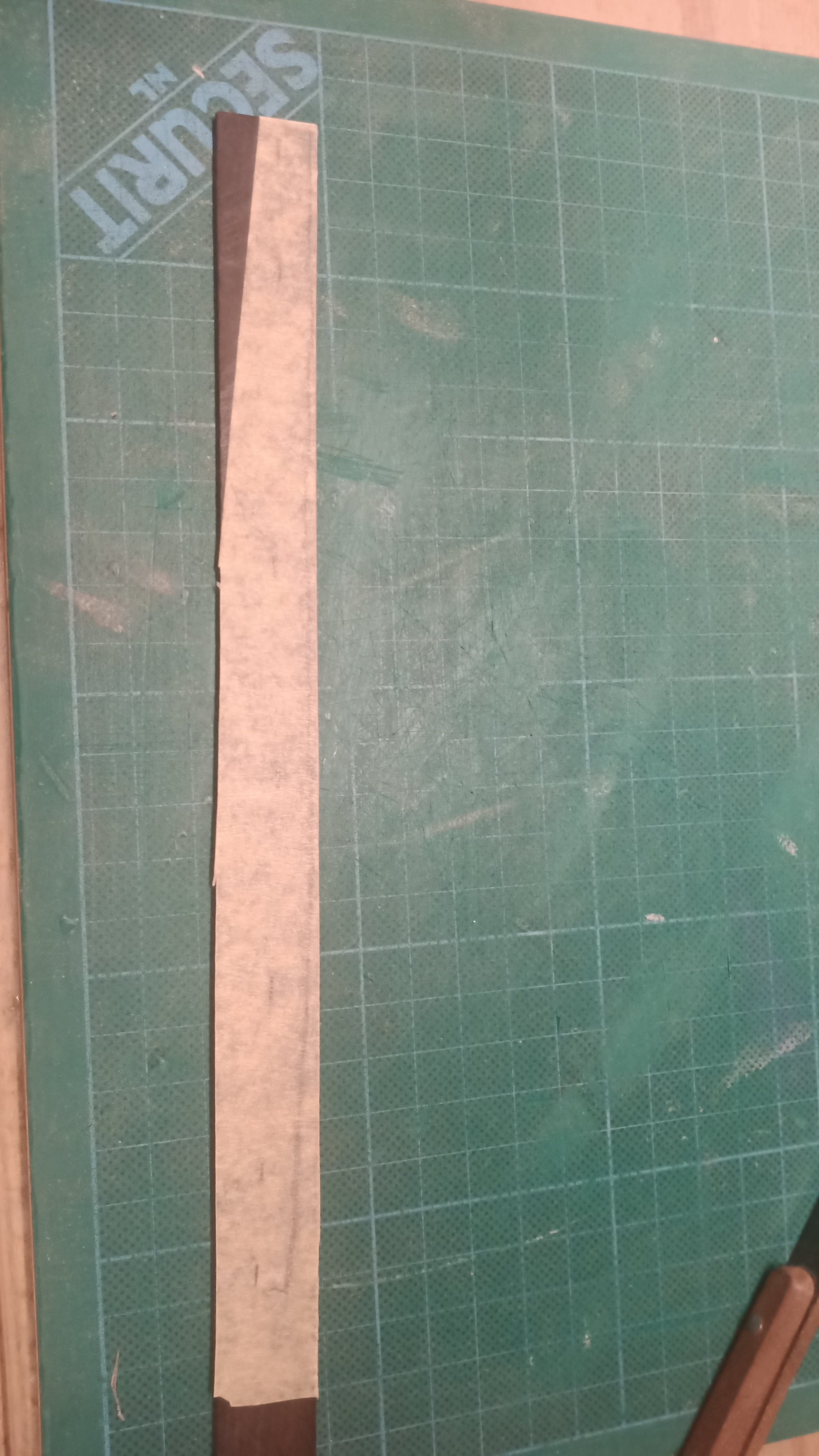

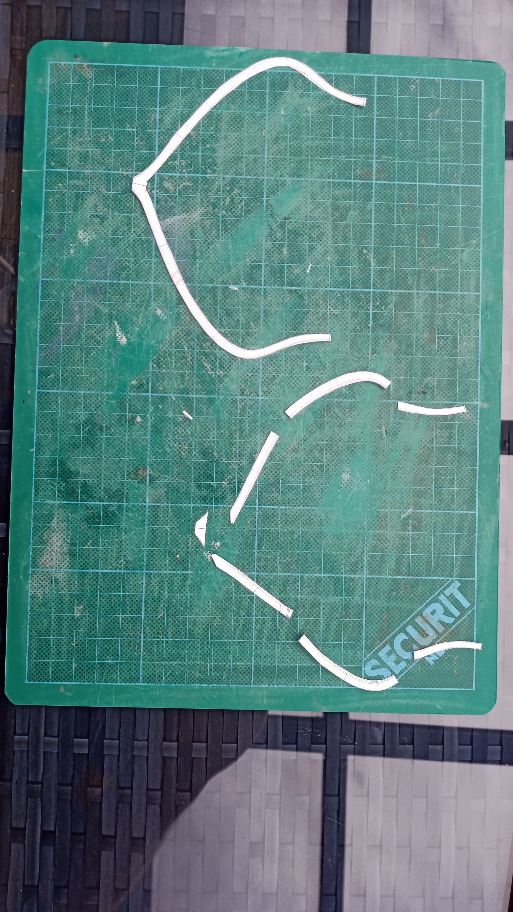

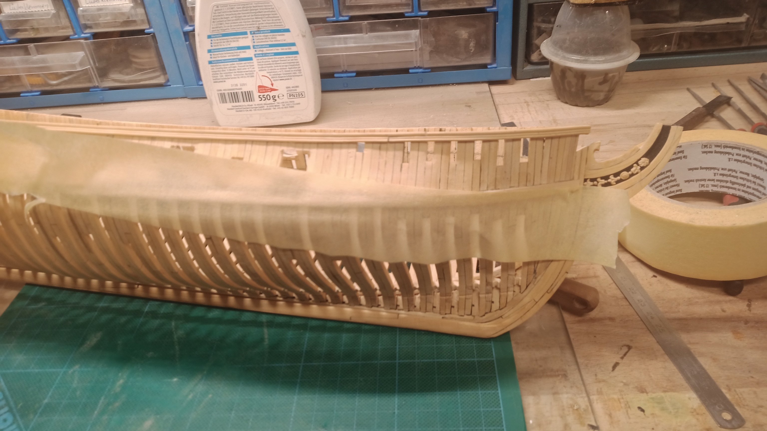

Hello everyone

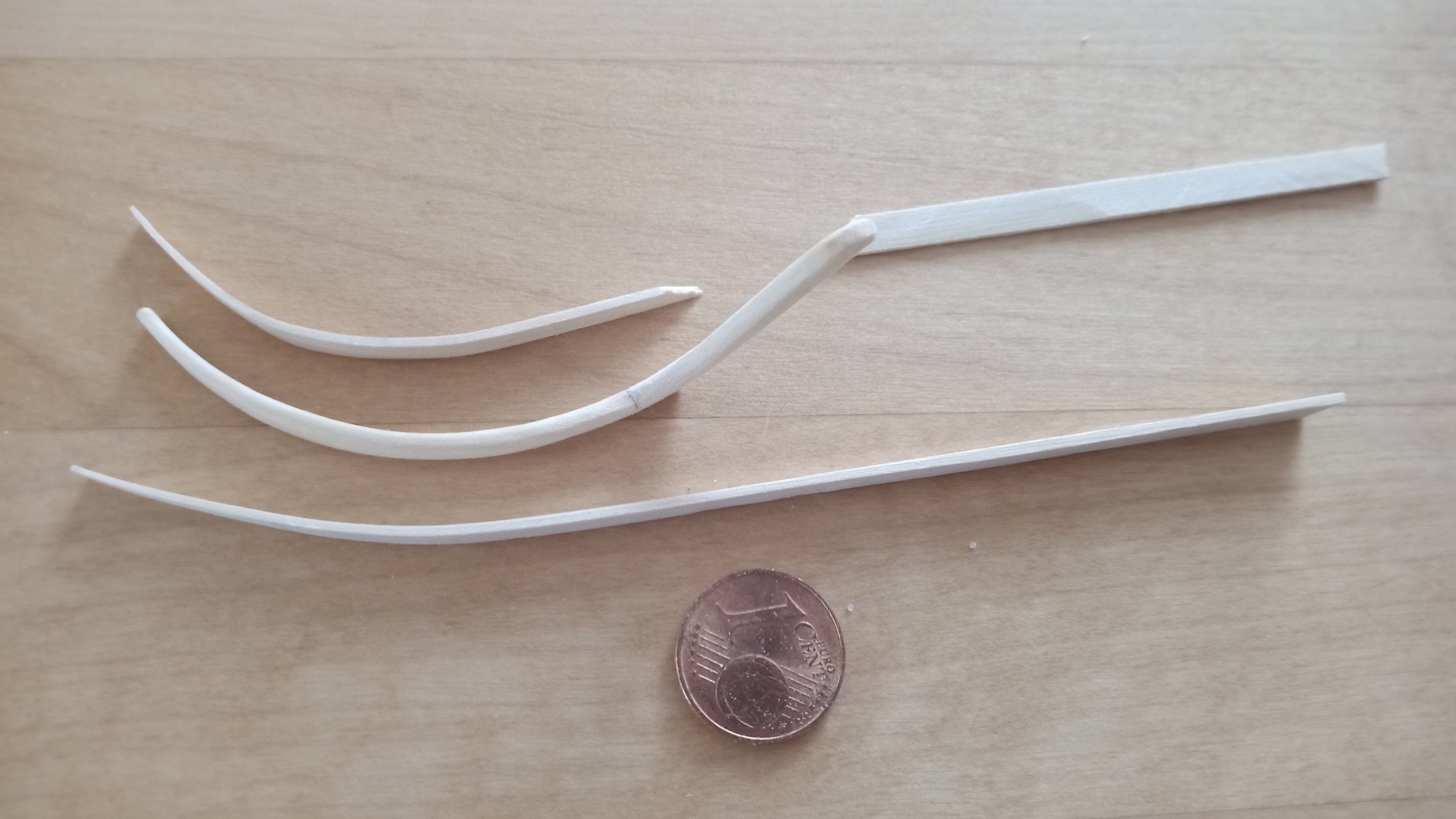

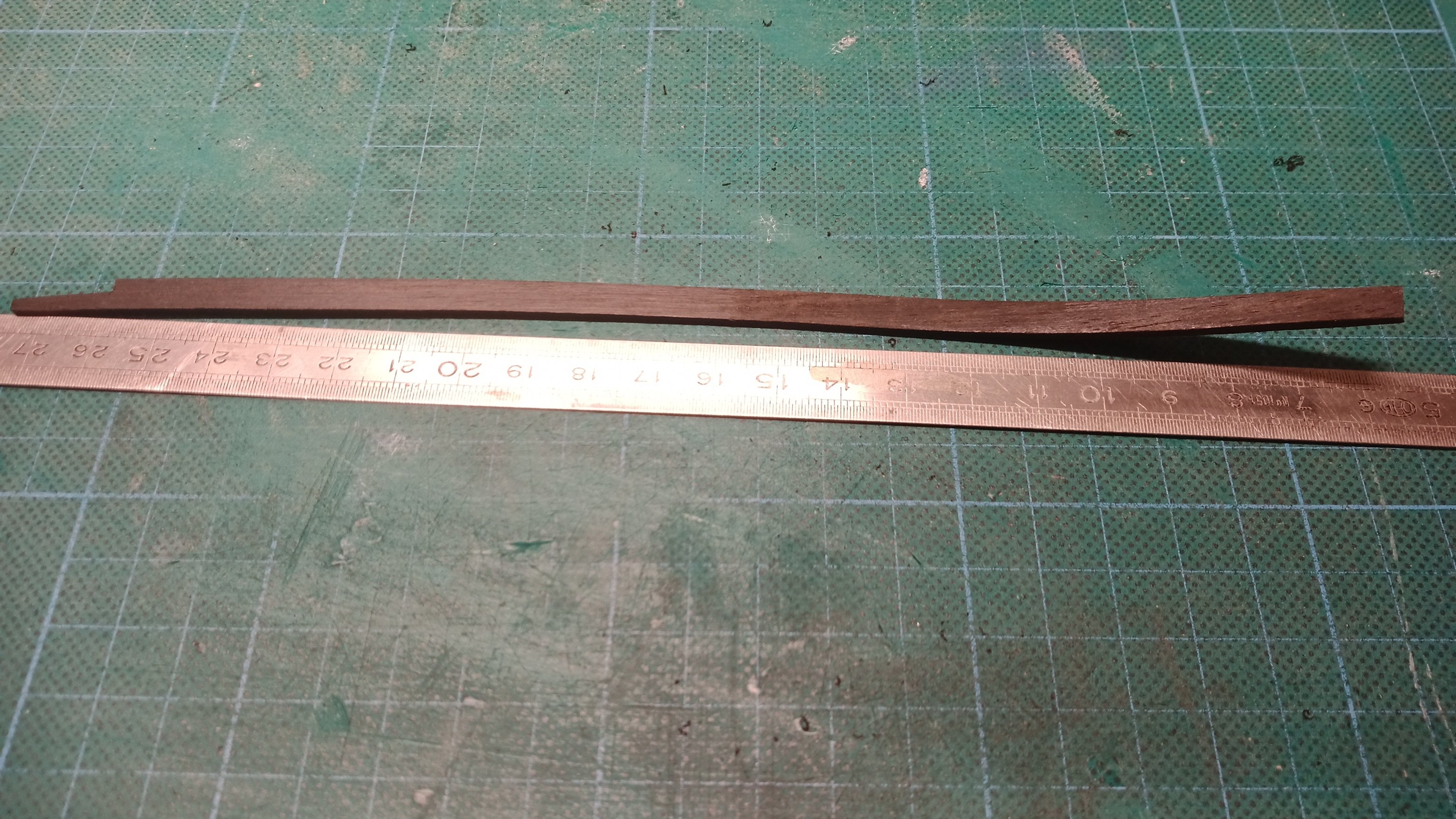

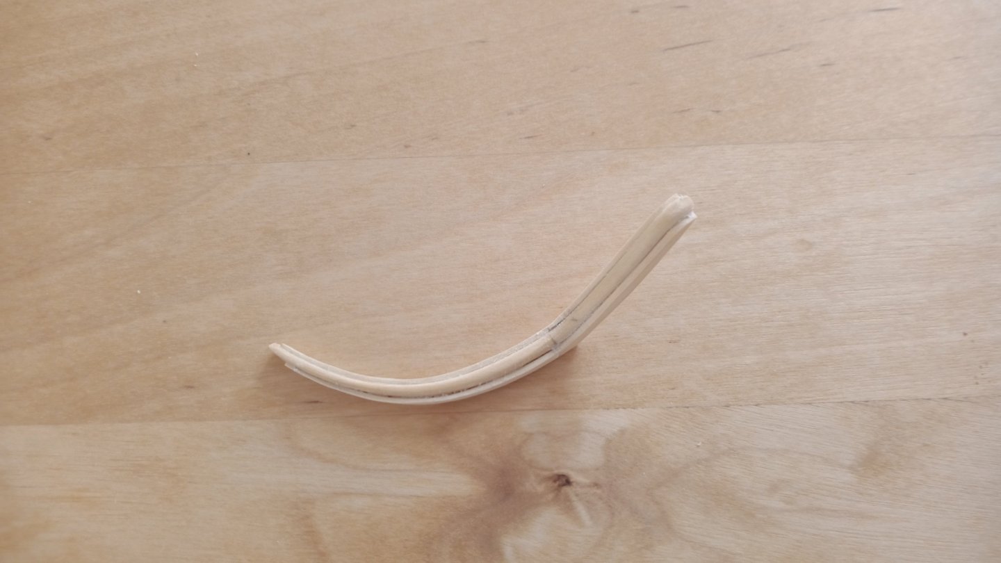

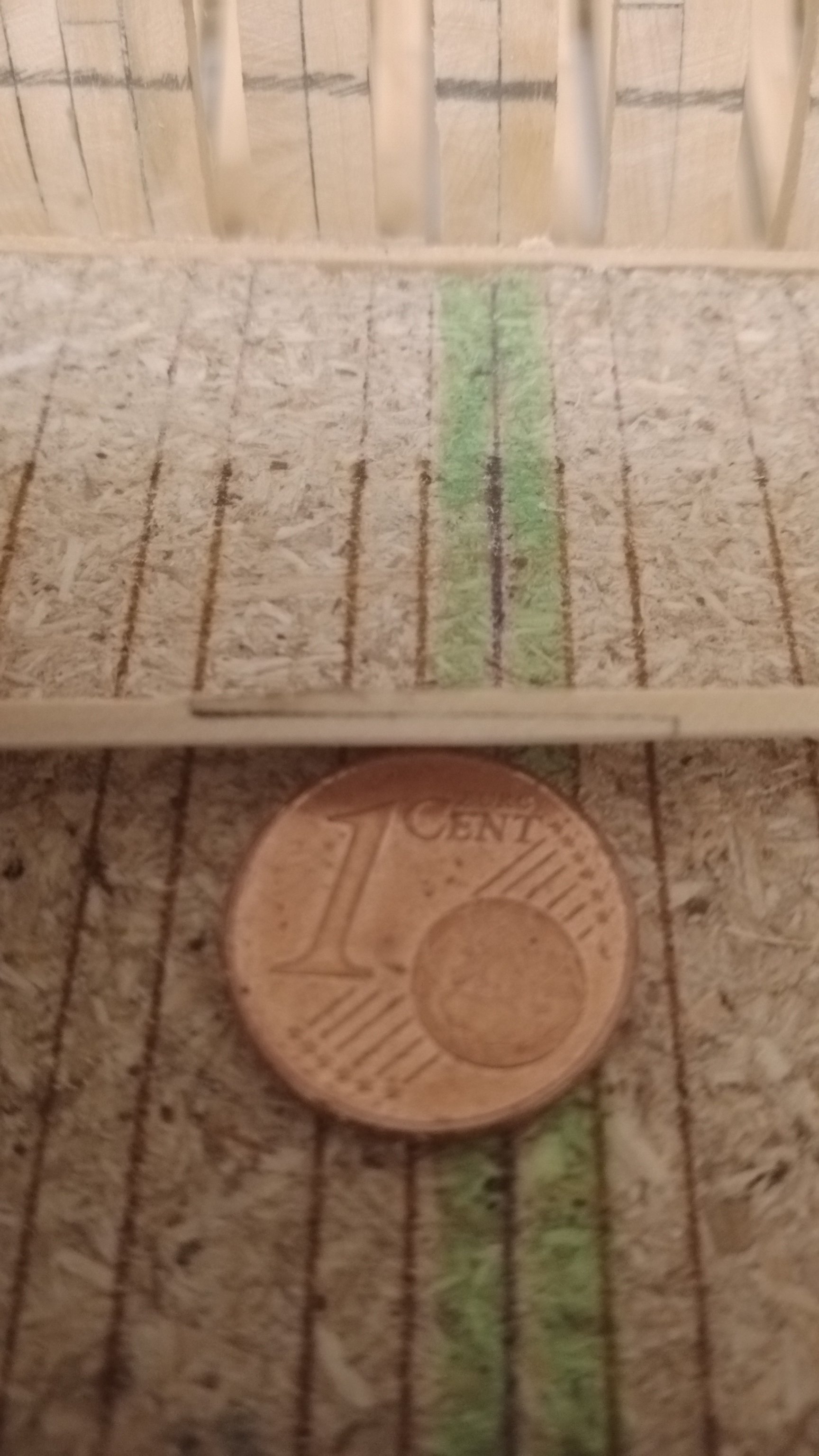

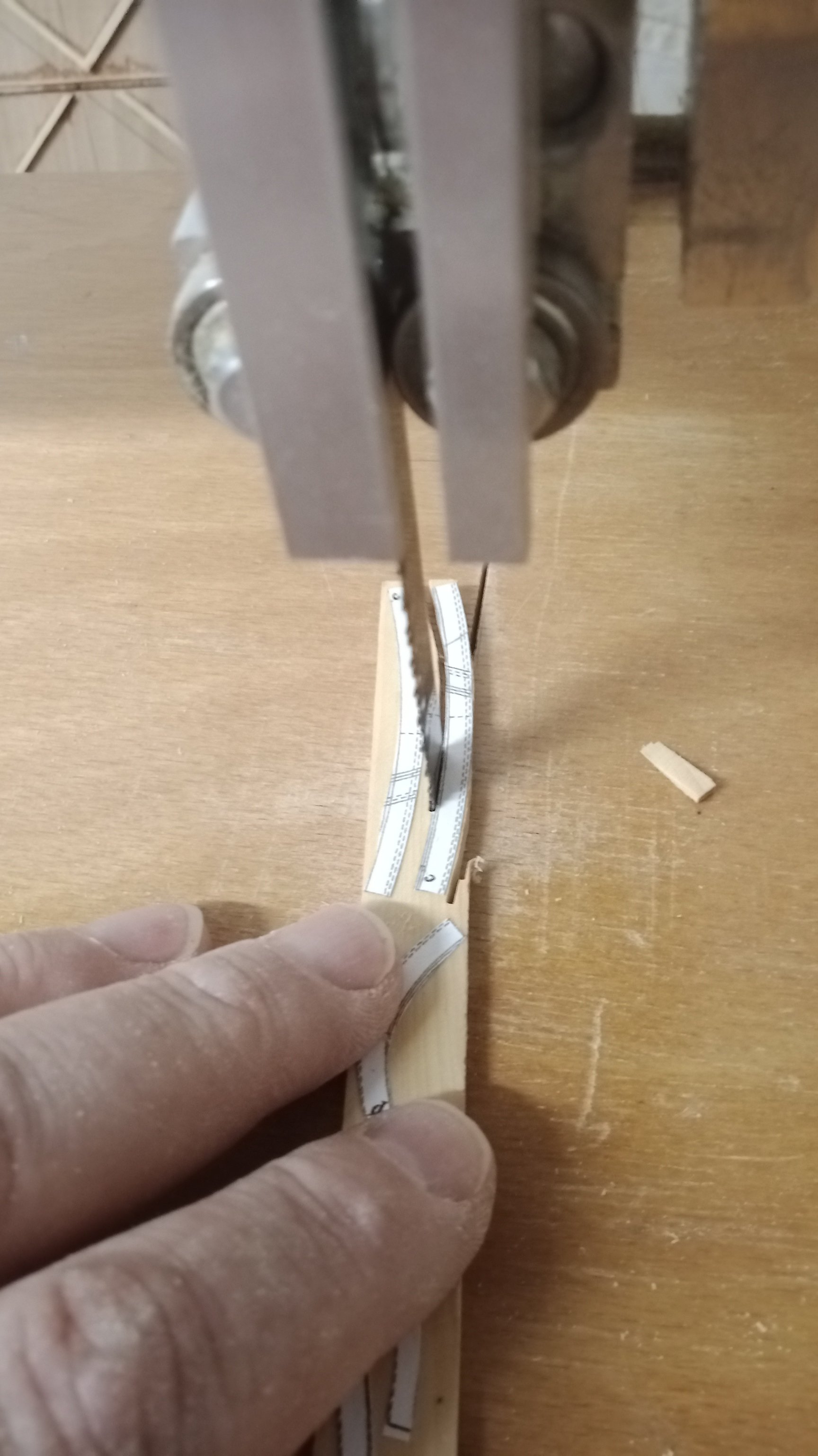

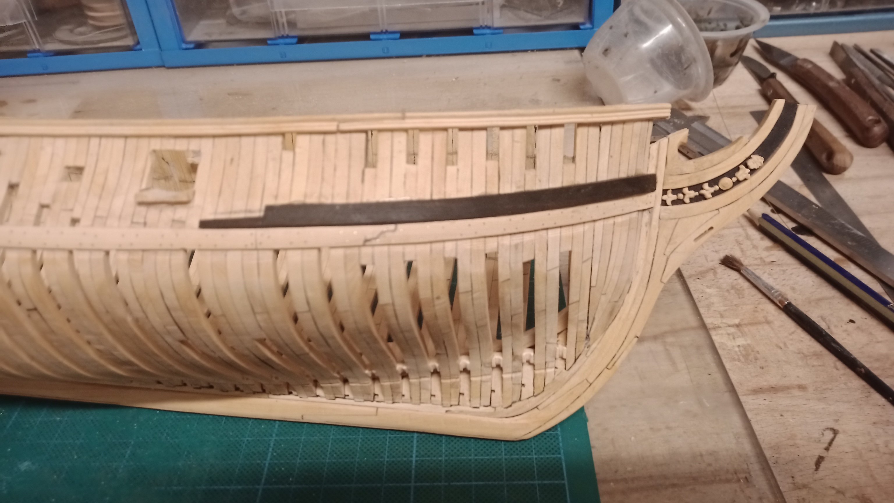

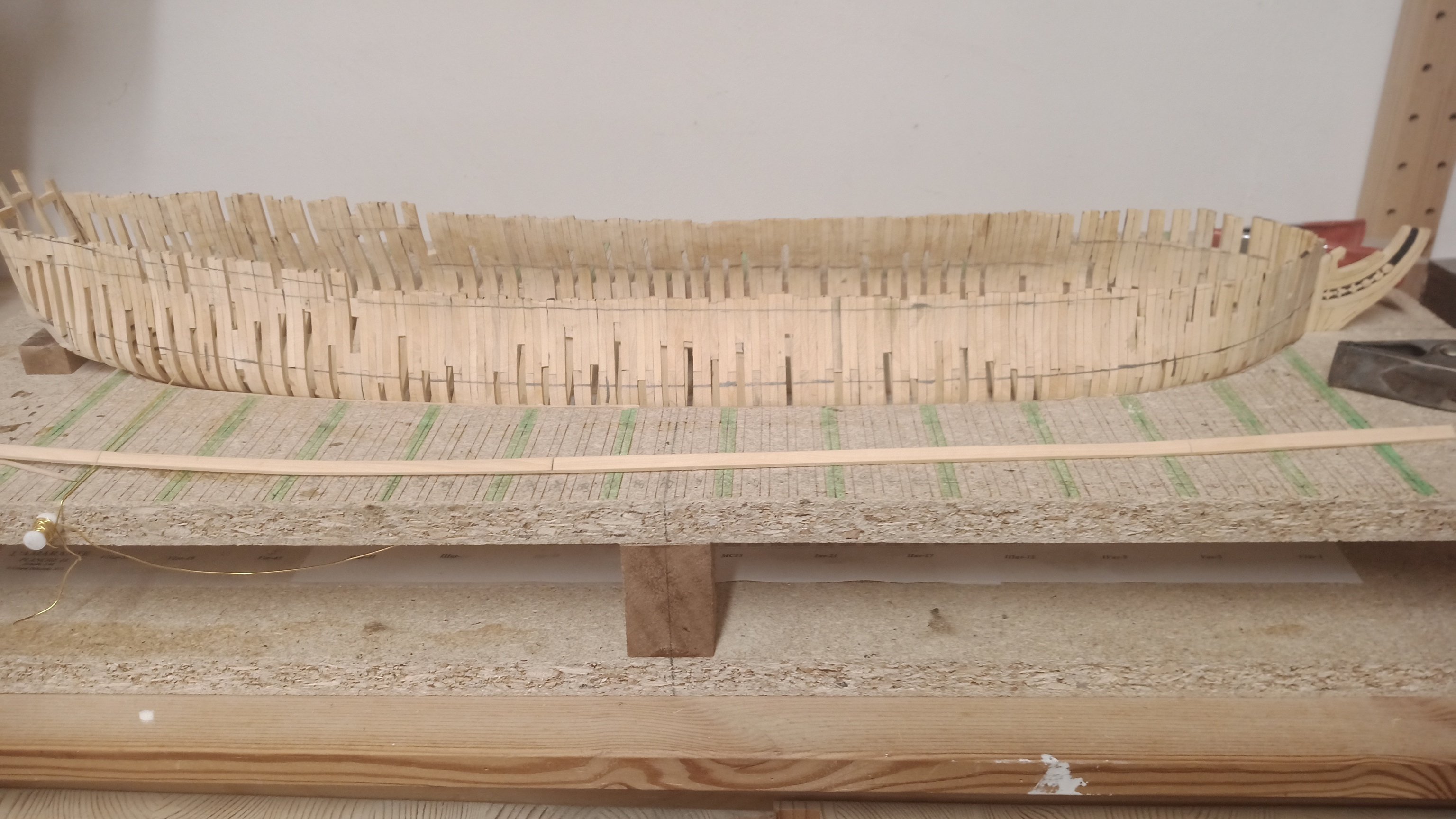

Planks usually look somewhat straight on the hull. But in reality, they aren't.
Here is the comparison of a plank with a ruler.
Here I'll show you my method for finding the right plank shape.

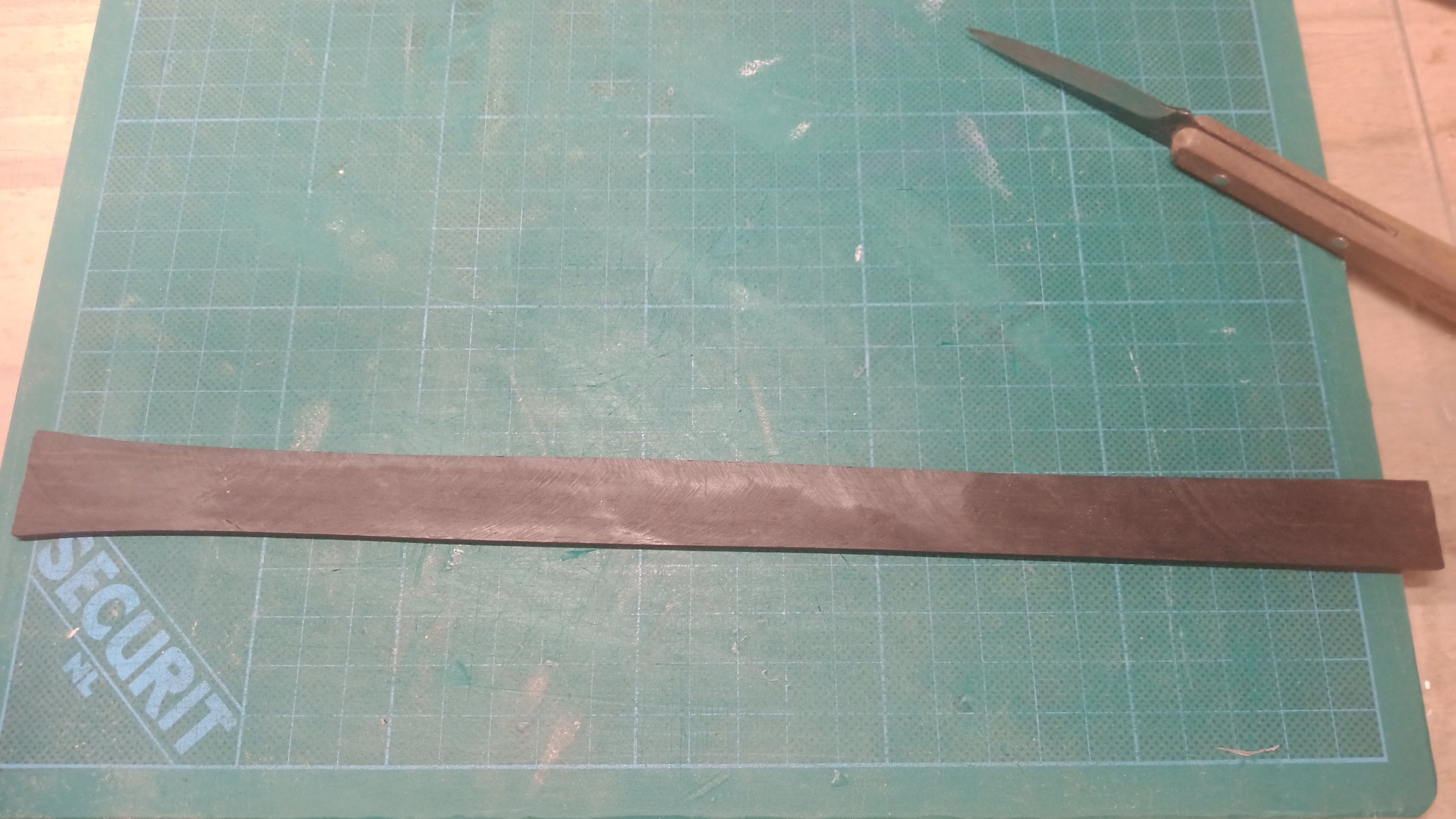

Starting material. Here, a strip of ebony.
The bottom edge of the new plank is measured from the top edge of the adjacent plank using parchment paper or paper tape.
The template thus created is glued to the ebony strip...
...and sawn out.

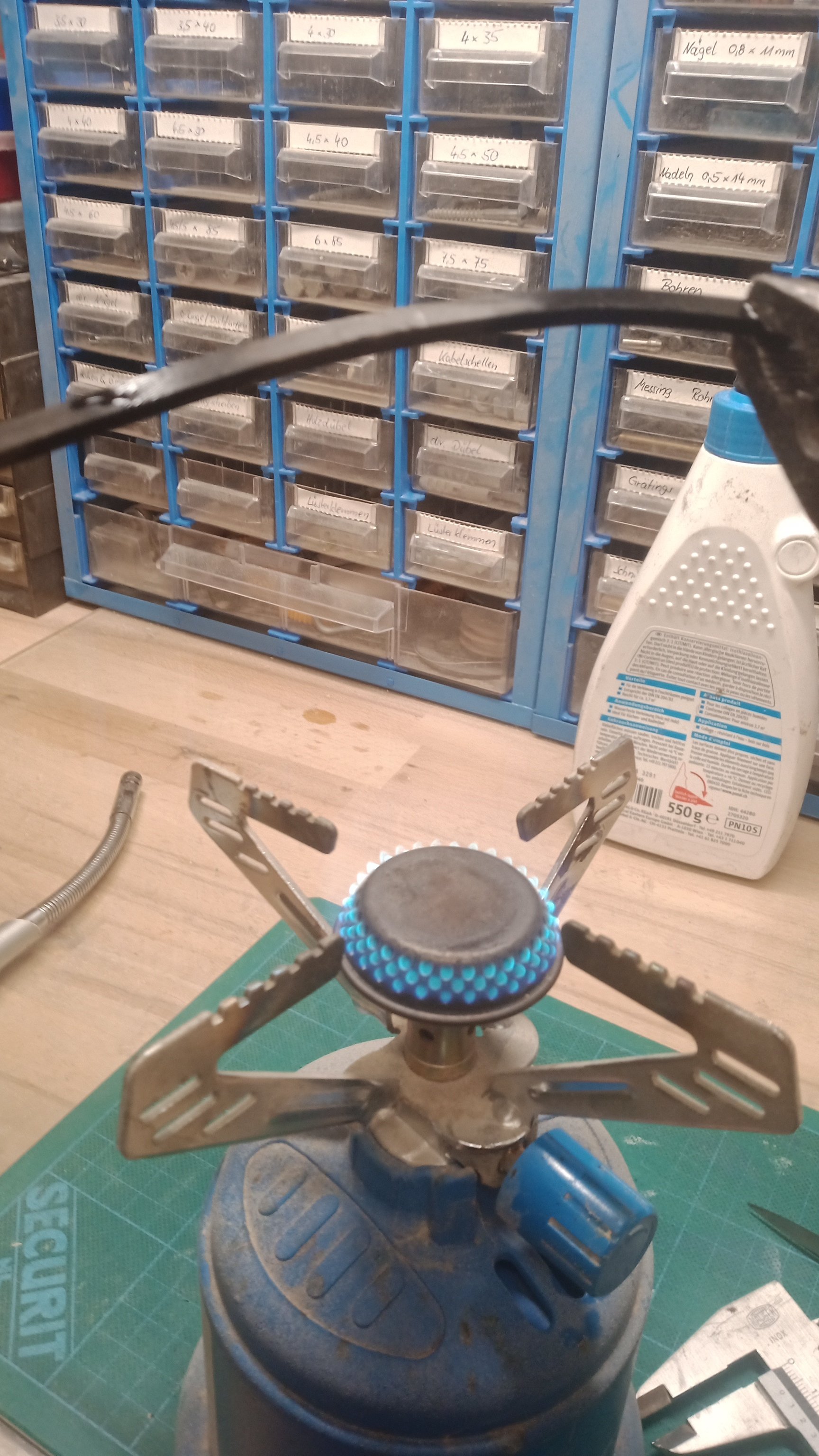

It is moistened and bent over a camping stove.
Once again, the plank-ruler comparison.
Fits
to be continued
Herzliche Grüße
Willi
Edited by Willi

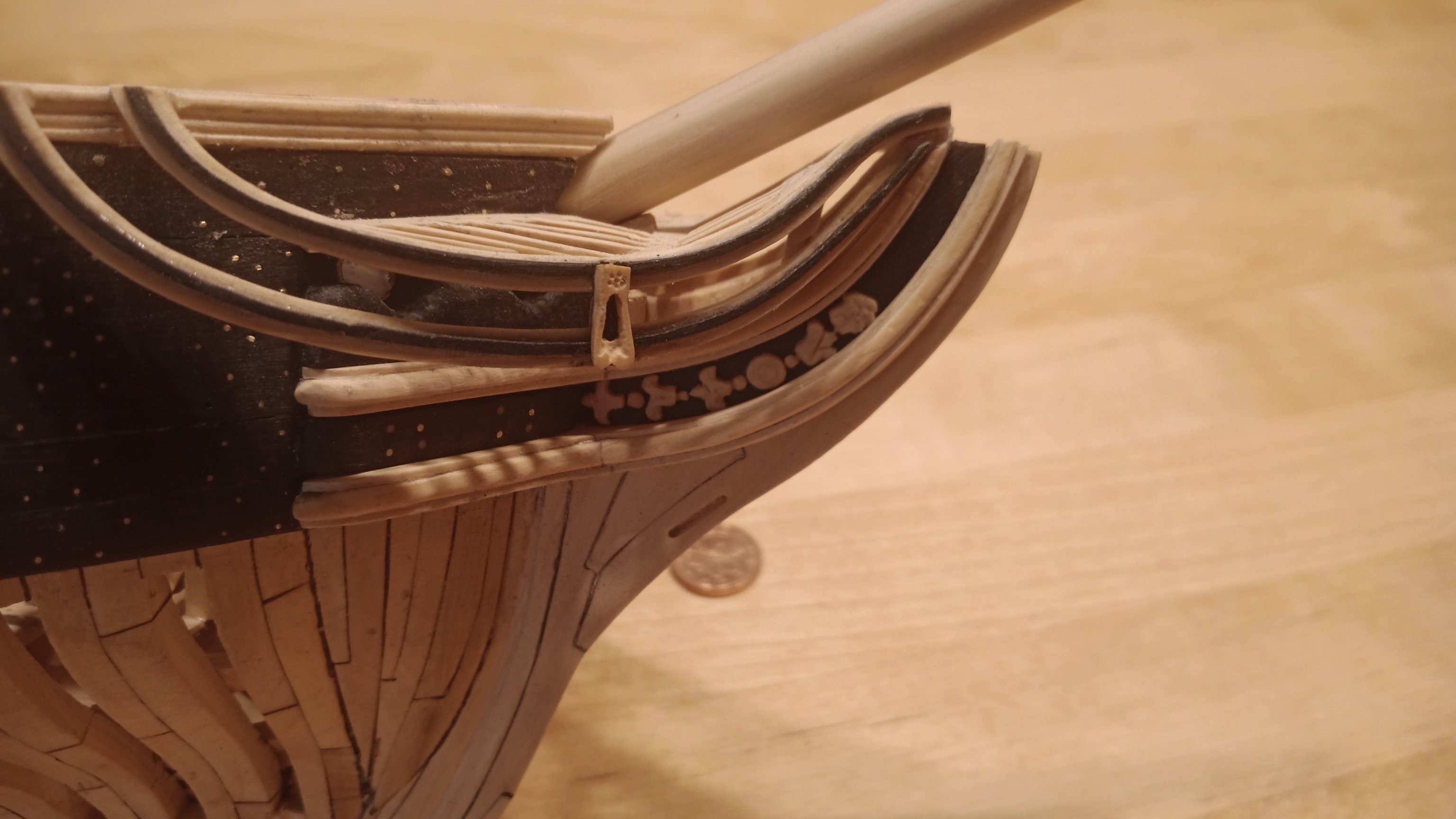

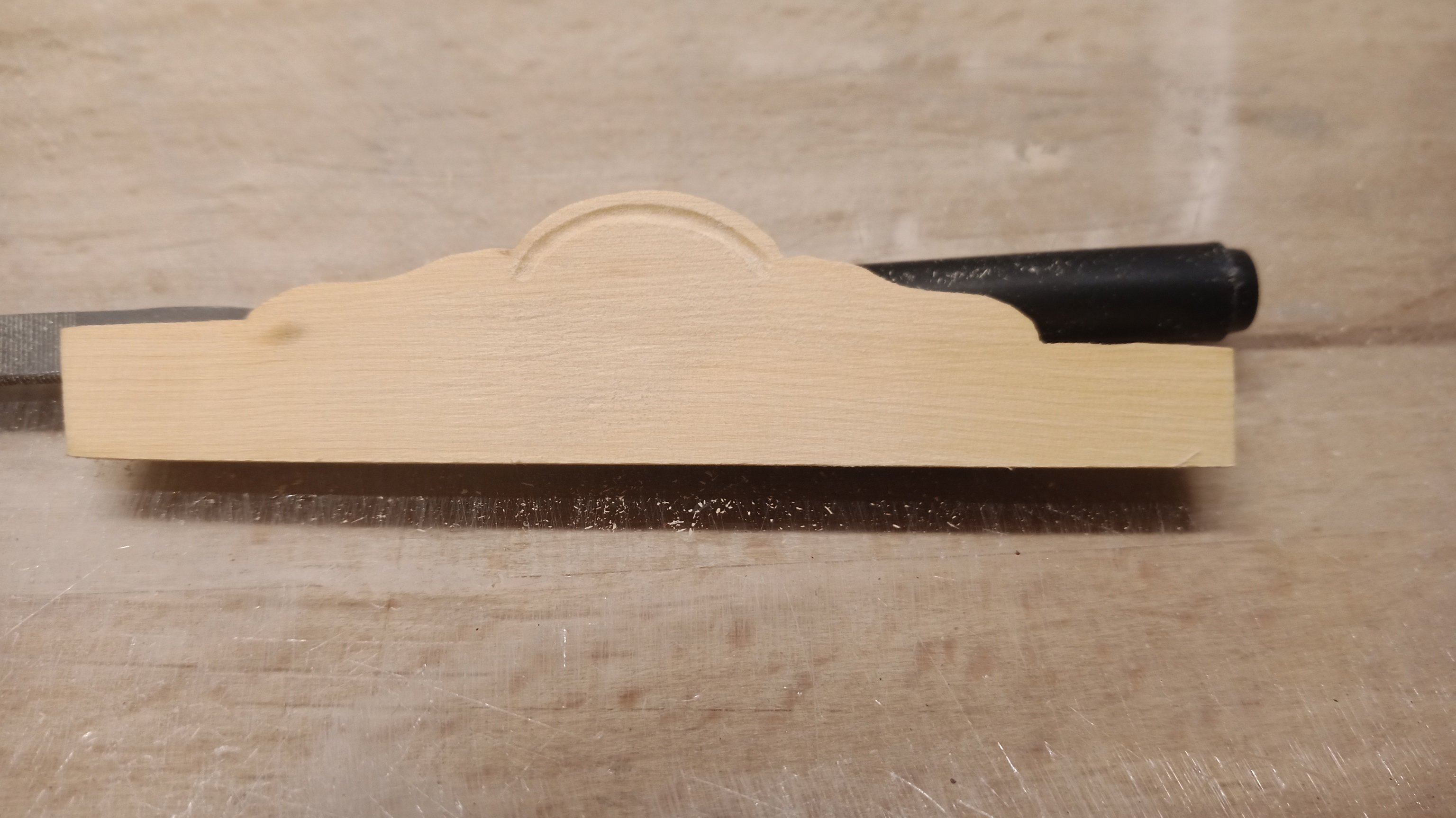

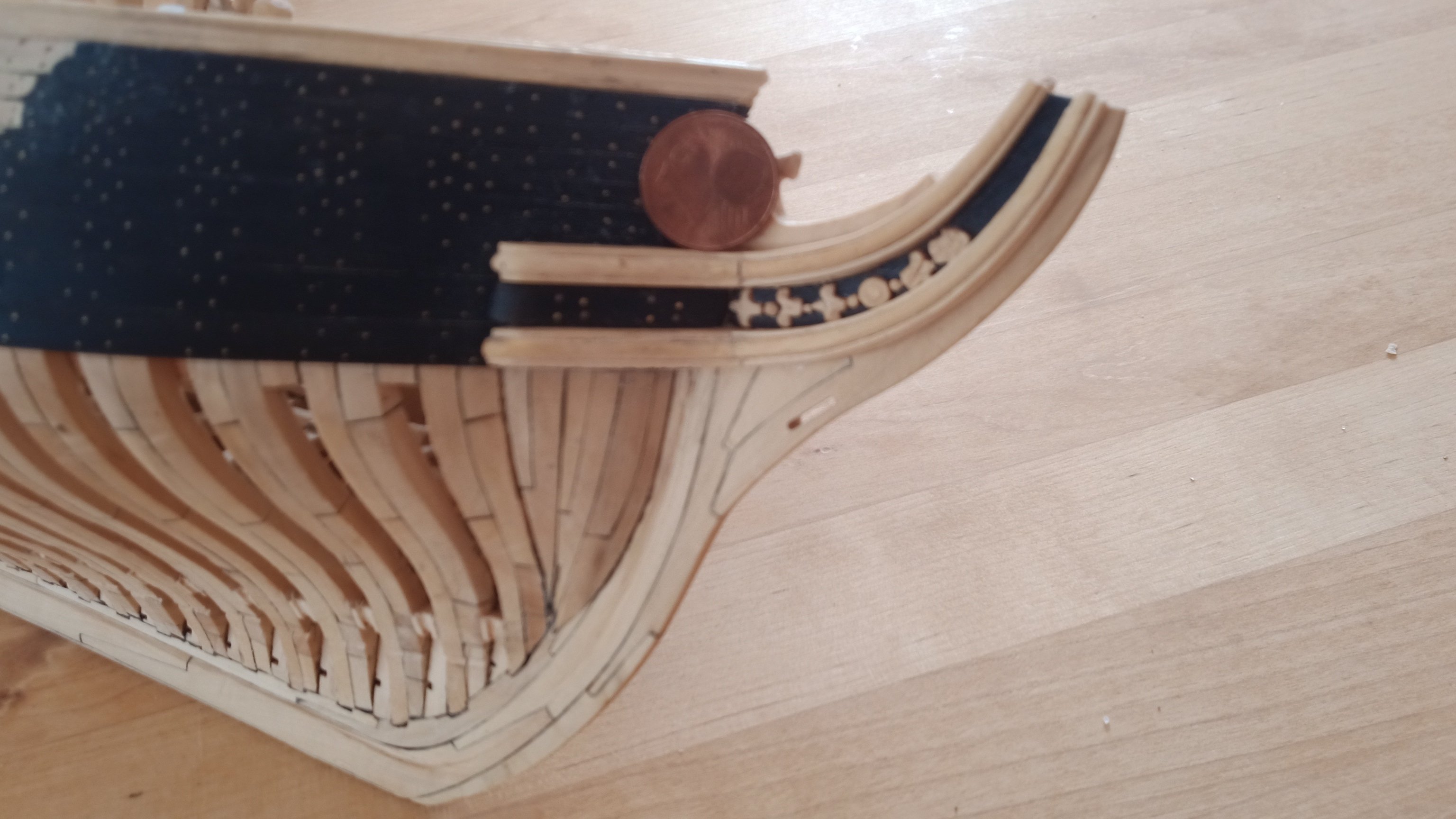

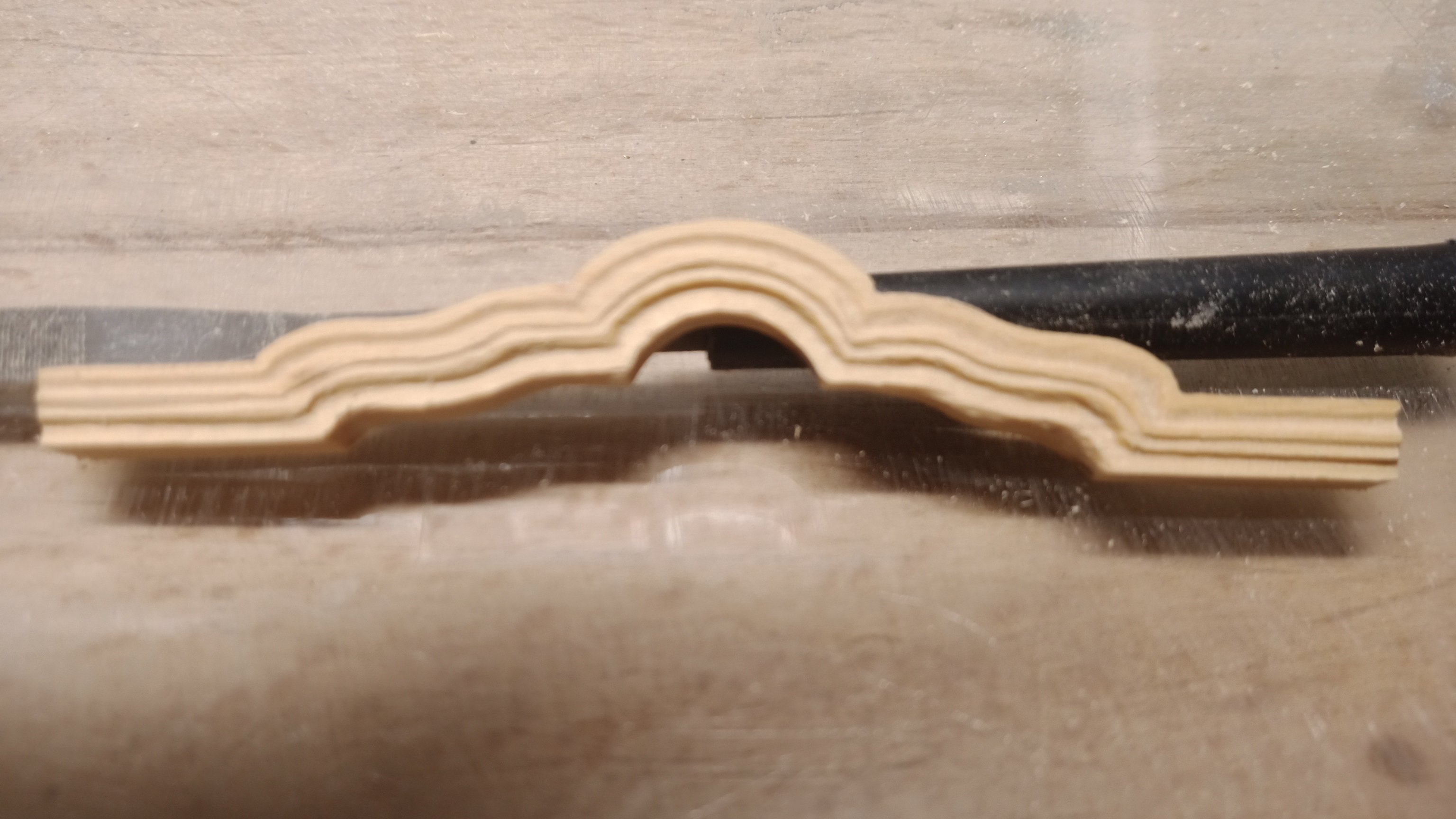

Hello everyone

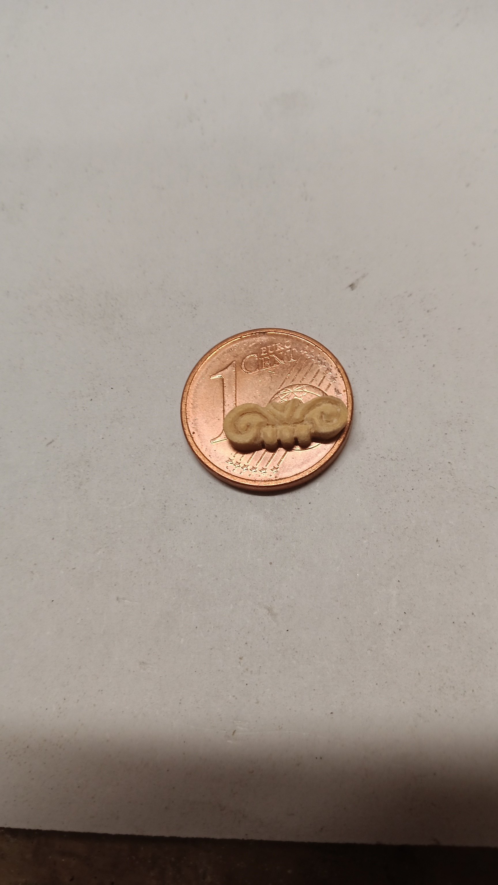

The head...
As mentioned elsewhere, it's difficult (for me) to create a profile on a curved strip.
Here, I worked with several layers.
to be continued...
Herzliche Grüße
Willi
Edited by Willi

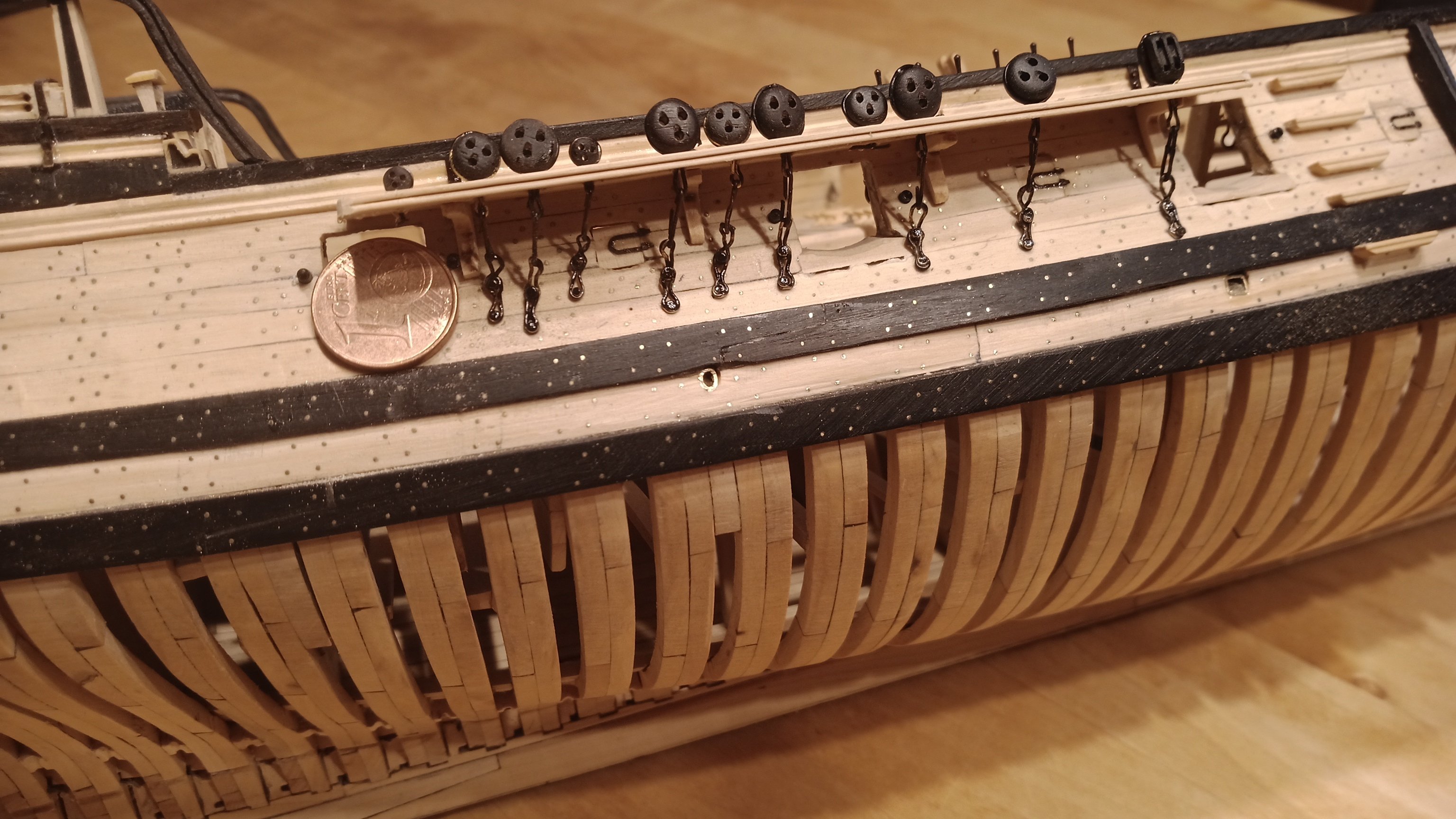

Hello everyone

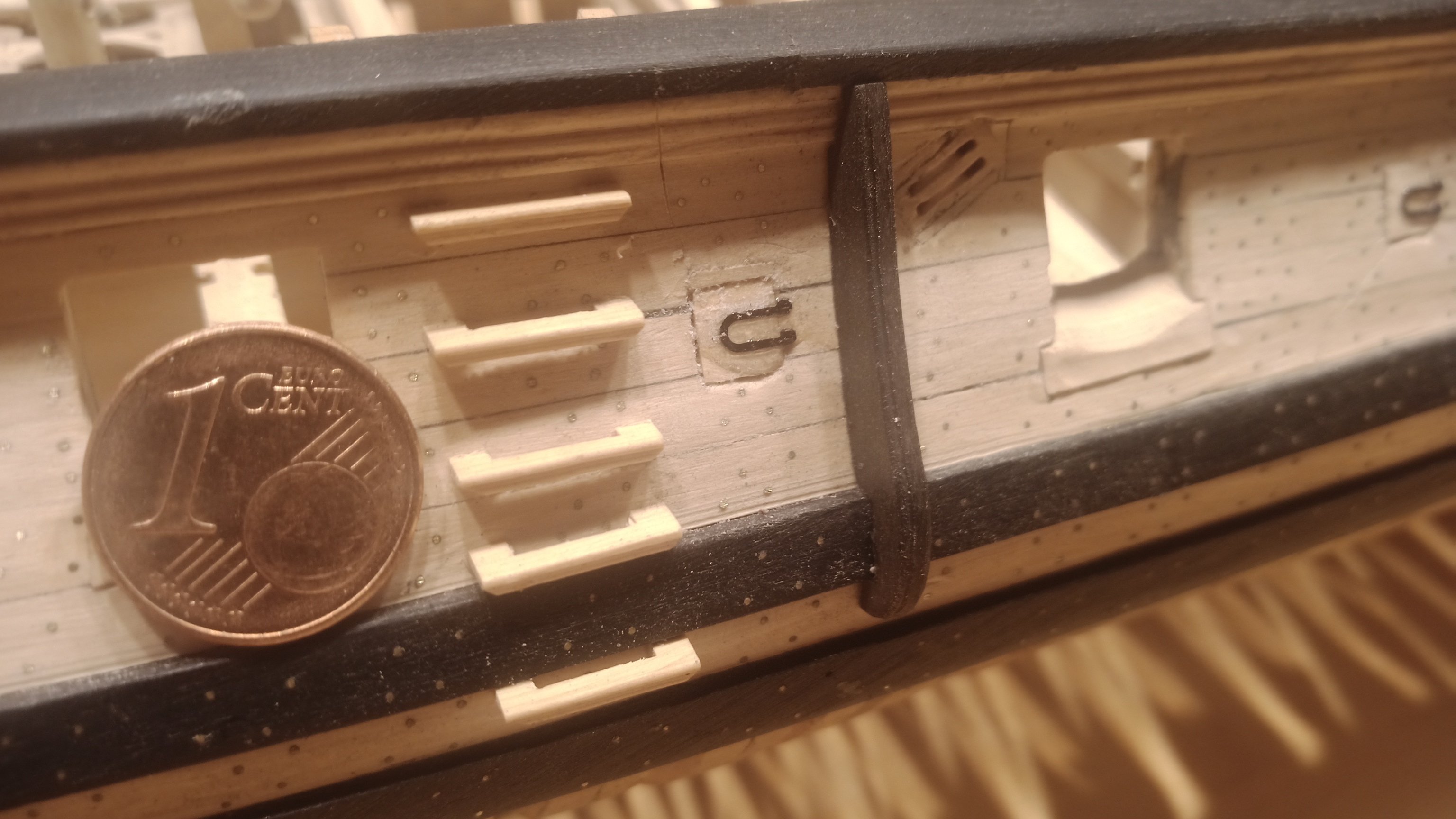

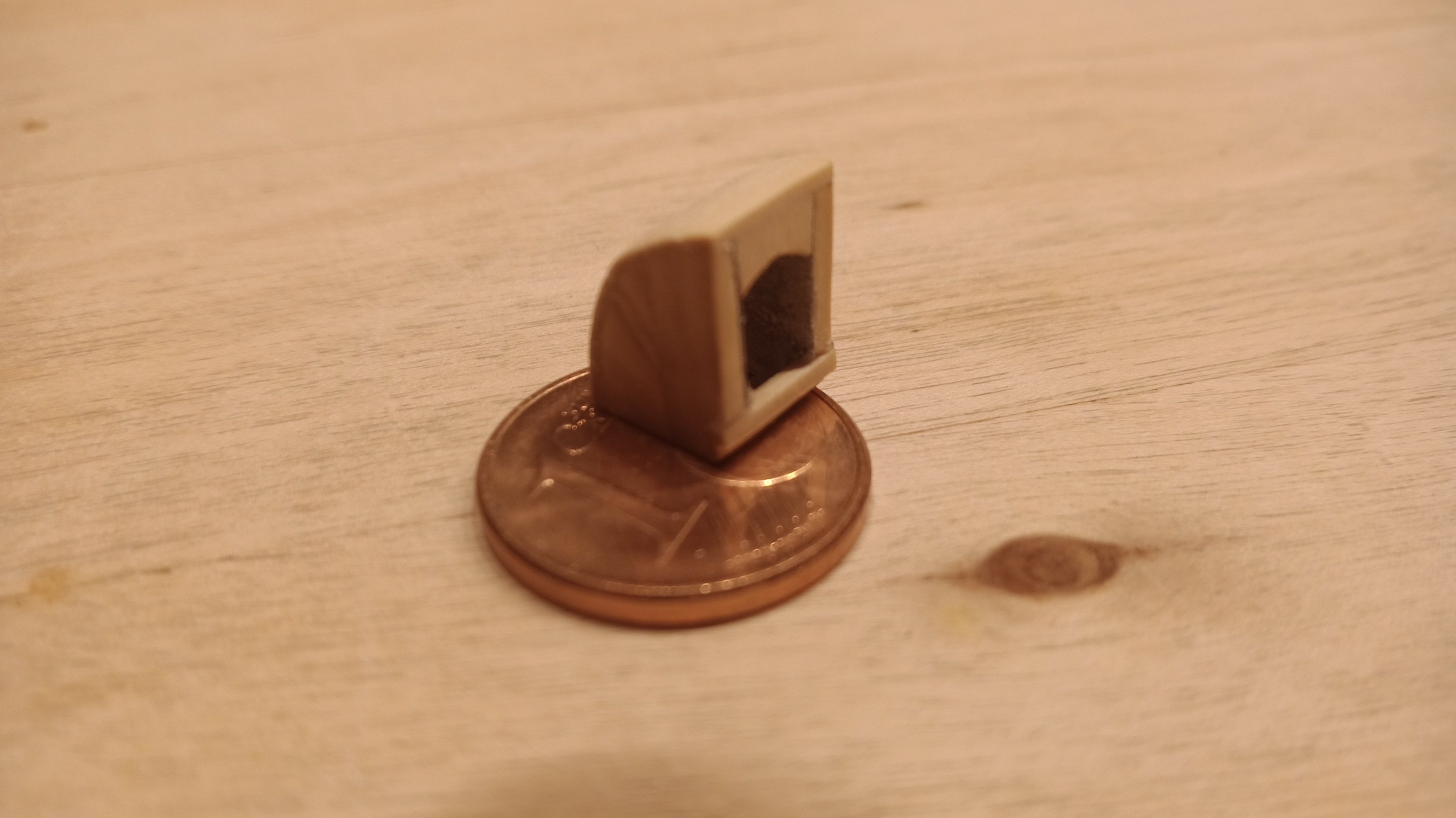

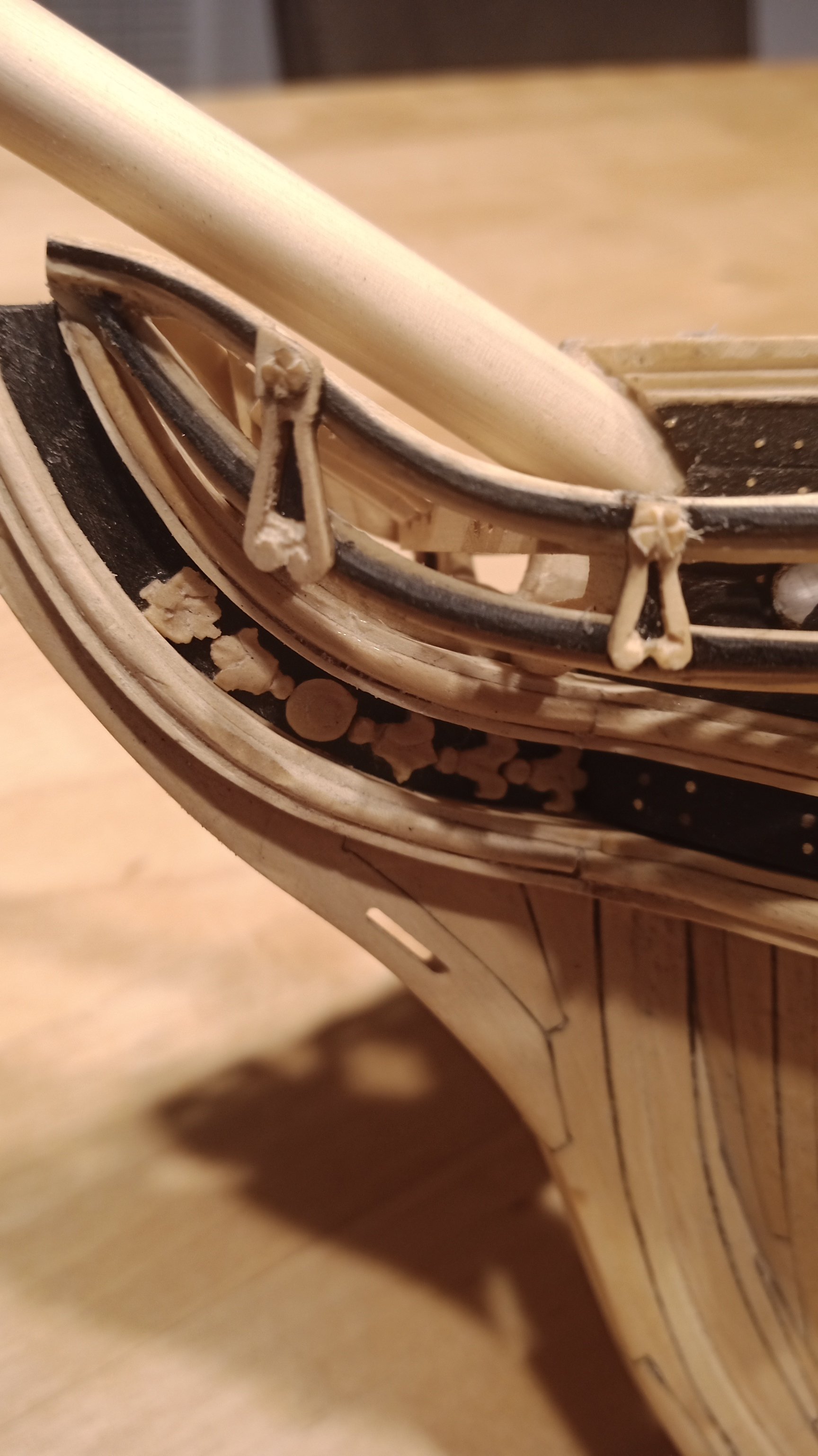

The channels an their chains:
That brings me to the current status of the work.
I'm not satisfied with everything. There's a gap between my expectations of myself and my abilities.
Even though I hope you enjoyed the little journey so far.
to be continued...
Herzliche Grüße
Willi

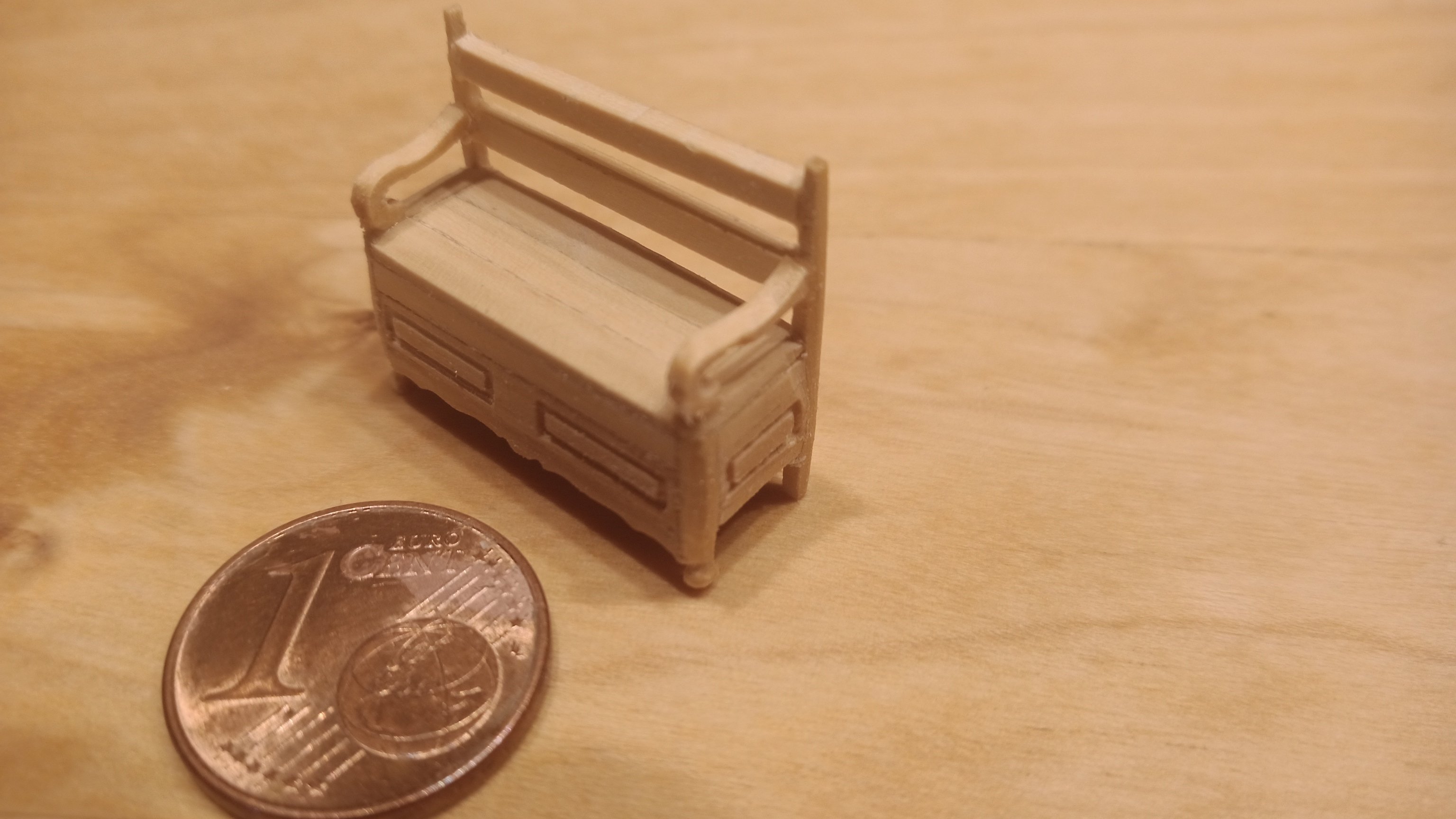

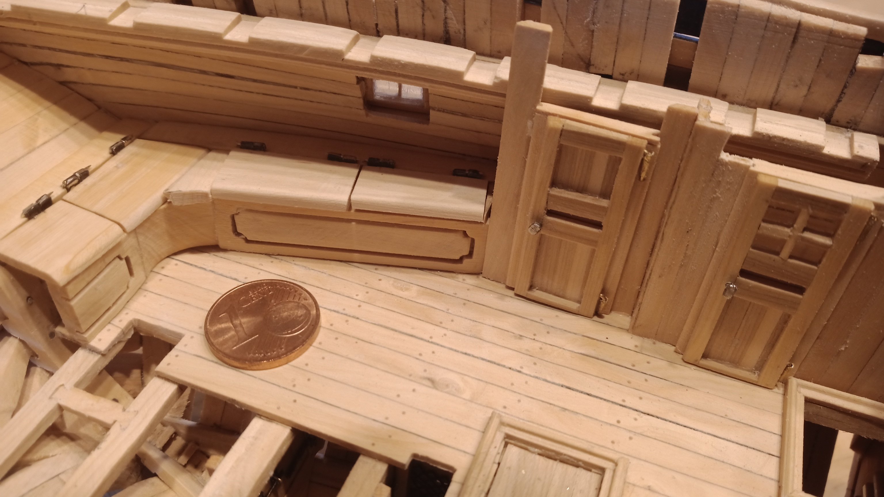

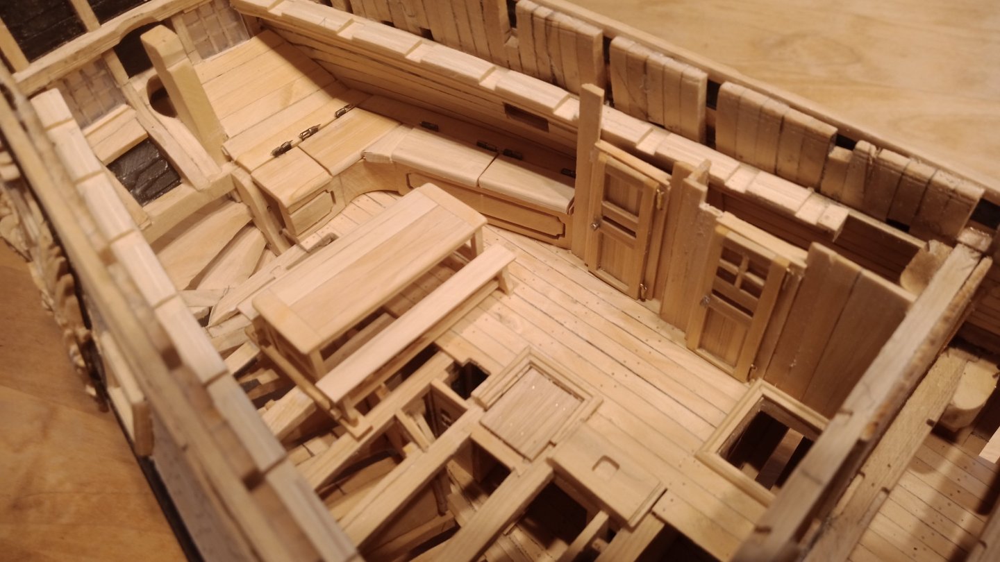

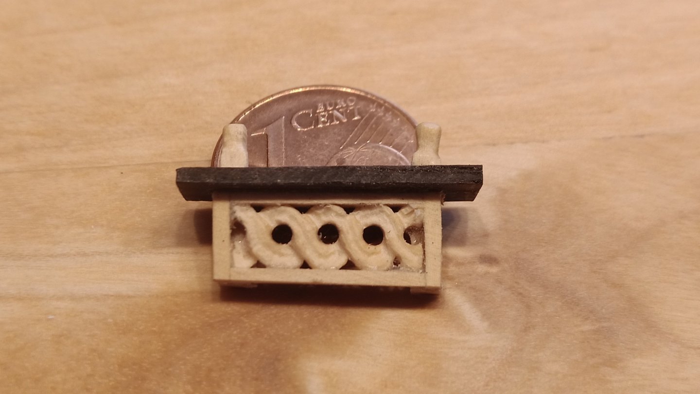

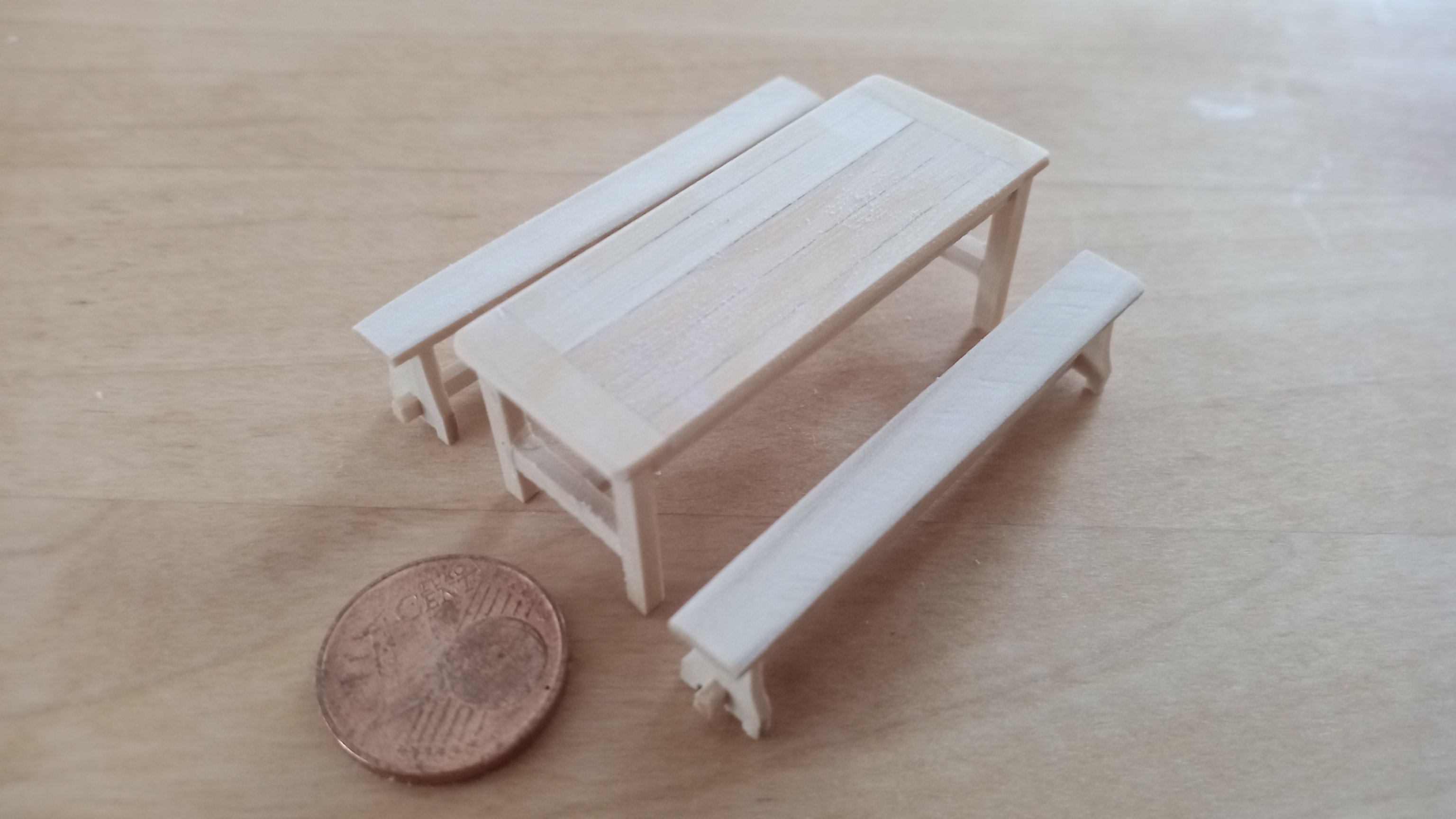

Really fantastic work! I'm struck by the table and chairs--they may be some of the simpler constructions in this build, but they're made beautifully.

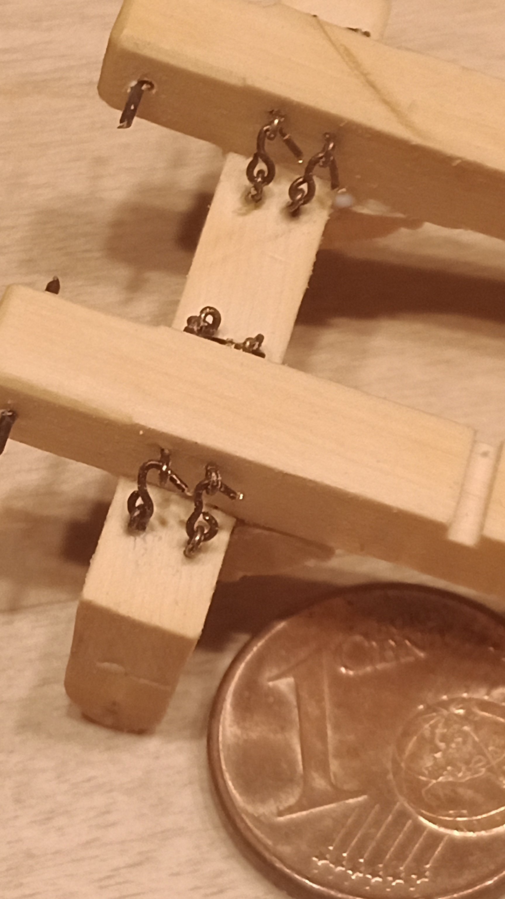

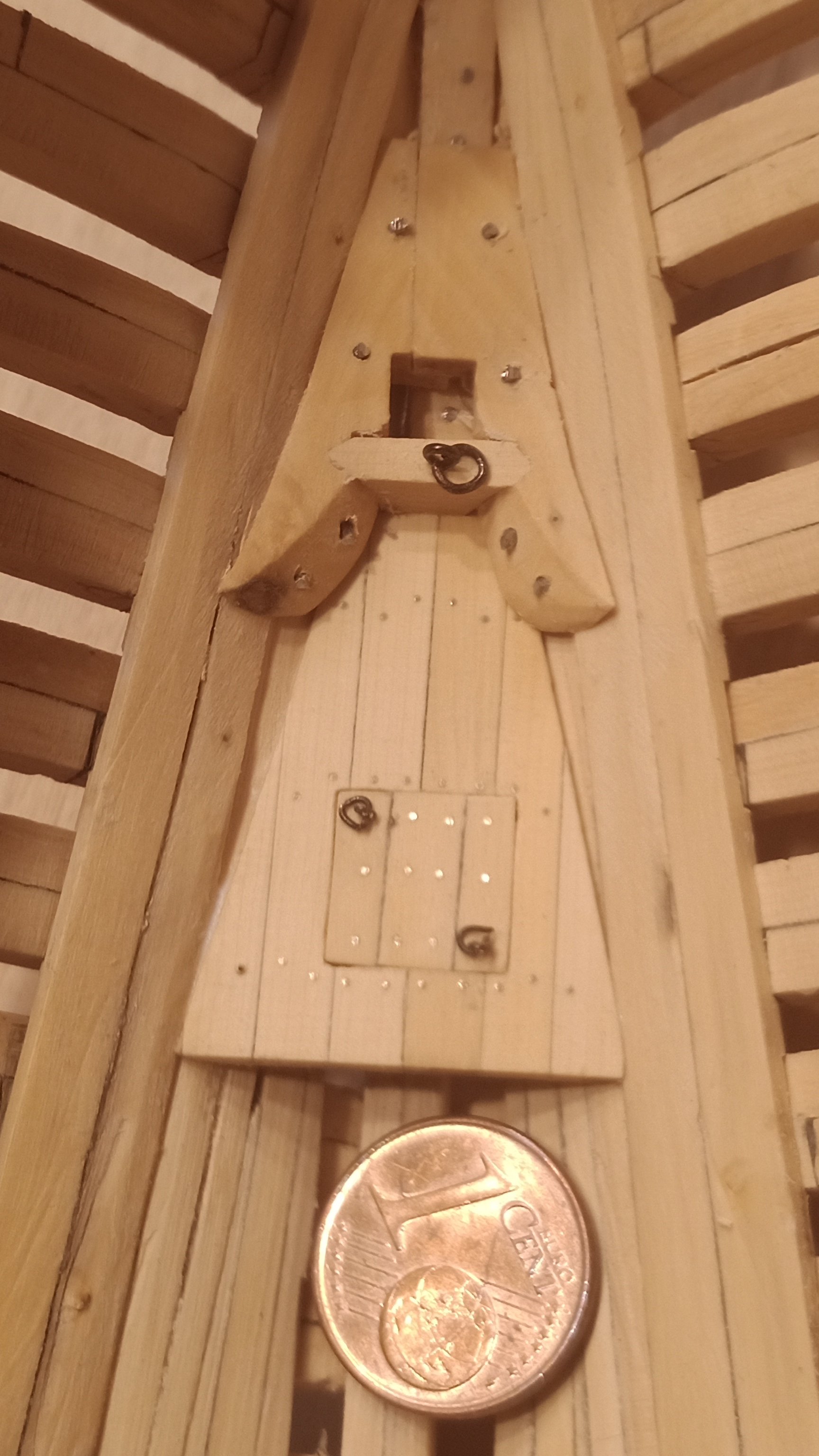

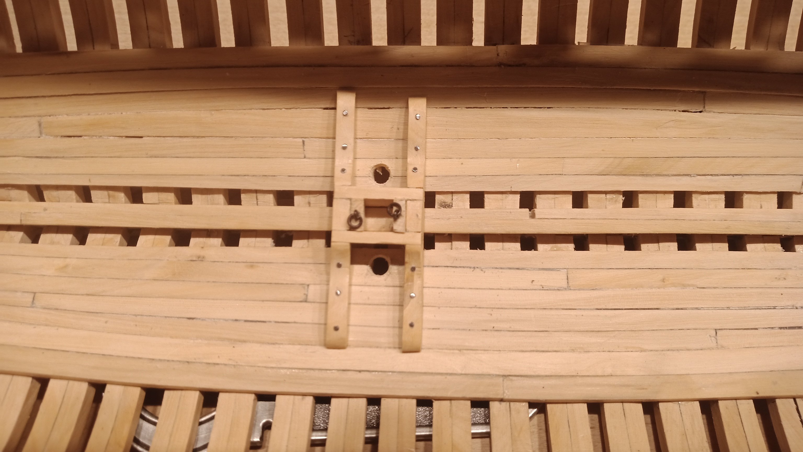

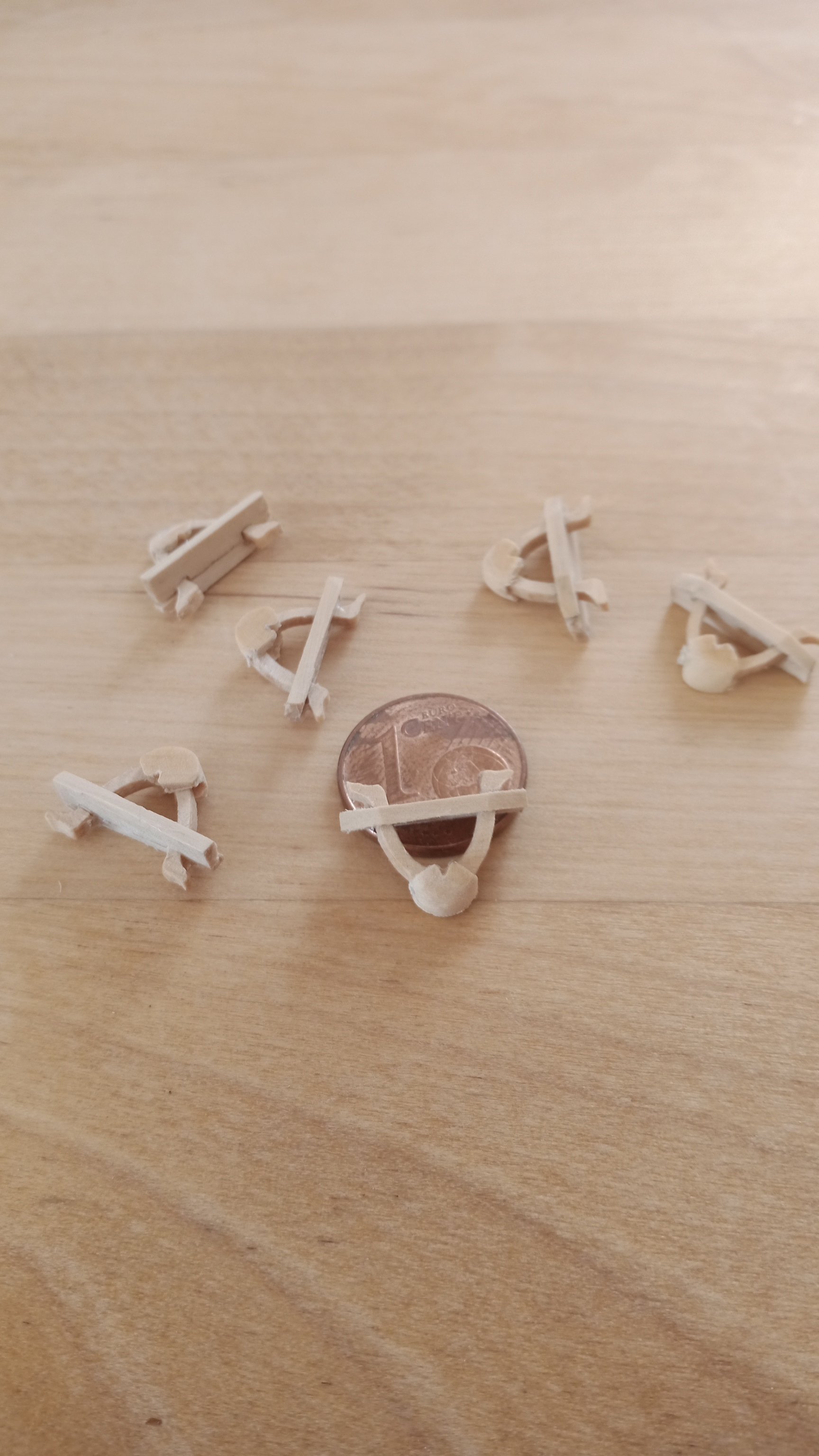

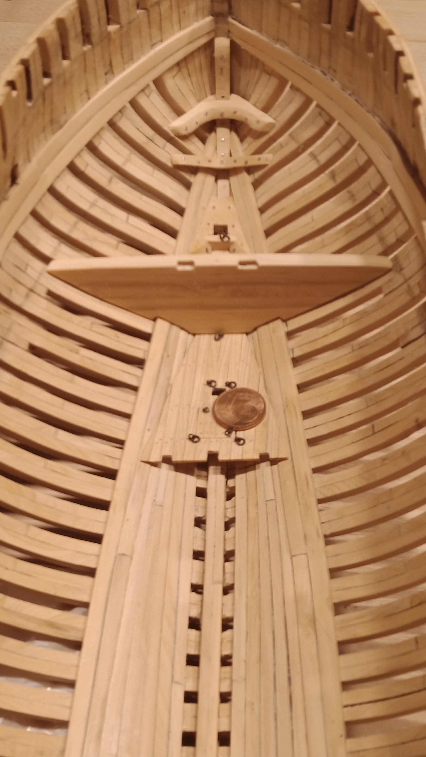

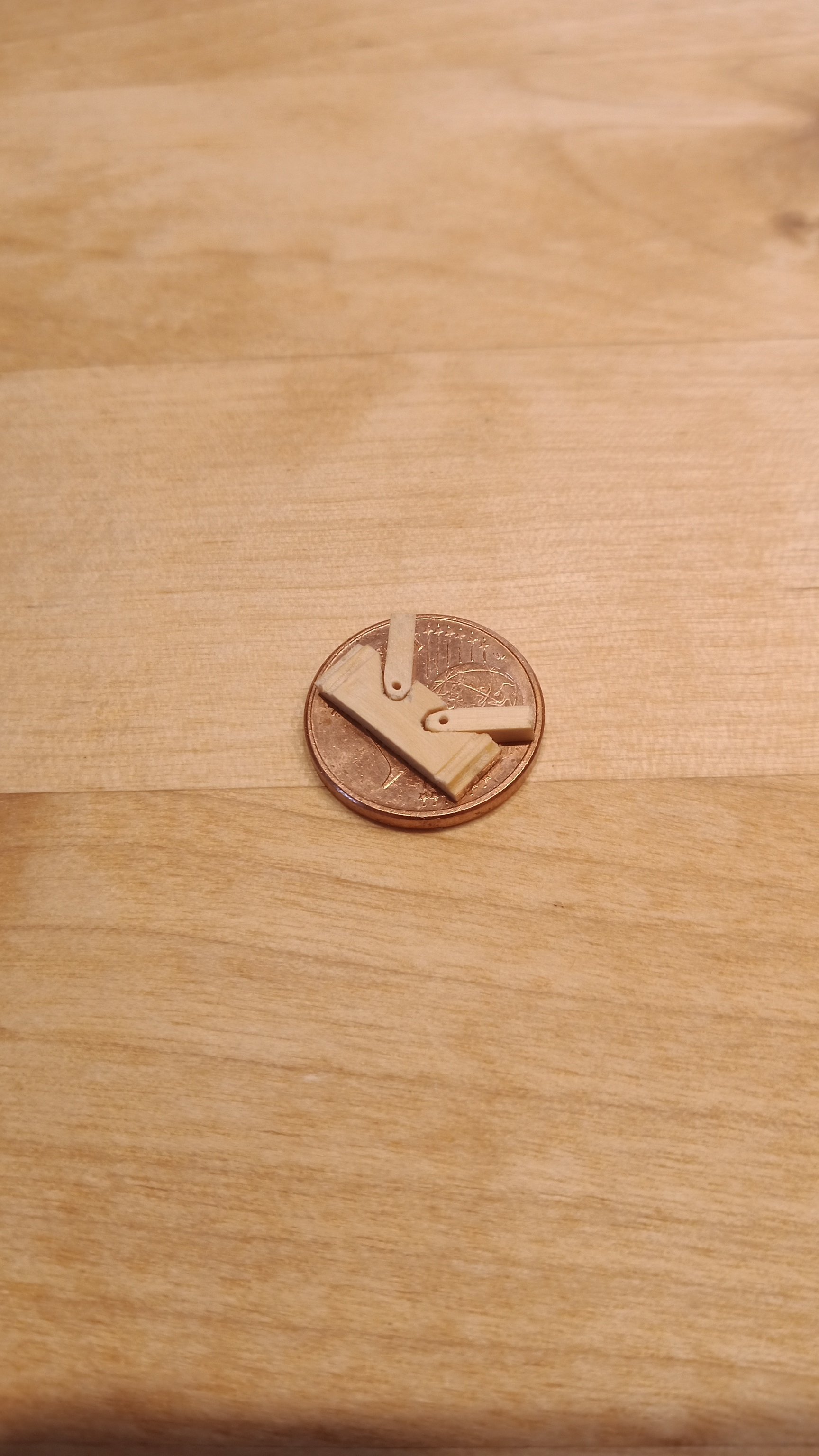

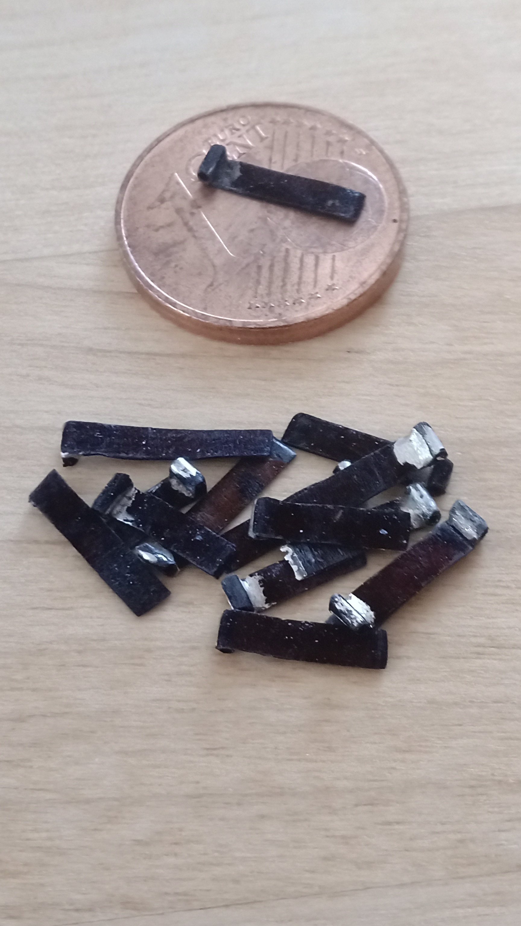

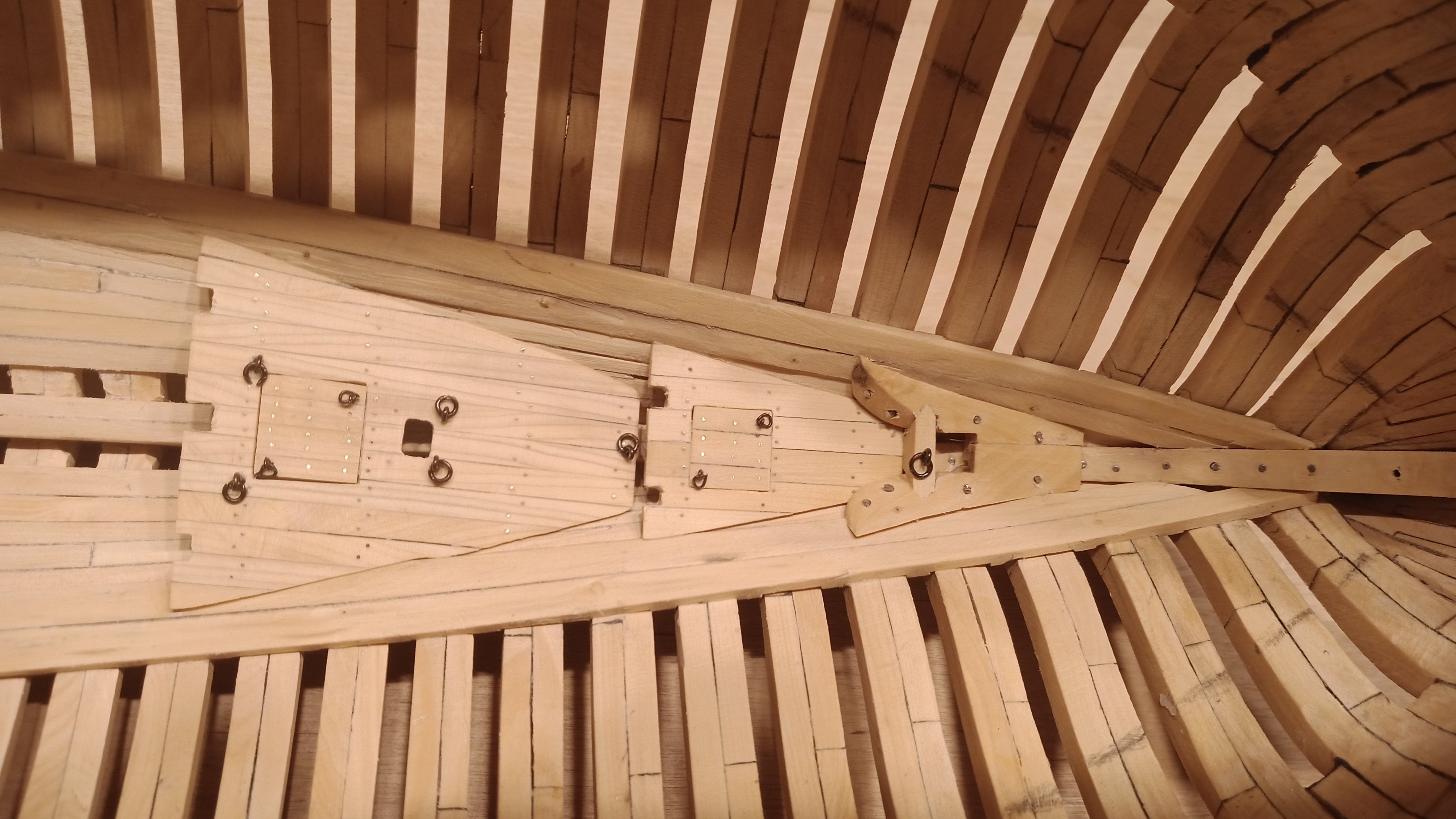

Hello everyone

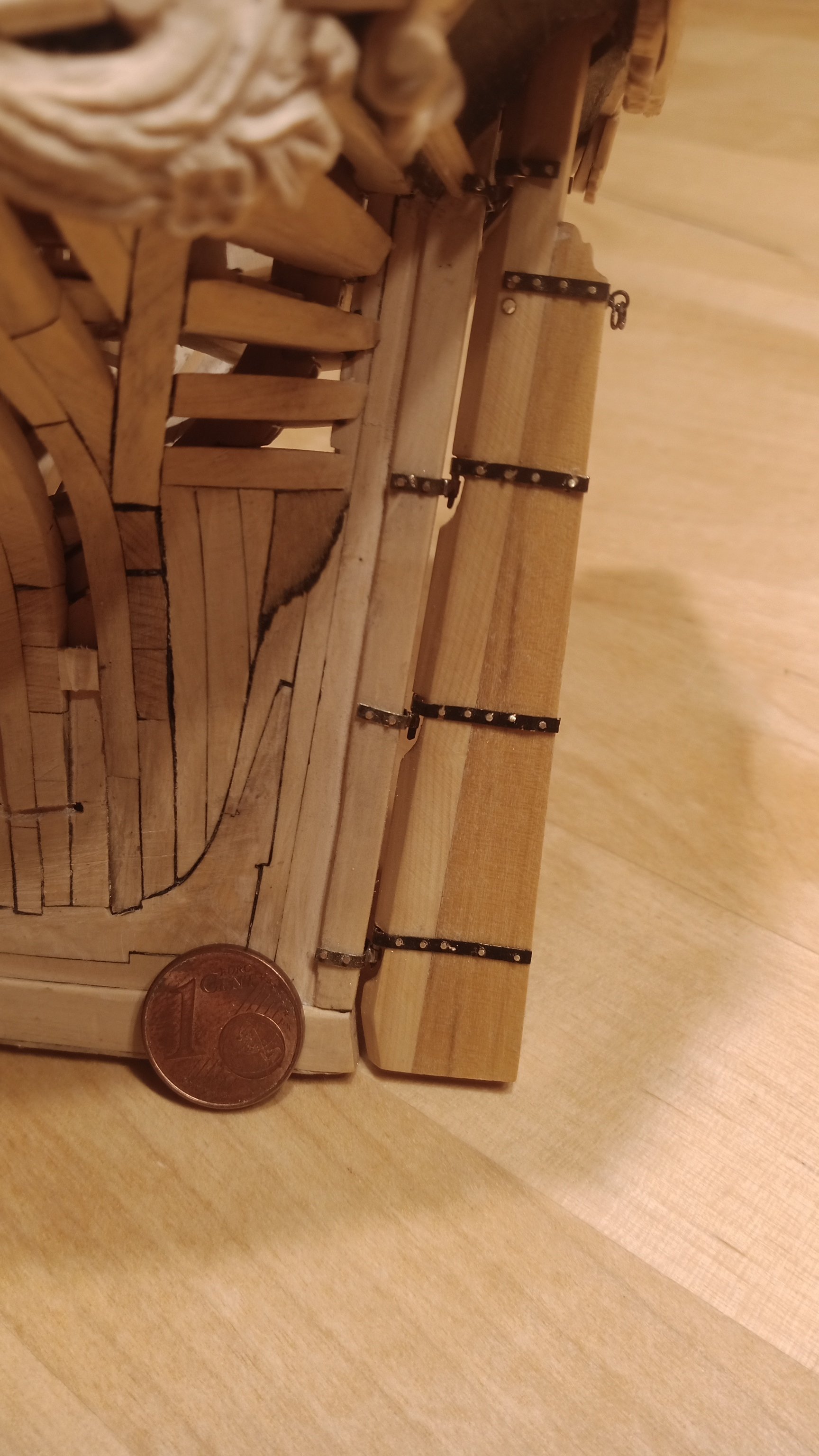

There's been a little progress, as small as its parts.

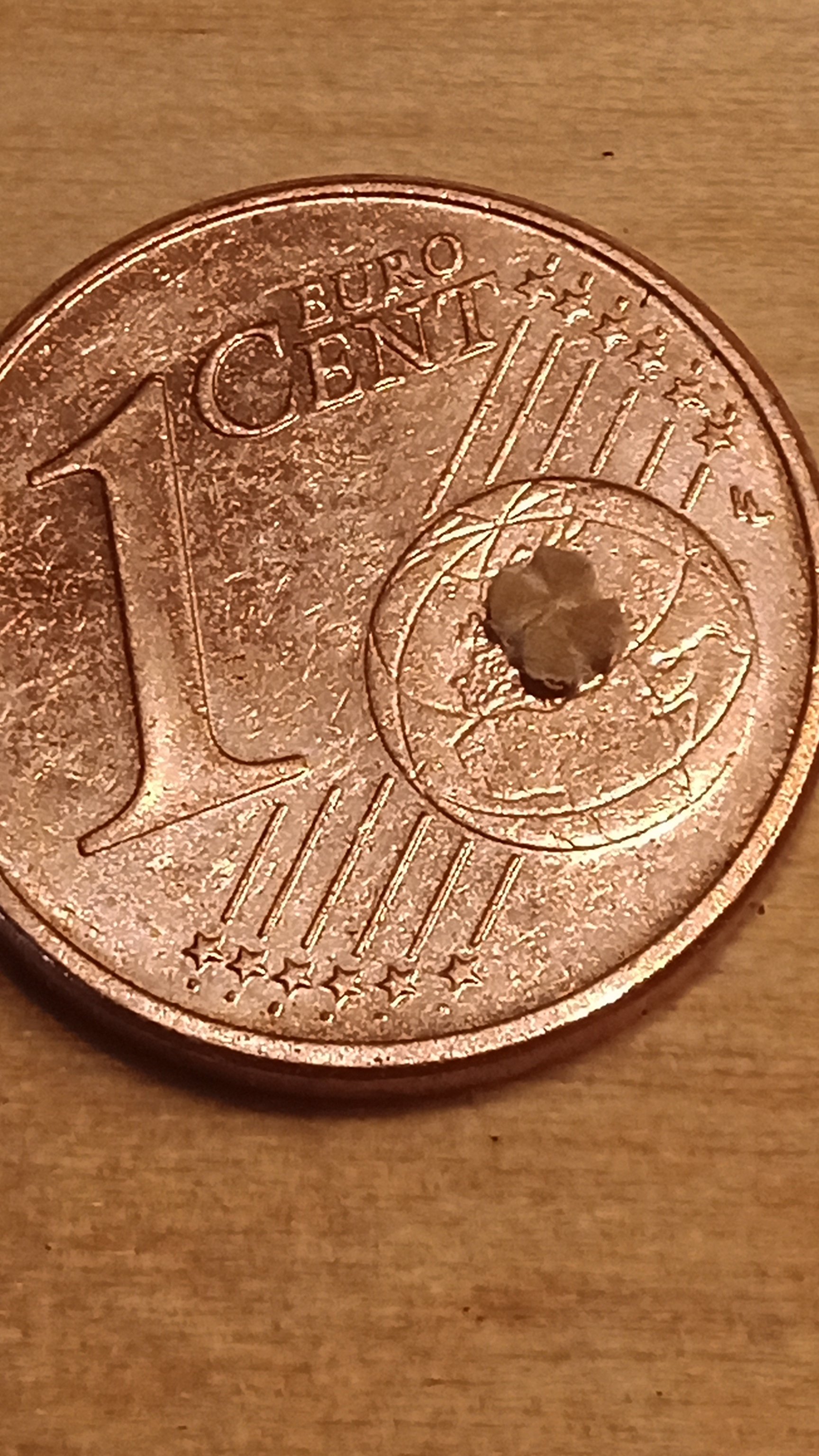

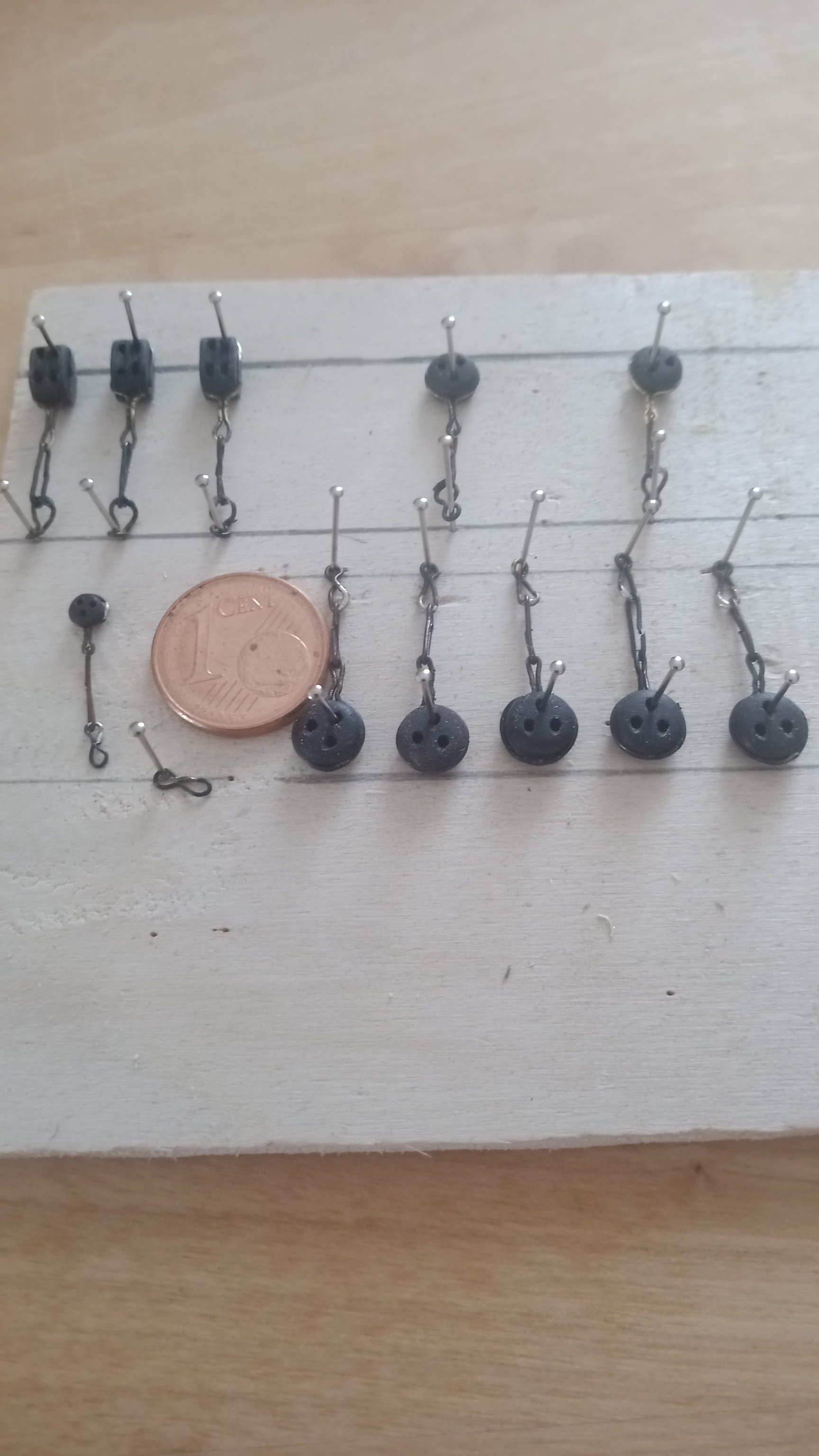

There are probably around 60 eyebolts with rings that had to be made and installed.
In the first photo, you can see four thimbles at the top. I didn't use them, though; they were too big.
A lot of work for a barely visible result.

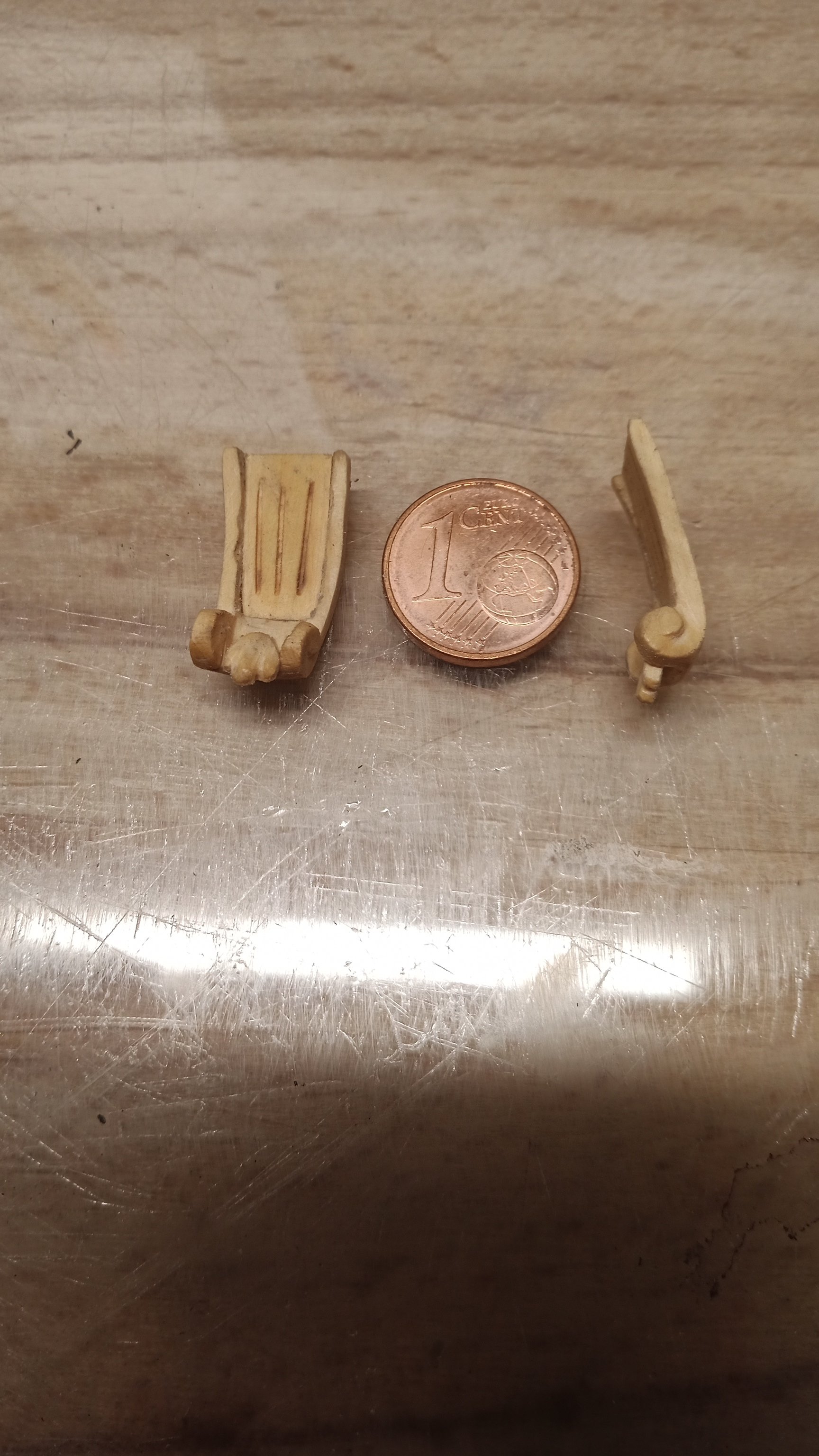

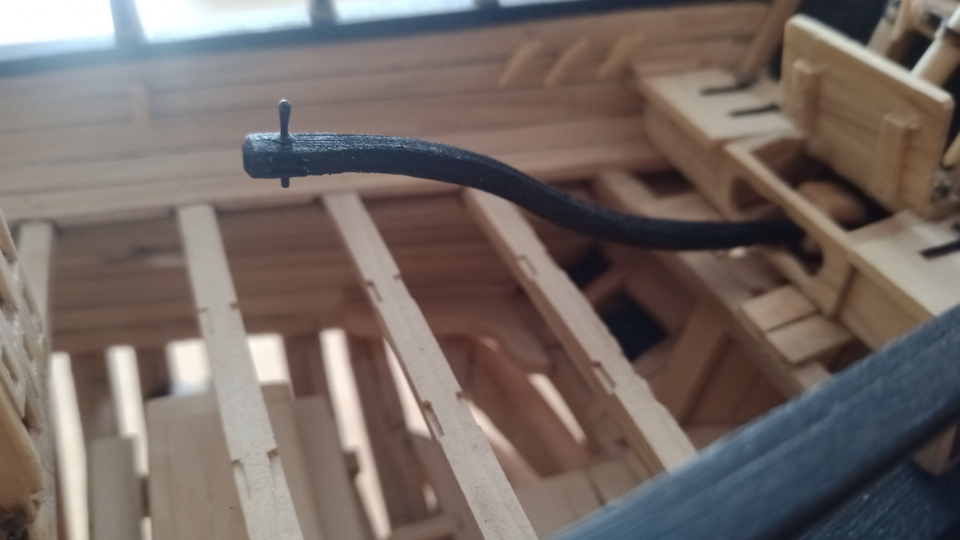

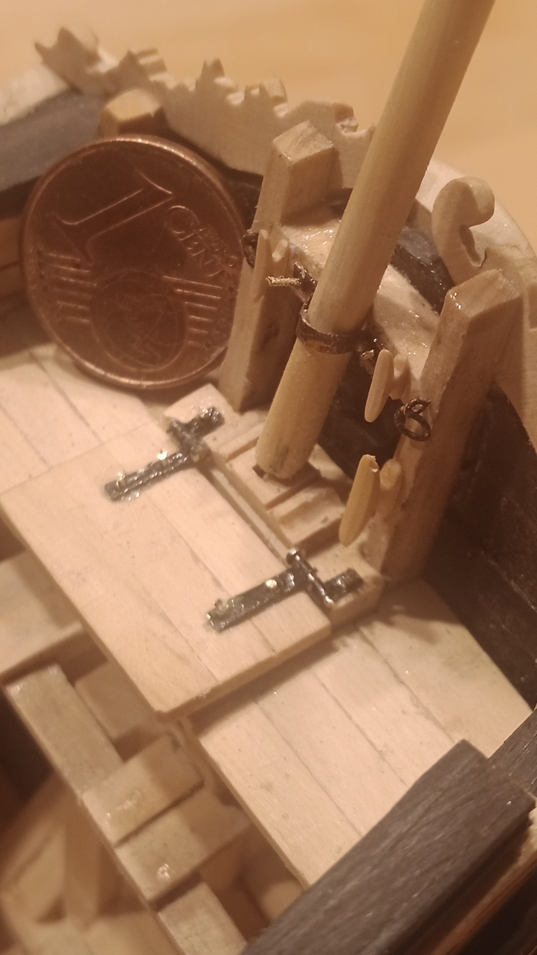

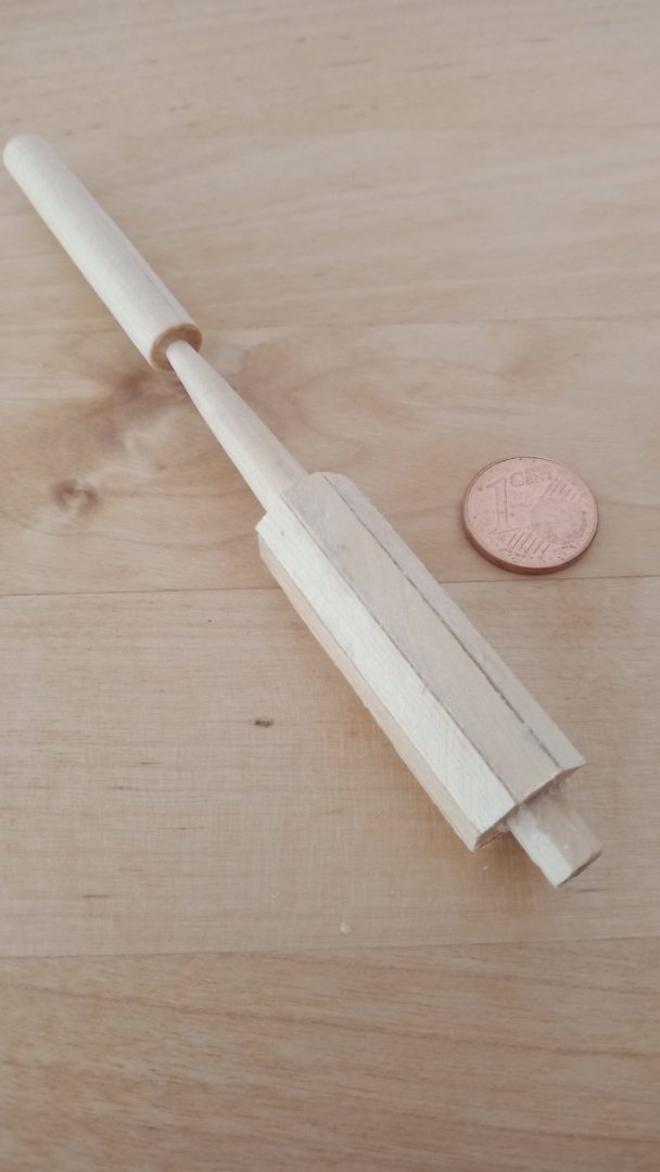

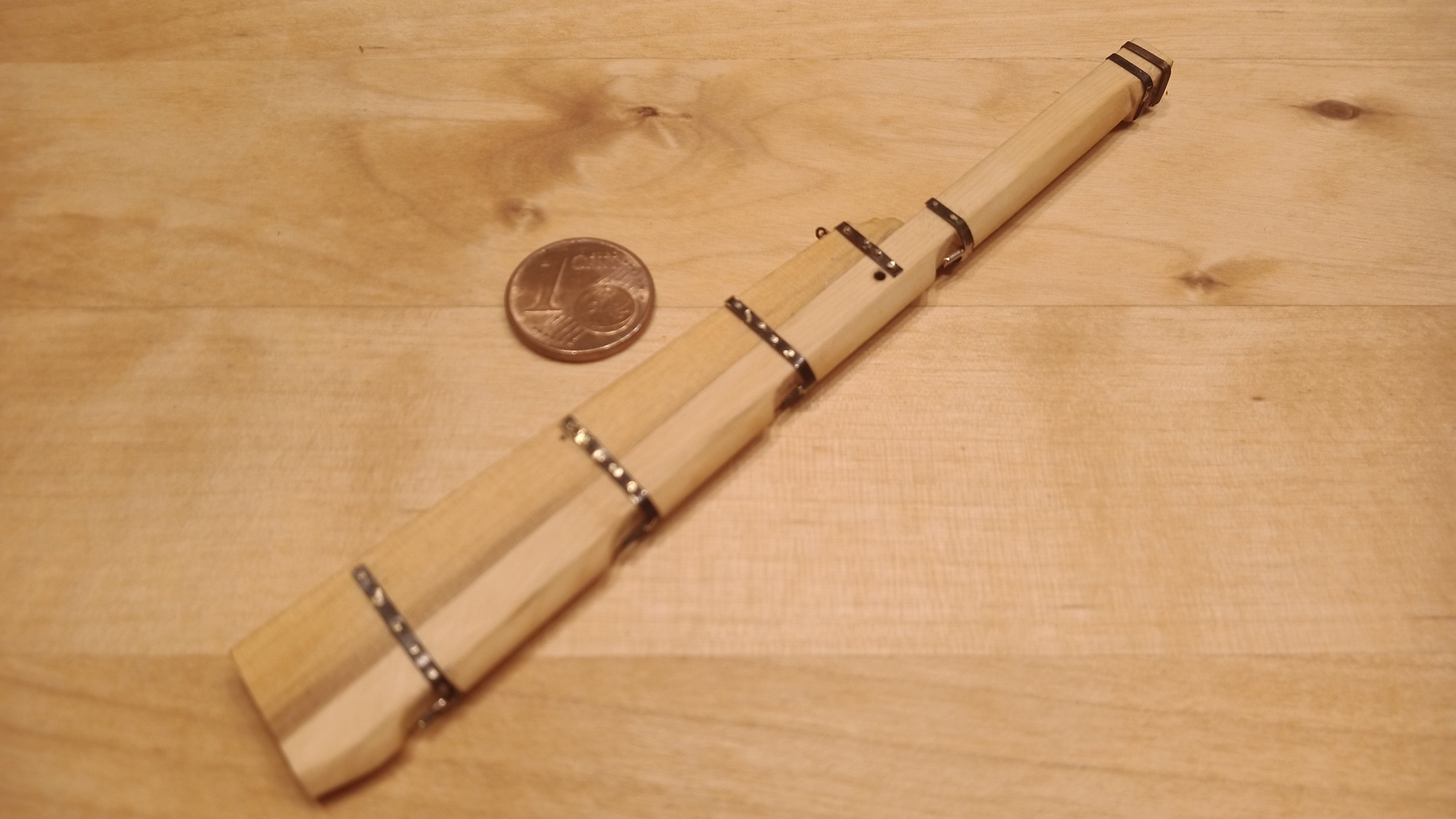

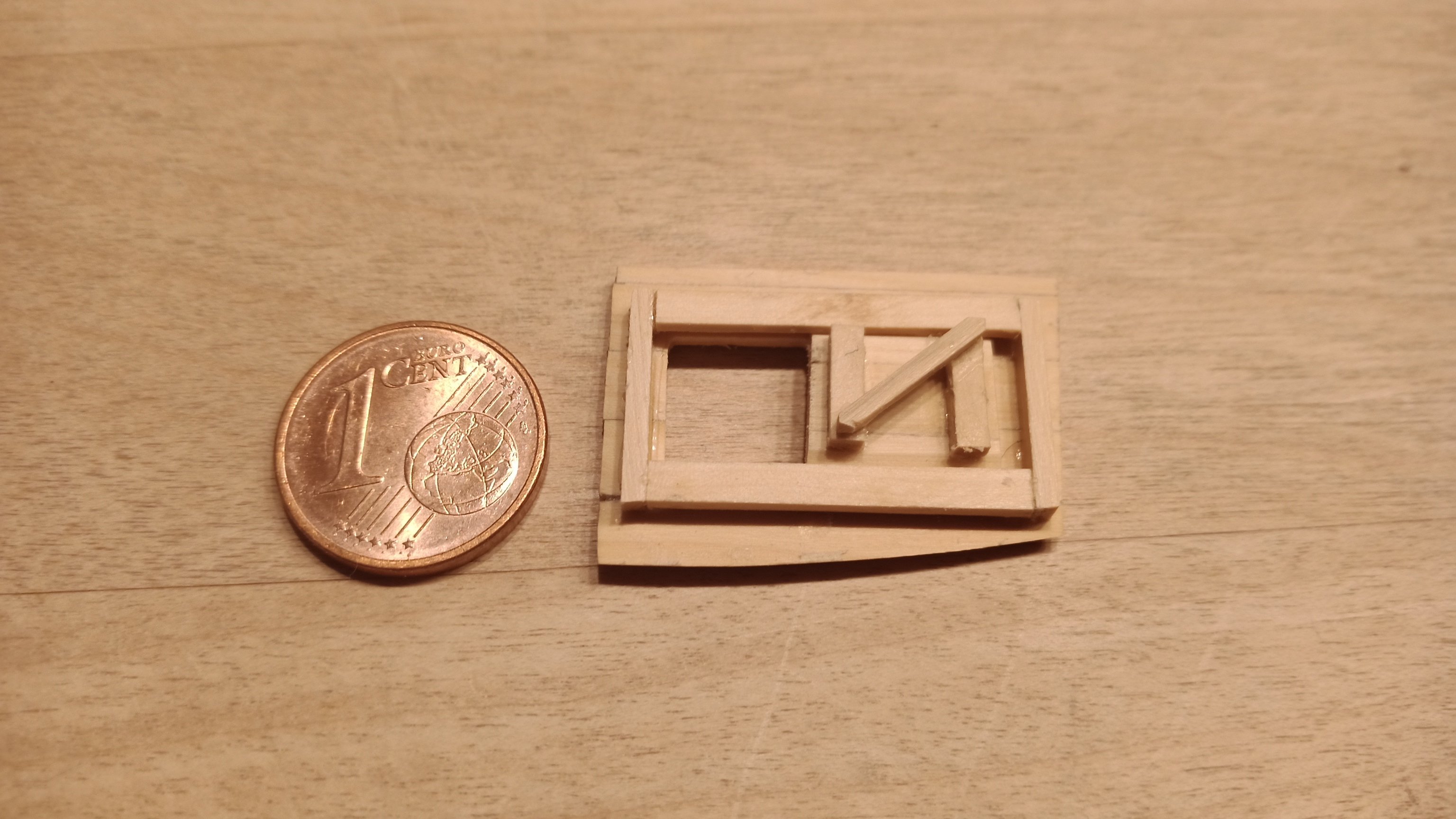

Small progress:

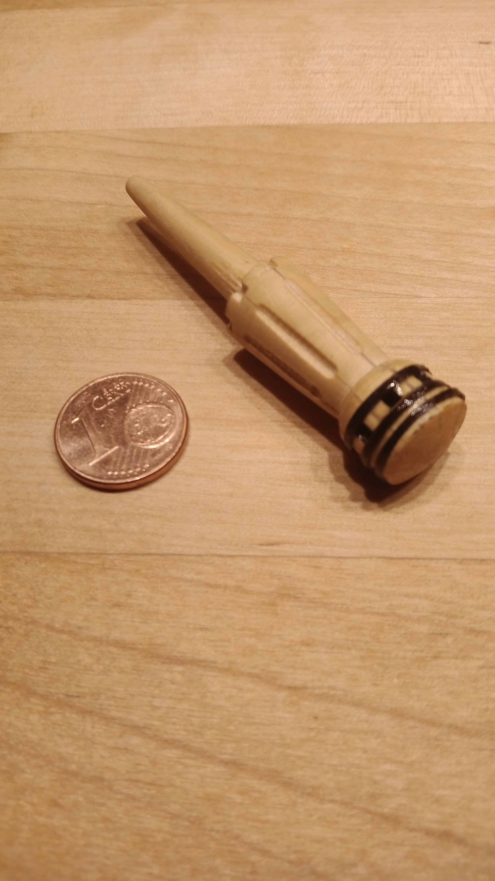

The bumpkins have been made.
Part of the length has an octagonal cross-section. Because these things are very small and curved, and taper towards the end, I couldn't think of a sensible way to machine them precisely and with sharp edges. The first attempt resulted in the area being perceived as more round.
I then used a visual trick by giving the beveled surfaces a slightly concave shape with a ball-end milling cutter.
We'll see if I leave it at that or if I can think of something else to improve them.
I can't install them yet; they would get in the way when lashing down the bowsprit and adjusting the figurehead.

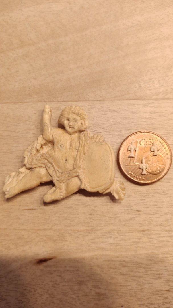

Hello everyone

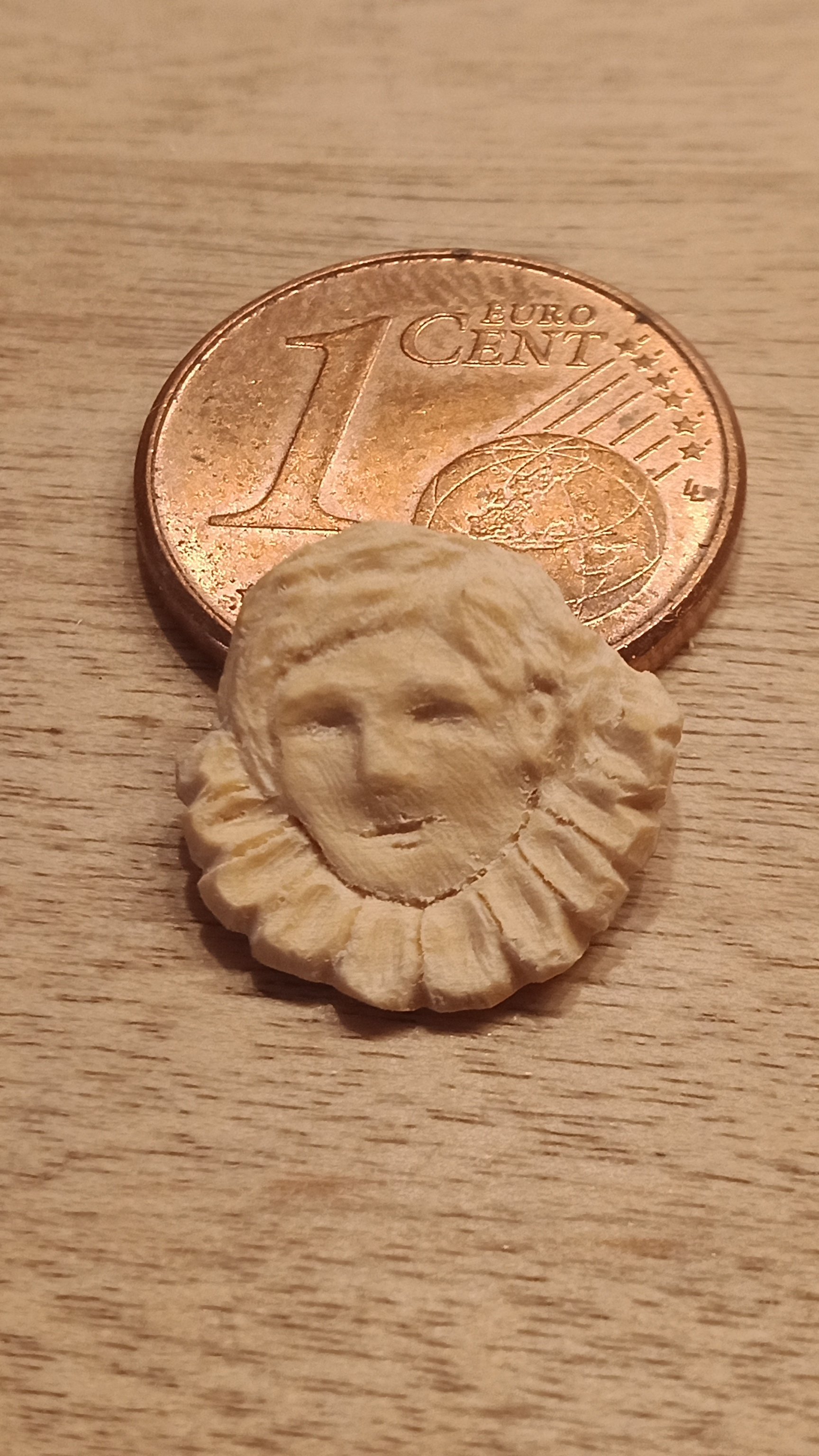

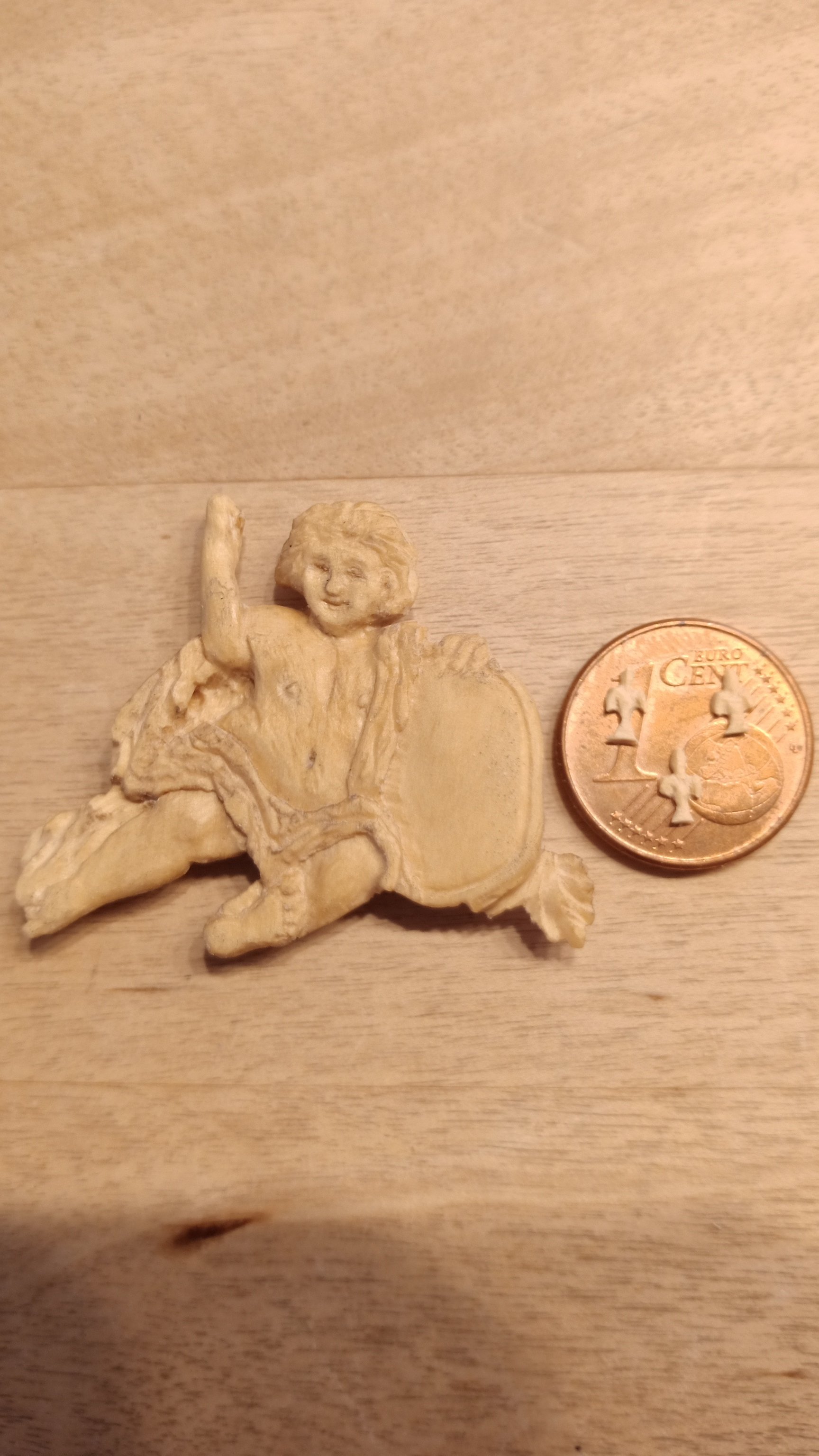

The figurehead:
First, I tried to draw the figure to fit its size and shape.
Here, it fits quite well, but it's looking too downward.
The direction of view is now correct, but a piece is missing at the bottom.
This is ok.
Carving:
still a bit too strong, the lady, too many workouts I guess
I'm still missing a few pieces of cloth that will extend the figure aft, and of course, the little flower it's supposed to hold in its right hand. I'm not sure how to do that yet.
Herzliche Grüße
Willi
Edited by Willi
Hello everyone
For the bouquet, I stripped a low-voltage stranded wire, twisted one end together, unraveled the other, and bent the ends over, then glued pieces of tissue paper over them.
Maybe I'll come up with something better, but for now, I'll leave it as it is.
I'm not entirely happy with the lady's eye area yet, but that's the case with almost all my figures of this type and size: they're too deeply hollowed out. This creates very dark shadows, which, if you look closely, create a zombie-like expression.
This happens when I try too often to correct the facial expression, because this can only be done by removing material.
If the light falls correctly, i.e., without casting shadows, the result is quite okay.
Besides, these strong shadows make the eyes recognizable at normal viewing distances, so they're okay.

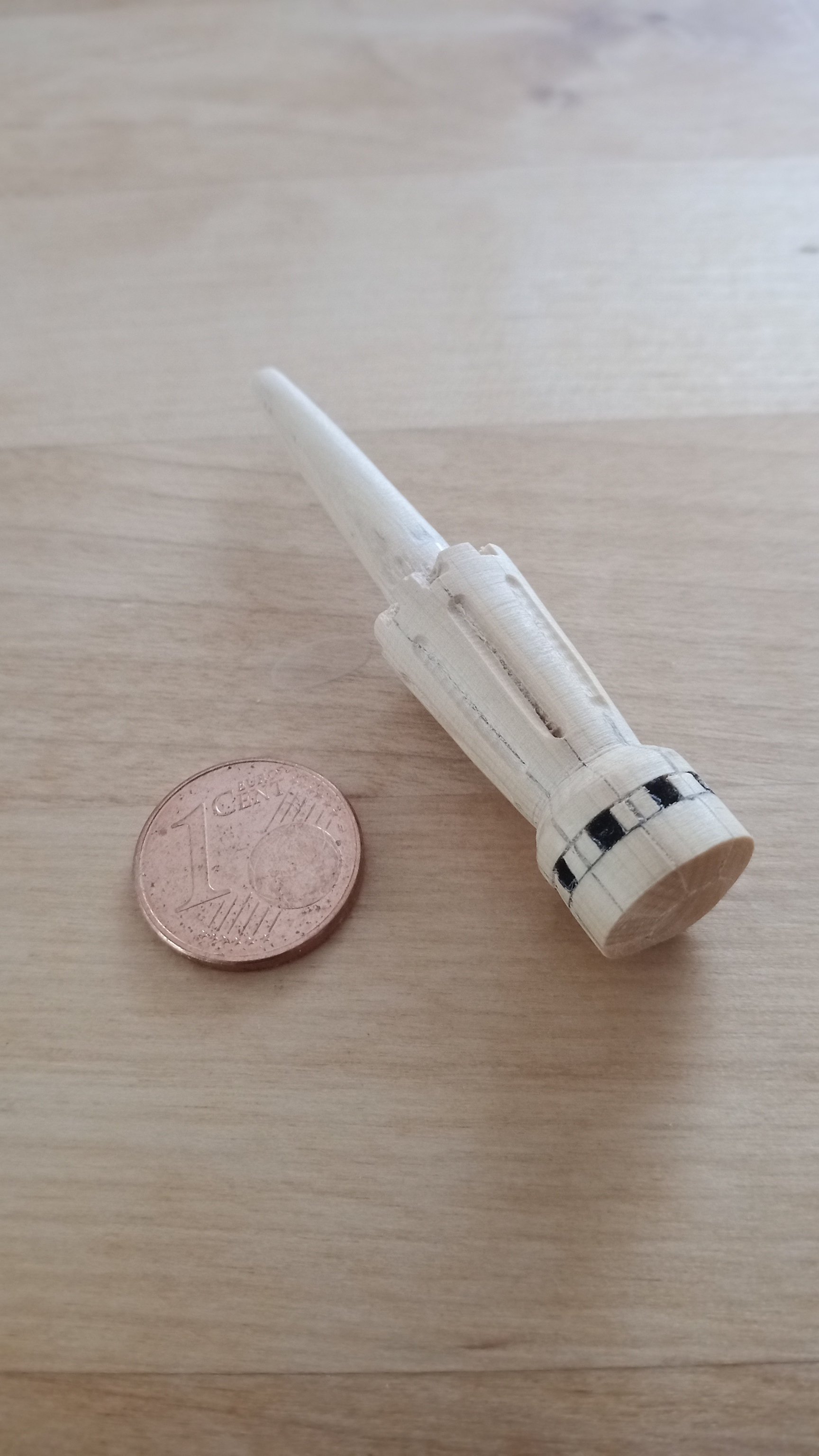

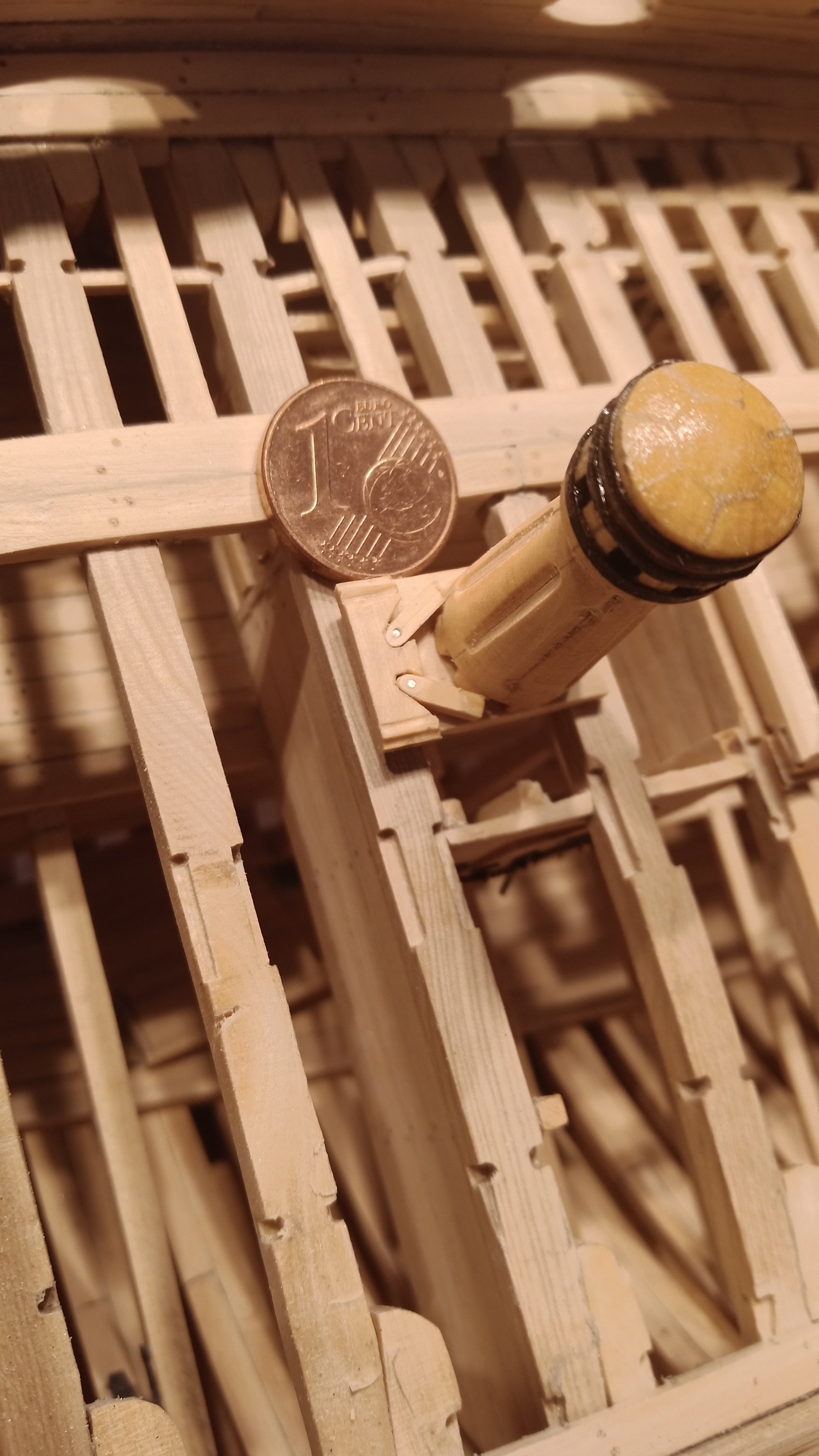

Hello everyone

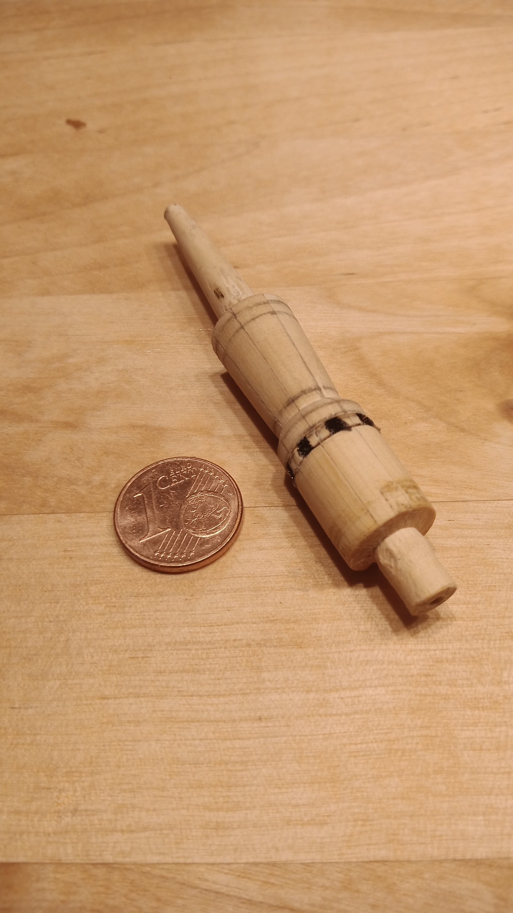

After a short vacation, I continued with the anchors for my small corvette.
These were made of ebony and boxwood. Only the anchor flukes and the ring are made of brass.
The correct covering of the anchor ring (called: puddening) was particularly important to me. It was already discussed here (page 8 of the document): anchor ring
Often it is done as shown in the following picture on the left. However, this leads to the covering being pushed apart by the lashing ring.
So I tried to do it as shown in the picture on the right. Here, the ropes of the covering are at a better angle to the lashing ring and are held better by it.
I'm not entirely satisfied with the result, but at these sizes I'm reaching the limits of my abilities even though this is the corvette's largest anchor. I'll probably use the simpler method (as shown in the sketch on the left) for covering the rings of the smaller anchors.
In this picture, you can see the pattern of the clothing a little better. Sorry, but photography isn't my strong suit.
Here you can see the smaller anchor:
