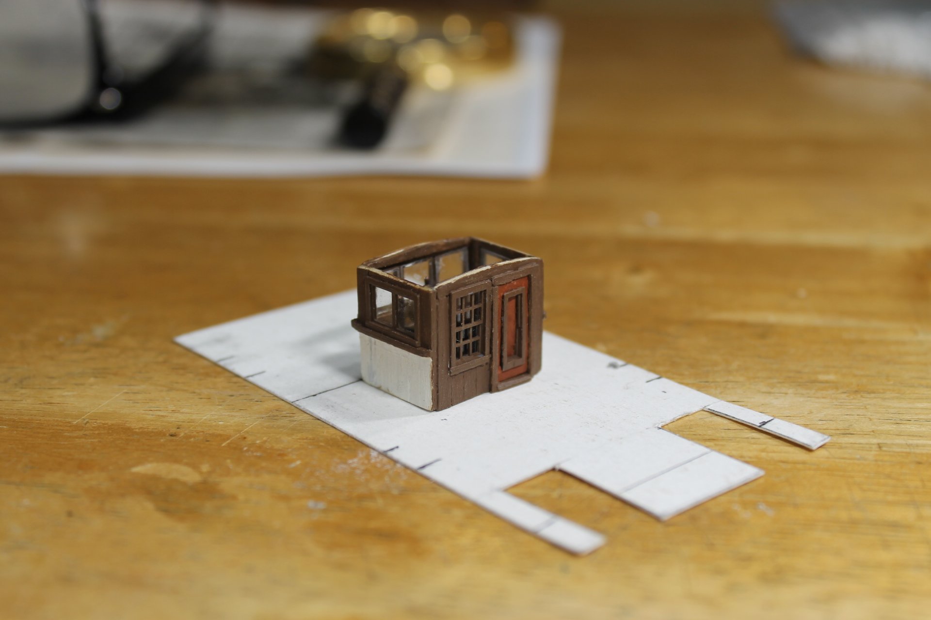

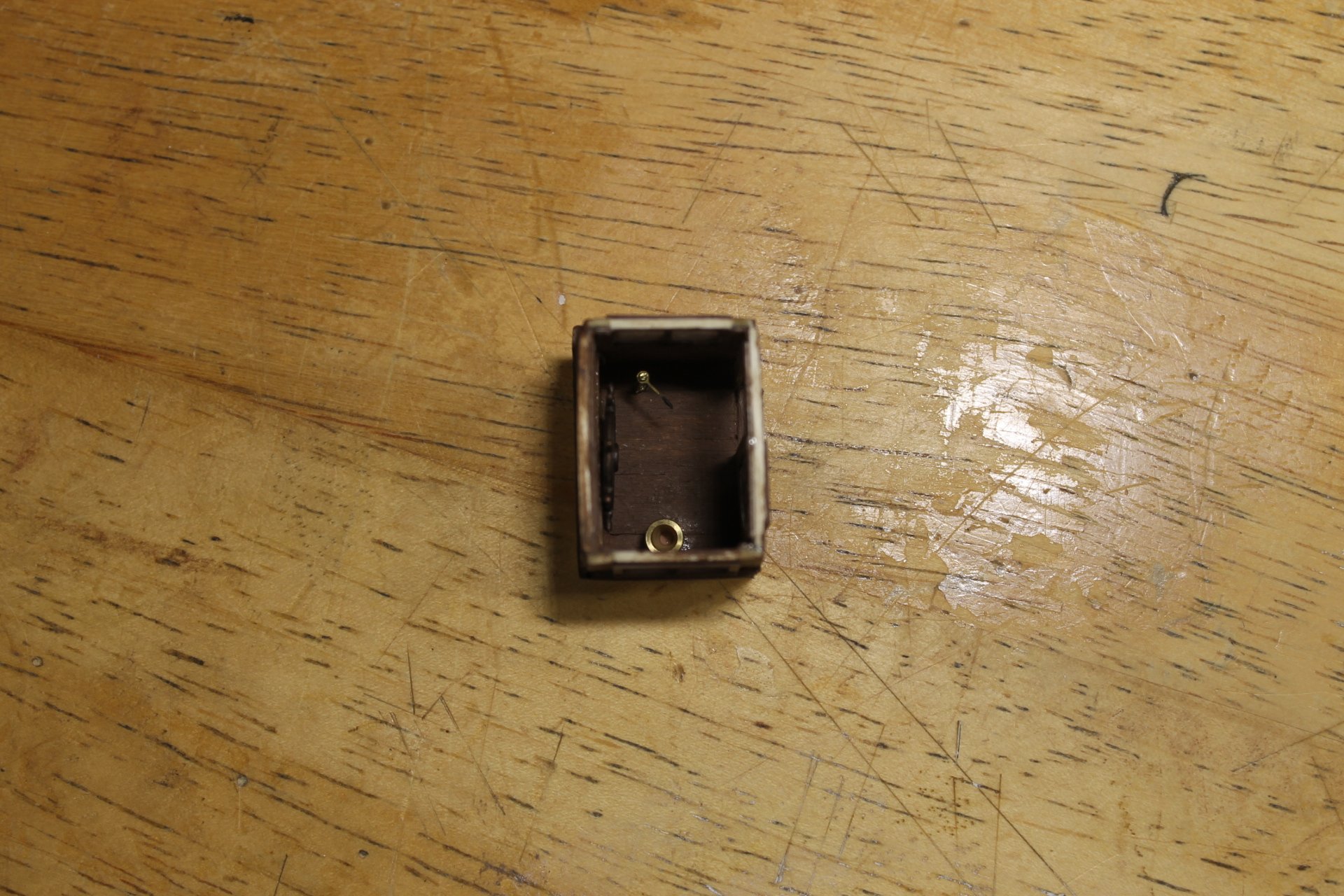

I'm almost done with the pilothouse. All that remains is the roof and the mystery object on top.
 On the inside I added the ship's wheel, my signature control arm, and a spittoon. Sorry, Bob, no whisky barrel. :)
 The windows are glazed and the floor I almost forgot is in.

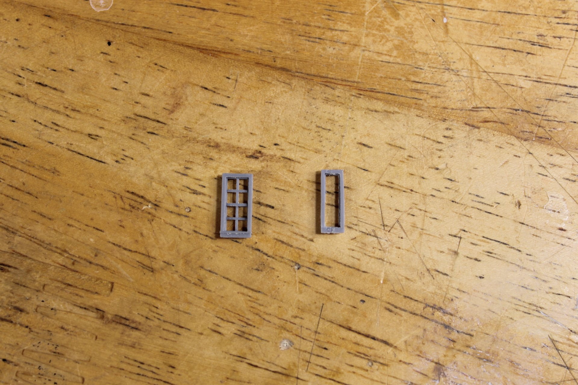

 Which left the door. Looking at the press photo the PH door is the most elaborate piece of woodwork on Billy. It's pretty danged fancy for a sternwheeler especially Billy. I'm sure it was from one of the buildings Engel salvaged to build Billy. It had fancy trim, panel, and appears to have bene painted/stained two different colors.
 The doors in my other builds have been simple utilitarian and left open where one could see inside. I choose to keep the door closed as it is in the photo.
 I used one of my spare windows for the trim by removing stiles and rails and narrowing to fit the door.
 I painted it in two colors and the jury is out. After living with this a couple of hours I think it would look better if was just the single brown color. What the door in the photo lacked was a doorknob which I thought strange but then I realized. this is Billy. :)
 Thank you for your support and for following along.
   Keith

 I'm leaving the door as is for the time being, the brown grew on me maybe the door color will to. I've added a bit of weathering and will probably revisit weathering once the PH is attached.
 And with that done, it's on to the hull.
