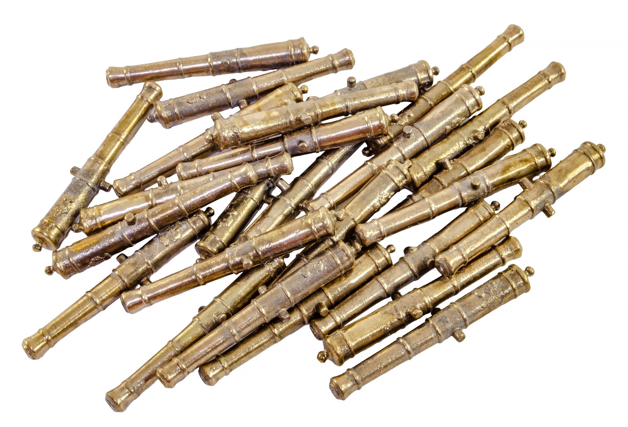

  • Guns, anchor, rudder hinge, brass casting, and many more metal fittings
  • All laser-cut wooden sheets with quality wood ( minimal colour variation)
  • POF kit, many high accurate ribs
  • 8 pound class artillery * 26
  • 4 pound class artillery  * 4

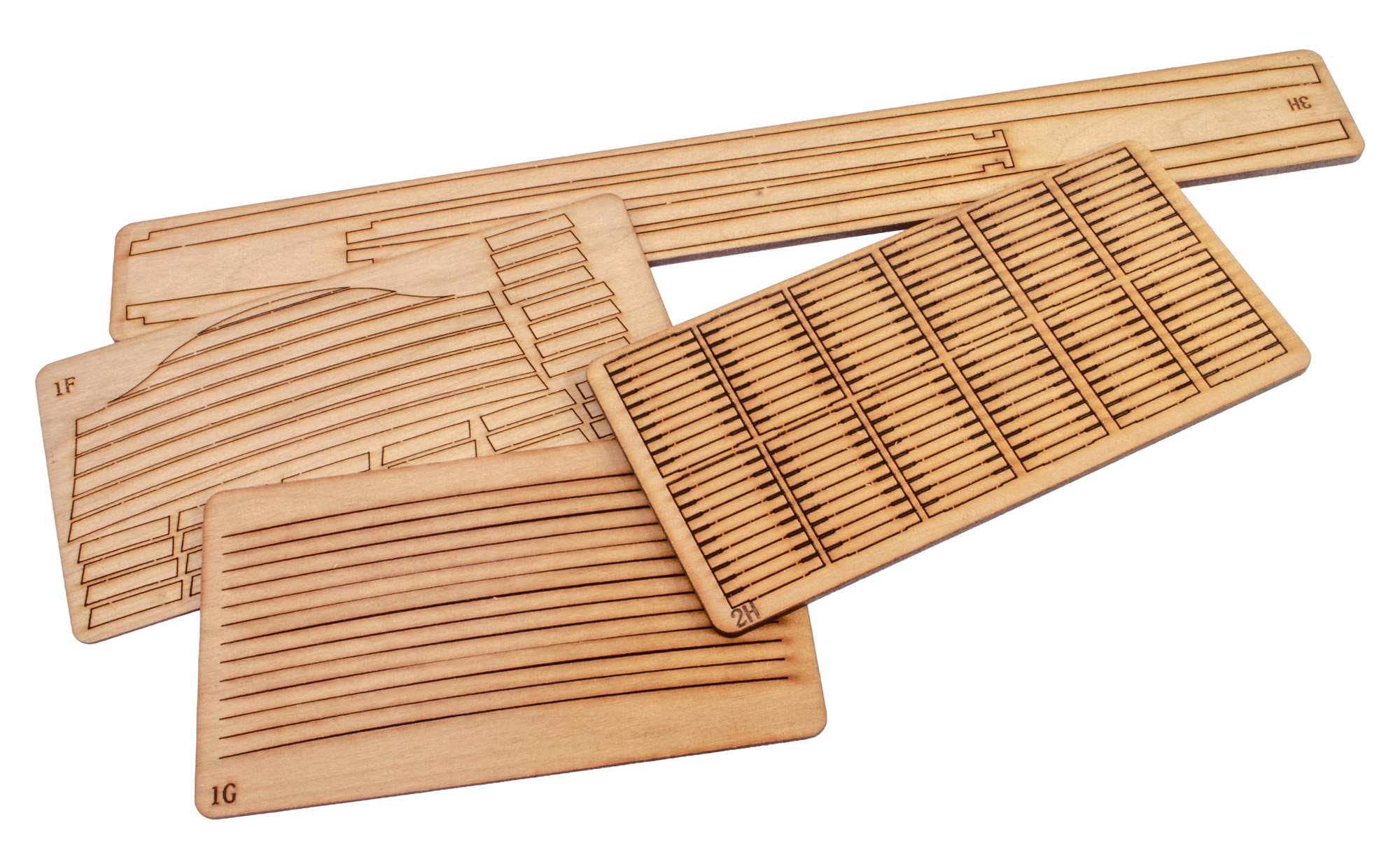

PART 1

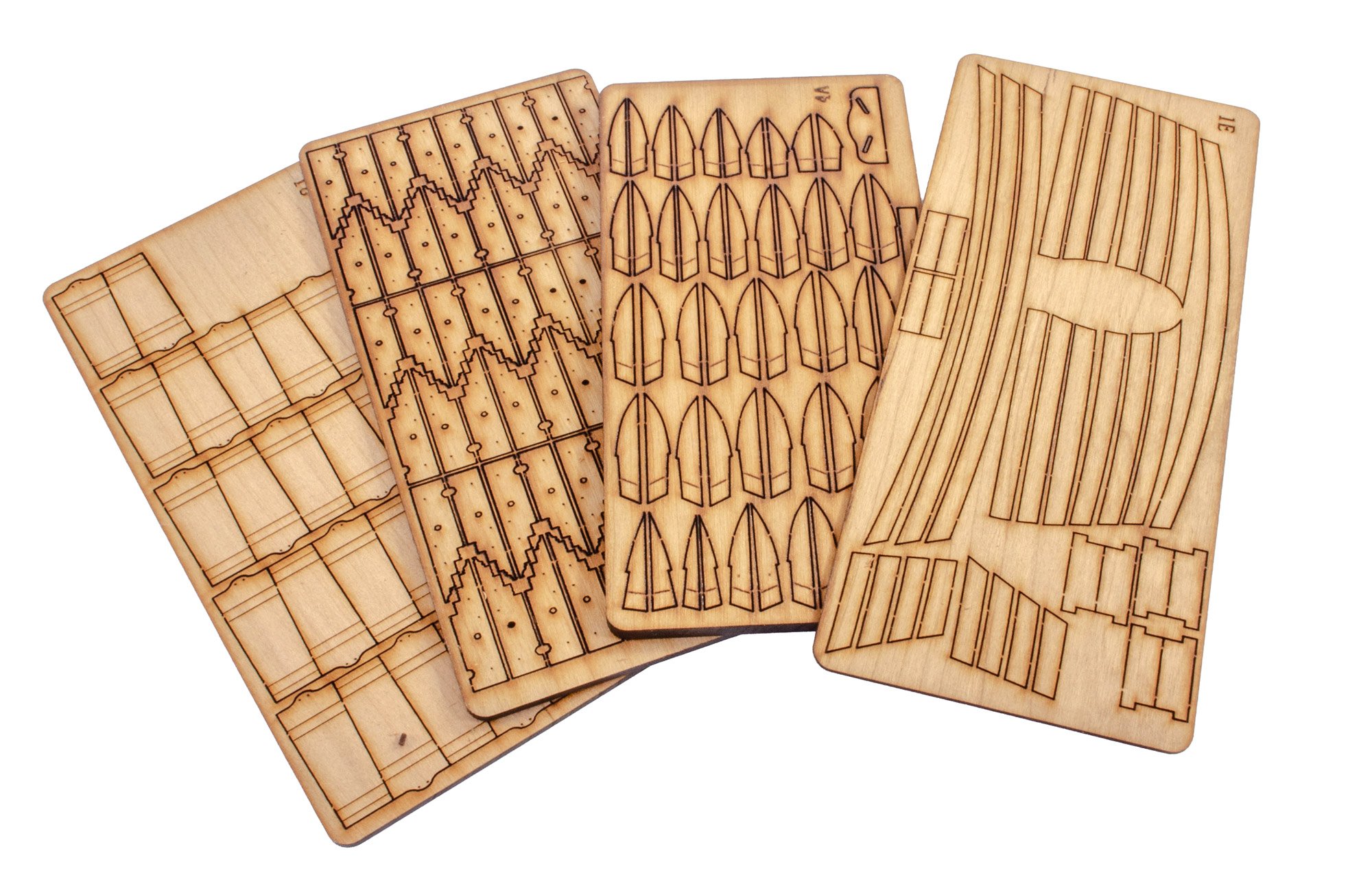

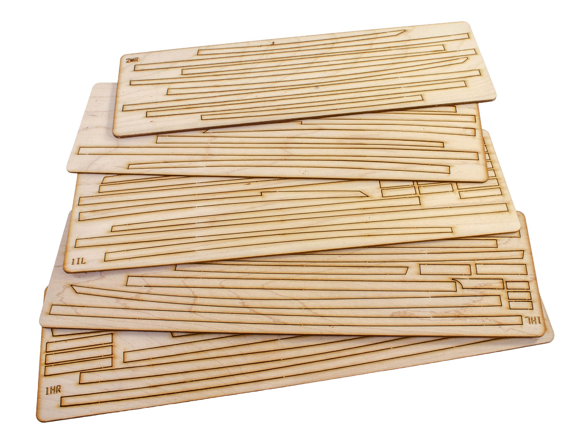

Like the first sets in the La Renommée series, this contains many sheets (cherry wood) or frame parts. All sheets are laser cut and contain engraved lines which help with alignment and bevelling. There is some char/resin residue on the rear of the sheets, but this easily comes away with some minor sanding. Pack 1 contains three wrapped packets of parts. Numbering on these is shown in the manual, with each sheet having a reference number. There are no metal parts or fittings in this pack. All of this will come later.
Instructions
The instruction booklet for this part is minimal as it merely shows the sheets and how the frames are built. There is also a large sheet over which the frames are assembled. Just remember to use some cellophane as a barrier so the parts don't stick to it.

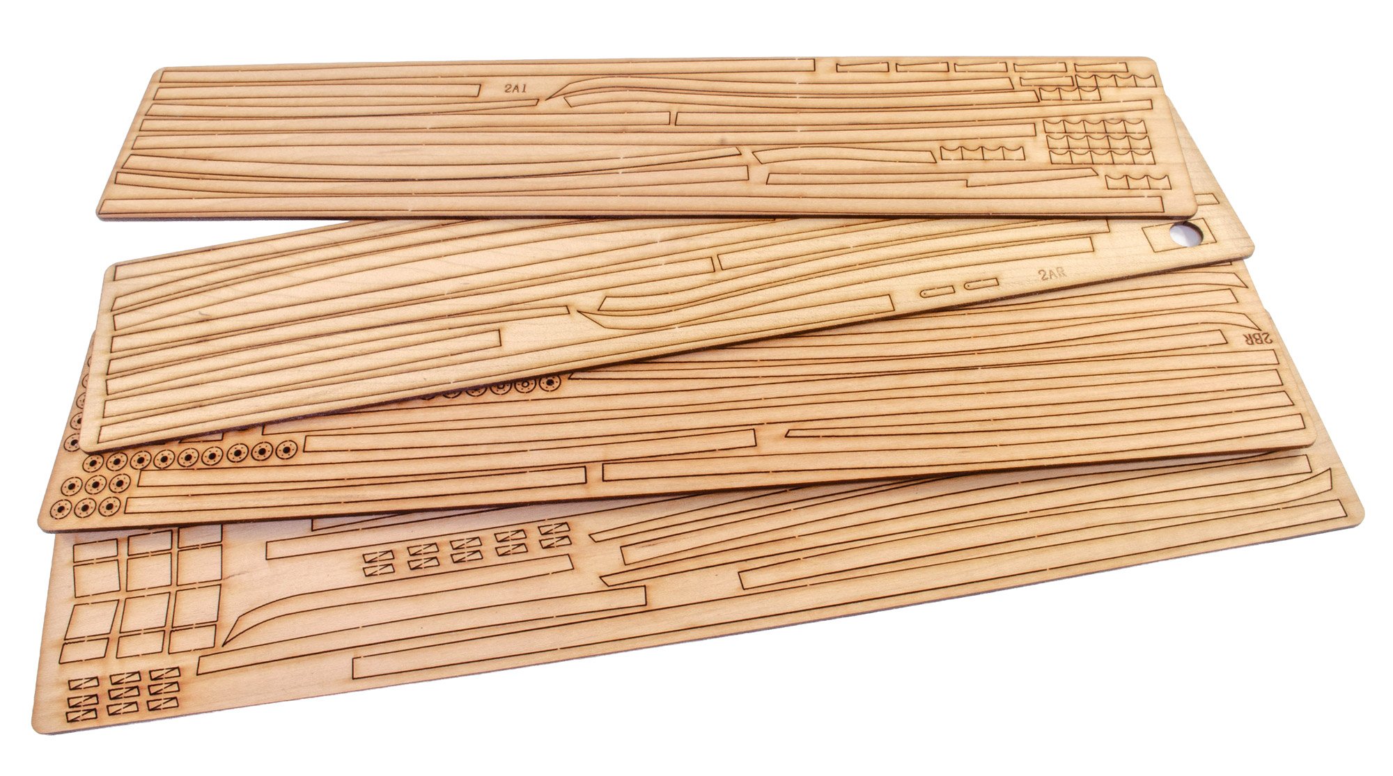

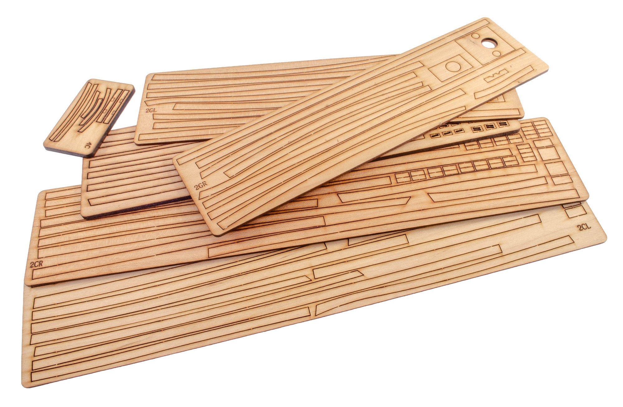

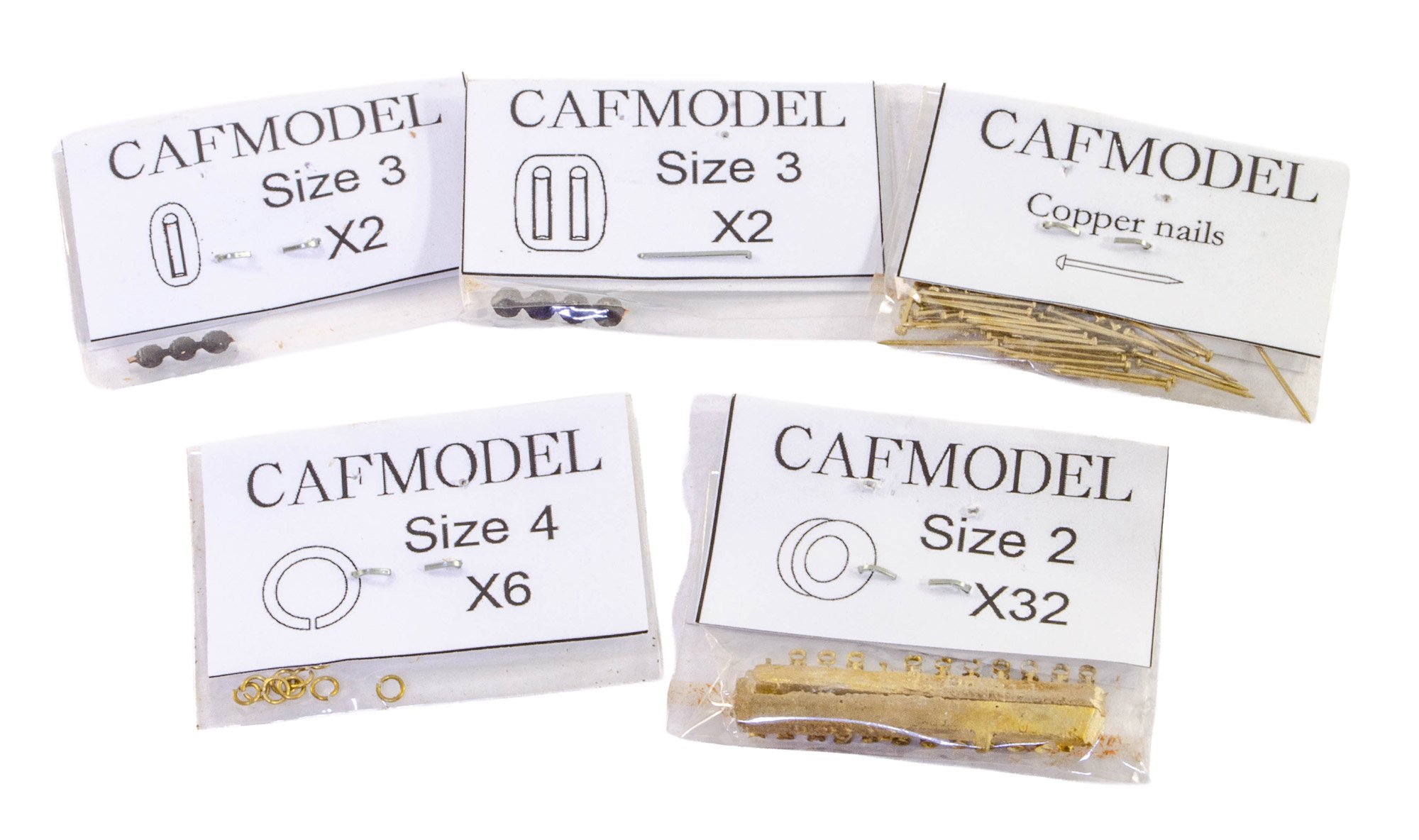

PART 2
This pack is largely similar to the previous, except a plywood jig is included for the modeller to build the bow frames around. At this stage, there's still no cradle as we are concerned with the building of those many frames. All parts are packed into a single cellophane wrap. After unpacking and photographing, tape was used to re-bind the parts to prevent any twist until I come to build the model.
Instructions
This is very similar to Pack 1, except the bow jig is illustrated. This looks very simple to build. Again, a full size sheet is included over which to build the numerous hull frames.

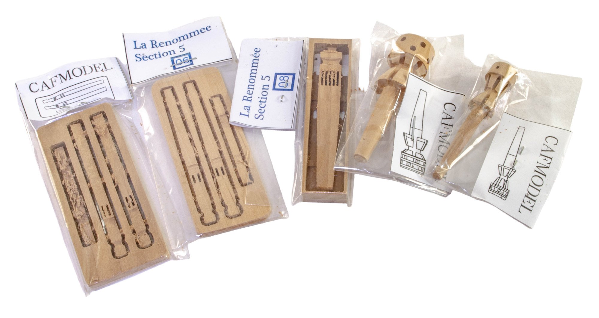

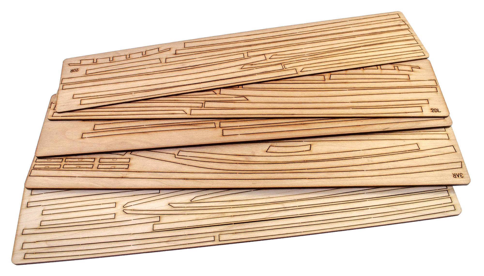

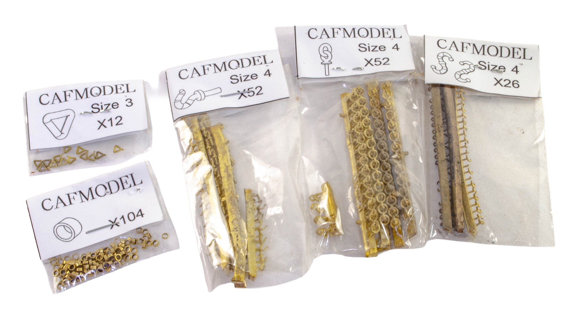

PART 3
This is beginning to look all too familiar...but WAIT! We now also have parts for the hull jig! Not all though, as some are also supplied in the next pack, but at least you get a good start in getting that very large construction underway. As you'd expect, the cradle is constructed from laser-cut plywood.
All parts in this pack are sealed in a single cellophane wrap. As well as more framing and that cradle, there are also two small frames containing CNC machined parts which relate to the stern of La Renommée. These just want freeing up and carefully sanding smooth.

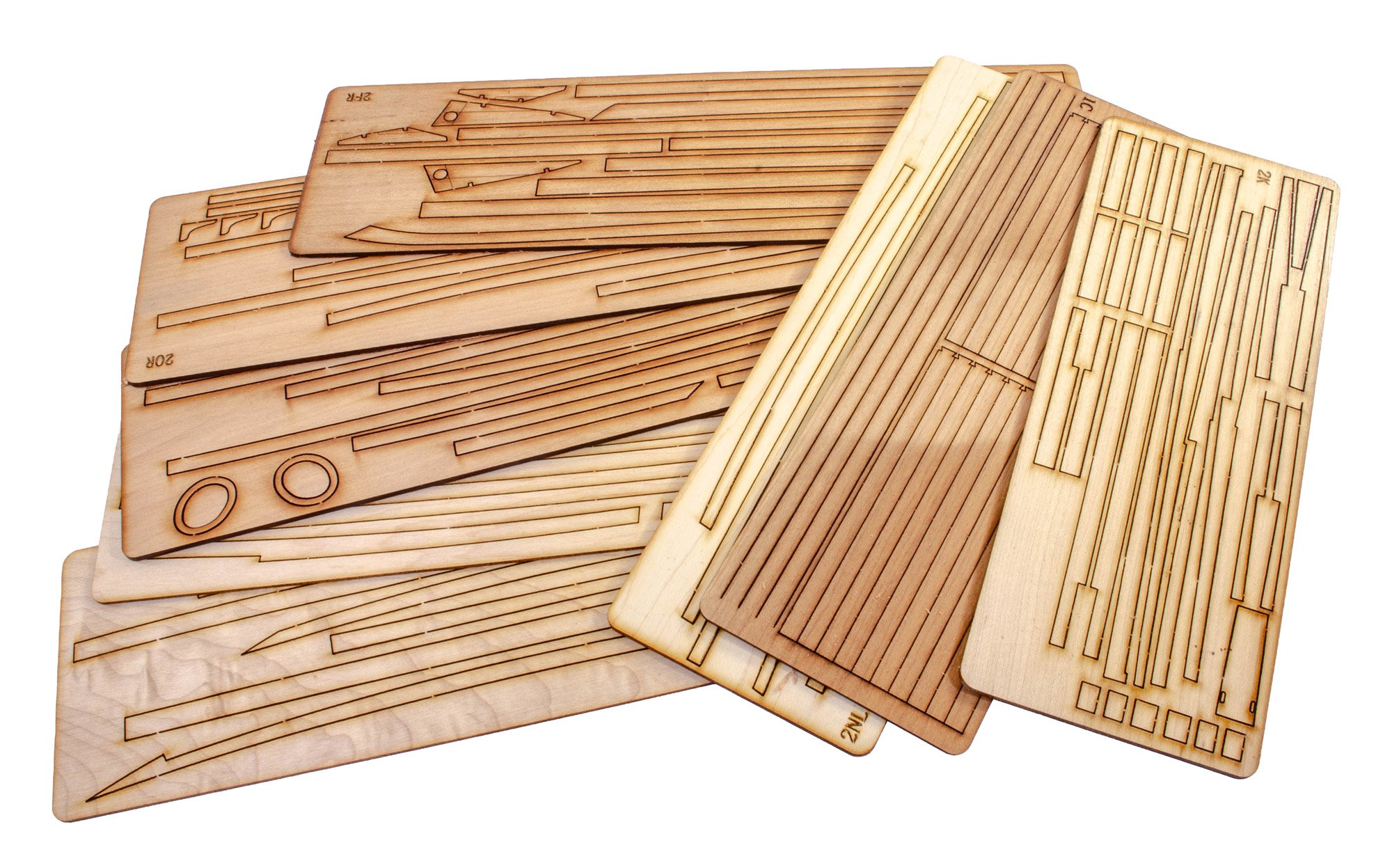

PART 4

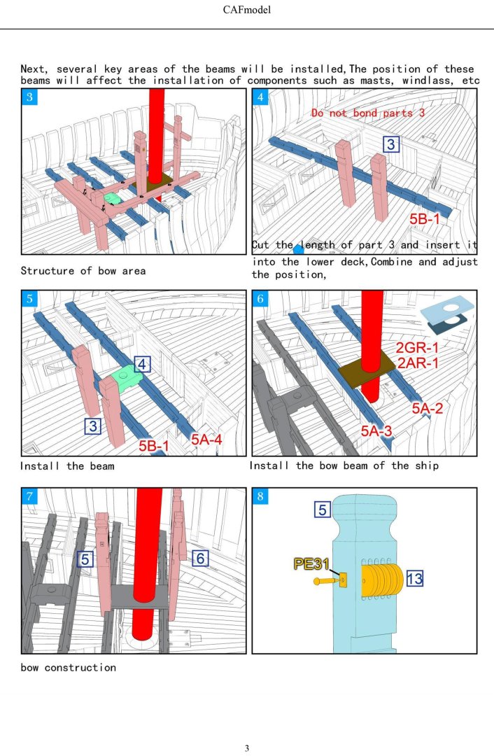

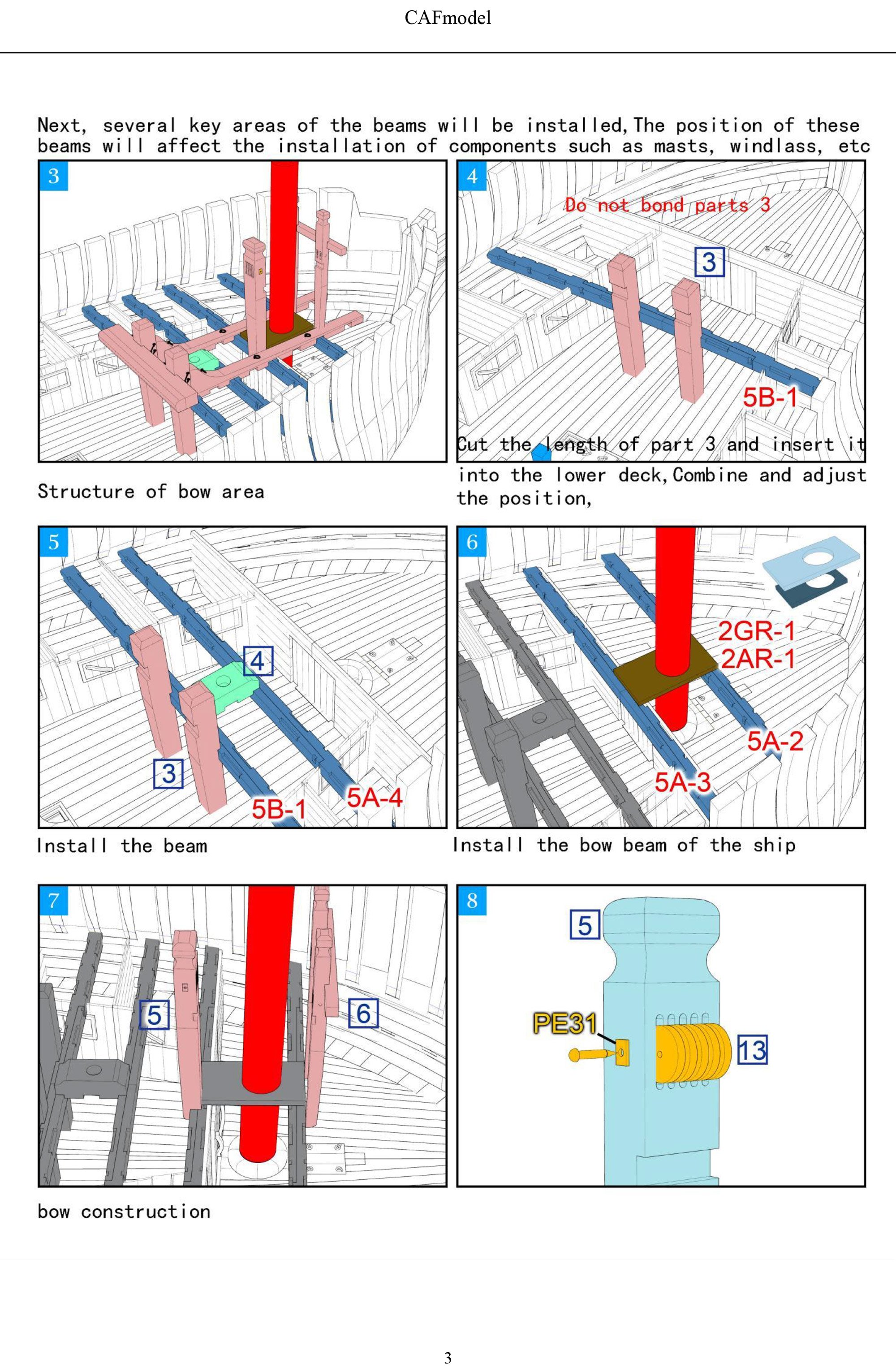

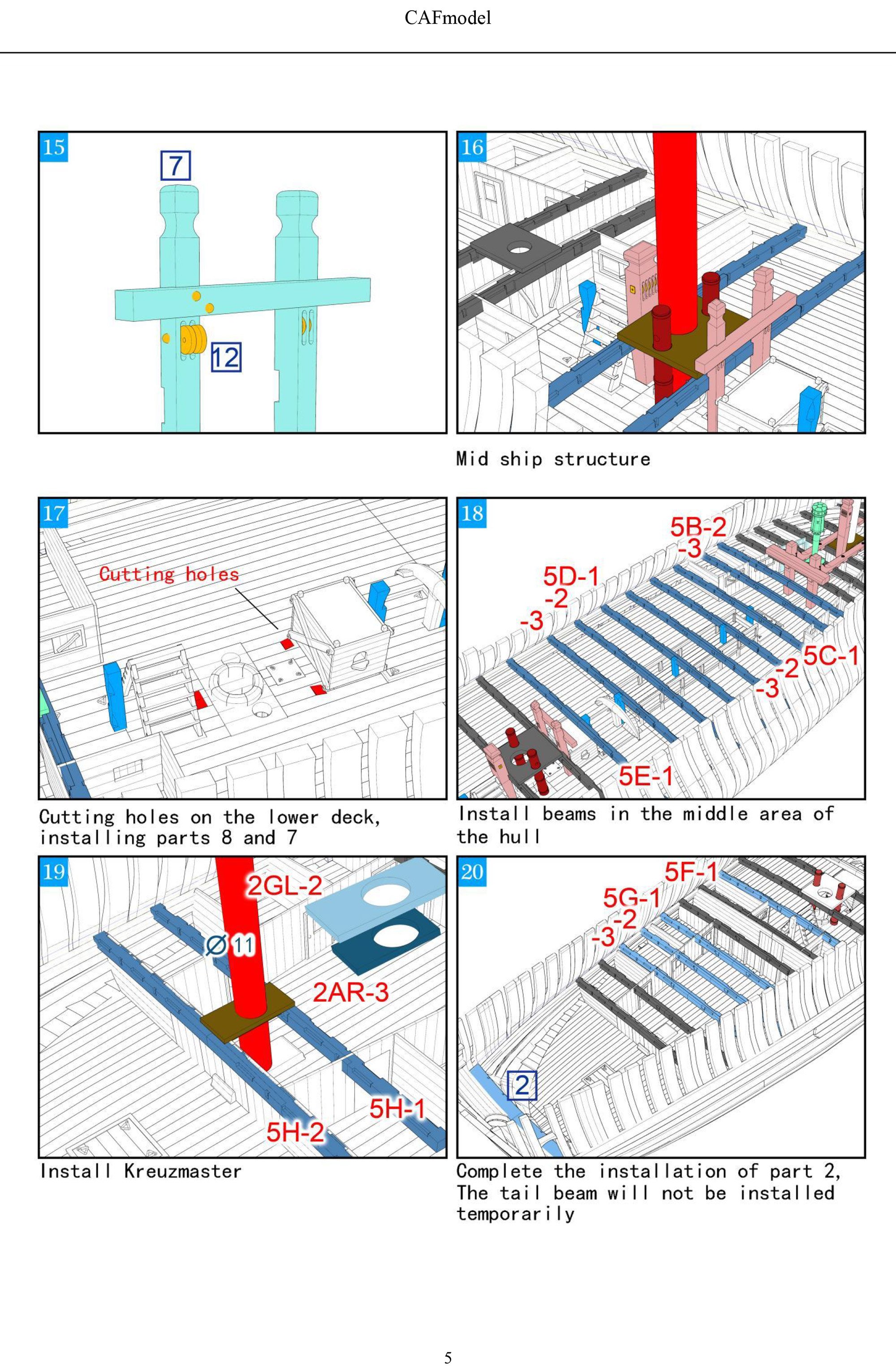

This pack is very similar to the previous in that it contains more framings, but also the keel, meaning that the hull really can now start to be assembled. Everything is packed into a single cellophane wrap as before. We've also been given more CNC-machined parts. It's quite unusual to split that large cradle into more than one pack, and not to have that as the initial box too.
Instructions
If you'd like to see the whole instructions for this and how these first four parts come together, then they are available directly from the product page. Please check them out and if you're already tempted by this release, please tell Tom you've been following this topic.

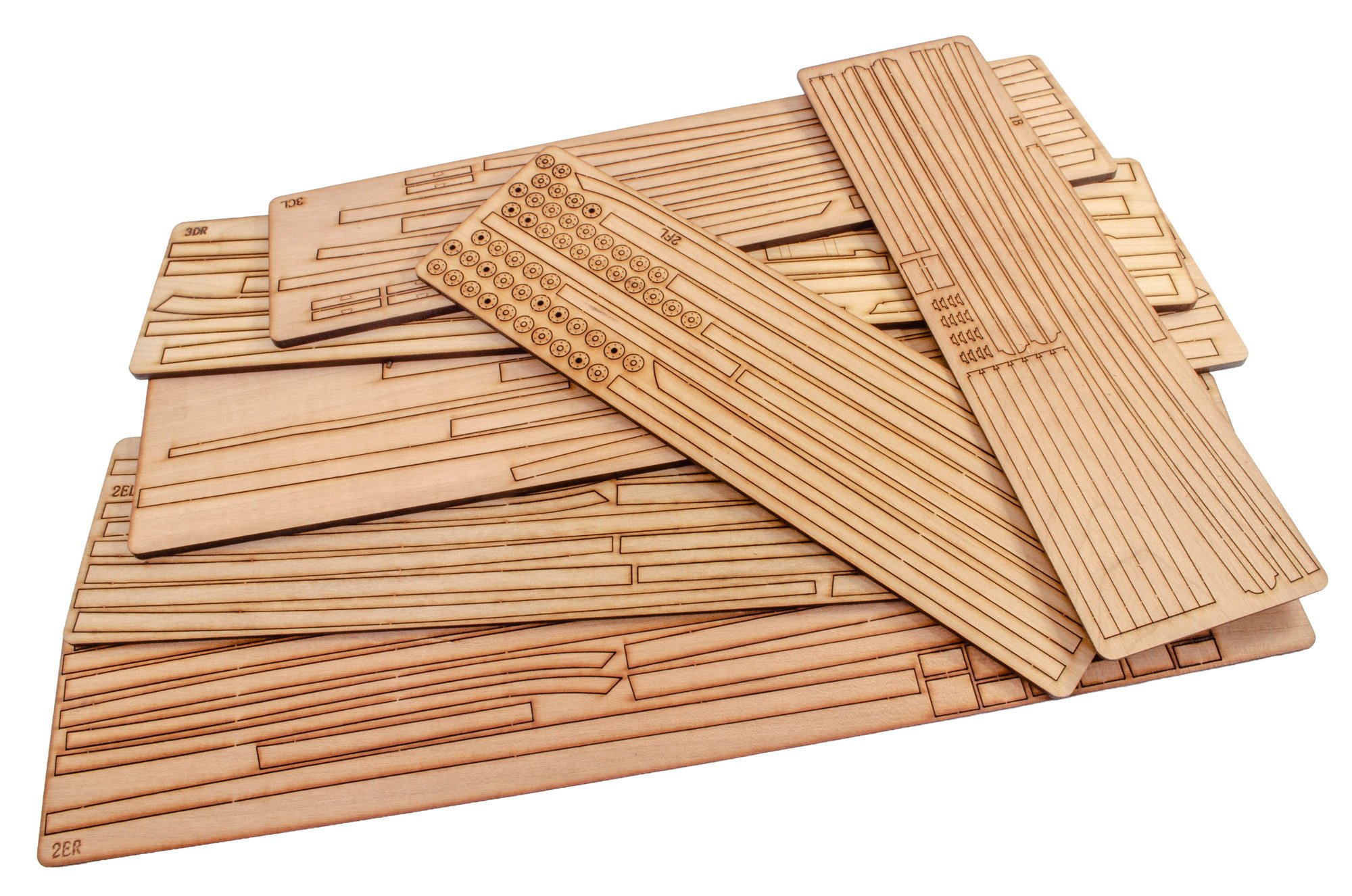

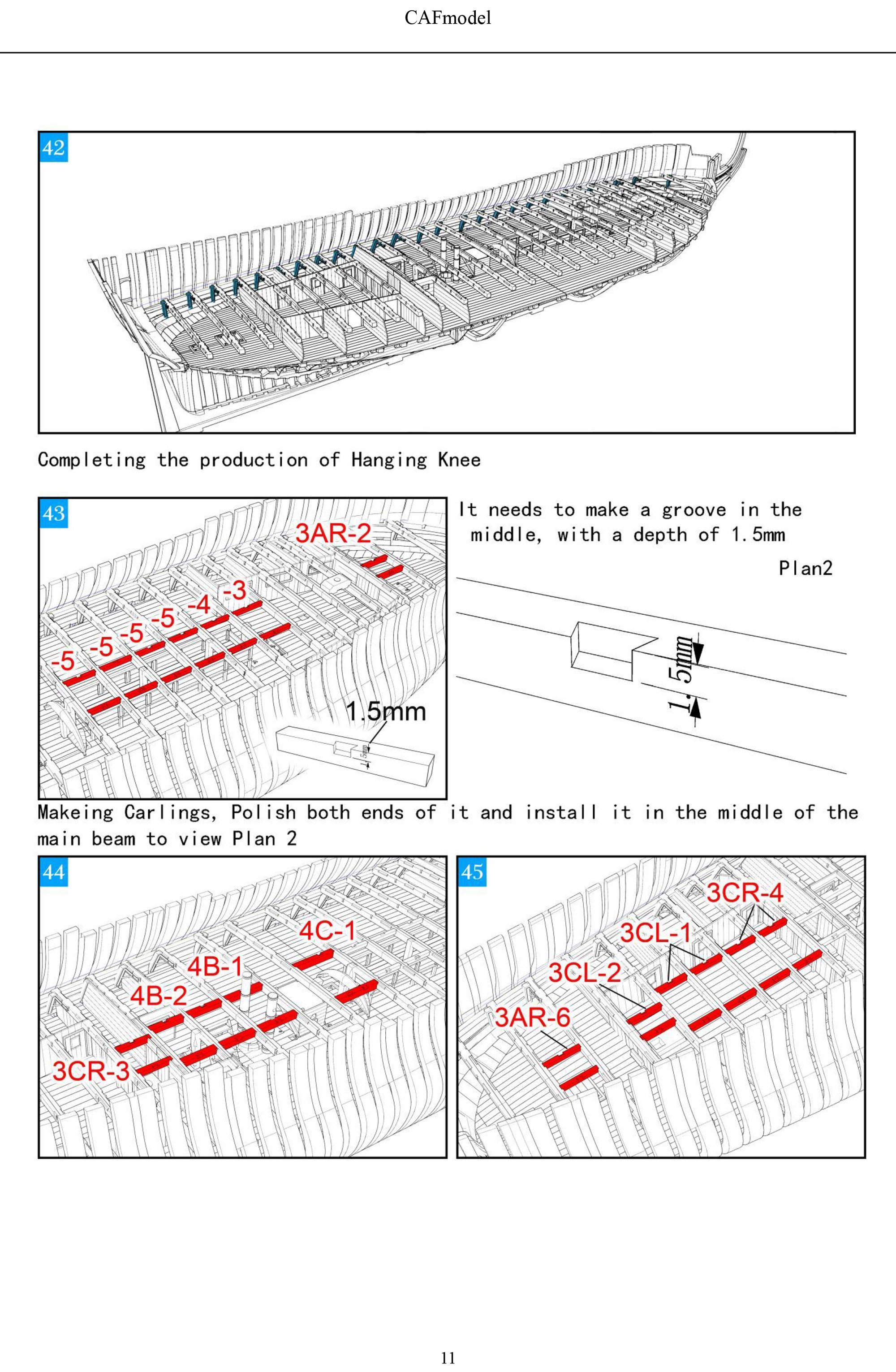

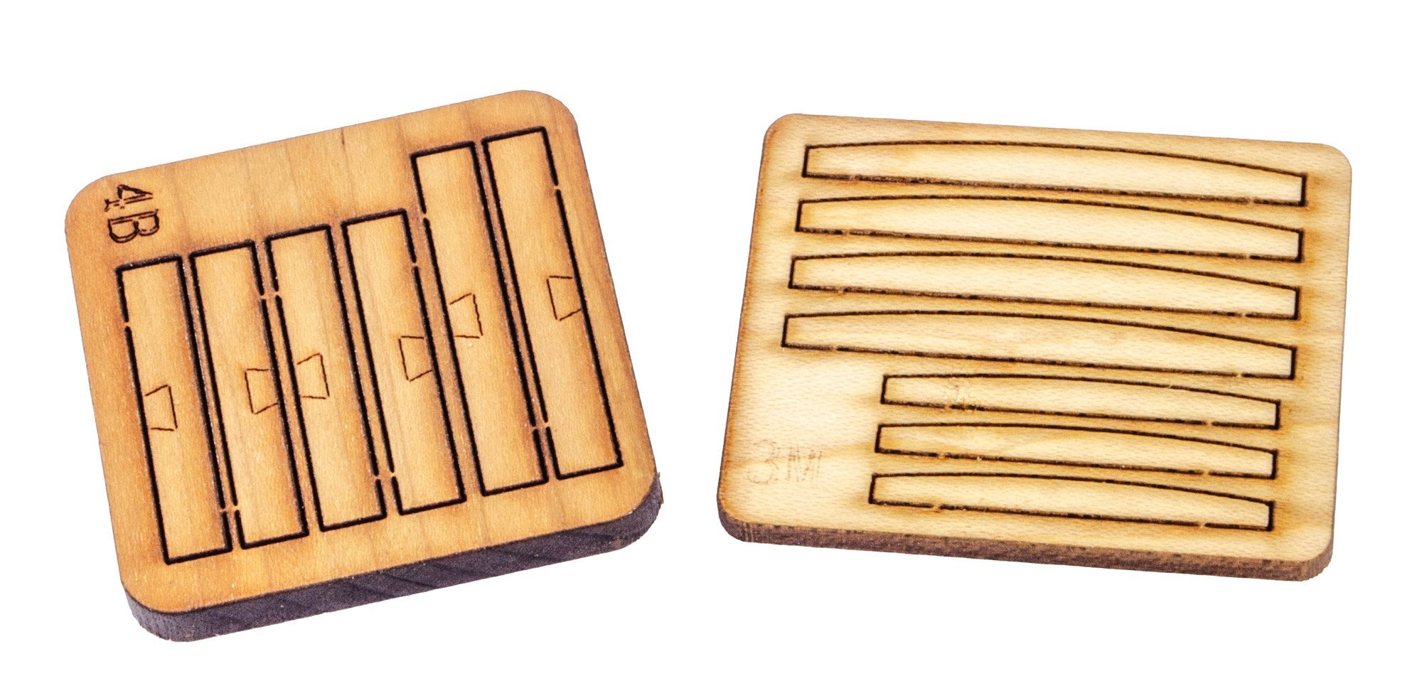

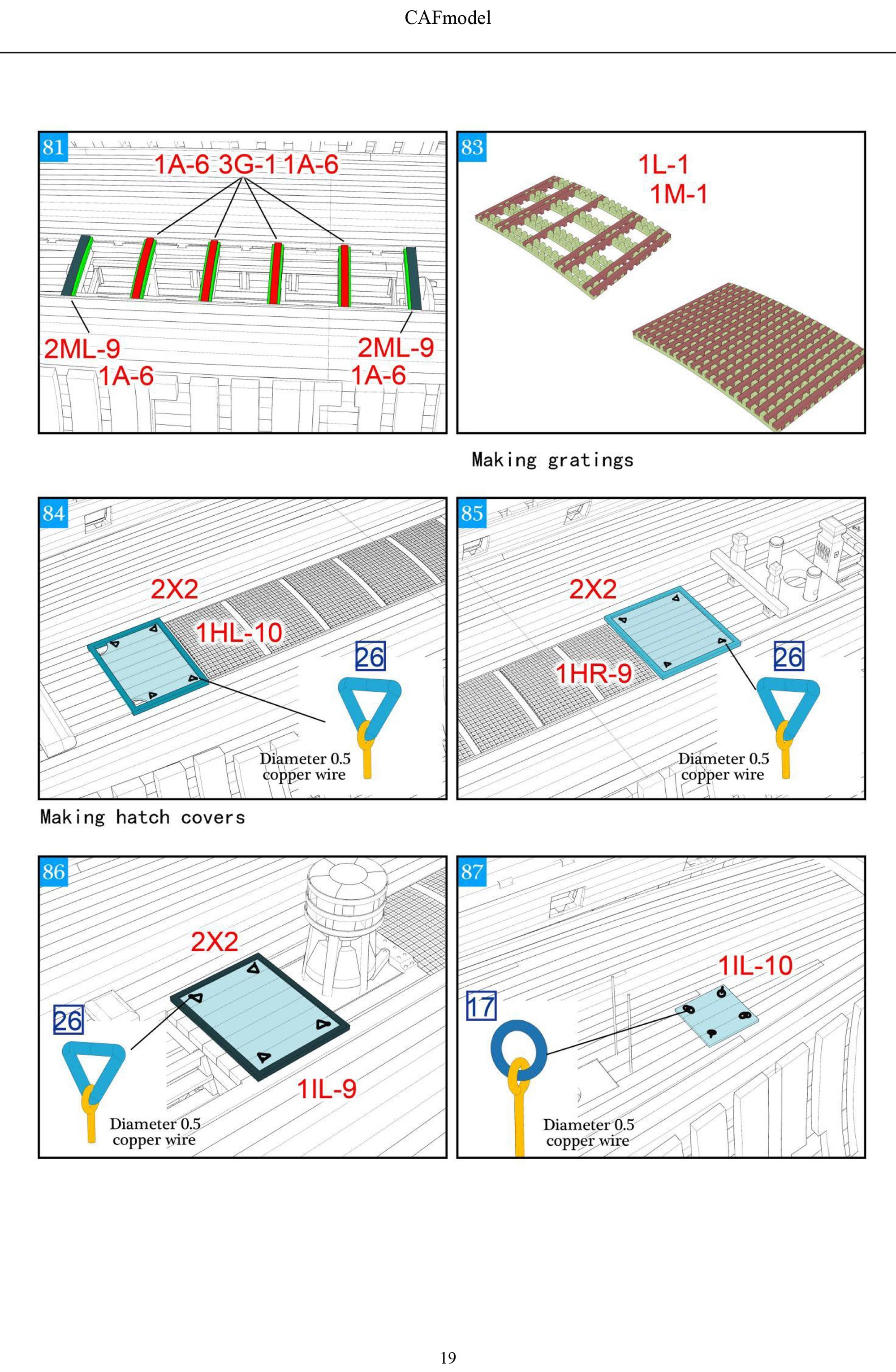

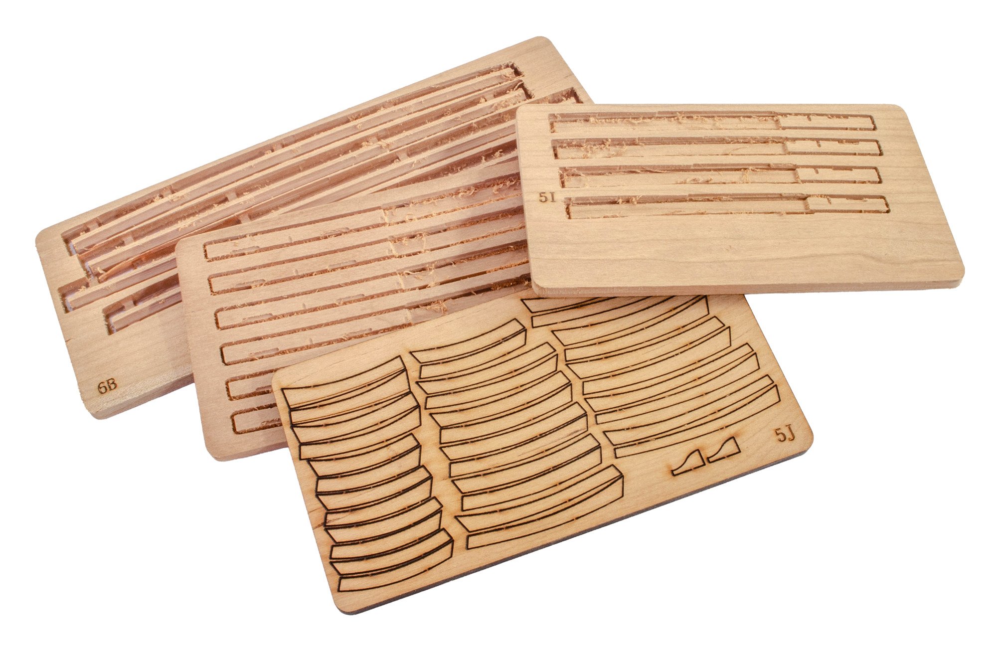

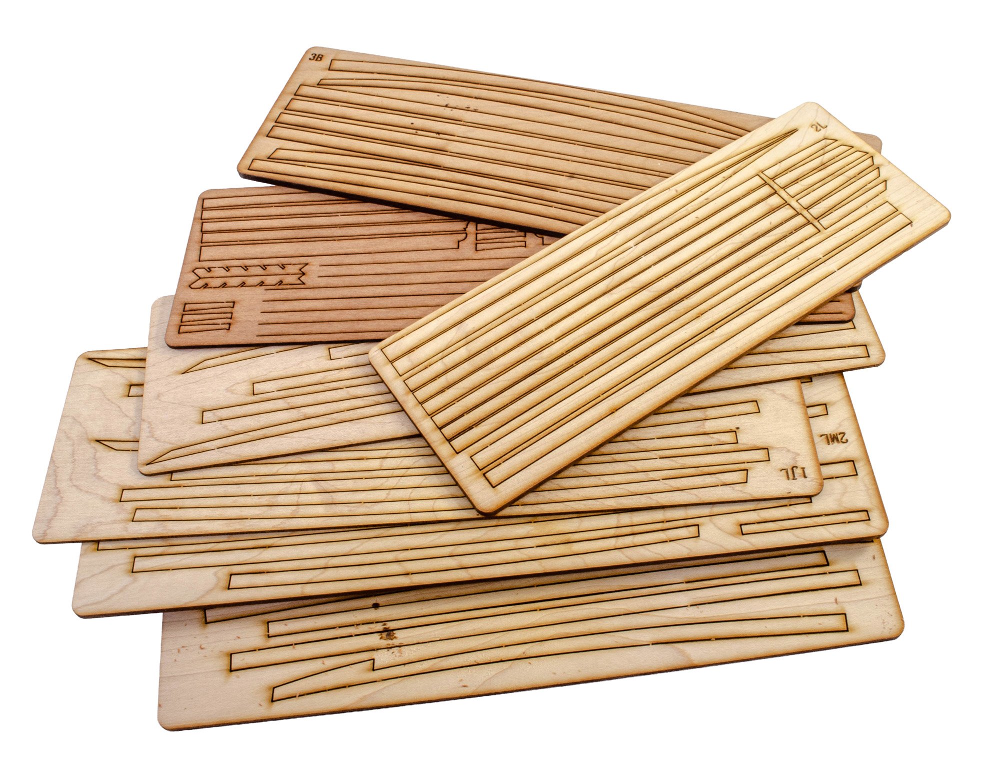

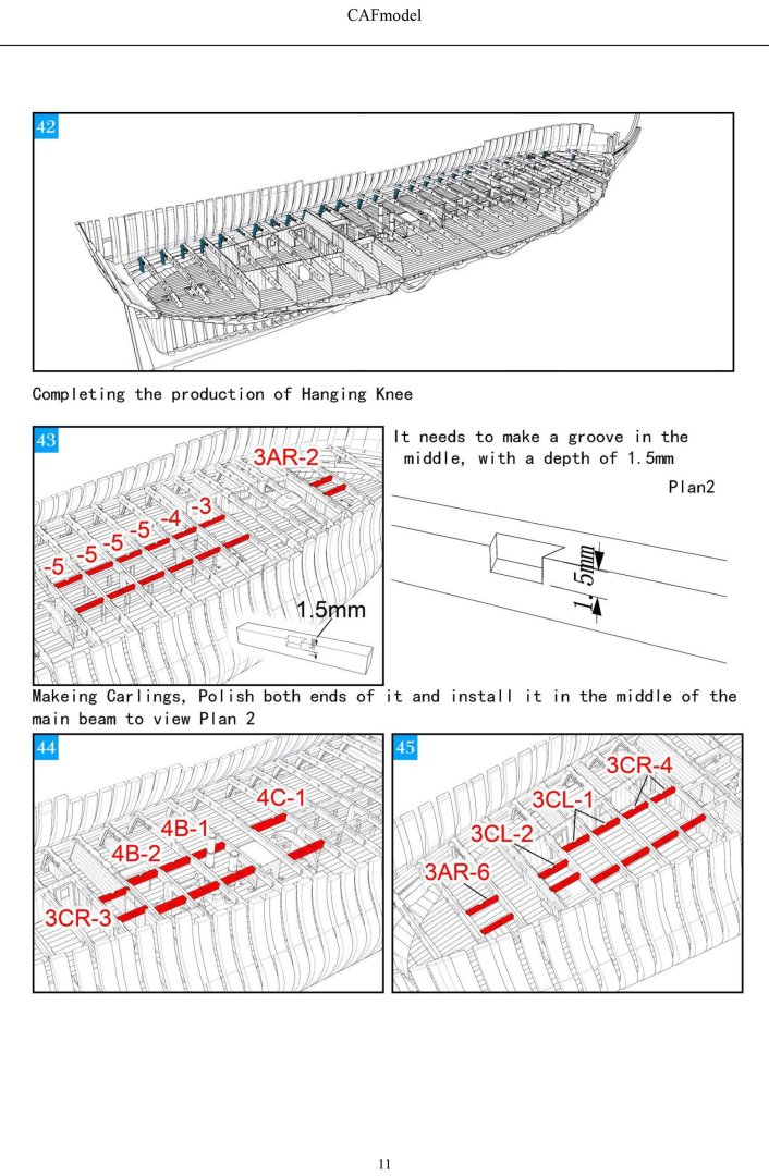

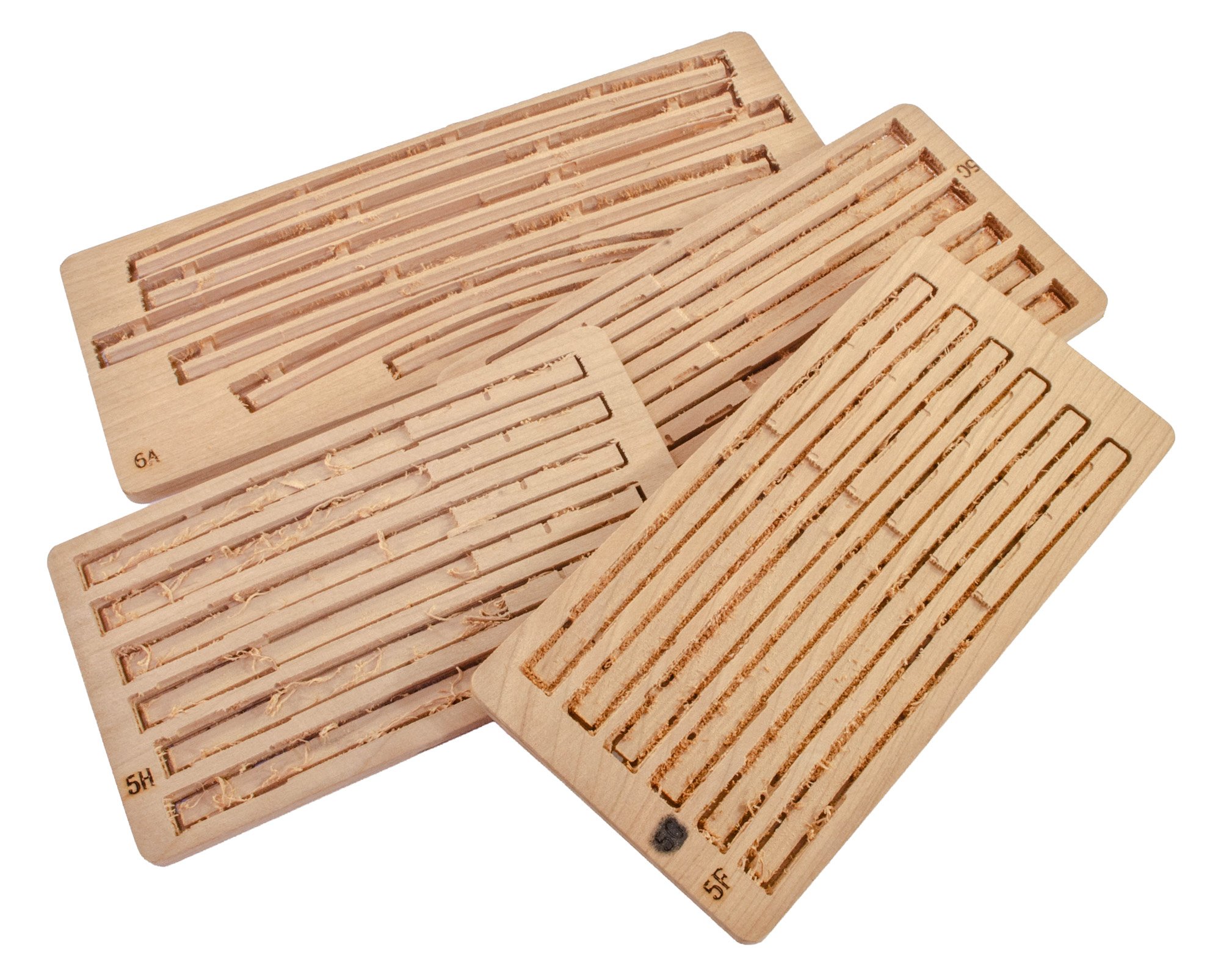

PART 4.5 (Optional)
Yes, this box is indeed optional to the final build, but in all fairness, it seems nonsensical not to add it unless you're working to strict budgeting restraints. This set will add all of the main hull internal details, such as cabins, internal bulkhead detail, livestock pens, water pumps...in fact, you name it, and it'll be there. It's certainly a weighty box too and crammed 101% full with an incredible number of sheets, as well as fittings and PE etc. All parts in this pack are packed into a single cellophane wrap, and there are individual stacks of sheet timber, both laser and CNC-cut.

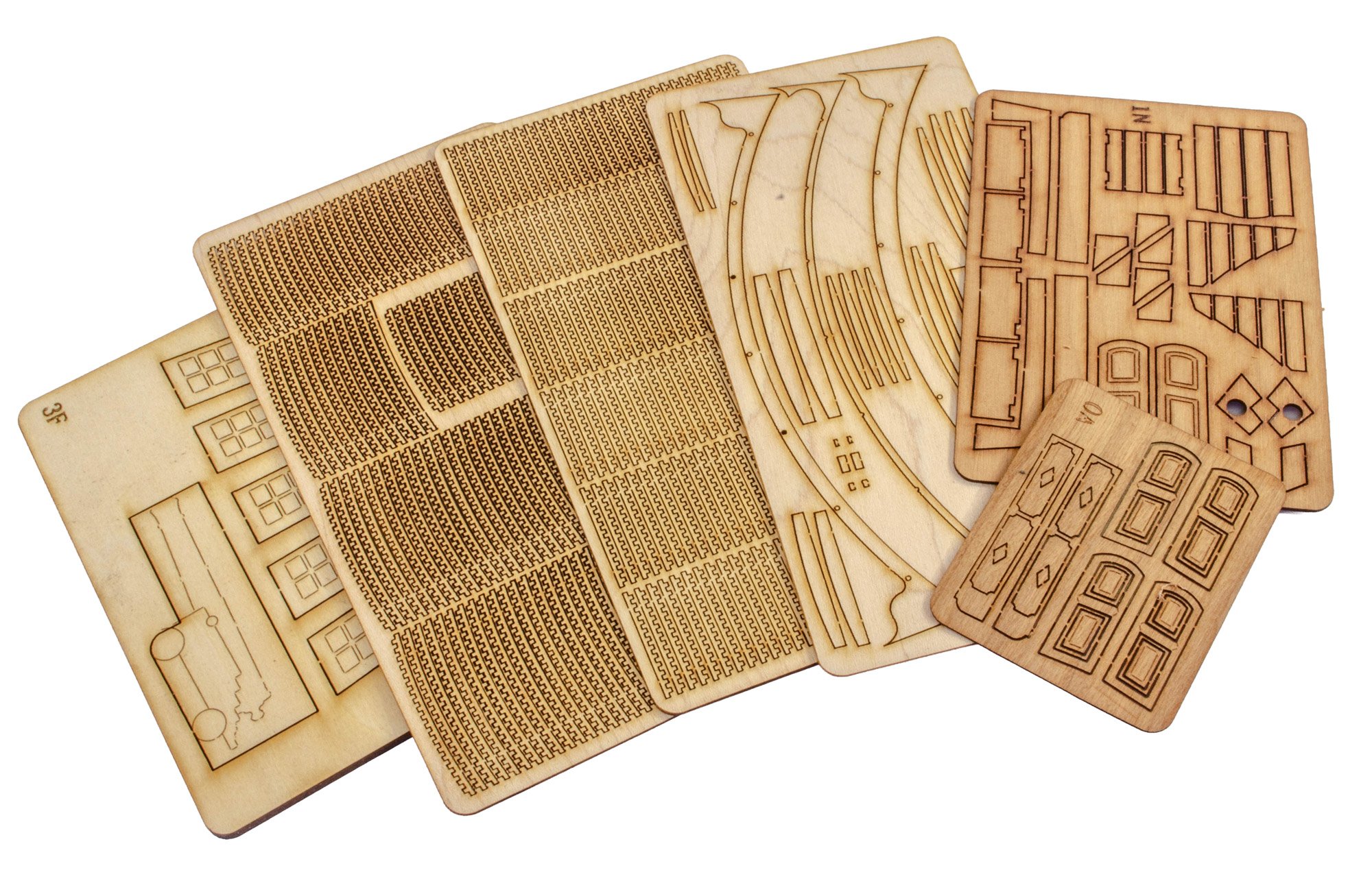

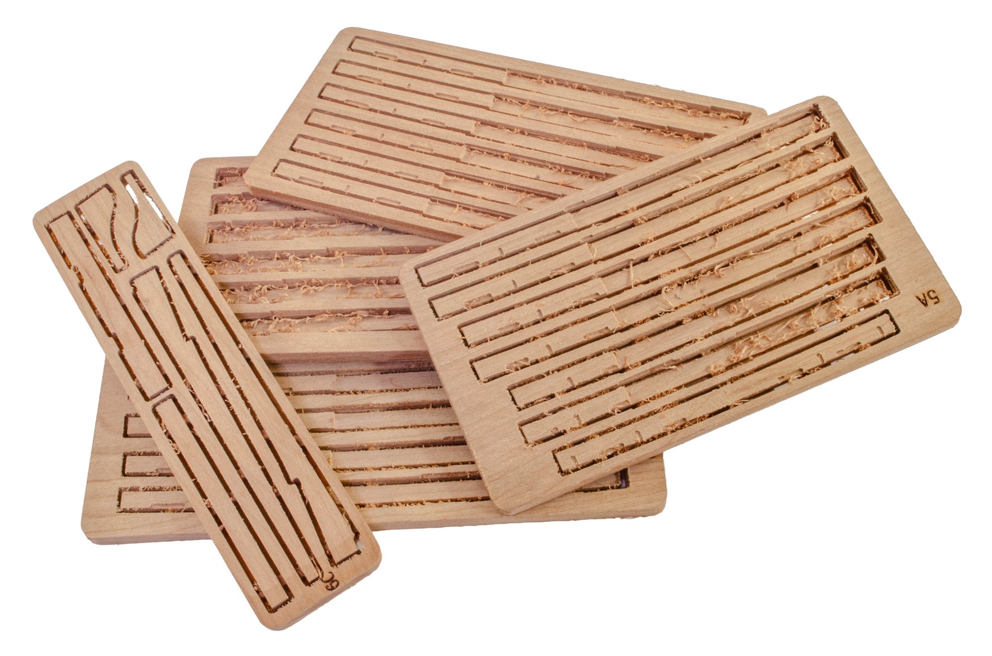

These sheets are CNC cut. I did wonder about the levels of debris still attached to them, but the majority of this is attached to the frames and not the parts themselves. I did remove a quantity of this beforehand, so that isn't an issue. A nice, clean cutting bit would definitely be advisable for manufacturing though.
This pack contains around 31 sheets of laser-cut cherry parts, and a further 9 sheets of plywood for creating the various internal shapes within the hull structure. All laser work is nicely cut, and with minimal rear scorching. As a matter of course, I'd routinely use a sanding mouse with a fine grit to finish off the rear of all sheets so that none of that wood colour shows any discolouration.

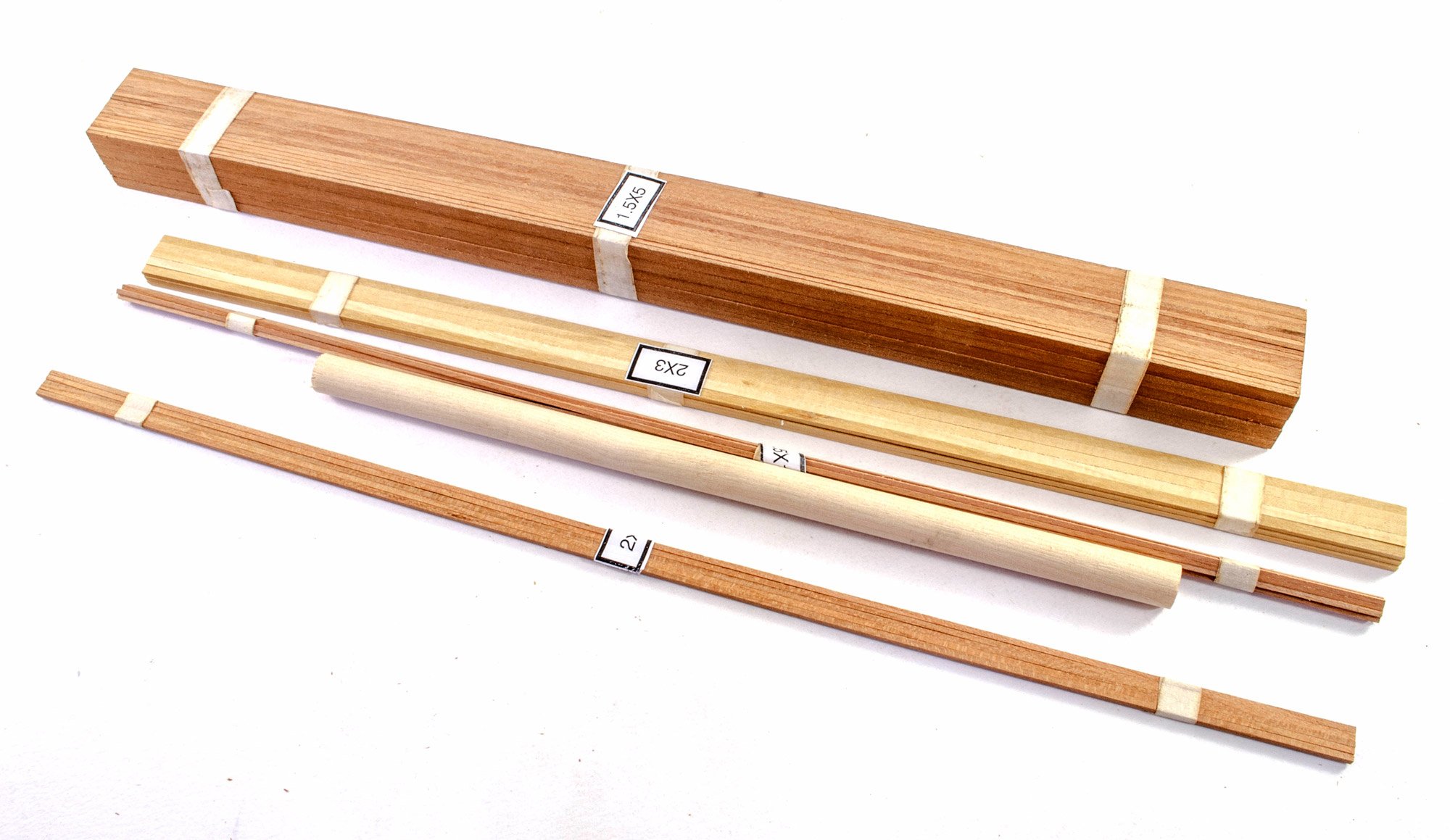

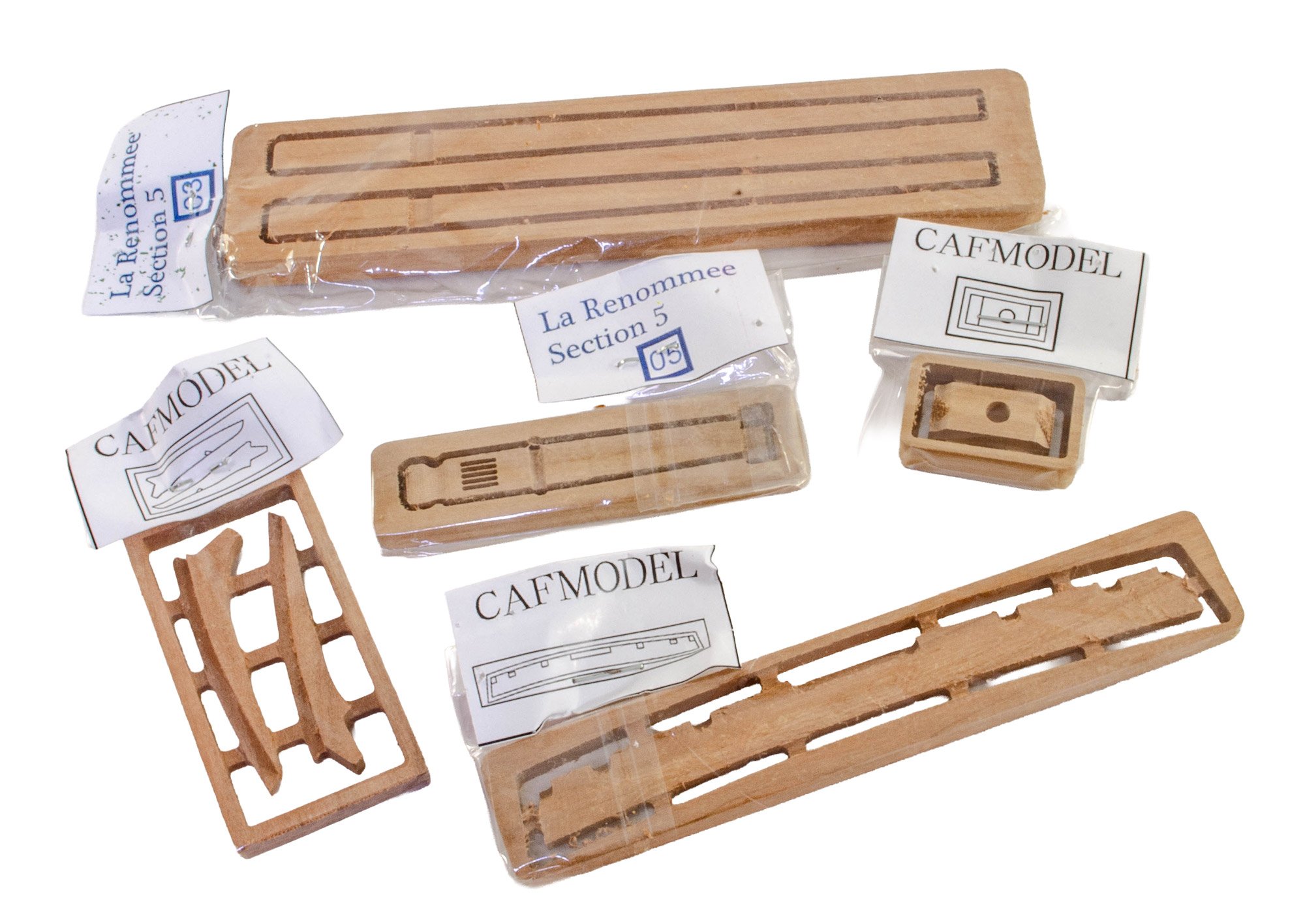

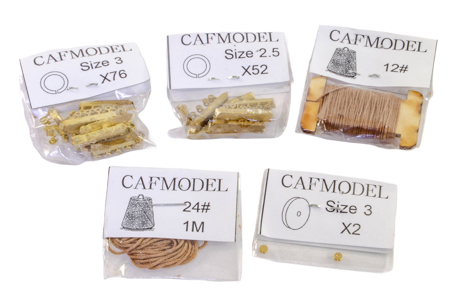

Quite a large pack of cellophane-wrapped timber is included in this set, all very uniform in colour, nicely cut with no bad edges, and also marked up for identification. Two sections of dowel are also supplied, as is a roll of brass wore, in a CAF wooden spindle.

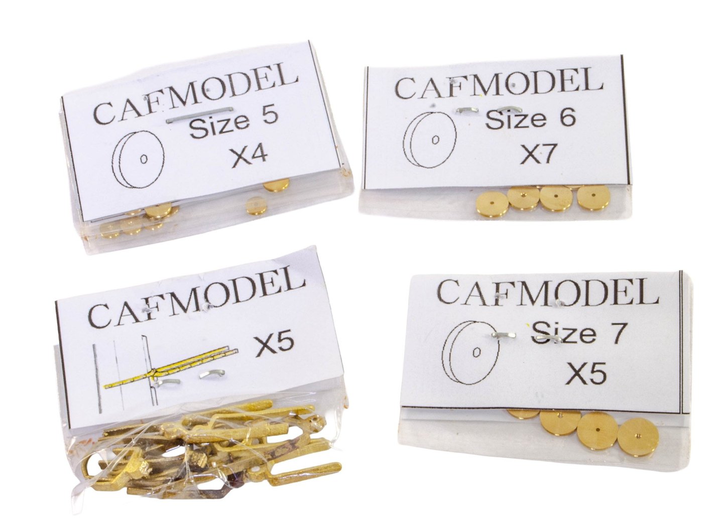

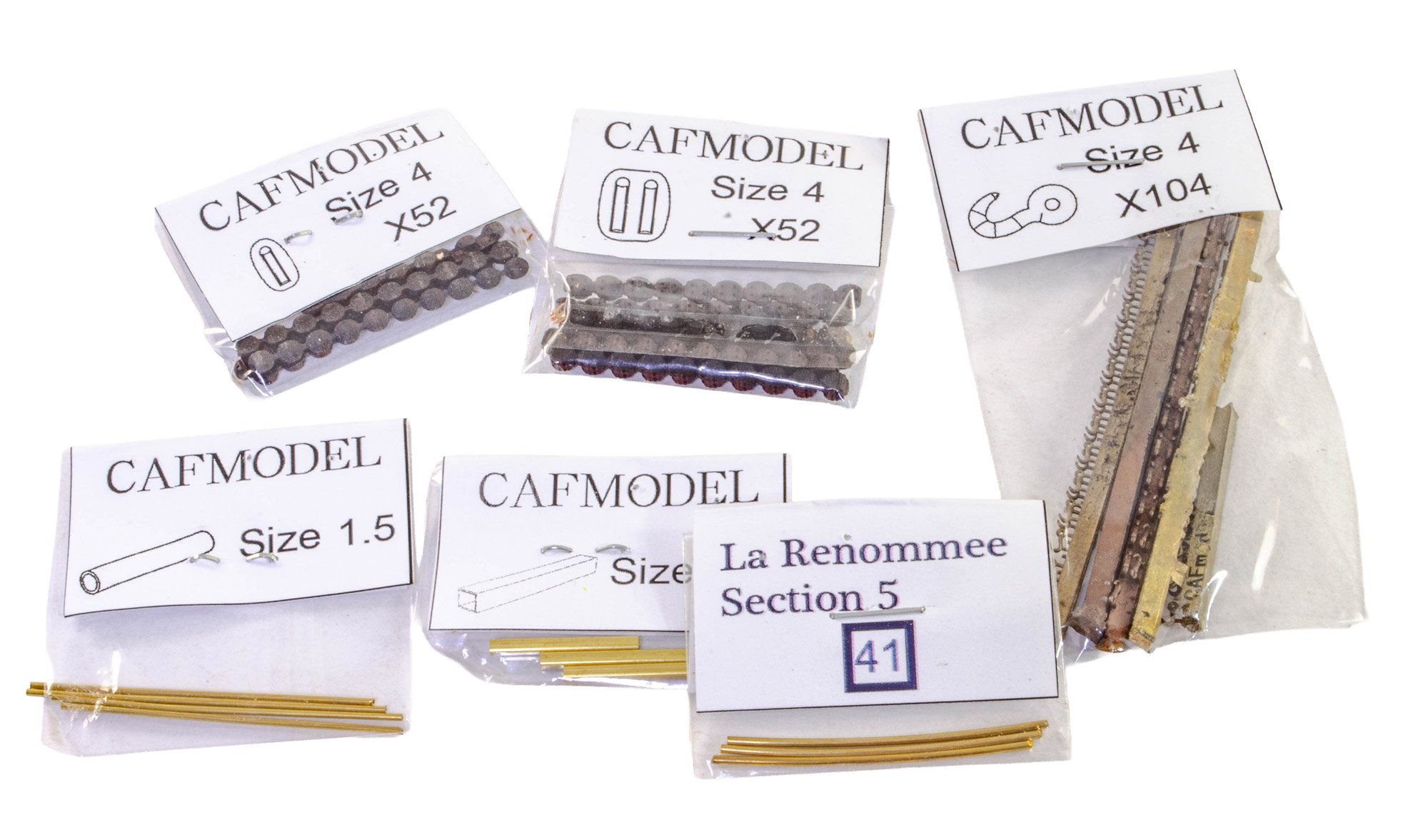

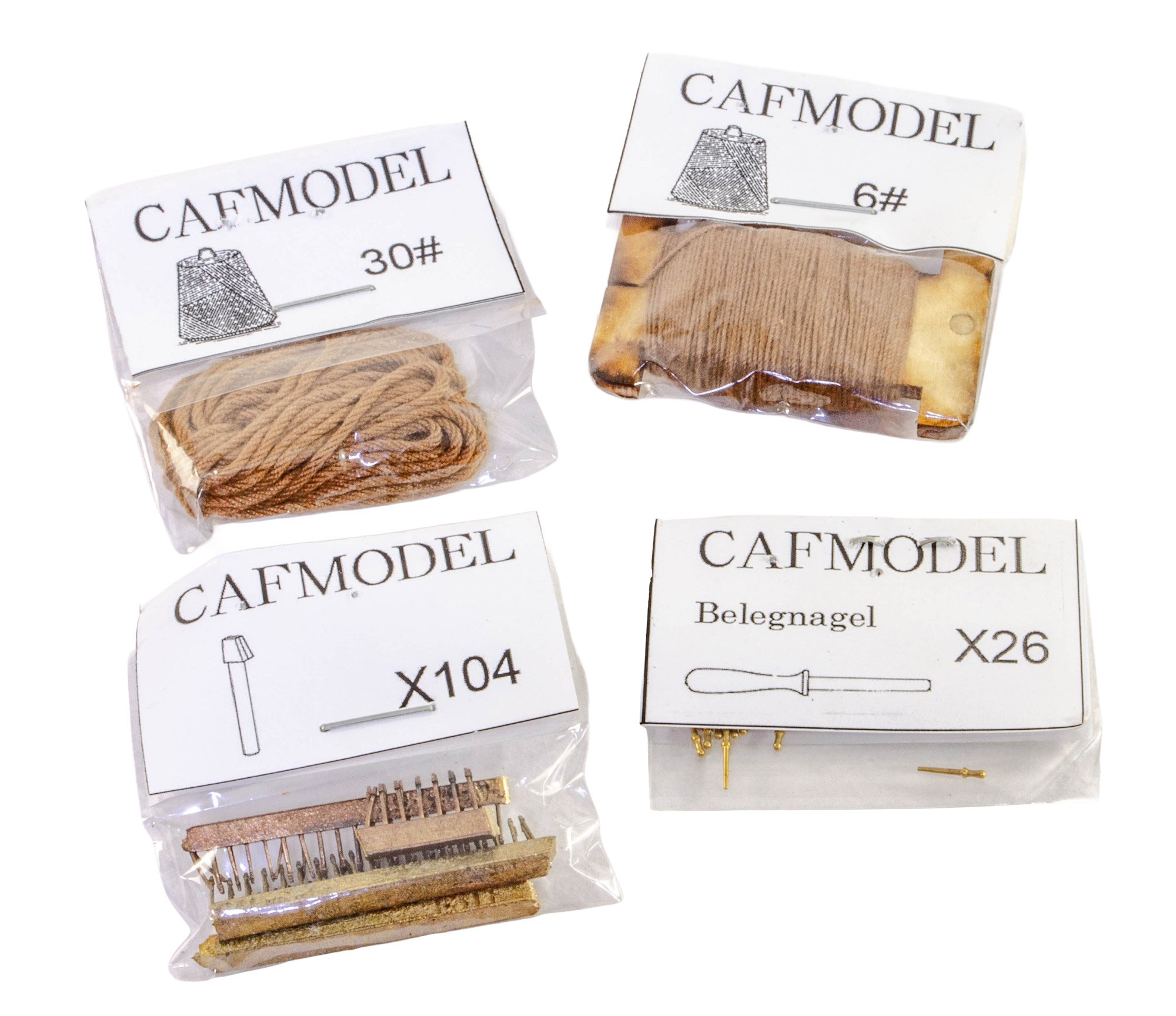

Various packets show rope, pump tubes, a resin jig for building poultry shed, eyelets, nails, internal anchor (stowage), and what looks like hatch lifting  loops which are made from cast metal.

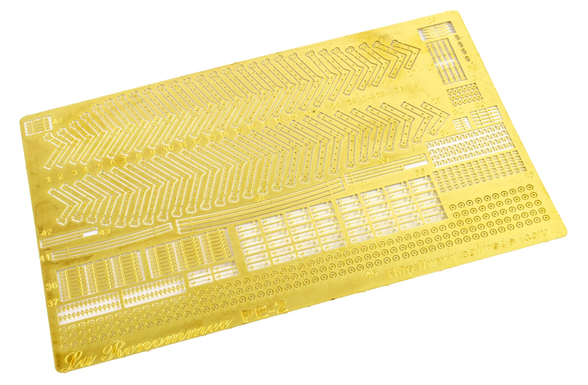

A large, single sheet of photo-etch is supplied. Here you will find parts for window frames, pump filter ends, lanterns, door hinges etc. PE quality is excellent with only small gates to remove each part.
It took about 15 minutes to finally get all of the parts back into the box, along with the manual etc, and that lid is still bulging.

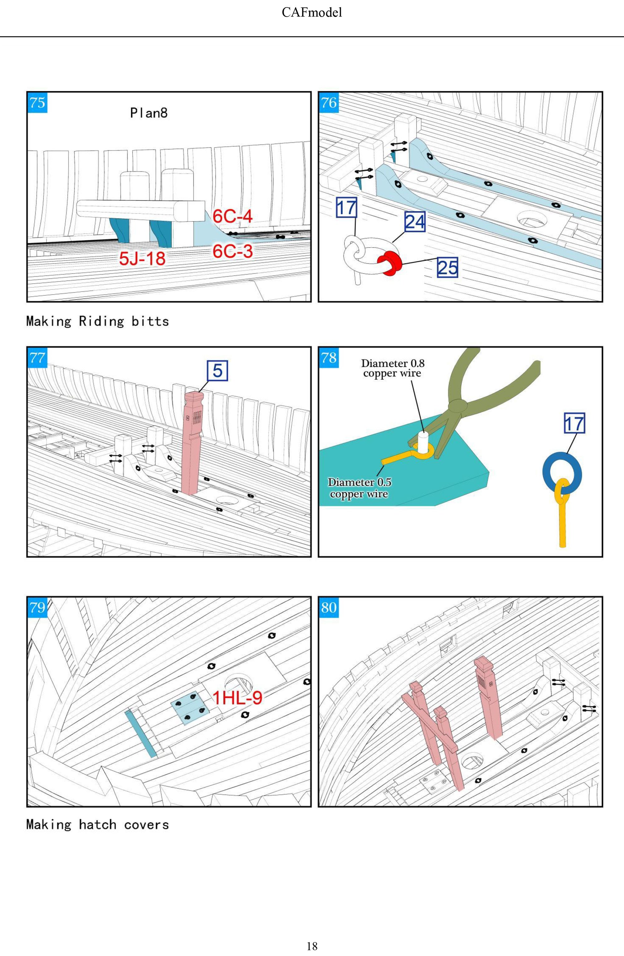

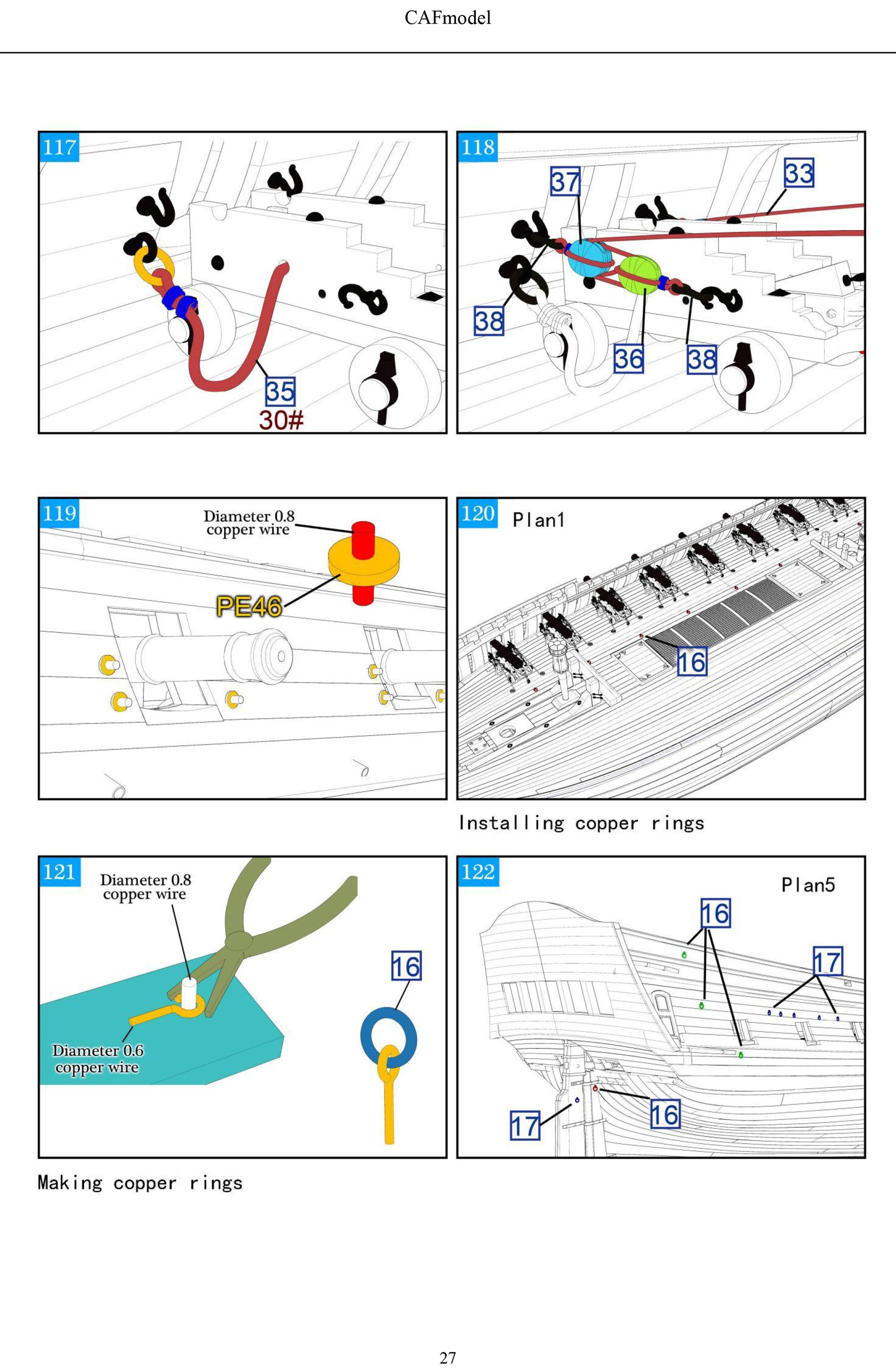

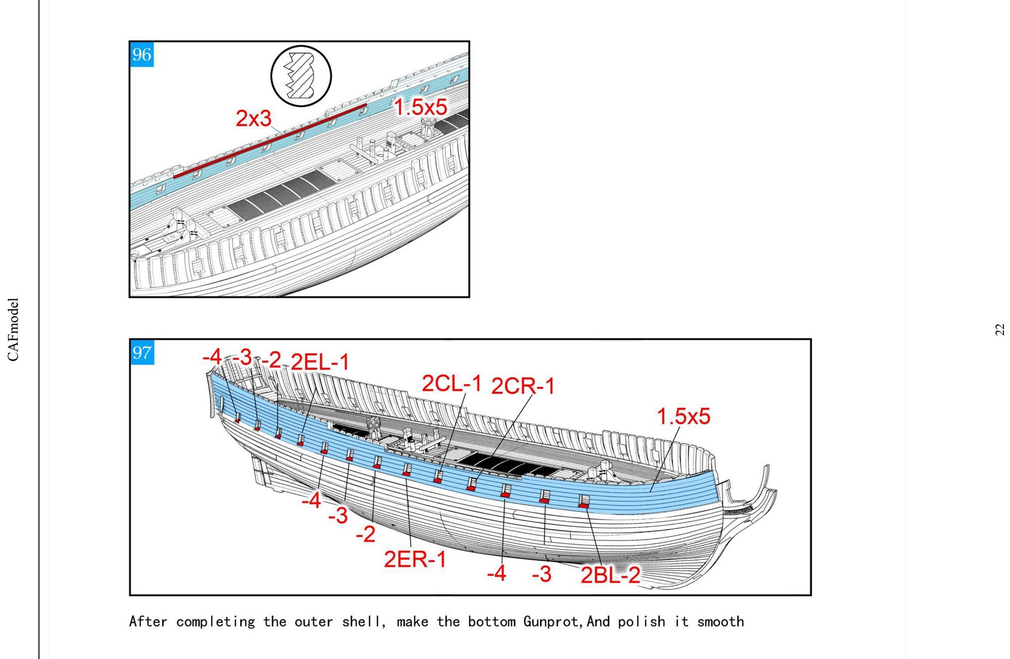

Instructions
The manual for this set is 46 pages in A4 format, clearly printed, with of those pages being part maps alone. If you want to have a preview of this manual, then it's on the CAF website along with the other kit chapters. Here are just a few selected pages.
