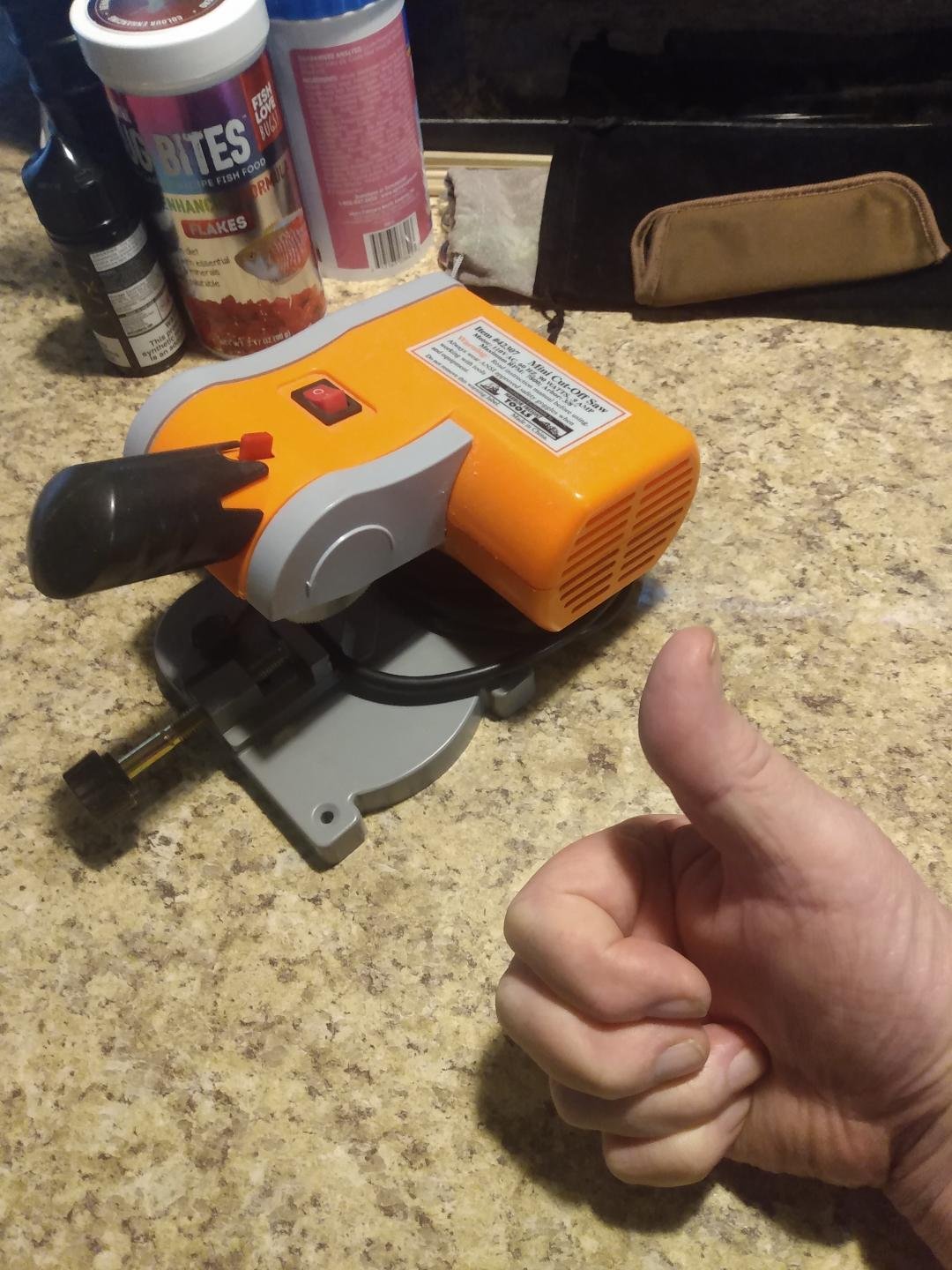

I have the complete 'Ultimation' line of products and love them all. The chopper will indeed cut a bevel on one end, but I deal with that in one of two ways. If it's planking, I'll often use that bevel to my advantage by turning the points 'up' and making a really tight butt joint against the preceding planks. If I don't want the beveled cut, I simply cut my pieces a tad long and use the sanding repeater to sand all of those parts to exact lengths while also removing those tapered cuts. As for the hand powered sander, itself. It is a gem, indeed. It's saved me many times when the complex geometry of a curious part and compound angles would make it difficult to accurately sand such a part via a powered disk sander where you must sand on one side of the disk due to rotation, etc. With the Ultimation sander, I just turn the crank in whichever direction best suits the needs for the part needing to be sanded. I have nothing but 'PRAISE' for all of my Ultimation tools!
Edited by tmj

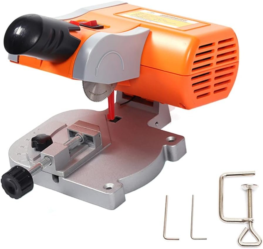

This is kinda goofy but works 'GREAT' for square cuts on thicker stuff that the Ultimation won't like. It's cheap too! Look for mini table saws on Amazon. I've had mine for 20 years and it still works like a champ!
Edited by tmj
These don't fall in the knife blade driven chopper/slicer category.
They are basically cut-off or chop saws.  Reviews on these cheap units indicate weak motors, distorted blades and other anamolies.
The one you posted is ~$29 on Amazon, a Proxxon is $329.  Price might make a difference in quality in this category.
Please post a picture of your 20 year old unit.
You do mention using it on thicker stock but using a unit like this on ultra thin stock, like what the chopper/slicers were made for, would most likely yield unsatisfactory results.
Edited by MintGum
Harbor Freight sells this saw for about 1/3 or 1/4 of the cost of the Micro Mark version - from the same mfg.  Identical except labels - the last time I compared them.
I purchased my say several years ago thinking if it got me through the project I was working on with a delivery deadline it was worth it - the tool would pay for itself.  I completed the job on time and I still have this little workhorse and it's now at least 10 years old.  If it ever dies, I will replace it with another from HF.
Here 'tis! 😁 I've cut tons of stuff on this little thing, mostly hardwoods. It's really a great little tool, despite its origins and price! As for 'thin' stuff? It'll cut a 1/32" thick plank, or a 'stack' of 1/32" thick planks just as easily and pretty as you please! Nice clean cuts even on the thin stuff!
While outside the realm of this thread, these machines all look like copies of each other, rebranded and marketed under different names.
As is often the question, what was the OEM(s)?  Amazon, Vevor, Harbor Freight, Micro Mark, etc... all appear to be copies of which OEM?
If I'm not mistaken, Harbor Freight is where I bought mine way back when!
