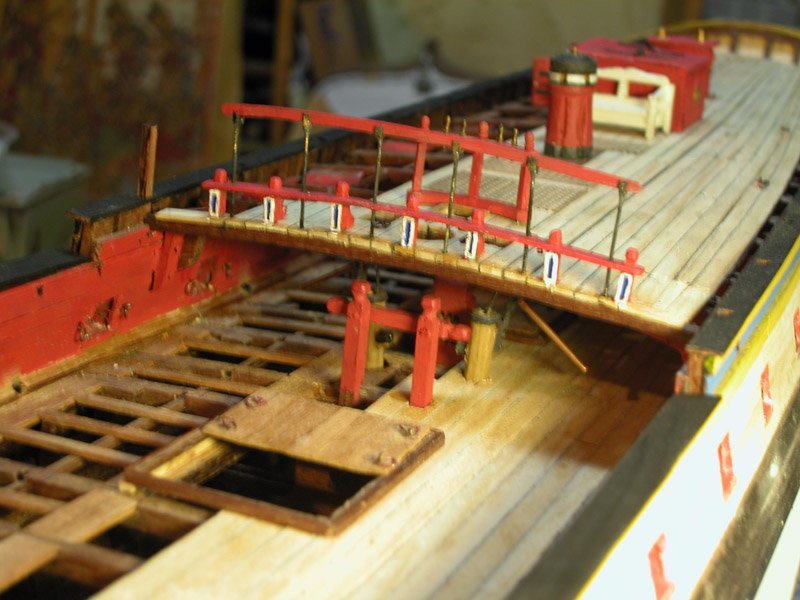

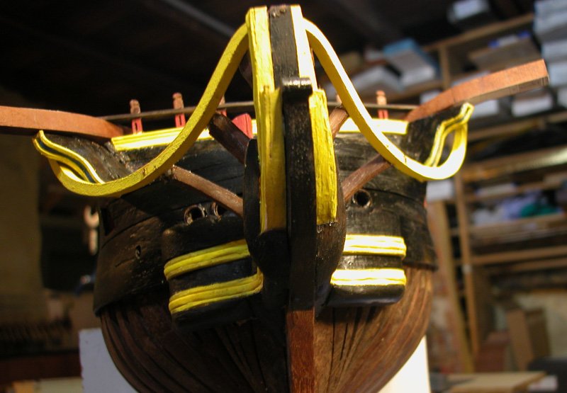

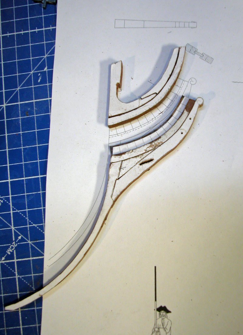

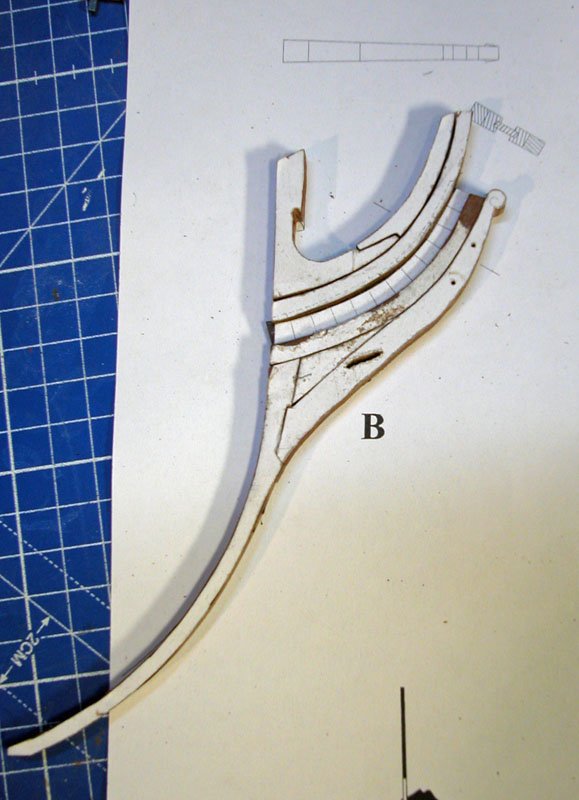

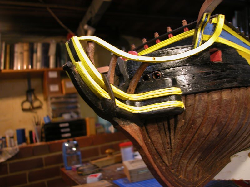

The beakhead bulkhead finished, as well as the shear plank for the forecastle. Note the cutout for the bowsprit
DSCN2852a.jpg.b6e0e63eedee22f65006a4f8cd86077e.jpgDSCN2854a.jpg.b73acf3d153da819572e185f525e3744.jpg

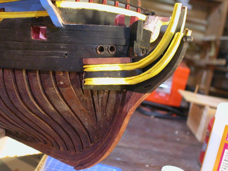

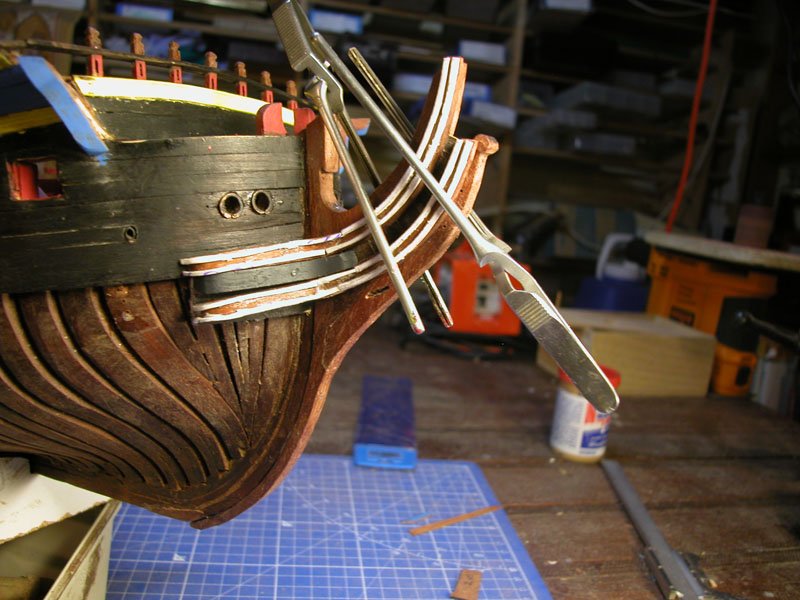

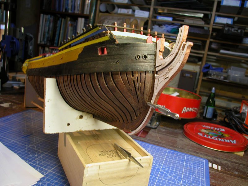

Sheer plank largely finished and some of the framing of the quarterdeck. Now I have to do some painting. Deck furniture will red ochre as may be the inside planking.

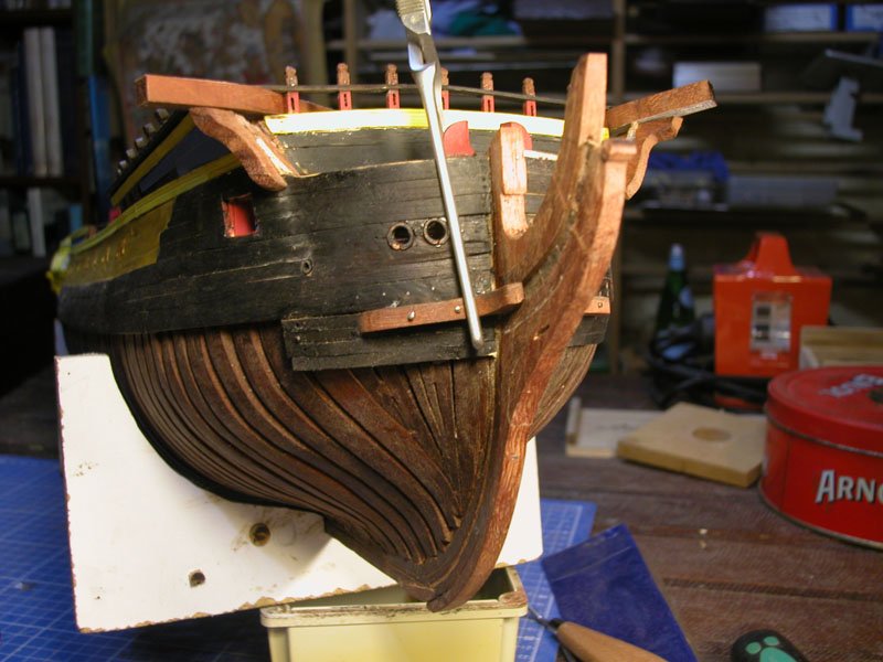

The forecastle deck. The framing is planned to be visible on the starboard side but planked on the port side. the central planking is thicker than the outer decke planking. The forecastle deck remains removable until all work on the main deck is complete.

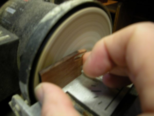

This shows the attachment to my cross-sled for making the gratings. The slats are to be the thickness of the saw blade(1mm.). A  1mm. thick brass strip is glued to the slot to allow a spacing of 1mm.
This allows slots to be cut in a block slightly deeper than the planned grating
The grating is turned through 90 degrees and shallower cuts are made for the upper slats
The 1mm. thick upper slats are glued in place . They are deeper than required and the excess will be sanded off later.
double sided tape (wondeful stuff!) is glued to a block of wood and the grating stuck face down .
DSCN2891a.jpg.8f4e3413ea42496f0254ba8a8b2a98a8.jpgDSCN2886a.jpg.4f5a1b7c07f8eb38ef8966a612ff7436.jpg
The excess depth is sanded off. (But Use a thicker block of wood than I did to avoid burnt finger tips). This exposes the lower slats.
DSCN2885a.jpg.15b9a2a6fff83e662e45fb2f2cd5be60.jpgDSCN2888a.jpg.97bc7ba3a55b8471142f270f468b57ff.jpg
T
The grating is detached from the tape, turned over and the excess of the upper slats sanded off
the grating just needs trimming to size now
Cheers. I apologise for teaching you to suck eggs but I have seen some awful gratings in my time. Usually with way over size holes that a sailor's foot would fall through.

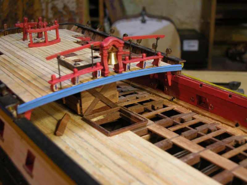

The after deck framing
The central thicker deck planking in place
The outer thinner deck planking in place. Gratings in place.The waterway will be added when the deck is finally attached
The two upper decks are removable which allows completion of the main deck and facilitates finishing off the upper deck furniture etc

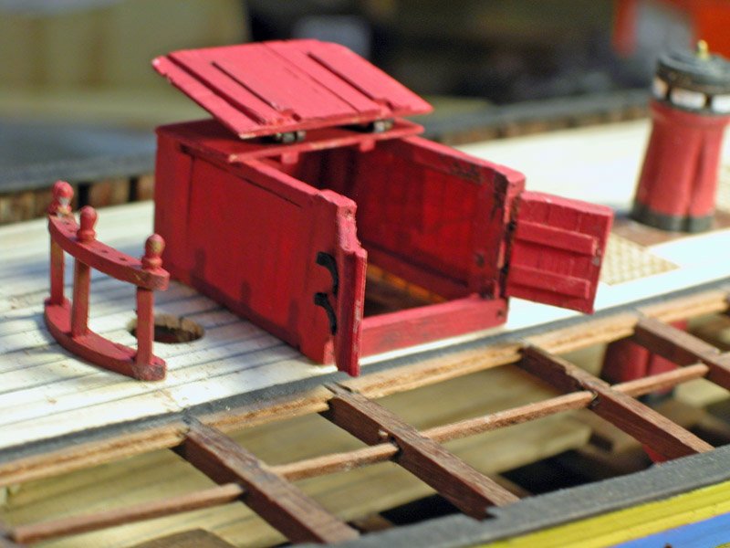

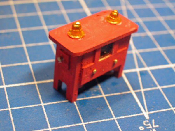

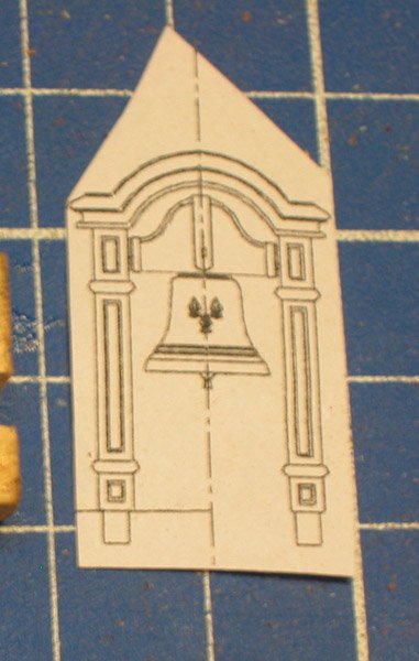

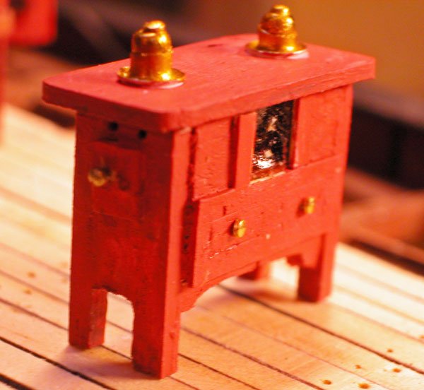

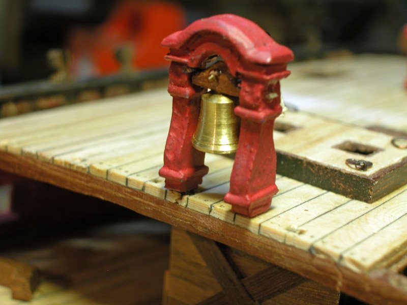

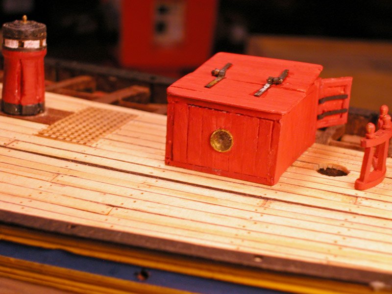

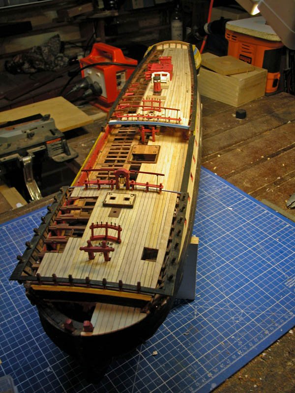

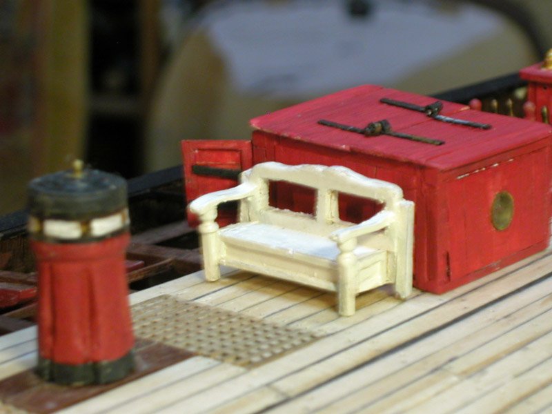

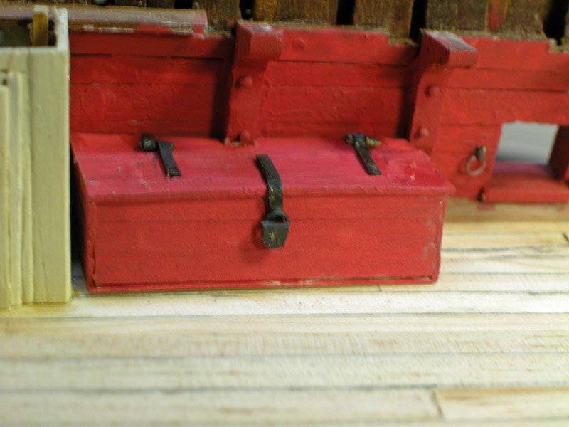

I have made quite a lot of the deck furniture:
The belfry:DSCN2900a.jpg.637f9f6605574c25b92d8f9a9850dfd0.jpg
The companionway:
DSCN2907a.jpg.2d95b18cb9b704602a85da193443cf39.jpgDSCN2904a.jpg.0f10da5f904f03b498a7744413c889df.jpg
and the binnacle, different to that shown on the plans.DSCN2905a.jpg.220c908cd5ec716729bd56cef9c2bdfd.jpgDSCN2910a.jpg.af9cfd9fefb86aff0eebd2b2498fbb9f.jpg
Also done are the pinrails for the three masts, all very fiddly. It's a bit like a doll's house.
More furniture to come.

The after deck has now most of its furniture and fitting. I will install a hen-coop although its not on the plans. I cant imagine the french travelling halfway round the world without a source of eggs for their soufflés 👨‍🍳🇫🇷. They also had a bread oven which I am thinking about Having wasted a mort of time trying to resin mold guns and carriages, I will go back to good old-fashioned wood for the carriage and will try Woods Metal for casting the guns which will only be seen on the port side of course.
DSCN2912a.jpg.e082eb0c2872afdd68a4e9f3080dca96.jpgan arms locker on the main deck
Cheers
Dick

I have done the deck furniture for the forecastle deck except for the capstan which I will make once the forecastle deck is permanently attached. Similarly the catheads.
I will now turn my attention to the main deck armament.
Cheers
Dick

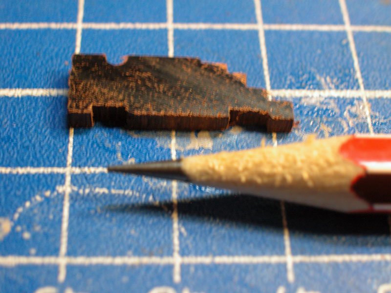

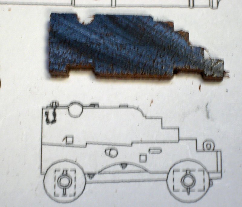

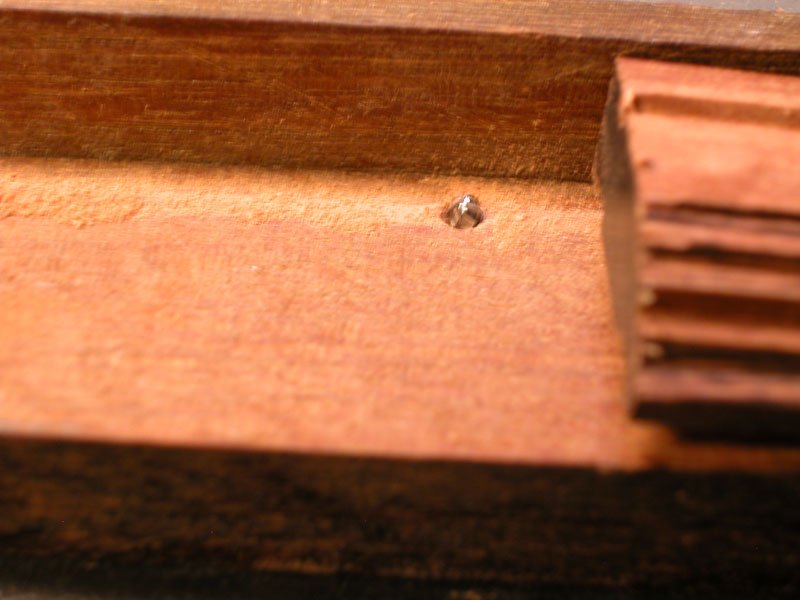

I used the good ole Byrnes saw to mill the steps in the guncarriage sides from two strips of 4mm jarrah glued together.
DSCN2927a.jpg.38f7551de3e1bb581734cb77909b3537.jpgDSCN2928a.jpg.afba7e34faccd5fa94e0c5167f061583.jpg
The semi circular slot for the trunnnions was milled using a very small burr mounted in the Dremel router guide. The guns on the gros ventre were only small 4 pounder popguns so the carriages are quite small
DSCN2934a.jpg.47bc1f5e5c11b5449540ba2b9f3a37eb.jpgDSCN2929a.jpg.728d57d9d54c86101c702546c21e68dc.jpgDSCN2932a.jpg.ede68c06a03bb02ca5055106430b37de.jpg

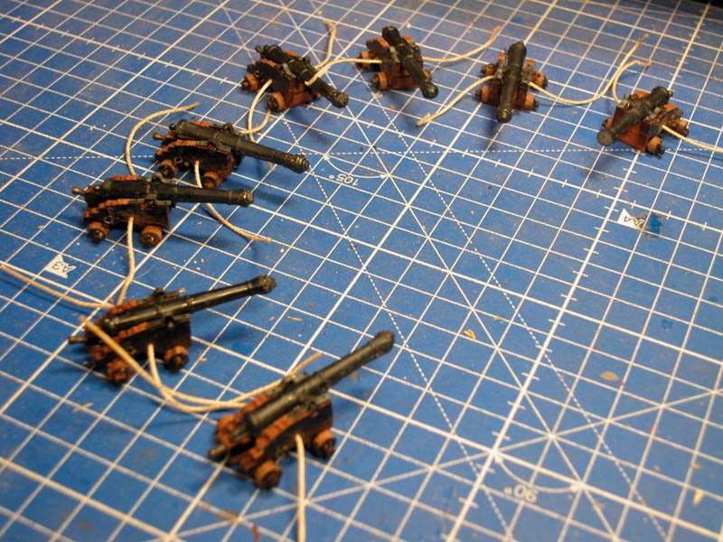

I have molded the guns in resin, although neater job might be obtained by turning them.
Here they are on their carriages. Please note that the continental practice was for the breeching rope to pass through the cheeks of the carriage
I will mount them later in the run-out positiion. Gun tackles under construction.

Its time to start on the head of the ship.
First the starboard side showing the portlids. The were not hinged and the two halflids were removed before running out the gun. The tip of the gun and its tompion plugged the hole when portlid closed.

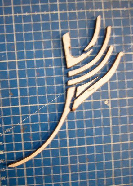

The next pic shows the several components of the head including the hooked gammoning knee, the knee of the head and curved cheekpieces.
Thinner filling pieces have been made to go between the curved cheeks
the assembled head prior to final shaping. Note the hook on the gammoning knee to accept the stay. This was comon french practice.
a trial attachment with duble side tape and a clamp to make sure the gammoning knee lines up with the stempost and support for bowsprit
Dick

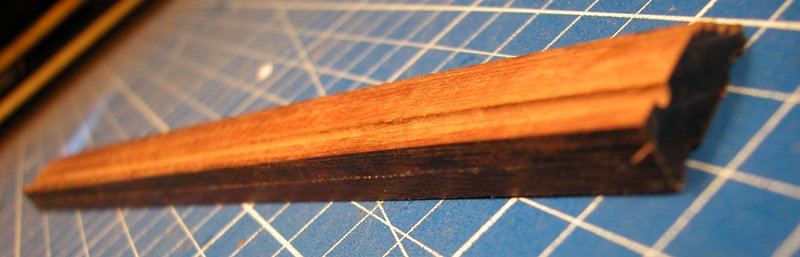

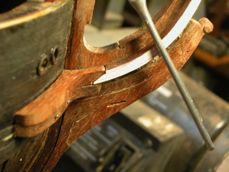

Further progress on construction of the head:
The filling piece which goes between the cheeks
The upper cheekpiec comes in 2 pieces joined at right angles by a scarfDSCN2989a.jpg.a24fc020e3fe163de11f375dd8486e31.jpg
The upper and lwer cheekpieces trialled
The cheekpieces isnstalled
Dick

On 11/25/2025 at 5:01 AM, Mark Pearse said:
Well done, they must have been tricky to get the shapes right.
Well, a fair bit of hair pulling and cursing.
Progress on the head timbers:
cheekpieces in place and filling piece between the cheeks. The first timber of the bolsters below the hawse-holes is installed
Bolsters complete, The rounded timbers below the lower cheekpiece are 3 in number on each side (much hair pulling!) are to protect the head from the anchor flukes.
The main head rail is in place. Note the bolster and vertical timber to protect the gammoning. The curved stanchions(jambettes in french) to brace the head rails are seen (much gnashing of teeth and rending of garments). It's enough to make me build kits again (only joshing).
Cheers
