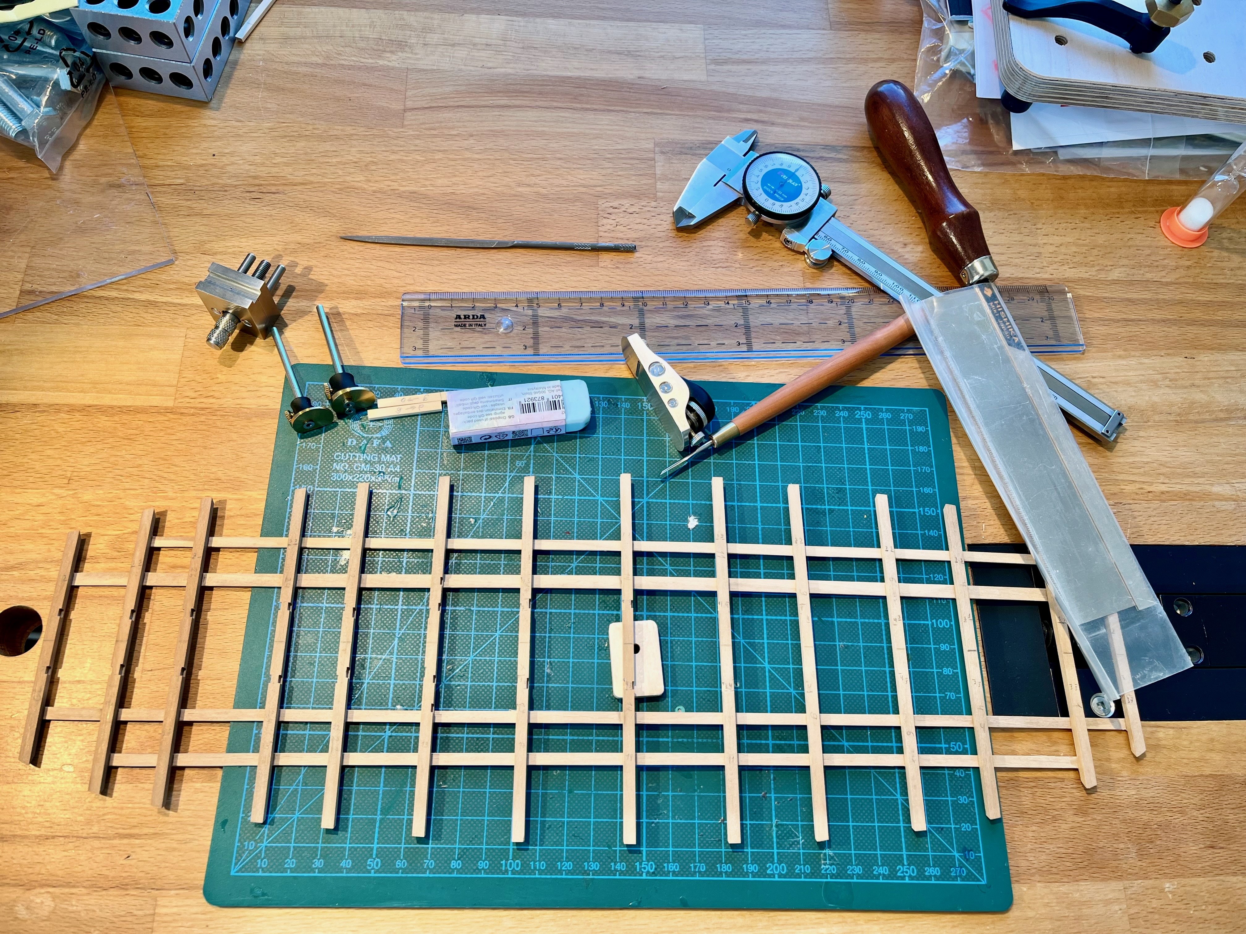

Deck framing preparations
Here is the "final" deck layout that I settled on. Knee shape is quite approximate and would be refined on the model, but the carlings are all in their final spots. Ledges are omitted for clarity, but they would be placed on the top and middle part of the deck, leaving the bottom one fully bare. Depending on the visuals I might add the bottom row of carlings later on.
If anyone can spot any mistake - please let me know before it is too late! :D

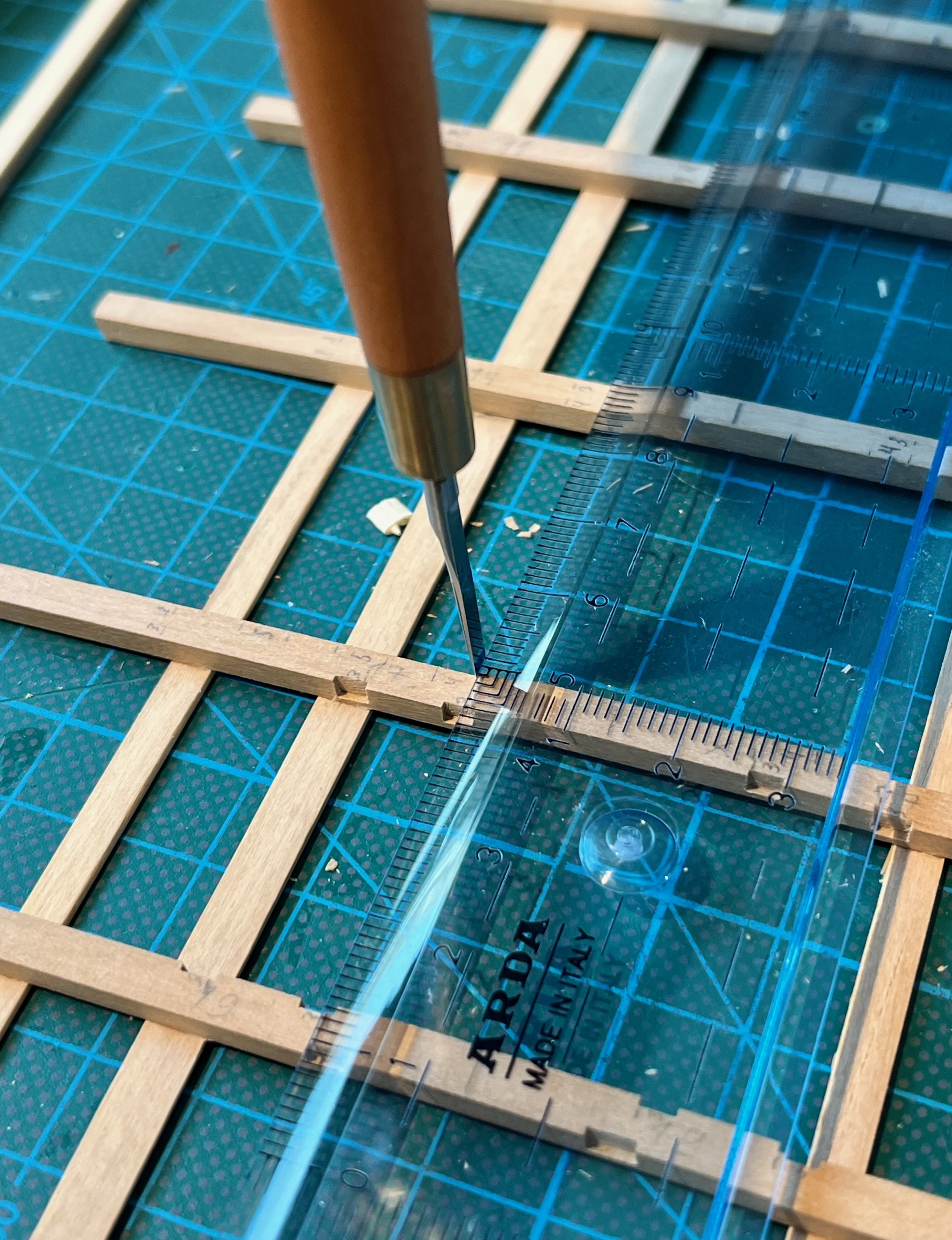

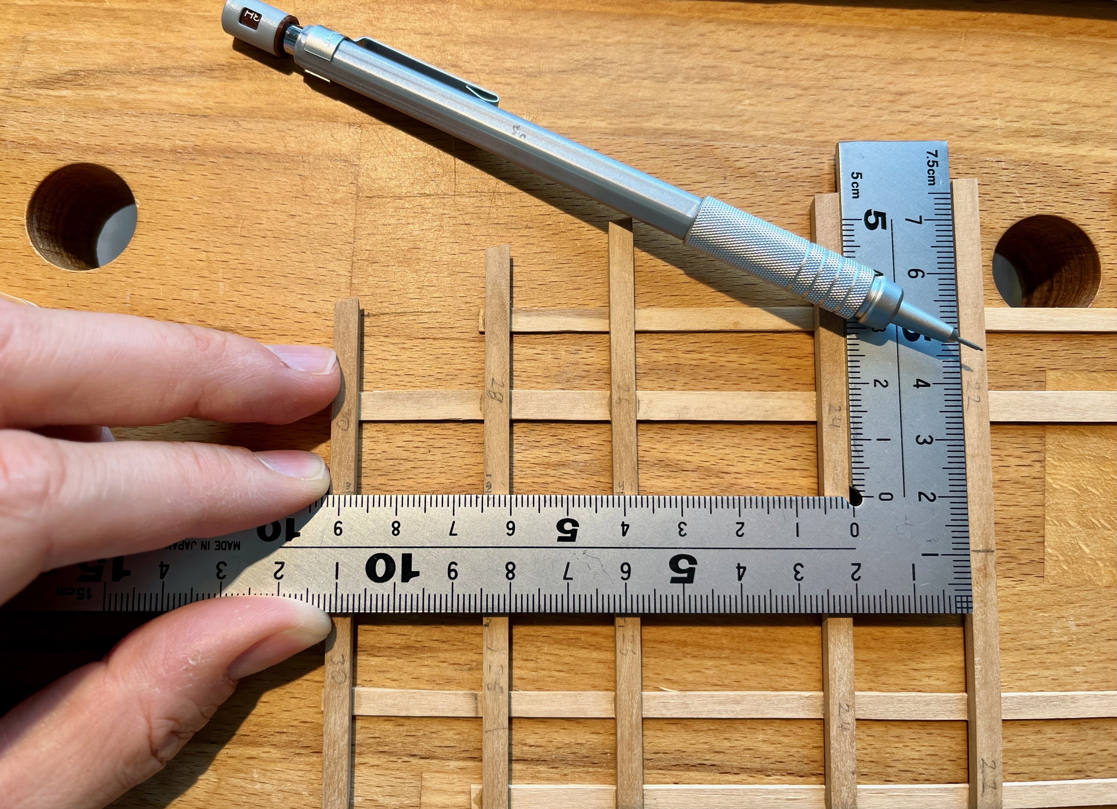

First I tried to mark up the layout using the a square. Unfortunately not all beams are perfectly perpendicular, not to a visible degree, but enough to make that method unusable.
After some experiments I settled on this setup:

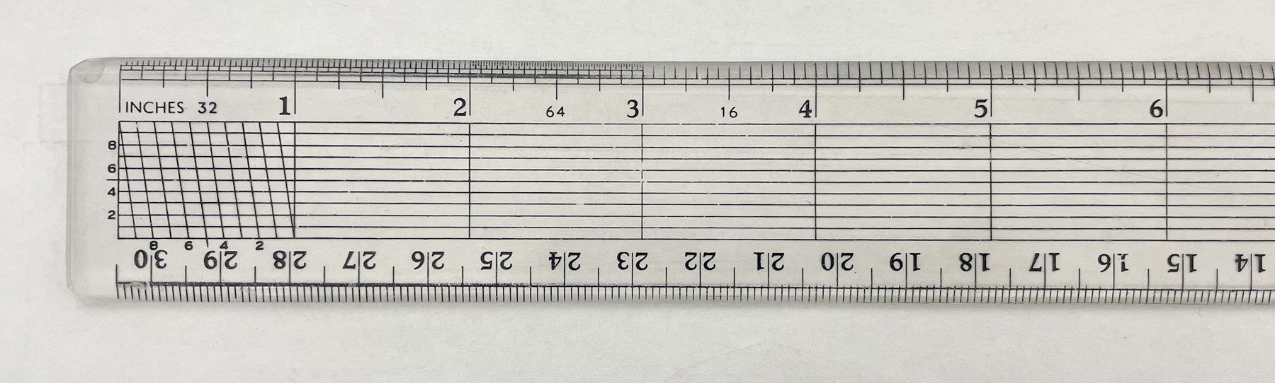

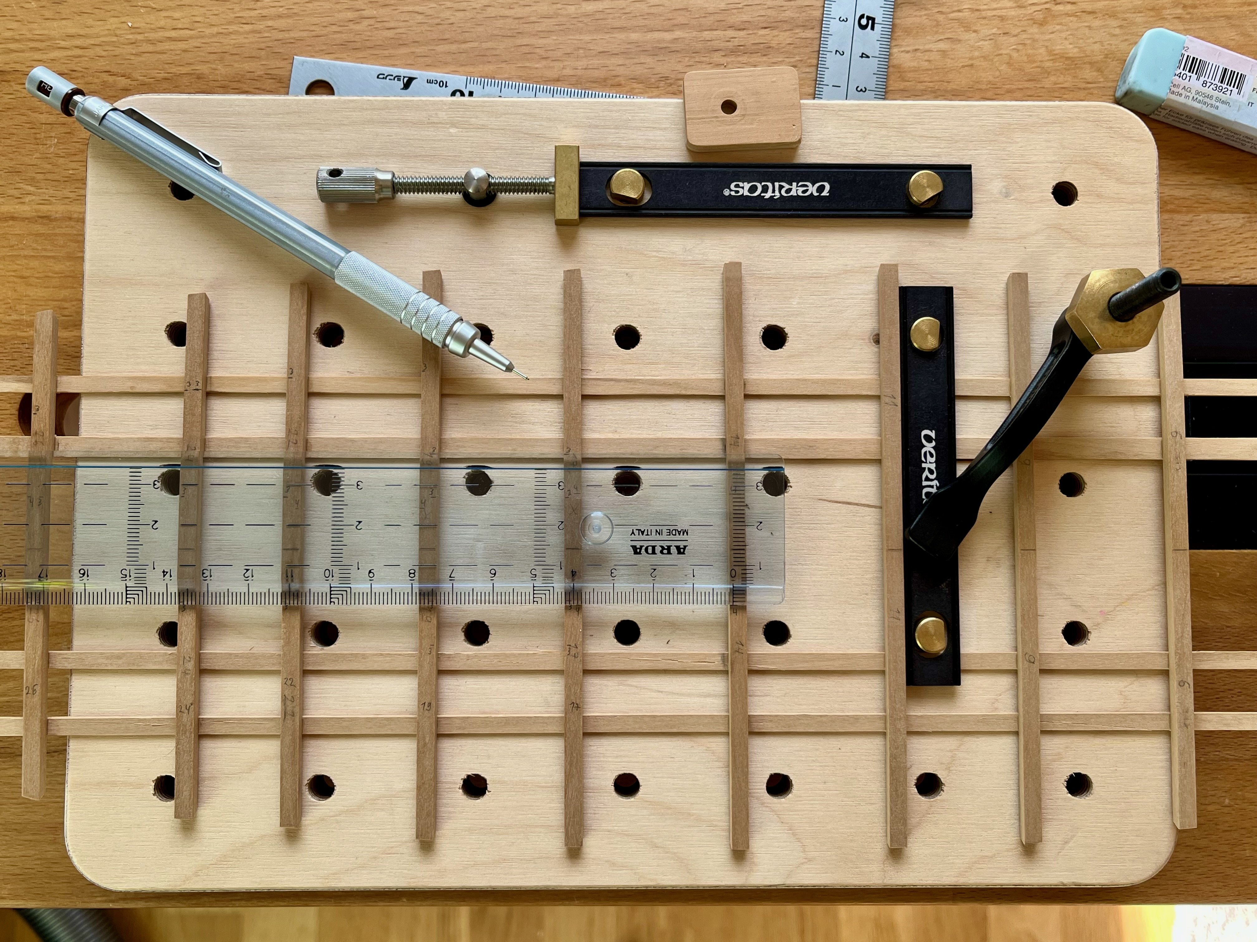

The deck is clamped in place and an unusual ruler is used to mark up relative to the centerline. That ruler has graduations in two axises, with notches following the 1, 2 and 3cm from the edge. That makes it ideal for the task - "these two notches should be 18mm from the centerline", while the ruler makes sure your centerline is not skewed. Invaluable! I got it in an arts & craft shop, not sure if there is a special name for that kind of a ruler.
Suddenly you need quite a lot of precision. Even a 0.3mm pencil feels too thick, and you need to account for the line thickness.
In the end I only used pencil marks as a rough guide. The final markup is done with a chisel with its back resting against the ruler:
Make sure to only mark one side of the notch, "the reference side". The other side can be fine tuned to fit, avoiding an accidental skewing by adjusting the notch width from both ends.

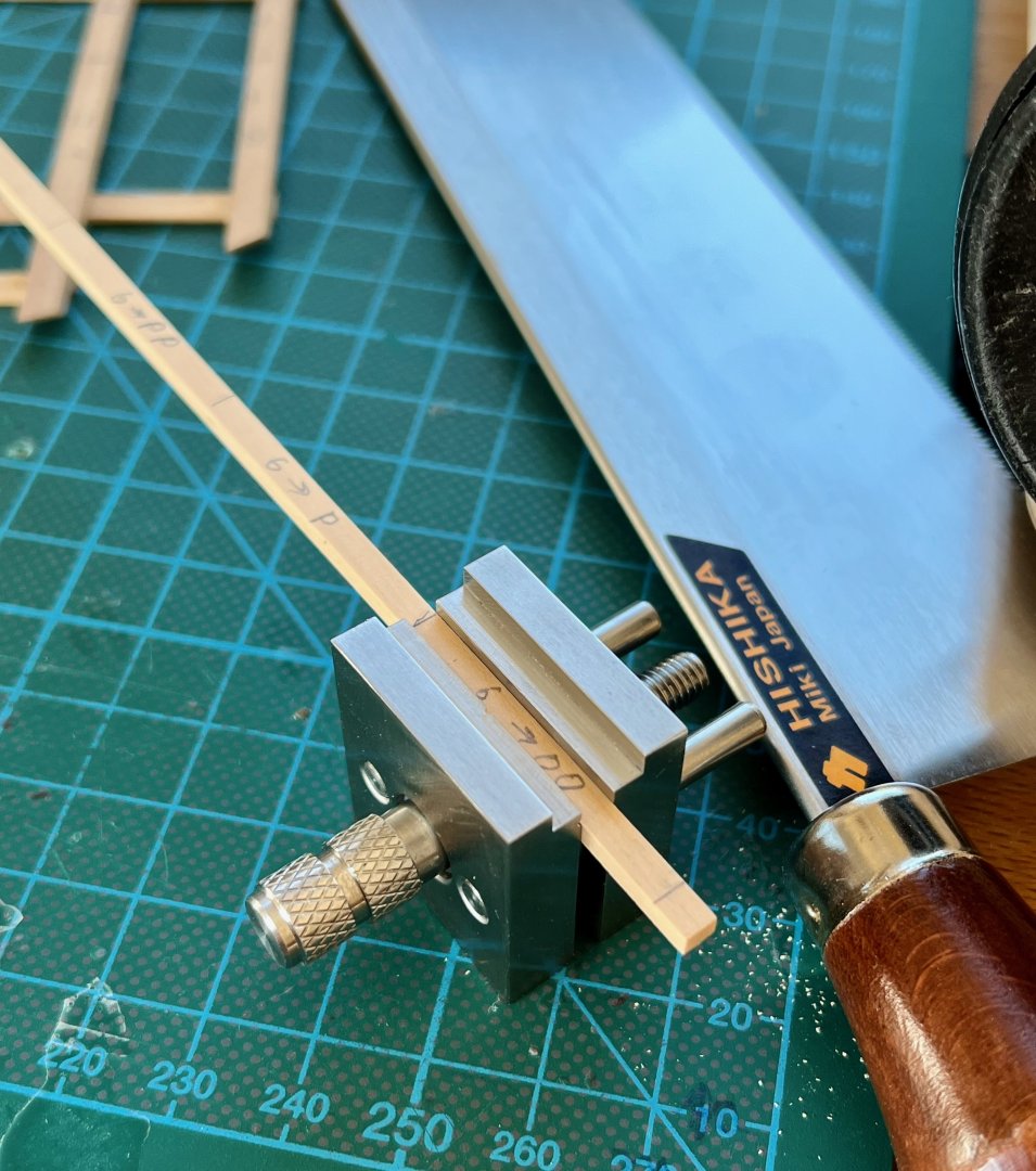

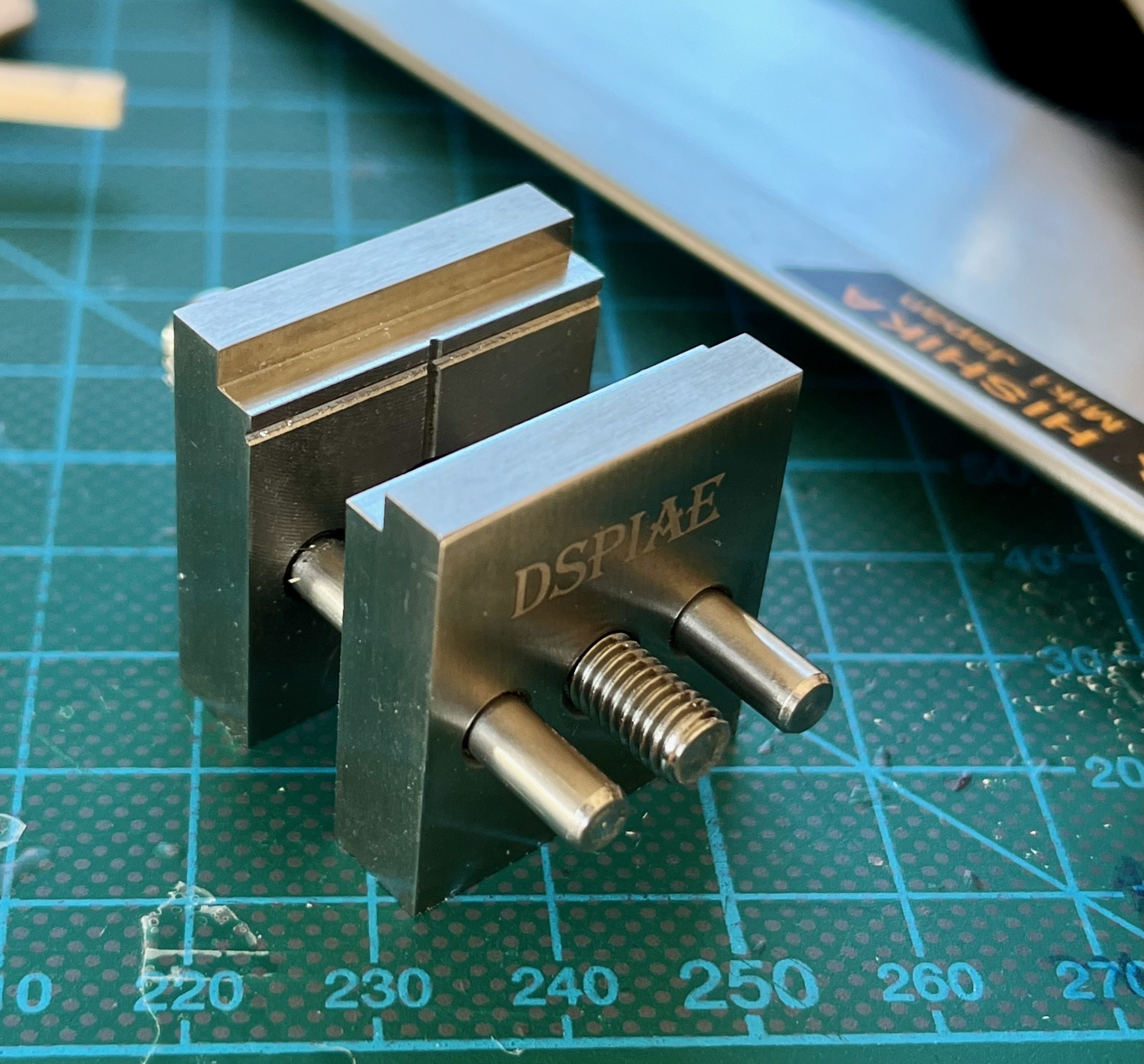

While cutting the carlings I used a new toy - a tiny vice is square and strong enough for such holding, feels very convenient for working on tiny pieces! Can recommend:
Foto2025-10-10130104.thumb.jpeg.273b6dd8c0b94dfe5aec52c6df03d794.jpegFoto2025-10-10130119.thumb.jpeg.2175f88149f1296bb7a895cf17c7460e.jpeg
The whole process is very therapeutic and is exactly what I needed. The "thinking" part is over, now it's just making tiny wooden things and cutting notches, over and over. I can sneak in a 30min session here and there, cut a few notches every day and keep progressing!
Here are all the tools that I need for a single session, keeping them close to reduce the setup time :)
Mini marking gauges are set up in advance, one for the depth and one for the height.

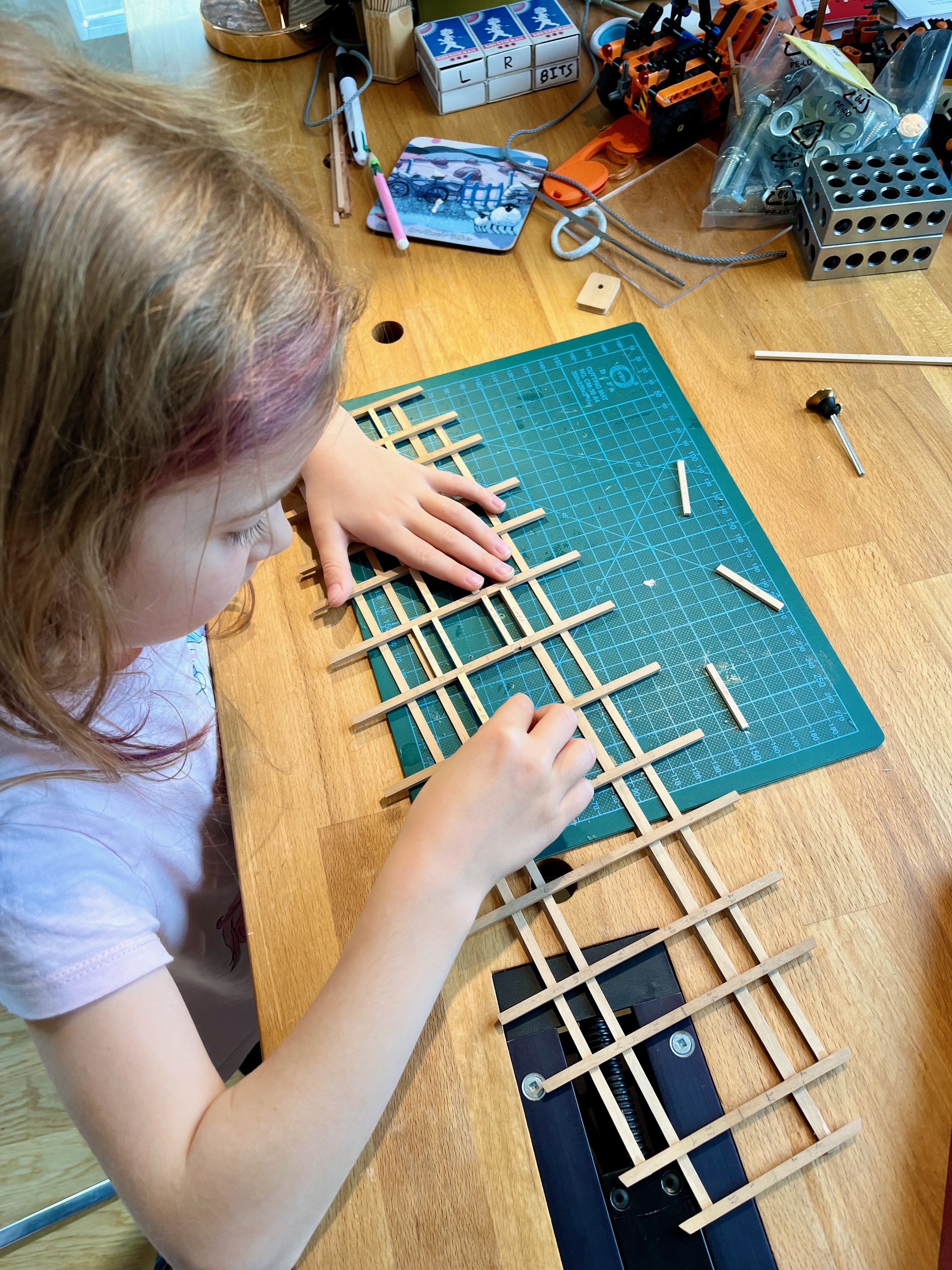

My youngest enjoyed this wooden puzzle, asking me to dry fit the deck over and over again :D  And yes, she is starting her own first build (MS Midwest Dinghy) as we speak! The build log might follow.

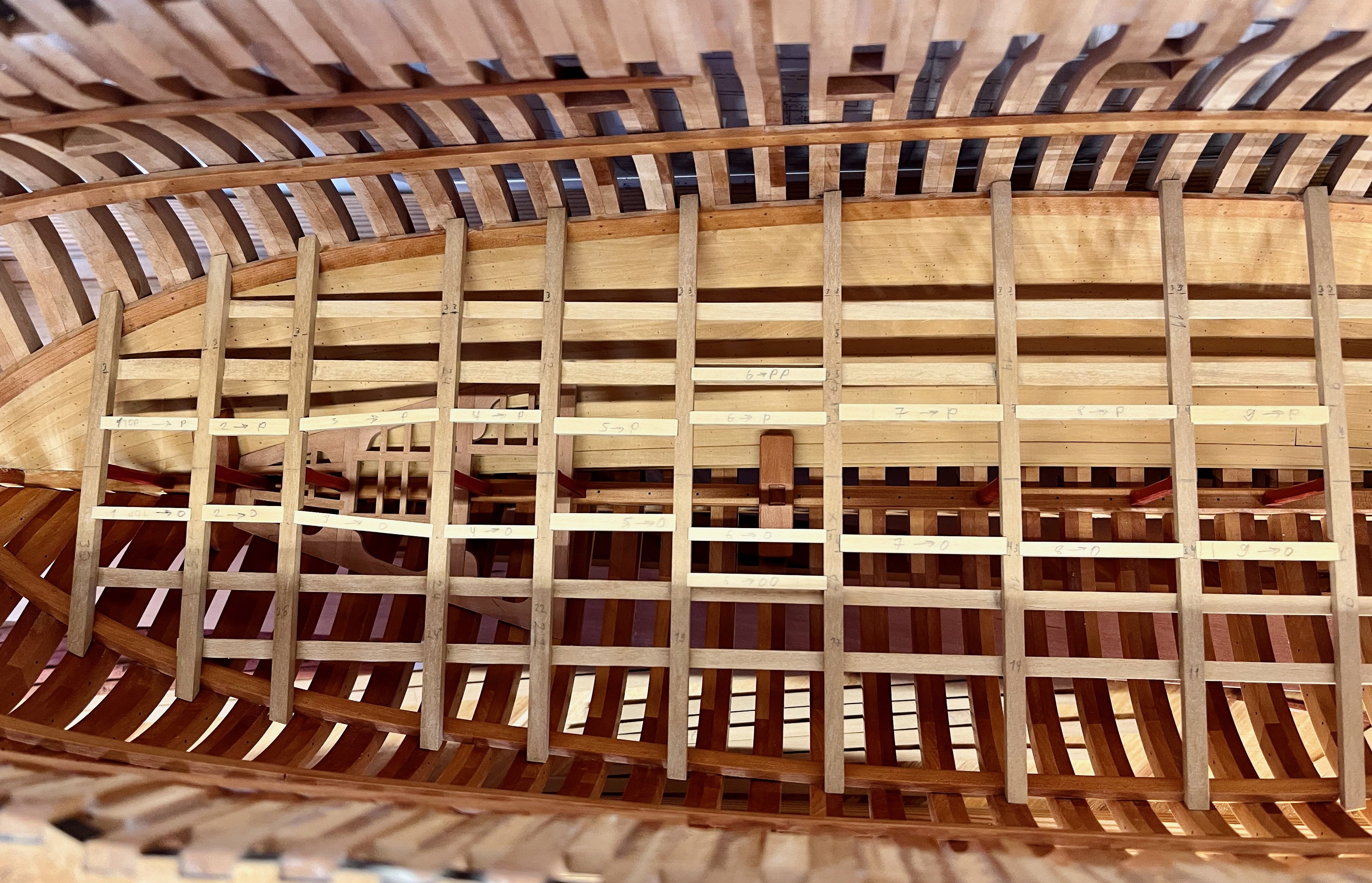

Intermediary result so far, like the contrast of the fresh wood! Only dry fit and no sanding.

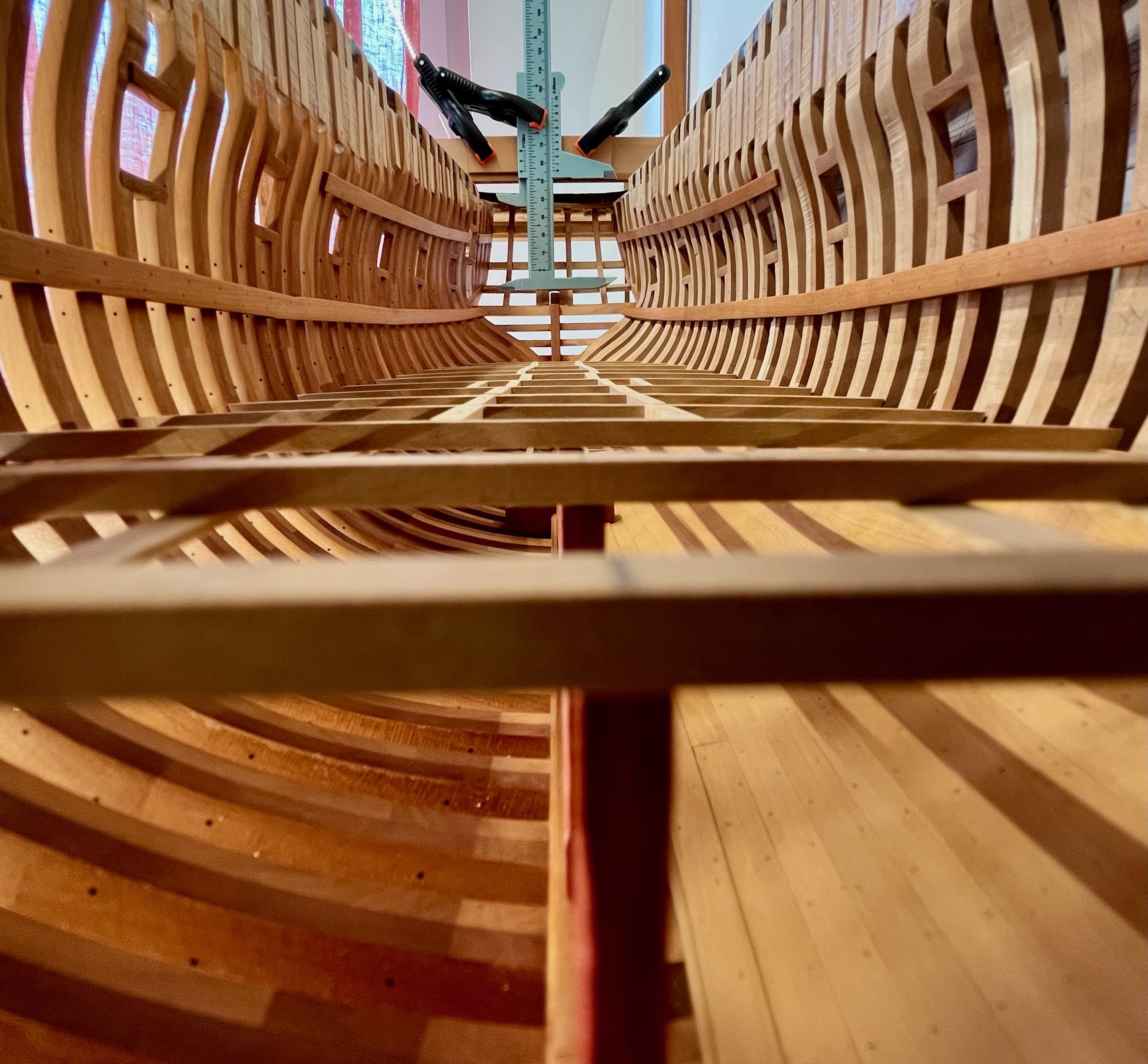

Woke up in the middle of the night - how would I remove the deck if hanging knees are installed? They are notched in deck clamps, so I can't lift it or turn it sideways. And installing them later is not possible since they sit between a beam and a lodging knee.
In the end I will be saved by omitting the hanging knees on the open side of the hull (left on this photo).
But if I would have built a symmetrical hull with both knees on both sides - then I need to somehow perfectly fit everything off the model, assemble it and then sand the deck on the model, without scratching the hull?
The magic of sanding would barely be available then… That sounds very complicated.
A lot of build logs just omit that problem, going directly to a fantastic finished result! Now I am very curious 🤓

If you figure out what the name is for that unusual ruler is, be sure to let us know! I am not finding anything like it on my initial searches.
JD
Current build: Schooner Mary Day (scratch)
Previous builds:  Model Shipways Pride of Baltimore 2, Amati HMS Endeavour, Midwest Muscongus Bay Lobster Smack, Bluejacket America, Midwest Sharpie Schooner
I got it in a local craft shop and had no idea it is somehow rare.
Can’t find it on Amazon, but it is an Arda brand. It is an Italian company, so doubt they make an imperial version.
Here is their catalogue, see page 32.
I mostly use the 30cm version, but it depends on the scale you are working in.
https://www.arda.it/cataloghi/2025/ARDA - DISEGNO 2025.pdf
But I found alternatives! Search for the ”graph ruler plastic” and you will find some others with the same idea - graduated in both X and Y axis.
Maybe Druxey can shed some light on the intended usage of such rulers in the graphic / drafting world 😊
Edited by Mike Y
The y axis markings allow one to draw a series of closely spaced parallel lines. I have a rule that works on the same principal. Glad to oblige, Mike!

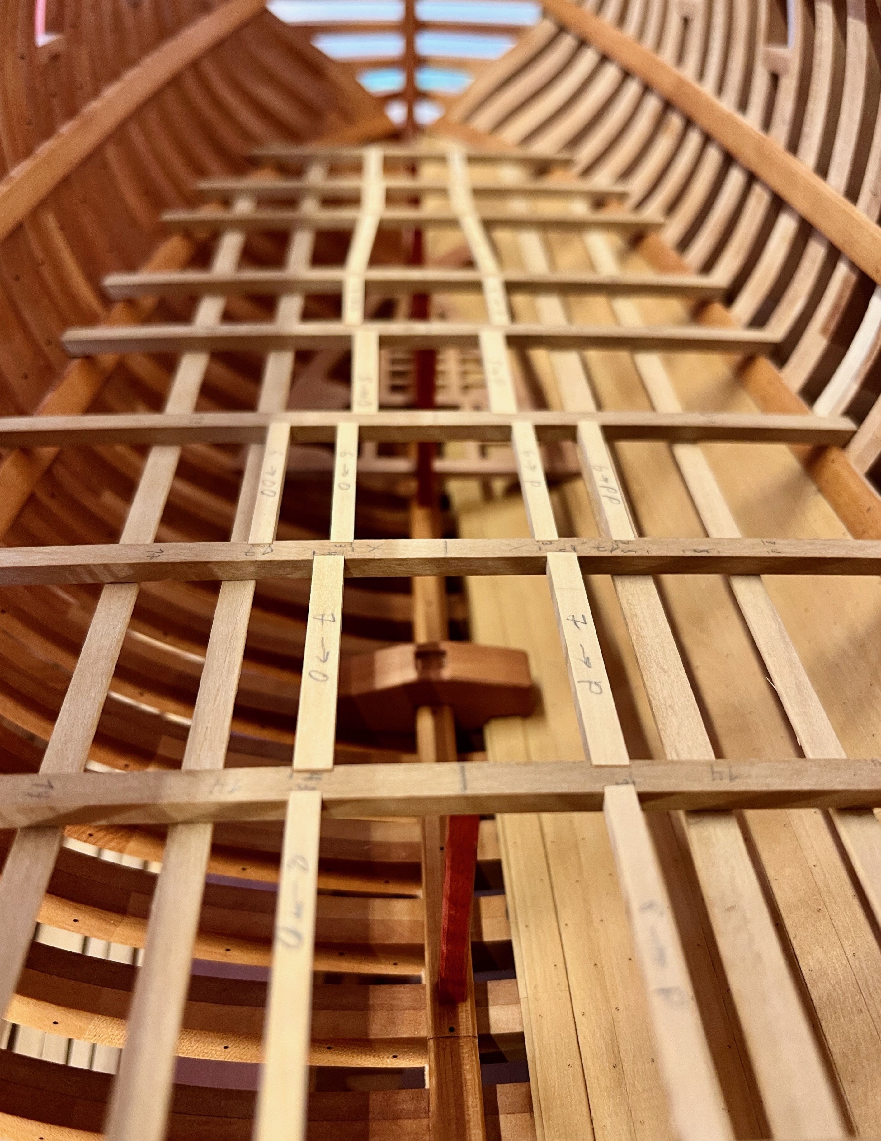

Now I have a pile of carlings ready for installation
And here they are all in place!
Notches on the exposed side are left empty to avoid obstructing the view. I might put some carlings into them later.
They needed more care than the non-empty notches, since you want all notch surfaces to look smooth and pretty, no chance to cover them with a carling later on. So I was cutting a smaller notch and then make a few final cuts once it is done, cutting off any tear-out.
That concludes the carling phase, next in line are the lodging/hanging knees and ledges!
