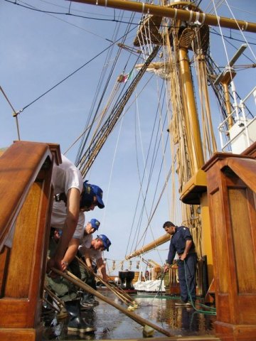

Hi Fabius, you are really a great help for me, thank you again very much!
Due to your help, lots of the ropes I could now identify. Still a problem is for me, that multiples of the ropes are labled with the same words, but it is not clear, to which sail they belong. I think I have to make my own assignment.... But nevertheless, also this plan does not fit totally to the real pictures.....
Now I am running in the next problem, After a long time, I took a look into the kit (the last months I made only things which had been anyway not within the kit) and I had to discover, that the kit contains only ONE black and ONE brown rope! No different type of ropes, the same for everything! And I had to discover, that the kit contains only ONE sort of blocks, no more! I will have to sort out the different rope-types and their thickness!
Following the links below, you can see lots of different blocks from the Amerigo (pictures from a dockyard time of the vessel):
http://www.congedativespucci.it/galleria/camp2006/images/57.jpg
http://www.congedativespucci.it/galleria/camp2006/images/56.jpg
http://www.congedativespucci.it/galleria/camp2006/images/50.jpg
So I know, what I have to do......
It is a bit disappointing, that such an expensive kit does not contain suitable material and plans for the rigging.
