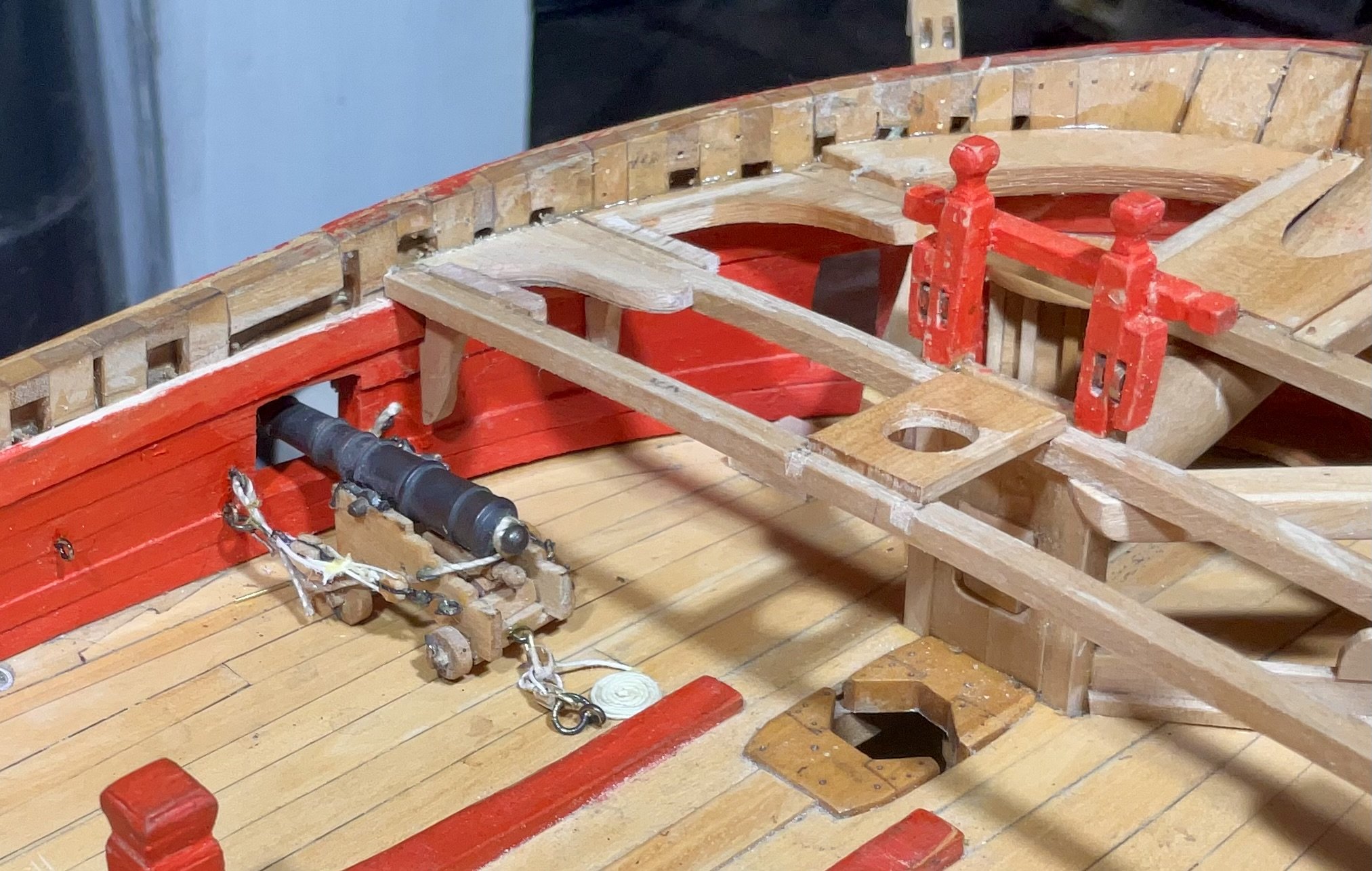

Finial fitting of the lower Capstan. I had to fit the last two beams which are slightly wider than the rest to be able to get the finial height of the barrel. . Then added the partner and adjusted the Barrel so it is just above the level of the partner. That is it for the year as I am off to NY to cut down a christmas tree and role in the snow. Thank goodness for alcohol.
PS no time square for us. We are going up to Kingston, up to a tree farm, using a regular saw to cut down the Christmas tree and hall it home on the roof of the car. We have not had a white Christmas for a very long time, so i am going to be happy to freeze my *** of this year. A few concerts are on the agenda and lost of good food.
