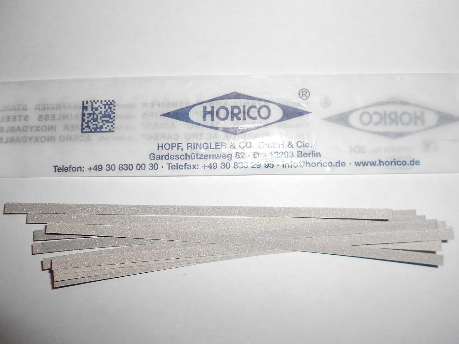

On 4/12/2017 at 2:09 AM, wefalck said:
- so-called separation strips. These are used to file the sides of teeth or false teeth. They are abrasive material of various grades on a backing of either Mylar or stainless steel. For the time being I got some Mylar ones, which I bought to make sanders for my filing machine and the micro hand-sander I built. I have not being able to identify an on-line source for the steel-backed ones. One may need to buy directly from the manufacturers: http://www.horico.de/en/neuigkeiten/2-uncategorised/91-alle-streifen.html. The Mylar-strips are about 5 mm wide, while the steel ones come in width down to 3 mm. As you can see in the link, Horico also makes fine-toothed steel-strips, i.e. saws.
- There is also one provider for something like a miniature hacksaw that uses the above steel sawblades or abrasive strips: http://www.ebay.de/itm/172605444198?_trksid=p2060353.m1438.l2649&ssPageName=STRK%3AMEBIDX%3AIT.
I have not seen this on offer somewhere else and this offer appears to be rather pricey. Haven't tried this yet.
I found you can get these polishing/separator strips on Amazon. The stainless steel ones appear to be spring steel coated with diamond so very promising, I ordered some yesterday. The mylar ones look good also and I ordered some of them, but they're more or less flexi-i-file pieces so they might be just a better replacement for those.
How much did you actually pay for these HORICO Stahlcarbo® strips ? The only Amazon-offer I saw today seems to be grossly overpriced. So far I only found suppliers that would only sell to professionals or traders, but not to private persons. May have to contact the manufacturer directly.
$19.45 delivered for 12 diamond-coated stainless steel strips, and they seem to be made well and should last quite a long time. I'm disappointed they're only on .007" steel, I was hoping for a bit stiffer. But if nothing else you can make lots of really useful semi-files out of these and that's what I intend to do.
I might pick up some of the wider 6mm strips also. BTW all manufacturers seem to sell coarse/med/fine grit but no indication of how that maps to normal diamond sharpening stones and the like.
That's the kind of price I saw on Amazon, while dental supply-houses in Germany charge around 4 to 6 € for the dozen plus shipping ... actually the 30x series is not diamond-coated, but carborundum-coated according to HORICO. The diamond ones have a different number.
The thin steel backing with a total thickness of 0.1 mm made them particularly interesting from my point of view, as you can widen narrow slots and the likes with them. No other file or sanding-paper is that thin.

5 hours ago, Kurtrjohnson said:
With regards to the dental abrasive strips, which coarseness is the most practical for use on wood, fine, medium or coarse?  What sandpaper grit are they similar to, 400, 600, 1000??  They sound very interesting.
Kurt
As I mentioned, not really sure, but I would start with the fine grit. The medium that I tried last night was maybe 100 grit(?) and I assume the coarse is going to be more for reshaping than sanding.
Thanks, That gives a point of reference, they're much coarser than I would have imagined. I thought the fine would of been too fine to be of much use. I use flexigrit now, but the metal backing should really be a plus. I'll have to give them a go.
Kurt
Member: Ship Model Society of New Jersey
Give me a couple days to play with them, I just had a few minutes to experiment with them this evening and I may rate the medium more like 220. But regardless I think these are going to be really handy for making various sanding/filing tools, I'm going to mount them on some brass pieces and also some spring steel pieces but you could use wood in most cases.
Also, this brand is definitely diamond :) But a bit more expensive at $12 for 5 pieces. But still used on wood they should last almost forever so I think either the Horico ones or these are going to be good purchases.
Send them an email last nigth, enquiring, whether they could deliver directly to a non-professional. They called me up this morning, curious what I was going to use them for. I had to 'confess' that it was for modelling purposes. We then had a nice chat about the applications and needs. In fact, HORICO did offer the strips and other tools from their range to a modelling supplier, but somehow it did not catch on. They realised that they would need some sort of holder for the strips. I gather, they are thinking about this market. Their carbide rotary tools seem to be of good quality, but rather expensive for us modellers - even when you consider that these burrs my last a modeller's life, there is always the risk that you break a small 25 € tool ... That is probably, why they could not sell to our market.
In any case, exceptionally they will send me my strips :)

On 4/28/2017 at 2:45 PM, Kurtrjohnson said:
I received a set of the medium strips, I'd say they're like 600 grit maybe finer. I think the coarse might be more useful over all.
Kurt
I finally ended up estimating 325-400. But I think you're right, coarse is what we mostly need and I'm waiting on some coarse ones to be delivered.
