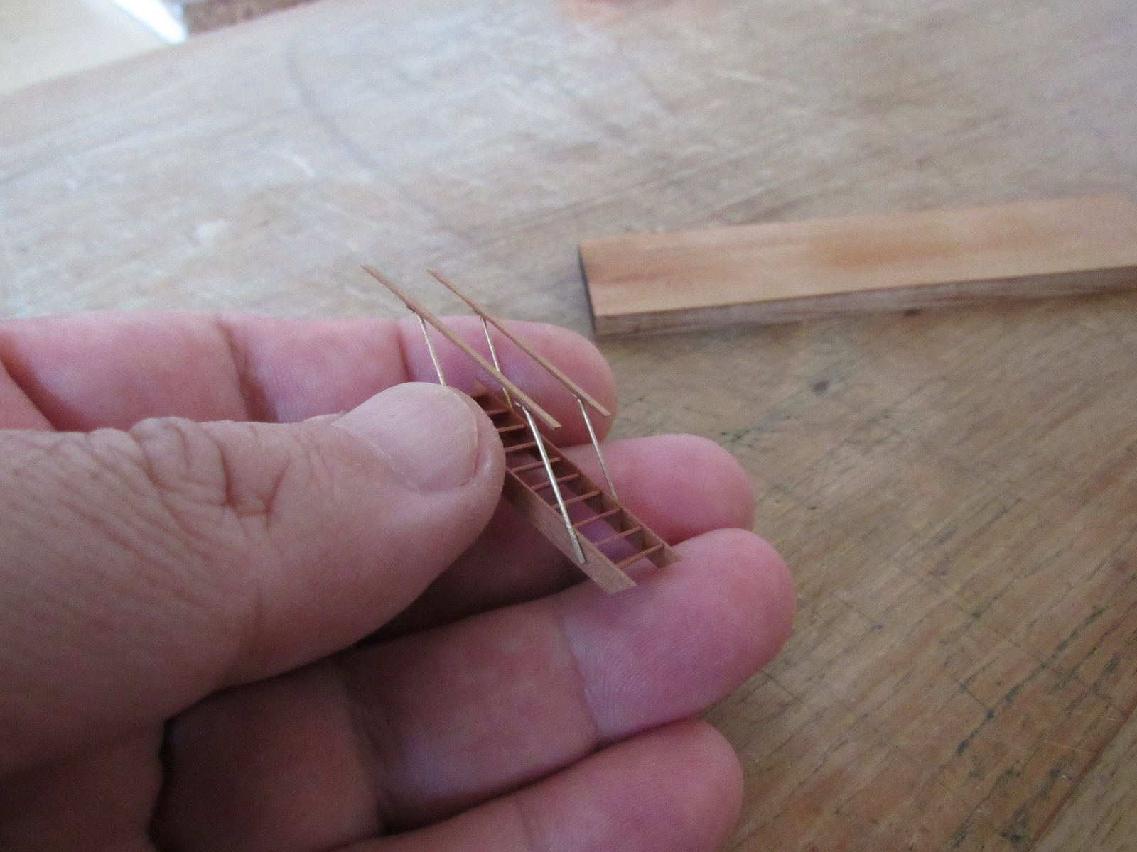

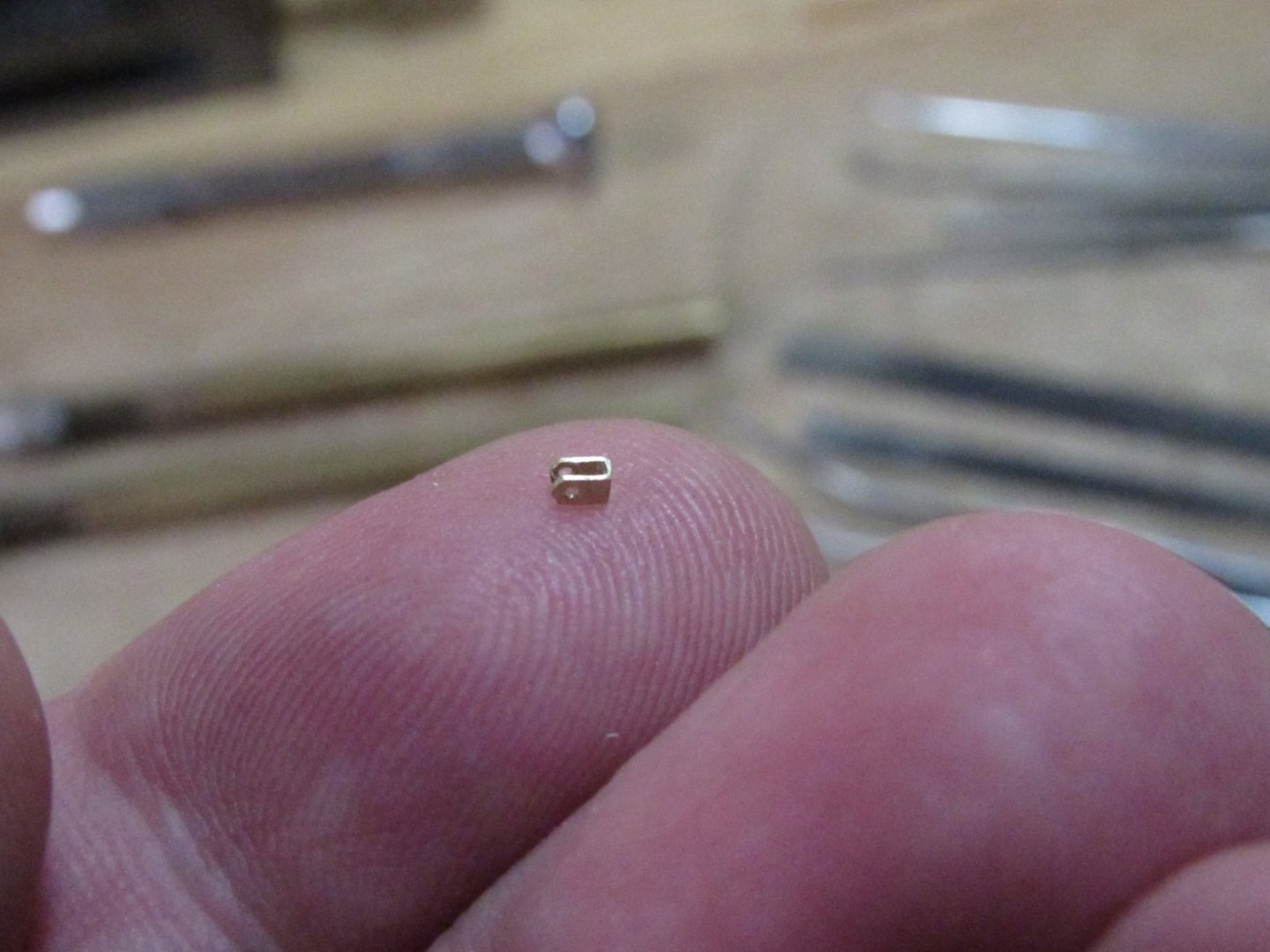

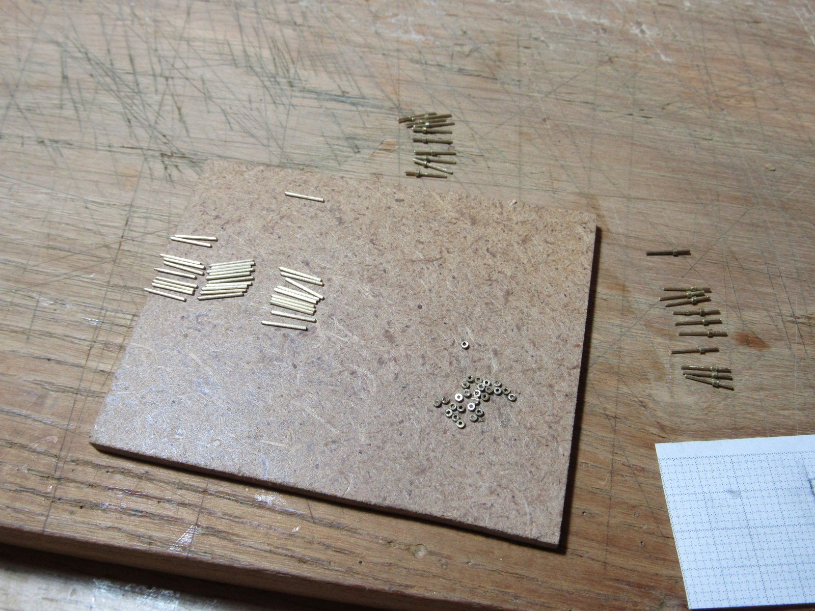

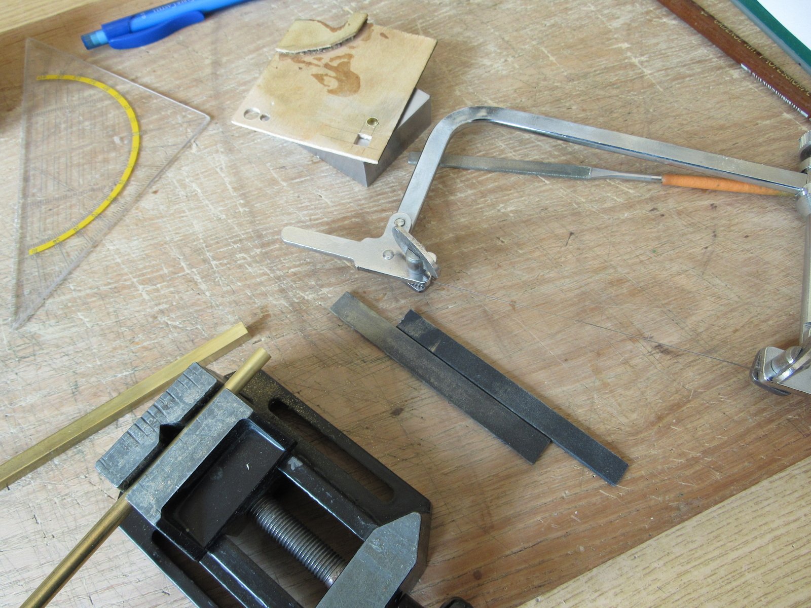

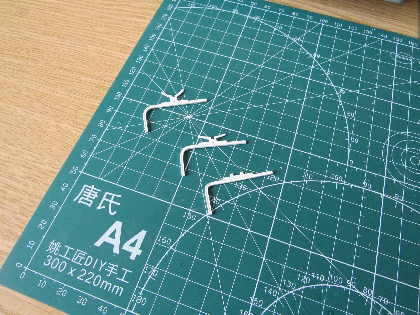

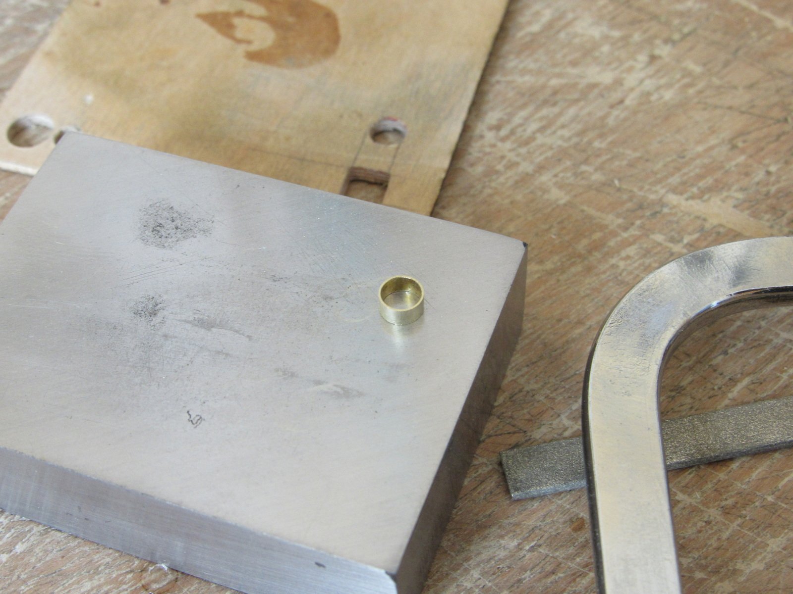

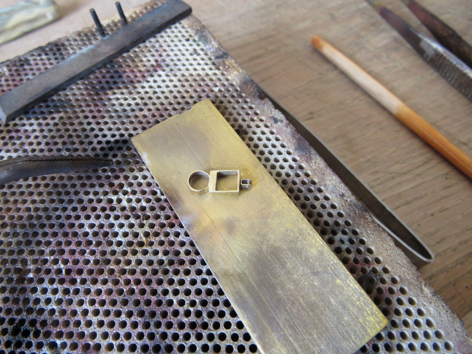

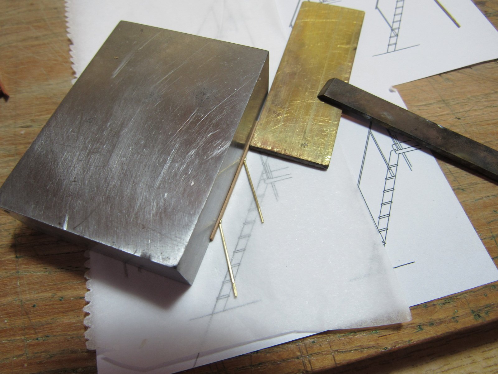

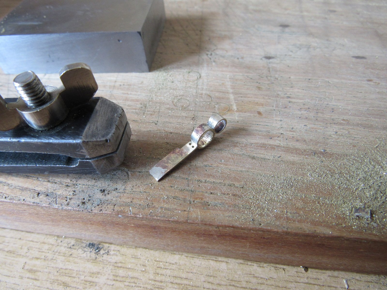

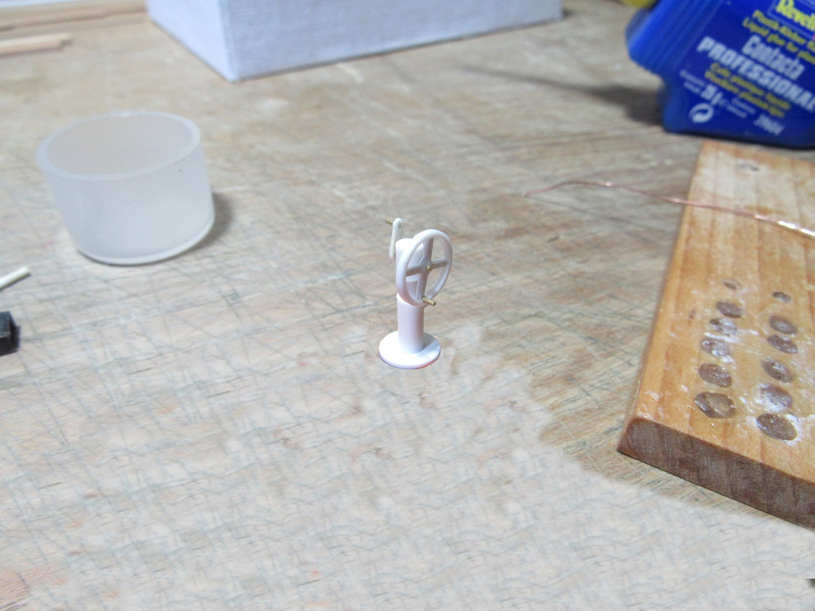

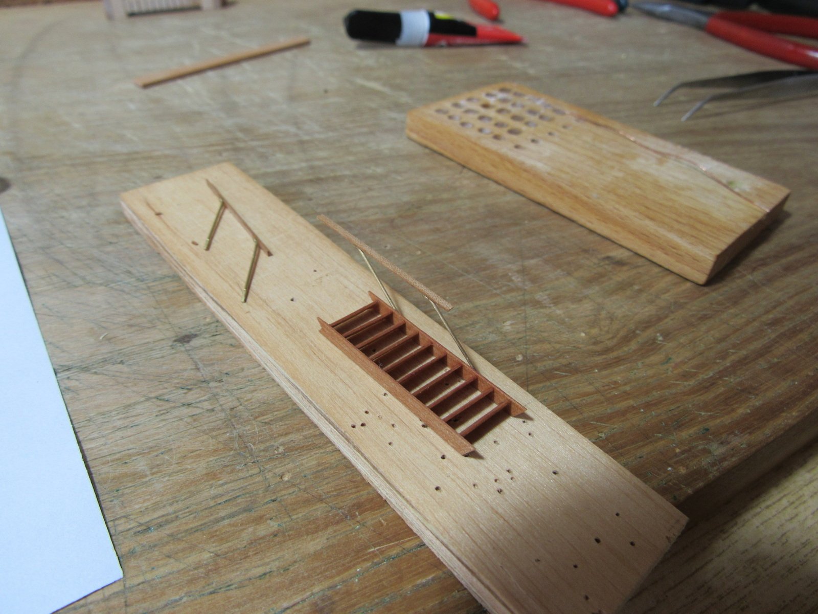

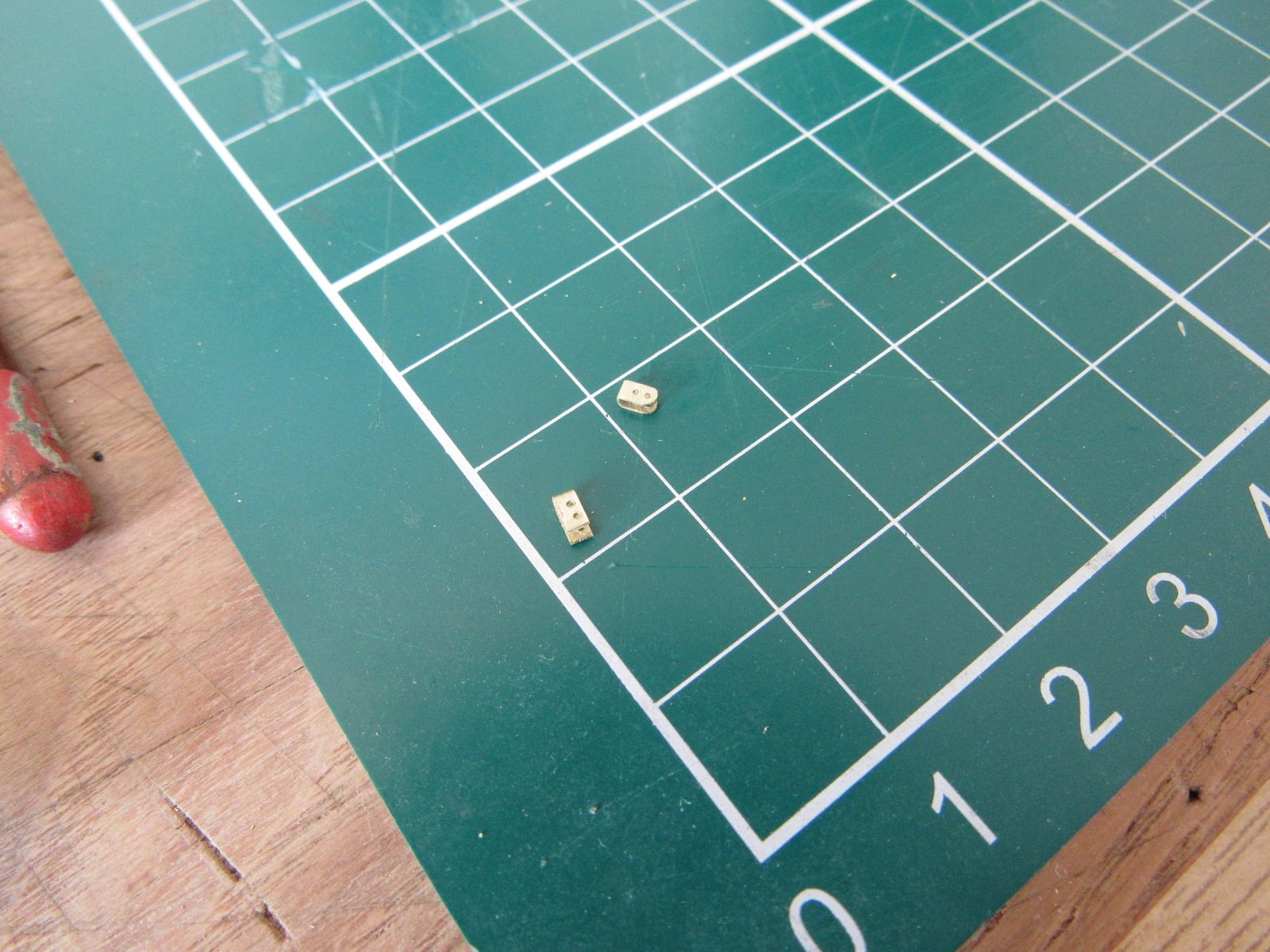

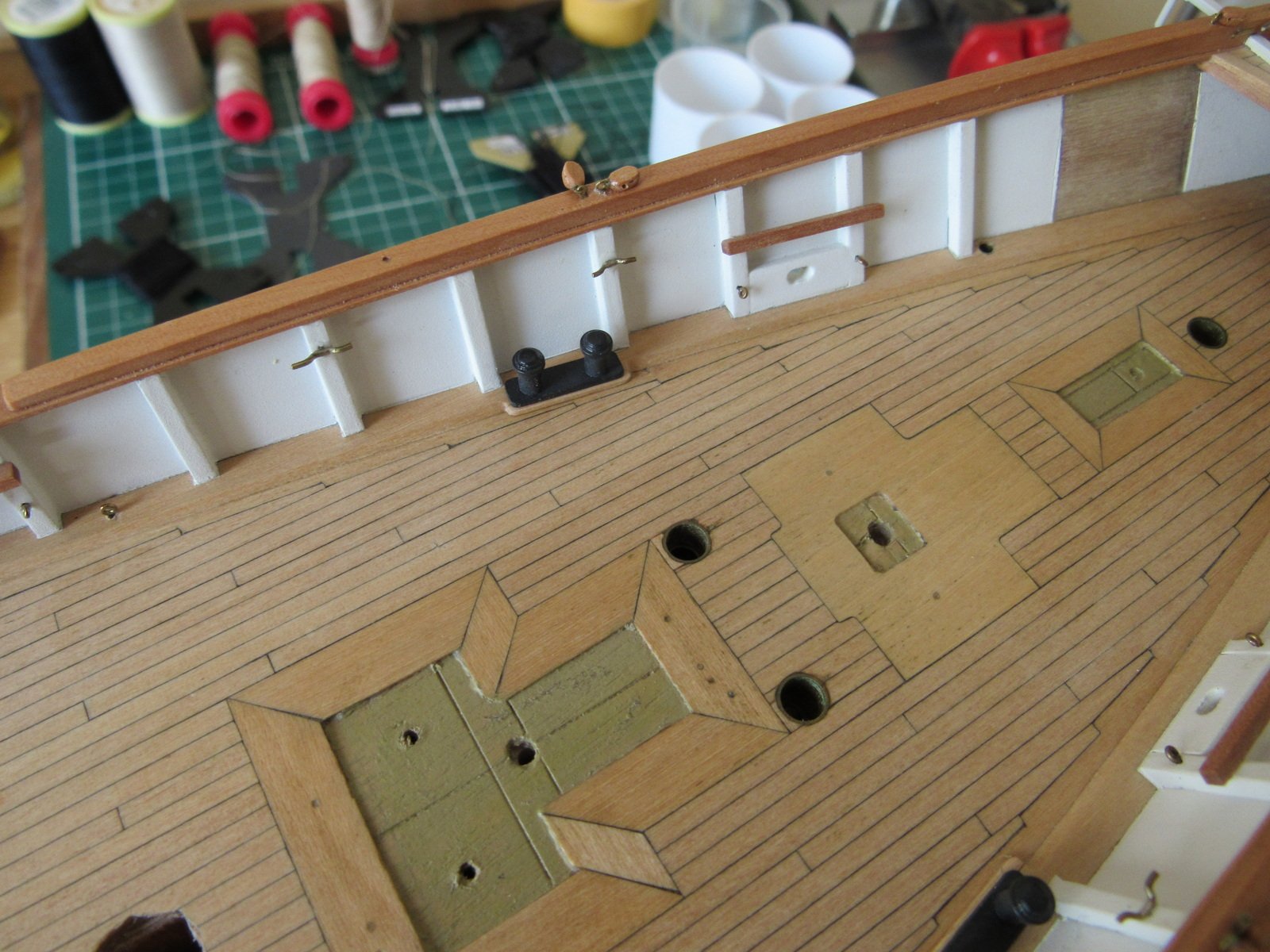

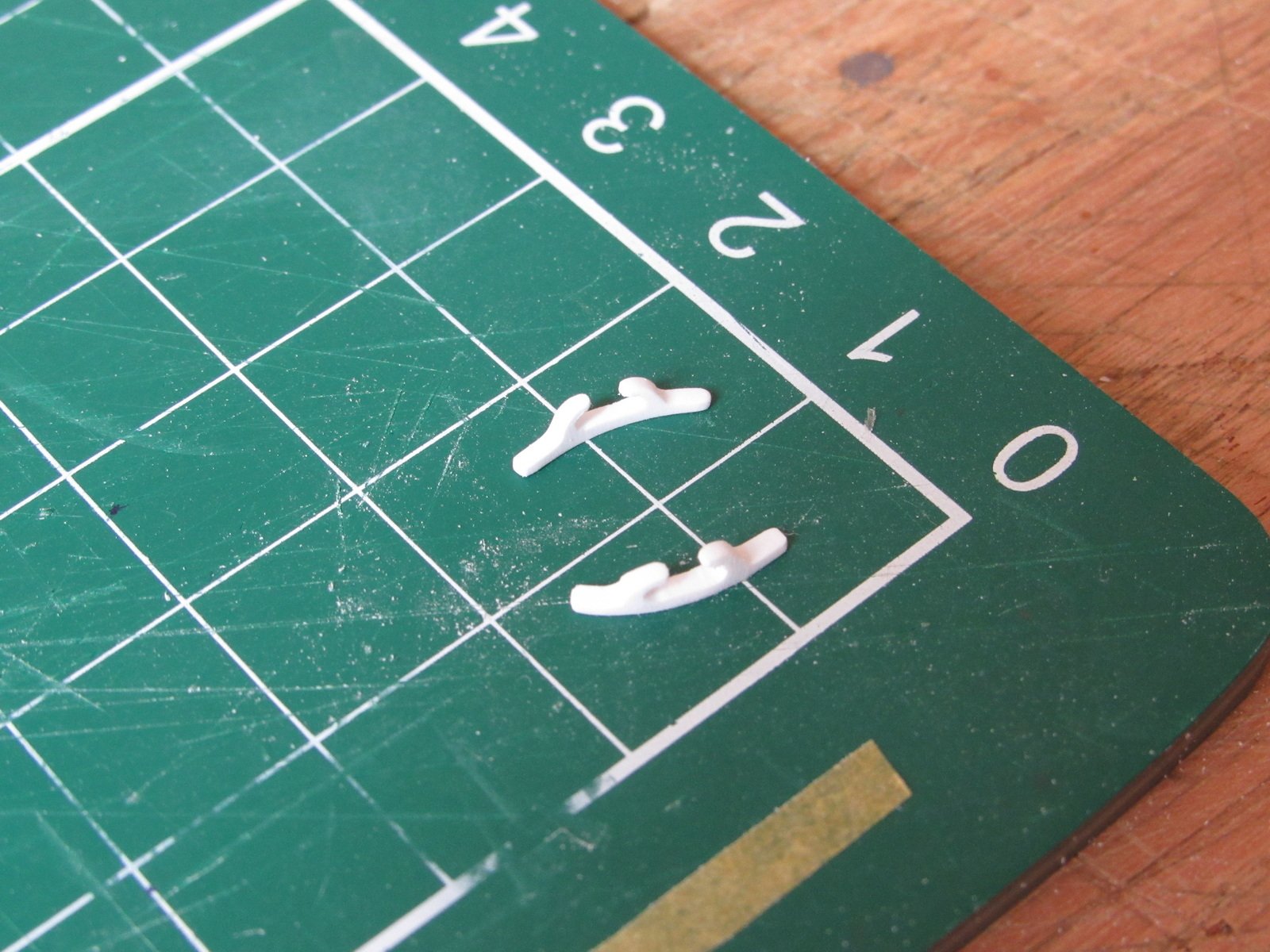

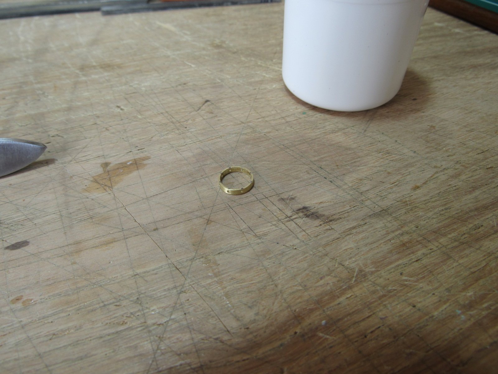

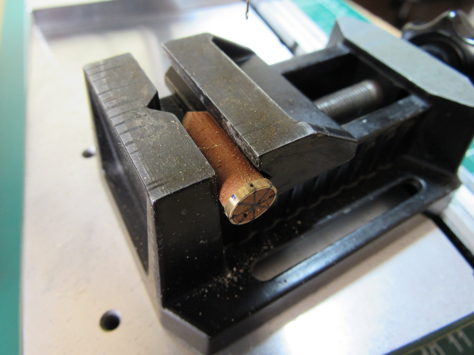

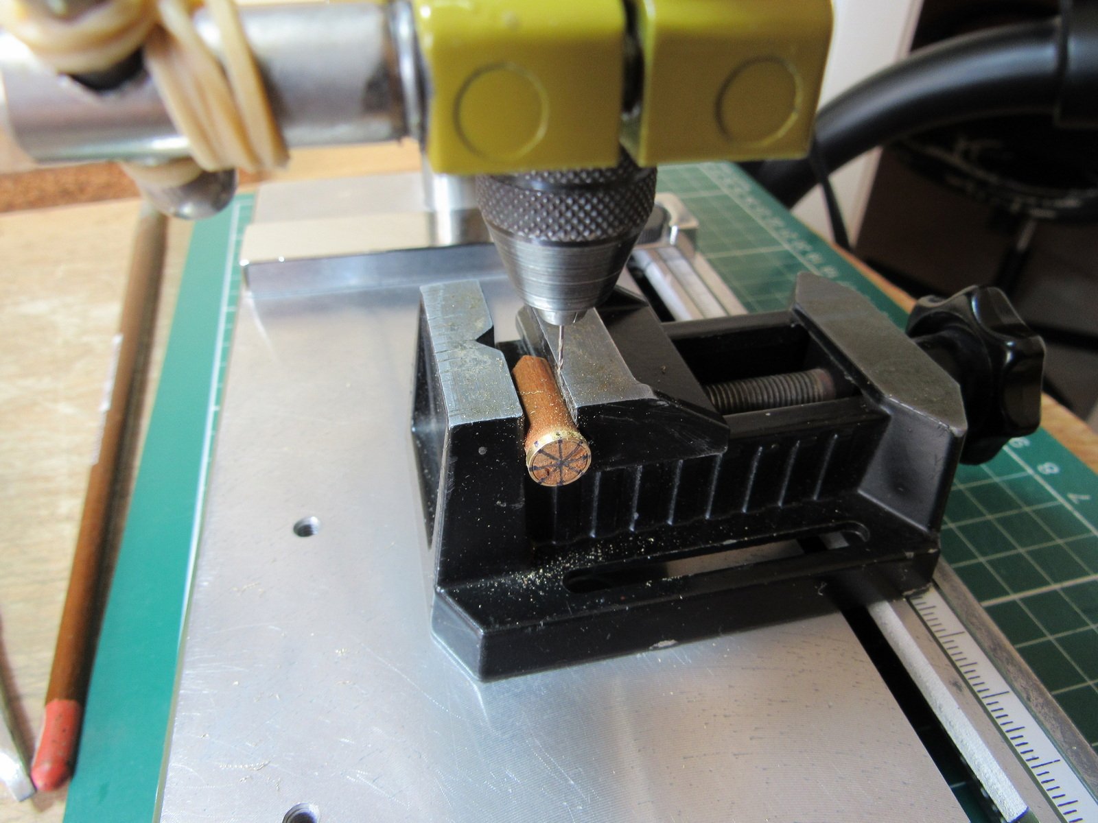

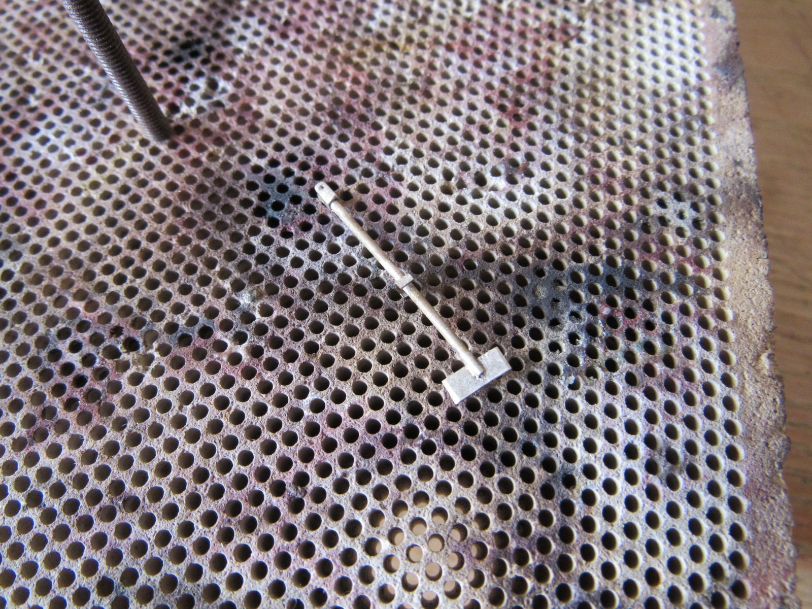

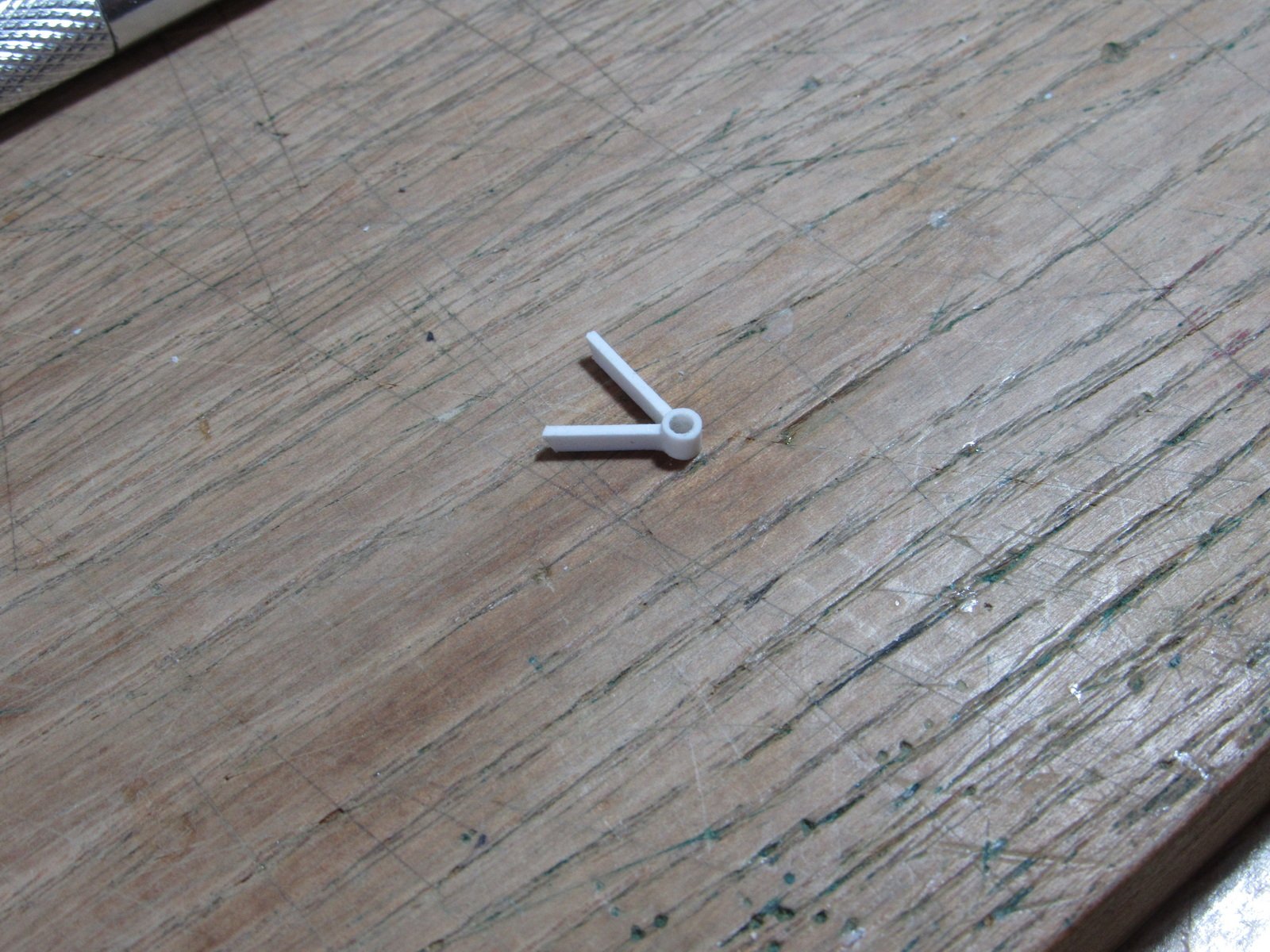

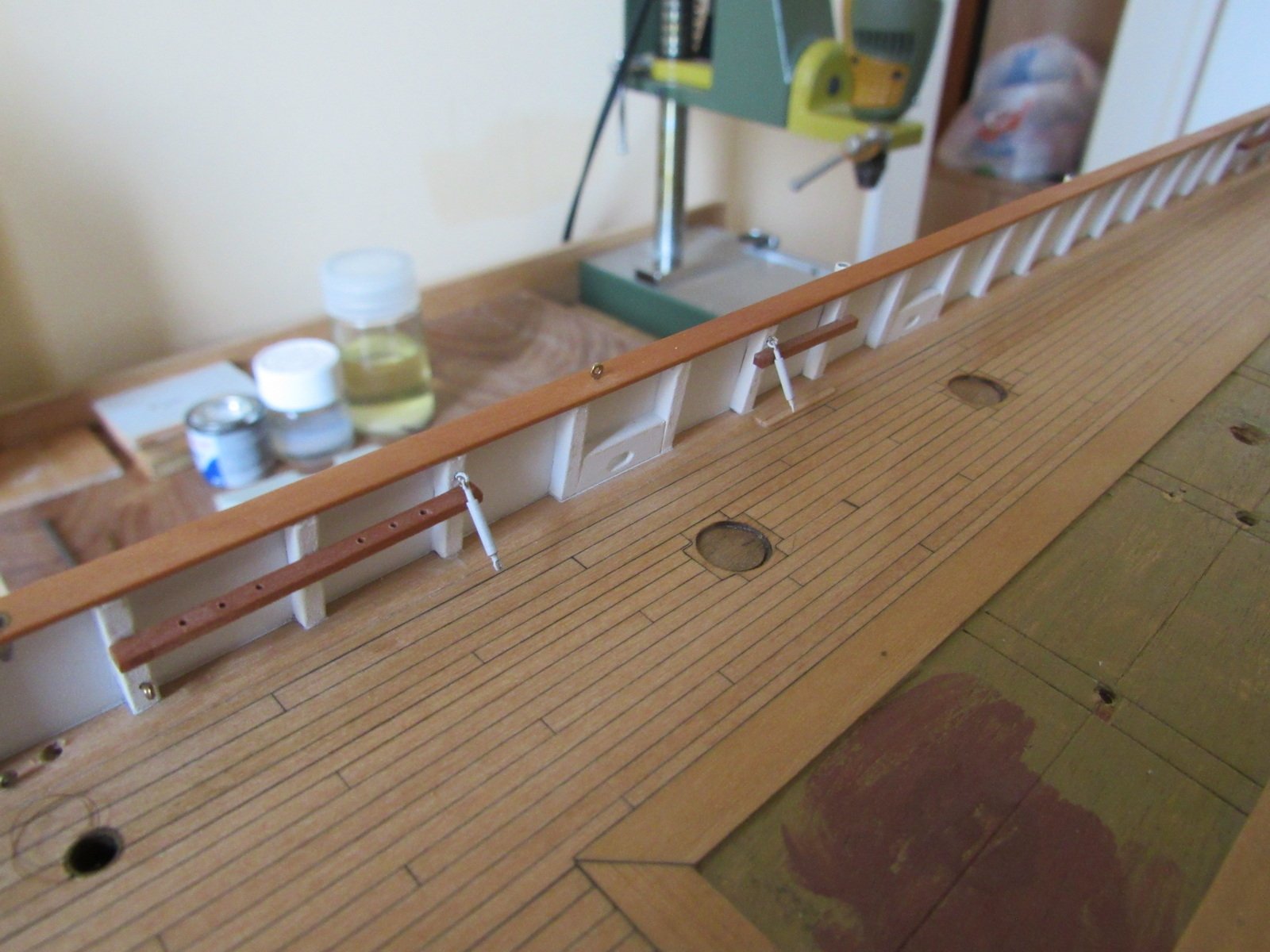

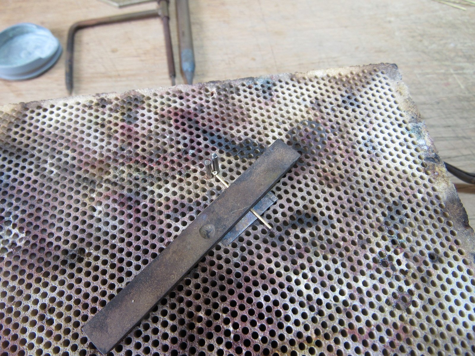

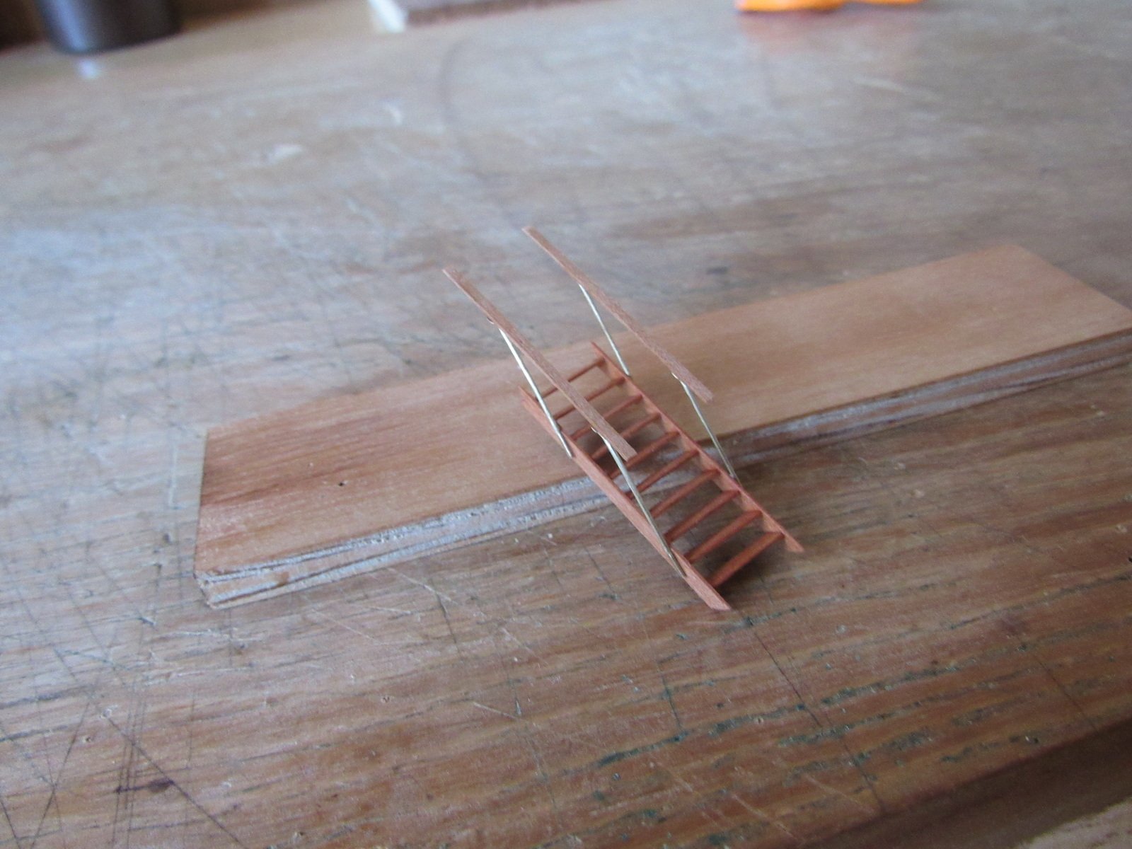

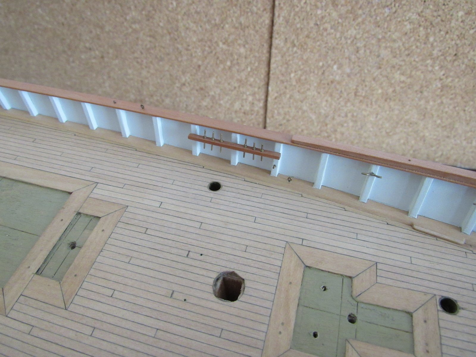

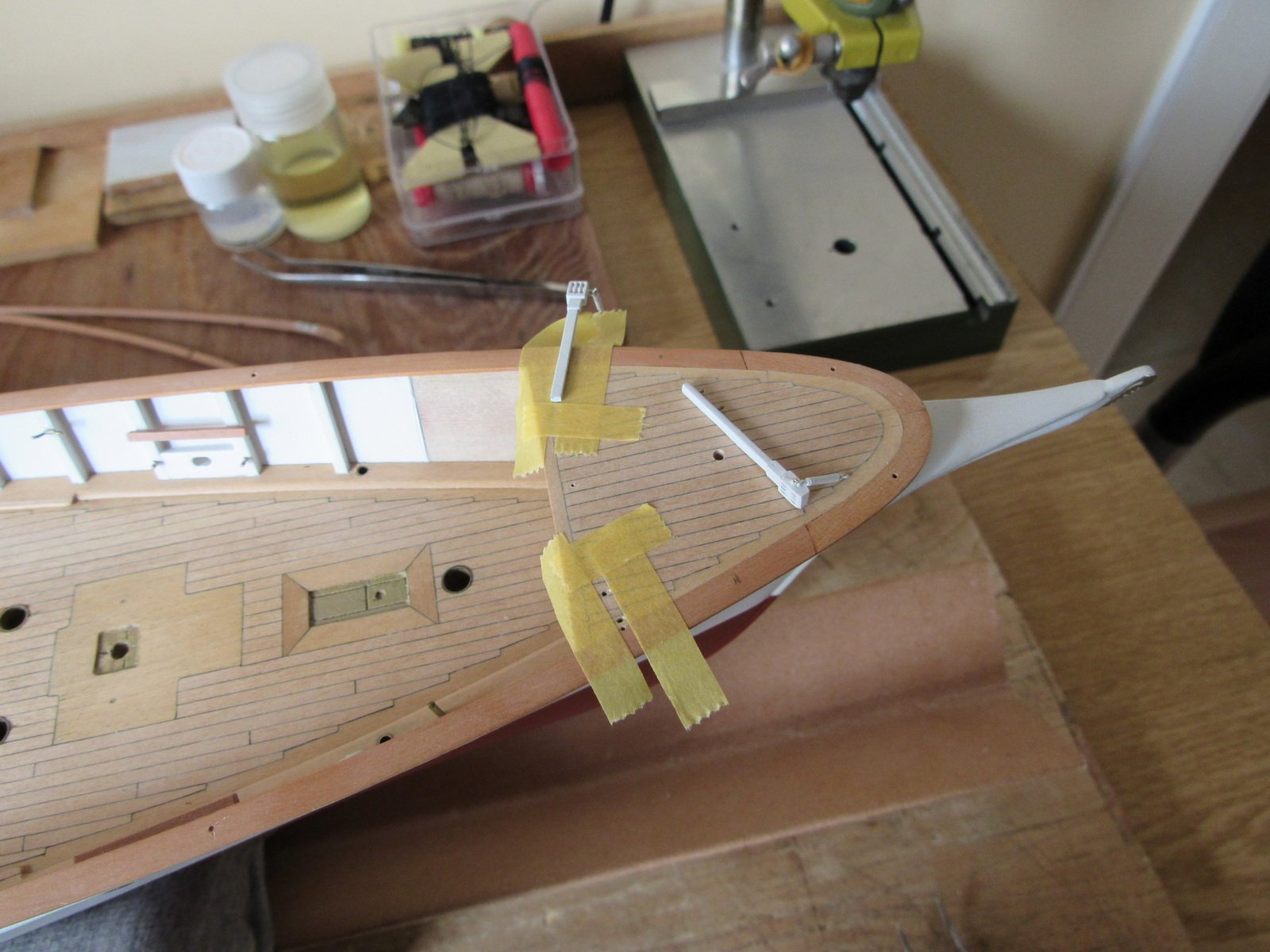

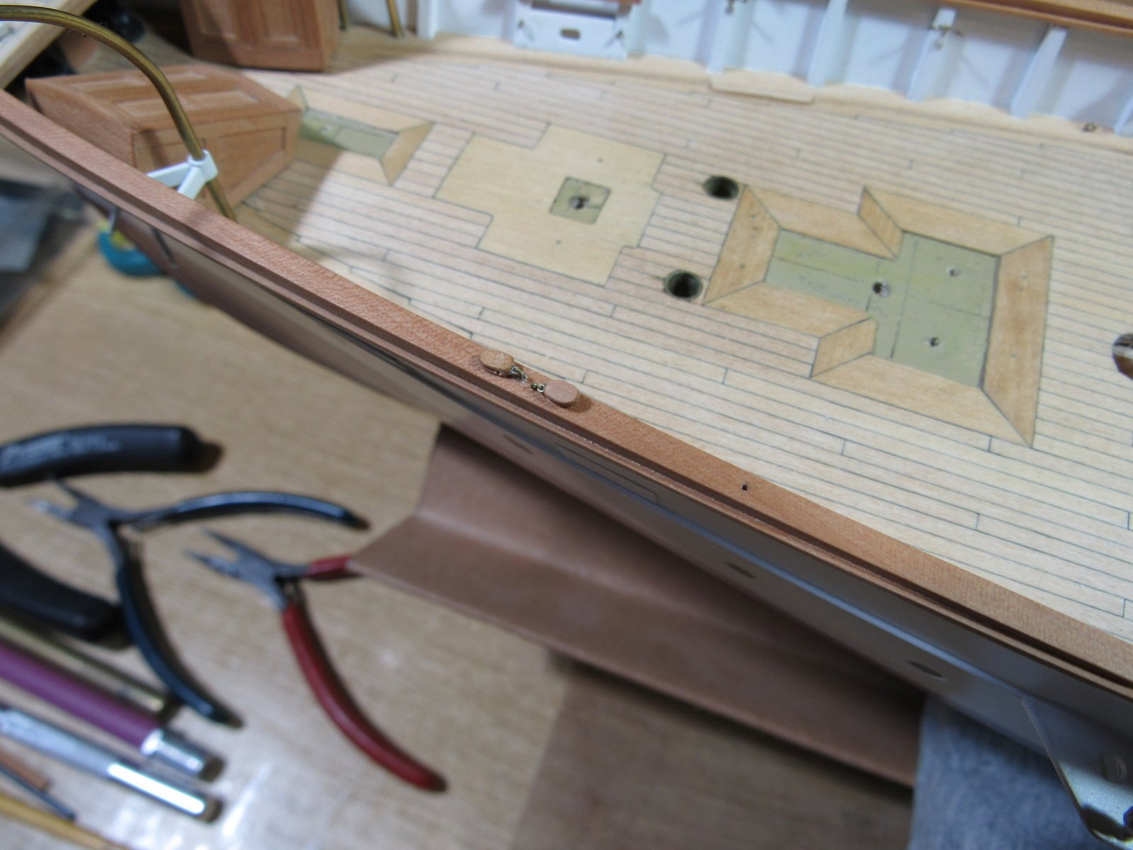

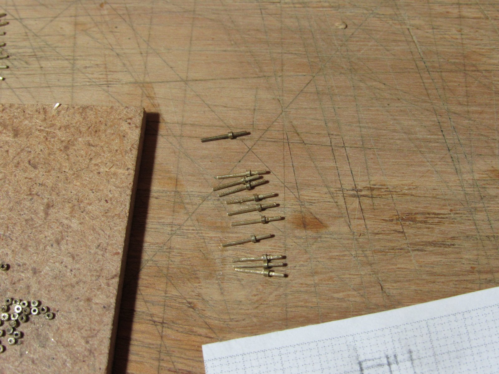

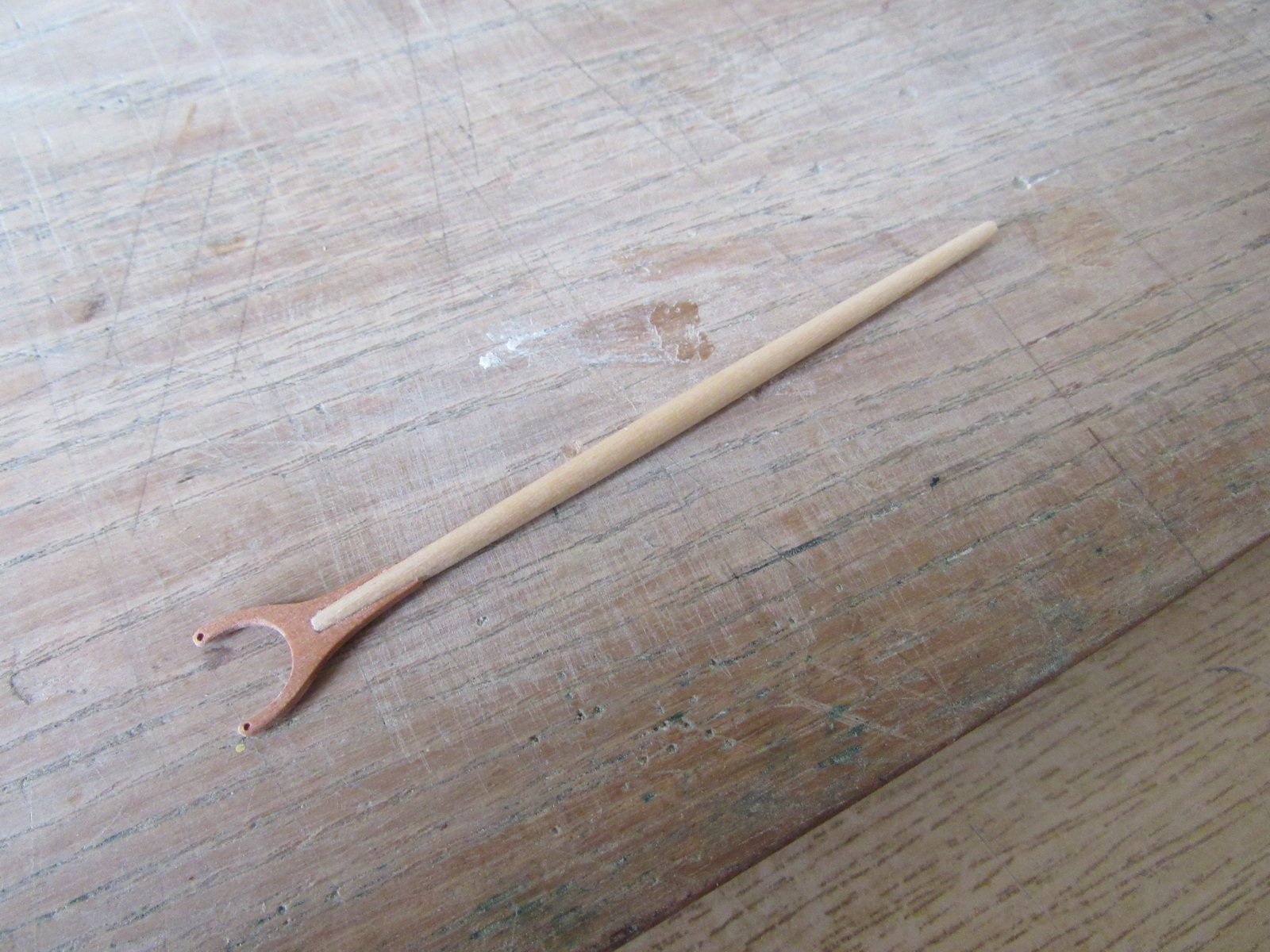

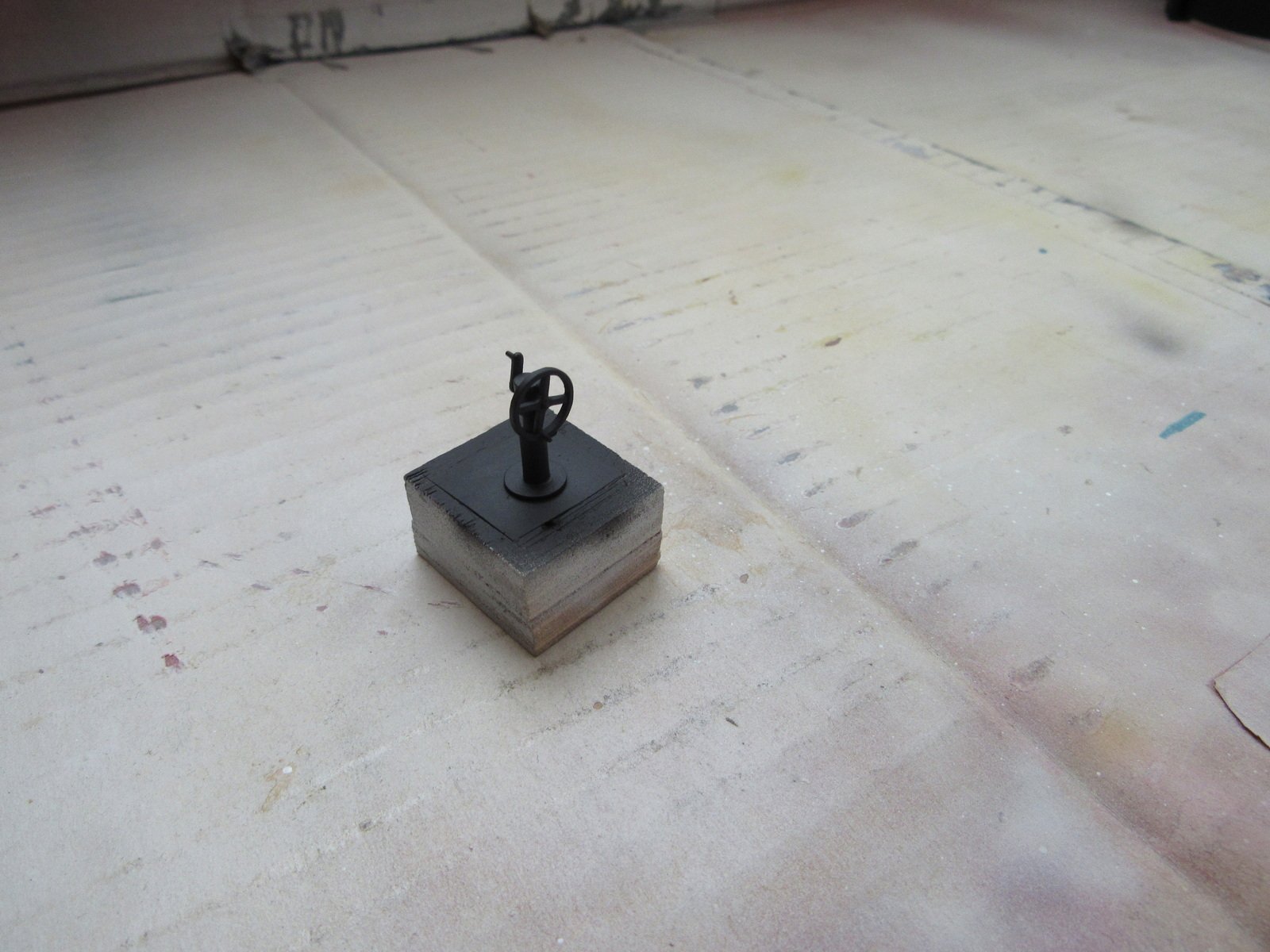

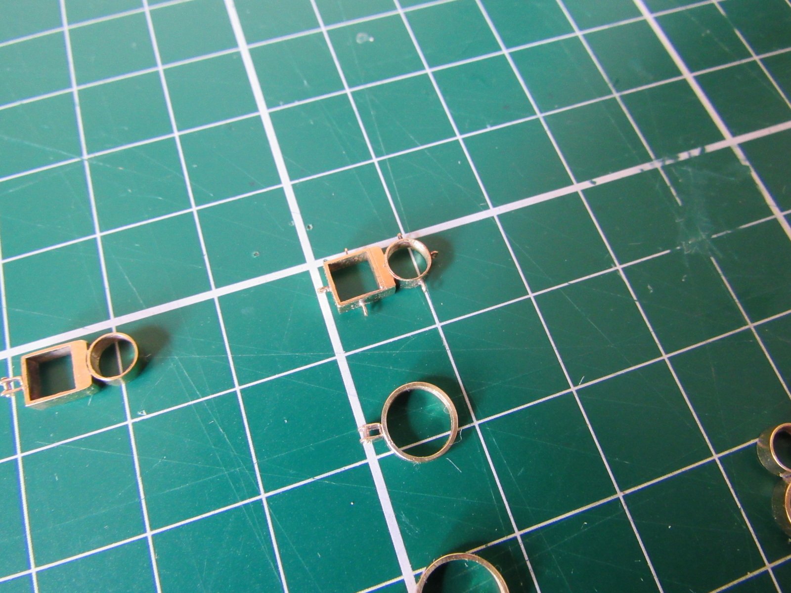

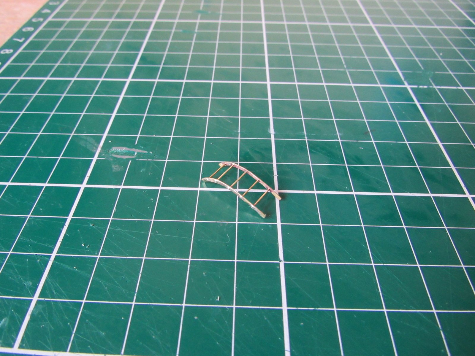

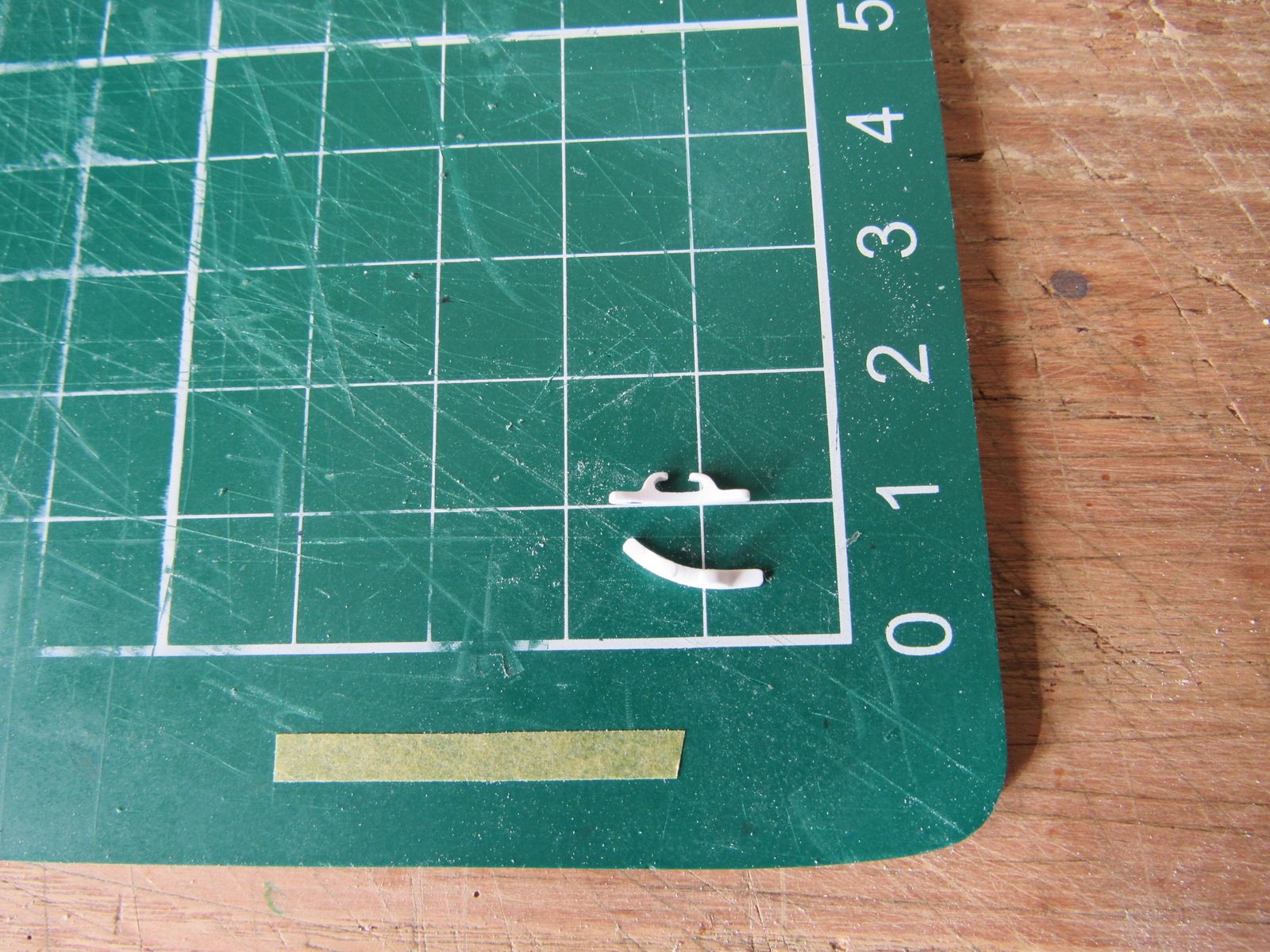

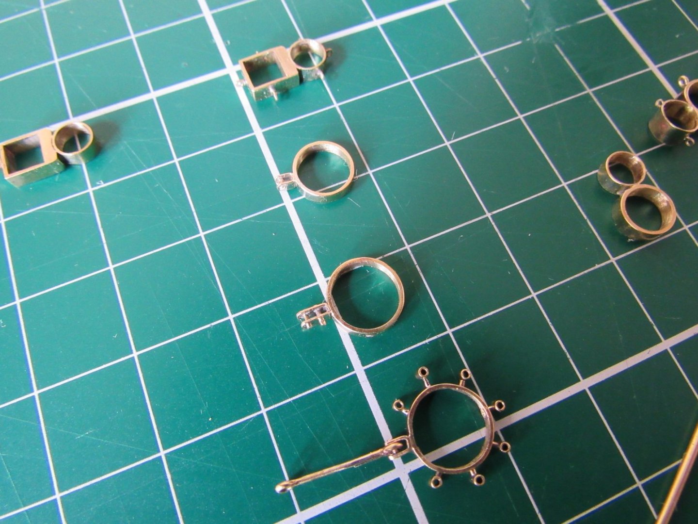

Various parts
-Belaying pins
-Fairleads
-Bilge pump

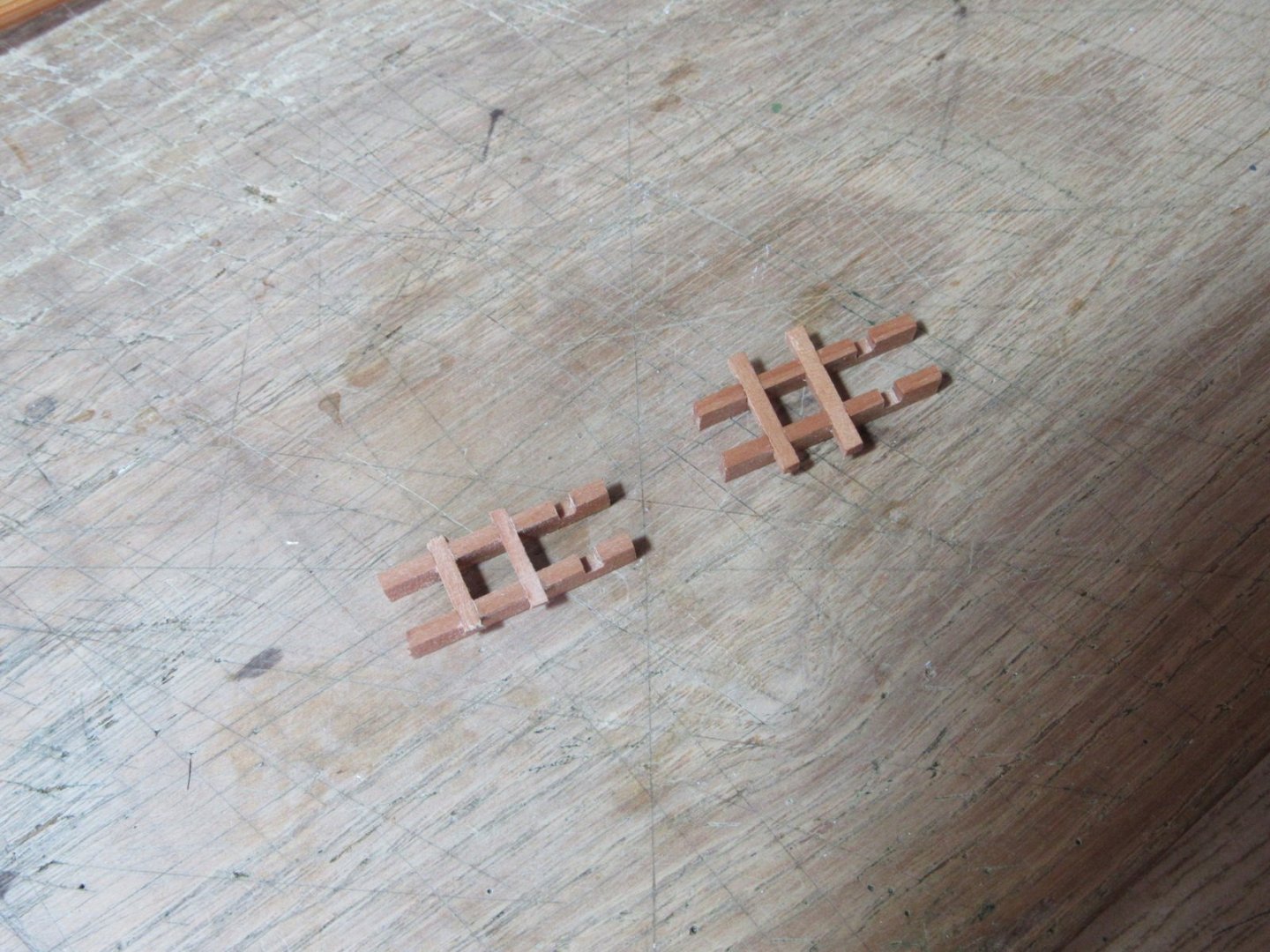

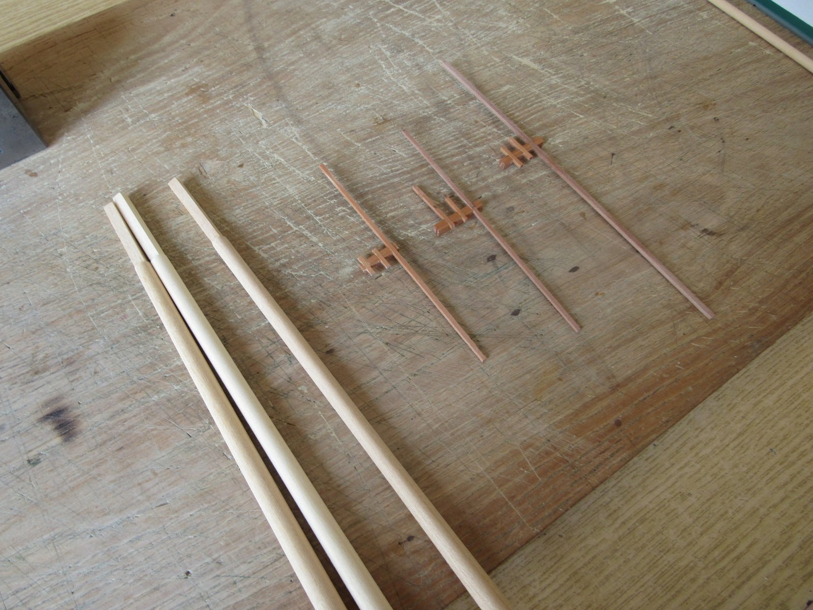

-Ladder to the bridge
-Ladder to the forecastle
-Cradle for steam launch
Edited by Ilhan Gokcay

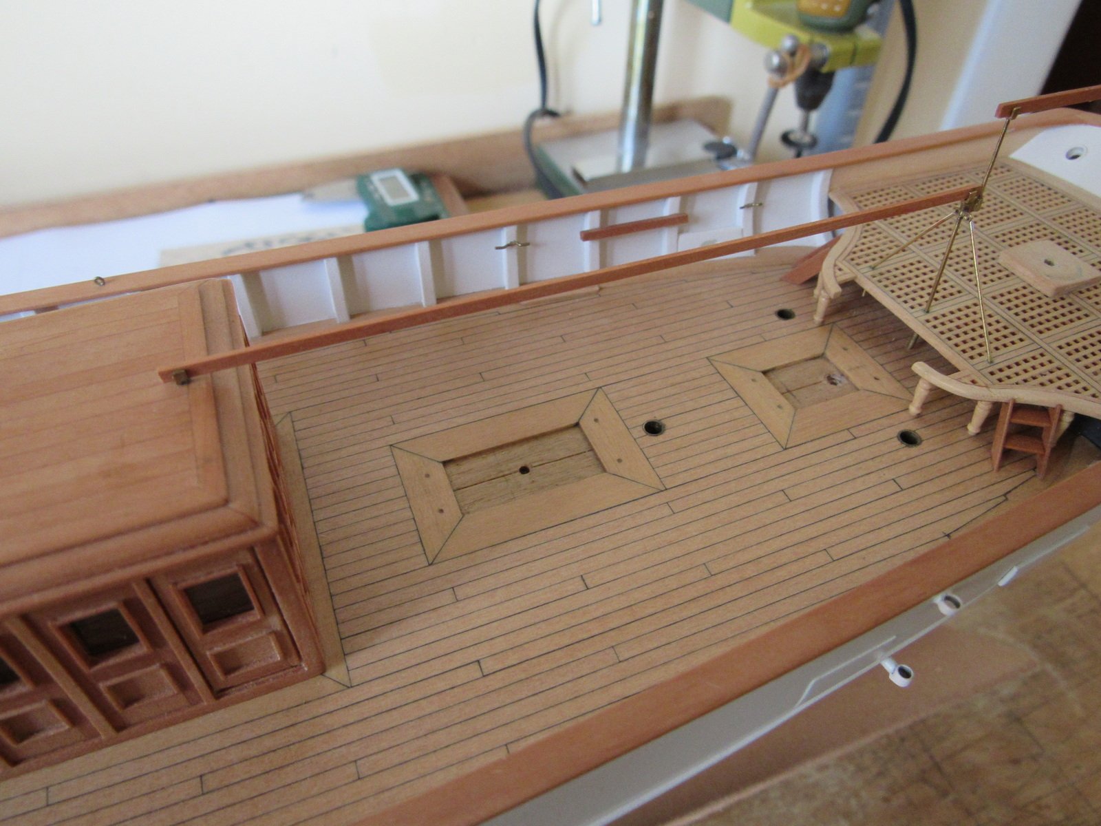

All parts finished.  Happily back to hull.

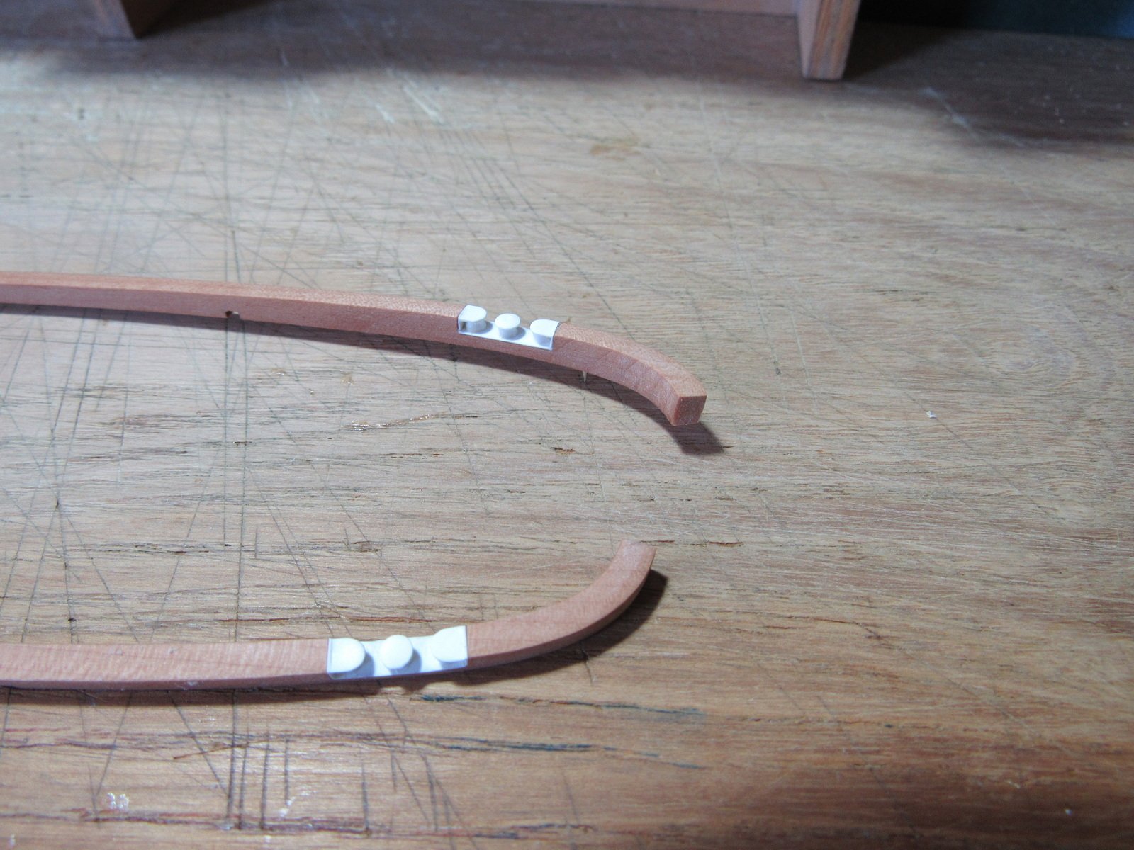

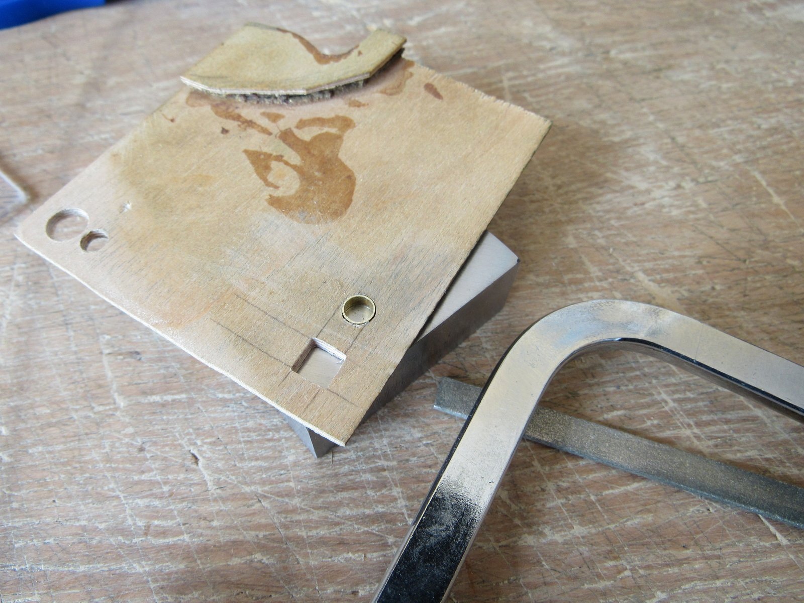

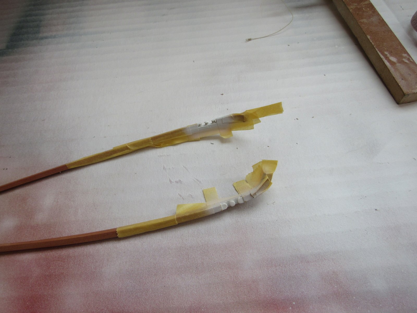

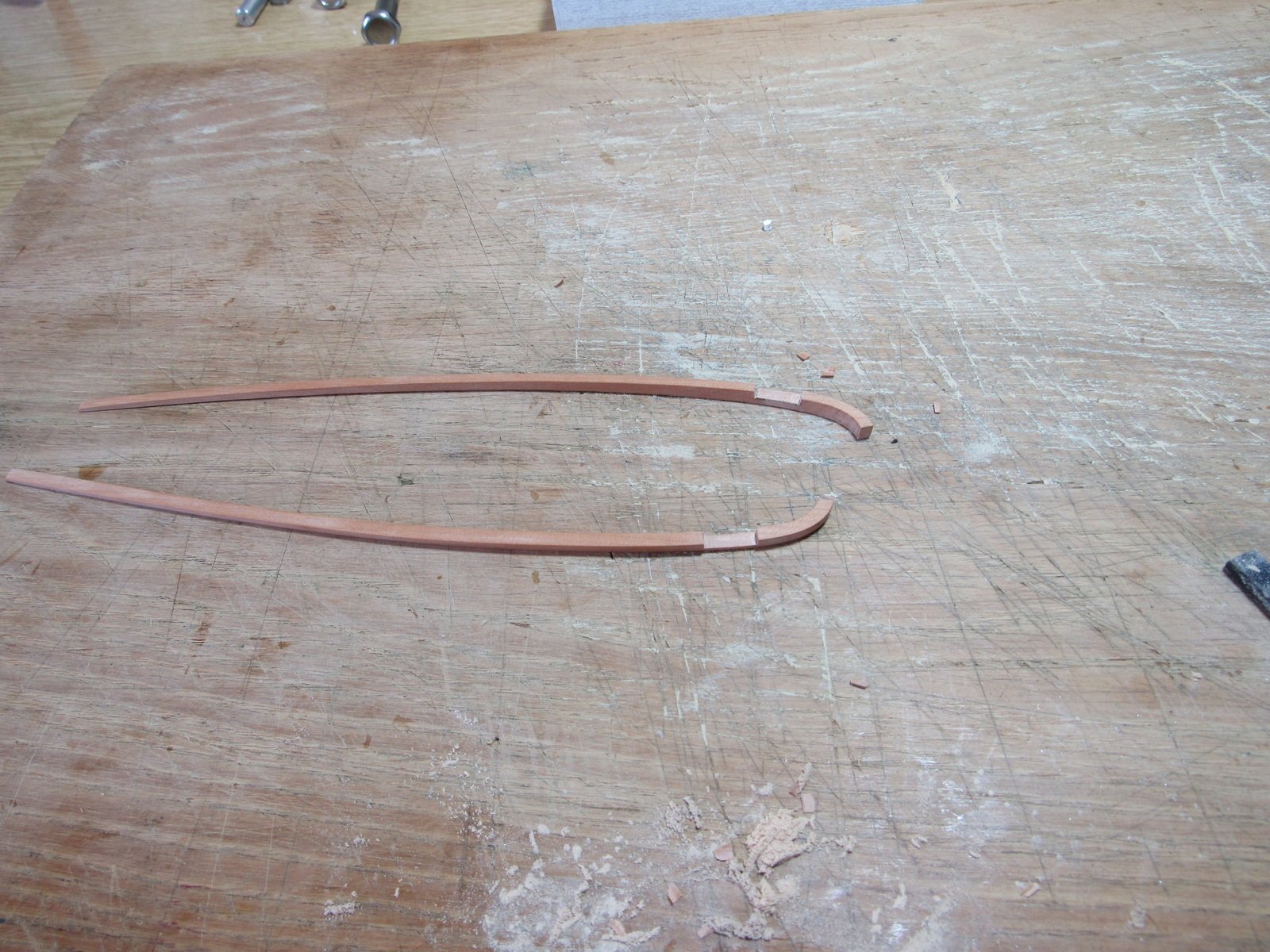

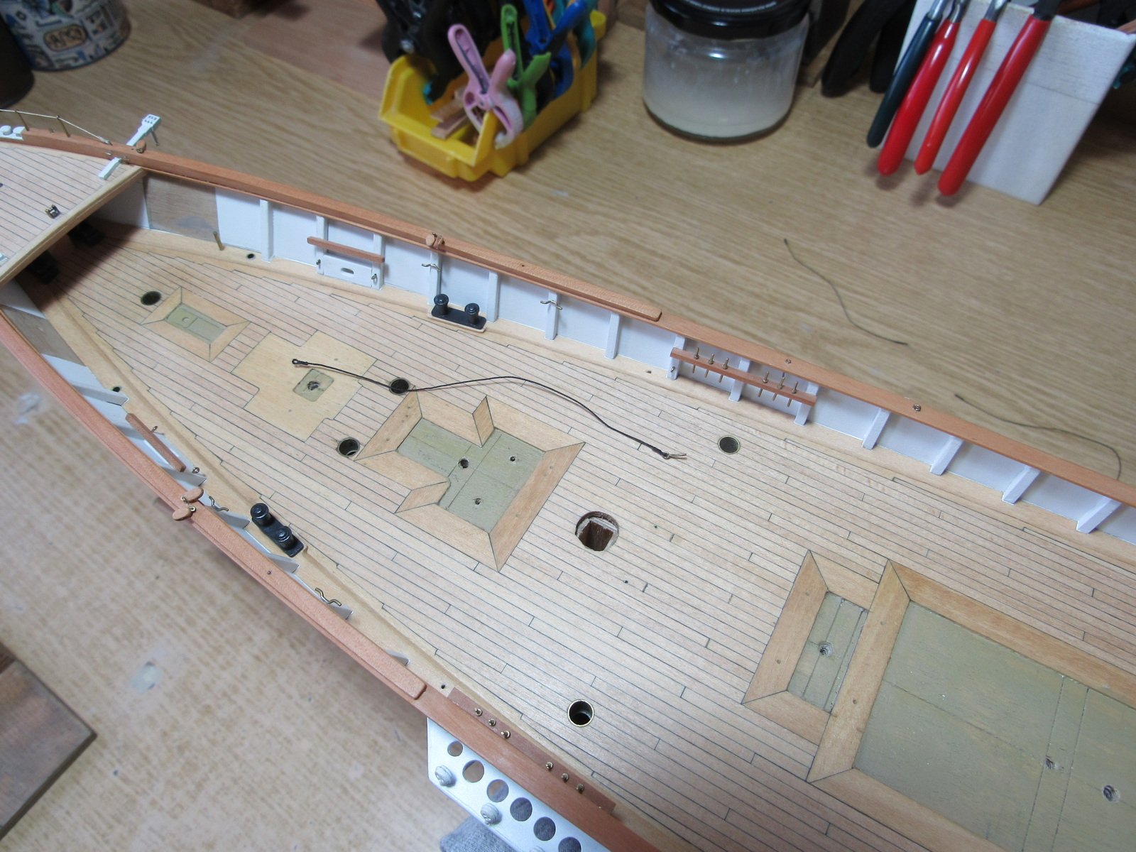

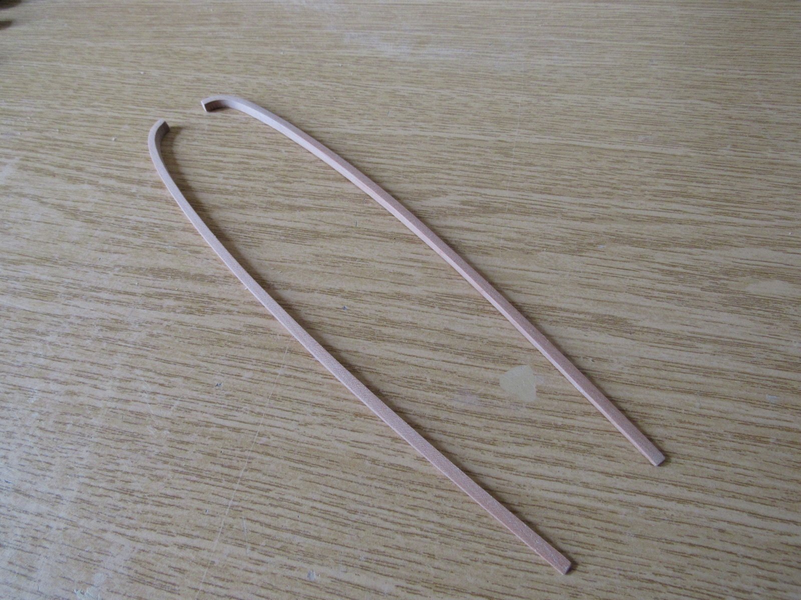

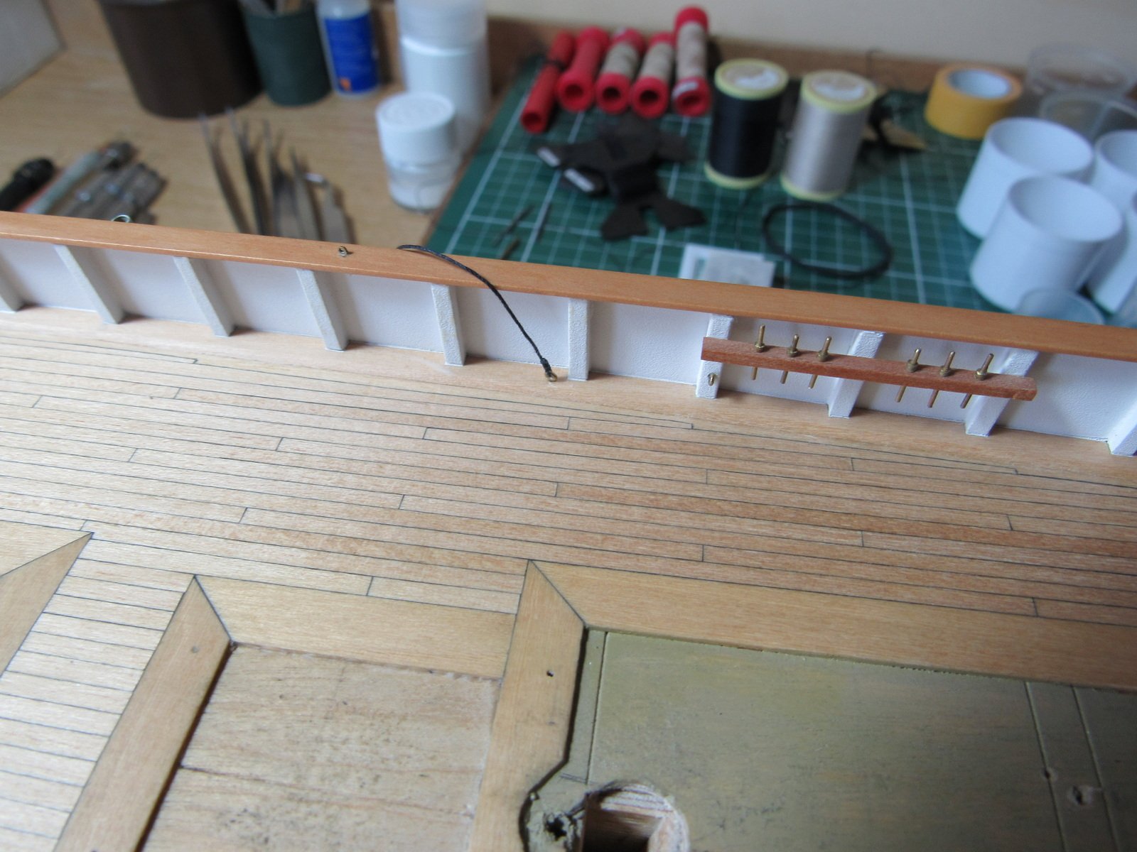

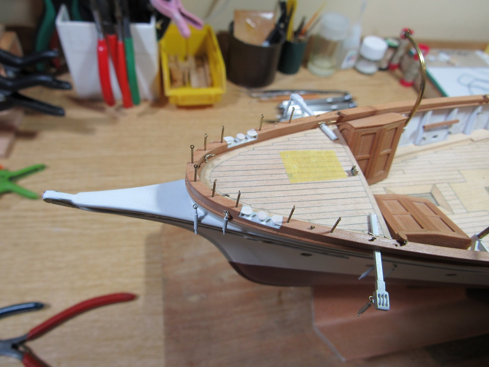

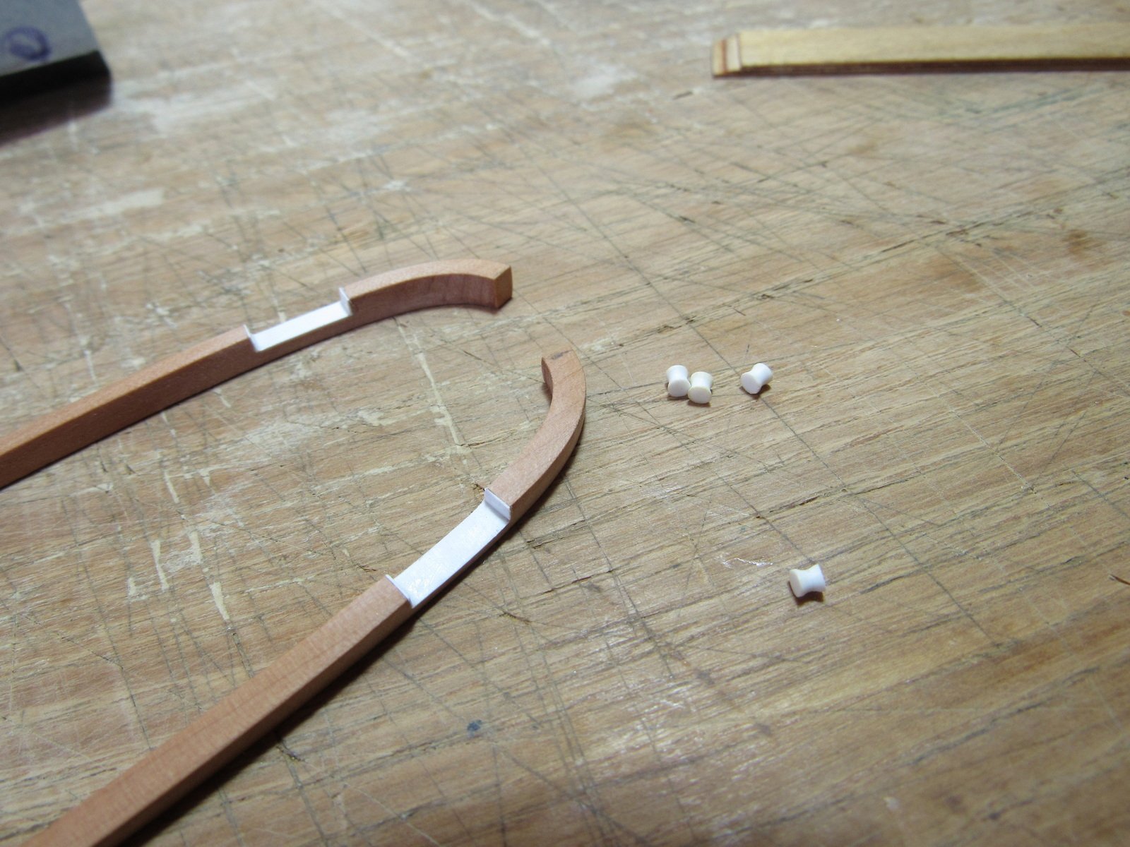

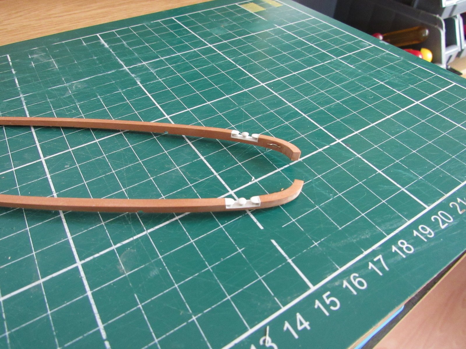

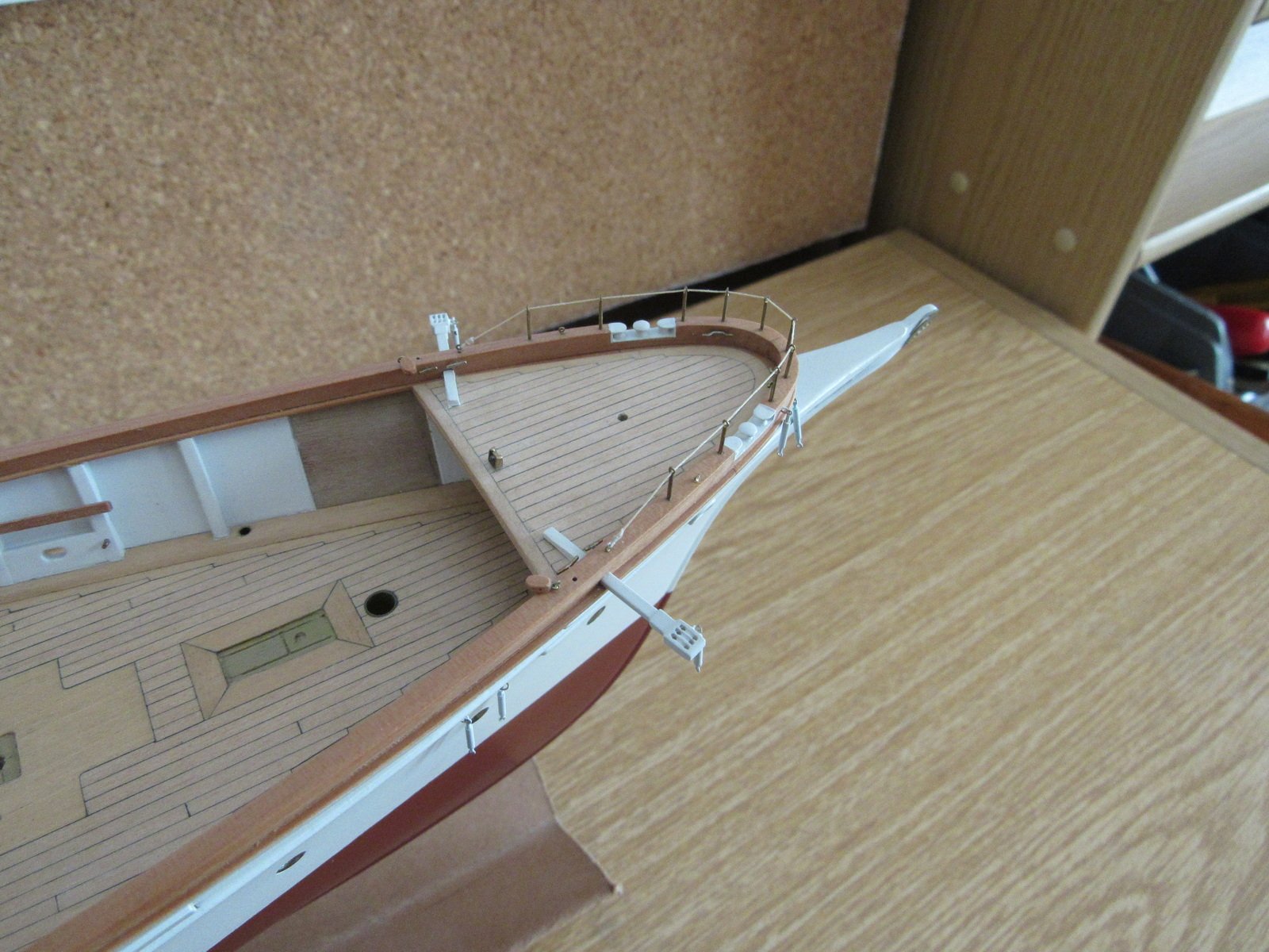

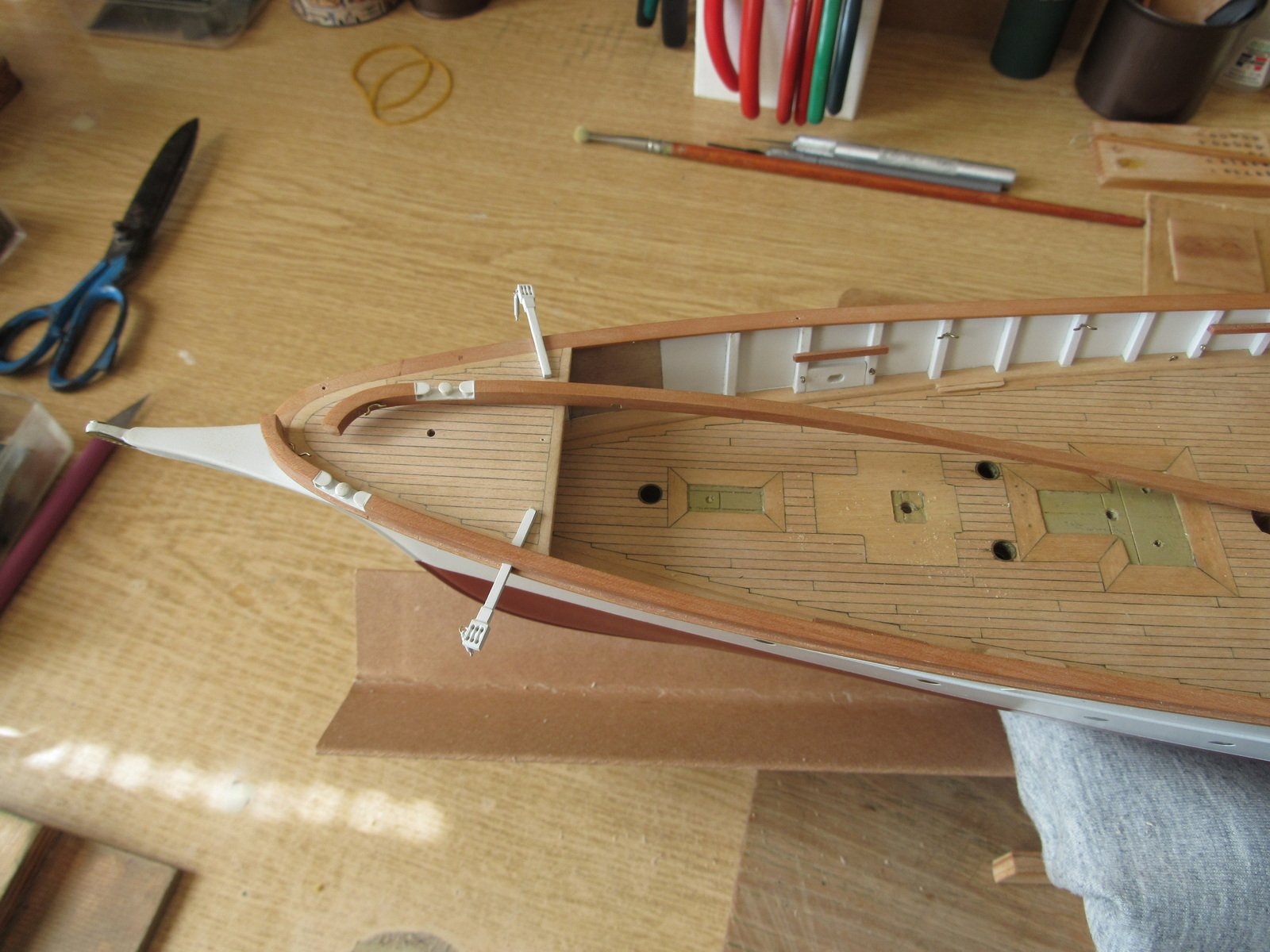

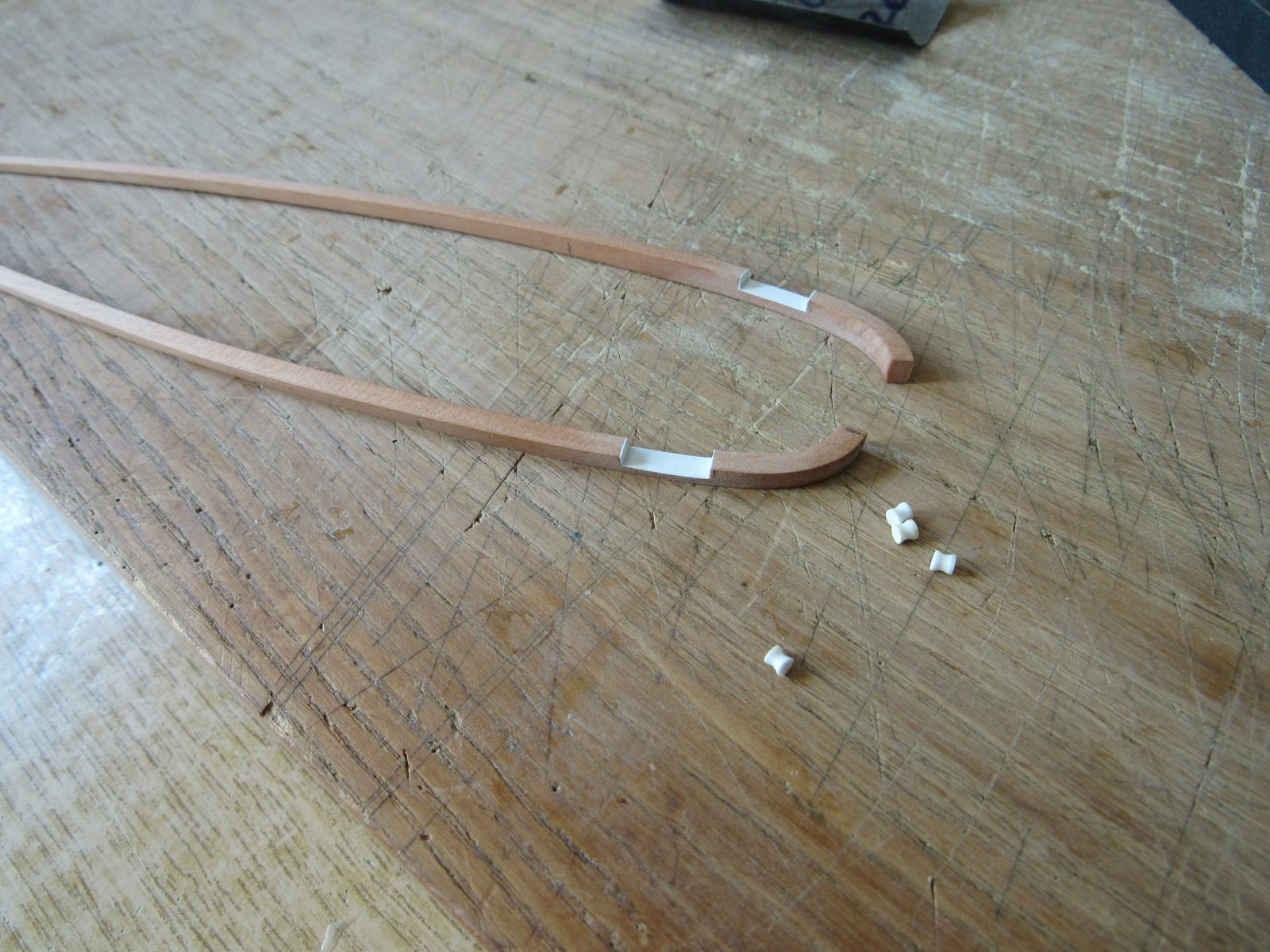

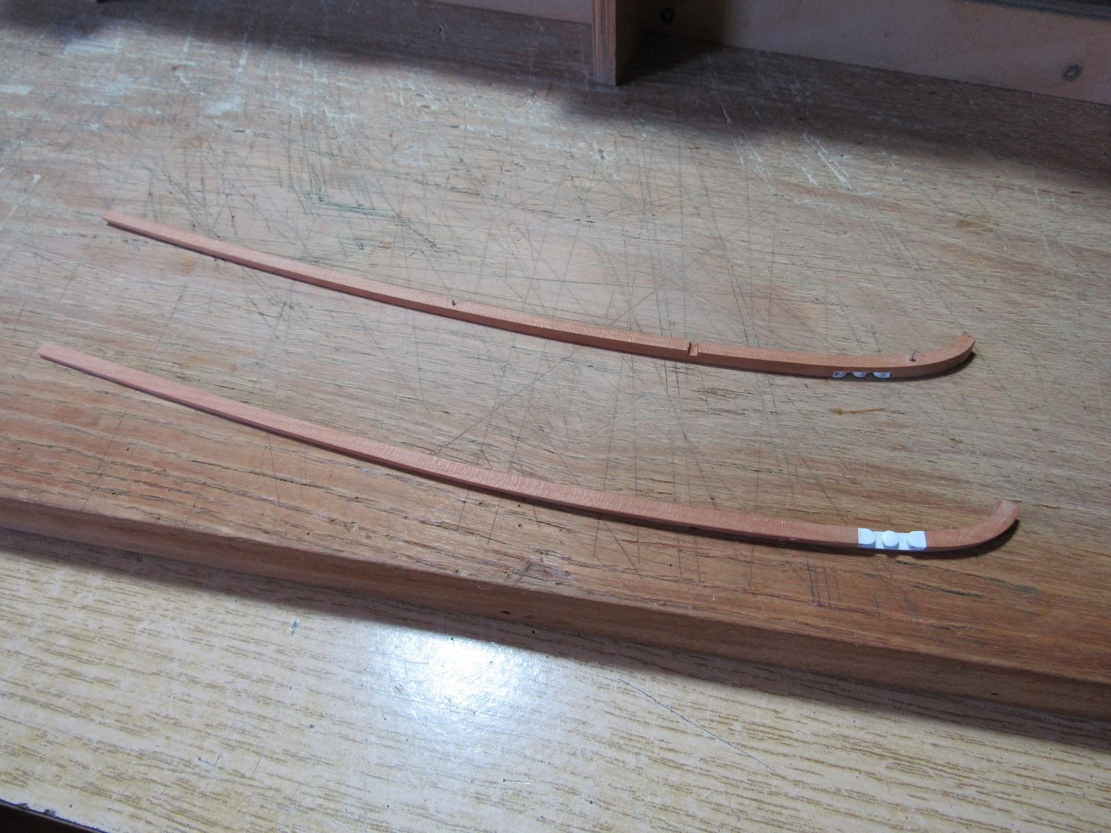

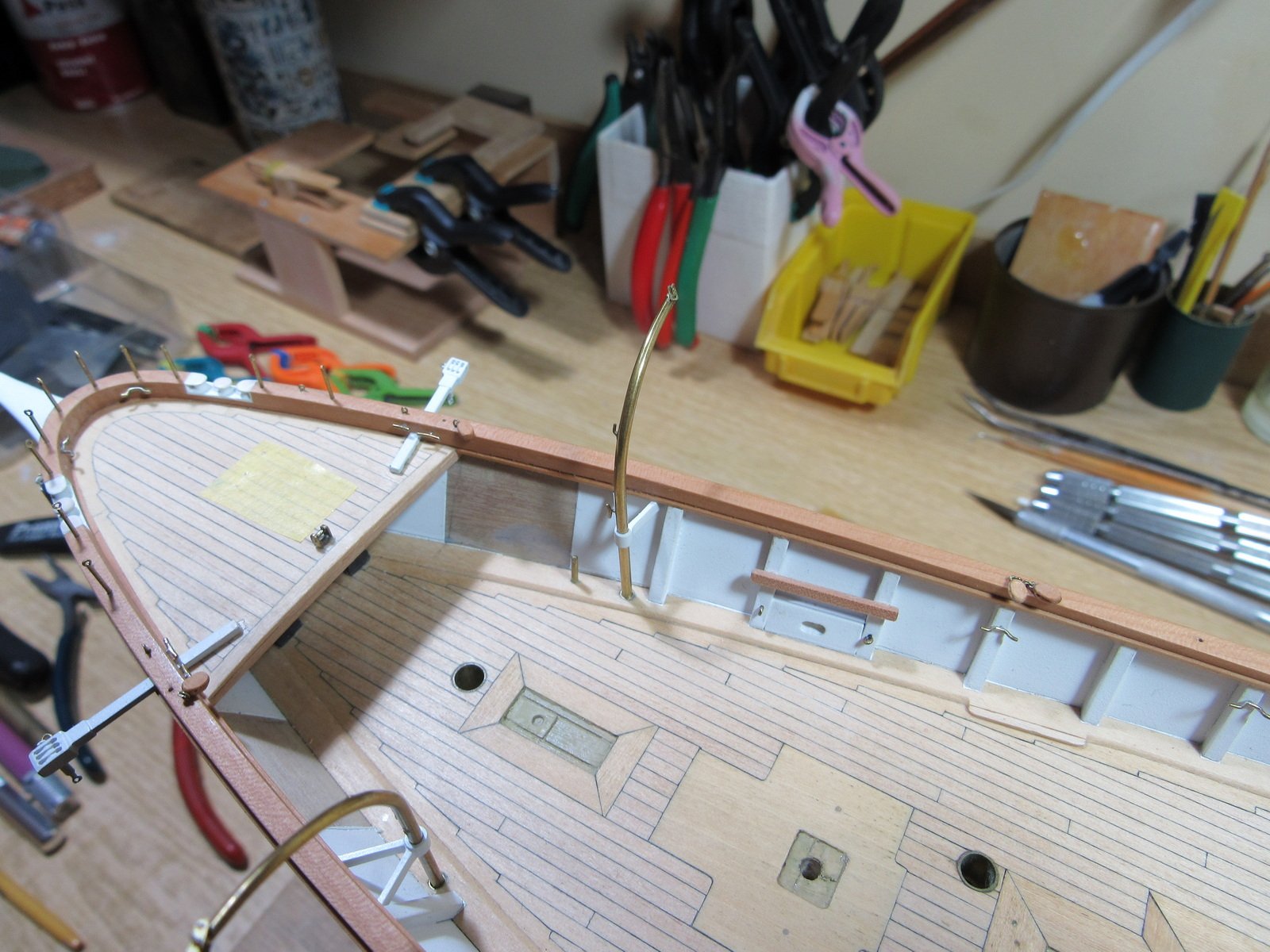

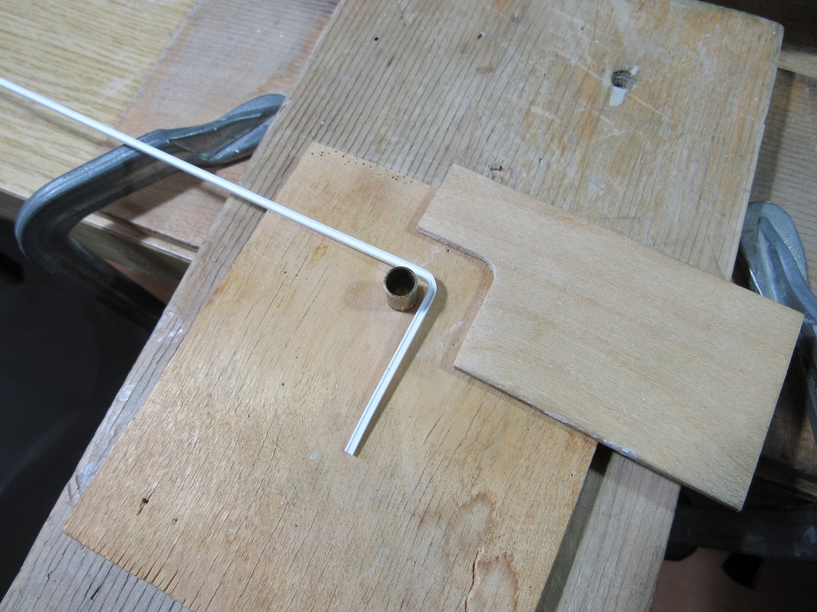

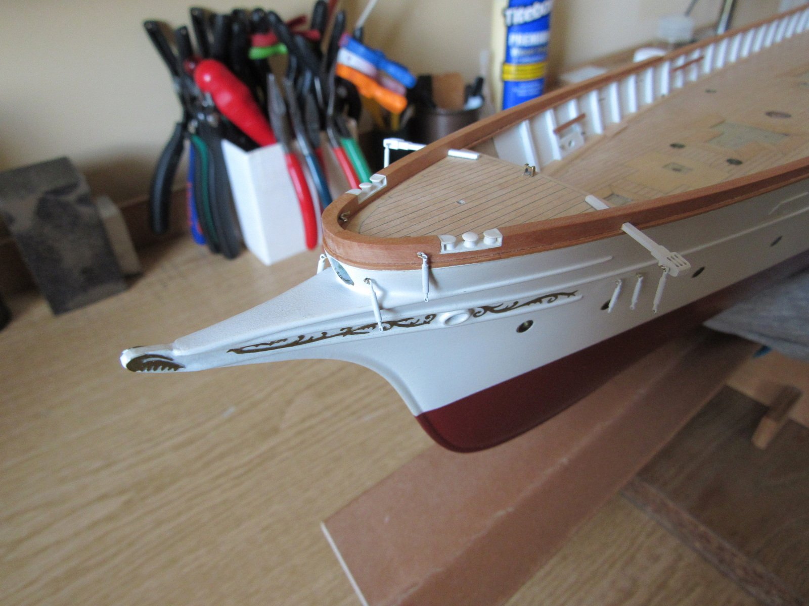

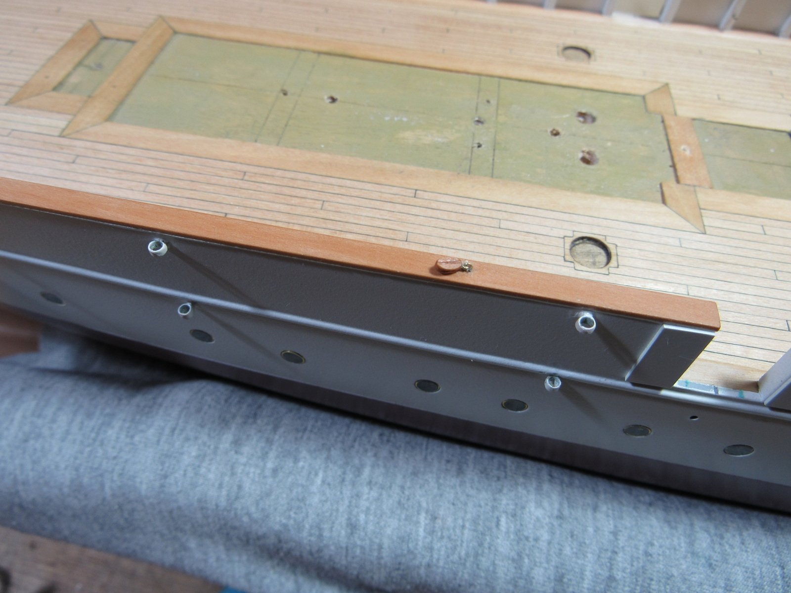

I finished the rail at forecastle. I've cut the shape from 6 mm pear sheet, fitted, surfaced, outfitted and glued.

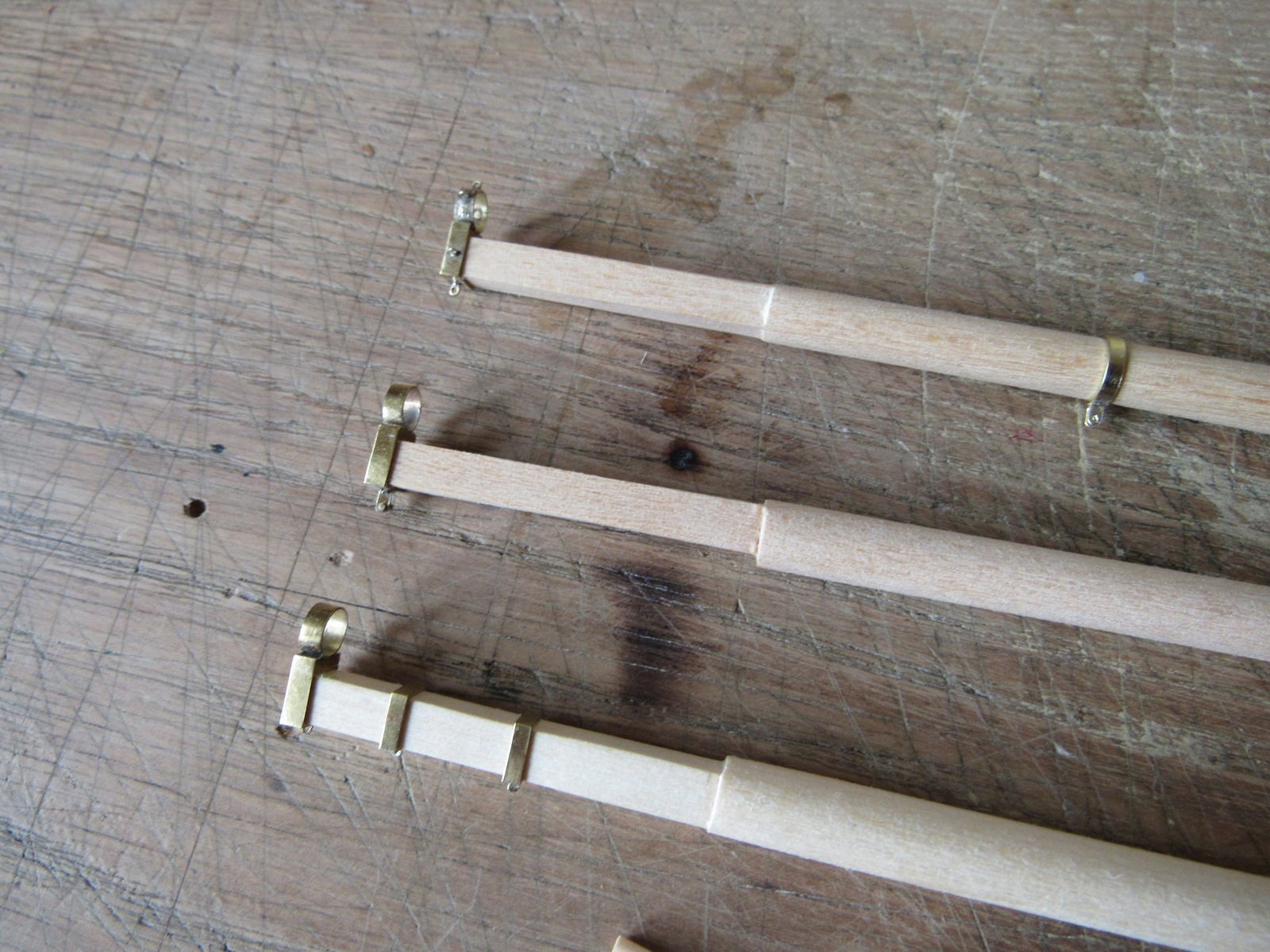

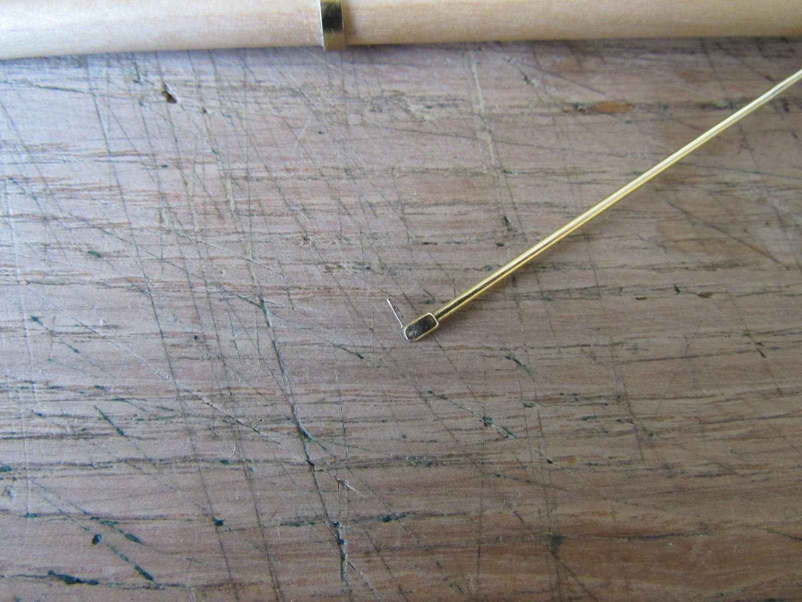

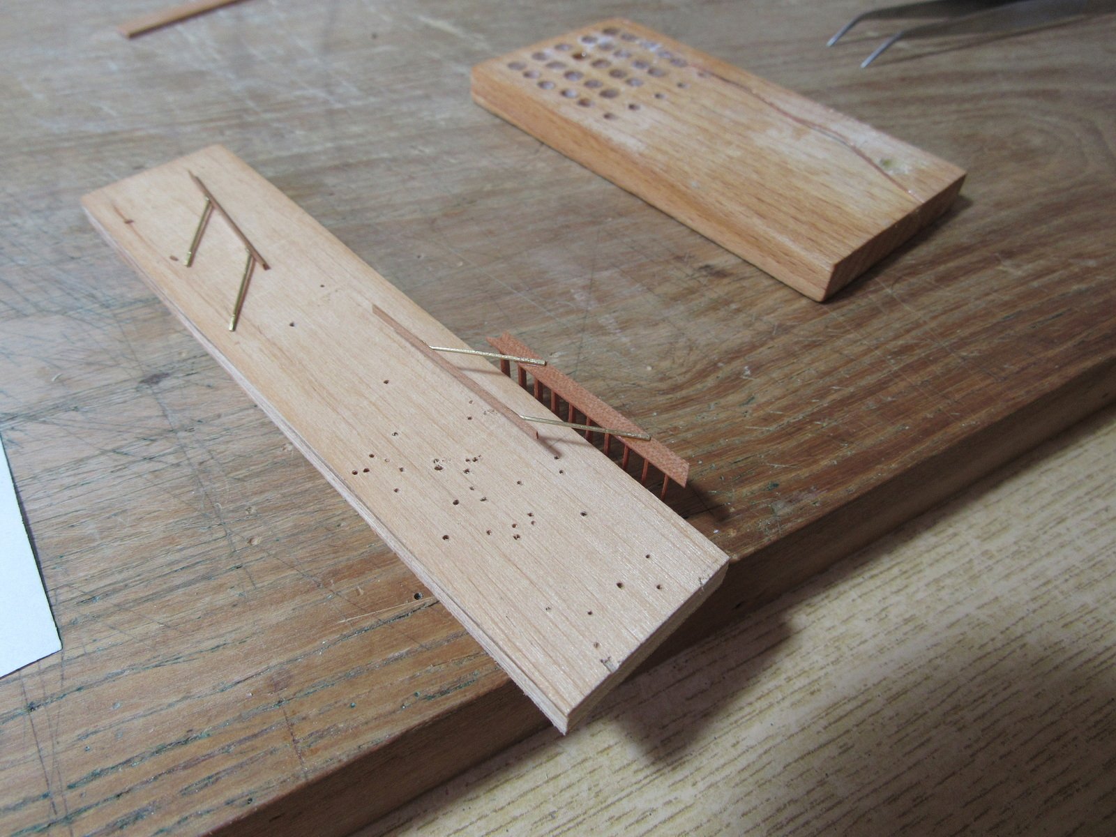

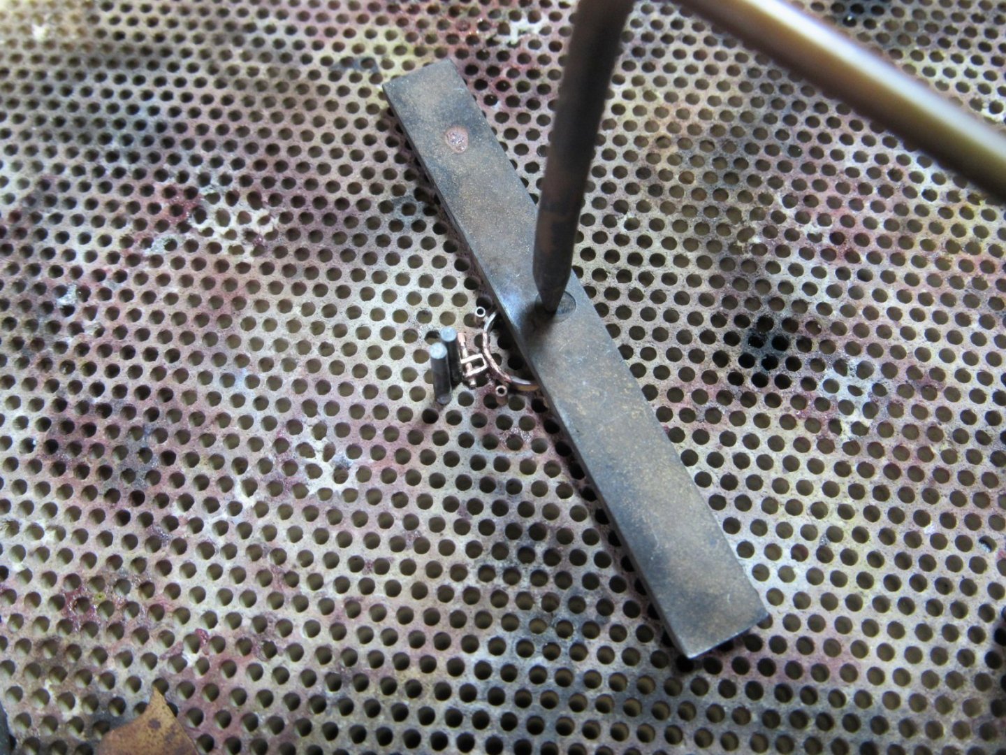

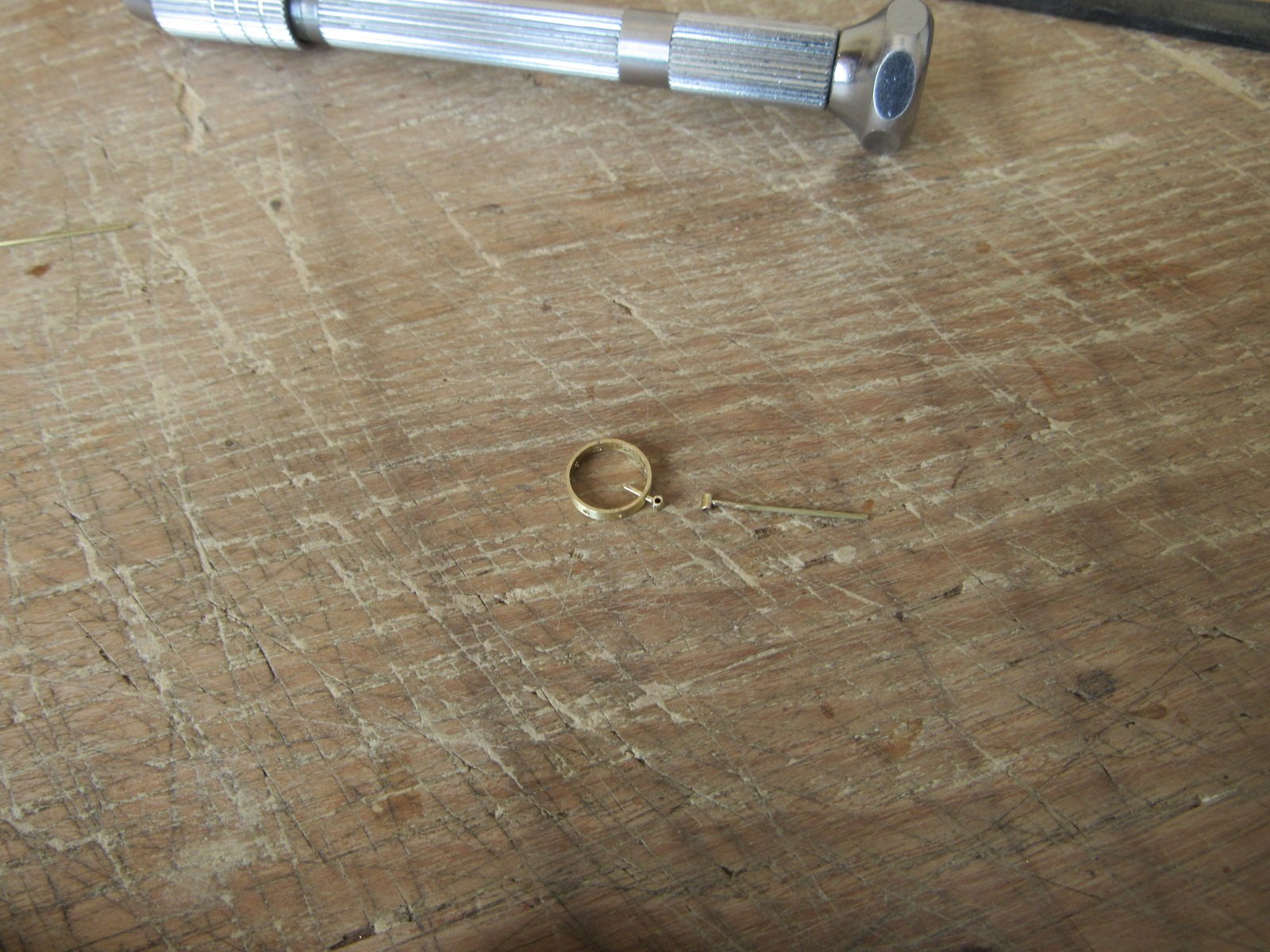

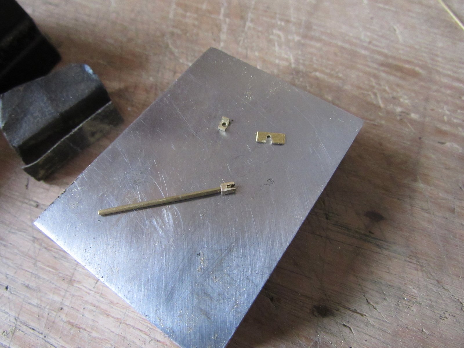

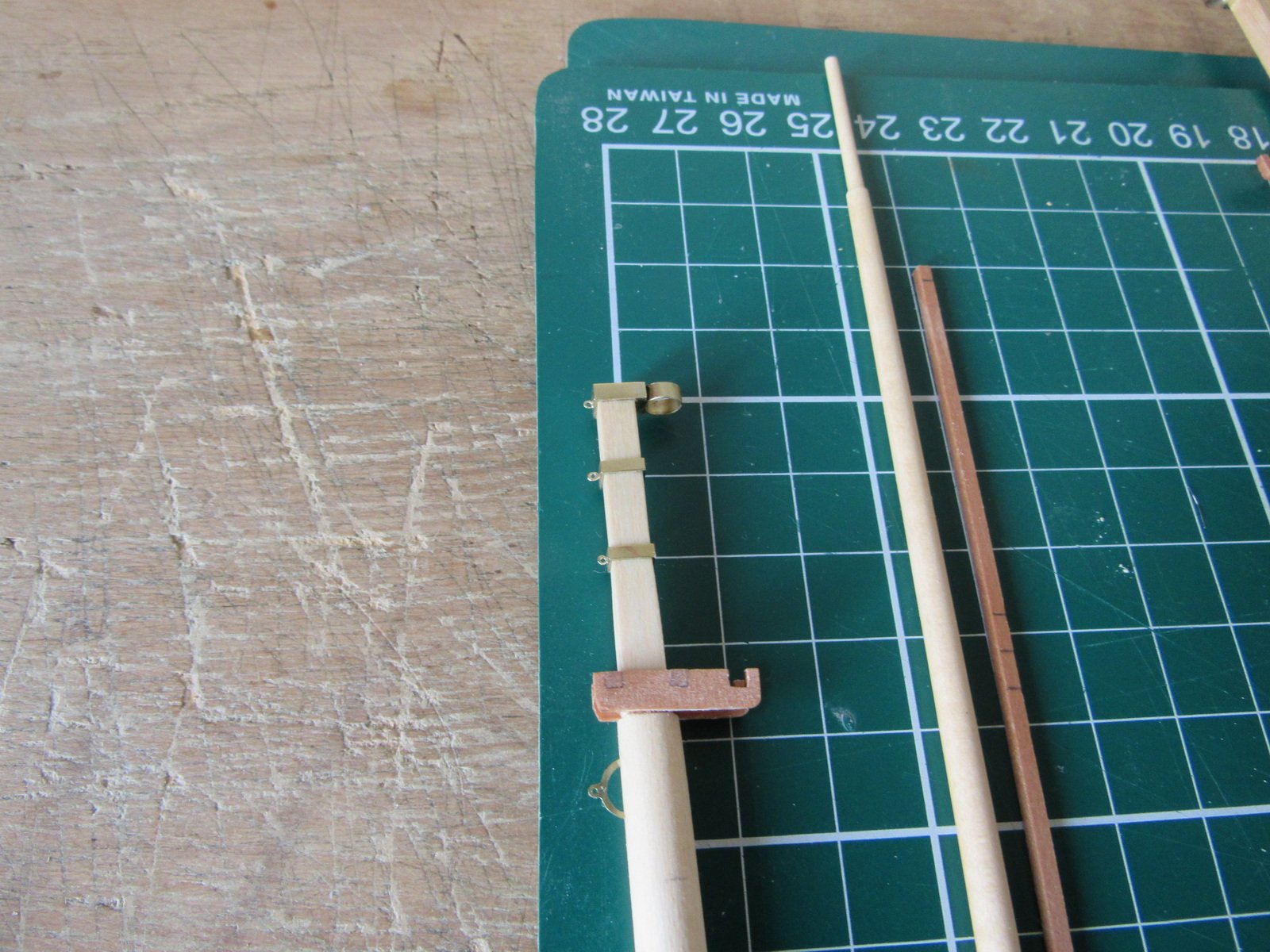

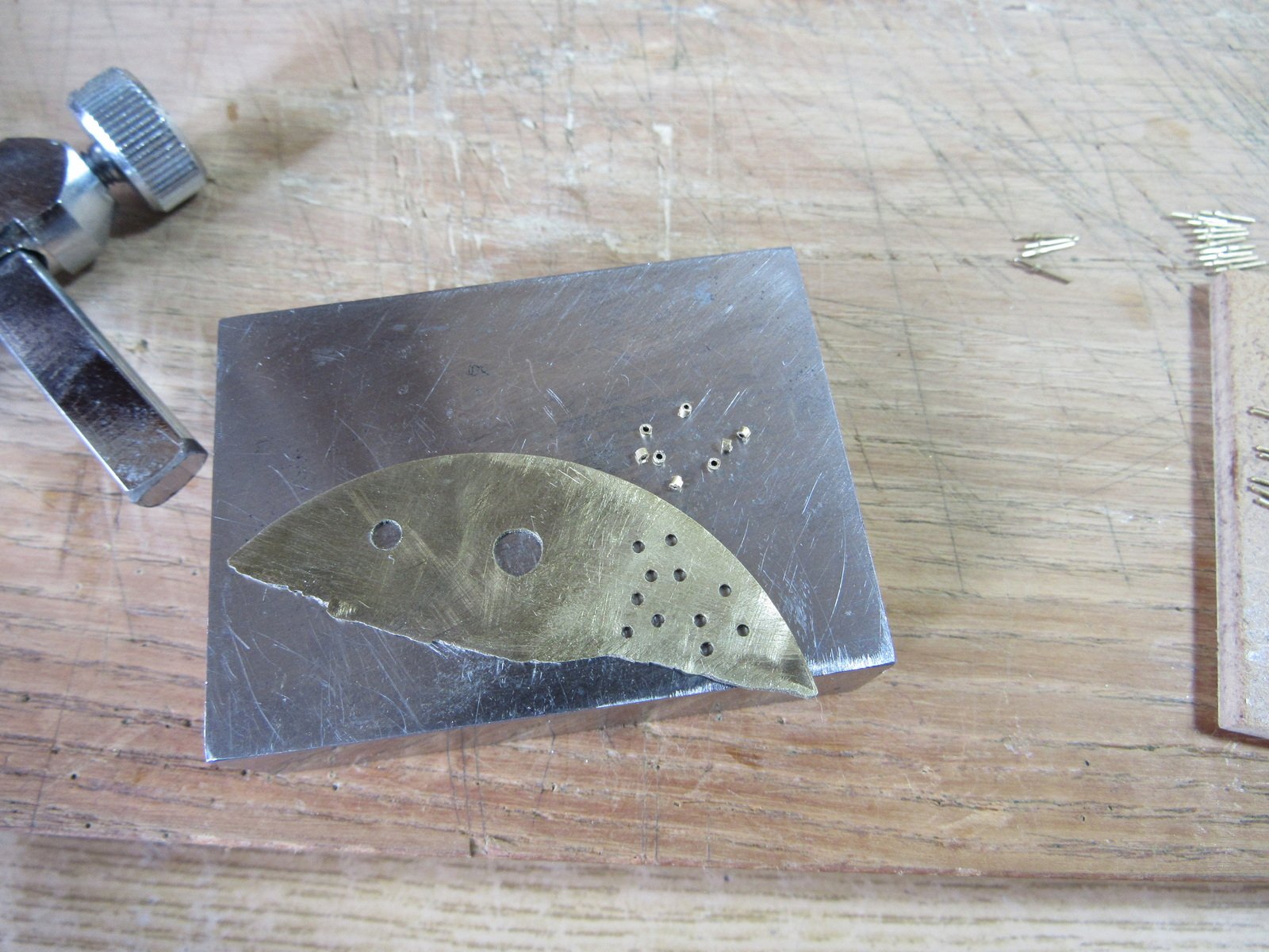

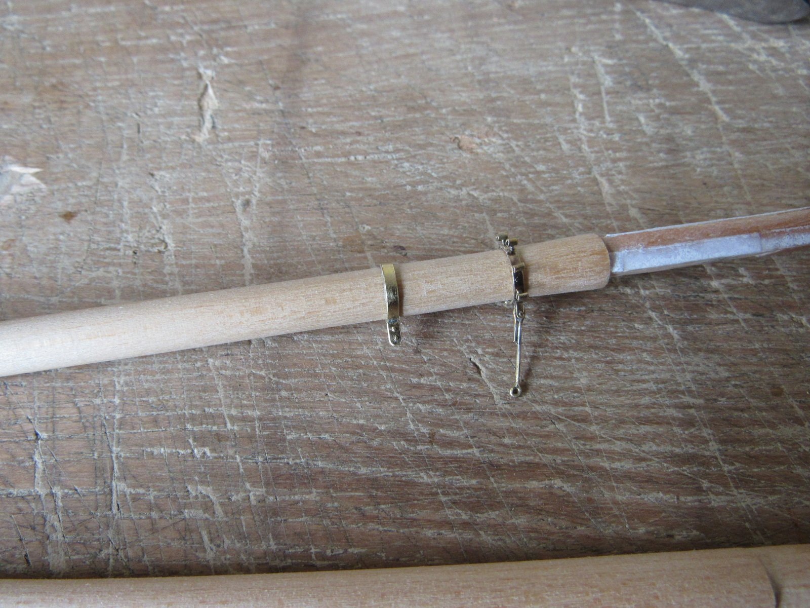

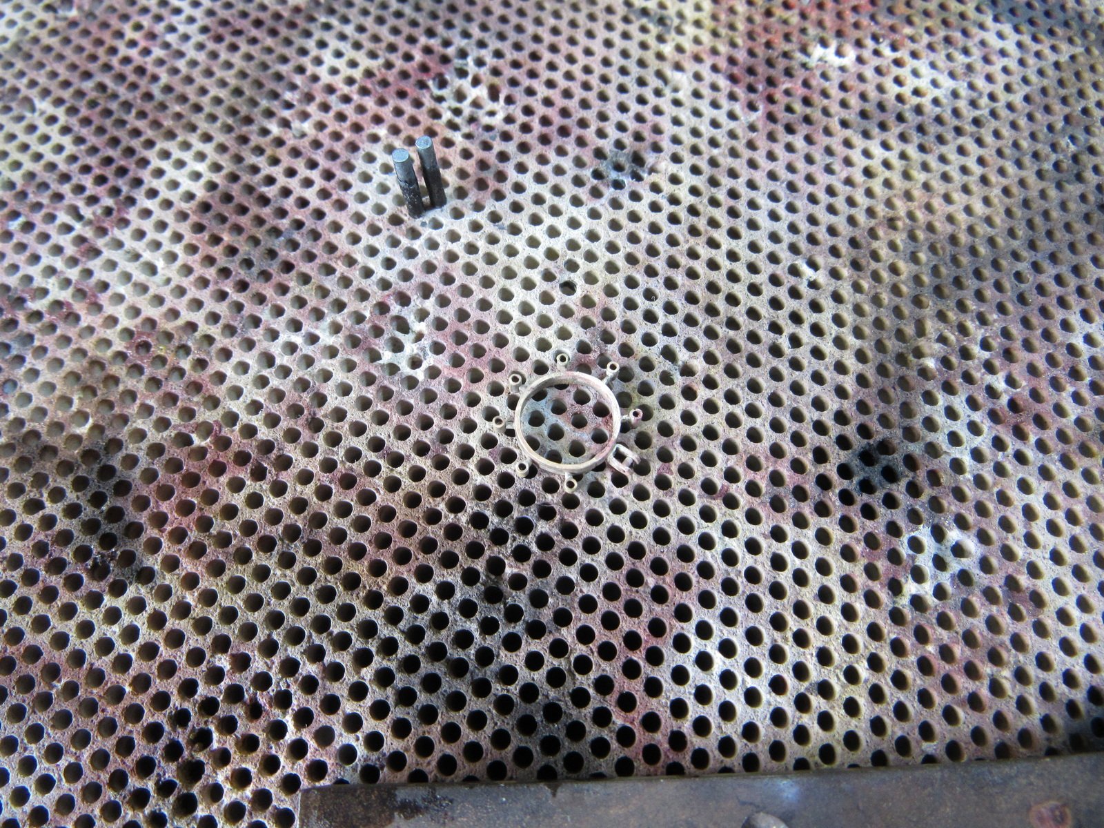

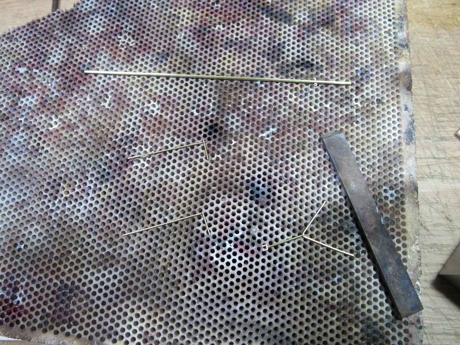

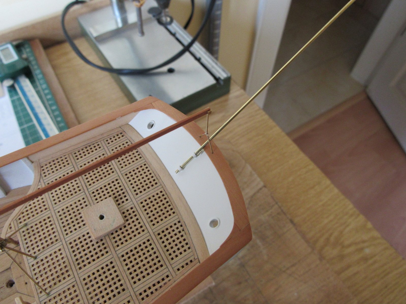

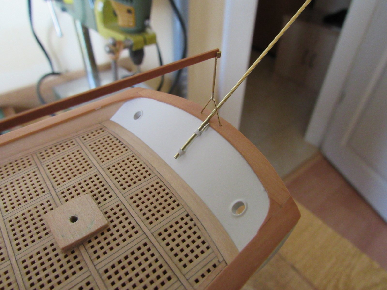

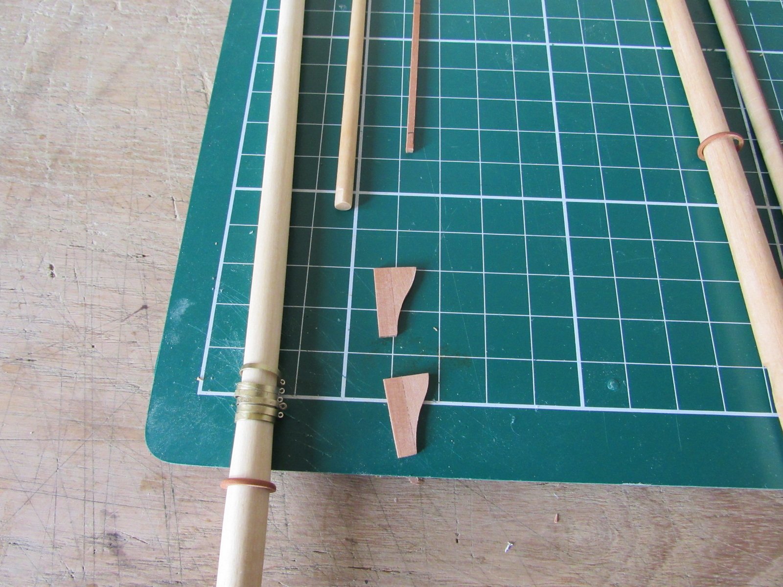

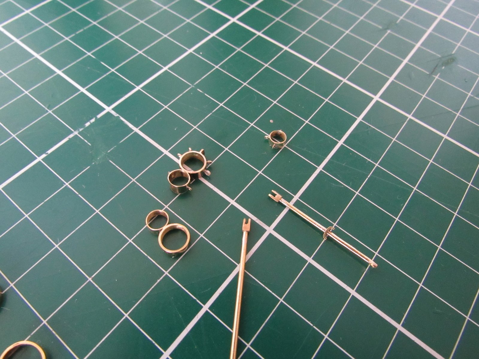

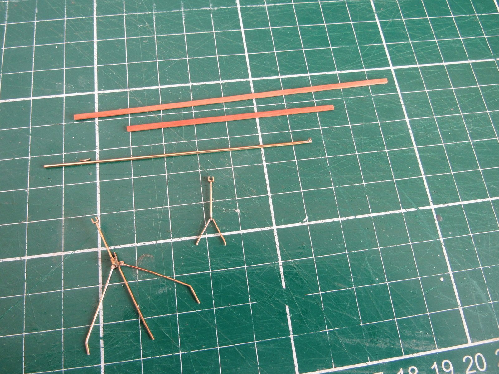

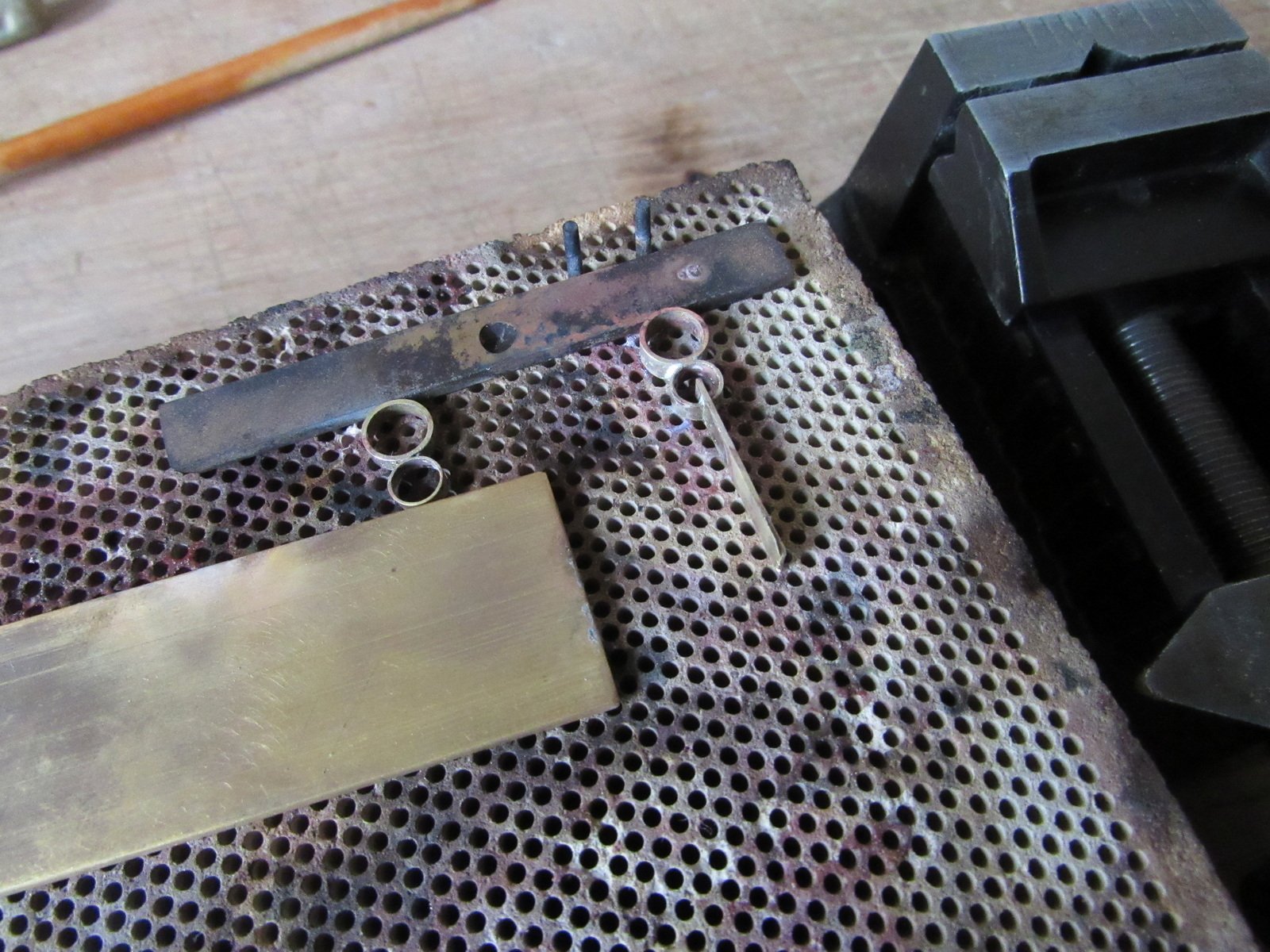

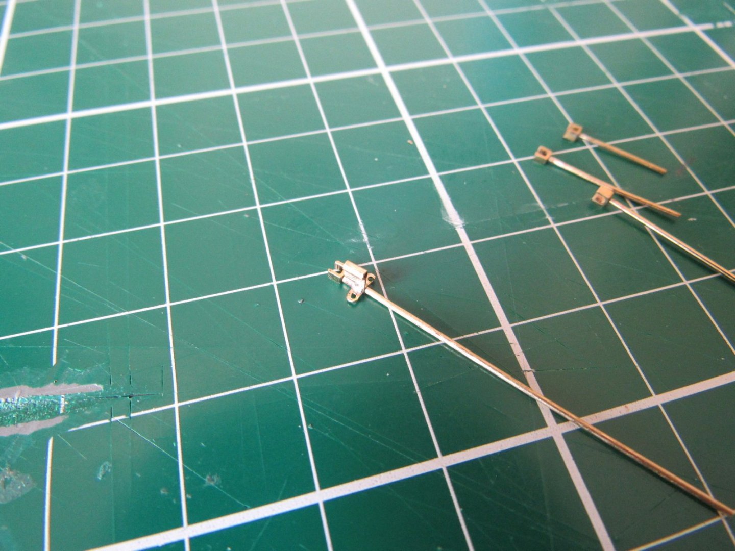

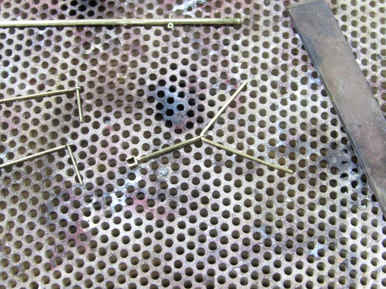

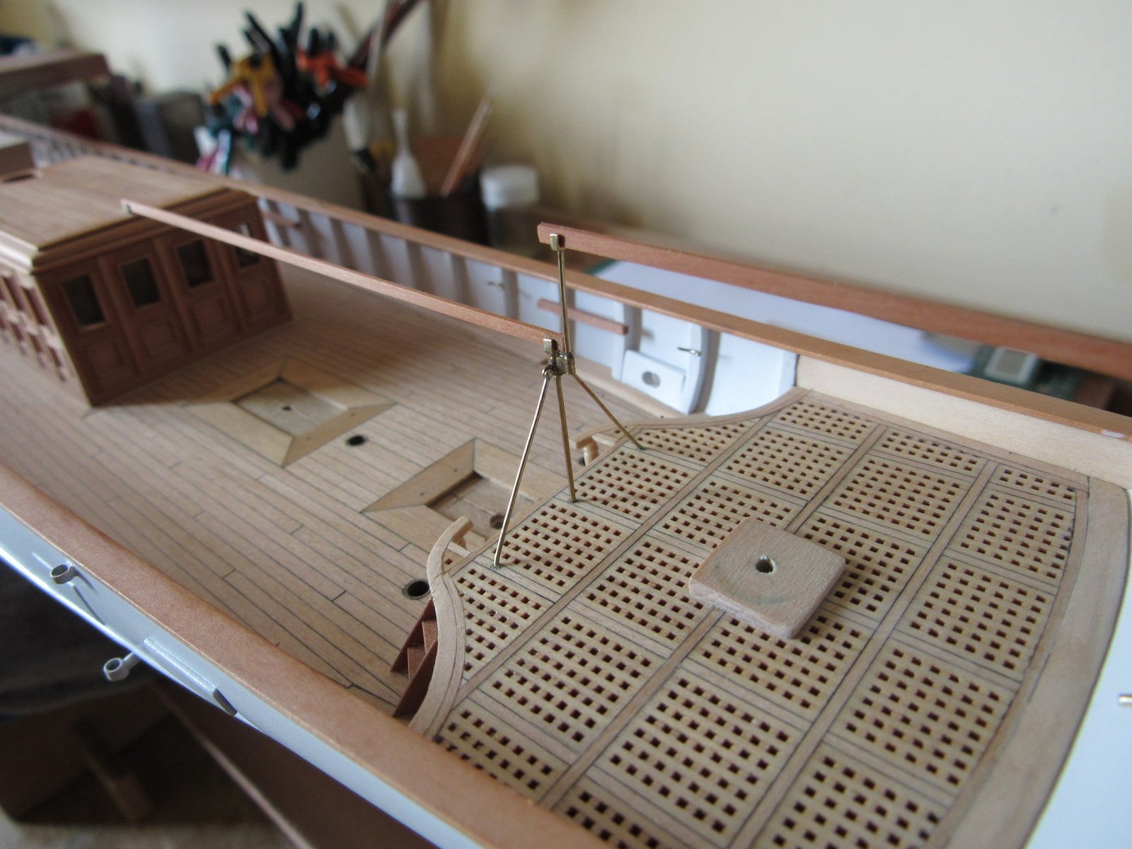

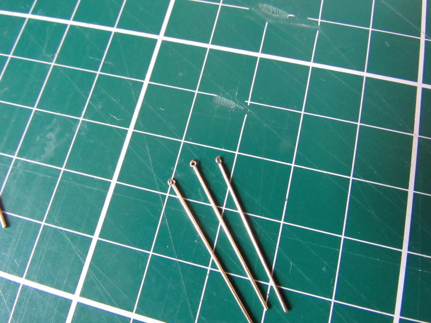

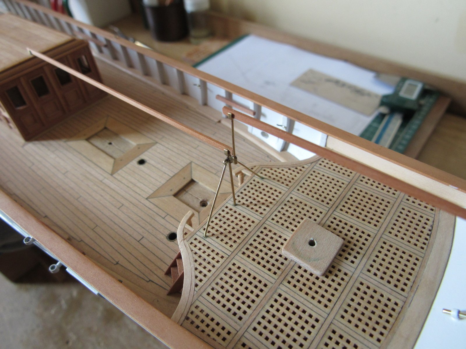

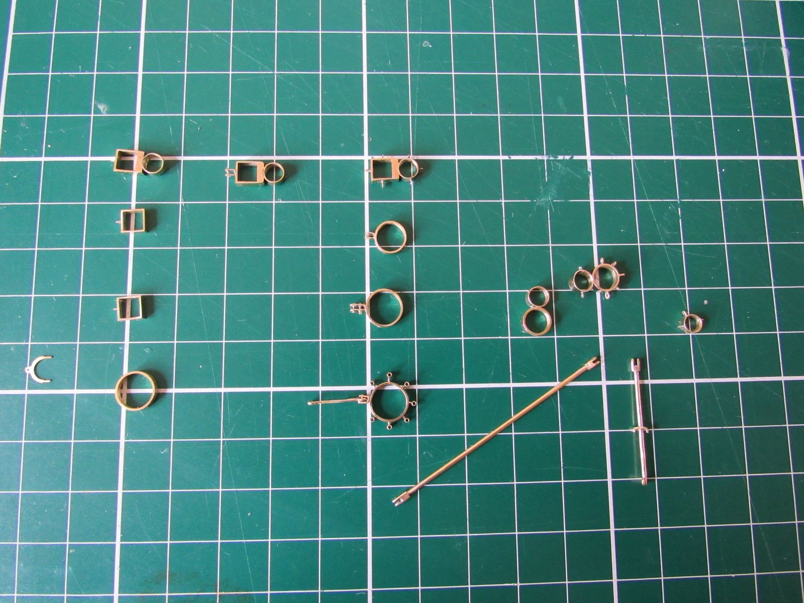

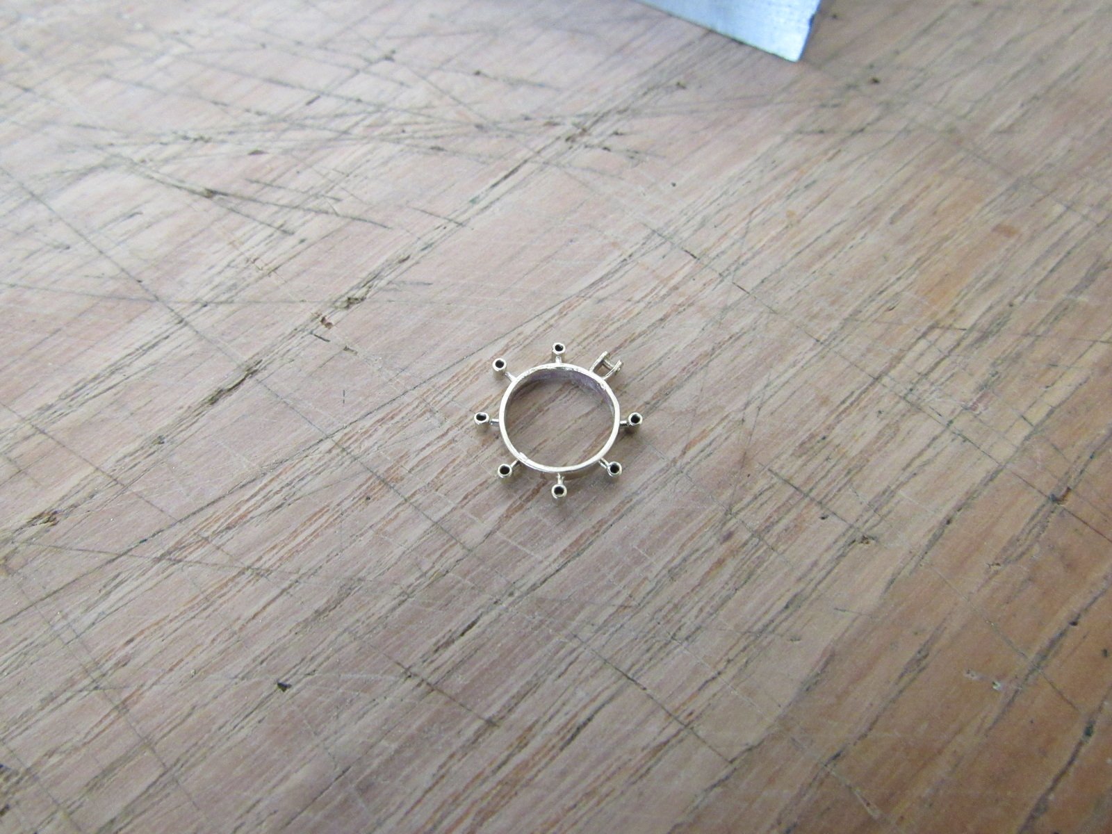

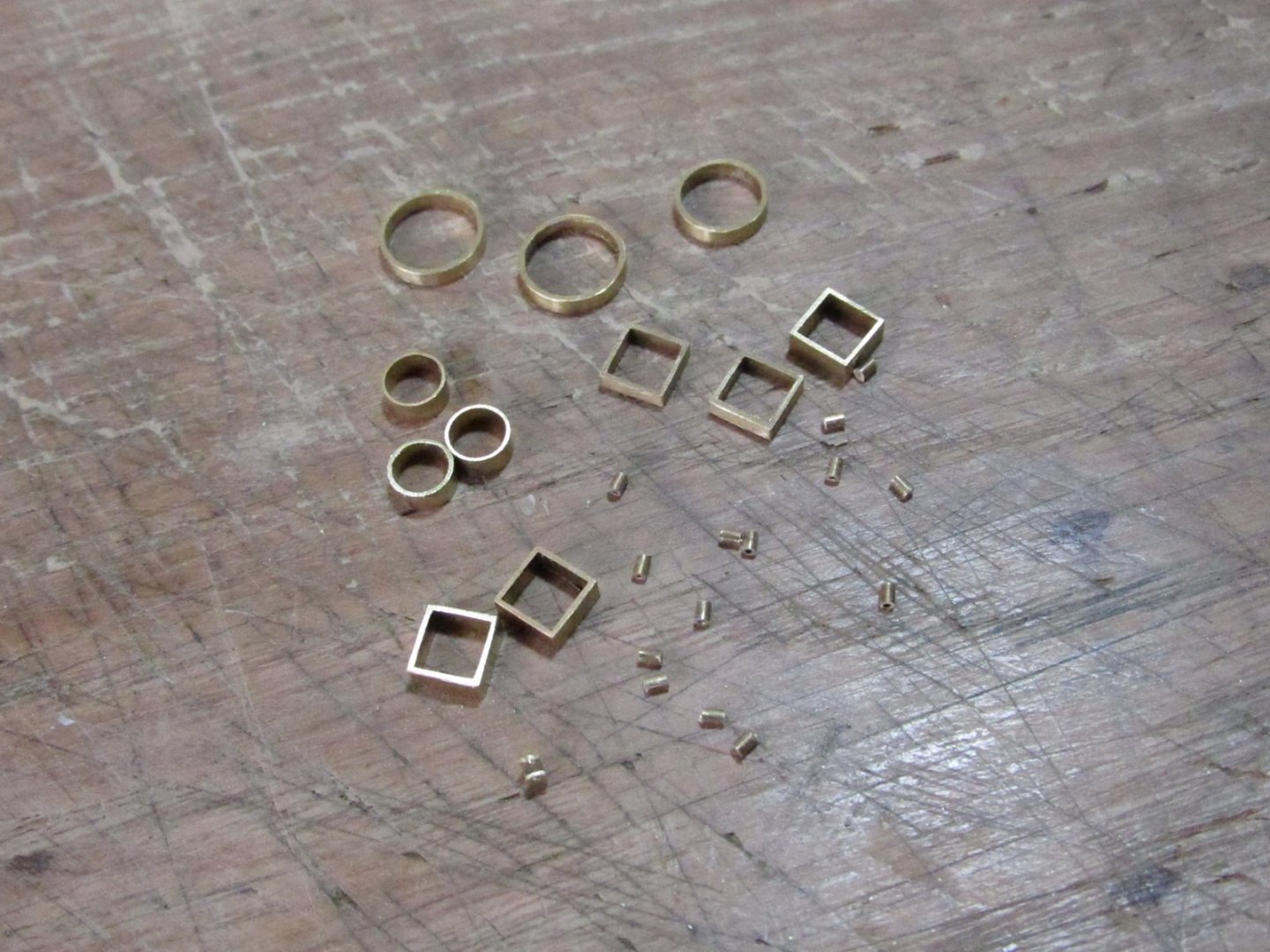

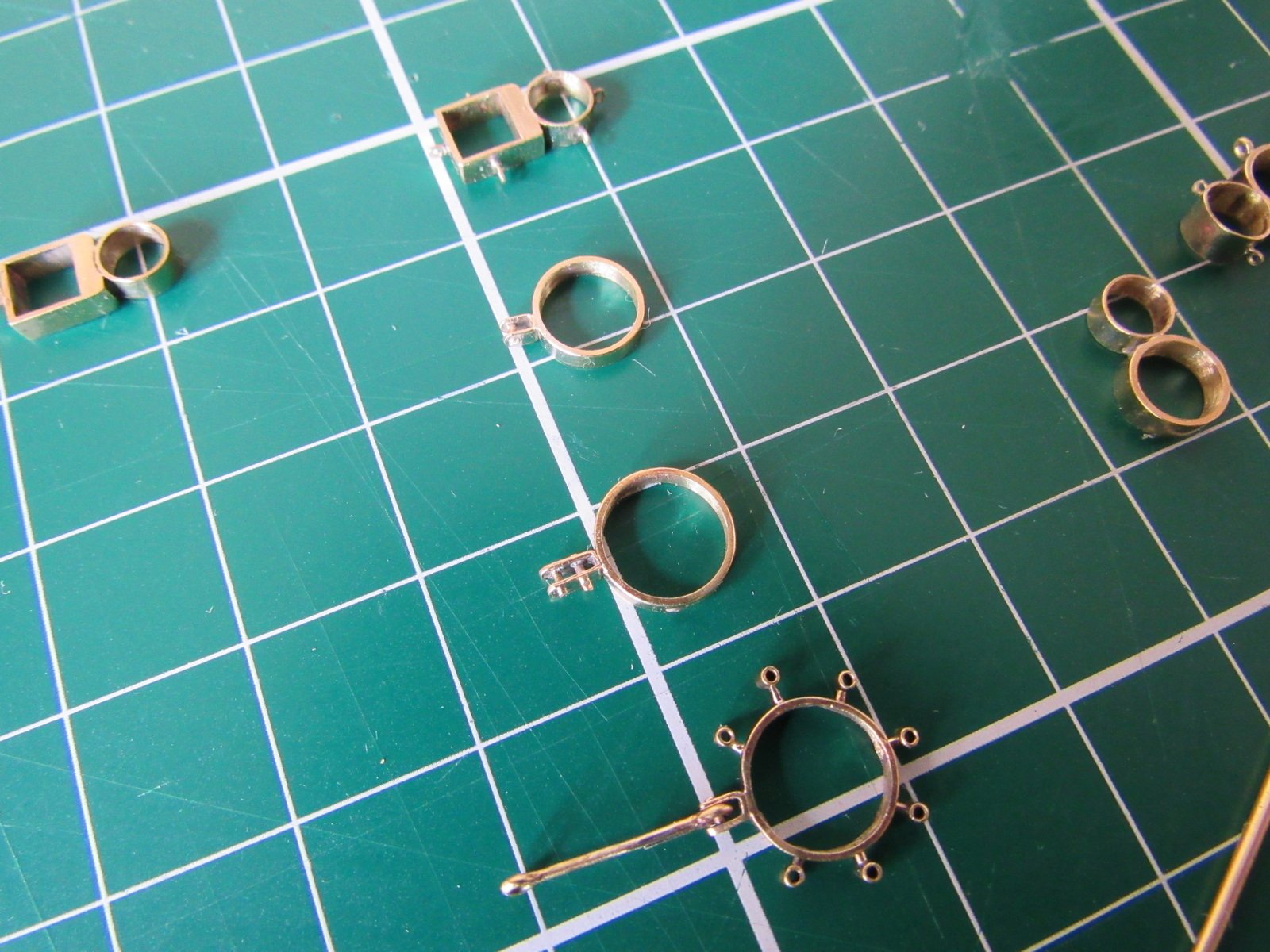

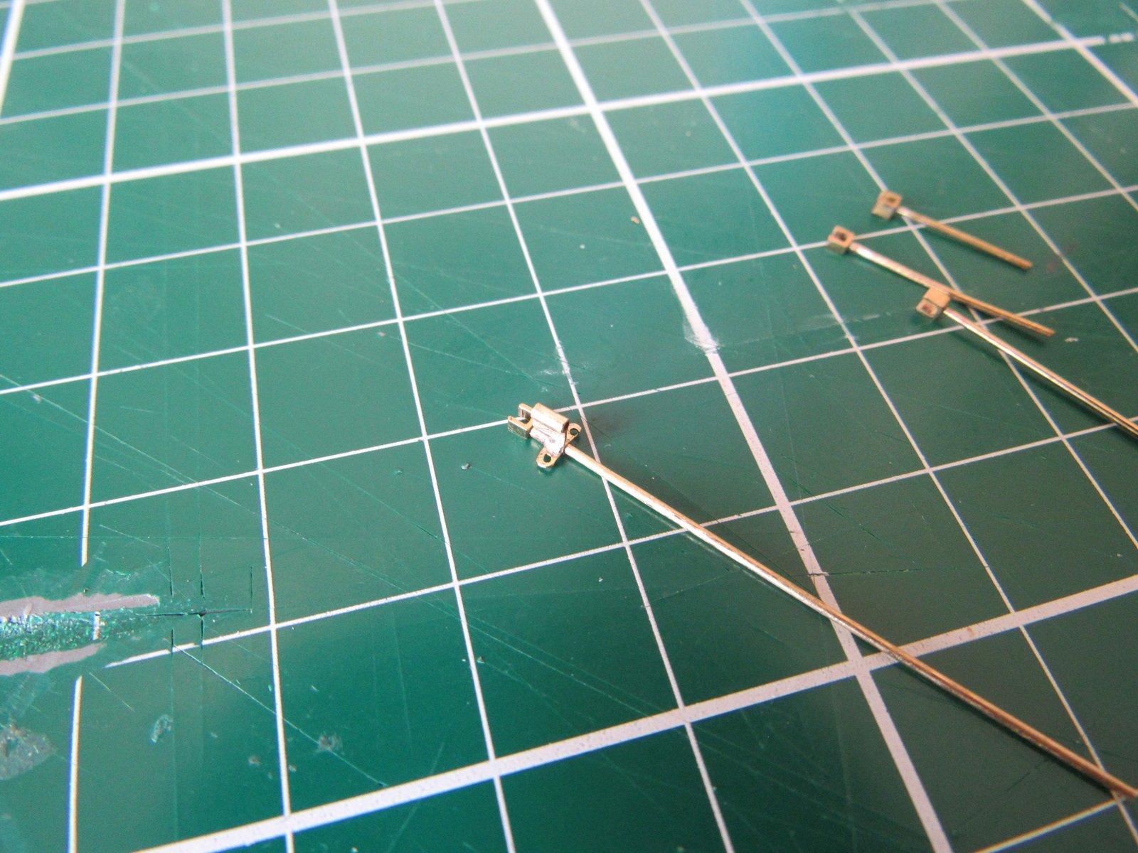

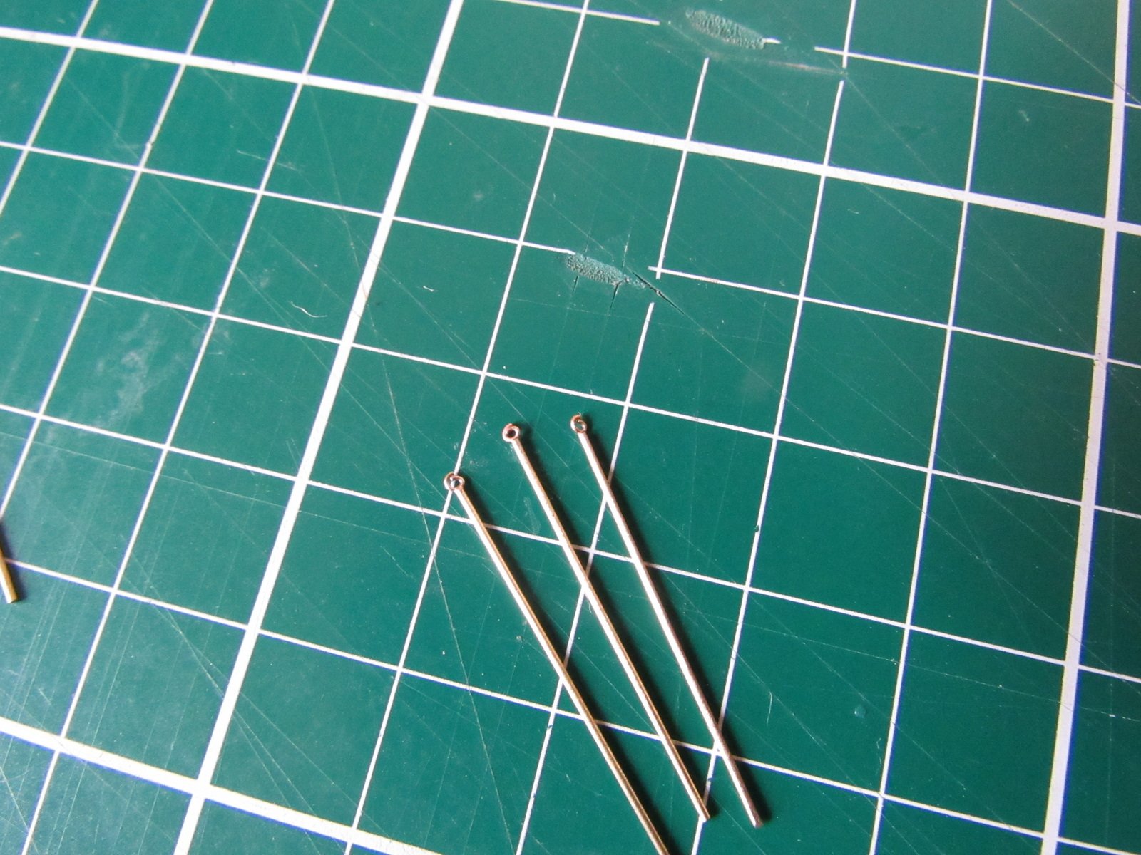

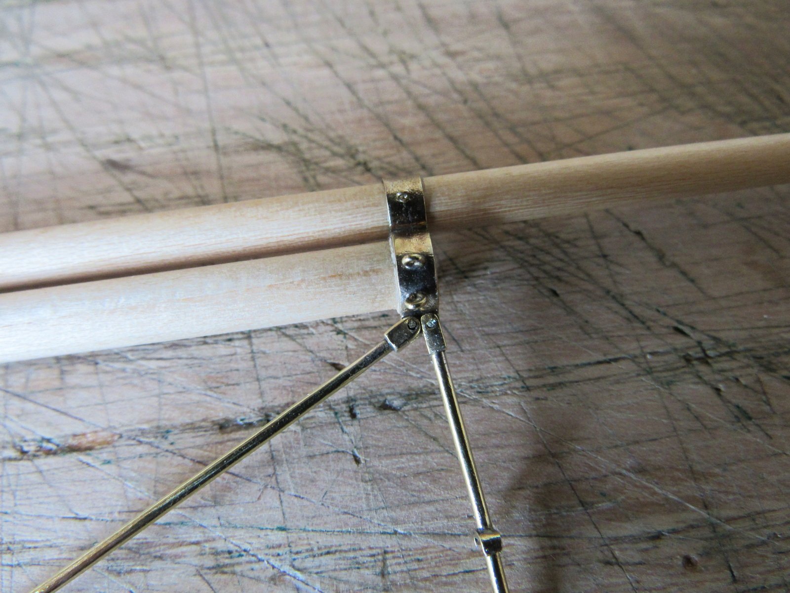

Tent stanchions and flagstaff made of brass profiles, rods, tubes.

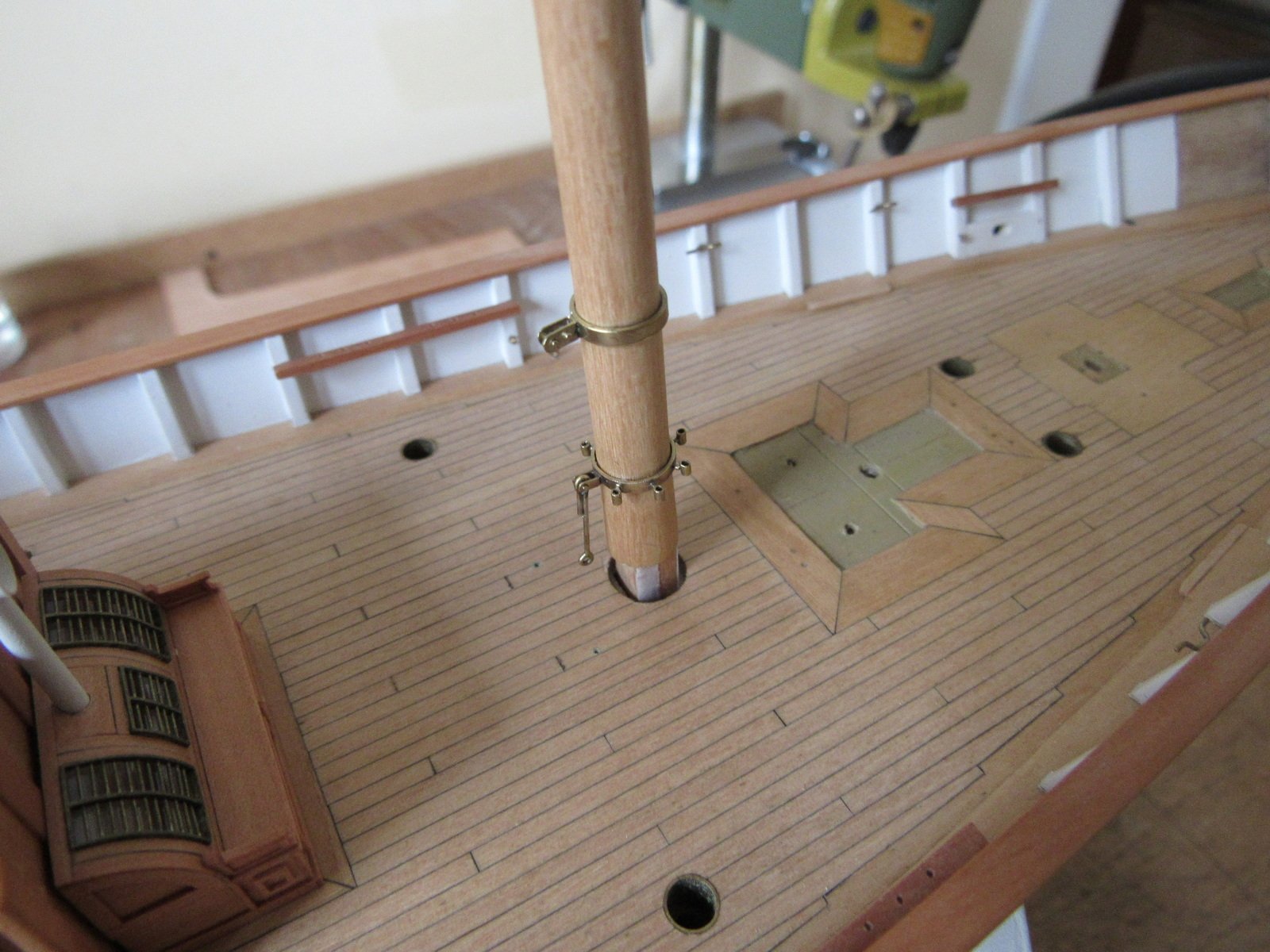

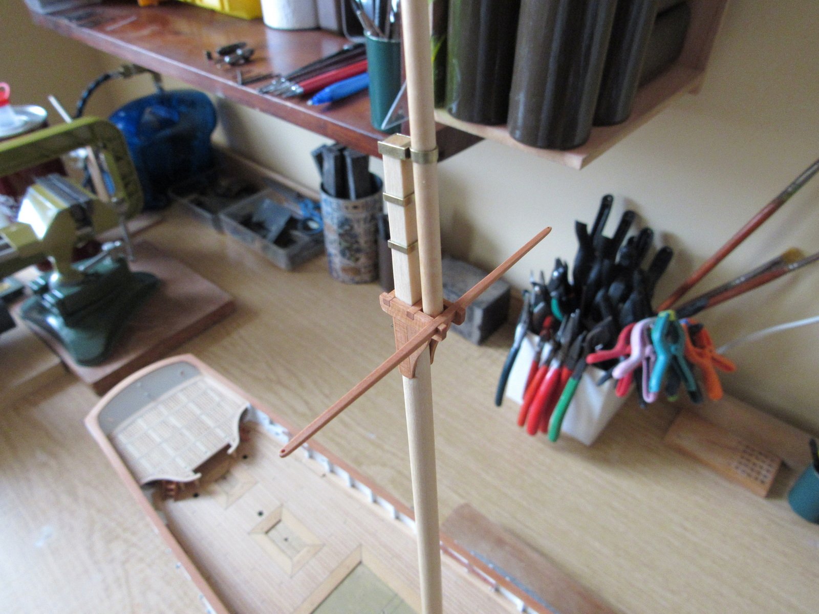

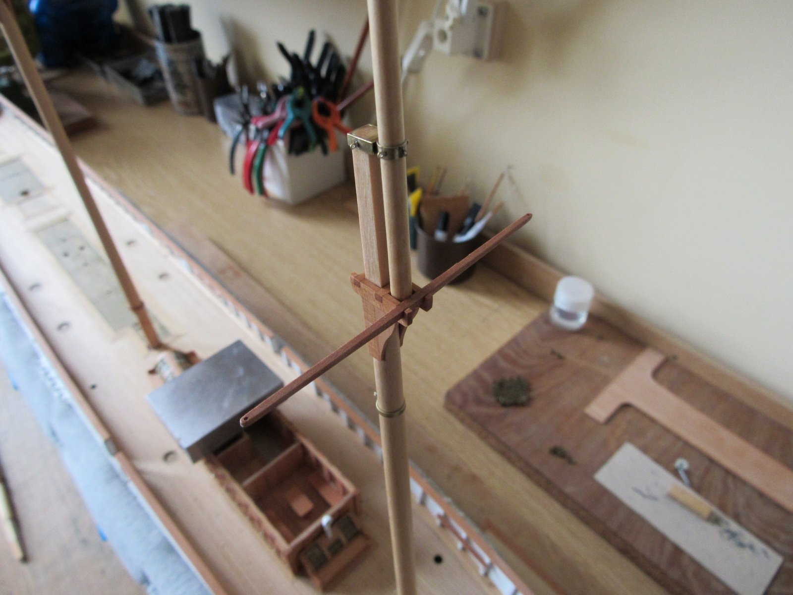

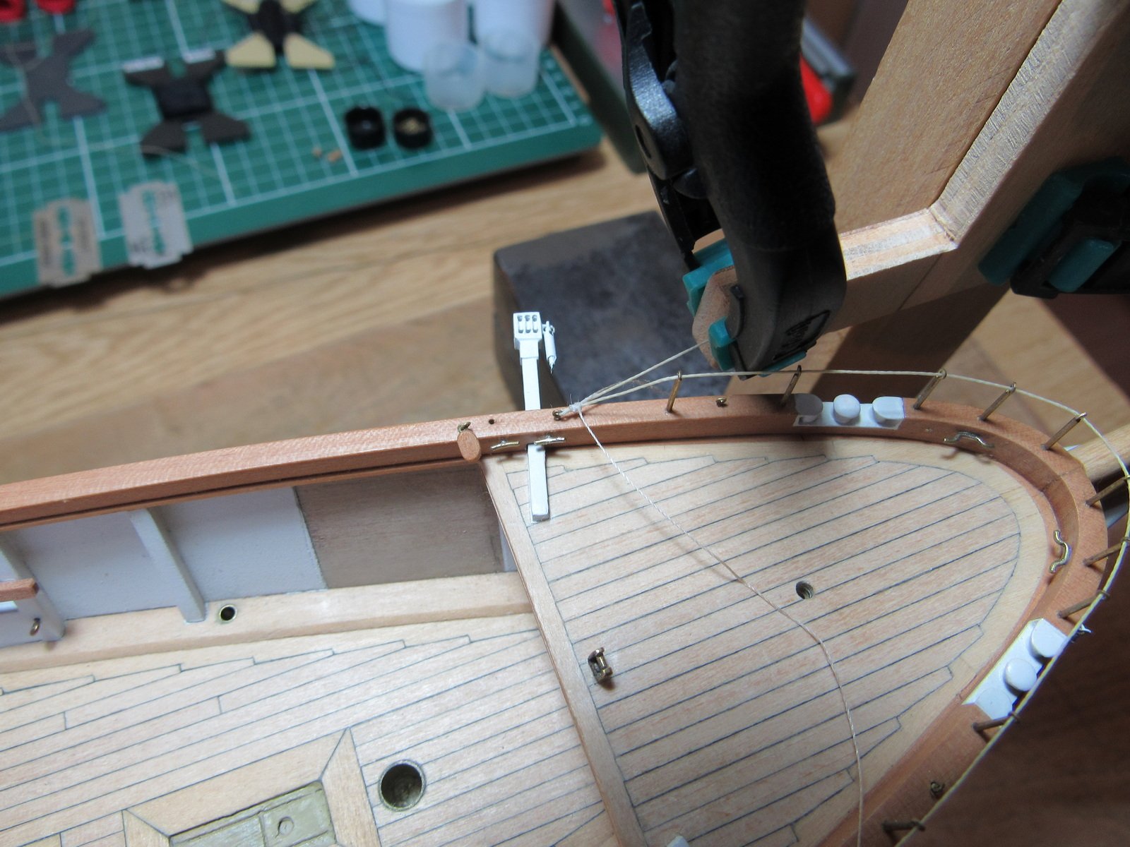

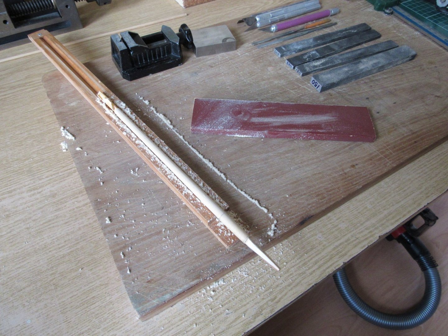

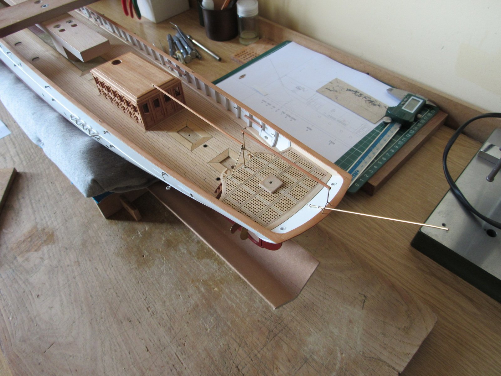

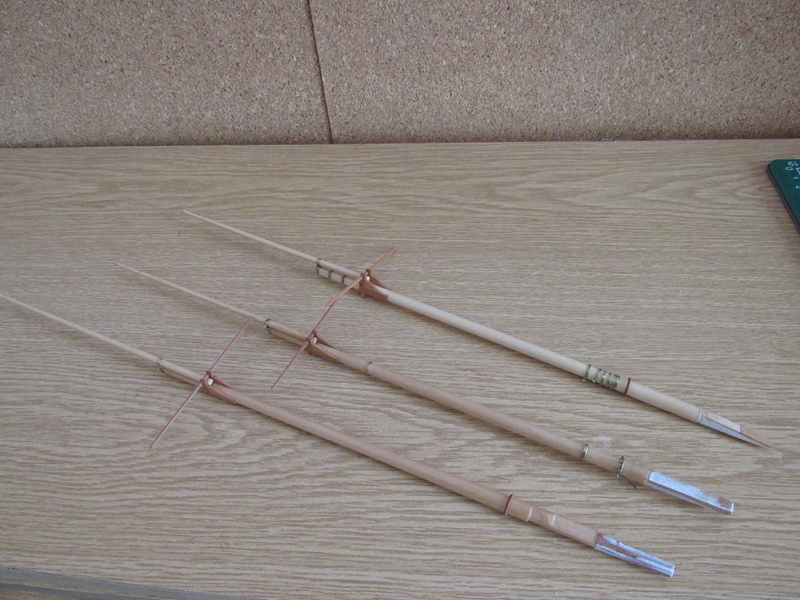

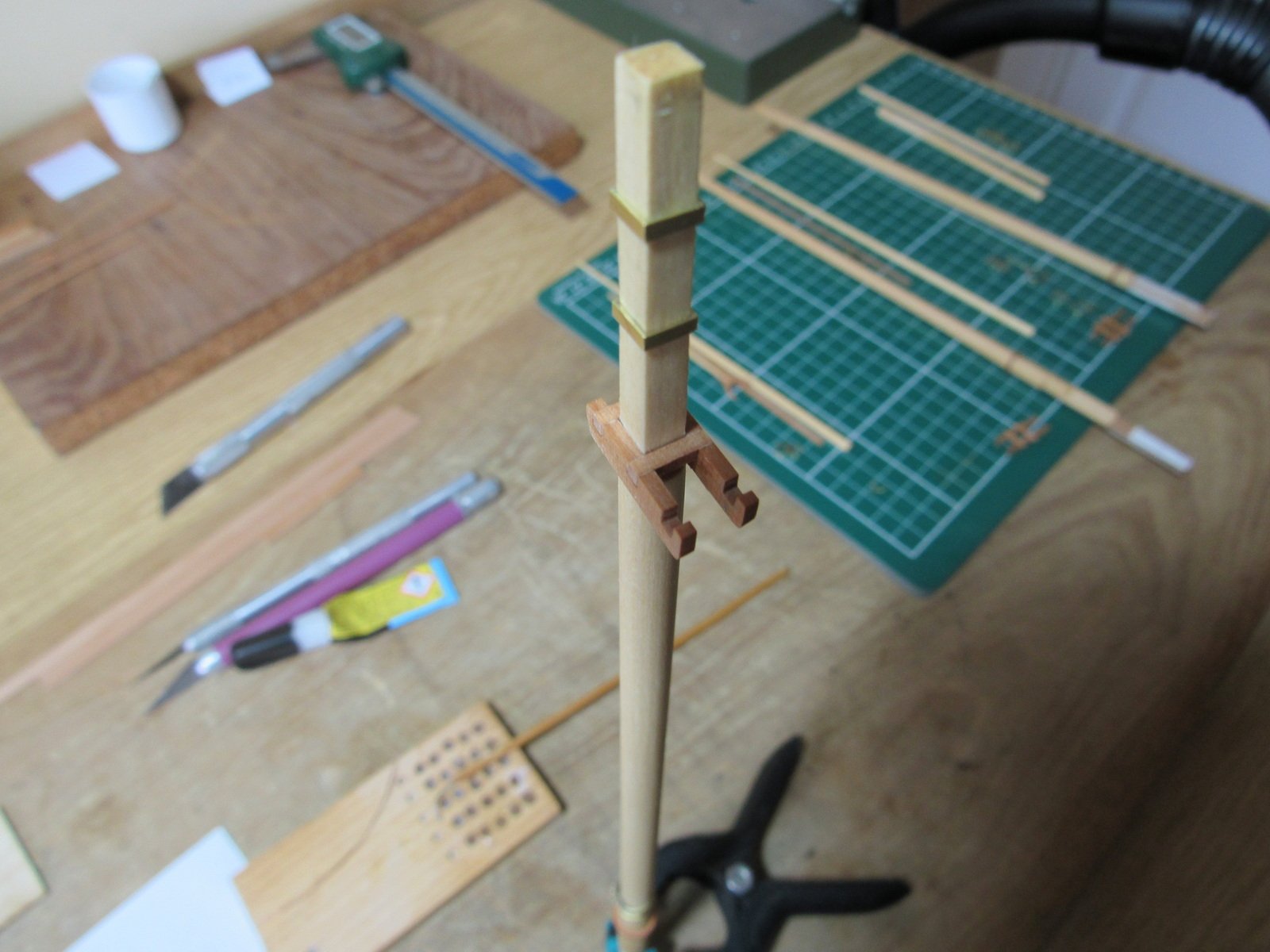

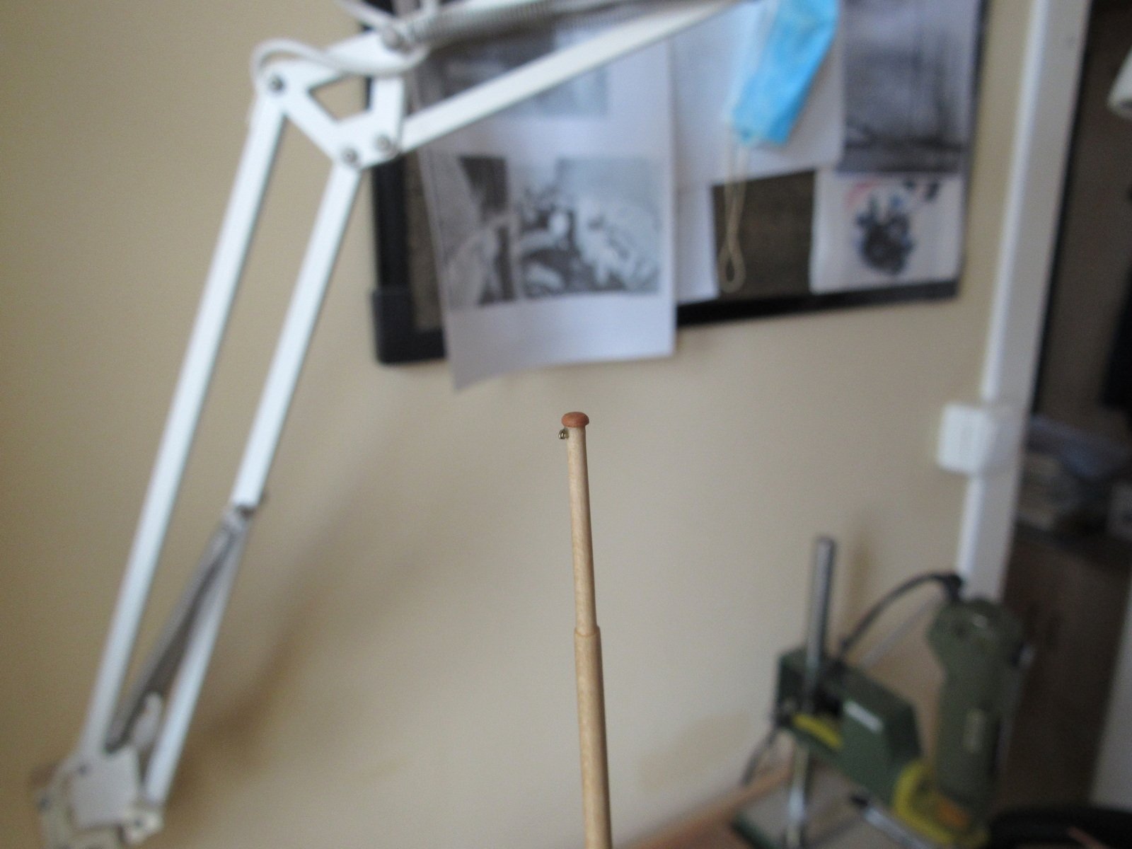

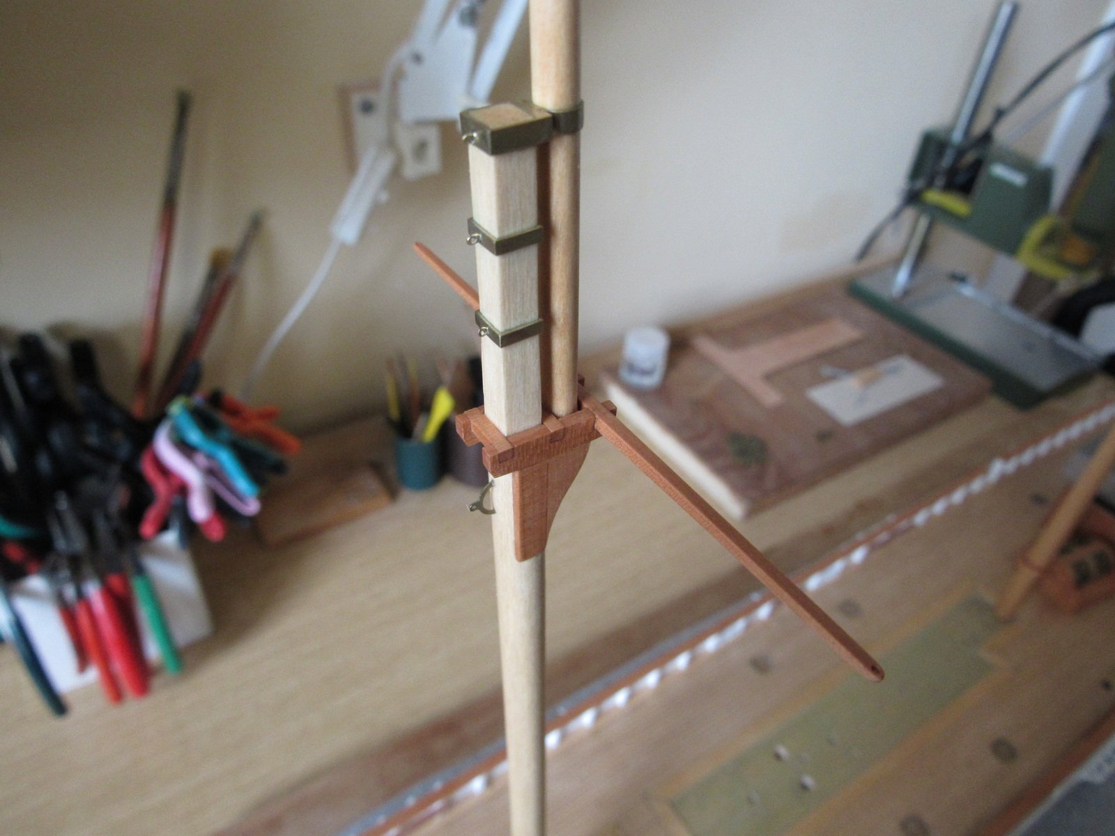

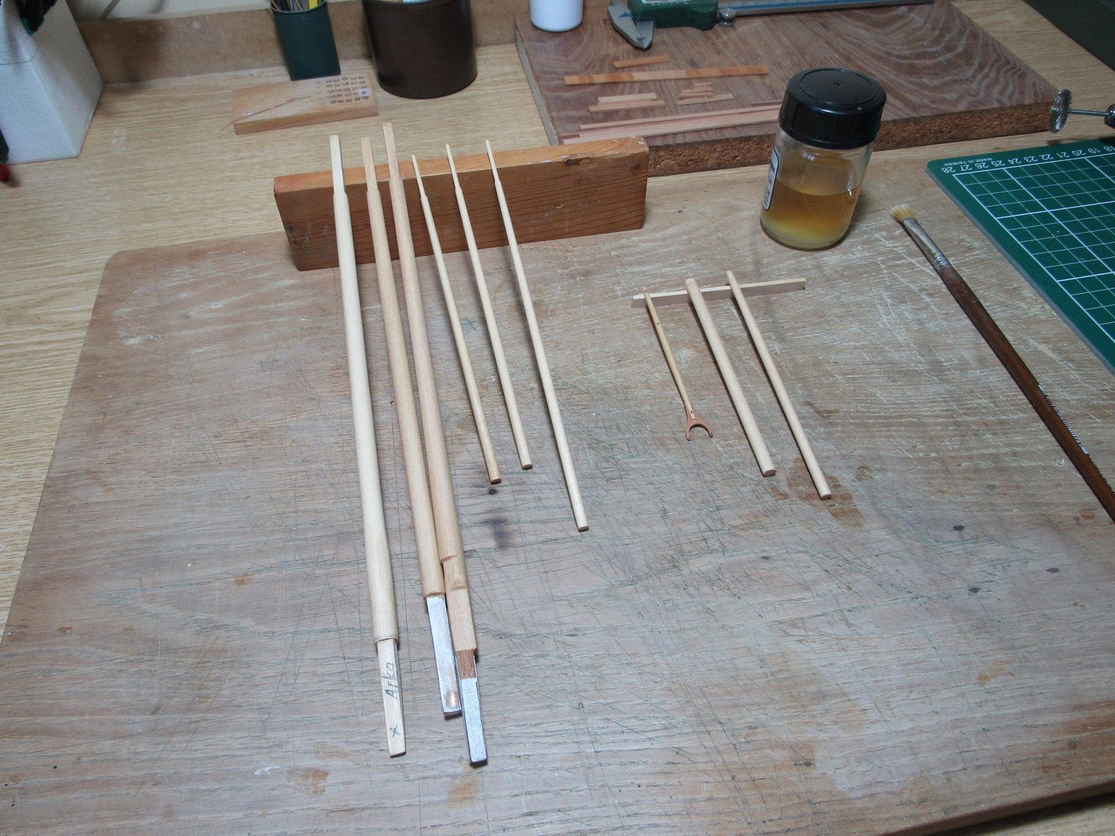

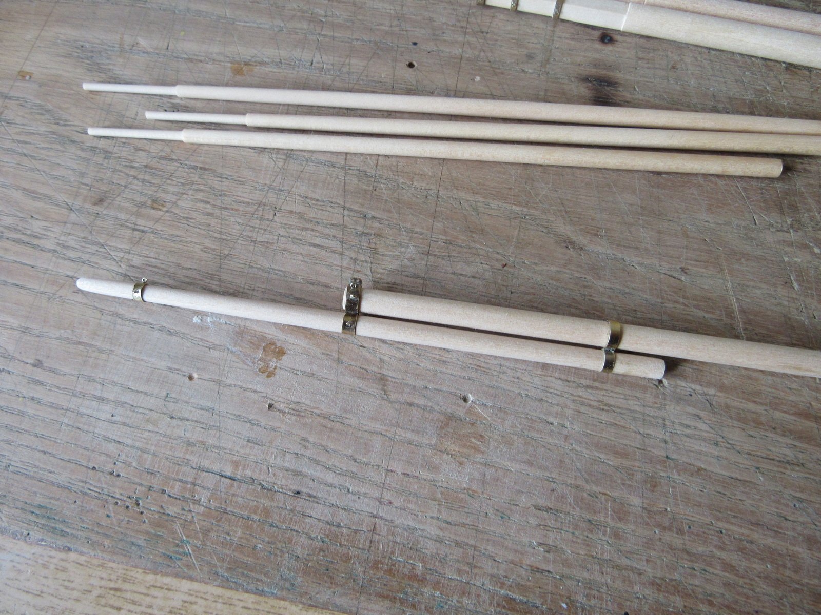

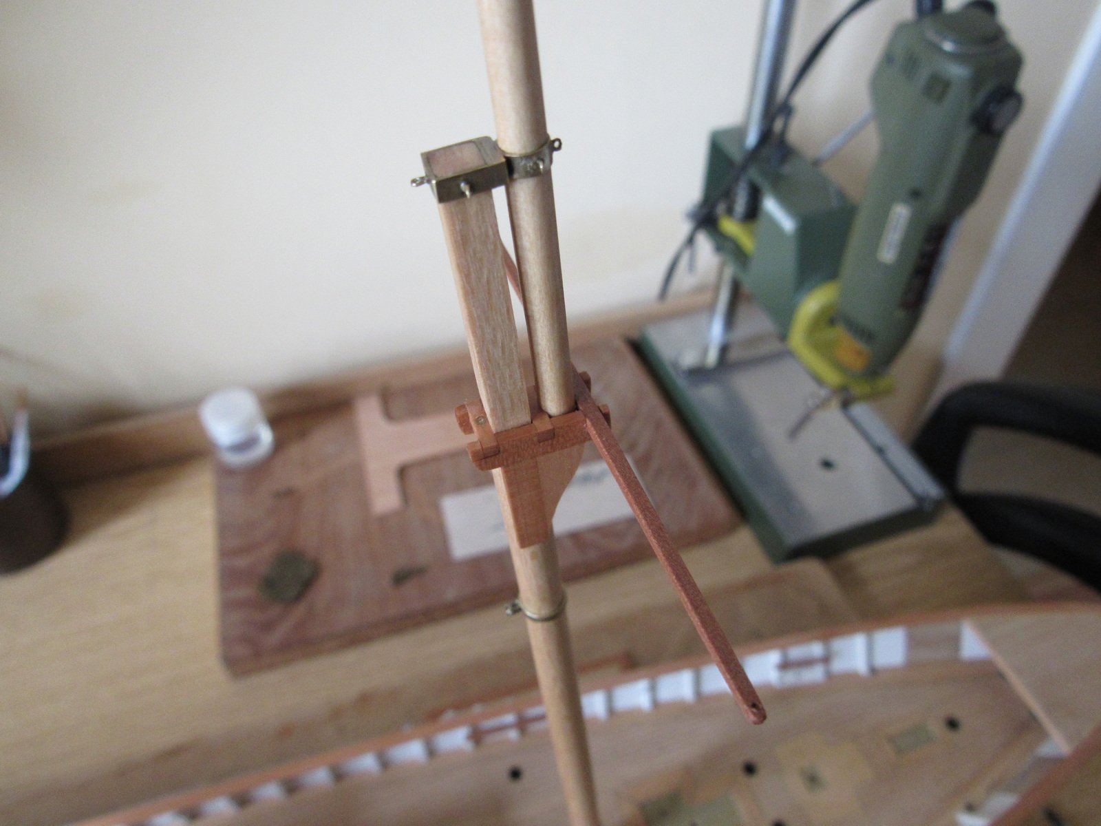

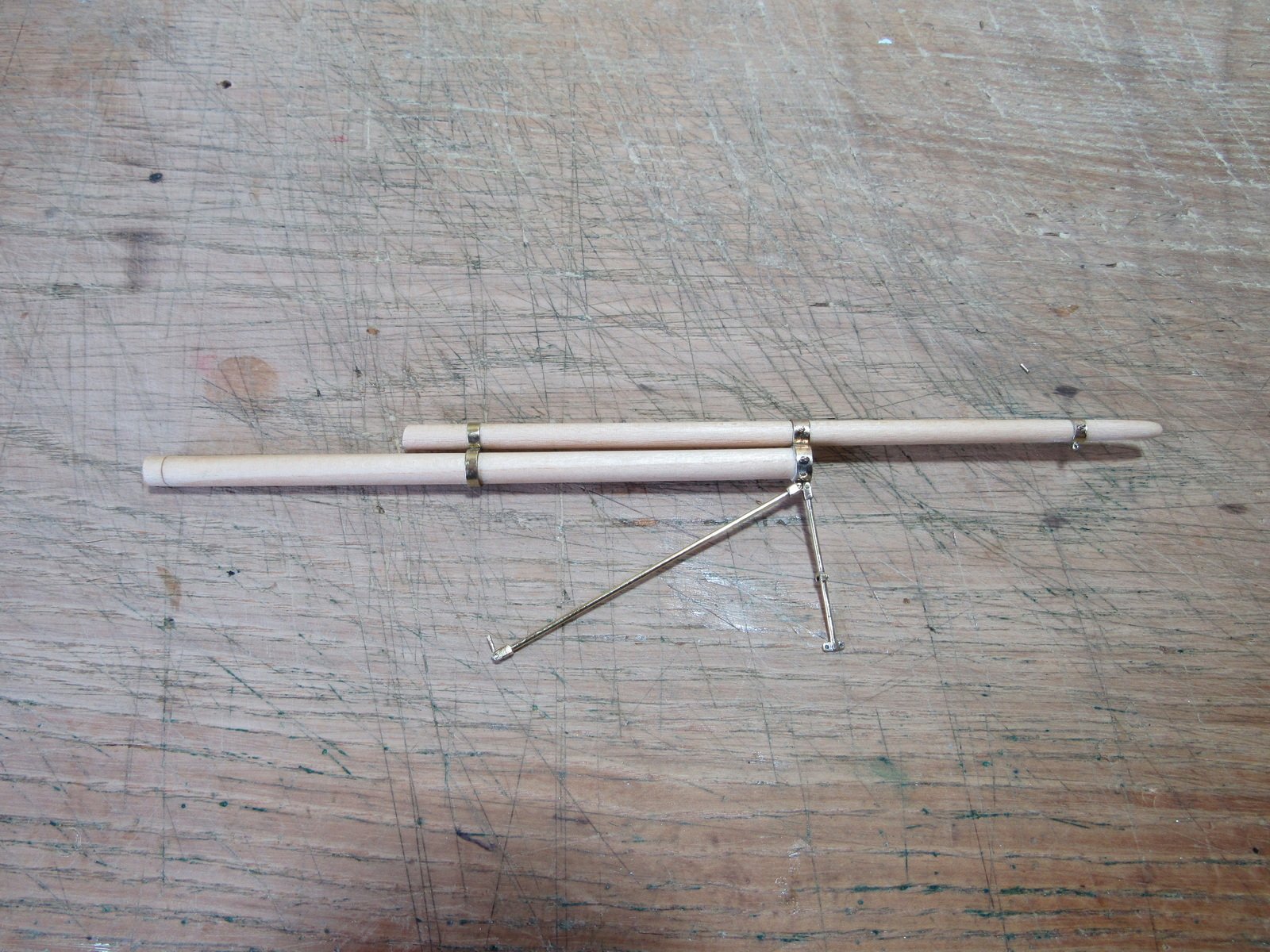

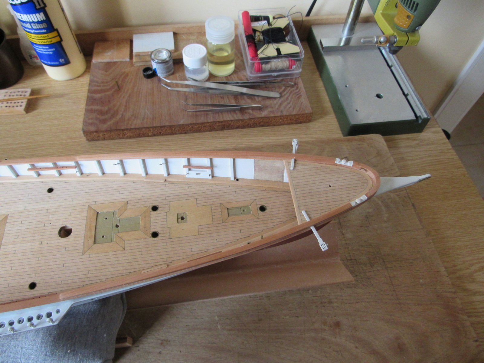

Completed the rigging on the masts. I will not glue the masts. They will have a tight fit.
I used diluted white glue for the rigging. Takes time but better than CA which is too stiff and probably not durable.
