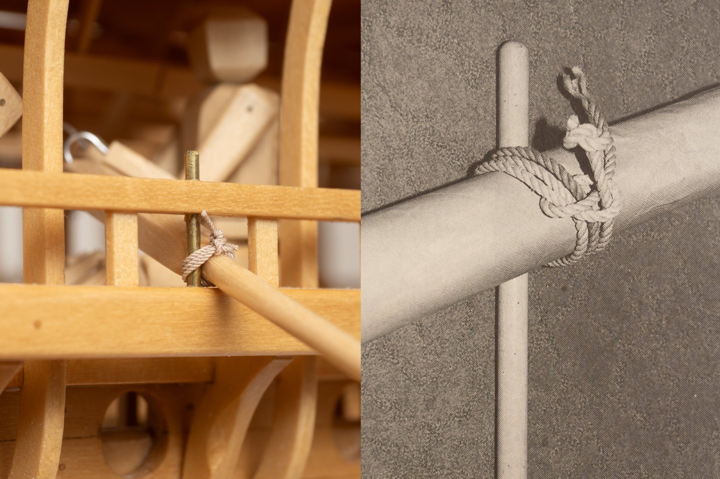

I've been thinking about how to secure the oars to the thole pins. During the first trials leather loops were used, but these tended to stretch as they got wet so in 1994 an adjustable rope grommet was introduced on the advice of a Poros fisherman (Ref The Athenian Trireme, Coats et al). I have used some thinned down leather for my steering oar bearings but am not sure of the longevity of using real leather in this application so will probable go with the 1994 rope version. Here is its using Ben's 0.5mm polyester rope (12mm full scale), which seems about right. In the Illustration "the stopper knot at one end of the grommet has been pulled clear for clarity". Mine is pulled up tight...
Still getting to grips with this small scale ropework. One of the things I've realised is the amount of wastage one requires, just to give you something to hold onto. Its very fiddly stuff!
I'm going to have to order some more rope to make sure I have enough...

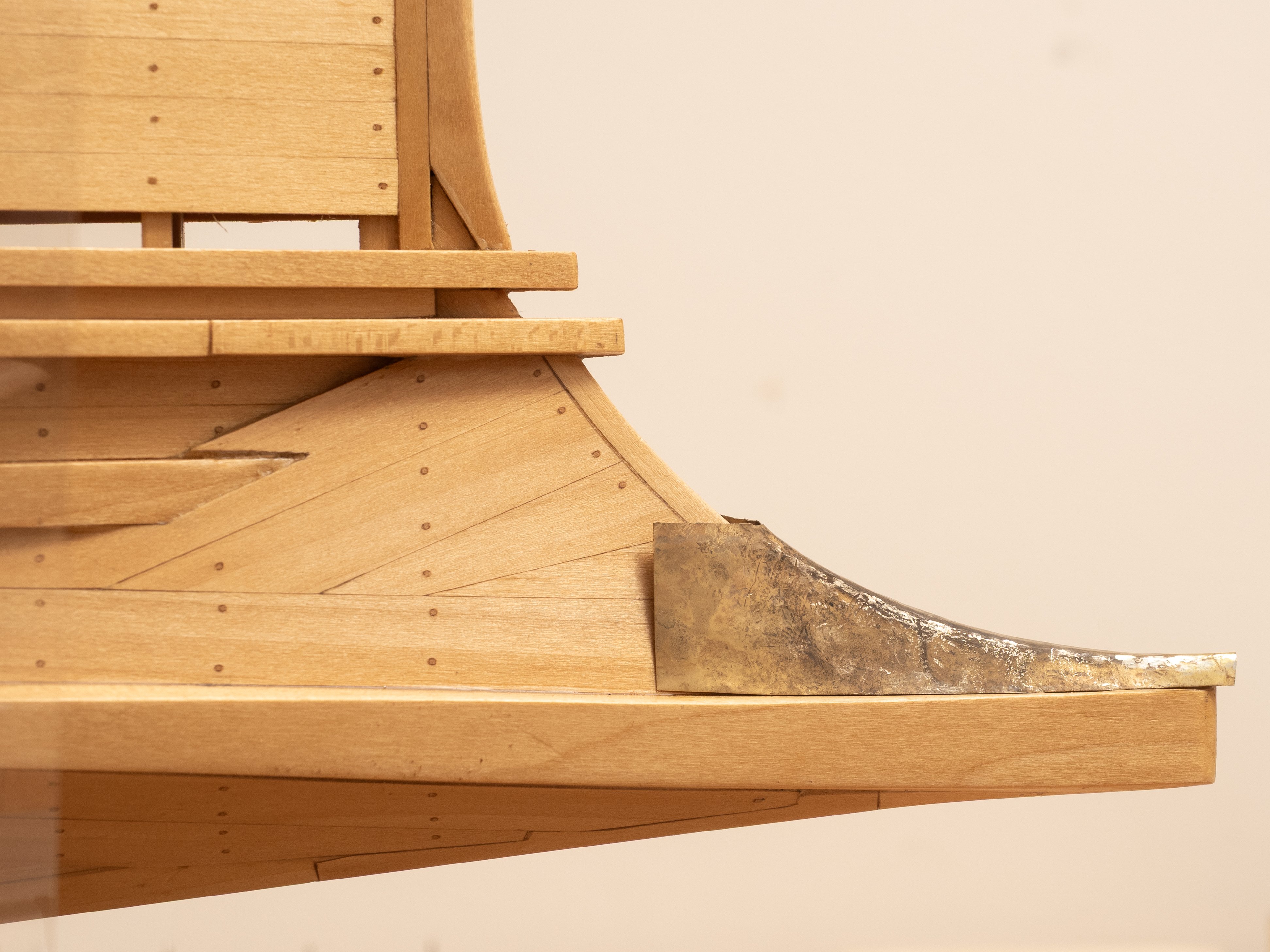

For some time I've been considering whether to cast the ram (like the archaeological Athlit Ram) or fabricate from plate (as was done on Olympias). Recently I had a go at estimating the weight and determined that the majority of the sheath needs to be 0.2mm brass (equivalent to 5mm plate full size). That excludes casting since the minimum achievable wall thickness seems to be around 0.6mm.
So, the next thing is to determine how Im going to put it together and out of how many pieces...

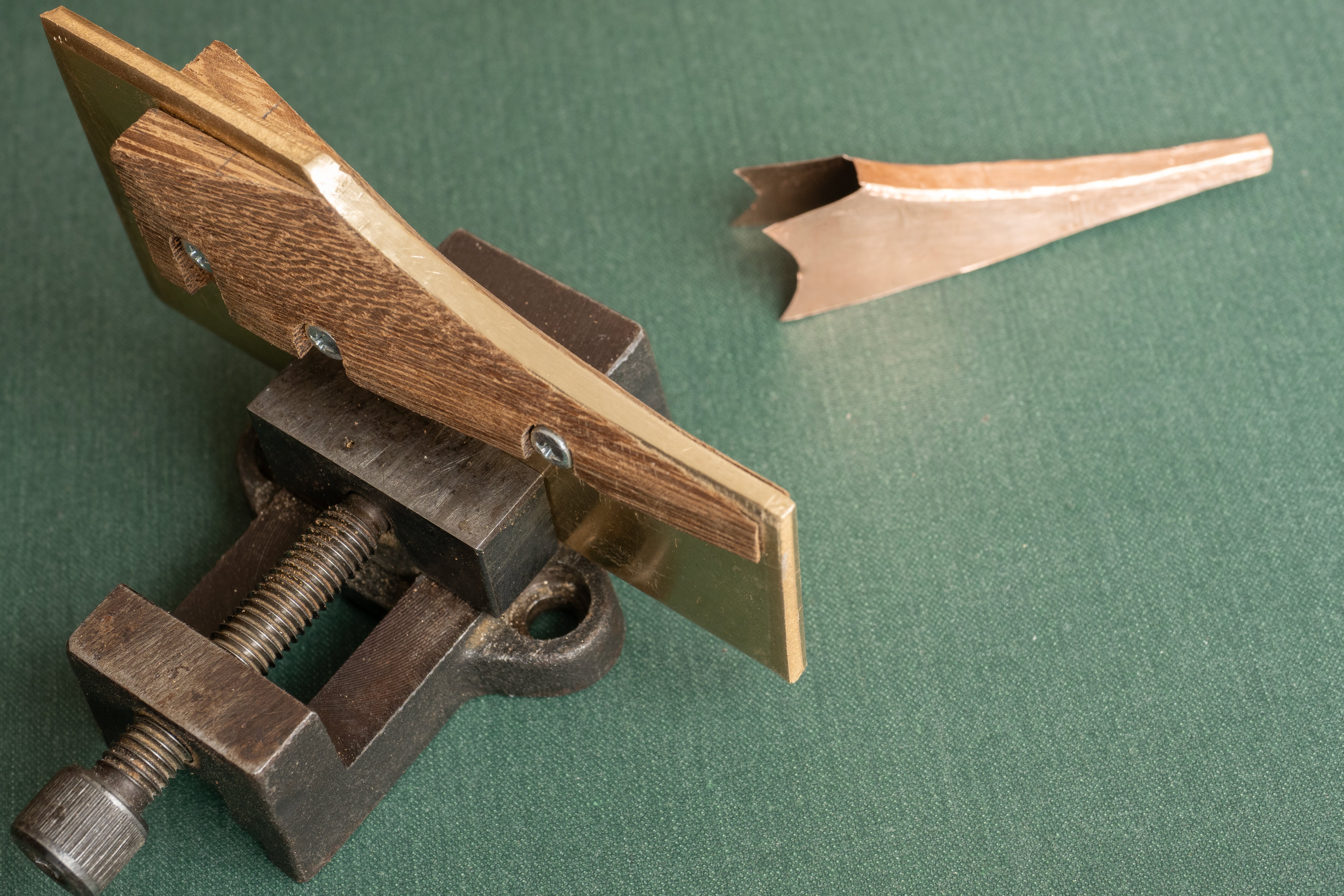

I've produced this former to look at the feasibility of shaping a single piece of 0.2mm brass for the top part of the sheath. First attempt in 0.1mm copper shown alongside the former. This worked quite well without any annealing. first attempts with brass have been difficult but, hopefully some more thorough annealing will make it work. Otherwise its two pieces with an overlap over the top. Either way Im going to end up with a lot of soldering stages so we'll have to see how that will work out...
The answer, of course, is get a bigger blowtorch...

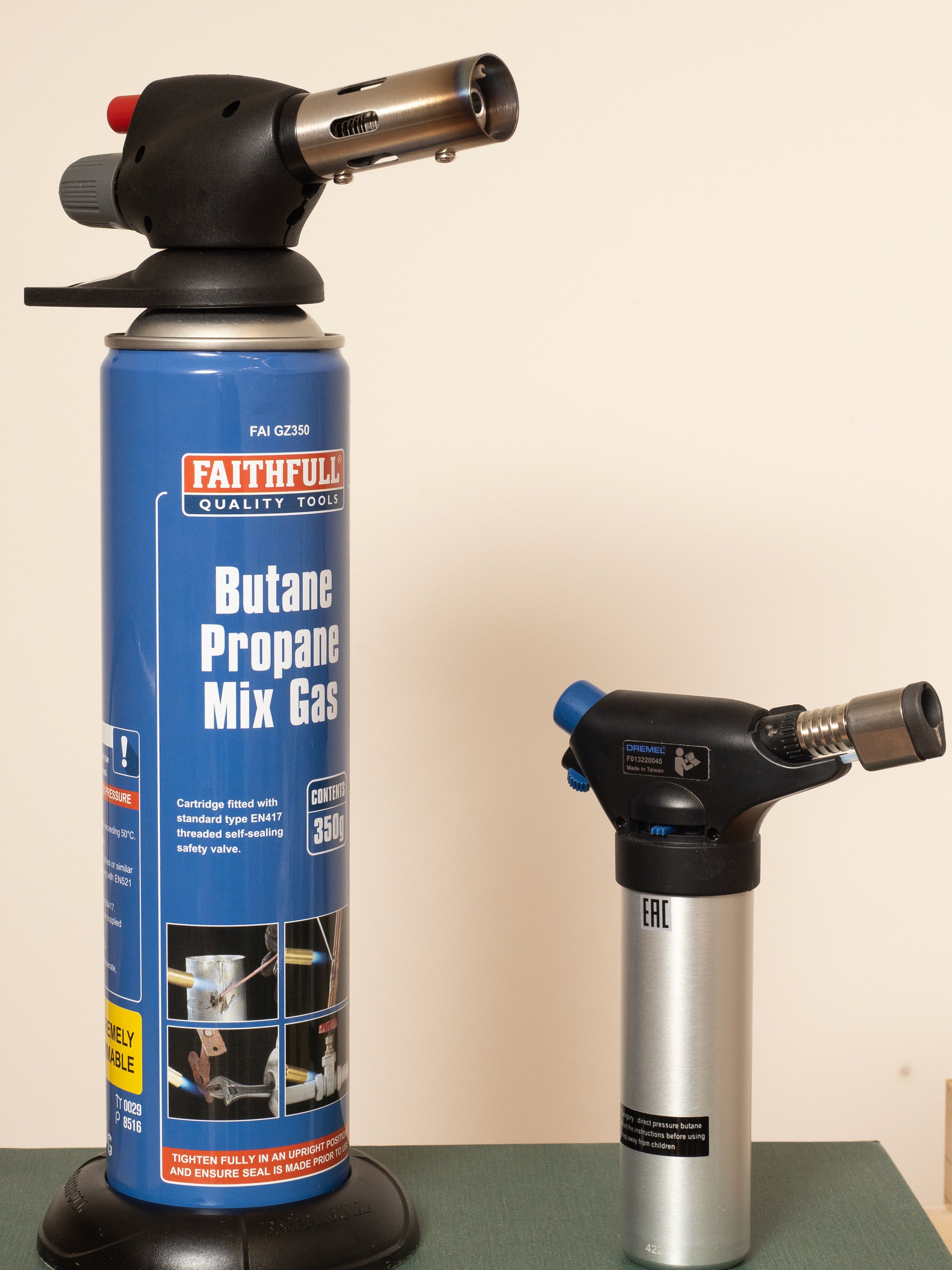

My little Dremel blowtorch wasn't capable of heating the whole piece up enough to anneal it sufficiently. Last night I got a really hot (open) coal fire going and tried to use that. Placing the piece amongst the glowing coals did generate enough heat to get it glowing red hot, but it was difficult to control and I ended up melting the ends of two attempts.
So today i bought a bigger blowtorch (the one on the left). That did the trick. Plenty of heat to get the piece red hot with sufficient control to avoid melting any of it...
The results of about 15 cycles of heating a piece of 0.2mm thick brass sheet to red hot, quenching in water and bashing with a brass hammer over my former can be seen below. Not quite trimmed to fit yet, but I've achieved the shape I need...

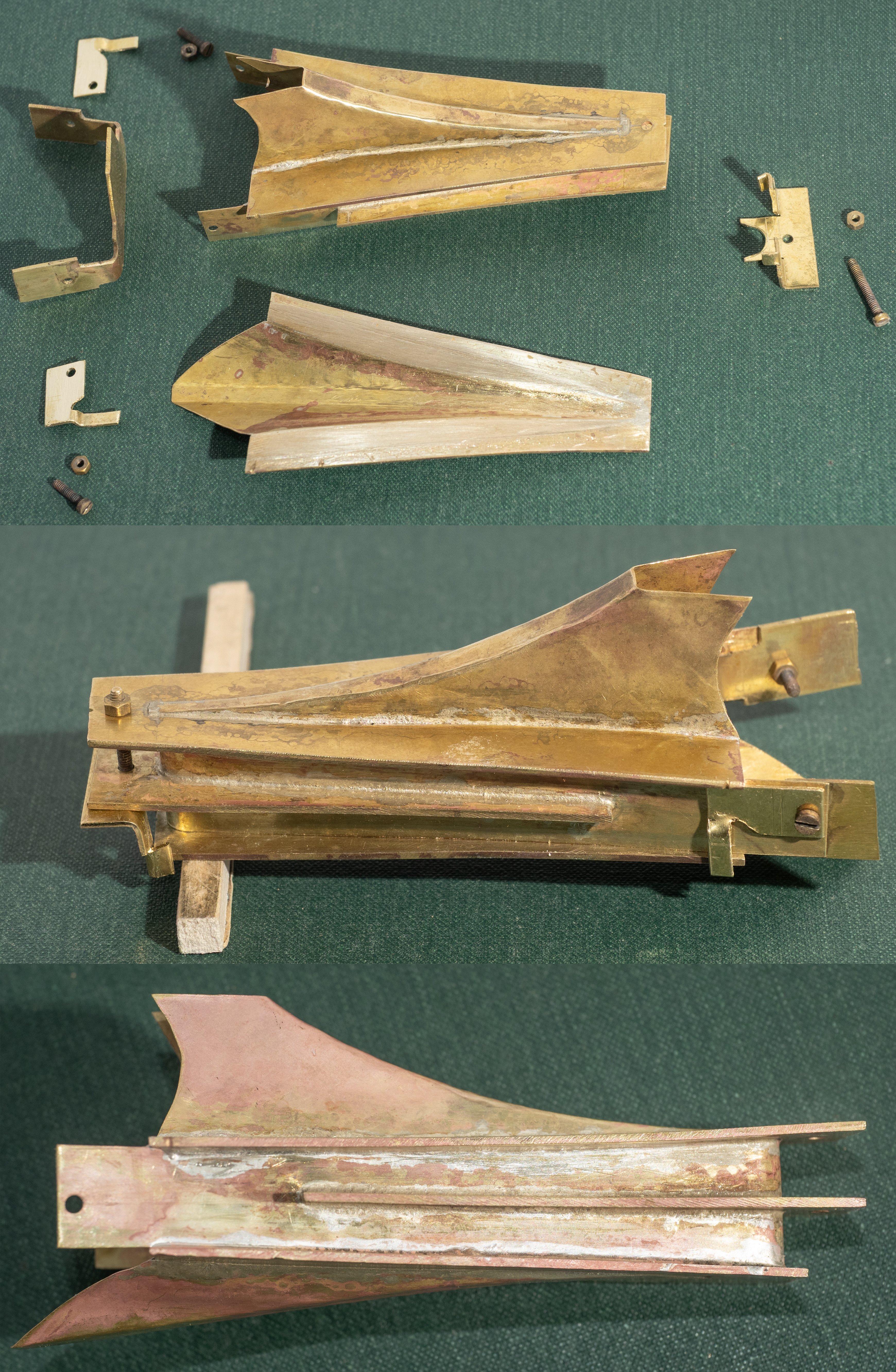

Upper part of ram assembly in construction:
Upper image shows the component pieces (upper sheathing from 0.2mm brass and upper ram plate from 1mm brass) together with a jig/clip to hold the two pieces in place while brazing. I used a silver solder paste of medium melting point (720 - 765 degrees centigrade) from Cooksongold and applied it to both parts along the contact line.
By experimenting on a test piece I found that the larger blowtorch was needed to get enough heat into the piece for the solder to flow. The results are shown in the middle image. As you can see excess solder has flowed over part of the upper ram plate which will need cleaning off.
The clip/jig was removable, but the thin strip of brass had soldered to the piece so this needed filing away as well.
The lower image shows the piece after soaking in "Picklean Safe pickling powder" (again from Cooksongold) and some cleaning with files sandpaper and a wire brush. I'm planning to leave final cleaning until the entire ram is constructed (there is a lot more heat to put into it before then).
Apparently the pinkish areas are caused by loss of zinc on the surface of the heated brass, it seems very superficial so, hopefully I can remove it in the final clean...
Here are the upper and lower pieces and the mid ram plate loosely held on to the wooden ram structure. I'm quite pleased with the fit I've managed to achieve so far (there have been a few "test pieces" which didn't work out! - but were useful for practicing soldering of these very thin plates...) . The real challenge is going to be aligning the three pieces when I connect the three pieces together.

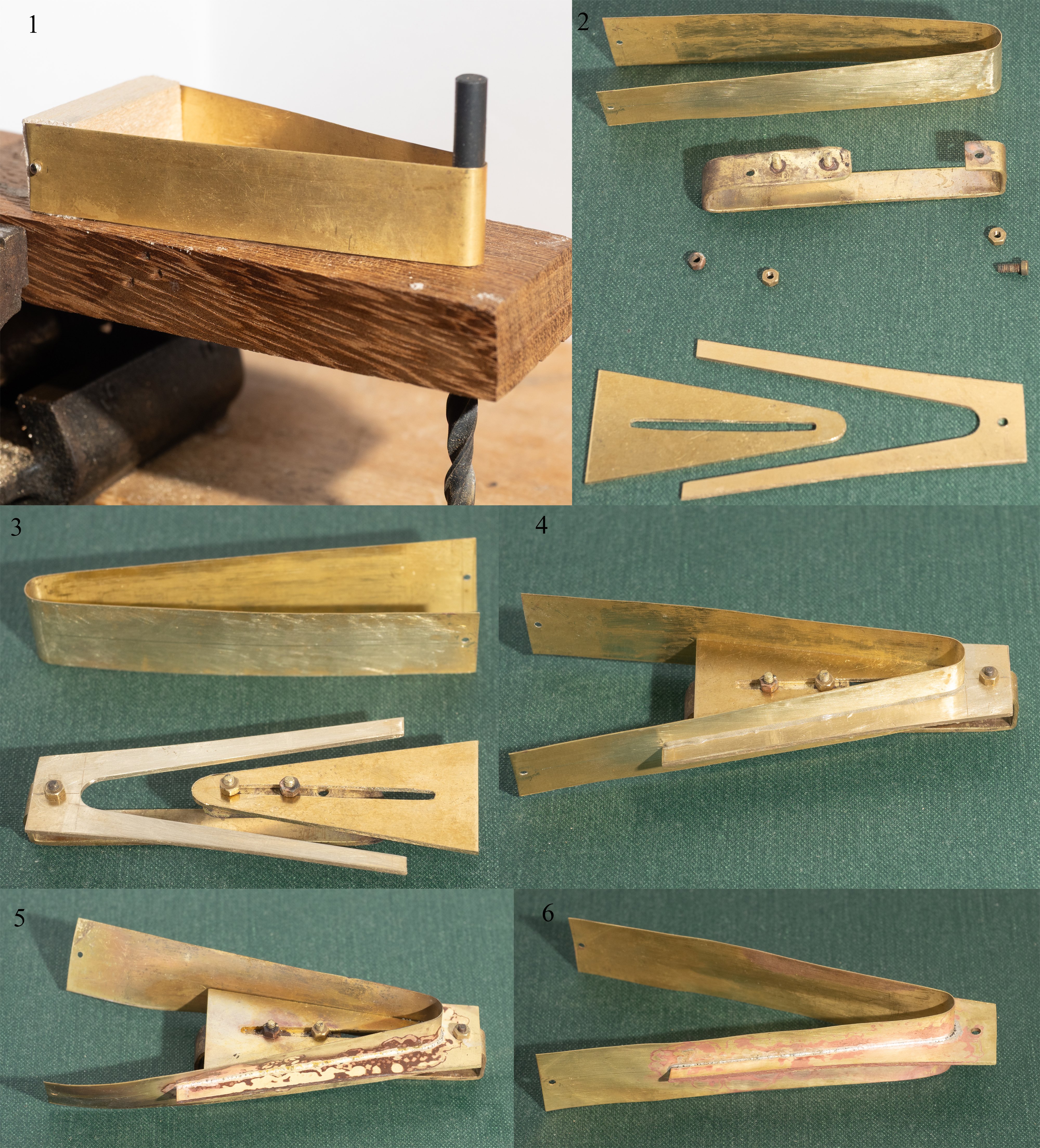

Mid part of the ram in construction (Part 1)
Image 1: Shows the mid cladding plate being formed around a 5mm drill to fit the radius at the front of the wooden ram substructure.
Image 2:  The Mid Ram plate (the fork shape piece at the lower right hand corner of image 2) is shaped to fit the wooden ram substructure and the slotted plate is shaped to fit inside this with a clearance of 0.2mm all round to allow for the thickness of the cladding plate. The drilled bend plate in the middle of image 2 is designed to hold the mid ram plate firmly while the slotted plate can be pushed forward to force the cladding plate to the right profile. I have soldered (using medium silver solder) the two bolts that hold the slotted plate as I found that it was over fiddly having these loose).
Image 3: The silver solder (medium solder/flux paste) is applied to both the cladding piece and the ram plate and then the cladding plate is lowered into the jig and the slotted piece pushed forward to force the two parts together in the required alignment.
Image 4: Shows the result with the silver solder paste applied.
Image 5: Shows all the distortion that takes place with the 0.2mm plate when you heat it up high enough for the medium solder to melt!
Image 6:  shows it after cleaning with picklean and roughly straightened out.
Clear as mud?
Ive left a couple of mm of "green" each side of the cladding sheet which I now need to shape to fit the space between the upper and lower ram assemblies...

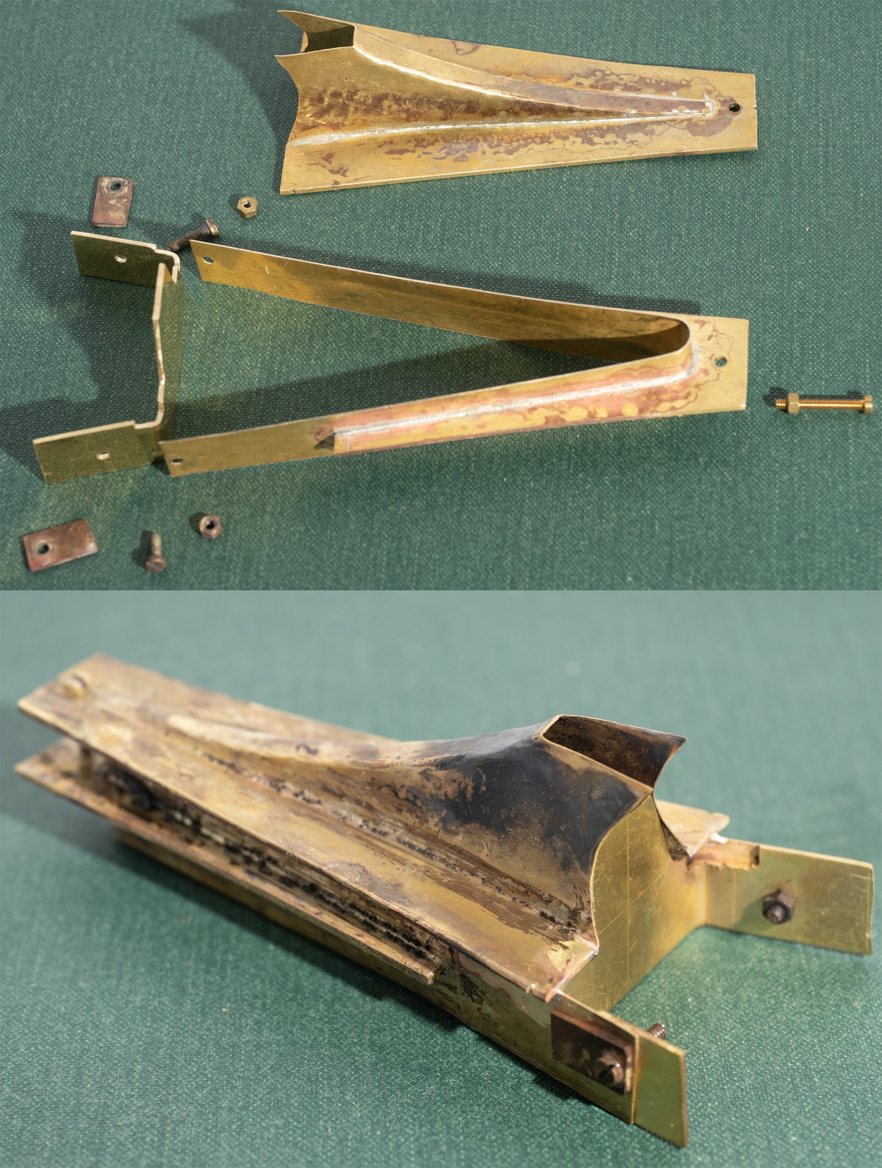

Today attached the Mid ram assembly to the upper ram assembly.
1 The upper edge of the mid ram cladding was shaped to fit the curve of the upper ram plate. This requires a high degree of accuracy as silver solder has very little gap filling ability.
2. Constructed a jig to hold the aftermost (highly flexible, particularly when heat is applied) part of the mid ram cladding firmly and at the right distance apart to closely fit the ram timbers (upper image below)
3. The existing welds were protected using "TEMPGUARD" heat dissipating gel to reduce the risk of them falling apart during the soldering process.
4.  Silver solder/flux paste (Easy 705-725 deg C to get some distance from the medium solder used previously...) applied and the two pieces brought together for soldering. I ended up using the large torch for this even though it wasn't possible to be so precise with the heating,a s I found I needed the heat input.
5. The result (bottom image) after soldering but before jig removal and "pickcleaning".
I was very pleased at the accuracy I achieved with this. The ram fits very snugly on the timbers (so far). I also managed to engineer the jig to keep it clear of any solder so it didn't require the endless filing I had to do previously.
