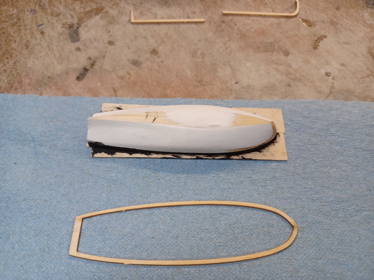

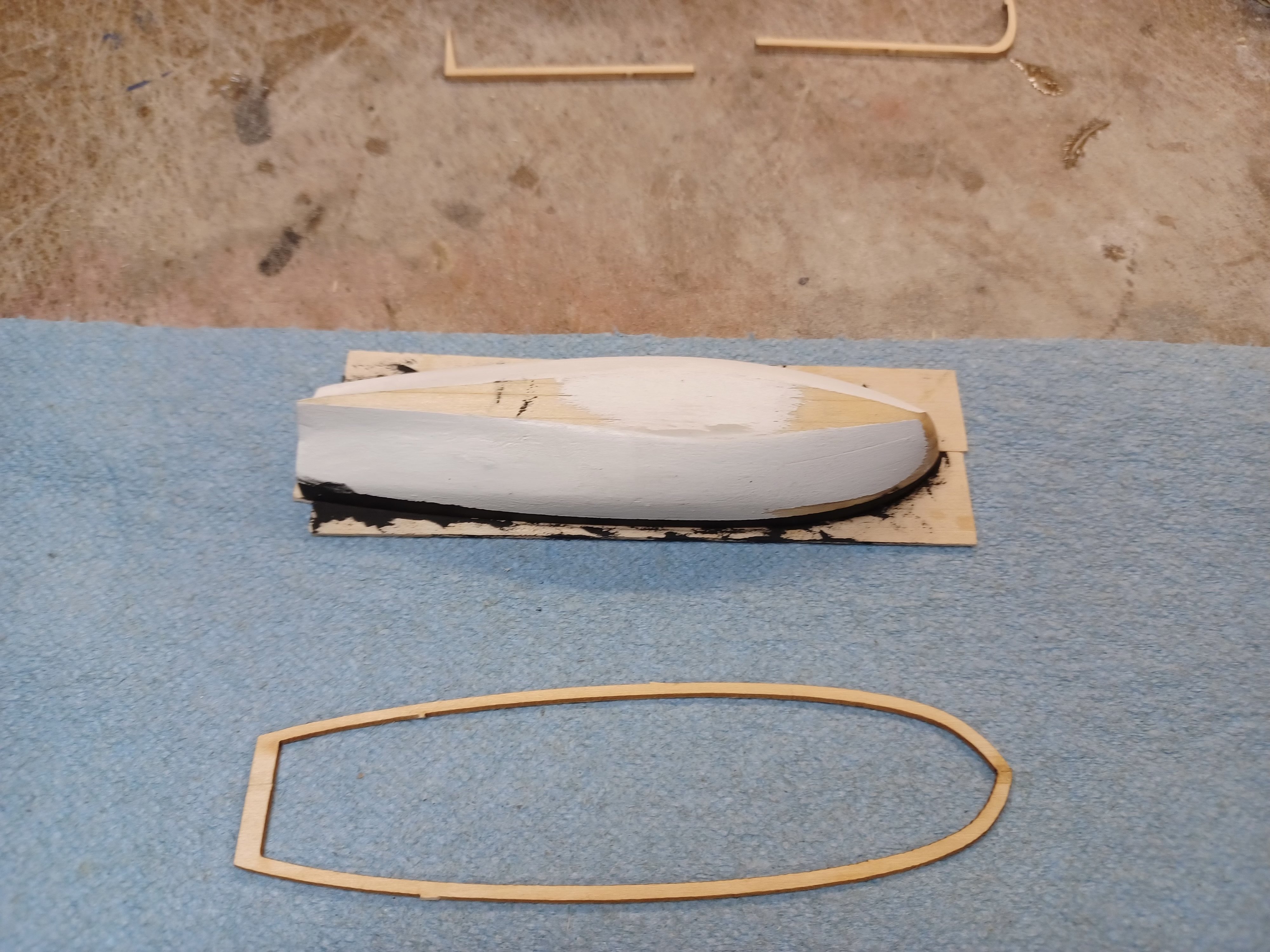

Here is a series of pictures that depicts how I did my sanding/shaping.  Some of this has been used in shaping balsa pieces on my planes.  I am not saying this is the best, or only way to shape the lifts, just how I do it.
For First Timers:
1. Pick an end to start at. (I chose the wider part at the bow.). This allows for a wider area to start with.  In smaller, or narrower areas, you will find the changing file size and shape a frequent chore.
2.  Try to sand across two lifts each time.  Begin sanding the ridges down I try to vary which 2 lifts I work on.  The intent is to sand the darker laser cut areas away leaving only clean wood.
3.  Since the bow is a wide area, sand evenly across all lifts.  As you do, the darker parts will begin to narrow.  The goal is to remove just enough material to eliminate the lines totally.  However, pay close attention to the thickness of the wood, all lifts.
4. As you follow the steps above, keep drawing the sanding further back narrowing the lines into the narrowest you can get.  Most will simply disappear and if you stop sanding that area as soon as they do, the shape will begin to appear.
5. The narrowest areas at the stern will take several different sanding tools.  Sandpaper wrapped around dowels of different sizes is my way.  Along with mini files and sanding sticks.
6.  Along the way, try dragging a fingernail across the lines.  When you get to the point that you can diminish the amount of sanding in that area.

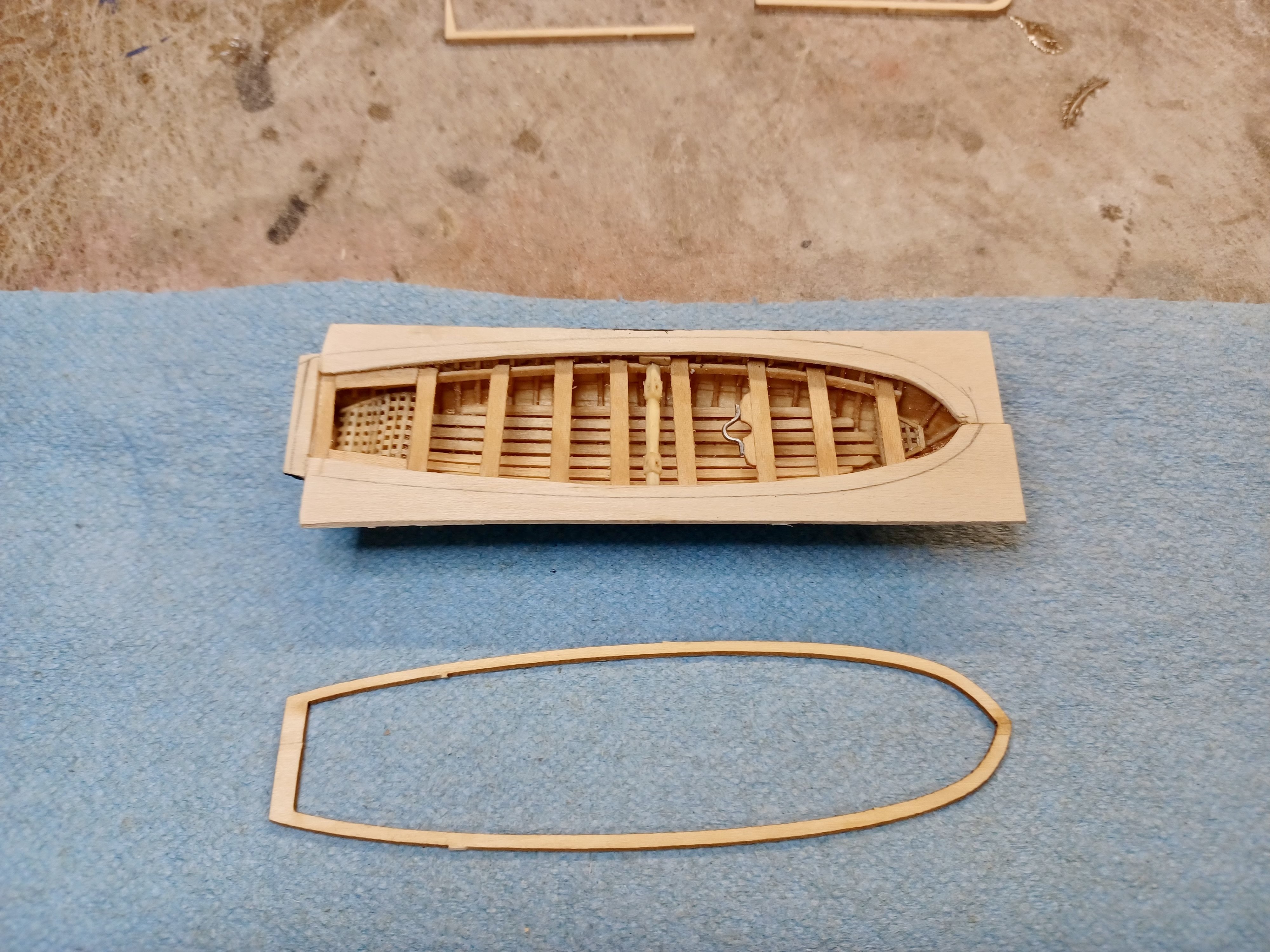

Now it is on to the longboat inside shaping.  All of the sanding steps in my previous post are still relevant.  Removing the biggest part of the burned wood from the lifts is still a good guide.  However, I recommend keeping a sharp lookout right at each lift joint.  Since we sanded enough on the outside to  remove it, the closer you get to it being removed, the thinner the joint is.  Again I have started at the bow concentrating on forming in a good vertical joint bottom to top.  In the picture, you can see the different dremel bits, mini file, and sandpaper.  I constantly switch in order to sand out different parts at different angles and shape.
Picture two is how I check the thickness in the sanded area.  Once you can see the light glowing through the wood…stay away from that area.  The goal, for me, is to remove excess wood in the areas where no light is emitted.

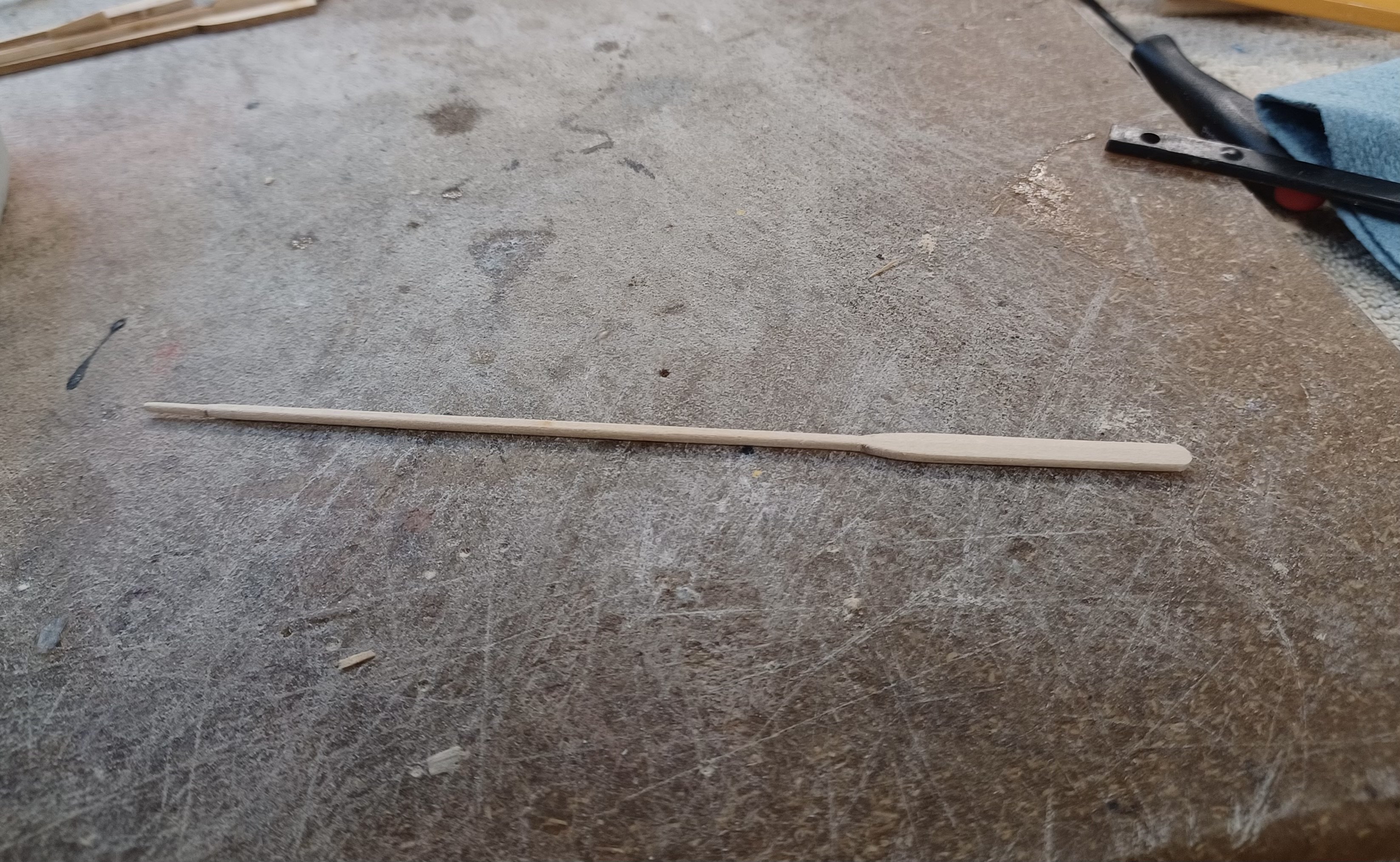

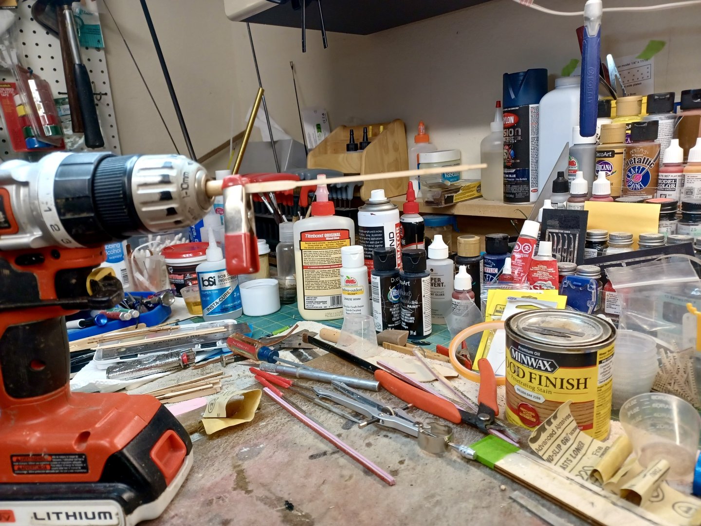

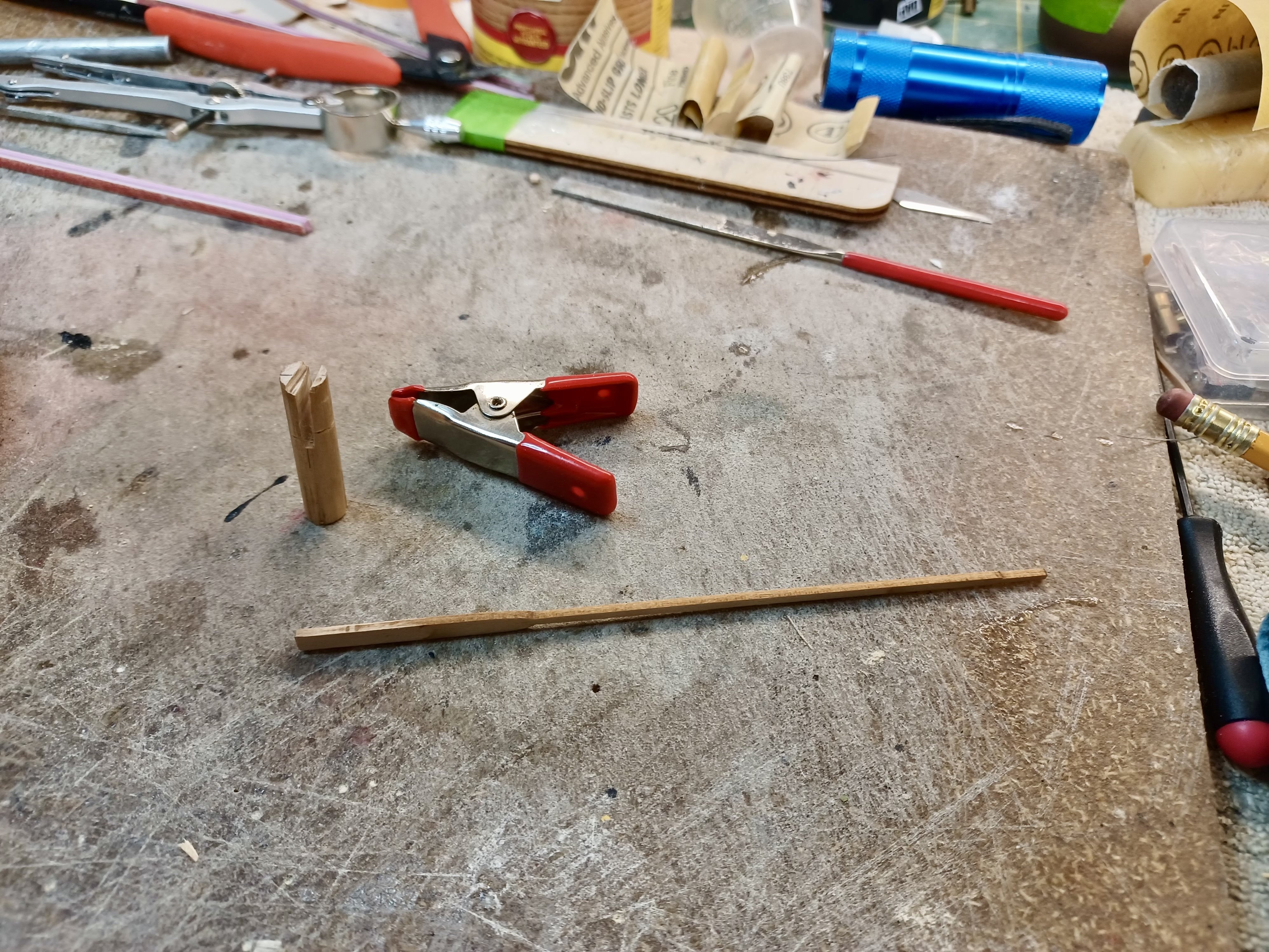

I am at the point where I needed to remove all 22 sweeps and oars from the laser cut stock and shape them.  So, I either needed to figure out a way to make it easier to shape, or spend hours sanding the square shafts into round.  I decided to try something in my cordless drill and found a solution that is not perfect, but does make possible to shape them quickly.  Using a piece of 3/8” dowel, I cut a slot in the end.  I then slip in the wide part of the sweep and shape the long round section and handle.  Here are pics of the parts, then in the drill, and finally, the result.
Neat trick!

Thank you all. It took a while to figure out, and it’s not perfect.  It is difficult to get the sweep perfectly centered, but if I loosely hold the sandpaper, the wood is flexible enough to wobble without breaking.  And by using a small bar clamp on the drill (See post #373.), I can set the speed where I need and concentrate on shaping.  One tip I have is that progress can be felt in my fingertips.  With it starting out square, I can sand until no more vibration from the sharp edges is felt.  Then it’s just a matter of shaping the paddle and the handle ends.

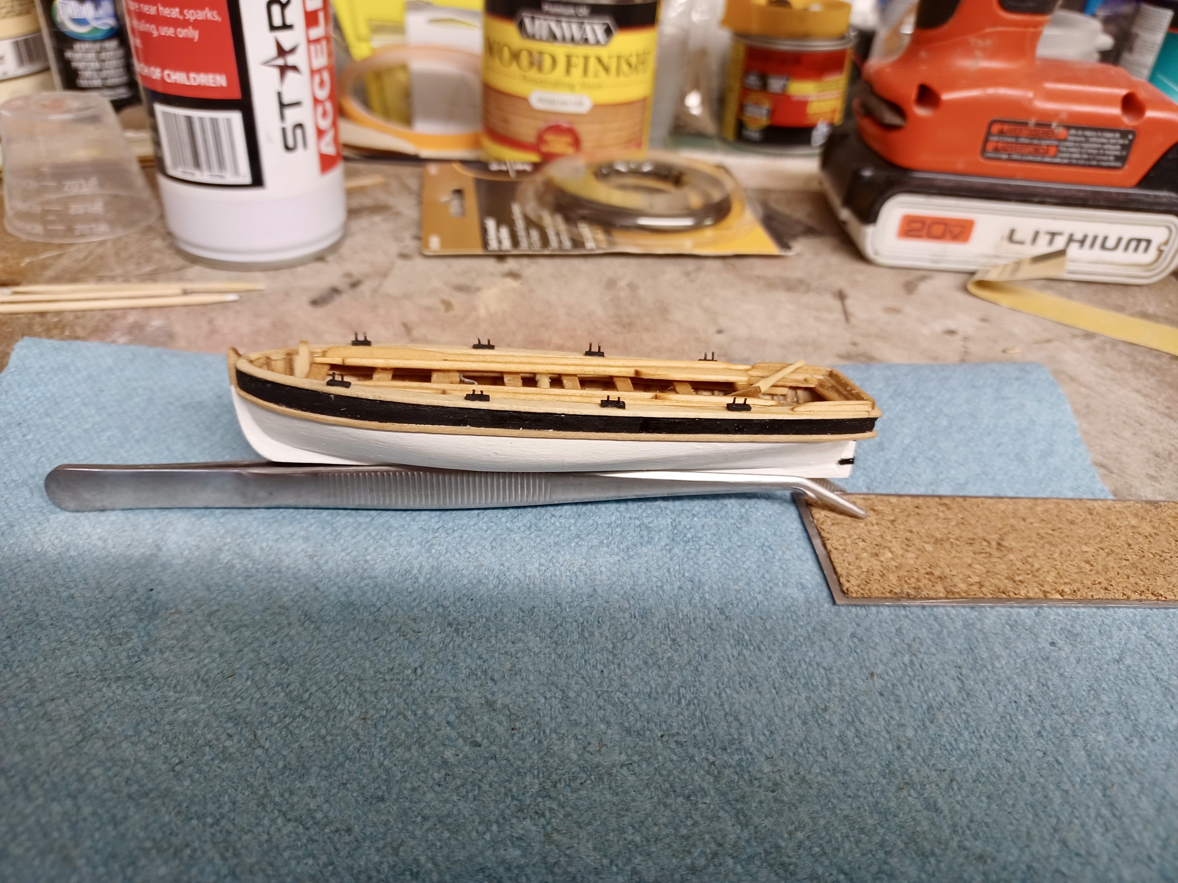

Ready for the Gallows Bits

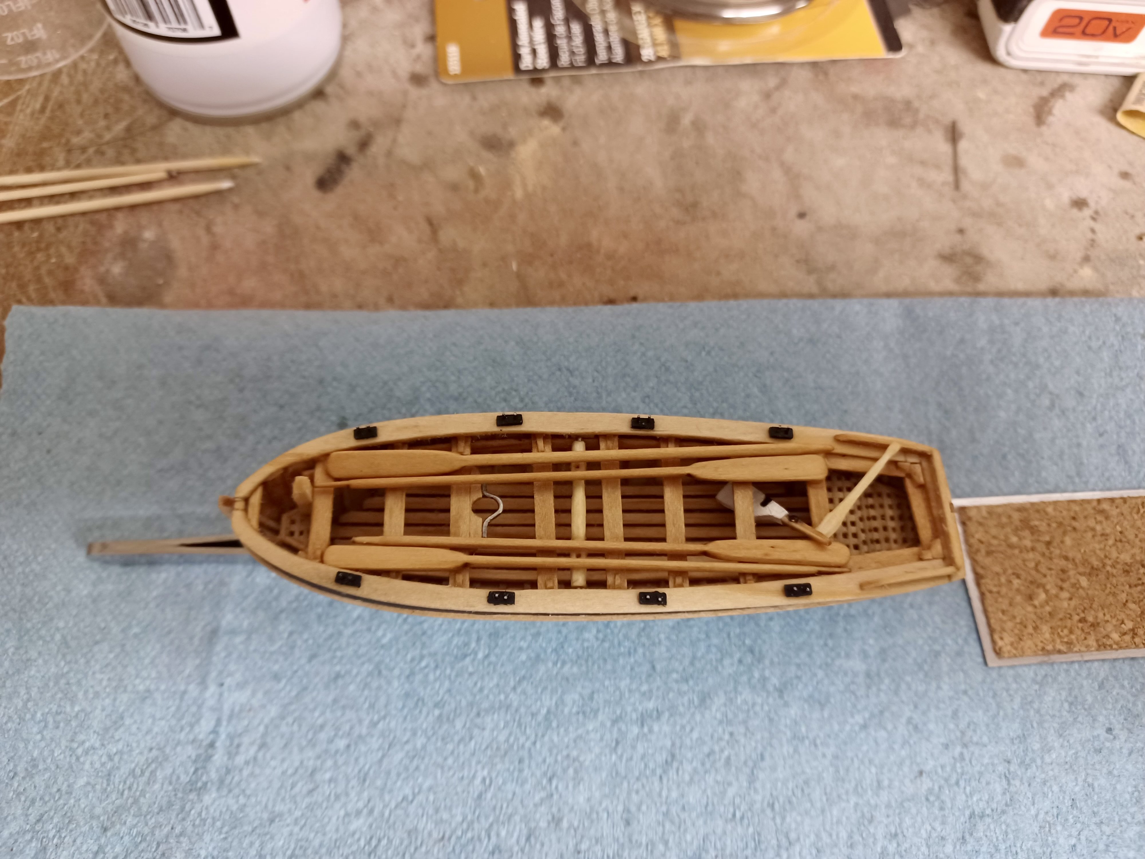

Finally completed the longboat and it is ready to be added to the deck.  I still have the rest of the sweeps to finish before mounting it in place.
**One thing that became clear during the construction, using my drill apparatus to turn the oar handles does not work well due to the oar being quite small.**.
So, they were sanded by hand.  Many a profanity was issued when trying to attach the gudgeons and pintles.  If they were any smaller, a sneeze would cause them to disintegrate.

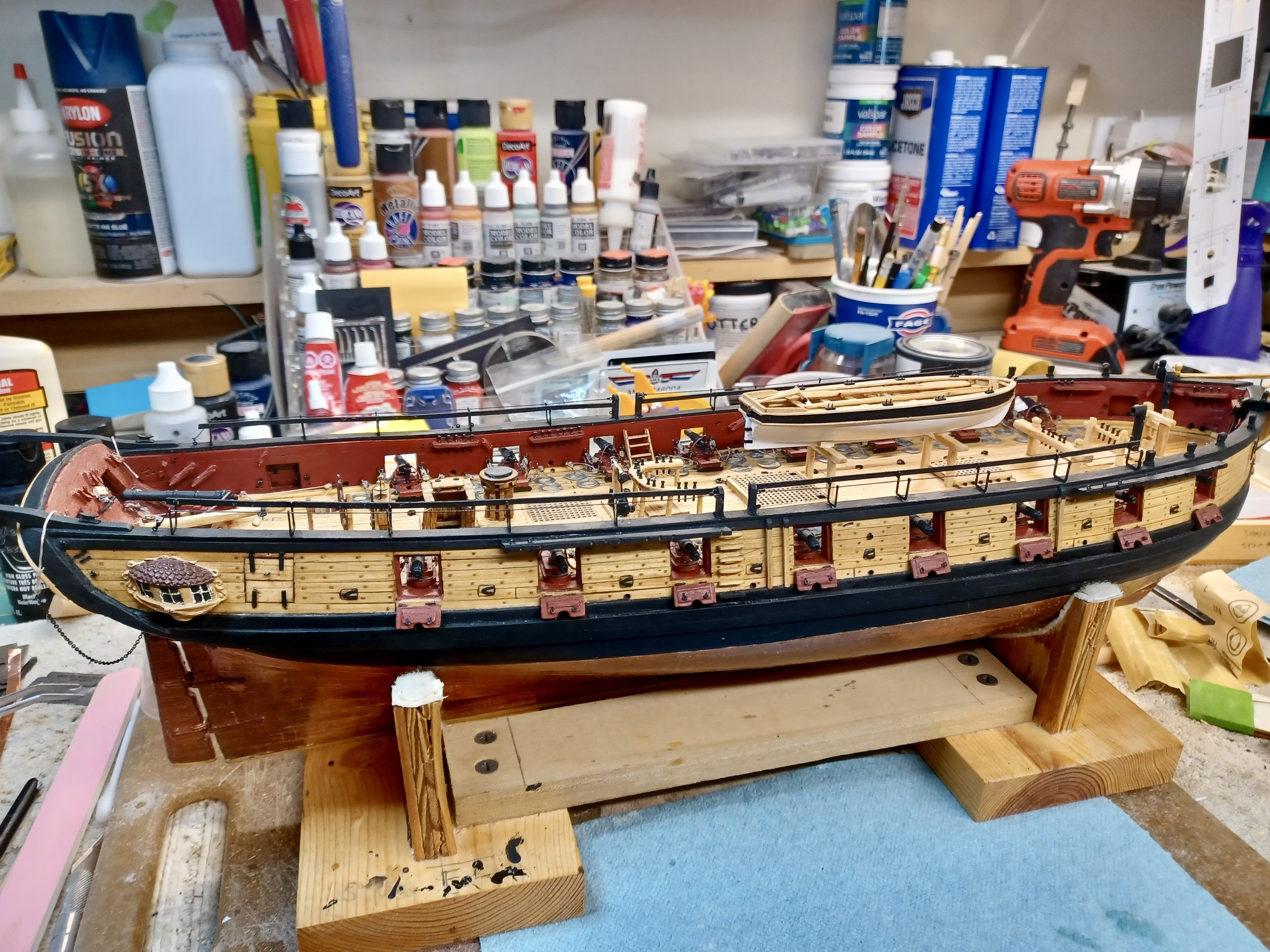

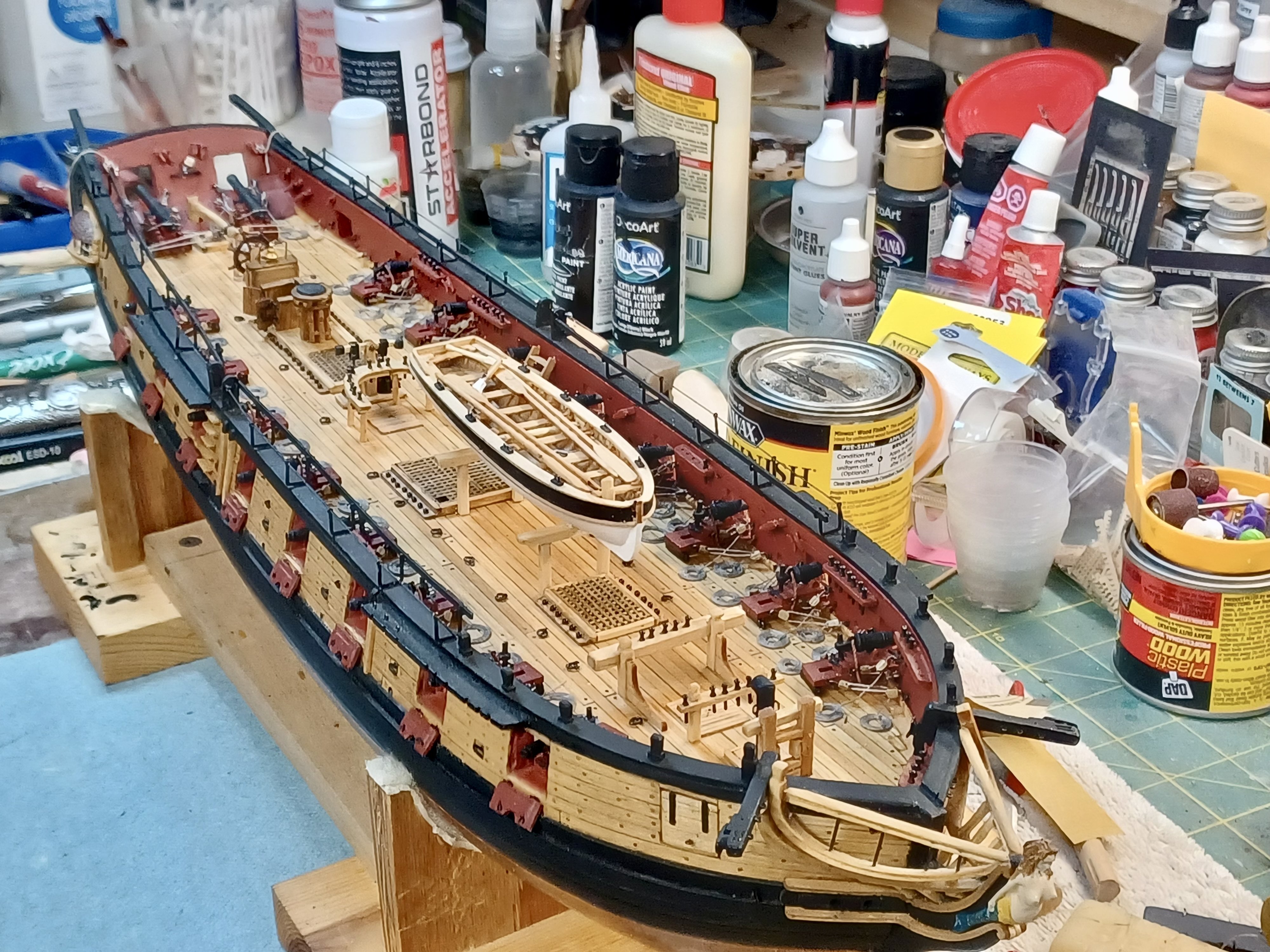

Big Change With Longboat
It’s amazing how the height and depth perception changes with the addition of the longboat.  The perception has really changed and the Syren is starting to look like a real ship…only in miniature.  Those areas, and small blemishes have started to move into the not noticeable.  I still have the sweeps to sand, lash together and add, but that should go quickly.  At this point, I can only imagine how the result will begun to appear when adding each new element of the rigging.
Unfortunately, it’s that time of year where mowing becomes a have to do, and the heat will begin to shorten my building time.  I can always pray for rain, but that doesn’t help much.  And the pics.

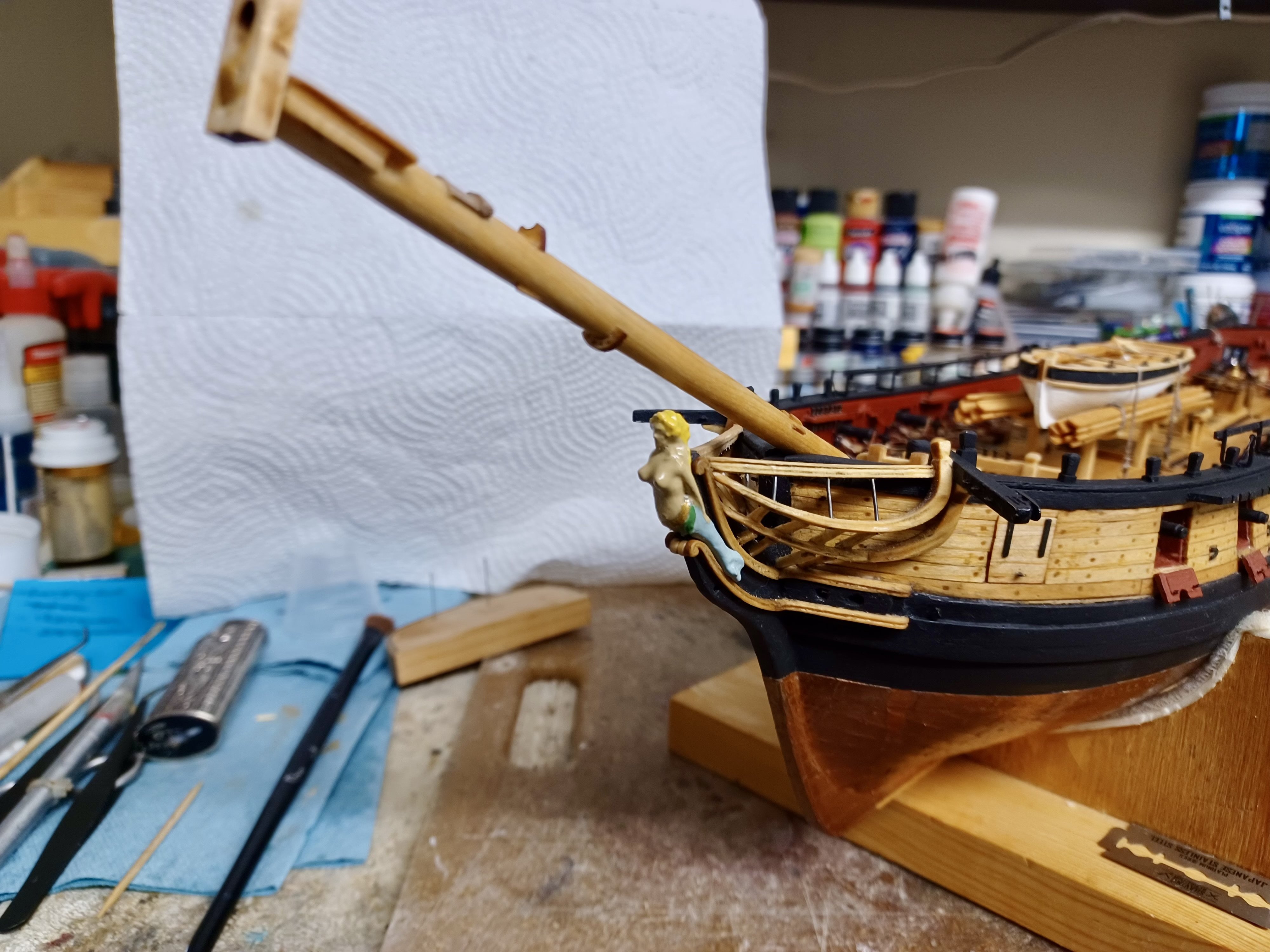

First, is the figurehead and its appearance.  What you see in the picture is after about 3 or 4 attempts using different colors.  My goal was to have color, but not so much detail as to draw the viewer’s eyes away from the rest of the ship.  And I wanted it to look like other figureheads of the day.  I looked at numerous examples, and still wanted to get the mix just right.  I am happy with the final result, and its gloss is what I was going for.

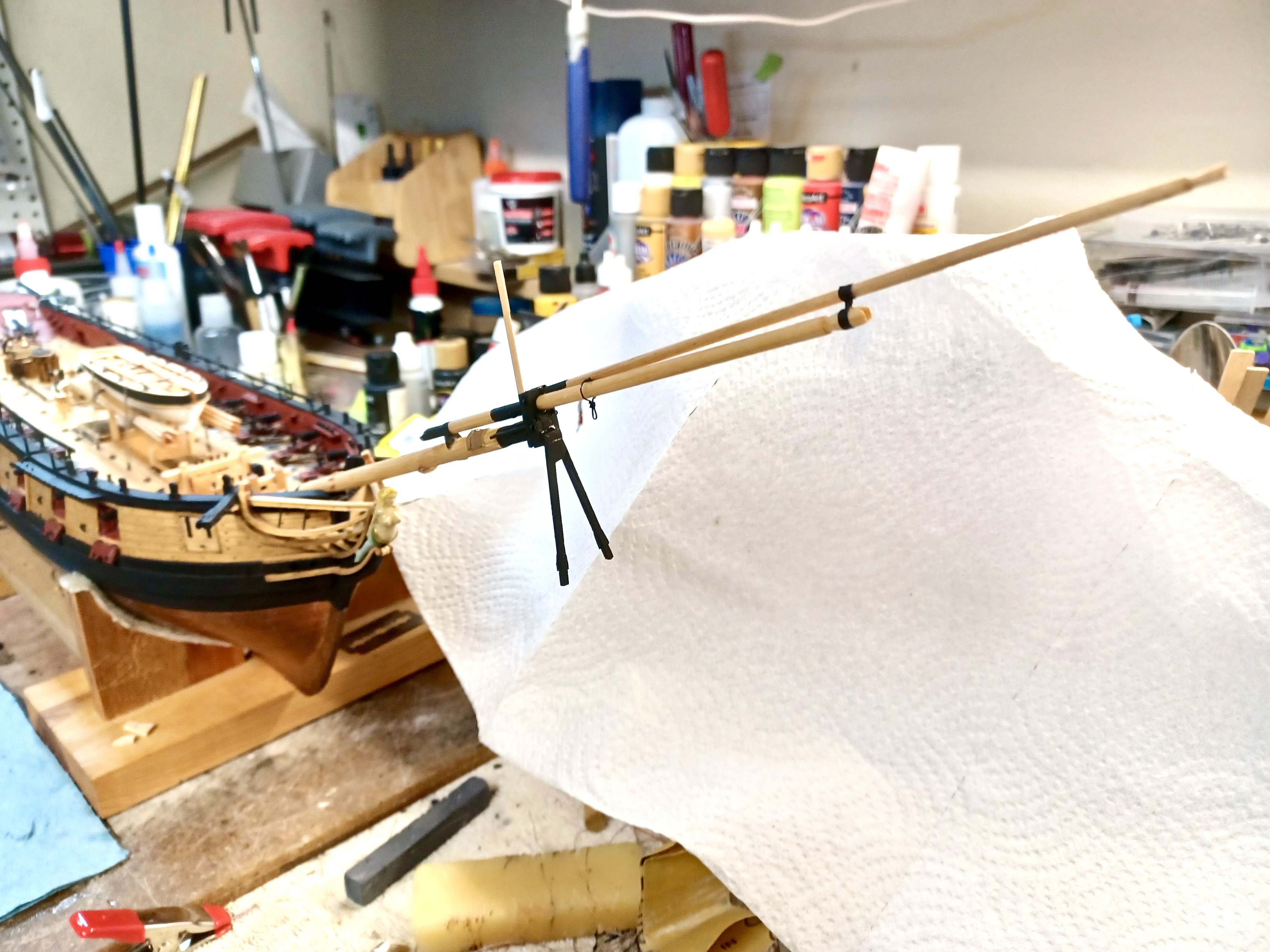

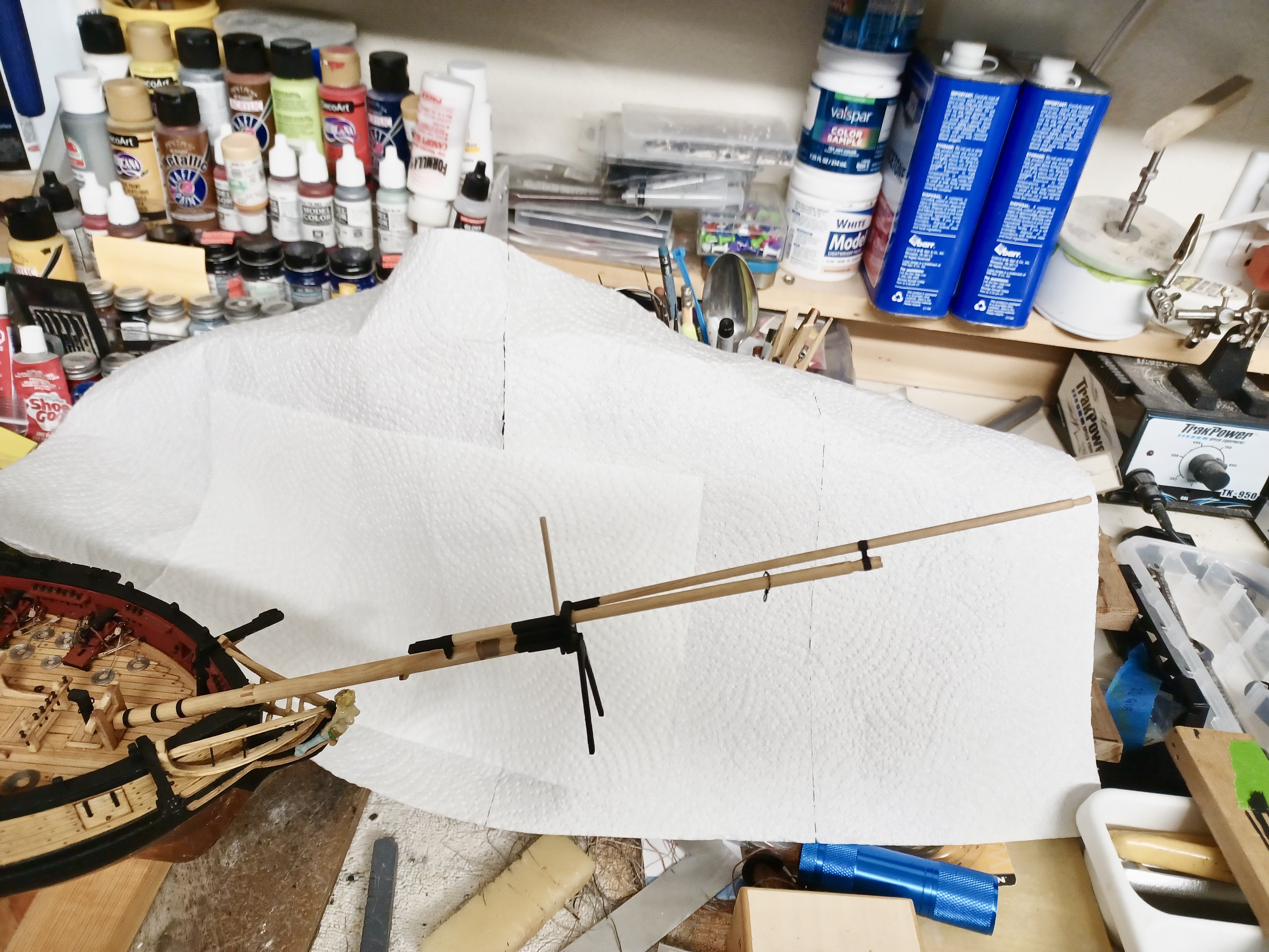

Second, the bowsprit has taken much longer than anticipated.  Most of the delay was due to one item.  The 1/16” tape that represents the iron bands around the base.  I did not find the tape in the kit that is used to represent them.  Normally, that should not be a problem because I use similar tape as striping on my planes.  However, in this scale, I do not have anything as narrow, nor any black striping.  So, I took some 1/4” striping, cut down to 1/16” and then painted it.  I tried ordering some from the hobby site I use, but they won’t have any until the end of June.  I believe the substitute worked out fine and am now back on track.

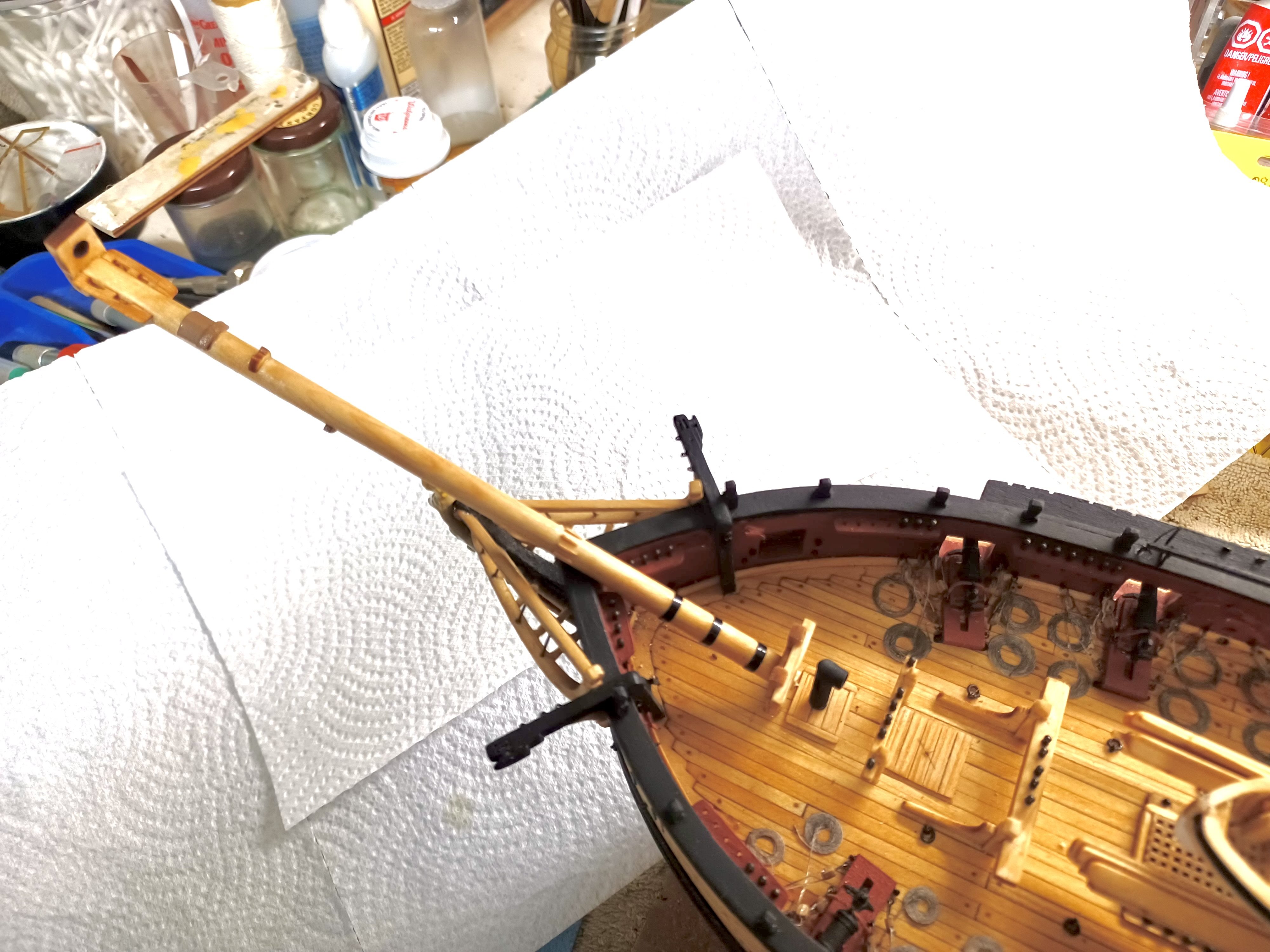

I completed most of the bowsprit today, but still have some final adds to go.  I did, as the instruction booklet says, and did some filing work on the cap rail.  The goal is to lower the sprit to 1/16”-3/32” above the figurehead.  It is right at 3/32”, and I may very well leave it as is and glue it in, but I have some time to make the final decision.  Before I move forward, I still need to add the 3/32” single blocks to the cap, flying jib boom, glue on the simulated staples to the cap, and dolphin striker.  All of these will be much easier to do before gluing in the sprit.
And, finally, I have two things to add that I have skipped, the bumpkins, and the rail netting.  The bumpkins will be in place before running the bowsprit rigging, and the netting before l move to the masts.  And, then finally, I will add the ball truck to the jack staff.

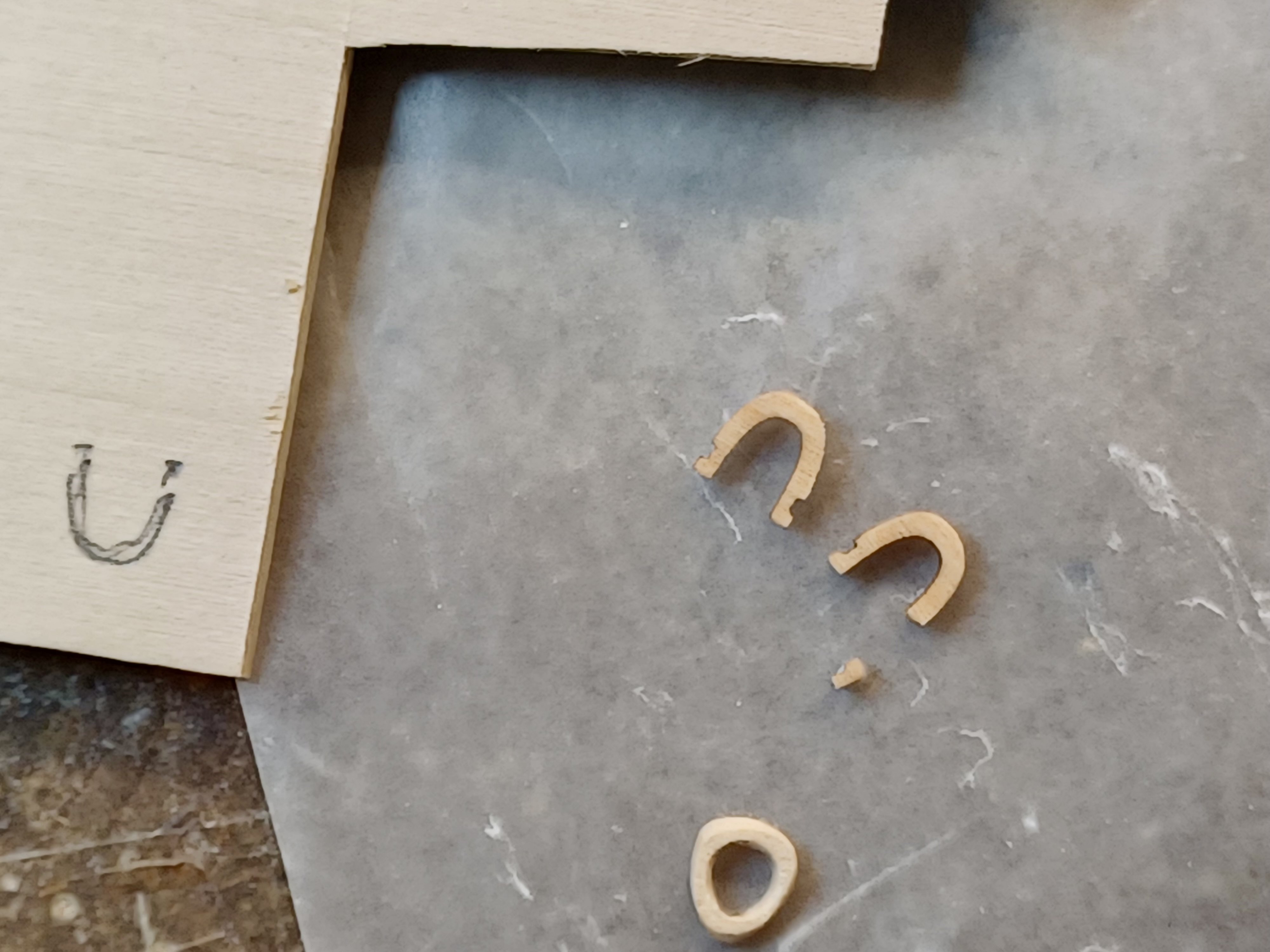

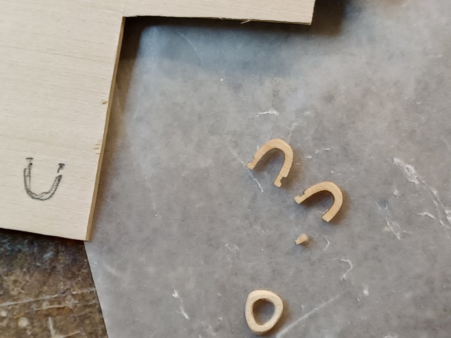

Although I was not looking forward to another mini shaping process, I thought I was prepared to shape it with very careful treatment.  (see picture). I decided to remove the closed hearts (10) from the laser cut stock, and begin sanding their shape.  I left the center of them in place and delicately sanded clean their shape outside first.  The one is in the picture is number 1 of the 10, and I think it is very workable.  Only 9 more to go…yikes.
However, the Open Hearts are another story.  Like the fife rail, the wood is very crumbly, so much so, that I was barely able to remove the laser marks.  In fact, the first two, came apart at the slightest touch.  So, on the next two, I barely removed the laser marks, and then decided to bathe them in a mixture of white glue and water.  My thought is to strengthen the parts before shaping and hardening their surface.  Well, that didn’t work either…at least for one of them.  In the picture, you can see one that is complete while the second has a part that has already fallen off.  This while only soaking in the water/glue mixture.
So, I will probably make 2 new open hearts out of different wood as I did with the fife rail.  Once resolved, I will do another update.
My Thoughts:  I appreciate the fact that multiple copies of both parts are provided in the kit.  However, for the open hearts there only 4 when the piece of wood they are cut out of has enough room for many more.  Even then, I am not sure if it would make any difference.
Edited by Redshadowrider

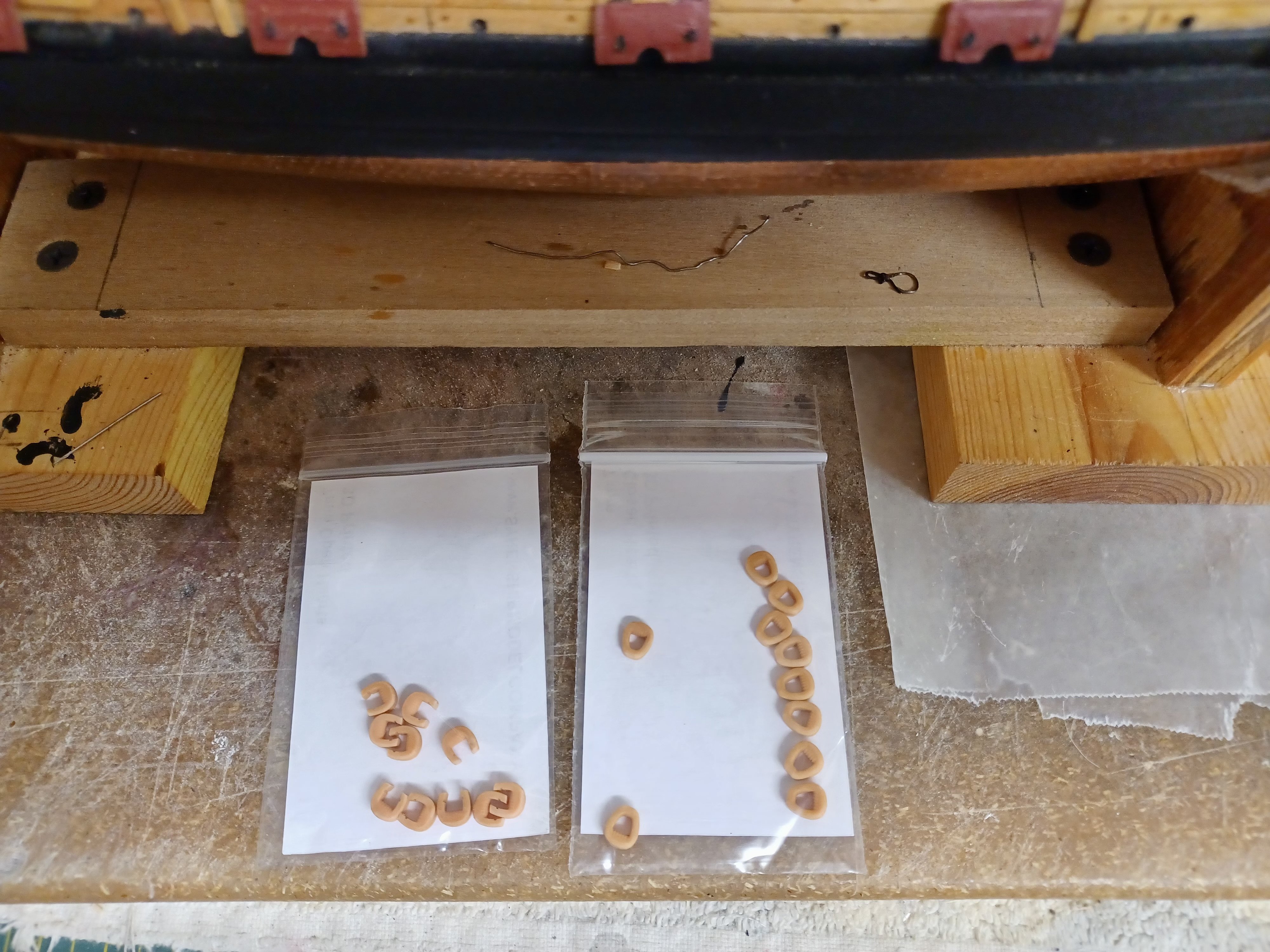

After the open heart experience of crumbling wood, I started on the closed heart parts.  I was able to shape the first one and it came out ok.  The second, however, broke when trying to remove the laser marks.  It took me less than a minute to decide that with 10 needed, I did not have the patience to create the closed hearts, nor did I want to go back and create the open ones either.   So, I bought them.
I have held off from any additional work until they arrived from Syren Model Company.  I do not fault the kit manufacturer for providing them as laser cut parts, but there comes a point where parts this small just as well be included with the kit.

I am always leery of small parts cut out of thin wood sheets. All woods have a grain, and break easily along the grain. The smaller the part the more likely it will break when handling. Well, maybe European boxwood is an exception, but I have no experience with it. Castello/Costello boxwood is really nice for carving but I haven't pressed my luck with thin pieces.
I always use thin "aircraft" plywood for pieces like these hearts. The alternating grain on each layer makes it MUCH stronger and less prone to breaking.
I guess you got 3D printed resin parts from Syren by the look of the picture. My experience with 3D printed resin parts is that they are very brittle and break easily. But Chuck has done a lot of research and maybe he is using a better resin than I have used.
I have used Syren's older wooden "kits" and they are excellent! They are made up of three thin layers of Castello boxwood. After gluing them together they are very strong, like plywood. And they have the nice groove around the edge for the rope to fit into. If Chuck is still making these wooden kits the next time I need hearts I will buy them instead of the resin parts.

To those following this build, hang in there.  Two things have been slowing my progress on the bowsprit.  First, this is the time of year that the heat reduces the time I can spend working in the ship in the garage.  So much so, that I am considering purchasing one of those small “coolers” that work in small areas.  I have been researching them and trying to separate truth from advertising.
Second, is the creation and install of the open and closed hearts.  The instruction manual, and practicum are a little hazy.  So, I have been going through other Syren build logs to try and find clarifications.  Last night I found the clarification on the build by @abelson
