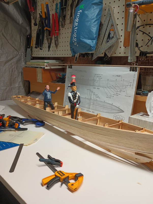

Hi all hope everyone is well . Haven't posted in awhile , but I have managed to get some work done . I didn't use the basswood sheets , was getting frustrated and decided to use the balsa planks that came with the kit . The results came out better than I hoped , no major gaps or issues I did have to shim a couple of the bulwarks . IMG-20210316-163126405-HDR.jpg
I kind of thought that might happen. The real ships were plank construction not sheet so it would stand to reason the the model would work out better that way as well. Congratulations!
