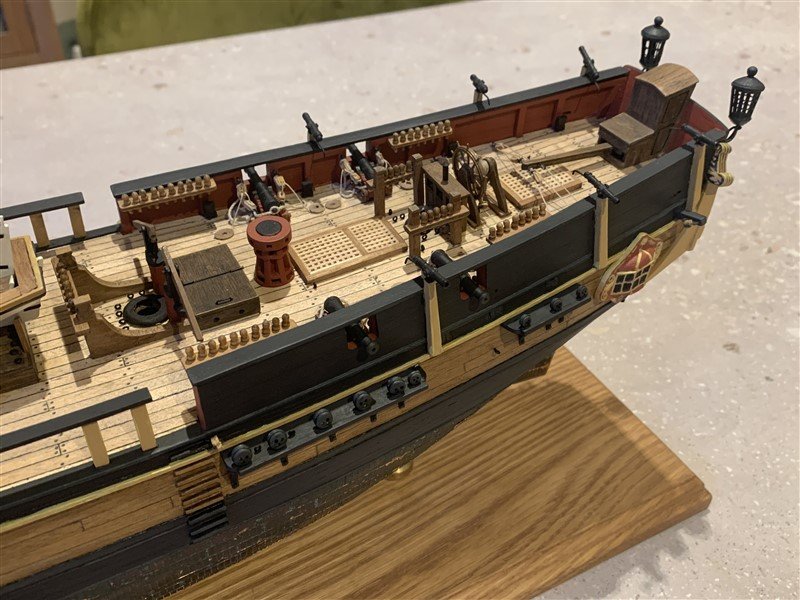

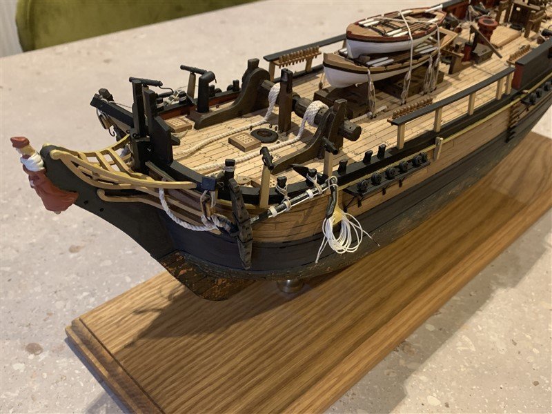

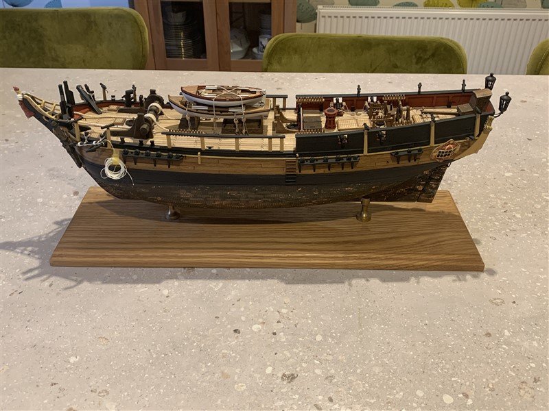

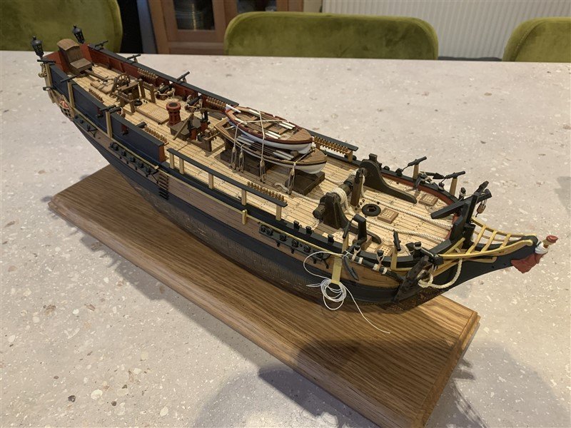

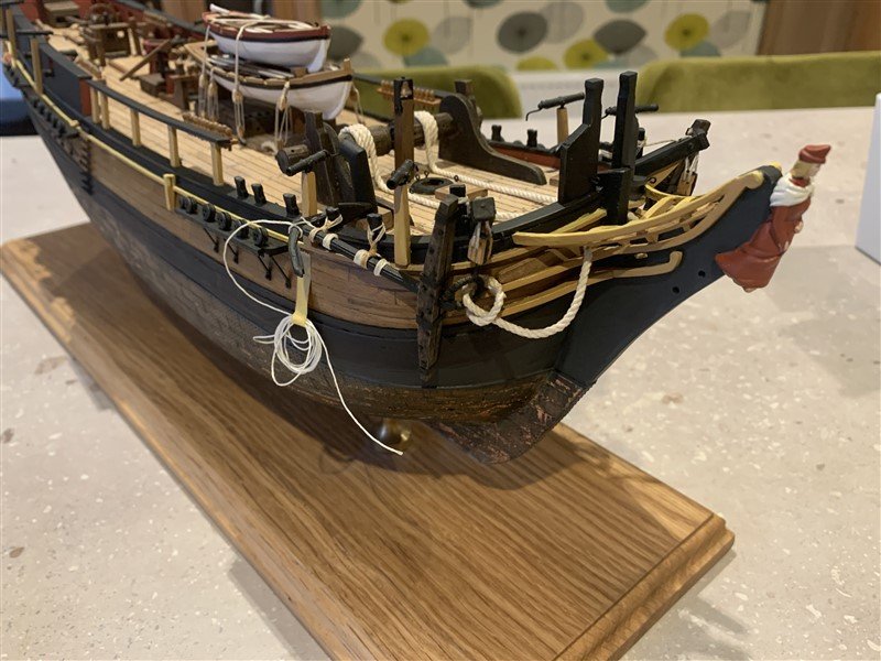

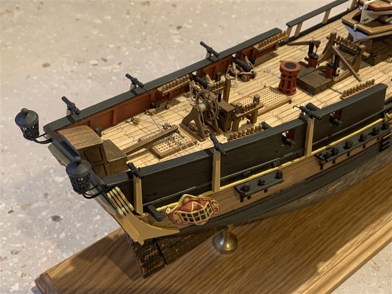

Blowing the cobwebs off this build log.  My mast-less Bounty has been sulking up on the shelf of shame for many years on and off.  😞
When I last left it I had just about finished the hull and had started building the masts, but then my interest in it just left me for various reasons.  Lately however, I have had to move it around in the garage to get at other stuff and got around to looking at it over the last few weeks.  I think the reason I left it was that I was not happy with the paint job or colour scheme, like many I suspect, I followed the "Anatomy of the Ship" series book by John McKay, but having done that scheme and then read a bit more into the subject, I came to the disheartening conclusion my Bounty looked like a Georgian Dock-side tart! And that I think is where the rot set in and even though I did start the masts, my heart wasn't in it.  It also didn't help that I discovered Vanguard model kits.... 😆
Funnily enough, that last point is oddly the catalyst for me to finally finish this damn thing off!  Sometime in the not too distant future Chris is going to release his HMS Surprise, and then I know this kit will once more be dead to me for many more years and it runs the risk of the kids putting it in a skip, unfinished, when I kick the bucket! - so it's now or never!
So my plan for this autumn/winter if to polish off the Bounty and get back to the Sparkler, before Surprise lands. - No mucking about this time, the race is on! 🤣

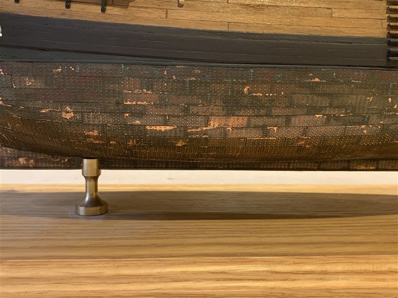

So whilst I have been rummaging around in the garage trying to find the plans, instructions (for what they are worth!) and the few remaining parts to finish this off, I have also been revisiting that paint job.  Not easy given how cluttered the model is now, but on this I am a little more content and have the enthusiasm to pick up where I left off.  Below is a selection of pictures of where I got to and her new paint job.
Hope some of you tag along again on this final push!

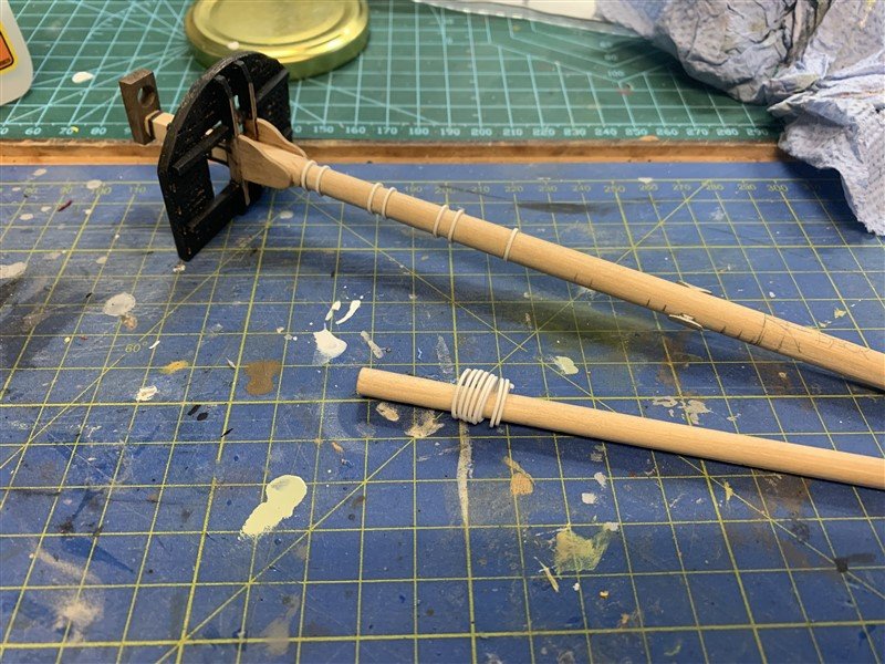

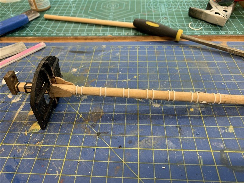

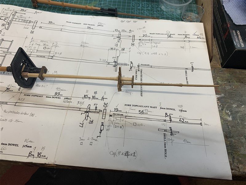

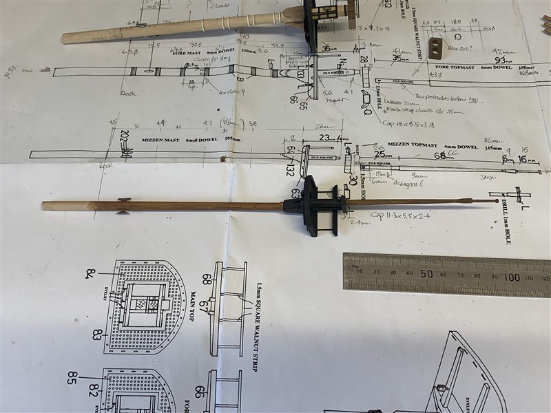

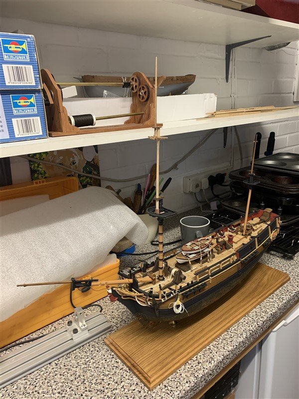

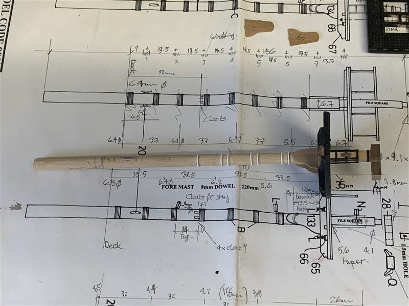

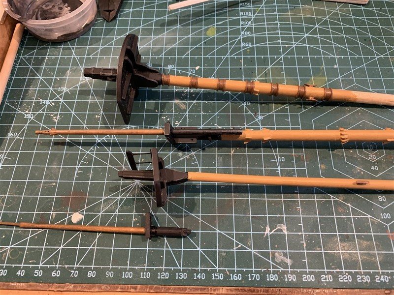

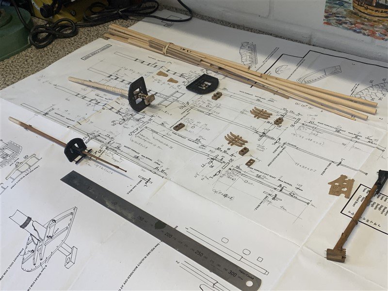

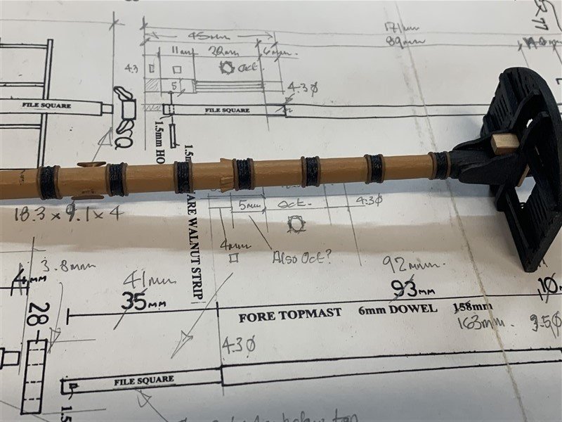

Evening all, I've been making steady progress with work on the masts, the Mizzen was largely done, so has just needed some blocks tying to it and a touch-up of the paintwork; the two sections are not permanently fixed so I can do the lower shrouds and stays easier.  The bowsprit likewise is nearly done and has also had a refresh with paint and started the process of adding blocks etc.  On the Foremast I had nearly done the lower mast, but I had not finished adding the mast hoops to go above and below the wooldings.  These I made out of 0.7mm styrene rod, curled around a dowel and then heated to retain some of the curve.  These just needed a sand to getting to a uniform depth after gluing, once done painting in brown and the addition of woolding rope to finish.  The lower mast needs some blocks adding and the handrail on the platform.  While doing that I have made a start on the fore topmast and fore topgallant mast.  The last couple of pictures show the current state of affairs.  Think I will keep moving from making sawdust and hopefully more mast sections and adding blocks to the finished parts to keep up momentum!
Thanks for looking in. 👋

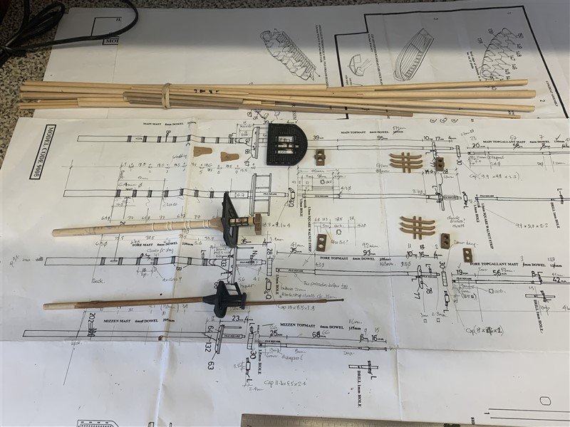

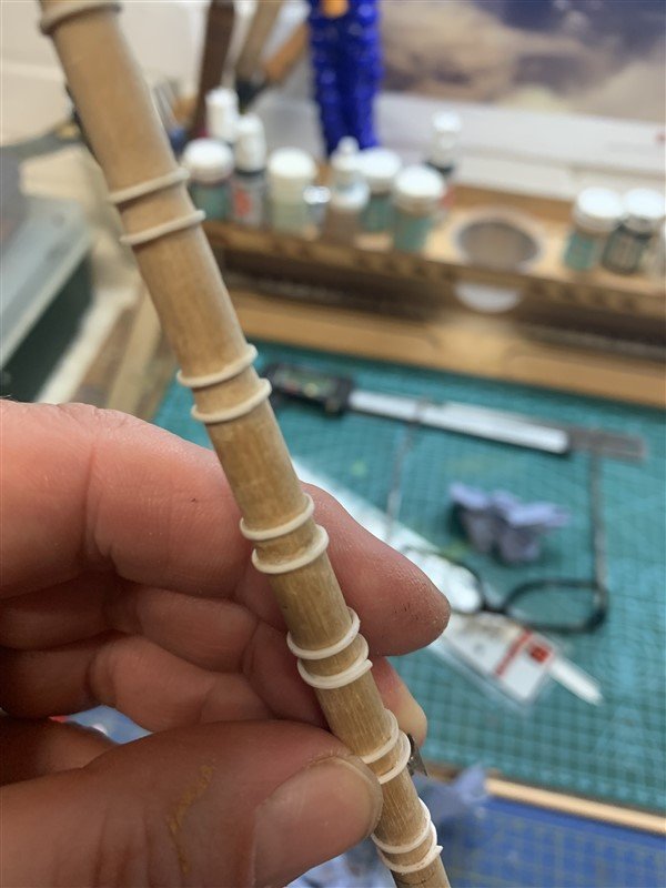

The main mast has also now largely been constructed, using the same techniques as the others with various card and styrene rod embellishments for the mast hoops and reinforcements.  I also used wire for the stanchions of the fighting tops rear handrail; I didn't fancy the chances of delicate wood stanchions surviving my rigging efforts later, or the chances of me adding the handrail once the rigging is on.
Also been tying blocks to the masts as I have been going along, so as not to leave all that to do in one hit.
Hopefully the next update (not as long a time gap as this one! 🤞) will be the masts completed.  Then on to adding blocks to the yards, before the dreaded "R" word we don't mention....

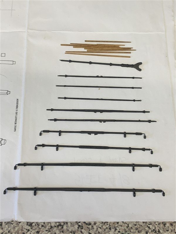

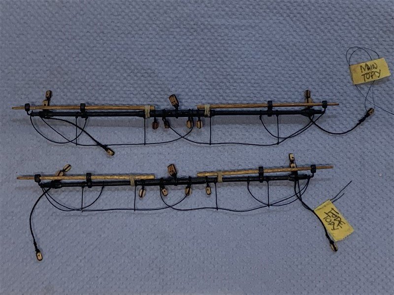

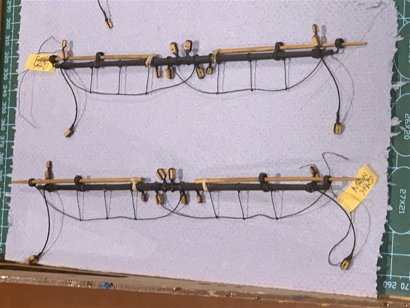

Thanks all for the "likes" and the kind comments.  As a small update, I've been working on the yards, all fairly repetitive stuff so just a couple of sample pictures for where I have got to so far.  And yes I have left the most complicated ones until the end! 🙄 - Fore and Main lower and topsail yards, hope to have these done in the next week or so.

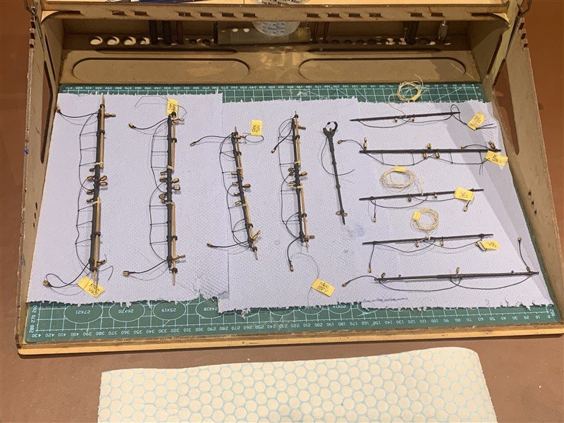

Not many updates recently, but the yards are all pretty similar and not very photogenic with my phone camera, so I have not done multiple updates of similar looking stuff.  But good news - the end of the yard(s) construction is here! 😁
Nothing for it now but to get down to starting the rigging over the Christmas holidays.  I will be spending a long time studying plans and the AOTS book first!
