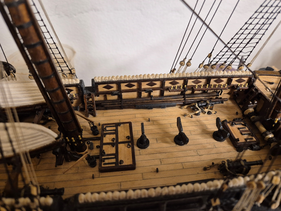

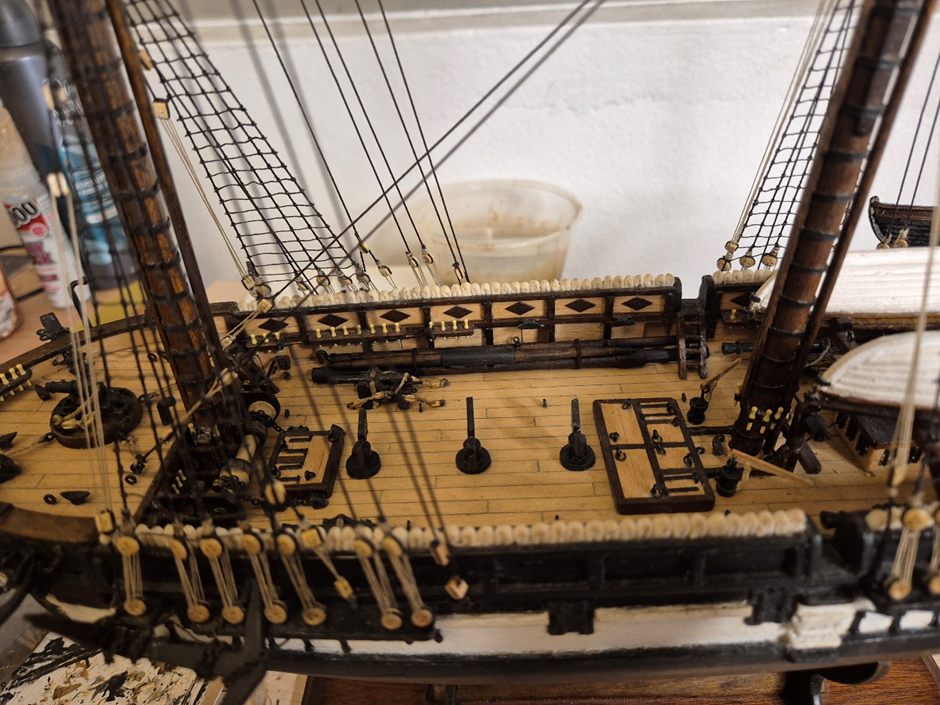

After finishing the anchors, there were only a few small things before the deck details and the second stage of the build was finished.
I secured the whaleboat and the gig onto the davits and coiled up the excess rope. I’ve upgraded my thread to the rigging cord from Syren now, it does look much nicer.
image.png.3399190e42a5dfc07b2a987e5362ee95.pngimage.png.72eef97faa58a663fd472d6258a0dc5b.pngimage.png.6c938baef4d3e2da15468775751ae568.png
I also noticed that there is a lot of detail around the bow included in AOTS that I had not included. This includes the all-important shitting hole or more tastefully; the “seat of ease”.
After that, I took some more photos of the completed stage 2.
The close ups really show how dusty parts of the ship have become. Looks alright from a distance, but I might need to have another go at tackling the dust. Parts of the ship have been sitting for three years now.

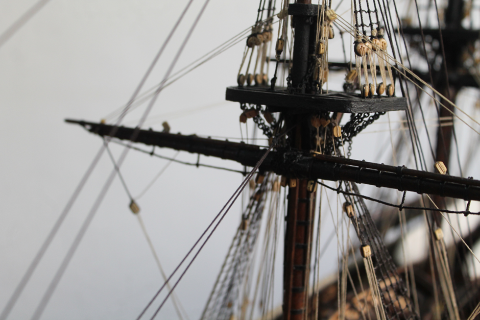

Okay, now onto stage 3 of the build: masts, rigging and sails.

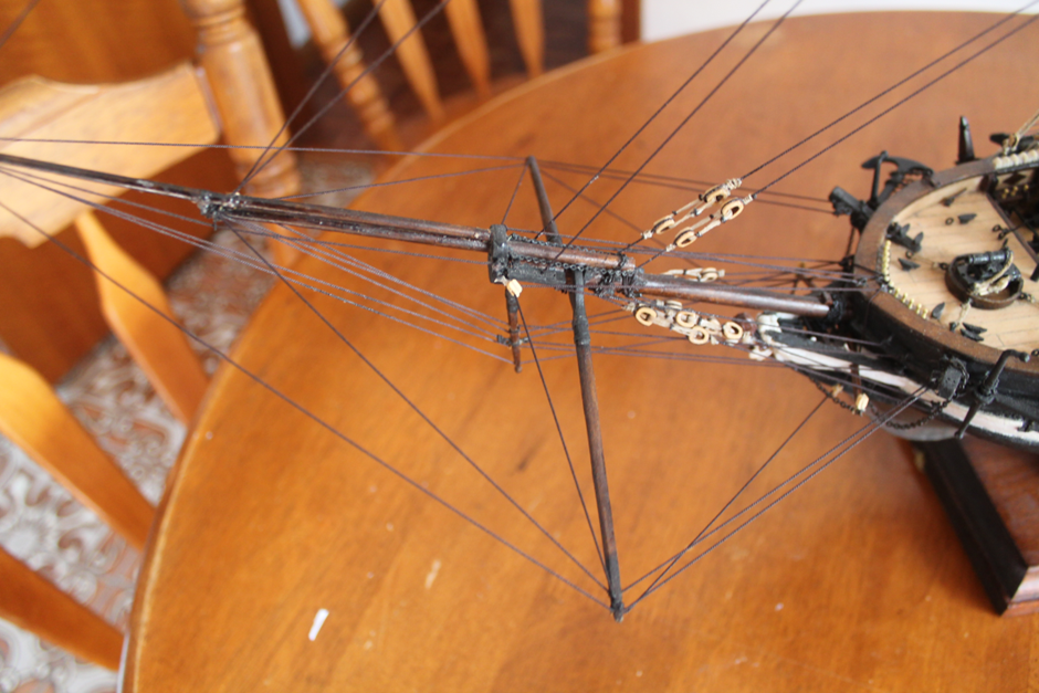

First was the bowsprit. I built this primarily using AOTS rather than the kit instructions. This is an ongoing thing as the kit seems to deviate quite significantly from AOTS for the rigging likely for simplicity and ease of construction here. The rigging is doing my head in a little bit at the moment.
The chain gammoning was an absolute pain. The hole in the bow to fit this was a bit to small and it was extremely difficult to thread chain through it multiple times to secure the bowsprit.
Next were the masts, the ship is finally going vertical!
I used a slightly thicker dowel for the fore and main masts, I think 8 mm.
I found the spider hoops to be quite difficult. These were made by bending a 2 mm brass strip into two rings to go around the mast and the trysail mast. I then drilled holes in this brass strip to take the rings for the belaying pins. The rings for the belaying pins were cut from brass tubing and then I drilled holes in them to take nails and secure them onto the mast. I also used a trick from @brunnels with heat shrink tape to make all the mast hoops, which worked out great thank you!
Deadeyes still kind of a pain, but I got there. I used chain to secure them rather than rope.
Mizzen mast was mostly the same as the kit.
I’m working on the standing rigging now. It’s a long process but just need to take it one rope at a time and I’ll get there. Maybe I will actually end up finishing this thing. Although, the final major hurdle that is sails is on my mind.

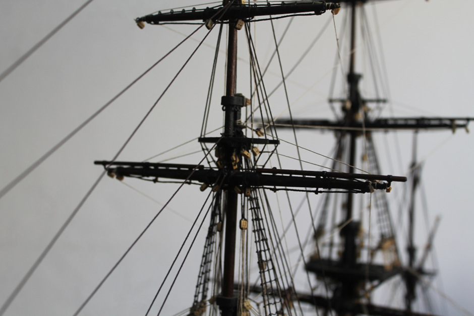

Alright, it’s rigging time. Was sure a slow process, but I eventually got going.
image.png.442ad81cde4799082bffe8beb5f8c261.pngimage.png.0fd6e68c3f763a4f597d35e124245d4e.png
image.png.8a8b50826675fc6e2e45c178c2d3a1c9.pngimage.png.f1ca343e2343a80381b4af3beb8c62f5.png

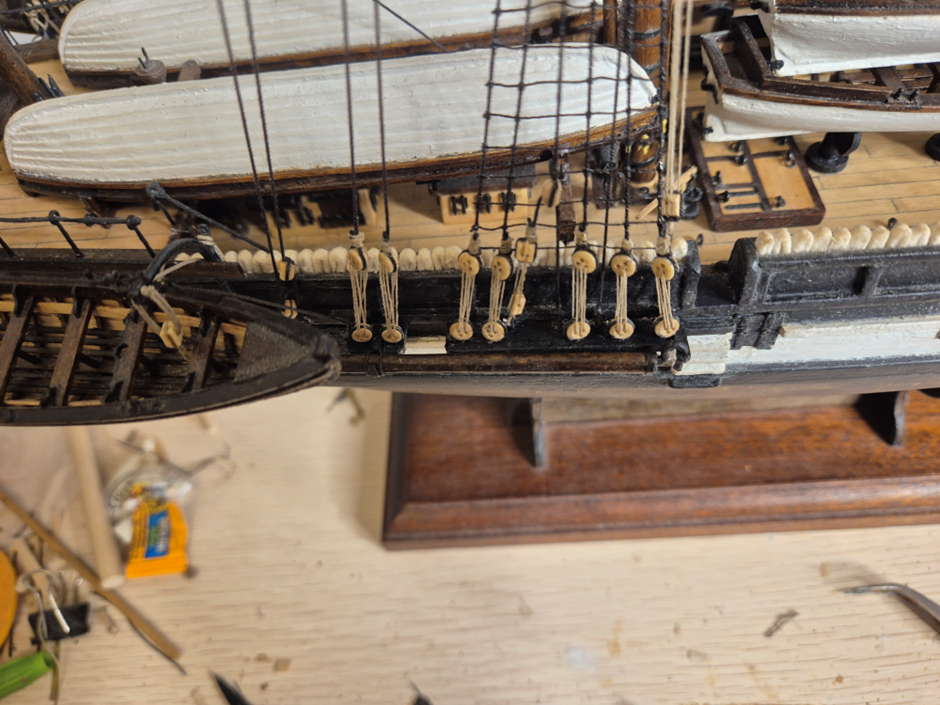

Shrouds all in. I realised that the rake for the fore mast is not quite right, which means that the mast top slopes slightly. I realised far too late, so will have to live with this.
image.png.a068a6495f063179ce93c38a99302512.pngimage.png.b4f4d364d740db994e0f5ce796c1caba.pngimage.png.49af80ca9803b3fce07c12cfad2576cf.pngimage.png.e919eadcb74e5d5a45575eb4c491b350.png
I ended up getting through the ratlines quite quickly, I actually find this really enjoyable. The thing that tends to slow me down is moving on to new steps and thinking about how to do it properly. So working through ~200 ratlines was actually quite fun. The Syren rope looks much better, but the clove hitches can unwind a bit. I secured them either with some CA glue or a bit of varnish once they were all complete. There were still some that came loose, also several mistakes along the way. Learning to be a bit more okay with that.
Very happy with how she is coming along at the moment. Now on to spars and the running rigging.

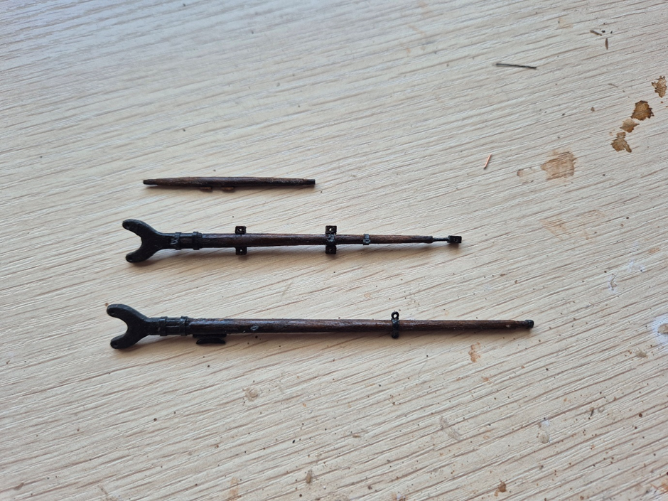

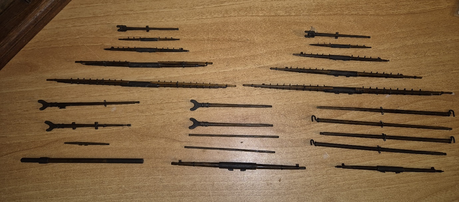

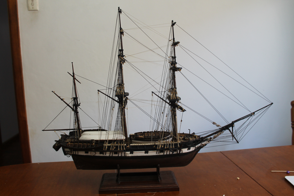

Okay, have been working through the spars and have finished them all off now. Once again, I have used AOTS more than the kit instructions. The kit seems to have significantly simplified the rigging so I will stick with AOTS even though it makes my head hurt sometimes.
image.png.e0b1ece0beb2bb6c74f3c4d7e4d89a6d.pngimage.png.e7d0713bcda1399397931f43cc76ddf9.png

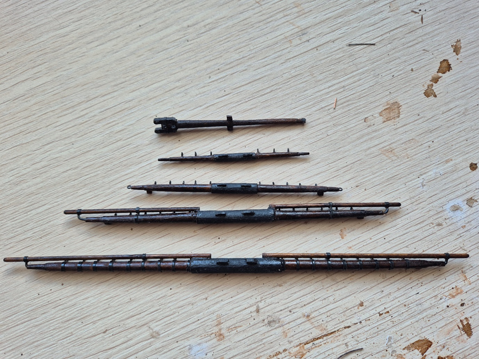

Here they all are laid out. I have also made lower studding sail booms for both the fore and the main masts (right of the final image) Based on the request from Fitzroy for additional spars I also made a spare topmast, topsail yard, topgallant yard and two topmast studdingsail booms.
image.png.a03ea8c275a4f816c21a4bf02c4758e2.pngimage.png.46a654188dea057b3d0d3313acdf8e6c.pngimage.png.73a283e1c1bfcc89c0f309c4a75c279c.png
I bundled up that set of reserve spars and fixed them to the deck. A fixed the main lower studding sail booms to the channels as well.
image.png.1079a9f221c6bd64cfc583194a3e8f10.pngimage.png.26d8583ef1220c768a2c253439515dc1.png
I also attached the spreaders to the bowsprit.
I have many more sticks to attach now...

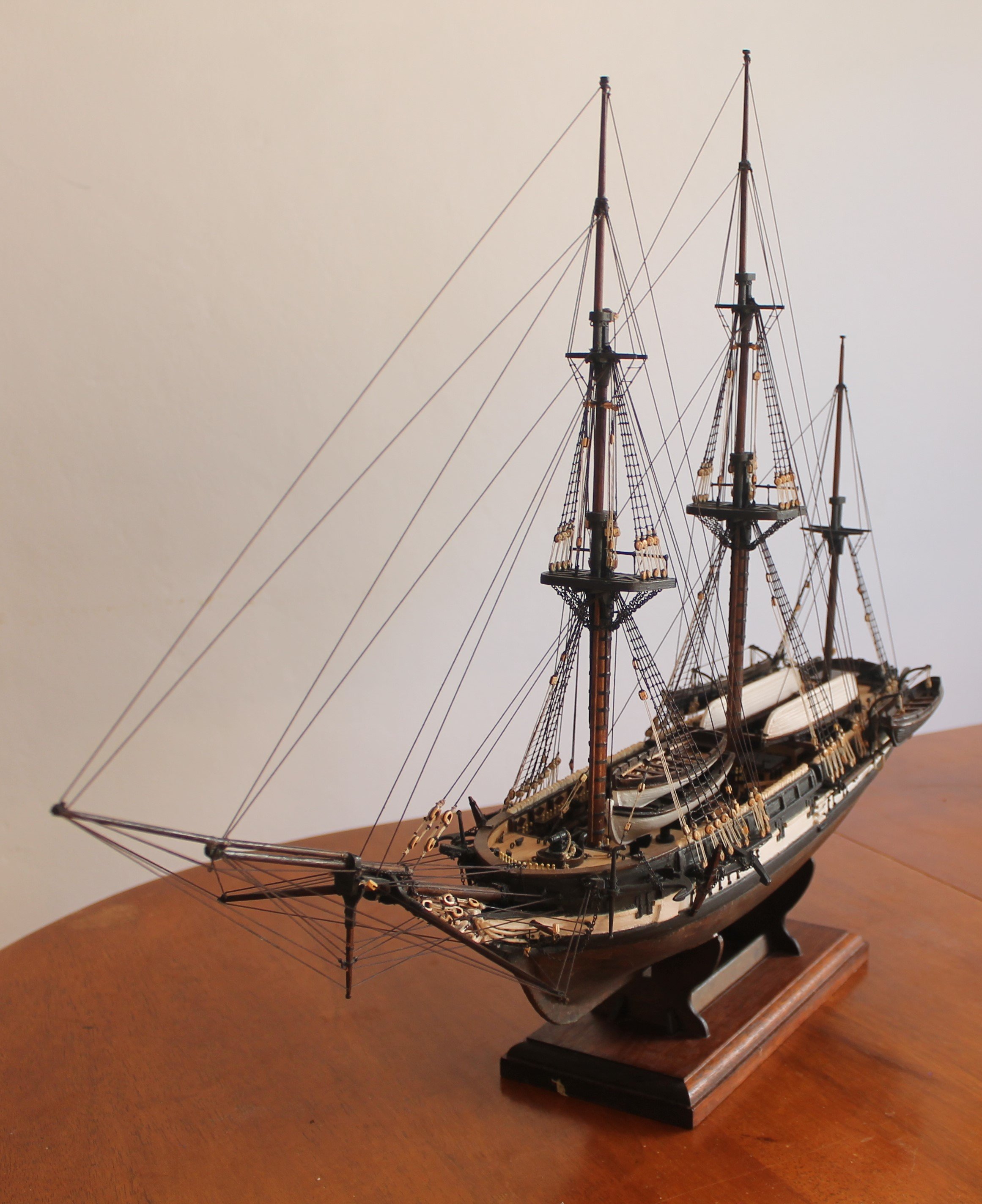

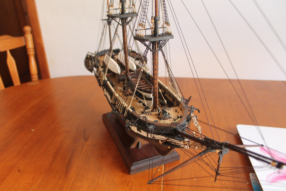

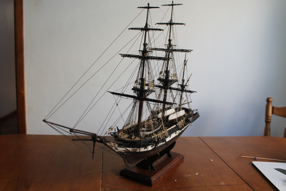

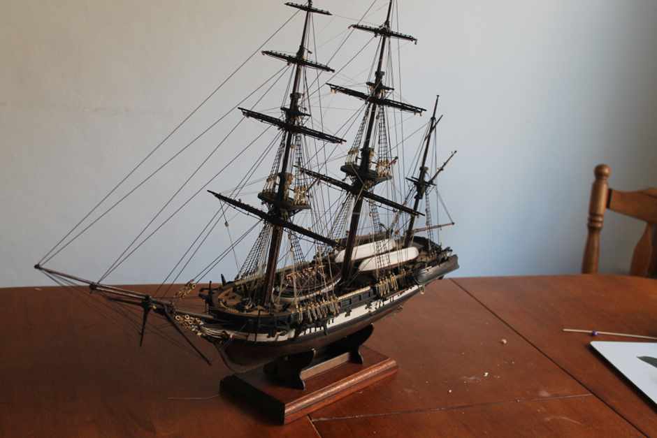

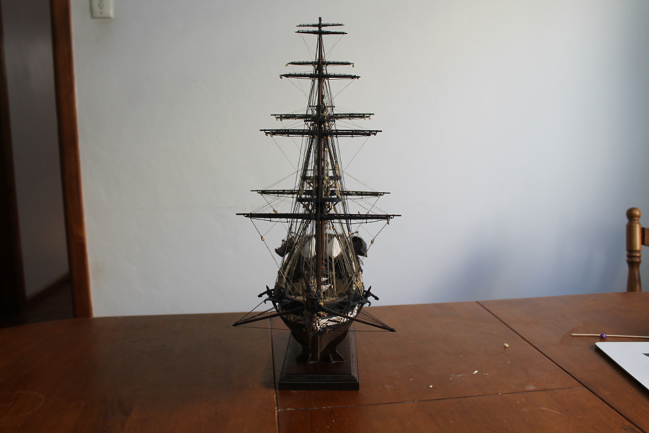

Okay, have been working away at attaching all the spars and doing the running rigging. Has been a long process and don’t really have progress photos, but is finished now. Here are some pictures of the end result.
I had thought of this is a possible finishing point as sails are maybe somewhat optional. Now that I am here though, I think there was never any chance that I wouldn’t at least give sails an attempt. Need to do some thinking now as there are many opinions. If anyone has a favourite method, please feel free to share.
