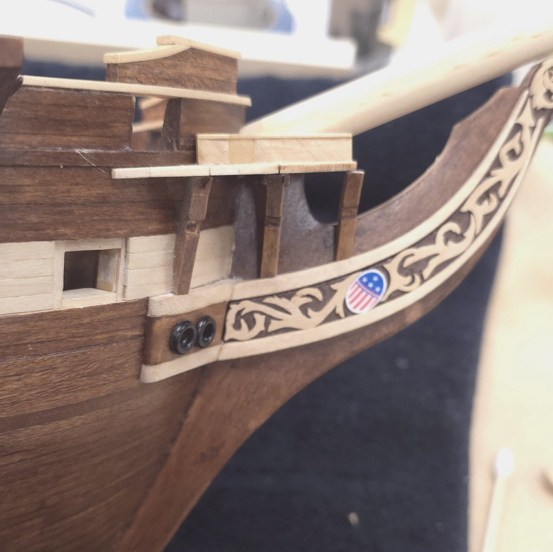

Getting close..

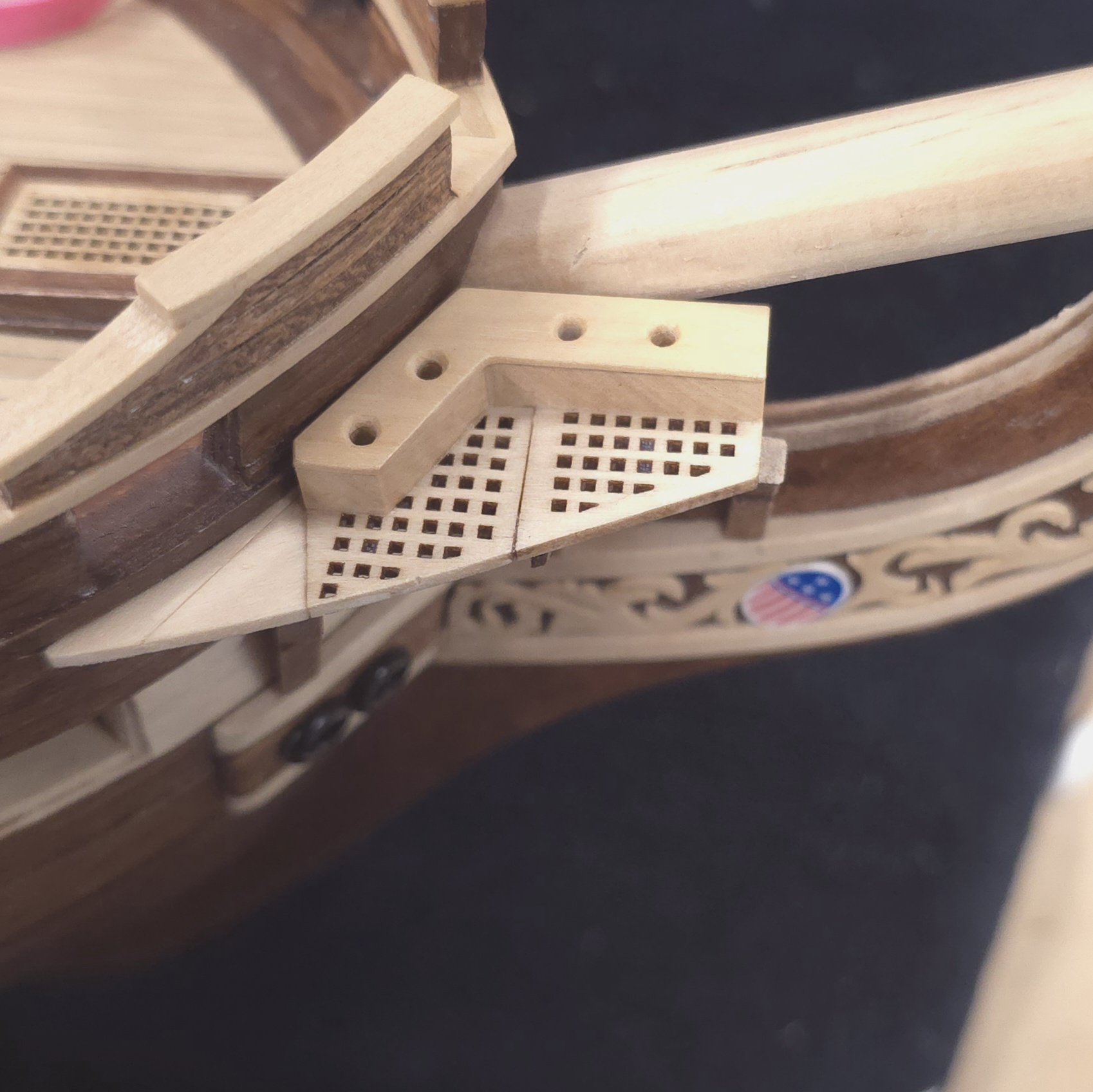

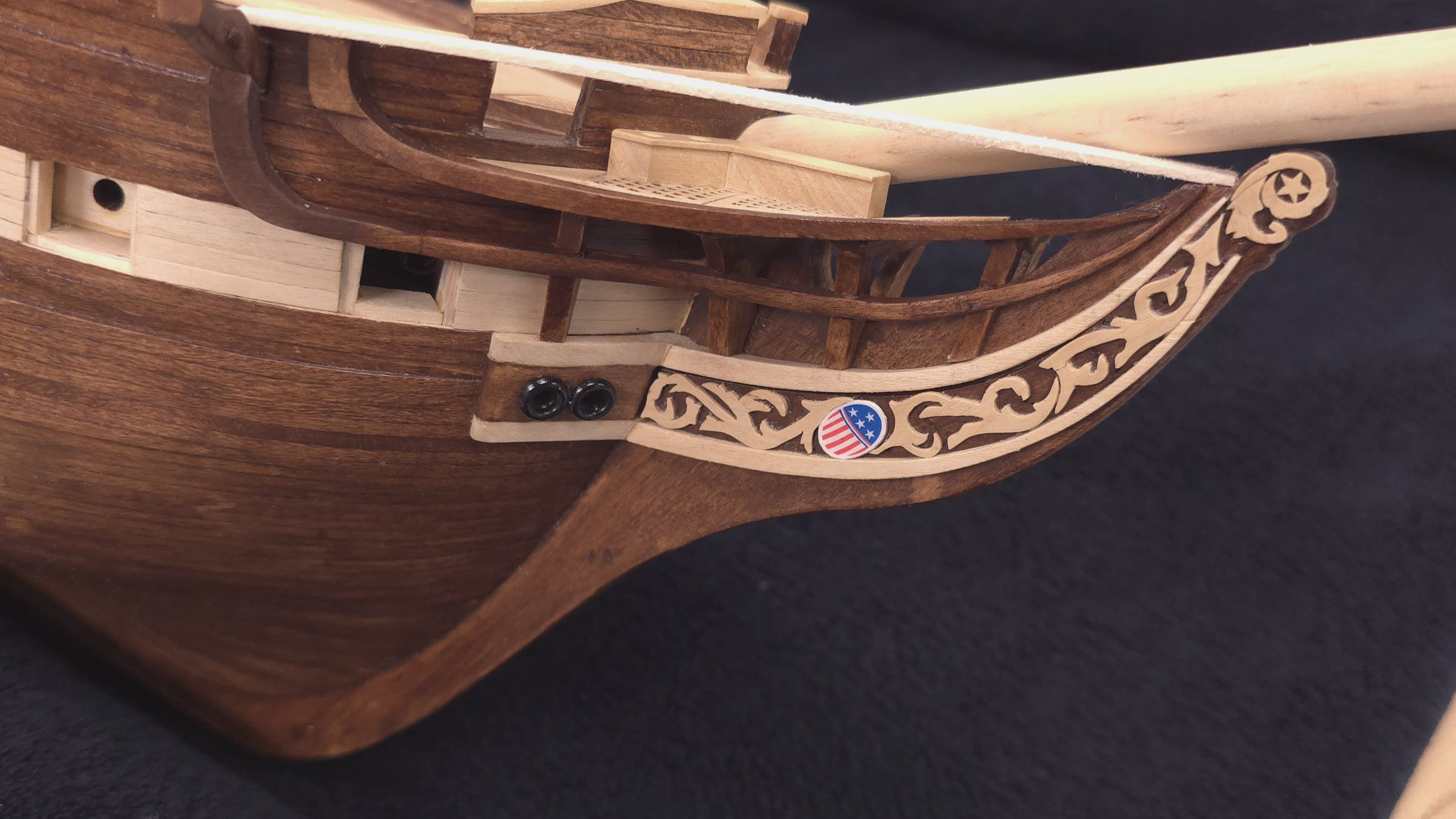

But Thomas, how the heck did you get such a great fit between grating and rail 2?  Kudos!  I'm going to cut my rail and tackle it in two pieces like you seem to have.
Thank you!

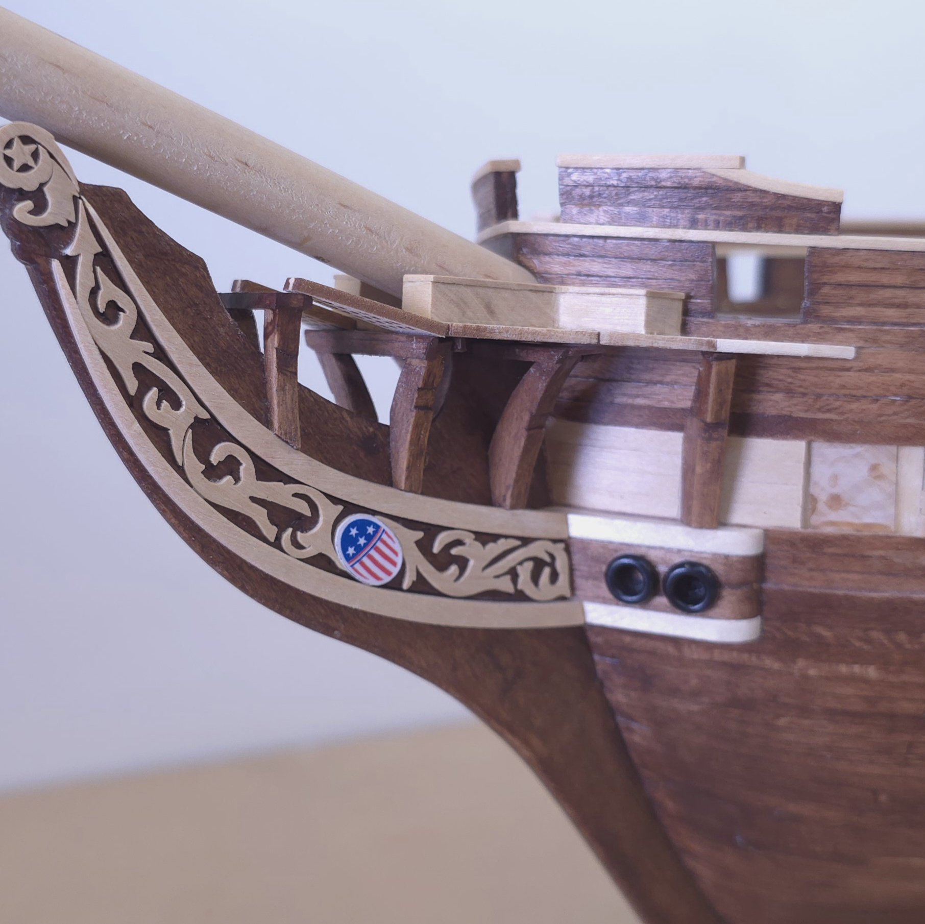

From what I remember, I did all of the supports first using the gratings as a guide. The second rail was fitted to fit the grating and the hull. It’s also been 5 years since then too!IMG_6633.thumb.jpeg.29d8cd2b6f99ac662fc69dfd463d04e7.jpegYou can also see in my picture that I messed up the supports and had to patch them to get a better shape.

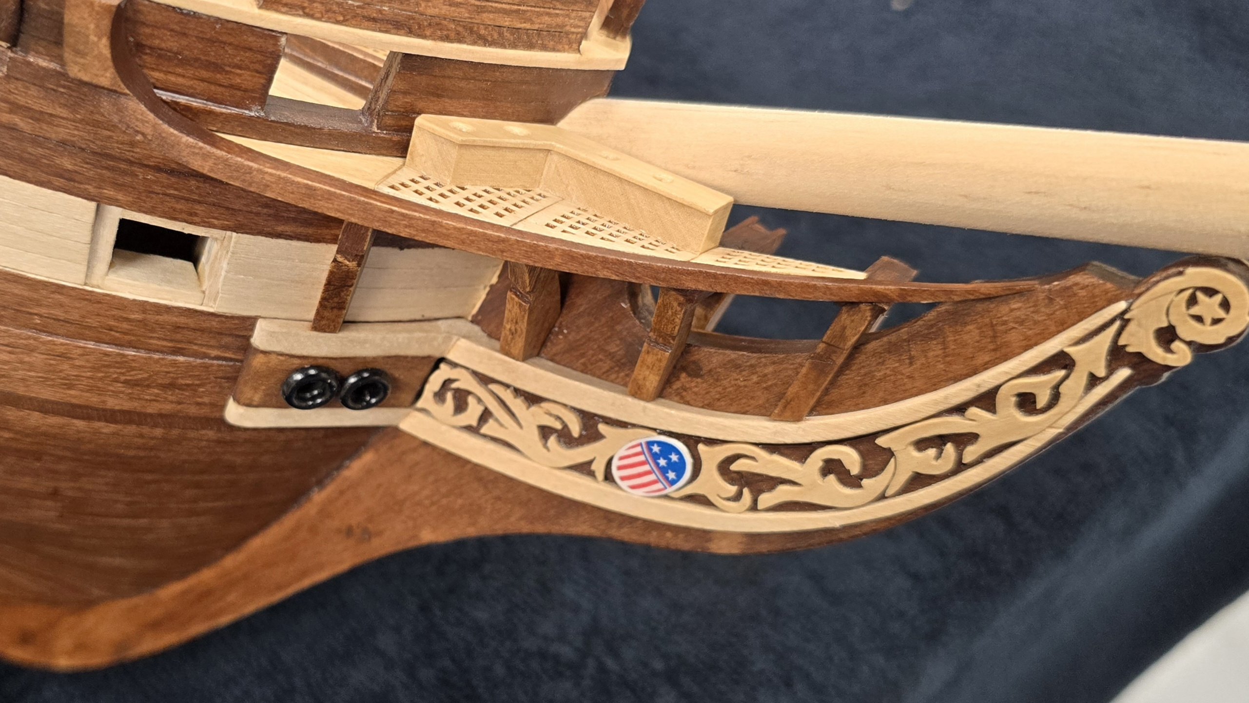

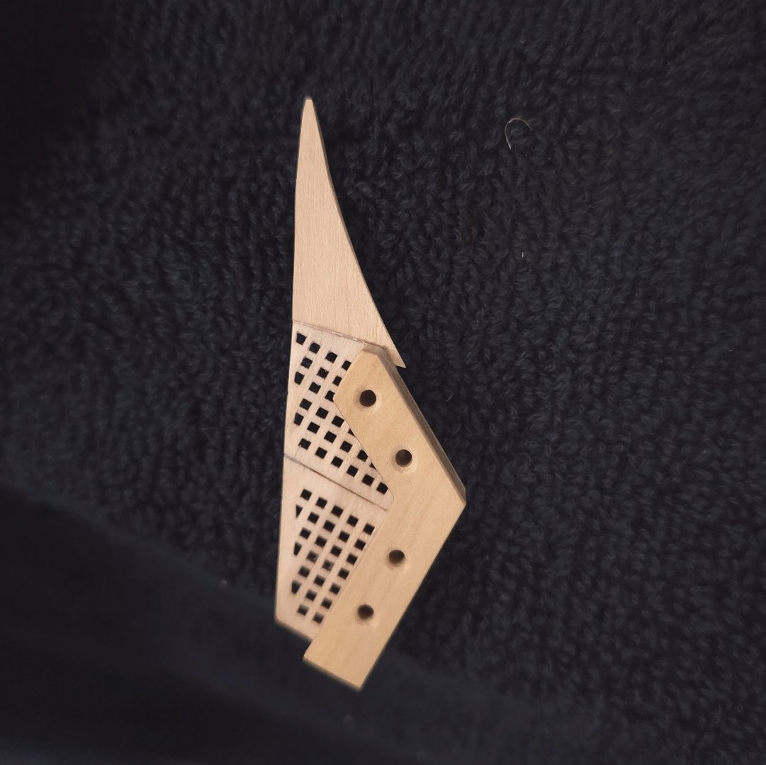

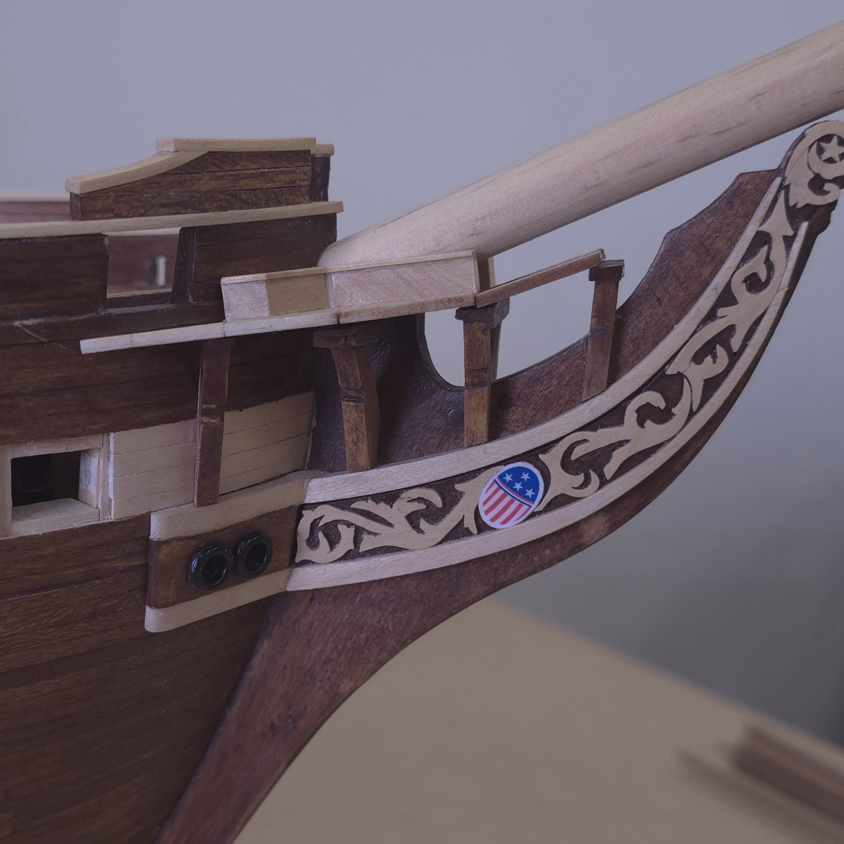

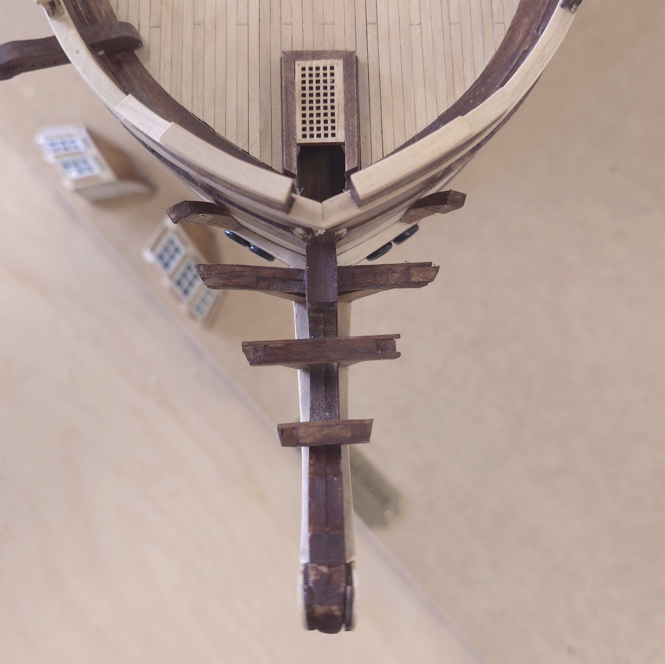

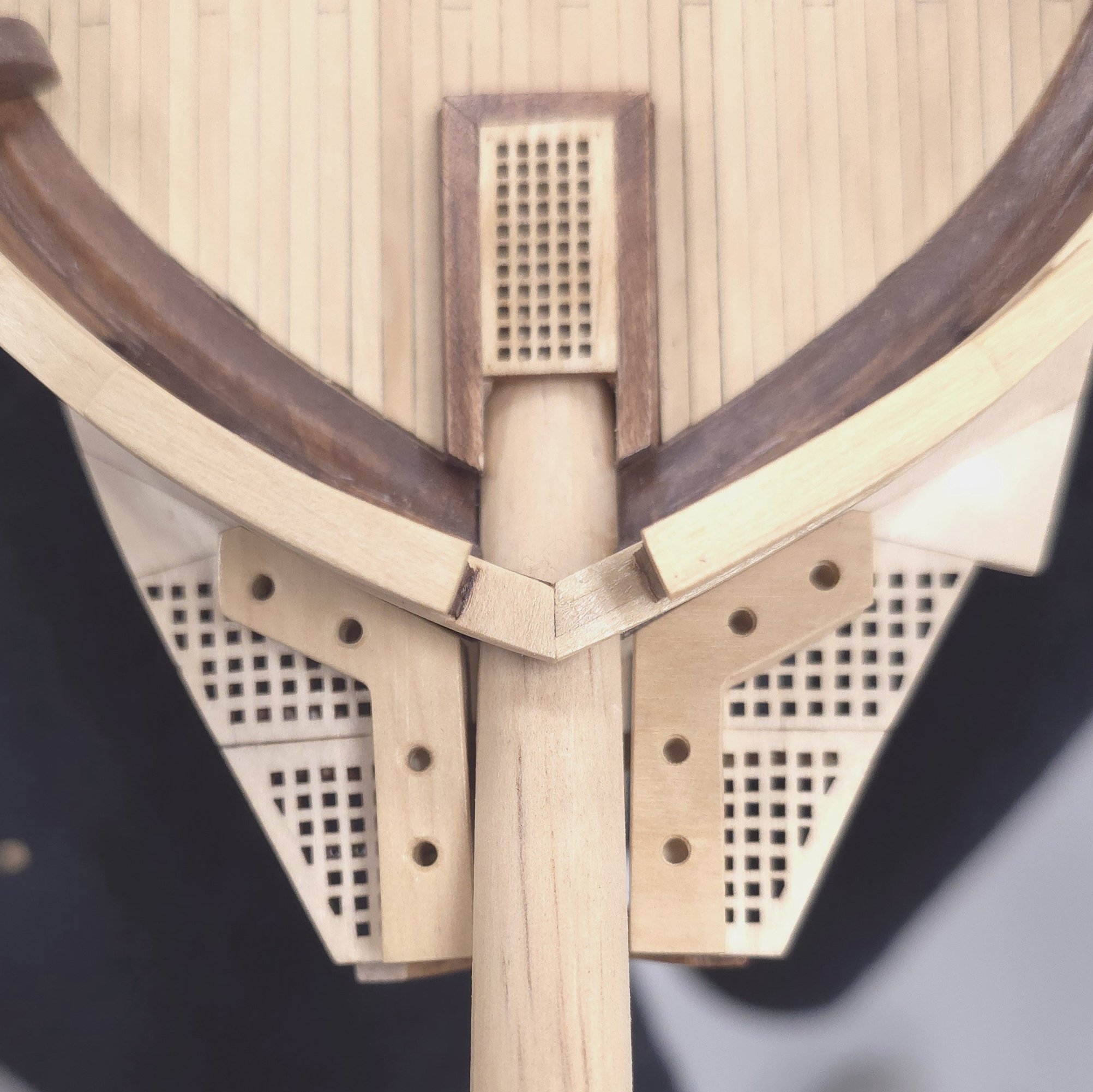

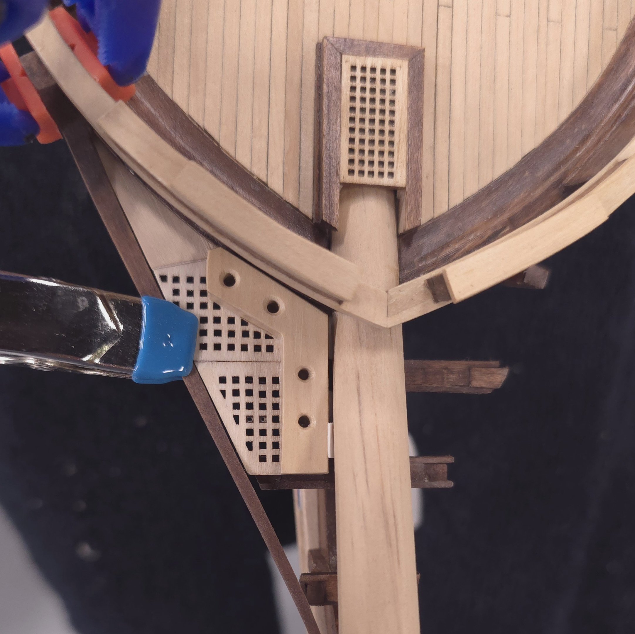

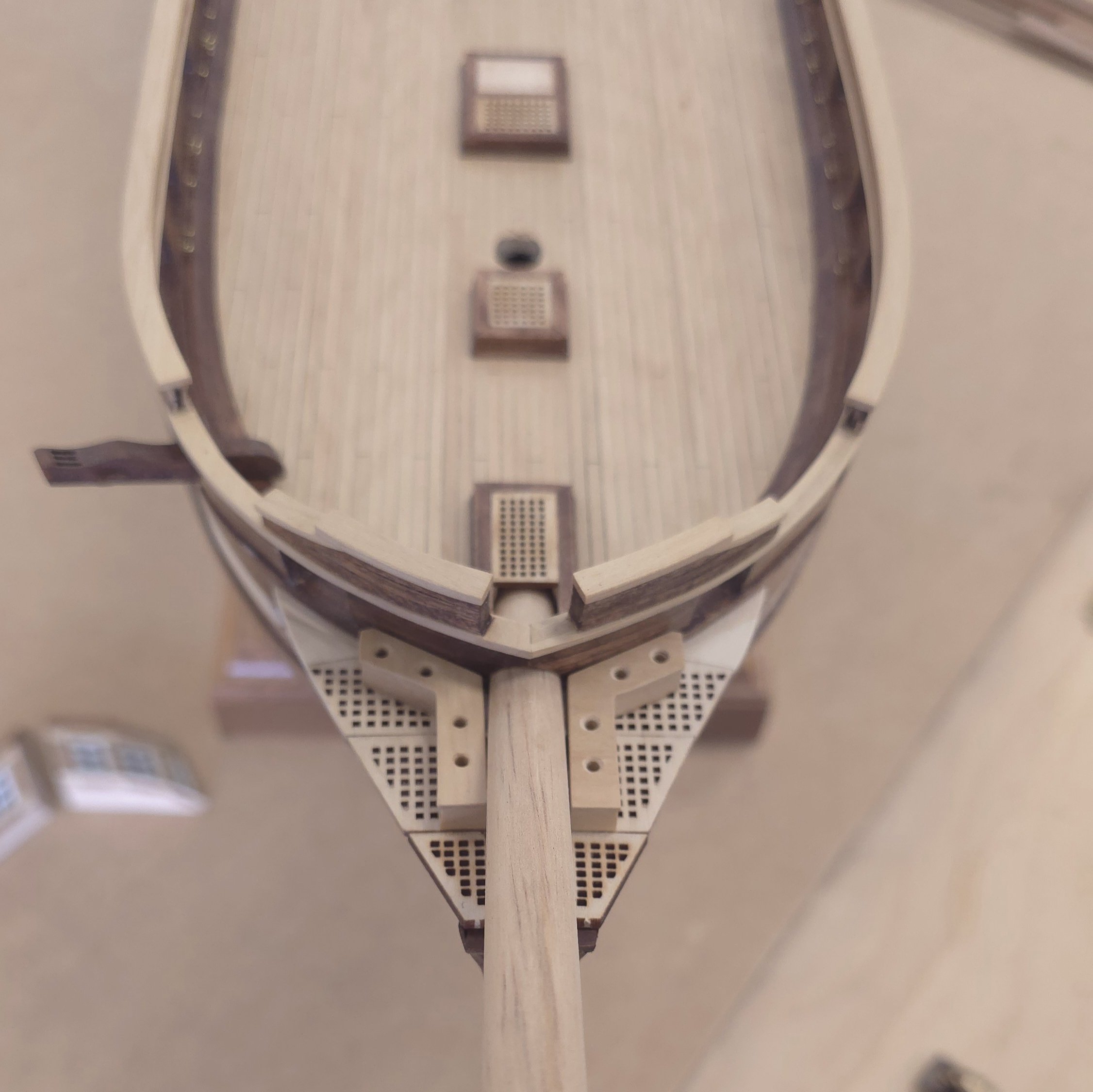

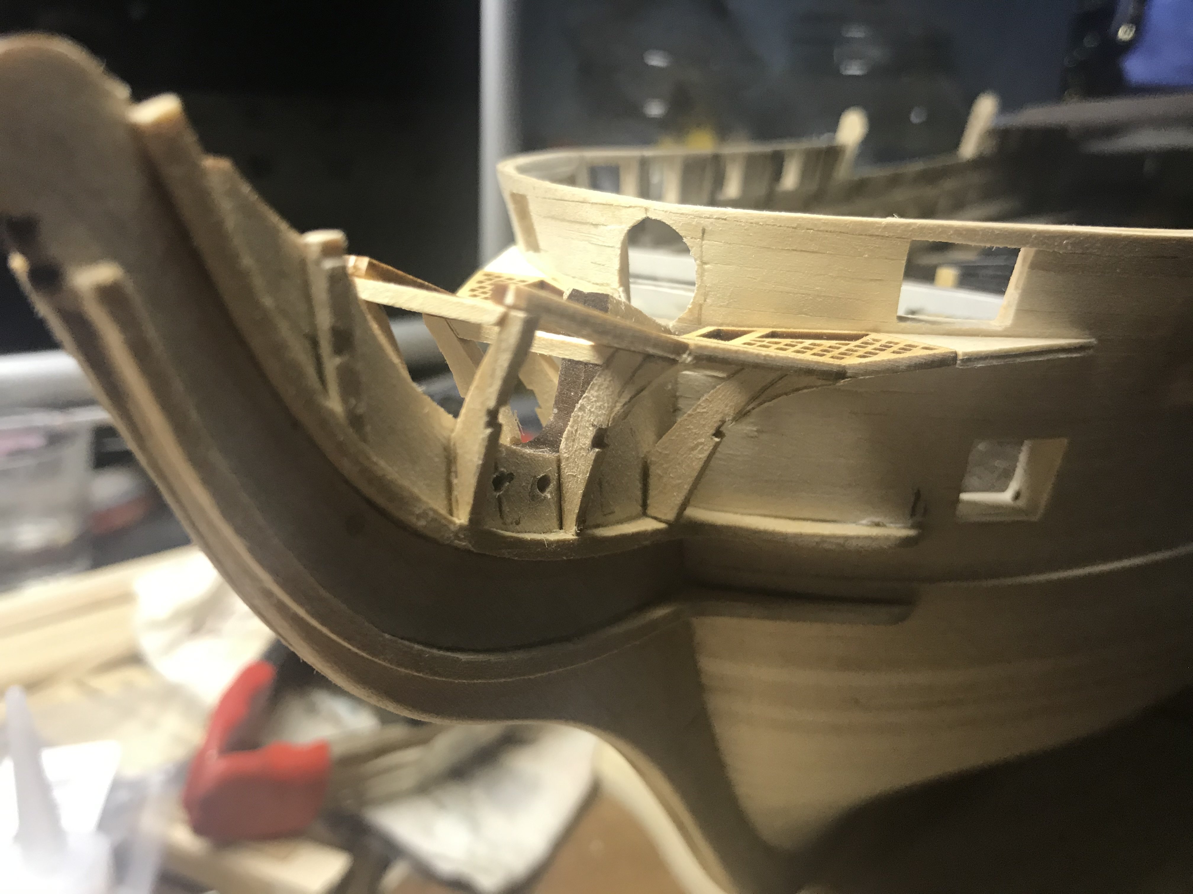

Back to the fiddly bits.  Man,  oh man, is this time consuming stuff.  Also it's amazing what you see in photographs that you don't see when you're working on the parts themselves. I'm going to have to do some tweaking on the little slots for the third rail. There seems to be some disparity in the height of the slot on support 3 on the port side compared to that of the starboard side. Oh well, having fun..
The grating has not yet been glued in. I was waiting for the base support to be fairly solid first.

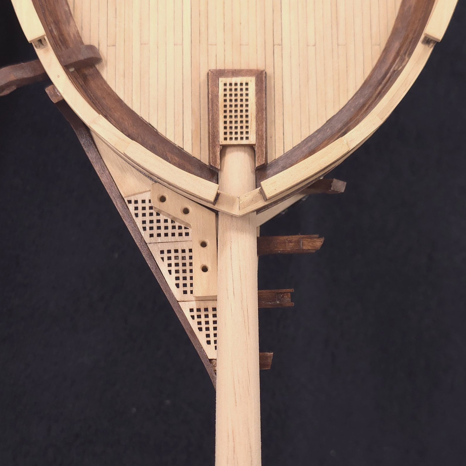

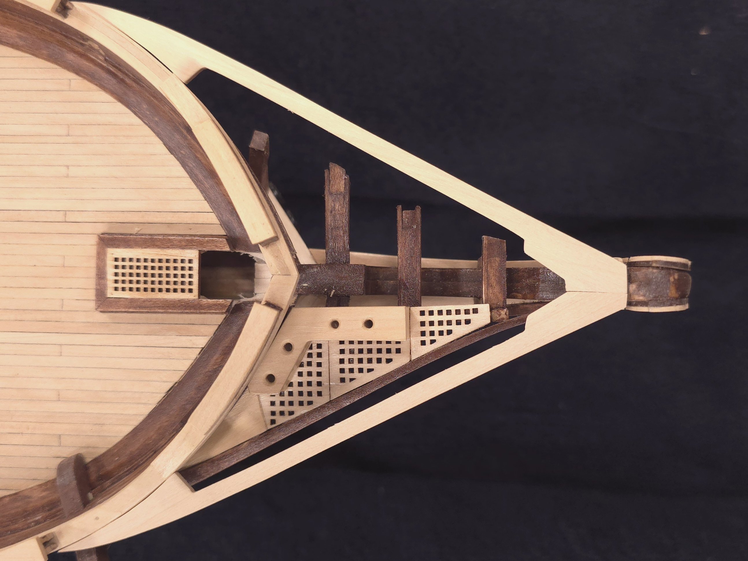

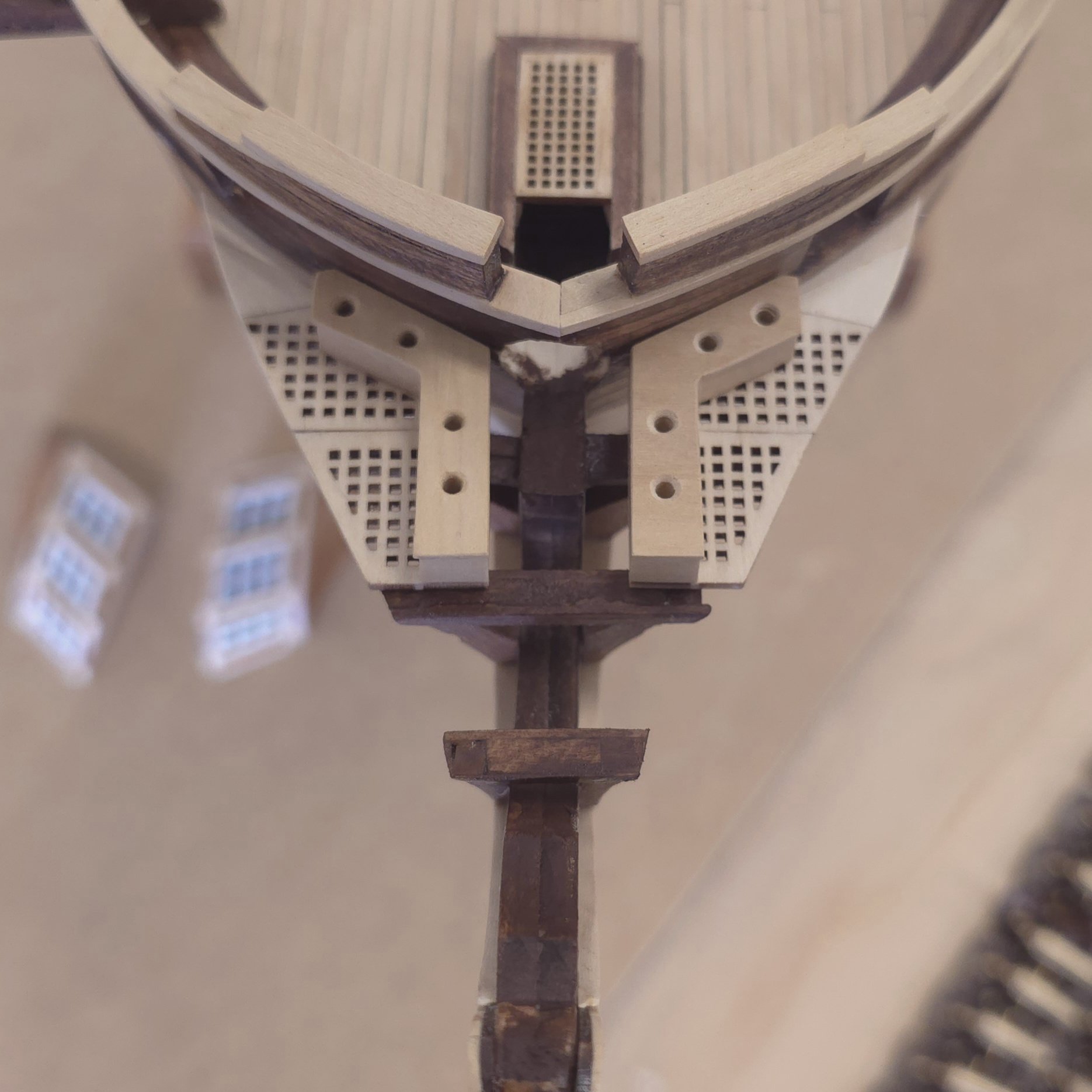

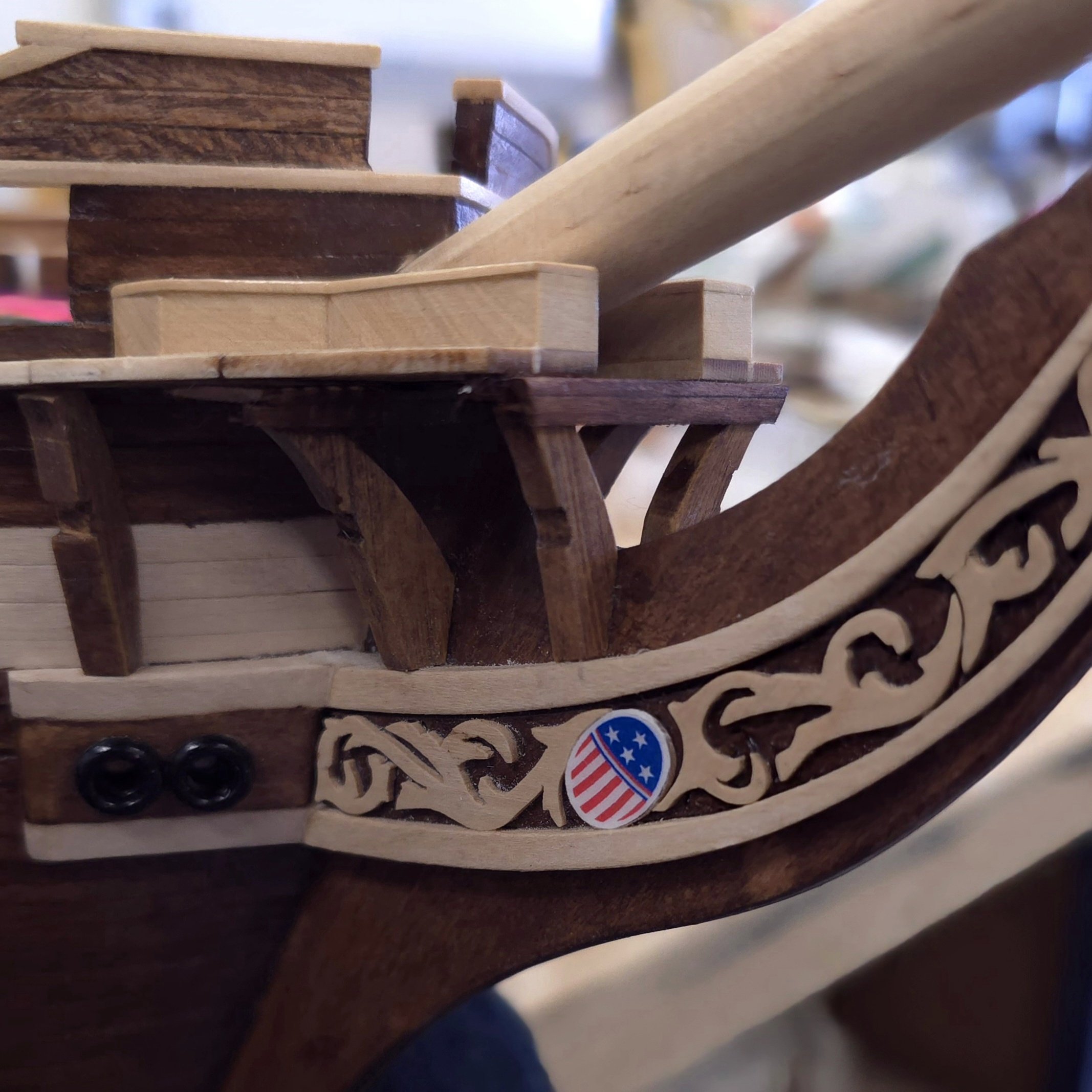

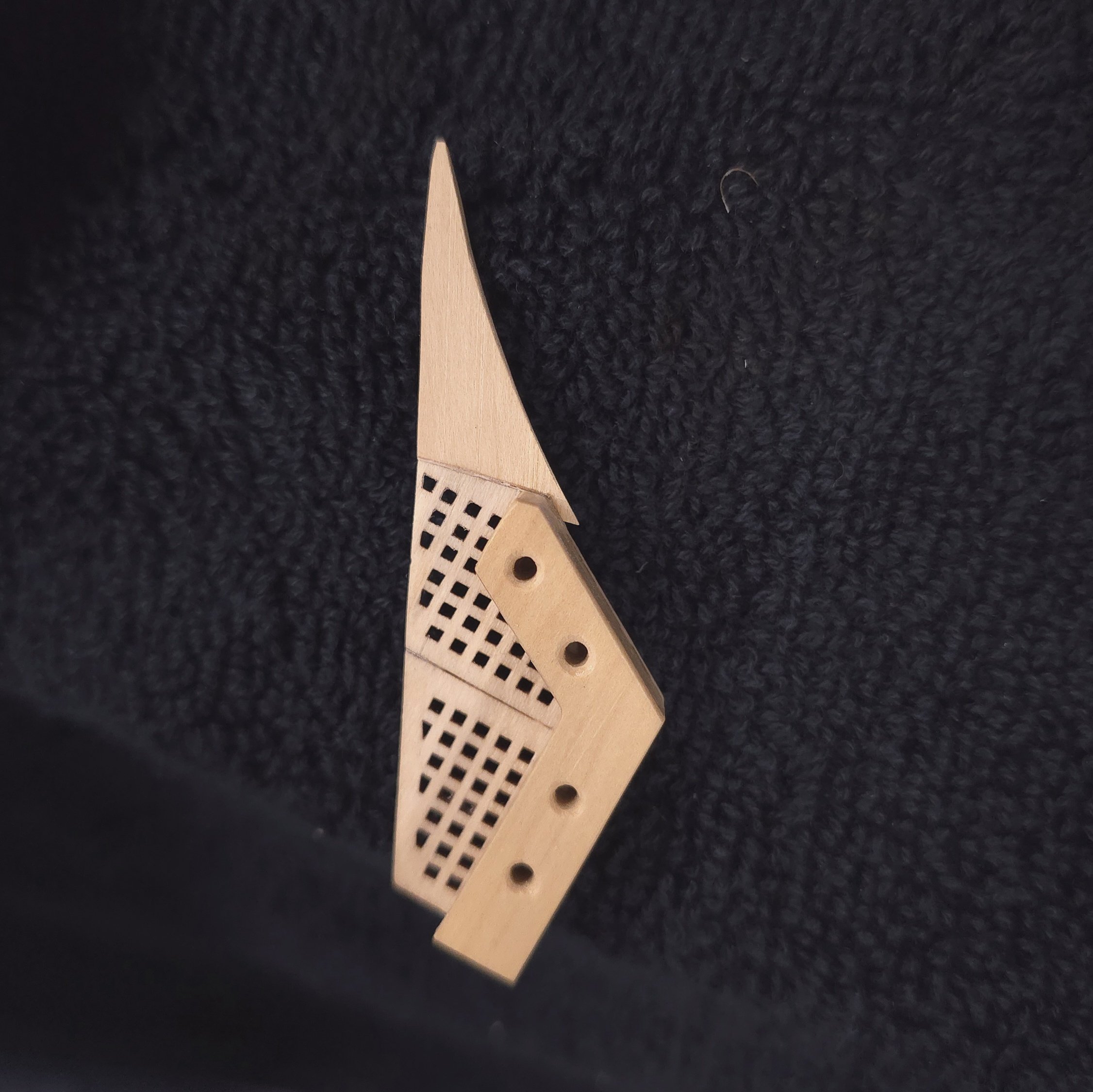

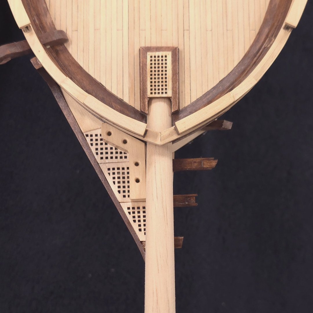

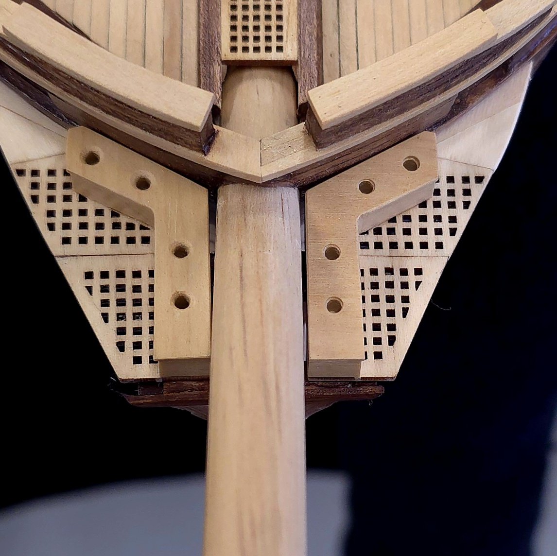

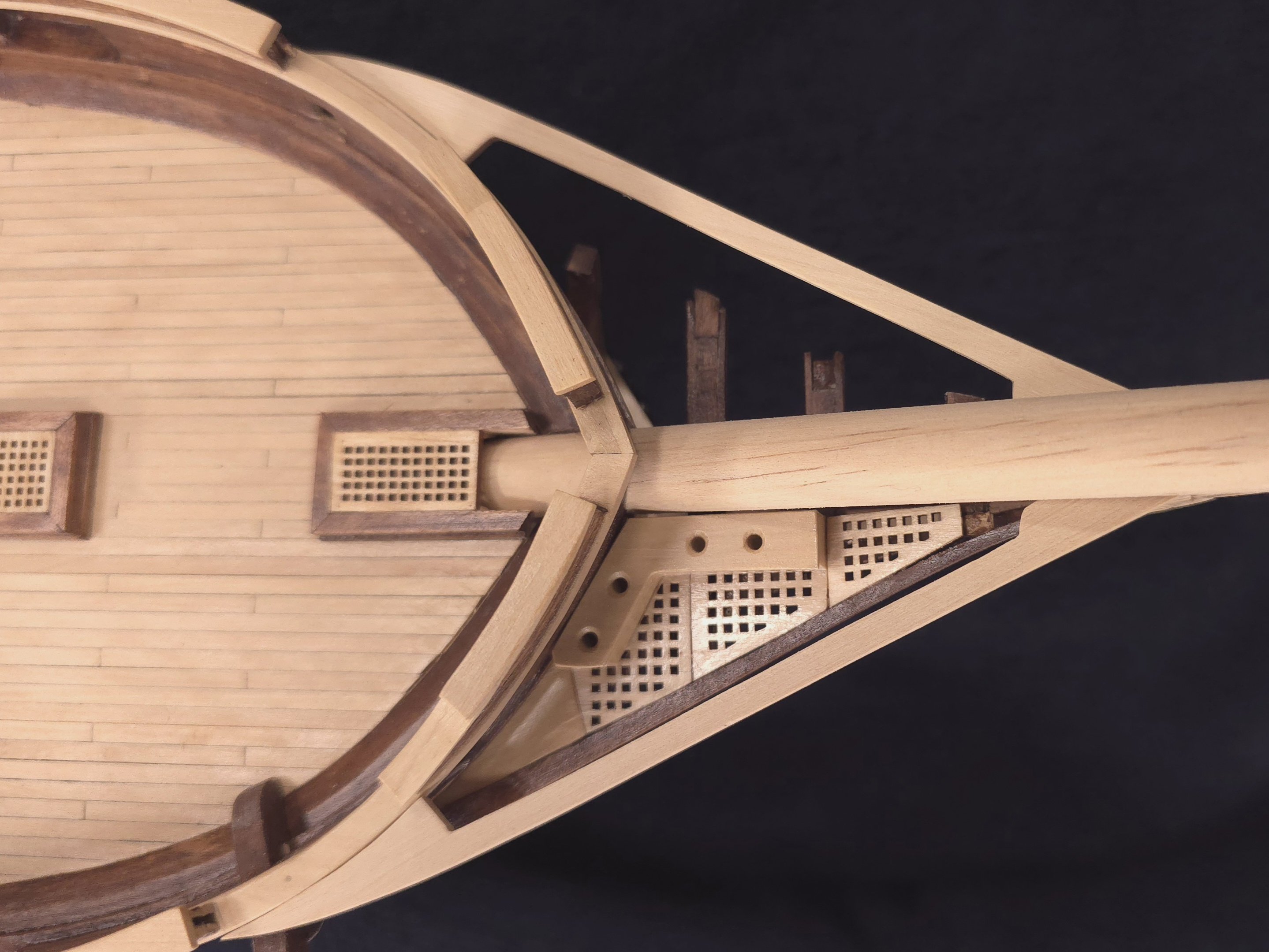

Off to the endodontist, yet again 🙄, in a couple of minutes. Before I go, the most recent modifications. I had to reshape the gratng to get a better fit between the lower headrail and the grating. After doing so, I committed and glued the grating/head assembly to supports three, four, and five. Maybe I'll get back this afternoon and install the rail. Cheers..
Edited by Der Alte Rentner
You got a very good fit between rail and gratings.
There's one thing that caught my eye though. Your lower headrail seems a bit short to me. Shouldn't it extend all the way to the end? In that case, it looks like support number 1 will be outside the rail.
Good catch. I deliberately chose to eliminate support number one, figuring that for the millimeter or two distance from the stem, it wasn't worth bothering about.
I took a look at how the top rail would fit and decided this would be a good place to end rail number two. Time will tell if there will be some deconstruction in my future. 😁

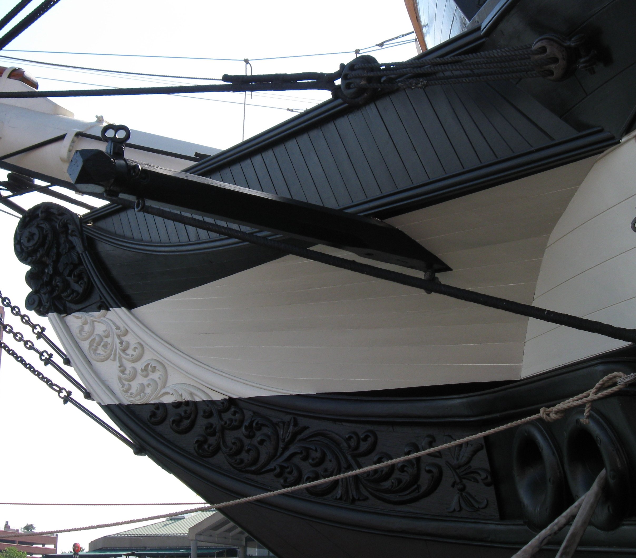

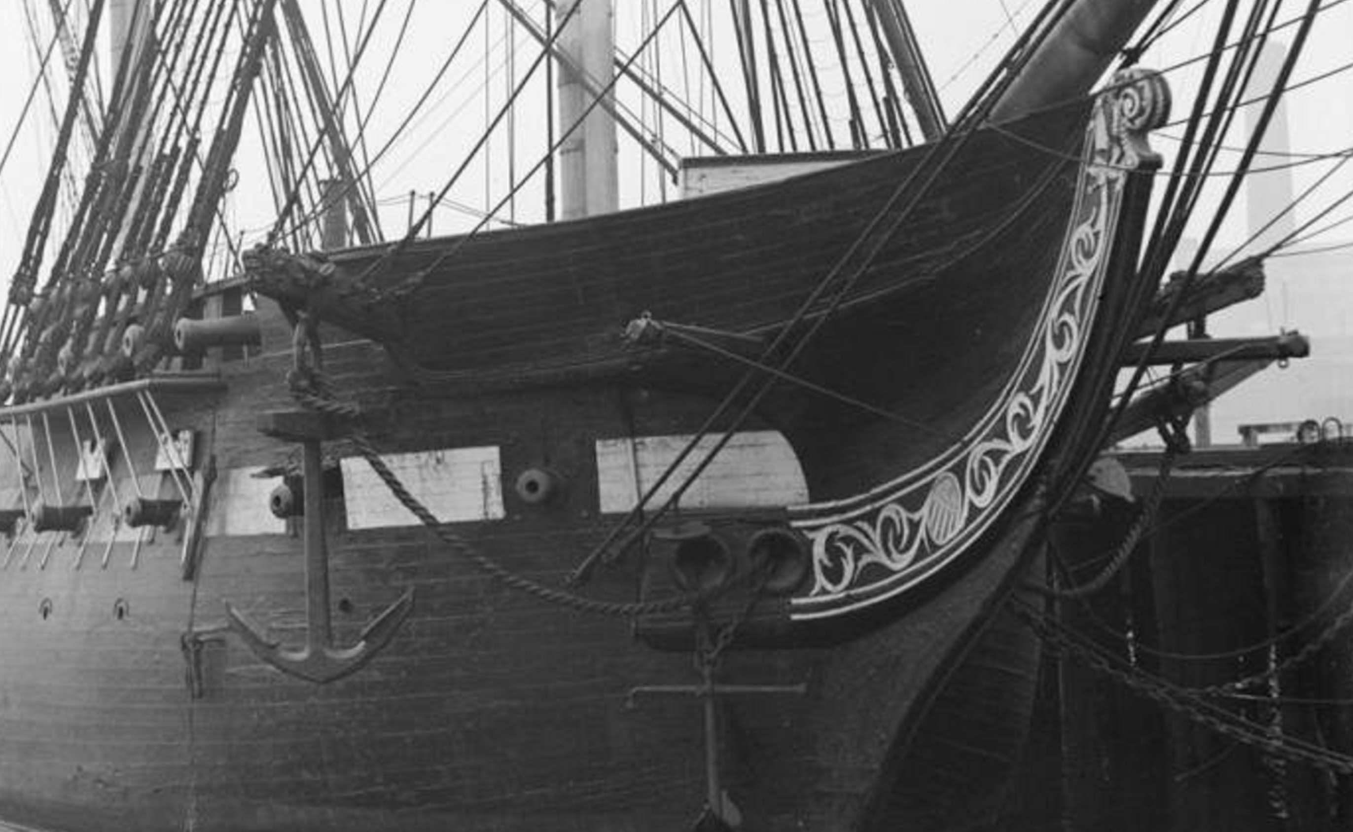

The fully enclosed head was a style with US warships from about the 1850s.   Constitution was basically rebuilt around 1854ish but may have had her head enclosed before then.
The head of Constellation built 1854

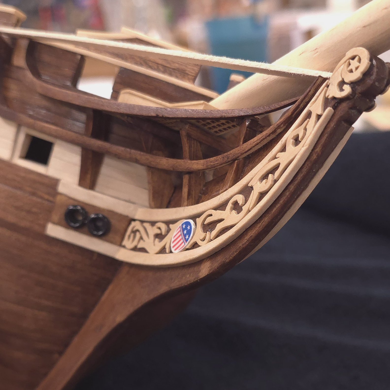

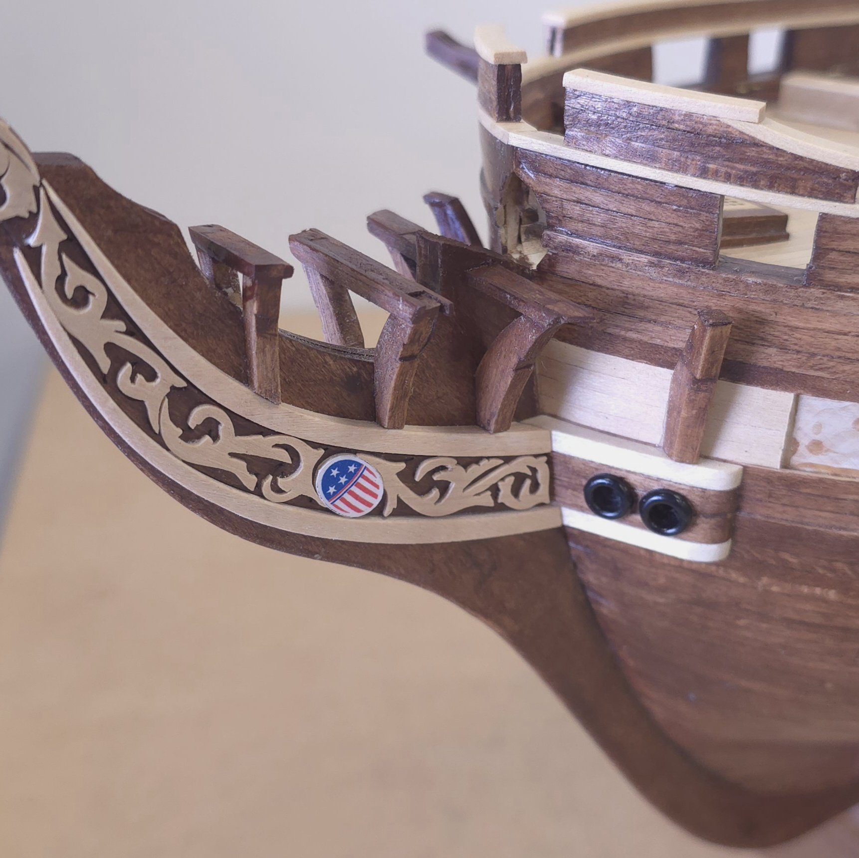

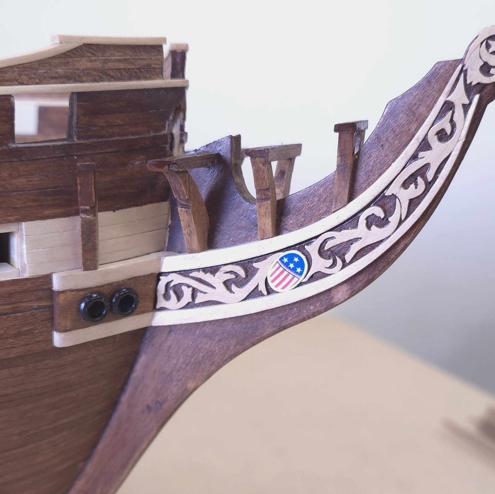

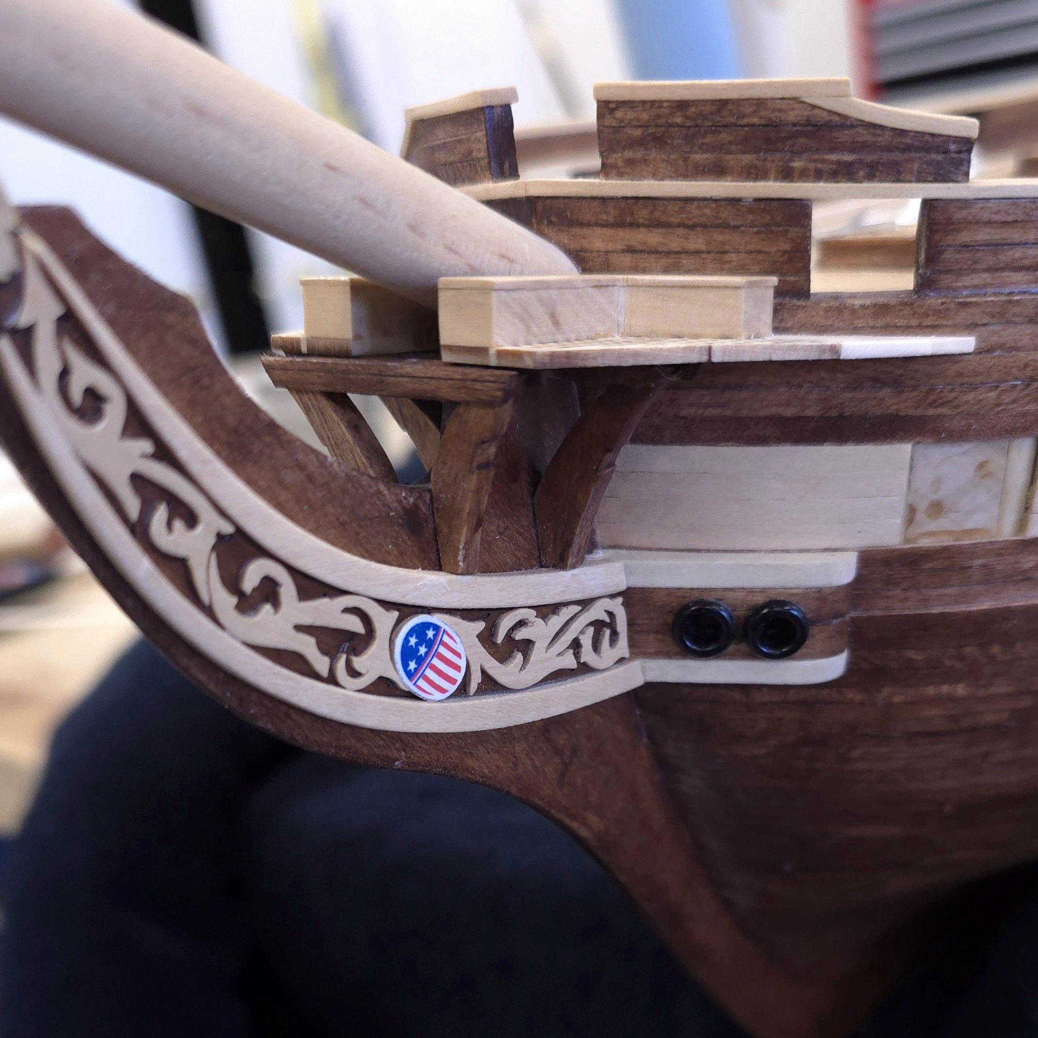

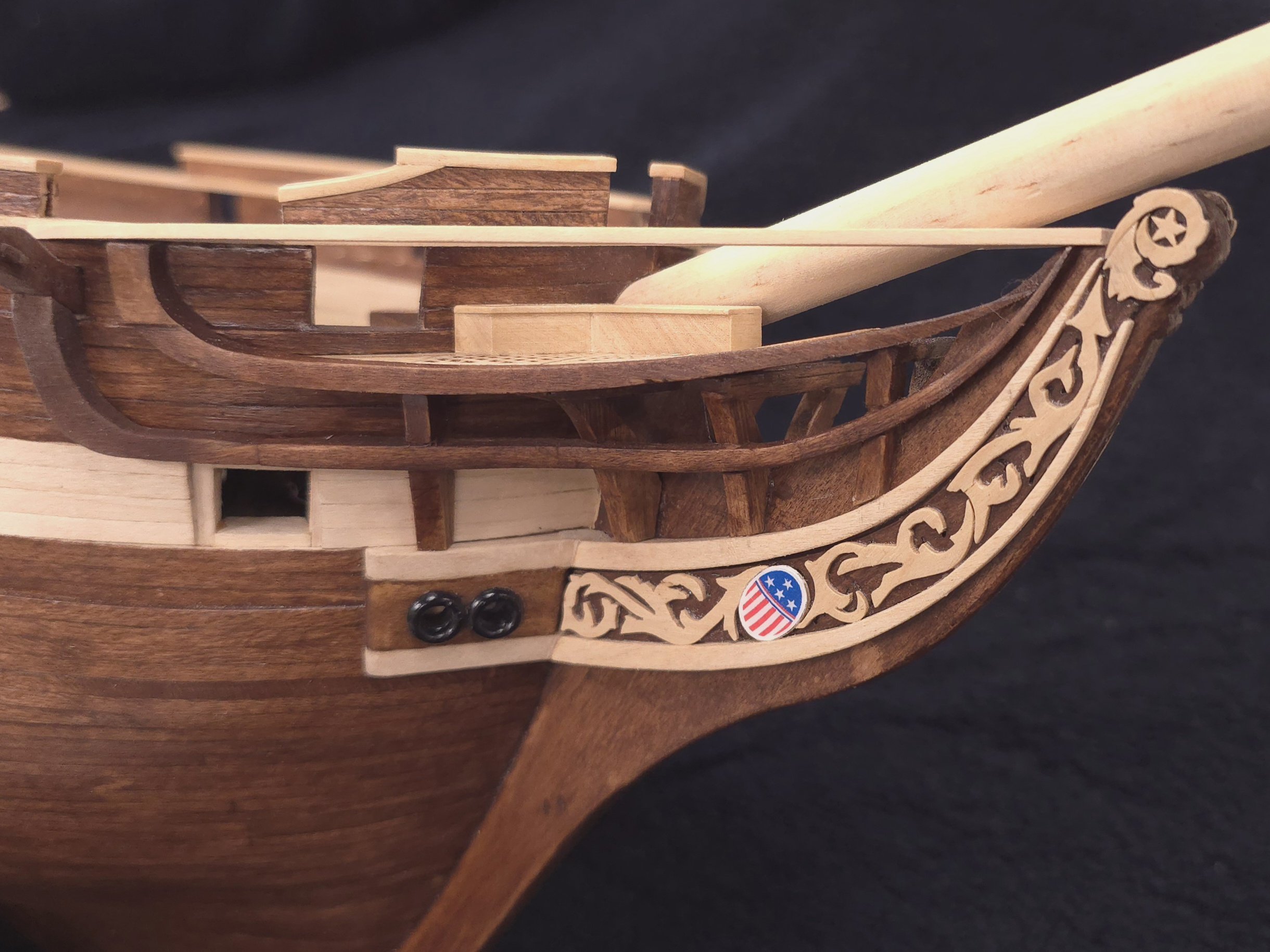

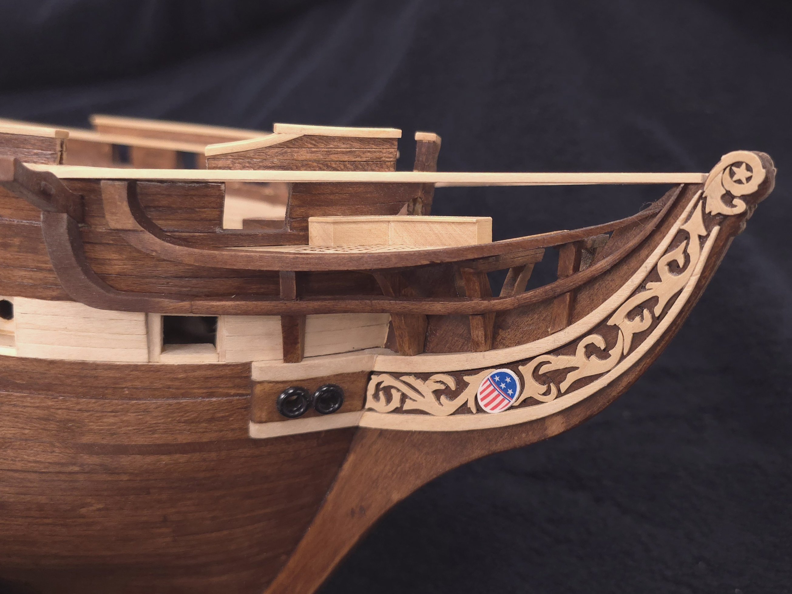

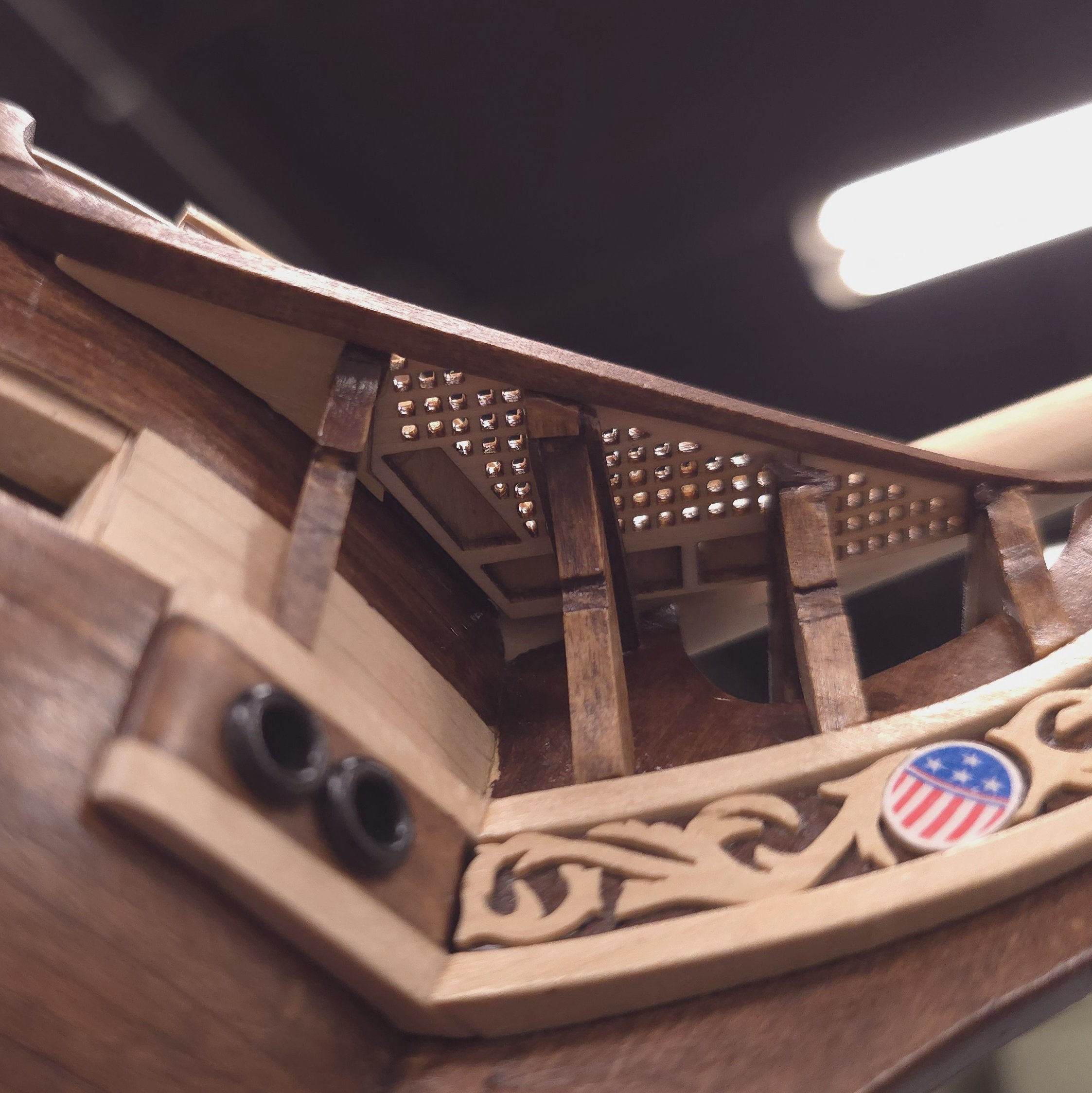

4 hours to install the third rail. I tried three different techniques before I bailed on them and opted for picking a softer piece of wood and just using the plank Bender to shape it.
And again, it's amazing what the camera picks up that the eye does not when you're actually working on it. I'm not going to change it, but I'm not 100% satisfied with the shape right above the flag.
And! I just noticed that I was a little sloppy applying stain to the bottom of that rail.  Oh well..

For such a fiddly struggle as the head is, yours is looking great!
Just keep in mind, the artist is always the harshest critic of his own work.

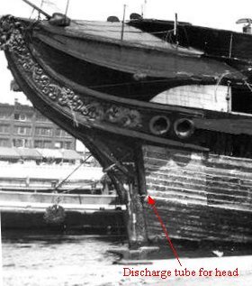

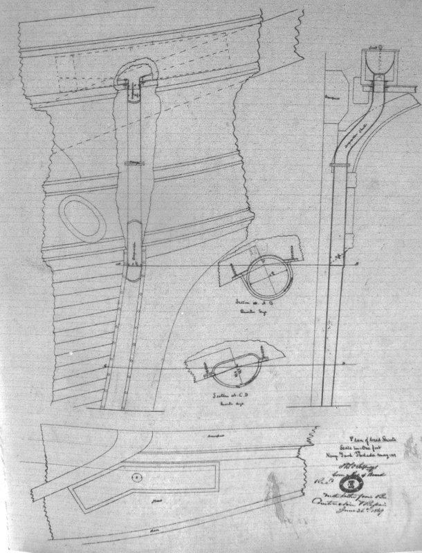

The mind sometimes ventures to weird places..  Um, with the entire area planked, where did the effluent go?
Looks good, Peter!  And also remember what has been mentioned on countless other build logs... You are noticing things, as the artist, using a zoomed-in camera.  Back up 2-3 feet with the naked eye and it's never noticed. 🤷‍♂️👍
Over the side somewhere!  With one hand hanging onto a rope and the other hand... well, nevermind.... 🫢🤣
Gregg
Down the "poop chute," of course

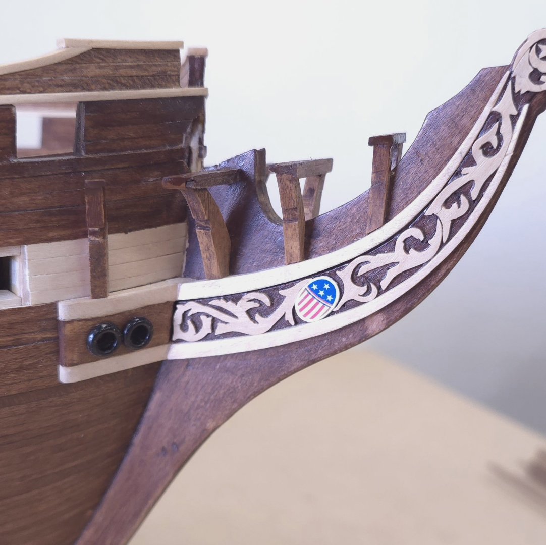

Thanks again, Thomas, for providing that group of pictures a little while ago.

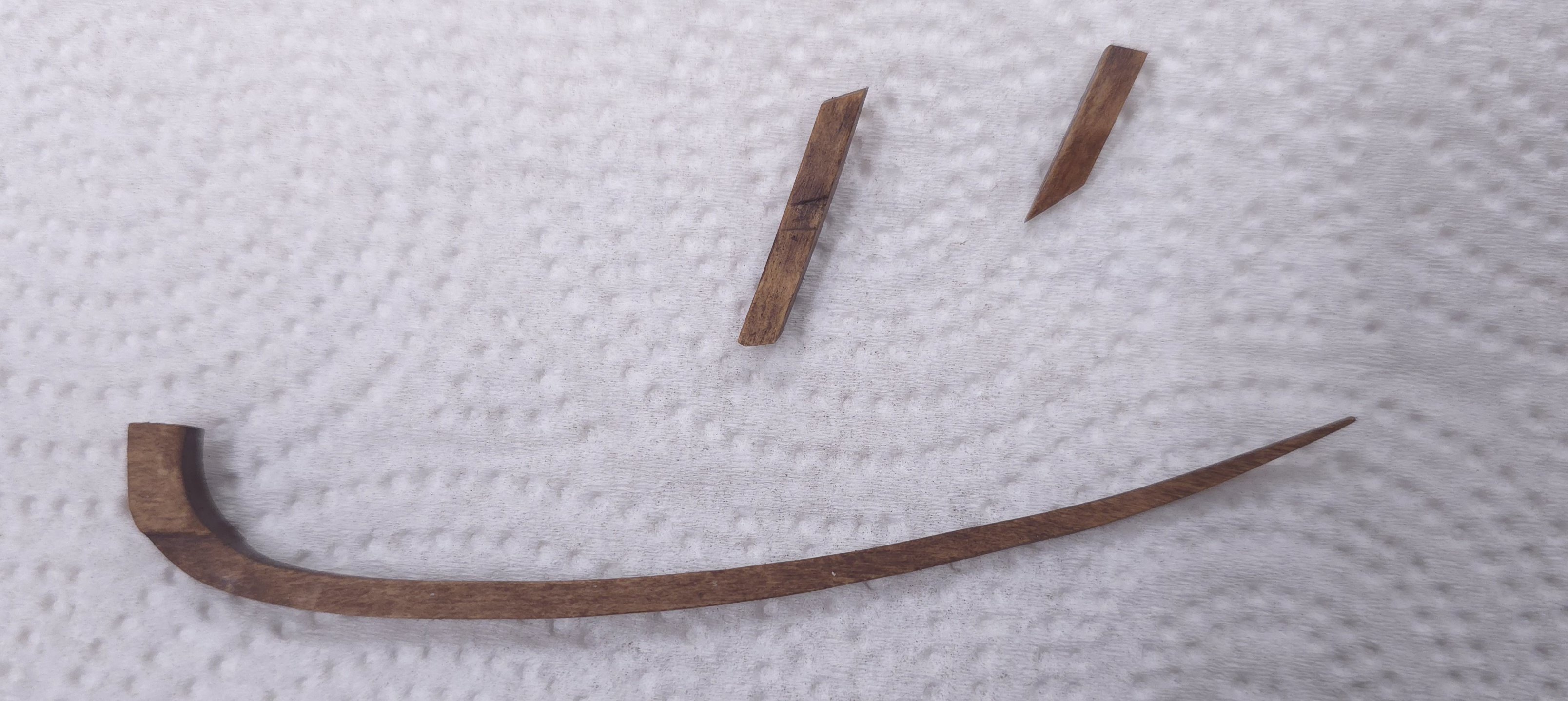

This one really helps me visualize how the head and main rails merge.  I couldn't quite work that out from the plans.  Since my main rail is already in place, I'll have to do a little bit of tweaking to get the headrail and filler piece configured. But now I have a direction.
IMG_4654.thumb.jpeg.17db37ca5d33a1e296d949dac48a0e3f.jpeg.767f7c7b0170763e97b244838926adac.jpeg

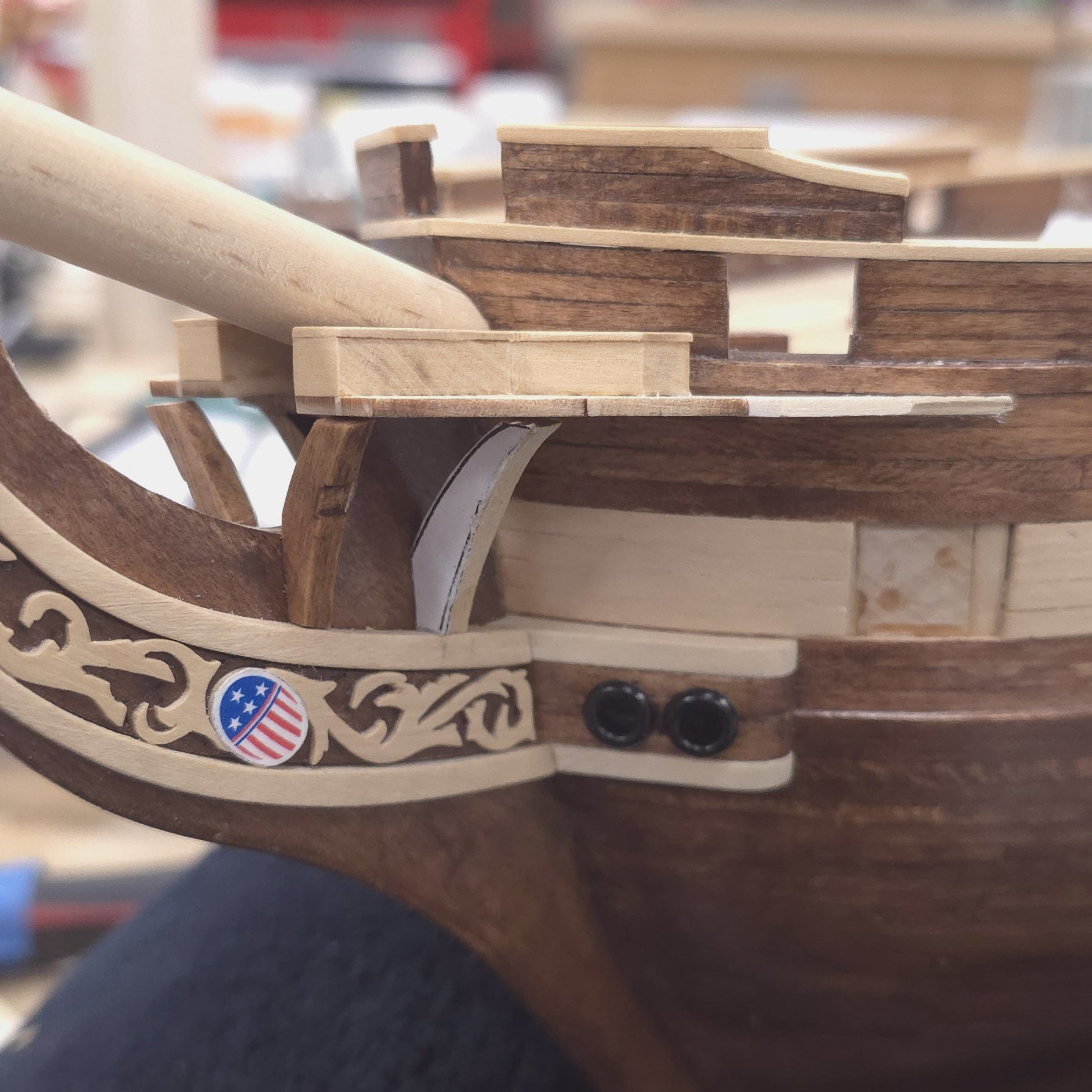

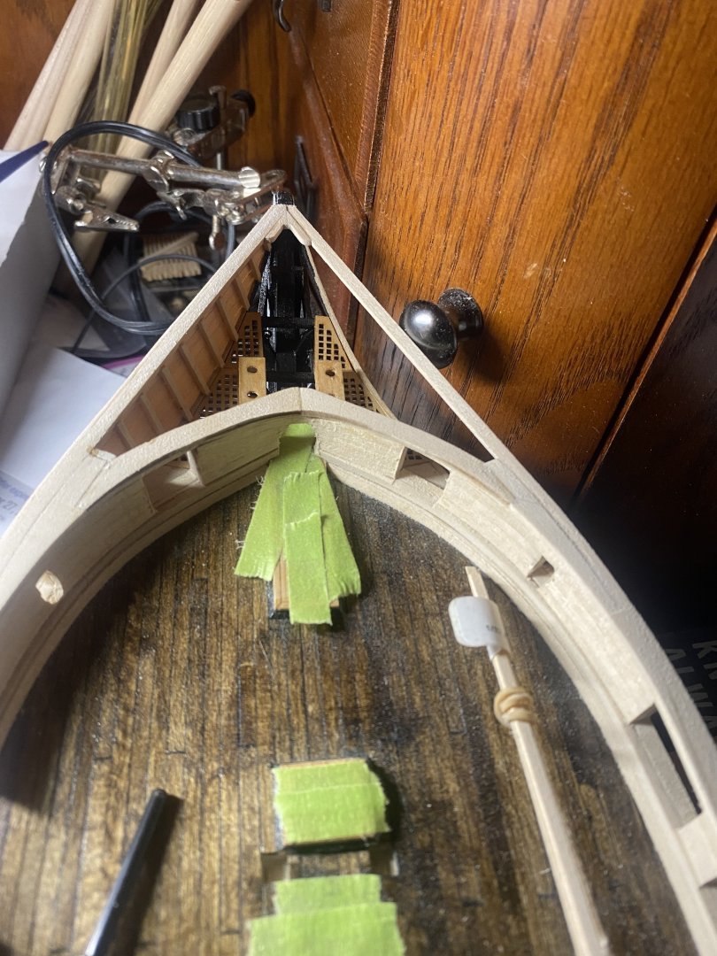

Mustafa and greg, I added the following pictures after you saw this post.
In order to do the planking on the starboard side I needed to fabricate the main rail. As long as I was making one, I did both. They are only tacked in for these photos.
