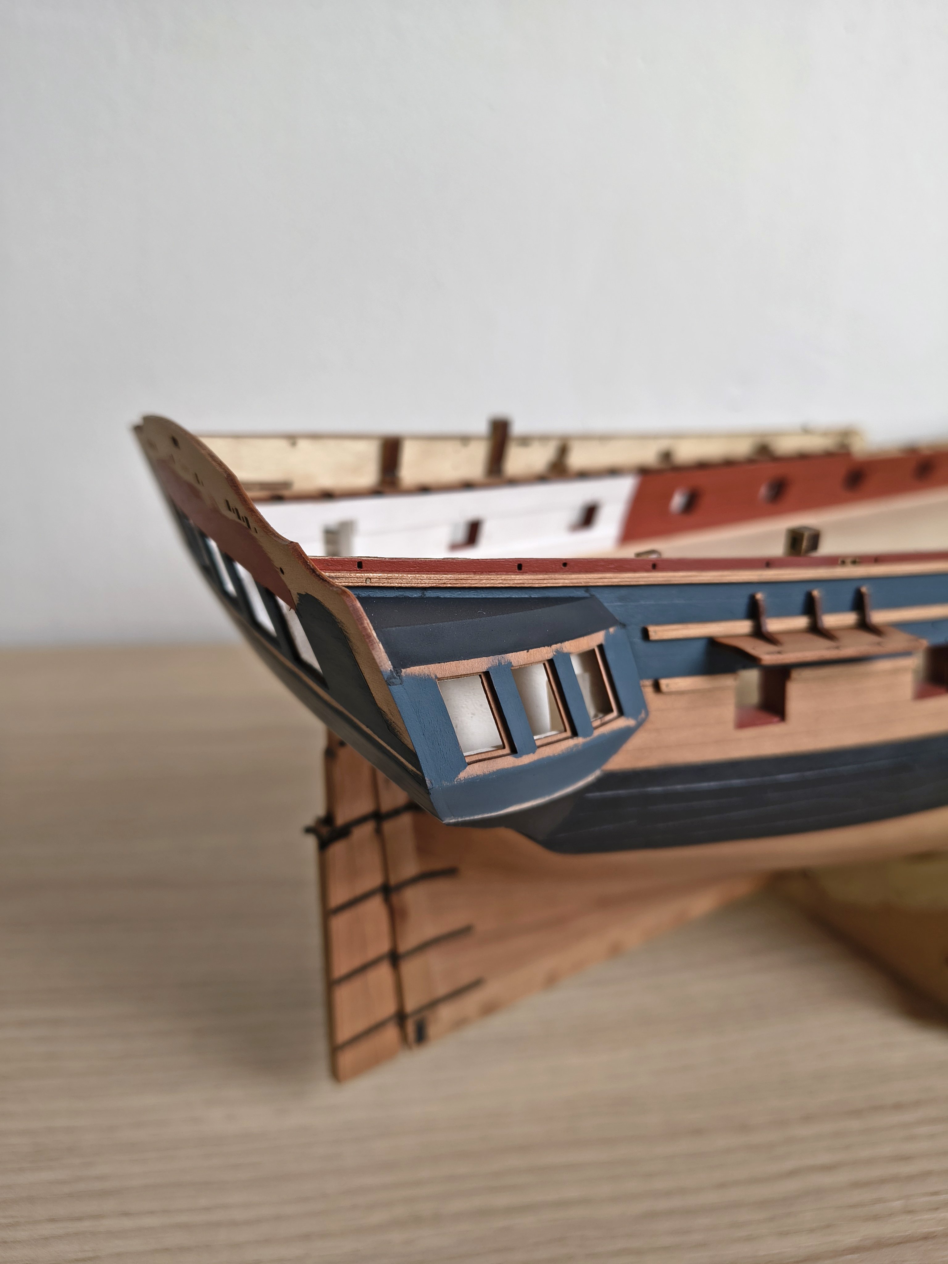

Ronald, is the ornament on the slats that cover the head timbers just painted, or is it embossed? Did you use a brush or a stencil? How wide are the slats?
I hope I understood your question correctly...it's still early haha, otherwise just let me know.
These are lasered. Chris Watton is responsible for that (part of the kit decoration). The only thing I did was paint the lower part (which was burned away by the laser) blue. Of course, I can't paint that neatly, but I was able to scrape off any paint that ended up on the higher part with a knife.
Like this:
IMG_20250927_093932620.thumb.jpg.ad66a4422e3a2d99099378a7298a9c65.jpg.8edb4cf3a5fc7c76bf0e65d54a548bd3.jpg

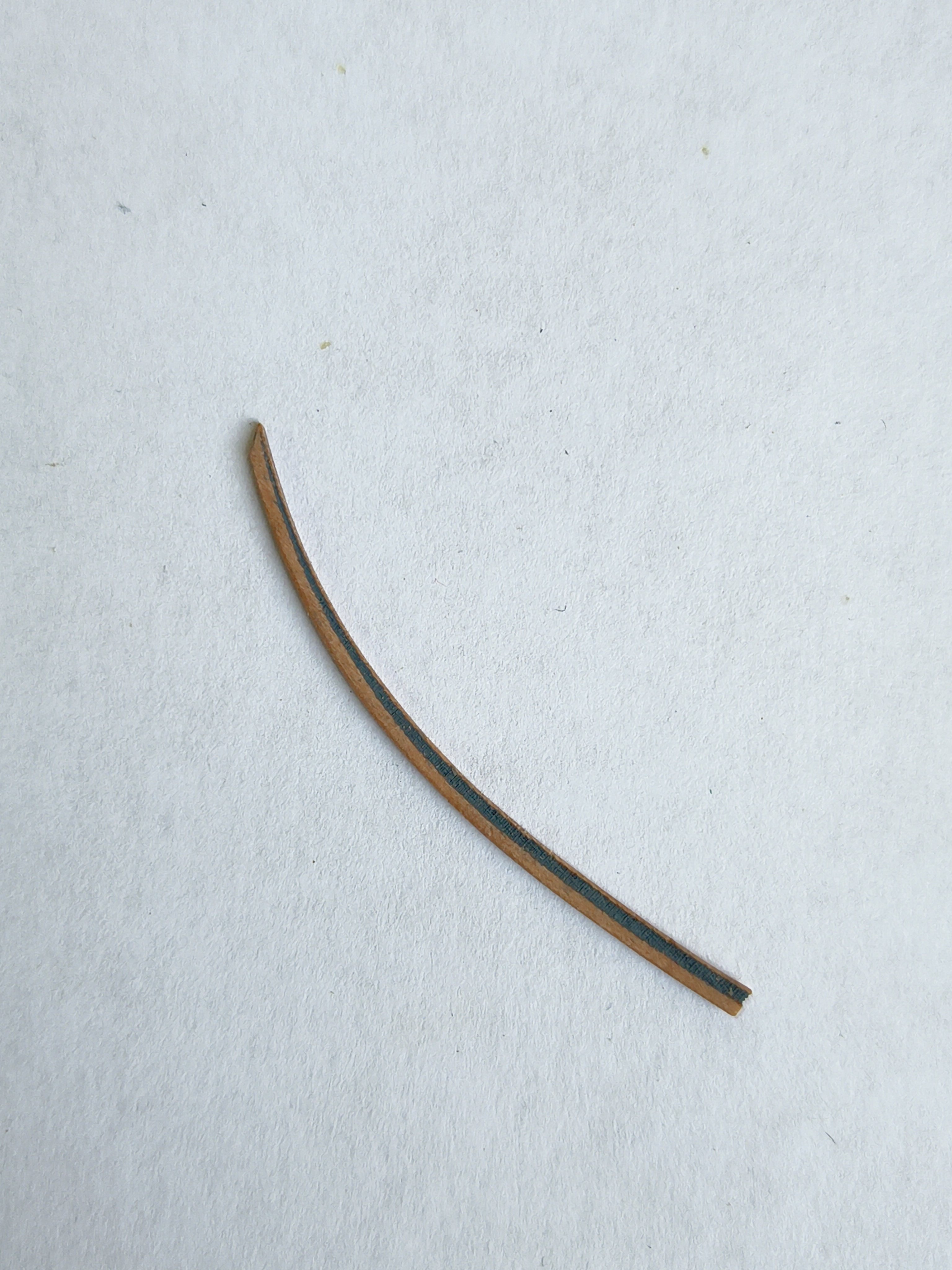

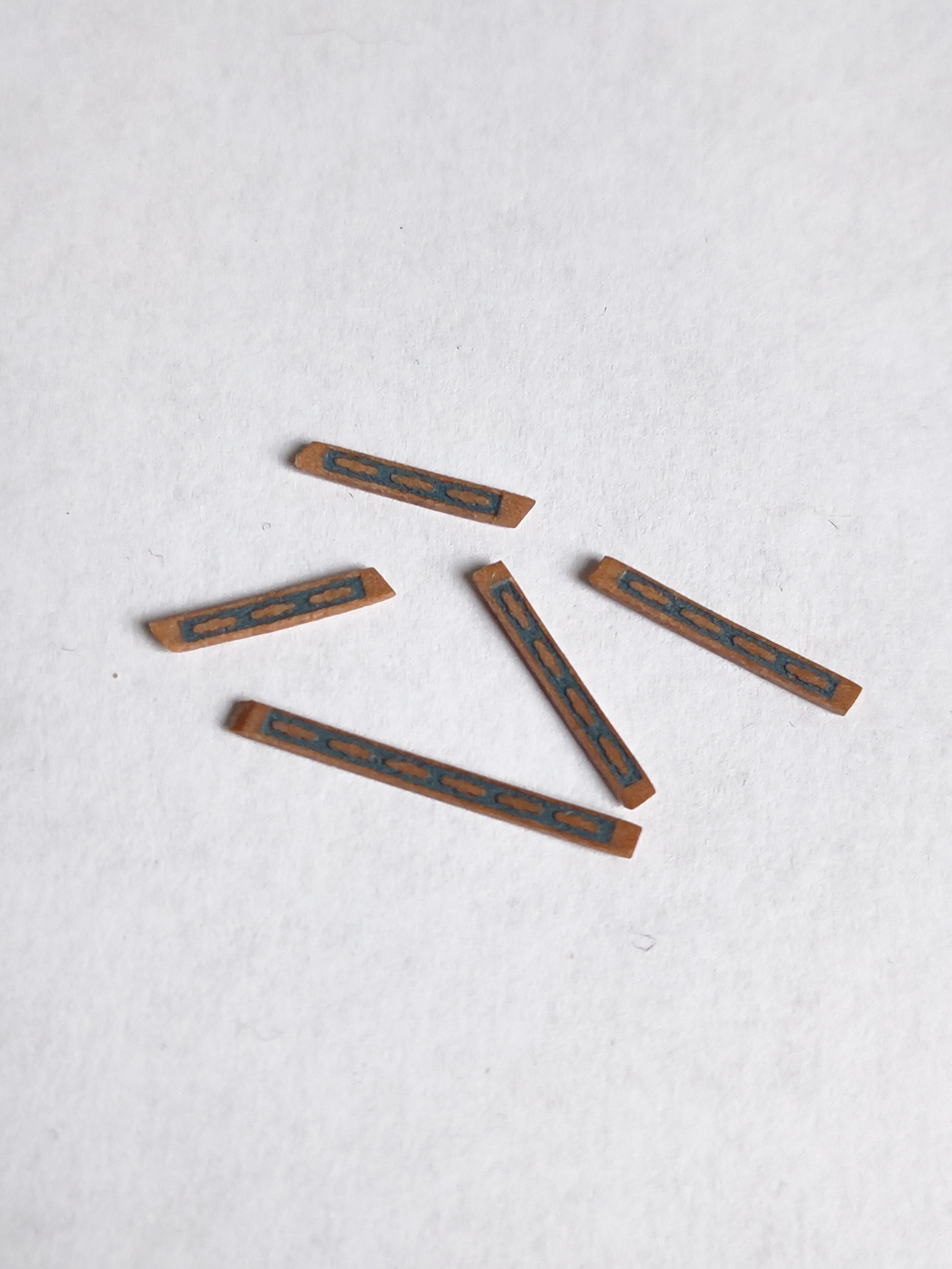

Ronald, I was referring to these bars. Are they also laser-cut? What is their width? I'm asking because I'm currently in the process of assembling a head. Corel doesn't have any laser-cut pieces, and I want to add texture to these parts. However, they are very small on my scale.
Yes then I understand correctly and yes they are lasercut, so I think that would be difficult to replicate. Perhaps with some kind of paper template that you can cut out after printing and then use as a template. But I'm afraid that would be very difficult at the scale you're building. Unless you're a gifted painter...then you could try it by hand. 😱
Thank you for the information, Ronald! I'm not much of an painter...) But this is about relief. I'll try to give the details at least longitudinal relief using scribe plates)

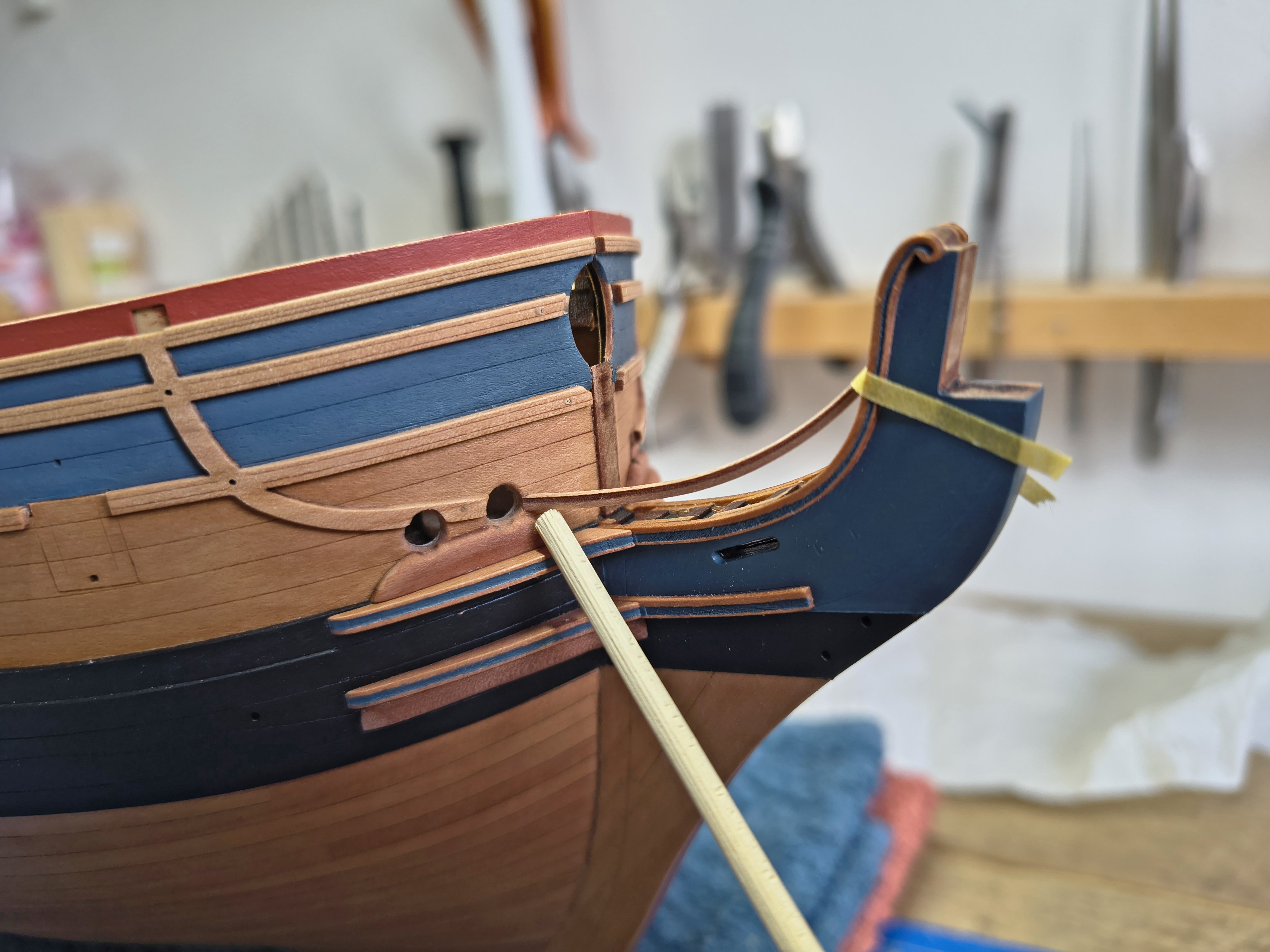

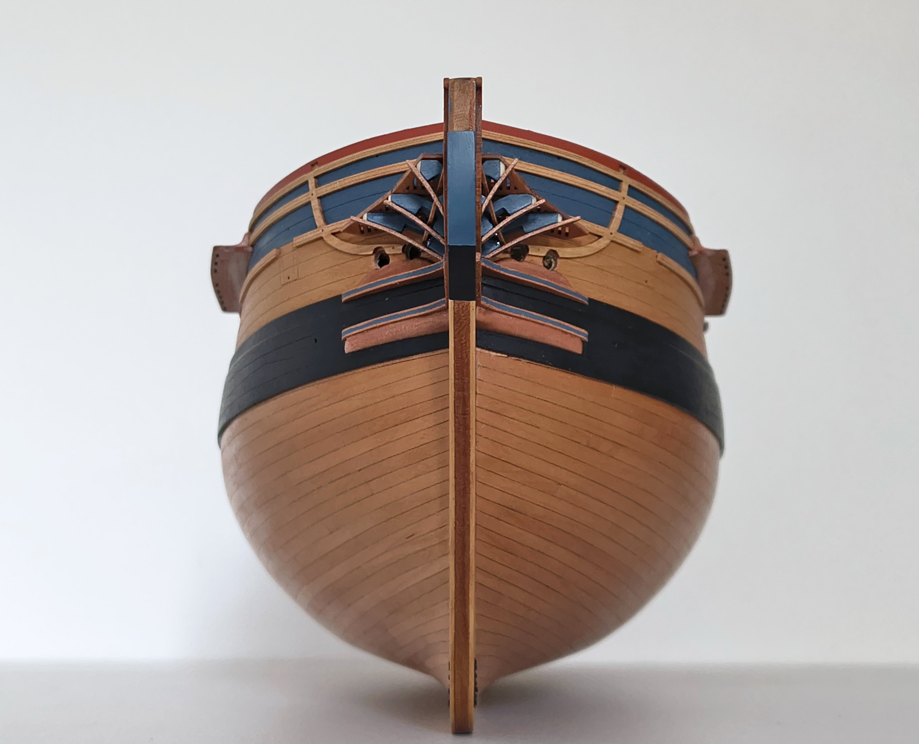

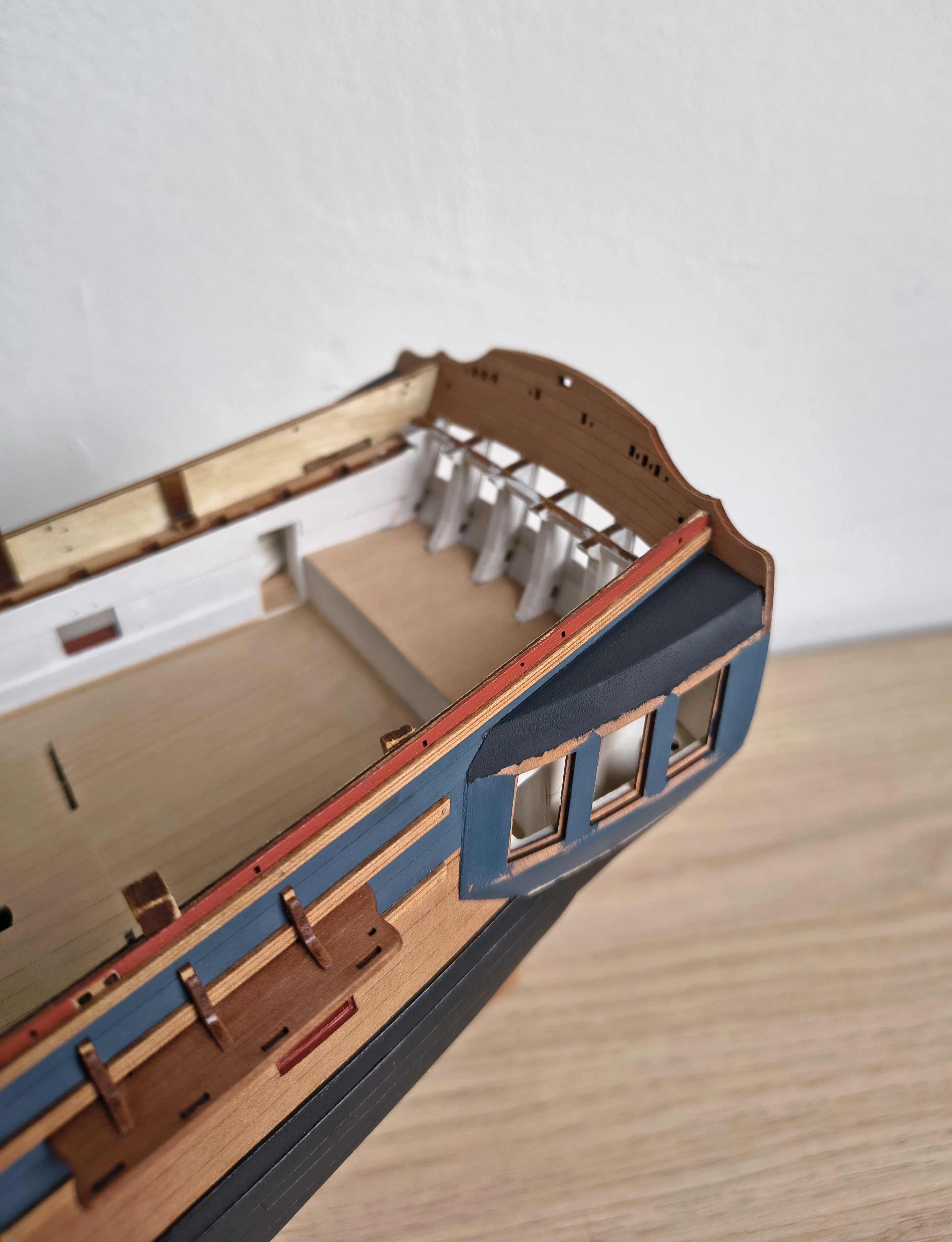

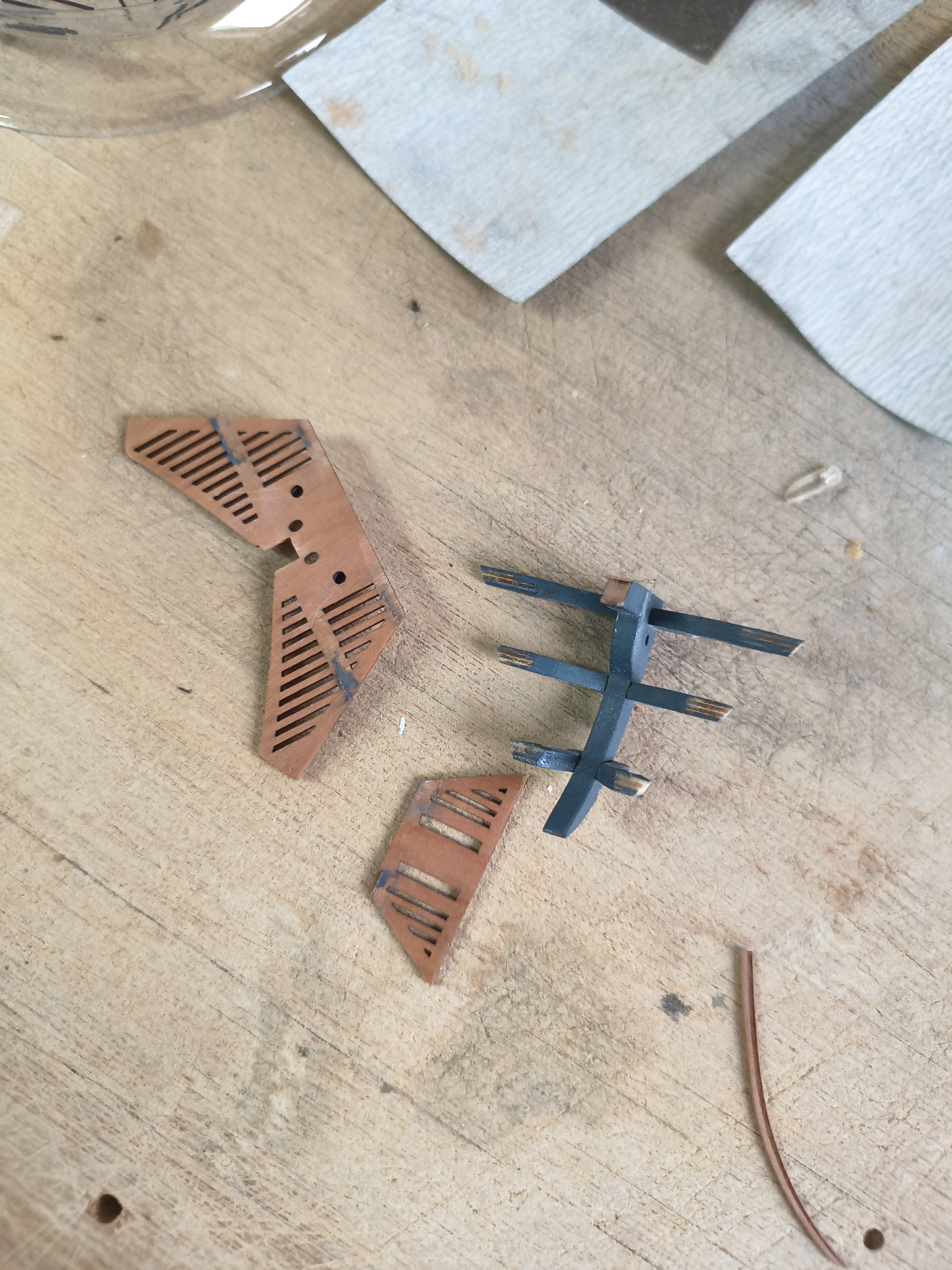

Okay...to follow up on yesterday's update, here are some pictures of the process. :)
The final part of the "Head foundations," as Beef Wellington so nicely called it, revolves around the correct placement of the two "bow lower rails." I first sanded them to size because Chris had left them slightly longer, as every ship is slightly different. This way, without the grating assembly/gammoning knee getting in the way, I could hold the bow lower rails at the start point (inner hawse holes) and end point (tip of the gammoning knee) and cut them to the correct size. (I would recommend leaving them a millimeter longer so you have some extra meat at the last minute if it's just a tad too short.)

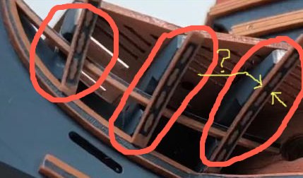

By the way... I assume there shouldn't be any sideways curves/distortions in these rails, but that's my interpretation of the plans/kit. They might have been in the original, but I think for better flow they should be straight. That's why I've sized them this way.
The next step was to file the slots in the V-brackets to size to prevent any sideways deformation of the lower bow rails, reaching the start and end points of the rails on the hull. Again...this is my interpretation; perhaps the original prototype had a slight curve in it...I have no idea :)
So, here and there I had to file the slots a little larger (especially those closest to the hull) so that the rails would actually lie on both sides at the start and end points without putting any tension on them. That's why I had laid the ship on its side here...so the rails would fit in place without any effort.
All that filing loosened the glued gratings from the V-brackets, which actually turned out to be a good thing. (I used some rubbing alcohol to loosen them completely.)

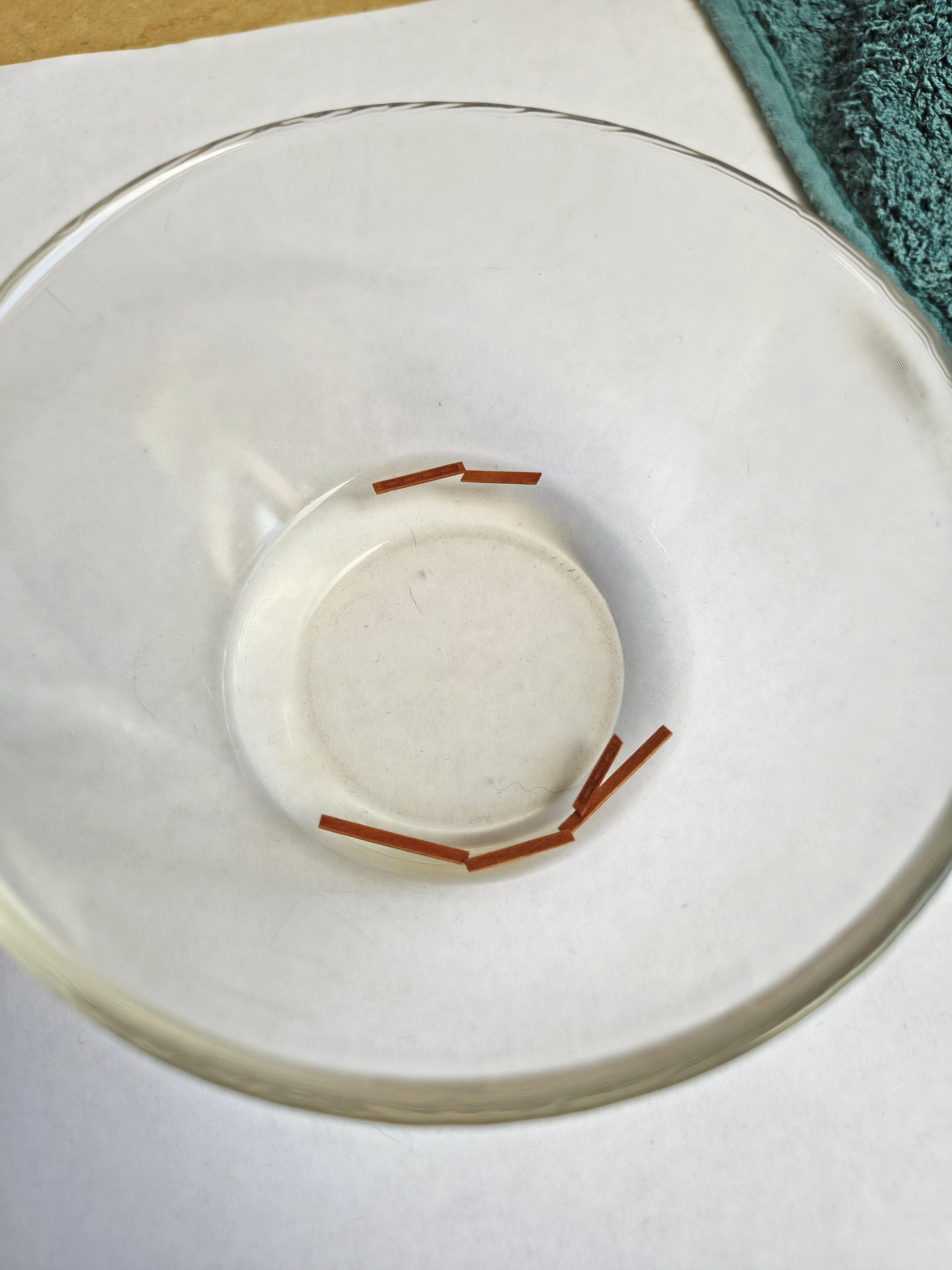

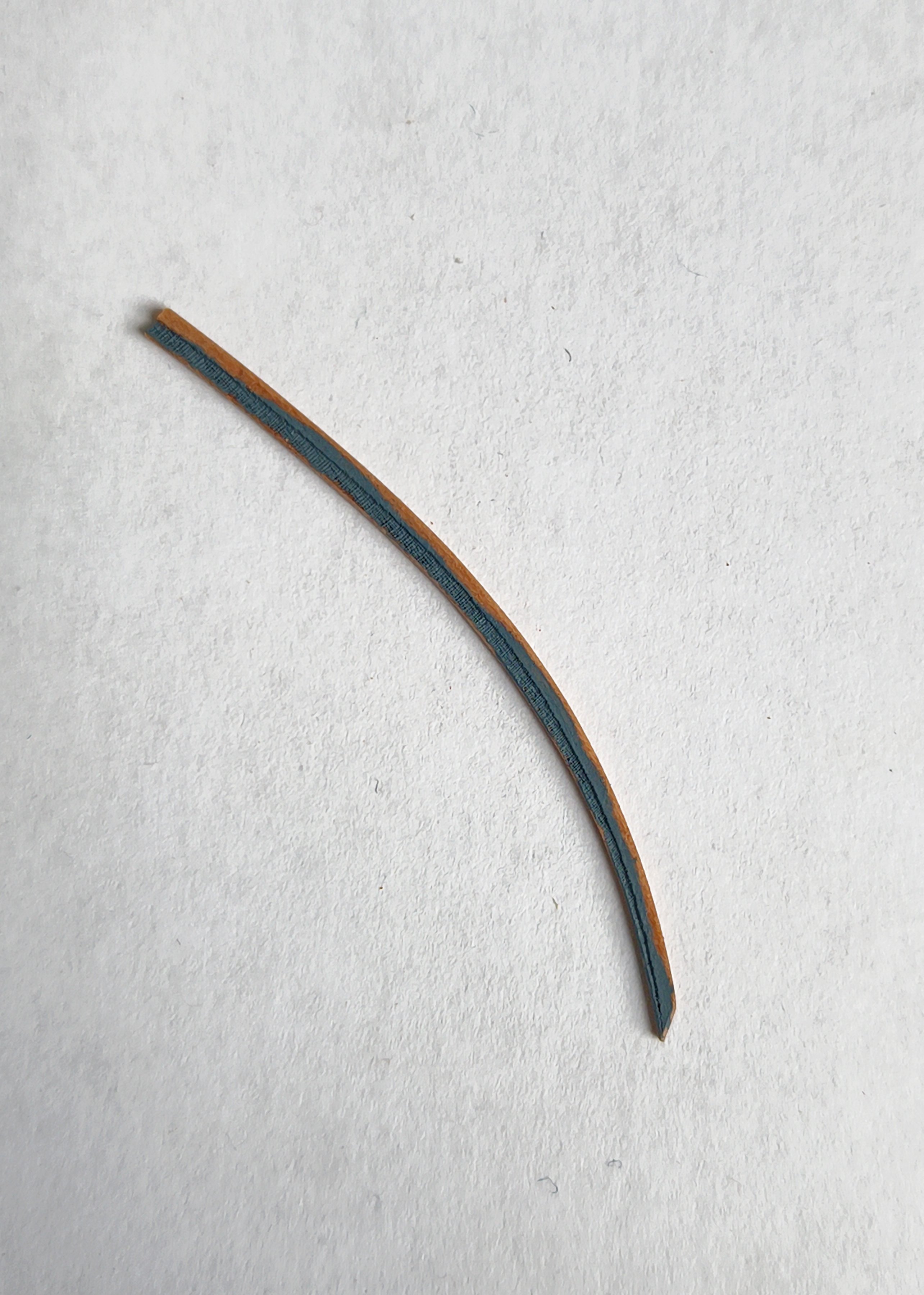

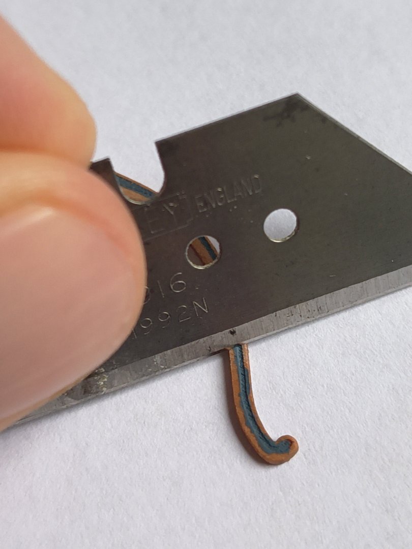

After everything was cut to size regarding the "lower bow rails," I could paint or varnish all the parts. I'm so glad the parts were lasered because, as you can see, I'm a pretty terrible painter, haha... I found it really difficult to paint the lasered part blue here without going all over the place. In my own defense, though... I'd had too much coffee and had been working out beforehand, haha, which always makes for a less-than-steady hand.
I used the same order as with the previous lasered decorations. First, I treated all the raised areas with WOP, so the blue paint wouldn't adhere as well. Then I painted the lower part (the lasered part) blue. Then I scraped everything off the raised part with a knife and gave the scraped area an extra coat of WOP. This creates beautiful, straight lines.
In the meantime, I also bought this beautiful dust extractor from Ikea, based on Mike Y's tip.
Very happy with it and it has a handy design :)

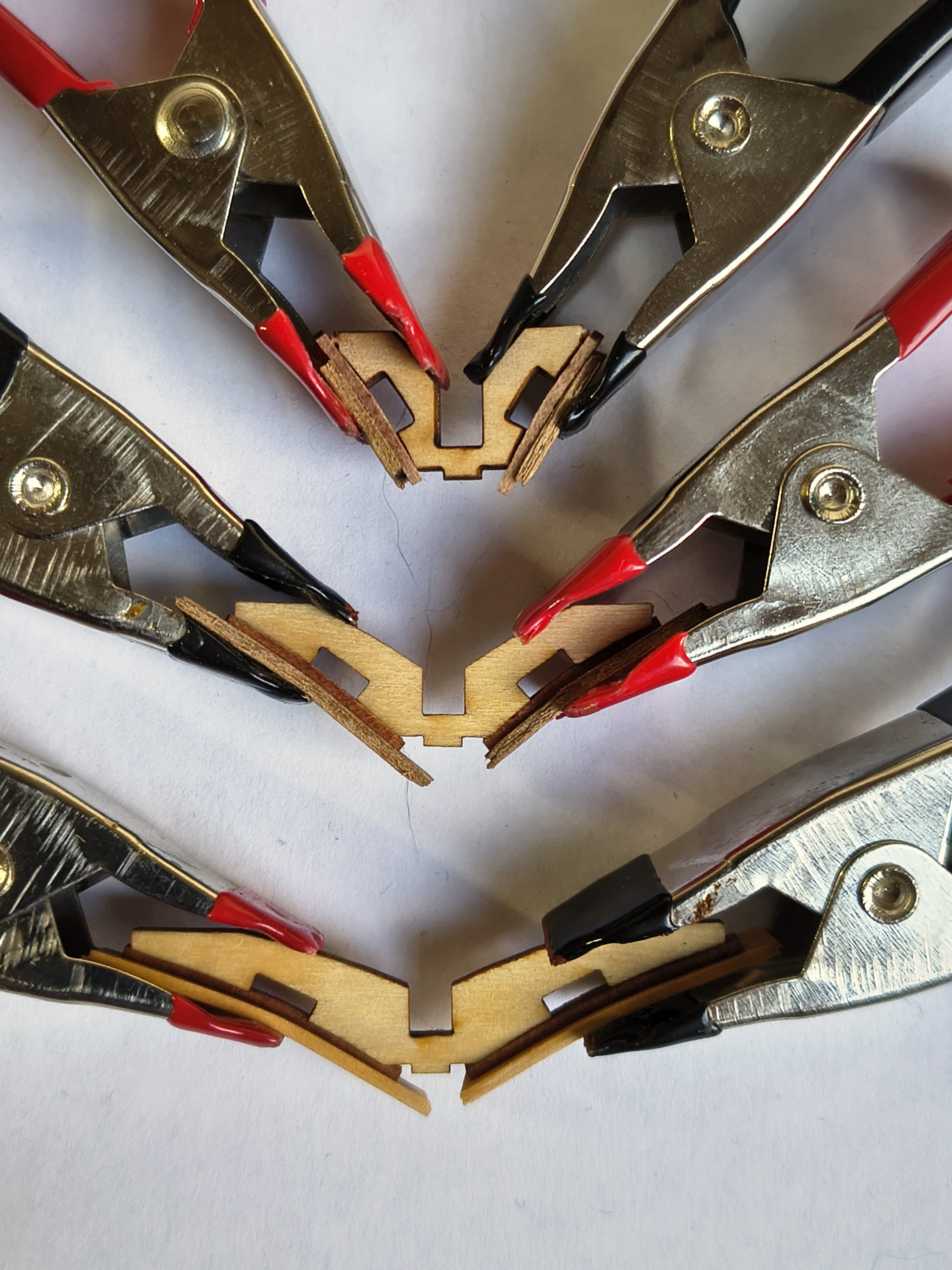

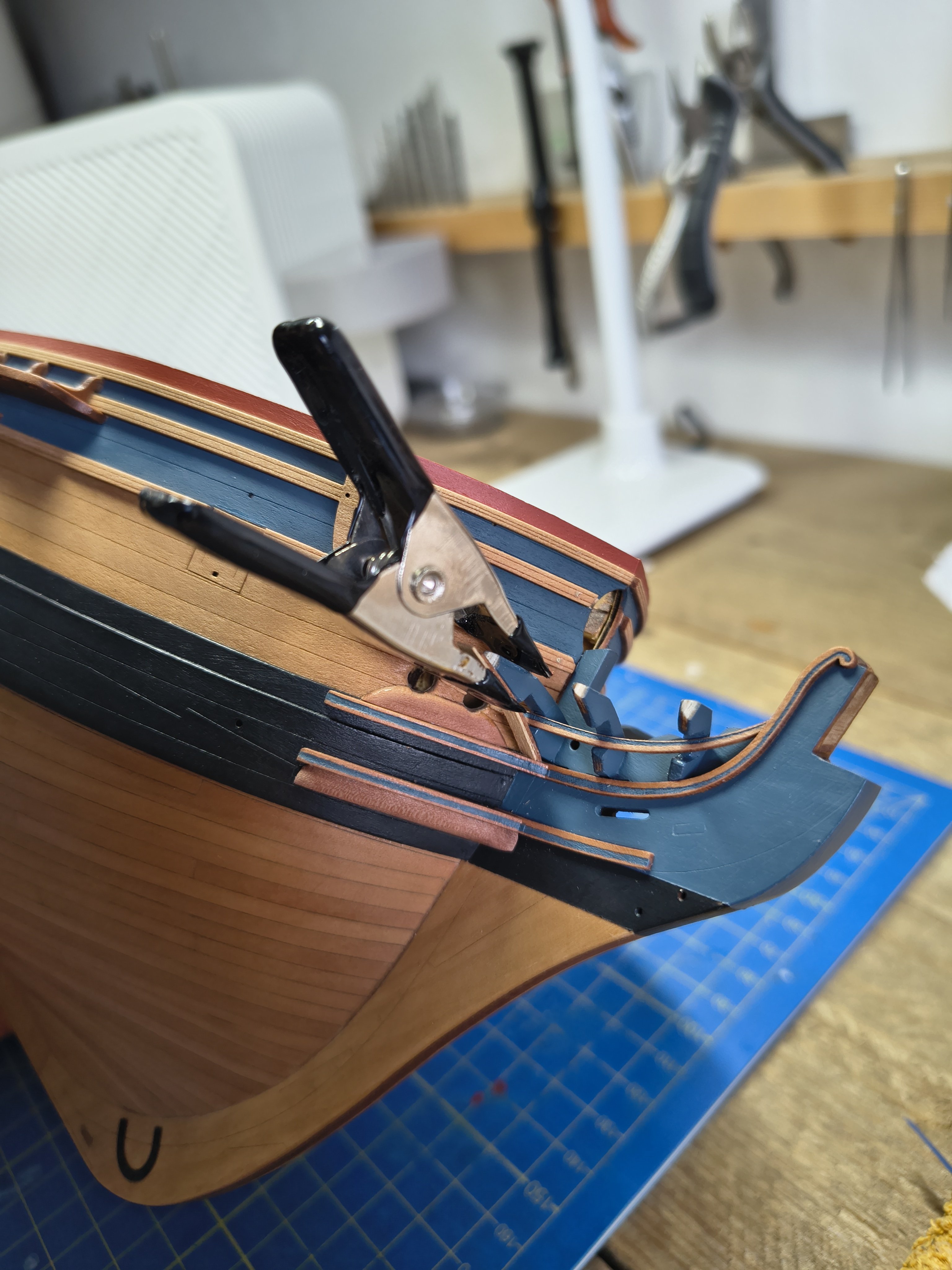

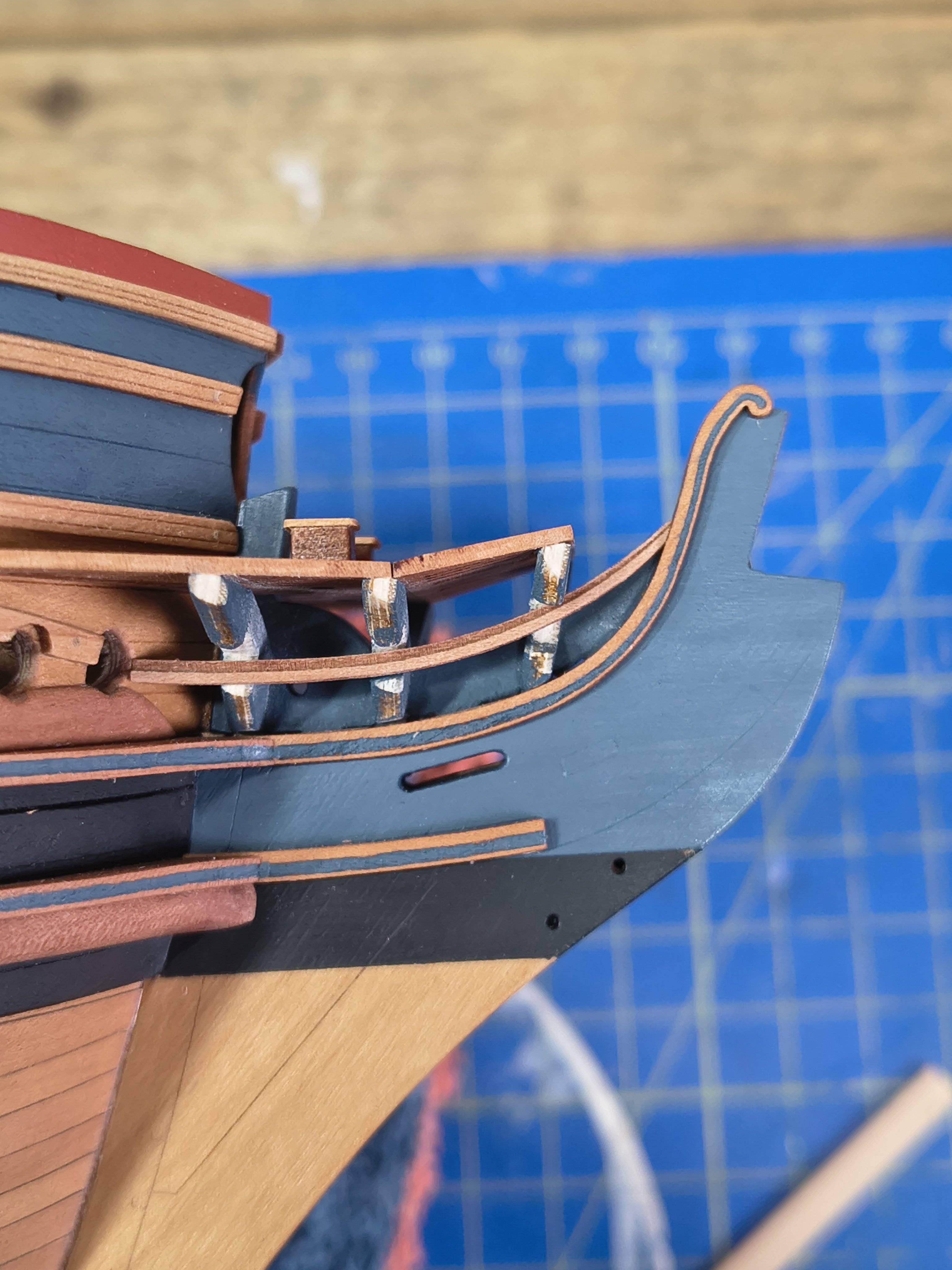

After I put the gammoning knee with the V-brackets back in place, I glued the lower bow rails with CA. I found this more practical and felt stronger because the contact points were so small.
The next step was to install the V-shaped head rail patterns (how does Chris come up with all those names,😆). First, I soaked them in some warm water (about 15 minutes) and then clamped them to the extra set of V-brackets Chris had provided...a second set is very handy (thanks, Chris👍). I'm not sure if pre-soaking was really necessary, since the curve is minimal, but I thought it might help with the gluing afterward.
The painting method was in exactly the same order as the "lower bow rails" described earlier.
By the way, before painting, I tried sanding the underside of these parts so they fit seamlessly with the lower bow rails.
(Not entirely successfully 🥲
Then I glued these parts to the V-brackets. This is where it was helpful that the gratings weren't on top, as this made clamping them until the glue dried very convenient.
However, gluing them wasn't easy...it took me several tries to get them reasonably secure. (I think it would be difficult if they came loose later, so I wanted to make sure they were secure.)
Of course, lastly, the gratings were glued back in place (with the cute "seats of ease":D) and that's the end of this chapter...

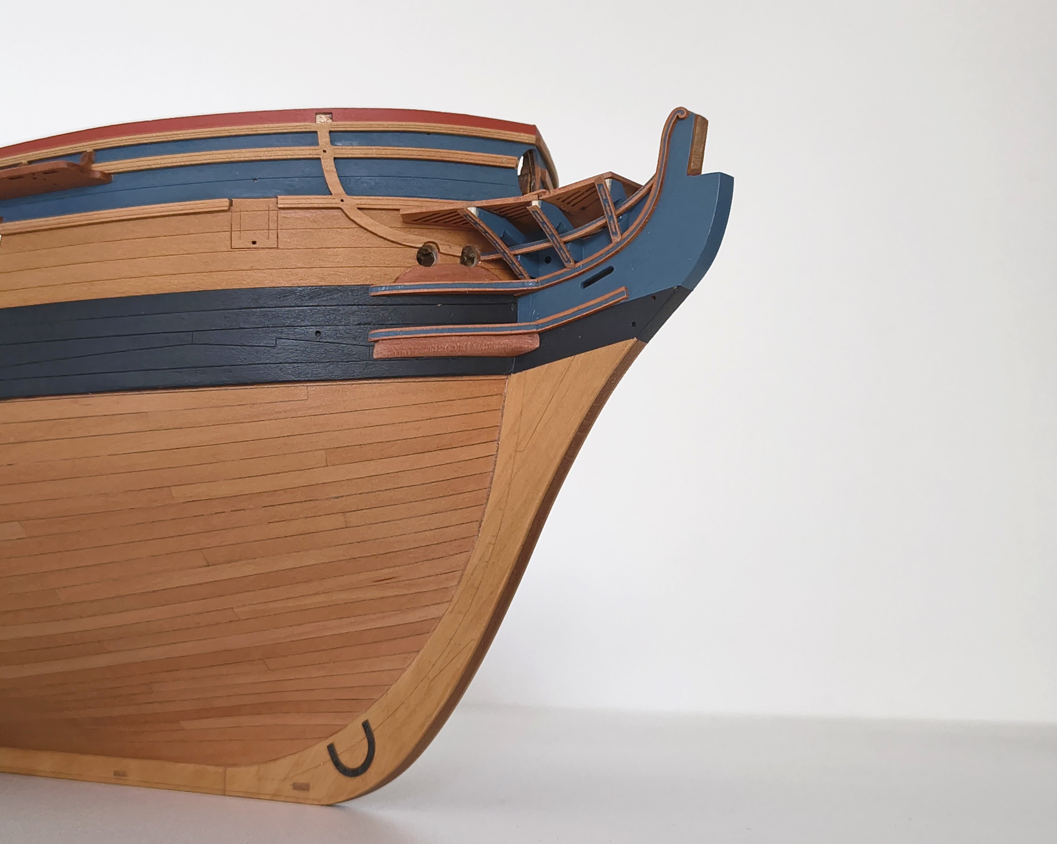

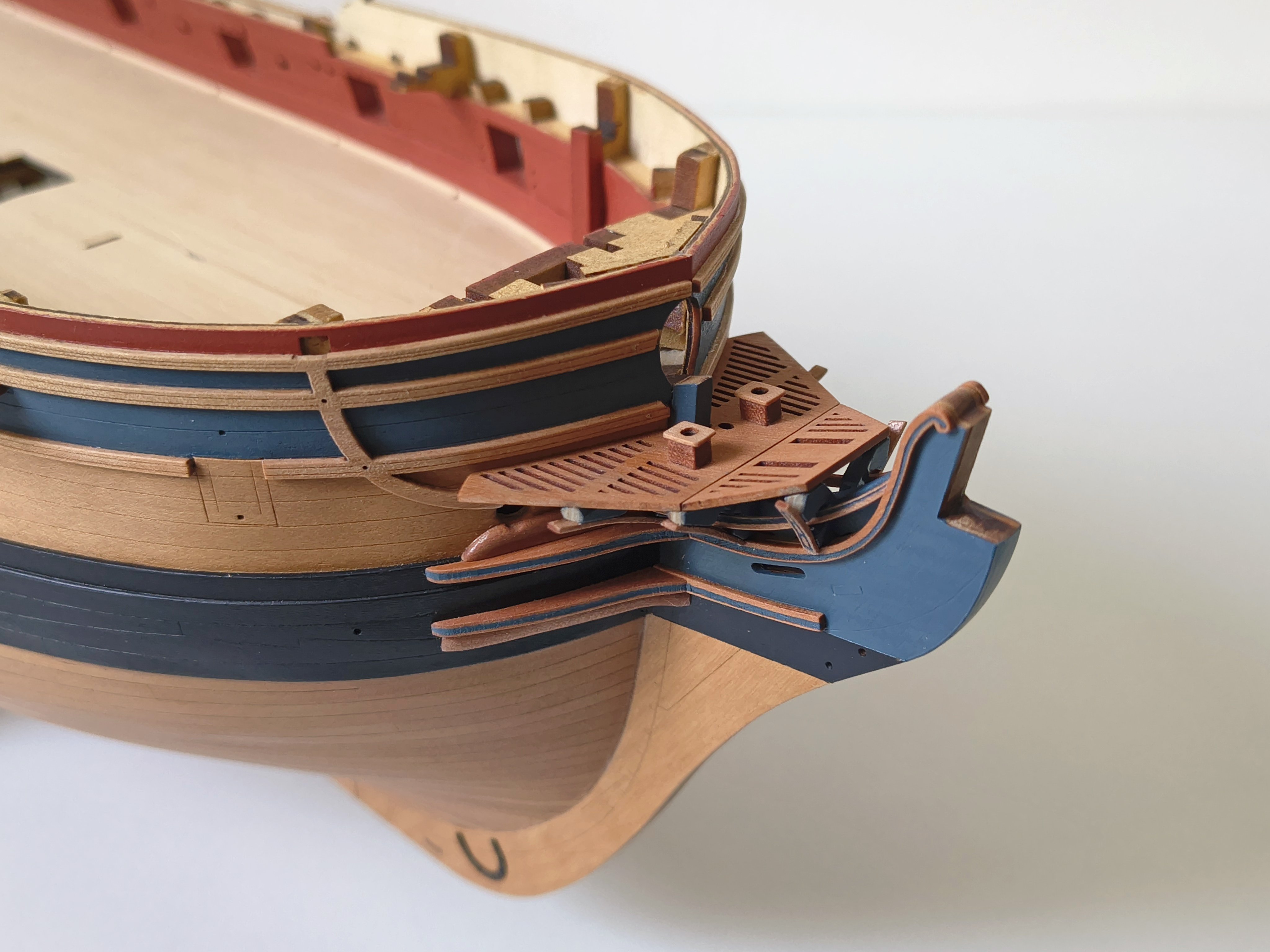

By the way, I haven't sanded the head rail patterns at the top to length yet, as you can see in the photos; they still extend beyond the V-brackets. This is how it looks in the manual, and I saw that they were sanded to size later. I don't think I'll sand them to the correct length until I install the bow main rail. Perhaps that rail will still have some influence on this.

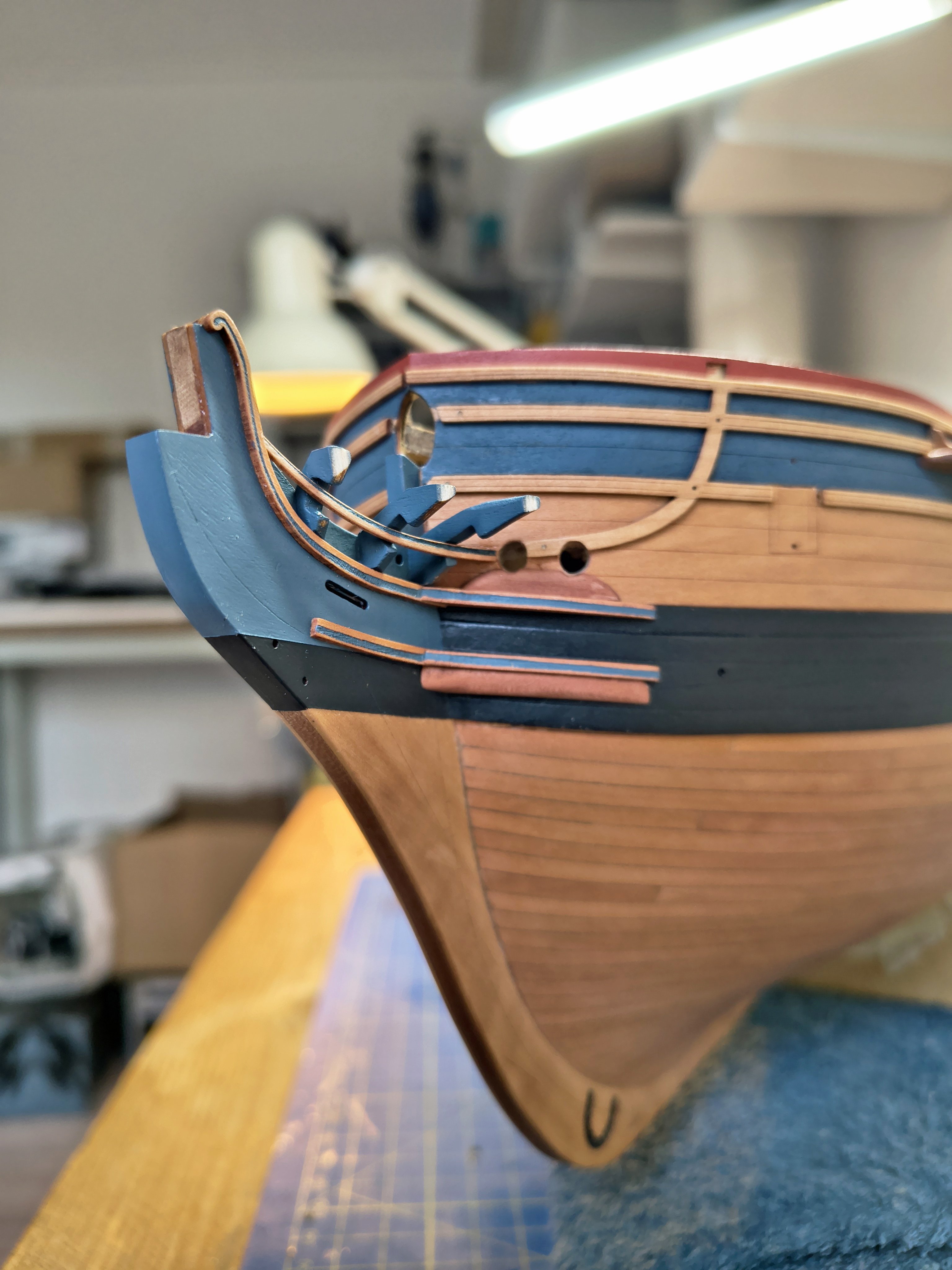

Here are some more photos...I'm happy with the final result! I didn't think it was the easiest part of the ship, but it all turned out well.
I thought this photo was really cool!
Edited by Ronald-V

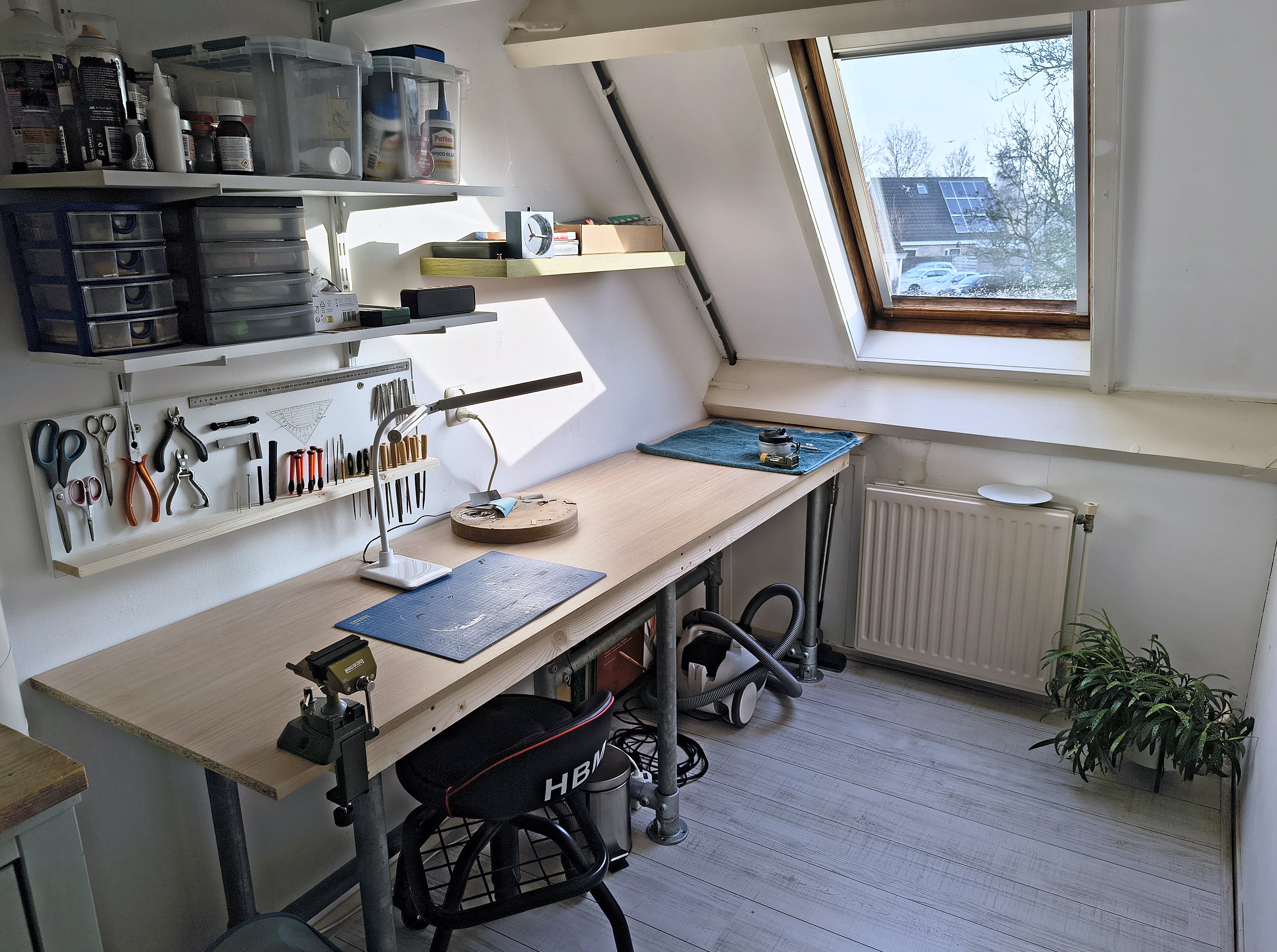

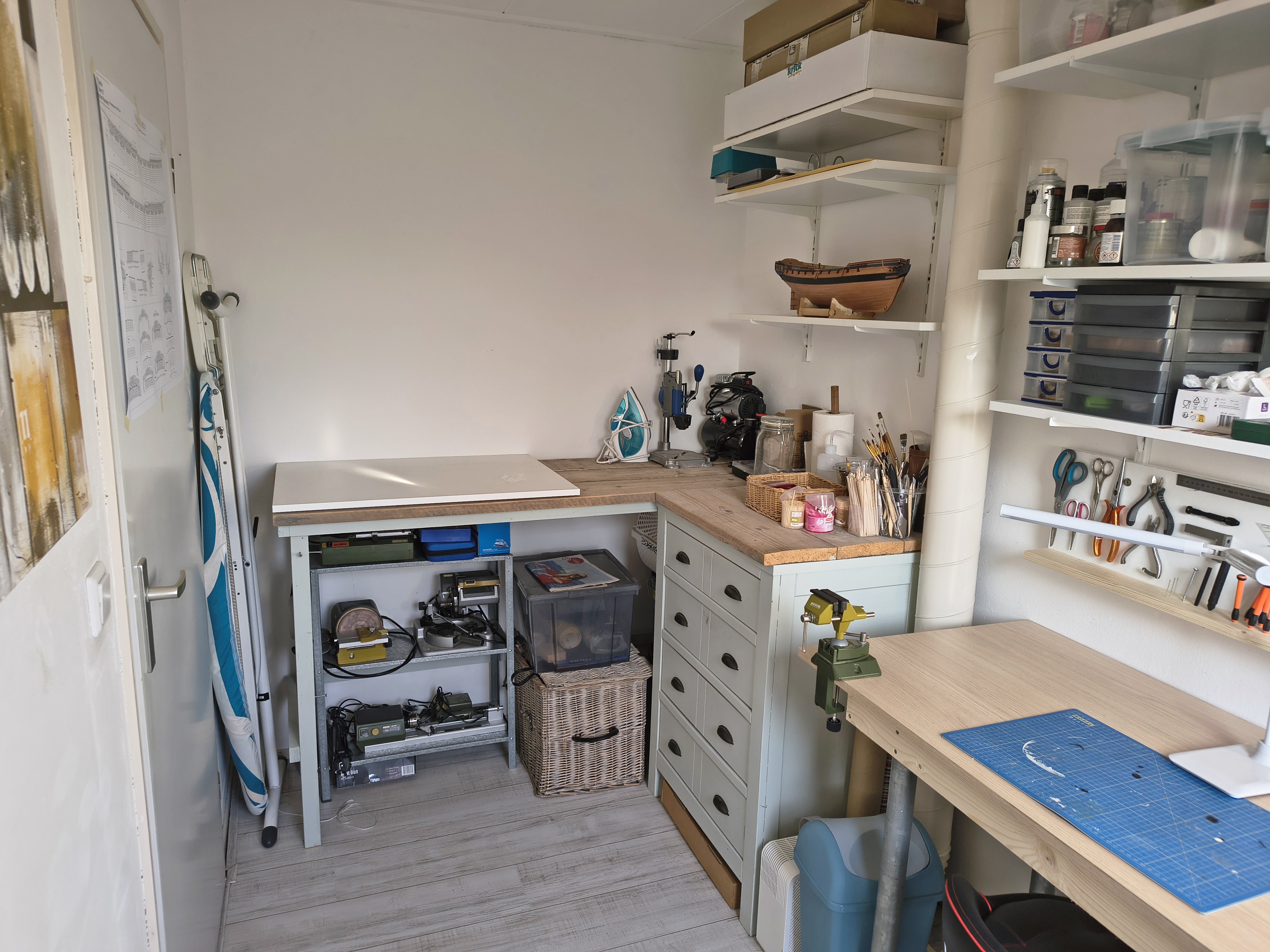

Not really an update, but a quick snapshot of what I've been working on. I've been busy cleaning up/reorganizing my house these past few weeks, and the hobby room was definitely in need of some work. I had a lot of stuff in there that wasn't hobby-related and was taking up a lot of space... I cleared everything out and moved it, and now I'm really happy with the space I have left! I also rebuilt the work table (it had rather uneven scaffolding planks and therefore wasn't perfectly level), making it a nice, long table (2.4m). I'm currently waiting for a magnifying lamp I ordered, and then I'll have it pretty much complete. It's not a large space, but it's enough for what I'm doing.
Now I can happily get back to working on the Sphinx!

Fantastic workshop Ronald-V and I understand why you sorted it out so well.  Part of the enjoyment of ship building for me in my workshop is the fact it's very organised and tidy.  It's just a nice place to be when doing our favourite hobby and yours is the same.
Man - oh - man!   I wonder how many days it would take me to clean and organize my shipyard.  I love your, a place for everything, and everything in its place approach to your workspace.  In particular the small hand tool organizer you have on the wall above the bench.  I'm tempted to take a few days off to follow your lead.    Thanks for sharing and the inspiration..
Merry Christmas and Happy New Year
Thank you! Yes, absolutely...and it's best when you've just finished a construction phase and then you can tidy everything up and put it back in its place. So satisfying 🫠😁
Thank you! Yes that is really simple to make and I have always enjoyed having these tools within reach, but also not laying on a pile in a drawer.
And wish you ofcourse also nice days!
Edited by Ronald-V

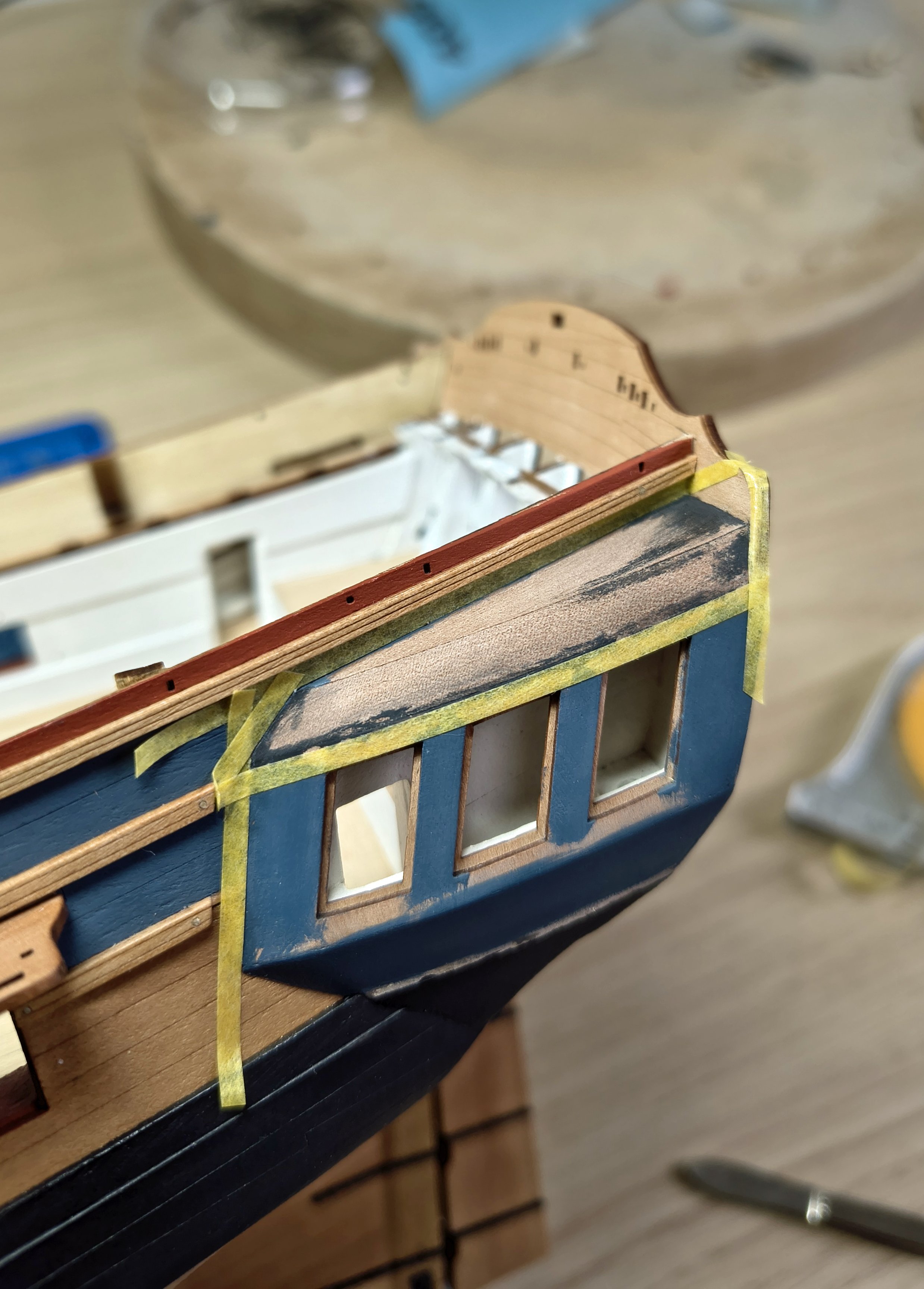

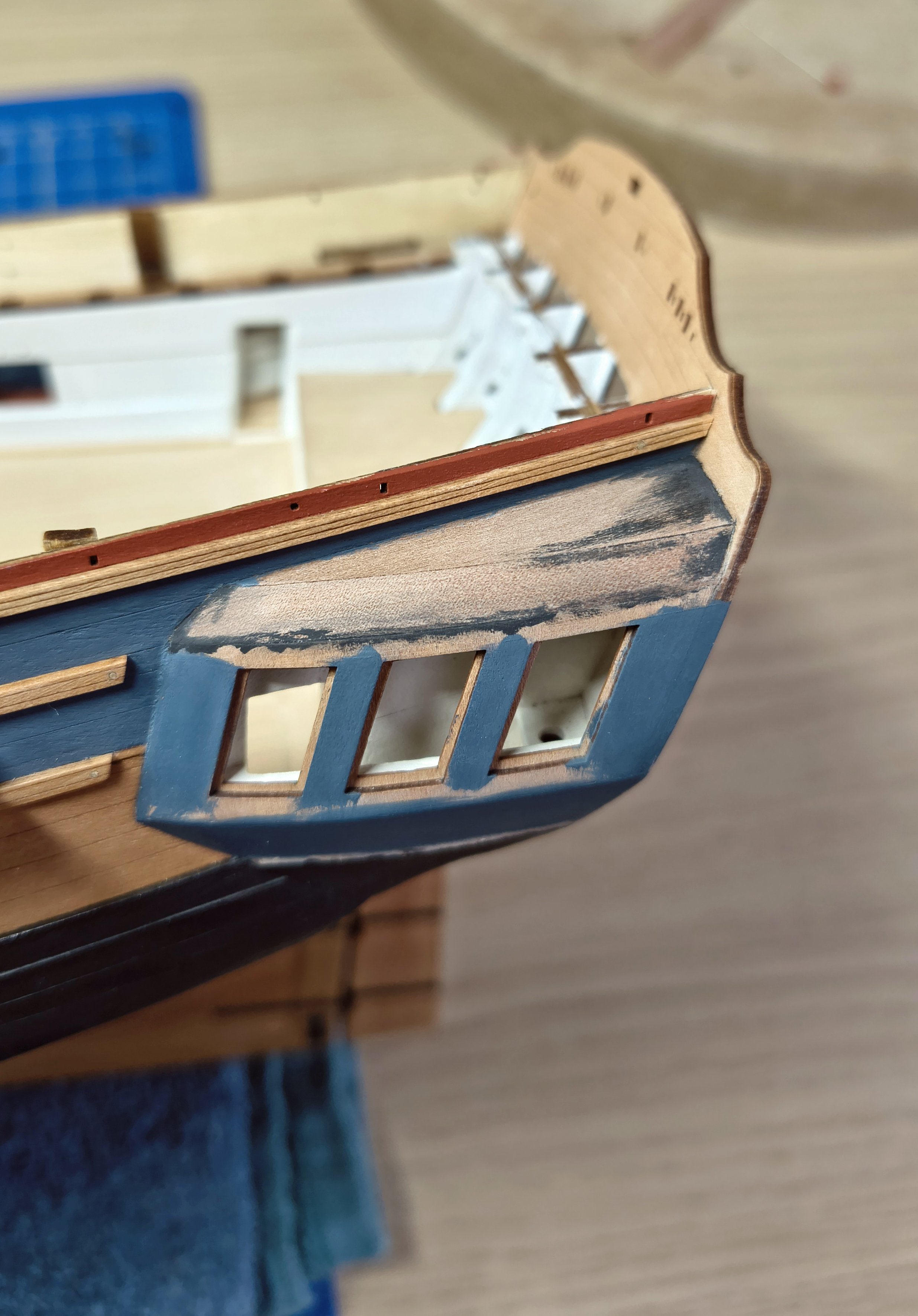

But first, I need to paint the roof of the quarter galleries. I tried it with a brush first, just for convenience' sake...but I found it wasn't working well. It looked streaky, and I found myself struggling to paint a straight line. This was partly due to the odd angles of the roof. There's nowhere to rest your hand properly to prevent it from shaking. So I decided to sand the paint attempt and then attack it with an airbrush.
First of all, masking...I have different widths of tape for this
I'm using Vallejo "black grey" 185 as the color here...the kind of lead color I was going for. It could probably be a bit lighter to make it look truly lead-like. But that could be done with highlights later.
I'm quite pleased with the result, nice and even. There's some bleed-through here and there, but nothing that can't be touched up with blue paint, for example, or scraped off the bare wood. The angled section will be covered with photo-etched lead tiles later, so that will be covered. But if any wood is visible underneath, at least it'll be the same color underneath.
Starboard in particular had quite a bit of bleed-through, I had already painted this earlier and then masked it off somewhat hastily...it really pays off to take your time with this :) , port side was already much better.
Of course, everything will be neatly finished with either photo-etch or wooden decorative strips.

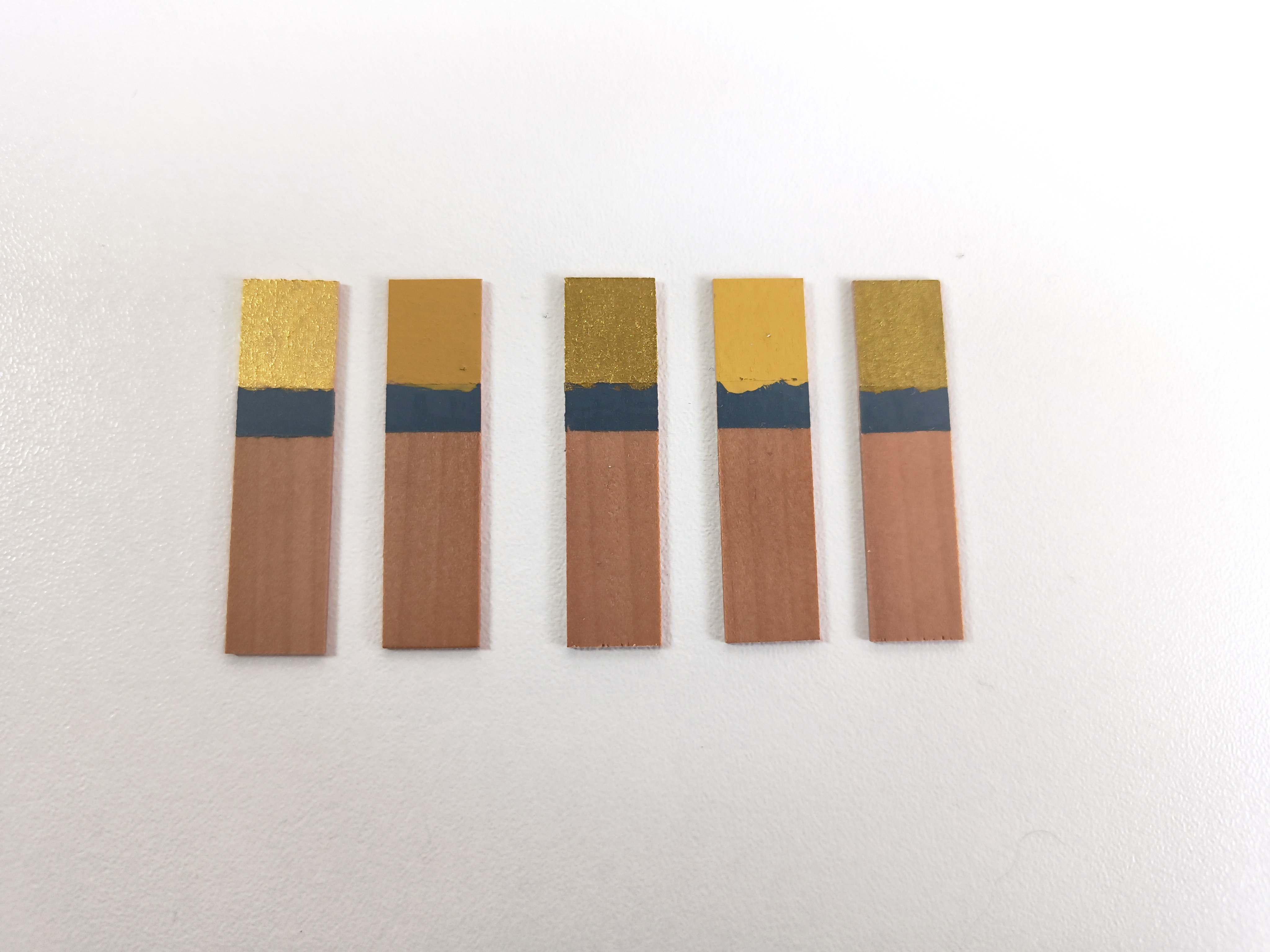

Okay...the color choice for all the decorations. I already had in mind that it should be some kind of ochre-yellow or gold. This seems to me to match my hull color best, the soft, slightly dark pearwood. I personally like a look where everything is somewhat cohesive and not too much stands out. I'm not really into anything too flashy. I certainly liked the gold James used in the prototype, but after testing the pieces below, I discovered that it doesn't go so well with my ship and the colors I already have. It's a bit too flashy. I ended up with Vallejo "Gold Brown" no. 158 (second from the left). This, combined with a rusty (brown,red) weathering stain, gives the decoration some depth and three-dimensionality. Perhaps some highlights, but I'm not sure about that yet. I've already done some test pieces with this color and stain and was quite enthusiastic.
I'm glad I picked out a color so I can really get started now, starting with the windows :)
