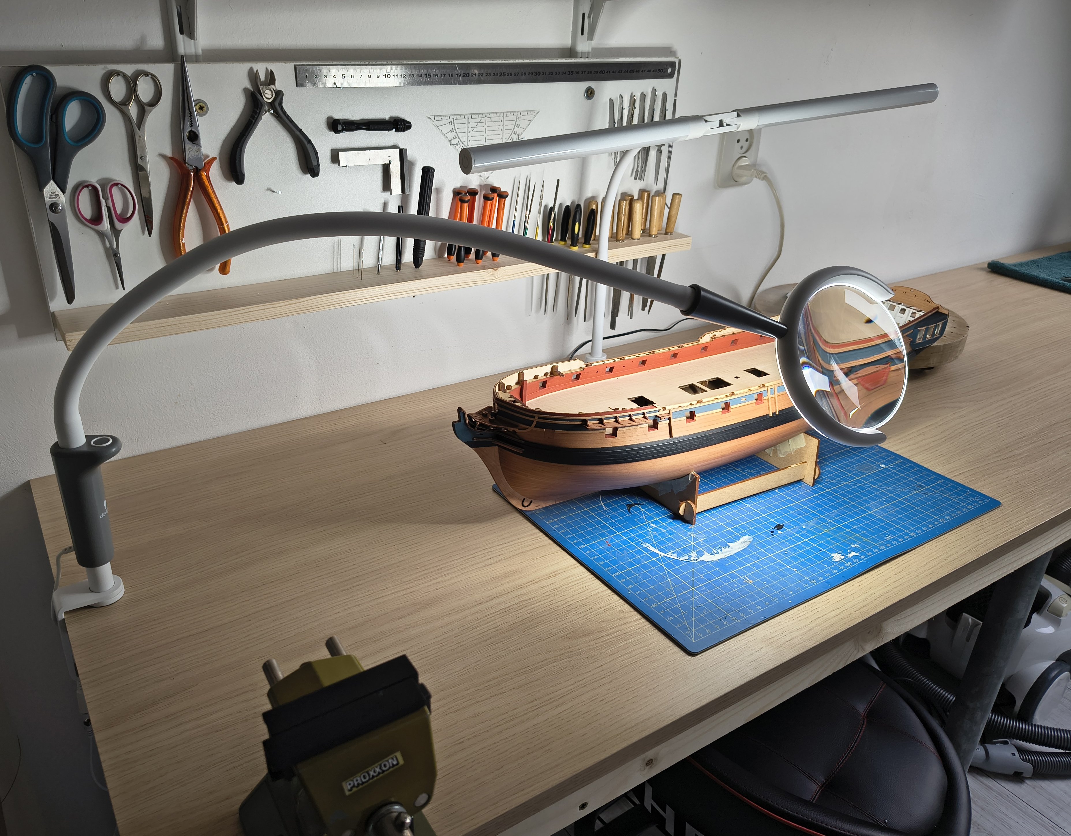

Thanks Frecap! Yes color choice is not an easy task, because it can make or break a model in my opinion. We will see how it's going to turn out...will be exciting!
Just received this. I've been looking for a good magnifying glass for a while. I always used a headband with a small magnifying glass over my eyes... but what I always found annoying about that was, for example, when I was painting, it was nice to have a magnified image while painting, but as soon as you had to dip your brush in the paint pot, you always had to look past it to avoid getting cross-eyed and nauseous, haha. Now I've tried a few standing desk magnifying glasses, but I found them all too big and bulky for my narrow table. And this one is just right, magnifies well, has nice "daylight," and a flexible arm. I know it's a good brand because my mother, a painter, has been using a larger version of this brand for years. They're not cheap (in my opinion), but quality comes at a price. :)
I like the idea of it, especially the part about being able to look away from what you're working on and having that in focus. But it seems to me that if you are moving between areas that you're working on, you've got to move the magnifier.  Also the box does not indicate the level of magnification. I know in my case I'm using pretty strong magnification on my Mr Magoo glasses. Still worth investigating. I'll look it up. Let your fans know how it works for you.
Edited by Der Alte Rentner
It's 1,75x magnifying...for me that's more then enough :)
I get your point on moving around, but then I can always use the headband with the magnifying glass. For me it was the point of a stand alone magnifyer so I can work on a particular spot without seeing everything around me up-close :)
