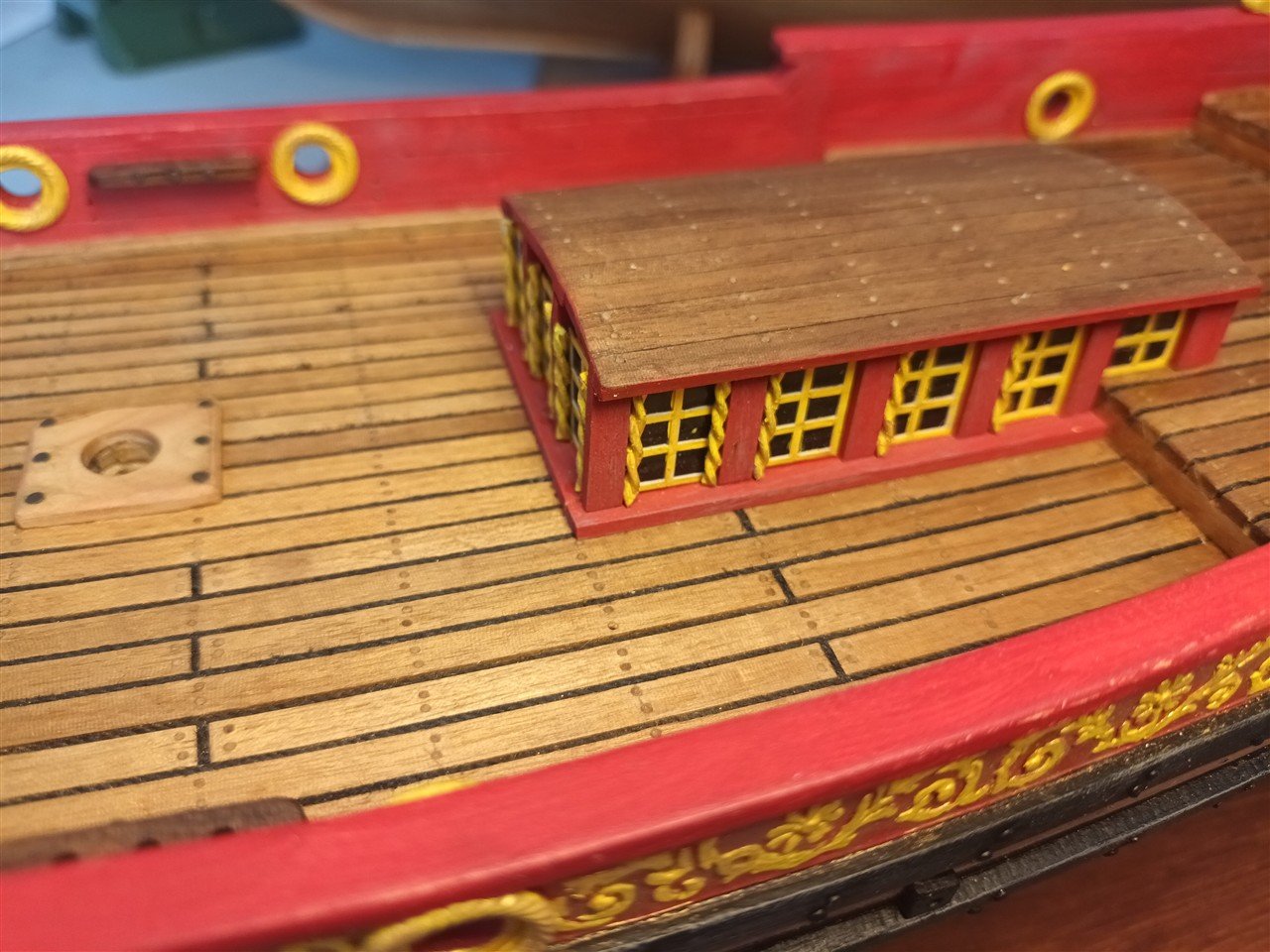

Thanks for the comments and pressing the like button.
Started building the pavilion (hopefully the right name)
This is bigger than the original. And some windows have already been used elsewhere.
So a new batch of windows is being made. The first ones in wood were disappointing. So they are now made in polystyrene.
20250217_124751_1280.jpg.822a4c8c587e4c7ba97b69bb27e9d864.jpg20250219_092511_1280.jpg.602badcf01233d3e795c8b93c9108224.jpg
Pre-painted windows and wood.
Assembled.
And provided with a roof.

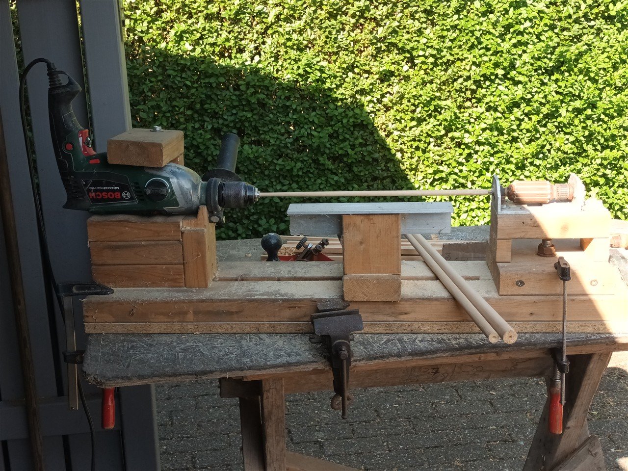

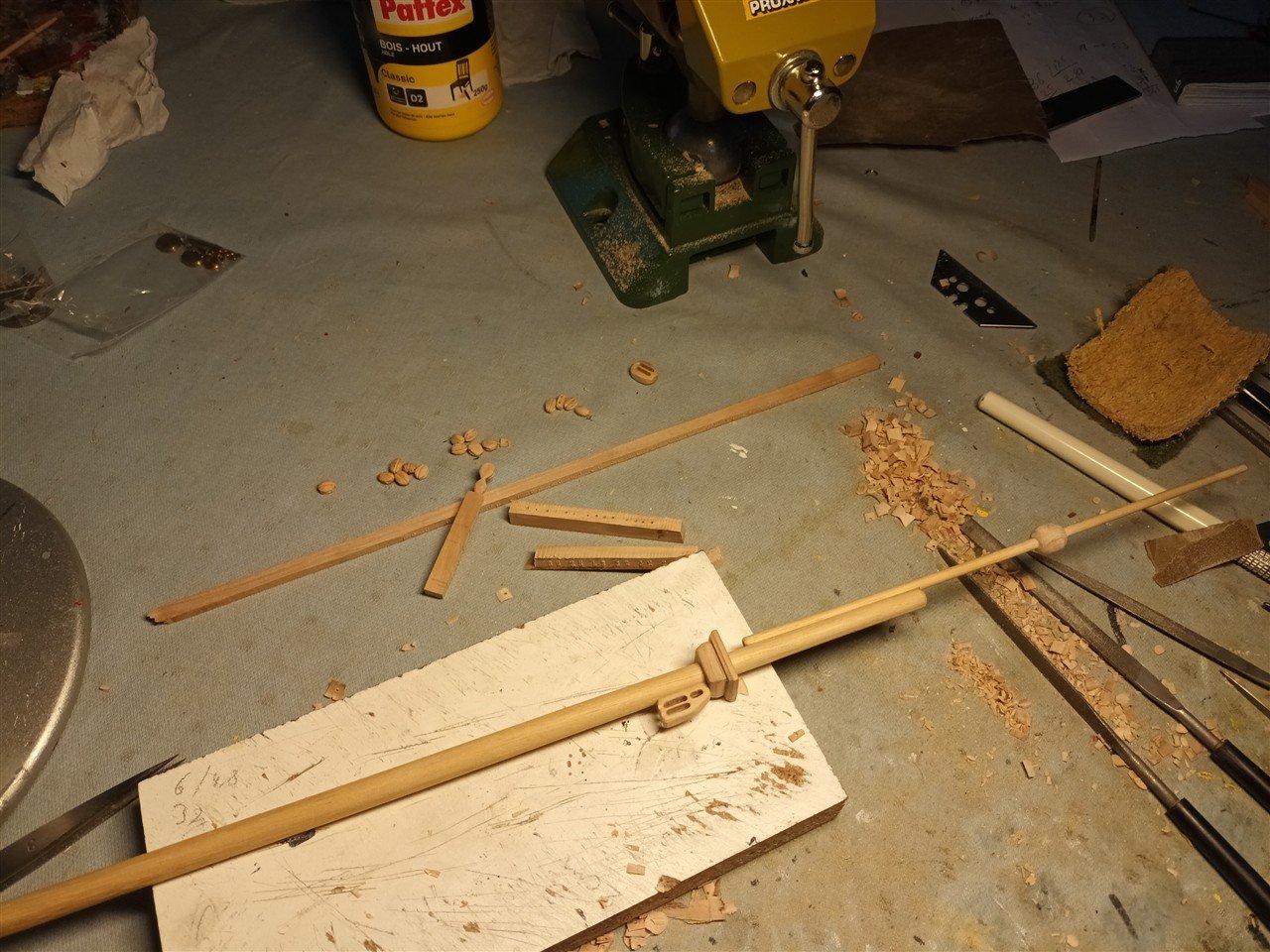

Small update,
Nice weather to work outside.
So the "lathe" set up. Own construction, not a pretty thing. But it works 😇.

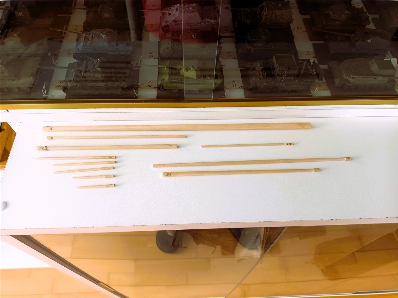

All mast parts and yards are "semi" ready.

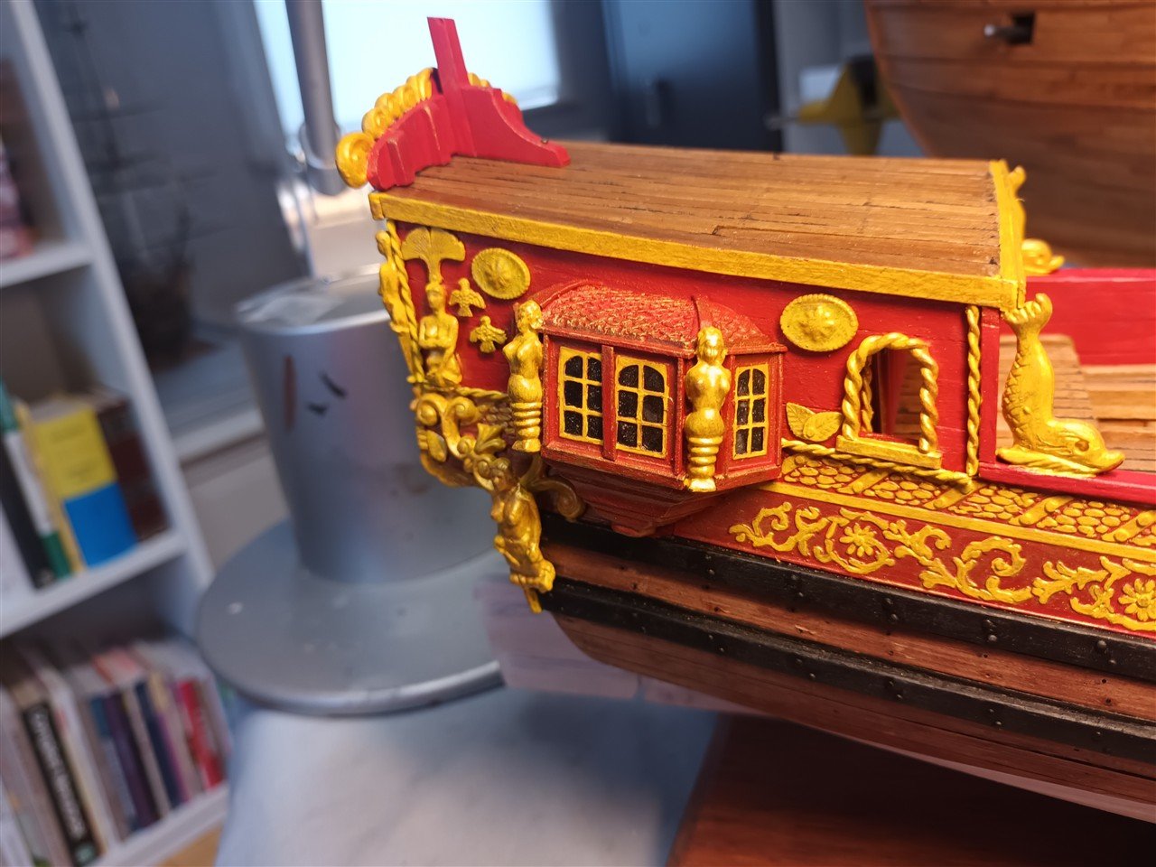

Needed a little break from the Mary Rose. So, the Corel yacht is back on the workbench.

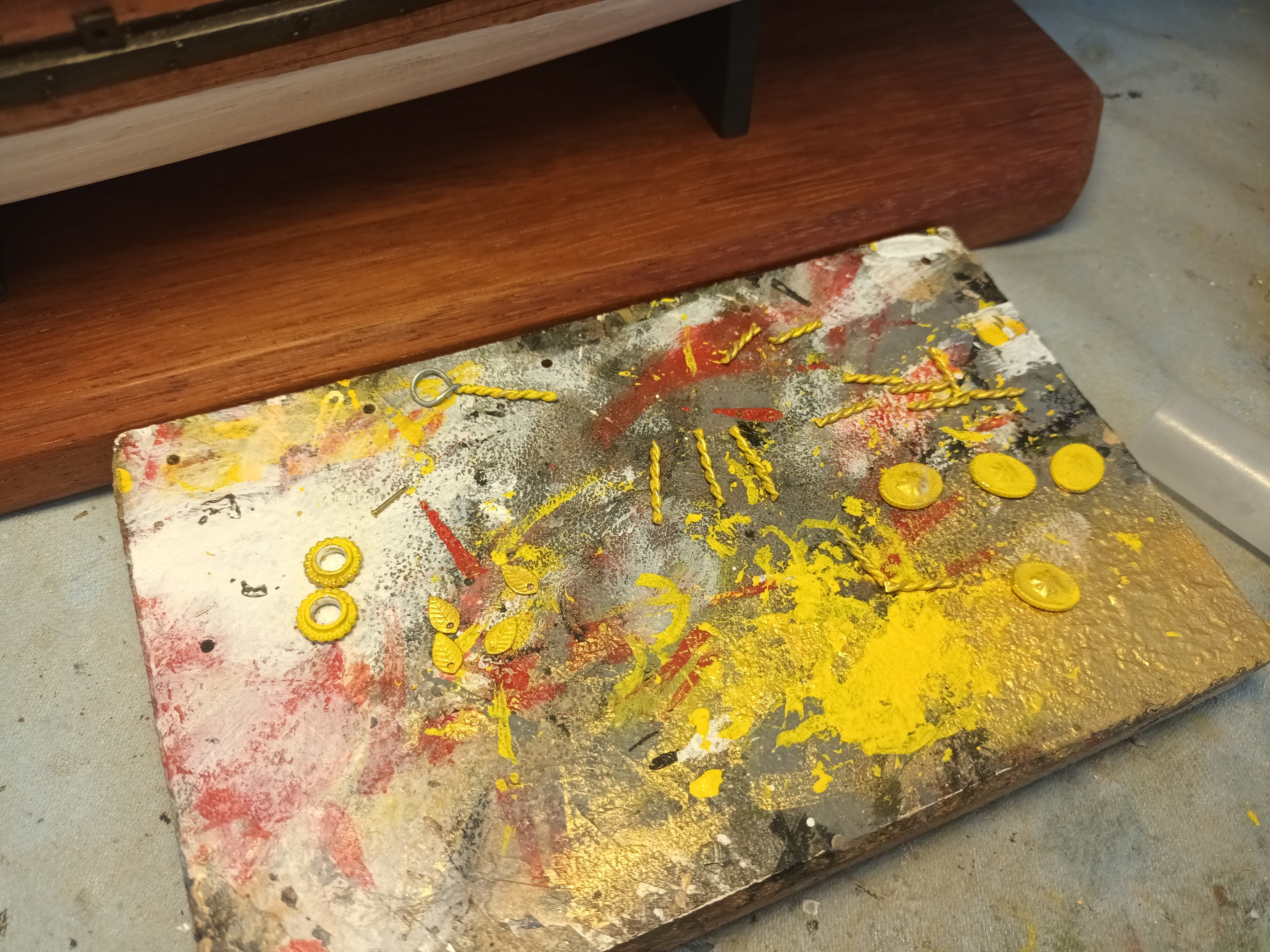

First job: adding some more decorations.
Work in progress
20250908_105728.thumb.jpg.49987bdbeffa55a7615a5bdaa8c45afd.jpg20250908_105733_1280.jpg.019391a04c36cfcb7f425385e97a3113.jpg
Ready
20250911_133741_1280.jpg.4ada3bc9a8d4c205aee9fb7d5c1cf28c.jpg20250911_133808_1280.jpg.17e7143797c6a93d107b3b942f499b60.jpg20250911_134212_1280.jpg.7f6a588785b650c5b251c9a793fabd2b.jpg

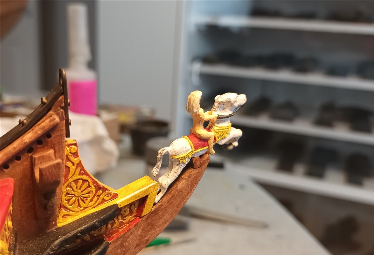

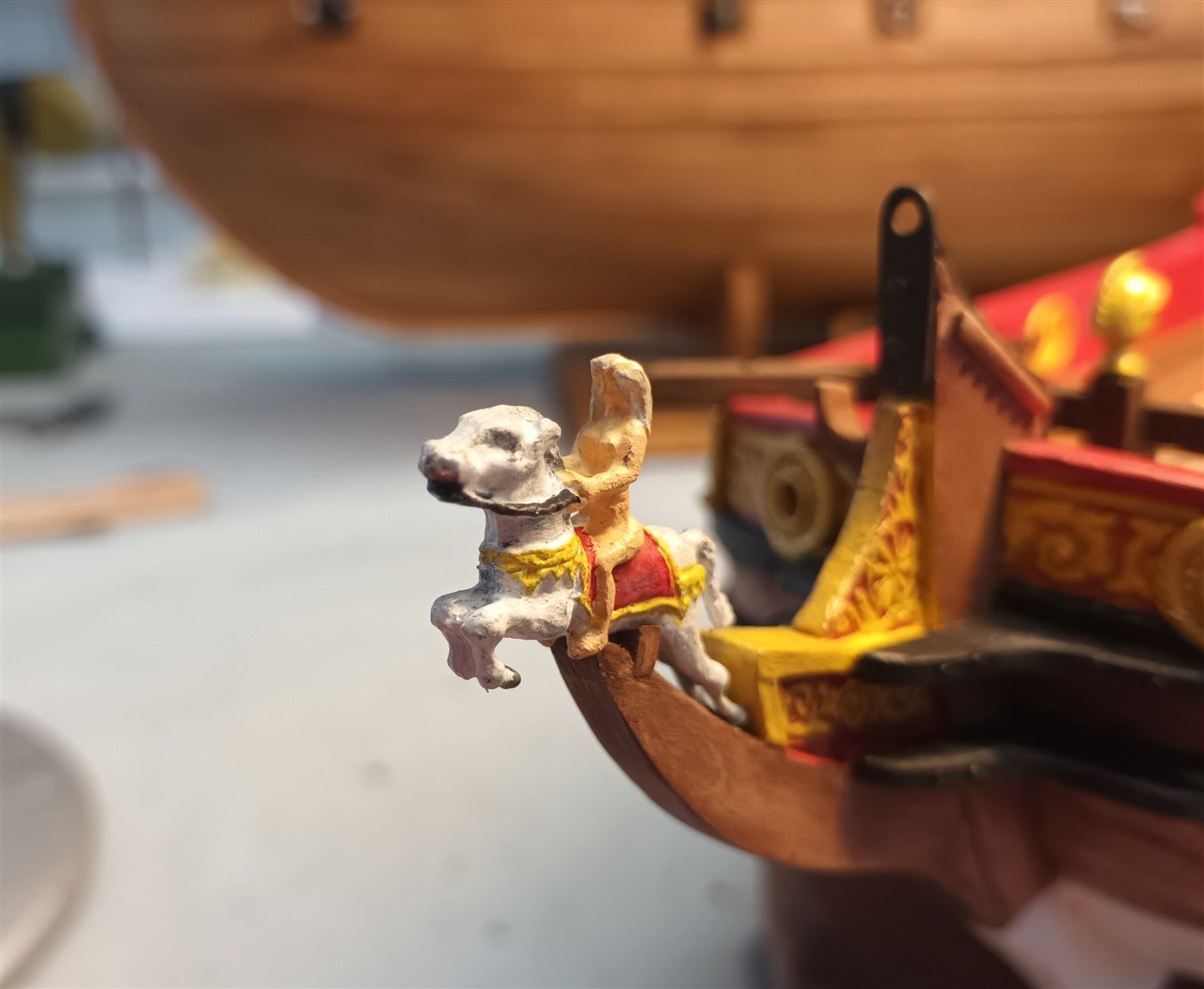

Figurehead painted and installed (looks like Lady Godiva...)
20250911_134242_1280.jpg.722cb1cb9bb66b10667f82f9bdaf7af7.jpg20250911_134308_1280.jpg.2026df248e7780ced3716c283462bc32.jpg

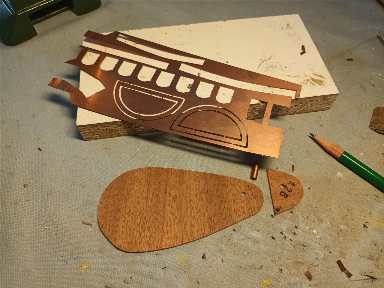

The "zwaarden" in Durch (English: boards??)
The kit parts are very basic. So, new ones need to be made.
The attachment points on the hull.
Painted
Utrecht replica
Model
20250915_153955_1280.jpg.6e79631a3119b511f84438c710f01786.jpg20250915_154004_1280.jpg.d5c05c482835219d6e9f30c09b68f3d2.jpg

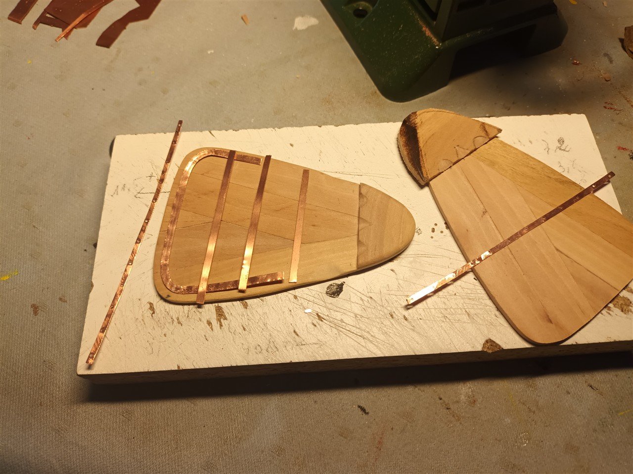

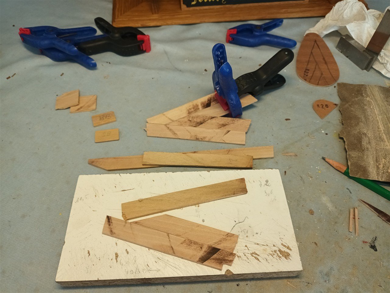

The new "boards"  under construction
20250912_092157_1280.jpg.d57224554ce0ccc1d7d8100c21743f6e.jpg20250917_085809_1280.jpg.ba64dea1ed03bdb560f3b4daf5089d4a.jpg20250917_085737_1280.jpg.f8b881f69e208853ce68abb59f87903d.jpg

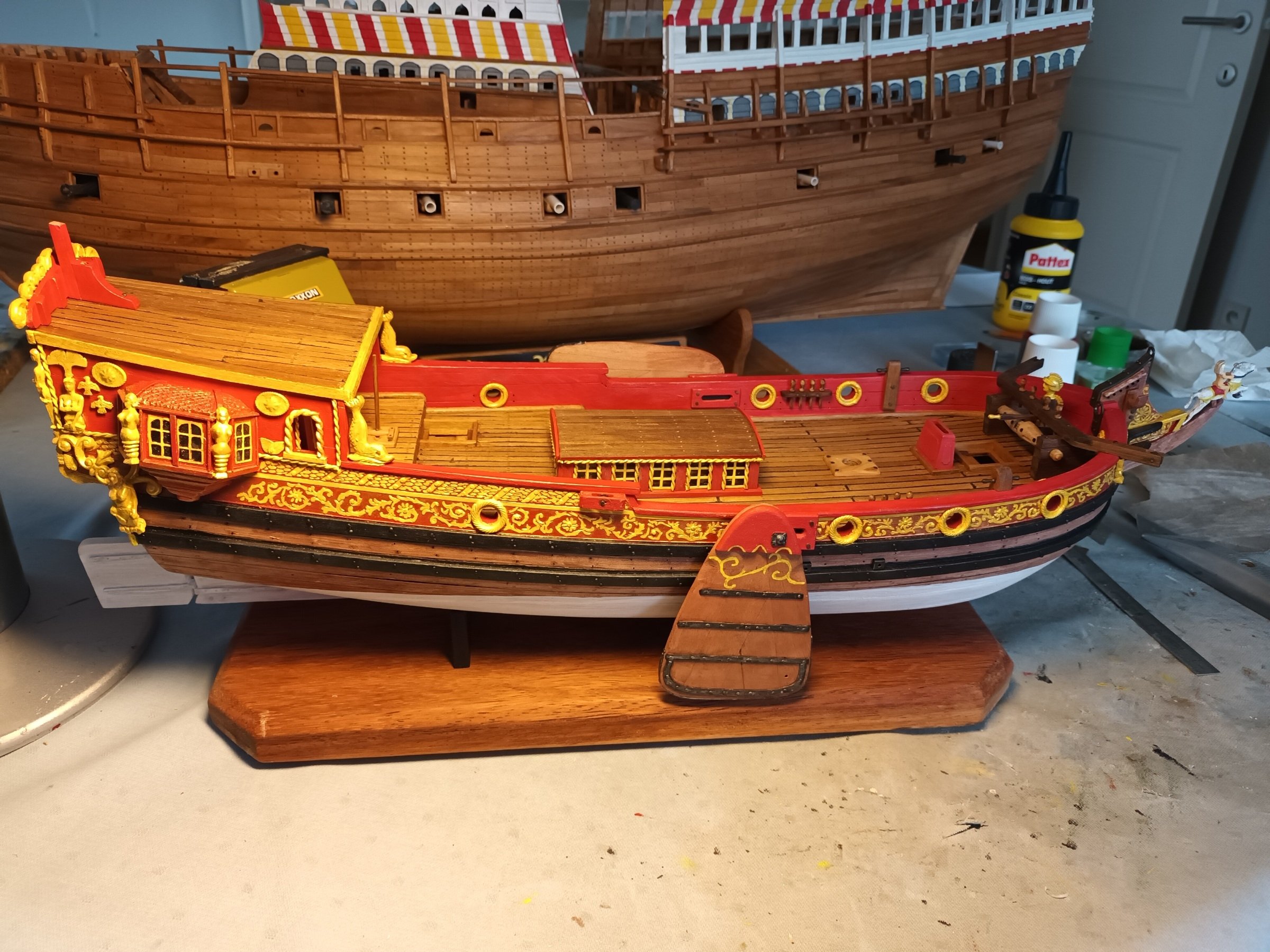

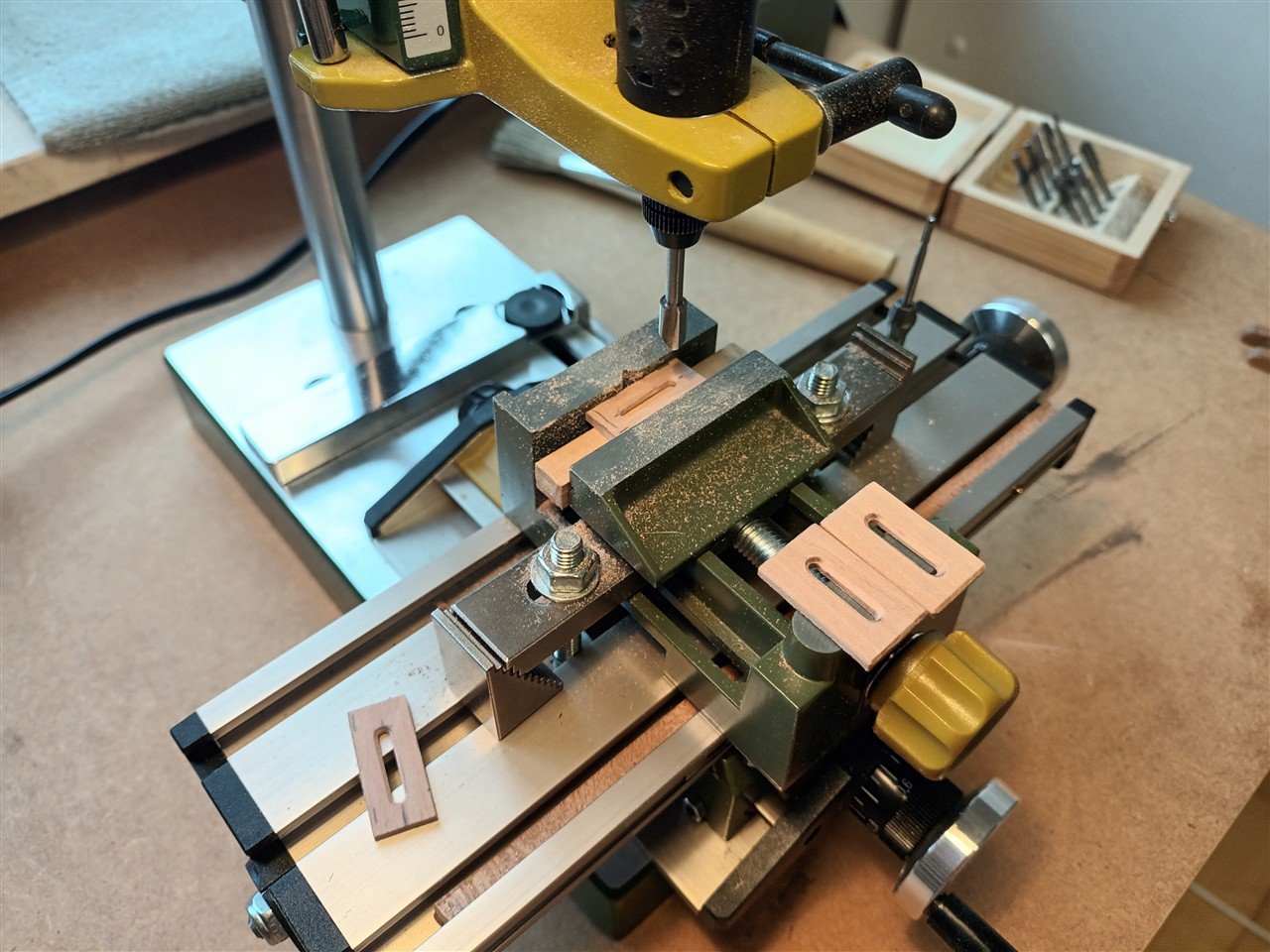

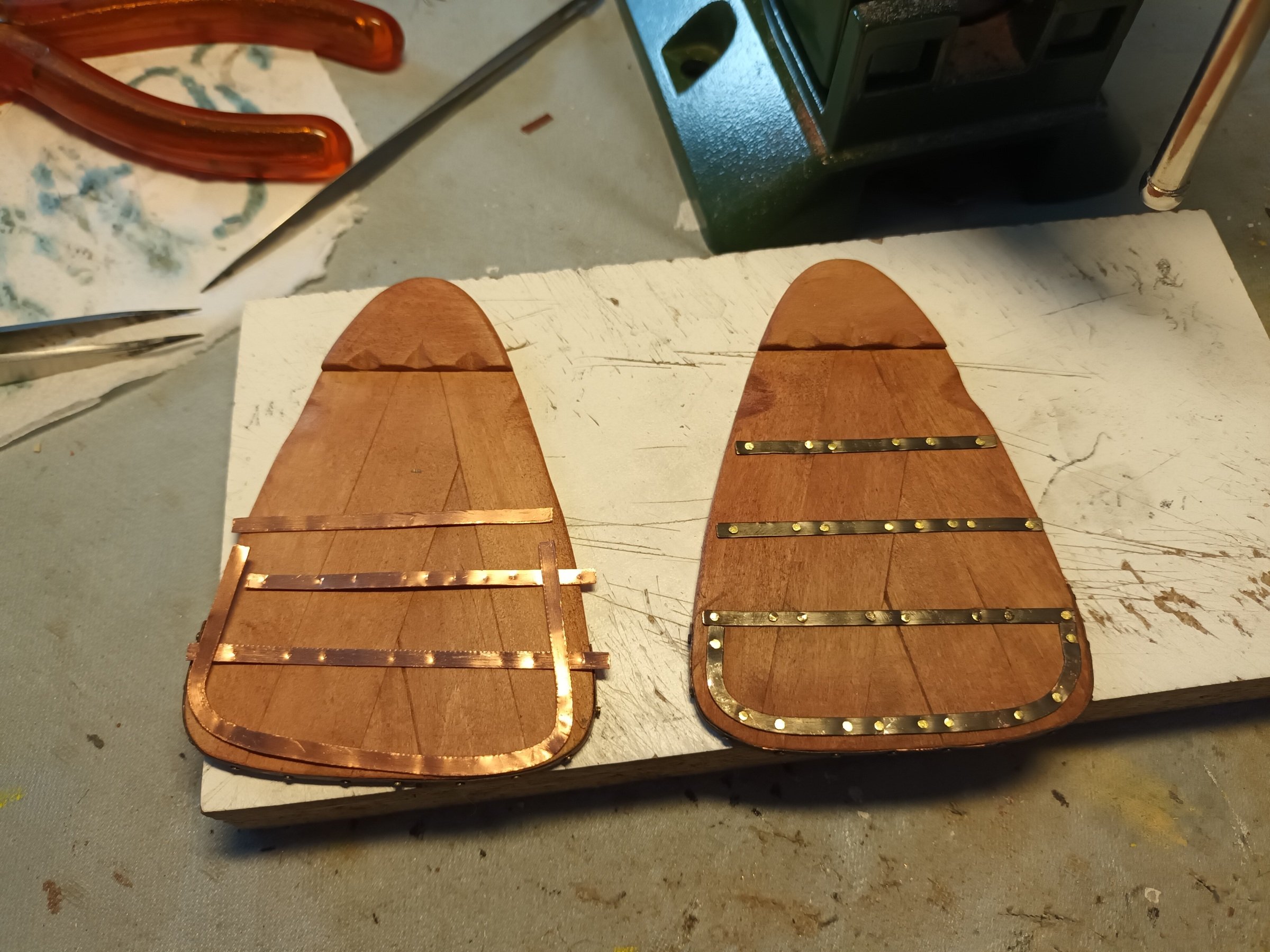

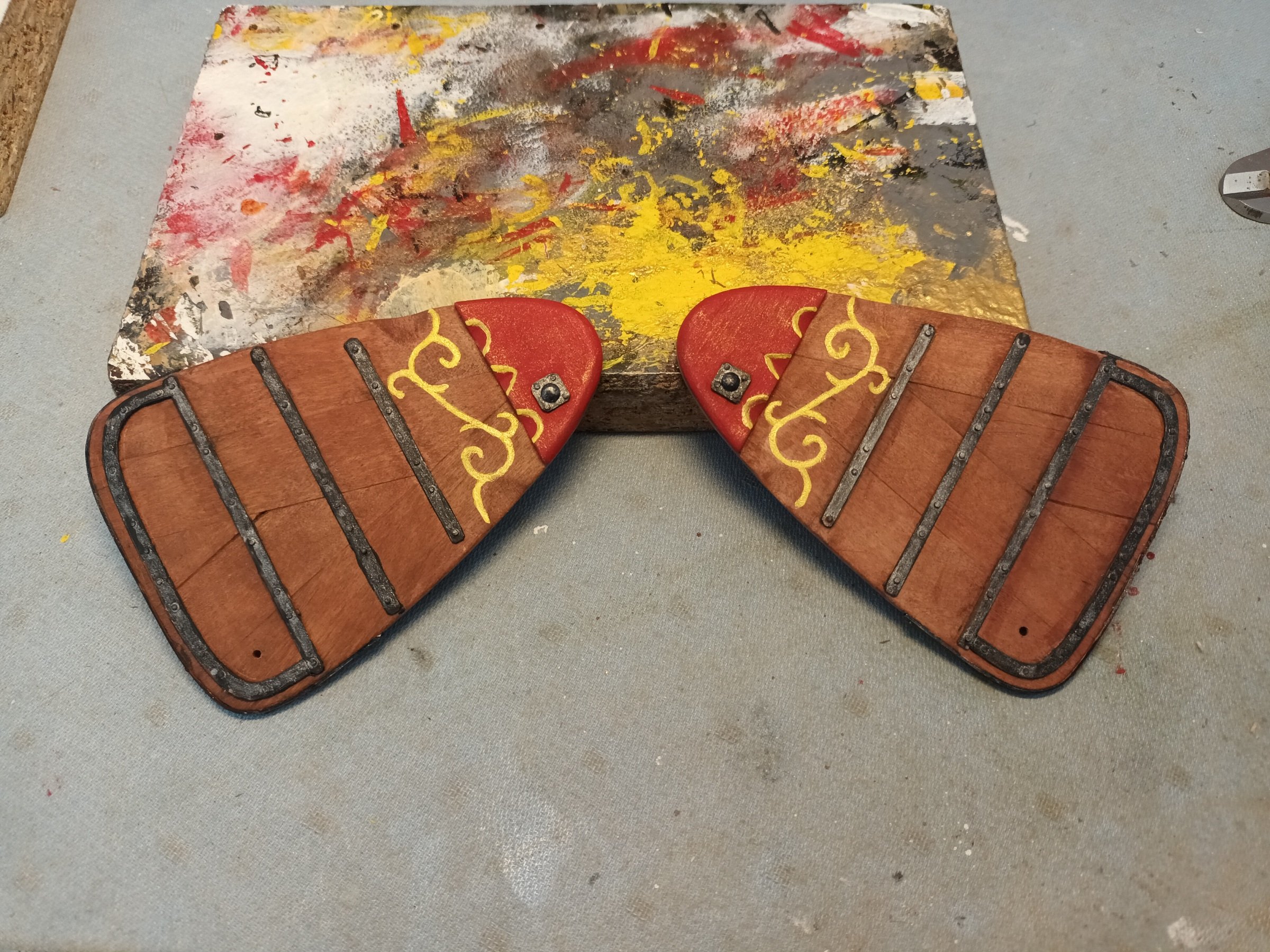

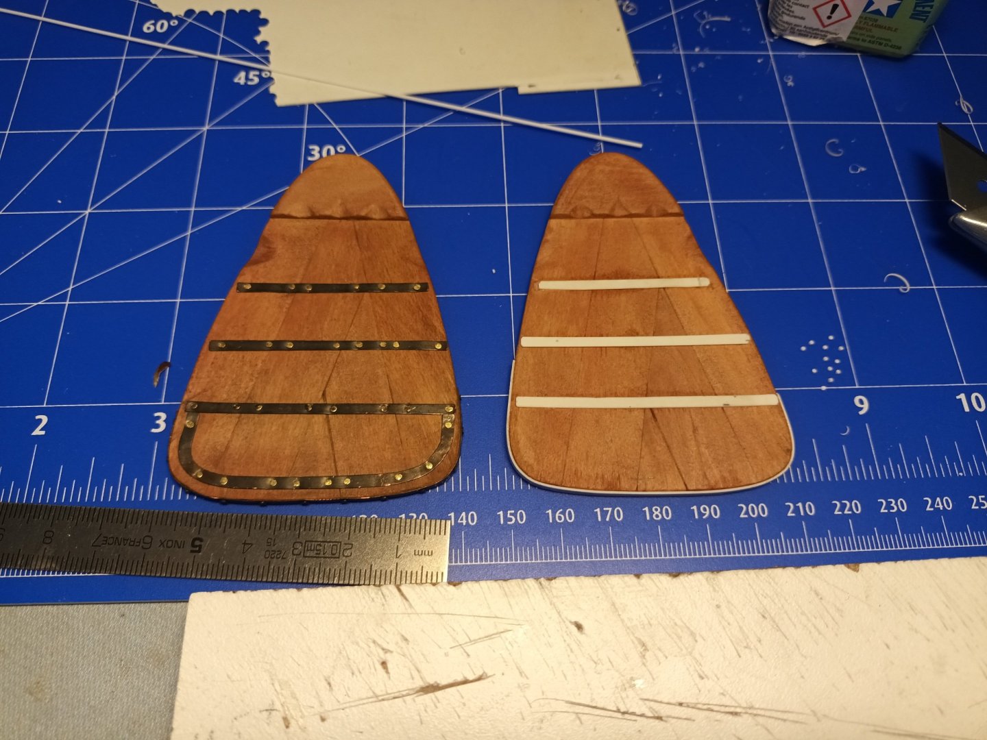

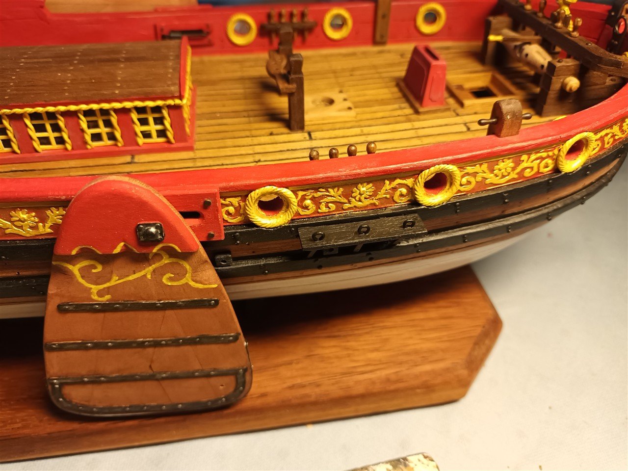

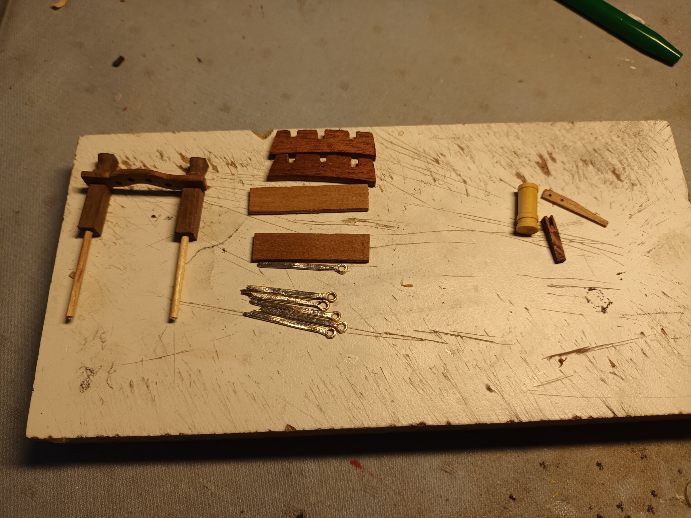

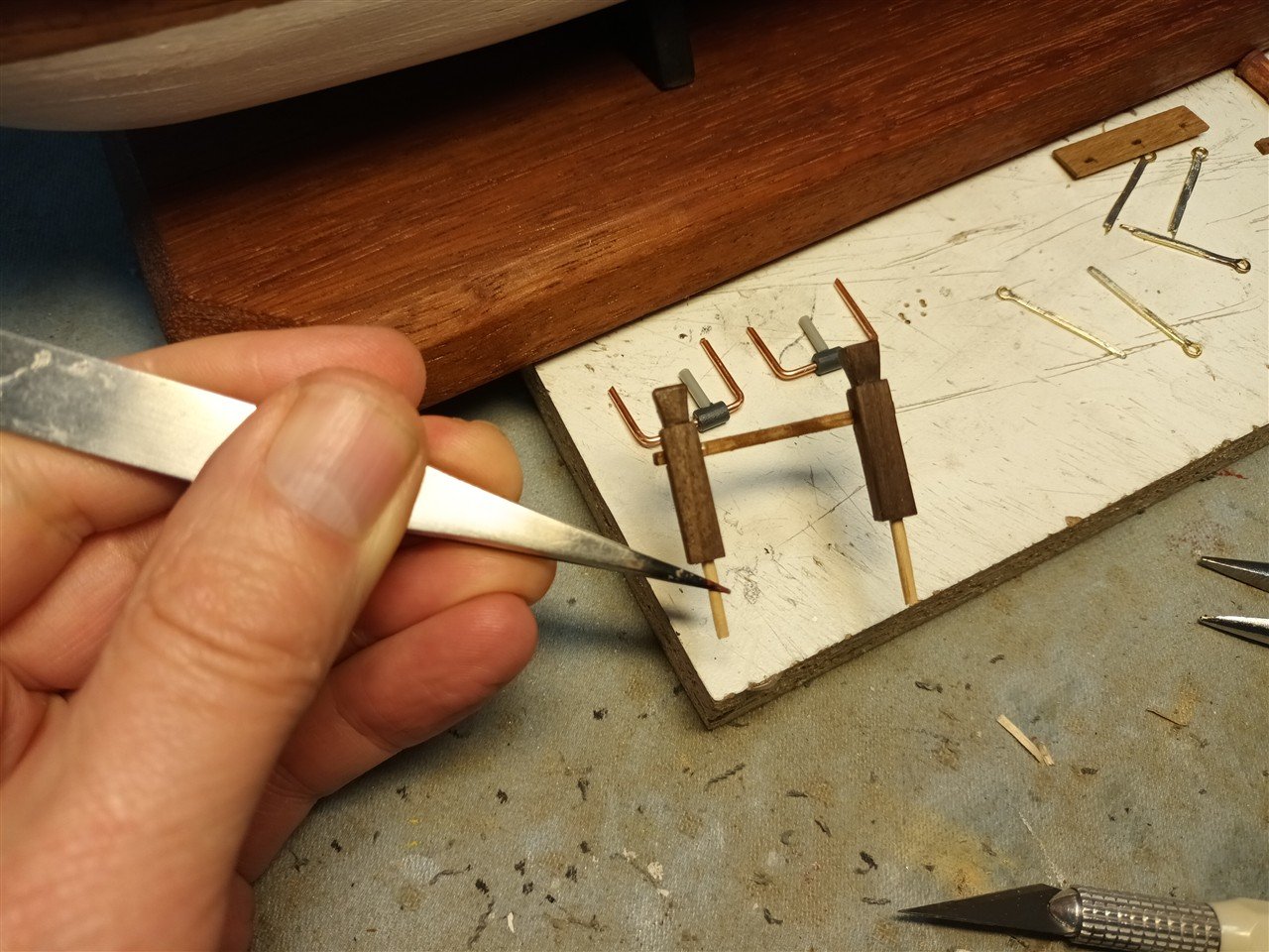

Finishing the leeboards.

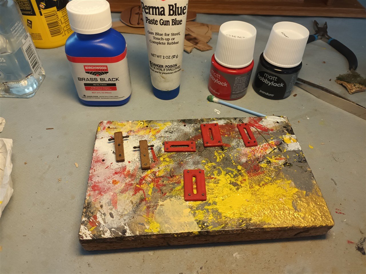

Part of this project was to try out new techniques for me. I've discovered that copper and brass aren't my thing.
The heads of the copper nails are also too large for scale.
So, I removed the copper and continued with polystyrene sheet, strip, etc.
The result: the painted version with plastic fittings.

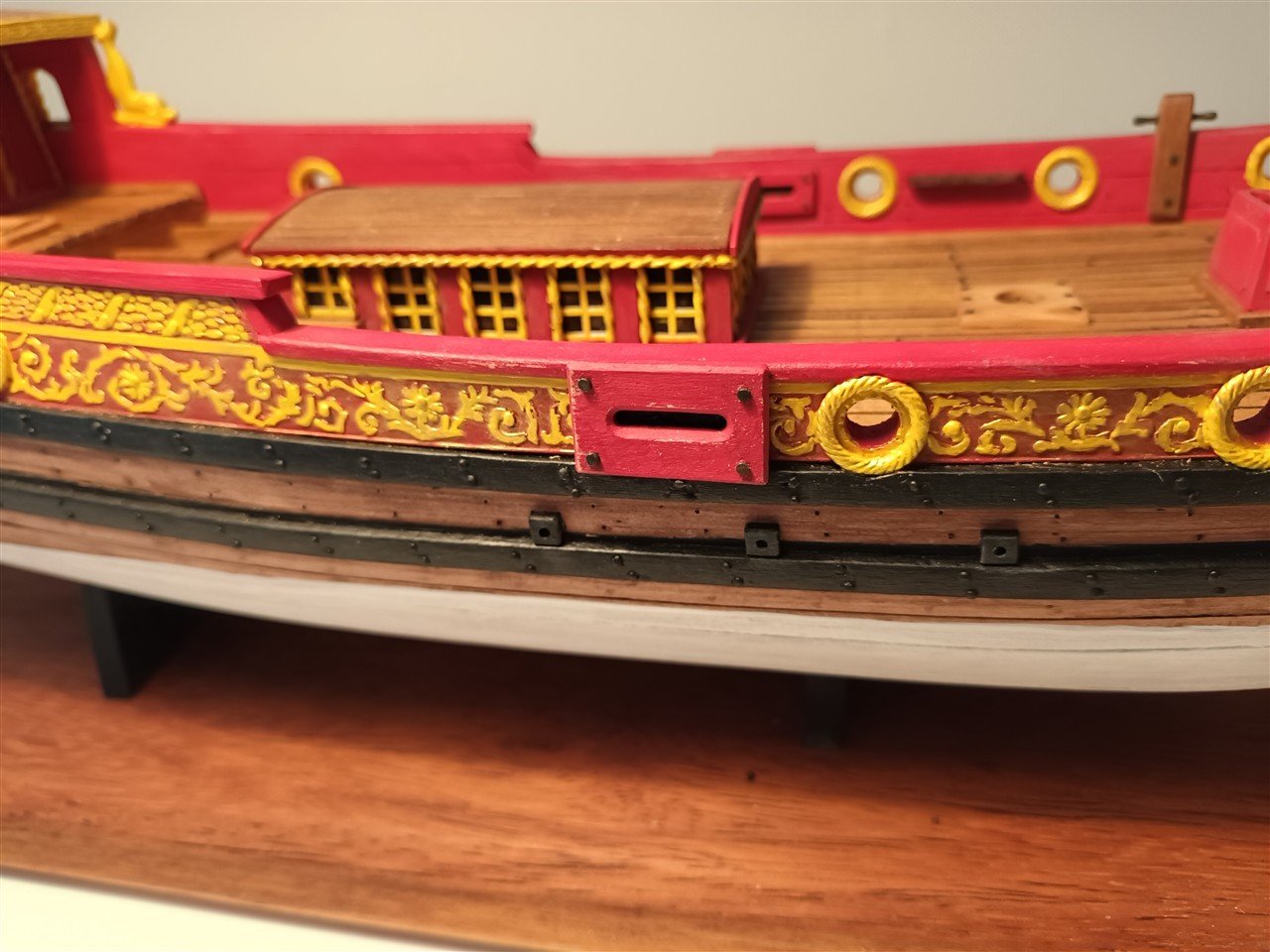

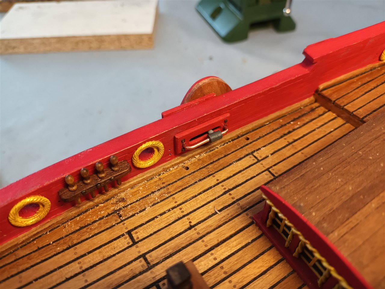

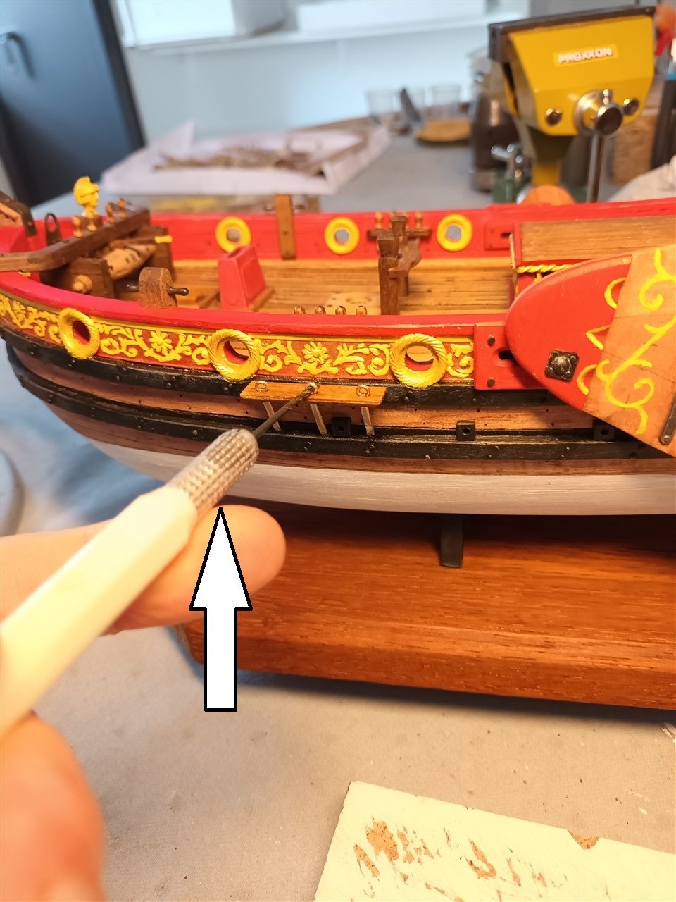

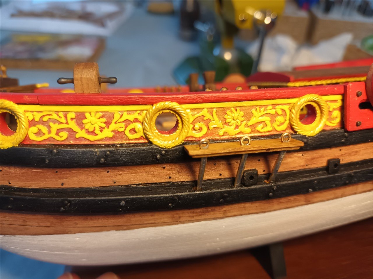

Further continuation,
Toothpicks are for a stronger hold
Channels
20250929_183441_1280.jpg.baad938e70009baf46e9e52f8497c688.jpg20250930_124630_1280.jpg.8b537d98bd50cda92ec9f50ab4dcc031.jpg
The model is lifted up for each eyebolt to test for proper attachment (test passed six times).
Painted
Leeboard attachment
painted

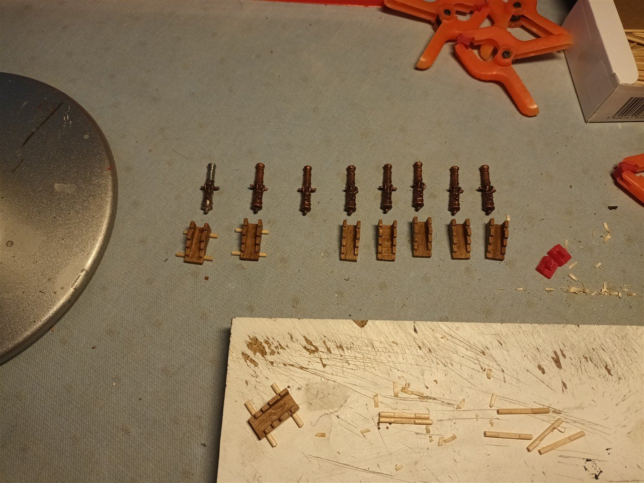

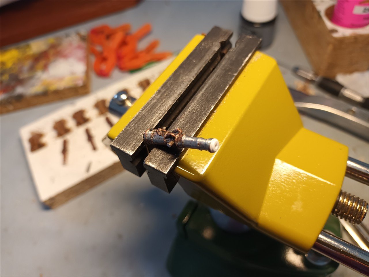

The cannon production line
Need on some cleening
20251002_123415_1280.jpg.ca3eaab8bf86cf41d3795a3b51cd5054.jpg20251002_123515_1280.jpg.aa9a65fe32d2117e167d0fdaf22e9d09.jpg

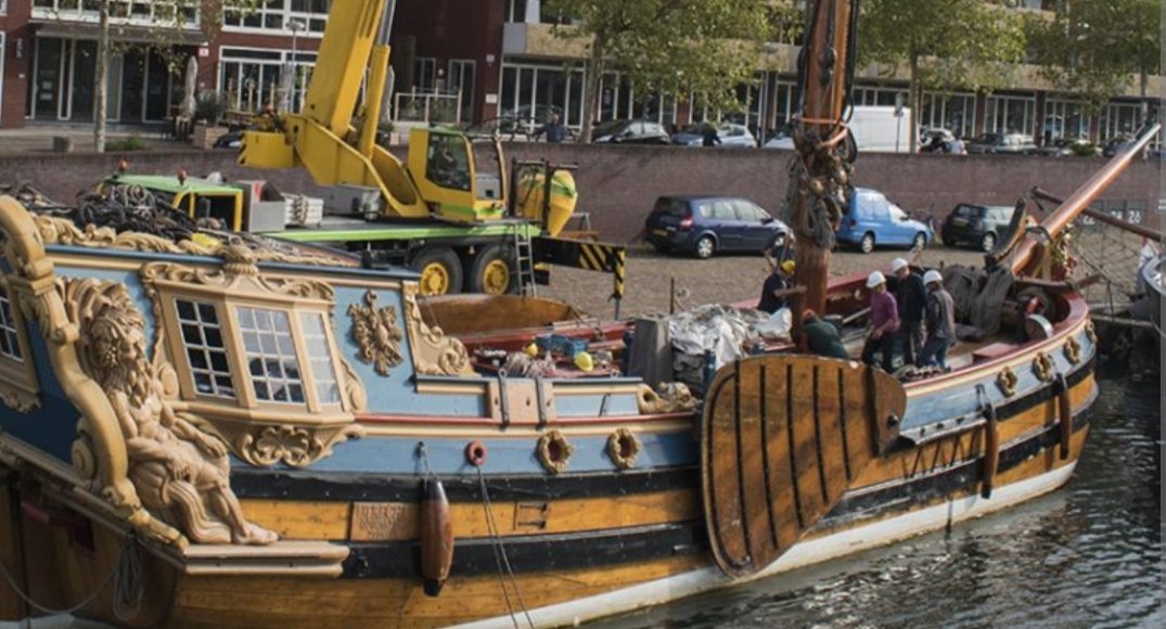

Hi Patrick

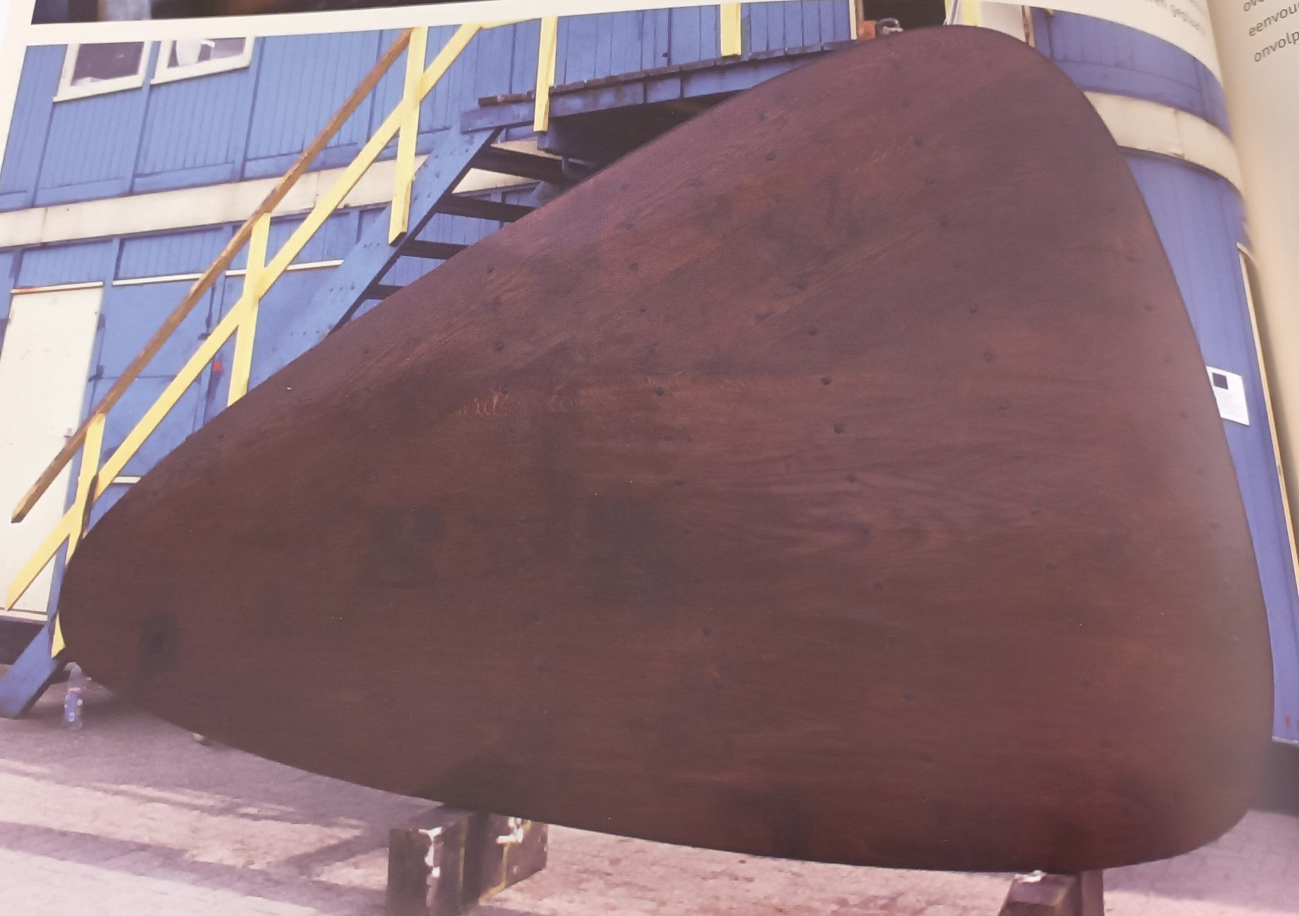

I'm curious - the leeboards are massive, & unless I'm missing something the plate behind that supports them isn't very large & is only at the top - so the leverage on the top part of the board & the mechanism, at times, must be huge. It just looks quite surprising that this amount of structure & support is enough.... Any reflections of yours on this would be interesting to hear.
thanks,
4 hours ago, Mark Pearse said:
Hi Patrick
thanks,
There is indeed no support on the rear side.
A brand new replica leeboard on the rear side.
And years later during a maintenance,  you see also no supports on the port side leeboard.
It is possible that the separate pieces were held together with one or more long bolts, don't now.

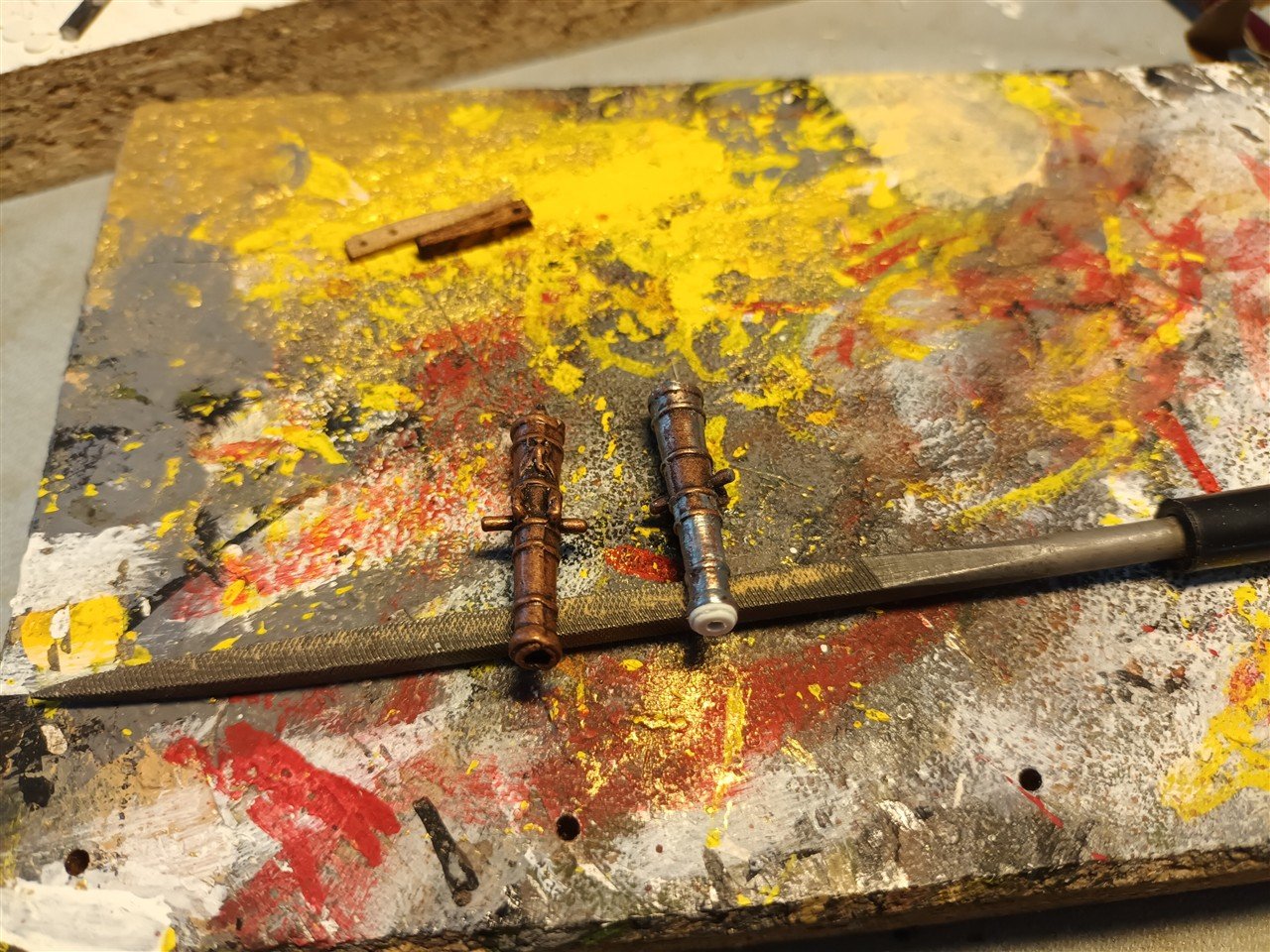

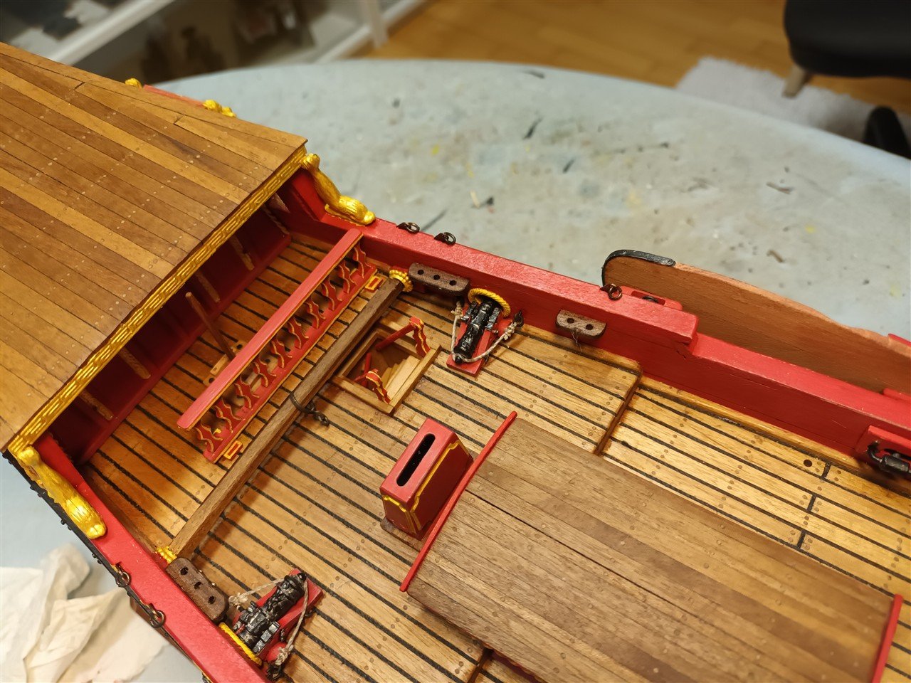

Cannon production
Step 1: prototype
Step 2: carriages painted and barrels in place
Step3: ready for last painting
Step 3 ready

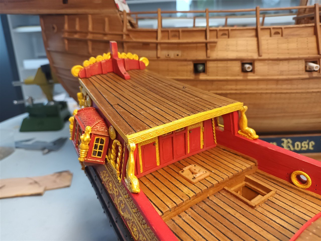

I didn't like the first method of planking in this area.
So I cut the 2mm planks from the kit to 1mm. And planked again.

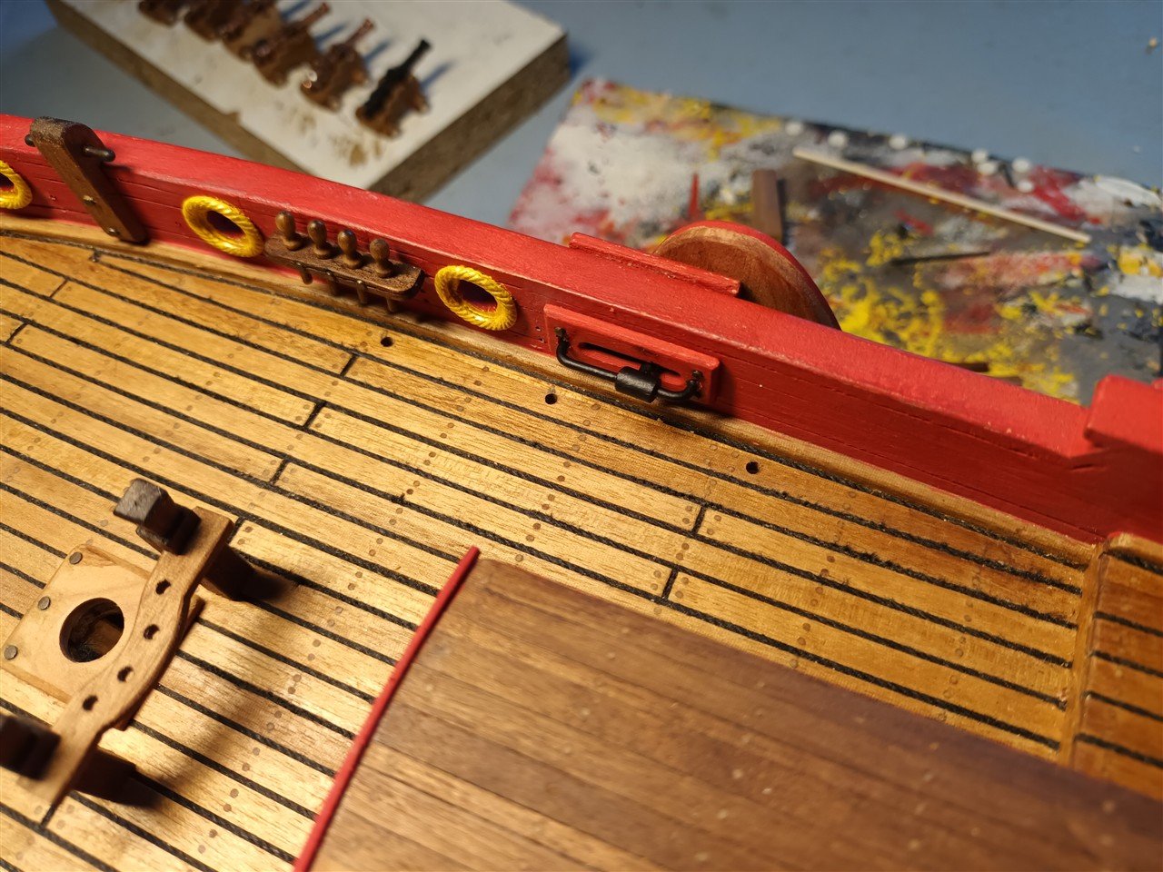

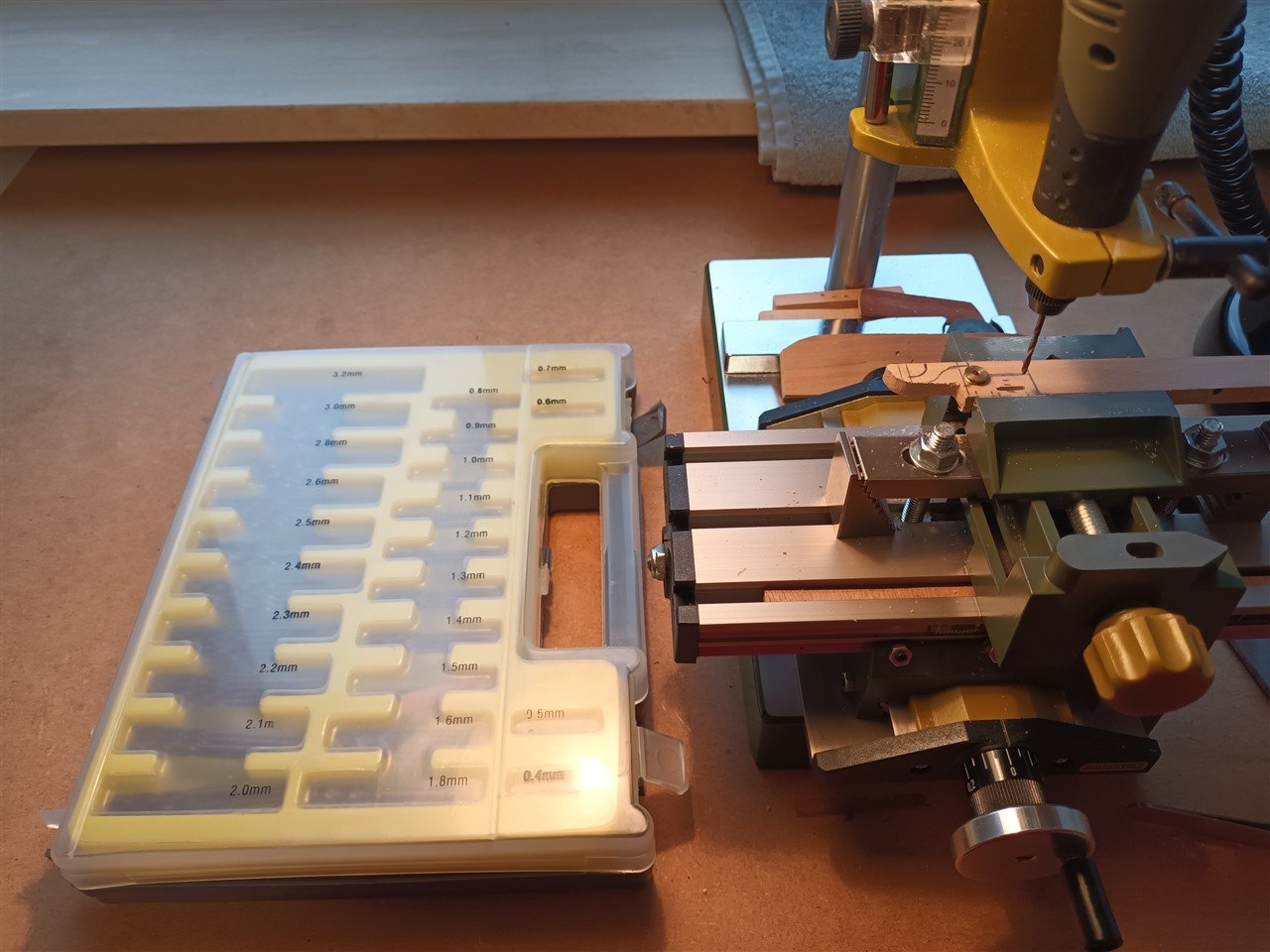

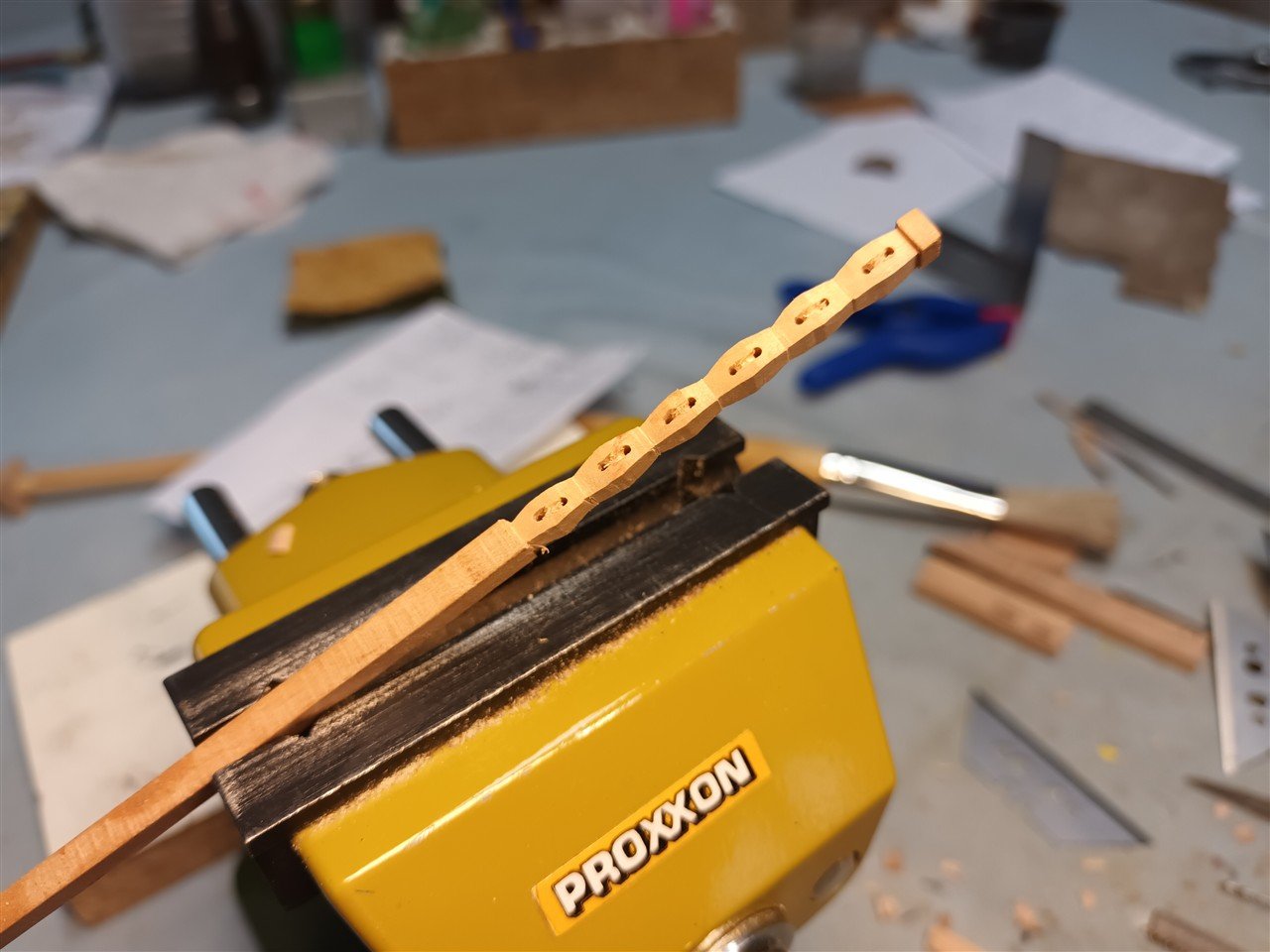

Making a railing for the quarterdeck.
Drilling all the holes for the metal pins seems excessive. But it makes for easy installation later.
Clamp the parts in the vice and glue with CA.
Ready

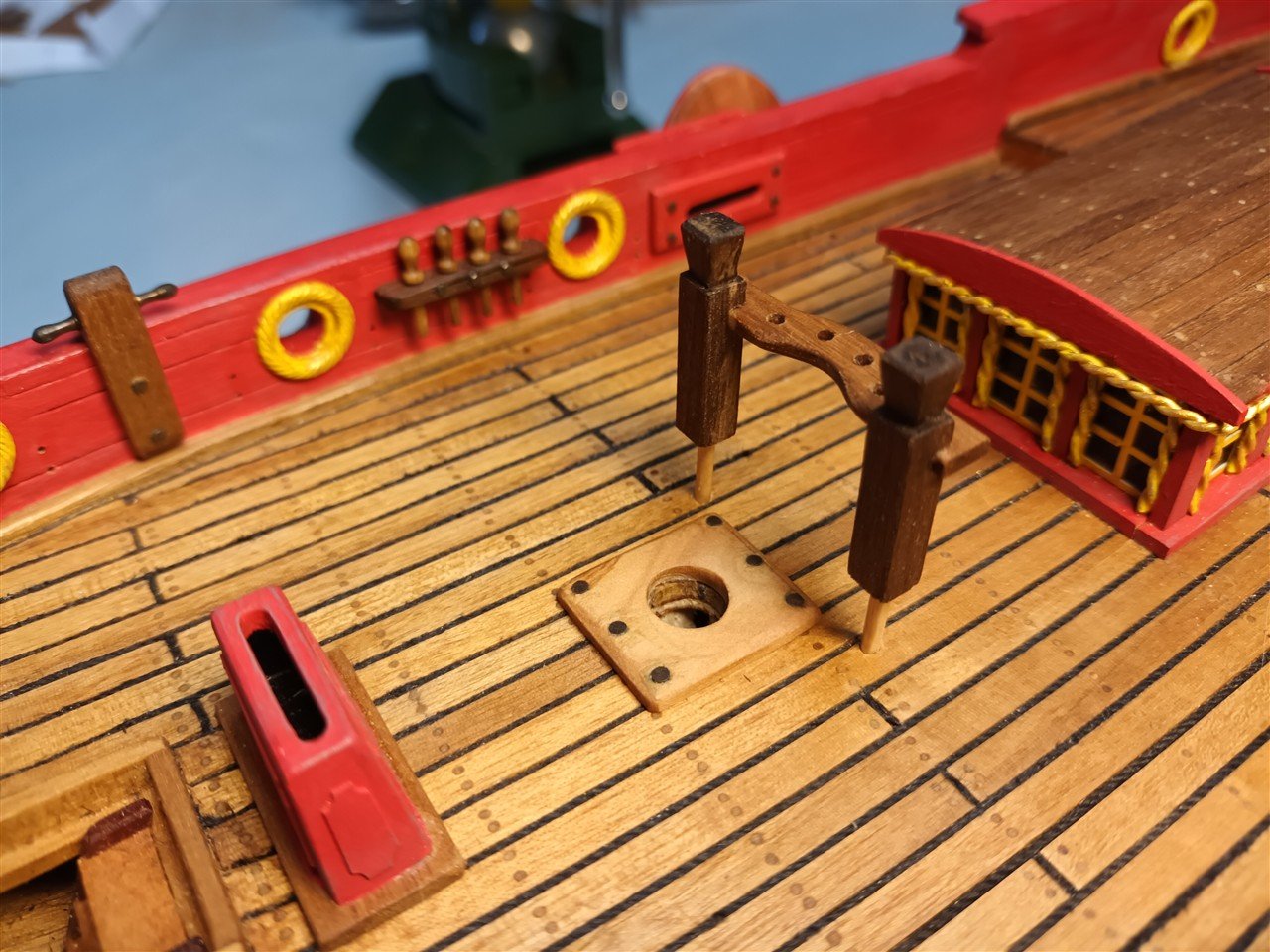

Making the "overloop" (I don't think there's an English word for this). These are for attaching the main and fore sail sheets.
Corel doesn't provide this for the fore sail. So, no room.
Too far forward
Or in the mast
So, the mast needs to be moved aft...
Work in progress.20251015_081256_1280.jpg.13580981875225fef82a97414cb5430f.jpg

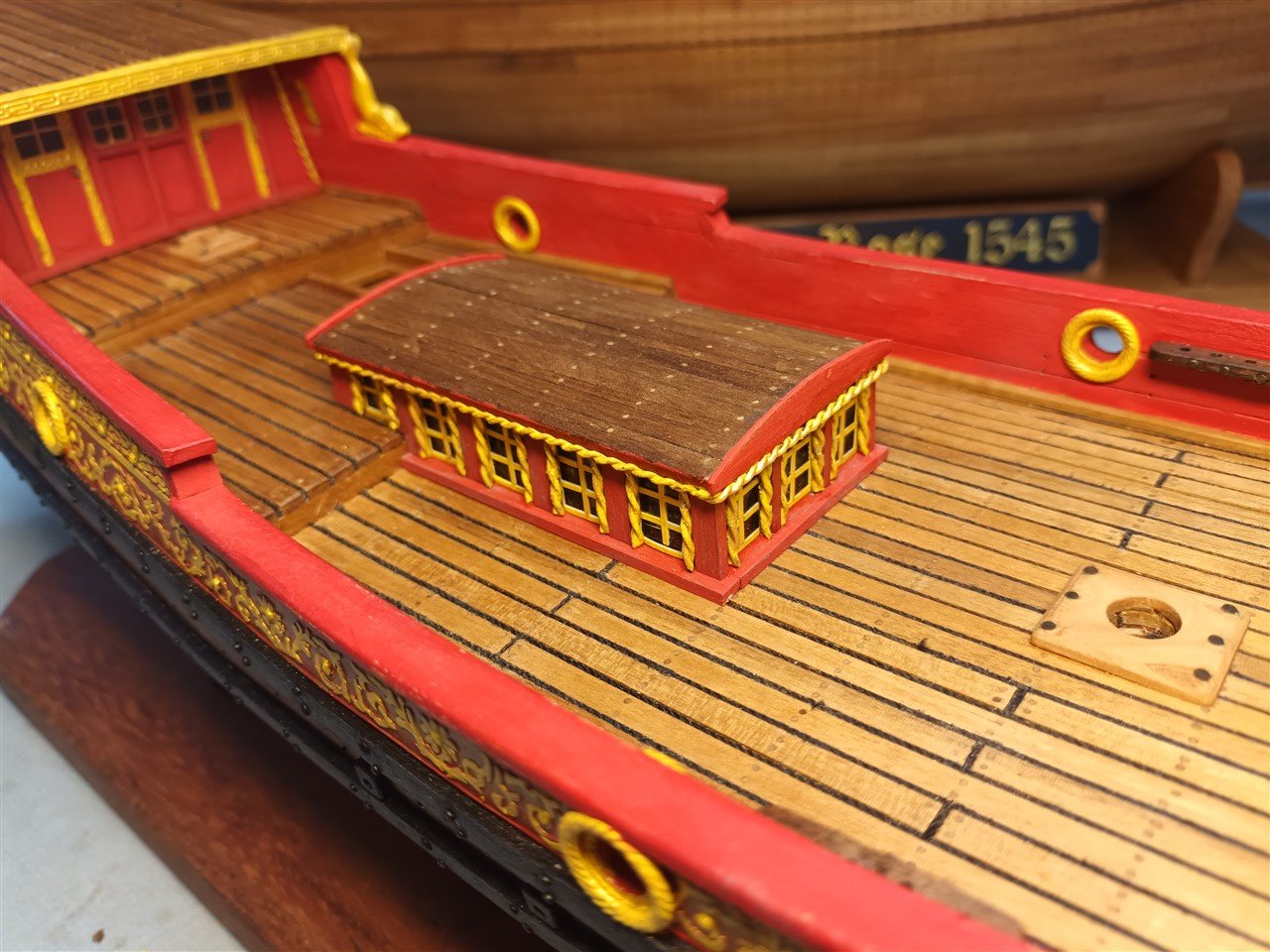

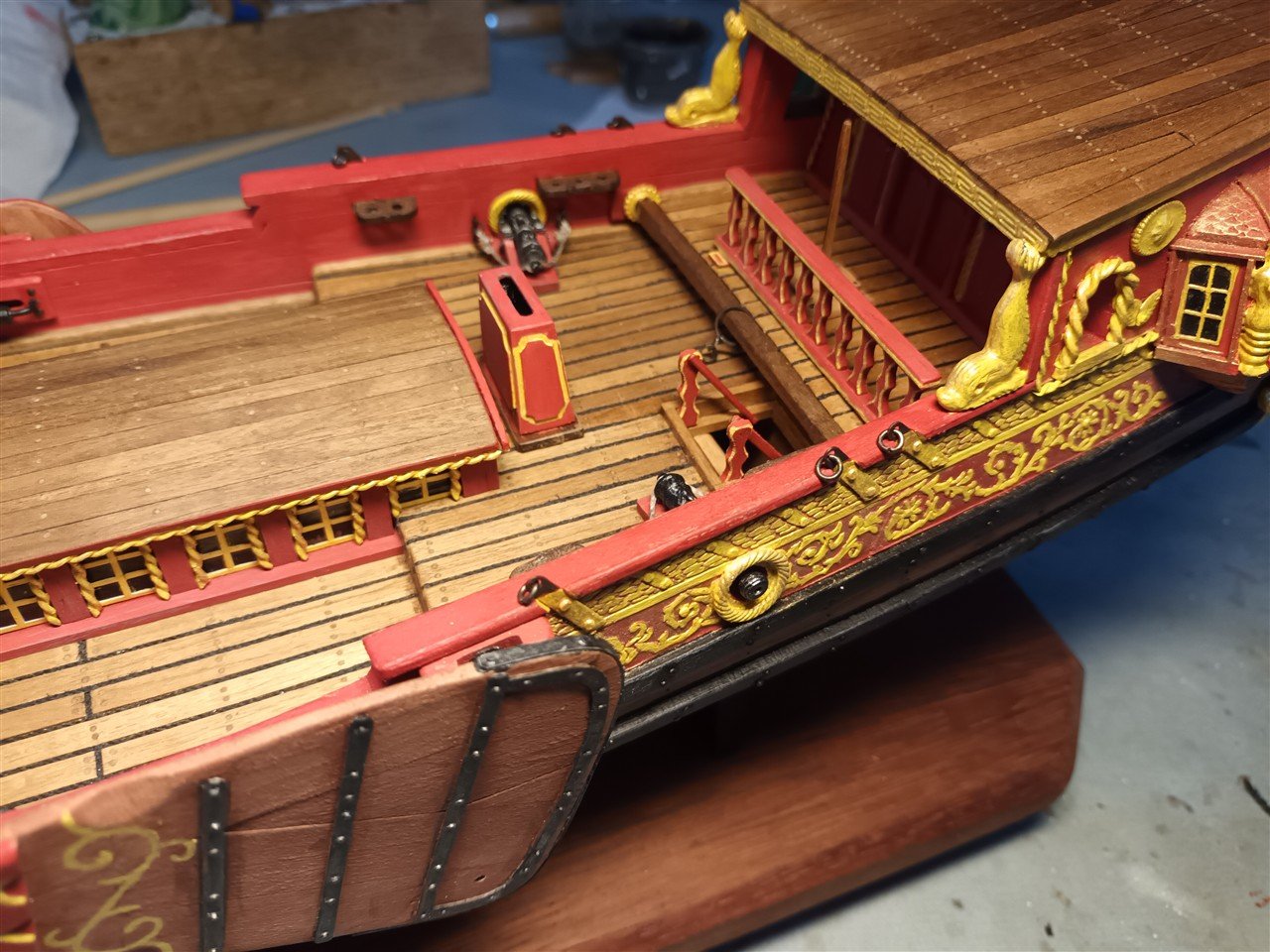

Railing in place (and the main sail "overloop").
The renovated deck on the cabin is also ready
Fore sail "overloop" in place.

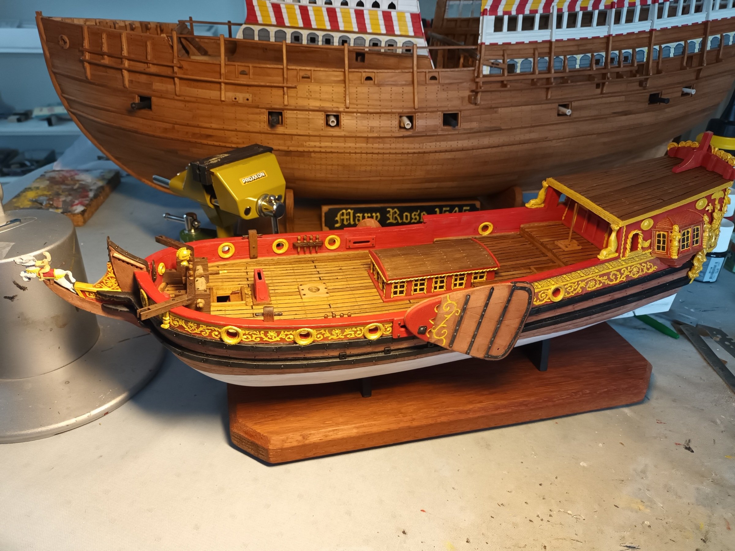

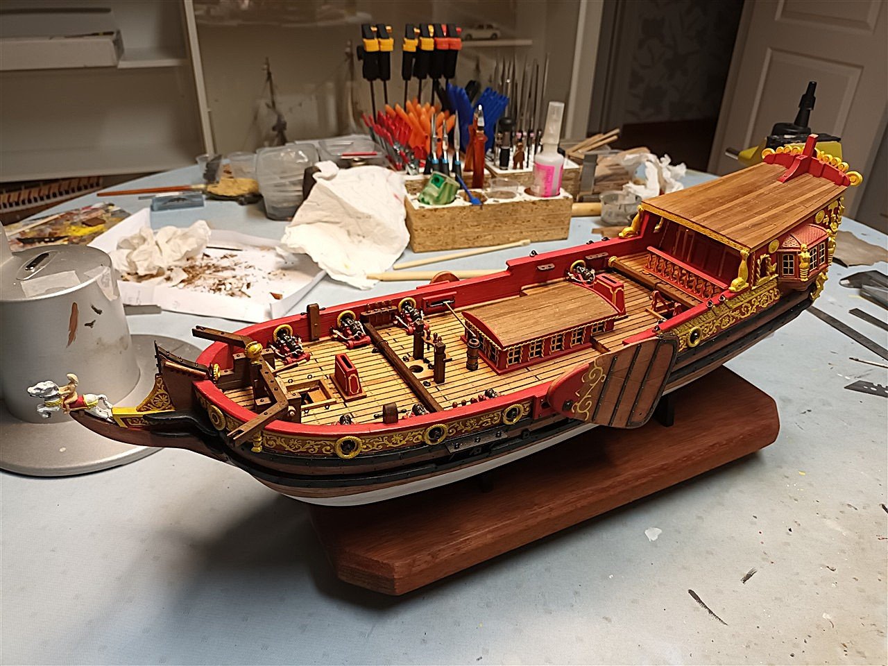

And after a few more extra details
20251023_192744_1280.jpg.ad90b54be5280fb672ca018ad119b581.jpg20251024_084751_1280.jpg.8ded2749c85a6ca46ae45751fb73682a.jpg
I think the hull is now complete :Whew:
Next : mast, yards, rigging, sails...
