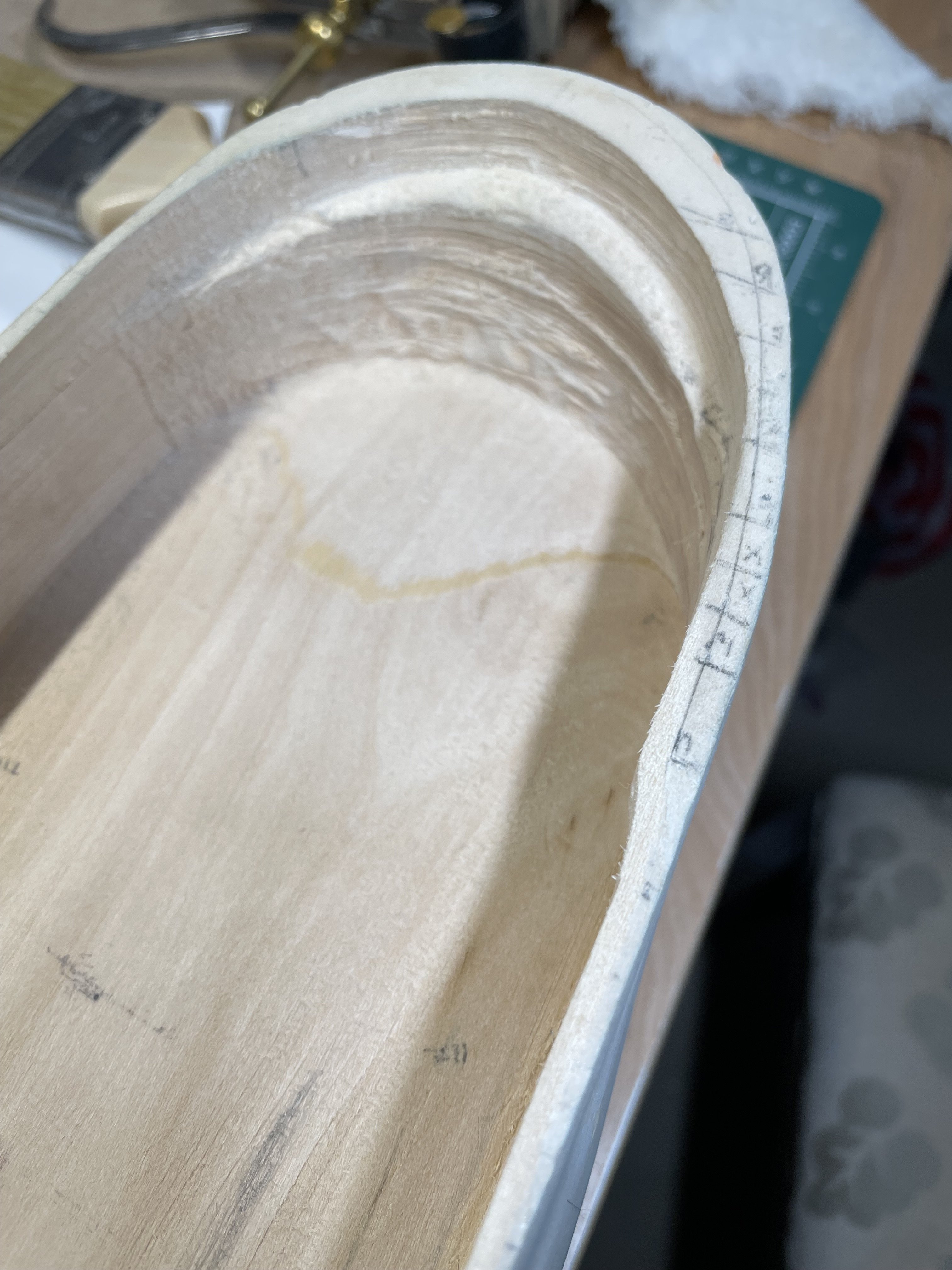

Finally, the hull is complete. The exterior has been sanded smooth to 400 grit, and to my eye it is symmetrical.
Shaping the inner bulwark has been a challenge. I began by trying to thin the wood to 5/32” overall, mindful that it should angle in about ⅜”. Everything seemed okay until I marked the height of the spar deck and gun deck. If the spar deck was the right height, the gun deck was too tall and vice versa.
So that meant the height of the bulwark overall was too high. By about ⅛”-¼”. The other problem was the thickness varied from 1/16” to ⅜” and it was too wavy. Lots of adjustments needed. IMG_3492.thumb.jpeg.6d321806f85779be7dc1c3c2e487f83f.jpeg

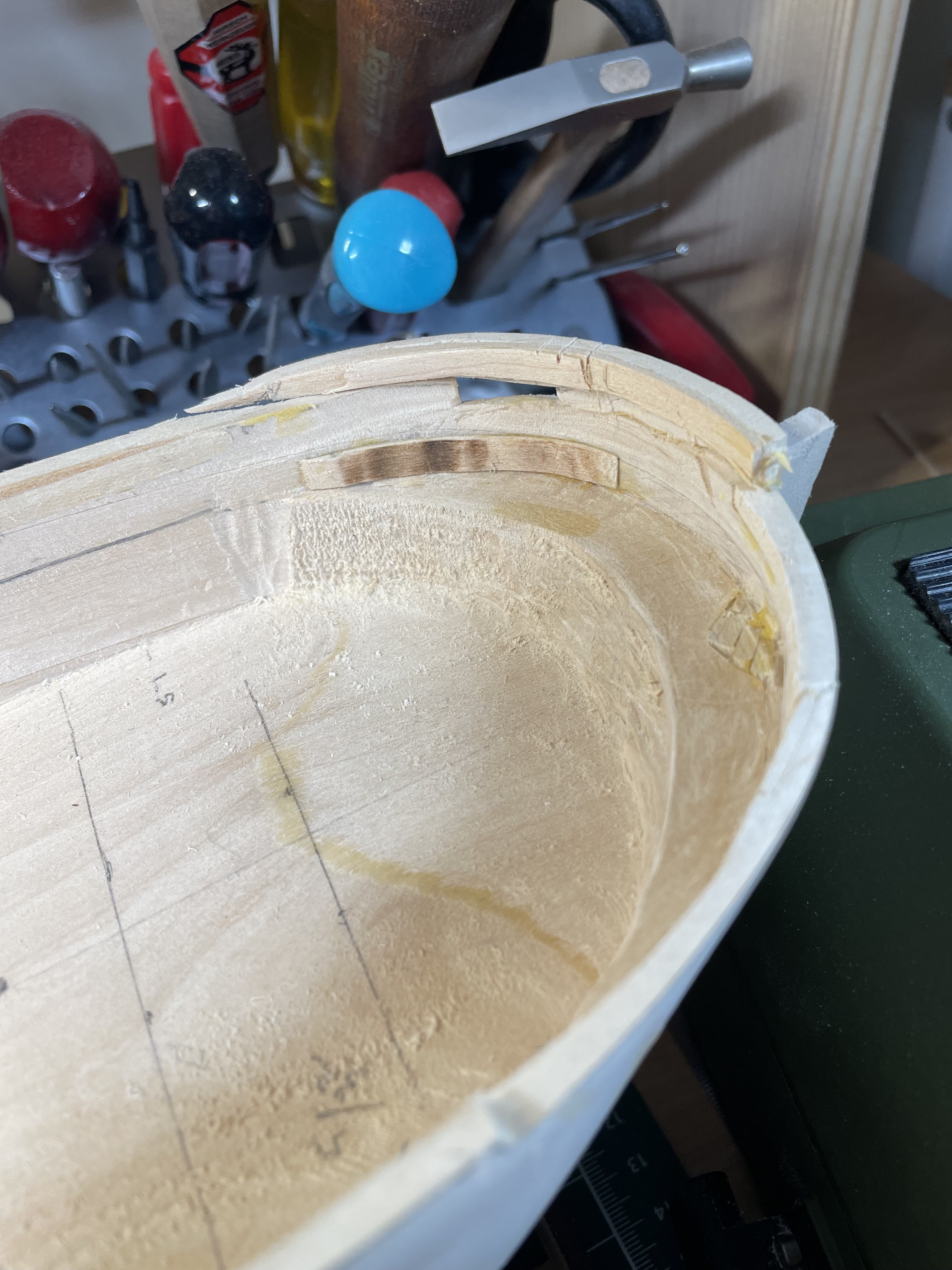

First I cut the ledge on the bow down to the right height (and you can see the variation in thickness.)

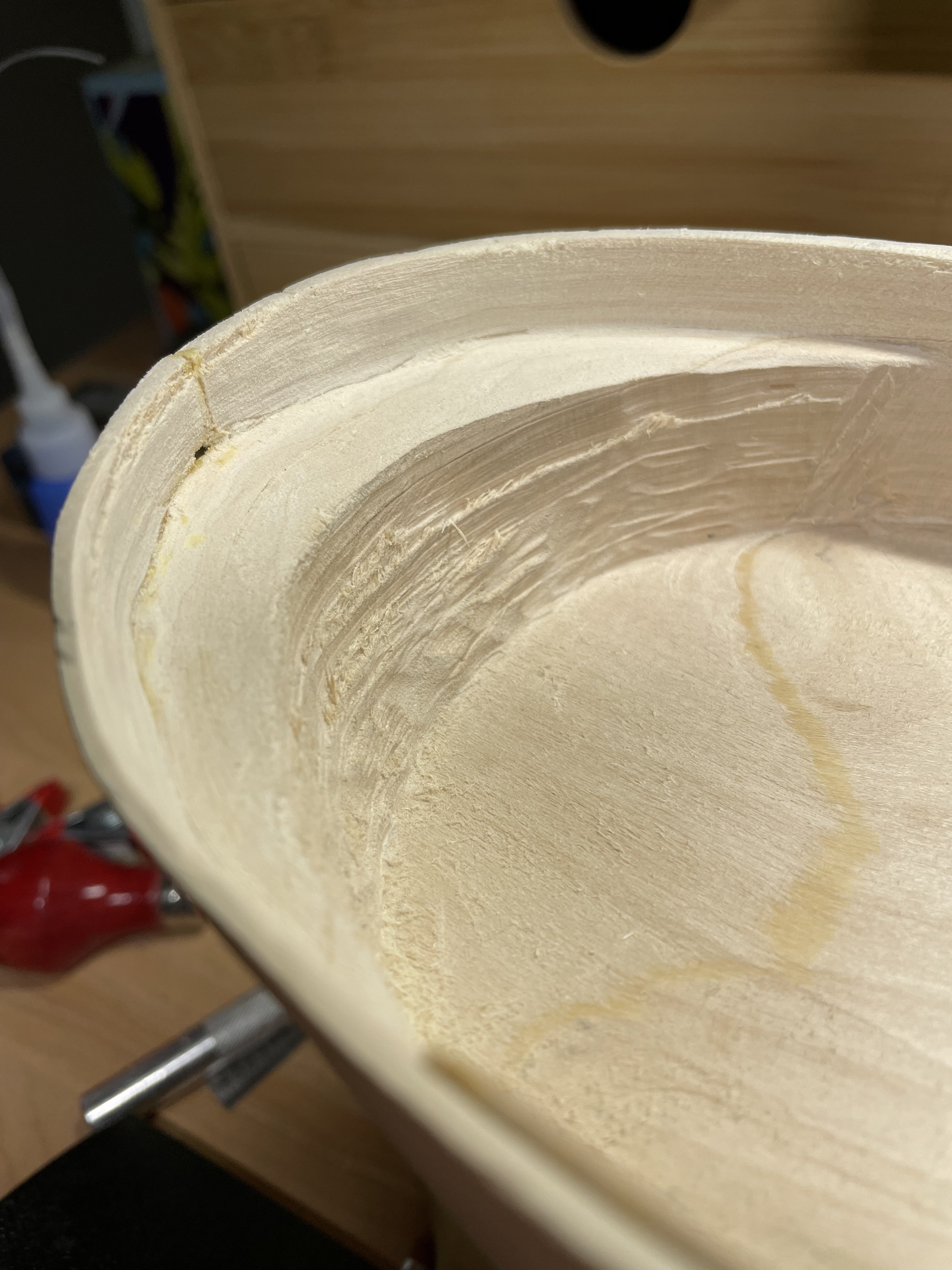

 Then I started thinning the bow with gouges, sandpaper and a dremel. This led to my next problem. The spar deck was TOO thin and cracked. So I glued it back, but the assembly was still fragile.IMG_3495.thumb.jpeg.806846f46b782969d2db290dca977fcd.jpeg
So I started adding planks to bring the bow back to 5/32”. I thought this would help stabilize it. Hah!
The original crack and the thin wood was just too much. I wound up cutting ¼” off the bow bulwark and replacing it with a “U” shaped piece of panel, then filing and sanding to fit (sorry, forgot to take a photo.)
Anyway, the rest of the process was pretty straightforward: adding planks to fill the low spots and sanding to remove the high spots.

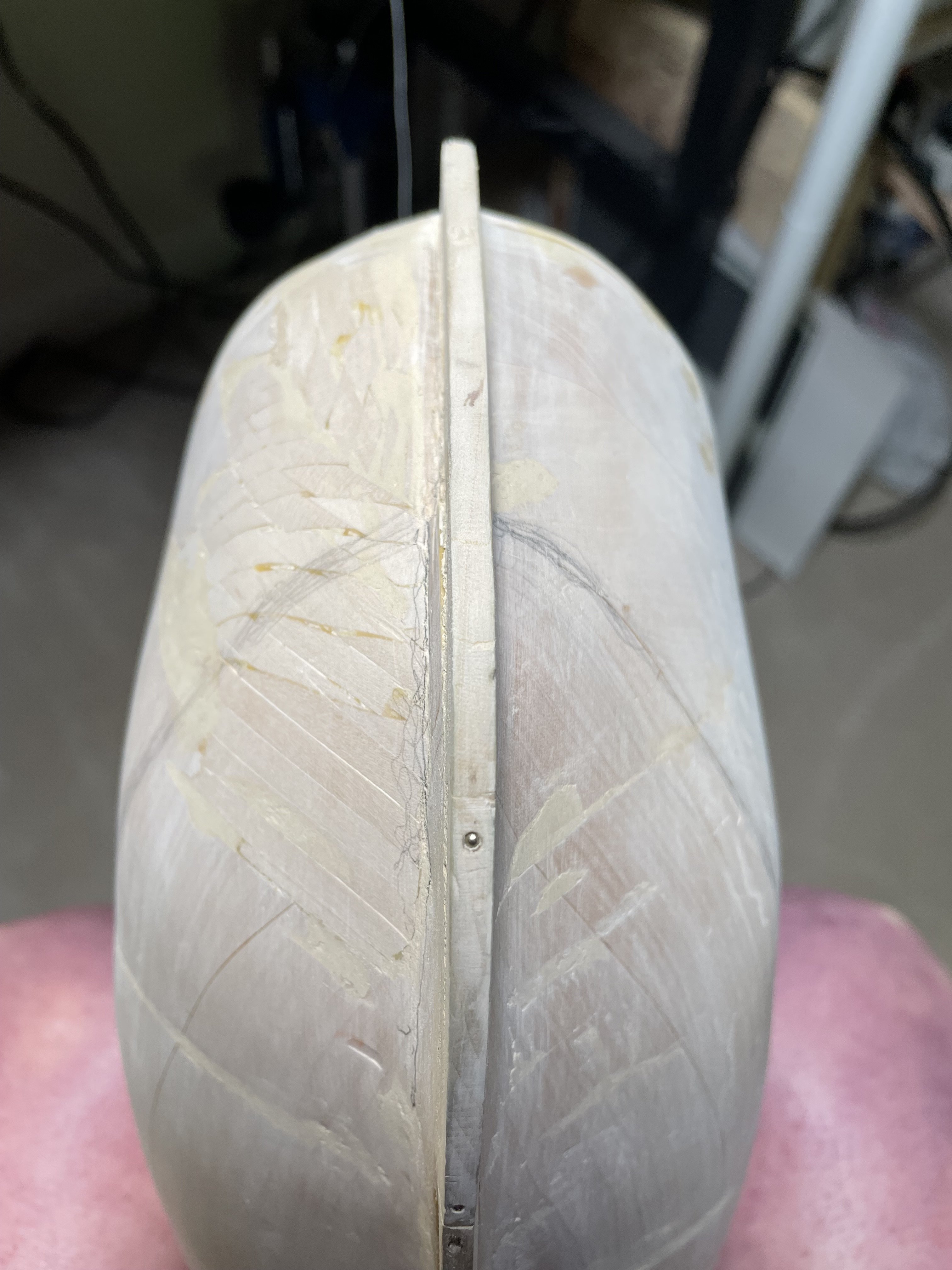

Stem Issues

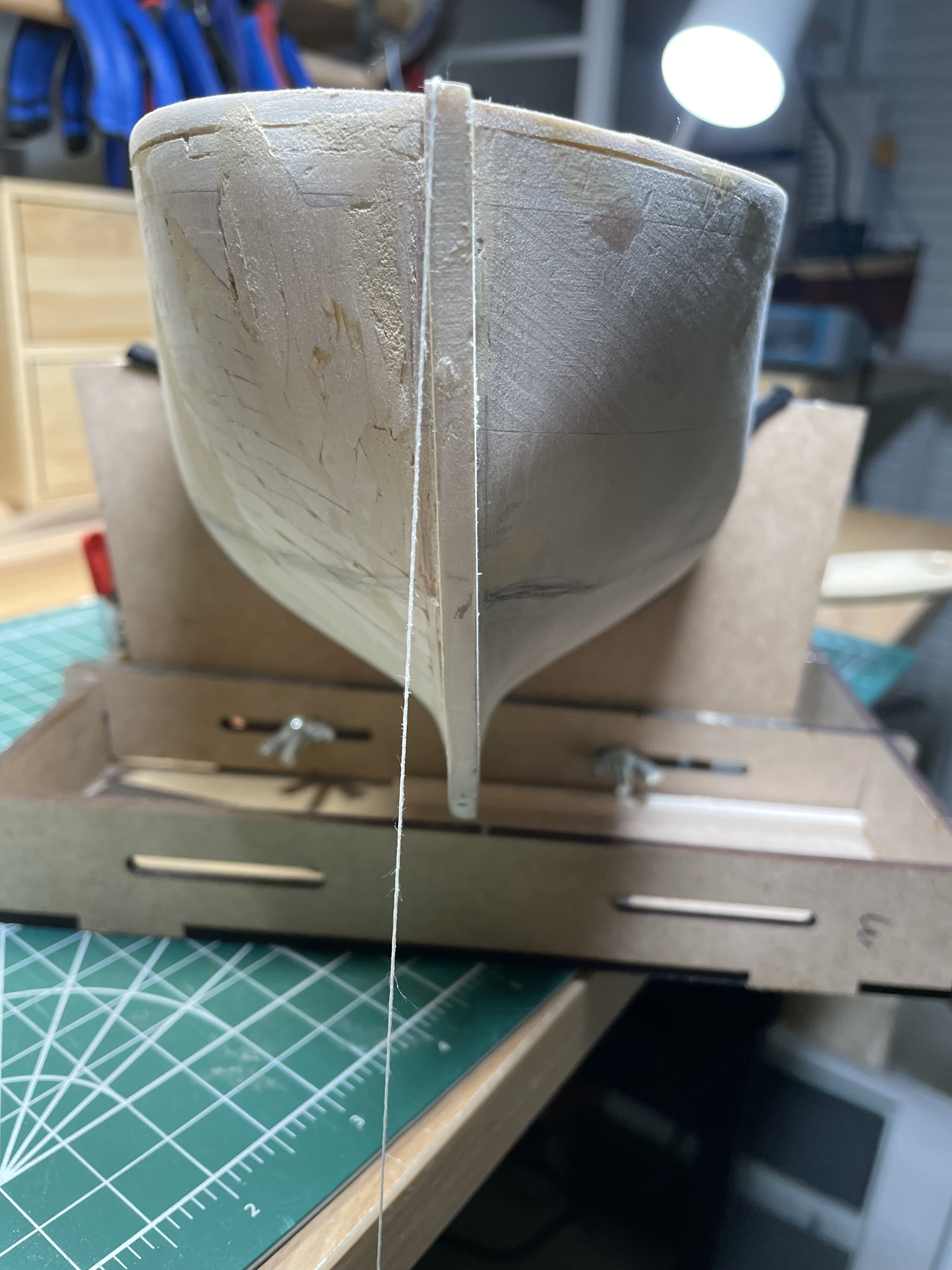

As I was measuring and marking the hull for planking and coppering, it seemed like the stem was off axis and leaning to port. So I rigged a plumb line and sure enough, I had attached it a few degrees off.
Now the question becomes, what’s the best way to fix it, because I know this will cause many more problems down the road.
It seems I both followed a wayward keel rabbet and kind of leaned the stem to get it in place.
So I’m looking for advice about the best way to fix this without destroying the profile. My plan is to remove the stem and cut away the starboard area around the stem; rebuild the keel rabbet and re-shape the profile along both sides; then replace the stem.
This looks like the line I need to follow. Any suggestions, tips, help or ideas would be greatly appreciated.

Thanks @KurtH for the tip. I rigged a plumb bob and scored my stem line off that. After some aggressive digging and sanding I got the stem straight and the keel more or less back in line. I know the stem is too long; I’ll trim it later.

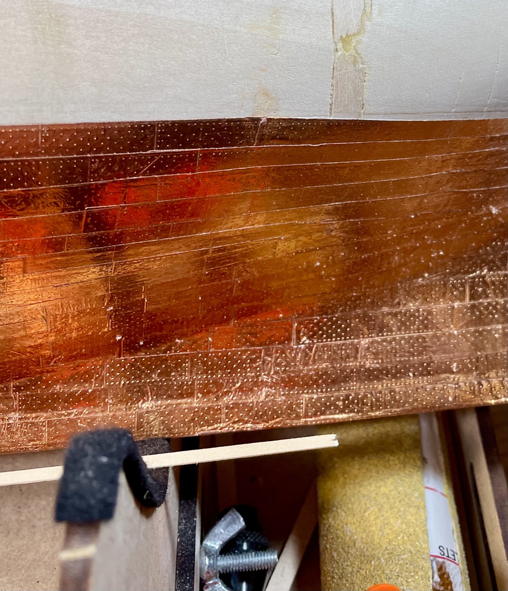

With that fixed, I was ready (again) to start building a ship. First up was coppering the hull. I followed the same process that @g8rfan did and smoothed the hull with 400 grit, then applied two coats of gesso, followed by a shiny finish of copper.
IMG_3524.thumb.jpeg.37ded1837ce6c6c08c850aeb7c10ba6a.jpegIMG_3526.thumb.jpeg.e43b40e046cf06ecd45f05a8fba16ae1.jpeg
I only used one coat of copper because it’s just got to hide any boo-boos in the copper. I’ll be using copper tape along with the little device g8rfan sent me.

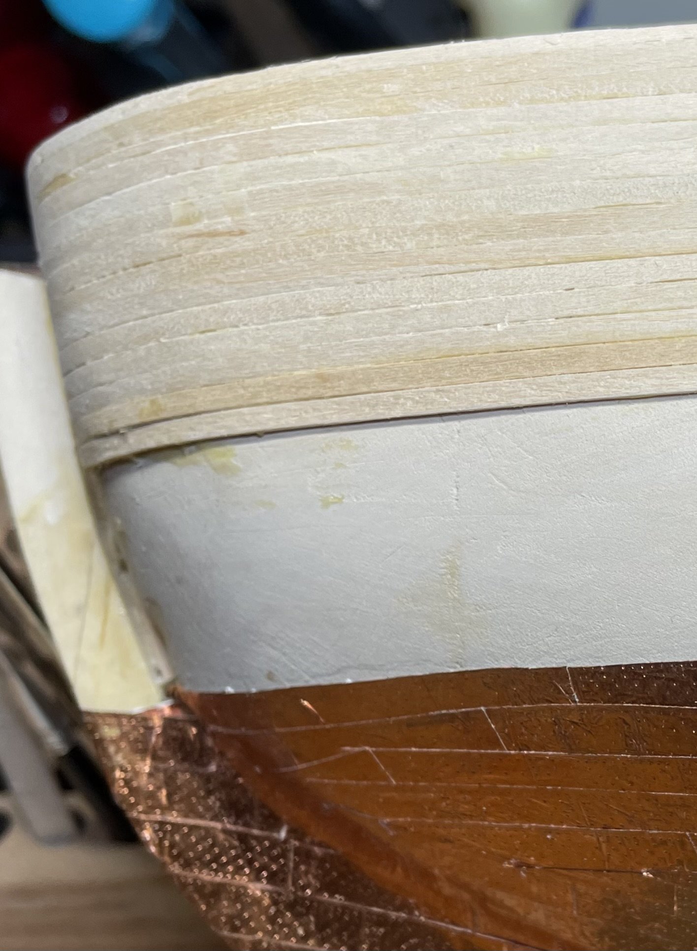

Well, I think it’s time for an update and I’m pleased to say that I’ve made some decent progress on the ship. (Knock on wood in case there’s any bad karma floating around.)
I decided to copper and plank the hull before cutting out the gunports because they’re fragile and I’m clumsy. This allowed me to hold the hull in different positions while applying the copper tape.

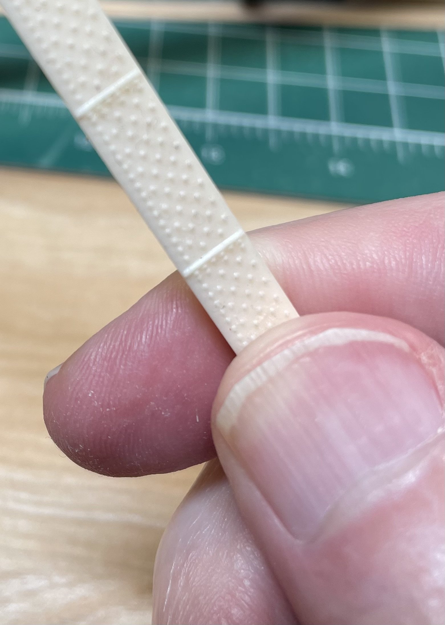

COPPERING THE HULL
I had painted the hull below the waterline a shiny copper color to hide any blemishes in my application process. I cut the tape to mimic three plates and just butt-joined the ends. To create the pattern in the foil, I used a stamp from @g8rfan who sent me one of his spares. I like that it’s not too complicated, but still shows detail in the finish.

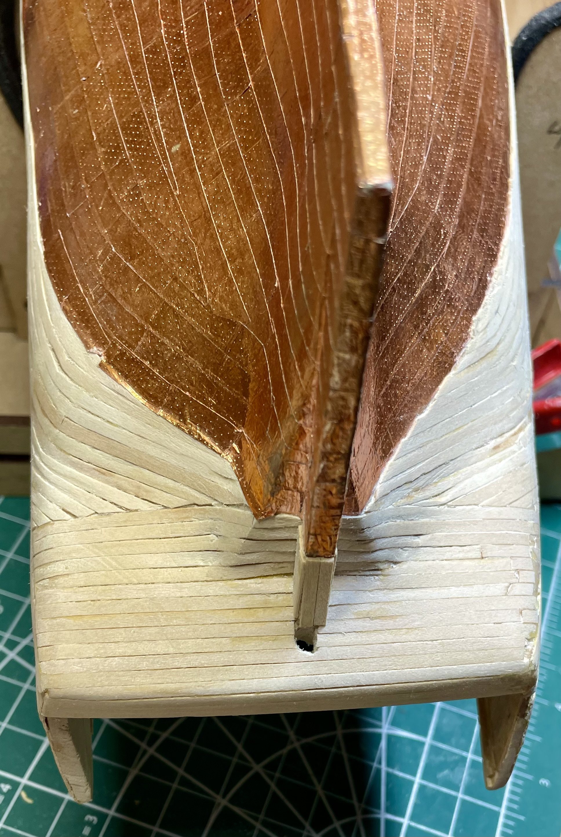

PLANKING
This step was pretty straightforward through most of the process. I bought additional planks from Bluejacket to cover the inside and outside of the bulwark. I  gently bent the planks for the curve in the bow. At the stern, the planks needed more manipulation to follow the shape.
Looking at the stern, I realized that the flare at the top of the sternpost was wrong. Too late now.

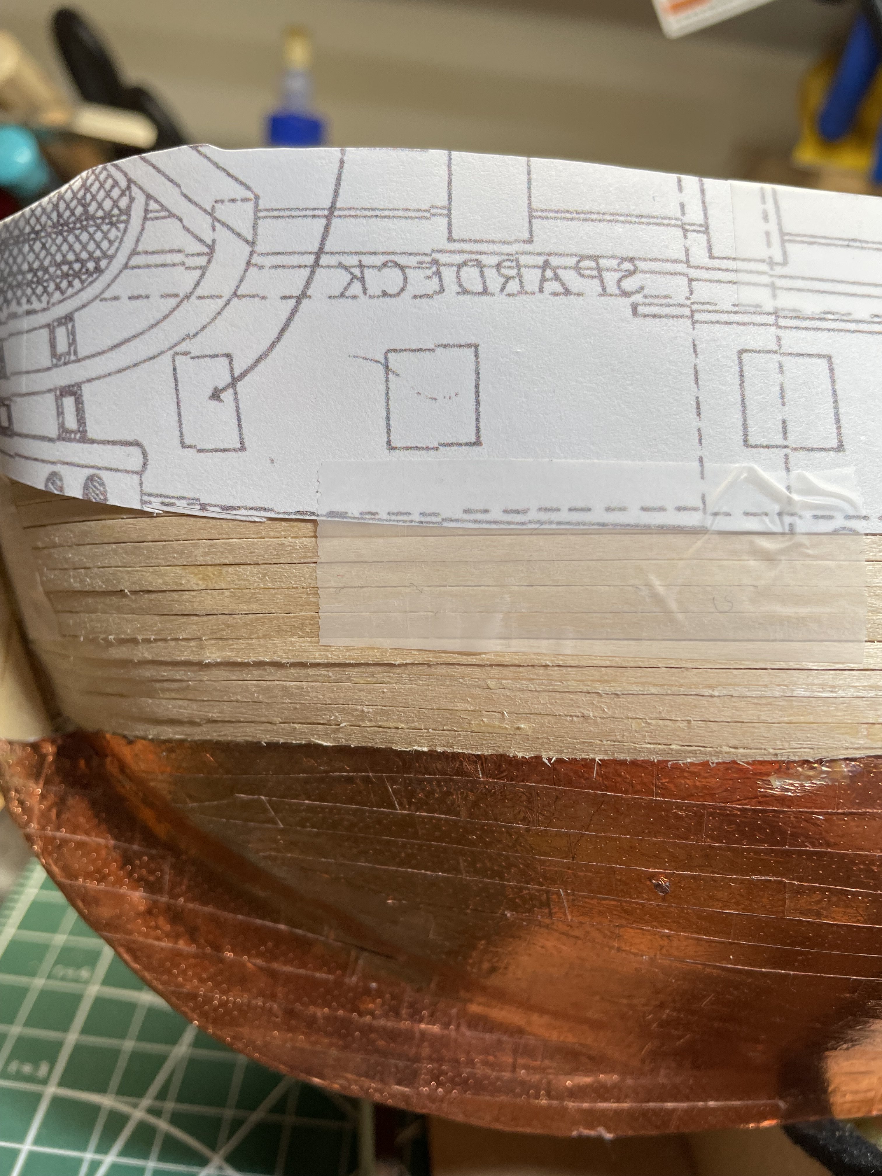

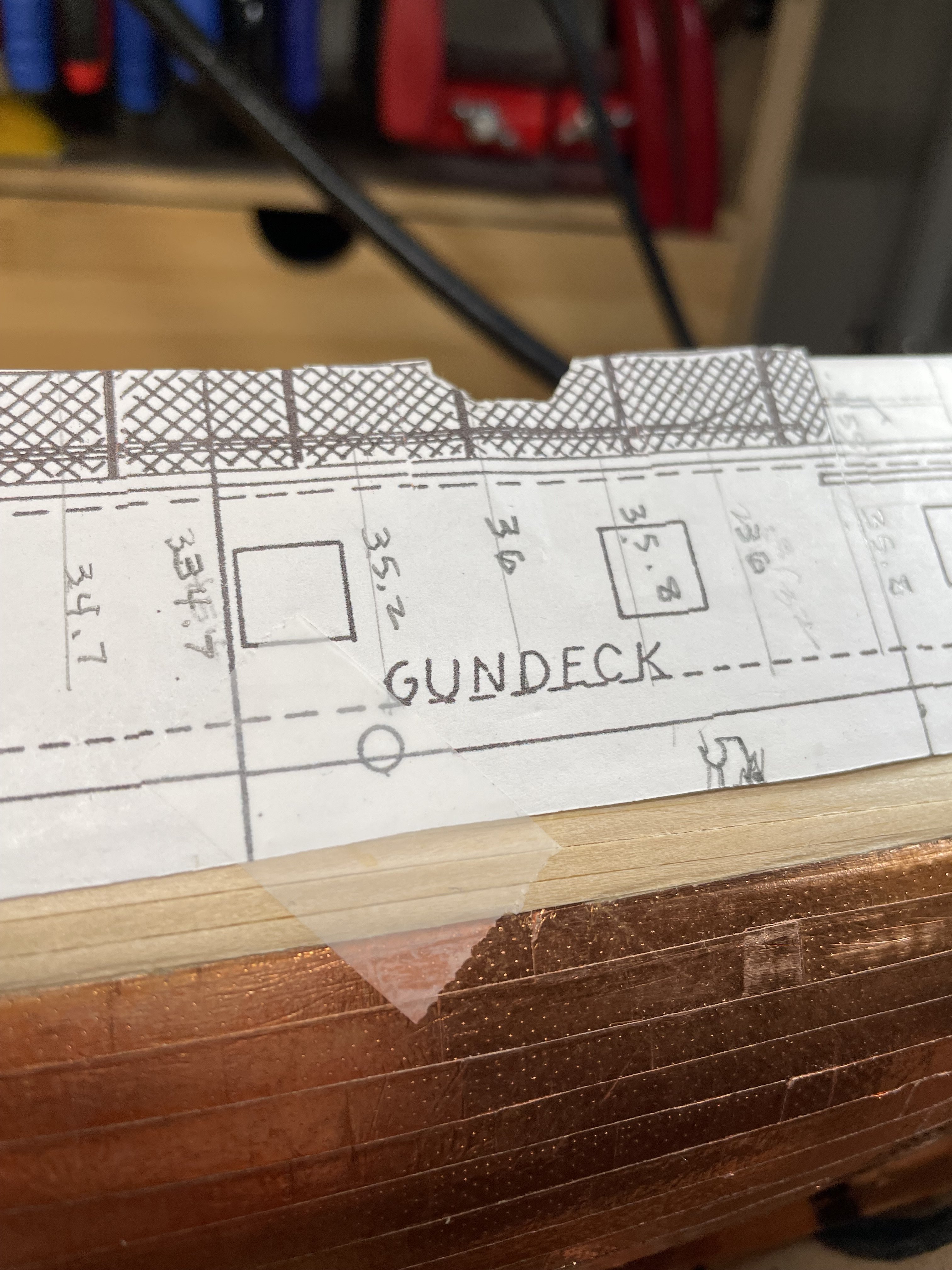

CUTTING THE GUNPORTS

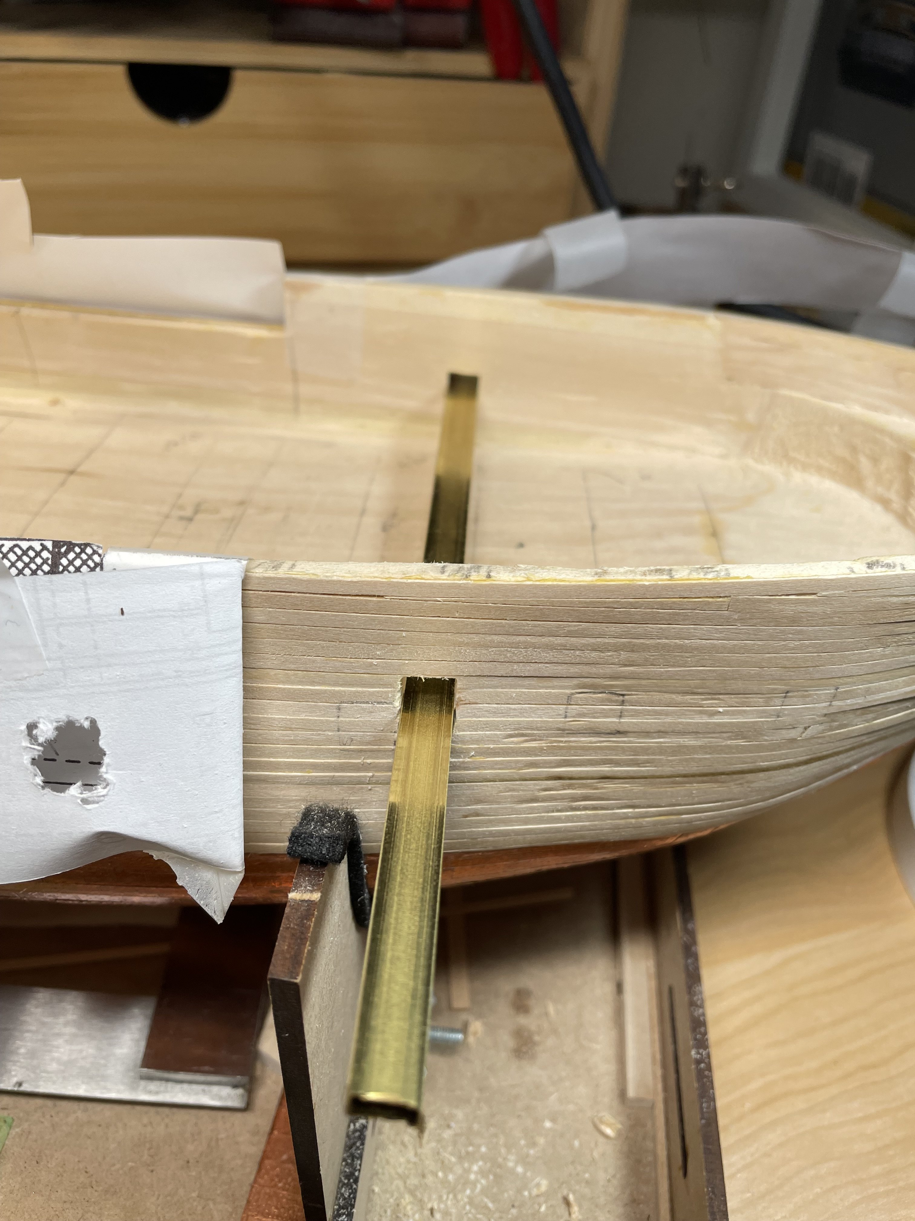

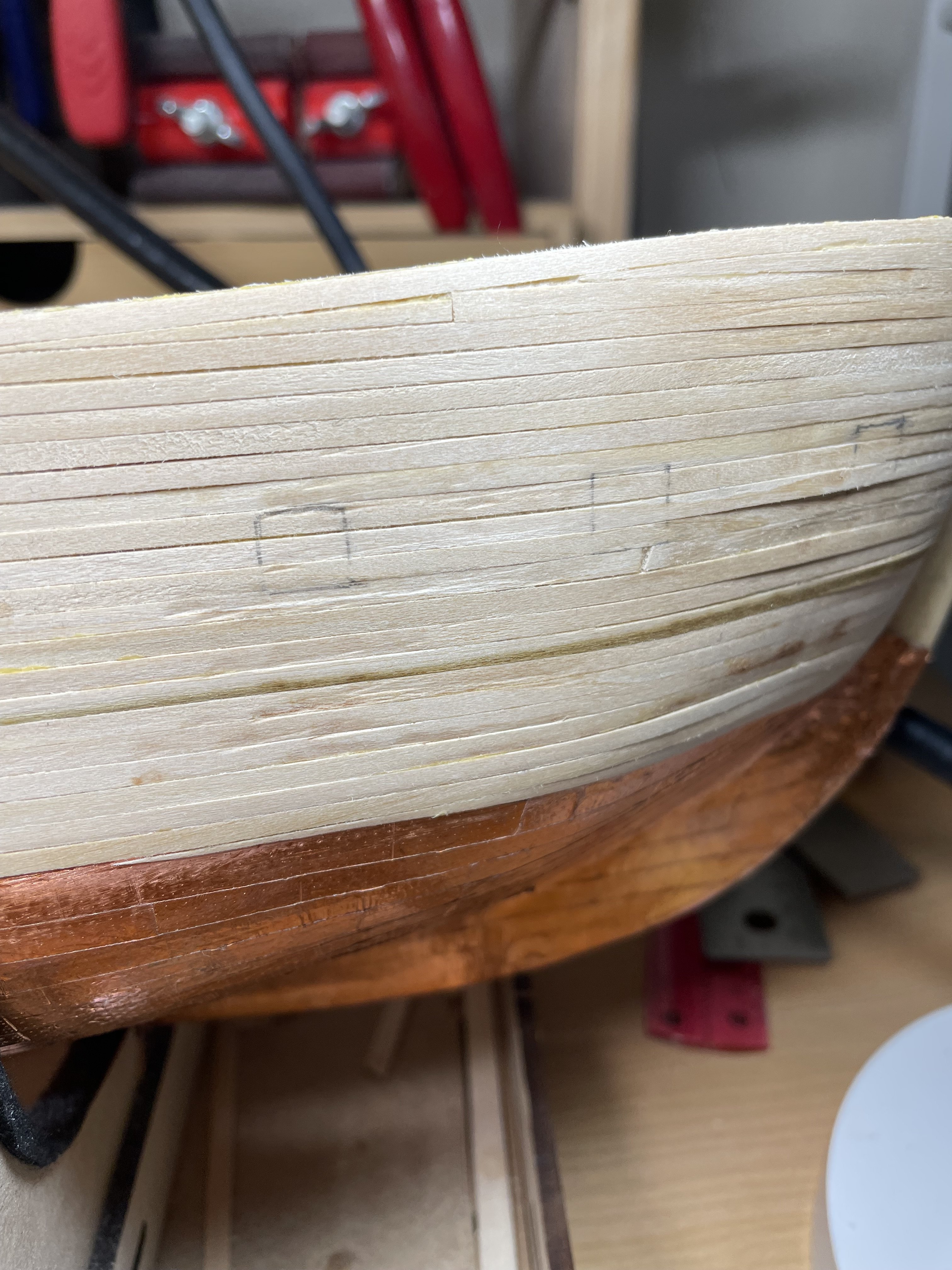

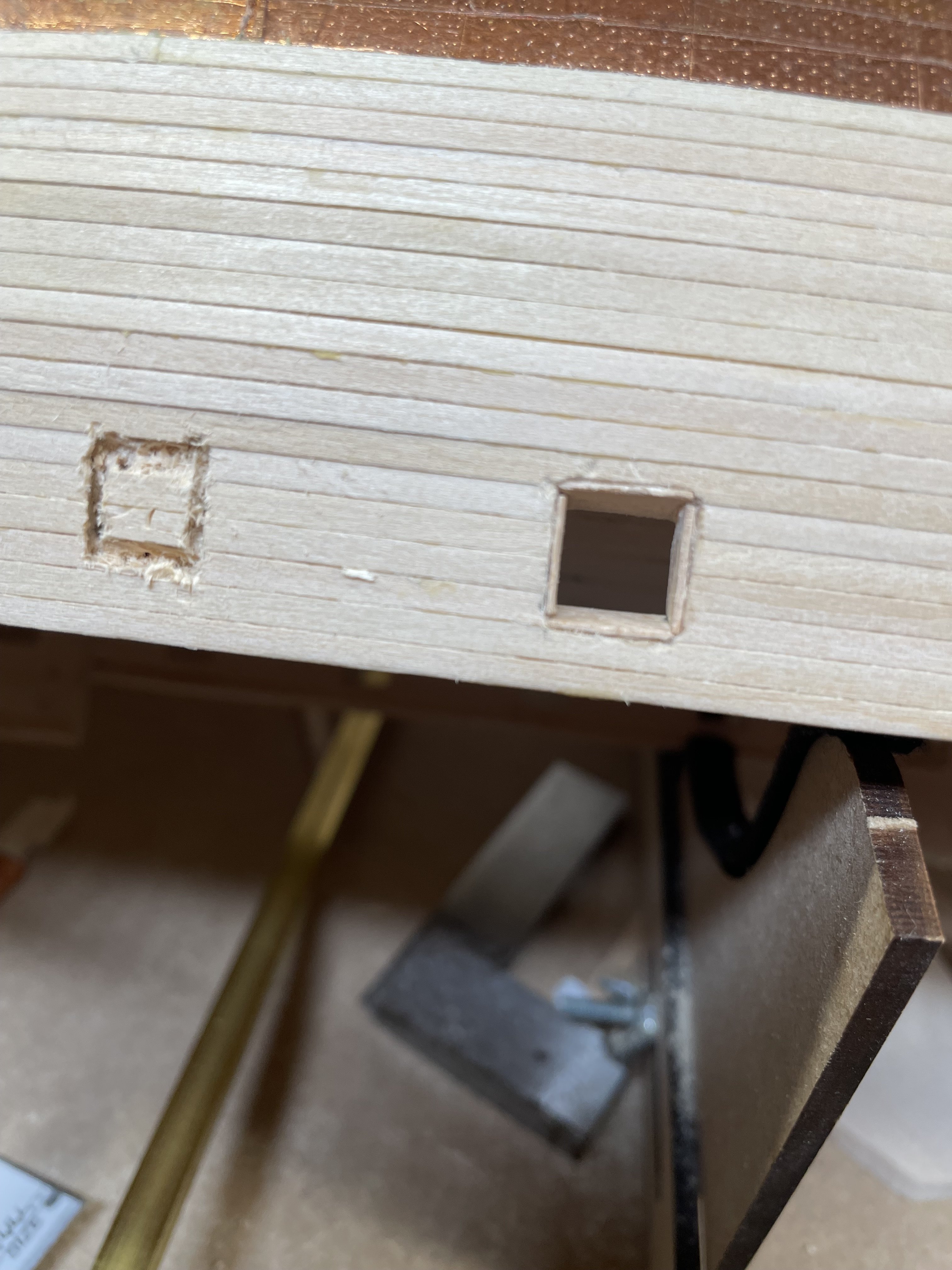

One of my fears was cutting the gunports in the right spot, so they were the right height above the deck, the right size and that port and starboard lined up. I started by making a mirror-image of the side view plans, then taping those on each side. I used the edges of the waist to align my template. Then I used a 1mm drill on a dremel to score the outline on the template.
My first attempt was pretty successful. The holes were in line and the pert side was 0.49” above the deck, while the starboard was 0.48”.

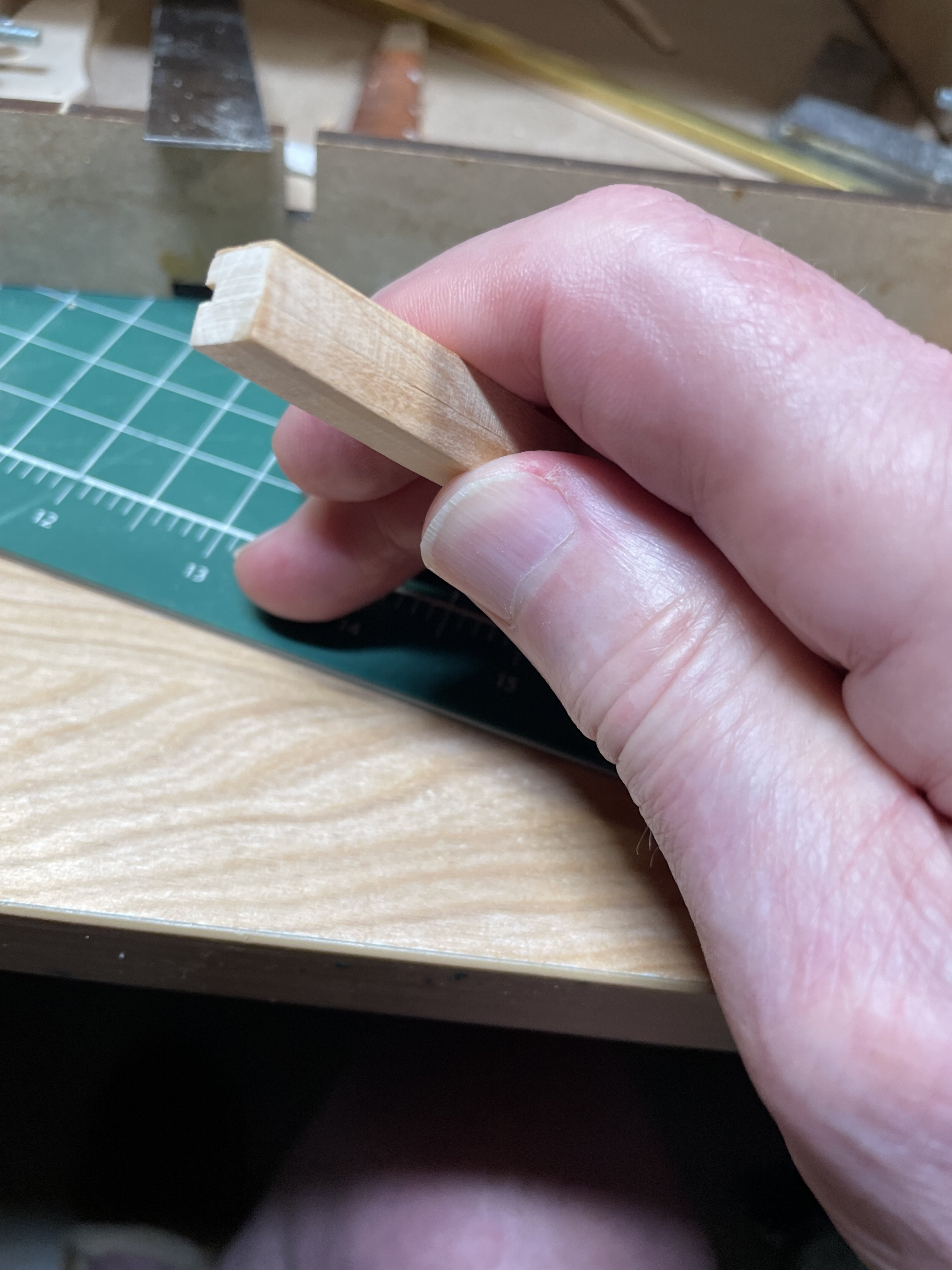

I made a little jig to test each opening. Just a few scraps glued together, whose sides were 11/32” or as close as I could get it. To finish the holes, I would add slim wood strips or sand down high spots.
And that’s where I am.  Thanks for your interest.

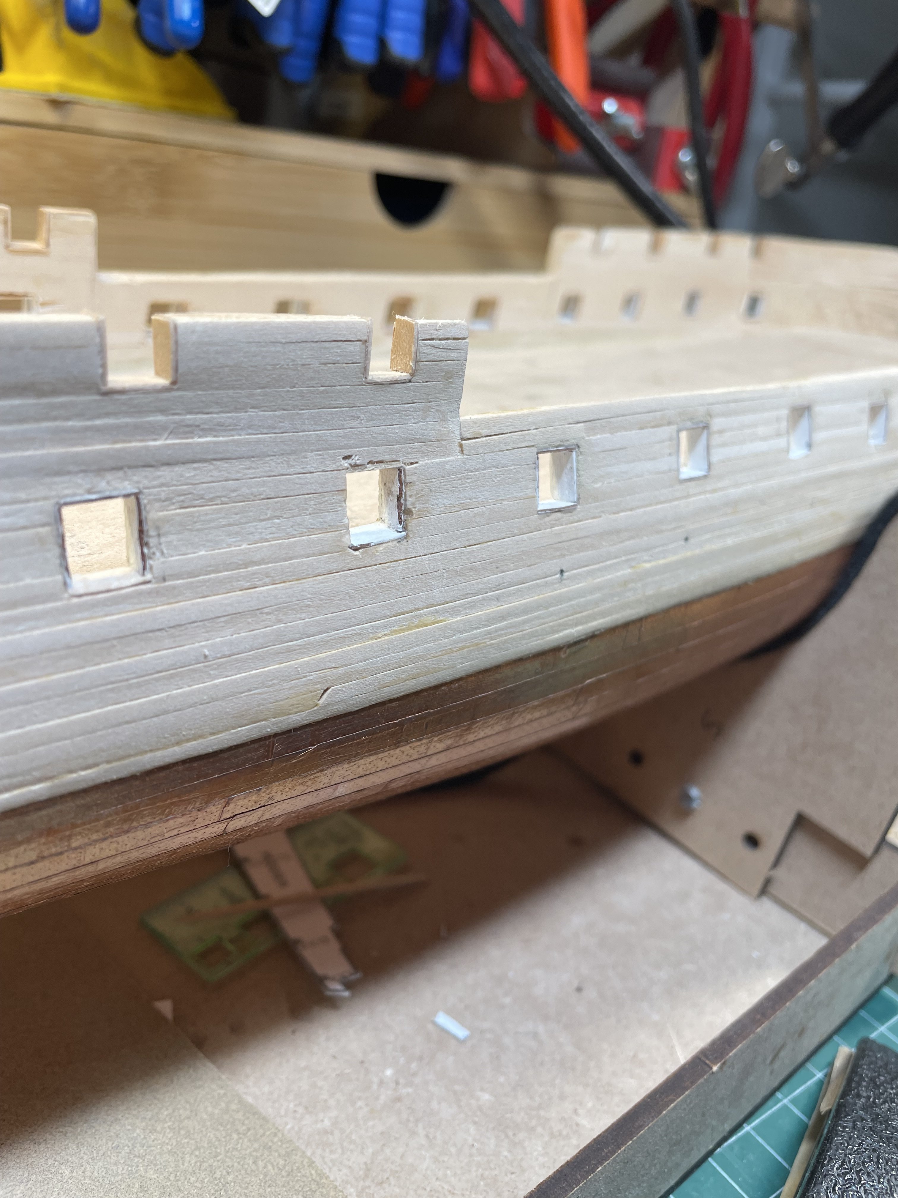

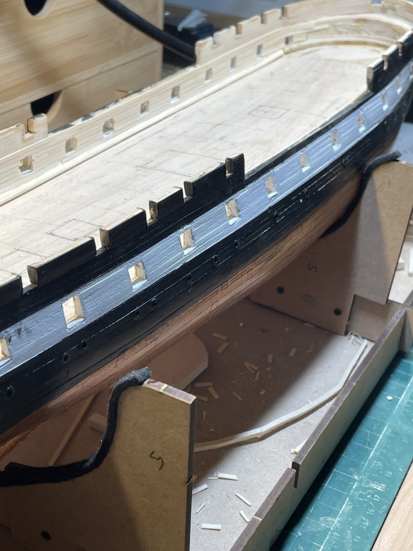

This week I made good progress on the hull. The gunports on both Gundeck and Spardeck have been cut. I thought they were kinda ragged, so I lined all with 0.20 planking from a previous kit.

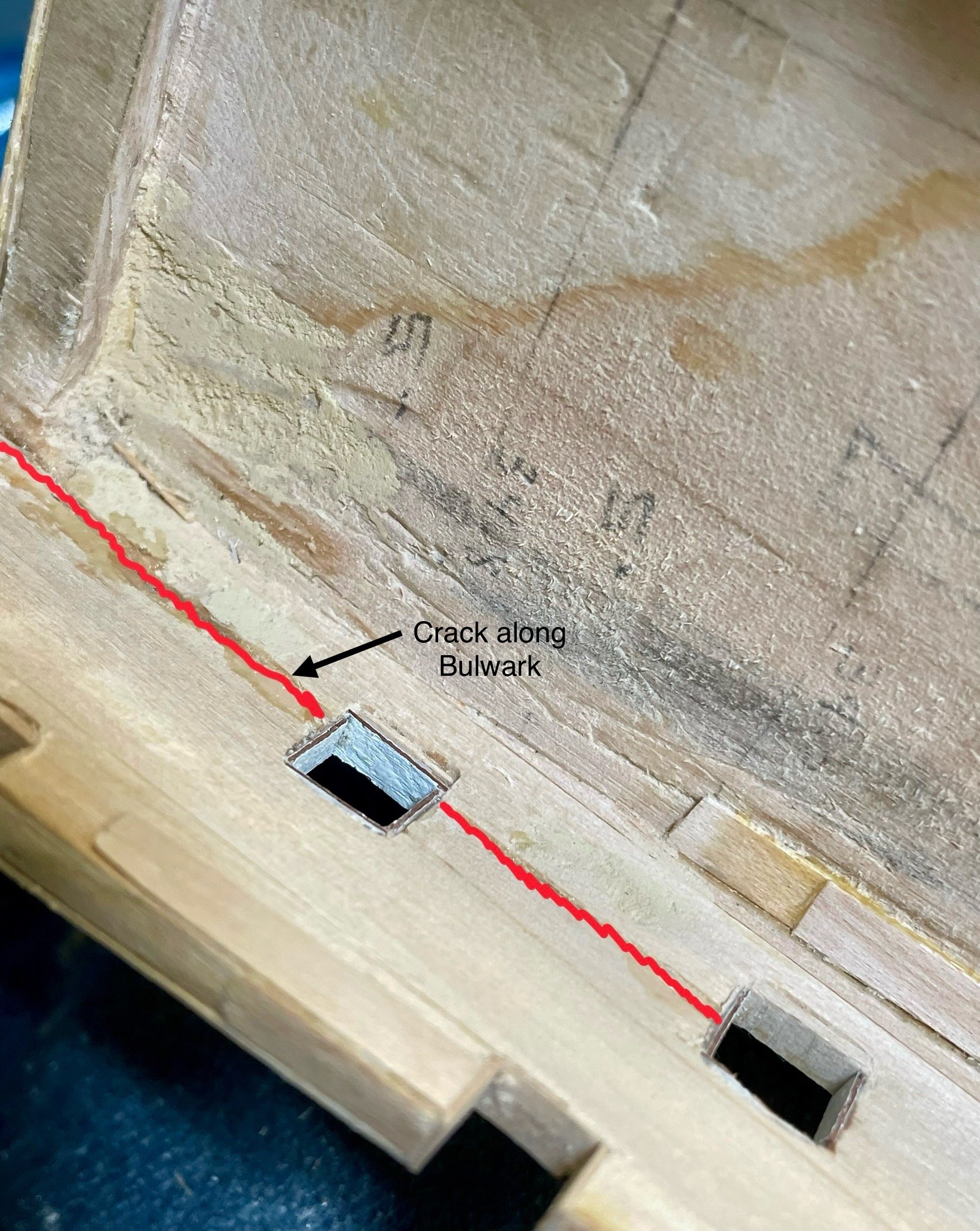

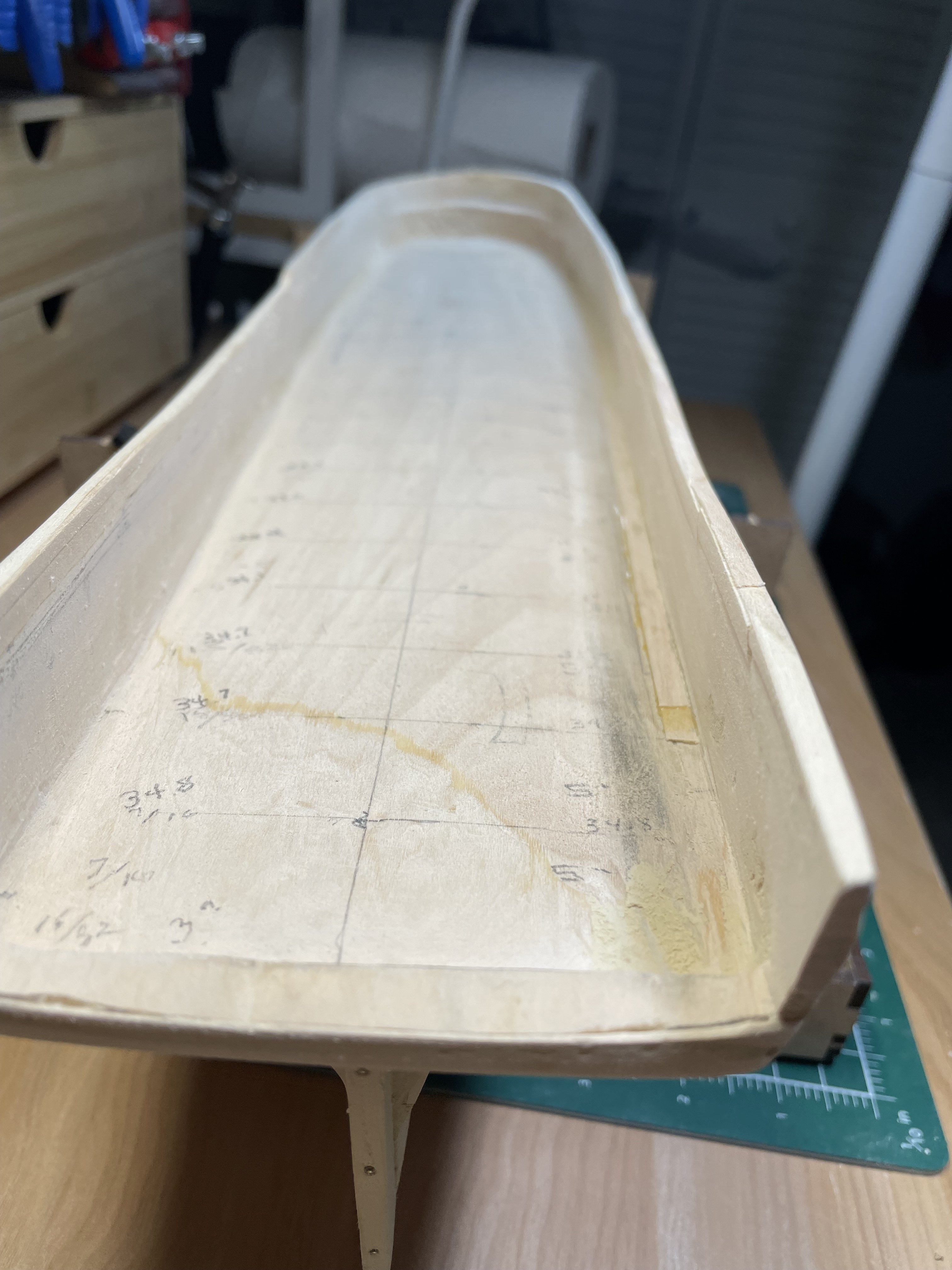

During the process, I managed to crack the starboard side bulwark, which made that side weak. I tried to strengthen that area with epoxy.
The epoxy helped, but I needed more stability, so I placed the transom supports at the stern. The combination of vertical and horizontal struts seemed to fix the wobble. It still scares me a bit that the bulwark can move. If anyone has any suggestions please feel free to share.
And, as you see, I added the airports below the gundeck.  The hull is just about ready to paint.
After painting, I think it’s time to finish the rudder and the stem.

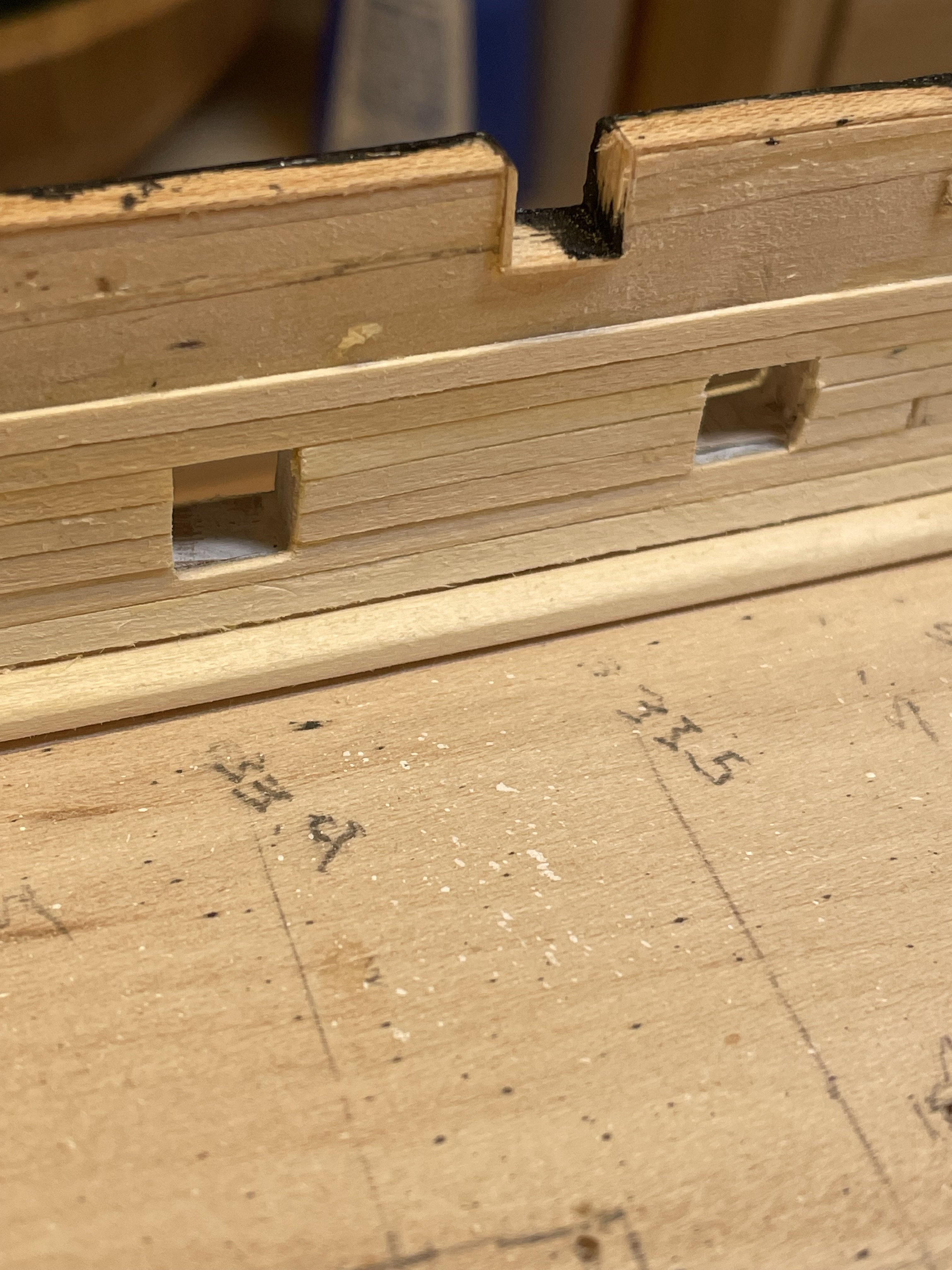

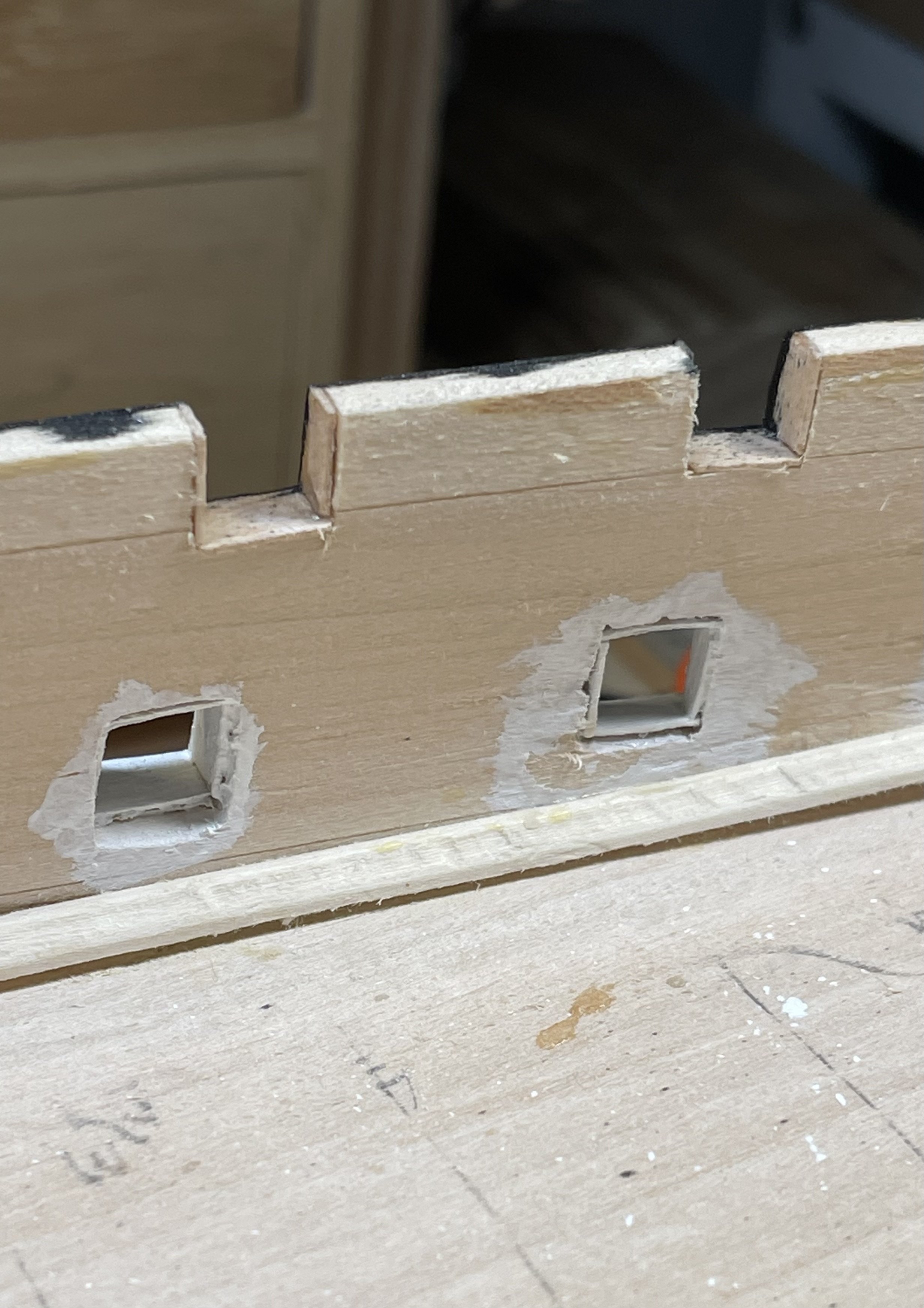

The gunports are all cut and painted.

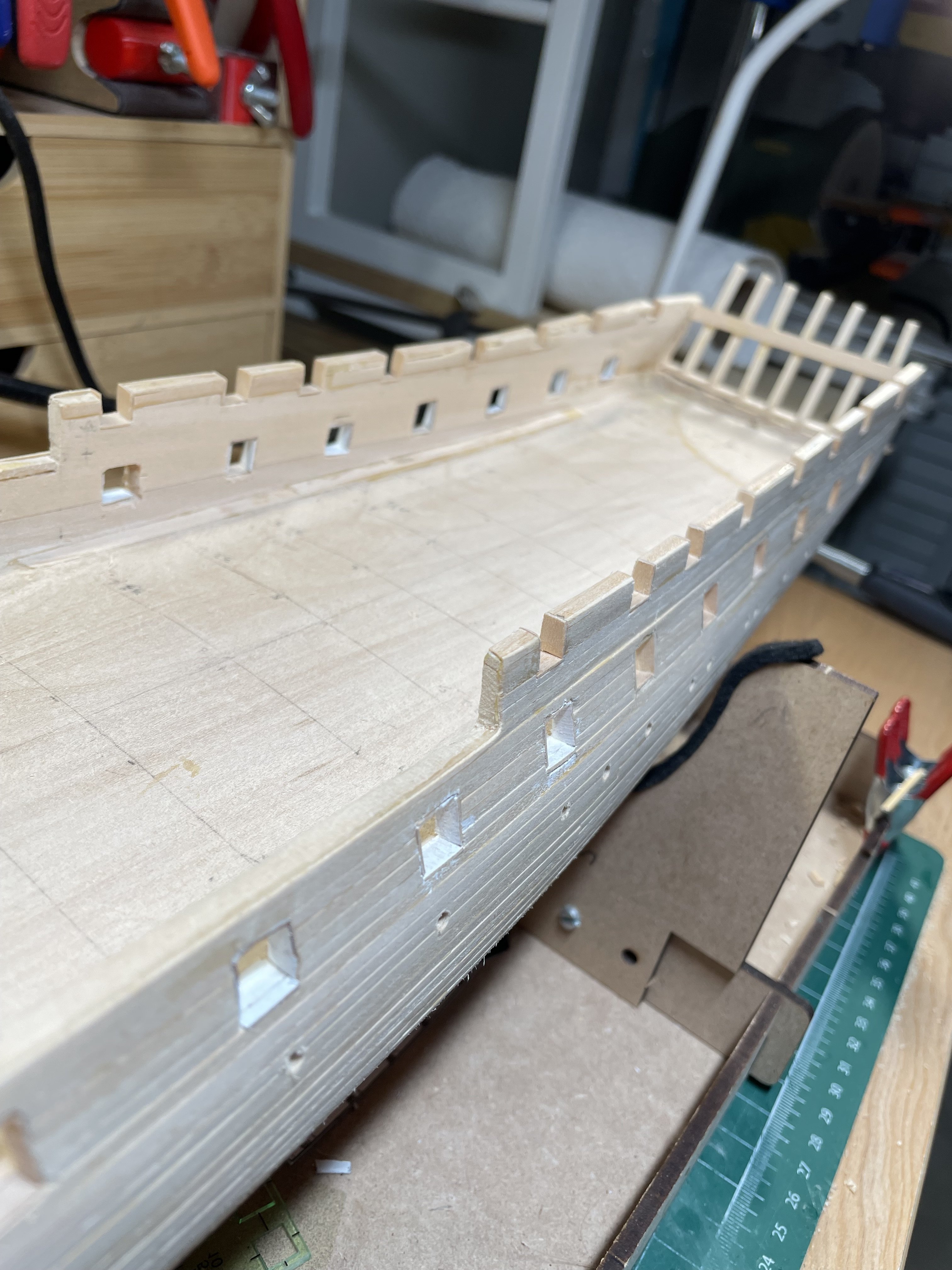

I discovered that my bulwark was not 5/32 throughout. It called for wider frames to cover and level each of the ports. I hope this doesn’t create issues when I add the cannon to the deck.
I filled the gaps with putty and then added framing pieces to create a flush-ish surface.
The waterway was also installed.
It was time to plank the interior bulwark.
Next steps are to paint the bulwark white and get the deck ready.
I’m concerned that the line between the gundeck ceiling and spar deck will fall somewhere above the top part of the gunports and I’m going to need to peel off some decking to put the waterway in place.
That’s where we stand now. I’m pretty sure I can get the deck in this week. I’m using the premade deck that is part of the kit.
