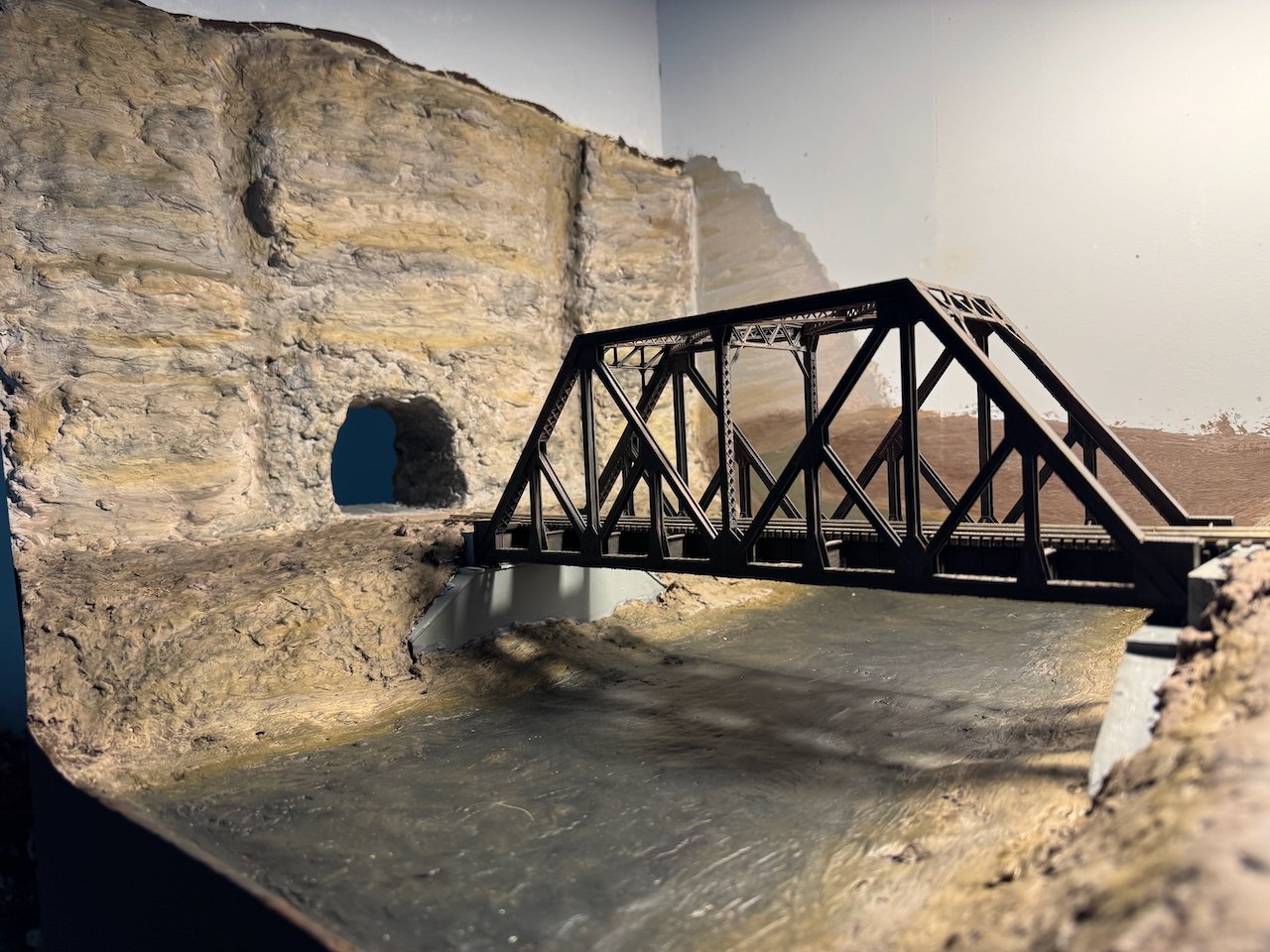

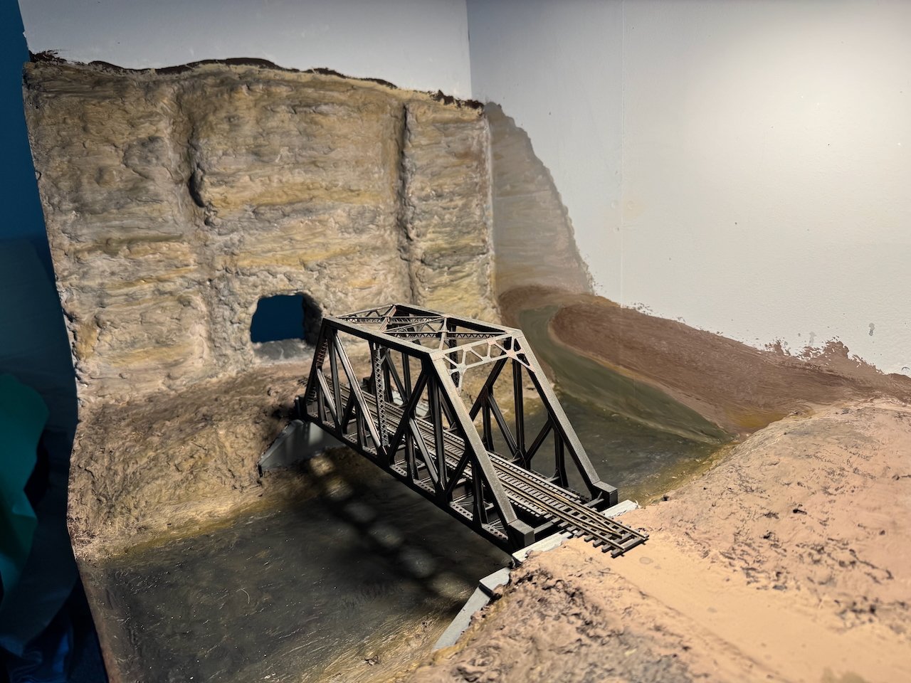

Made some progress on base-layer scenery painting this week, taking a few minutes over multiple nights to slowly build up layers of color. Right now, without any vegetation, it looks like somewhere in Utah or Wyoming. But that'll change.
I also took a first stab at some basic backdrop painting, just trying to add a hint of hills/river extending into the background. This isn't meant to be photo-realistic, just enough to let the eye realize that it's not all backdrop sky back there.
Also, the creek has been painted but I haven't added the model "water" yet, so it's just a dry surface. There will be multiple layers of "water" resin added, building up a sense of depth and a smooth surface. I also plan to tint the "water" some, as the real creek here tends to be pretty muddy, and this also helps fade the water into the painted "depth".
Most of the ground surface will be covered in various scenic materials to add texture, so the painting there doesn't need to stand on its own, but just provide an underlying foundation.
I'm not done with either the backdrop or the main bluff. Final touches on the bluff will include some more dark washes to bring out texture and cracks, and some vertical washes to simulate mineral streaking. The backdrop needs more texture, and the outer edges will be sharped up once I paint the sky (which I haven't done yet at all; that's just white primer).
But I thought I'd share progress and get feedback. You can at least get a sense of where I'm going with this.

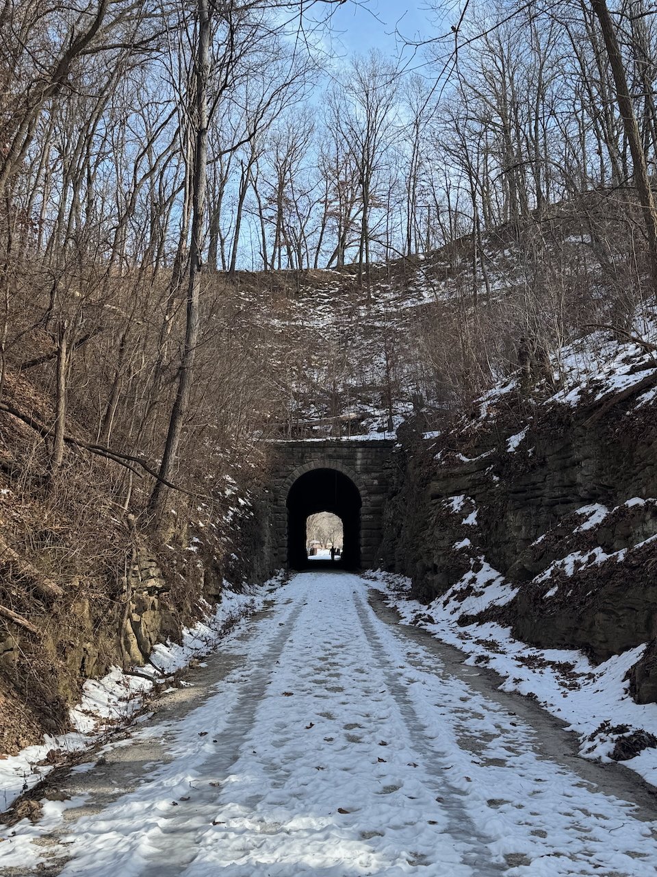

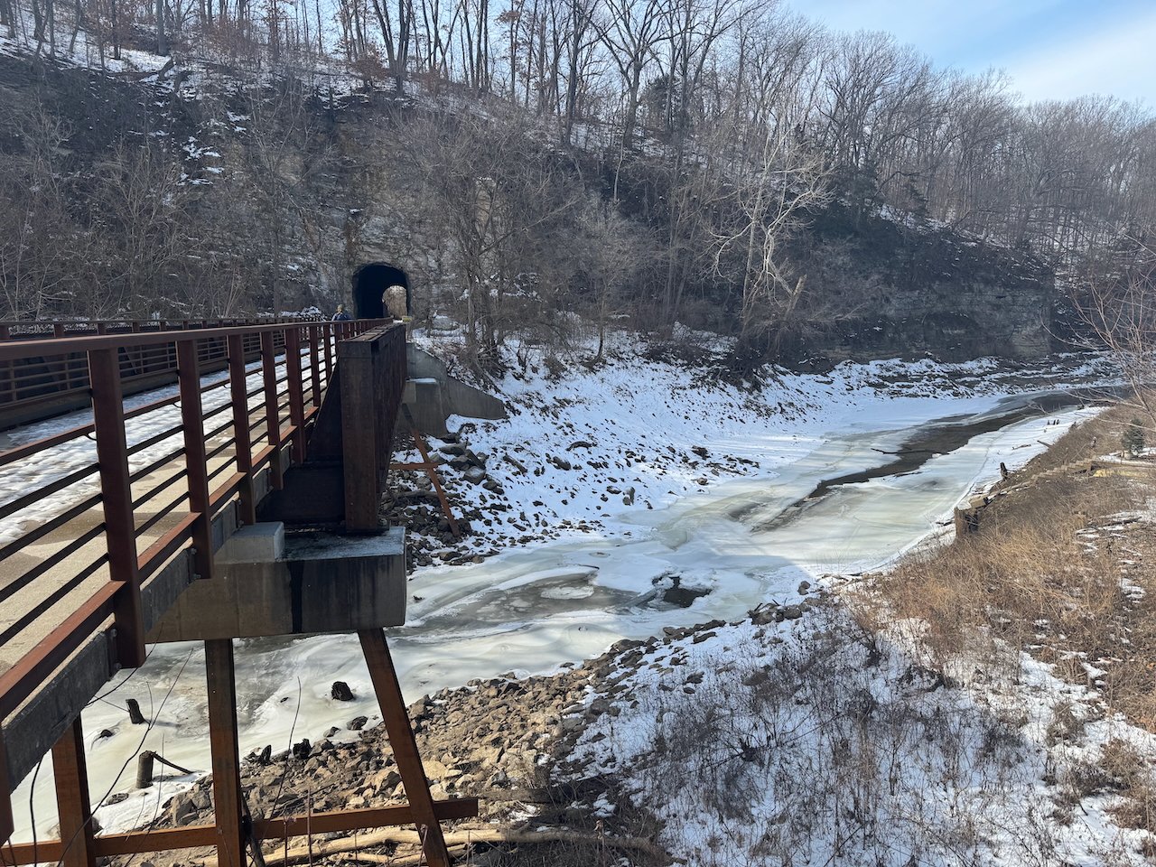

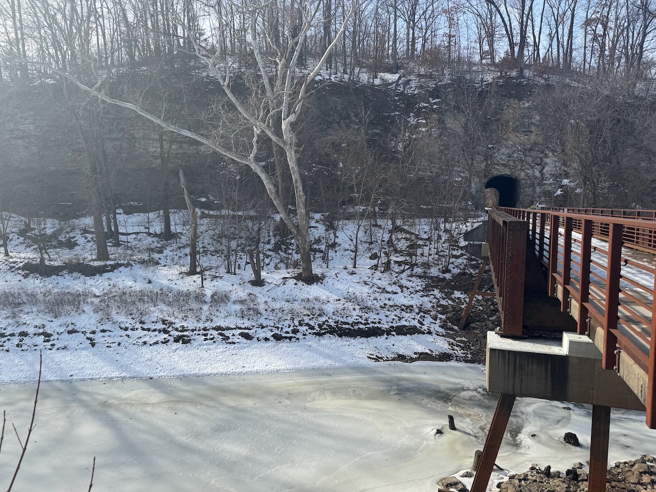

Oh, and here are a few more winter context shots. I'm going for late fall, so no snow or ice, but otherwise the color palette is similar.

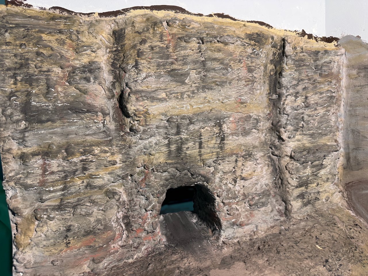

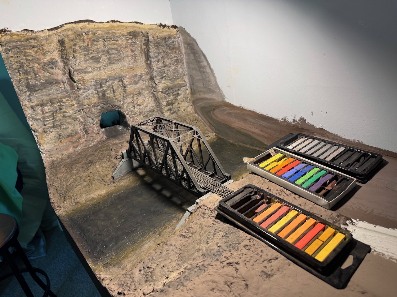

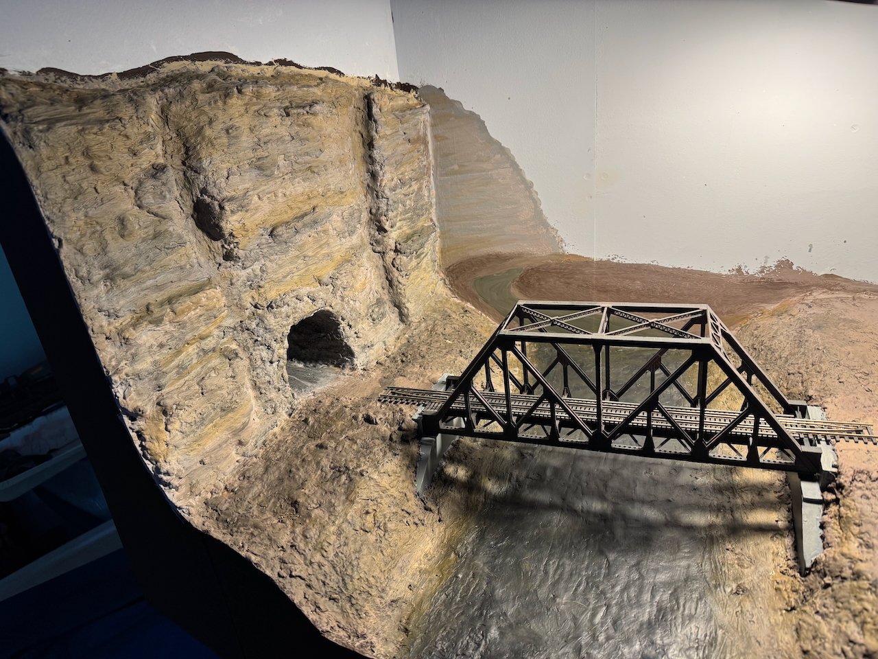

I spent some time this morning adding color & texture to the rocks using artist's pastels. I use these all the time for weathering models, and they're really effective at finishing scenic settings as well. They don't drip, and can be rubbed in with fingers or brushes (old toothbrushes work really well). Their powdered texture adds a "softness" to rock faces that paints don't, which helps them feel more realistic. I also touched up the backdrop with these, which again softens the painted took and allows more subtle textures than paints do.
Here's a broad view:
Here's a closeup of the rock face. The pastels let me add mineral staining as well as streaks of white that simulate the various layers of white-grey chert laced within the limestone beds. I also added smoke stains above the tunnel.

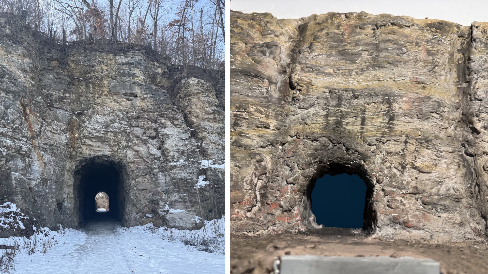

And for further comparison, I made these three sets of photos with similar perspectives. First, modern portal and model equivalent. This shows one thing I didn't get right; it's becoming clear to me that my tunnel shape is a little too squat; it should be taller for its width. Can't change it now and it'll still clear trains fine.
Second, historic photo directly down the tracks and model equivalent:

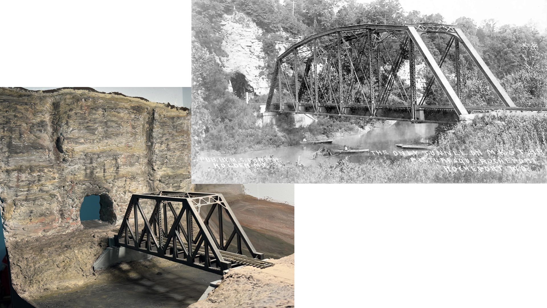

Third, historic photo from side and model equivalent. I've mentioned this before, but I know the bridge doesn't quite match. For now I'm using a simple kit; someday I'd be happy to build a  closer-matching bridge from scratch but it's not my priority.
I think I'm happy with the coloration, so the next step is to move on to things like adding ground-surface texture, water, and eventually trees (so it stops looking like Wyoming).

Is there any faulting/fracturing in those rocks? On the modern photo it looks a bit like it. If so, these could be added perhaps with some ink washes?
Do you leave the pastels as they are, or will you add some 'fixative', as pastel artists sometimes used to do? Otherwise, how will you protect these surfaces in the presumable open layout. I also use pastels, but my models are all stored under glass-covers.
Good questions!
There is no faulting, though there are a handful of major vertical joints, which are already simulated. The ones on the model are a little more uniform top-to-bottom than the real ones, but I think they're close enough. Smaller "structures" you may be seeing are probably fracture planes where rock is locally spalling off the bluff face. I may experiment with using a dark pencil to draw in a few other fractures, but overall there isn't much in the way of vertical structural features crossing bedding planes.
I don't intend to use any fixative on these surfaces, as they won't be touched or handled. I apply most of my pastels with fingers and find that skin oil does a remarkable job of binding pastels to most surfaces. I've never used fixatives even on my ship models; I'd only do so for things like actual railroad cars that will be routinely handled.
This must be actually quite stable rock with little weathering - otherwise I would be worried, that after ice-melt in spring spalled-off rocks drop onto the tracks from the tunnel opening ...
Edited by wefalck
Oh, no, rocks are regularly dropping off that face and the other bluff lines along the route. I've got photos of dinner-plate-sized rocks that spalled off and got caught in the vines that often lace these bluffs, and end up dangling in midair like cargo in a ship's loading net. There's regularly little piles of debris at the base of the bluffs, and I've moved debris off the trail more than once at the tunnel mouth. It's mostly very small pieces, but it's definitely an actively weathering surface. I can only assume the railroad regularly checked the portal area for debris on the tracks, since they never stabilized it further.
To give a quick written recap of the geology at the portal, most of the bluff line there is Mississippian limestone laced with chert beds. But paleo-karst is quite common in these rocks; there are many places where old caves developed in the bedrock and then either collapsed and filled in with Pennsylvanian sands. All along this route you can find unusual protruding outcrops of hard sandstone that are essentially filled-sink structures, more erosion-resistant than the surrounding limestone, so remaining behind as filled molds when the limestone dissolves.
As it turns out, this portal is drilled right into one of those collapse structures; 10 m to either side and it's solid limestone, but right where they put the bore, it's a complex massive breccia of chert and other rock fragments that collapsed into the paleokarst. This extends well into the tunnel, pretty much as far as to the point where they started the brick/stone lining out to the western end. Like the other filled-sink structures, it seems to be relatively solid and well-cemented, and most of the debris I see coming down off the bluff is from the limestone spalling off higher up, not actually chunks from the breccia. This observation fits the fact that the railroad never bothered to line this part of the tunnel, so seems to have realized that the filled-sink breccia is in fact quite stable, despite looking like it shouldn't be.

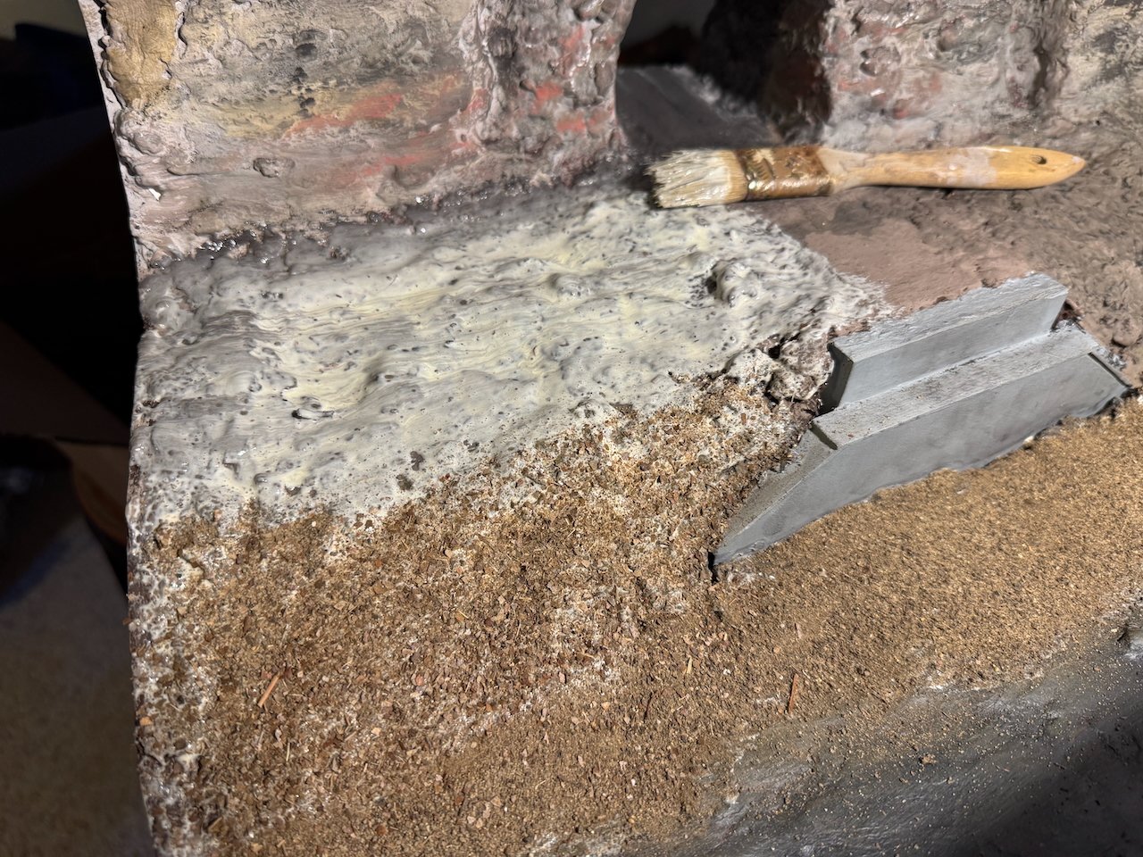

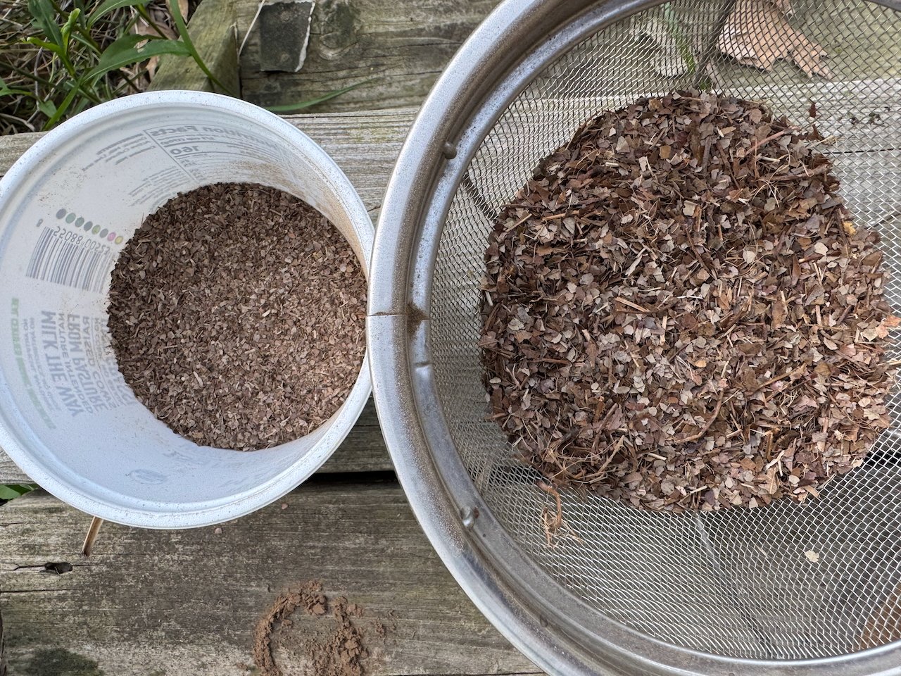

Got a little more scenery work done this weekend. It was time to start adding texture to the riverbanks and ground surface, so everything doesn't look like smooth plaster. As I've said before, one of the reasons I'm setting this project in late fall / early winter is that it lets me produce a lot of scenery material from natural sources rather than buying lots of plastic/fake stuff. It's hard to maintain a natural green color, especially one that looks real, but natural brown tones are a lot easier to come by.

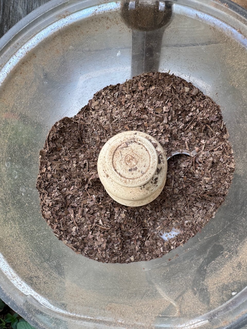

I started with a bin of dried leaves I'd set aside, running these through an old blender in batches to pulverize them. Some bits never shred all the way, so I used a sieve to select for the smaller sizes.
In my head, I call this blend "fish food" because it looks an awful lot like the flakes used to feed aquarium fish.

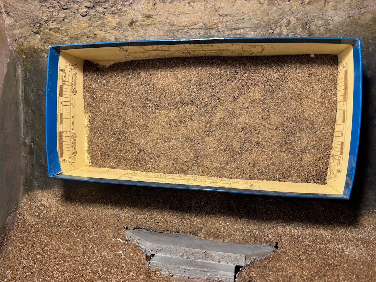

Similarly, I collected a batch of fine sand from the creek on my property, which has the same geologic setting as the headwaters of the creek depicted here. A similar sifting process gave me a blend of scale "gravel". In both cases, using natural materials gives a spectrum of subtle natural color variations that I find a lot more visually complex and realistic than purchased scenic materials with a limited range of tones.

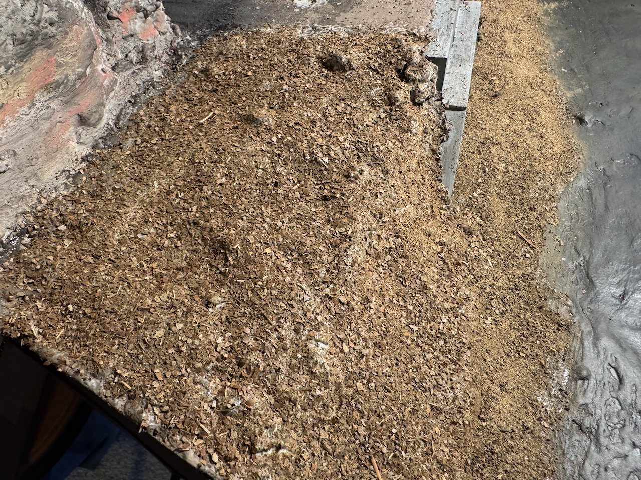

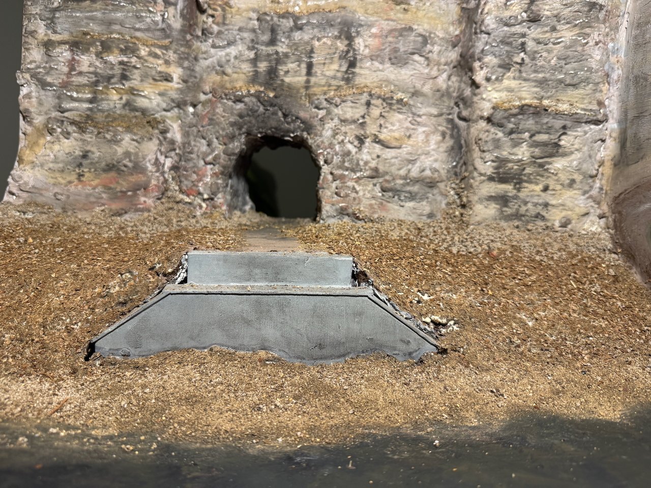

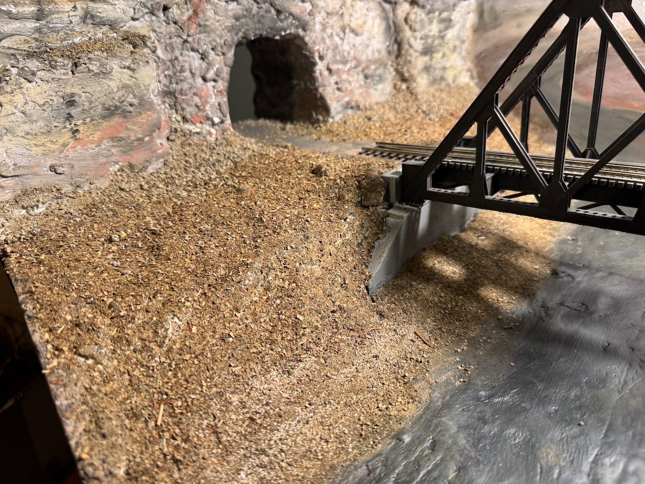

To apply this on the landscape, I brushed full-strength glue over the painted plaster, then sifted/sprinkled material onto it. I ran a band of nearly pure "gravel" along the creek, then slowly reduced its quantity as I worked up the bank, increasing the proportion of leafy material. By the upper floodplain surface, it's almost all leaf material. To my eye, this gives a really natural looking transition out of the creek and up into an area that will have a lot more trees and vegetation. IMG_9398.jpeg.8de8838282d1efd48fe3d808f1cde30d.jpeg
All of this material is coarser than true scale, but I find that it helps the eye "see" the right texture. In my opinion, true scale material would be so fine it would "look" too smooth. A strong modeling belief I hold is that it's just as important that a scene "look" or "feel" right than that it "be" right. And to my eye, this creates a feel that the eye connects to real landscape textures even if it's technically out of scale. The random chaos of the particle shapes, in both the leaves and the sifted sand, also helps create a more natural-looking texture than purchased material that tends to be more uniform. At least that's my opinion. And philosphically, I just love that these scenic textures are all-natural and sourced from a landscape near the actual real-life scene.
Here are a couple broader shots showing the finished effect on this bank. I also added some coarser rock material along the base of the bluff to blend the transition from vertical to horizontal, and to produce the effect of fallen rocks that's very much there in real life. I'm finding that the finished textures looks different in these photos than it does in person, though, and my phone isn't handling the depth of scene here well.
But that gives the idea. I haven't run this by my in-house landscape expert, though, so we'll see what she thinks. It can be adjusted if needs be. Once we're happy with it, I can start working on trees and other vegetation that will further tie the scene together.
