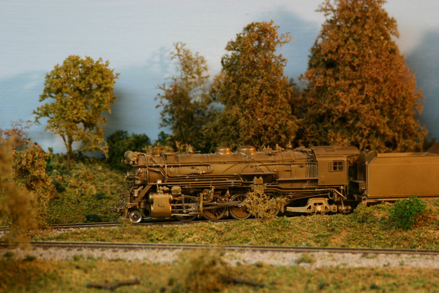

Missouri, Kansas, & Texas Railroad along the Missouri River by Cathead - 1/87 (HO) scale - model railroad with steamboat
Eric,
This is all quite fascinating and informative for me, especially since you have a backgound in how landscapes are actually formed.
I look forward to each post (and Comments) on the bridge and tunnel scene taking shape.  Keep 'em coming, thanks.

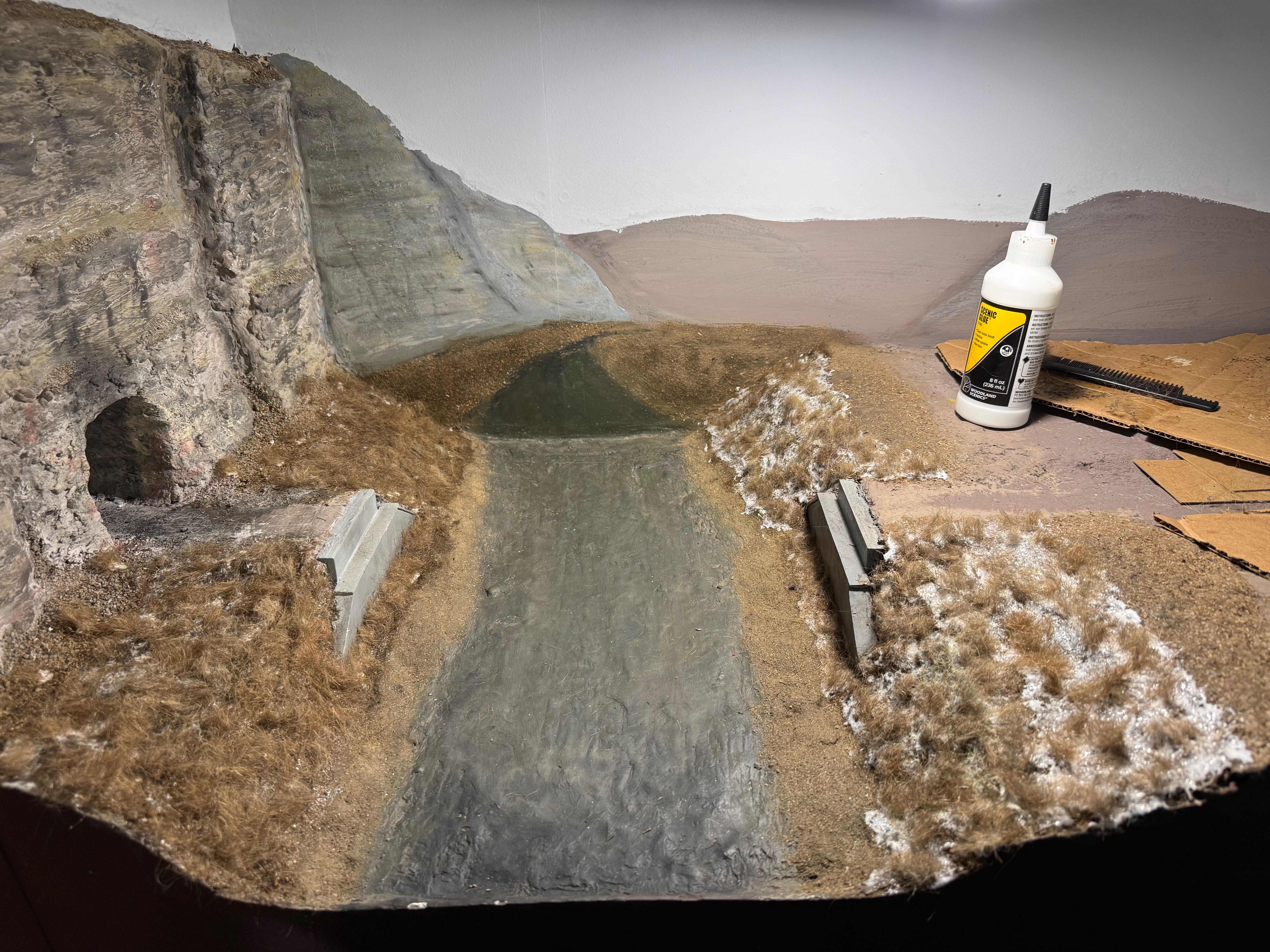

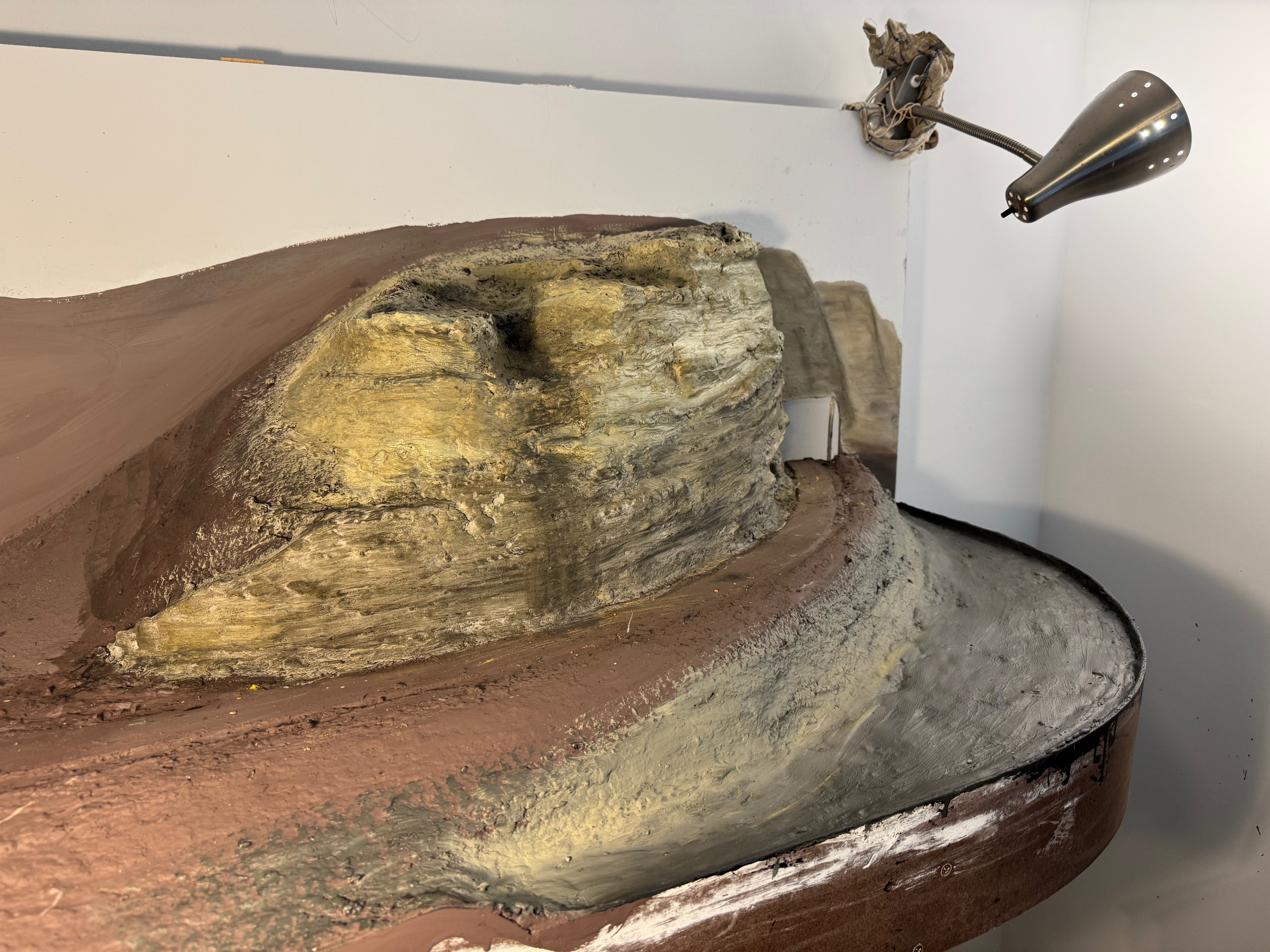

Having said that, I should have waited to post the results above. Shortly after I did, Mrs. Scenic Consultant came in from the garden and had a look. She agreed that the material was coarser than scale, but also had a very good idea how to adjust it. She suggested rubbing off some of the coarsest outer layer, which I tried, and it worked brilliantly. What happened was that the material that had truly embedded in the glue stayed, dulling the painted plaster surface and giving a sense of texture, but some of the material that was sticking up more and really looking coarse went away, making the grain/particle size less obvious. It's a bit hard to explain this change, but I tried a series of photos this morning to see if I could get the comparison across.
(1) Original painted plaster creek bank. Too smooth, uniform, and shiny, though the color and base shape are good:
(2) Sifted leaf and sand application. Improves the texture and complexity, kills the "shine", but a bit coarse (I started to realize that the flatter surfaces looked a bit like a power company wood chipper had been through). And the area along the creek bank is a bit too gravely for an area that in real life is mostly muddy rather than rocky:
(3) Same texture after the upper layer has been rubbed away. Now there's a more subtle blend of "powder" and coarser material dulling the surface, maintaining that complex natural non-plaster look, but less of the "wood-chipper and gravel" effect:
I thought (2) was fine until I saw what (3) accomplished, and that's now the new approach. The material that gets rubbed off can be collected and re-used elsewhere, so it's not a waste.

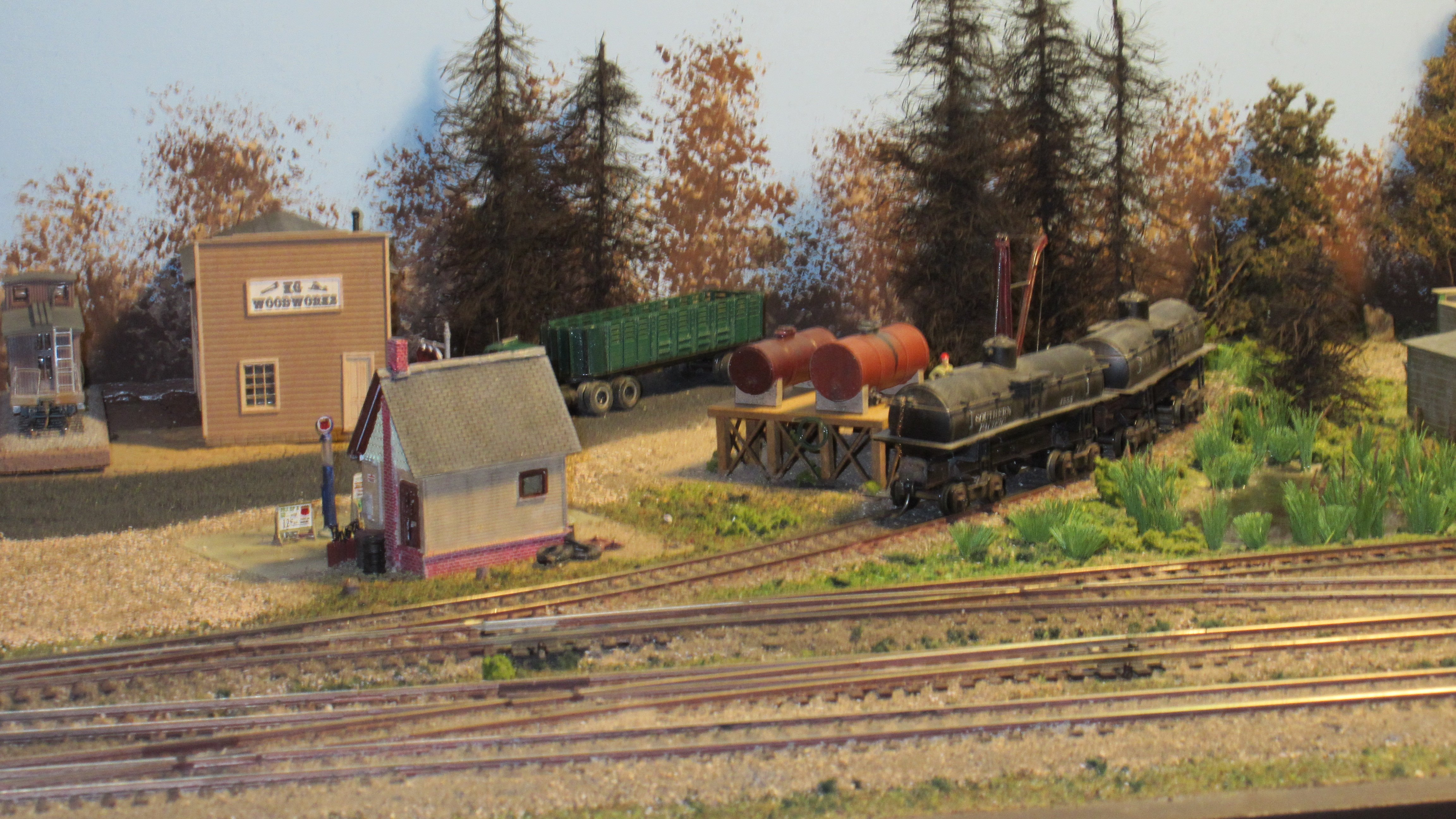

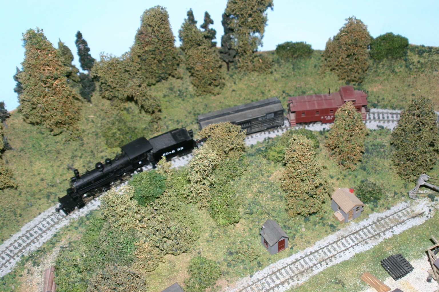

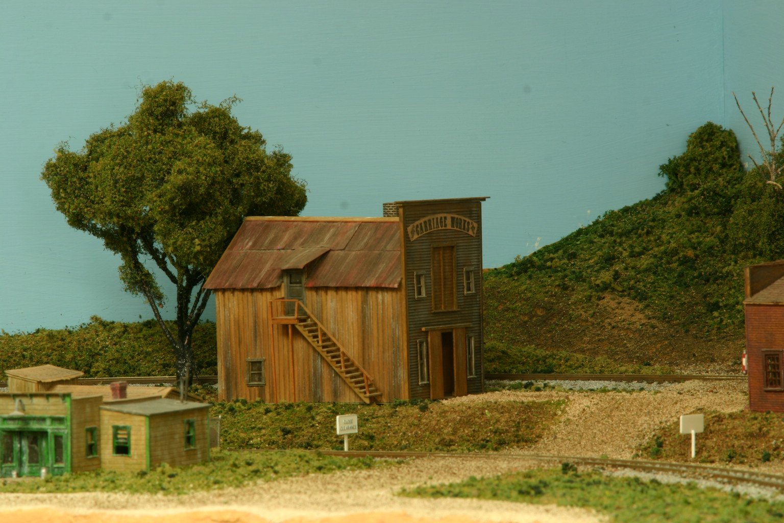

Just some ideas for ground cover.  Most is woodland scenics some trees are scenic express and the pine trees are made by me and the big tree behind the building is made from a sagebrush branch and then ground foam for foliage.  Don't forget to add some branches or sticks as dead fall trees or dead standing trees.  Makes the scene more believable.

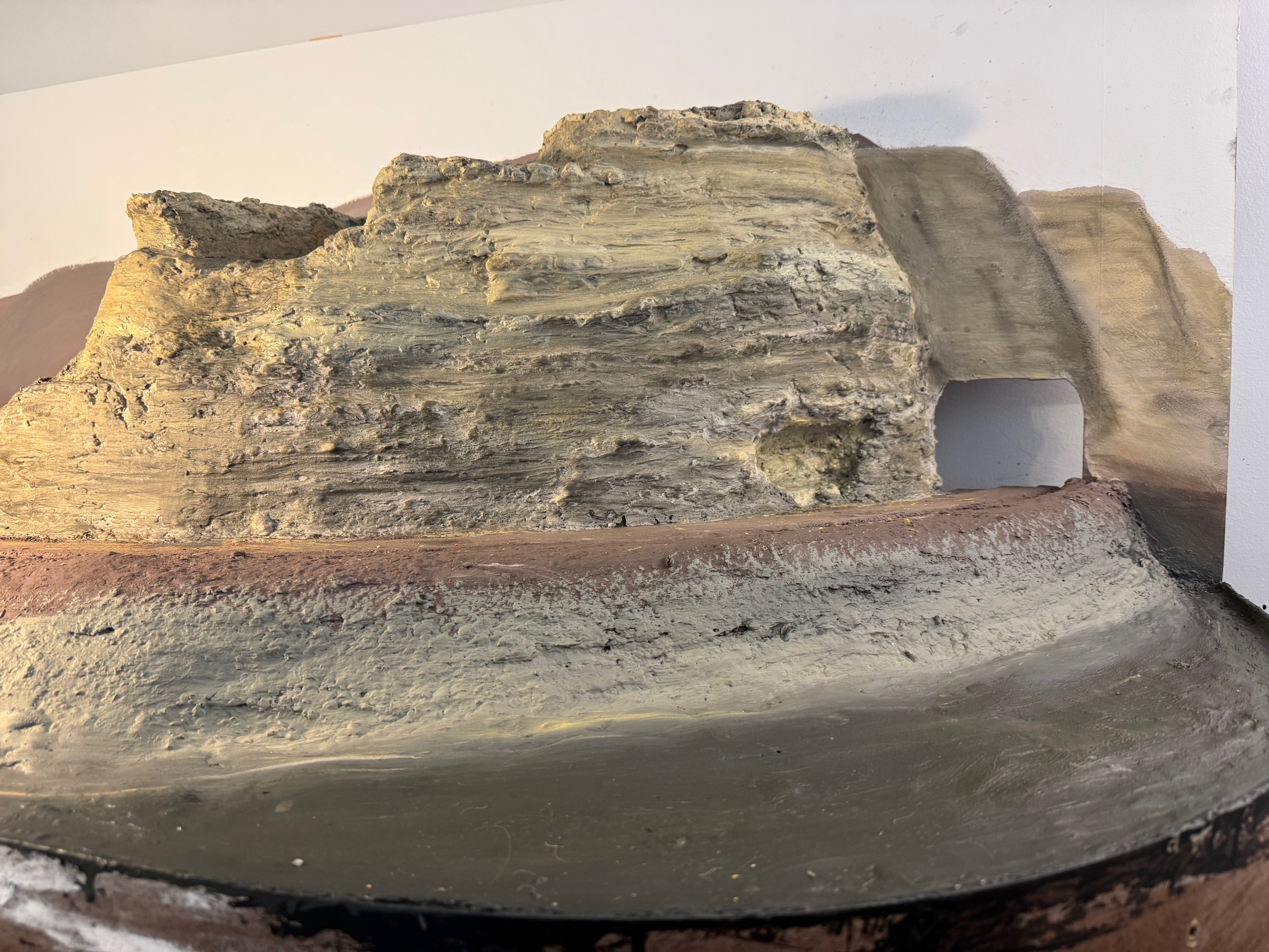

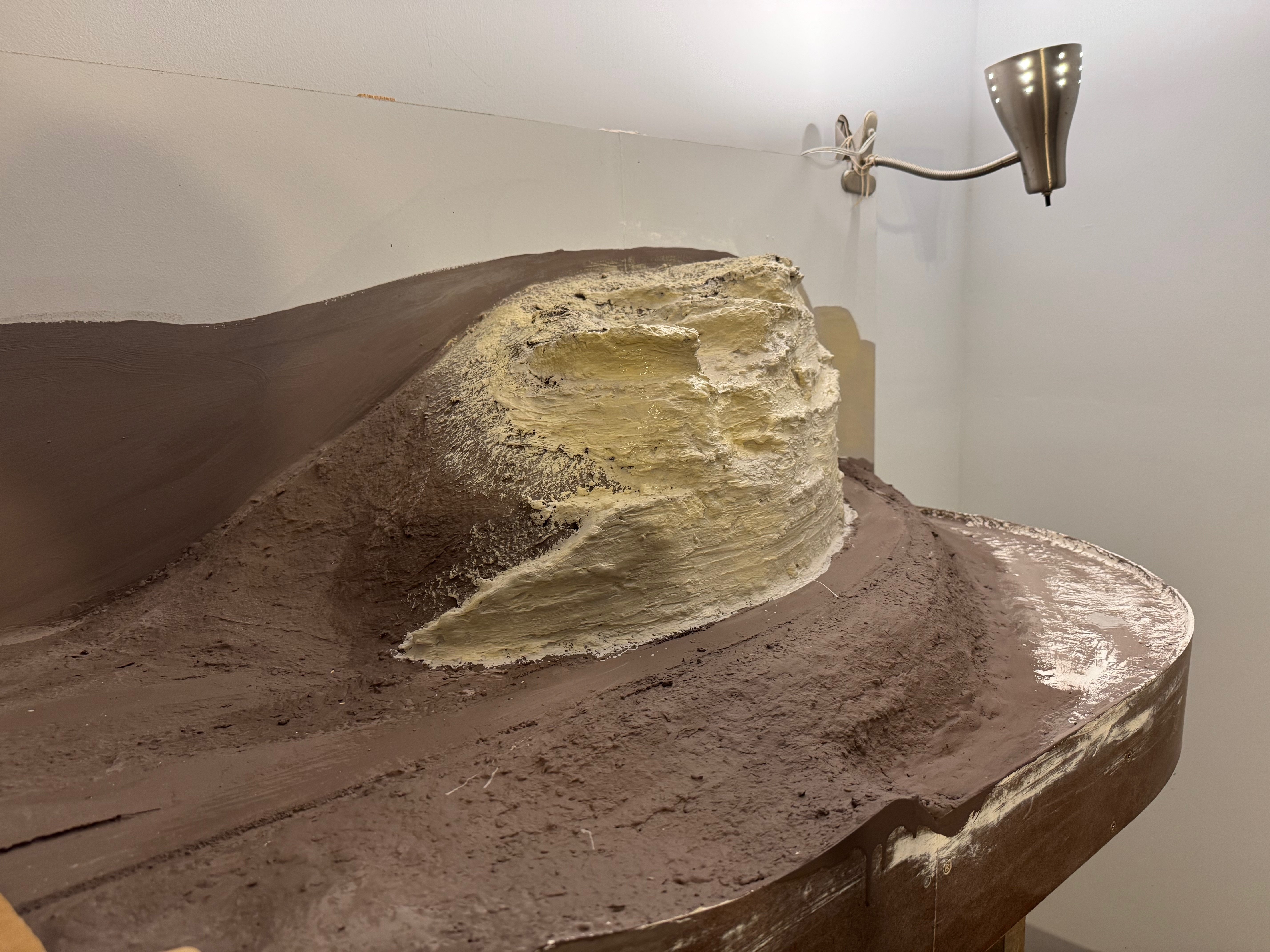

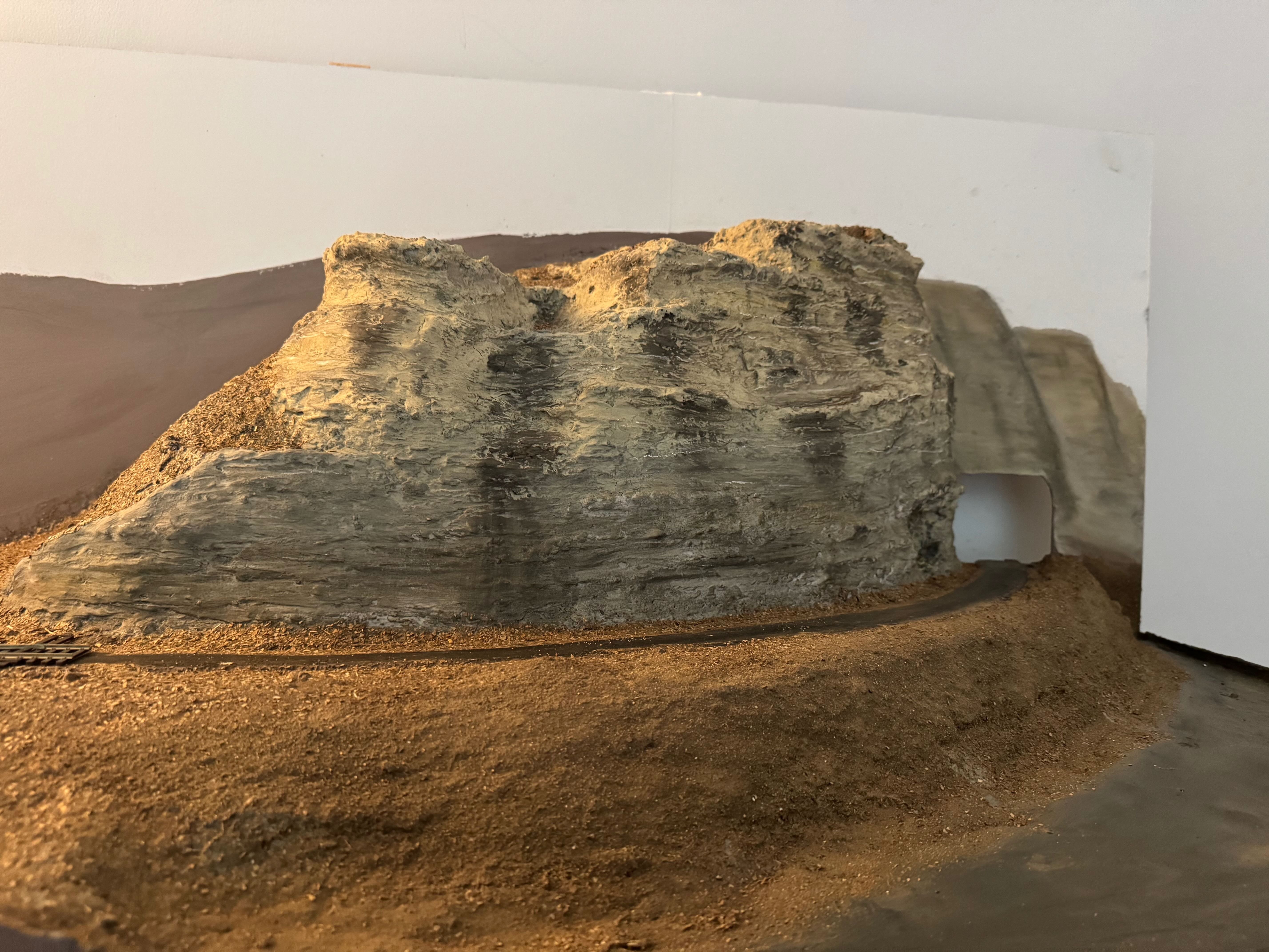

I've made broader progress that I'm not quite ready to write up yet, but here's a narrower update on a minor upgrade. The shape of the tunnel has been bugging me; it seems too squat. It wasn't really obvious to me until I'd finished the bluff, but now I can't un-see it. I think you can see what I mean in the paired photo below. The real one is significantly rectangular; mine is nearly square. Bugs me.
So I decided to renovate it. This meant raising the ceiling and narrowing the sides. Starting point:
I used a woodworking tool I had in a drawer, a rotary rasp that chucks into a power drill. It's meant for rough shaping of wood, but boy is it perfect for boring out a tunnel.
Then I filled in the sides with some new plaster.
Gave it a fresh base coat of paint:
And weathered it down:
That's much better. The beauty of this is that I'm modeling the period not long after this tunnel was freshly blasted. So it's actually perfect to have the area right around the portal look a little disrupted and different from the rest of the rock. I didn't weather it quite as much, leaving the color a little fresher.
I'm pretty pleased with how this came out. Just shows it's worth going back and reassessing your work now and then.

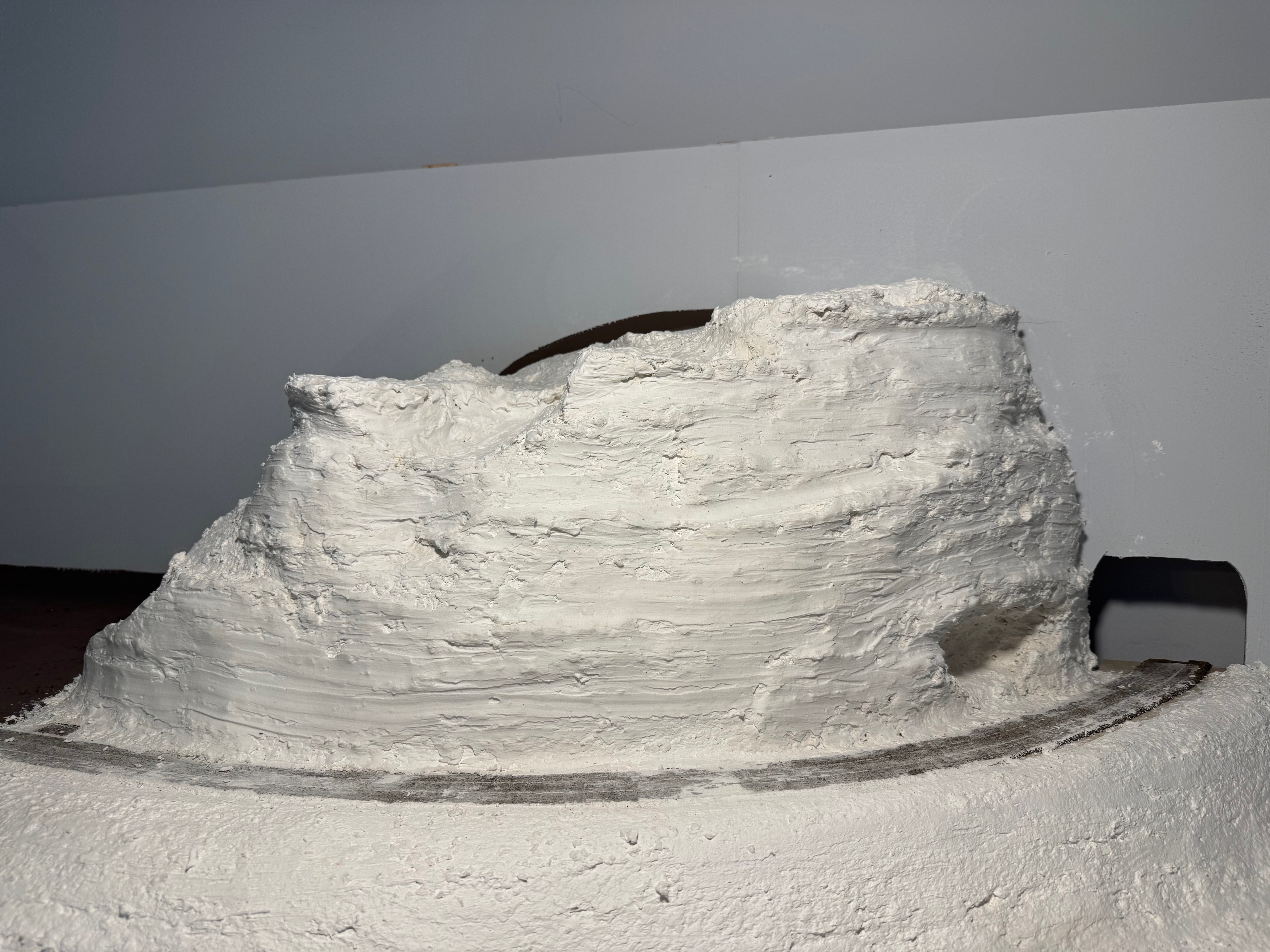

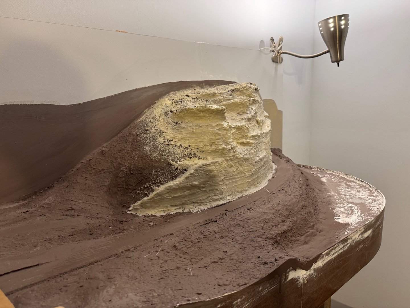

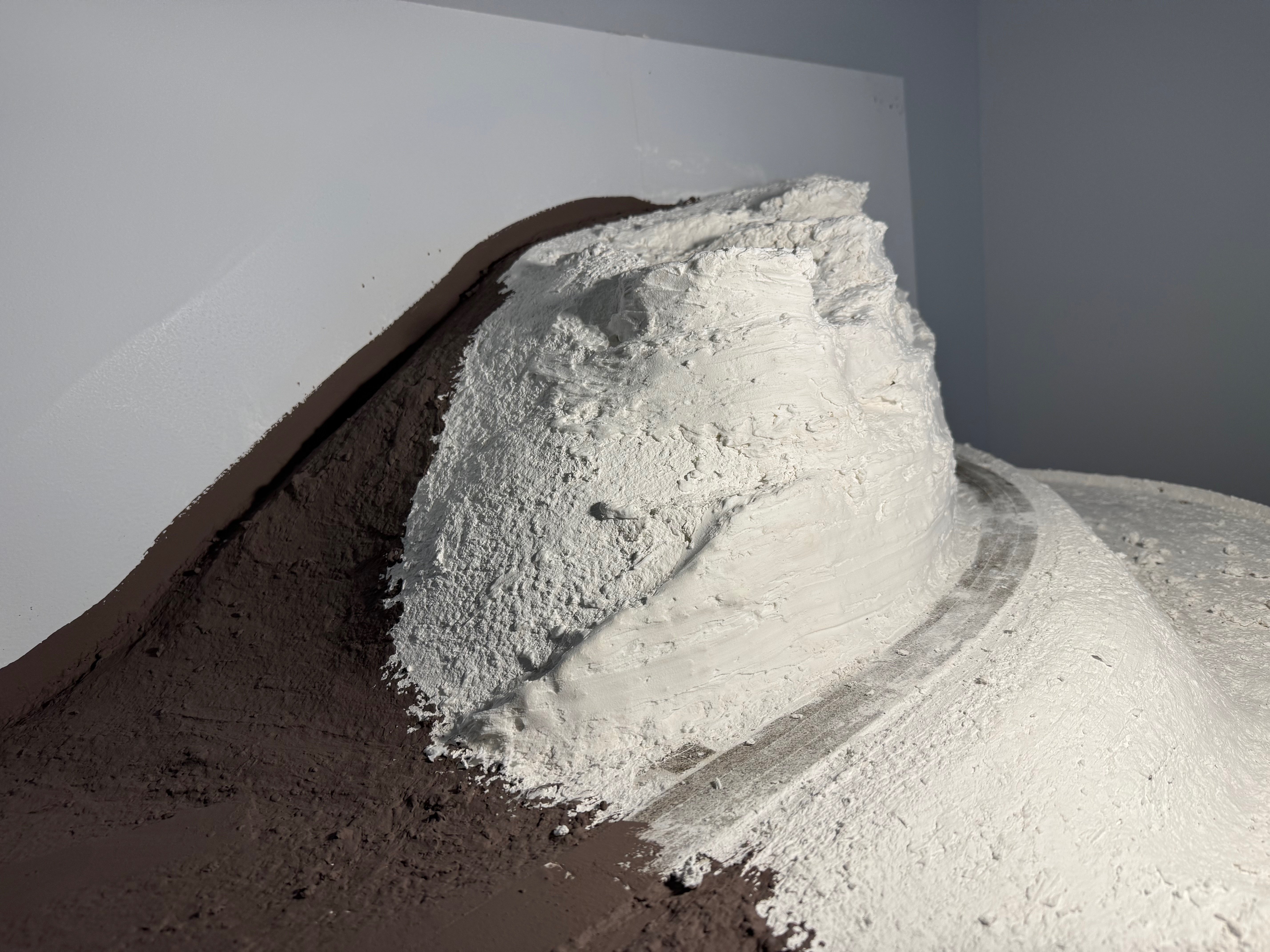

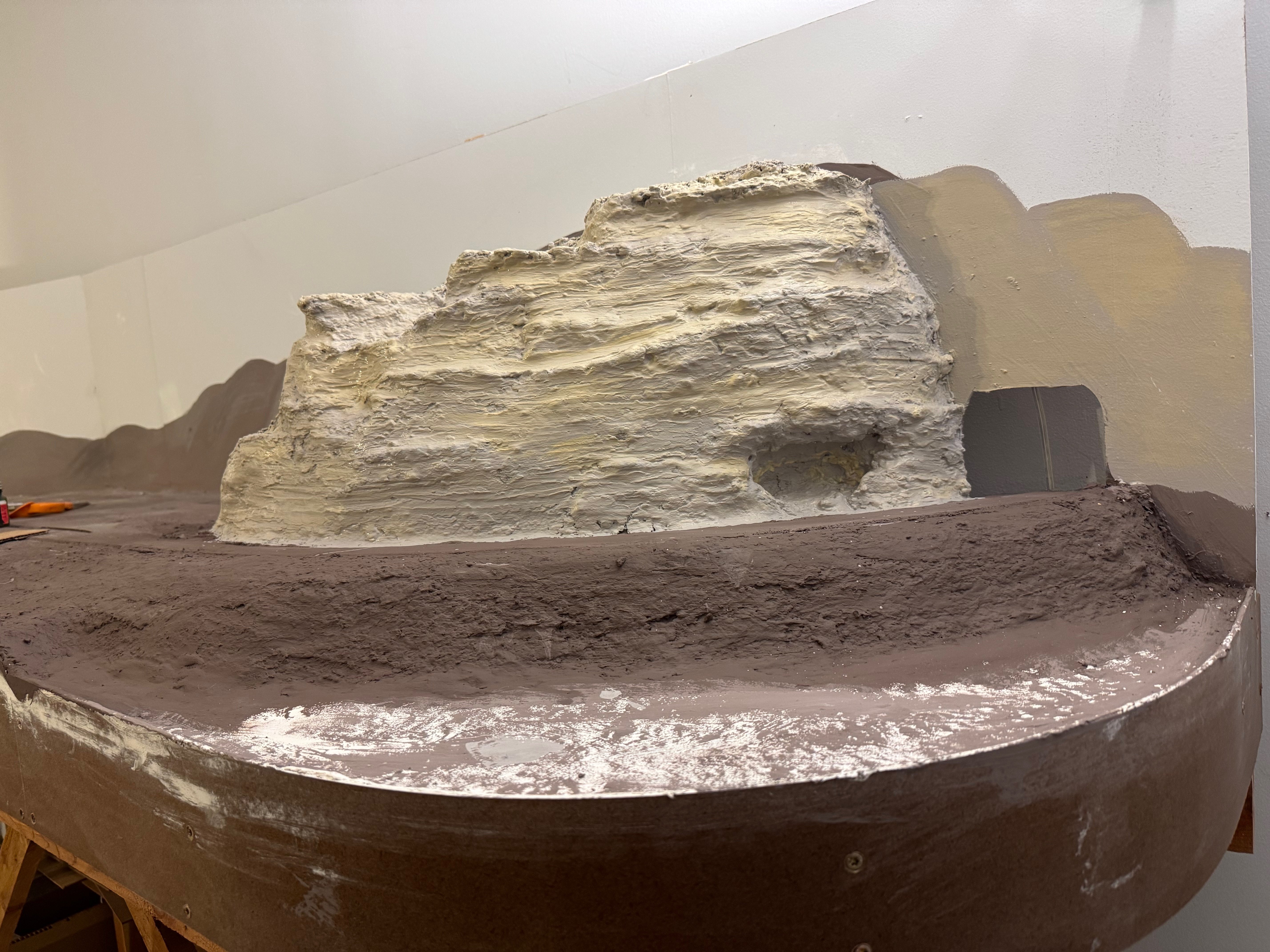

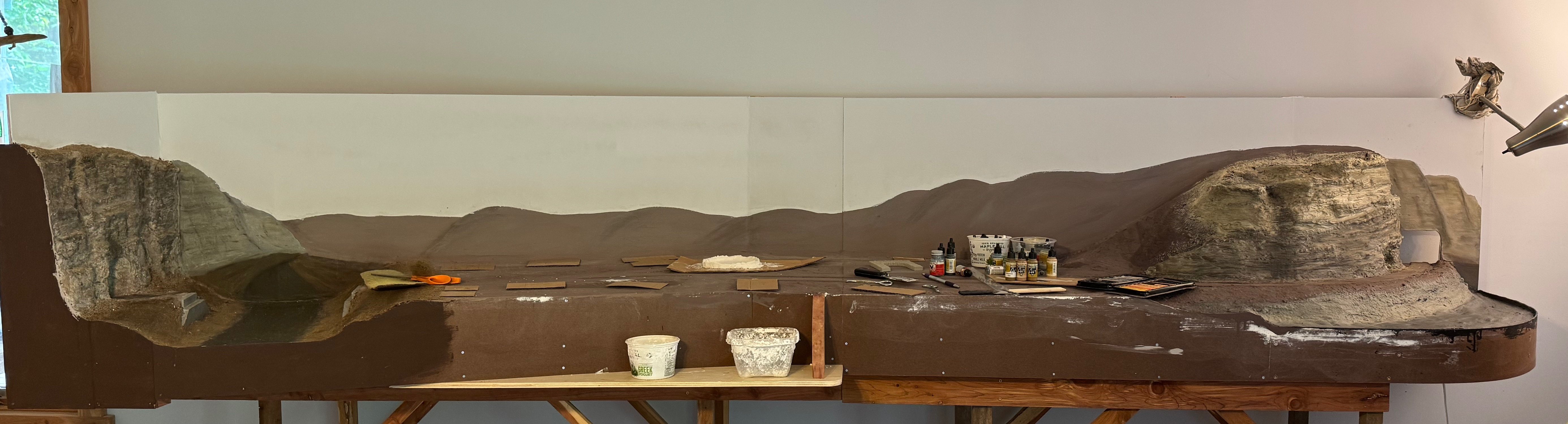

OK, here's a broader update covering the last week or so. I've been filling in the bluff line to the right with plaster and base color layers.
Base plaster layer shaped into rock faces and outcrops:
Early paint layers:
Adding more color complexity:

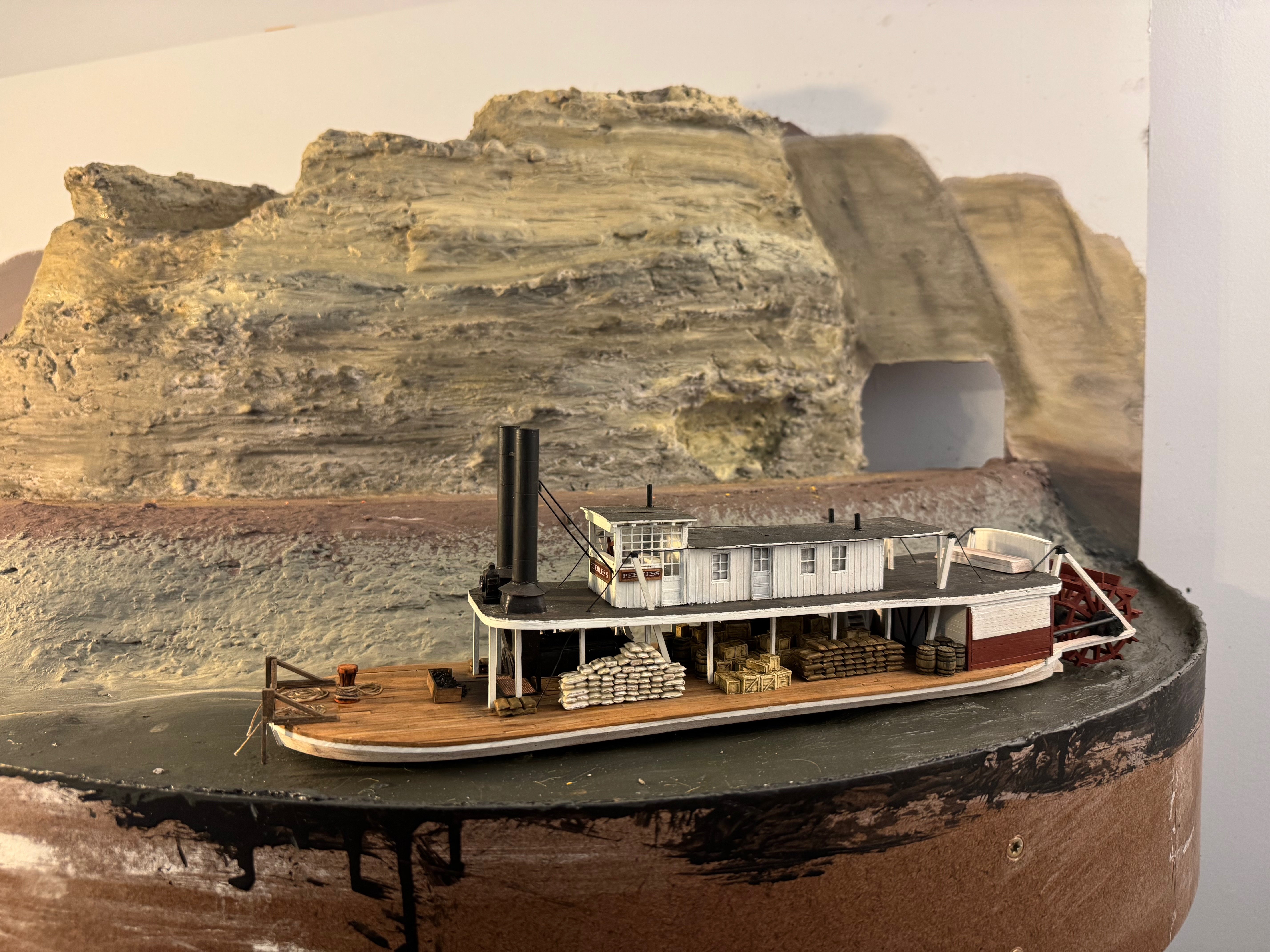

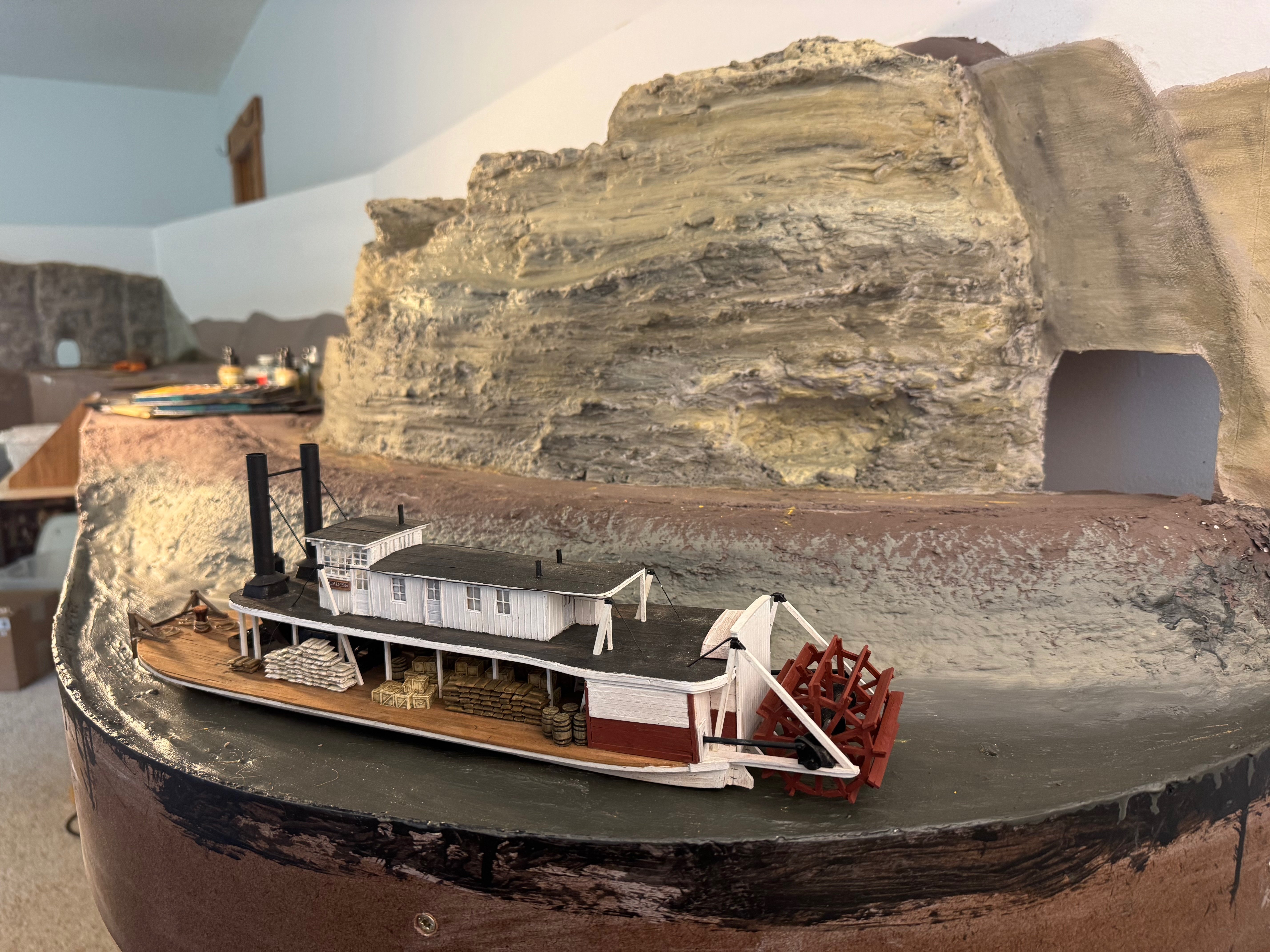

And since this is Model SHIP World, here's a reminder that this whole scene was inspired by Peerless operating on this stretch of the Missouri River.
Right now this all still looks like Montana, not Missouri, in the absence of vegetation. But it's coming along. I'm not done with bluff coloration, I'm still planning to build up more color complexity and texture, as on the tunnel bluff. Here's a reference shot as a reminder:

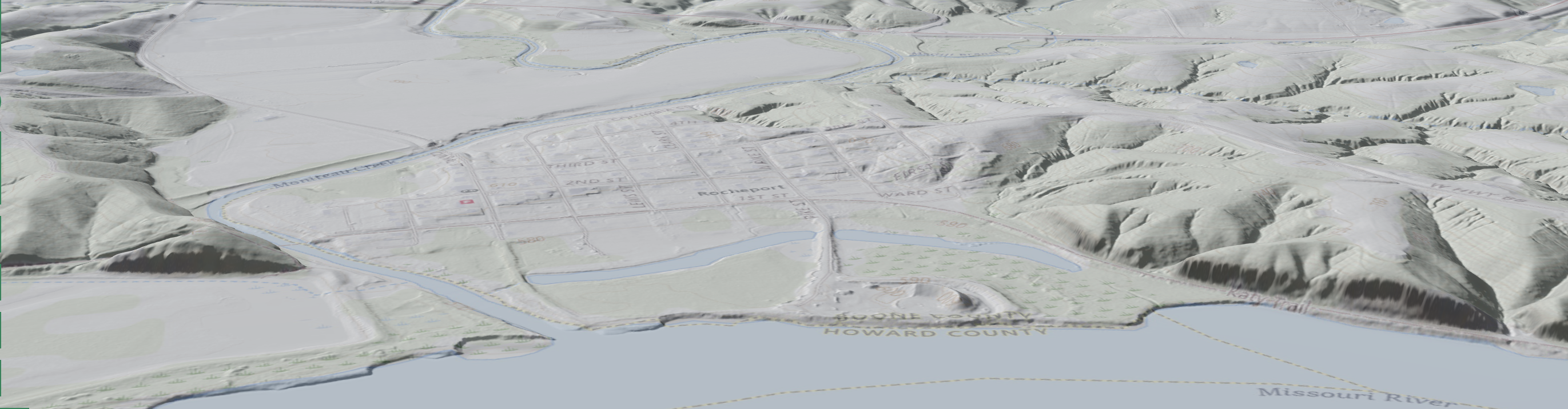

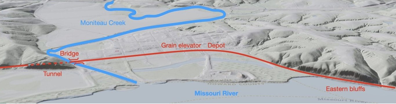

So here's a low-angle 3D view of the landscape at Rocheport, looking north at roughly the same perspective the viewer of the layout has. This is taken from the US Geological Survey's National Map online map data server, something I use all the time in my day to day work. From left to right, you can follow the rail line through the tunnel at the nose of the left-hand ridge, across the bridge over Moniteau Creek, through the town of Rocheport on the flat riverbottoms between the two lines of hills, then back to the sheer bedrock bluffs along the Missouri River at far right.
And the reason I share this, is that here is the current layout's version of that view:
You can see that I've started painting the backdrop as well, giving rough shape to the line of hills framing the Moniteau Creek valley in the background and giving the scene some depth. Maybe this helps give some more geographic context to what I'm building here. If you're wondering, the bluffs on the right side are quite a bit shorter than the real thing; I simply don't have vertical space to build them to scale, and even if I did they'd probably look fake. This height uses the principle of selective compression, as does so much of model railroading, to give what I think is a proper sense of scale and proportion that "feels" right. Same for the horizontal compression of Rocheport, which has a far longer distance between the two bluffs than I can include here, but I've planned the town's layout to include enough signature features so that it'll "feel" right.

I realized I should probably give a labelled version of that 3D map, not assuming everyone knows/remembers the geography as well as I do. So here it is for comparison with the broad layout view:

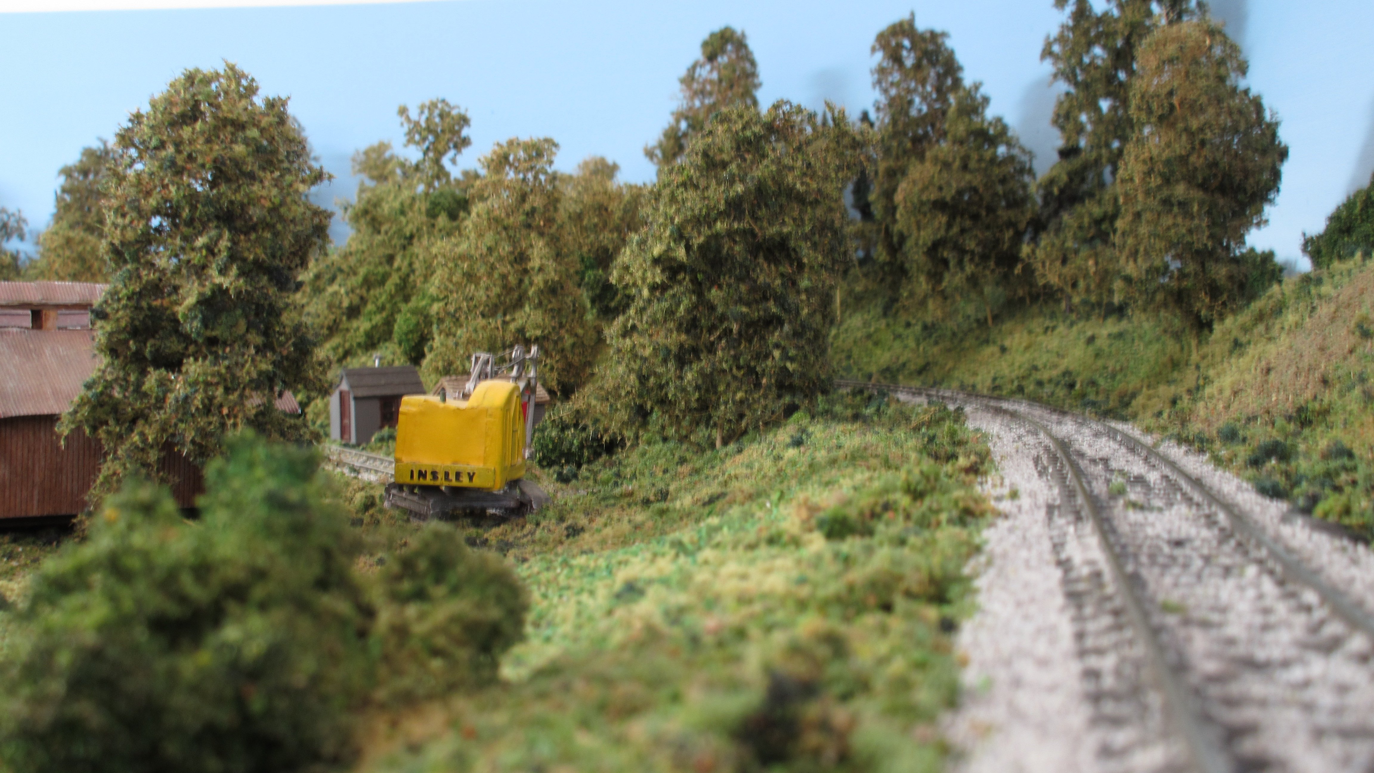

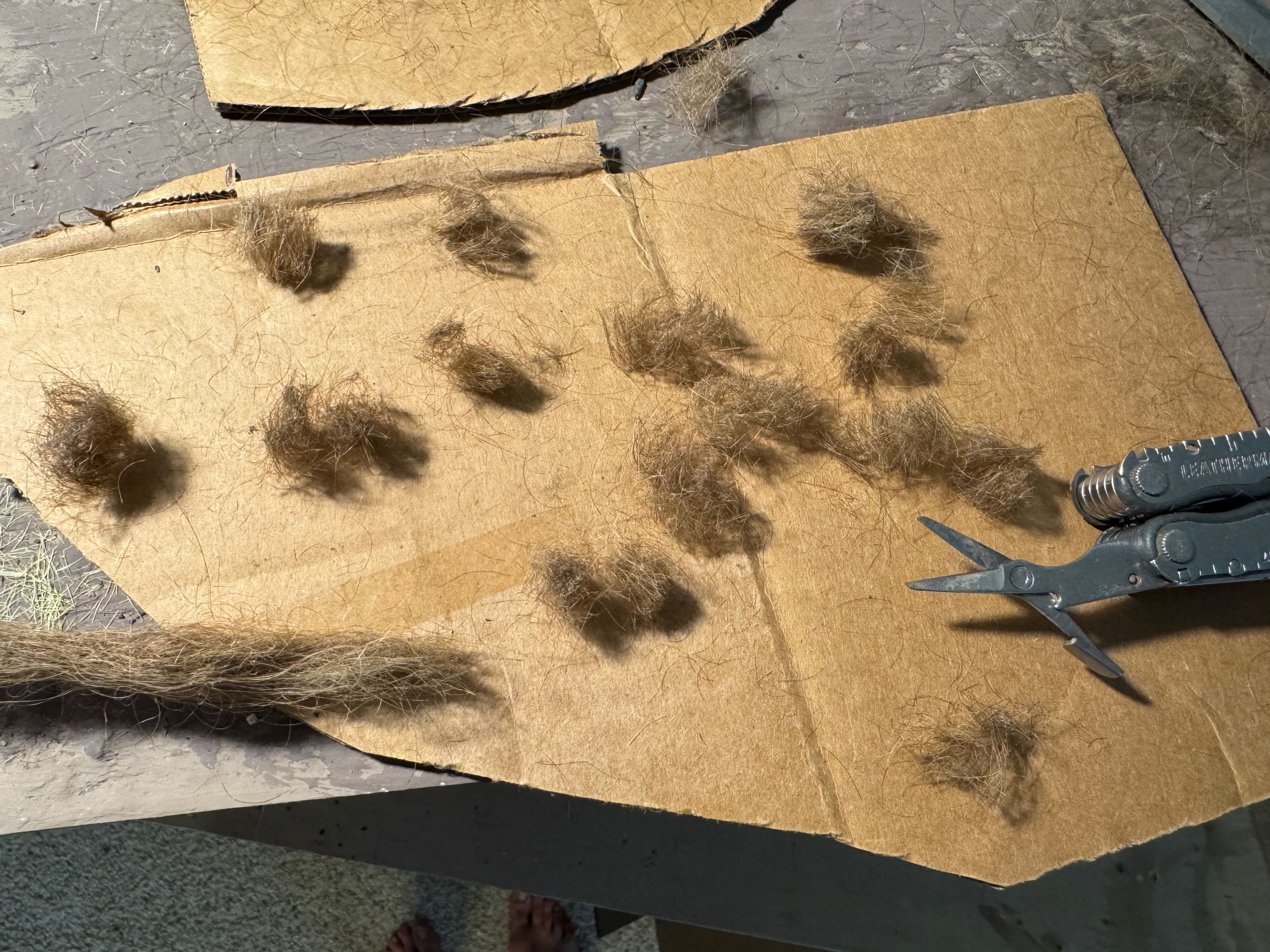

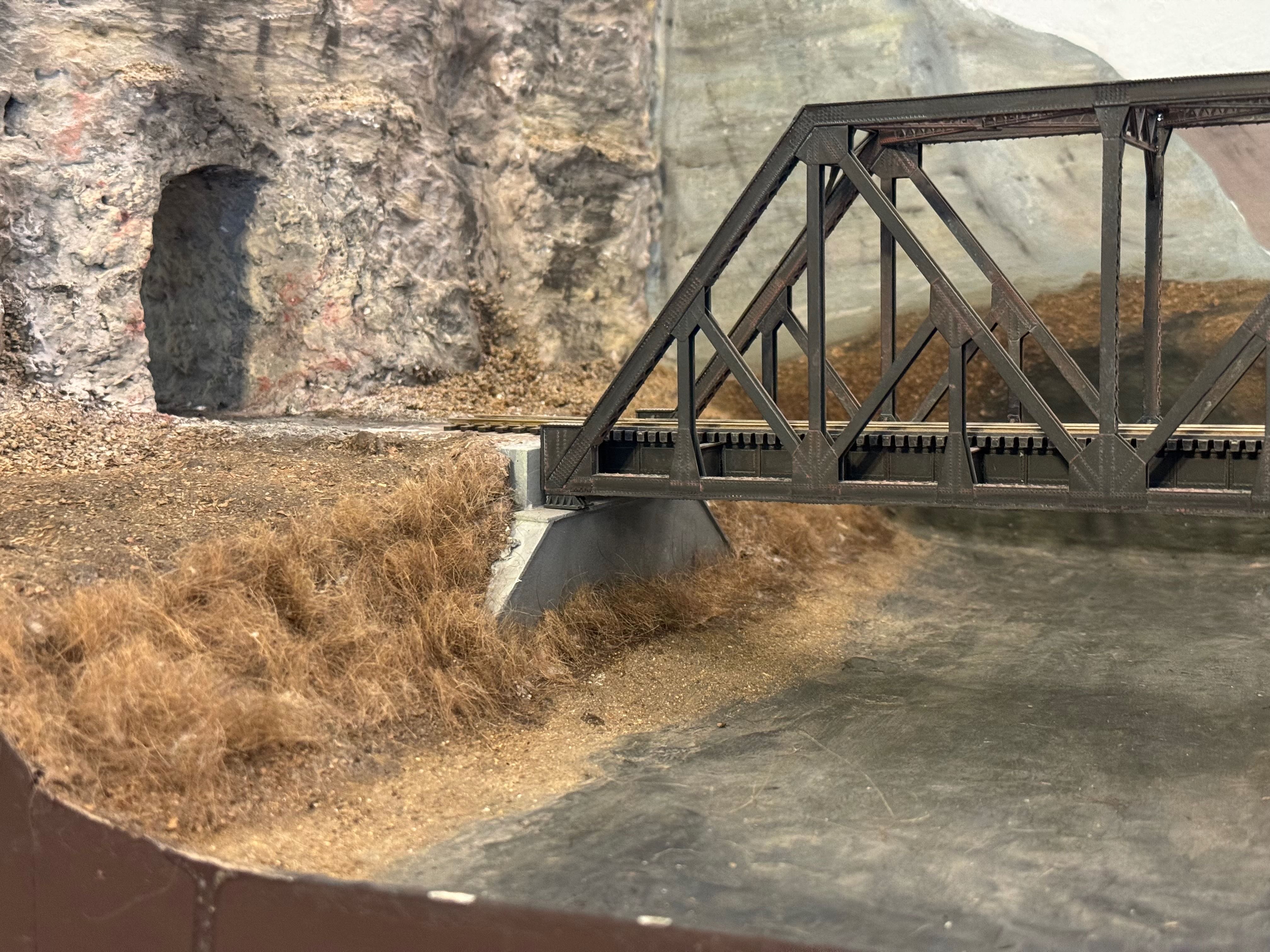

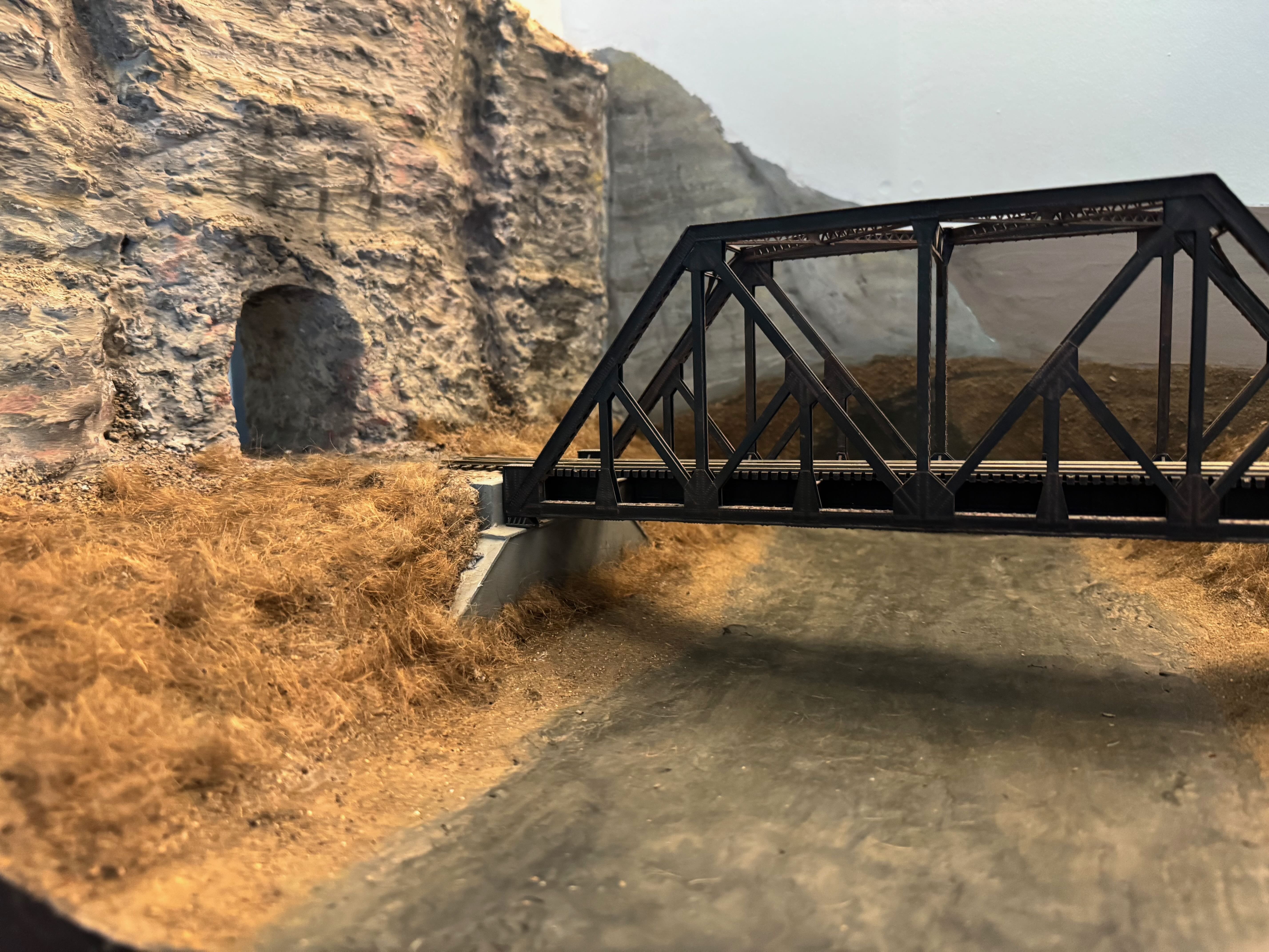

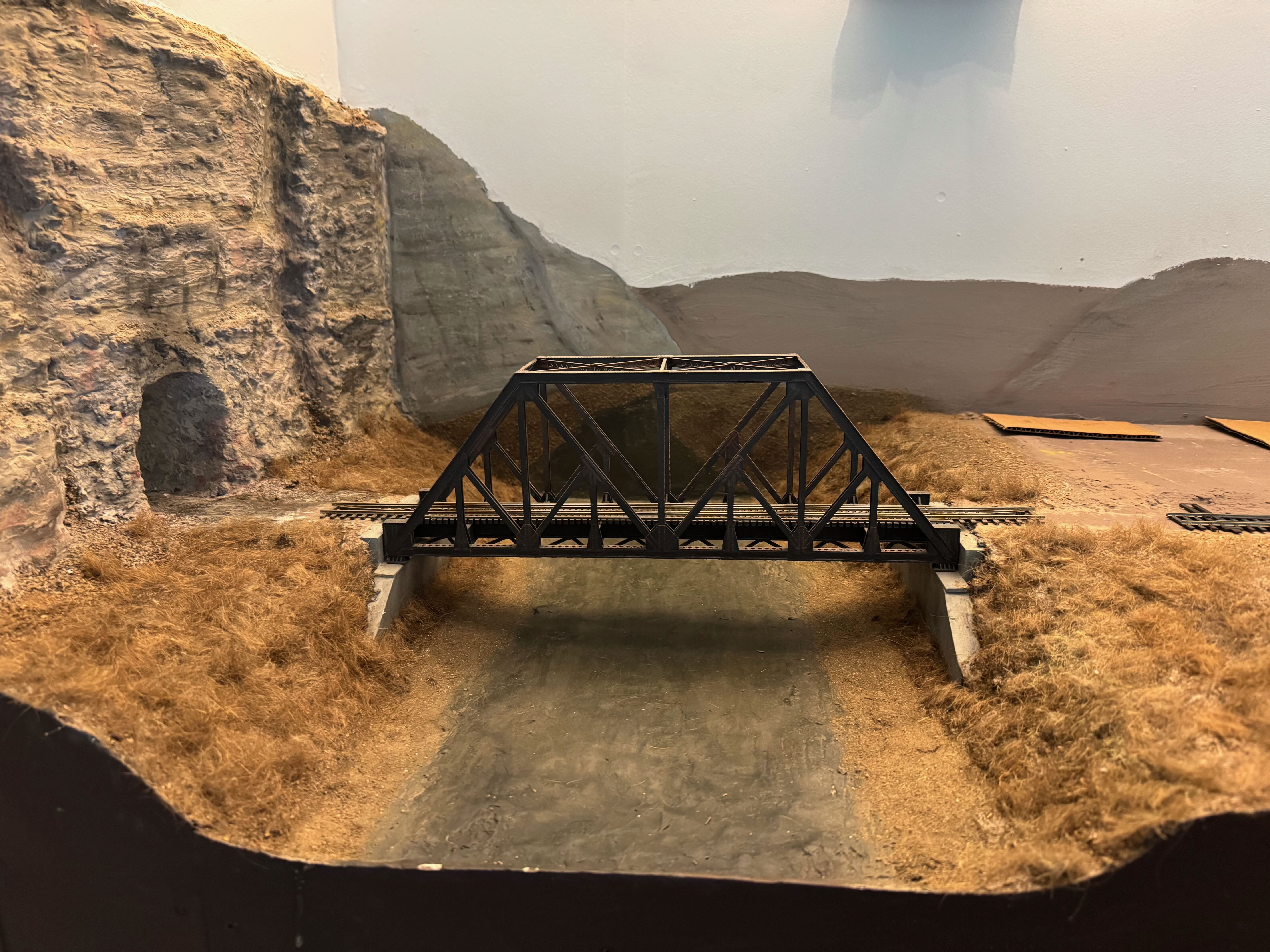

I decided it was time to start adding vegetation to the Moniteau Creek area. As a reminder, this area was pretty grassy/weedy/scruffy back then, with scattered bushes and a handful of trees.
So I started with a layer of complex grasses. Modelers often use static grass for this, which is a product consisting of fine grains that are applied onto a glued surface and then made to stand up vertically using static charge. It actually works quite well, but my problem was that static grass doesn't come in the proper brown/deep yellow shade of late fall Missouri prairie grass. I also find that most manufactured scenery products never manage to have the subtle complexity in color and texture that natural materials do (just like the ground cover already used). But I found a really effective natural replacement that comes out like this:
Any guesses?
It's hair. Mrs. Cathead's hair, to be specific. Her hair color is nearly exactly the shades of dried Missouri prairie grass, and has all the natural complexity one could want in a scenery product. Here's how I used it.
I took some clumps leftover from the hairbrush (we save some of these anyway for use in deterring garden pests like mice). I twisted lengths of hair into tightly wounded bundles, then cut them off into short clumps that stick together naturally.
I then spread scenic glue on a patch of landscape and began planting the clumps, teasing them apart a bit to create the naturally even clumpiness of prairie grass while still covering most of the landscape. To emphasize this point, too many scenery makers assume that natural grass grows uniformly, like a lawn, but prairie grasses especially grow in tight clumps with space around their base. That pattern is actually essential to the survival of a variety of native animal species, but that's a different discussion.
Here's a shot of one creek bank done, and of the broader area in various stages. The glue starts out white but dries clear.
And one more view of a completed area:
I really like the natural complexity in color and pattern this creates. It needs some bushes and woody growth to break up the pure grassiness, but it's a great start. I will be using static grass elsewhere in Rocheport, but wanted the creek banks to be especially wild and diverse in a way that static grass struggles to get right.

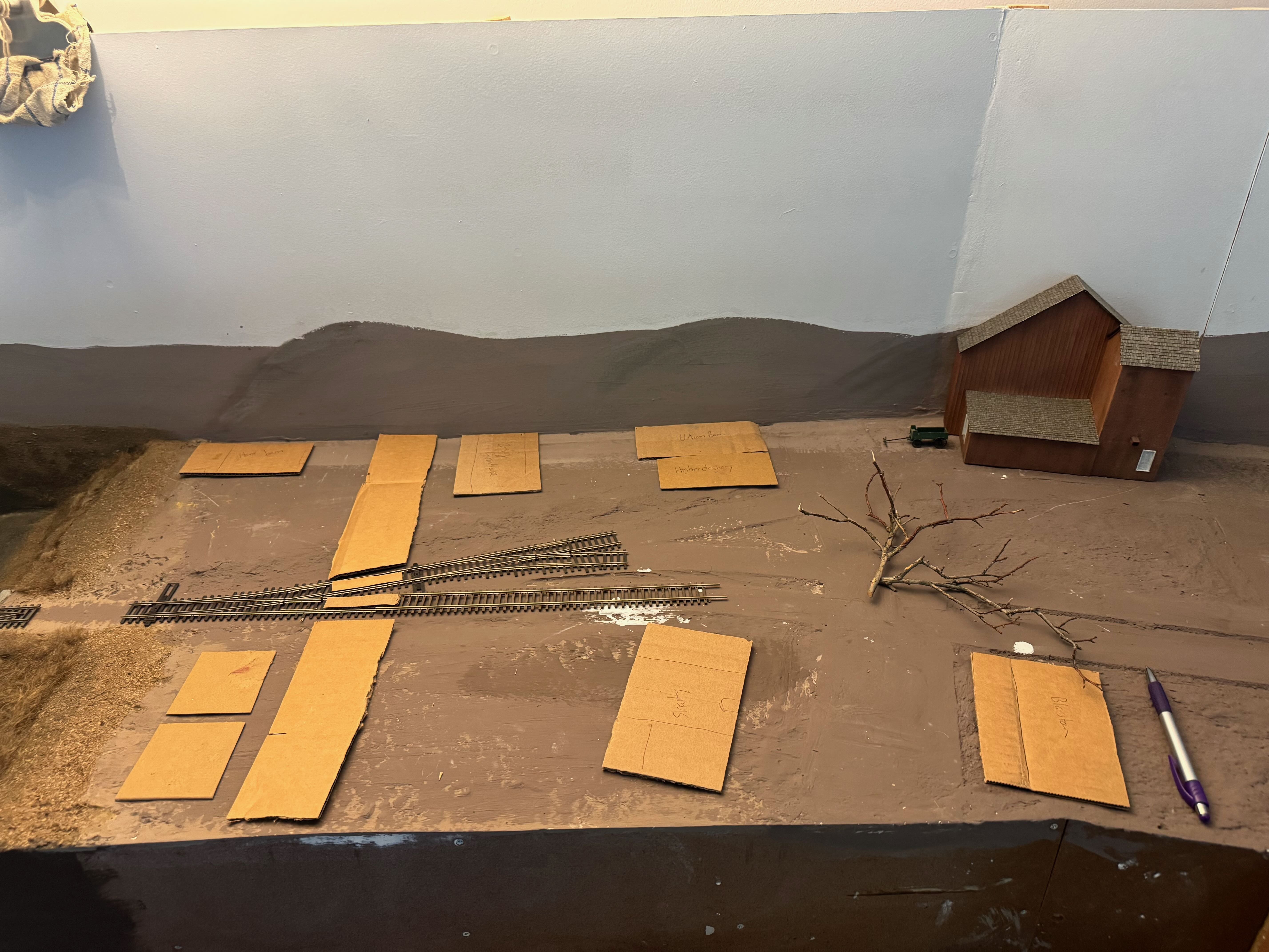

And two, I've started experimenting with various arrangements of building footprints for the town. I'm having to compress a lot of visual interest into a small area so there are various ways to use specific buildings to highlight aspects of the real town. I'm mostly going to use laser-cut wood kits for all of these, probably scratchbuilding a few simple structures. I don't feel the need to build all the buildings to match real ones; the keystone "real" structures for the location are the grain elevator / hay barn and the depot. The rest can simply create the right era and feel. Someday I can always go back and scratchbuild specific town buildings but I really don't see the need to put that much time into such things up front.

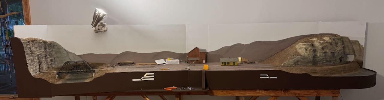

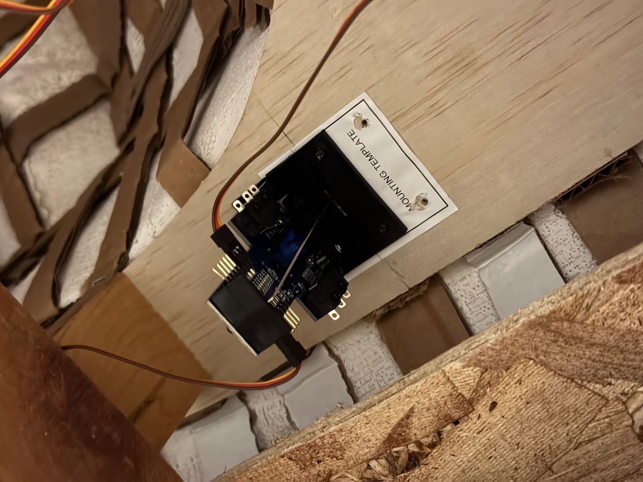

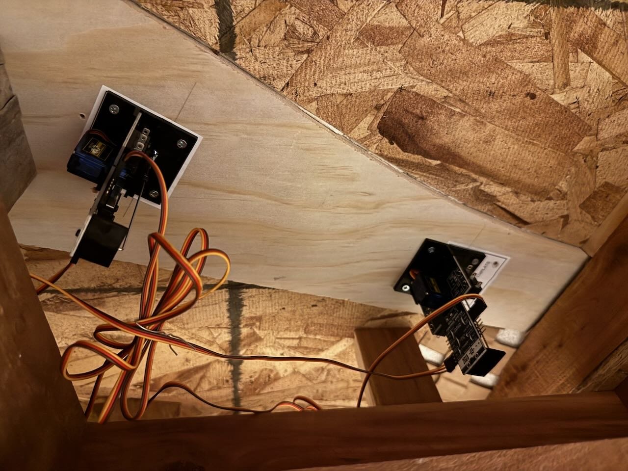

Time for a change of pace. I'm at the point, scenery-wise, where I'm comfortable starting to lay track. I've done most of the really messy work and I'm itching to make things move. The first step involved some pre-tracklaying setup, specifically installing switch machines. I'm using automatic controls for the turnouts (what railroaders call what non-railroaders call switches).
For the non-model-railroaders, these are basically electrical units that you install under the turnout. They have a metal rod that sticks up through the roadbed and moves the point rails back and forth. They can be controlled in various ways; I went with basic pushbuttons installed on the fascia that use color and position indicators to show which route the turnout is lined to follow. For the model railroaders, I'm using the Walthers system that is designed use plugs and sockets for all the wiring to eliminate sautering, because (a) I hate sautering and (b) I like the adjustability and reusability of the plug/socket system.
The short version of installation is as follows:
(a) place the turnout exactly where it's intended to be and spike it down temporarily,
(b) drill some marker holes through the roadbed to translate that location to the lower surface,
(c) install a template based on those reference holes to ensure the control unit below lines up with the machine above,
(d) remove the turnout and drill a wider hole back up through that will allow the control arm to move,
(e) install the machine with screws from below,
(f) re-install the turnout above,
(g) hook up the power and fascia control,
(h) push the button over and over again, reveling in the feeling that live action is getting close!
Here's a few photos:

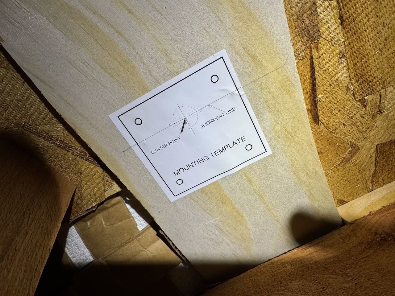

Aligning the template below; the wire at center is running through to the surface to mark the exact location:
Machines installed:
Sharp eyes will notice the offset templates on two of these. Despite several checks, I still managed to install two of three backward the first time. They work in either direction, but the control lights didn't line up with how I wanted them, so I just reversed the machines and everything lined up properly.
And here's how the top side looks.

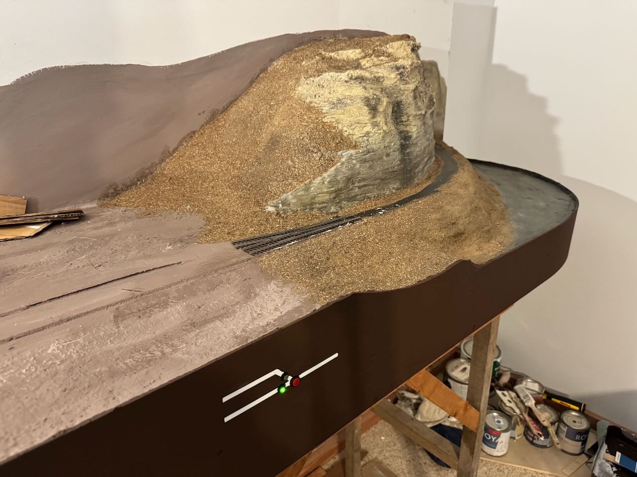

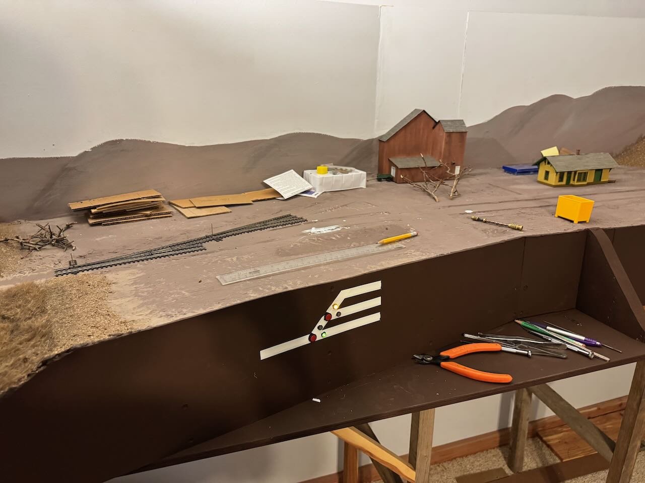

You'll notice the nice lights indicating which way the turnout is set; green for whichever route is more dominant and orange for whichever is subsidiary. Pushing the red button for a given turnout flips its route.
You'll also notice the track schematics controlled by these lights, and that they look different. I'm trialing two looks. The narrower lines are painted on, while the thicker lines are electrical tape. I have a personal preference but won't reveal it yet as I'm curious if anyone has perspectives I haven't thought of.
Those with keen eyes and memories will also notice that I finally painted the entire fascia in its final shade of rich brown. This really ties the scene together and makes it look nicer. Here's an overview shot of how things stand; also another way to judge the two track schematic styles.
Now that the turnout locations are set, I can start laying the rest of the track. There's more electrical work to do below, running bus lines from which individual track wires will run and so on, but it's really getting close now. Not actually sure when more progress will be made because I have an especially busy couple weeks coming up even by my standards, but it's nice to feel close to track happening.
Let me know what you think!

I think the narrower painted lines look neater and less obtrusive, but probably more time consuming to make. Tape will be much quicker to lay down, but could also start to curl up at the edges.  Also, would grey paint/tape draw the eye away less?
The electrical snippers give everthing scale....I didn't realise the scenery was smaller than I thought....very impressive.
