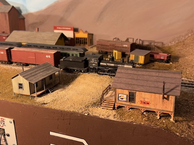

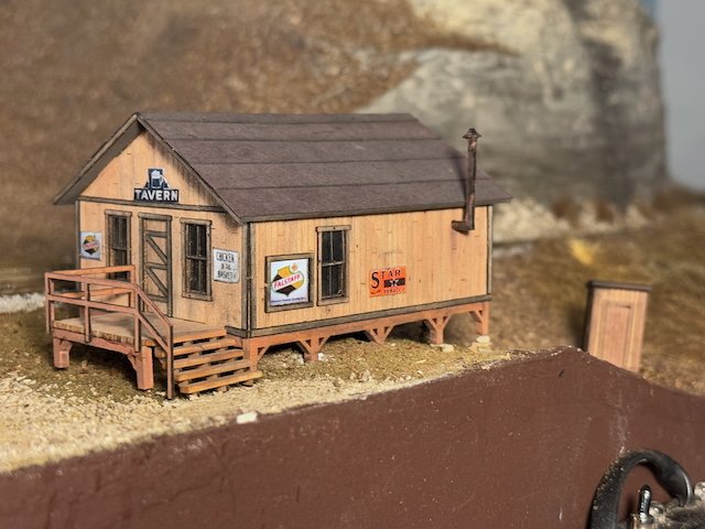

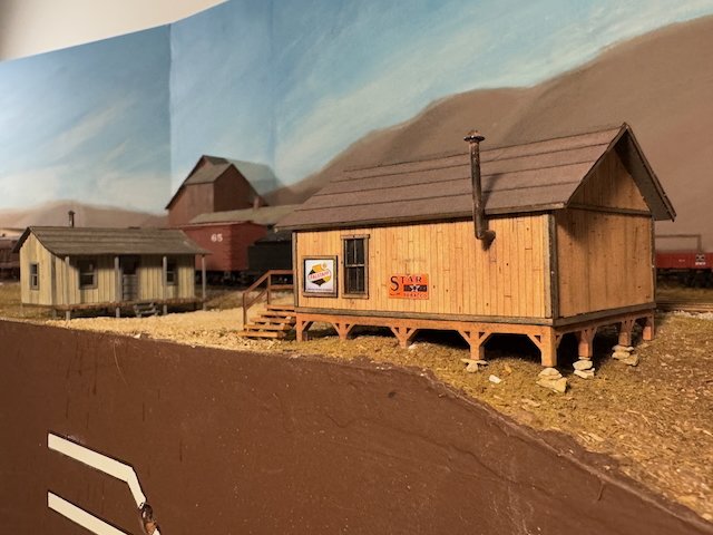

I intentionally chose this one and its partner across the street because they're up on posts, as is common for river-adjacent structures in this region. I used small pieces of crushed limestone to build up support pillars for the wooden posts. This is also pretty common around here in older buildings. Close eyes will notice in the first photo that I need to stick a couple rocks under the front porch posts.  I like how this sticks out over the slope that starts descending down to the river.
No paint on this one, it's all pastel weathering. I really wanted this to have a raw-wood look to it. The lower supports are intentionally more reddish to hint that maybe they were built from local Eastern Red Cedar, which is highly rot resistant and very common around here. I've built all of my full-scale outbuildings from it, and it would have been quite easy for someone to harvest in 1900, too. I think the raw wood goes well with the subtle grey of the sharecropper house, and contrasts with the brighter colors of the depot area.
And here's a broader view, showing how this frames the street leading from the river landing into town past the east side of the depot. That's the last building for this district; other than trees, other vegetation, and some fencing, that's pretty much how this is intended to look.

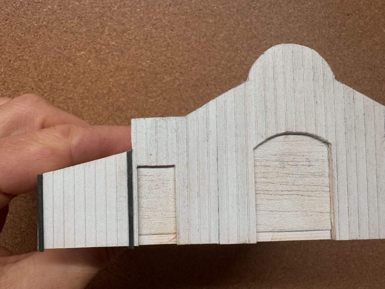

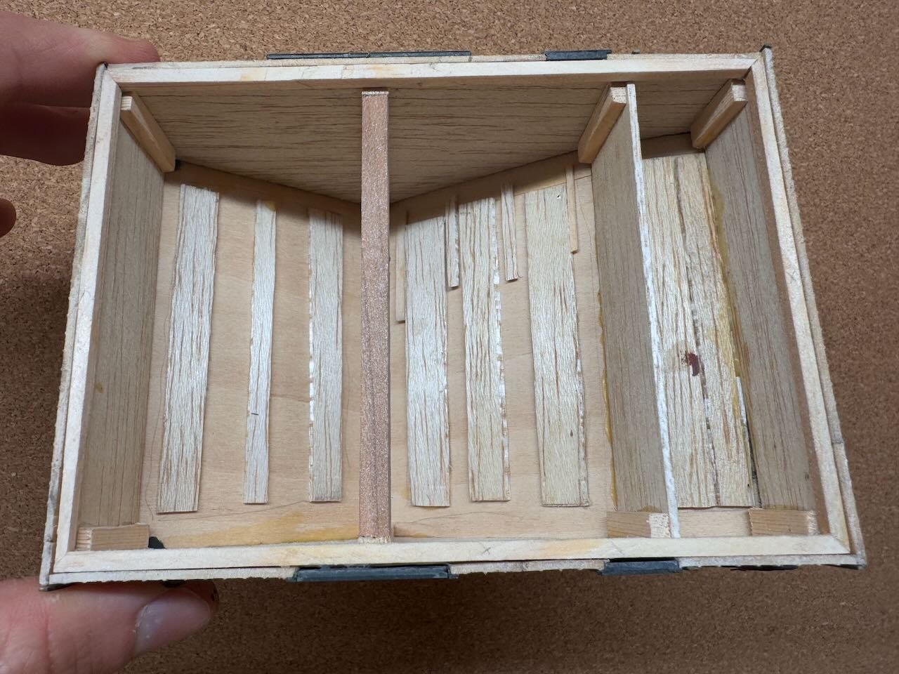

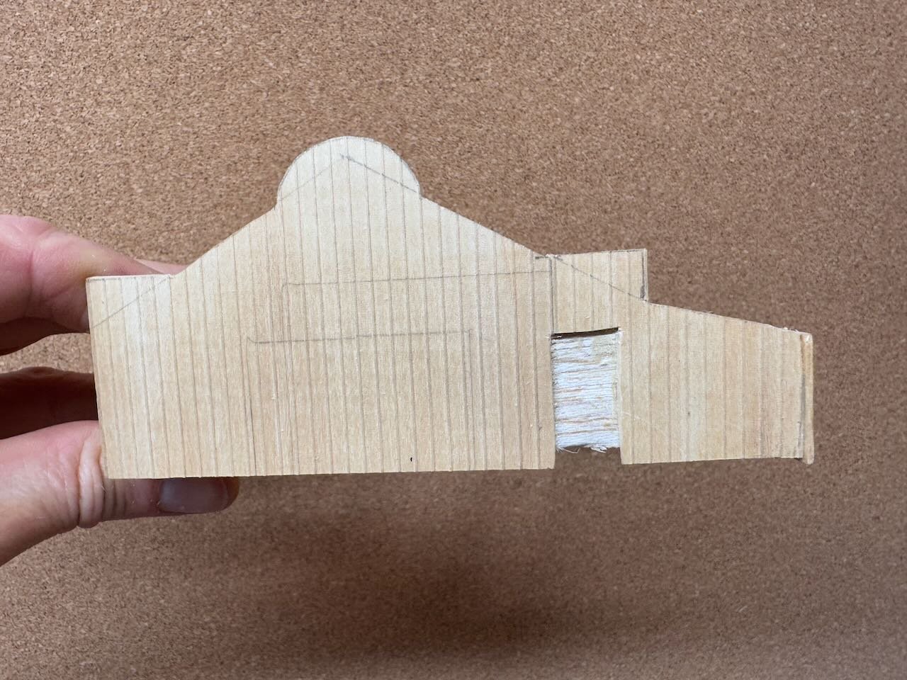

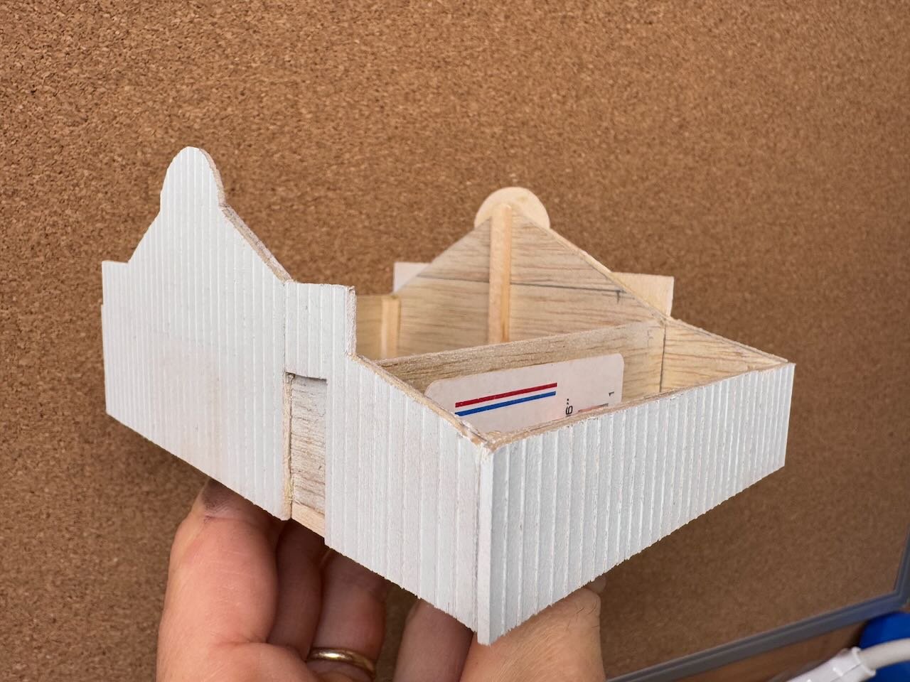

Time to build! I made a central frame of wooden sheets for structural strength. No windows or open doors (with one minor exception) will pierce this, so I didn't need to worry about what the interior looked like. I designed the dimensions by roughly measuring the ratios off the photo, and comparing to what would fit in the dedicated spot on the layout. It came out close enough that only minor compression was needed (which led to one oopsie that you'll notice later on).
With the central core done, I sheathed it in wood pre-scribed in a board-and-batten style. I couldn't quite tell how the real barn was sheathed, but as this was a fairly fancy structure for a barn, I decided it would have this more tightly sealed style than just regular boards. All doors will be plastic items scavenged from my scrap box to be both close enough to the real thing, and to look right on a barn. So I cut slots in the siding as needed, to accept these insets.
When I was happy with the siding pieces, I glued them on real good. View below shows the other side. I have no photos from this direction, so used a different style of main door that I'll discuss further below.

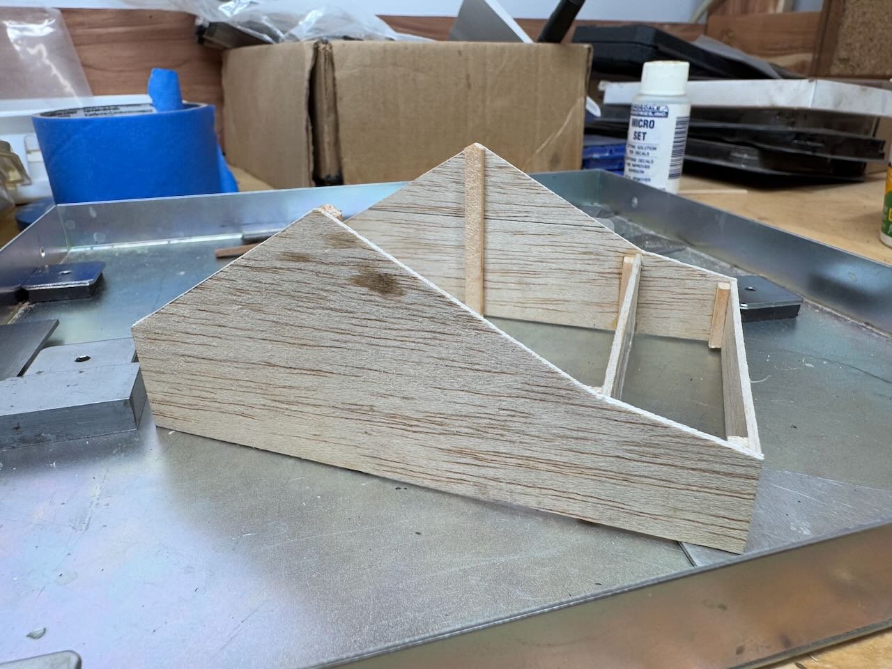

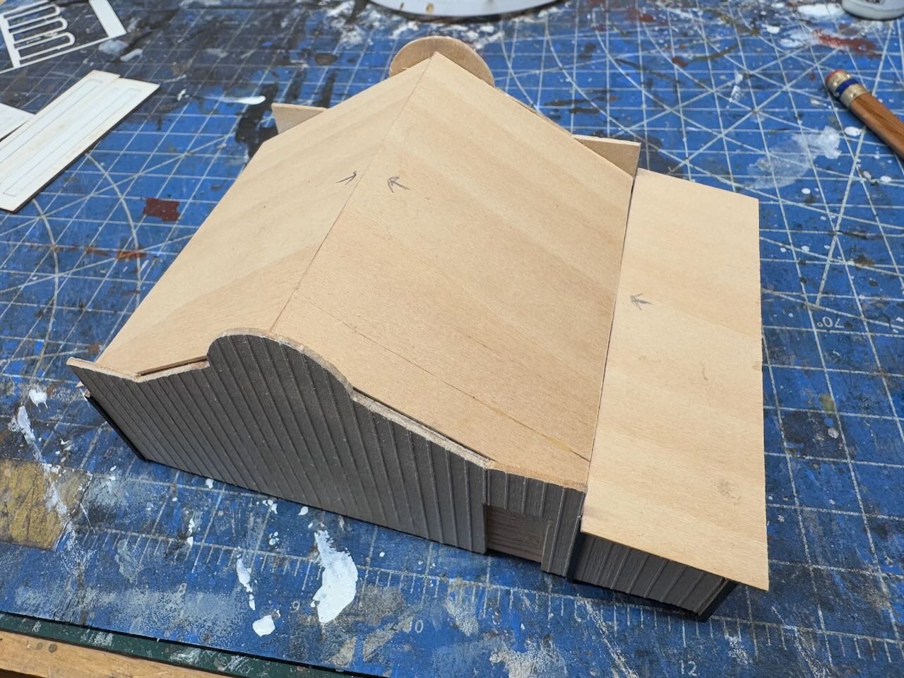

Next up was to design and cut the roof pieces. Slightly more complicated than usual since the central part fits within the fancy walls, while the outer shed just extends like normal but is wider. And there's a change in roof angle between the two parts.
These are thin sheets, so I braced them underneath to avoid warping. Below is a view showing that, and the beginning of shingle application.

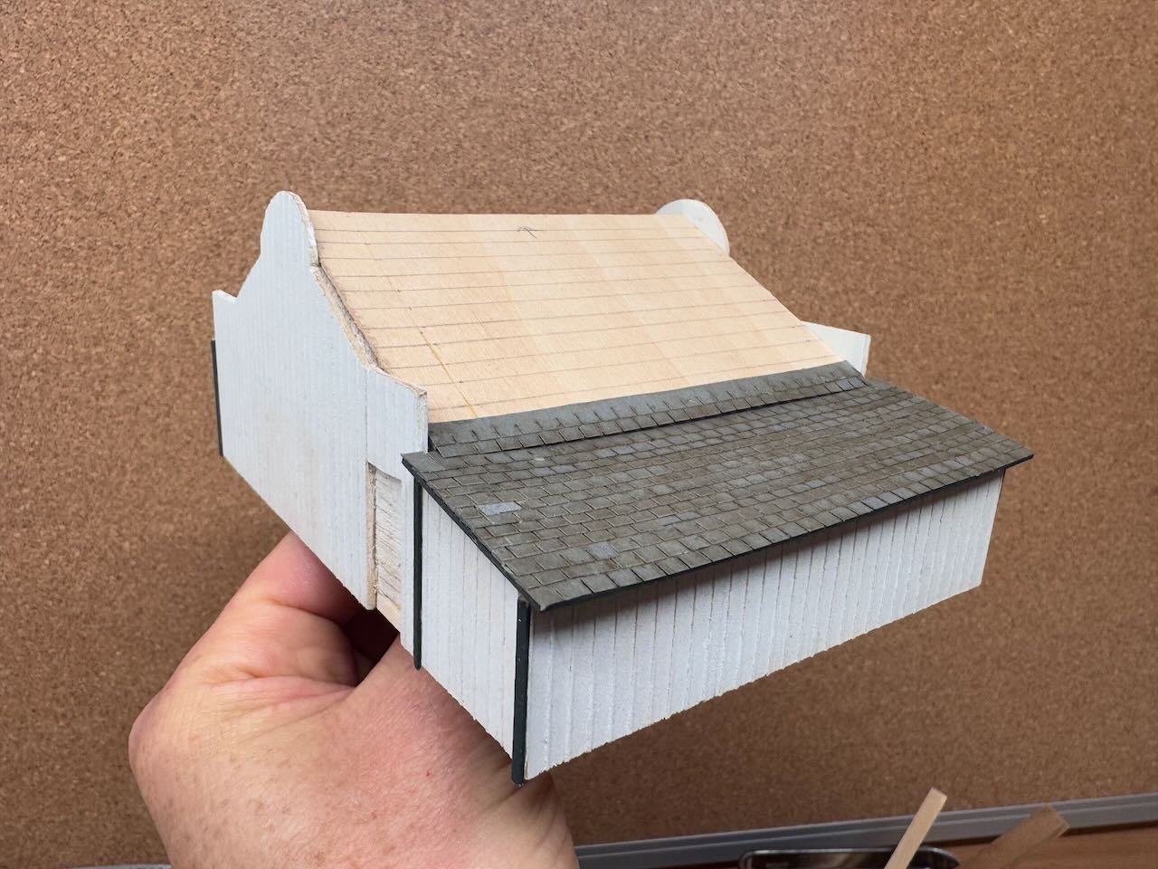

These shingles are tedious to apply, but look wonderful. I like to do these off-model, so I can leave overhangs at each end of the roof and trim them consistently. This created a challenge in this particular build, because I needed to make the transition between two roof angles (and thus pieces) but couldn't lay a transition strip over this between the projecting walls because I needed to lay shingles off-model. So what I did was lay the first set of shingles on the upper roof with half of the shingle line extending past the wood, such that when the finished roof piece was installed, they'd naturally overlap the lower roof. The image below shows what that looks like in a test-fit; the overlapping shingles are in the right place and will snug down nicely once these pieces are glued into place.
Once all the roof pieces were shingled and the glue drying (great task while half-watching a hockey game), I started working on the final trim. First, simple strips at the corners and joints between parts of the barn, like this.

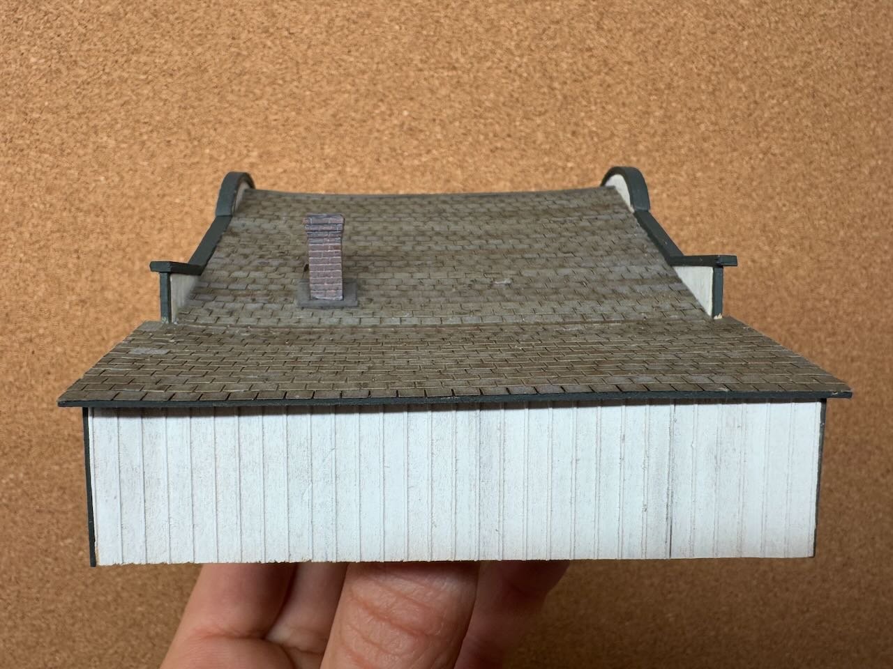

But if you were wondering, model ship-building skills came in very handy for that curved arch at either end of the roof. I cut some thin strips, soaked them, and bent them over a bottle of the right dimension, then left them near the wood stove to dry. Worked perfectly. I stopped taking photos at this point because I was too focused and having too much fun.

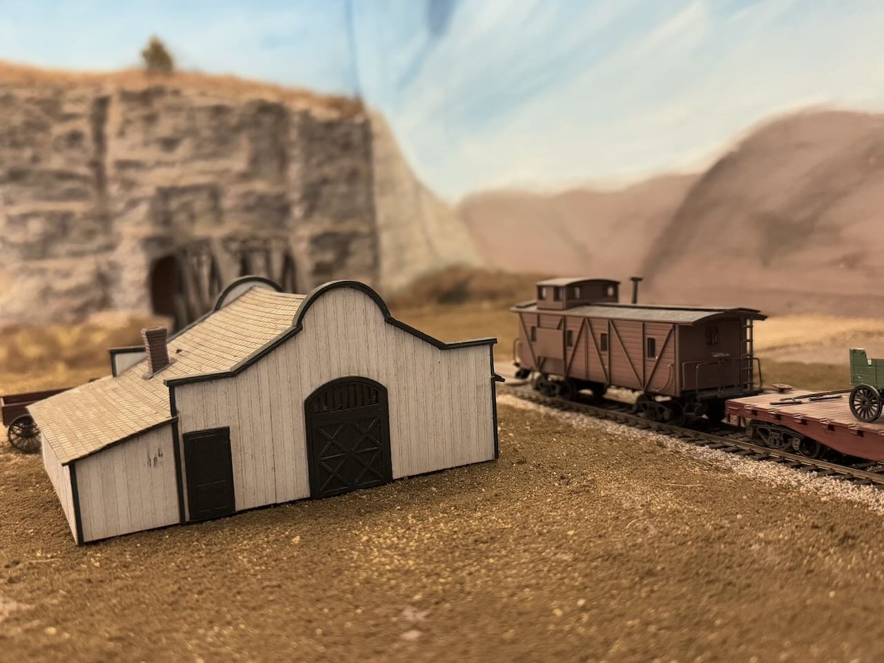

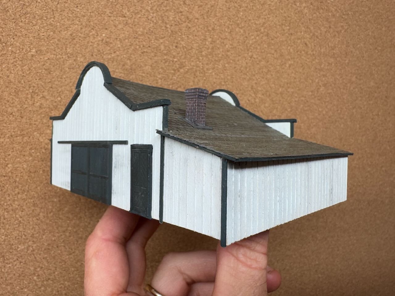

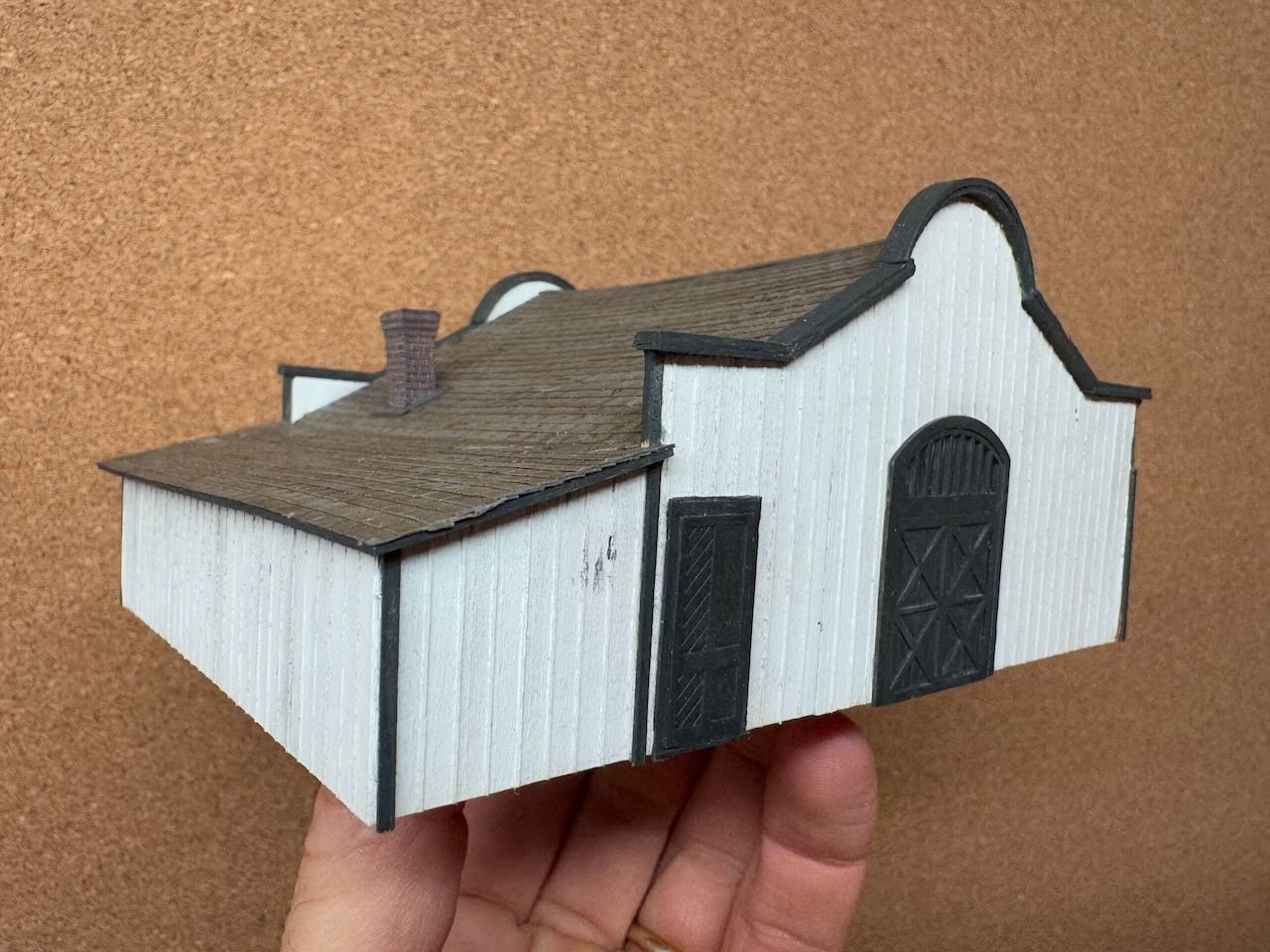

So here's the final barn. The siding is lightly weathered with pastels to give some variation to the siding, and I added subtle scrape marks where the sliding doors move against the walls.
Sharp eyes will notice the compression goof in the wall above. The original barn has two sliding doors that move to either side. I didn't account for the full sliding width when I compressed the building, so the right-hand one only has room to open halfway. Oopsie. I'm considering it an Easter egg for the observant.
Below is the other side. As I said above, I didn't have any photos from this side. Arguably it would have made sense to use the same style doors on both sides, but I didn't have two more of those barn doors in my scrapbox, and I did have this very attractive stable-style curved door, which really seemed to fit the barn's style. So that's what I used here and I'm quite pleased with the look. The slotted windows above are the only penetration of the walls, but they're so narrow I just mounted them against black-painted interior wood and glazed them.
Thought I can't tell what color the original trim was, I like this green-black color that helps the barn stand out from any other structures but still has a darker palette that fits the overall theme of the layout. And it just feels classy to me.
Below is the view from the side that faces the aisle. This shows an unintentional effect that turned out wonderfully. Despite interior-bracing the roof sheets, the collective moisture of the glue used to attach the shingles warped the sheets anyway. But as it turned out, that gave the roof a delightful sag that's just off-square enough to give an extra sense of realism. I don't think I could have done this better if I'd tried. It's pretty subtle unless you're looking directly from this angle but it really gives some added character. You can see some similar waviness in the shed roof at foreground, but again I love how that came out. The chimney is just another casting from my scrapbox, painted and weathered.
And a final shot of the interior, showing the internal structure and bracing.

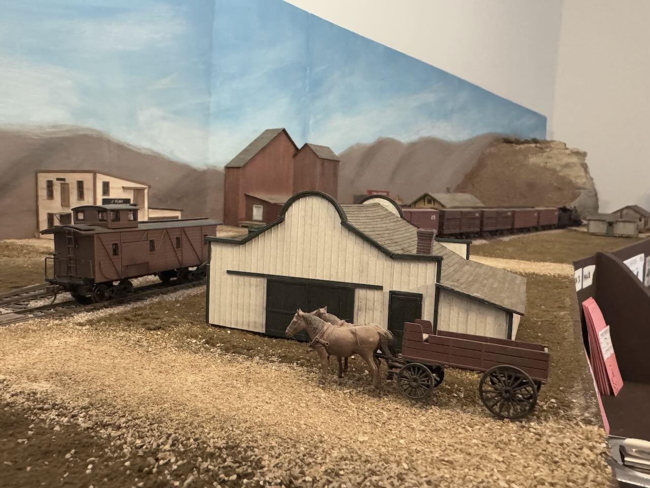

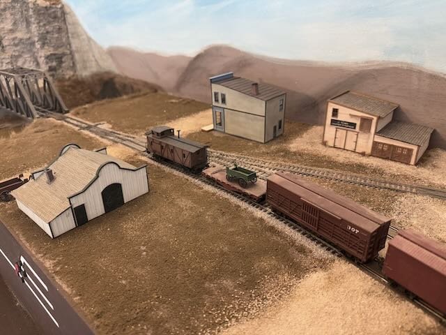

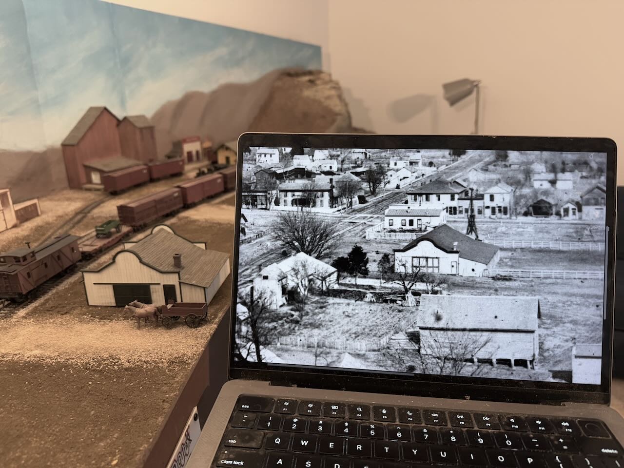

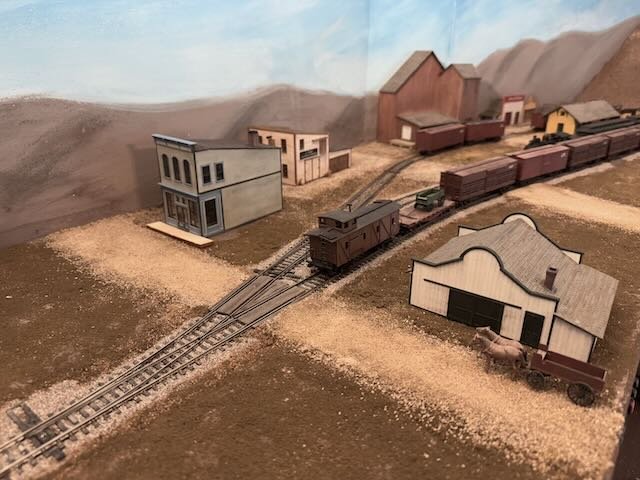

And now to place it on the layout. Here's two views in its intended setting, though without any attempt to blend in the base.
And for the full context, here's the model in place and the historic photo:
The biggest difference is the color of the doors: I tried painting them with the internal panels but just couldn't get the borders clean enough, so decided that solid-color doors were fine with me. Better "wrong" than "looks wrong".
The barn is low enough to work as a foreground structure, not getting in the way of reaching the tracks during operation. And it's just such an attractive and distinctive building! I have to say, I'm really pleased with how this came out. Very happy with it. I hope you are too!

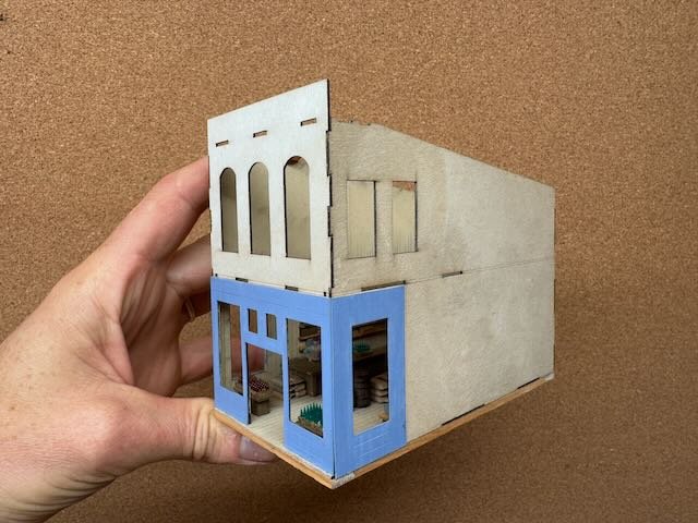

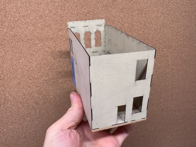

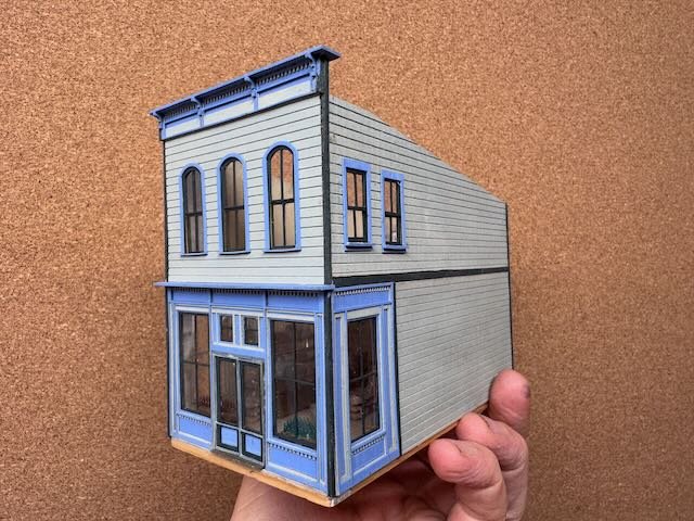

Yet another building! I'll do something else at some point, I promise. This one's a kit from Banta Modelworks. Follow the link if you want to see their version. I've never built something from this manufacturer before, and I have mixed feelings. Nice quality materials, but the instructions are poorly written and organized, and the design of how the kit is meant to go together isn't very intuitive to me. There are a couple design choices I'm not a fan of. Anyway, here's the first part of the build.
You start by building an interior frame of thin plywood, onto which you'll attach final siding.
The latter two photos above show two stages of building up fancier trim detail on the front. Right away this shows something I'm not a big fan of. It's hard to clamp outer sheets of details onto the inner plywood while glue is drying, when you've already built the inner structure. Especially because the kit assumes you've attached a floor already, so you can't access the sides from the bottom with clamps. And especially because all these sheets are super thin and prone to warping.

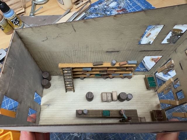

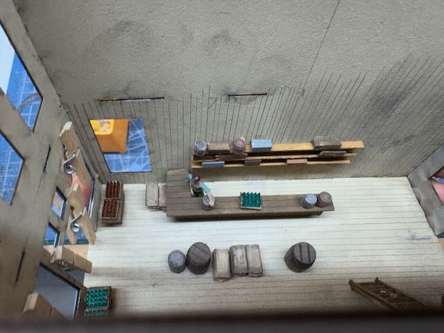

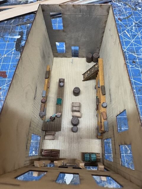

Sharp eyes will have noticed an interior. Sure enough, I went all out on this one. It has big open storefront windows that make an interior almost mandatory because it's so easy to see in. And this is another frustration, it's very hard to add an interior when the design forces you to integrate the floor into the walls within the initial box, so you have to add all the details down through two storeys of wall. Also, there's no provision in the design for the interior walls to be finished, they're just bare plywood with obvious grain and laser burns. The way the windows work (we'll get to that), it's not easy to add an interior layer of paneling.
I decided that this would be a grocer, general merchandise type store rather than the manufacturer's bank. Partly because the only bank in Rocheport is a very distinct stone building that I don't want to scratchbuild, and in any case is set several blocks farther back, well behind where the backdrop is. Whereas a general merchant is a fun interior to do and I can name it for one of the many known businesses shipping with the railroad. So here's the interior I put together, using wood scraps and various details from my scrap/parts box.
I really like how this came out. I drew the vertical interior paneling (and the floor boards) on with a pencil, figuring that it made decent boards and also broke up the lines of the existing plywood patterning.

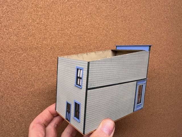

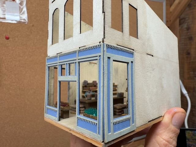

Here's another annoying thing about this kit: it's a two-storey building and they assume you'll put in the central floor/ceiling, but that would make it even harder to add an interior. There's no provision for access. So I just left out the interior floor. After some experimentation, I actually don't think it's visibly missing from normal viewing angles given the arrangement of the upper windows. Later on you'll see another adaption I made to help with this. Leaving this out also lets more natural light fall into the lower interior so more of the details can be seen (I'm not adding lighting).
After that, it's a slow process of building up three layers of very fine detailing on the front windows/doors, and adding general sheets of scribed paneling around the rest of the walls. All of the windows and doors are made off-model from multiple layers of fine parts, which is no problem. But here's the next annoyance: they expect you to insert all of these from the inside, with glue, after all the walls are built into a tight box. That was incredibly fussy to do, and there are some frustrating glue spots on the glass where I didn't do it perfectly. Most kits I've built do one of two things: make the windows and doors insertable from the outside, or design the kit so inside-mounted details happen before you assemble the walls. This was another case where leaving off the interior floor/ceiling was the right move; following the kit design it would have been glued in before needing to insert the windows from the inside, meaning some kind of crazy tweezer manipulation. No, thanks.
But after a lot of careful fussing, and tweaking my approach to minimize the risks of these odd directions, I came out with a pretty nice result. Also, I forgot to mention, I pre-airbrushed all of these parts on a warm day, so they could be assembled with minimal further touchup. Here's the finished shell, sans roof, pre-weathering:
For all the fuss, it's coming out pretty well. I like my muted but notably distinct color scheme, intended to make this building a centerpiece of the upscale part of town.  You can definitely see a nice swath of the interior through the big lower windows.

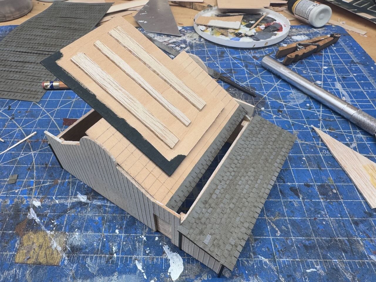

Next step is to make the roof, which won't be so bad. I'm planning to make it removable, though the kit assumes you'll glue it on. This is another way to show off (and repair?) the interior details. You may also have noticed that I built in an extended base, visible as raw wood in the photos above, that will get painted and detailed as a grey block foundation over which I can blend scenery materials without affecting the actual siding. The kit doesn't have a base, just a very thin (and warpable) plywood floor. This thick wooden base really stabilized the structure.
Soon I'll finish this and post more photos, including in place on the layout. In the meanwhile, hope you all enjoy some holiday time however you see fit!

Eric,
A nice looking building and well finished and furnished by you.
UK pricing on the their website says £47 so I guess they set a price target and designed it to suit, hence no 2nd floor etc. I agree, that no one will notice that floor is missing.  I can't understand either why they designed it so one couldn't work on the insides of the 'box'...strange.
It is interesting what buildings/establishments appear in a new town during the first round of building works, and then what buildings follow in the 2nd and 3rd rounds etc as a town grows.  I re-watched the TV series Deadwood (...gritty and not family viewing!) recently and it was a good insight in to how political power and money drives what buildings come first and which buinesses survive in the longer term.

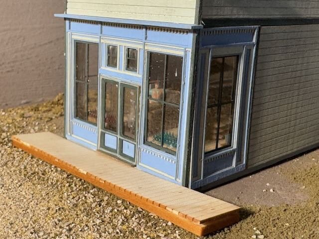

And here's the more or less finished building temporarily in place, just so you can see the context. Still a variety of small details to add, like a main sign on the front, maybe a few posters on the wall, etc. There will be another similar storefront between this and the backdrop. I did a bit of weathering on the walls to break up the smooth paint scheme.
I like the "alley" behind this block of buildings and the leatherworks. Gives this area a bit more urban feel and helps with the transition from upscale commercial into the more industrial depot district.
And here's a closeup. The sidewalk is just set in place, it'll be painted/weathered appropriately. But this shows how the interior helps; you can see some details of the store and even the proprietor. Much better than an empty box, with this many large windows.
