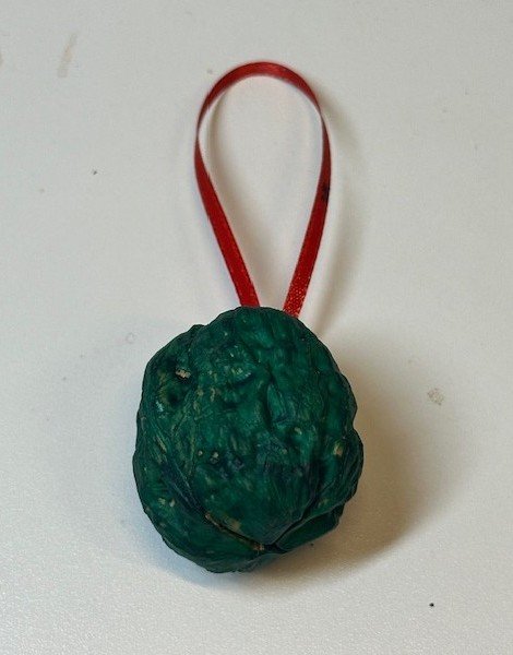

What I have been working on, though, diligently over the past week or so is my annual Christmas tree hanging walnuts project.  Back when I was a young child, my father would carefully crack open walnuts, dig the walnut and other pieces out of the shell, place money back in the shell, glue it, put a hanging bow on it and paint it so it hung on the tree on Christmas Eve.  I carried on that tradition with my children and now with my grandchildren.  Every year I come up with some new combination of ribbon and walnut colors in order to identify whose walnuts are whose.  Most of the walnuts have some denomination of currency folded and stuffed inside them, but some just have a few pennies in them just to tease them. (Even the ones with currency in them also have a couple of dimes in them so they rattle when shaken.)  Here's a picture of one of them.
Each of the five grandkids have a dozen walnuts this year, so with five grandkids, that's... 60 walnuts!  It's a bit of an organizational challenge as I complete them all (and keep them identified for whose are whose!), but I do enjoy it and the kids all look forward to "Papa's Walnuts"!

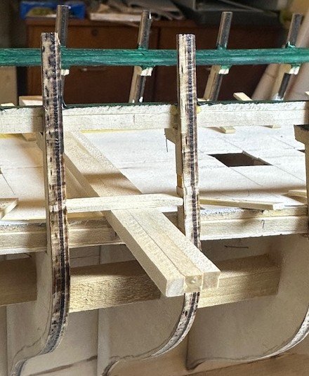

First off, Happy New Year to all, especially those that have provided guidance and critique in the early stages of this Constitution build of mine.  Like many others around this past holiday season, I took a bit of a break from the shipyard, not doing much actual work on the ship, but I did take the opportunity to review and plan some critical “next steps”, as they will affect how I am able to continue forward in this build.  My thanks to Mustafa for pointing out his concerns regarding how I removed the spar deck beams and some potential hurdles I might face.

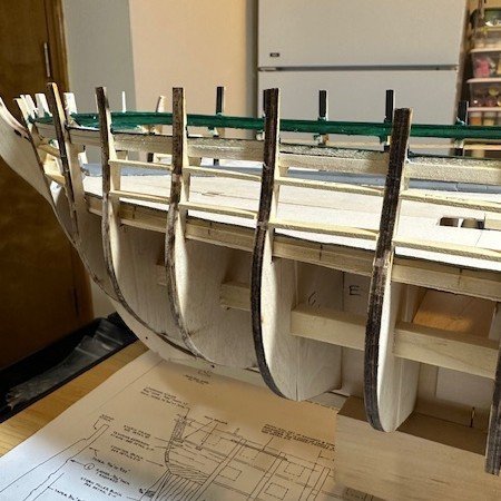

With that said, I did decide to cut back the spar deck beams back to the recently installed waterways strips.  I would have had considerable difficulty placing the gun deck bulwarks and the various horizontal and vertical knees.
260106a-SparBeamCuts.jpeg.ff29447f8343e4d9c54a82f0248971e0.jpeg    260106b-SparBeamCuts.jpeg.be7c91b6b5cf6b85fe983671b2b7435c.jpeg

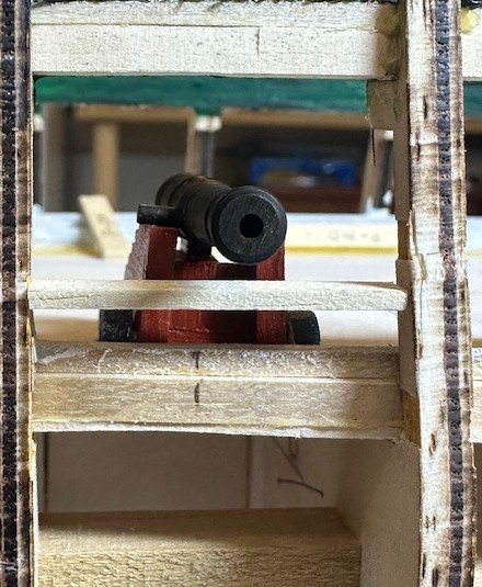

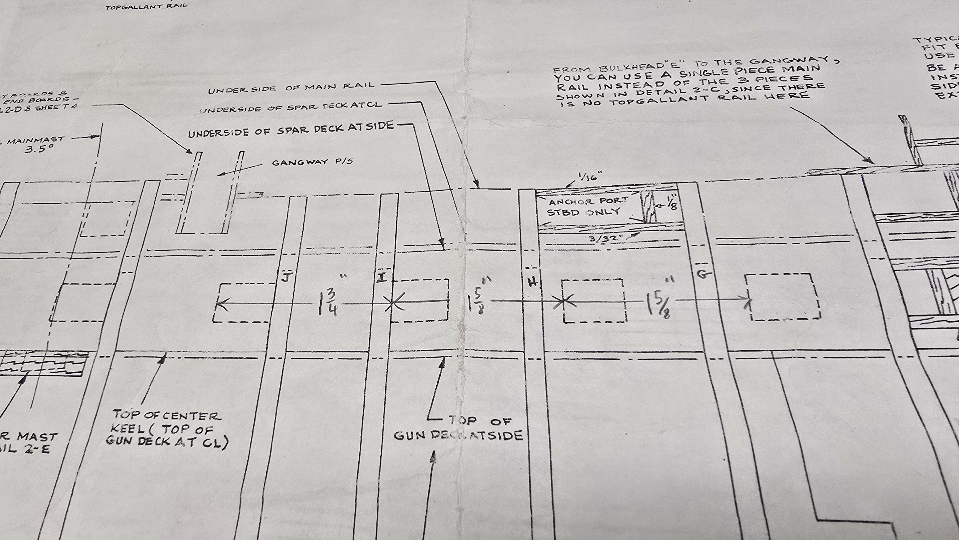

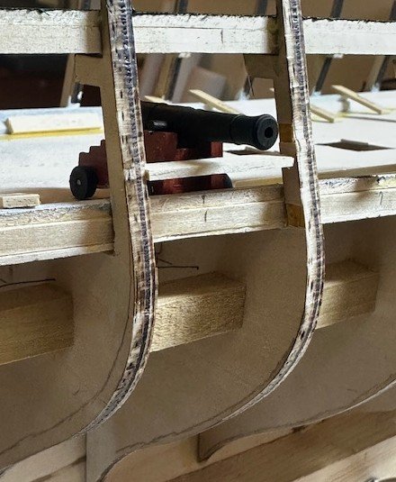

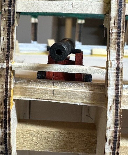

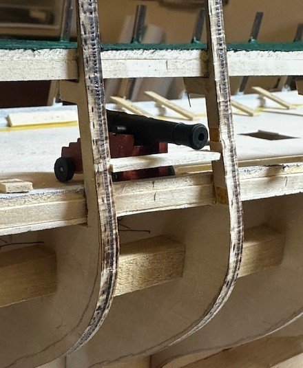

By placing the scale-size gun deck plans onto the false gun deck, I am able to see where the cannons will be placed for the gunport framing, which I will be working on next.  I wanted at least one mock-up of the 24-pound gun deck cannons and carriages in order to also test the placement of the framing.  While I really wanted to test my skills at making my own carriages using my mill, I chickened out and decided to at least try using Syren’s 3D printed black resin cannon and carriage assembly.
260106c-24poundCannon.jpeg.2c5861e95303858bf8749759f2a3dbf6.jpeg    260106d-24poundCannon.jpeg.20c749a7b9b55b238437620de1373bb6.jpeg
The cannon length of 1-23/32” (42.84mm) converts in scale very close to the actual 10’-5 3/4” length.  After assembling the carriage and doing some painting, the cannon looks pretty decent!  In accordance with the US Navy Plan #35810 painting schedule, the gun carriages are painted a Venitian Red color.  So, I got a tube of Utrecht Venetian Red acrylic paint.  I like the color!  And it looks fairly accurate.  This mock-up does not yet have any of the bolts and eyebolts added to it for rigging purposes.
