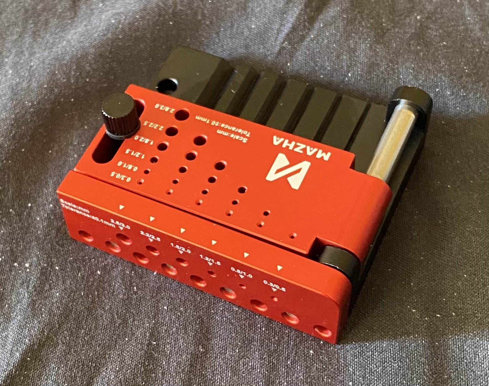

 This is cool tool. I would be especially interested in axial center drilling. Thinking over it I can see that to have a good centered hole I must use very accurately dimensioned round dowel stock. I measured my so called 4 mm dowels and they are all 3.87 mm. I have to put it into a groove marked as 4 mm DIA. The drilled hole will not be at axial center. I am afraid it will be very noticeable by the eye.
Would have to use a dowel plate first to assure the correct diameter.

I had not much success using a dowel plate on wood. I found no way to draw it through holes. It beaks if drawn or pushed through. May be I need to know some technics? How to draw the wood through the holes?
I'm sure there are examples on youtube.

True. It may work best for builds at a certain scale. Larger dowel drilling can be done in various other ways. But for some it may be a big time saver.

I tried my old jewelers draw plate today. I easily drew my 3.87 mm wood dowel into 3.5 mm and 1.78 bamboo toothpick into 1.5 mm. These are the sizes required for the tool in question.

I have unpleasant experience with DSPIAE tool maker. IMHO their tools are bad but made to look as expensive quality tools. I have their circle cutter. All hex head adjustment screws are made of material so soft that their hex indent gets broken first time I tried to have them adjusted with hex key.
Thank you for the news that it is made metall, I thought by the looks to be plastic ...
forth For the scaling of the diameters no problem, use some Scotch film, Tesa Film or masking tape wrapped around to bring it to the next size, should do the trick 🙂
So 3.87 mm becomes a almost neat 4 mm.
