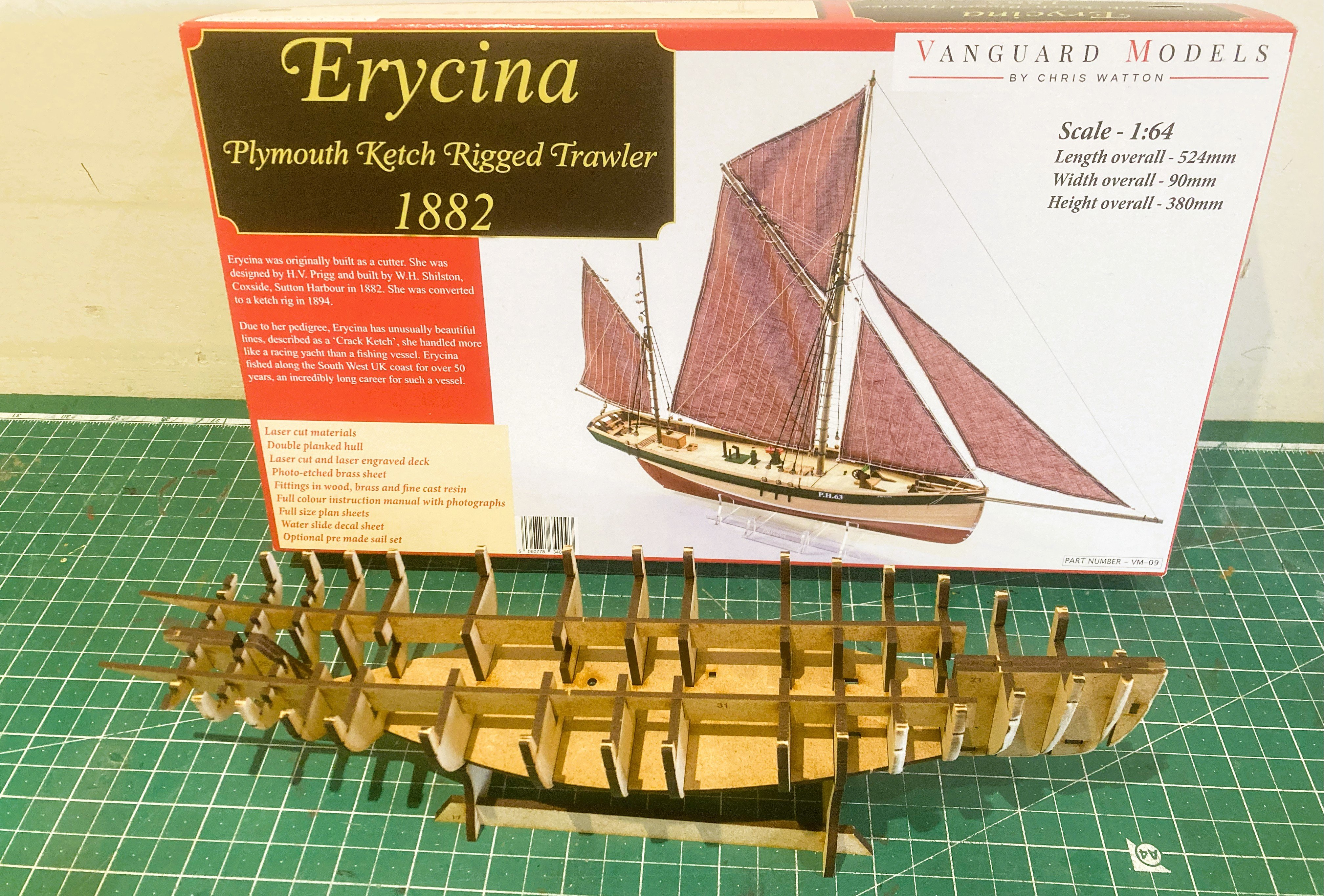

Erycina - Ketch rigged Plymouth Trawler 1882.
I’ve had this kit for a while, and with nothing specific in the immediate offing it will give me hopefully a no stress easy build of this pretty little fishing vessel to complement my Fifie and Zulu builds.
I was attracted to this boat by its sleek lines and interesting sail plan. Given the open deck and Fore and aft rigging it will be fairly easy to clean, and casing will not be required. It is also a model that will fit in a fairly small space.
My interest is also piqued given additional detailing for Erycina is provided in the book Sailing Trawlers by Edgar J. March
I can see an opportunity to indulge myself with a little off-piste detailing work.

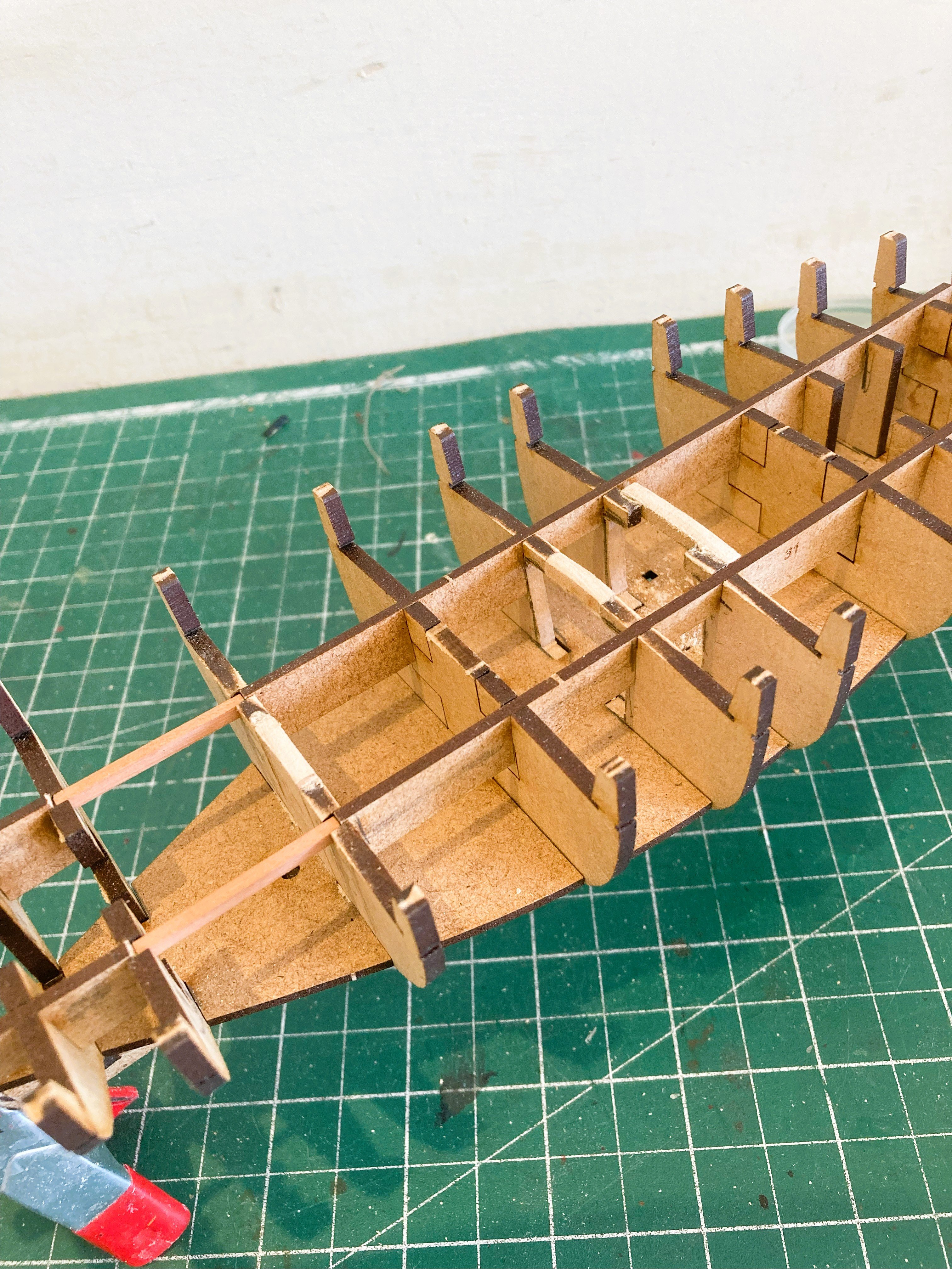

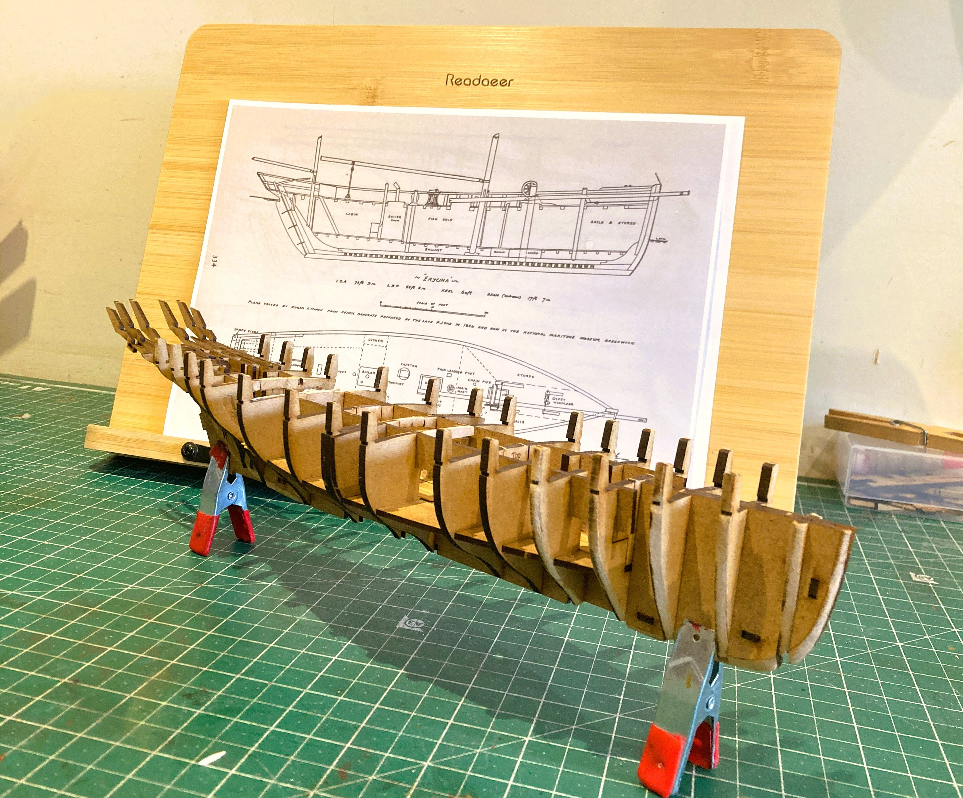

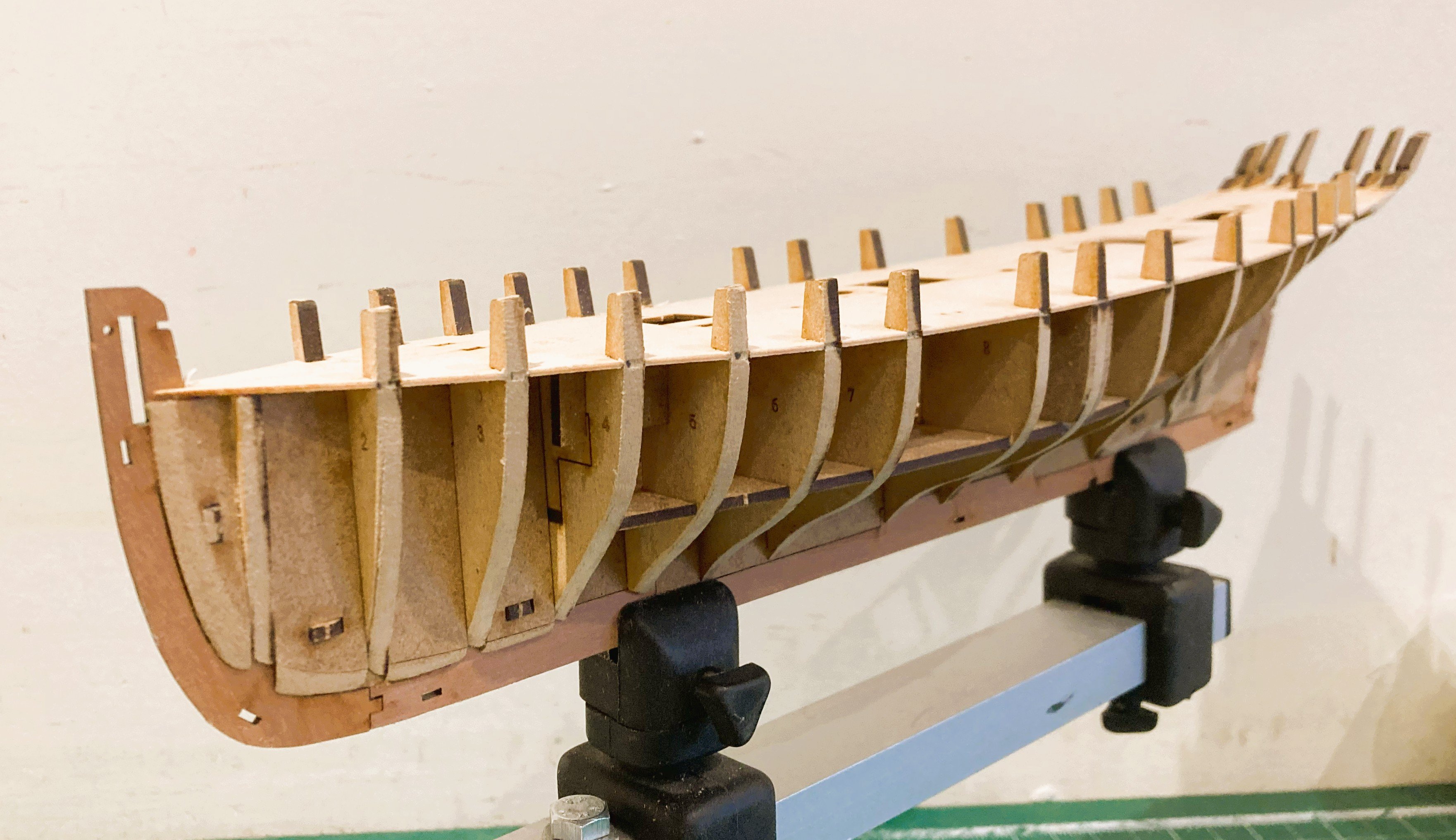

Early stages
The early stages of construction are just as we have come to expect from Vanguard.
5534a
Rapid early progress with glueless assembly of perfectly fitting parts.

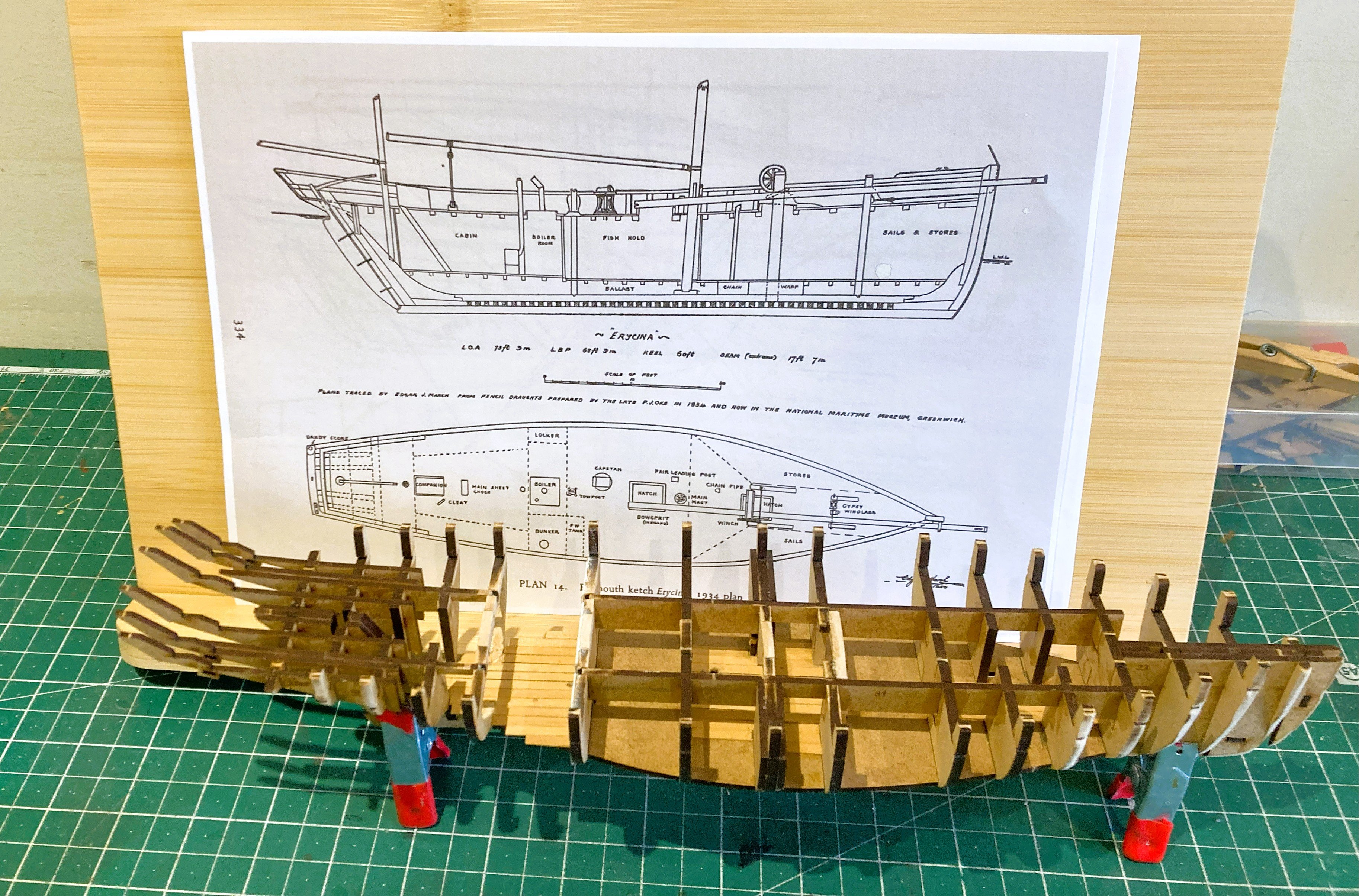

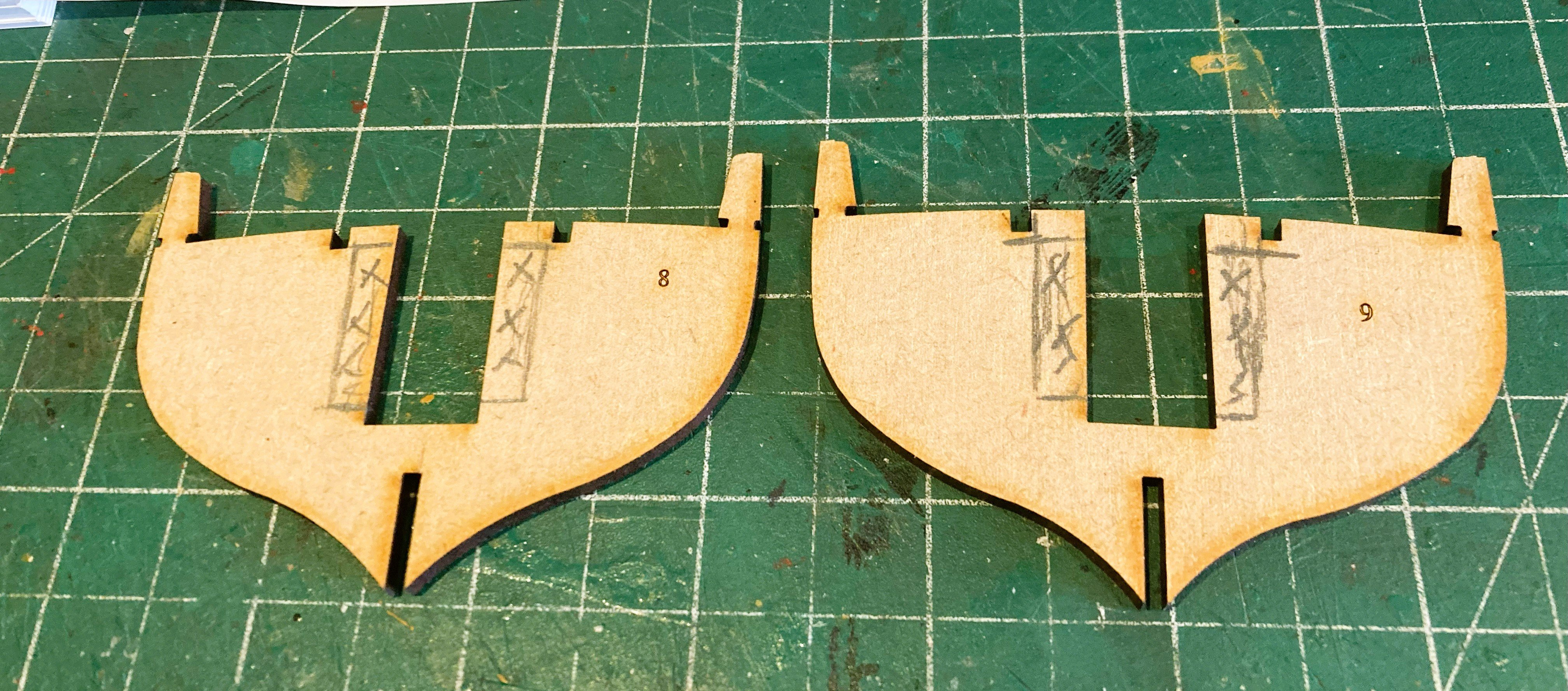

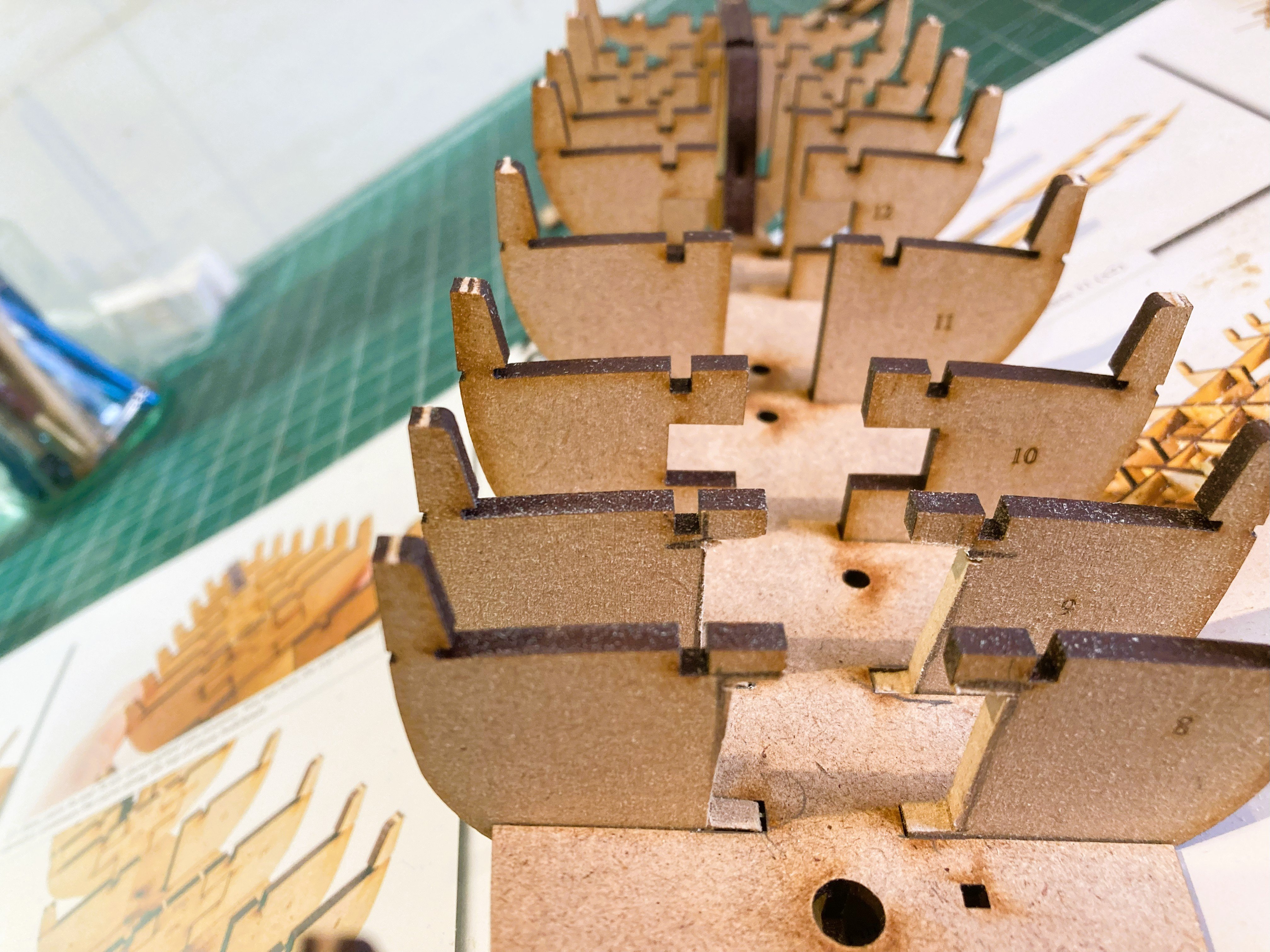

That is unless you decide to open up the lower deck areas of the Fish hold and the cabin space.
5537a

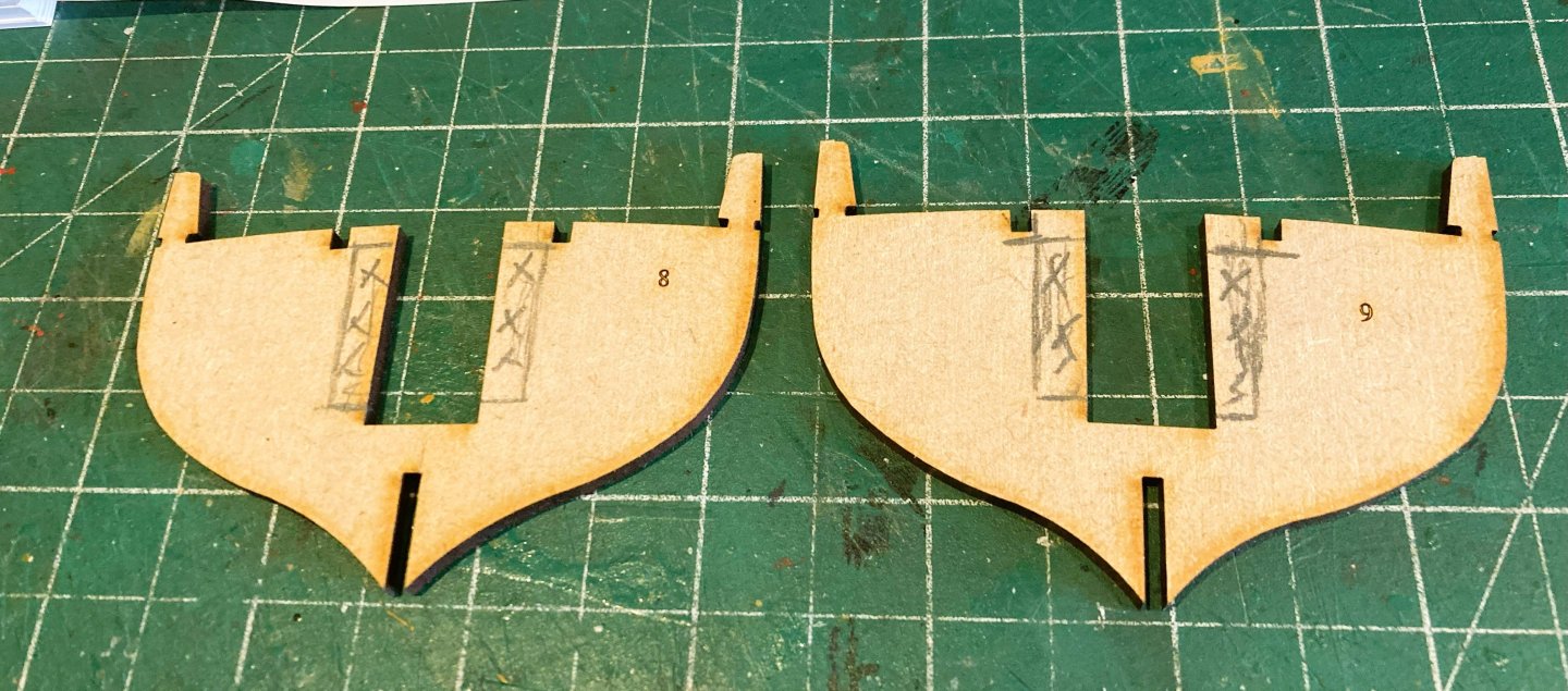

This involves some modification to the Bulkheads  8 and 9 ( in the case of the fish hold, and Bulkheads 12 and 13 in the case of the cabin area.
5539a
5540a
Bulkheads 8 and 9 modified to give a clear space below the Main Hatch to the Fish hold.
5547a
Faux deck beams are added but won’t be seen.
5548a
I was quite surprised by the small main hatch on Erycina, Barely 3’ 6”(L) X 3’.0 (W). Seems hardly practical on a fishing boat, and miniscule compared to the cavernous hatchways on the Fifie and Zulu boats.
She is however, quite a bit smaller than either Fifie or Zulu.
I do like to have some open hatchways, gives depth to a model and at least an impression of more there than there is.

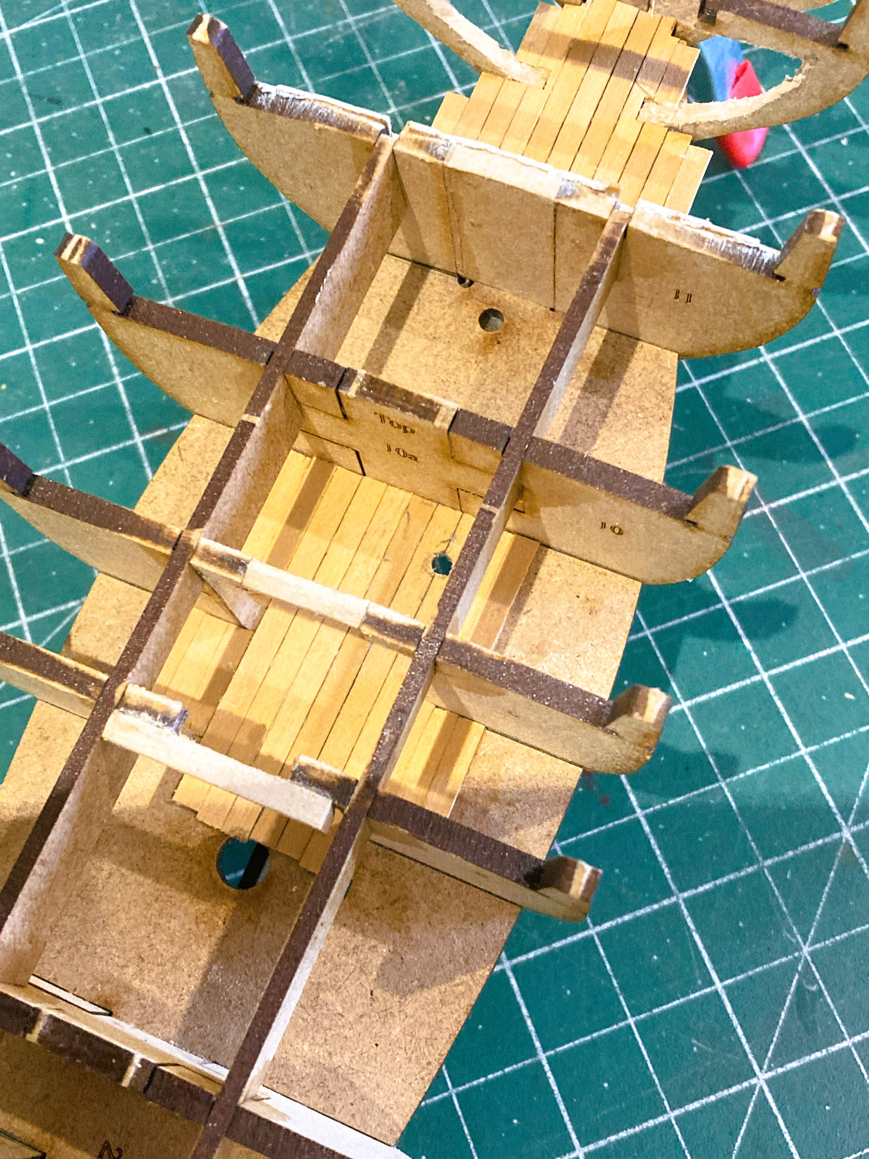

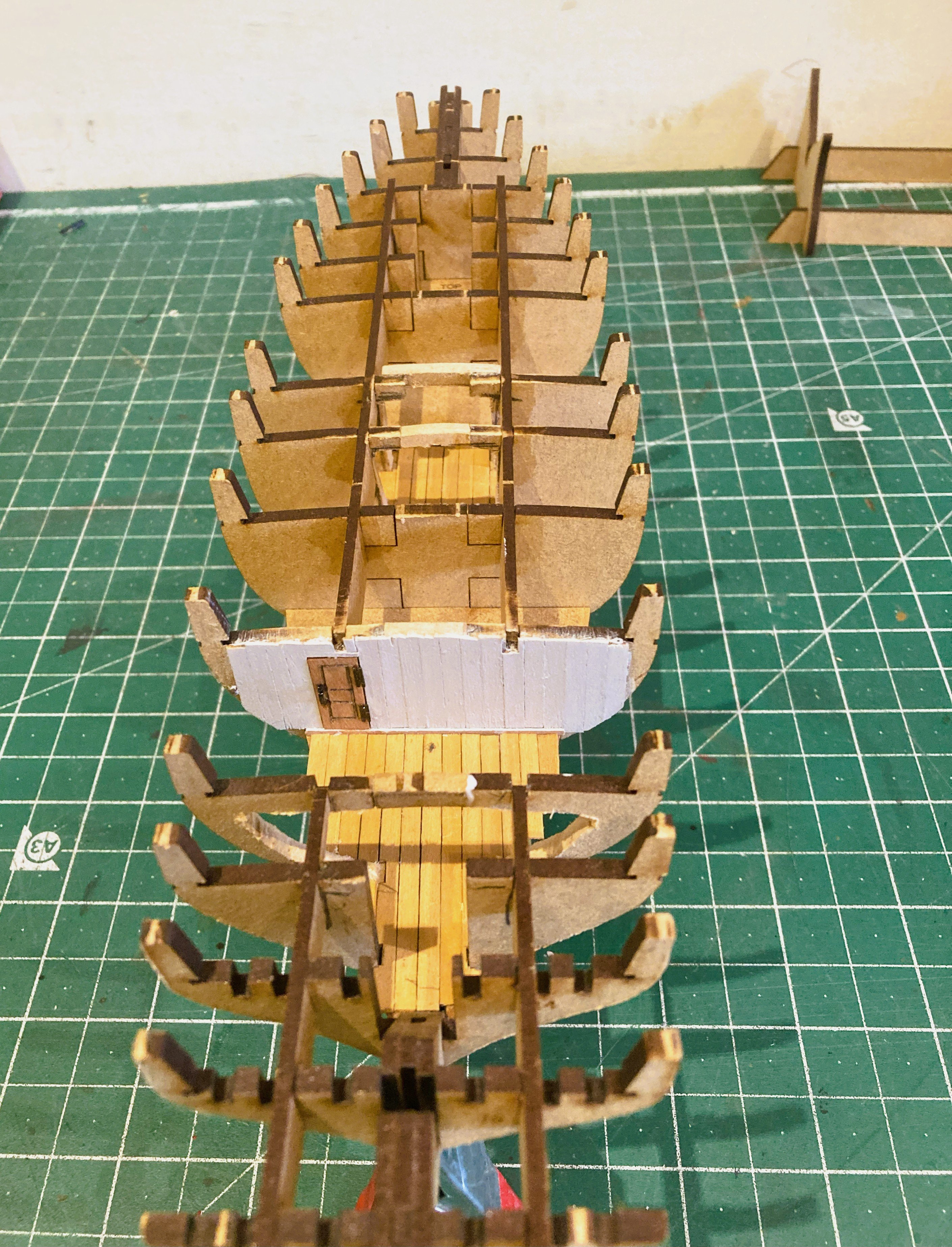

Stern cabin area

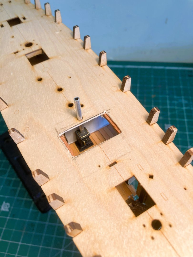

My idea is to fit out the cabin, certainly with the iron stove which will connect to the flue pipe emerging thro’ the deck, and  maybe with other fittings as space allows.
A section of deck will be left unplanked above the cabin.

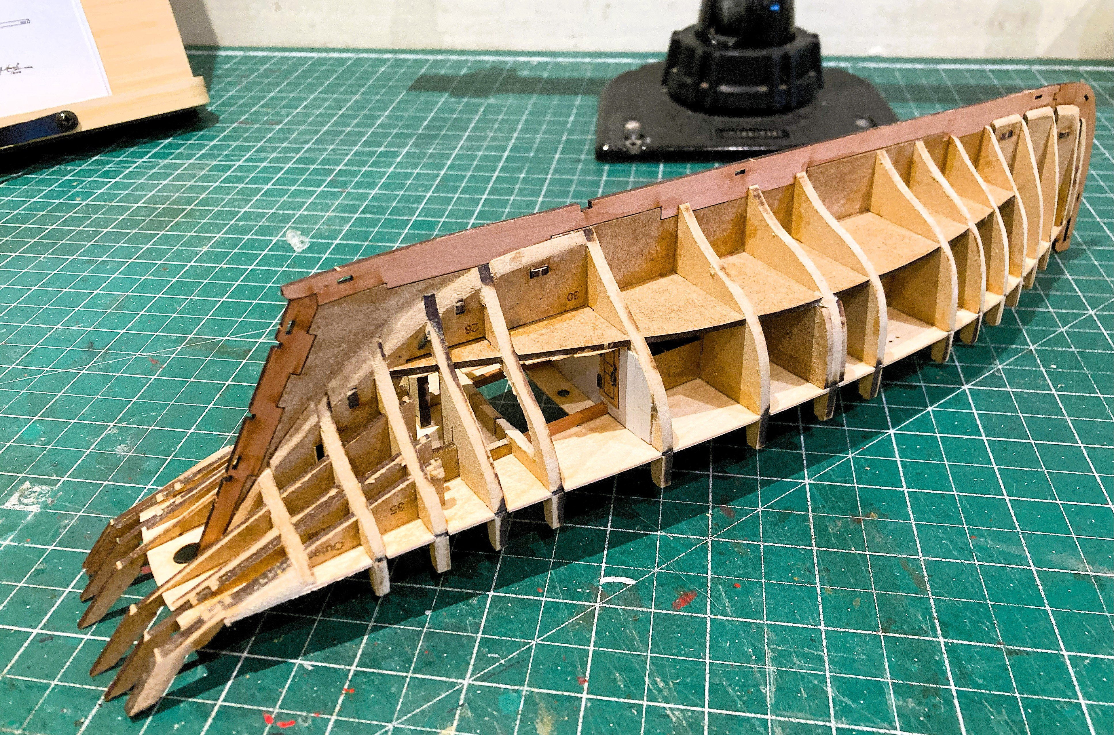

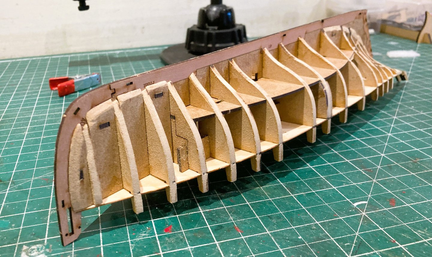

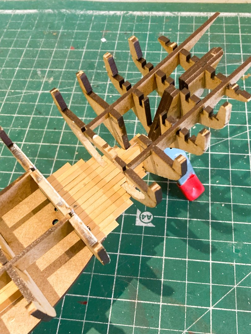

Modifying the cabin area is tricky, partly because work on Bulkhead 12 is more extensive, and because it proved too difficult to remove for shaping without risking damage and therefore had to be modified insitu.
The filler pieces between the bulkheads prevented removal.

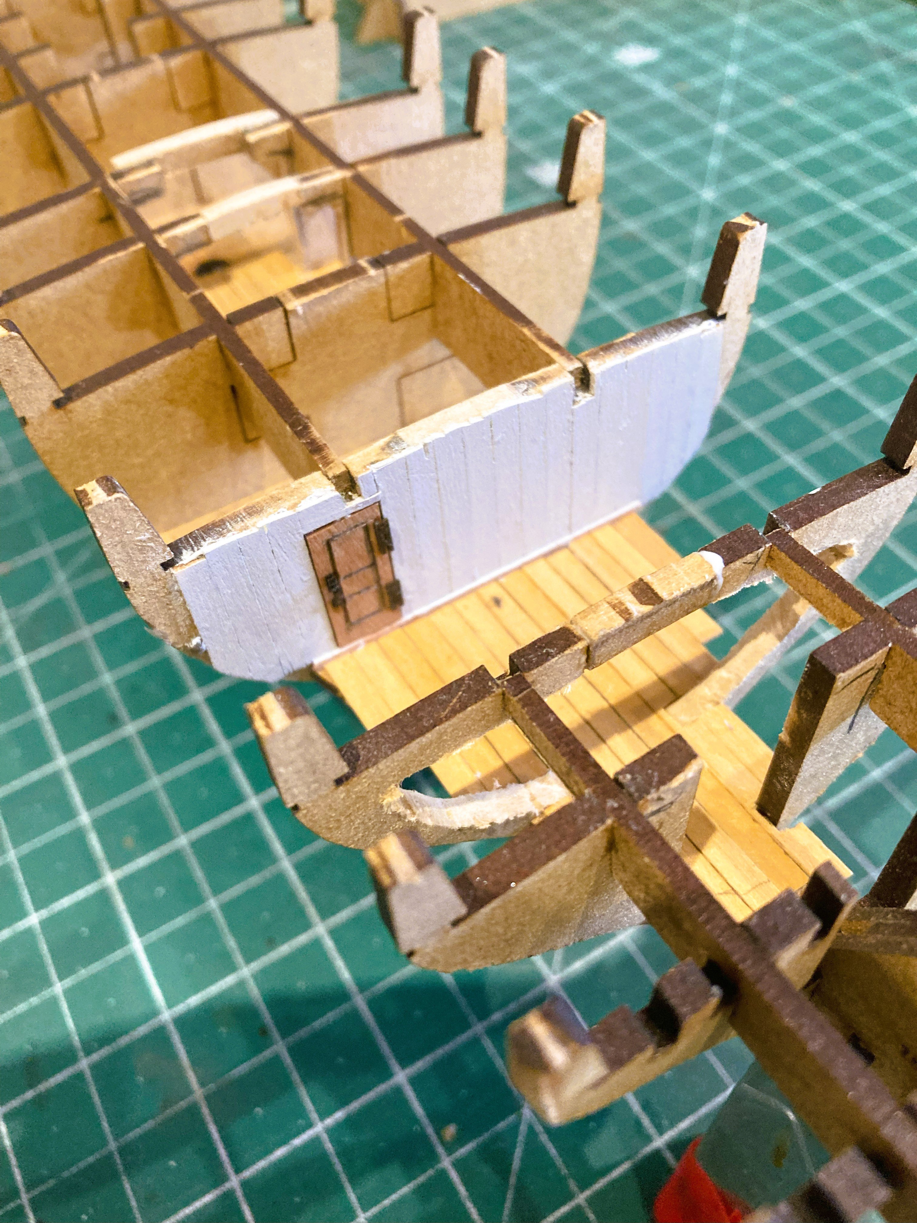

Bulkhead 11 is closed off as this forms the partition between the cabin and the Boiler room.
Bulkhead 12 bears the brunt of modification with large sections removed to create frames and beams. Tricky to get at to shape and sand.
5552a

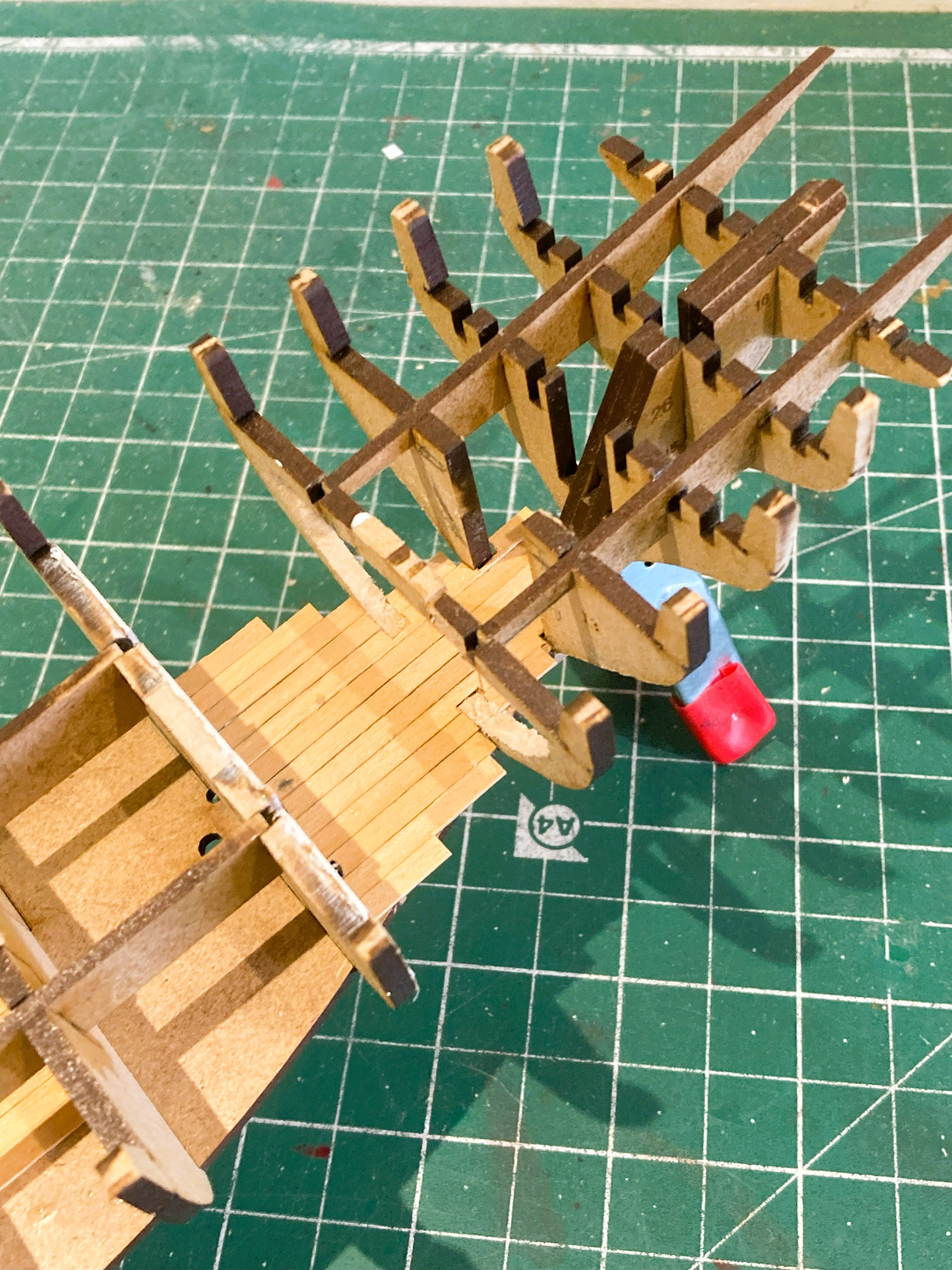

In this area the longitudinal bracing patterns are removed and replaced with Pear carlings.
5553a
Bulkhead 11 is boarded using Boxwood strip and Whitewashed.  A doorway leads to the Boiler room and the door is created from Boxwood strip and decorated with Syren hinges and Handle.
5554a
5557a
The cabin deck area is planked with Boxwood strip.
5559a
Similarly, the Fish hold is decked out using Boxwood strip.
5565a
A paper deck print is used to determine the viewable area.
Still work in progress, but you get the idea.

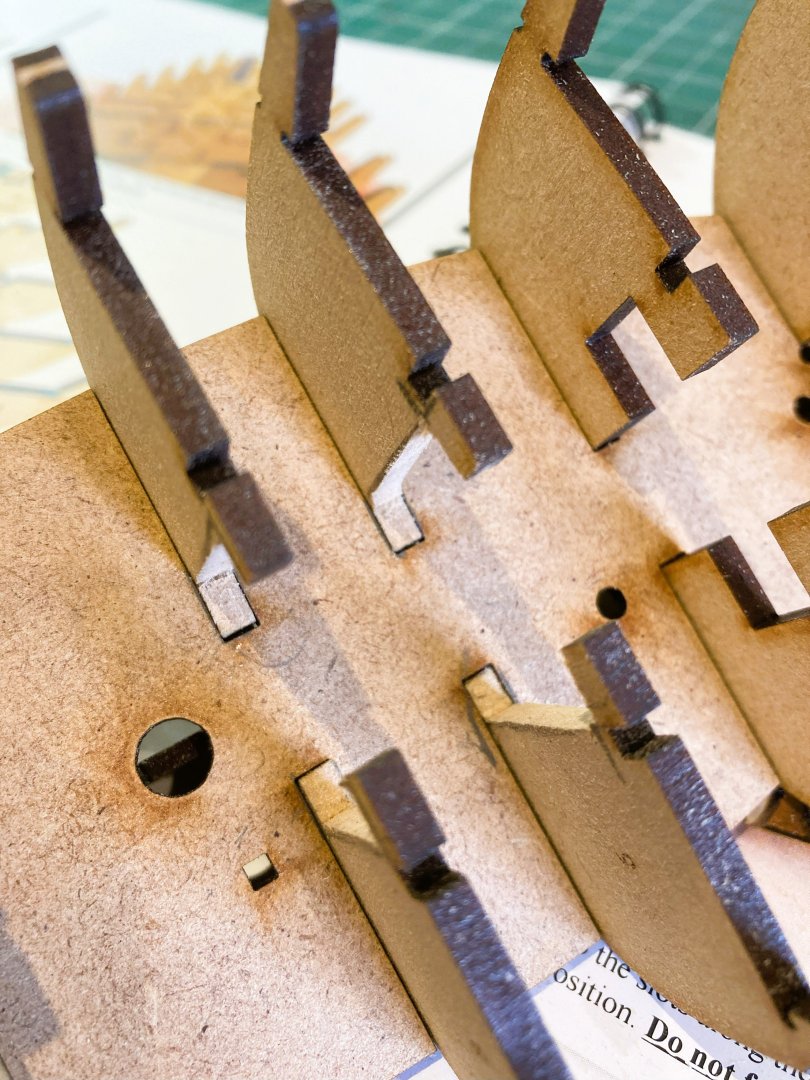

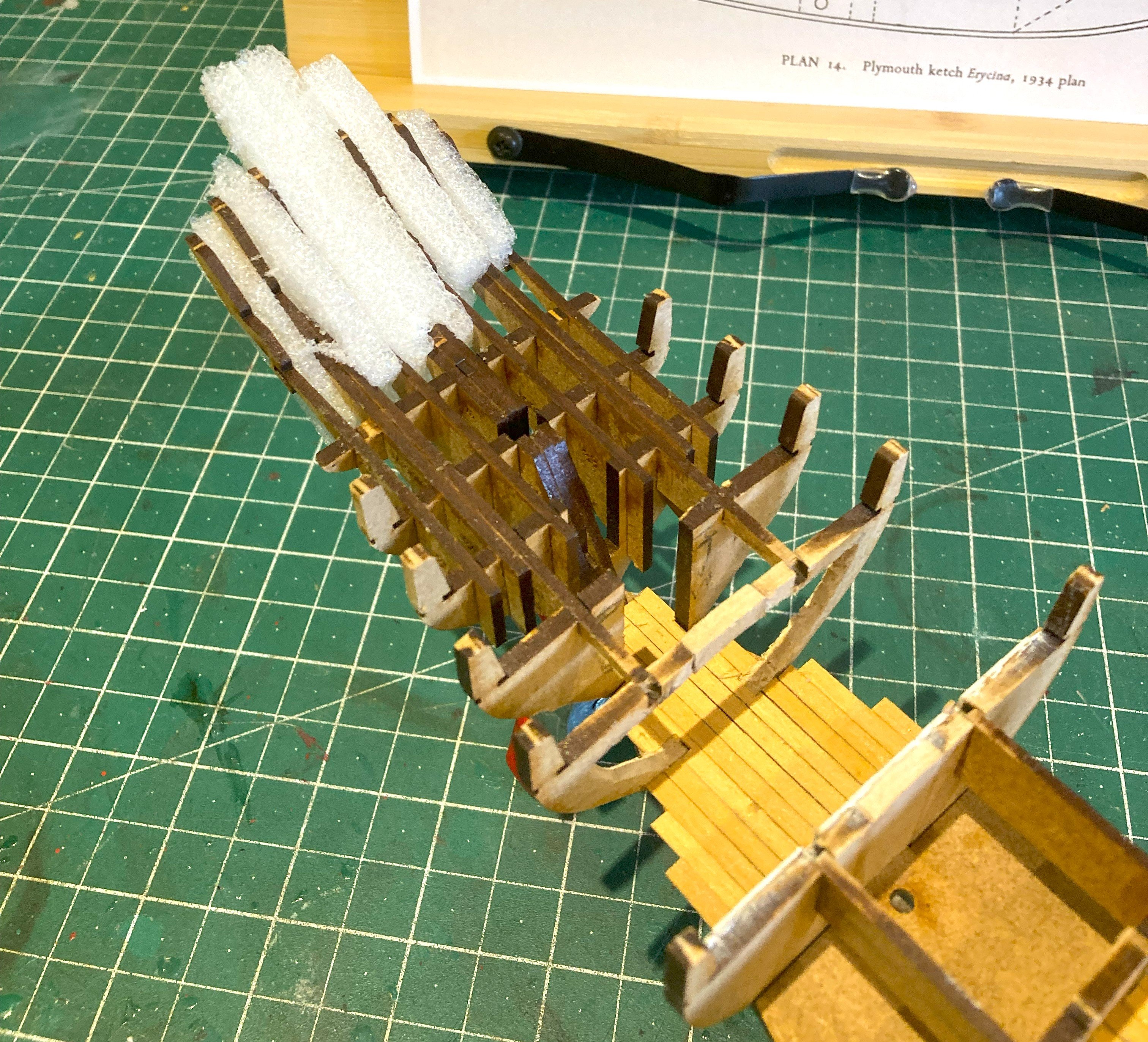

Stern timber frames

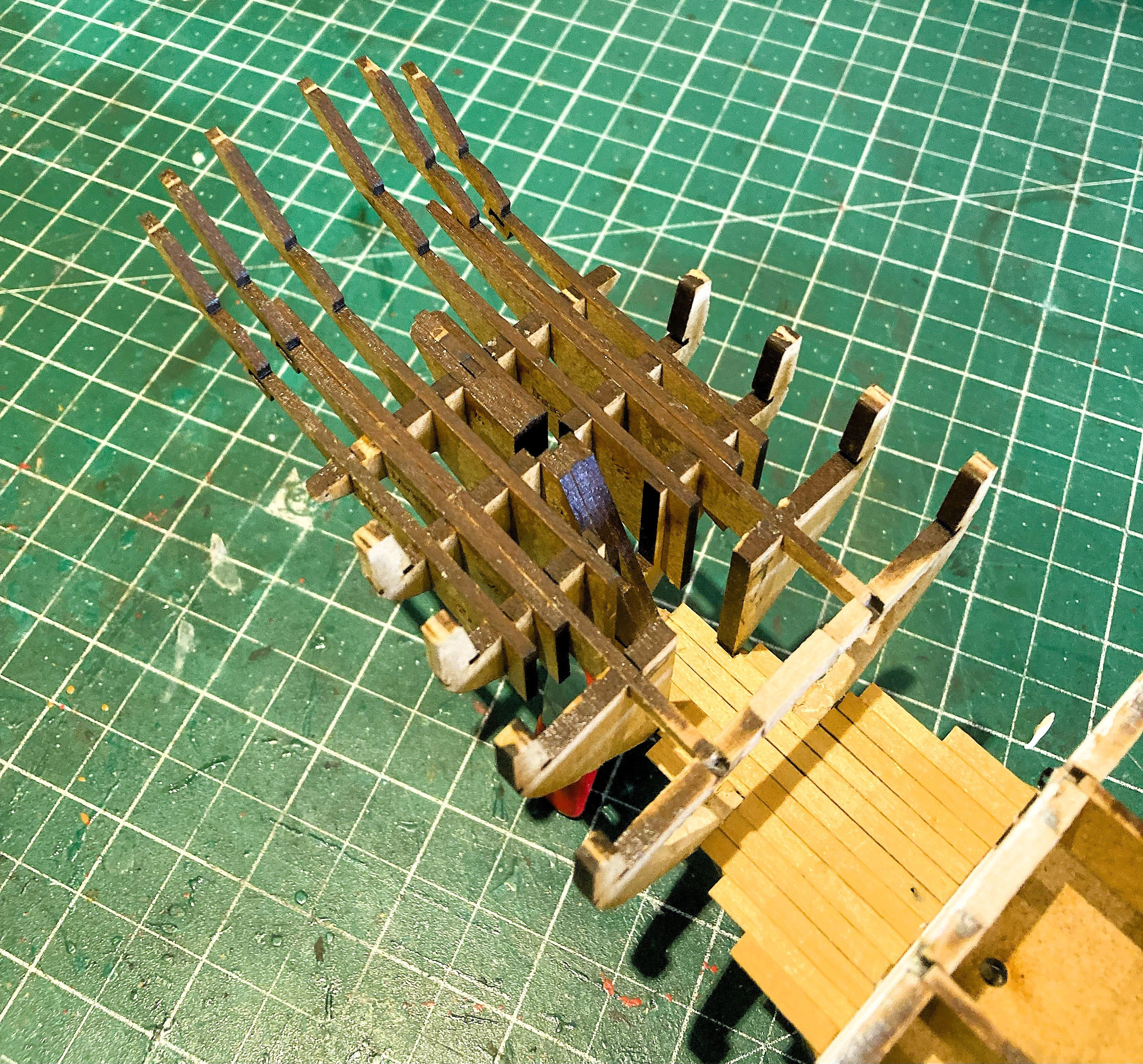

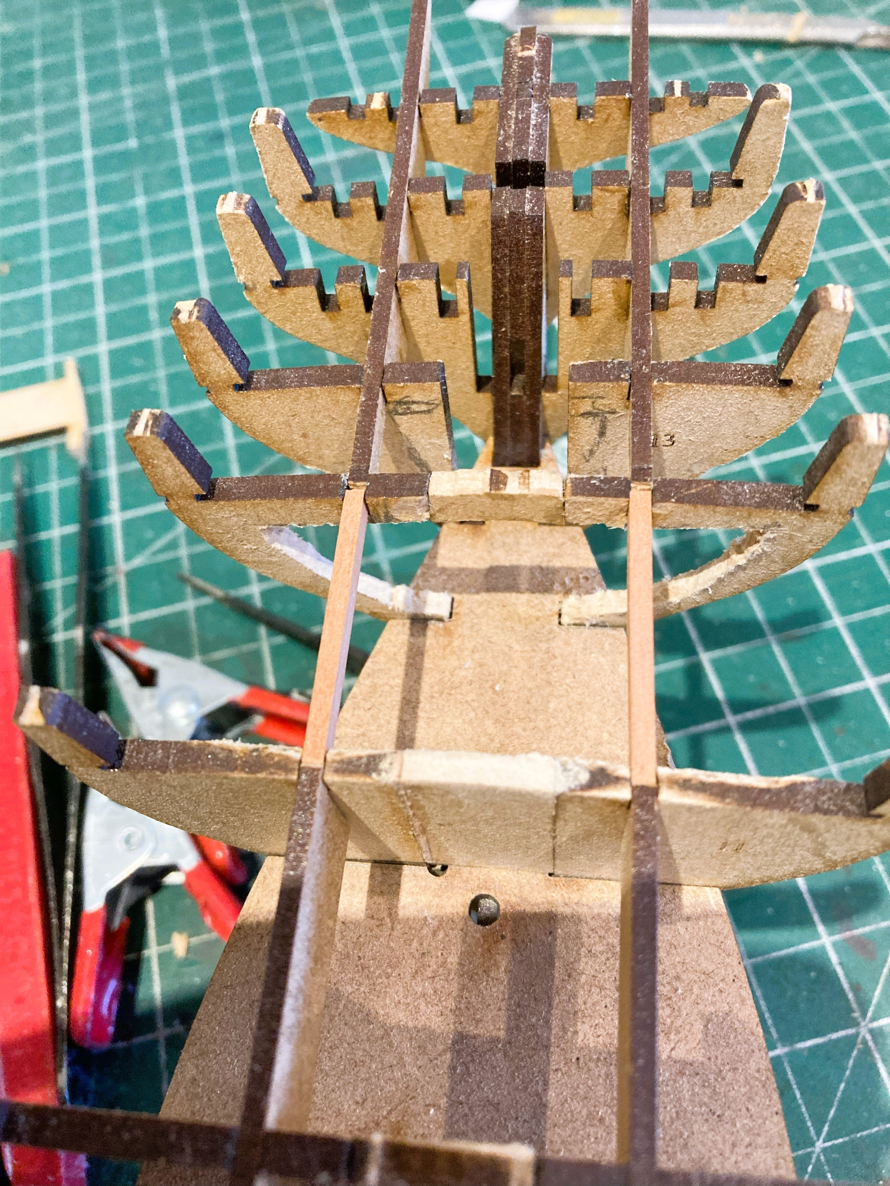

These are the long and vulnerable mdf stern timbers that set alarm bell ringing in my ears.
Great care is required not to stress or knock in the early build stages; repairs could prove tricky.
5572a
I found that careful sanding of the slots, and trial fitting was required to achieve a firm but not overtight fit which may have created difficulty if subsequent removal was necessary.
5573a
Fitting support pieces between the timbers is advisable. I use styrene foam pieces which are ideal.
Once the bulwarks are fitted this area becomes less at risk.

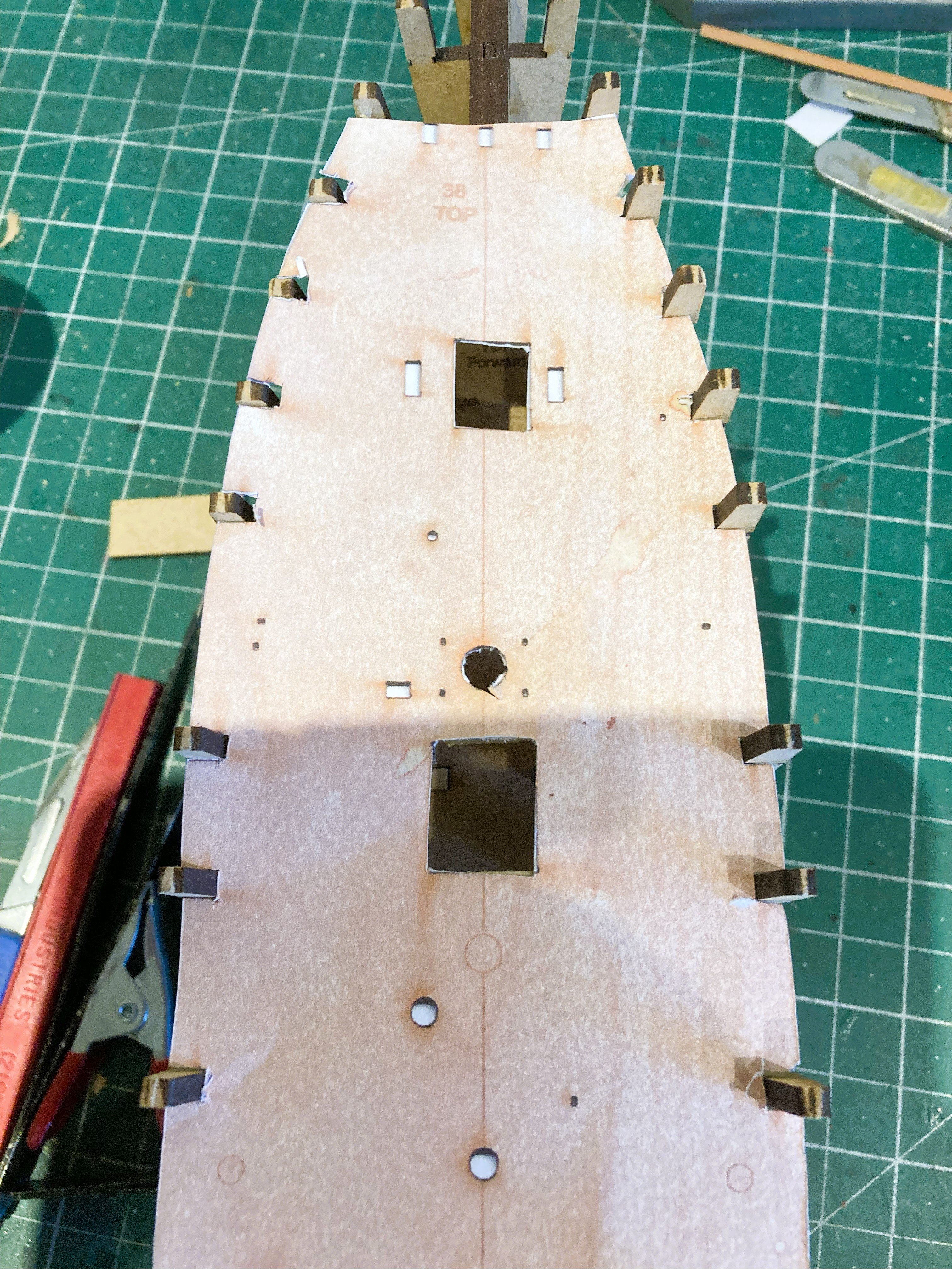

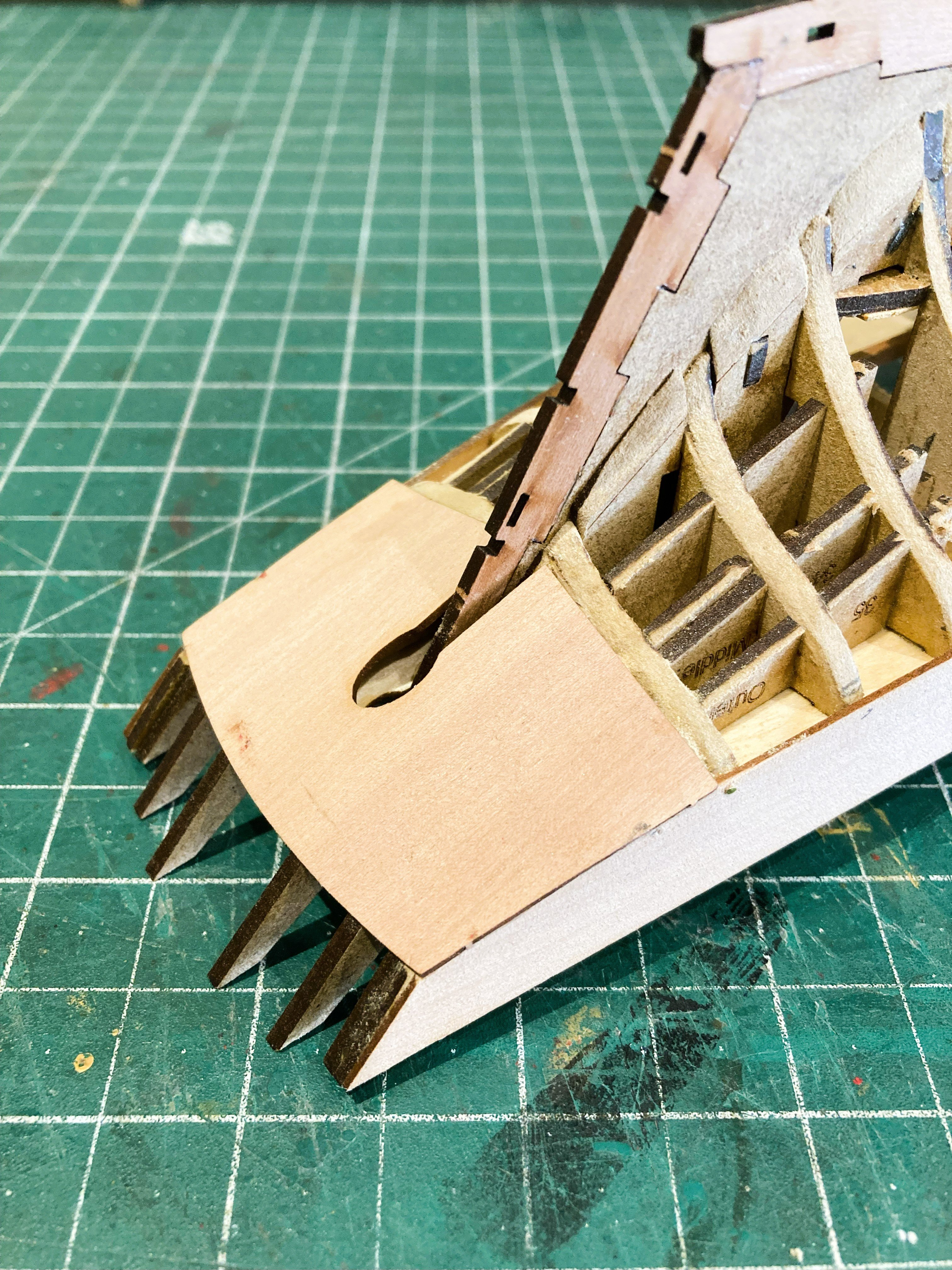

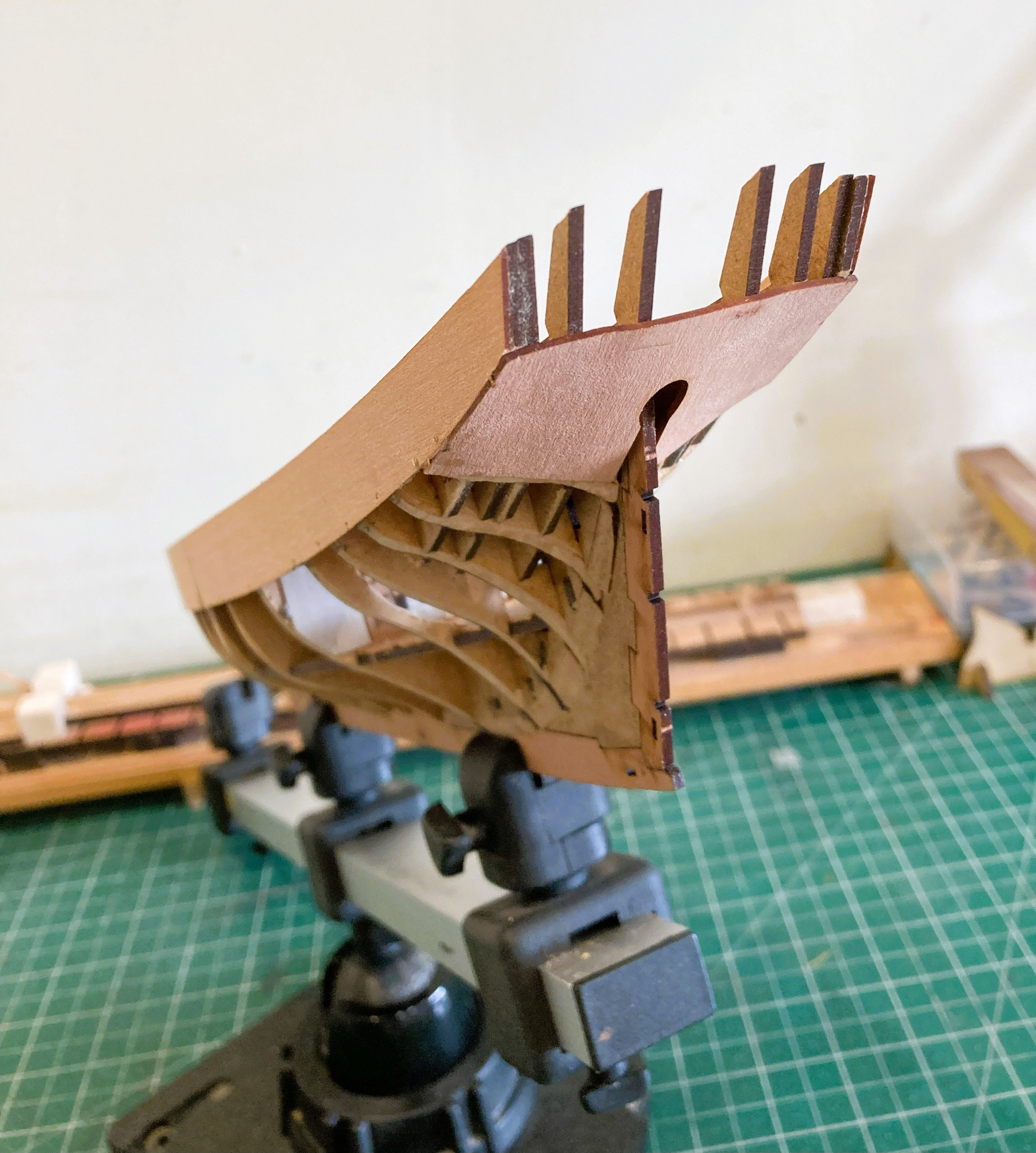

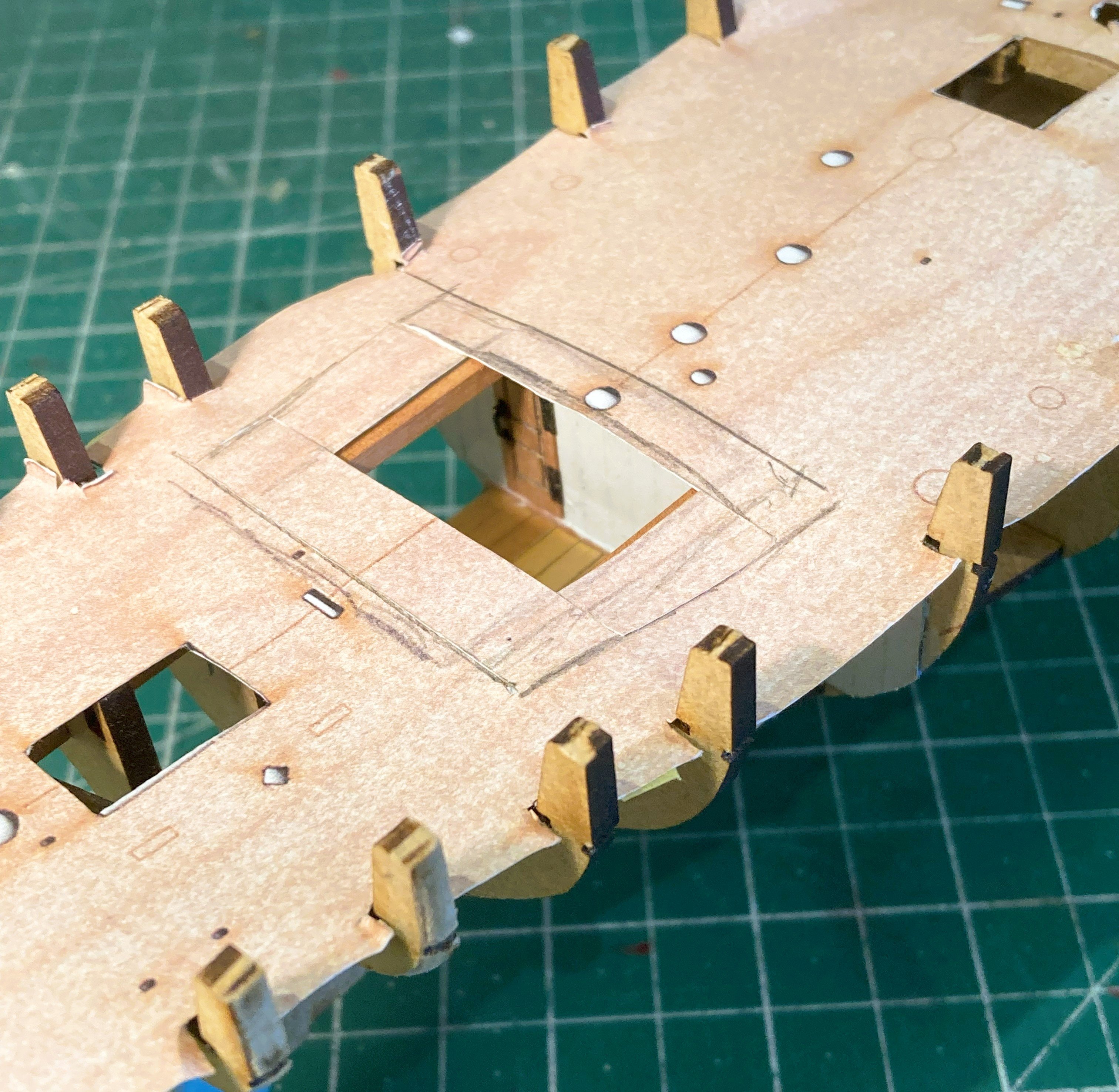

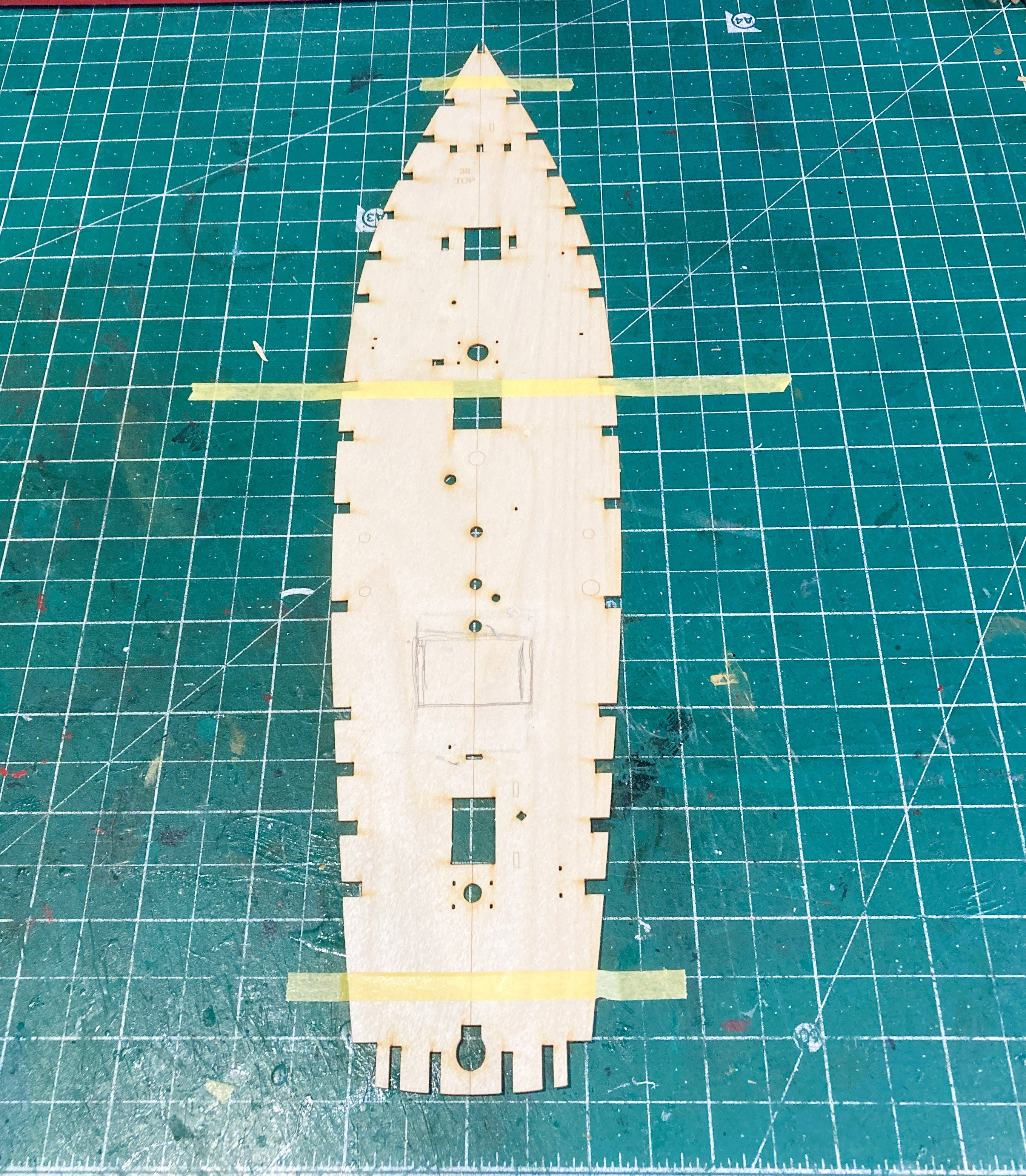

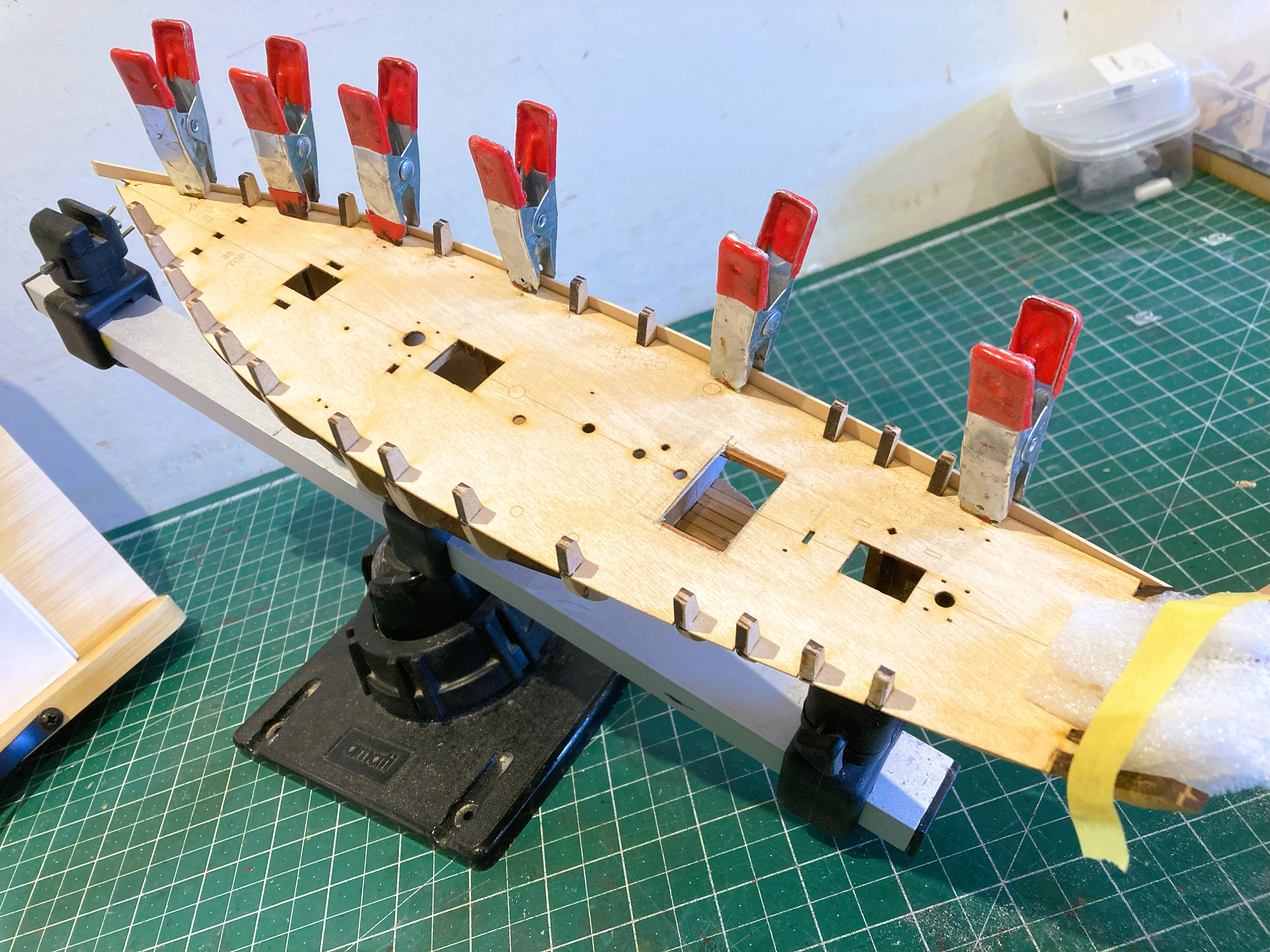

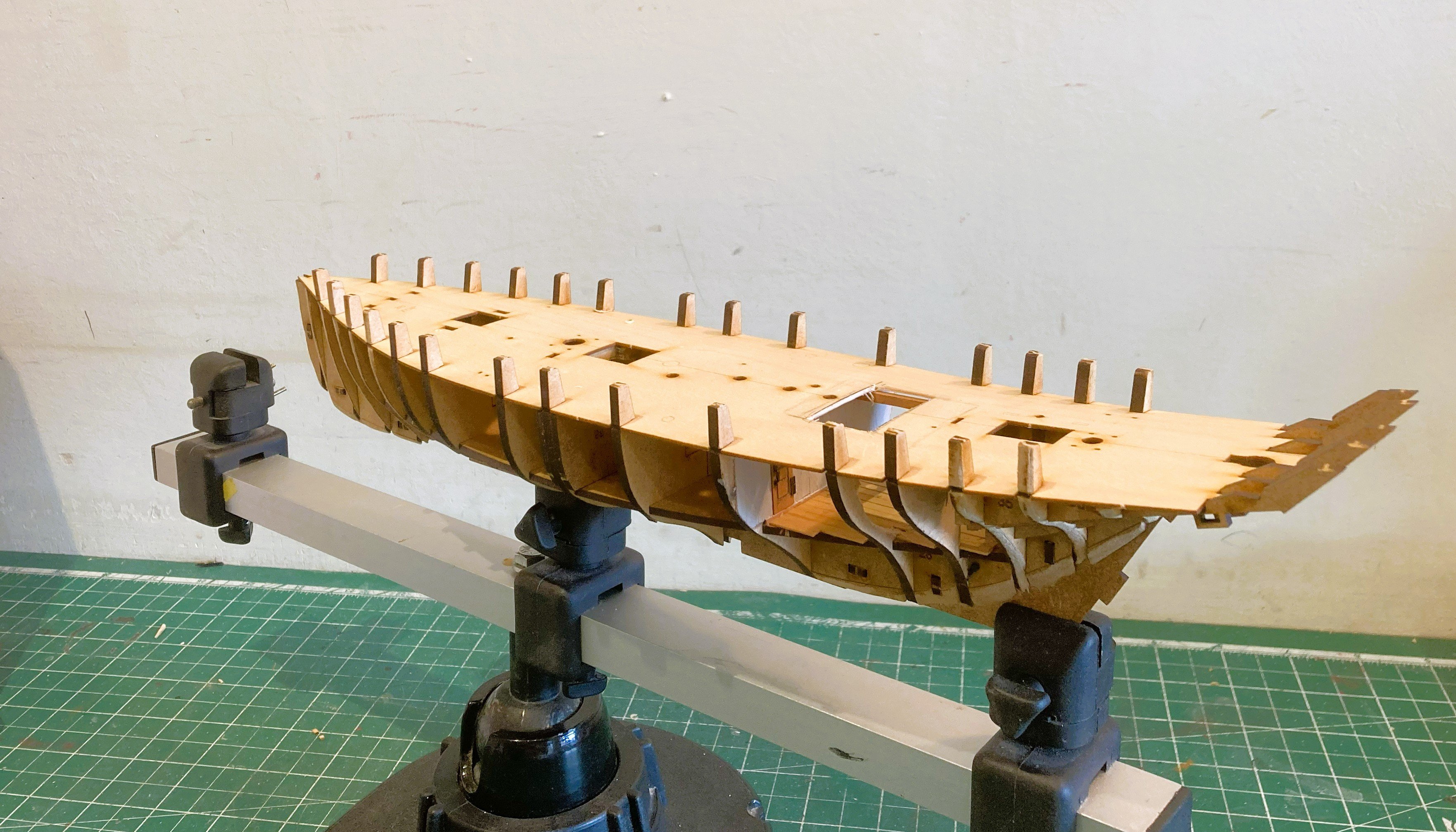

This is now the time to fit the ply sub-deck which will secure the bulkheads from lateral flex during fairing. Another testy little exercise.
5580a
The deck is taped square on the cutting mat to mark and remove the section above the cabin, a margin is allowed for some final trimming.
5582a
The bulkhead slots are tested for ease of fitment and having fully inserted the deck into the port side slots I work along the starboard side from fore to aft individually flexing and pressing the deck into place at each slot.
5584a
There is always fear of breaking something with this exercise, but firm and steady pressure get the job done.
I was pleased to see that the deck sits tight against the bulkheads and stern timbers, no pressure necessary to hold the deck down.
The hull is now rock steady for the fairing process to begin.

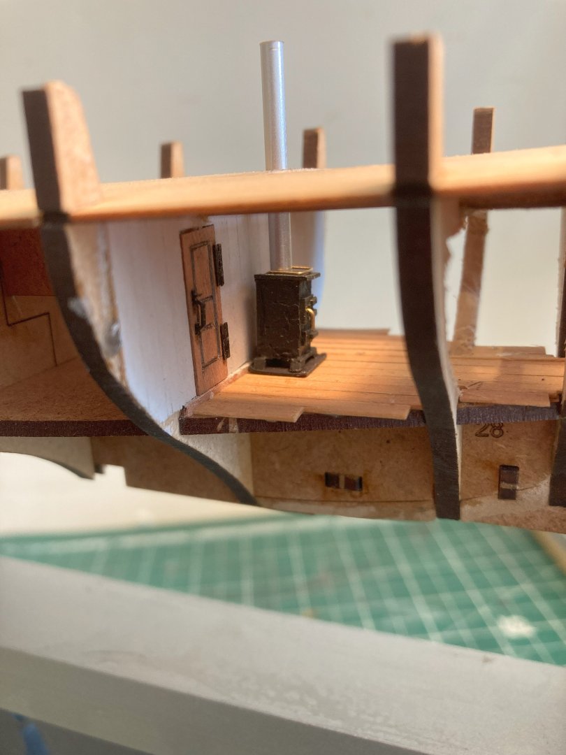

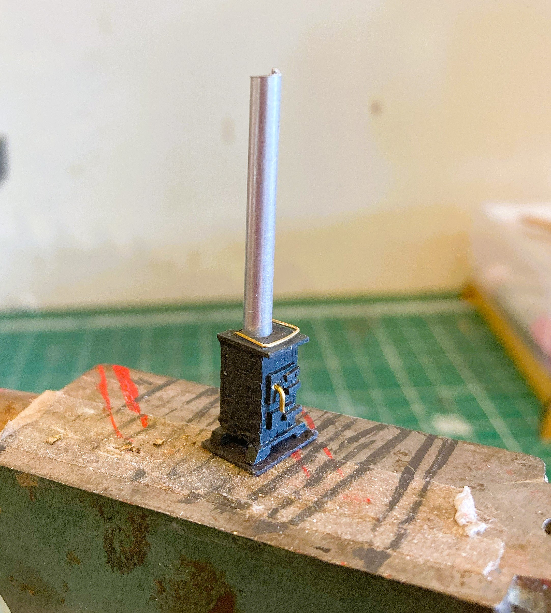

It is certain that a small stove was contained within the cabin of Erycina but the kit only shows the Flue pipe emerging above deck.
5585a
Before I begin fairing I knocked up a small stove to check the fit and position for the line of the flue pipe.
It is a tiny thing measuring only 12mm x 6mm.
5593a
The main objective is to see how it looks in the cabin position.
5595a
I think it will pass muster, at least to a blind man on a galloping horse.

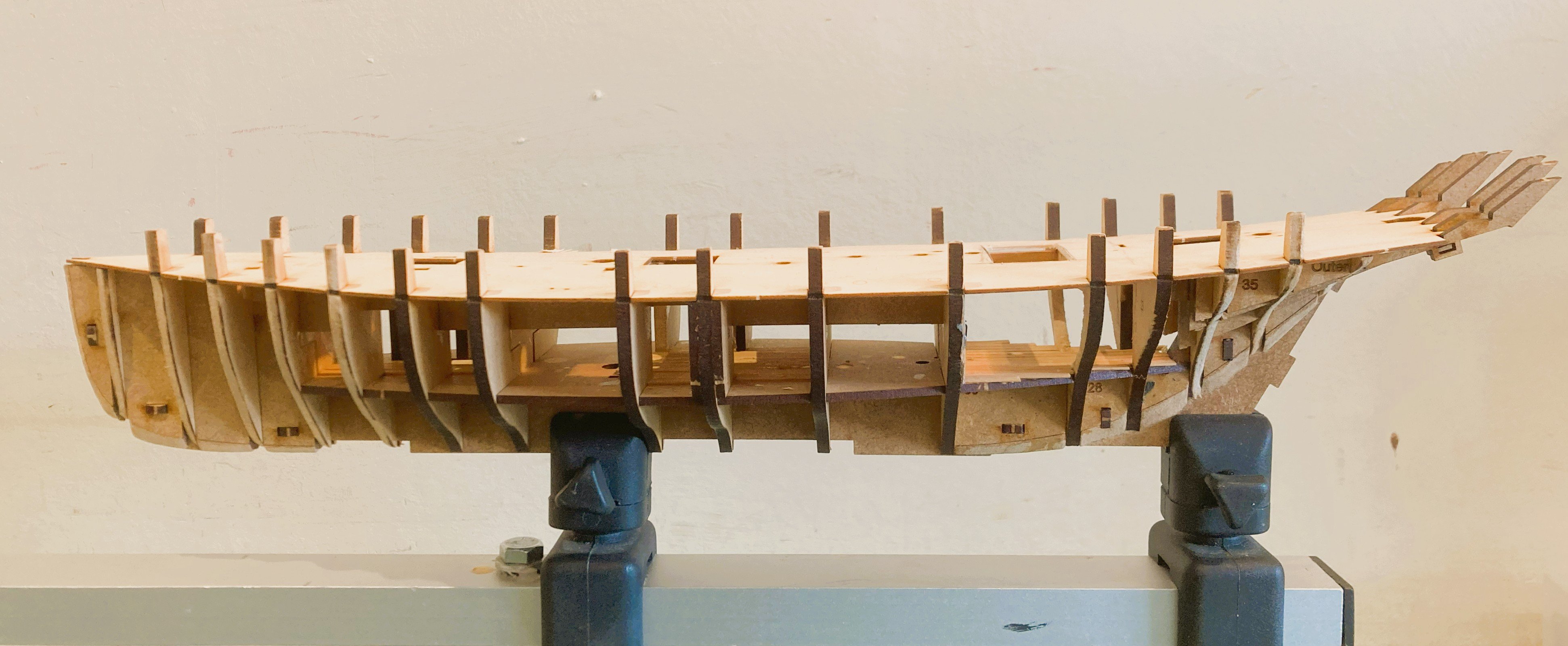

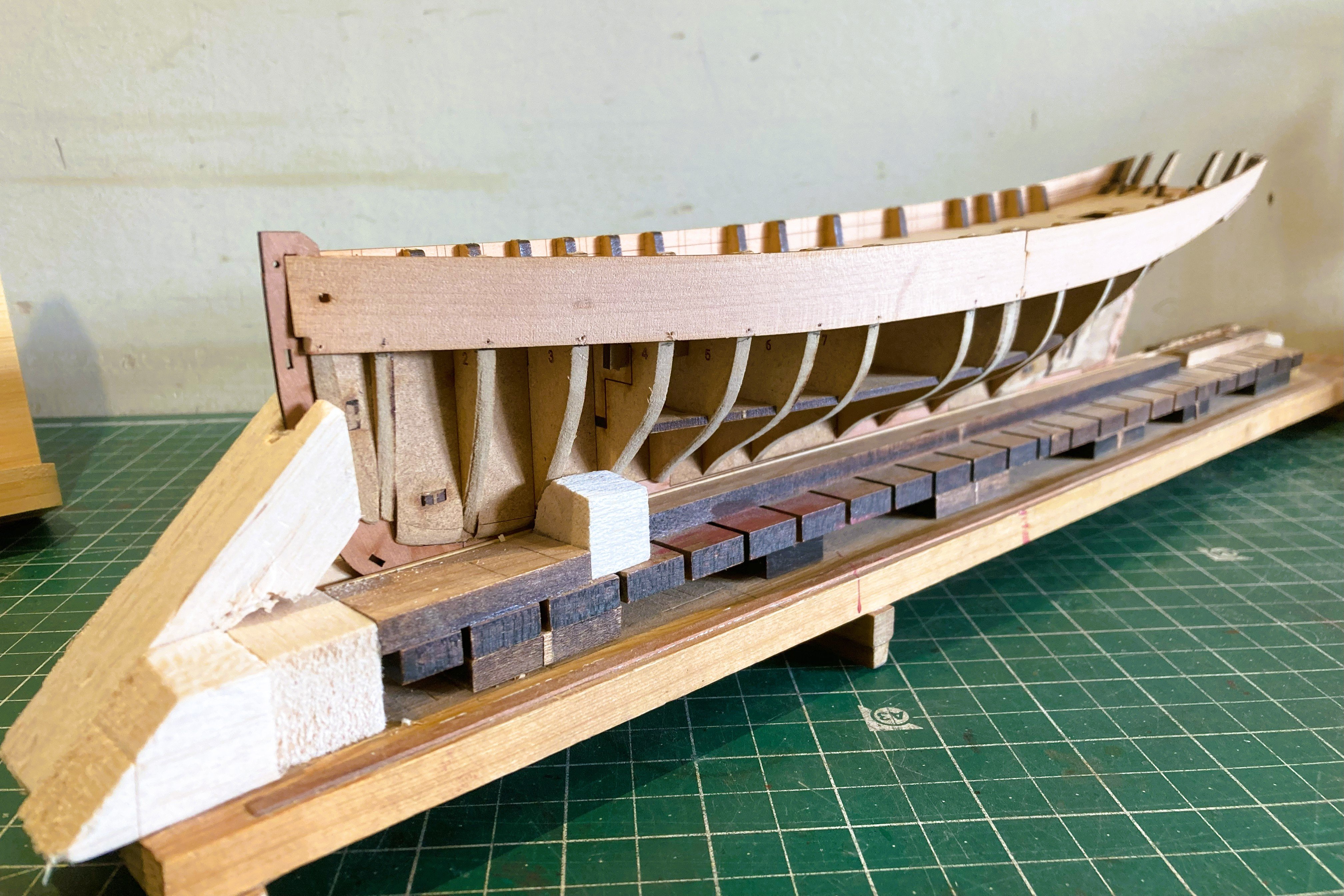

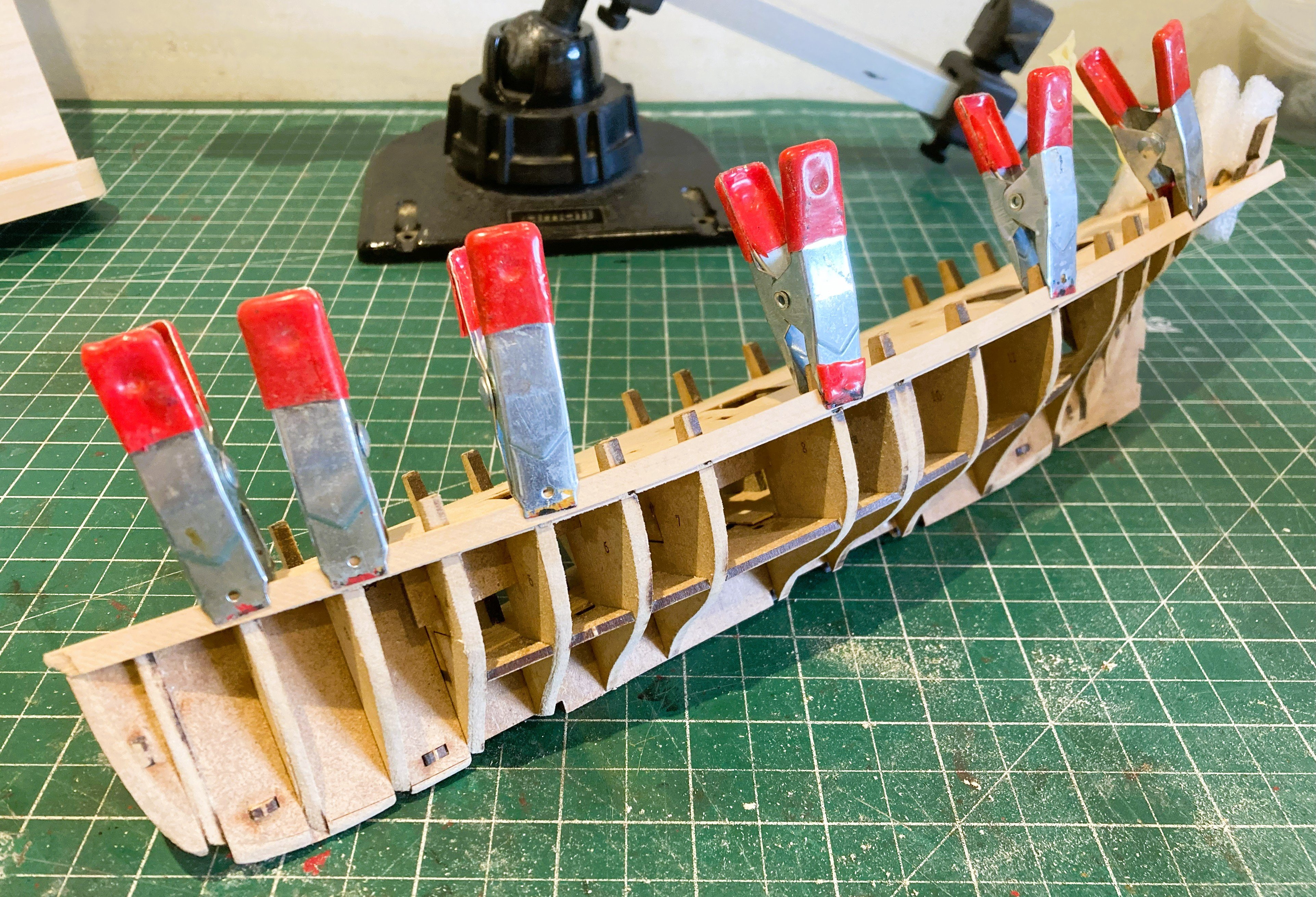

Fairing is straightforward on Erycina, it’s nice to have a hull that will fit in one hand to work on.
5600a
5604a
A careful check is made to ensure that a test board will fit tightly against the deck edge and bulkhead ears.
5607a
5608a
Similarly, all points of the faired bulkhead edges are checked using a test board to ensure full contact down to the keel.
5612a
5616a
5620a
The final stage of this section is the addition of the Pearwood  keel, Bow and sternpost parts. They all slot perfectly together into the false keel.

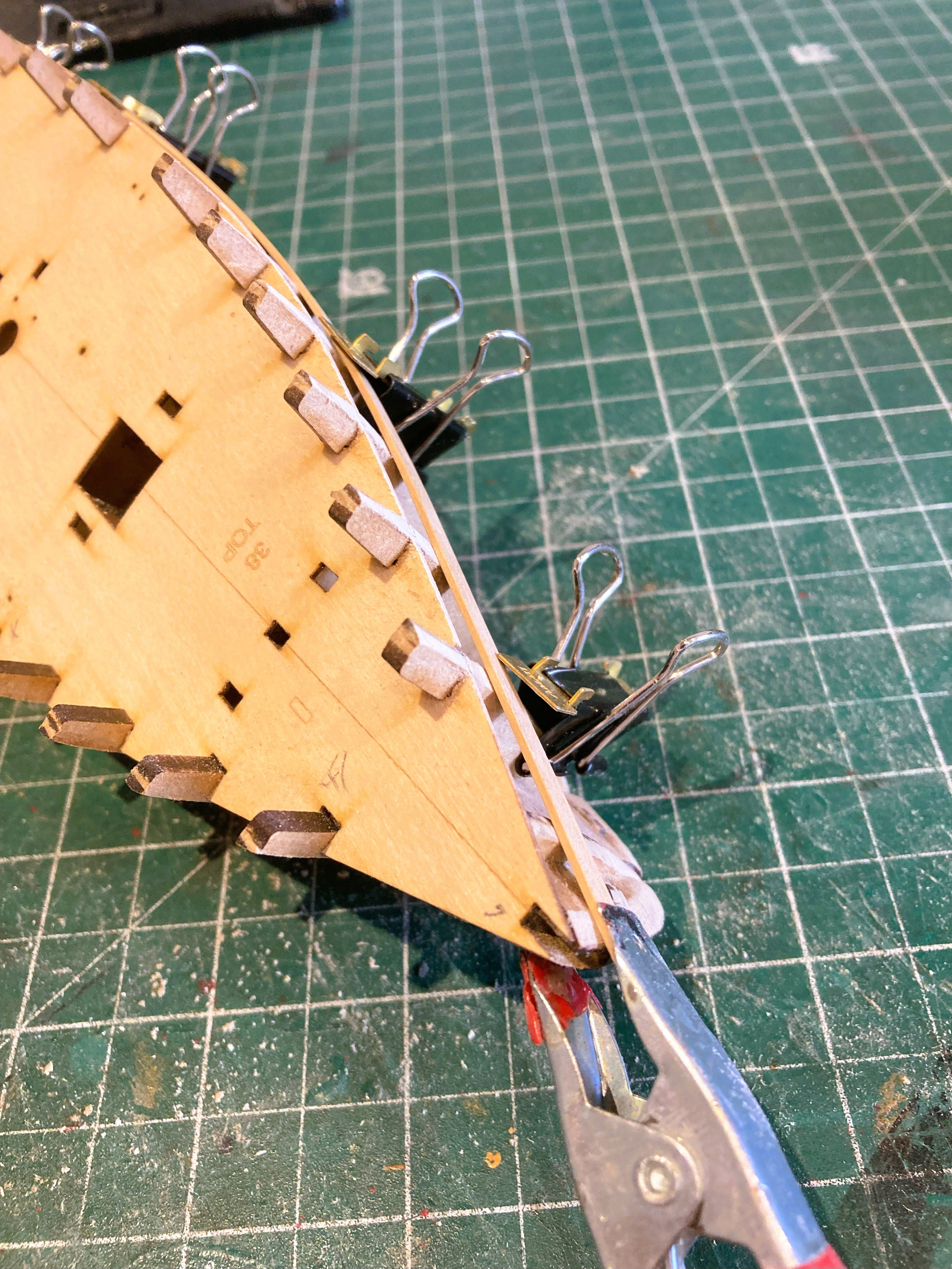

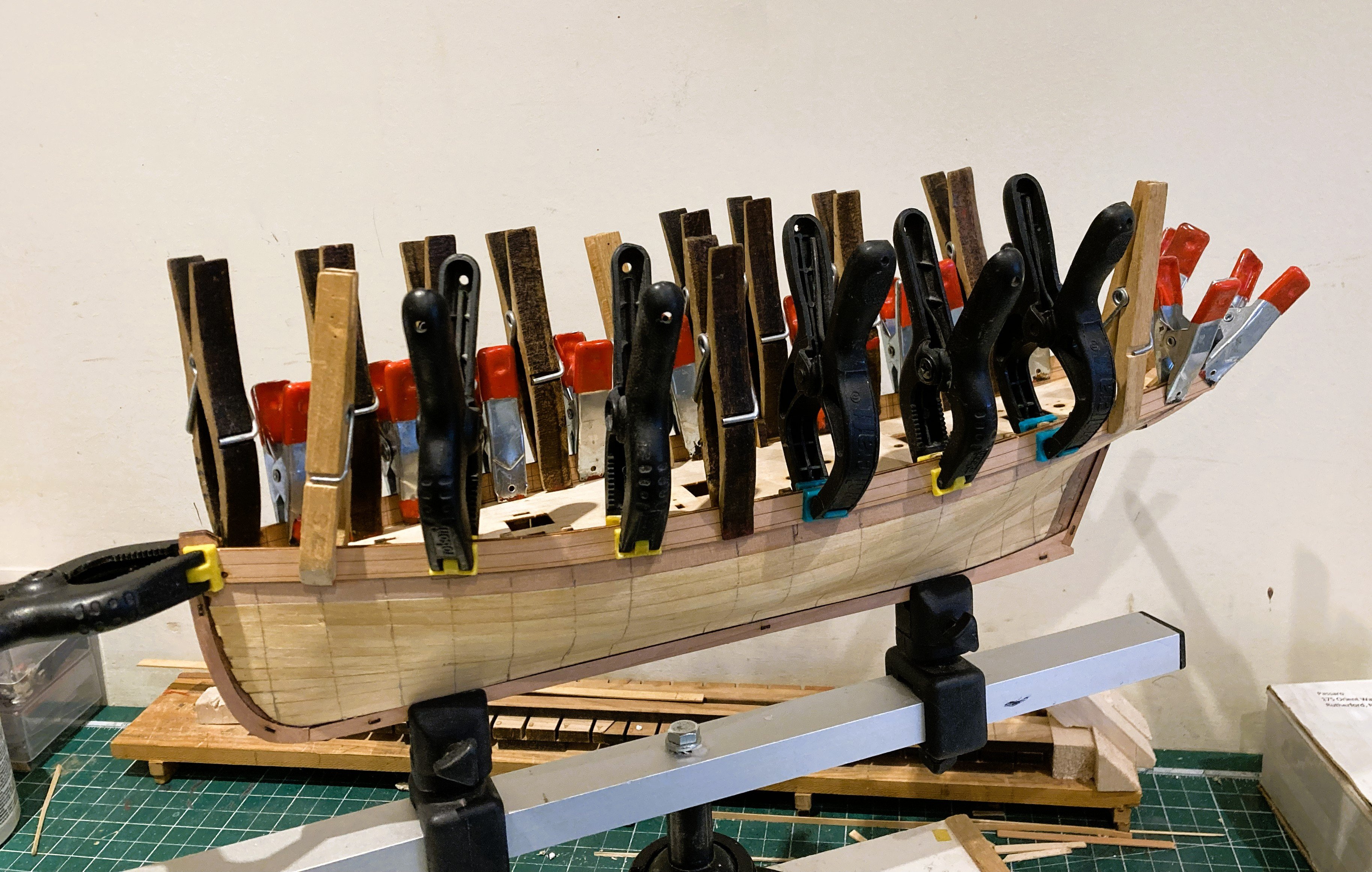

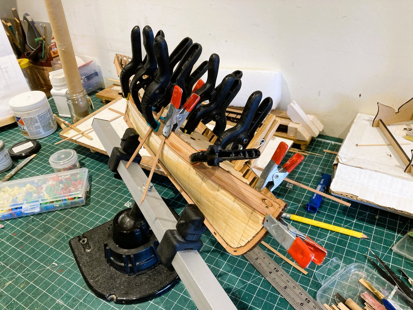

As is usual with Vanguard kits the bulwarks come in two sections (Fore and aft) of 1mm Pearwood strip.
They are marked on the interior with the frame positions and a useful fitting line which sits level with the deck line.
5623a
I dry fit them and use heat to reduce the spring before gluing and pinning.
5650a
5652a
Glue is not applied to the bulkhead extensions which are later removed.

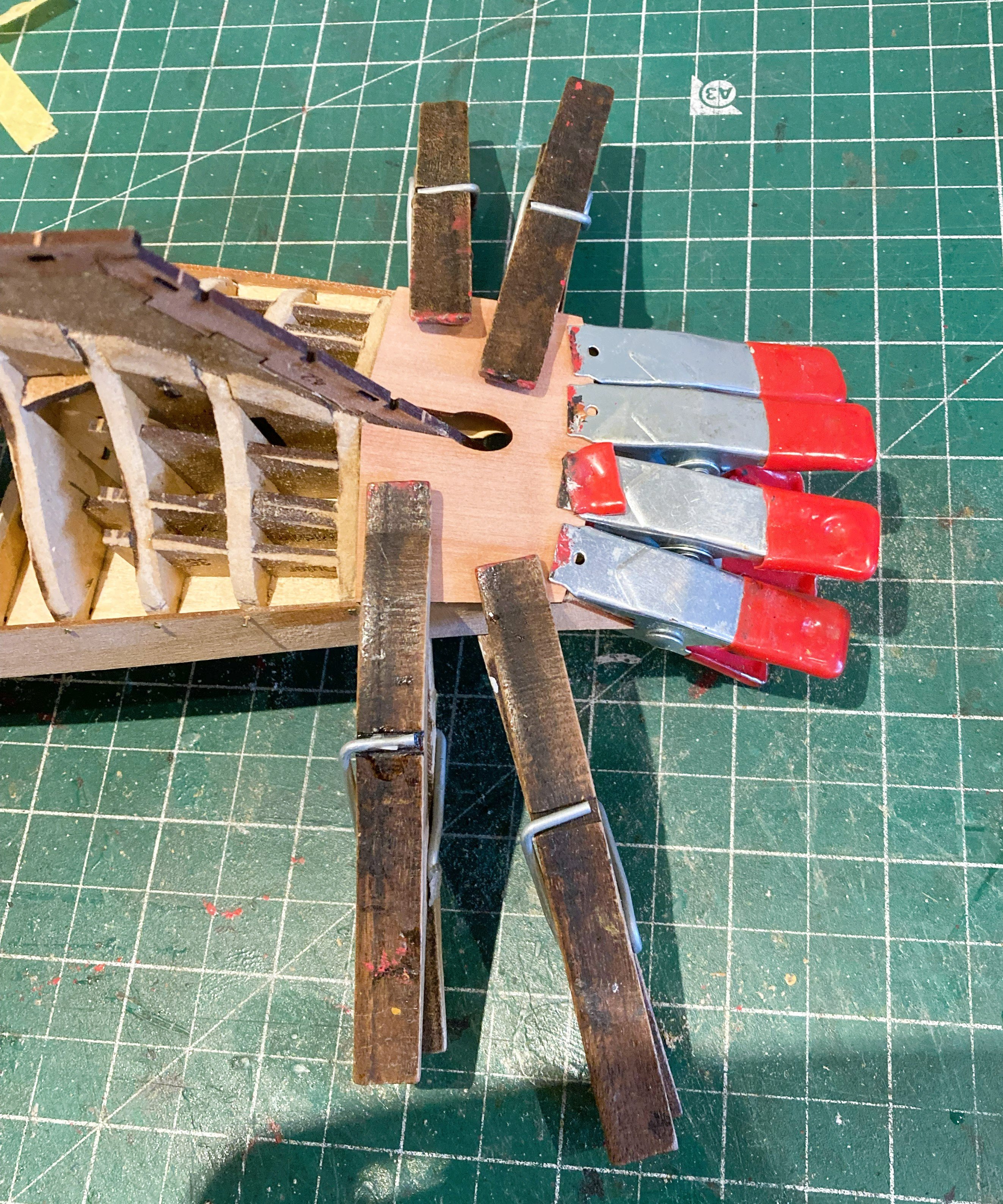

The stern counter frames require fairing to allow the counter pattern to fit cleanly across all frames.
5634a
The counter pattern is wetted before clamping to the frames for better conformation and allowed to dry out. This can be speeded up by applying heat.
5642a
5645a
With the bulwarks and counter in place the stern timbers are   better secured against accidental damage.

Just catching up on your Erycina BE. Love the mods to the fish hold and cabin.
The stove is excellent. Is it made from styrene sheet?
David

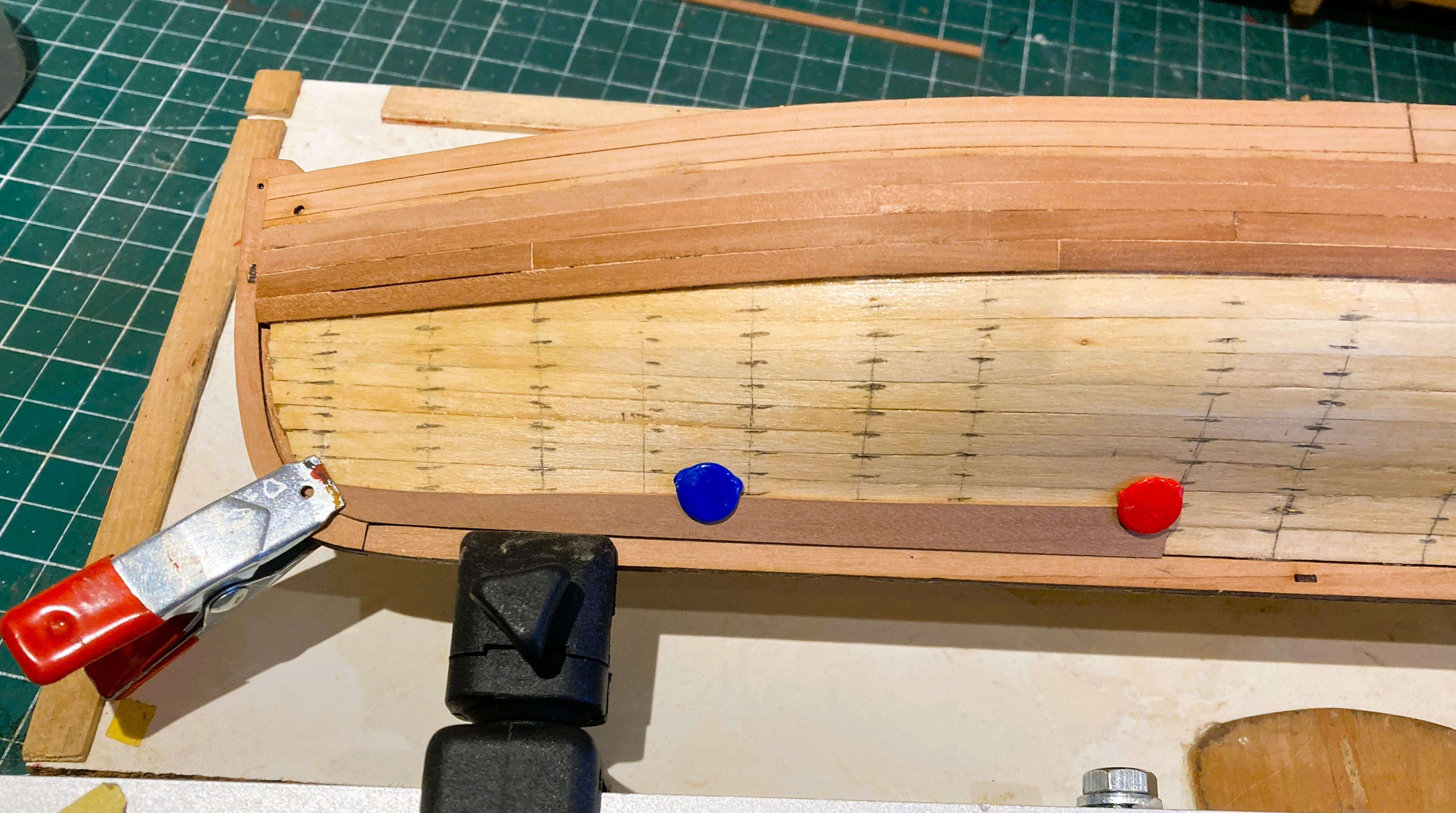

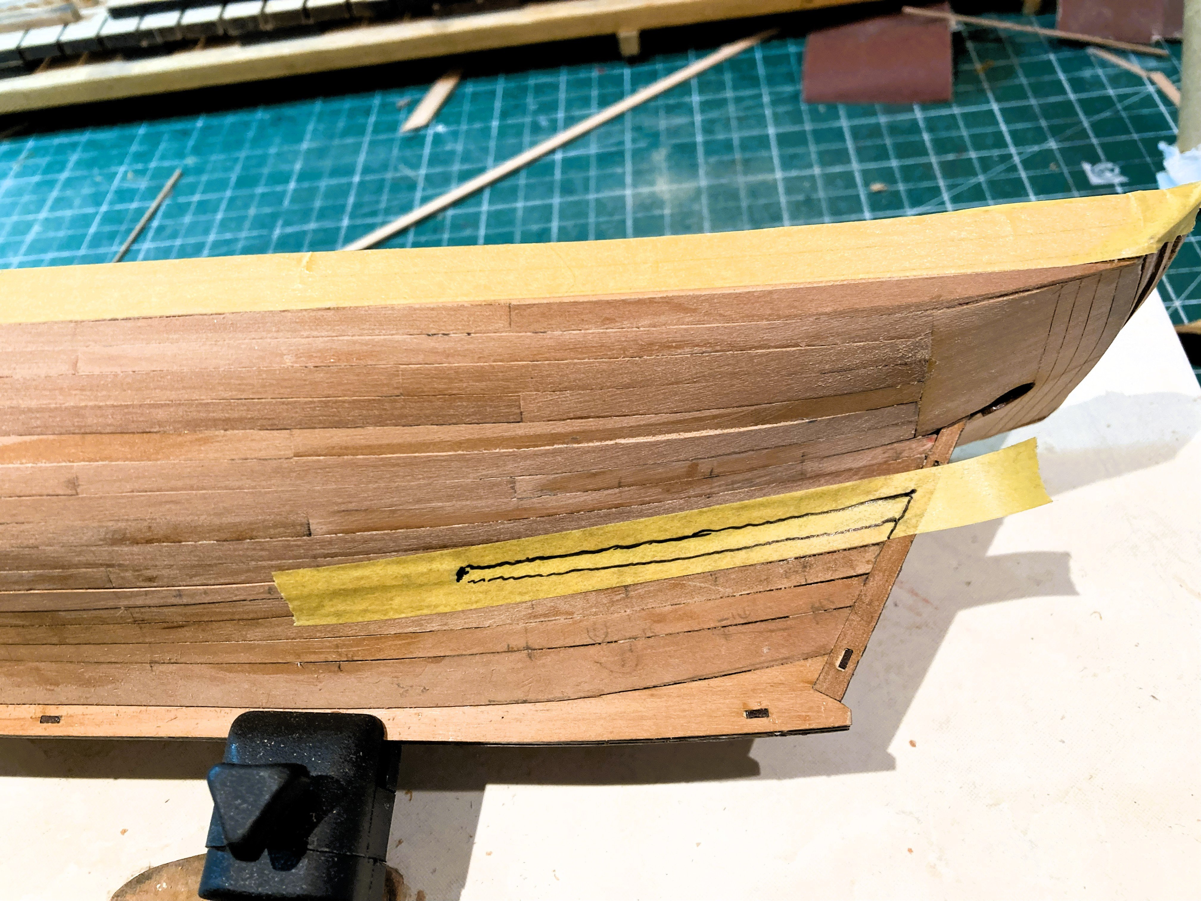

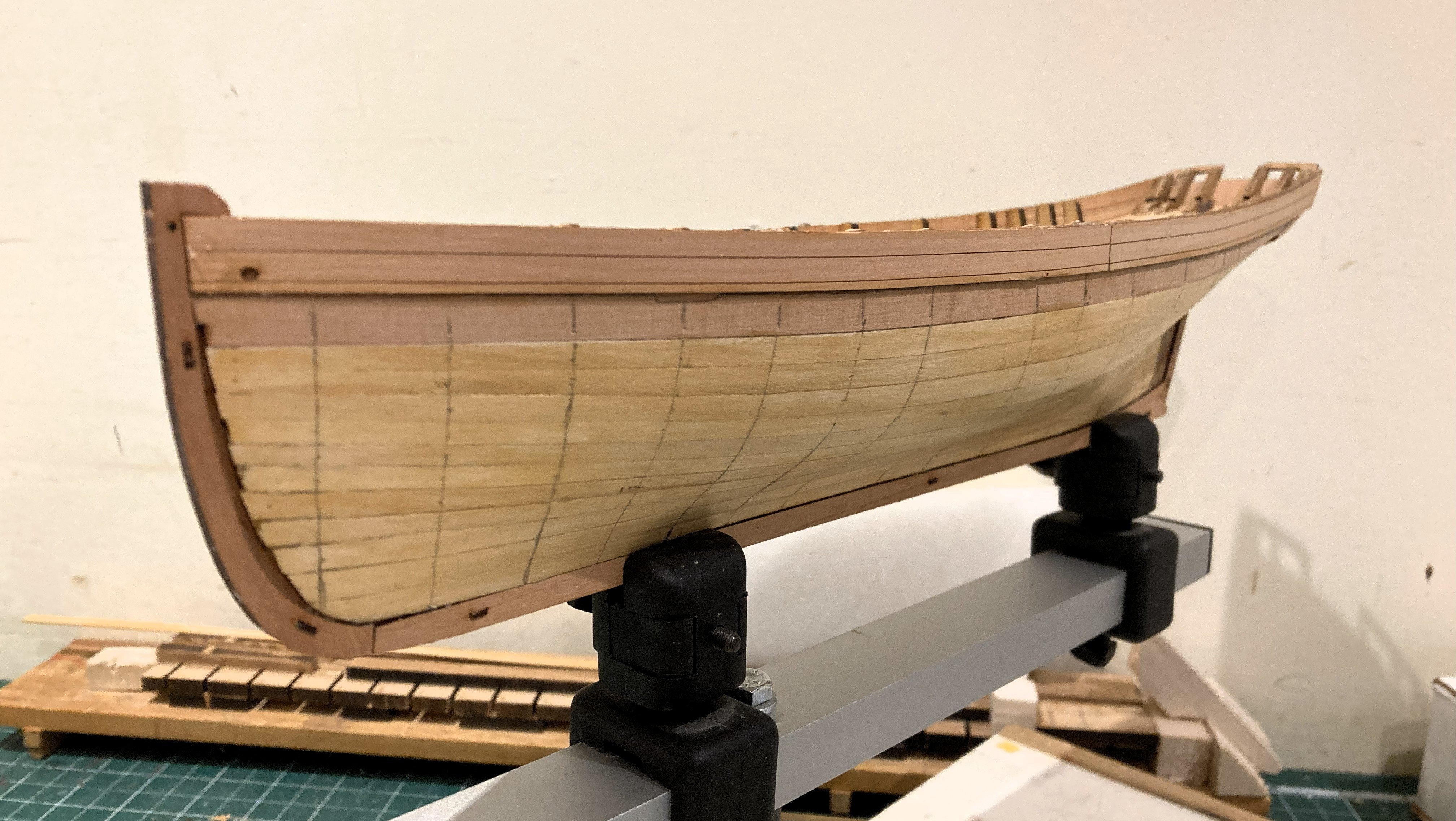

Post 7

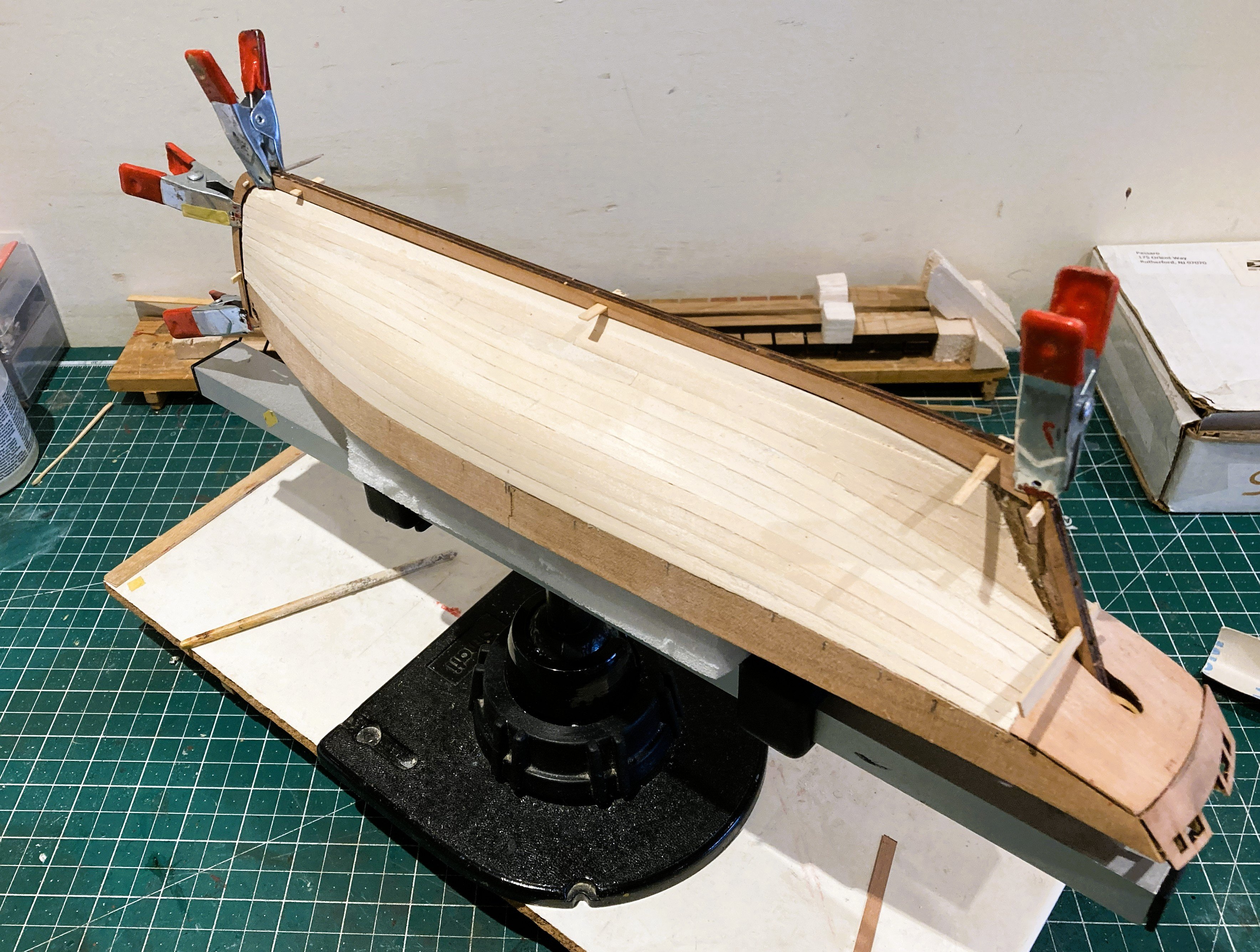

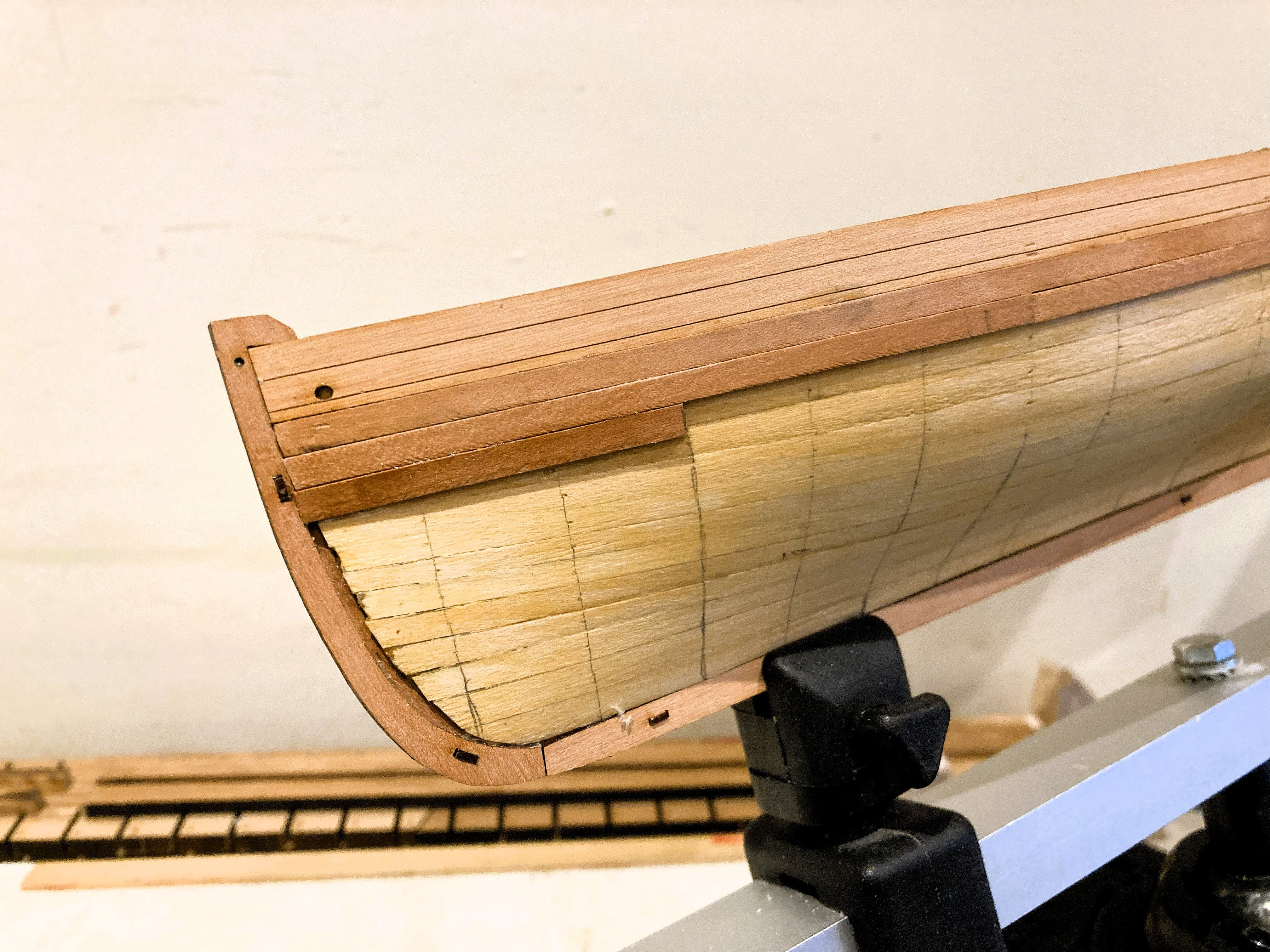

First Planking.

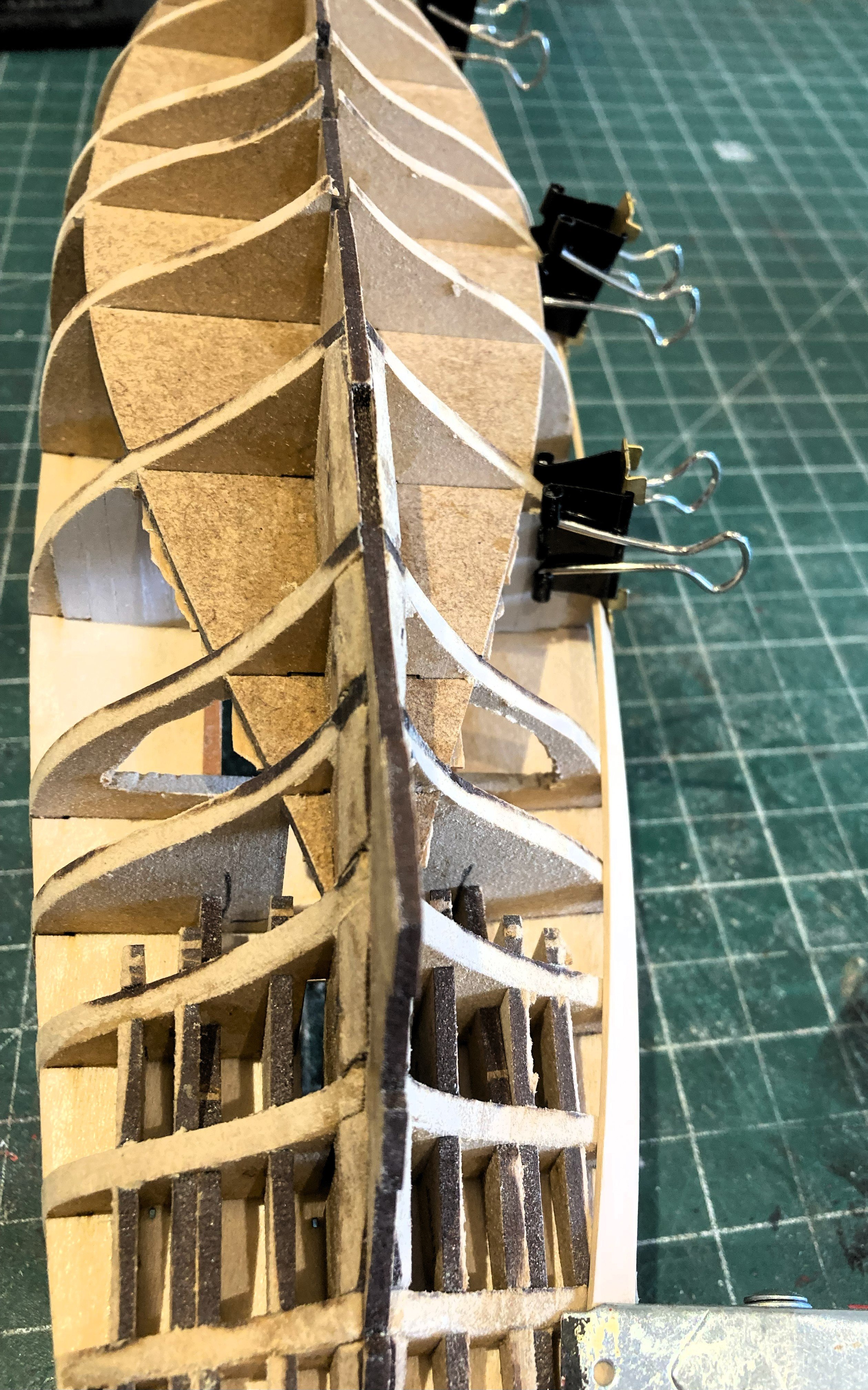

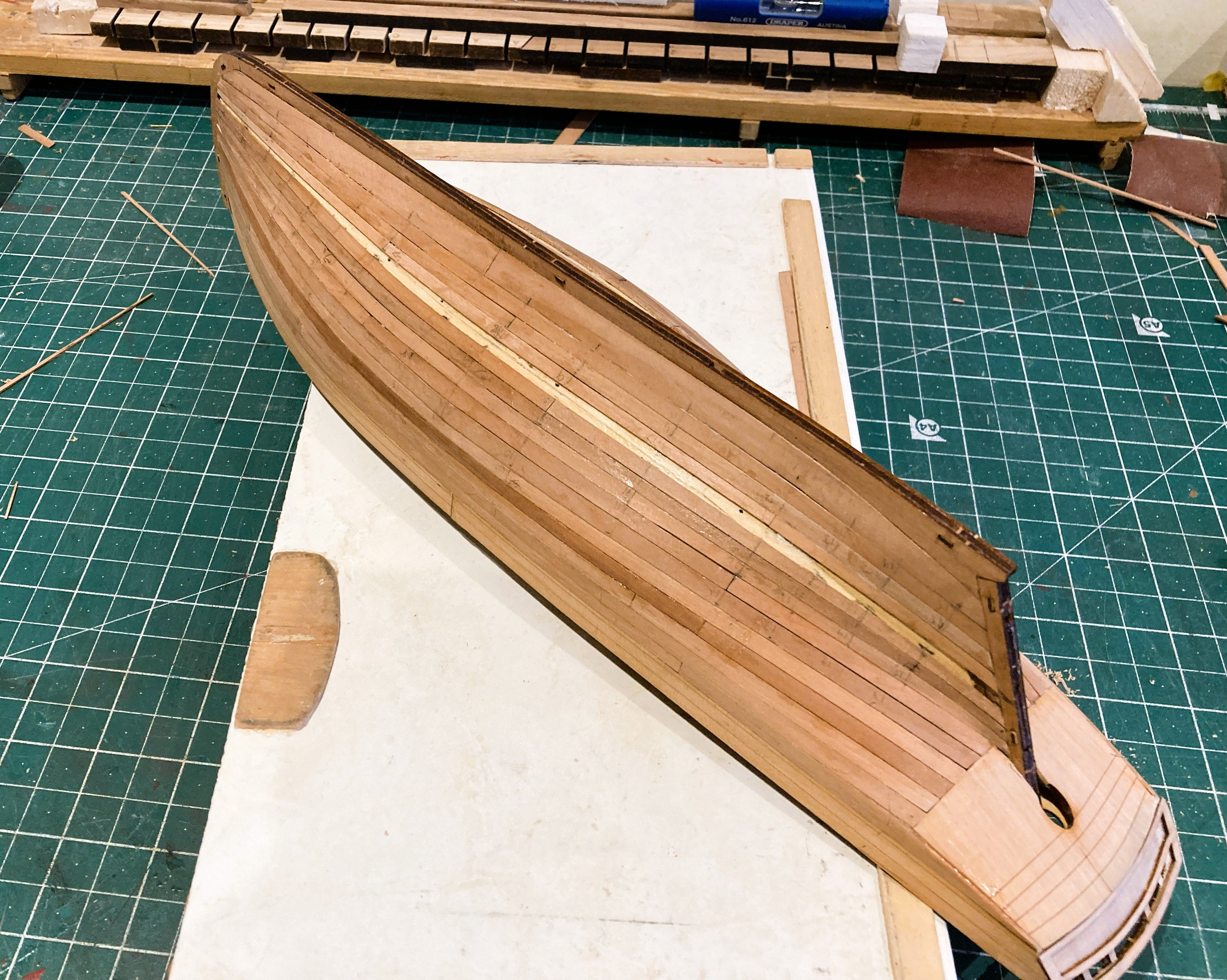

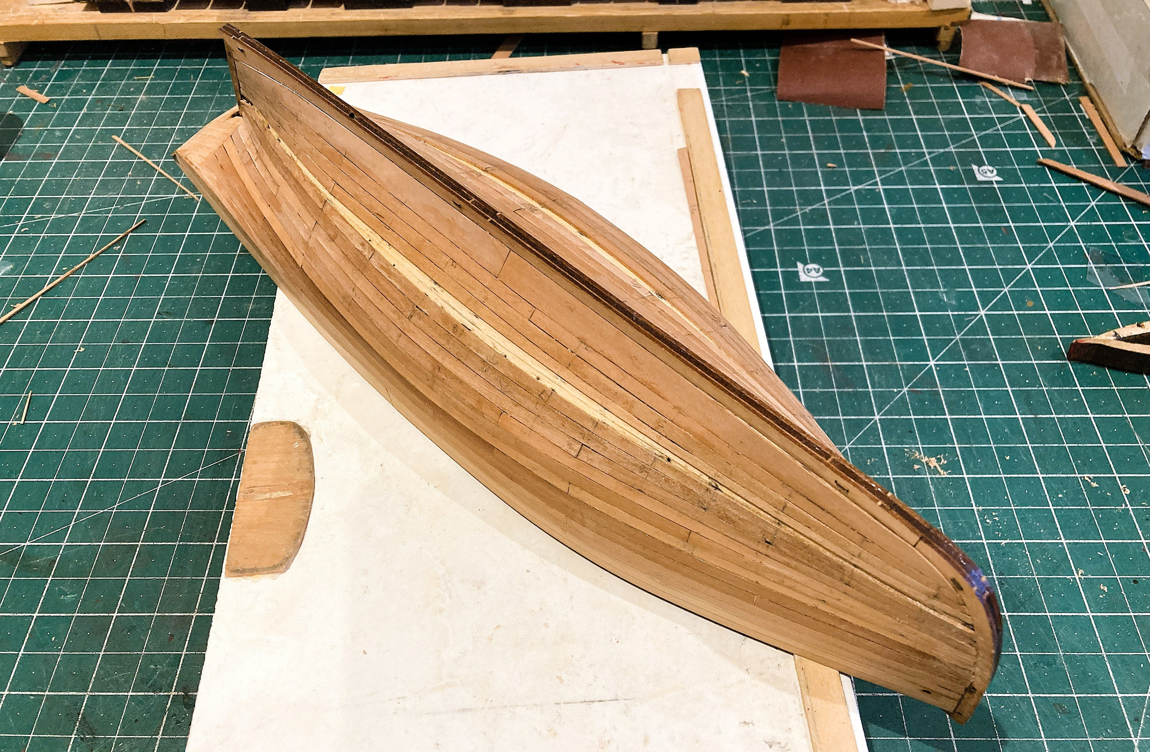

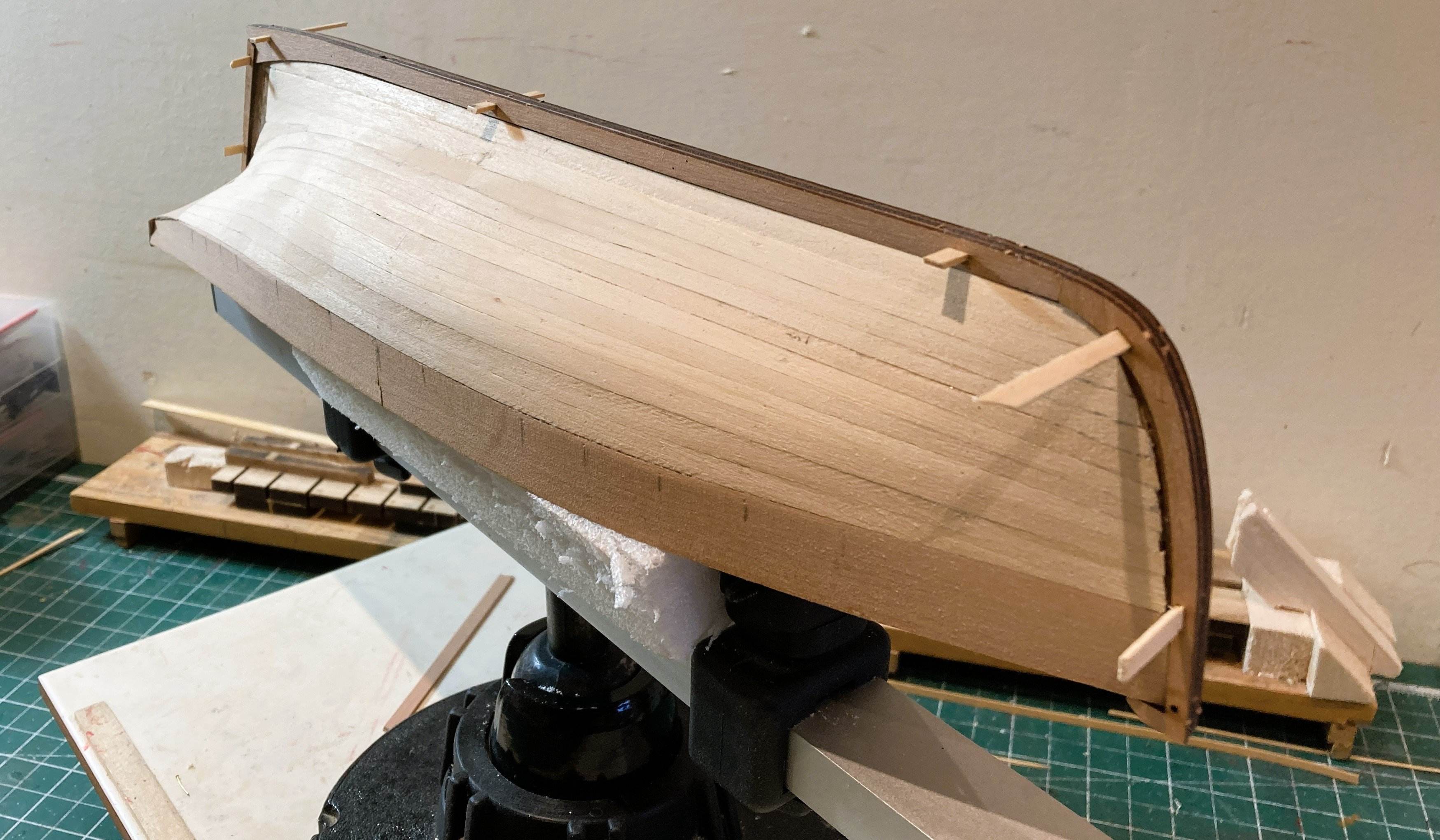

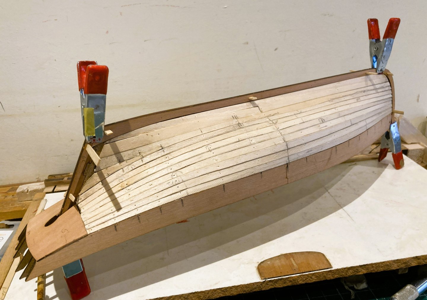

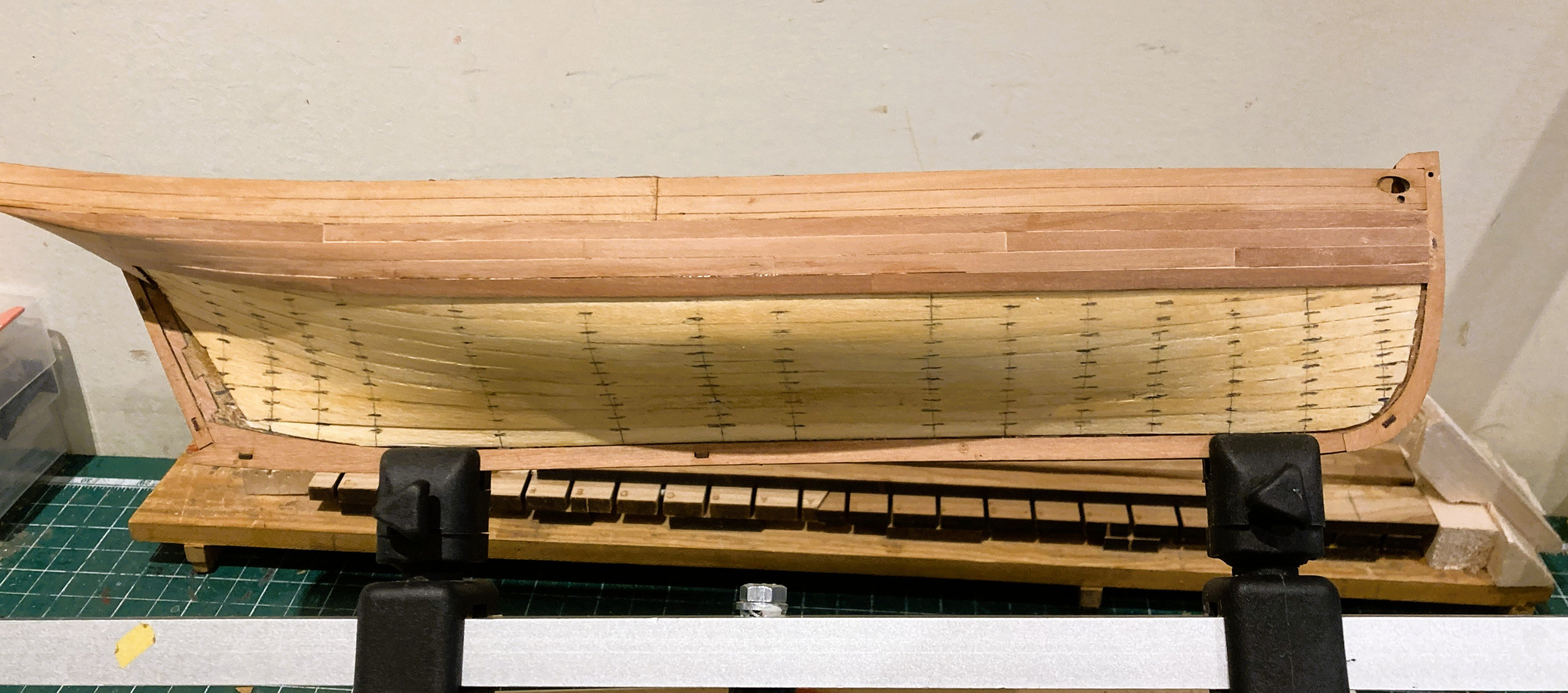

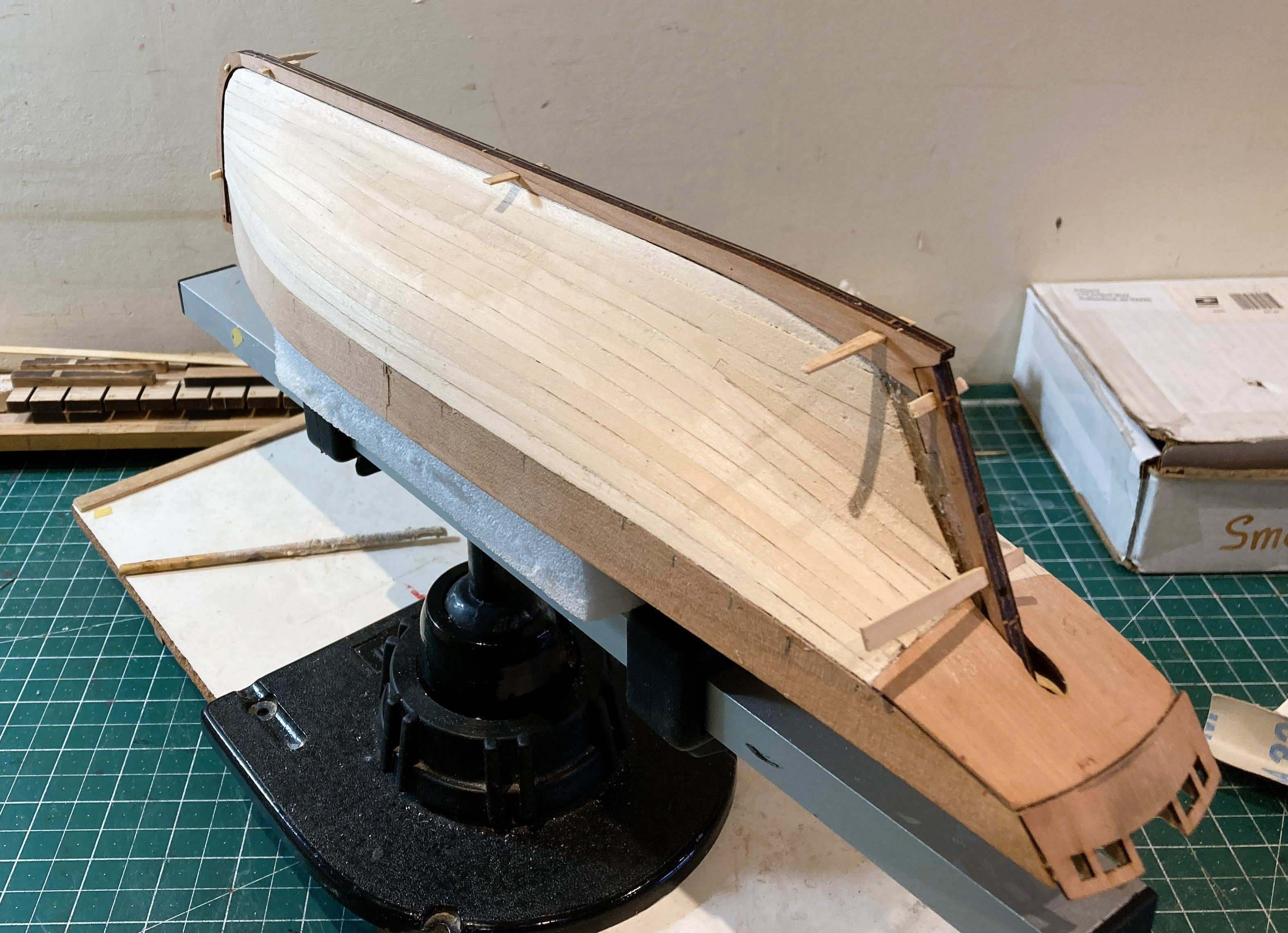

I begin the first layer planking using the kit provided 5mm limewood.
Somewhat inconsistent in conformity but sufficient for the purpose. I wasn’t overly concerned about thickness and depth issues in the timber on this first layer, and I used non kit broader limewood strips for the lower strakes running to the stern post, which naturally require wider strips.
6124a

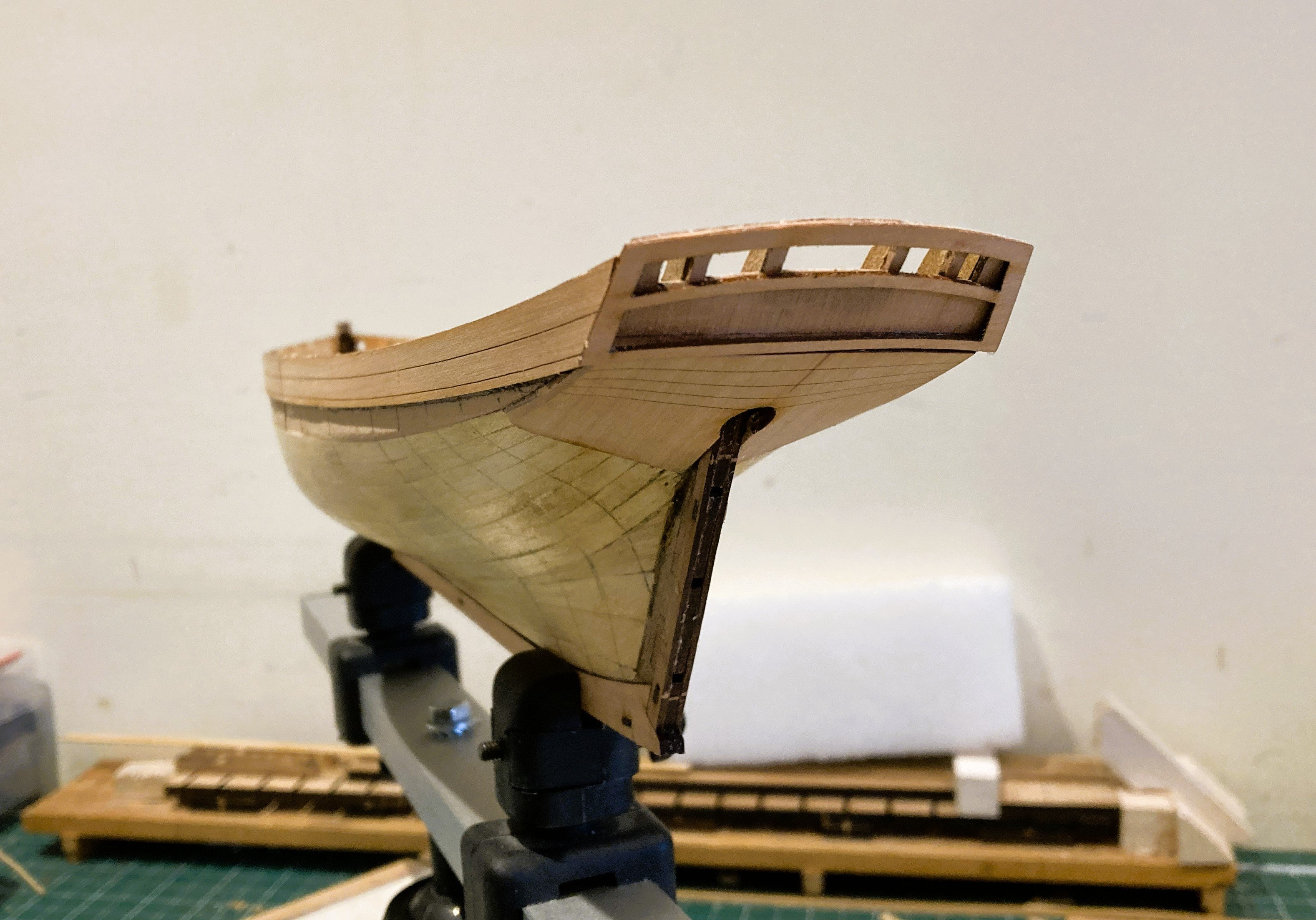

I have applied taper from the outset, and the stern section also requires bevel and twist to meet the counter and sit tight against the Bulwark patterns, particularly towards the stern.
6125a
With the first layer planking I use a simplified tick strip approach together with edge bending and bevelling which gives a useful insight to the planking runs on the all-important pearwood outer planking.
I found planking Erycina particularly at the stern more involved than I recall from either my Fifie or Zulu builds.
6157a
6160a
Towards the stern the strips are edge bent, pinned in place, and further heat applied from a Hairdryer on max setting.
This is done before final gluing.
6171a

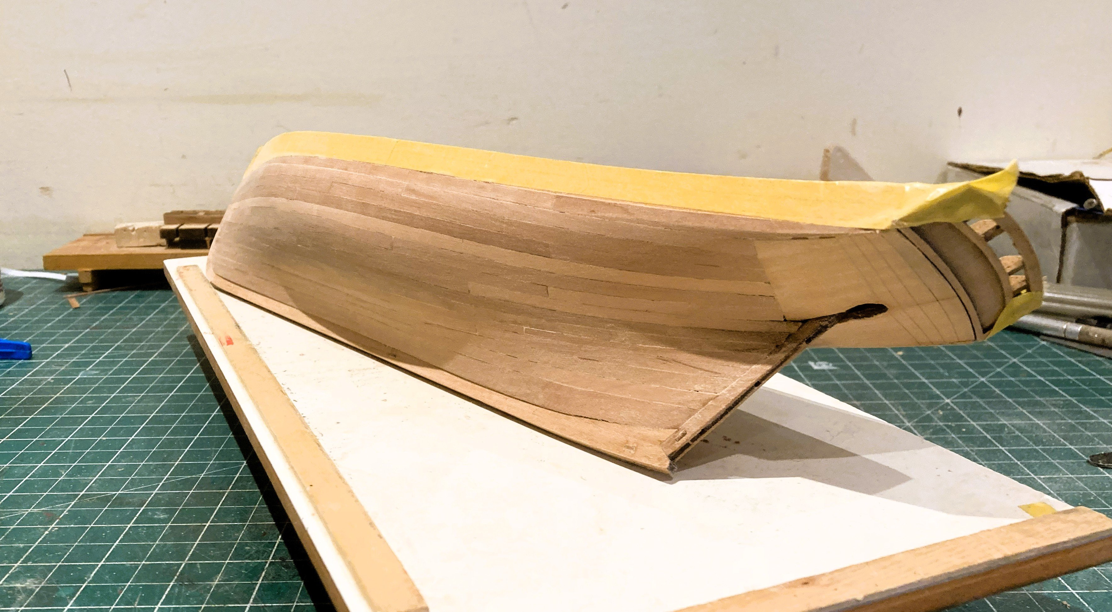

The final strake is spiled; I use Tamiya tape to mark the shape. I used two sections to form this strake.
6166a
For the Garboard plank I simply used a full 5mm strip.
Above this I used broader strips (8mm/10mm) in two sections with greater flare at the stern, all these sections are spiled.
The photo also shows the single drop plank I used to accommodate the upward run of the stern planking.
6178a
6183a
Very much at an ‘ugly duckling’ stage, but she will turn into a graceful Swan. Trust me …..🫤

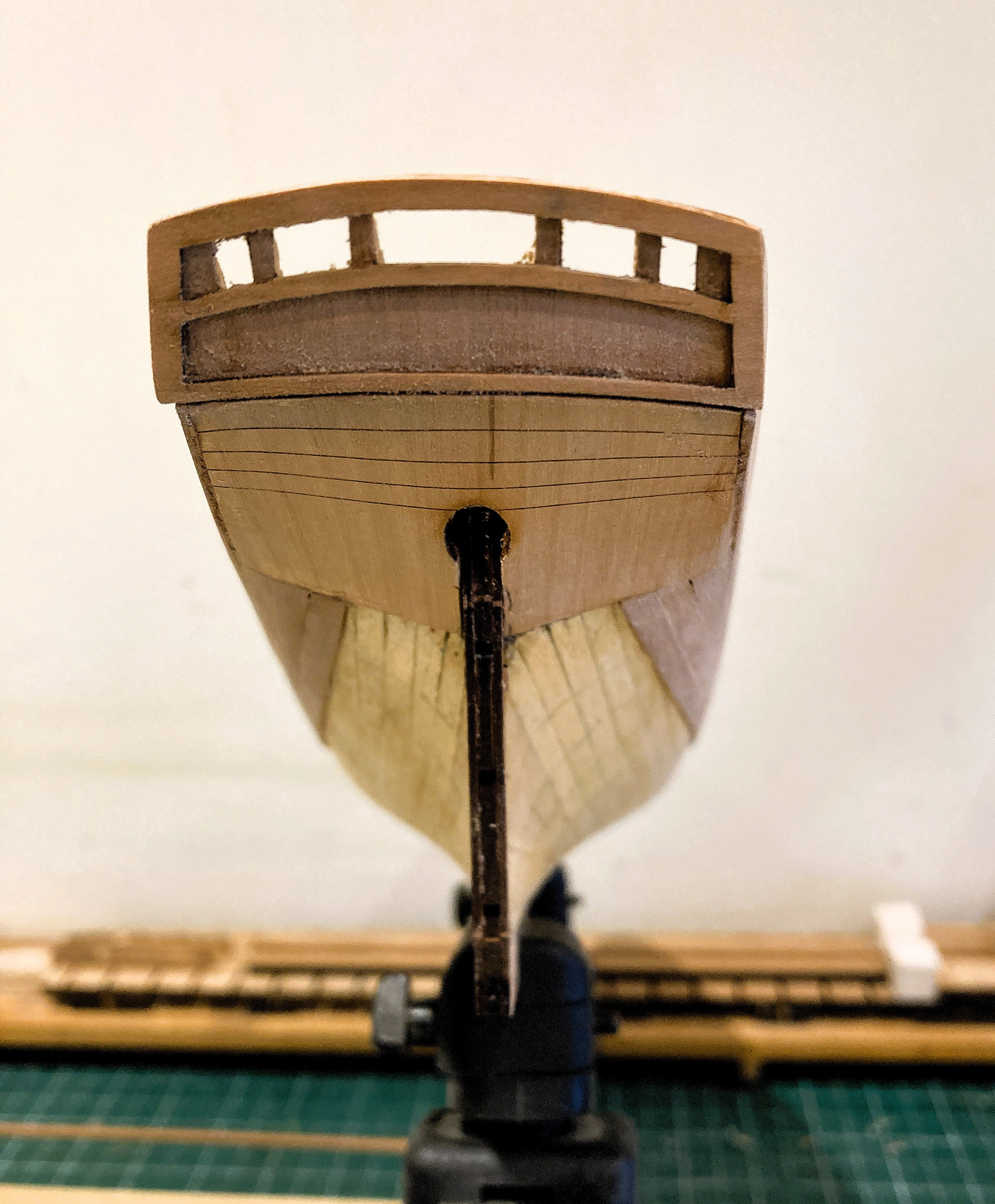

At this point the stern board is fitted, but before gluing into place it is a good time to clean up the inboard stern timbers.
6187a
These are heavy with char and it is easiest at this point to remove. The build manual photos show the char left insitu but whatever finish or none is applied, it is better removed.
The stern board is a delicate piece and the centre section of the top rail did break in two places.
6191a
Hopefully not too much of an issue as the outer stern frame surround will provide a guide to re-fit the broken parts later in the build.

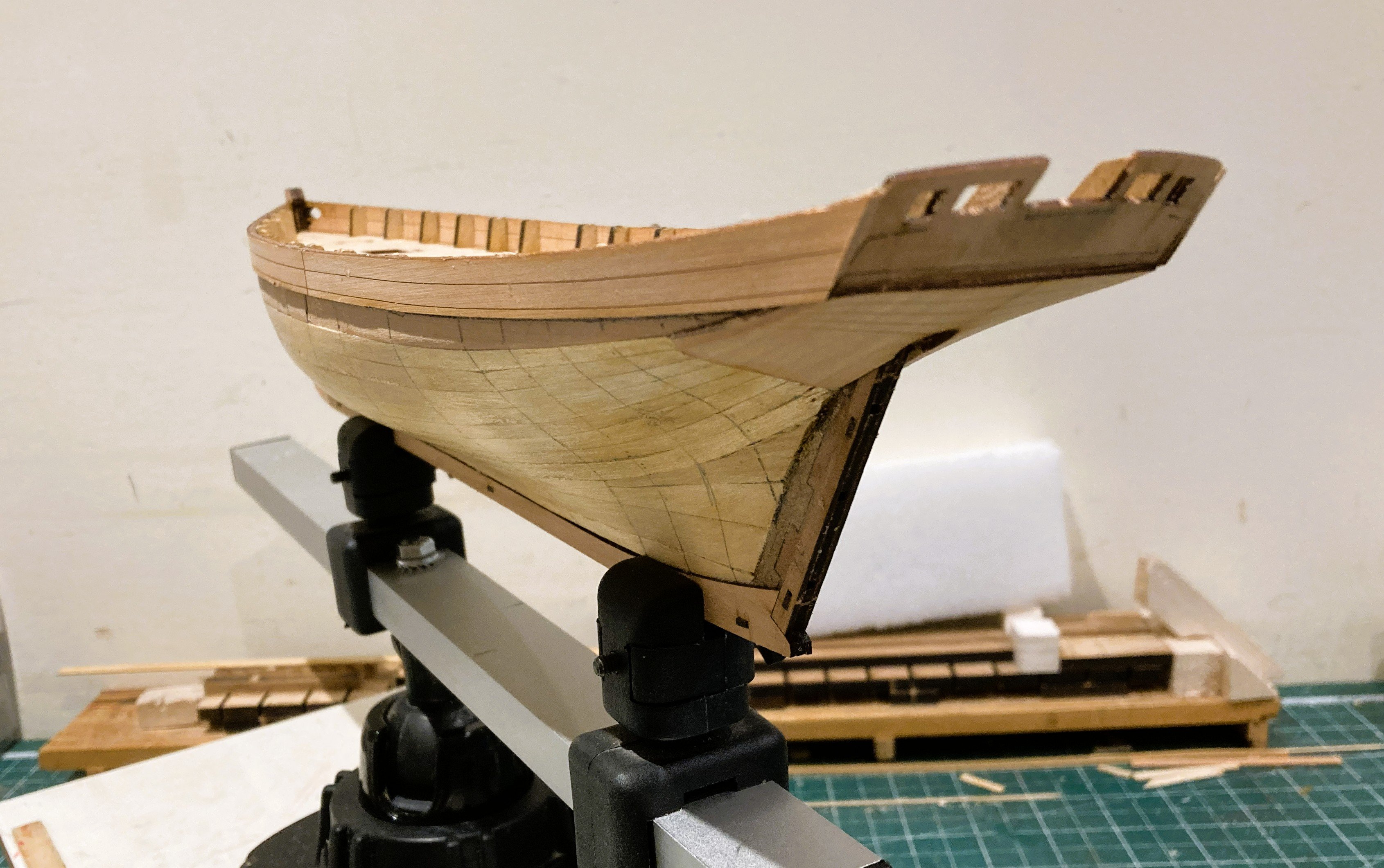

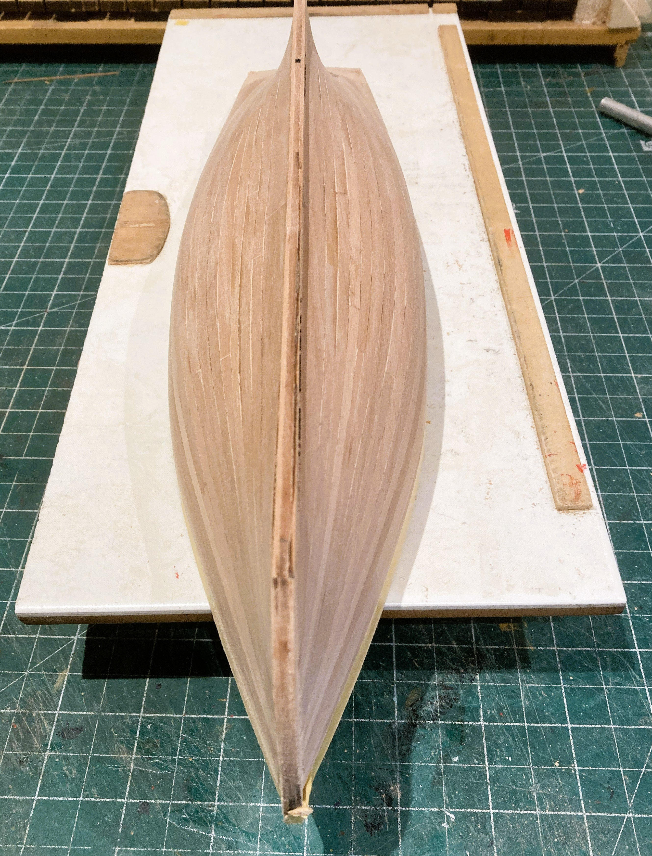

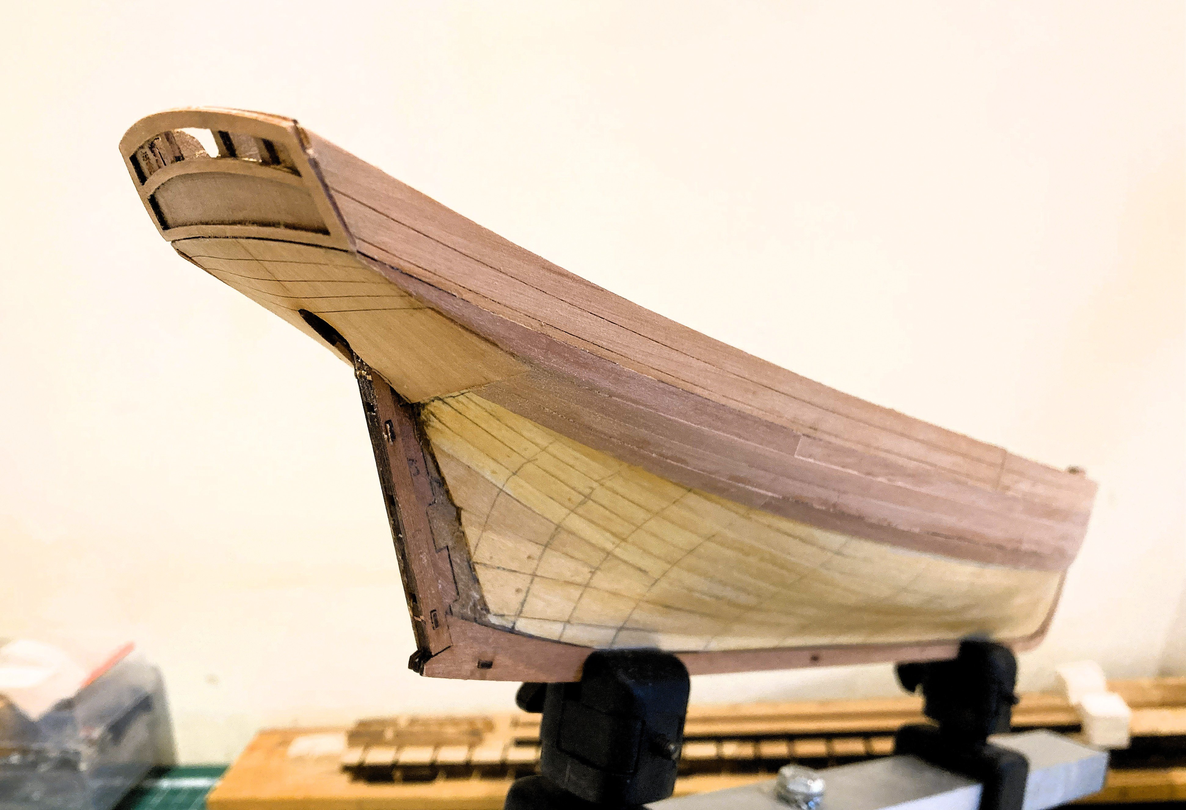

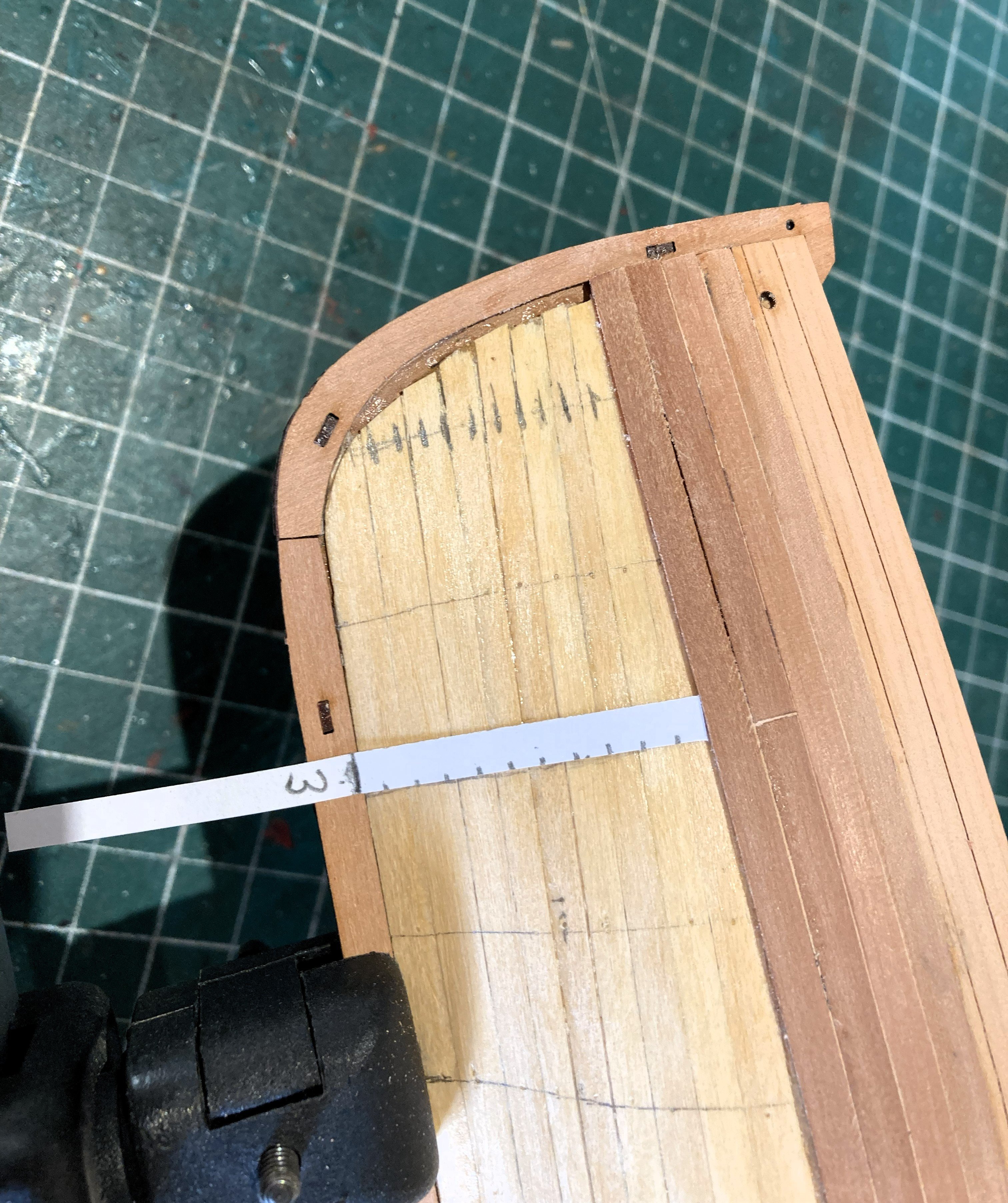

Post 8
Fettlin’ the Limewood.

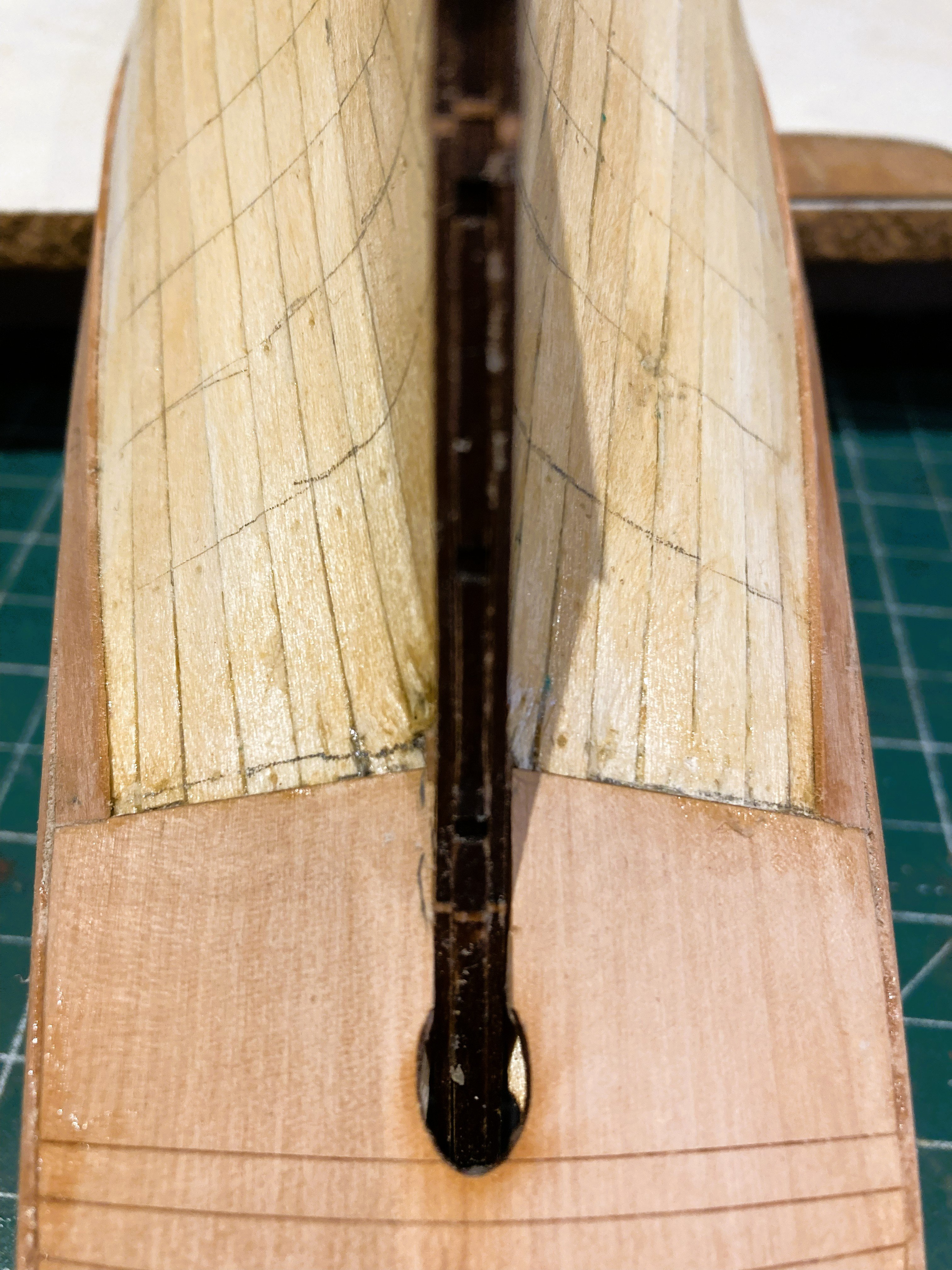

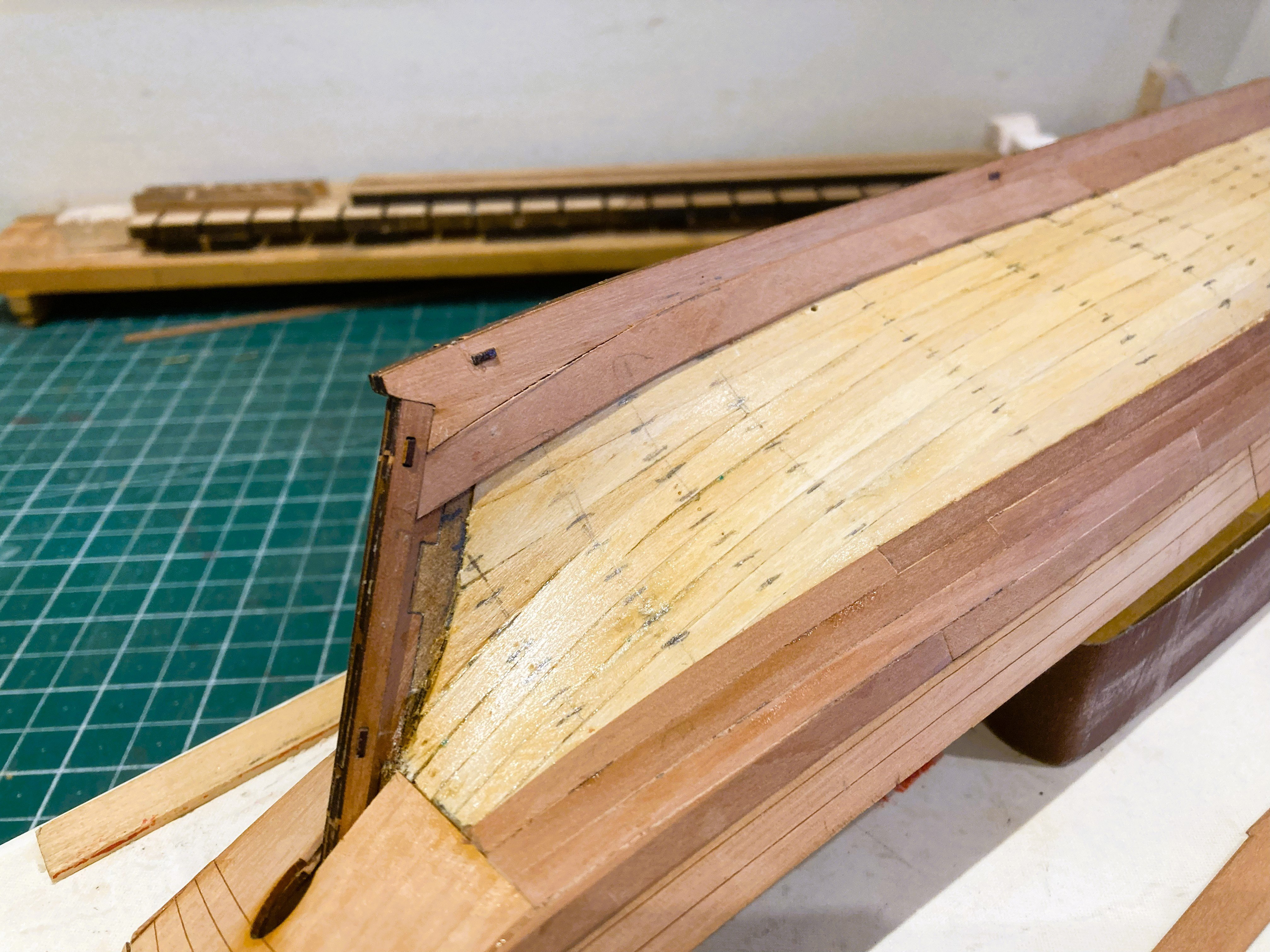

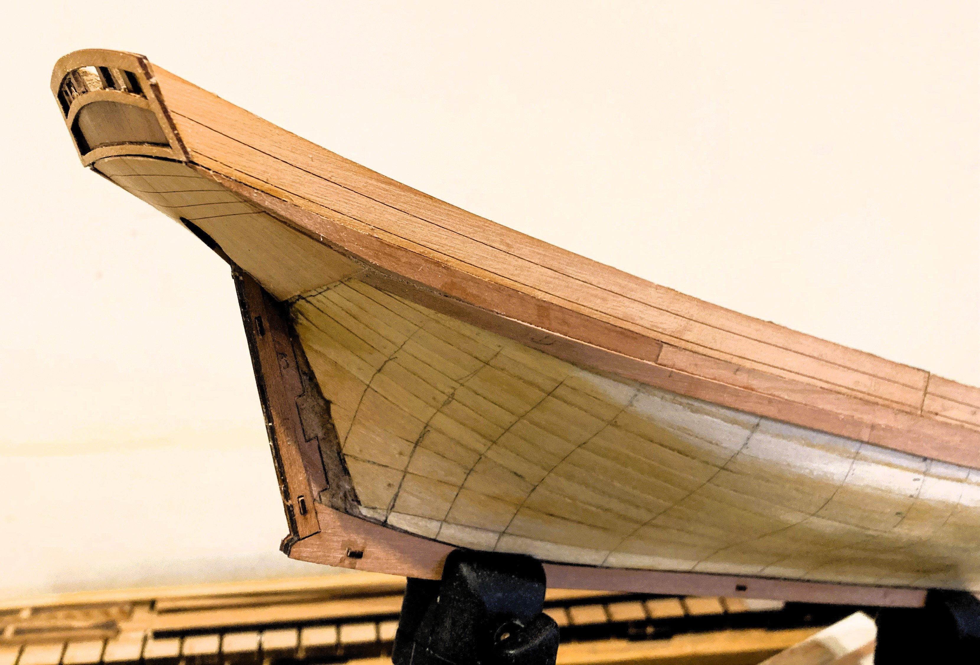

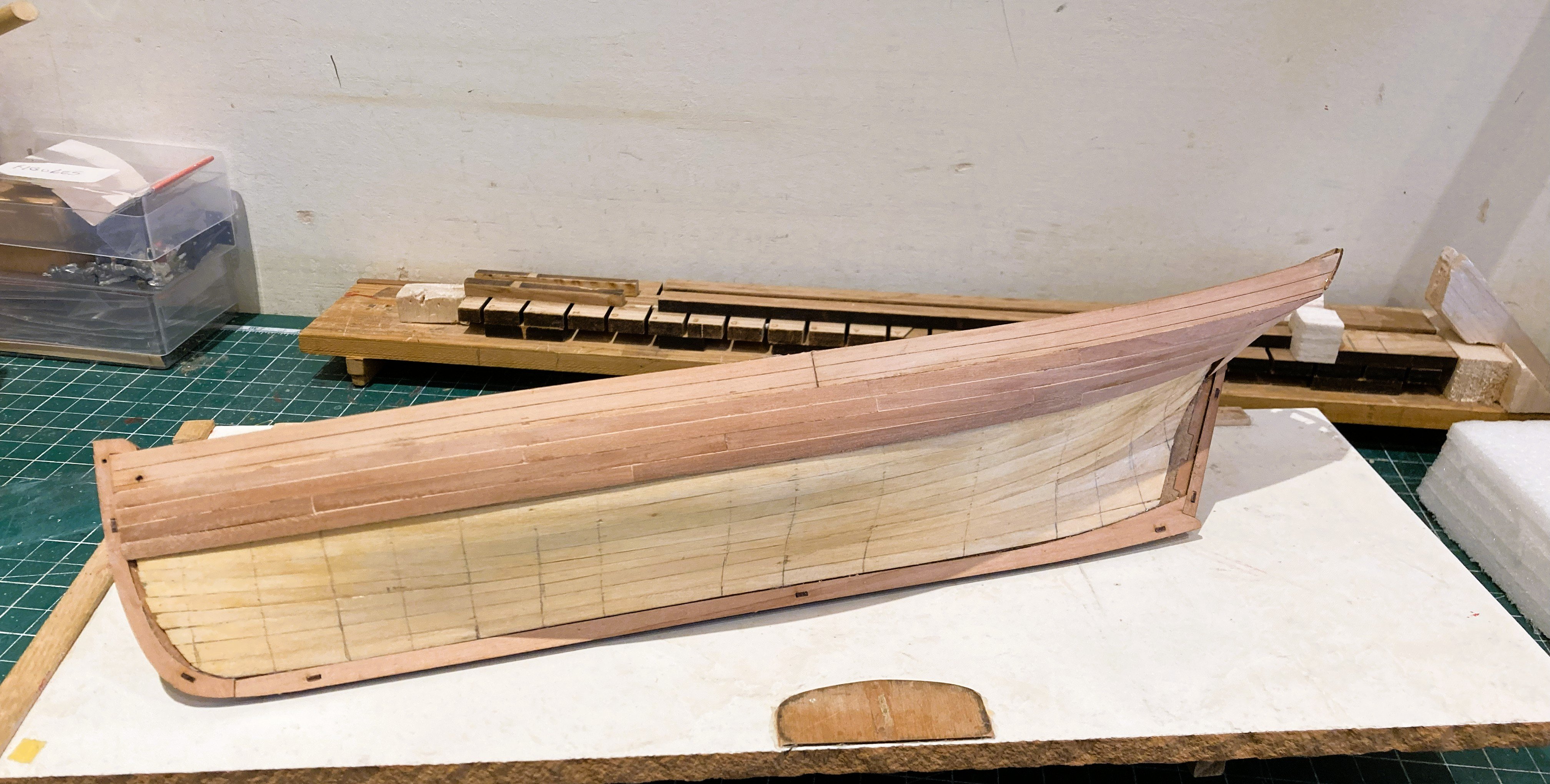

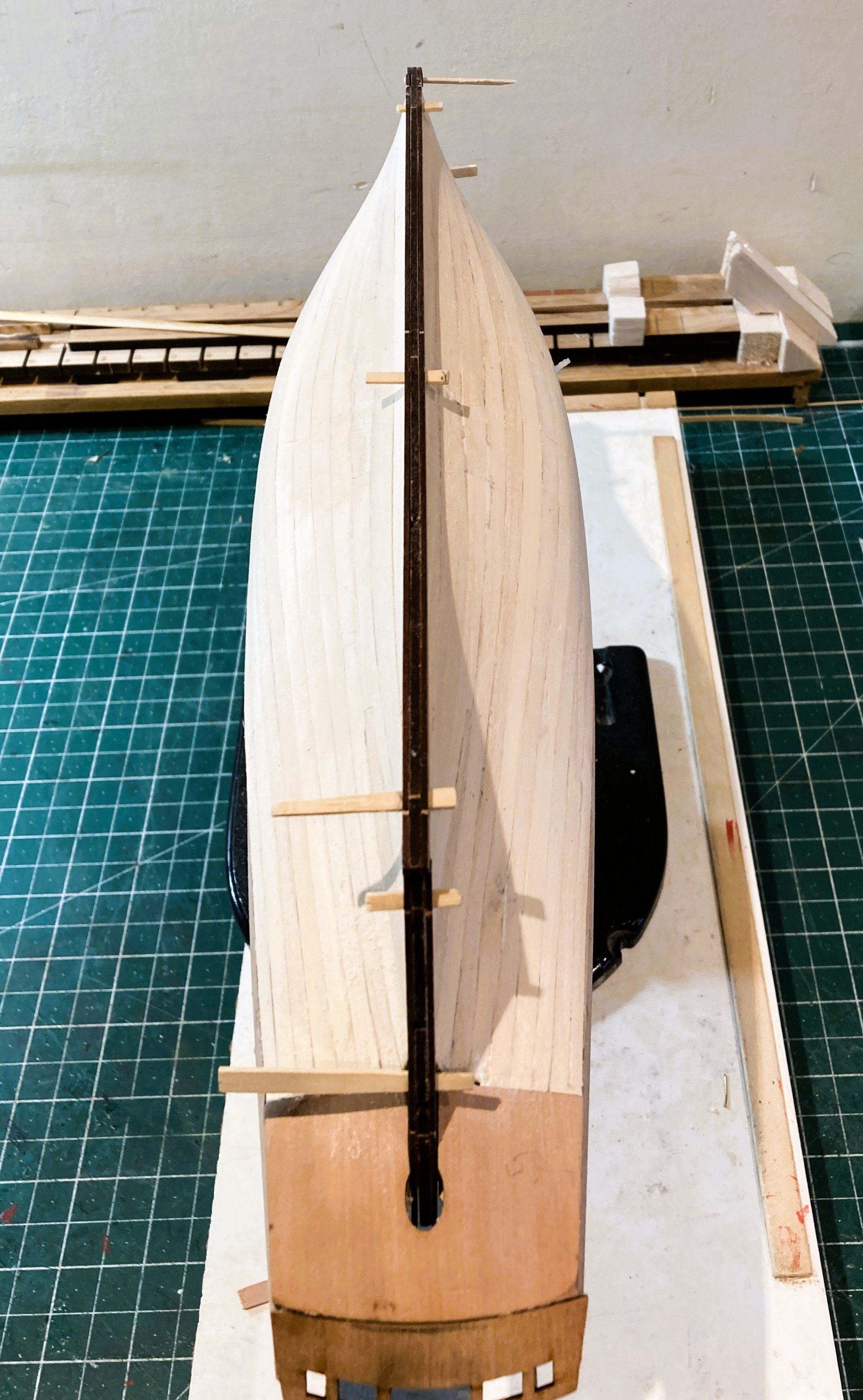

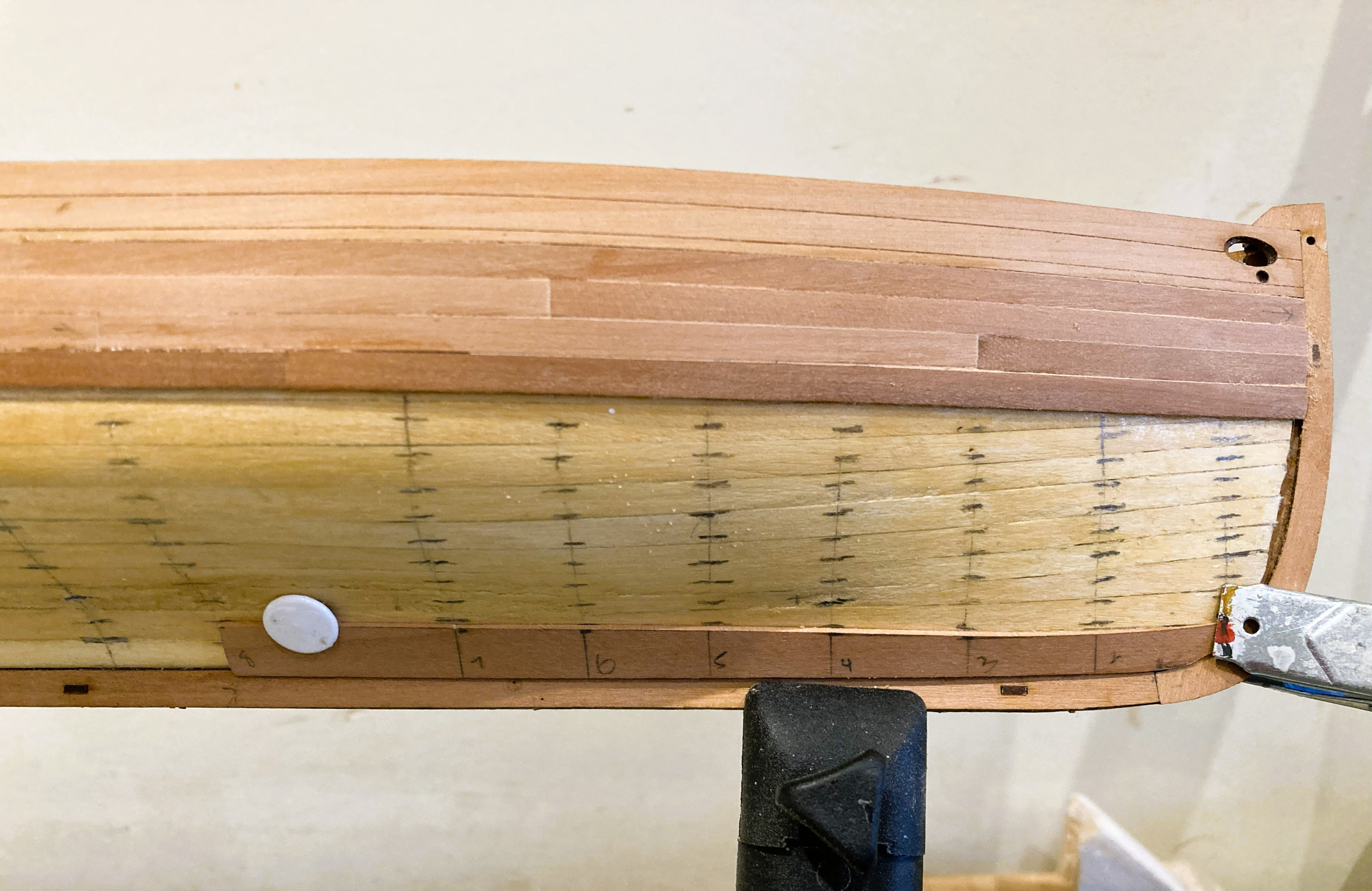

The planking at the stern has been left short of the sternpost as it would in any case have to be thinned to a feather edge to accommodate the outer planking.
6185a
I test fit the Pearwood outer strip patterns used to cover the keel, stem, and stern posts, and form a rabbet into which the top layer planking will fit.
The keel pattern is used to trim the Garboard plank around the bearding line.
6196a
What a difference a sanding makes.
Sanding the first layer takes very little effort, P120 paper is used to get the rough off followed by 320 and finer papers.
6208a
Any small irregular areas are filled with lightweight filler until the hull passes the blind feel test.
6205a
6203a
Nearing completion I again use the patterns to check the fit of the outer Pearwood planking against the formed rabbets, paying special attention to the bow and stern areas.
The final stage will be to apply sanding sealer to the hull.

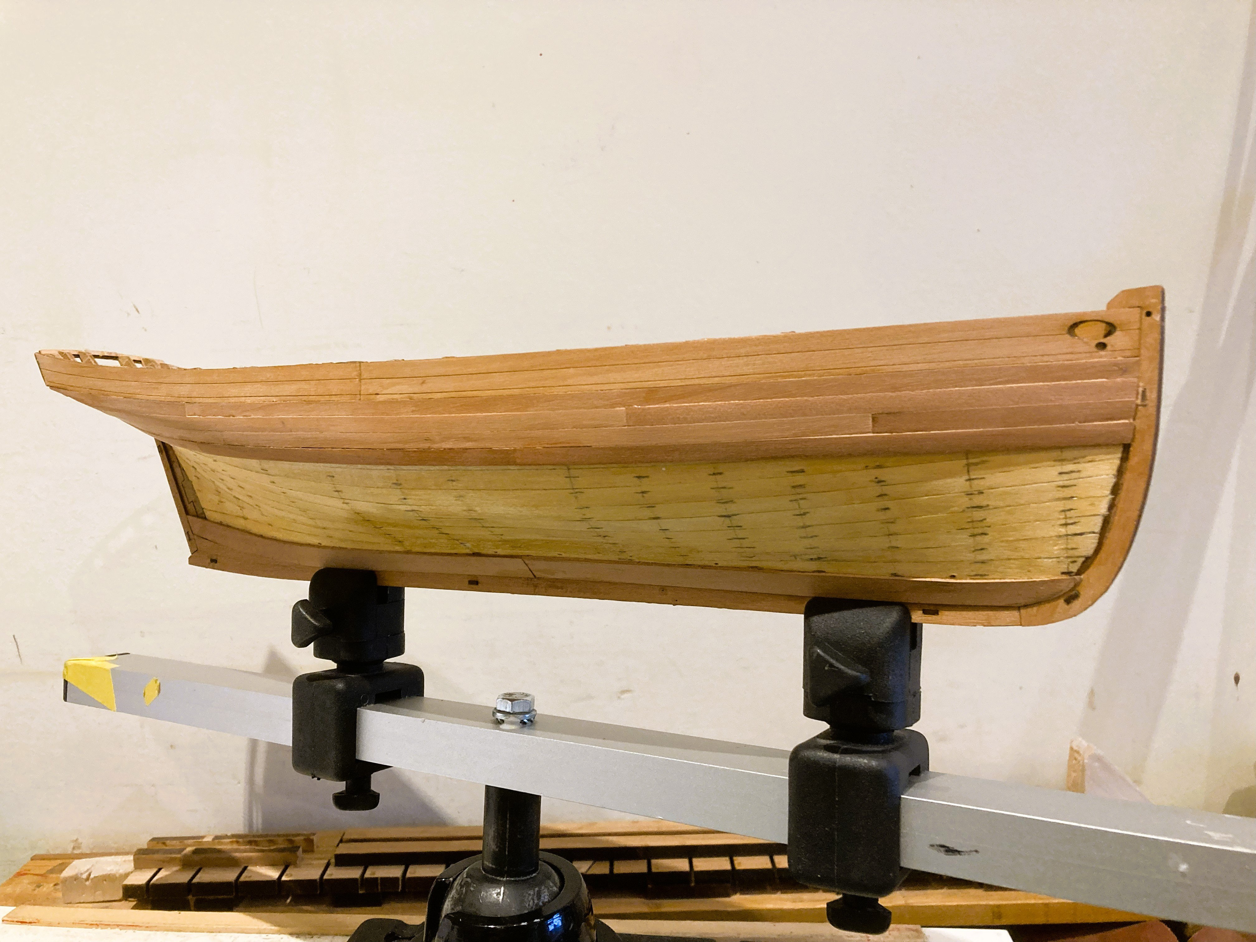

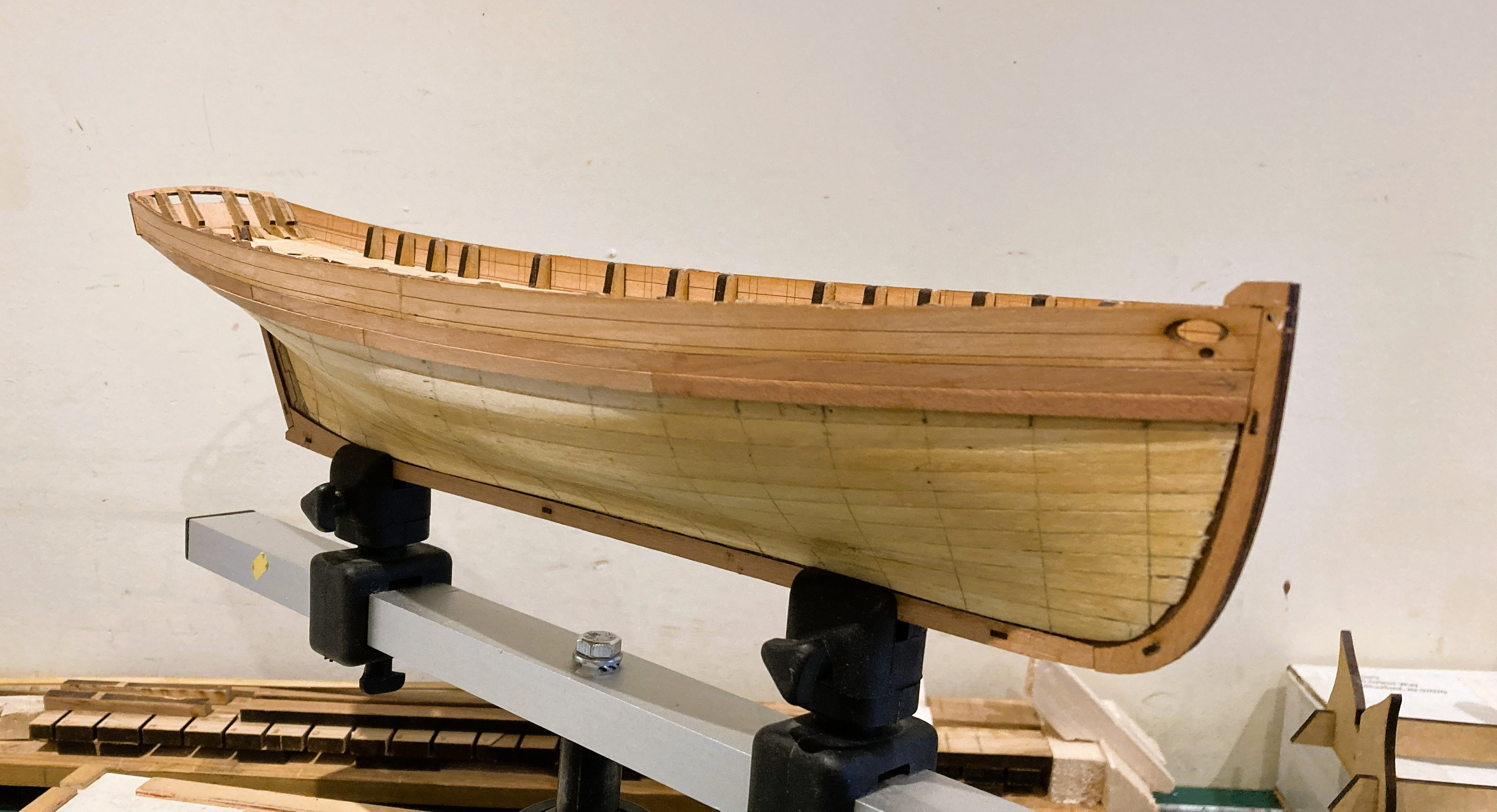

Post 9

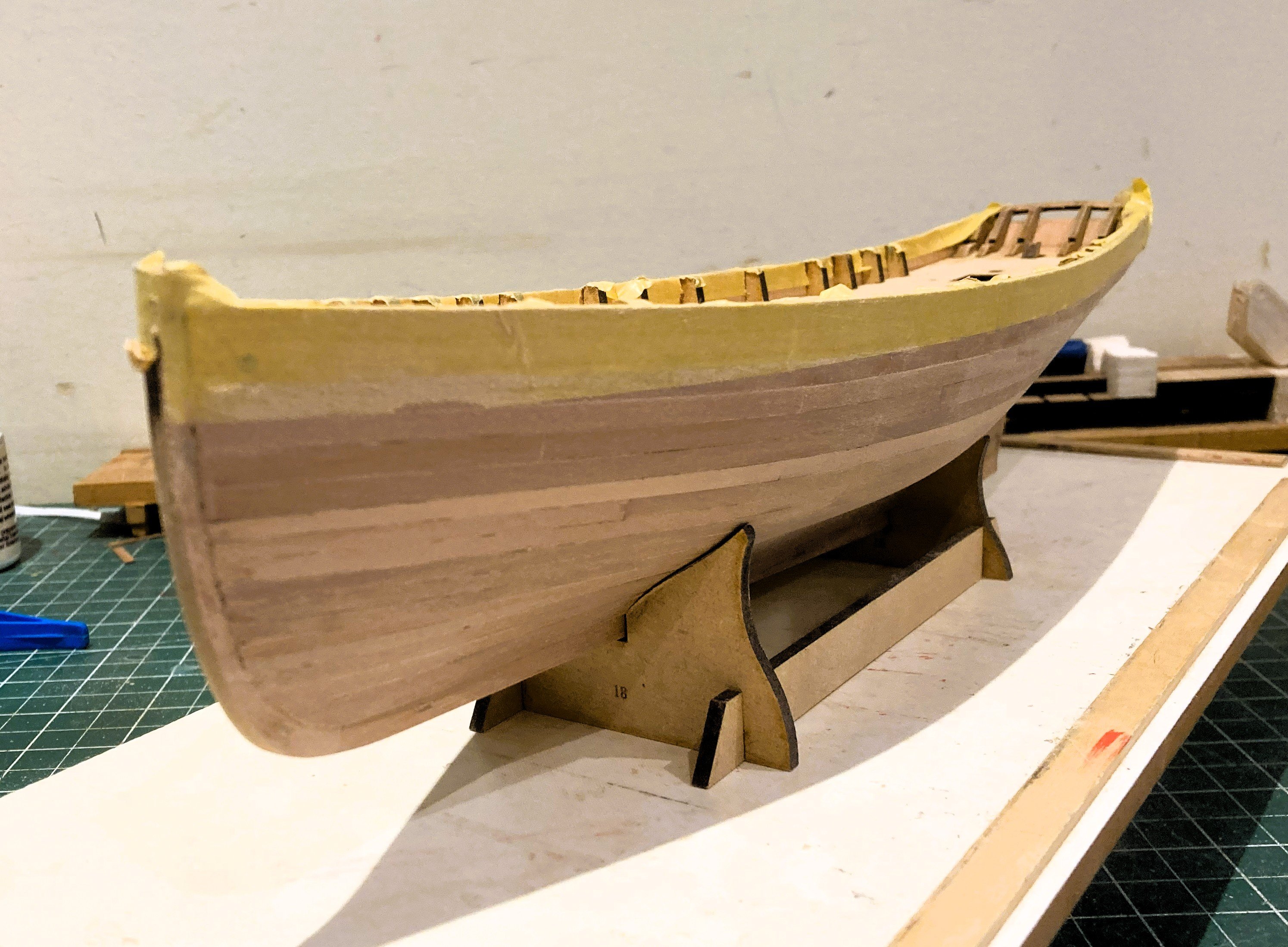

Prepping the hull for ‘show’ planking.

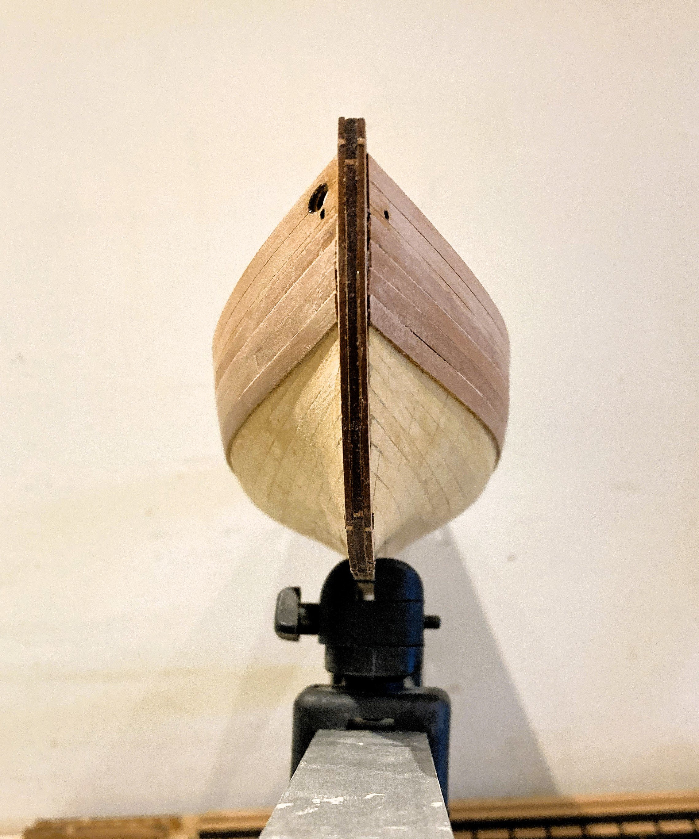

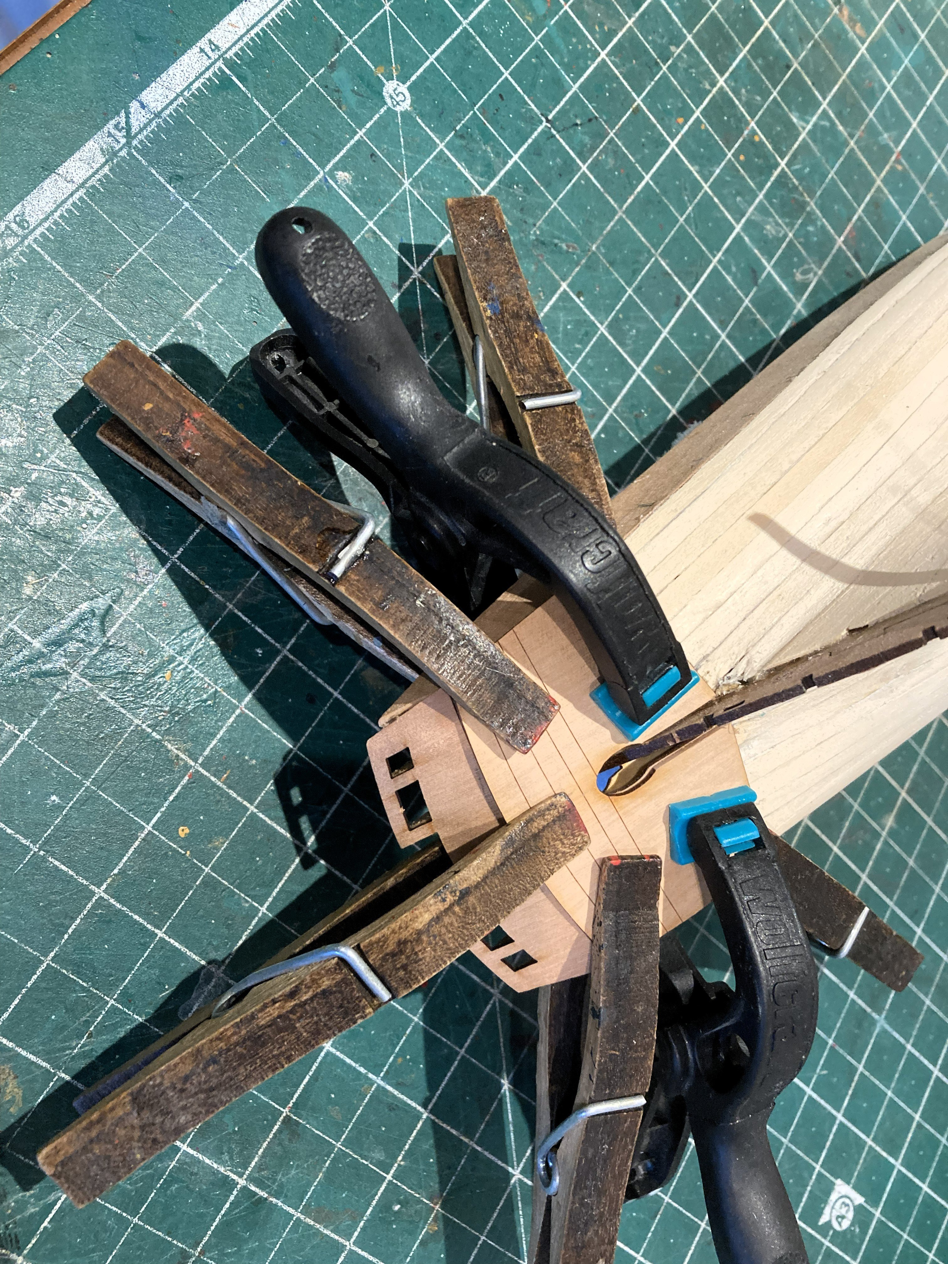

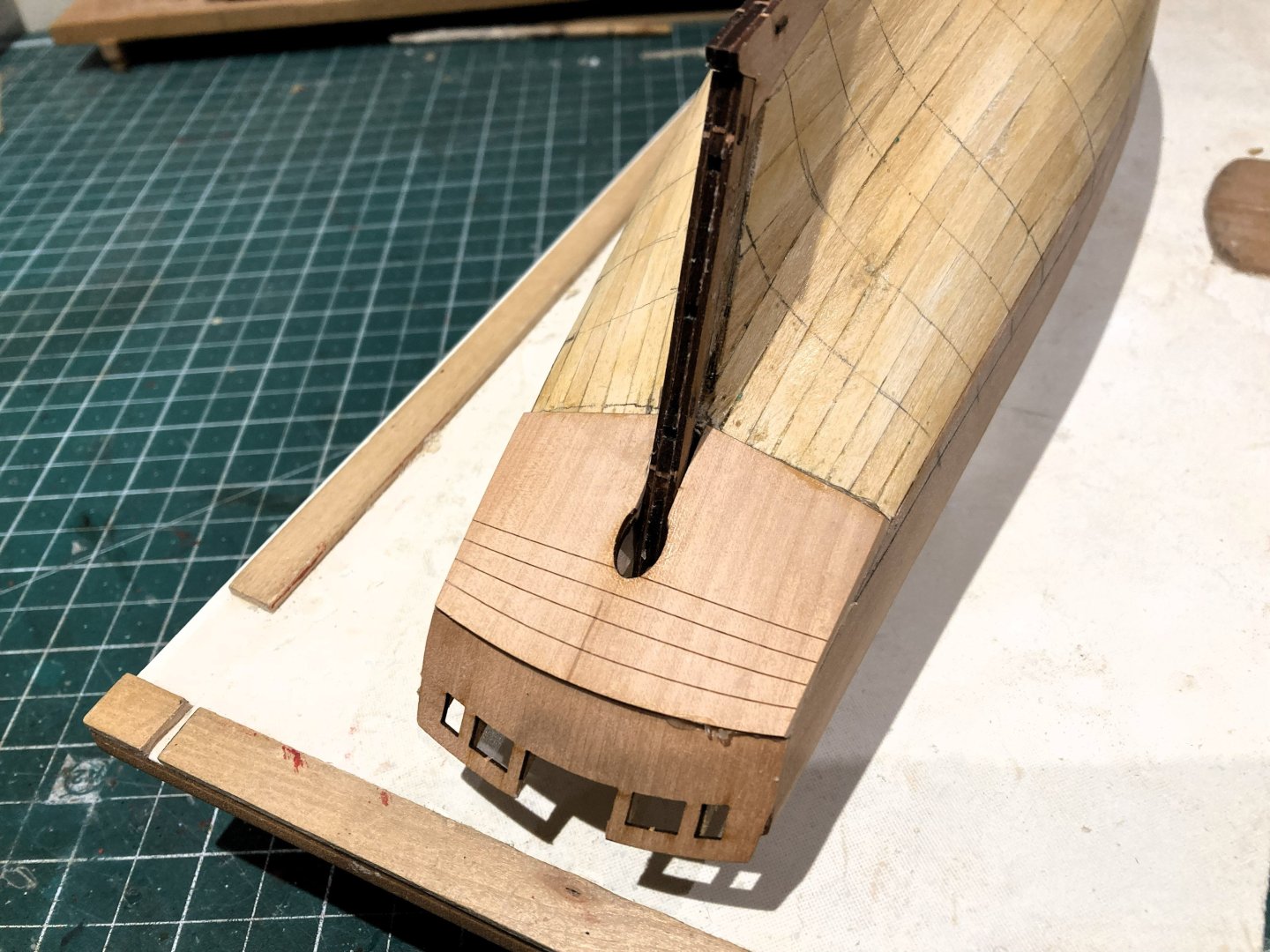

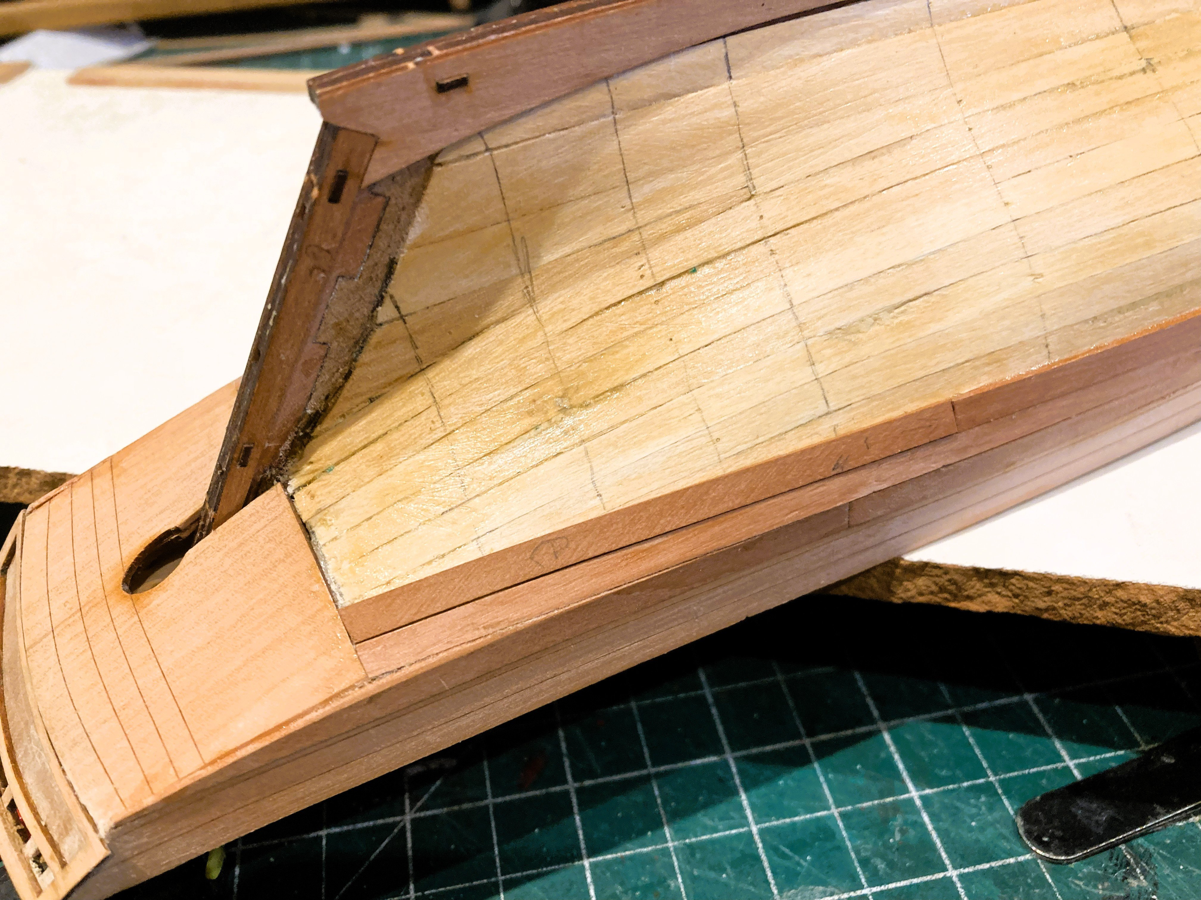

The Pearwood lower stern counter (outer) now needs to be fitted. This forms a rabett for the planking that sweeps up to the stern.
6209a
Before gluing, the part is clamped into place and heated using a hairdryer to take the spring out of it.
6215a
6213a
The patterns that cover the keel, stem, and sternpost are also glued and pegged into place.
Before fitting the Bulwark outer patterns, the bulkhead positions are marked on the planking. Sanding sealer has been applied to the Limewood hull.
6220a
The final action is to glue the Bulwark outer pattens in place.
This presented me with a small problem in that the Holes for the Bowsprit and hawse did not directly align with the inner pattern, something I recall from one of the other build logs.
No matter, I’ll sort it when I come to that point.
6222a
I slightly bevelled the inner side of the pattern at the bow to allow it to sit flush with the stem post.
6223a
I fitted both sides as they lay, squaring at the top. It is important that the stern Frame surround meets the bulwark patterns cleanly at the stern without any gaps.
6227a
I fitted this piece in advance of the stage indicated in the Manual.
Fitting at this point has no impact on the planking to come, and I was keen to repair the Stern Board fitted earlier.
Pearwood Planking up next.

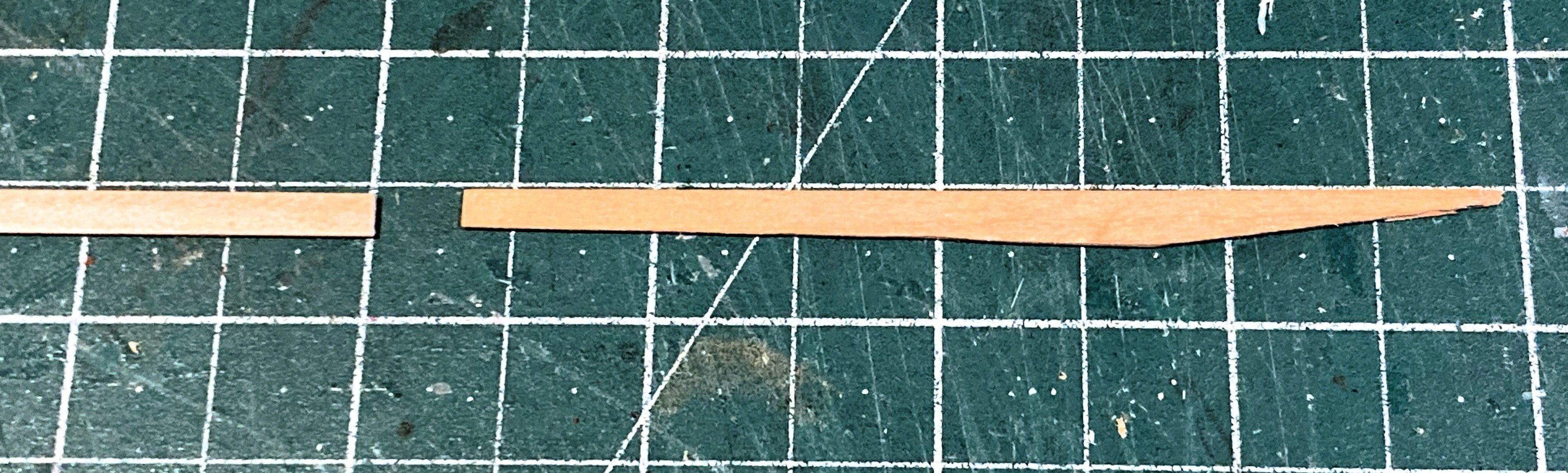

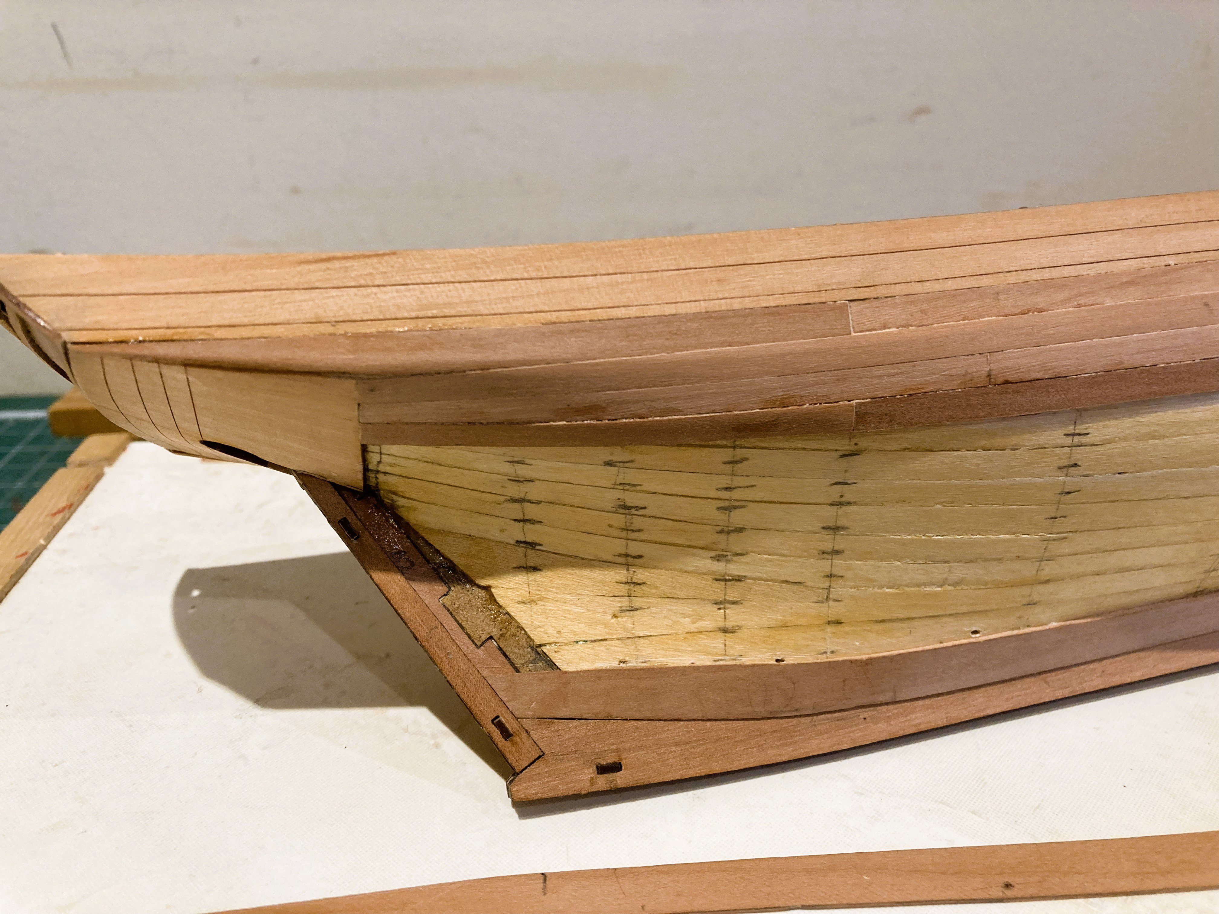

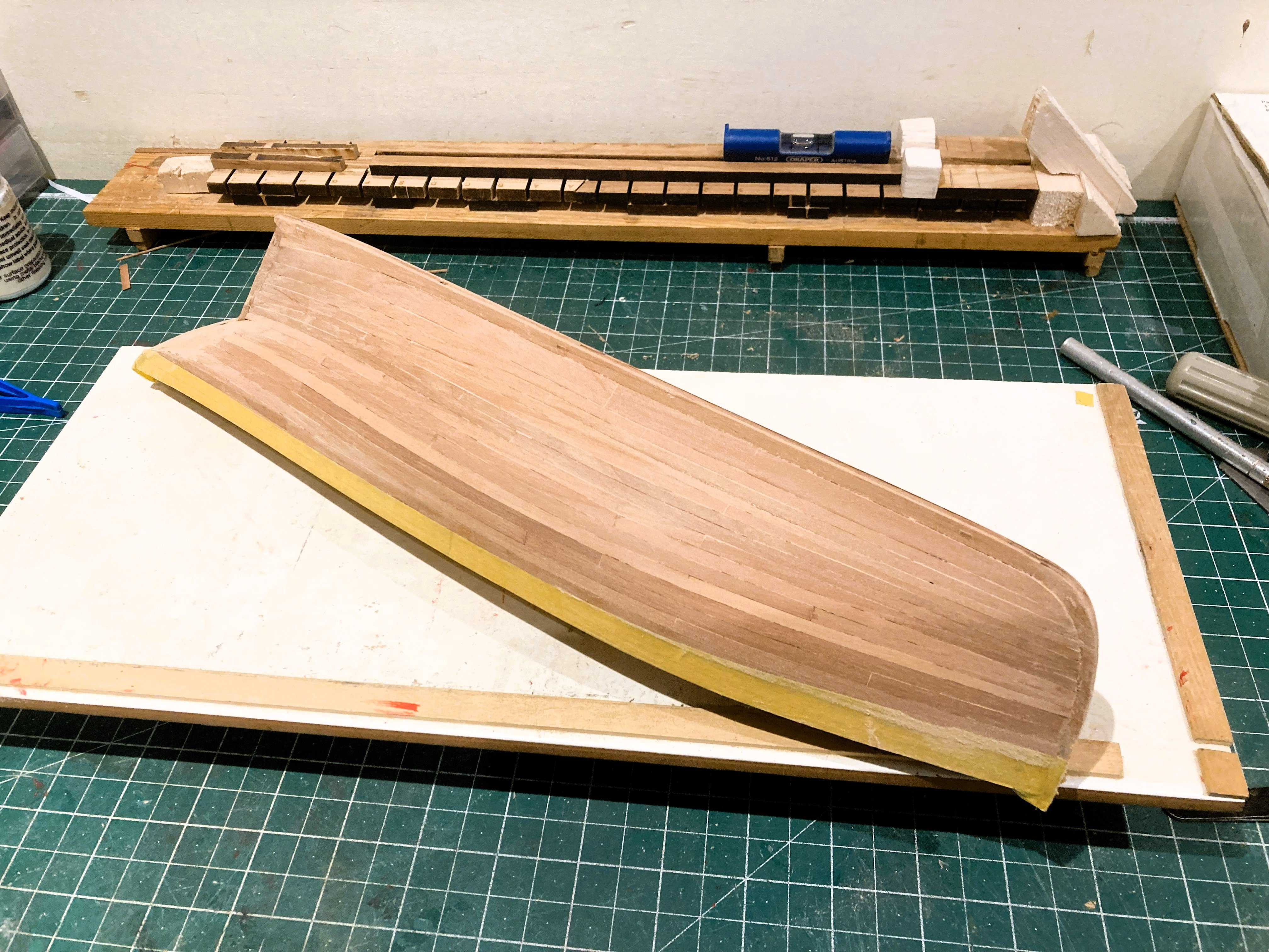

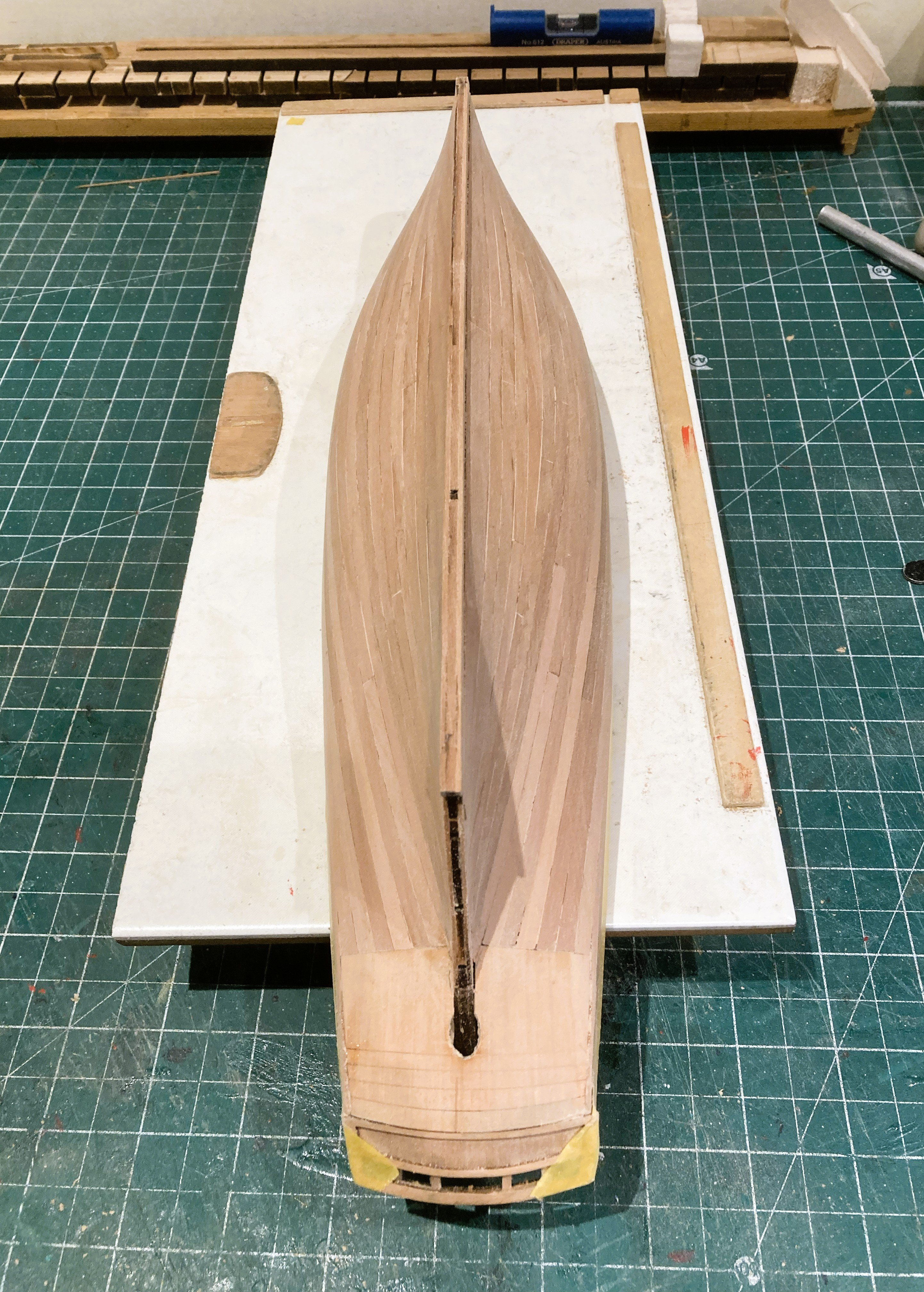

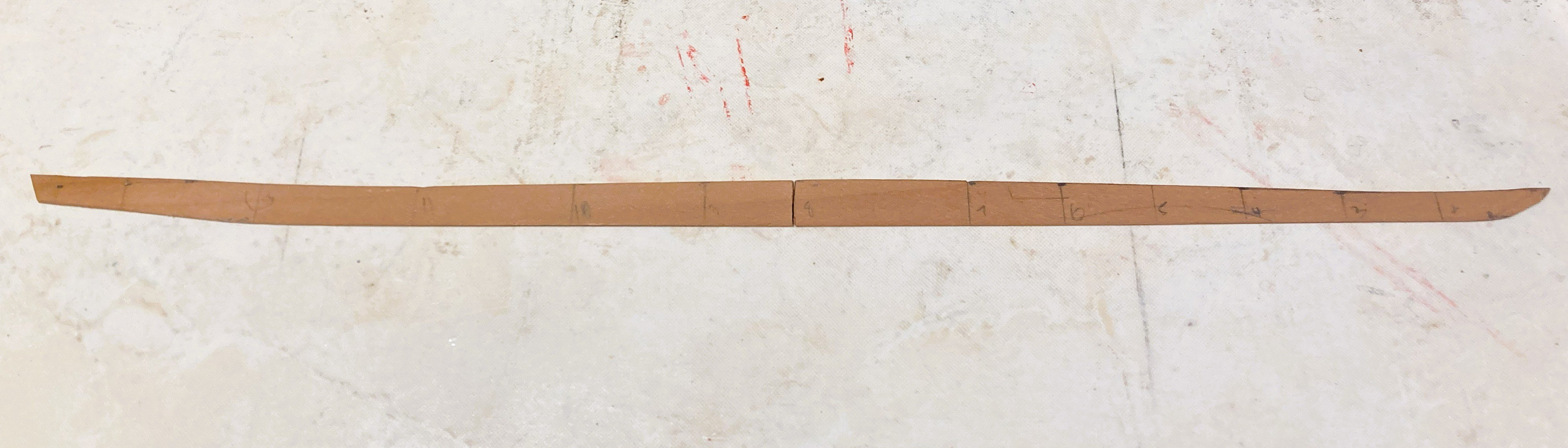

Pearwood Planking.
The kit provides 1x4mm Pearwood strips.

First strake below the pattern.
An odd one this, the given strips are a tad short to run the full length of the hull. This first strake terminates with a sharp point where it reaches the stern board.
6230a
I decided to fit this strake in two sections, the Bow section running to the fourth bulkhead from aft.
I fitted this without any taper or edge bend.
6233a
A tapered wider 5mm strip was shaped to cover the lower counter edge and run to the stern.
I preferred this option to the alternative of fitting an awkward filler piece.
The second Strake
6245a
I fitted in three sections and again without taper.
6260a
6247a
The aftermost plank does require a good bevel and some twist where it meets the counter.
The third strake down also takes full width planks, and the strake comprises four lengths.
6261a
I do like to represent the planking butt joints and give a nod to scale lengths but don’t plan the layout precisely.
6262a
This aftermost plank involves bevel and some twist.
The fourth strake has three planks, again all full width with only bevelling and some twist for the aftermost plank running to the counter.
6304a
6302a
6311a
6306a

The hull has now been marked off for the planking runs.
6320a
As I progress these will inevitably be adjusted and re-marked.
At this point I move onto the Garboard Plank.
6321a
For simplification I am using 10mm wide strips which are spiled to cover the lowest two marked strakes.
6232a
A little over-scale, but Garboards were generally wider, and given the position they do not visually impact on the model.
6326a
This is fitted in two sections for ease of handling.
6332a
The aft section is a little unusual in that I have spiled it to follow the upswept line of the keel to meet the stern post.
6338a
The alternative would be to have the Garboard terminating at a point short of the stern post.
6340a

The slog of planking continues.
Here in England’s currently not so pleasant land, January has provided day after day of cold wet weather, perfect for settling down for this sort of repetitive exercise.
You get into a rhythm a bit like Rattlin’ down.
Measure, Mark, taper/edge bend, test, and glue, clean and move on.
6354a
Following dry fitting the planks are pinned in place and blasted with the hairdryer on hot before gluing into place.
6356a
6357a
I have continued to form the strakes in three plank runs, easier to handle when using cyano.
6359a
6361a
The strake above the Garboard is now fitted, leaving six strakes to go each side.
6389a
There is an awkward area where the strake meets both the stern post and lower counter which would otherwise need filling.
The counter was trimmed slightly to allow passage of the plank.
Not quite sure whether this plain part of the counter is a kit simplification, it just looks a little odd to my eye.
In practice would it not have been framed and planked similarly to the engraved plank marks below the counter?
6392a
Five days effort and three strakes to go, one top, one bottom and a final spiled strake between.

Completion of Planking.
6399a
6401a
Not too bad a spiled shape for the final strake, which mostly sits below the round of the hull.
6407a
Pattern for the final spiled plank.
A major milestone in this minor build, completion of the planking. I think the ugly duckling is looking a little more Swan like now.
6408a
6409a
6412a
For sanding I used 120 followed by 320 papers.
6414a
To maintain the keel drag for waterline marking I found it necessary to fettle the work stand to allow the hull to sit fully down on the retaining pin.
6421a
A little more fiddling and fettlin’ before I move on.
