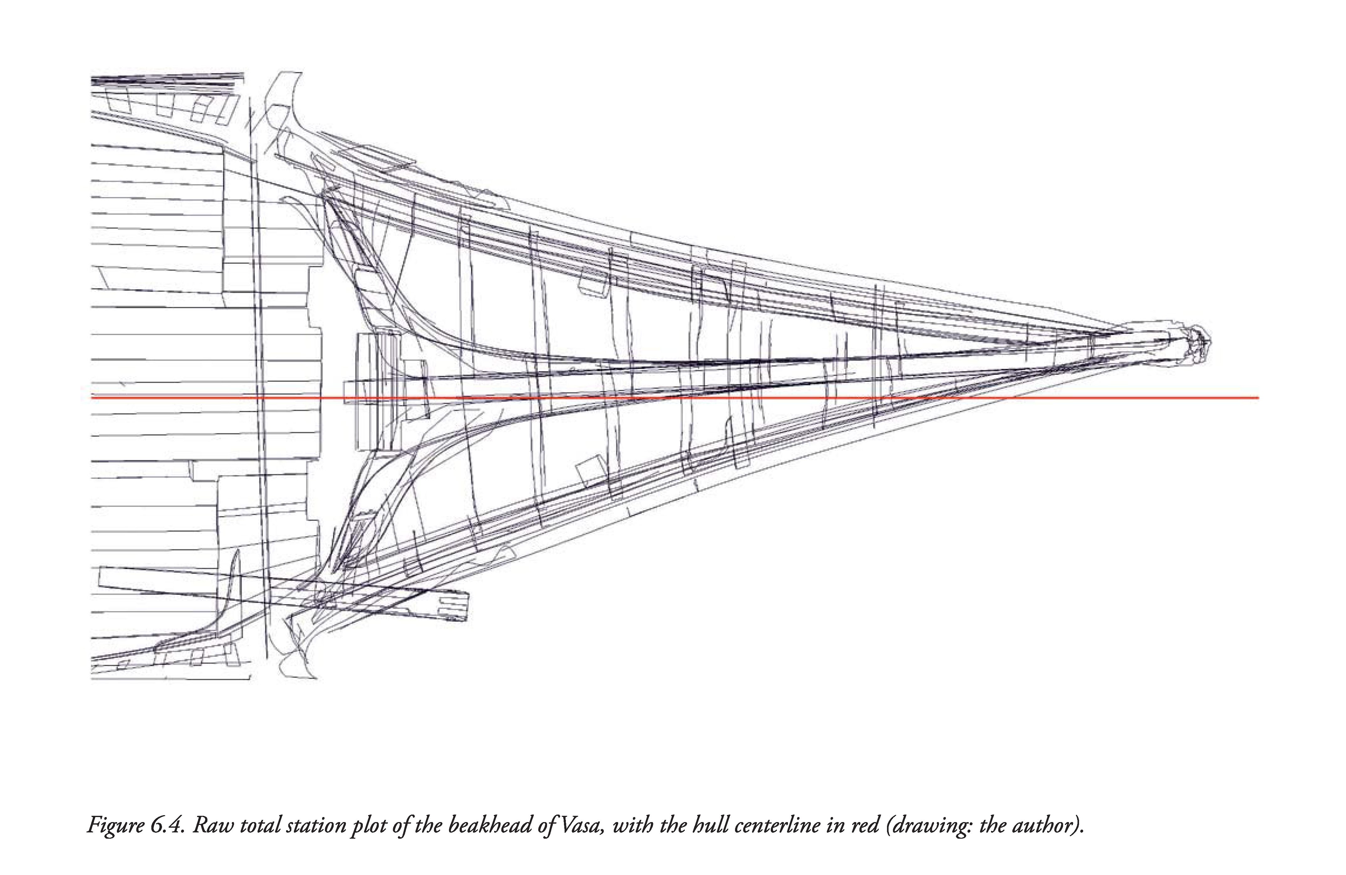

This will probably be the first model of the Vasa 1628 that I know of that will (intentionally) incorporate all the known defects and flaws of this vessel. I am particularly curious to see how the distortion of the beakhead will look in the photos of the model. It can be said that this rather conspicuous feature is never reproduced by model makers, so I commend the courage to do so.
Not everyone may know what this is about, so below is an illustration showing the beakhead distortion as it appears on the original (from a paper by Fred Hocker, In Details Remembered. Interpreting the Human Component in Shipbuilding, 2013). In fact, this very feature was omitted even in the official plans of the ship published in 1980, and there is still no updated set of plans.
PagesfromHockerFred-InDetailsRemembered.InterpretingtheHumanComponentinShipbuilding-inInterpretingShipwrecks...-2013.thumb.jpg.96c9229ddbfa66aa8f9b2ca1f07ec354.jpg

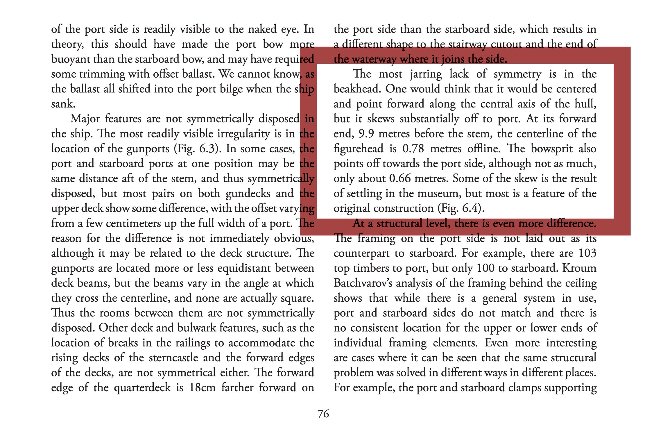

In this particular case, as in many others, I suggest taking a look at the relevant commentary in the article referred to. The entire section on the various asymmetries of the Vasa's structure is both interesting and informative, and here are a few paragraphs, including the one on the beakhead:

Intentional skewing of the bowsprit and beakhead seems rather unlikely, as the bowsprit runs exactly over the stempost (unlike, for example, English designs of the period, where the bowsprit ran alongside the stempost, always or at least often) and there was no reason to angle them in the horizontal plane. This arrangement is particularly evident in Björn Landström's fantastic illustrations in his equally fantastic book The Royal Warship Vasa, published in 1988. I highly recommend consulting this publication as well.

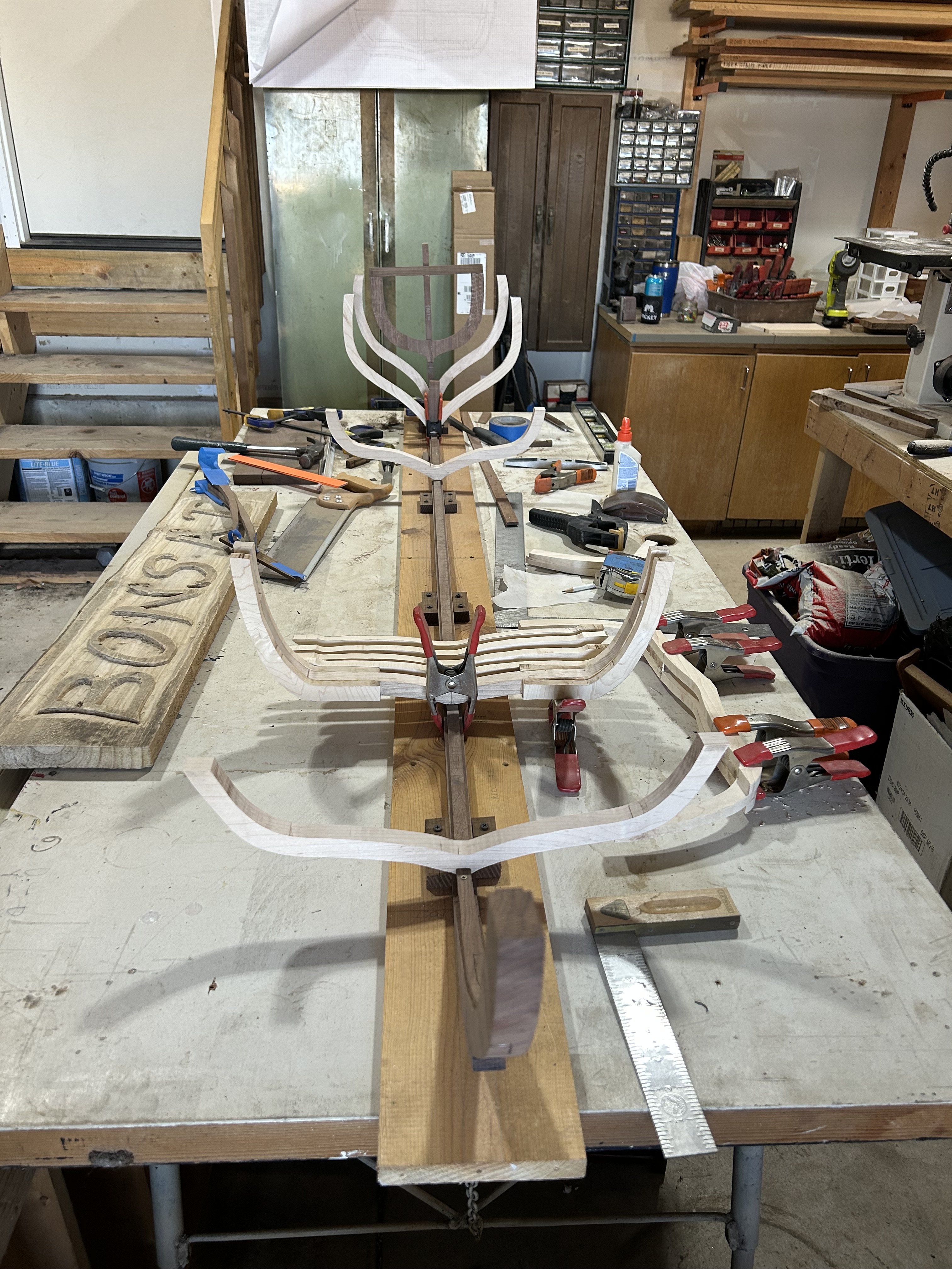

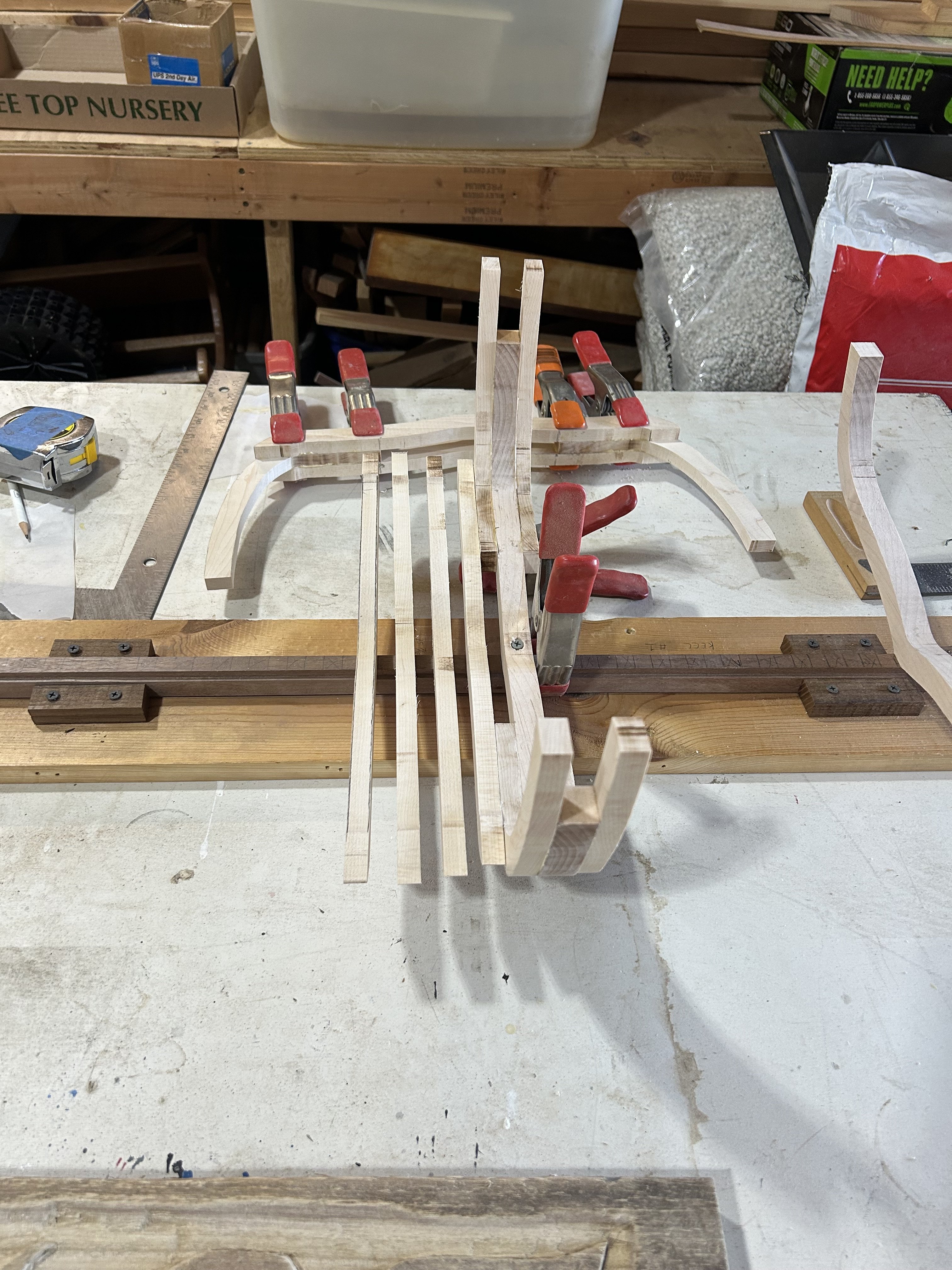

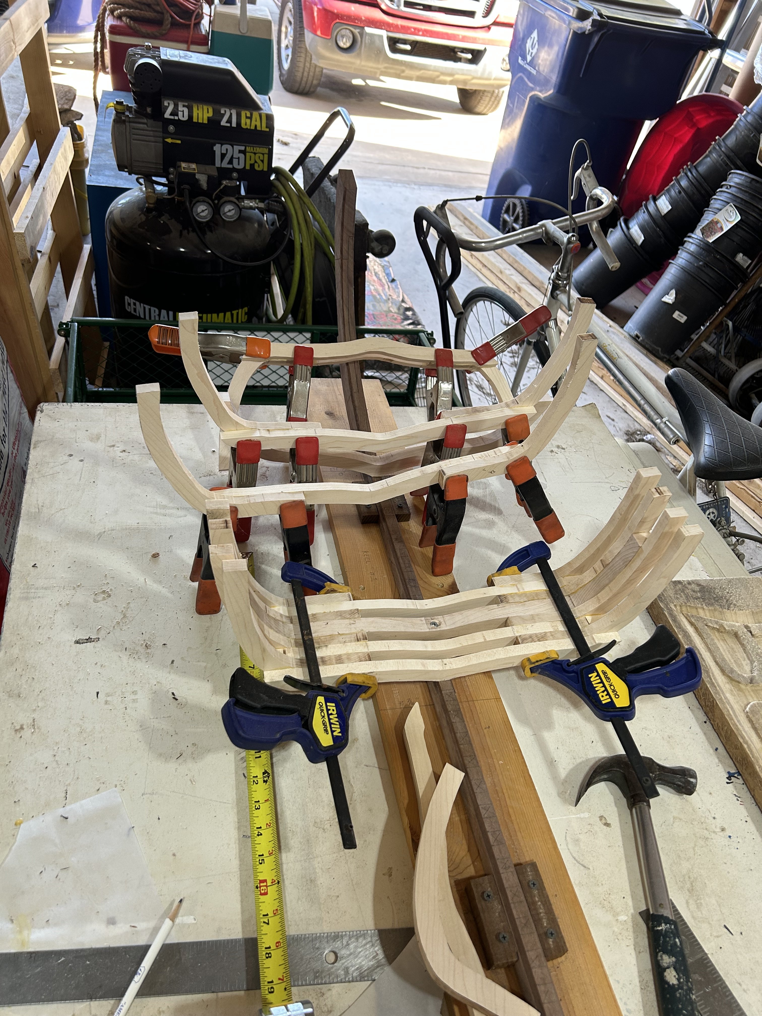

I’ve not updated in a while but work is progressing. Slowly getting frame pieces cut and fit. A long process especially since I have to make my own templates. I am concentrating more on the middle of the hull first as it is easier than the bow and stern. I have begun testing some pieces for those areas but nothing mounted.
I included a picture with a 25’ tape measure in it for size reference.

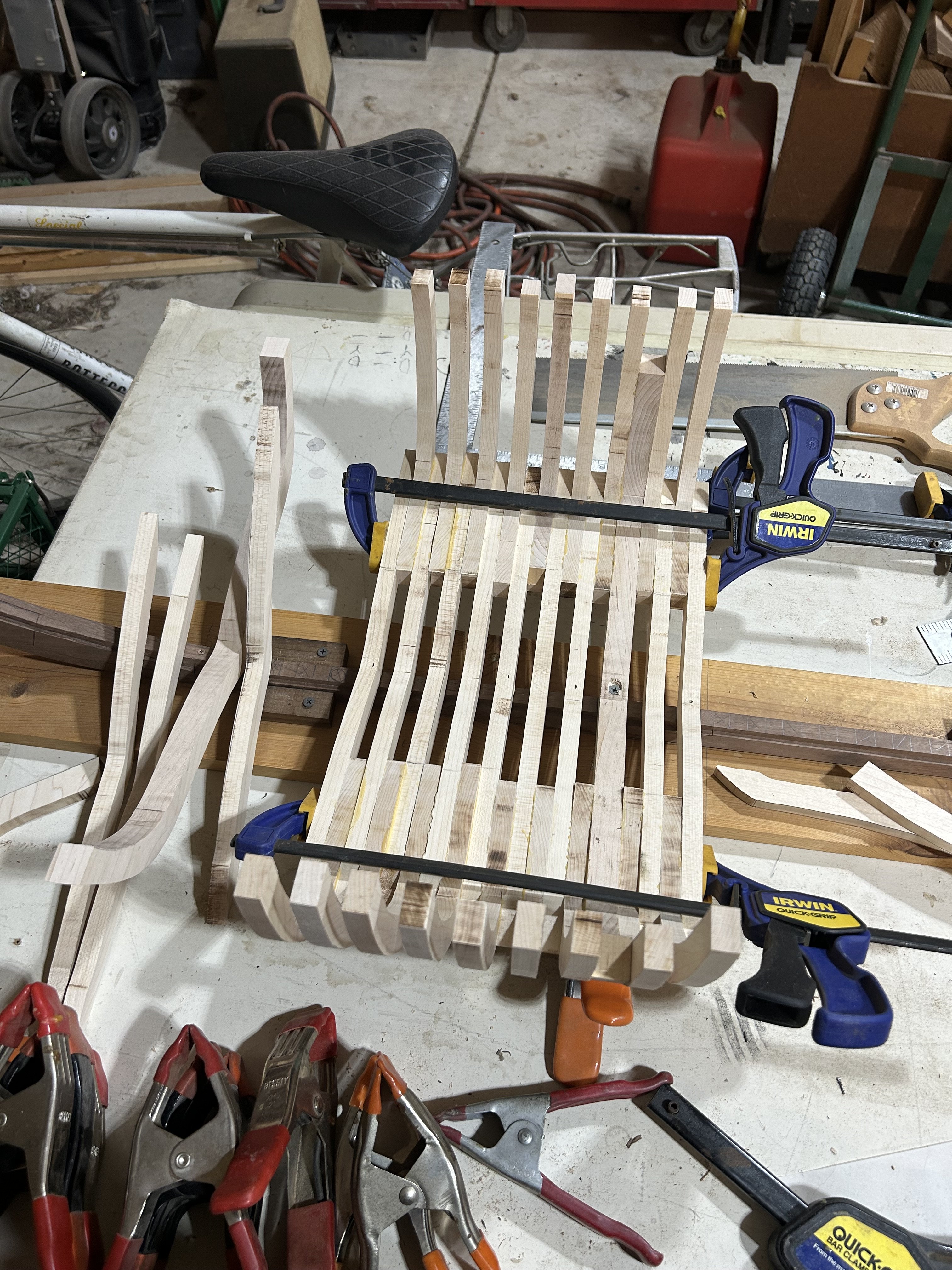

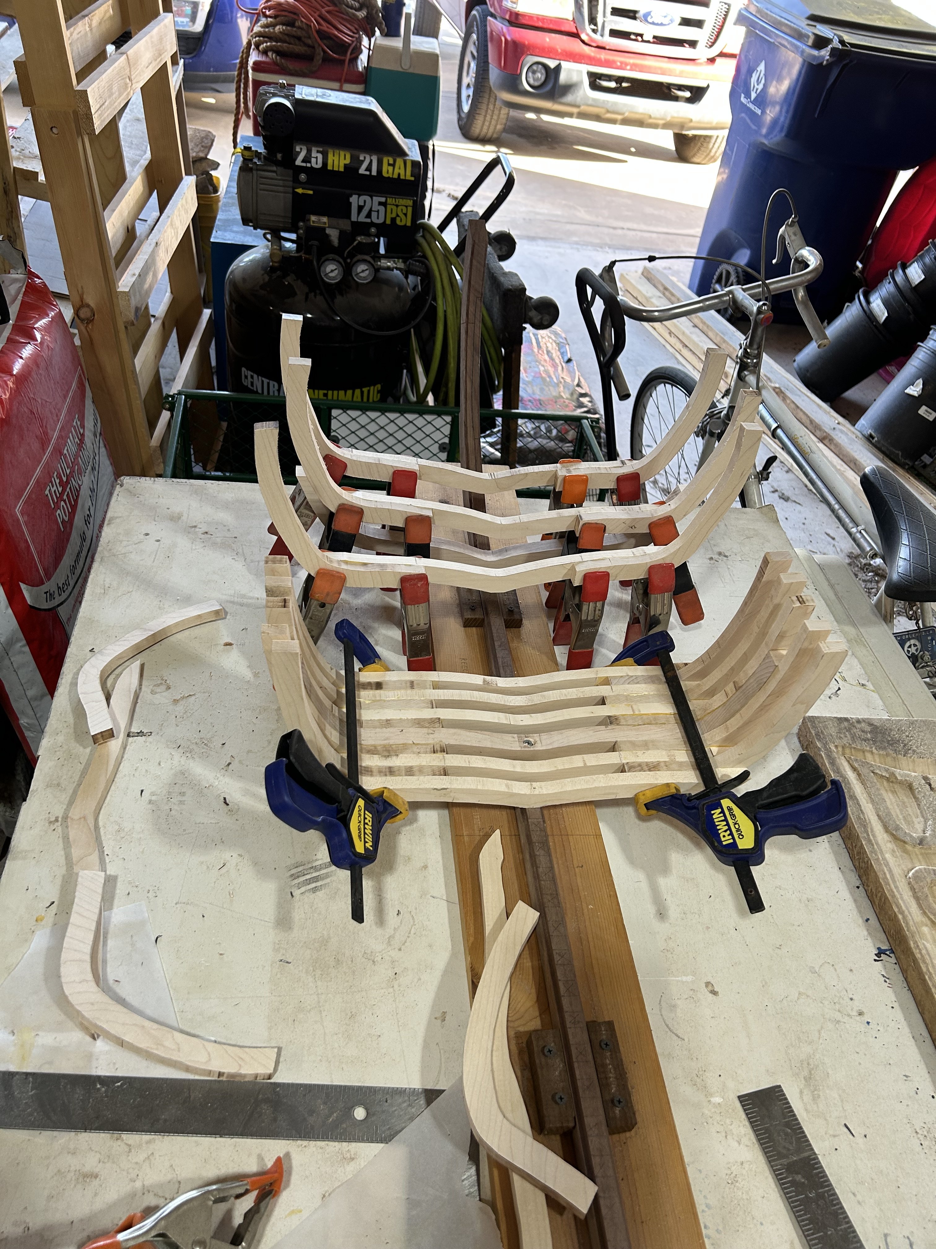

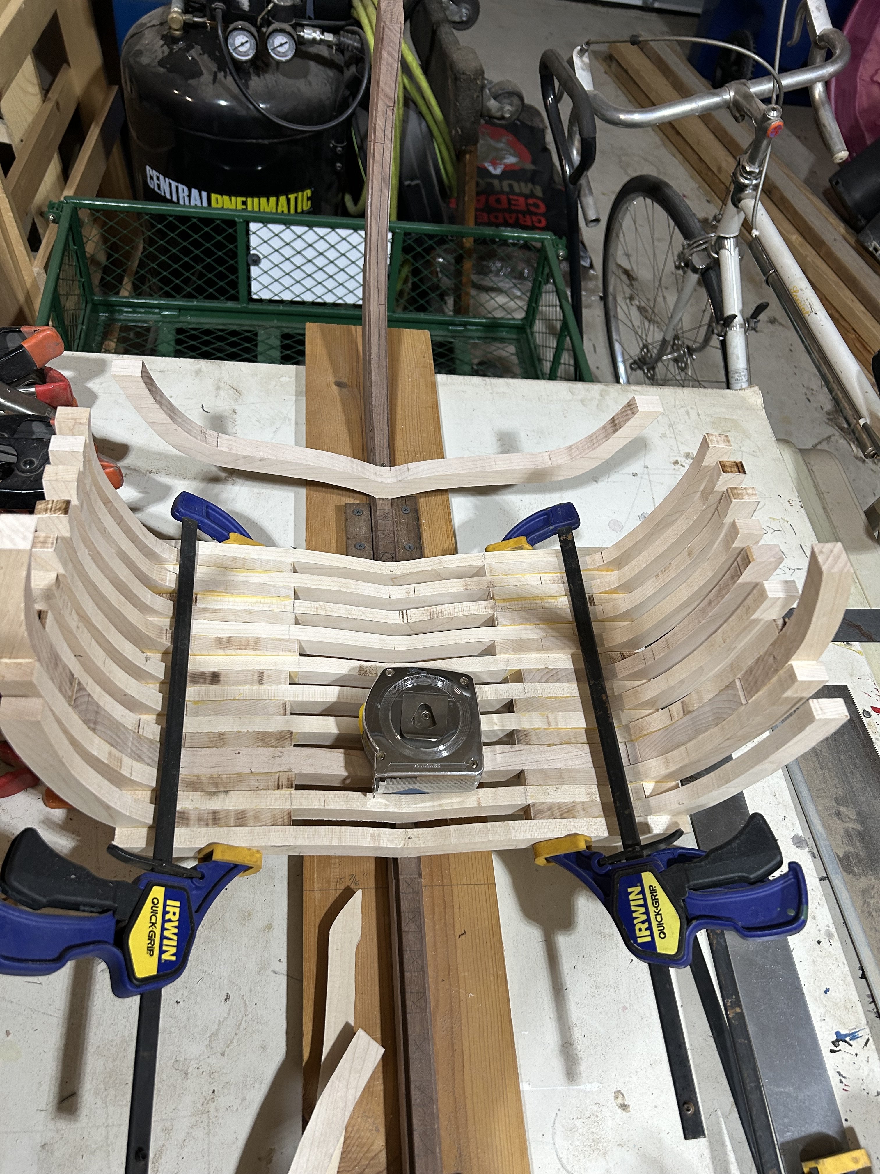

Adding more frames. Nearing the mainmast soon. To get a better idea of the hull’s full size, I added the futtocks and top timbers at the widest section. Yes, one side is leaning inward and needs to be adjusted…
A buddy of mine was having trouble picturing how big the model was getting so I took a picture of me in front of it to give more perspective.
