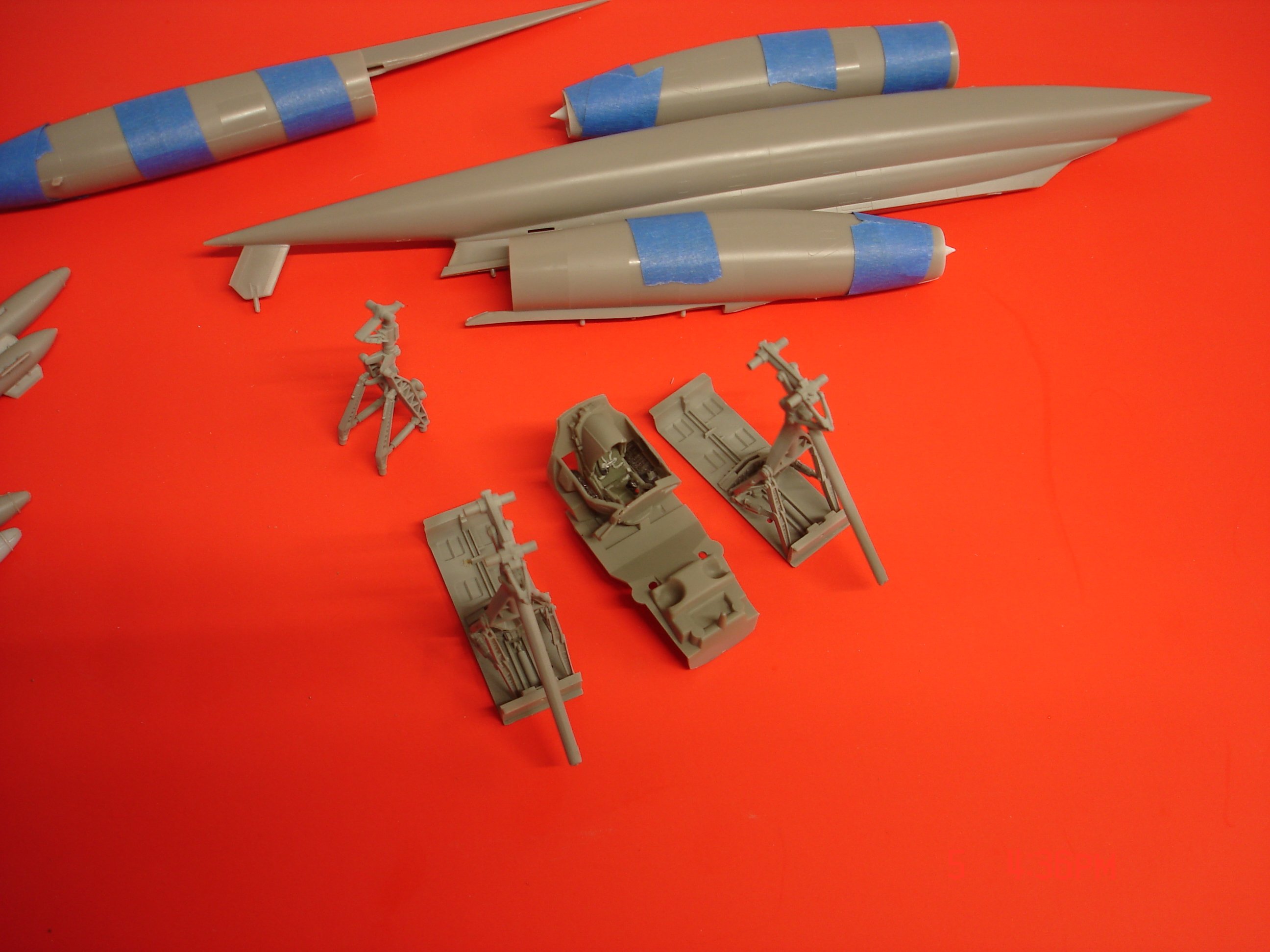

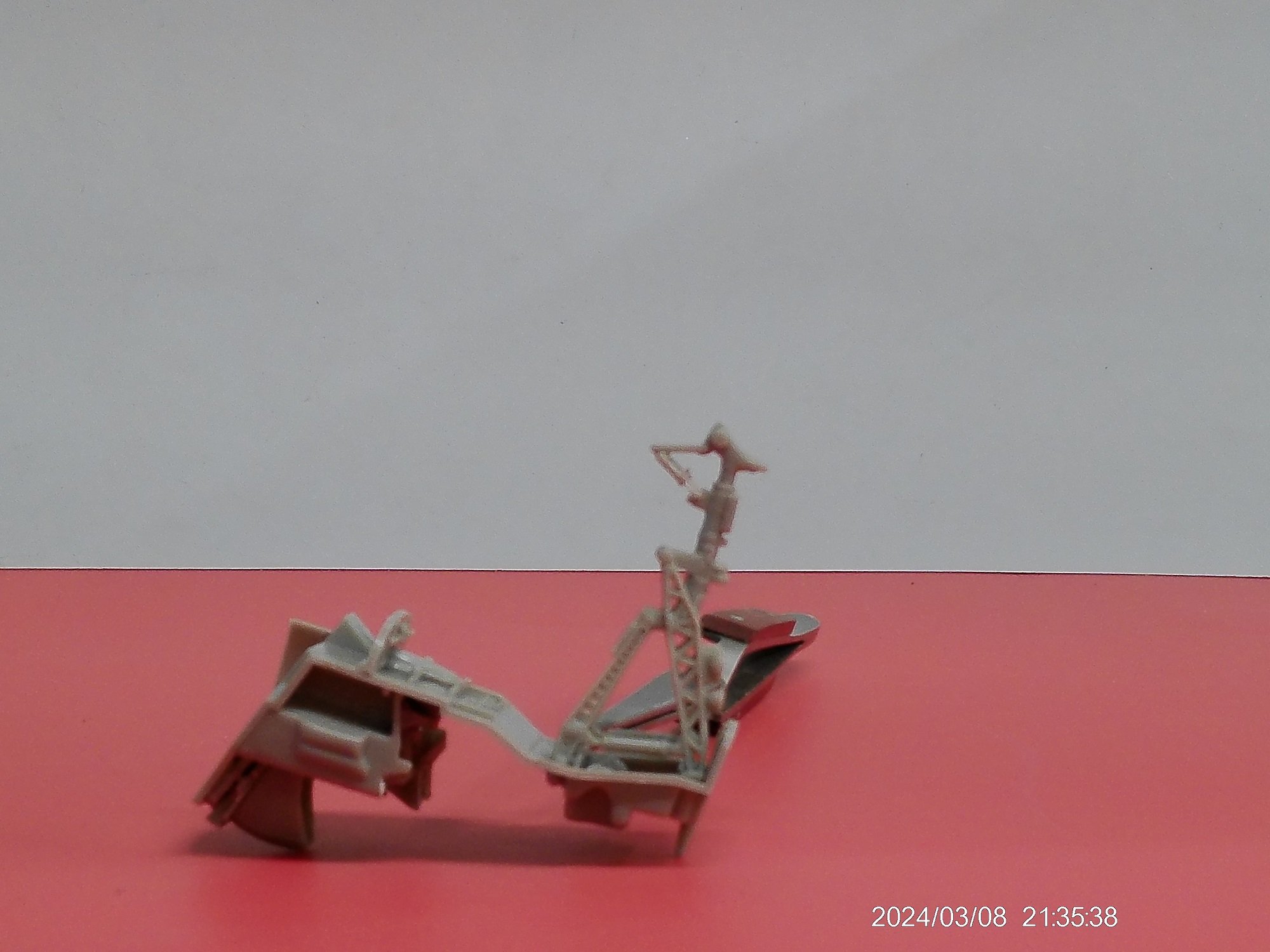

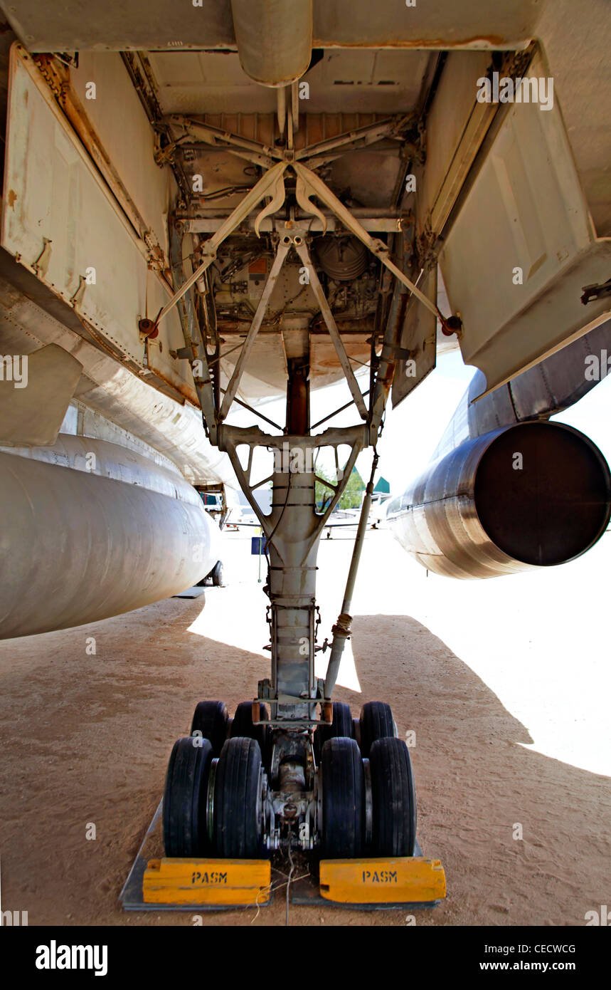

Thanks Ken for info but staying with the plastic thick hard plastic.I know it's stretching back into that memory file Ken call out is dark grey for the wheel well area but silver on the LG's themselves?But I know it's Navy but white WW's usually white LG but the AF/AAC zinc chromate and silver gear was it grey or silver ..I have not  done any research if I find one pic grey they are grey just to break up the color pattern.🤨

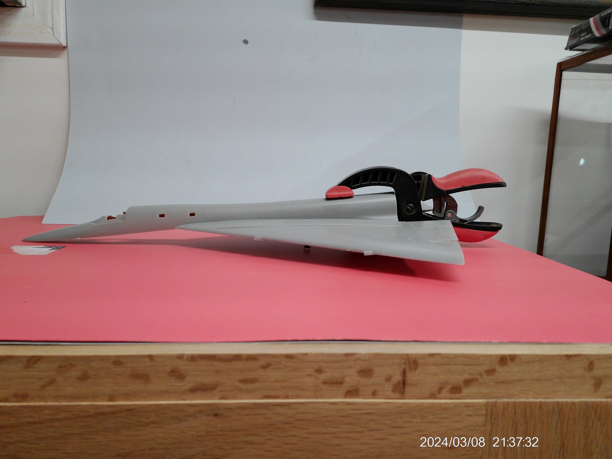

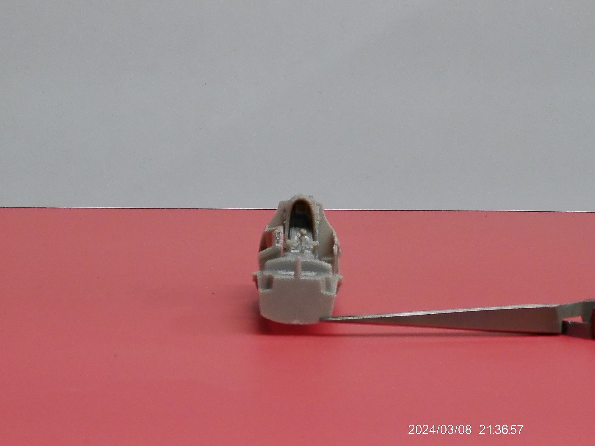

I have been assembling a lot of the sub assemblies LG's,Pit and the engines.The LG's though it does not look like it have been repainted into a light grey poor lighting on my part and nighttime on the shots,The copit was laft in the US Naval Dark Grey which really looks like RLM 02 in my eyes.The copit ATTM has been installed with a couple of lead weights just in case.I cut the nose pitot tube from it's attachment inside the nose and installed onto that a hollow tube it worked and is straight no breakie on that part I am thinking yellow/black for that part.I have been thinking since last night these engine pods need to be painted before they are installed to bring out panel effects masking and such is still swirling in the head?Too I am going black base the plane and maybe paint the bottom do panel and then attach the engine pods.Yves this plane is not hard at all to build just lots of sanding and some raised panel lines go away for me on the pods were most happened doing different panels should fix it.Just one pic ....

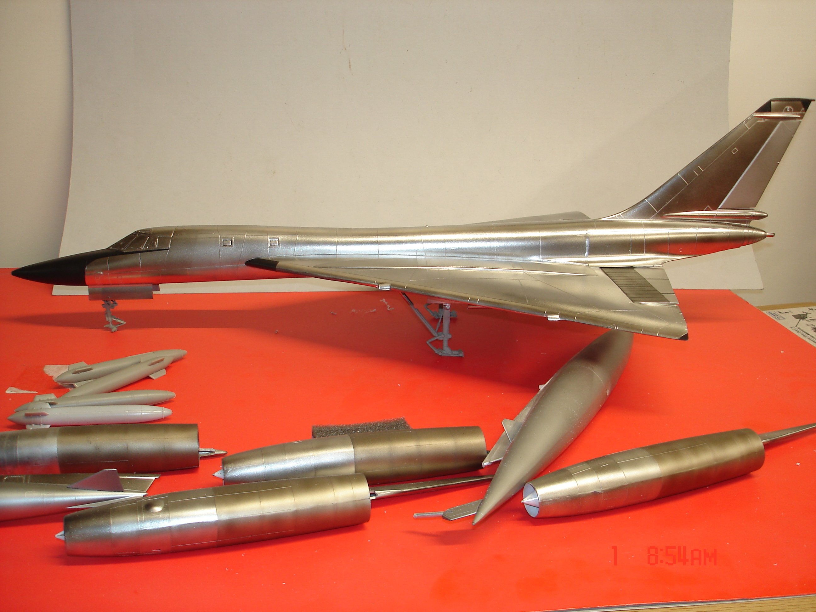

Progress has been slow but steady lots of sanding old molds/technology.I painted the engines primer,black,polished silver,silver119(panels) pale burnt metal,paneled line with rubber,pale metal(very thin) then burnt iron.The body of the plane has only been primed up top ATTM but is silky smooth after using a worn out 800grit scotch brite;)

The engine pods look very nice.

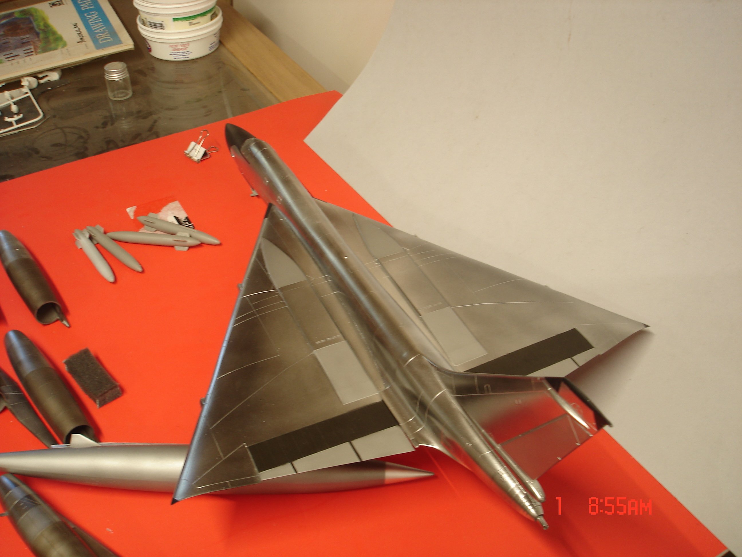

Thanks Alan I did one per night took 1/2 hours each evening now lets see if the rest of the plan works out.The idea is to primer the whole plane then buff and apply the gloss black then go polished aluminum .The next step will be to pick out panels,flaps and rudder.I will then SG the pods on fill the seams and retouch the paint.🤨
apic of panel colors

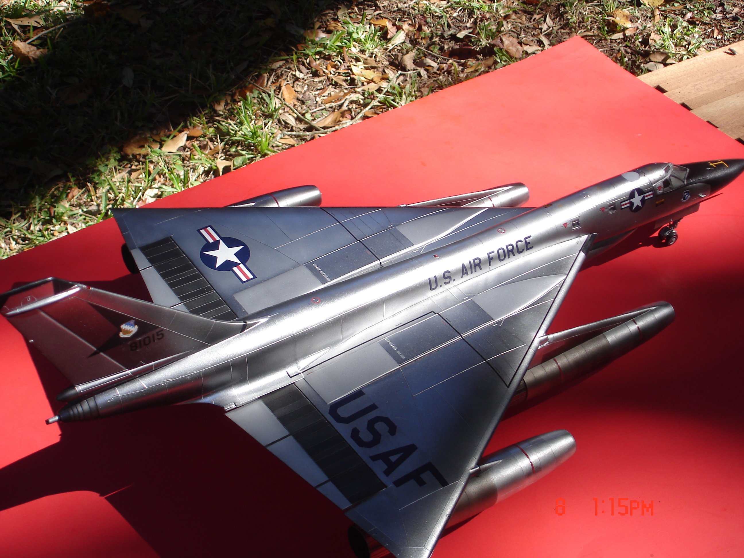

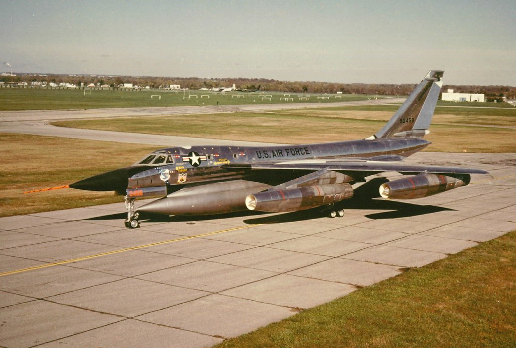

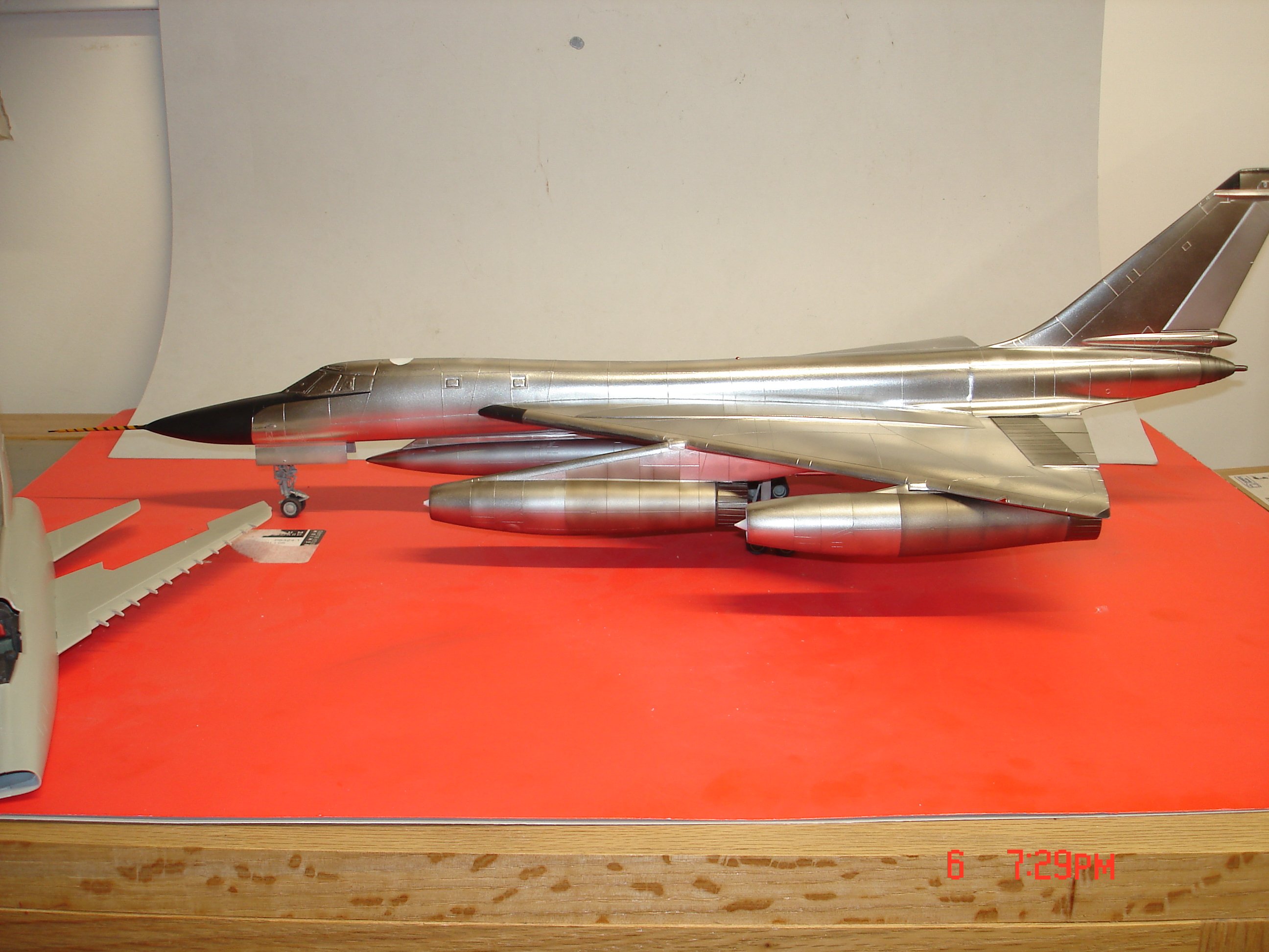

I keep plugging along sometime one step forward  two back?I am going to give myself a C= or B on this one the problem being I used rattle can for the black (it's a big canvas).The more I add color wise the better it starts to look so the decals shall help also.I looked at many videos these planes were polished. I have a coworker who was around these planes mentioned many models flat AL his head tilted eyes moved"No,they were shinny";)

That is a nice metallic finish! I could comb myself looking into it 😉.

Seriously Nice work  - that metalwork looks Fantastic.

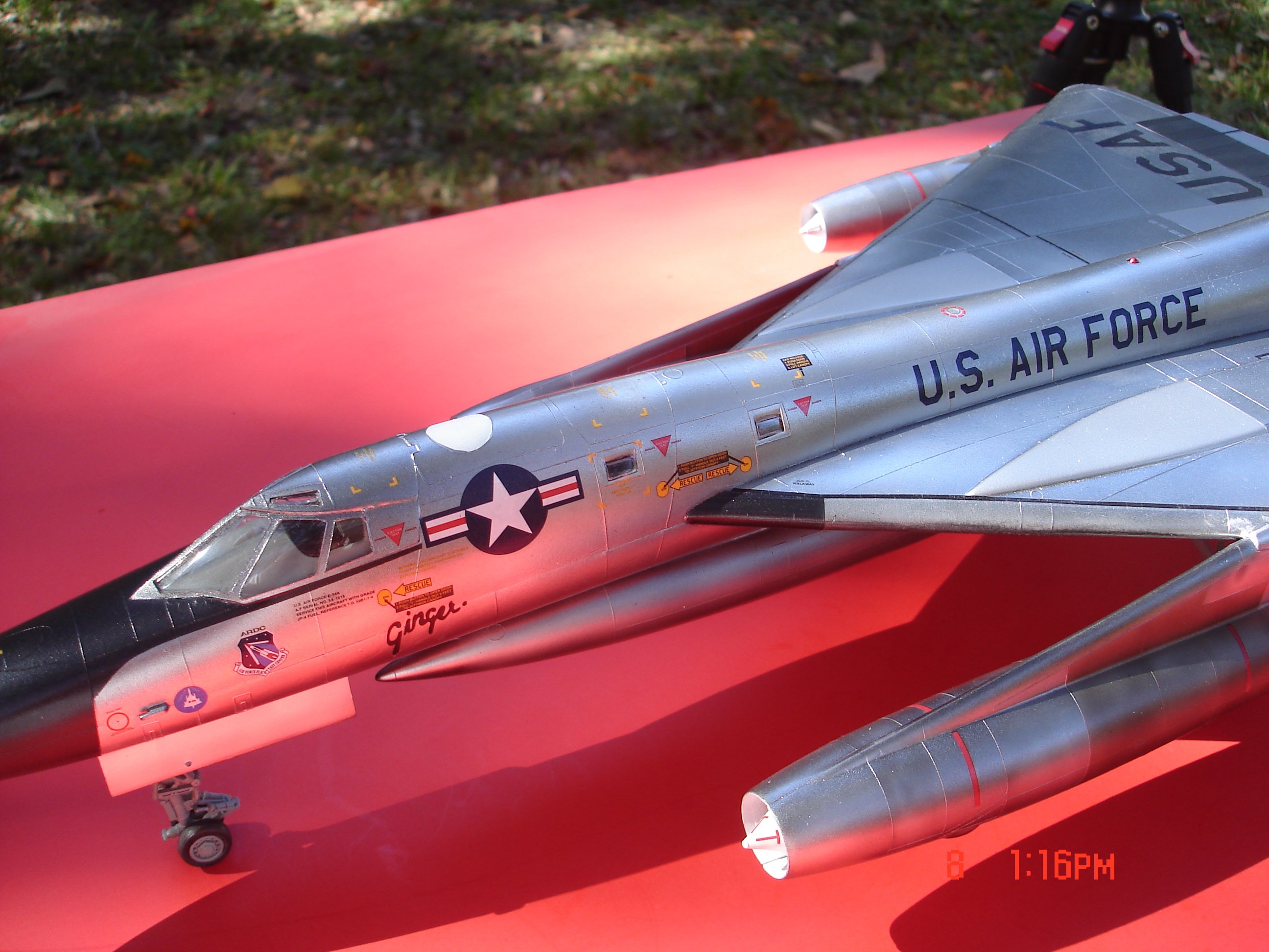

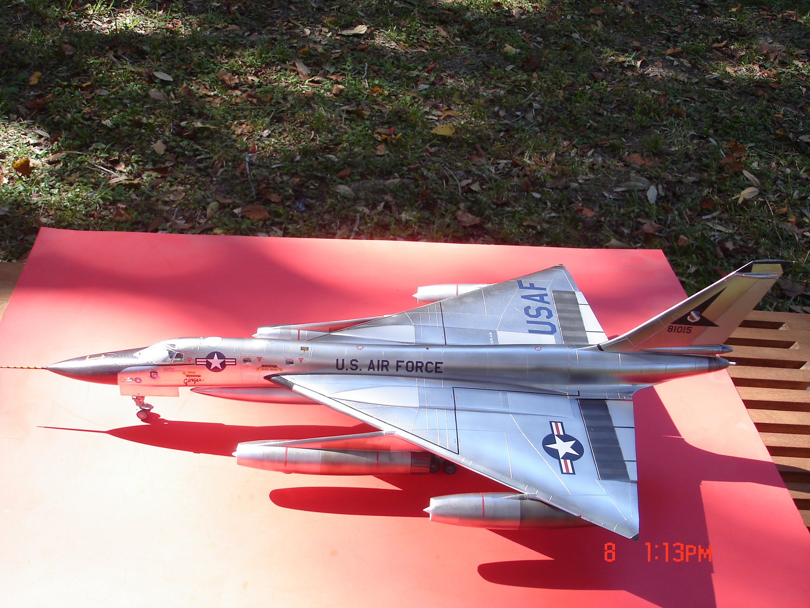

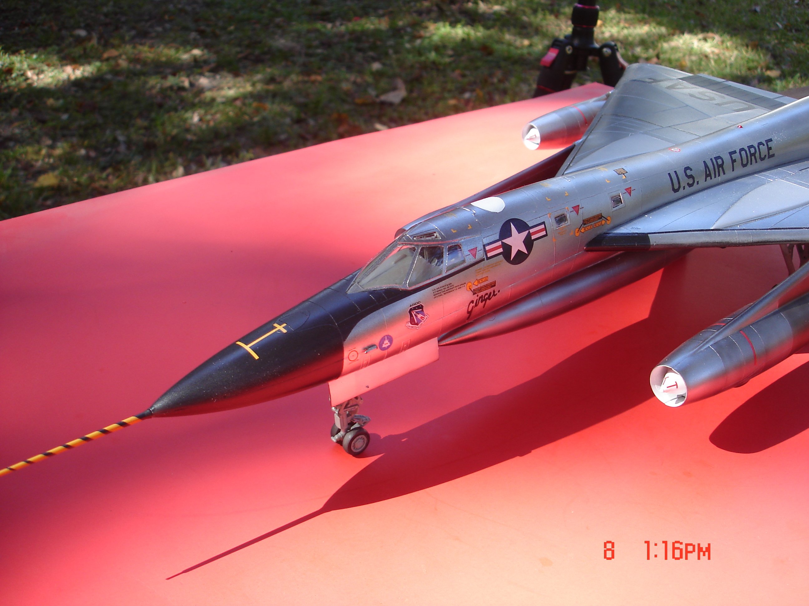

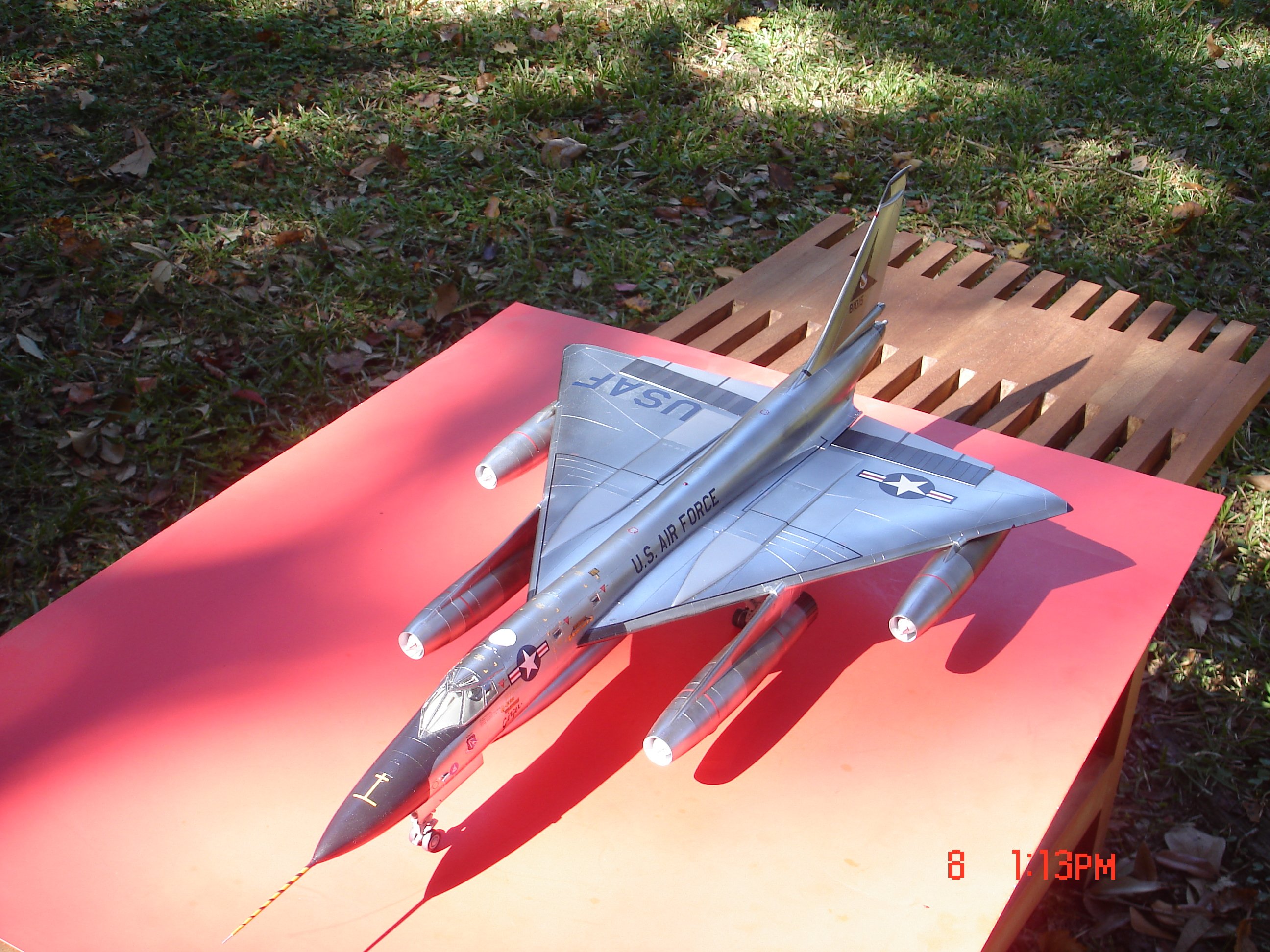

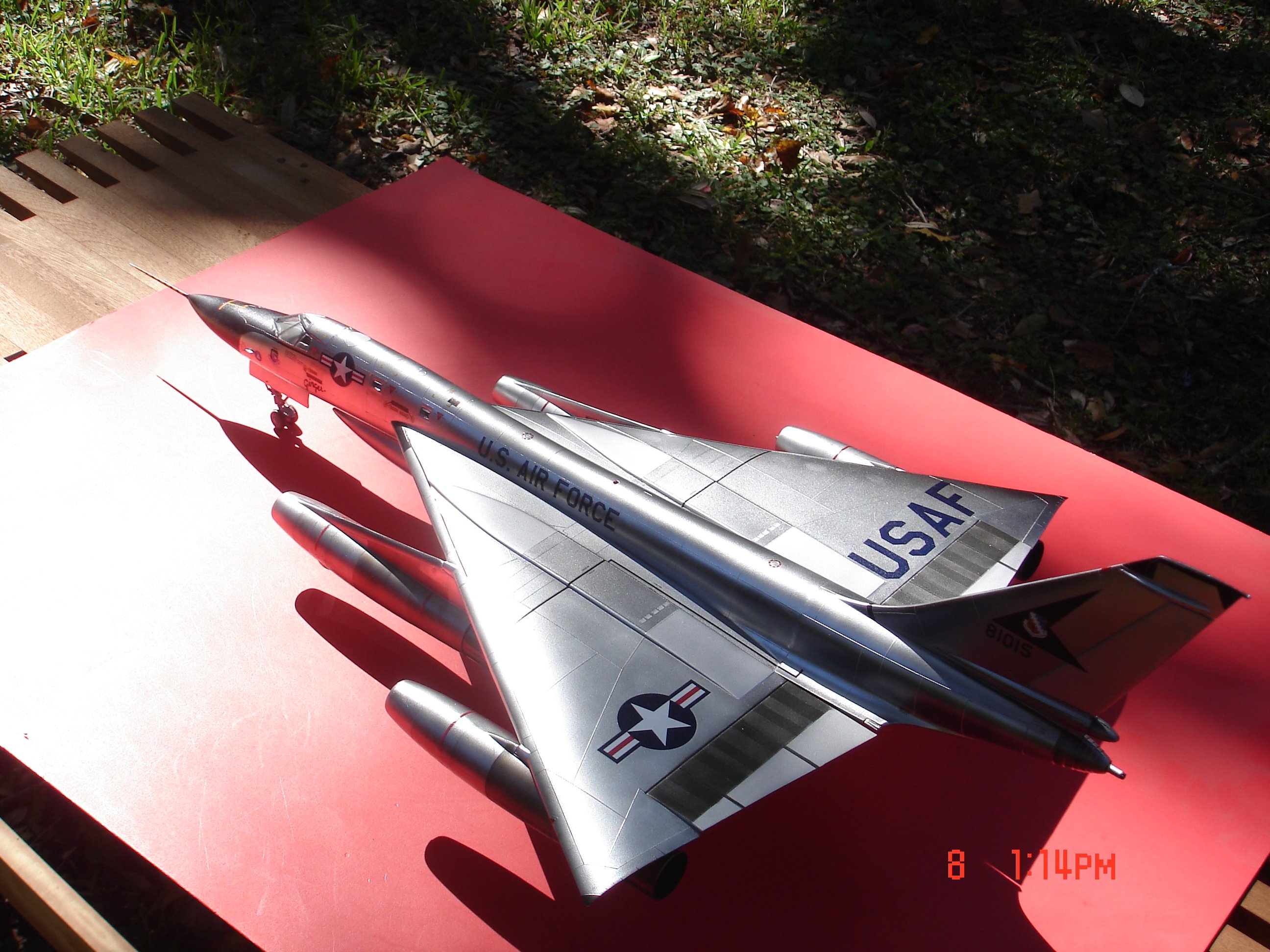

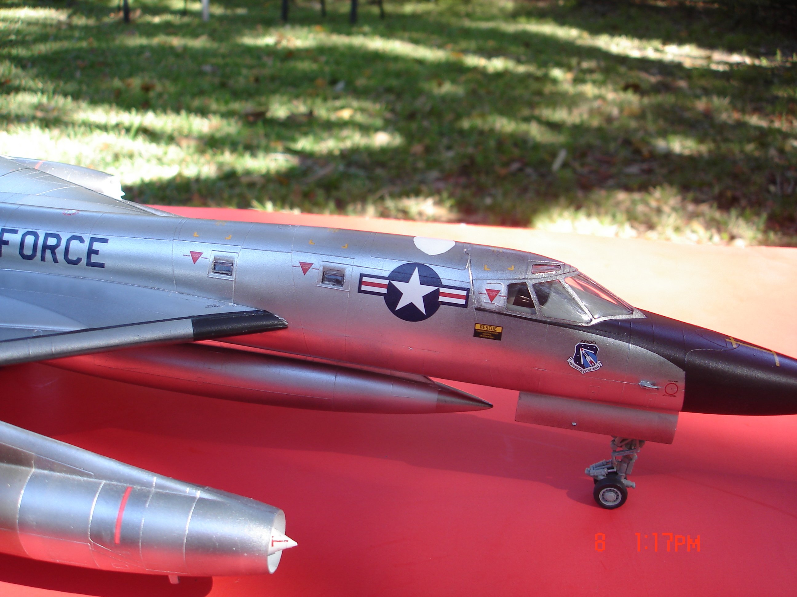

I will clear coat tomorrow with Pledge thinned with Mr.Leveling thinner makes it lay smooth and drys much quicker .The engines are what they are I got a no seam in what you look from the outside but inboard side I did not mess with.I found out doing the belly tank just putting putty and paint does not work still looked white in a sense.I painted a hairline color of black on the engine seams to the wing sprayed AlClad 105 and all was good.I think once all said and done it will not be a bad looking build giving it a B grade.🤨
The F-100C is the Trumpter kit got good vibes on this no seams hardly at all.;)

Amazing work.

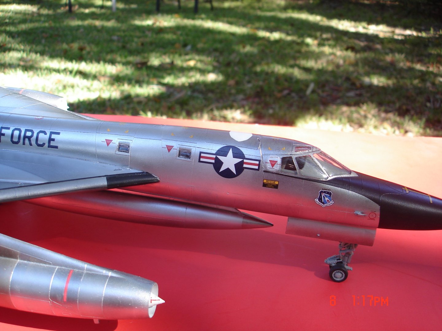

I remember these things - when I was a kid I lived about 45 miles from Little Rock AFB where these were stationed. They were a beast to fly. About 22% of them crashed, mainly on take off.
Phil
Current build: USS Cape MSI-2
12 hours ago, GrandpaPhil said:
Excellent work!  Very nicely done!
Thanks Phil sanding/scrapping was a big chore with this one.🤨
11 hours ago, ccoyle said:
Agree -- nice work!
I appreciate that Chris;)
They sure did Phil had their teething problems thanks for looking in;)
The others who have looked in giving likes and wows I really appreciate it!:imNotWorthy:
9 hours ago, king derelict said:

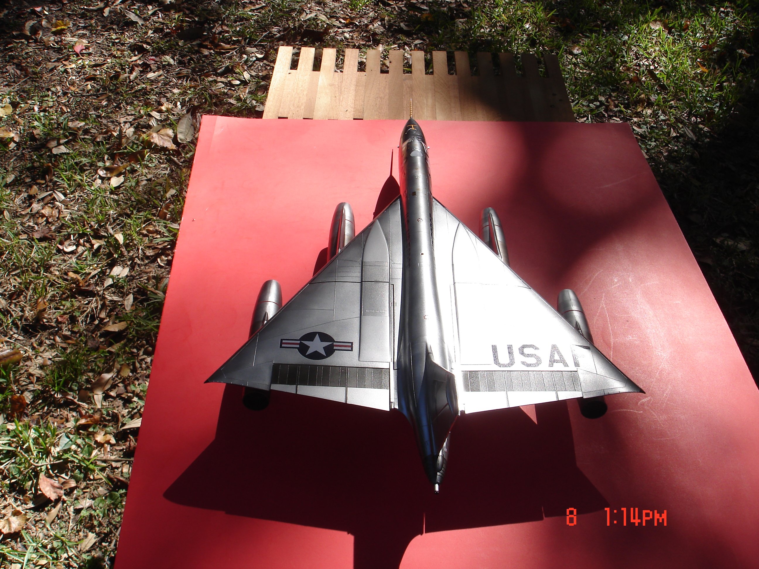

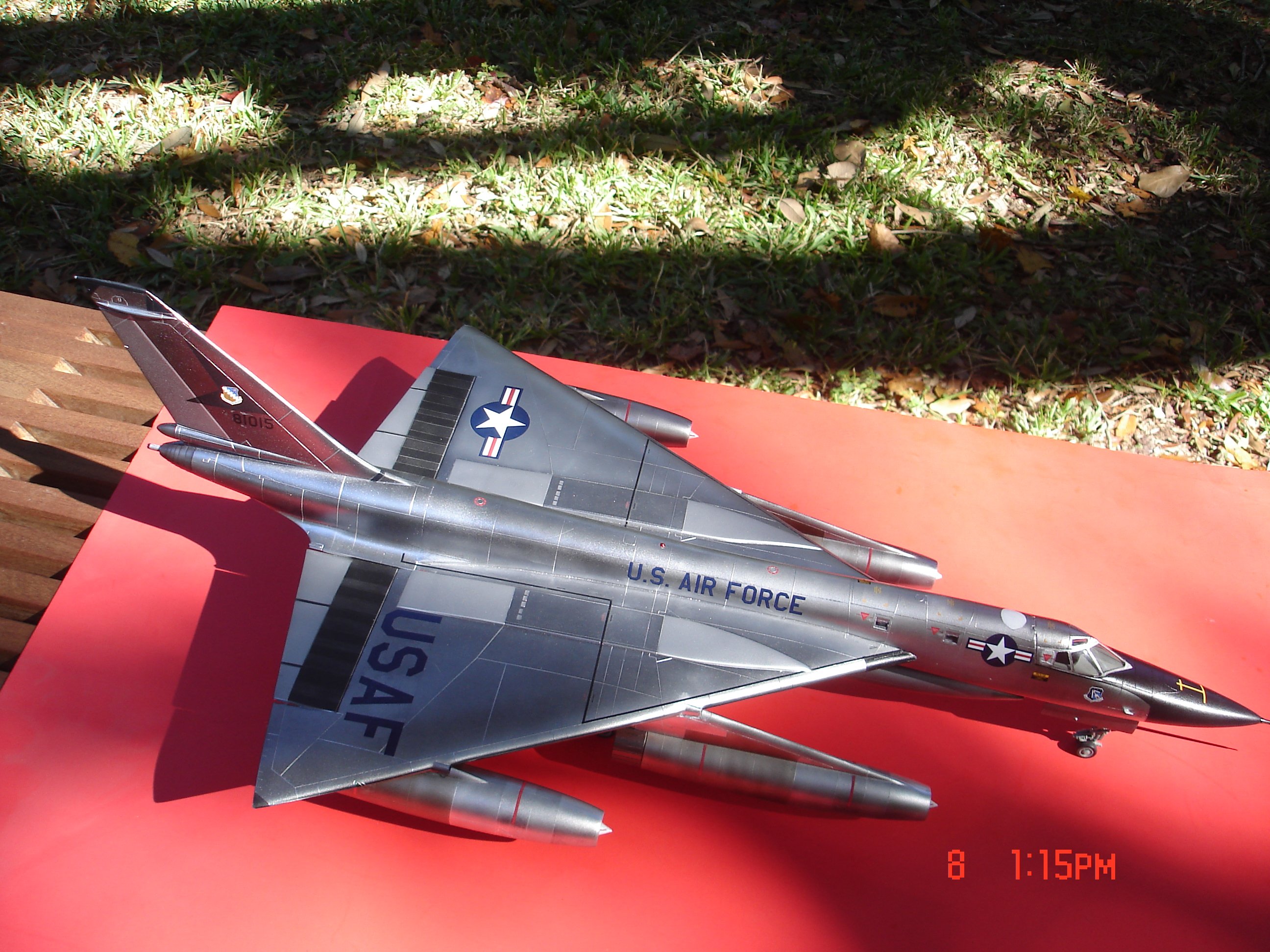

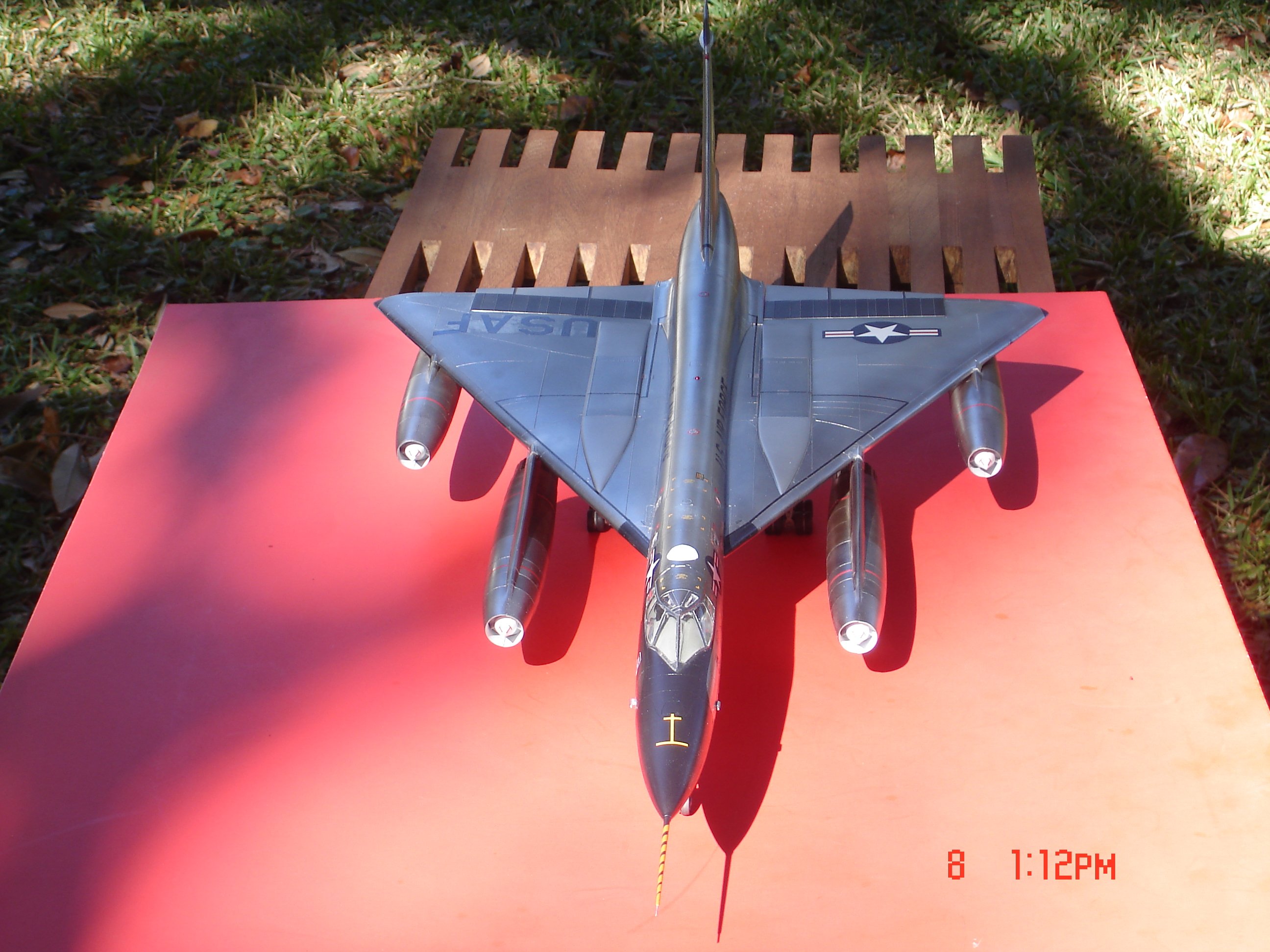

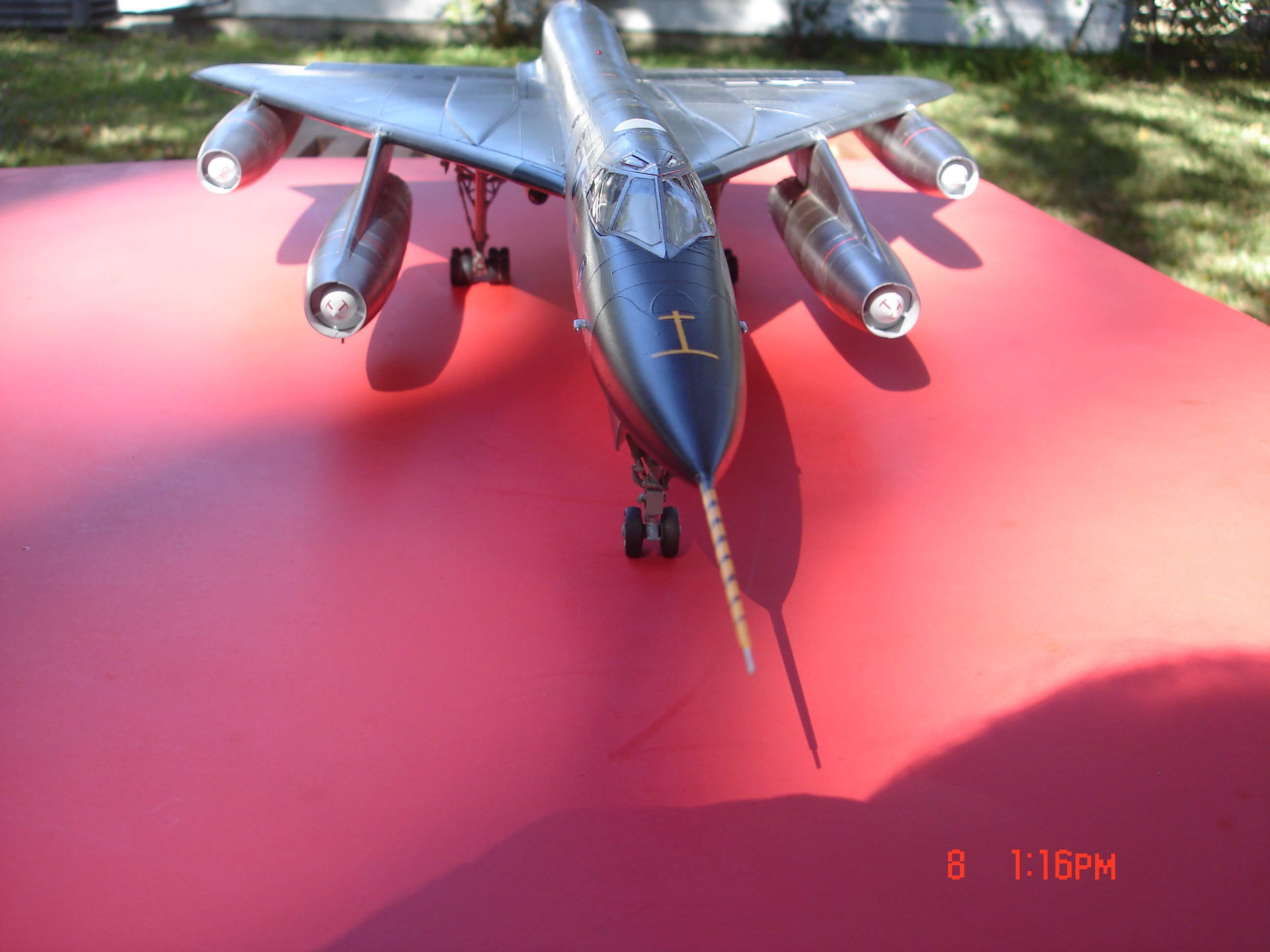

Beautiful work Jav. I really like the color variation between panels.
alan
Thanks Alan not much really happened on these planes panel wise but what you see.I saw two A/C on videos with those strange colored aileron's decided to incorporate it into the build  used AlClad Steel first then it was every other panel I used SNJ powder with a q-tip re-taped and sprayed steel again.;)
